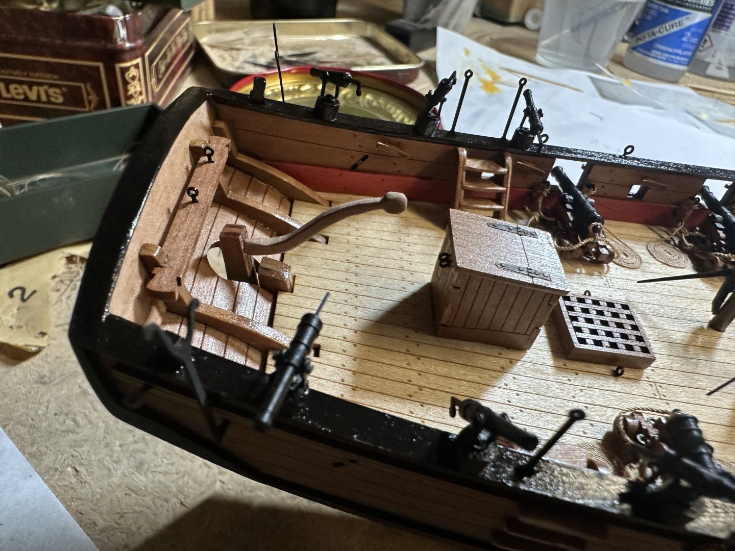

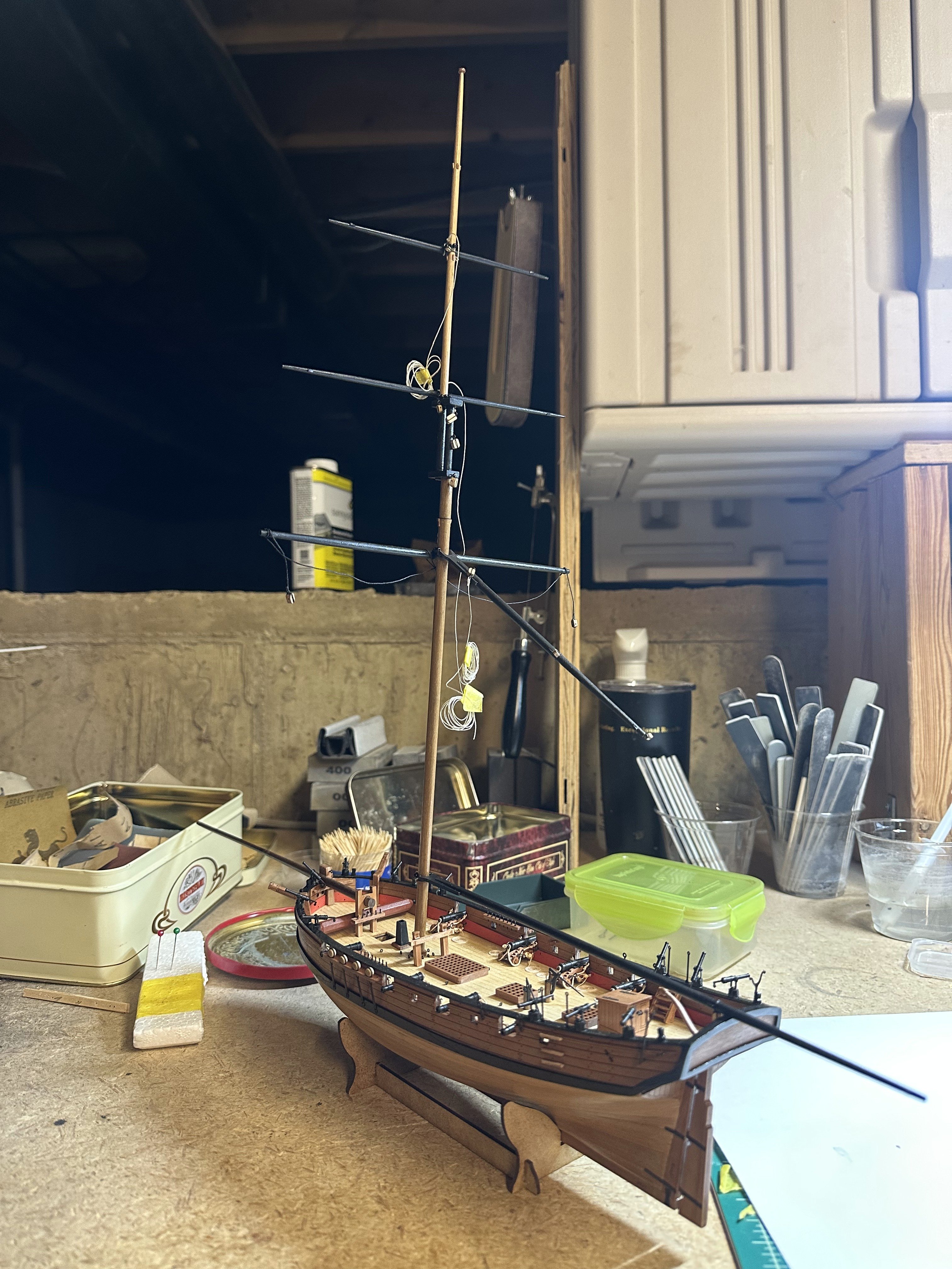

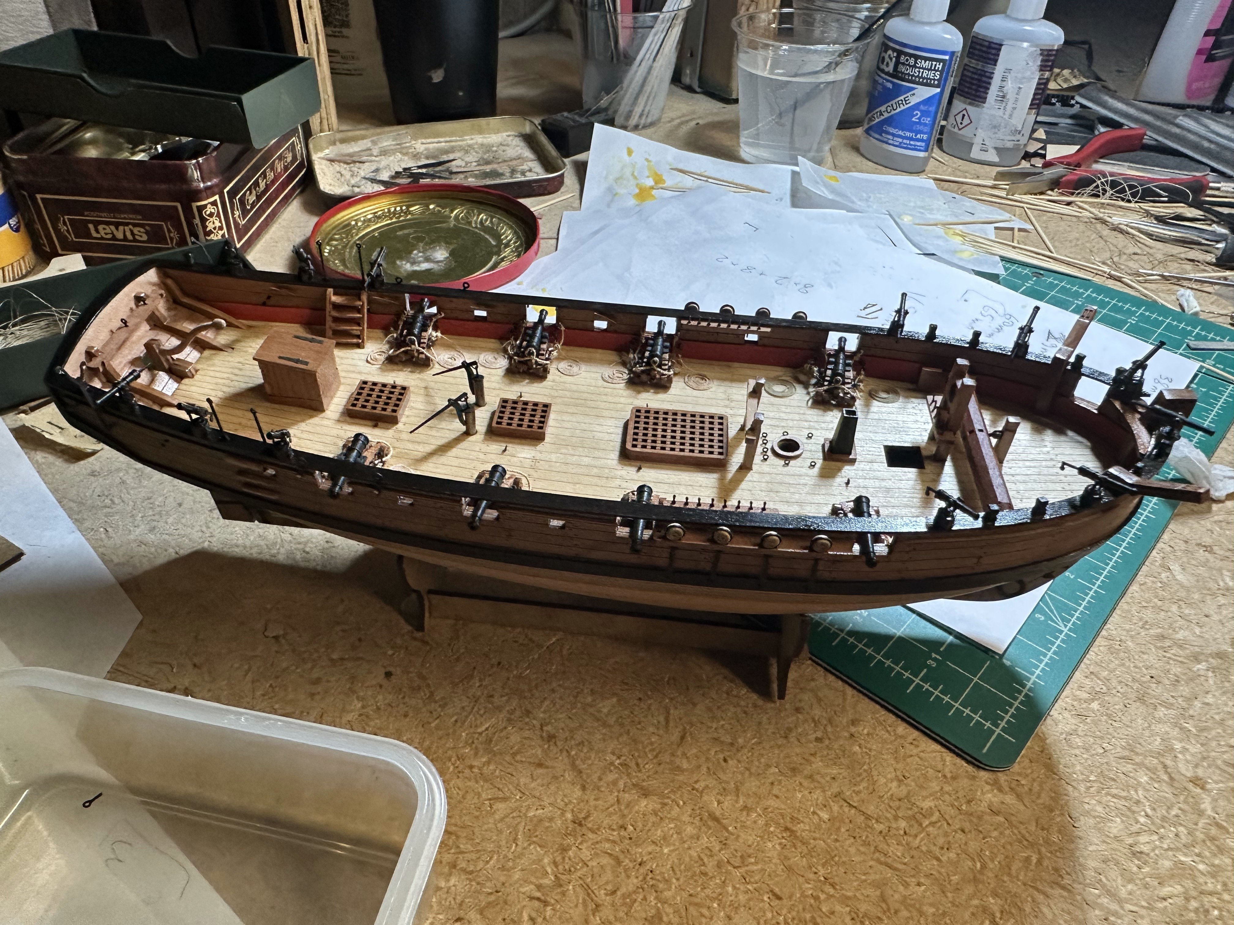

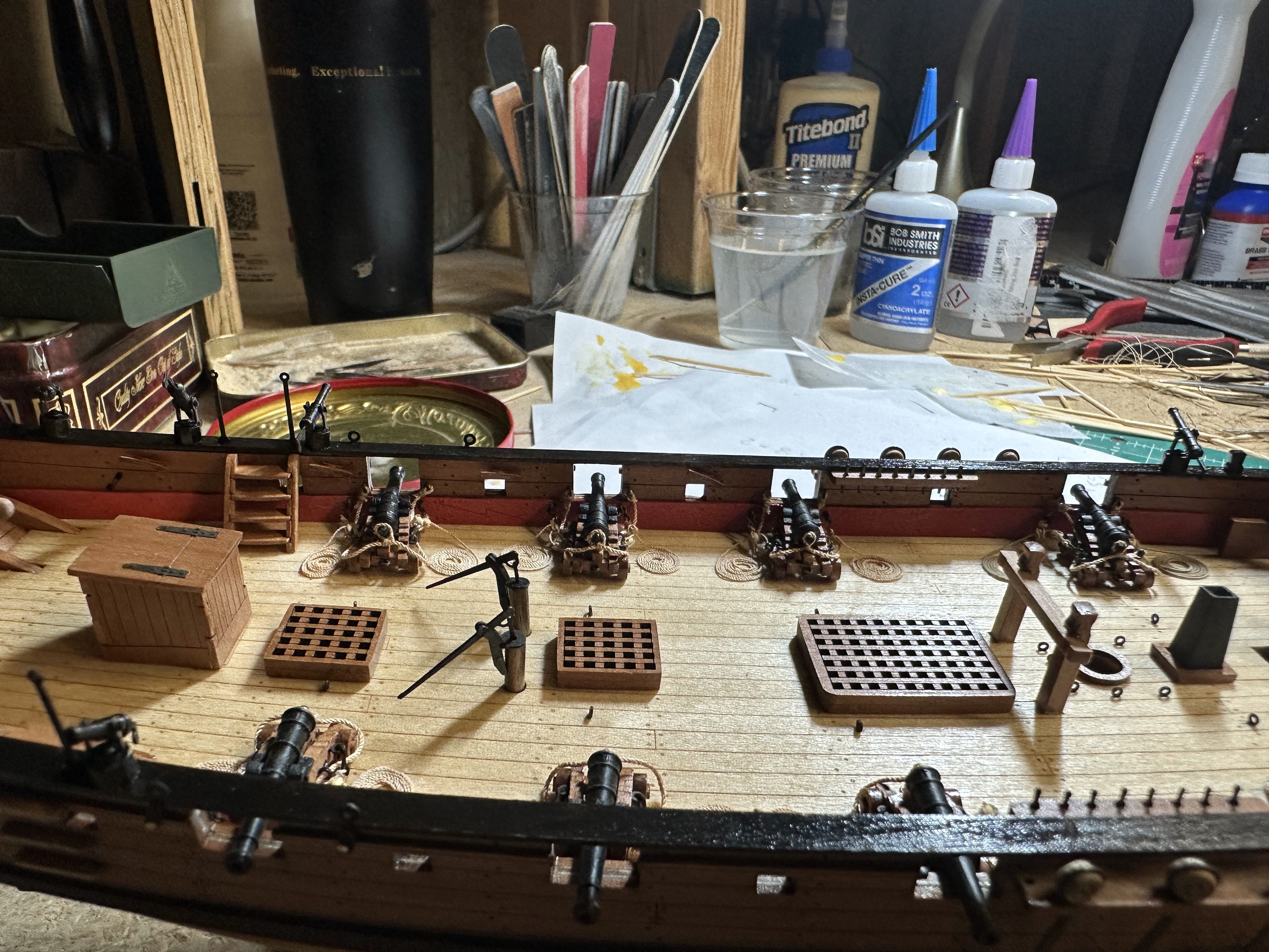

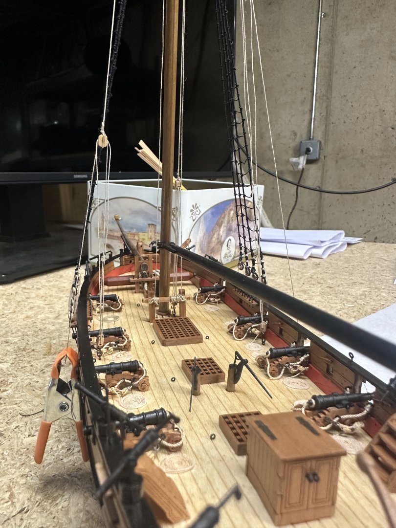

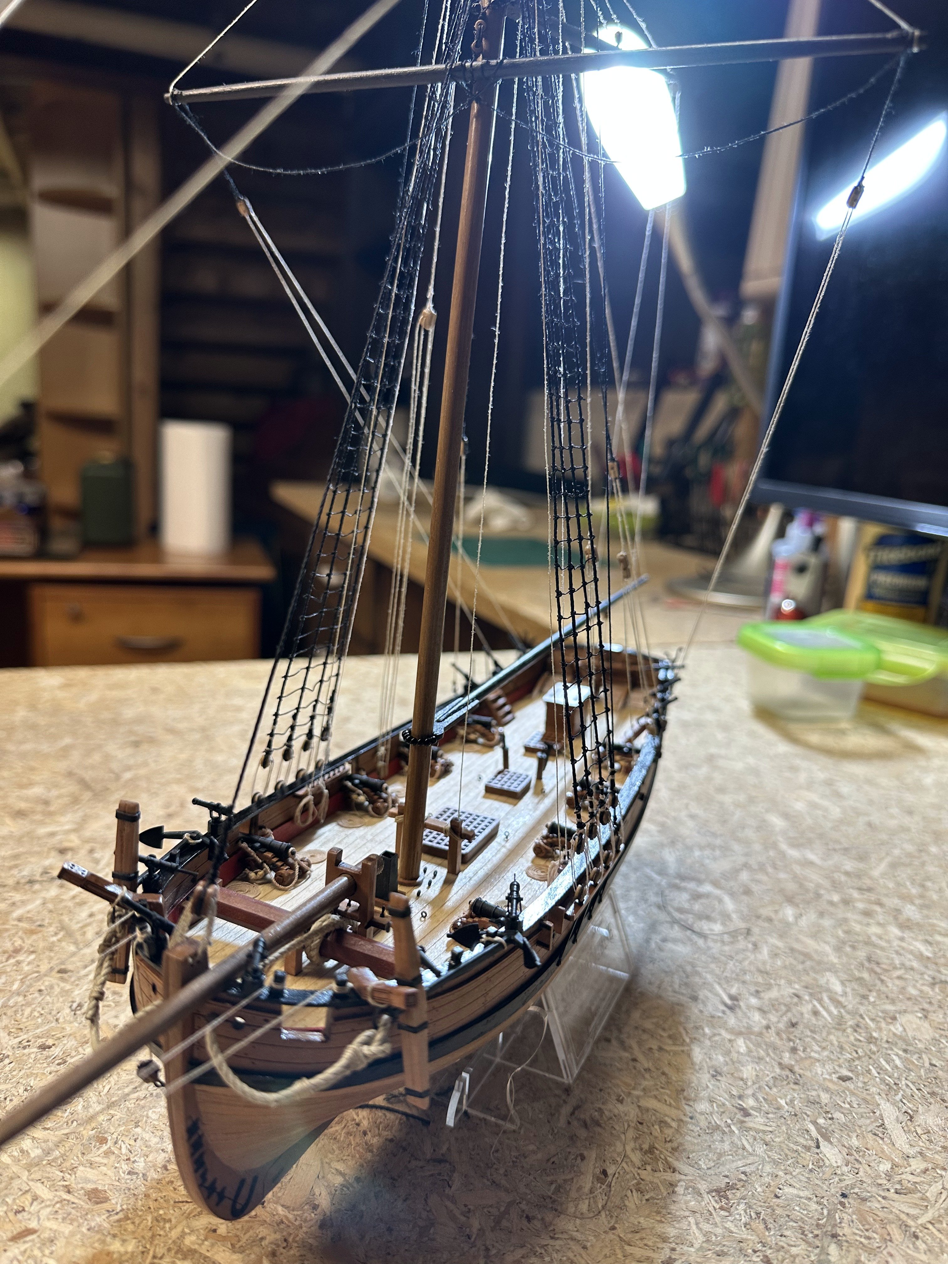

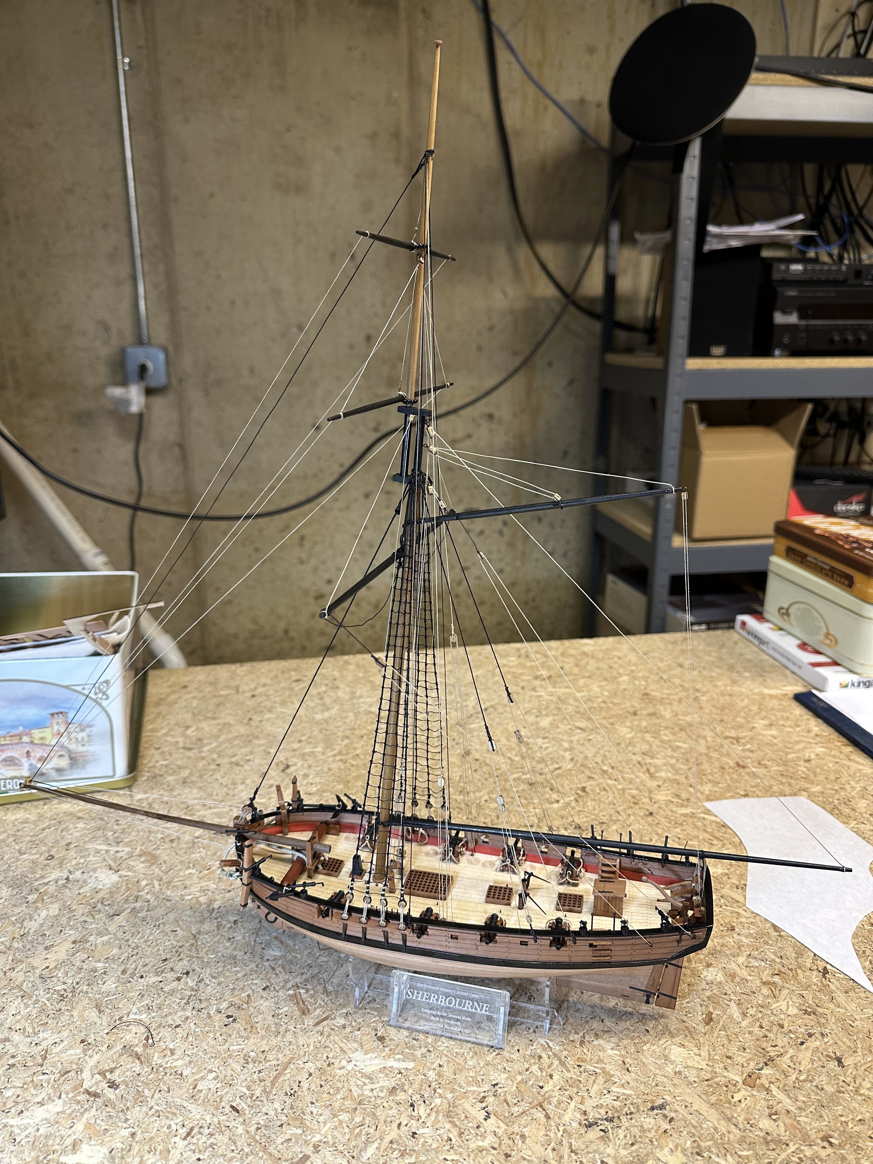

Today it was snowing all day so used the day to work on this... Going VERY slow looks like 🙂 only prepared the riggings for two cannons.  I got the loose rope coiled on the masking tape and put diluted wood glue to hold it together, will see tomorrow how it ends up.
I was hoping if anyone had any suggestions on the best (and easiest most importantly) way to make small eyebolts (1.5 mm).  Since I am rigging the cannons I will end up using 2 extra small eyebolts per gun.  I tried using few methods I found online using the copper wire i purchased but failed miserably.
