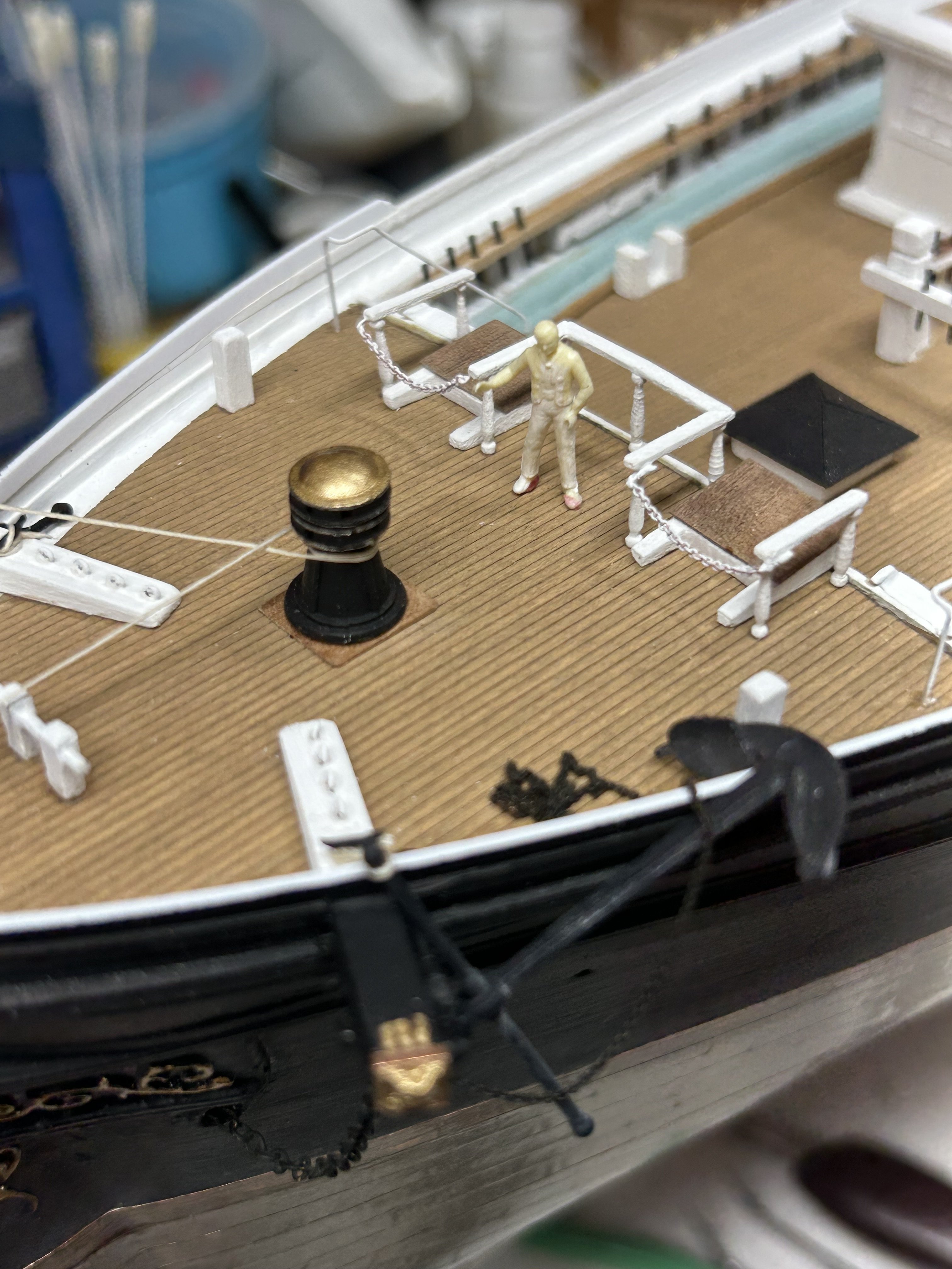

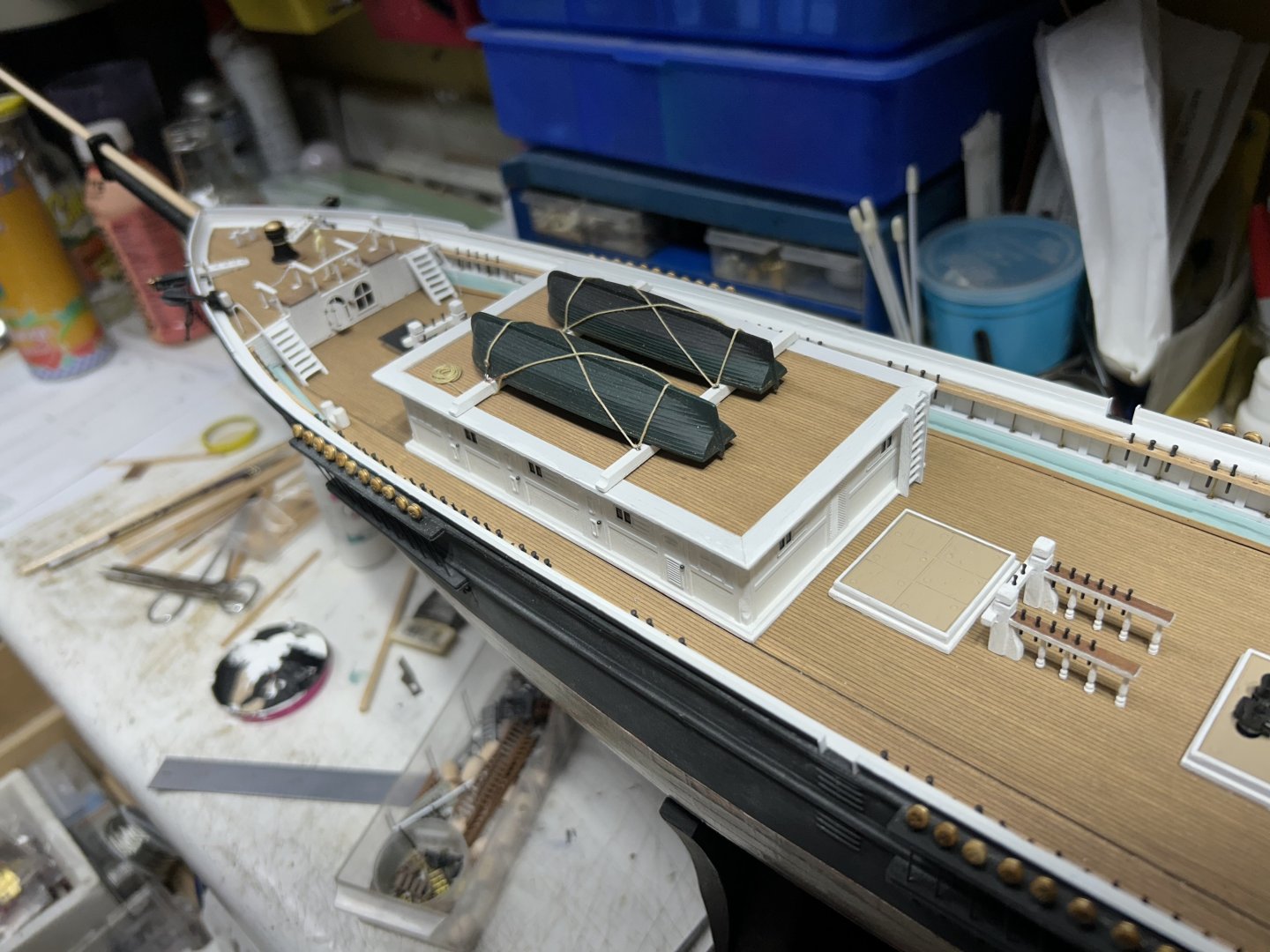

Some extras with the hired help.
Rob
Current build:
Finished build:
Current build(On hold):

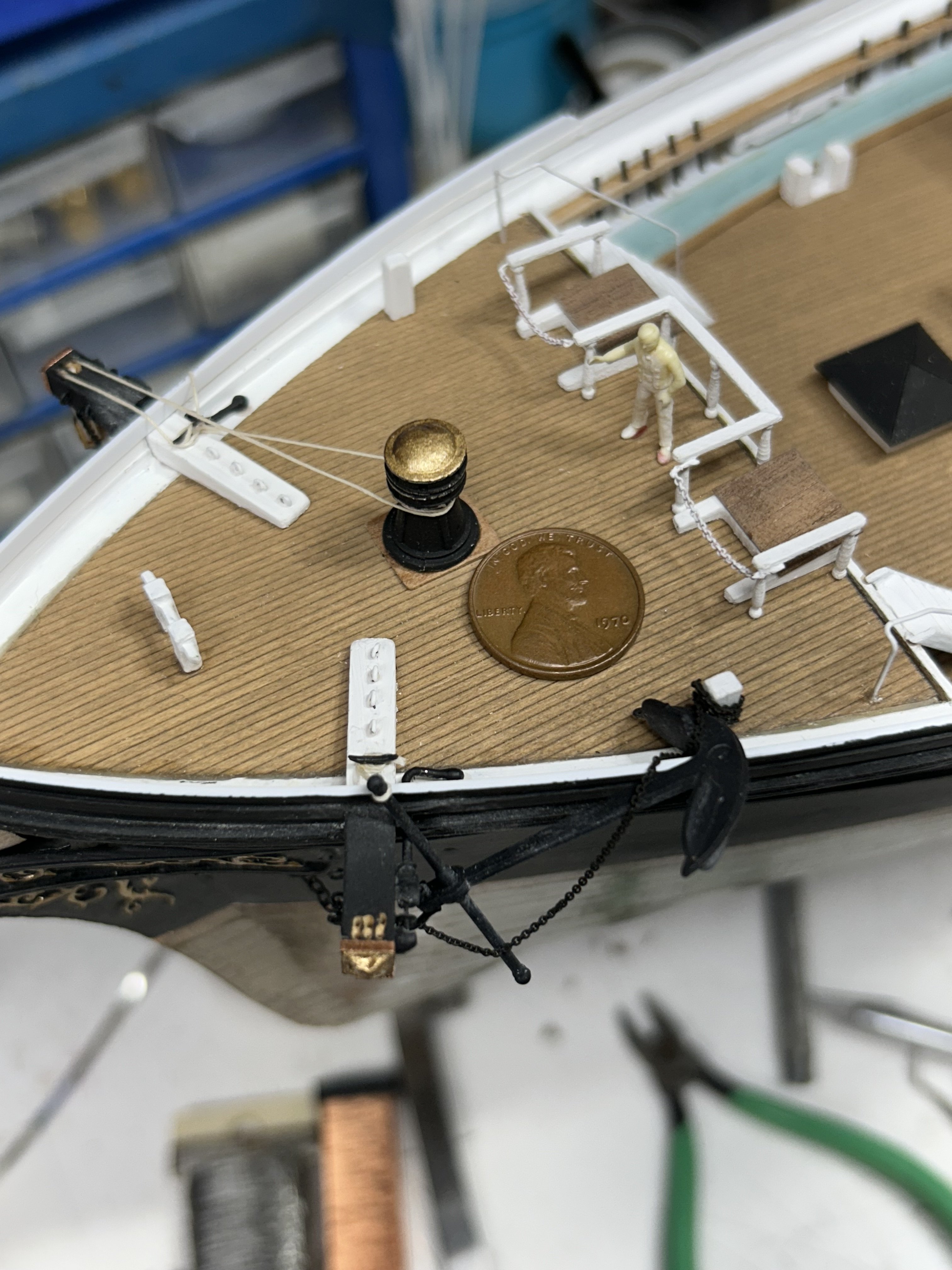

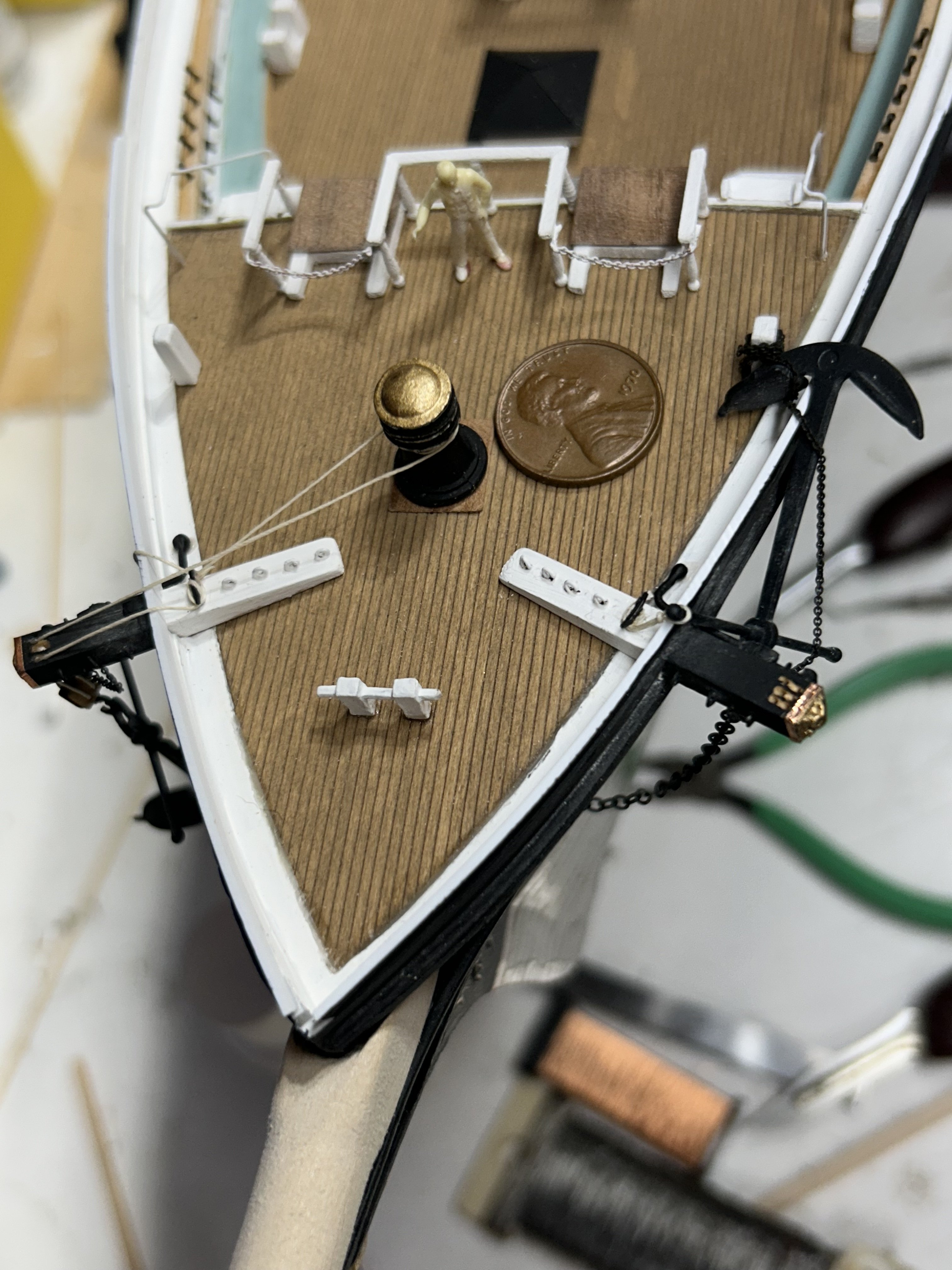

Couple pics with e penny for scale comparison.

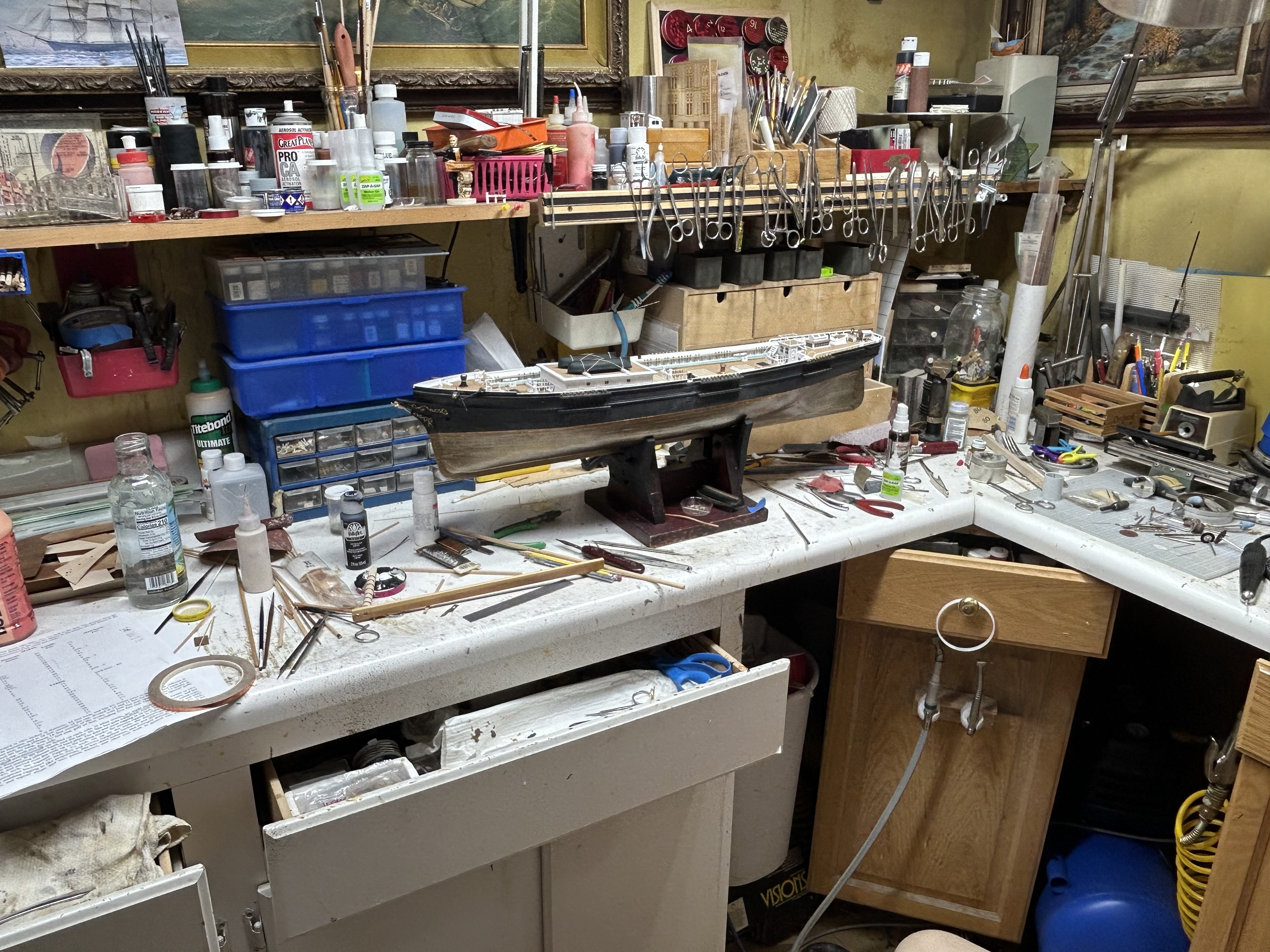

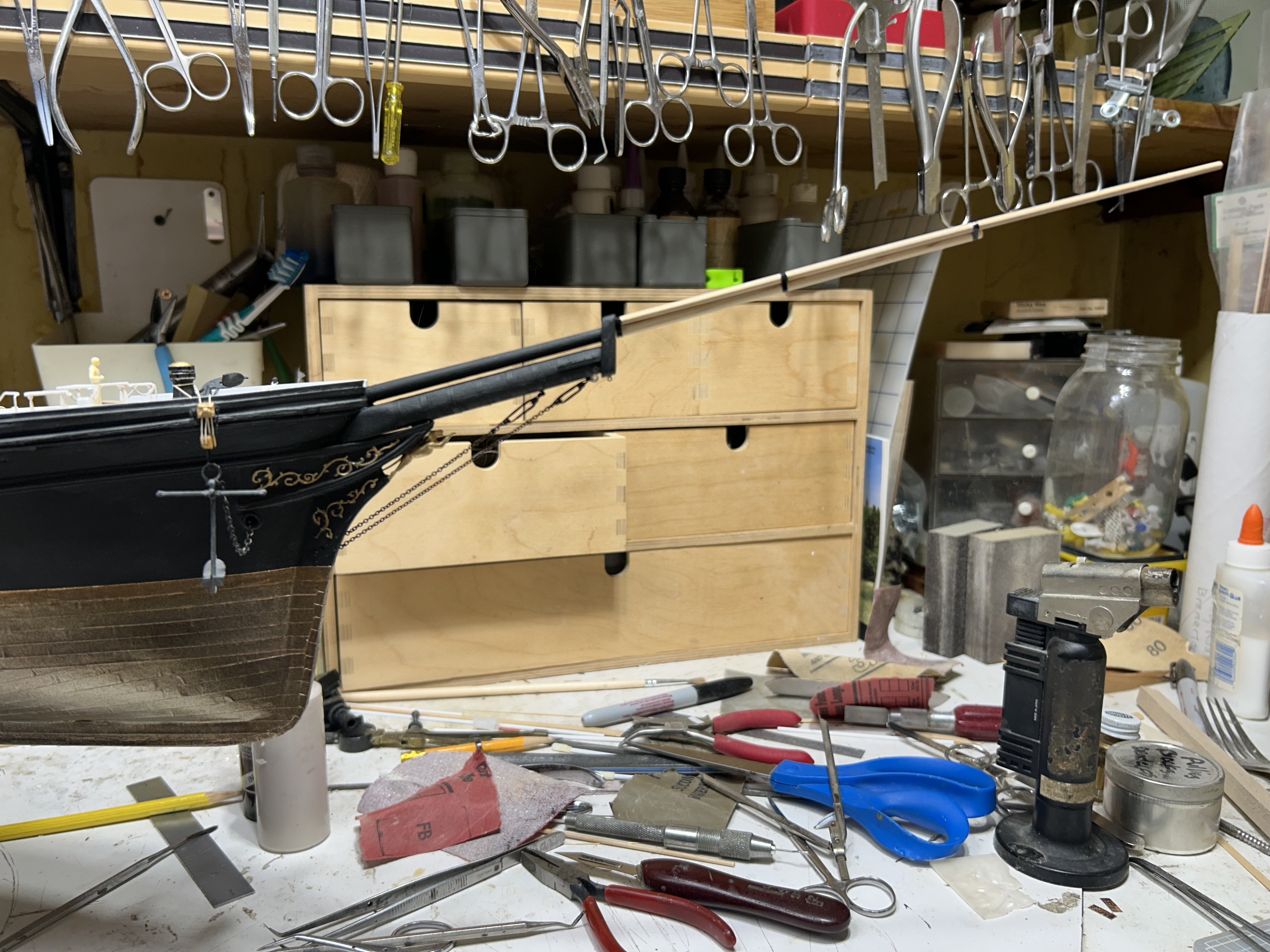

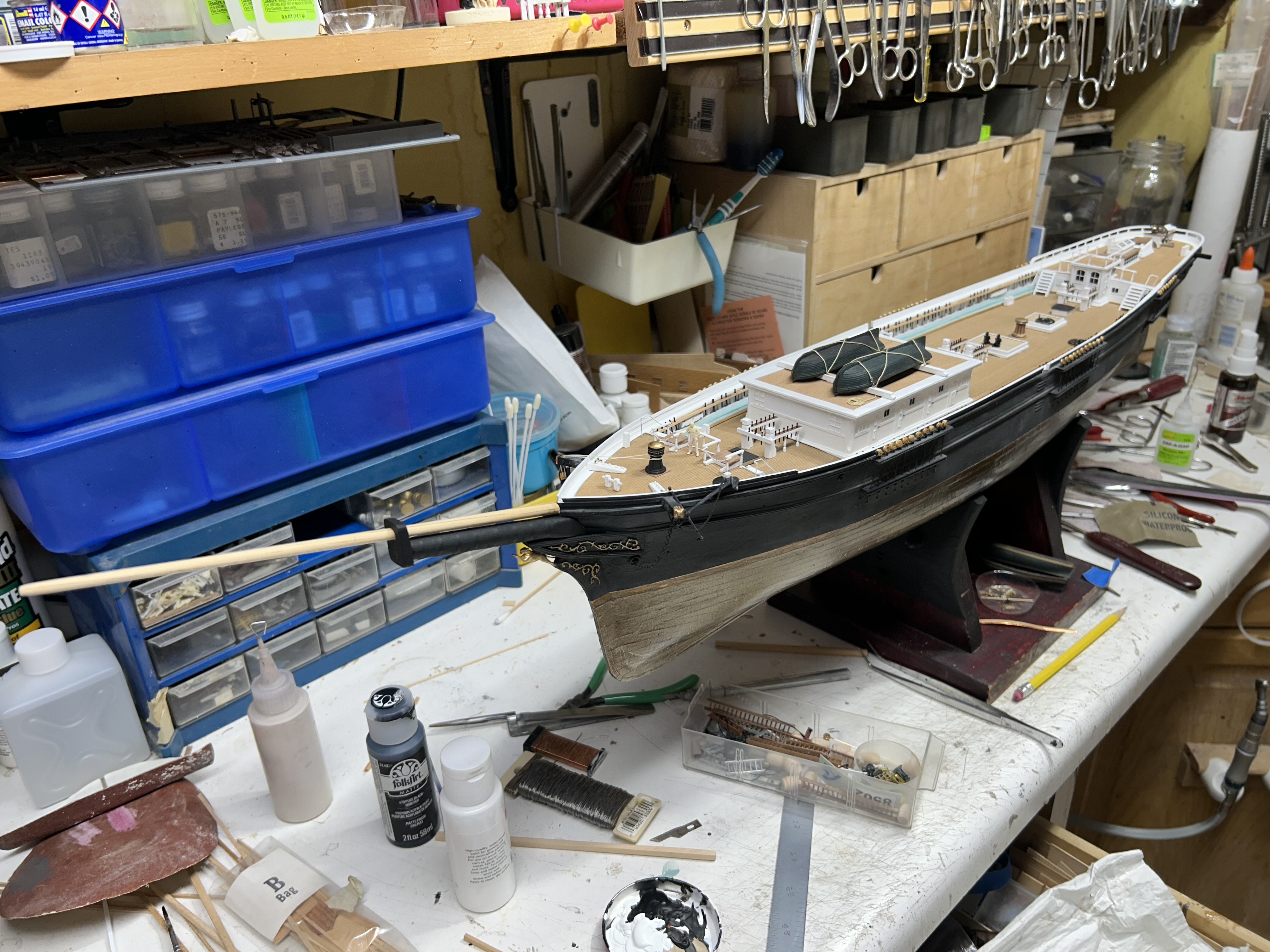

I thought I’d post a picture of my messy shop, where the magic happens.
Rob

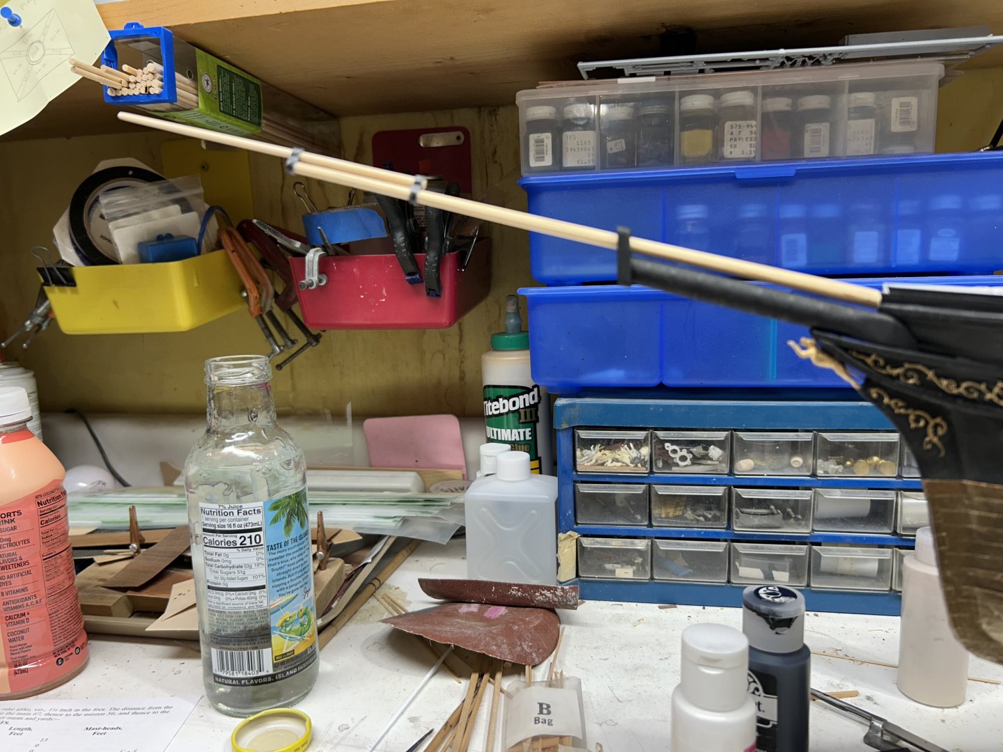

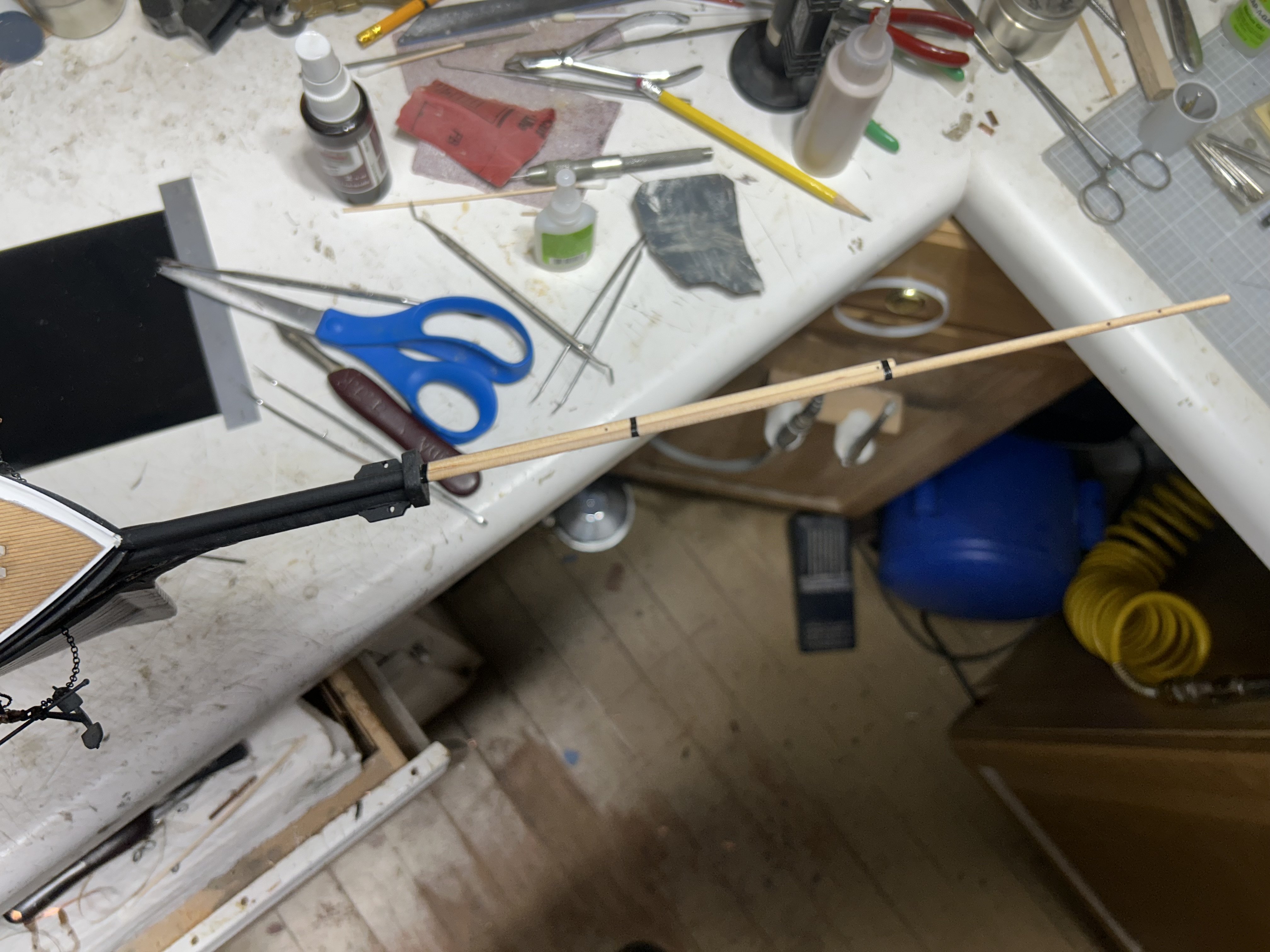

I began the work on the bowsprit and jib boom.
Rob

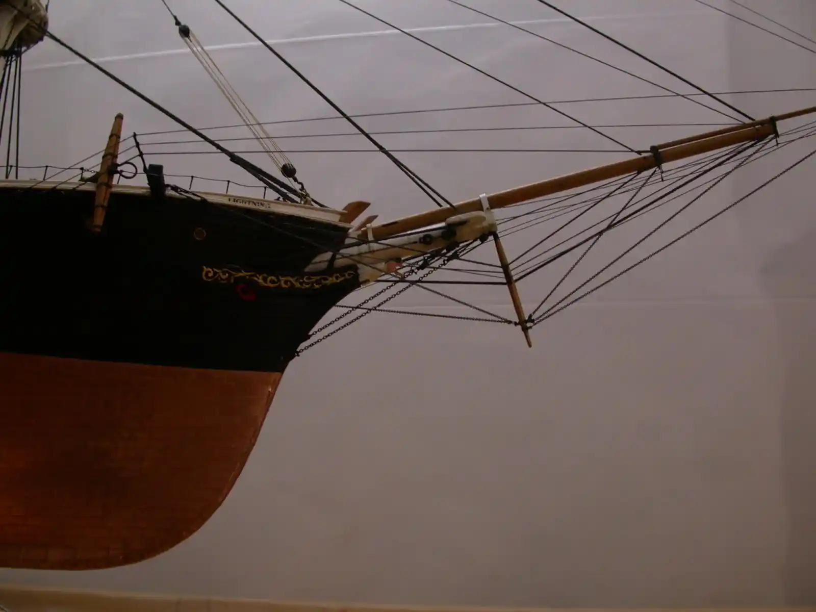

Interesting Rich.   McLean says she has a 24ft long bowsprit, a 38ft long jib boom,(to include both inner and outer jibs, divided at 18 and 15ft).  The flying jibboom is 18ft outside of the wythe.  I'm not fully sure of that term, or how it is applied here...but it represents a vertical line as in masonry.  Somewhere between 62 and 80ft...I suspect. Personally,  I'm considering Von Statina's wonderfully crafted Lightning's bowsprit design, which includes the jibboom (inner and outer) and flying jibboom arrangement, as seen here. The flying jib's doubling length, appears to mimic that of the jibboom and bowsprit.  I suspect from what is described in both descriptions, of Staghound and Lightning.....they are similarly designed.  Nearly the same terms other than the dimensions are used.

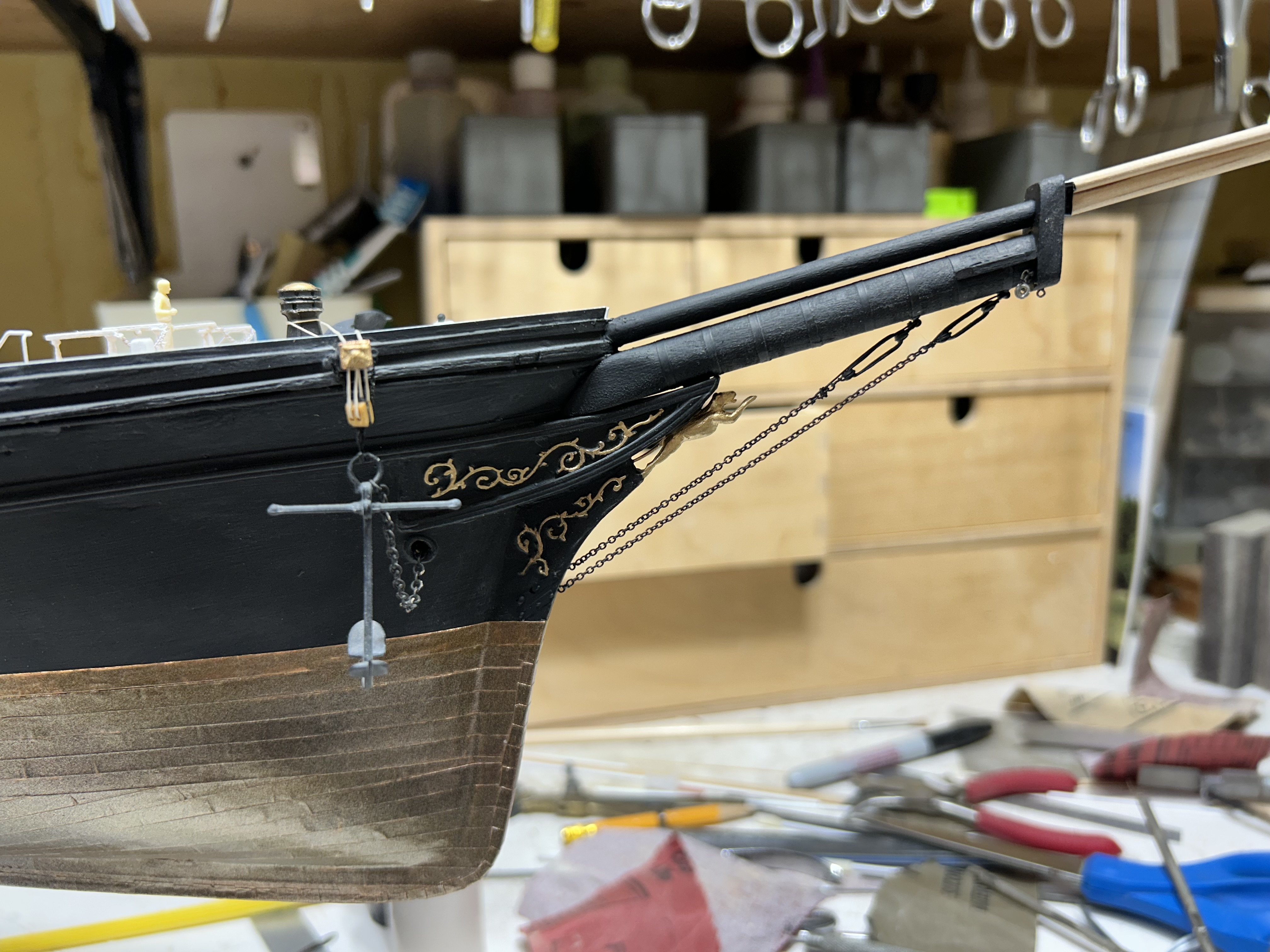

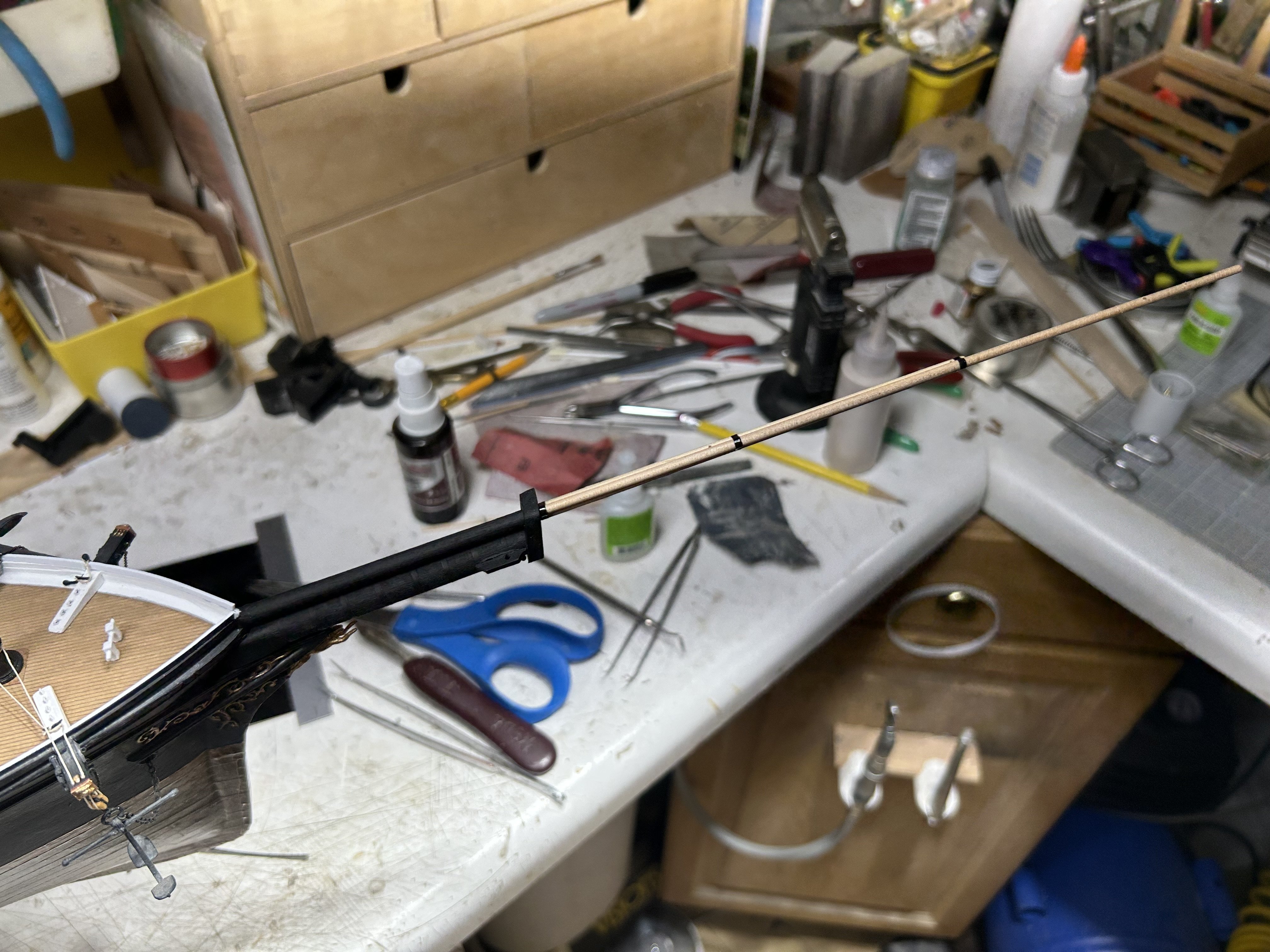

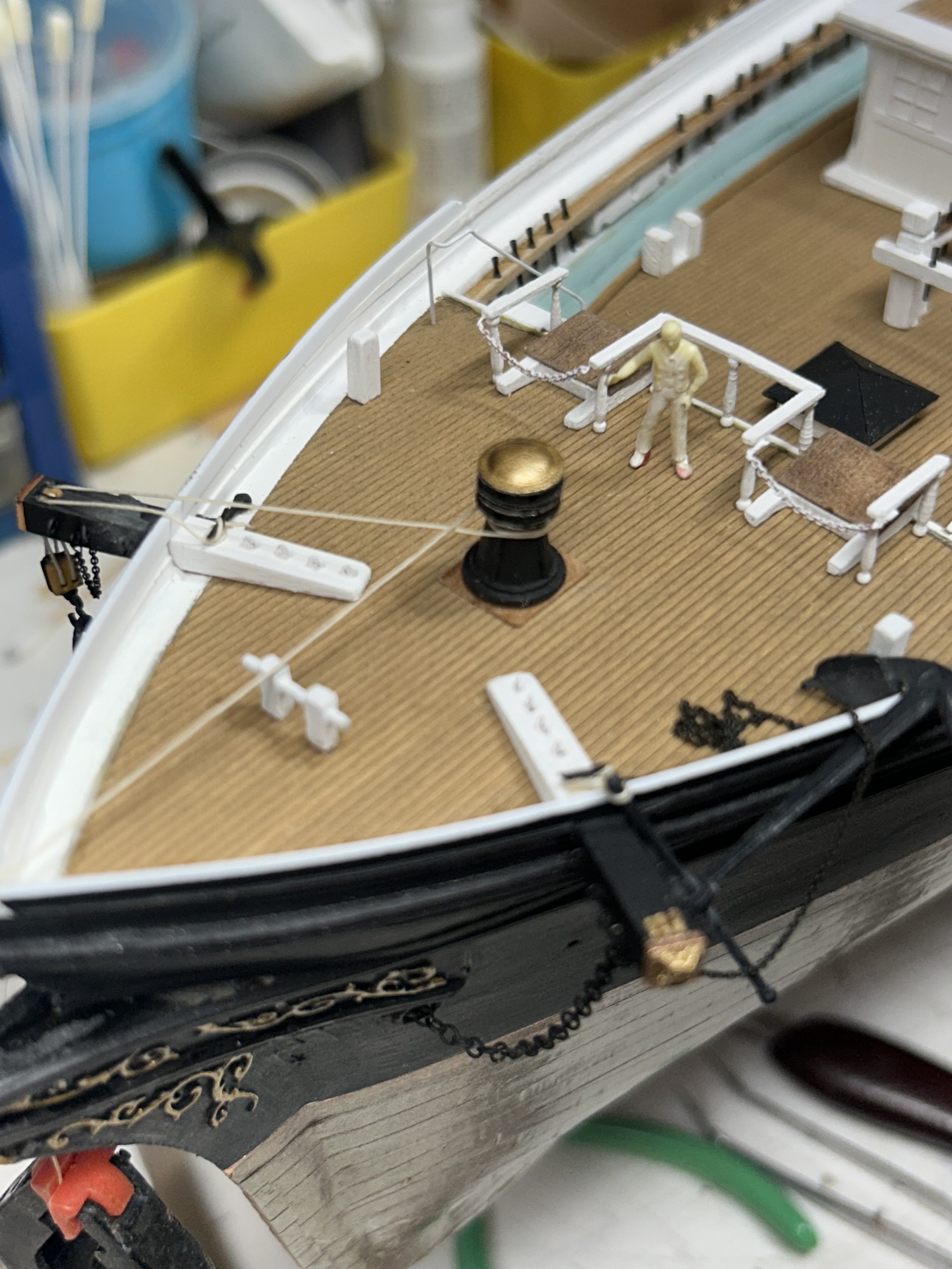

Worked a bit on the bowsprit.
Rob
Current build:
Finished build:

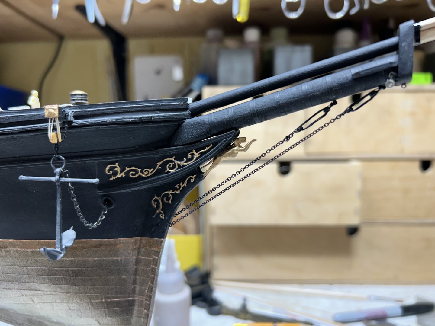

Not sure I like the brackets.   I might make a change.

Rob, a thought. Is it possible that the top of the jibboom and base of the flying jibboom might have been flattened to guarantee no possible rotation of the flying jibboom? Just like both inner bowsprit and jibboom were both carved back to rectangles to prevent any chance of rotation.
Not sure that is the solution.  Bruce simply rigged the flying jib as I did.  But I think I need to reduce the diameter of the jib and thus make the bracketing lighter.  Here is another of Bruce's work...you can see the space clearly between the booms.  The flying jib is rotated to the right to permit the stays clear passage.

Rob, since the jibboom was 16" diameter, maybe the flying jibboom was 14" diameter. Her 60' spanker boom was 12" diameter but that probably didn't need to support sailors. I think I read that Bruce secured Crothers' plans, which maybe illustrated the offset flying jibboom.
If that flying jib gets any smaller....the sheeves for the outer stays will surely compromise the boom and make it less resiliant to stress, and more apt to breakage.  I think I'm going to recreate my iron works to permit the flying jib to rest against the outer jib.  Reducing the gap between jibs and permitting a cleaner more continuous projection of booms.
Trick is....the jibboom cannot be modified untill it is passed through the endap of the bowsprit....locking it in place.  I will have to make all the necessary additions to the bowsprit...prior to any mods to the jibbooms.
The mods to the flying jib will have to wait till the finishing of the bowsprit and I'm ready to glue it in place at the prow of the hull.  Once the bowsprit is glued on....I can then glue the  jibboom to the bowsprit, and then, I can glue the flying jib with the new hardware to the outer jibboom.   I hope that makes sense.🤓

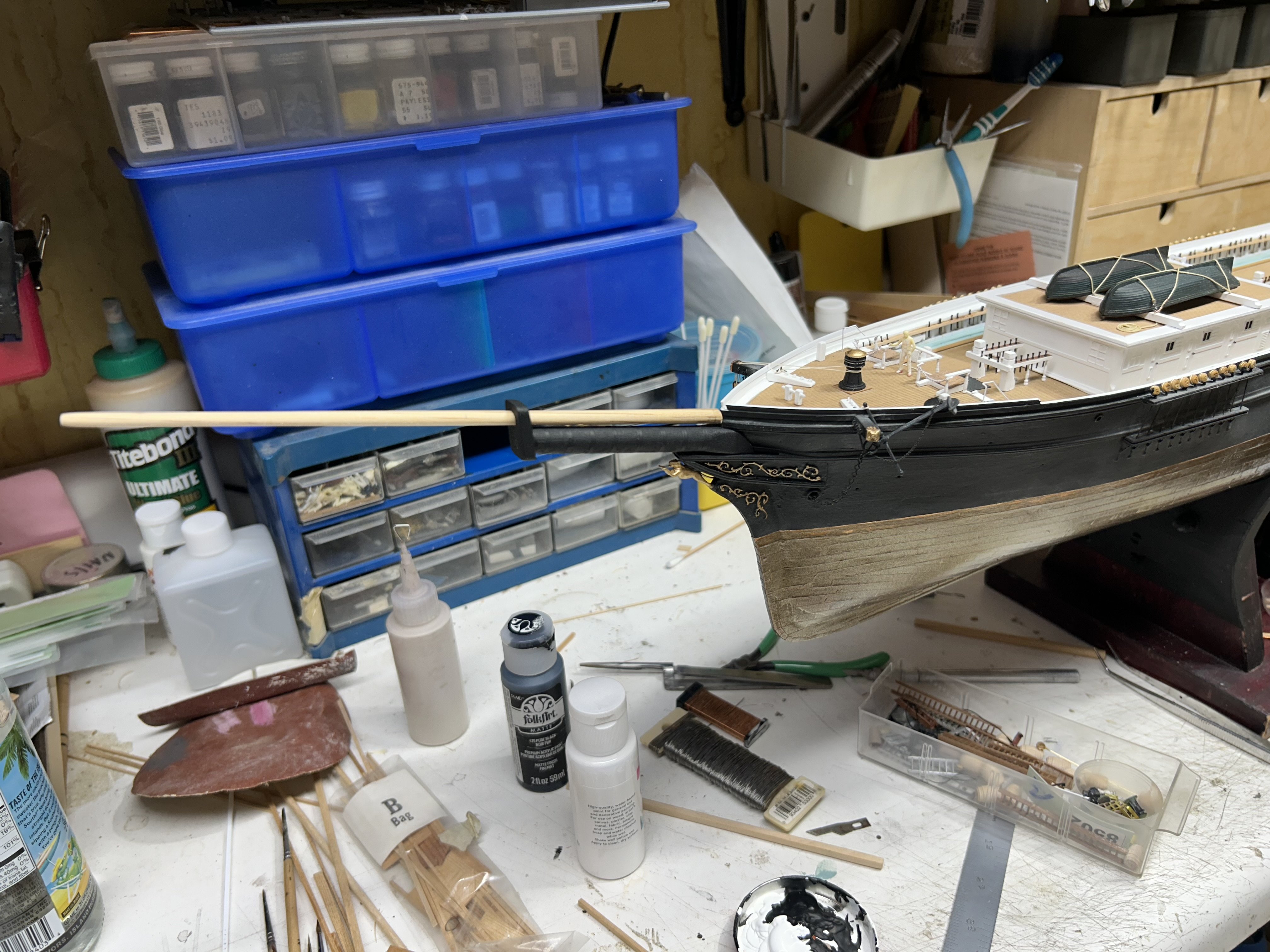

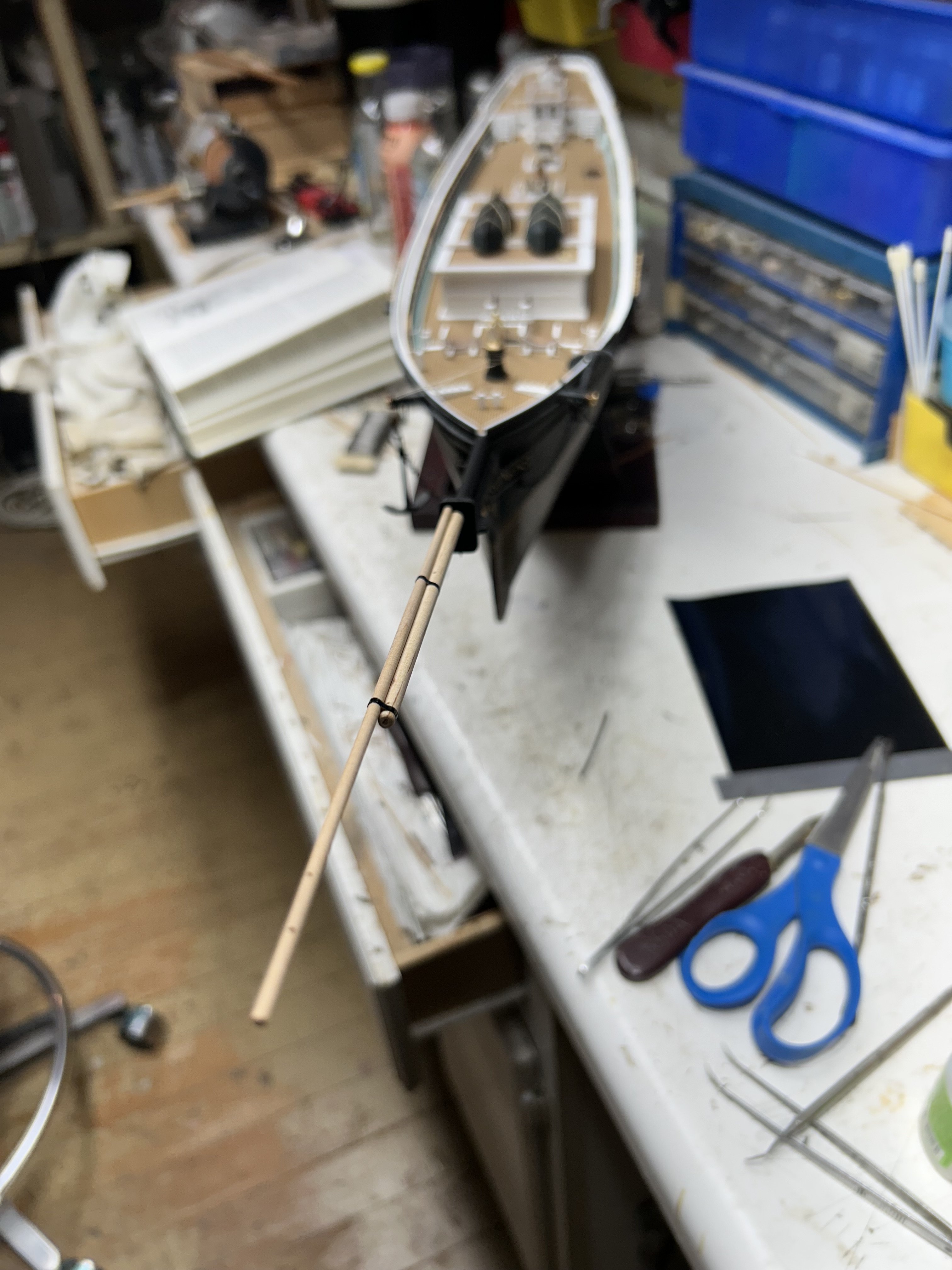

Worked on the flying jibboom.
Rob

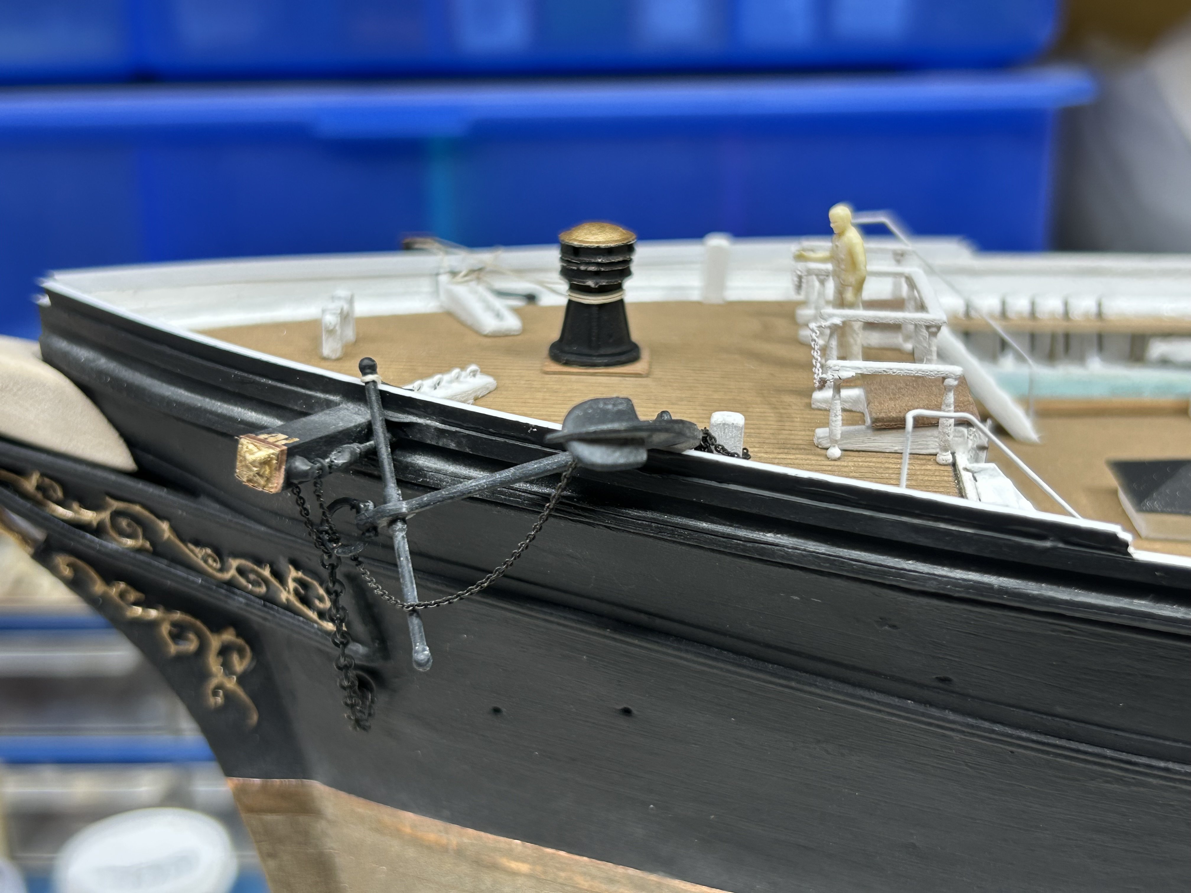

Putting on the bob stays.
Rob
