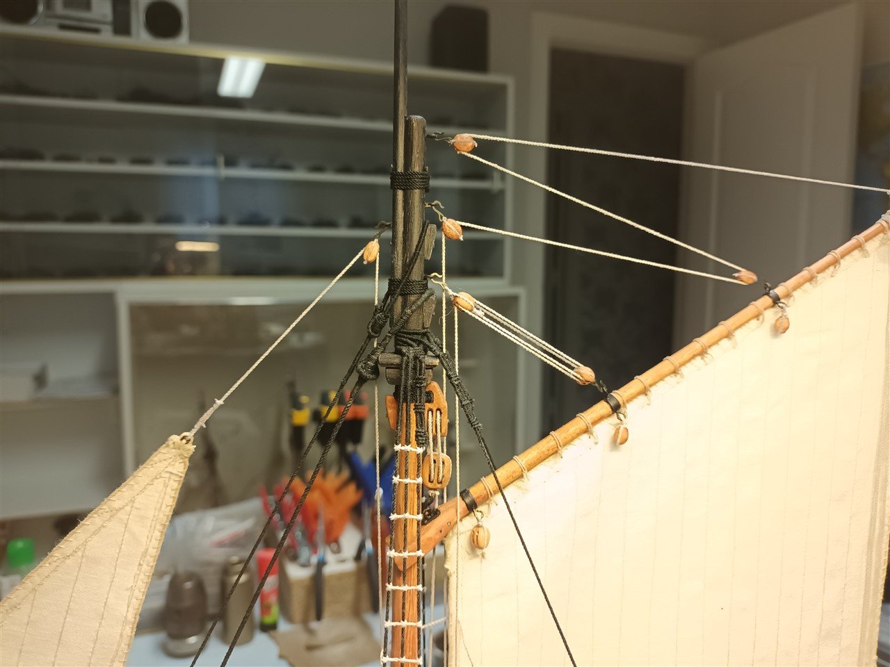

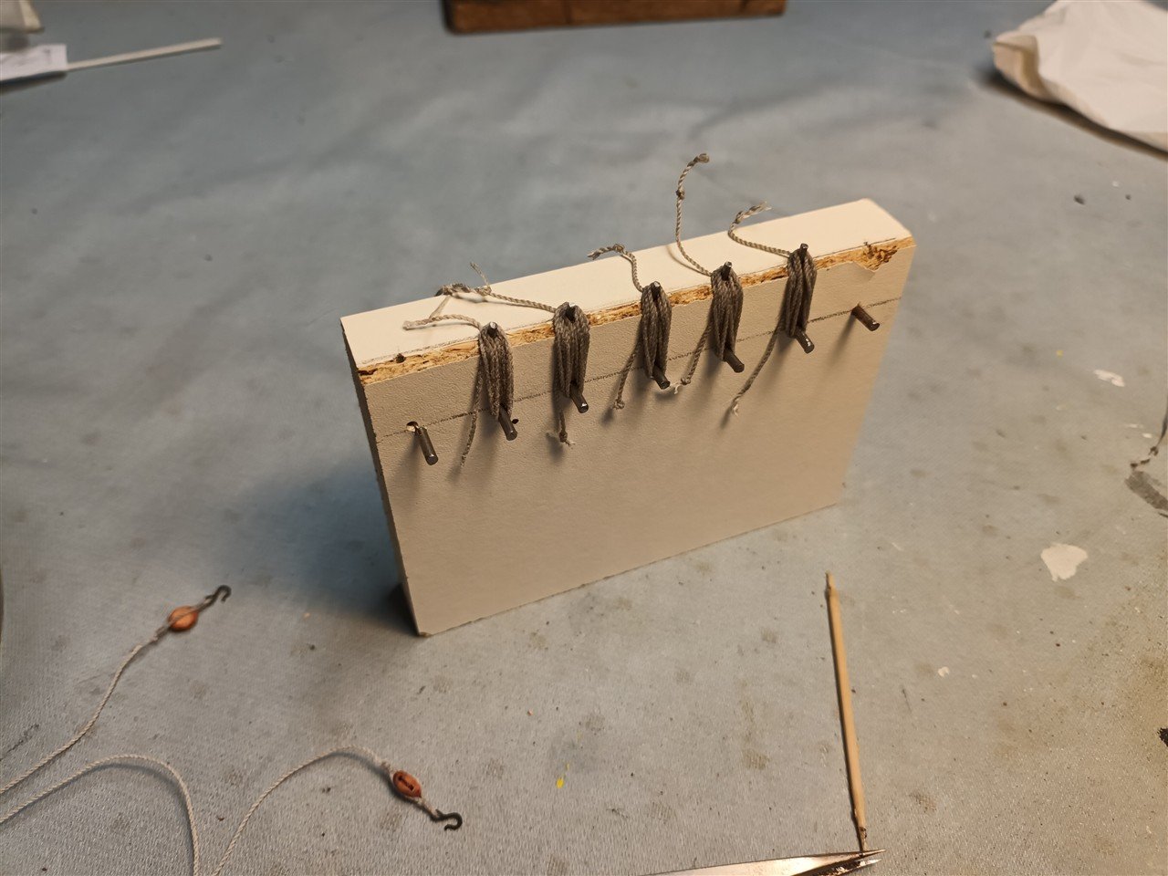

Standing rigging.
First, learn how to make rope.
Prepare the deadeyes.
Prepare the ropework.
Start.

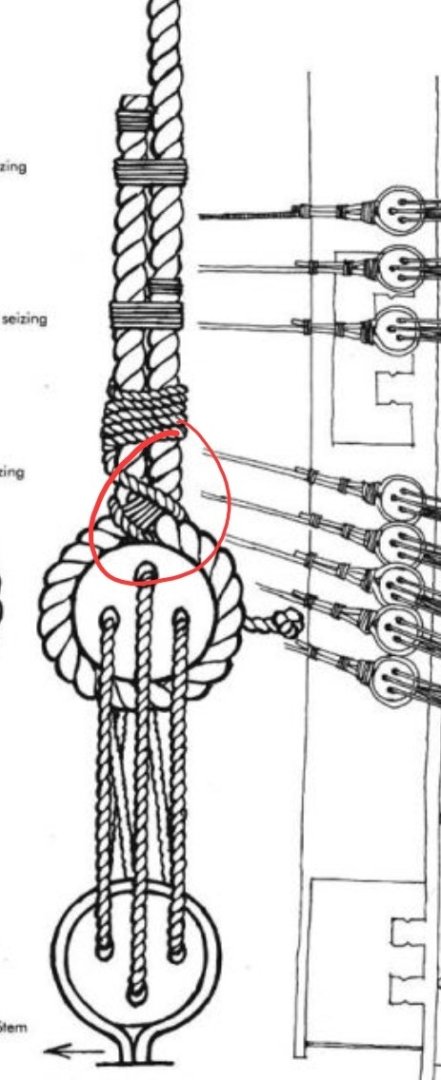

Due to some errors in the attachment of the top deadeyes, they are twisted.
Fixed this way. Probably historically incorrect, but it looks better.
20251129_085159_1280.jpg.0bb37050d94919e459cce330bf4fa4d2.jpg20251129_091600_1280.jpg.baacc862e2e1e5f304443402d395e98e.jpg

15 hours ago, 72Nova said:
Nice work Patrick. I've found twisting the dead eye one turn in the direction of the twist and redo the lanyards corrects this.
Michael D.
Thanks.
I tried twisting, but without success.
I think this is the reason the deadayes twist.
I used this method,  wrapped around each other.
instead of this method. Next to each other.
By the time I realized why, it was too late.
And I didn't feel like doing it all over again.
Edited by Baker

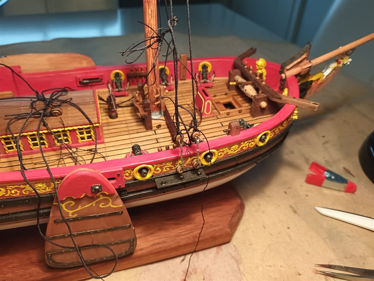

The standing rigging is ready and the 2 leeboards are rigged.
20251129_153548_1280.thumb.jpg.0f735381d853be33efbfeb7713c26d1d.jpg20251204_131155_1280.jpg.e51c29fa82dc08047f19f1c9eaef03ab.jpg20251204_131204_1280.jpg.ba2090063a6abc226206db2563abb7d4.jpg20251204_131251_1280.thumb.jpg.79a2131f7ca9e1f4610d1ffb5e5869ac.jpg

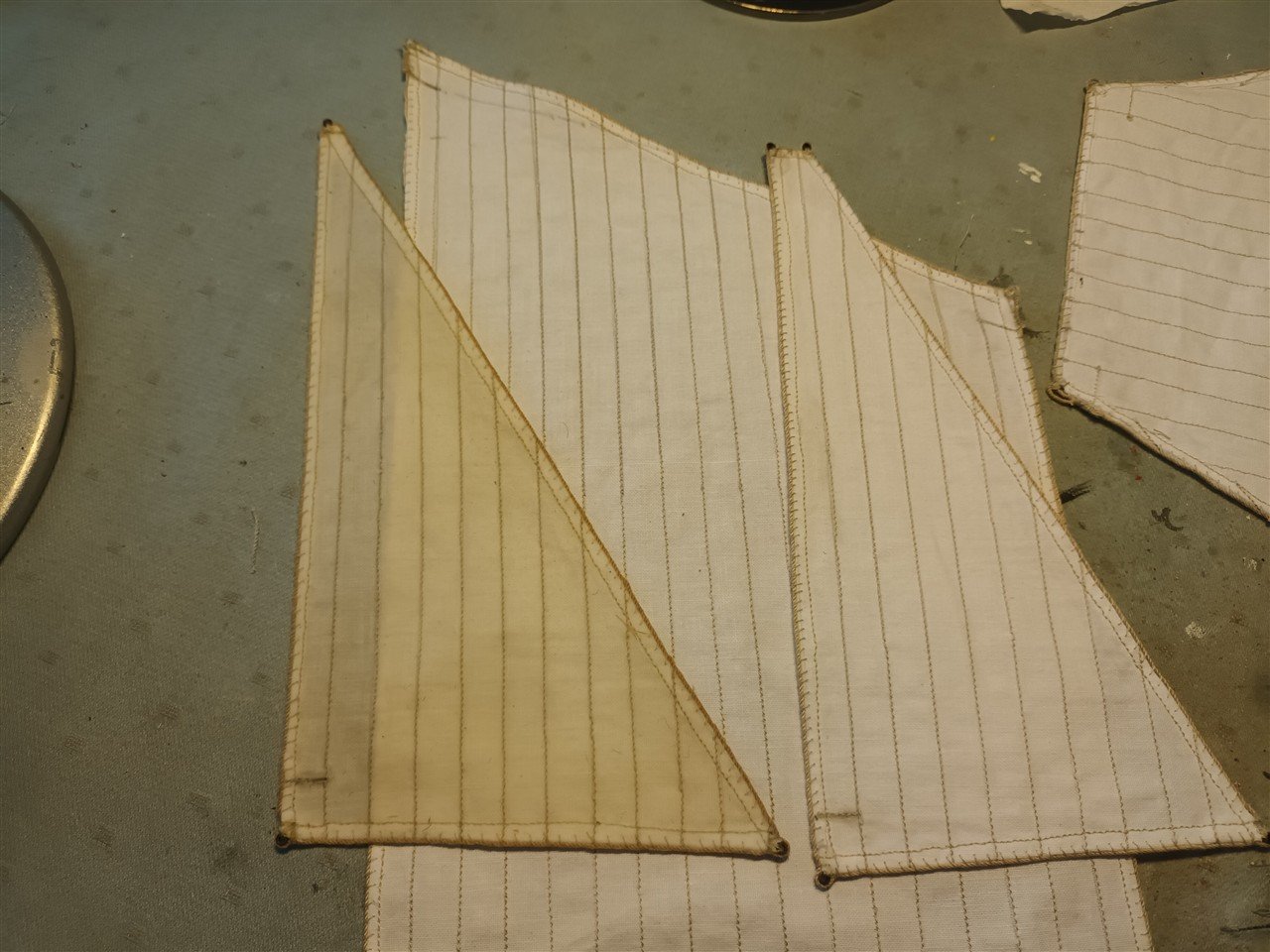

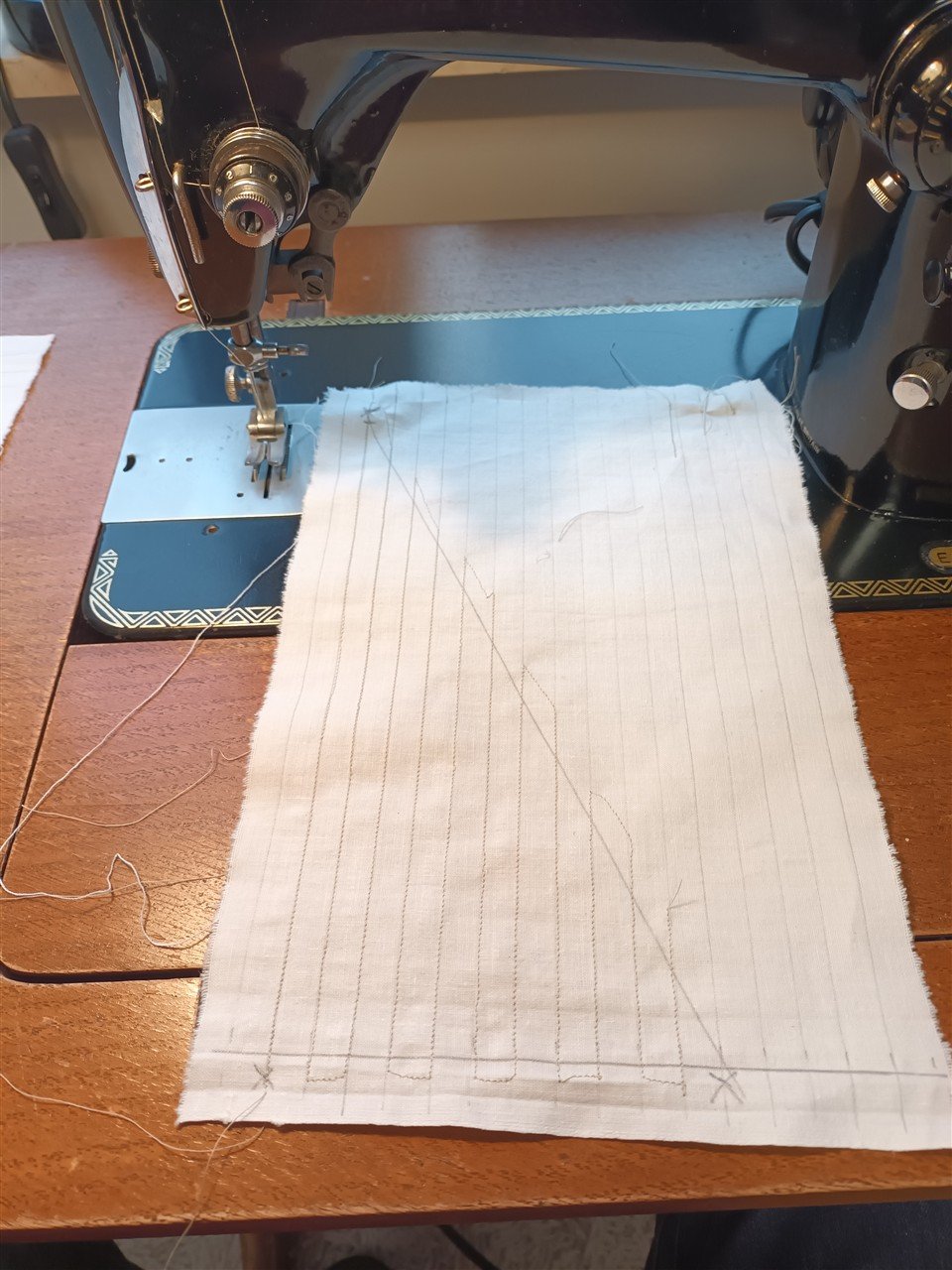

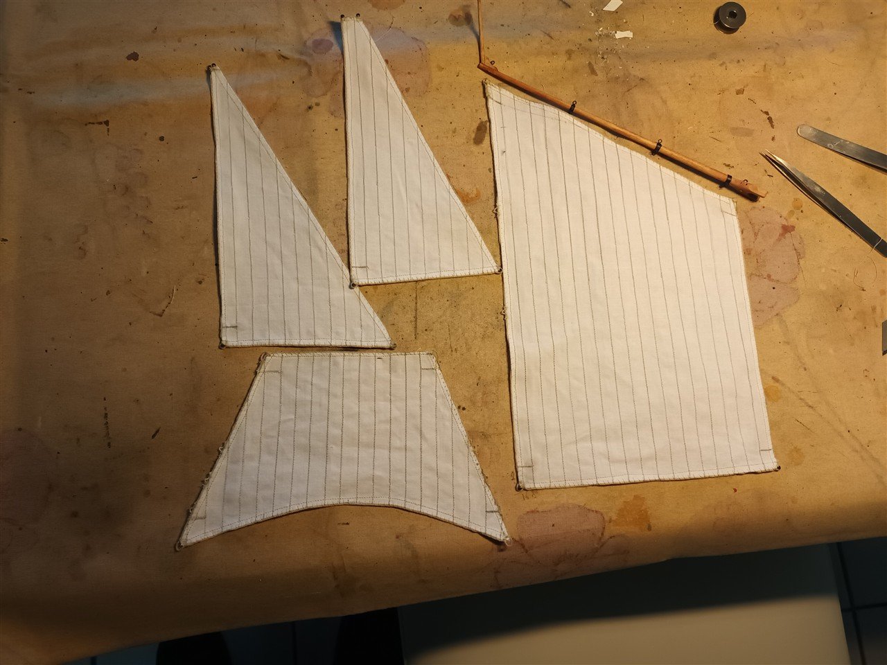

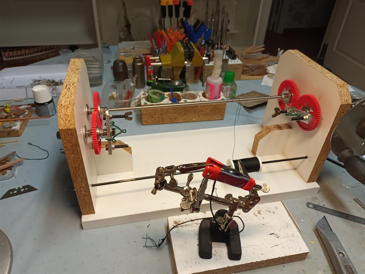

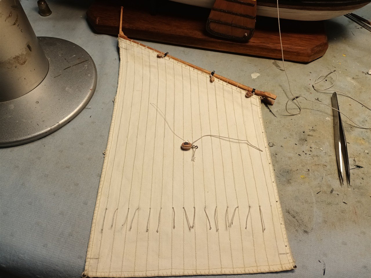

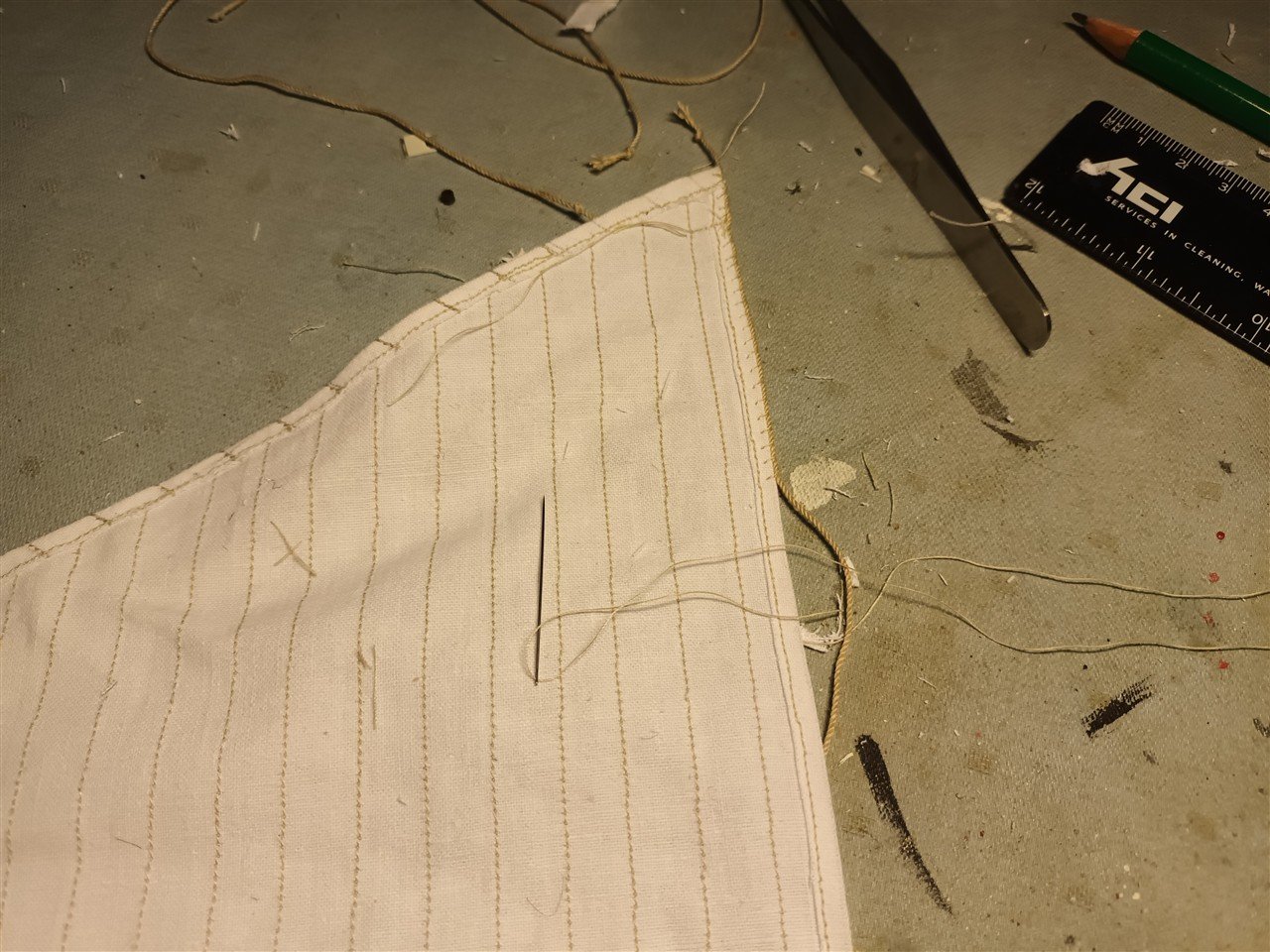

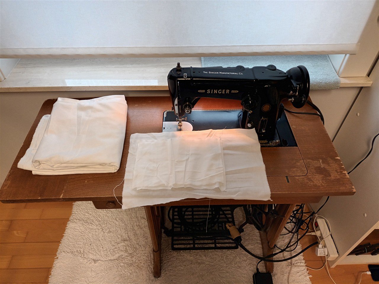

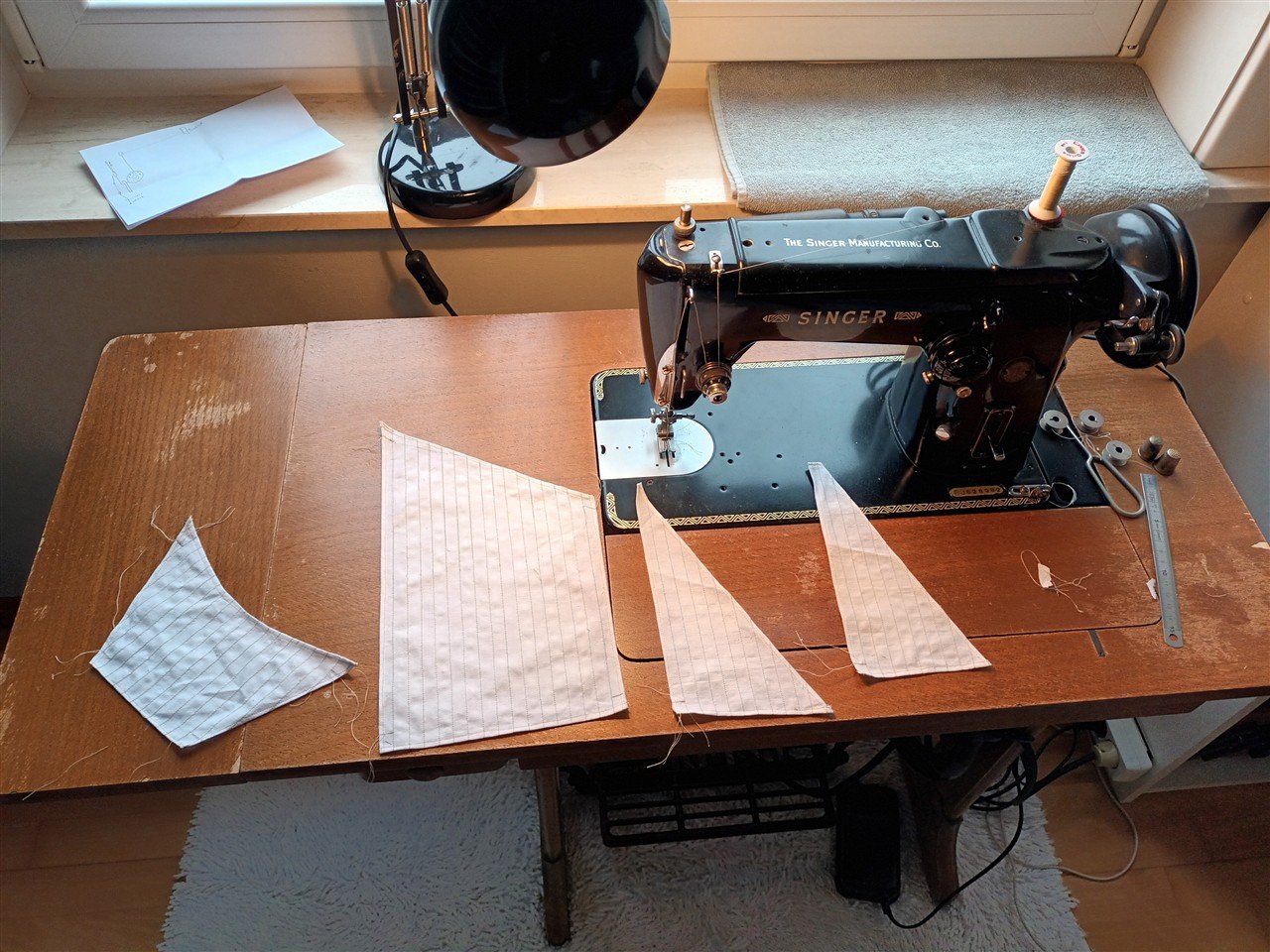

Sewing sails
From workbench
To sewing table. With the 70-year-old Singer machine.
And yes, this cotton makes sails too thick. But stitching and sewing are one of my favorites.

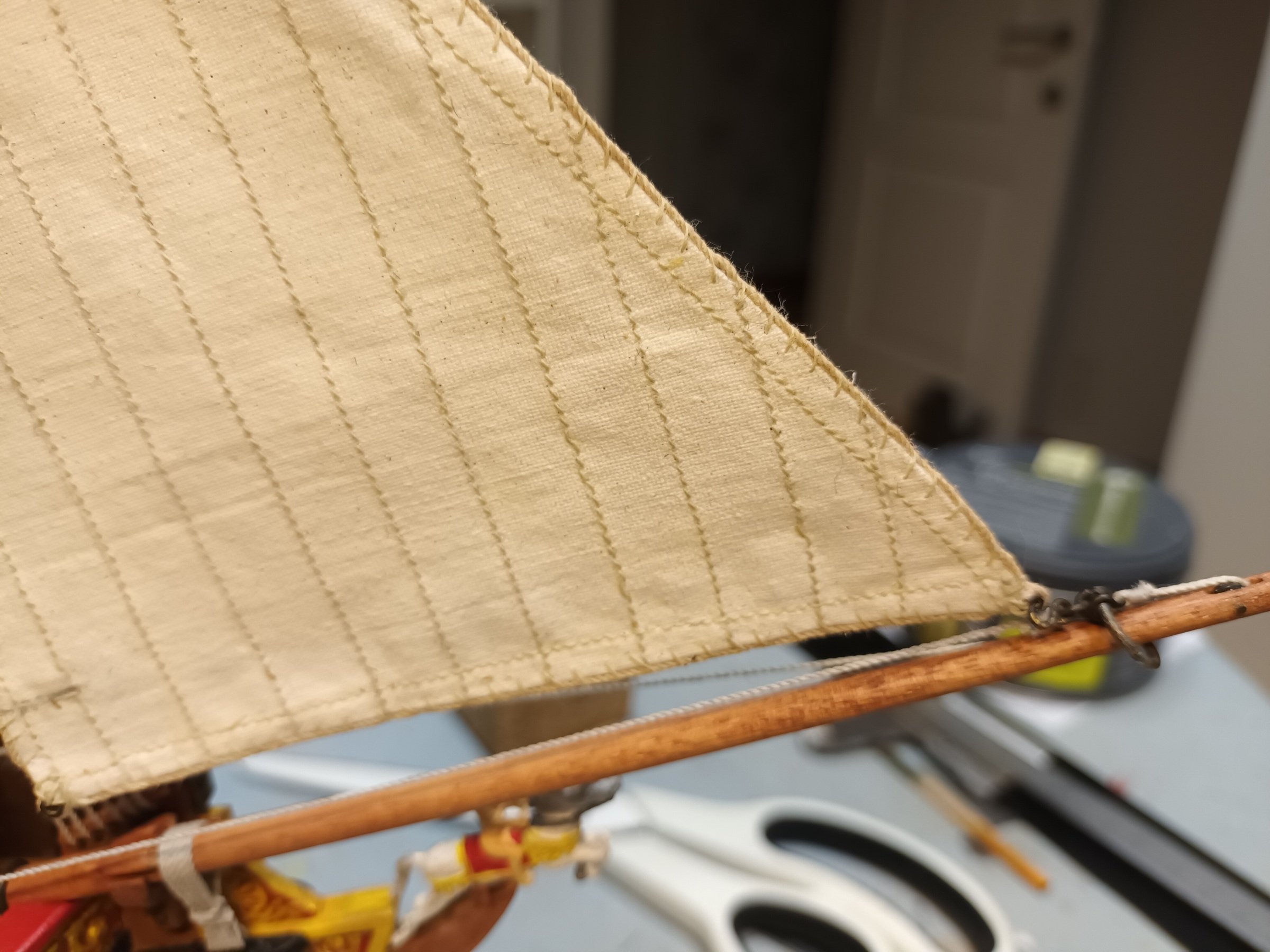

Stitching.
Sewing thread around the sails.
Stitching and sewing is ready

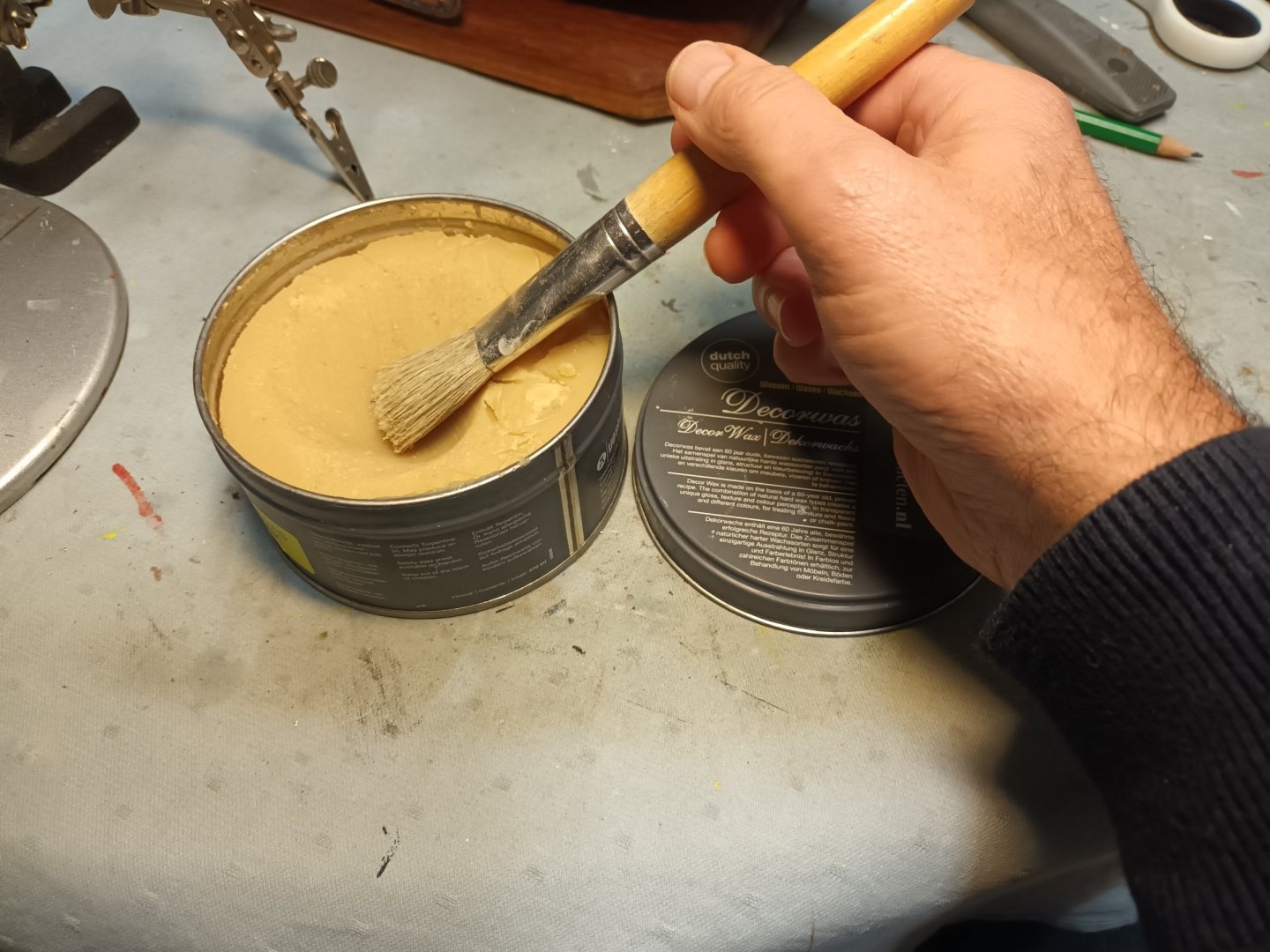

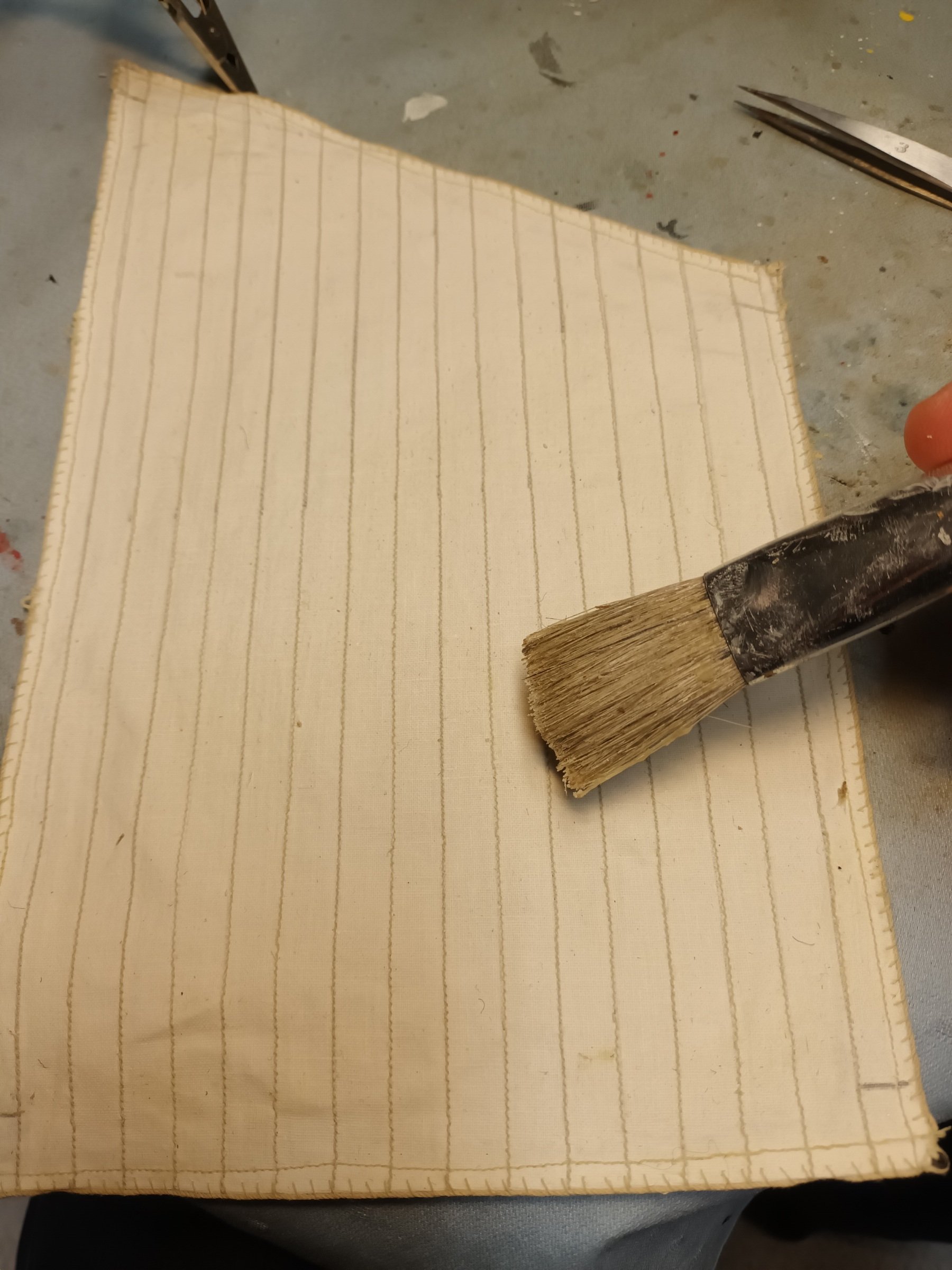

Treating with beeswax instantly changes the color and makes the sails less fluffy.
Next step: running rigging and hoisting the sails
Your sewing machines stitches per inch look really good at that scale, better then most I've seen and your hand stitch looks really good as well...hehe. Sails look great!!
Michael D.

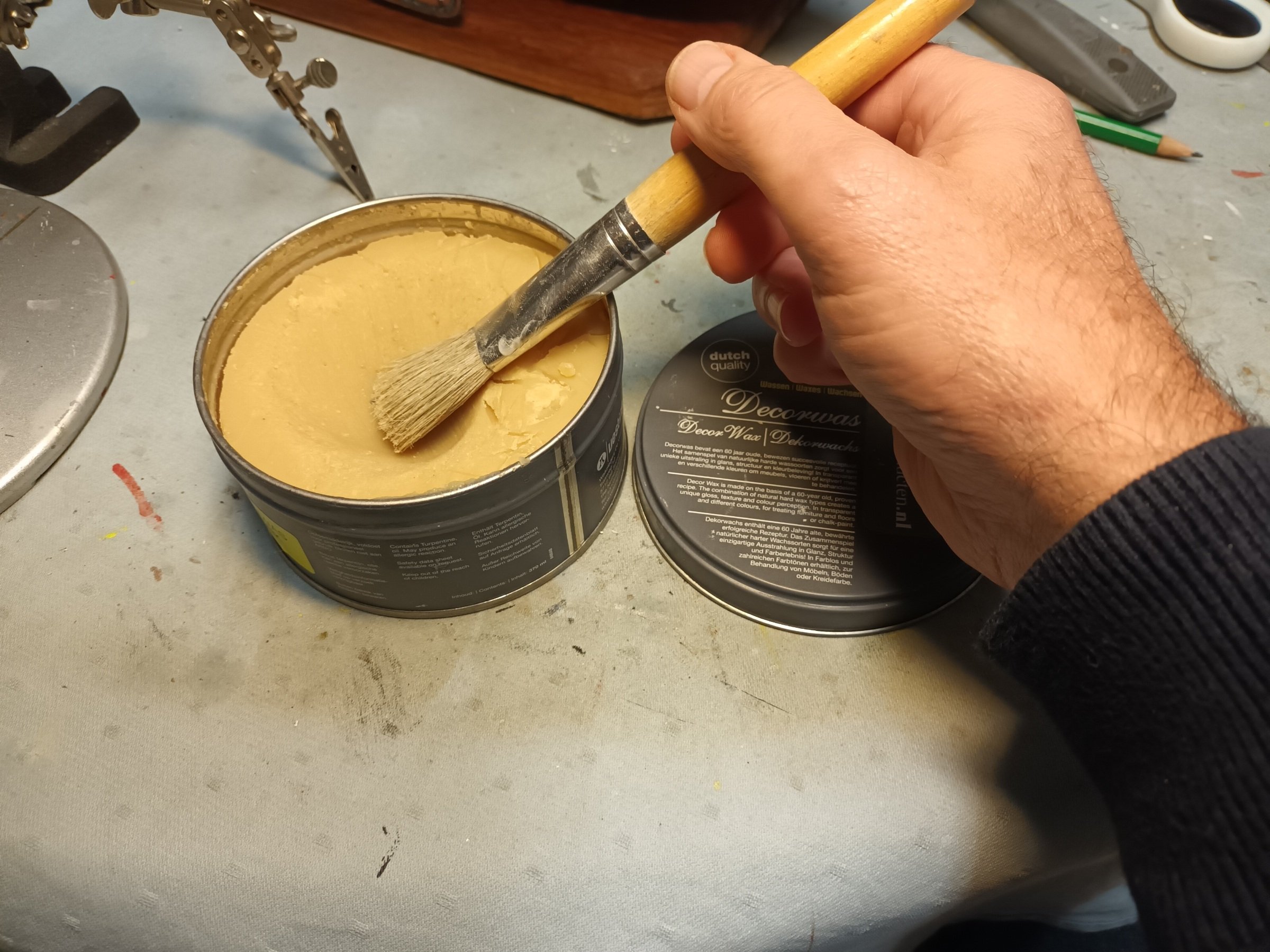

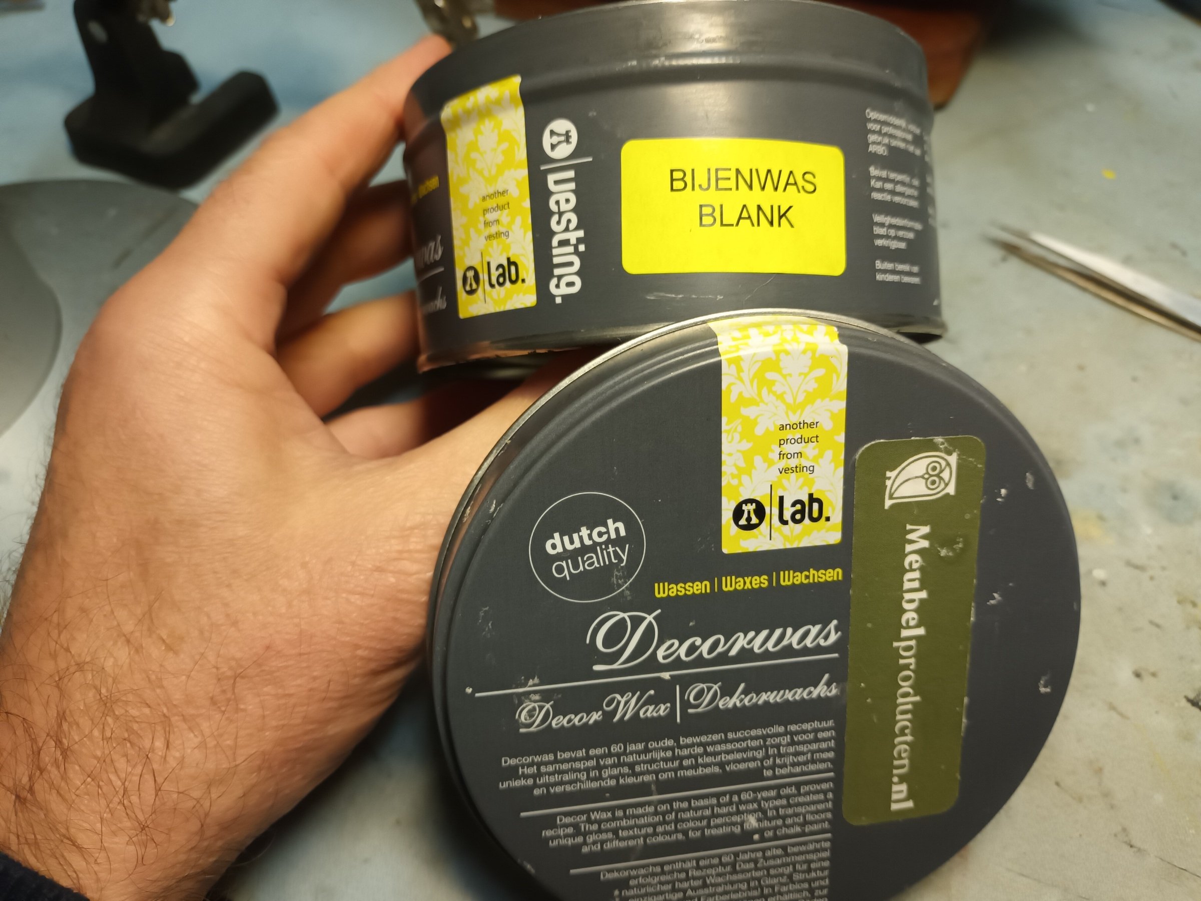

9 hours ago, Mark Pearse said:
Hi Patrick,
could you say more about the beeswax treatment process you use?
thanks
Product
apply with a brush
20251211_081648.thumb.jpg.043e4f32cef1b47c7ce68362ff3e7a46.jpg20251211_081808.thumb.jpg.8e863fde757e3540a614958fa515df17.jpg
Result after drying

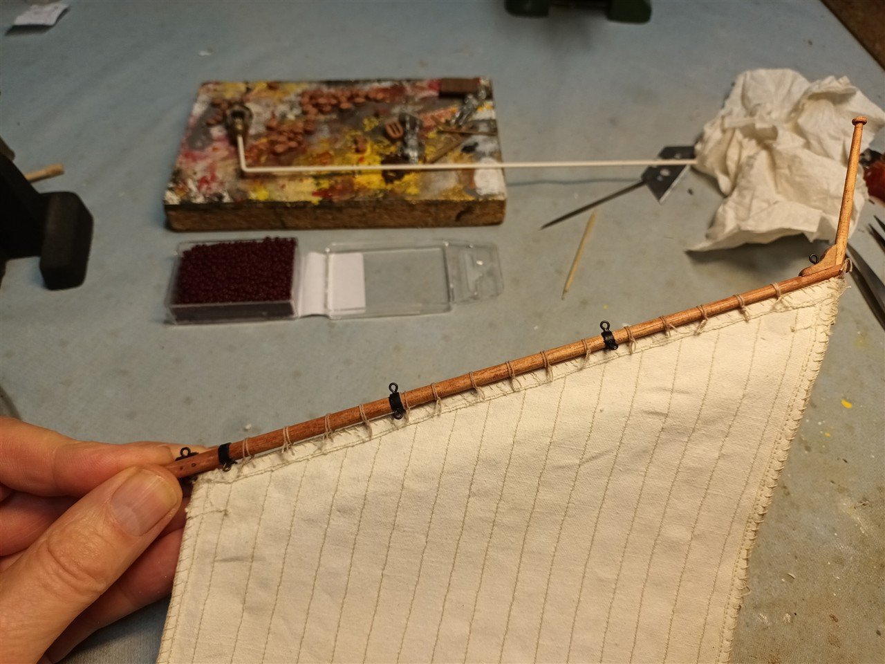

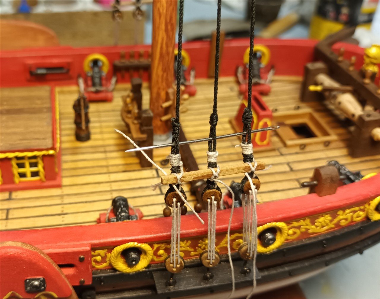

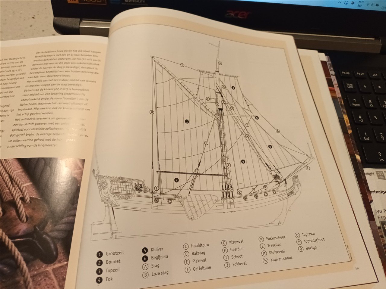

Running rigging an sails.
The Corel rigging diagram isn't complete.
That's why I'm using this drawing, along with examples of old yachts from this period.

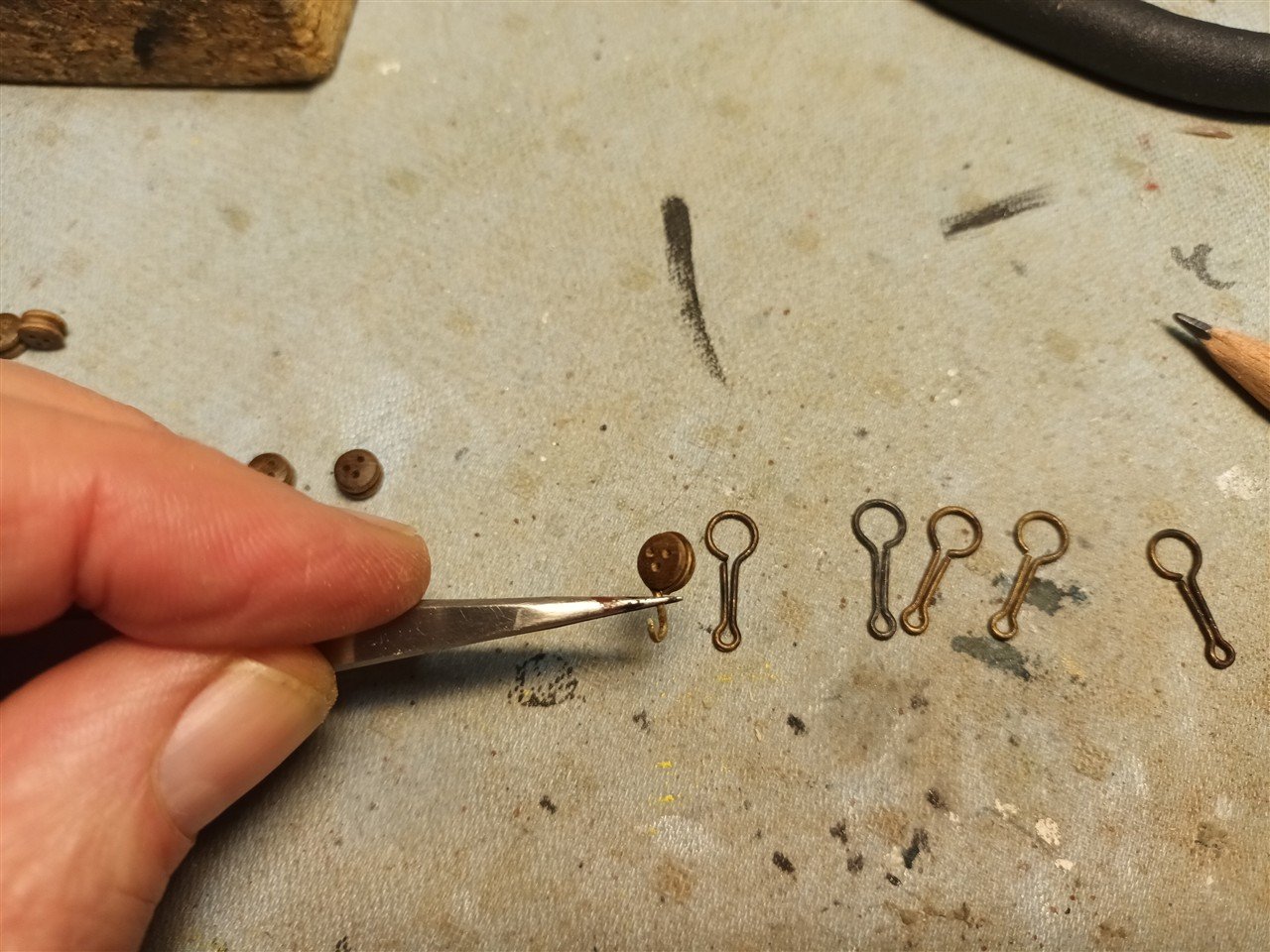

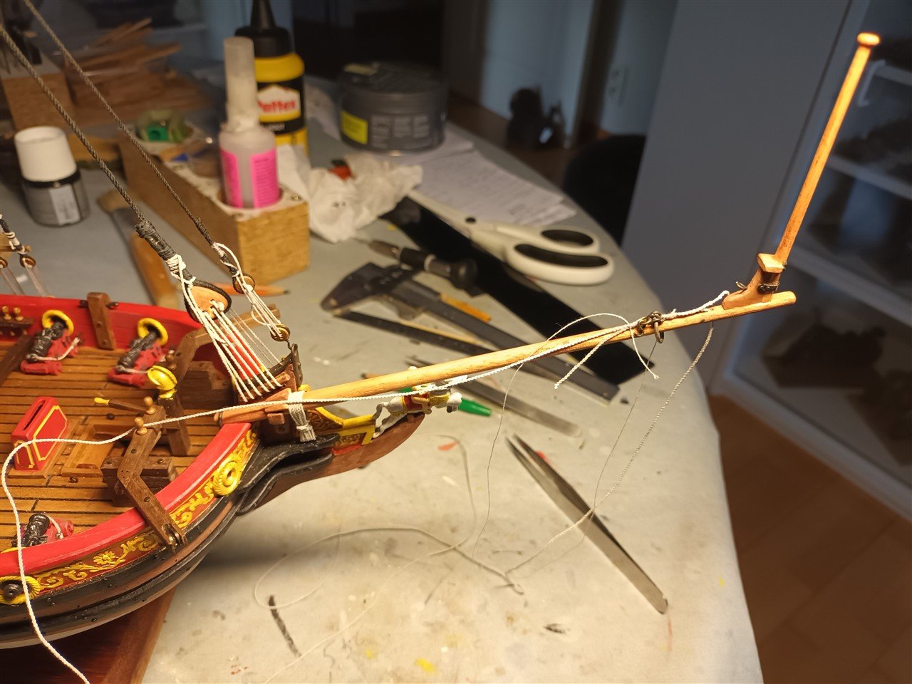

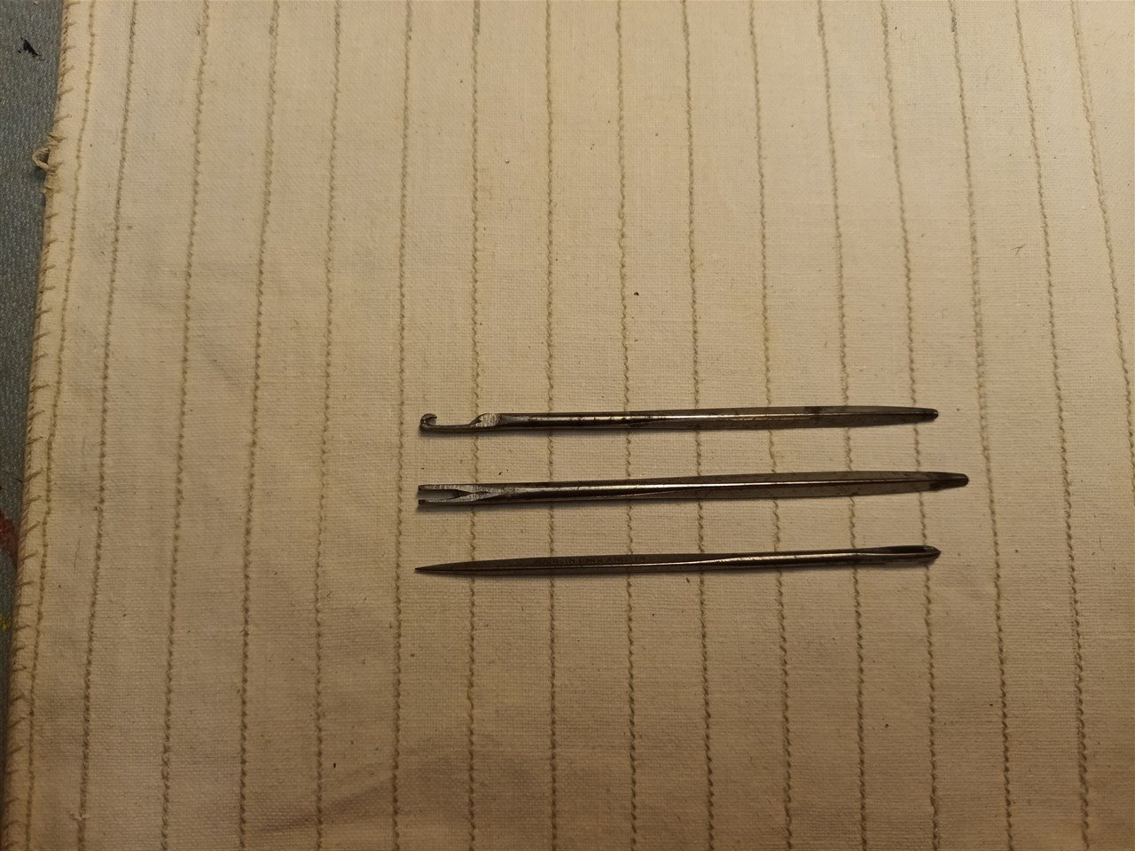

rigging accessories made from old needles
The "traveller" on the bowsprit

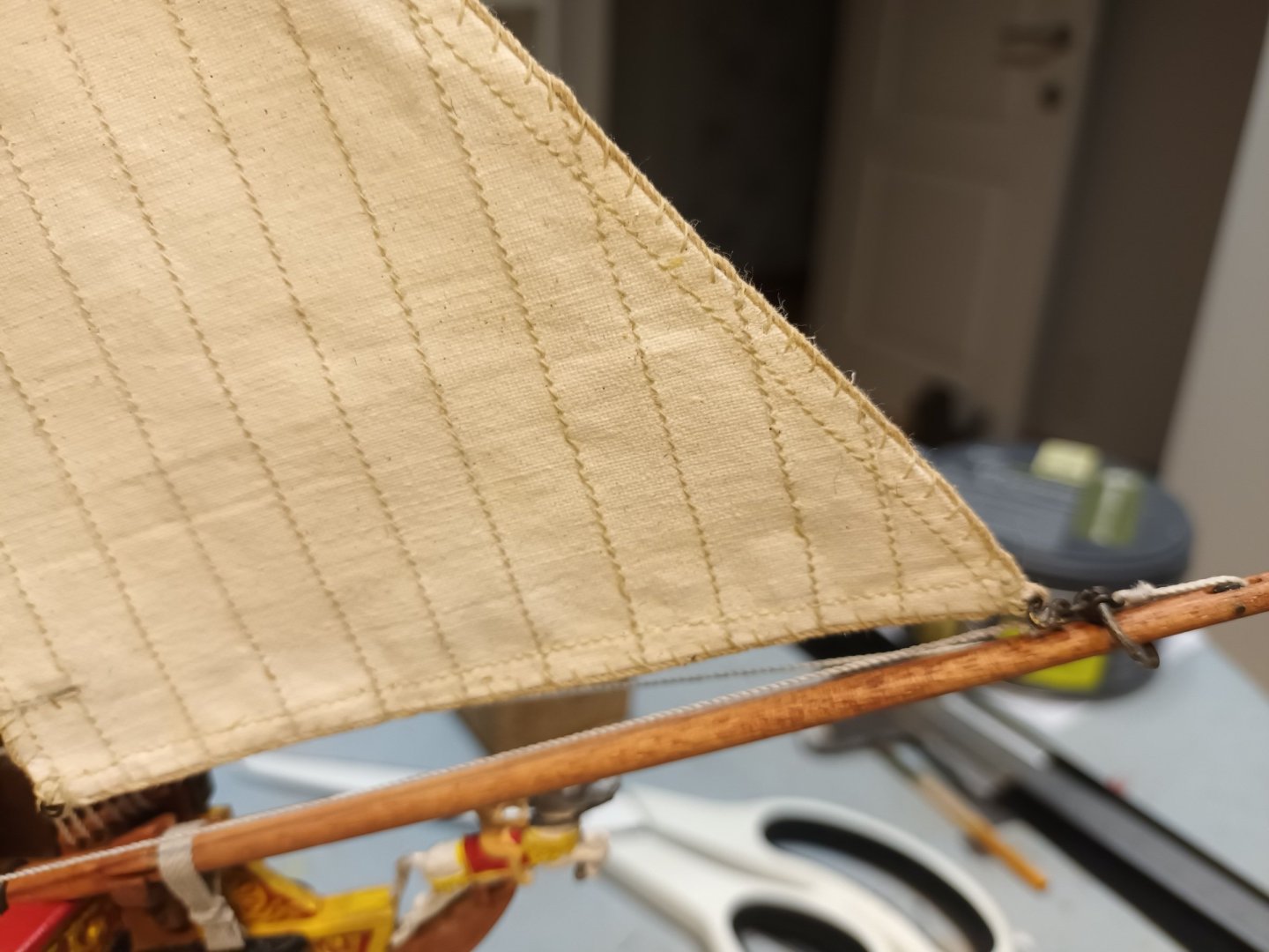

Attaching sail and blocks to the gaff
20251212_082251_1280.jpg.27ea5e2c4f27b568c8699b00d90cfebc.jpg20251215_091025_1280.jpg.3c2a6fac080a3c975bf01388d940d1d1.jpg

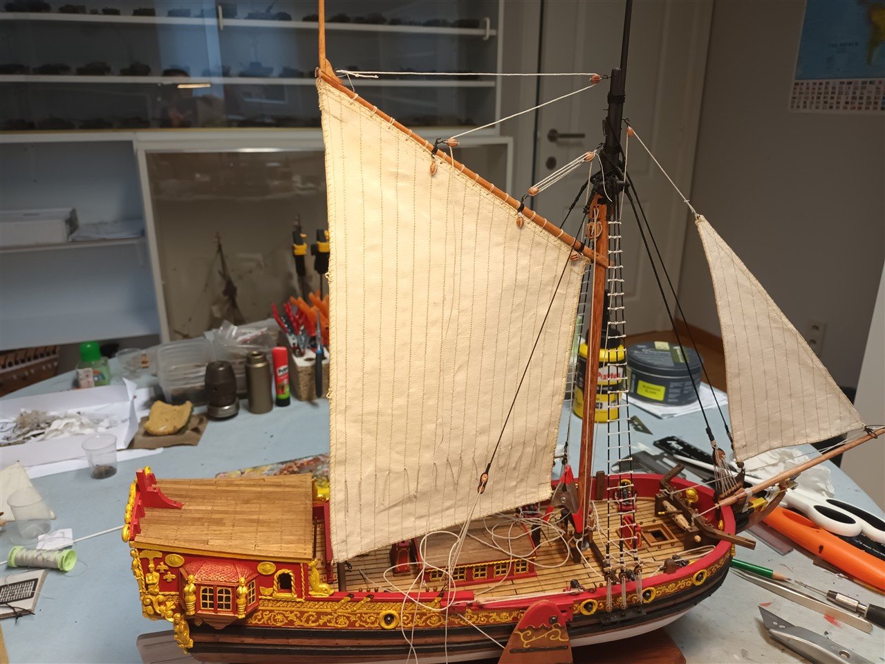

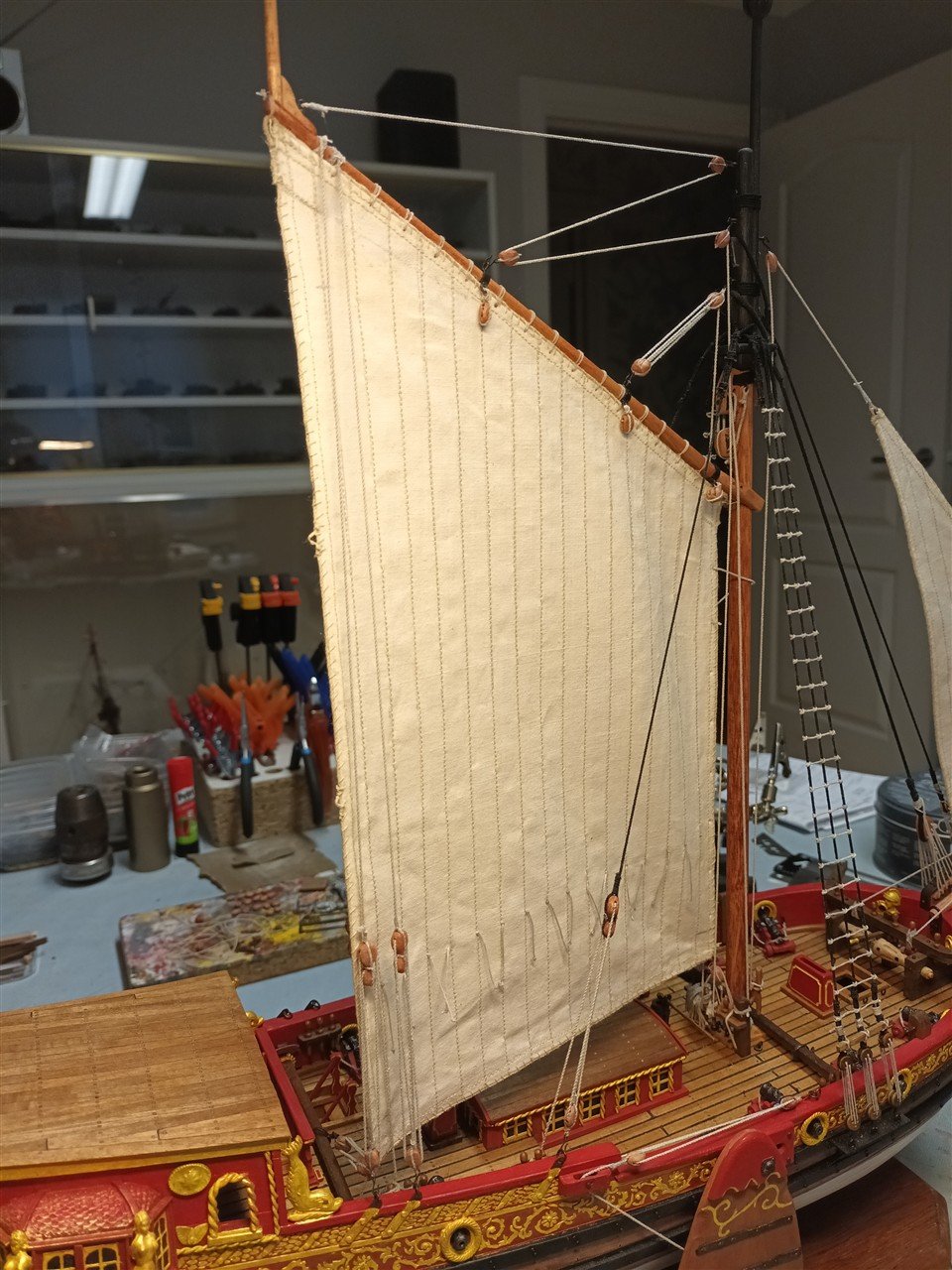

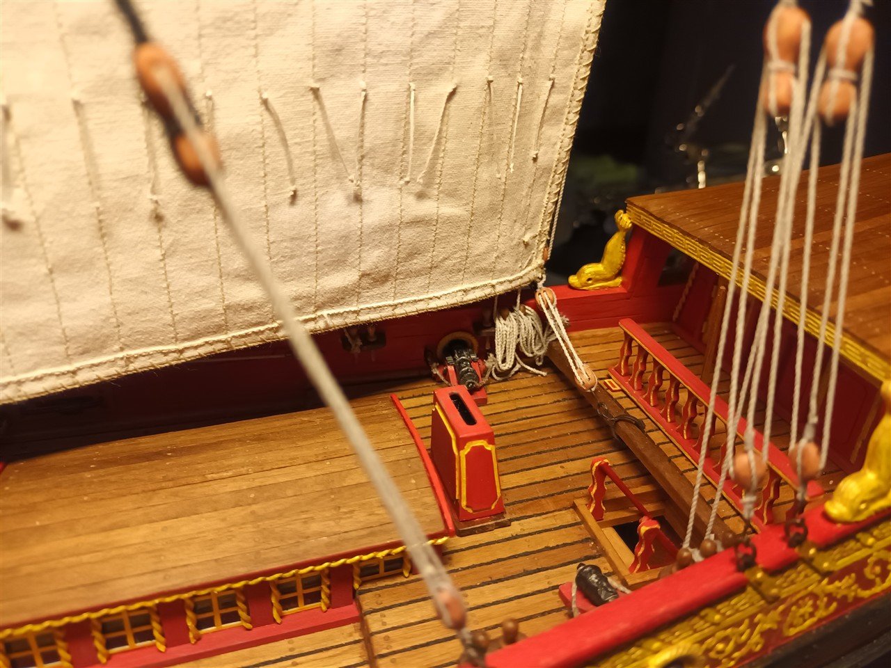

Hoisting sails, work in progress
20251215_110024_1280.jpg.1ccd8abb834d4a8a1034ff2c92802bd8.jpg20251217_111135_1280.jpg.e0c831052952402eab08da46d07cd0f8.jpg20251217_111216_1280.thumb.jpg.ba4e4f373bd711f39da735711ceca641.jpg

Thanks for following, and happy holidays to everyone
Hi Patrick,
A very interesting vessel & a lovely model.
Do we know about their sailing characteristics? Looking at her sail plan, the sail area is fairly forward, & possibly her centre of effort is forward of her centre of lateral resistance. But there's a great deal I don't know about how they could be sailed & it would be interesting to know more.
8 hours ago, Mark Pearse said:
Hi Patrick,
Thanks,
I'll see if I can find anything about this Subject.
Research and translating this into English might take a while (i never learned English at school).
