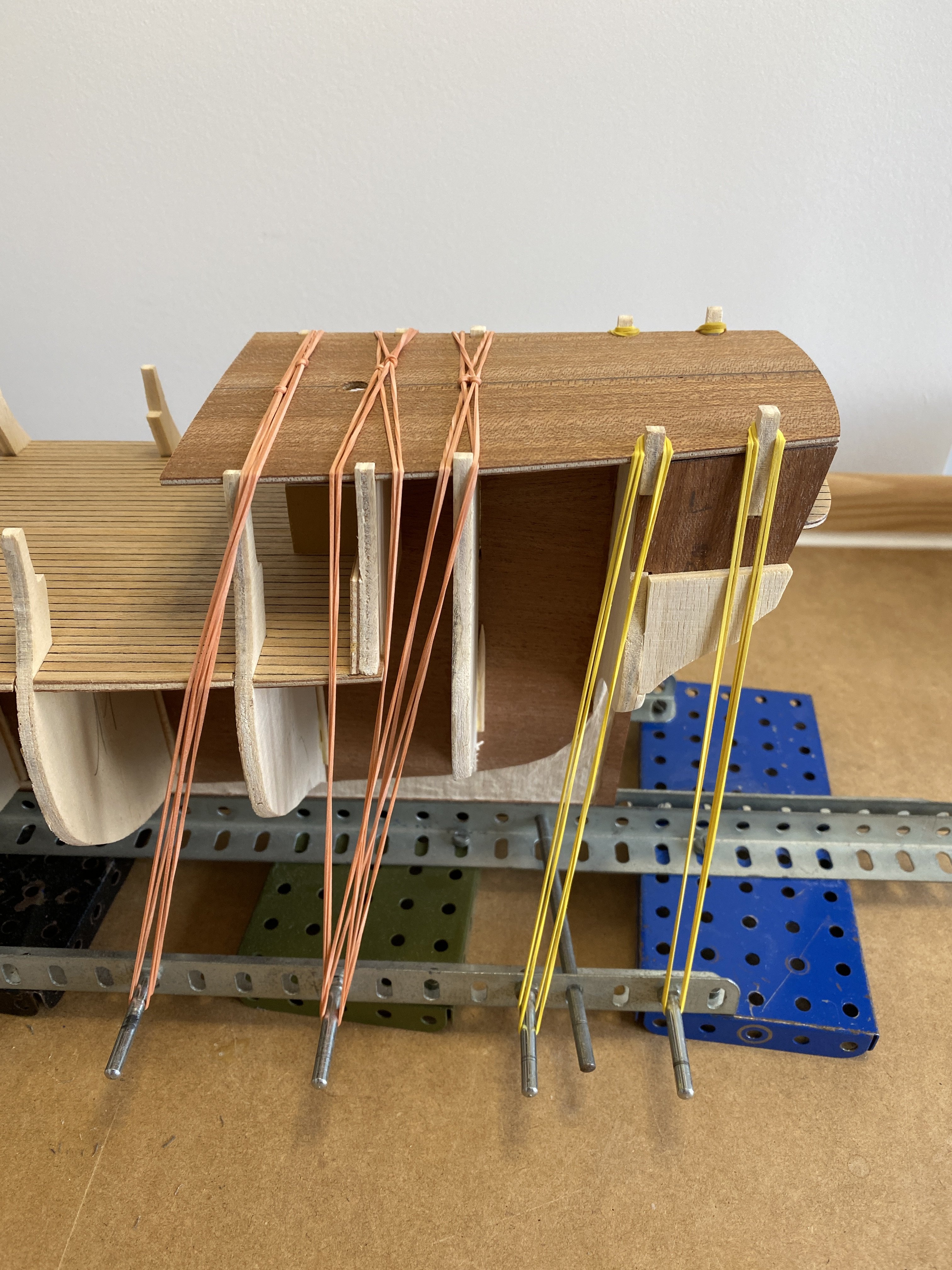

Glueing the Main Deck
After a distinct lack of progress over Xmas I've finally started the assembly by glueing the main deck to the bulkheads. The whole assembly can then be lifted by an inch or so to allow the front bulkhead to be inserted: this seemed easier to me than trying to glue the front bulkhead at the same time as those shown in the photo, since it complicates the assembly somewhat (due to lugs on the deck having to align with slots in the bulkhead) and there was a chance that the glue would start to dry before I got it all put together.
My childhood Meccano set makes a very useful tool for building jigs 🤣

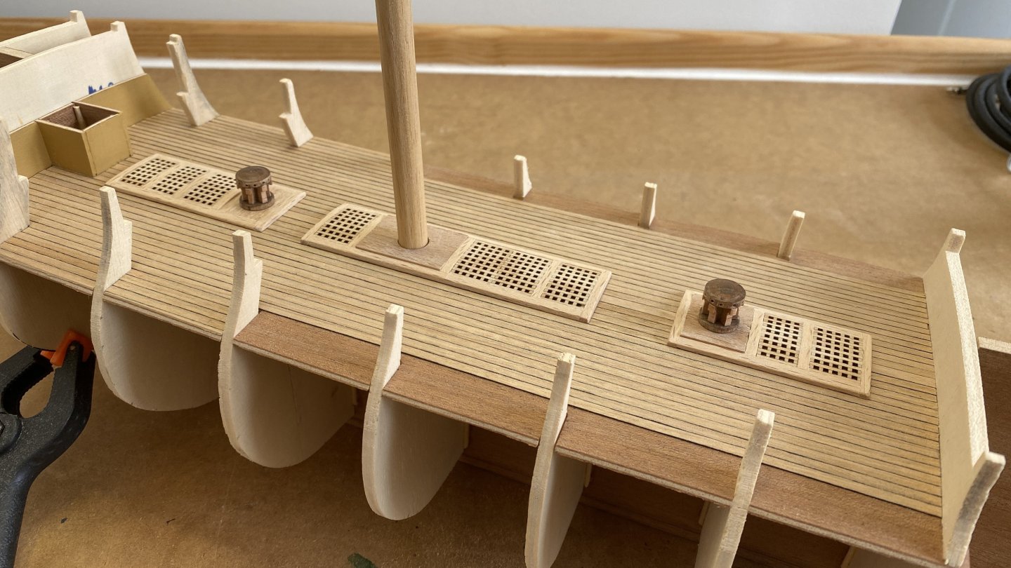

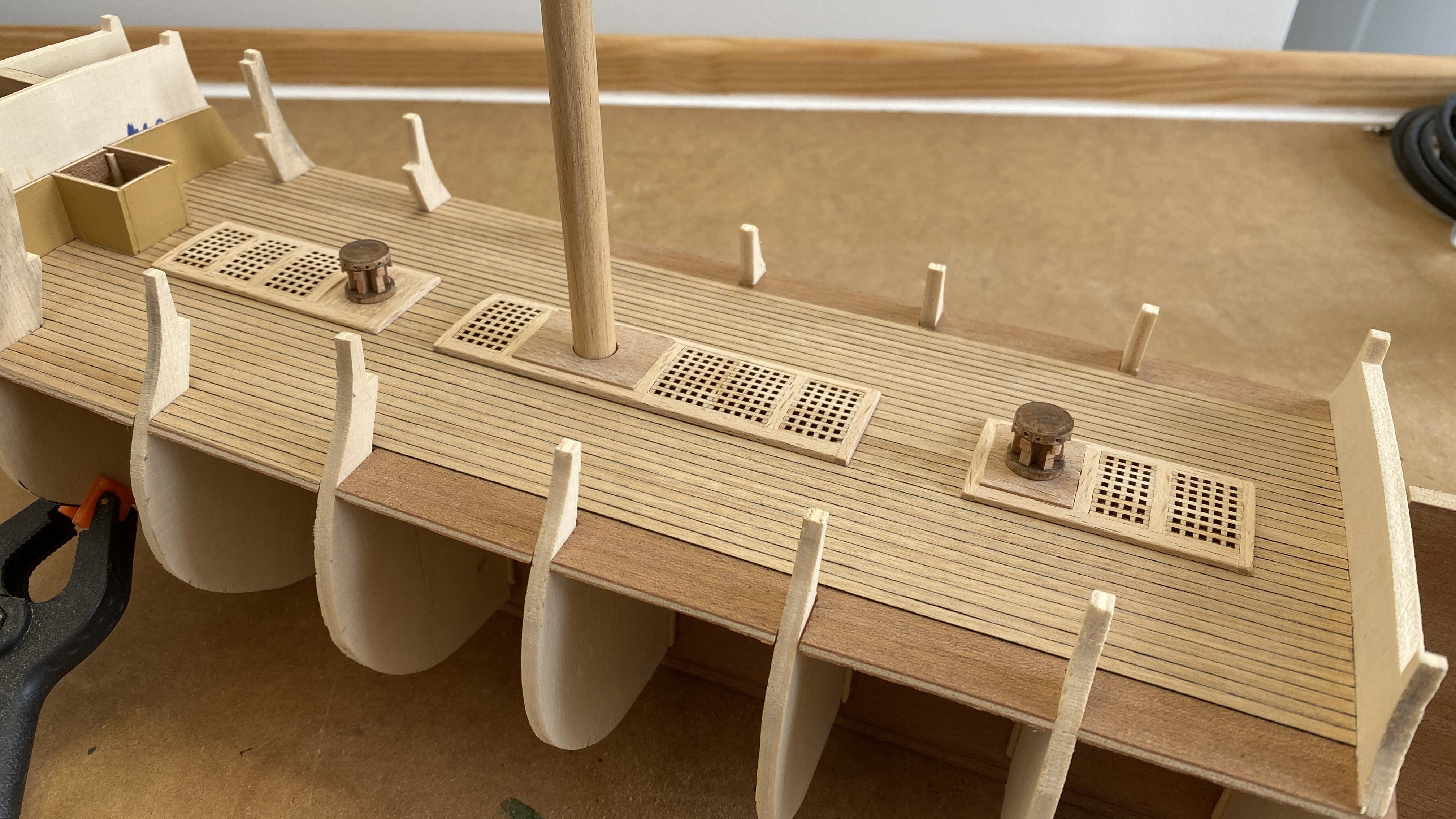

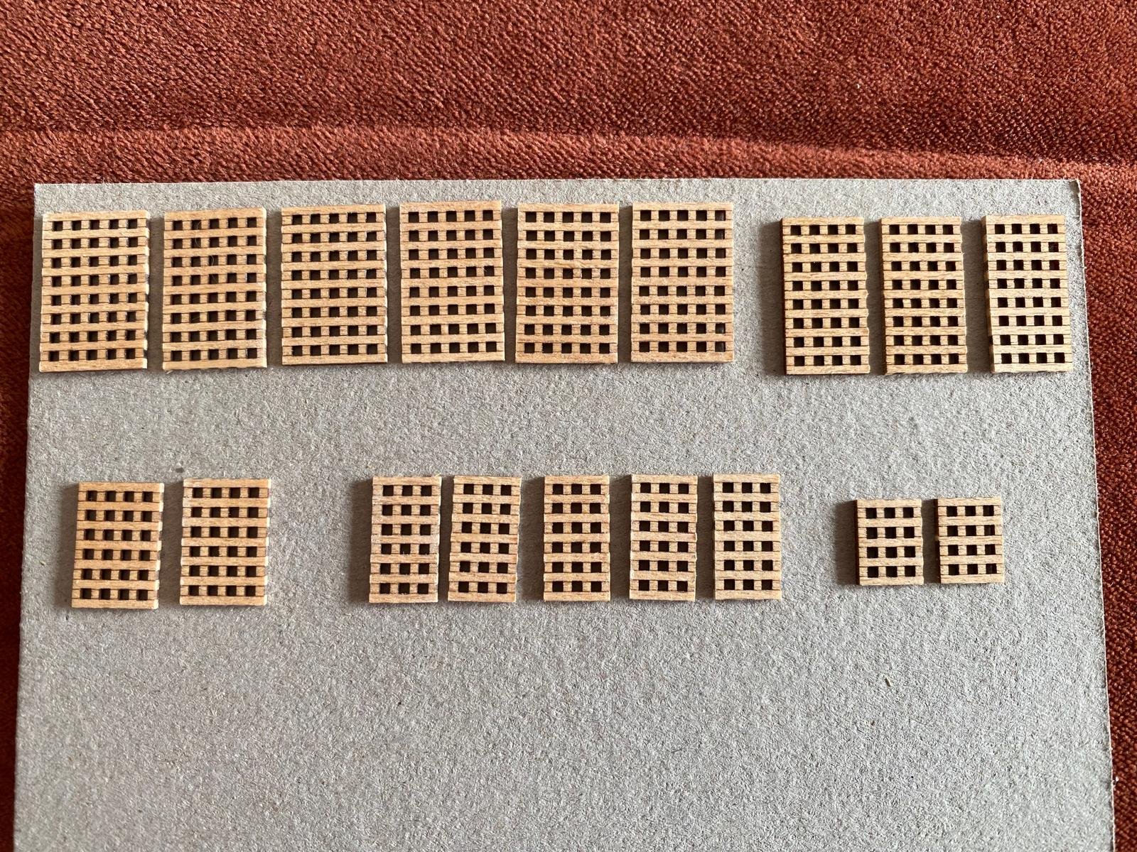

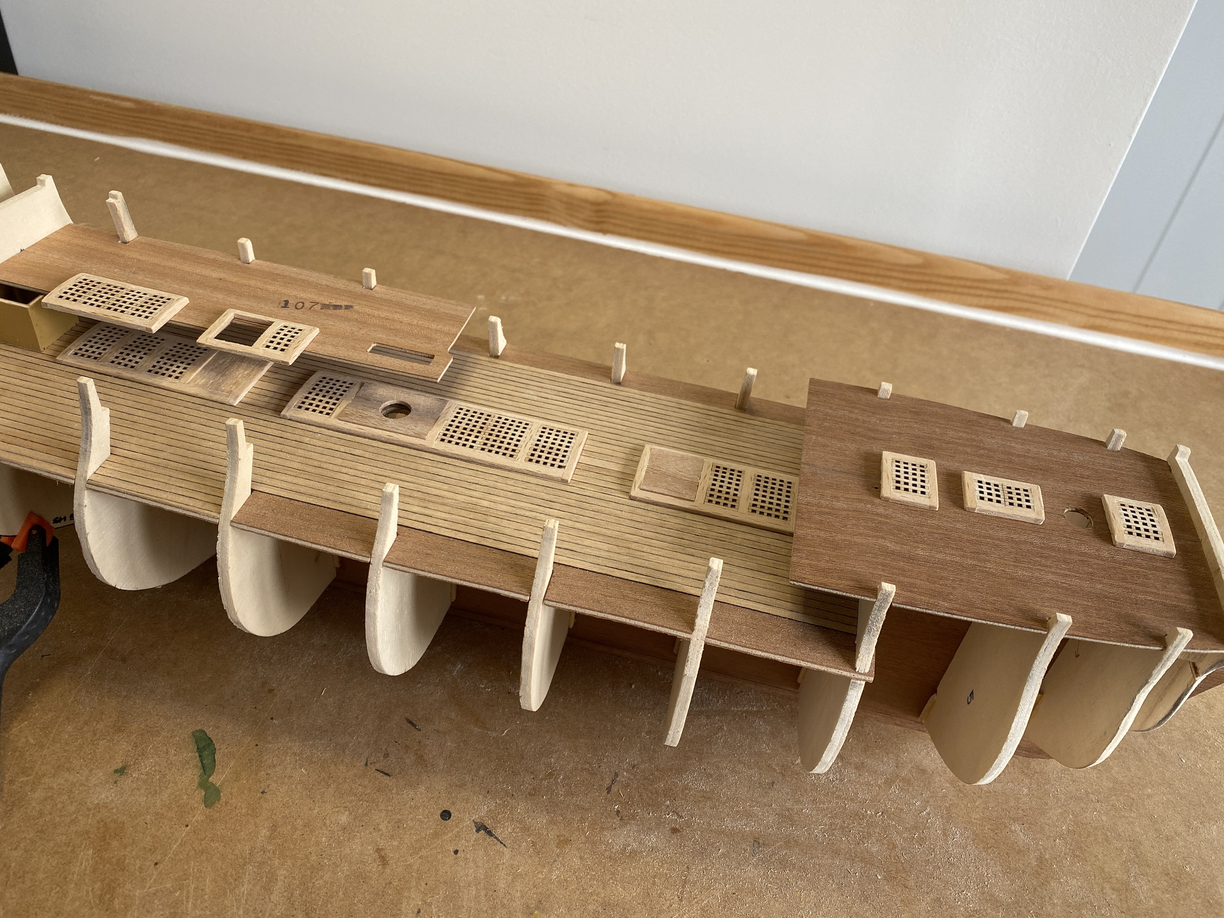

Three views of the gratings in various stages of completion.  I didn't get on at all well with the grating components supplied with the kit, so I bought a sheet of laser-cut grating from eBay and cut it down to the required grid sizes.  They are fractionally larger than those provided by Corel, but the difference is trivial.  I made these much earlier than needed as something to do while I procrastinated about completing the hull ready to do the hull planking 🙂

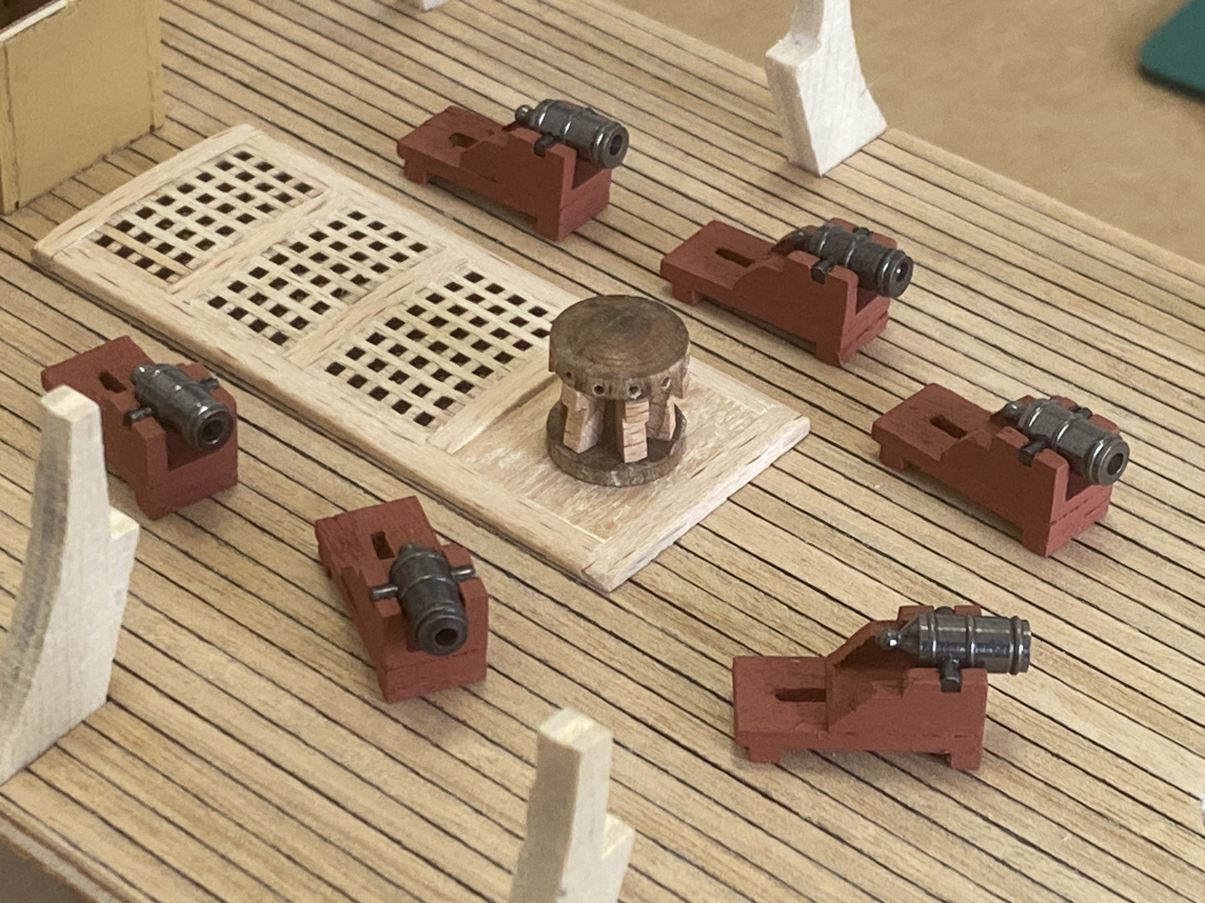

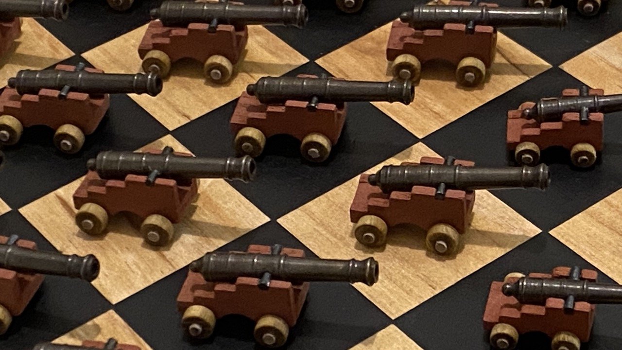

I made all the canons and carronades: as with the early construction of the gratings this was a deferral activity whilst I was procrastinating about planking the hull.  The Corel kit suggests using brass wire for the axels but it looks wrong as I wanted to use wood.  I was unable to source any with a suitably small diameter so I sanded down round larger wooden strip to the required diameter (using the Dremel and gripping the wood with sandpaper until the diameter had reduced sufficiently): took a while but I'm happy with the results.

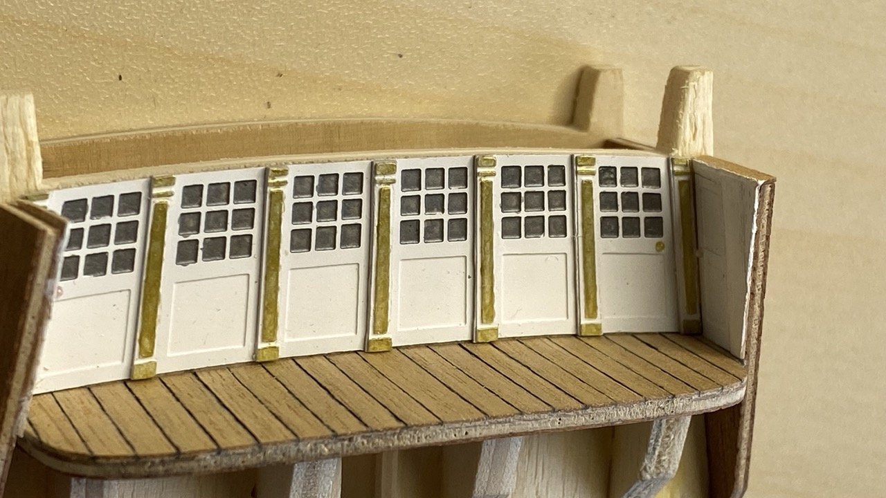

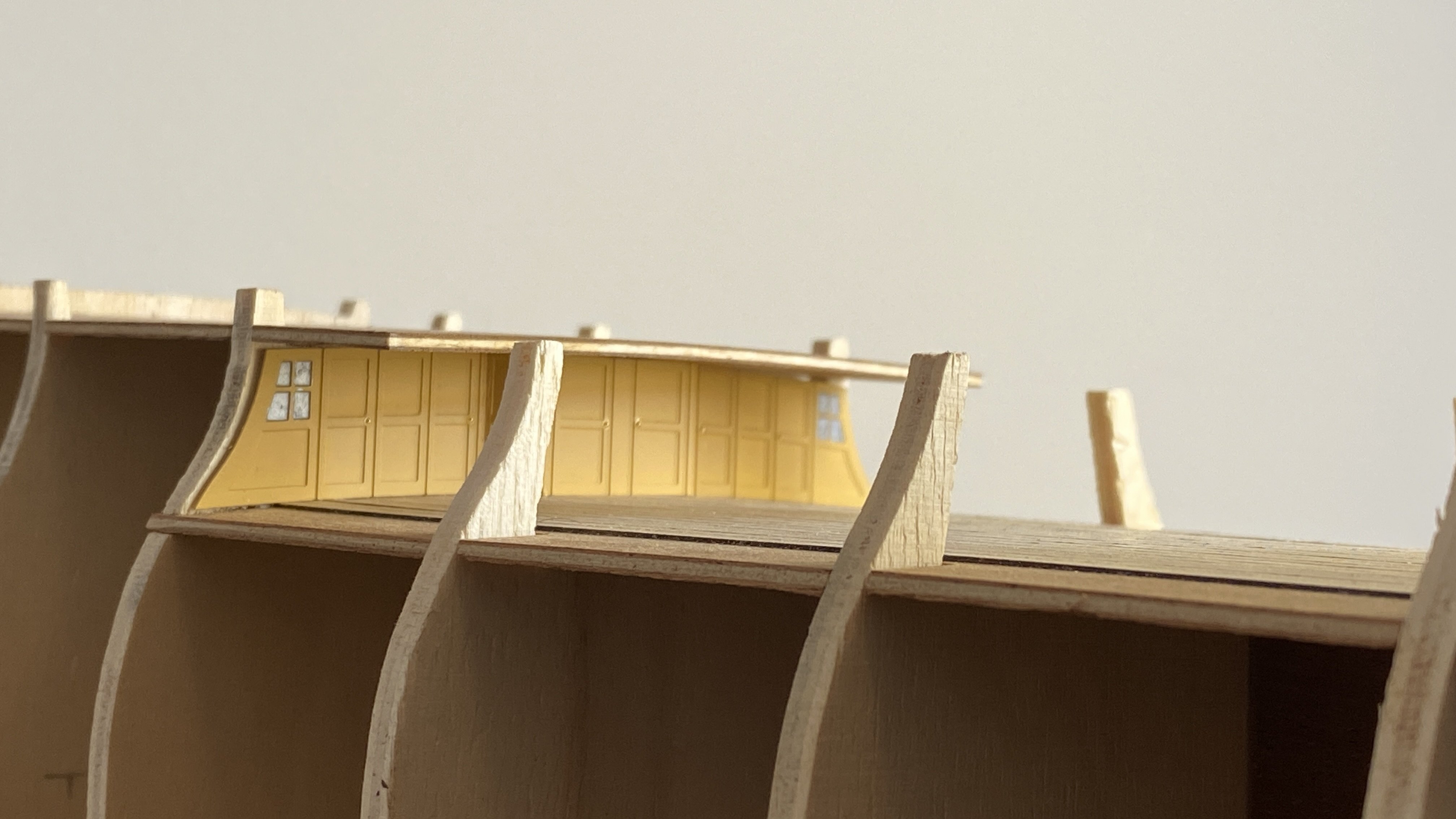

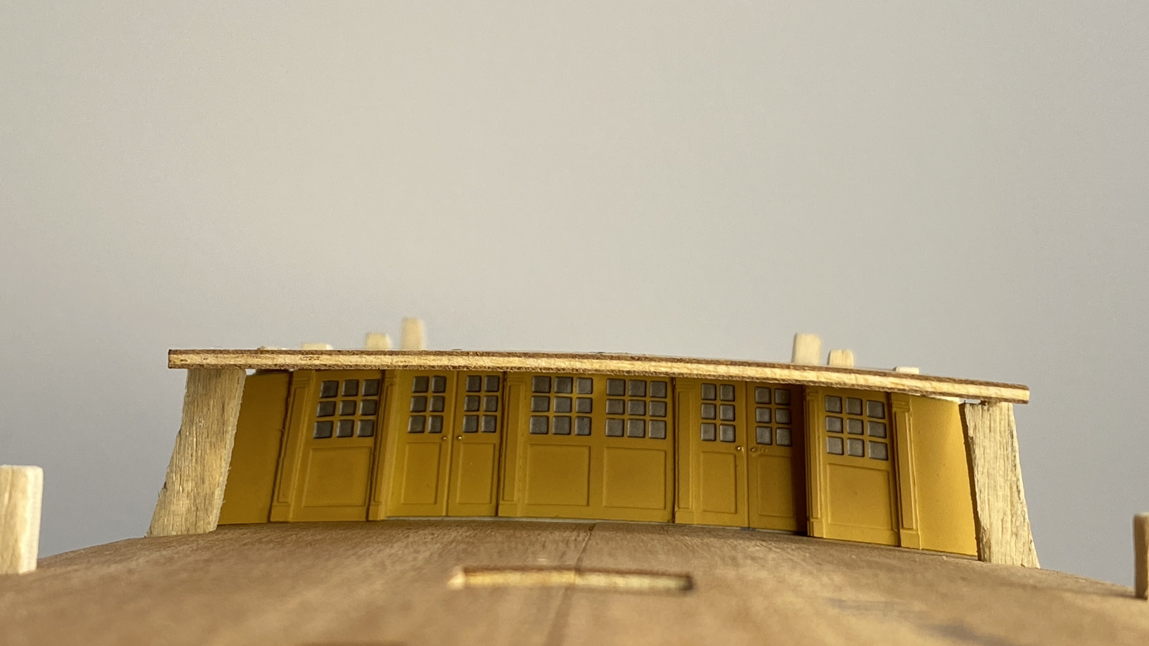

Having learnt from my many mistakes doing the stern gallery, the photo etch detailing on the bulkheads of the bow deck and the poop deck only took a couple of days to complete.  I've glued the bow bulkhead detailing into place, but the detailing for the poop deck will be glued in place after the quarter deck has been fitted.  (I'll need to slightly dismantle it to get it into position, but that's a trivial problem.)
Corel suggest using tack heads for the doorknobs, but at this scale they would represent doorknobs about 20cm in diameter, so I glued tiny resin beads in place: these are perhaps a bit too small, but I prefer them to the tack heads.

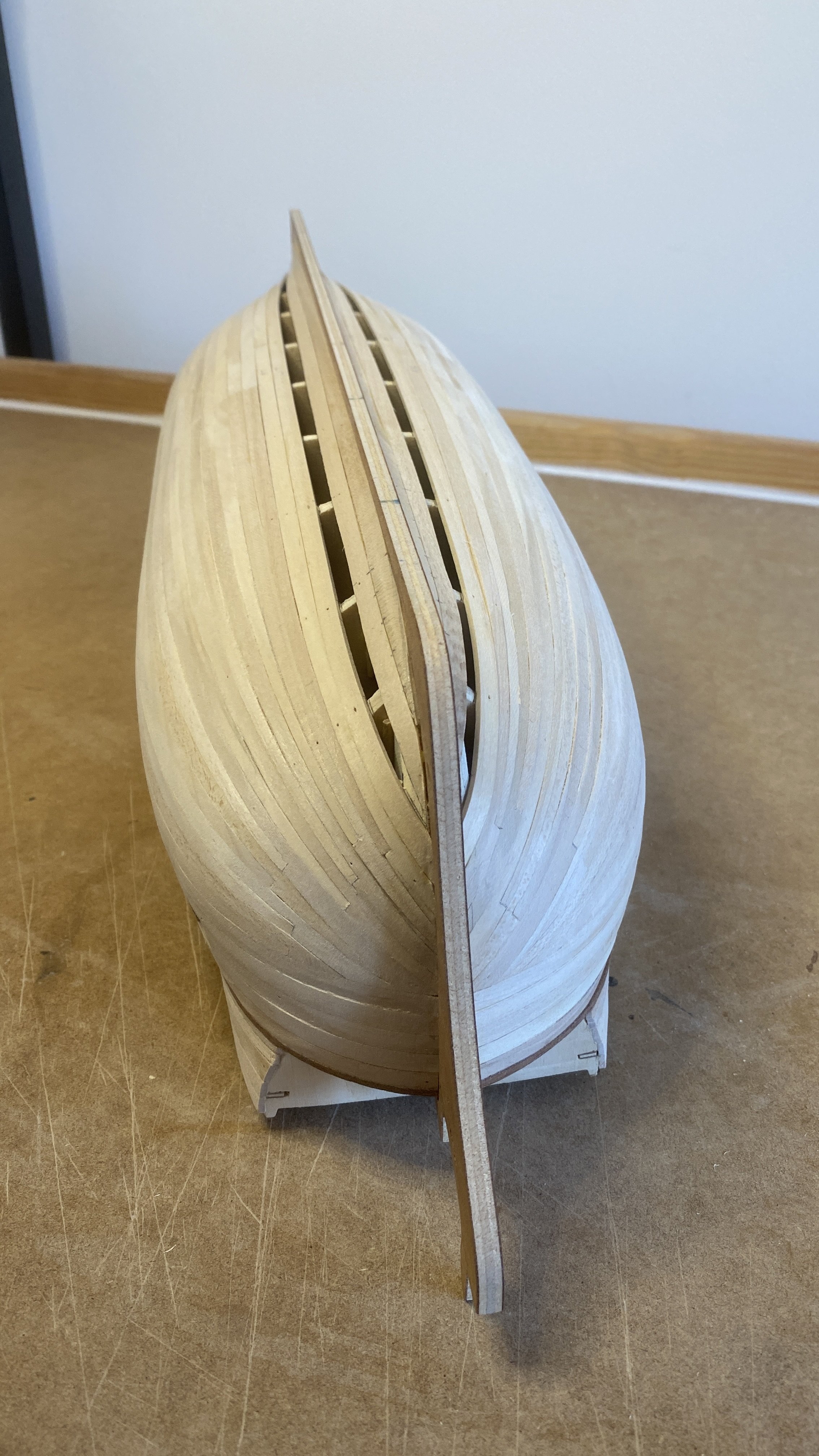

A few pictures of progress with the inner hull.
A bit unusually I believe, I've decided to do the lower hull planks that wrap around the stern in half-length sections, to avoid the complication of having to get a precise finish at the stern and at the bow on the same plank and at the same glueing event.  By having separate bow and stern planks I can restrict the complication to just a single end of the ship at any one time.  So far this is working well.
Another thing I'm doing that may not be standard is to put in the bow planks in a binary-divide fashion, i.e. firstly at large space intervals, then adding the planks in the middle region of those, and then in the middle region of those, and so on, to fill the space in a binary fashion.  I've chosen to do this so that I can get the planks to follow the natural curvature of the bows.  If I put them on sequentially, neighbour after neighbour, I found that this causes a gradual and incremental error in the planks from following the natural lines of the hull.  It means a bit more sanding to get the final planks in place, as they must each be located between two close neighbouring planks.  The additional work is helping to ensure that the planks follow the natural contours without aggregation of errors.  Thus far this is giving a simpler planking operation than I got with the first ship I built, which required an awful lot of bending of the planks so that they would deviate from the natural hull curvature.  Suffice to say that the outer hull planks won't necessarily follow this natural curvature approach, and so I anticipate them taking a long time to fit in a realistic fashion.
In contrast, I'm planning to fit the stern half of each plank sequentially, as I've found that there is less aggregation of errors and that the planks if spaced evenly do follow the curvature of the hull more readily than they do at the bow.  As I get closer to the keel I know that I'll have to fit a lot of spacer planks, which I think are called "stealers", but this is quite usual.
Though it's a lot of work and taking a long time, I'm pleased with the results so far.

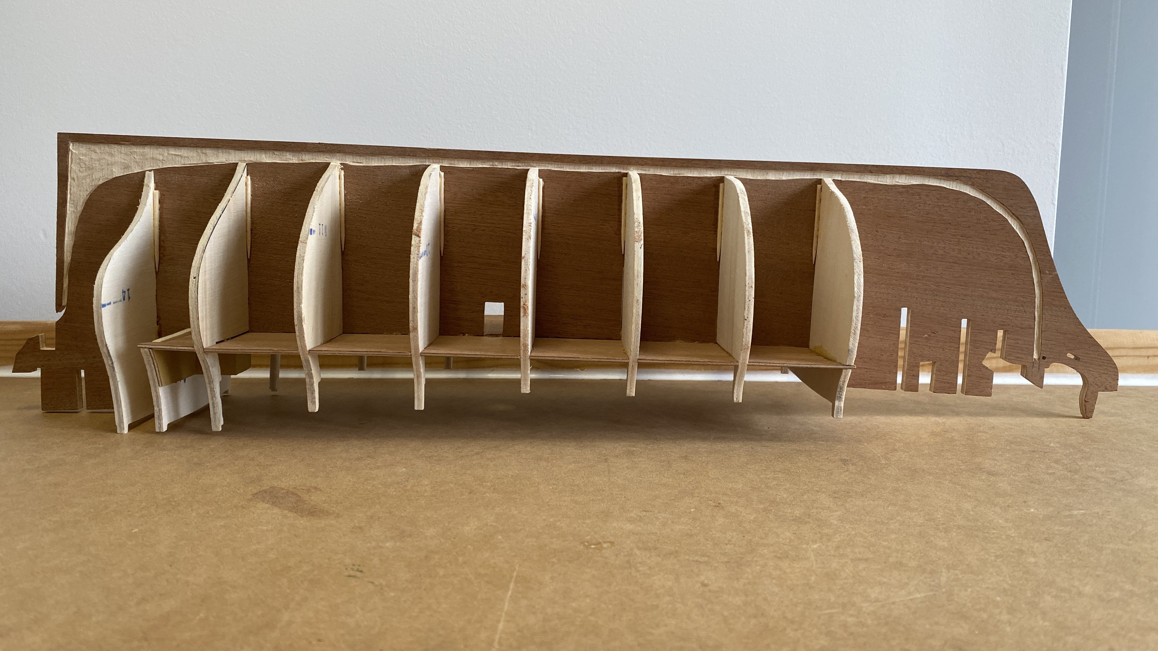

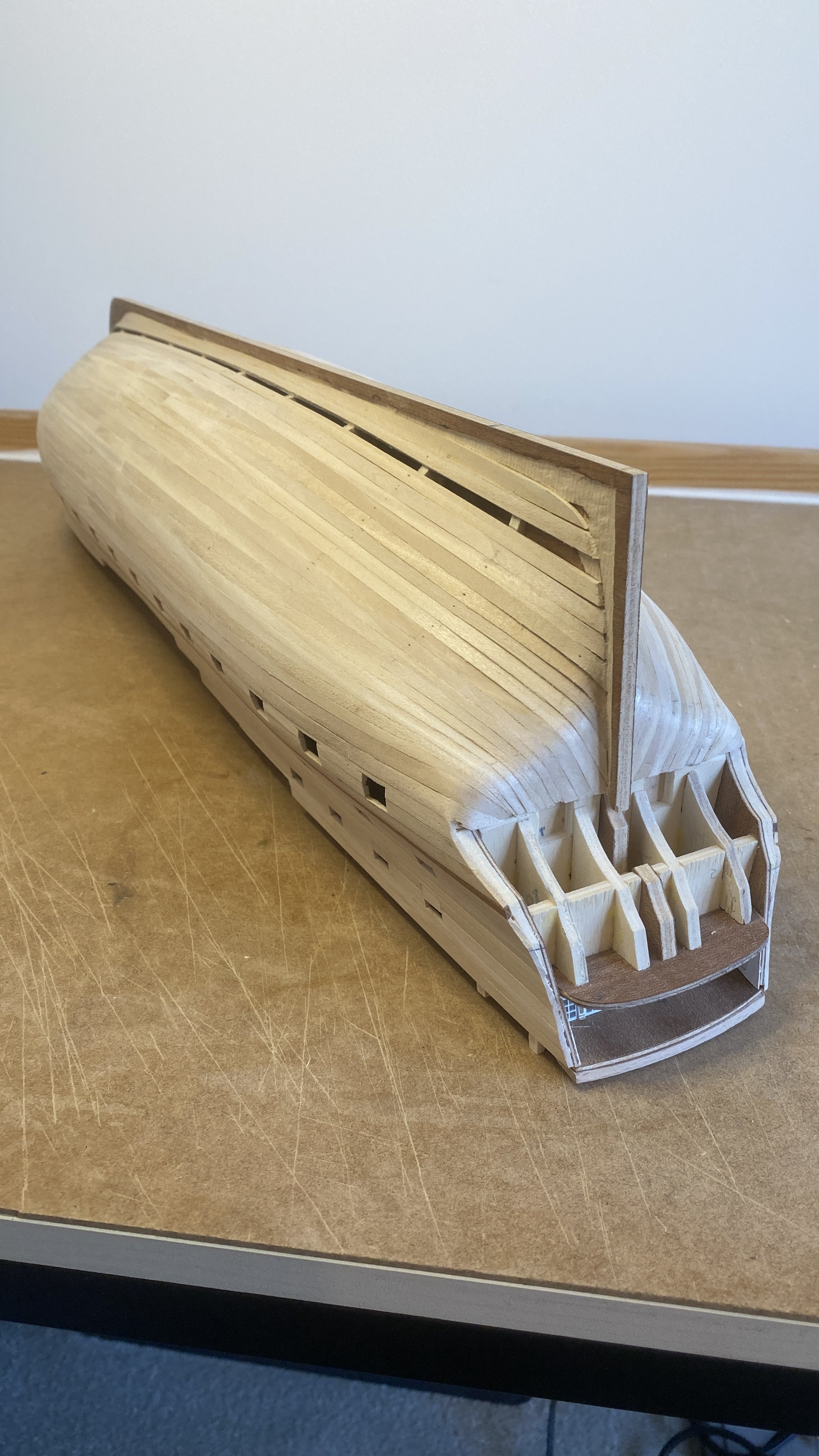

Three months and five days since I added the first inner hull plank and I've still not finished.  I'm hoping to complete the inner hull in the next few weeks.
I've noticed in other build logs the inner hull planks all going all the way back to the sternpost, whereas the instructions say "
at stern, it is better not to cover the keel No. 1, stopping along the lower limit of frames No. 12, 14 and 15".  It seems to me that stopping the inner hull planking before it reaches the stern post is a good thing, otherwise the hull would be an additional 3mm wide at the sternpost, which I don't think I want.  I'd welcome anyones advice on this.
Regards to all, Andy.

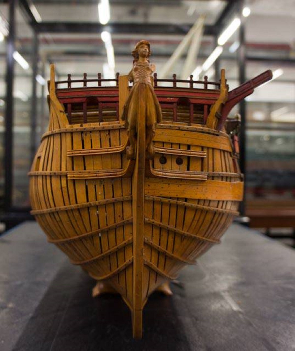

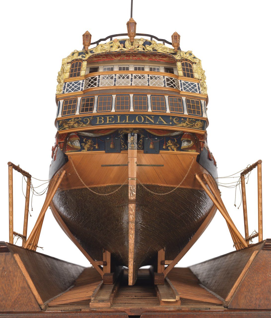

Hi Andy!
There are many things to be done to the Corel model, but even if some things are left and it will not be noticeable, the thick sternpost and knyavdiged look rough compared to the graceful watercuts of the prototypes. The knyavdiged narrows from the stem to the nasal figure both in the top view and in the front view. Similarly, the sternpost narrows from top to bottom. If you are thinking about further work, you can still make these corrections at this stage by planing these elements. Then you can lay the stern planking all the way to the sternpost.
Hi Andy,
I think it is optional to plank all the way to the stern. if you do, you will just have to remove some of the material so the second layer will sit flush with the stern post. That is how i did mine when i was at the stage you are at. It was a little more extra work but i think it added strength to the hull at that location.
Hi Frecap and Nearshore... many thanks for both your replies above.  The photos are extremely useful.  Frecap, I will definitely consider thinning down the stem and the sternpost - I like the visual effect.  Nearshore, I think I'm going to extend the inner hull planking to very near to the sternpost but will probably stop just shy of the endpoint.  I will confess that the cutting and fitting of the inner hull planks that transition from following the bulwarks to lying flat on the hull are quite intimidating so I'll probably dry-fit and trial them quite a few times before finally gluing.  I'm still very new to this!!!
100th inner hull plank glued on today... just more two to go!
I've terminated the inner hull planks at the stern along the curved line indicated in the plans (Sheet 5, Figure A).  If I need to add any additional bits later that will be simple enough.
Interestingly I've not needed to fit any stealers.  Not what I expected, but the inner hull planks have fitted rather well without.
