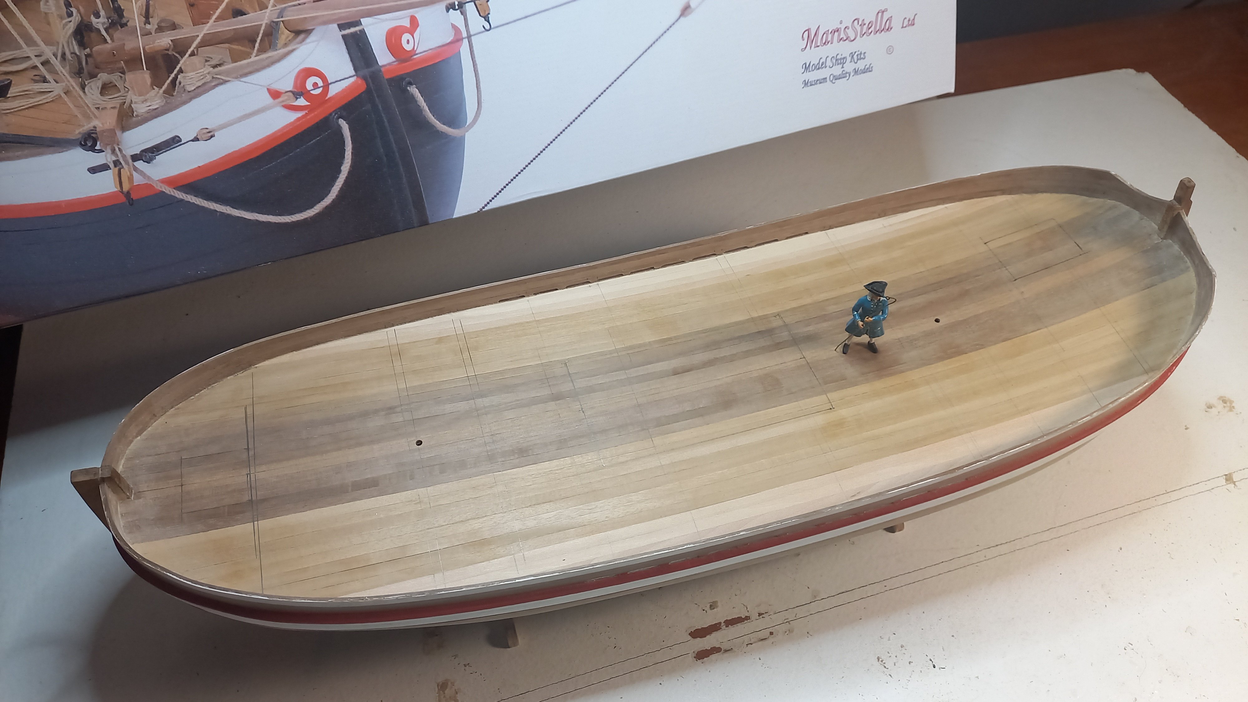

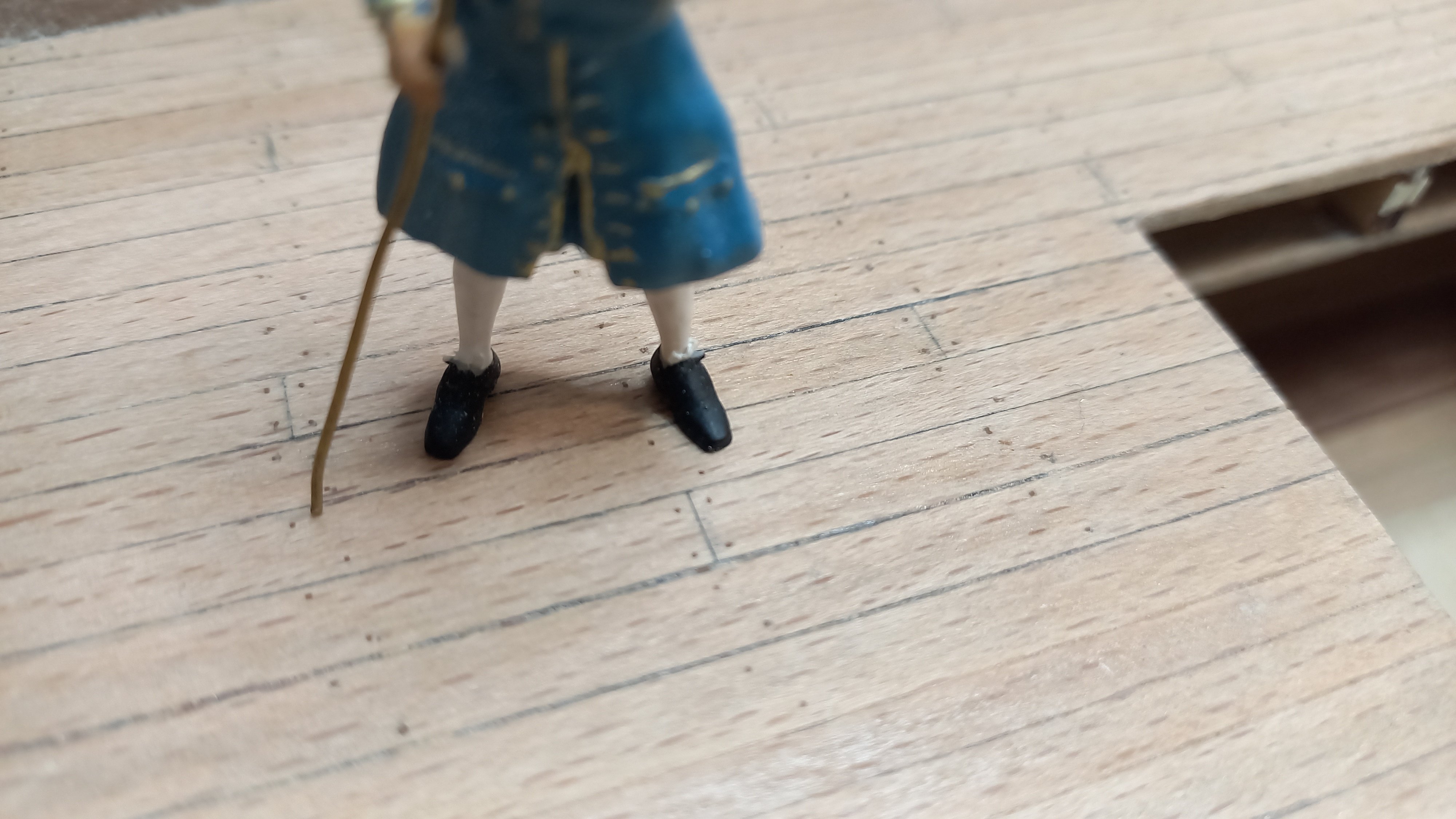

The first deck planking is finished. Sanding has been done to remove hollows and bumps.
The deck of the trabaccolo was wide and notably convex, with a thicker plank in the center called the "corsia" , where the mast and bitts were located. The cutting of the hatch panel and access to the living quarters will be done after the final deck planking is installed. I have accurately marked their future locations.
The underwater hull is painted with Mars Black acrylic paint.

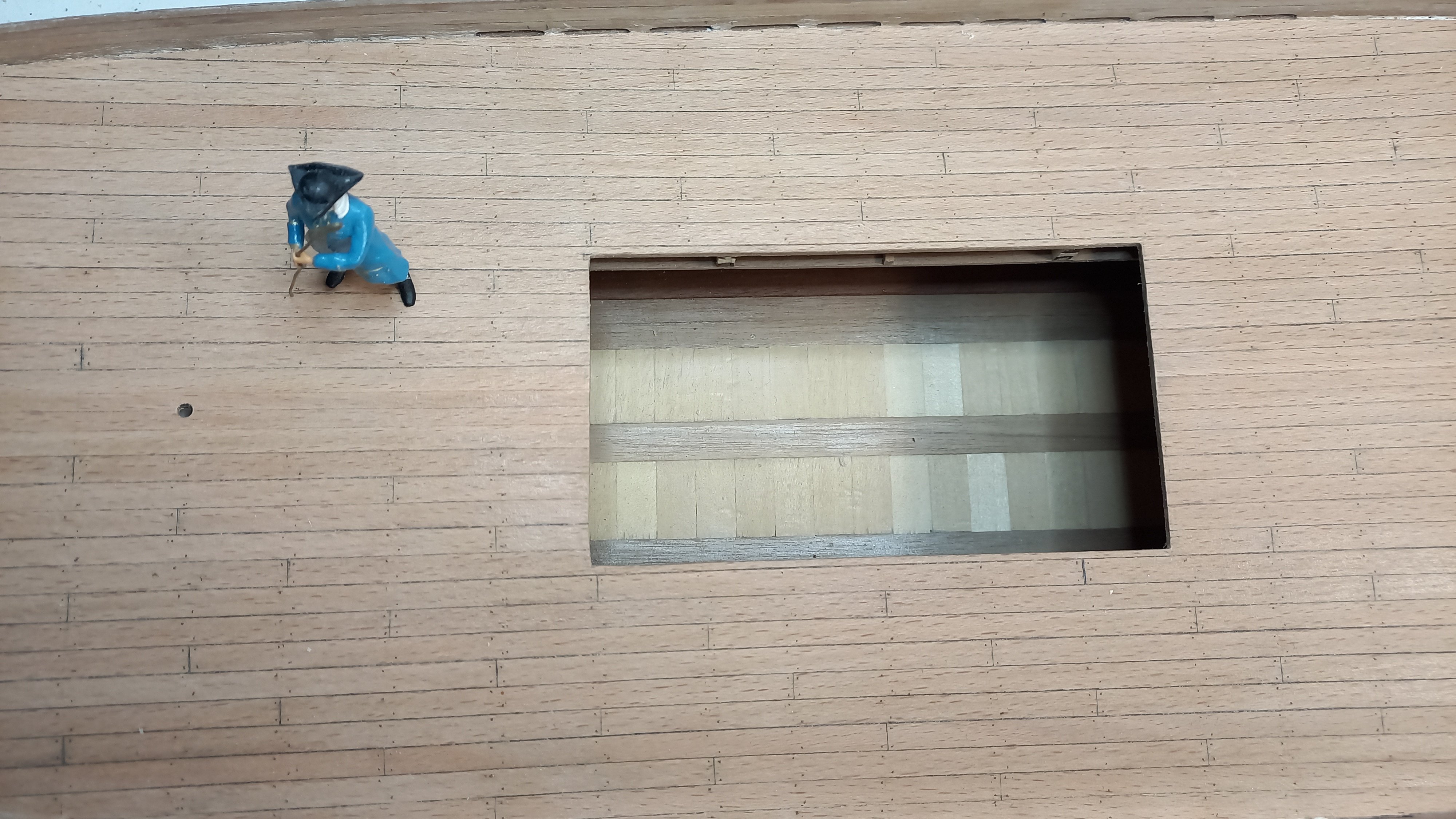

Hello,
I'm starting the final planking of the deck.
The normal length of a plank is 10 cm (which scales to 320 cm).
The kit suggests a beam spacing of 2.5 cm (or 80 cm scale). I've decided to reduce this spacing to 2.0 cm (64 cm scale). Therefore, I'll be simulating the treenails every 2.0 cm instead of 2.5 cm.
The second layer is completed using 0.5 x 5mm strips. This layer will also start amidships (in the middle of the deck), but with a key difference: a 17mm wide central strip will be glued on top of it. Therefore, the total width of the first four strips—two on either side of the centerline—must equal 17mm. These thicker planks in the center are called the "corsia."
I'm also making sure to avoid using shorter planks (as indicated by the red circles in the drawing extract) and am accounting for openings in the planking.

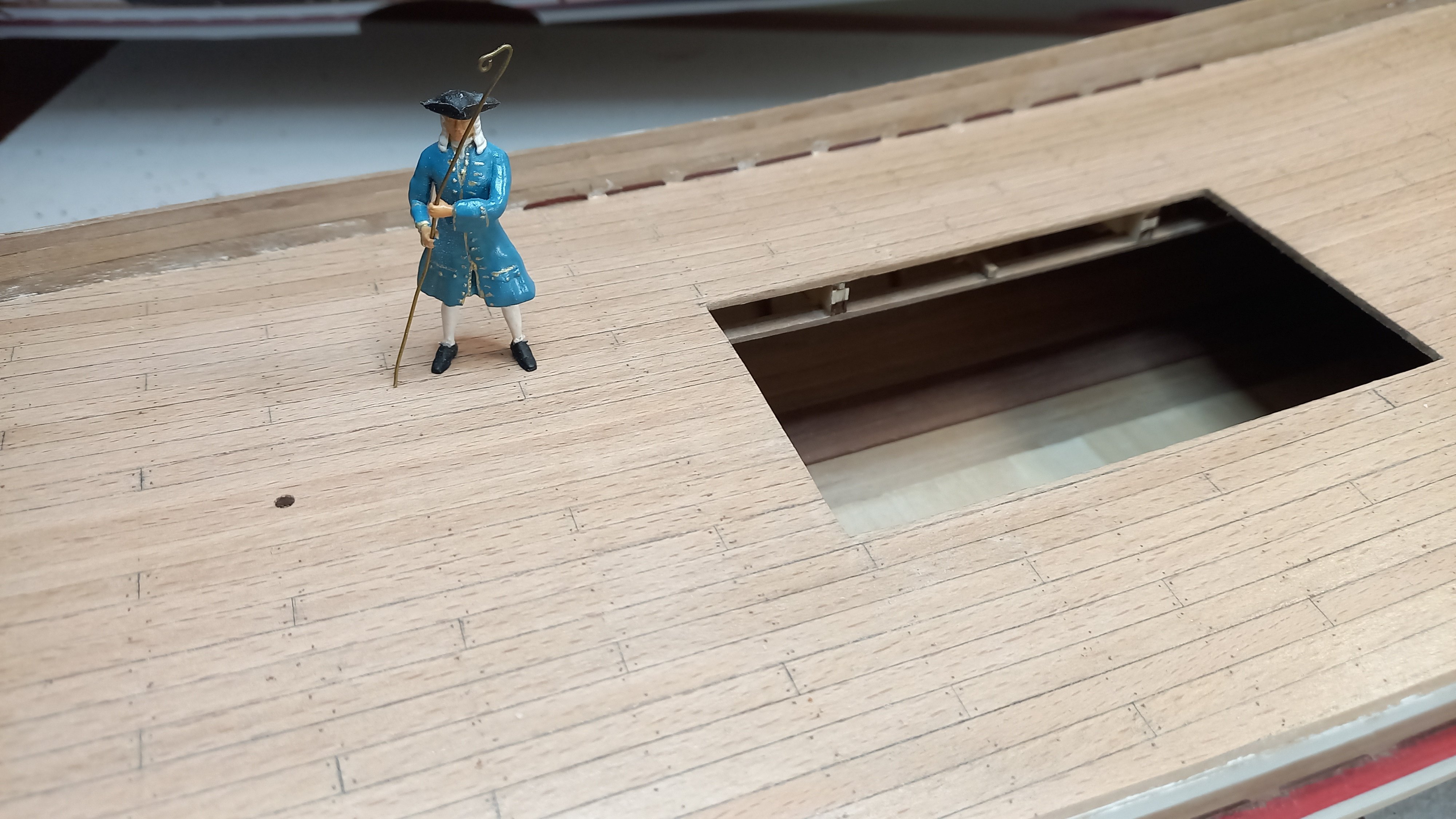

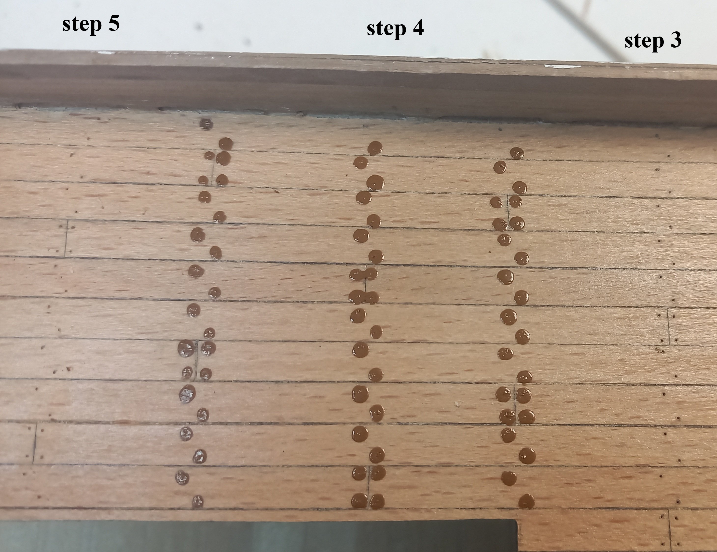

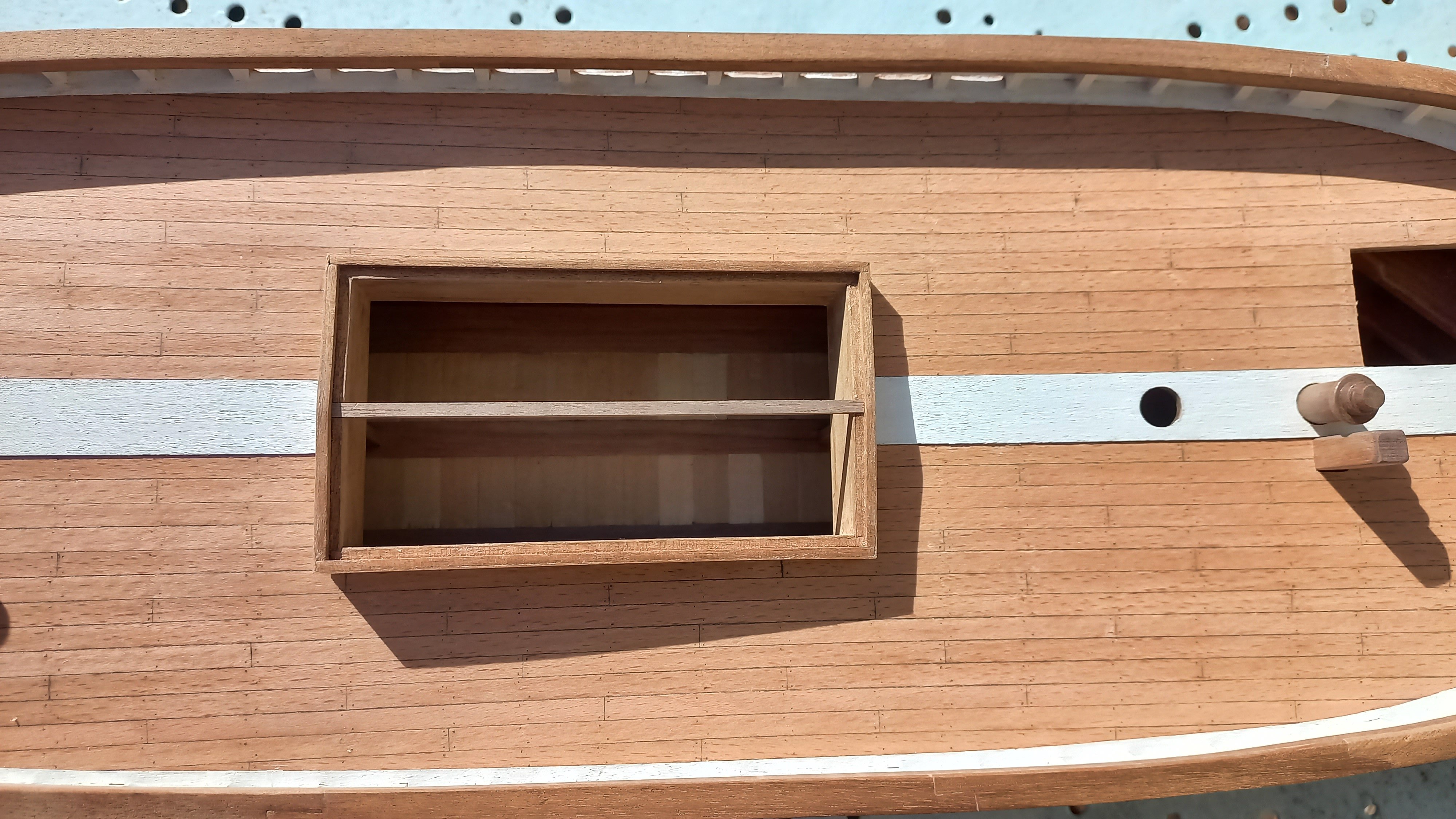

Hello,
I've finished the deck and all the treenails (around 500). 😅
(I reduce the distance between the line of treenails)
For the treenails, I did the following:
  1. Applied the wood filler (Fondur in France)
  2. Marked the position of each treenail
  3. Drilled the holes (0,3mm) .  ~10 drill bits to finish !
  4. Filled the holes with a mixture of glue and colorant (sienna)
  5. Removed the excess mixture
François
In progress Trabaccolo -MarisStella - 1:32
________________
Completed :
Endurance (log - Gallery)(OcCre), Granado 1756 - HM Bomb vessel - JoTiKa/Caldercraft - 1:64

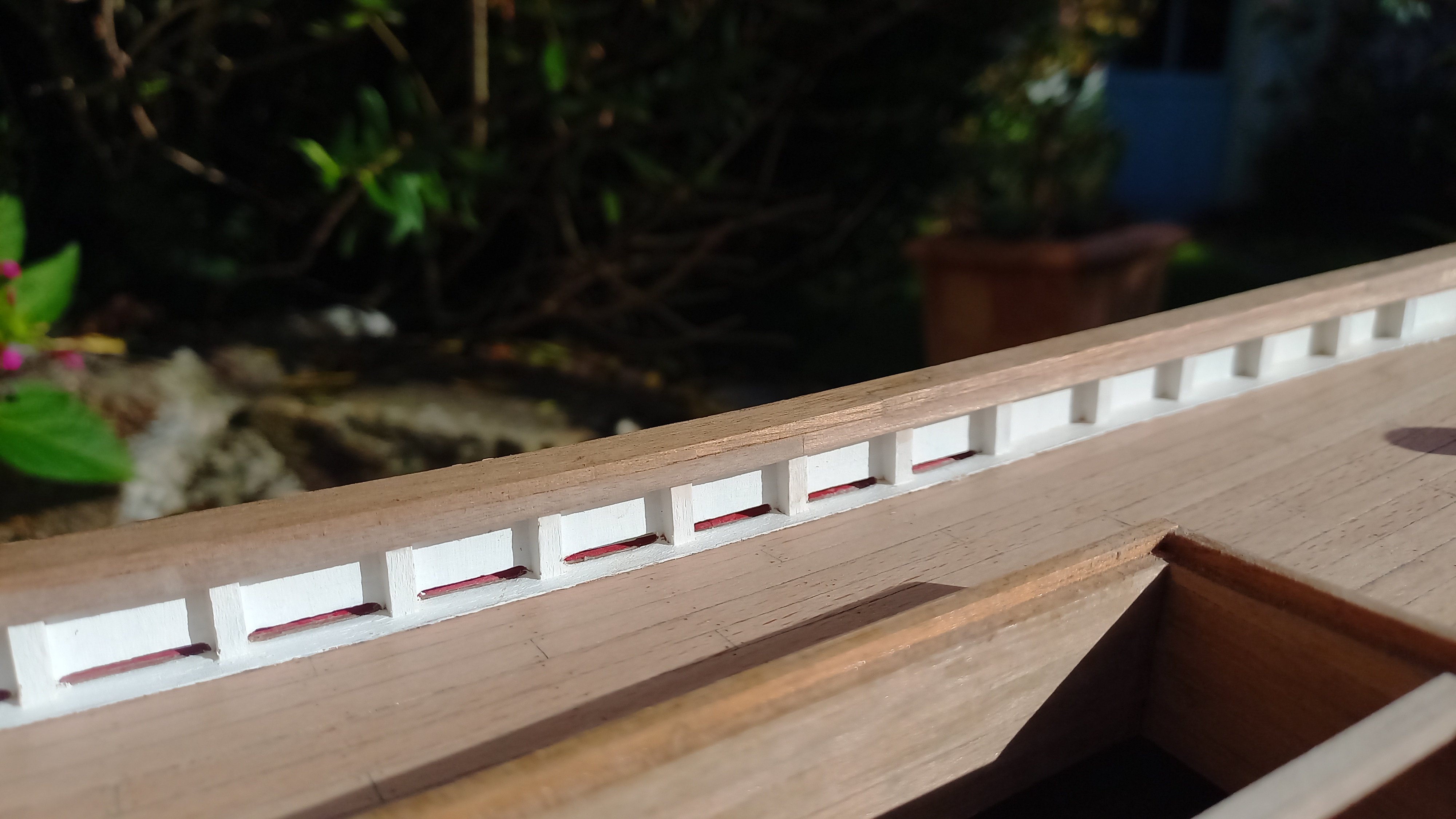

Hello,

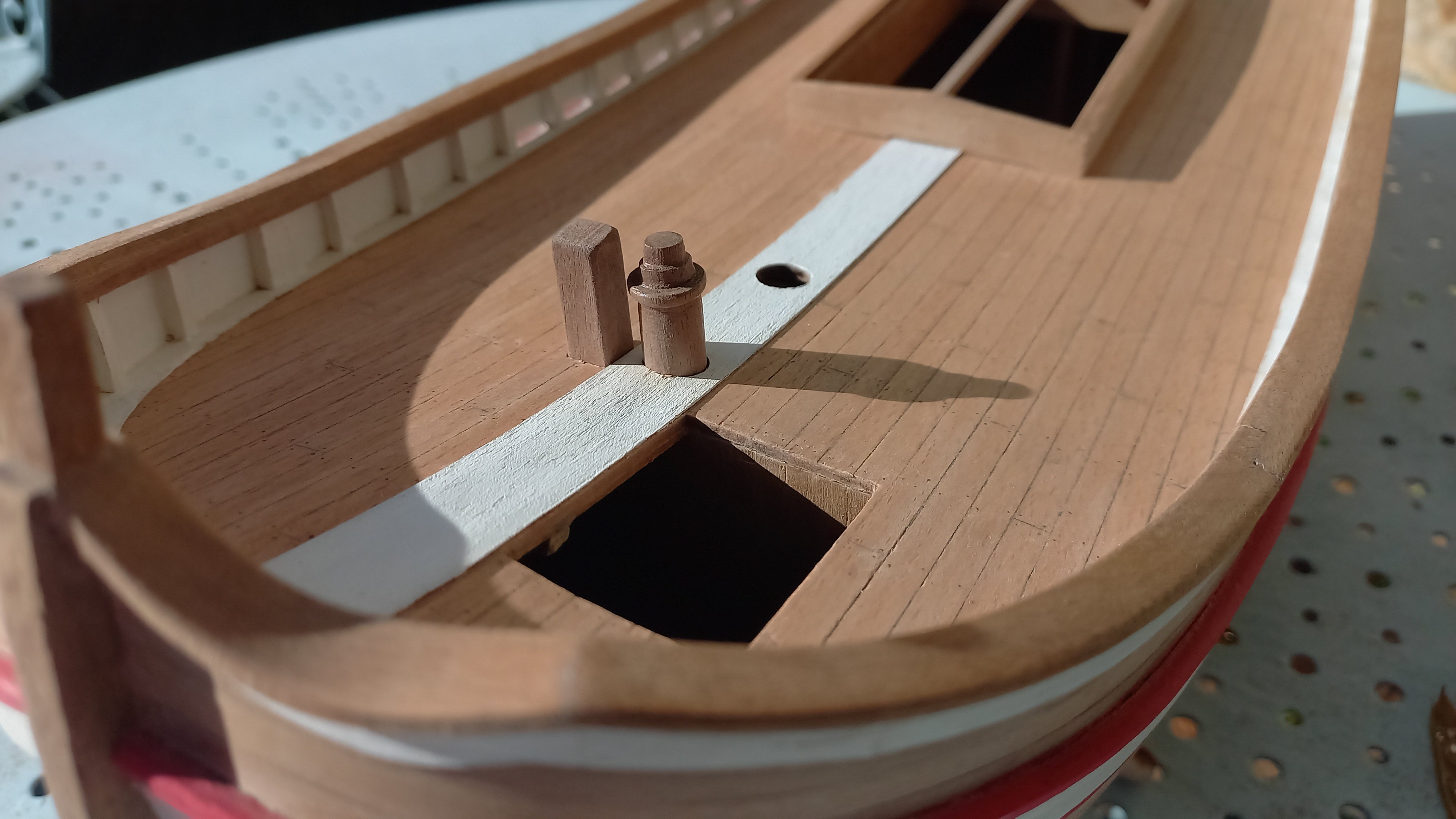

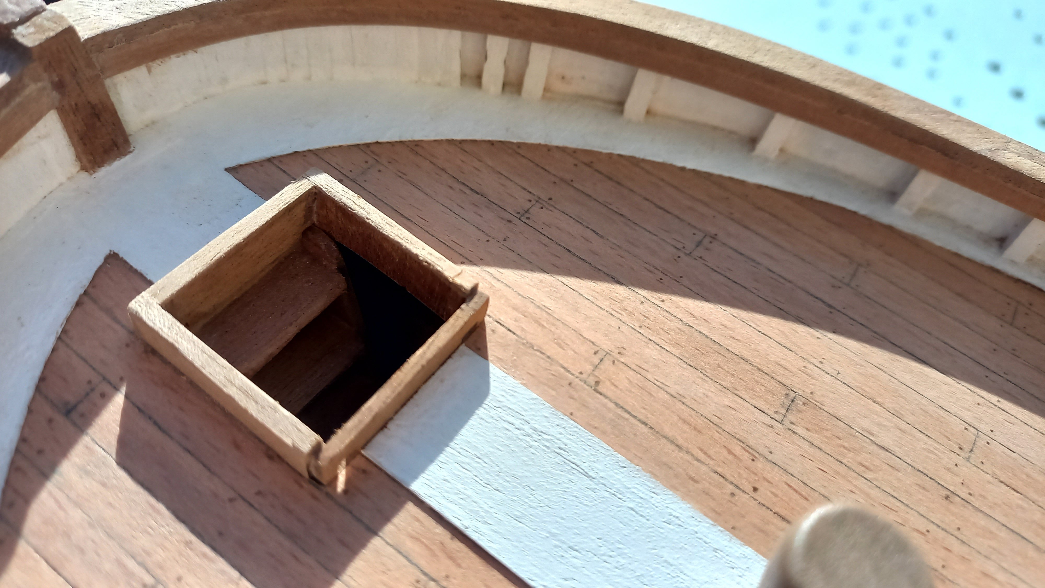

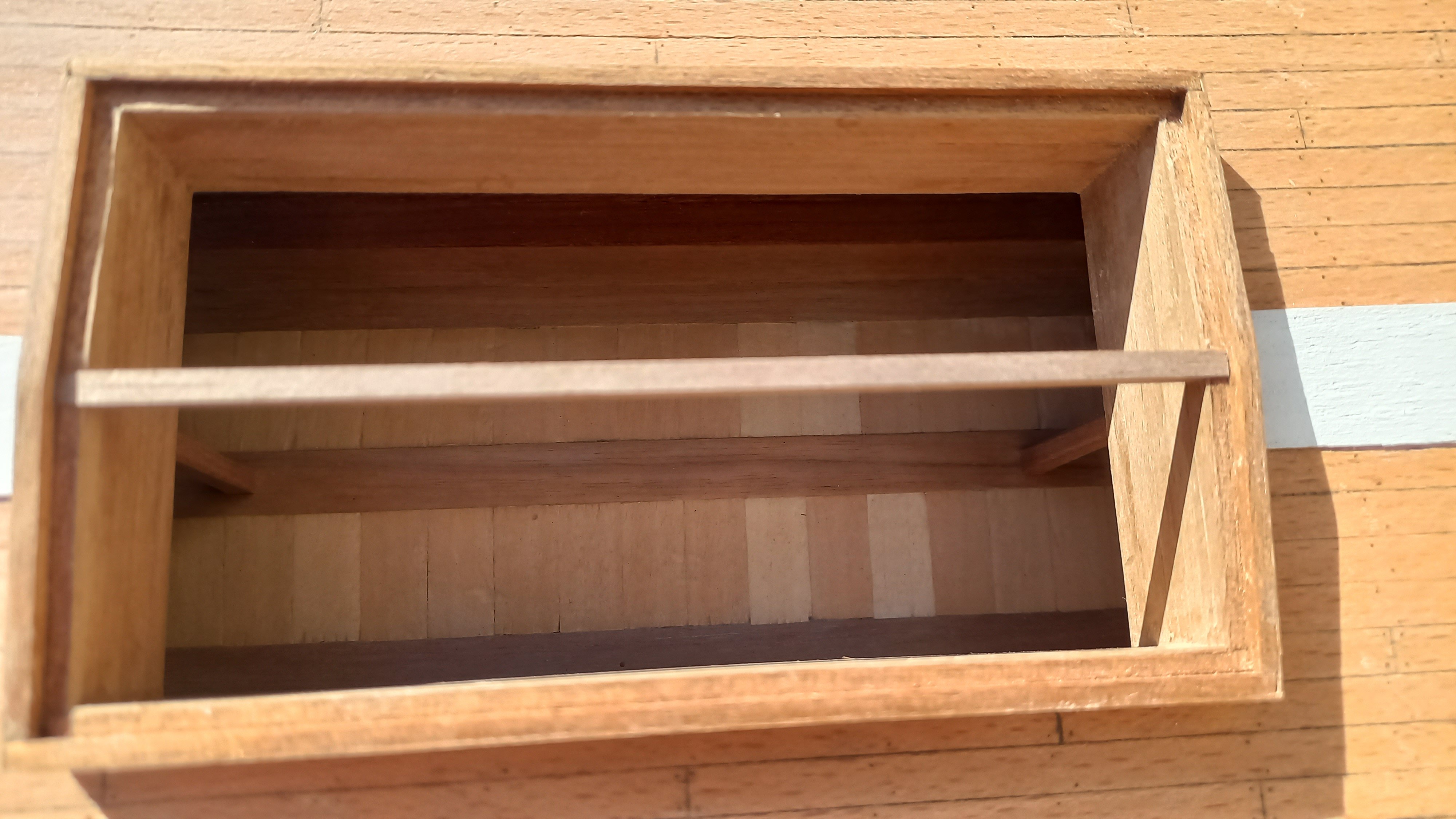

Waterway  and "corsia"  fitted.
The deck of the trabaccolo was wide and noticeably convex, with a thicker plank in the center called a "corsia"
François

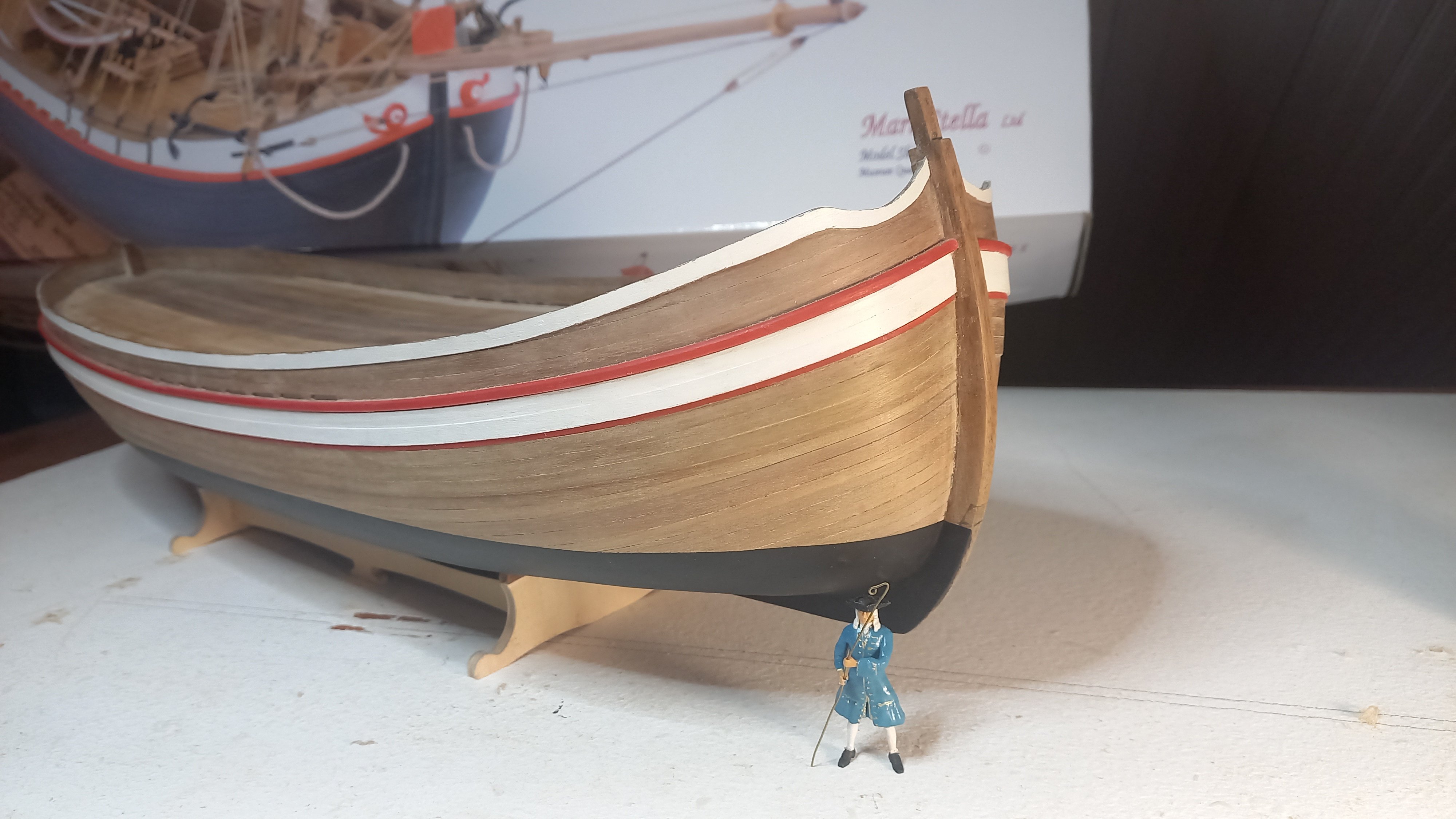

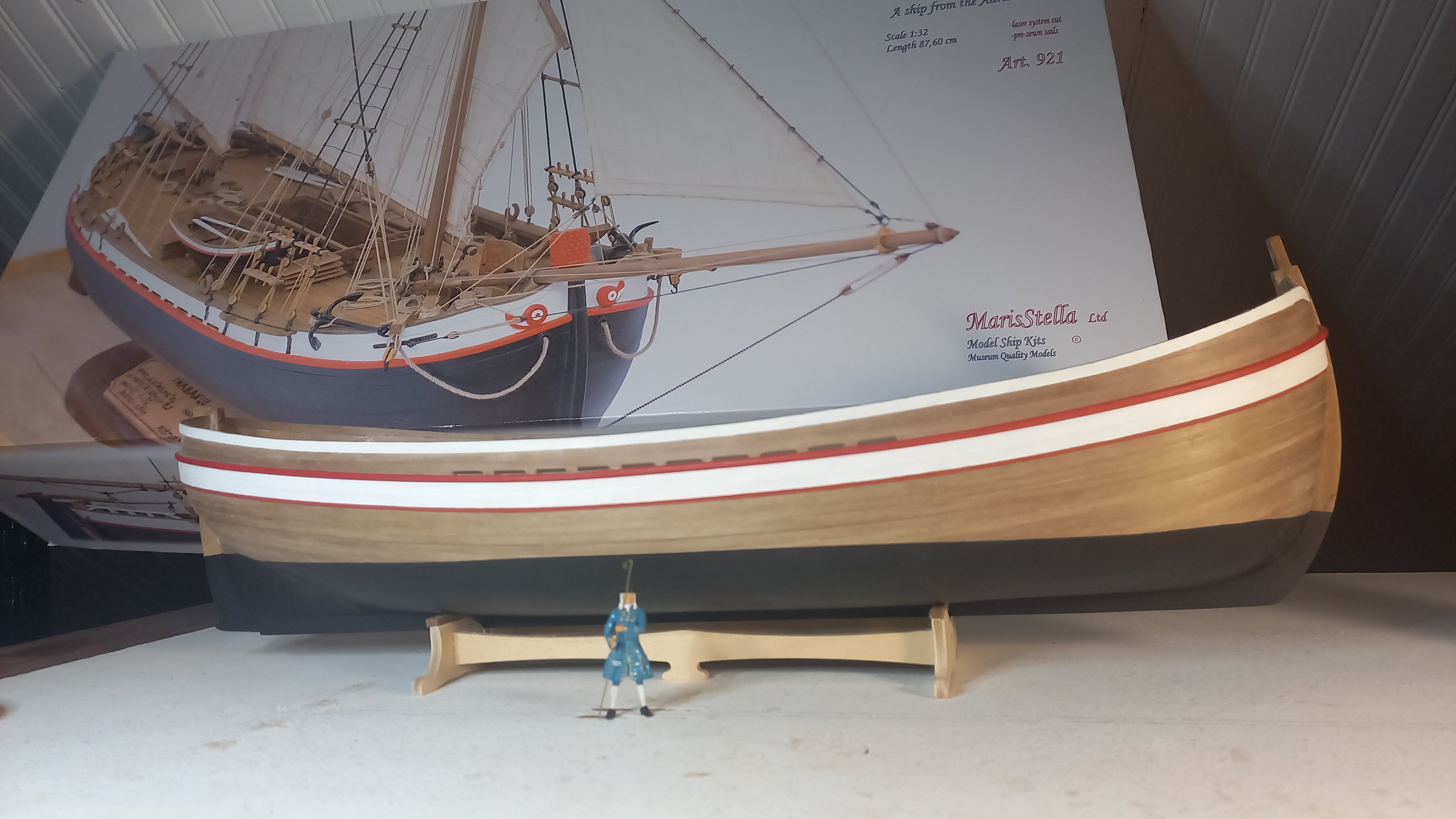

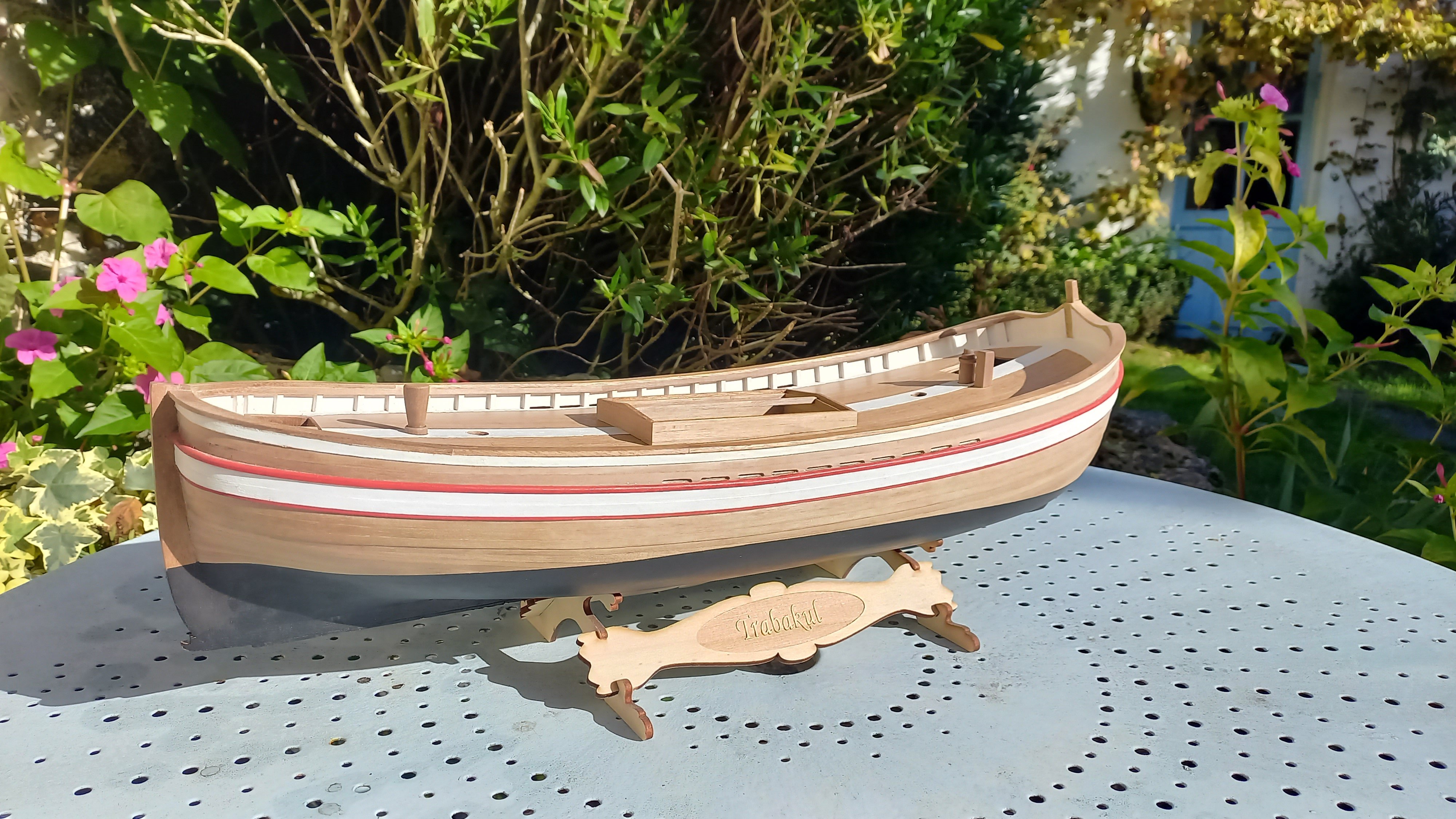

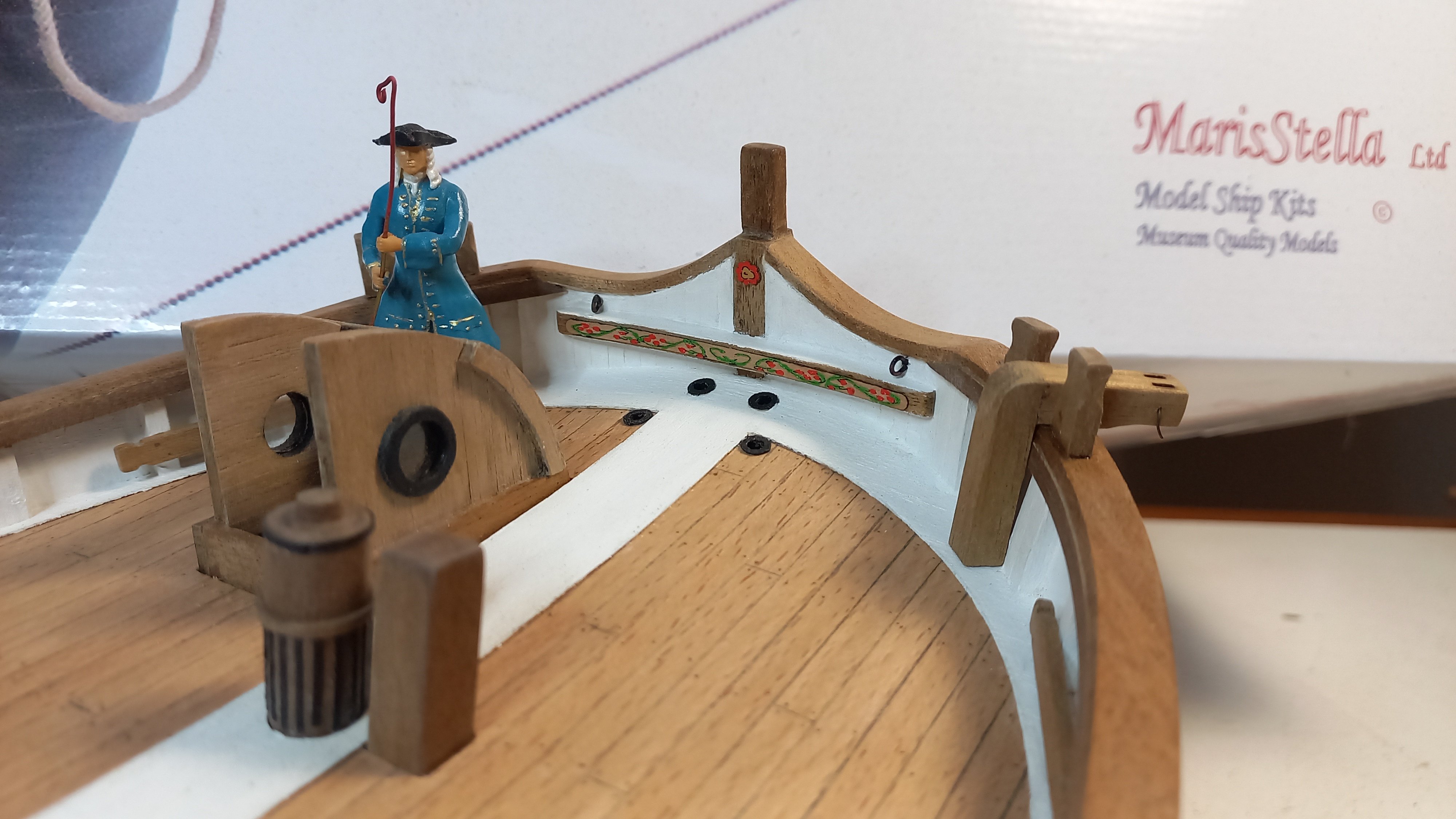

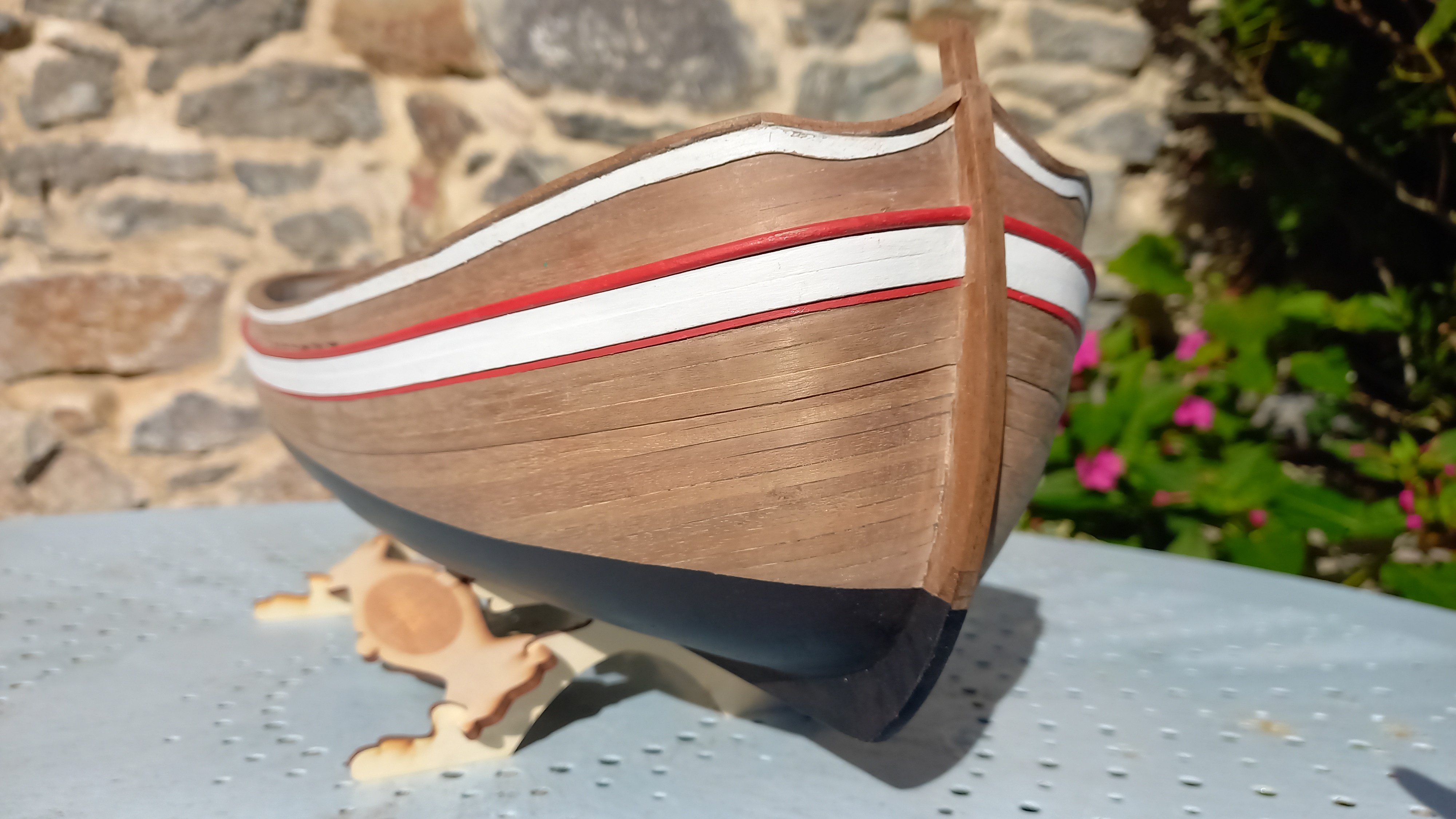

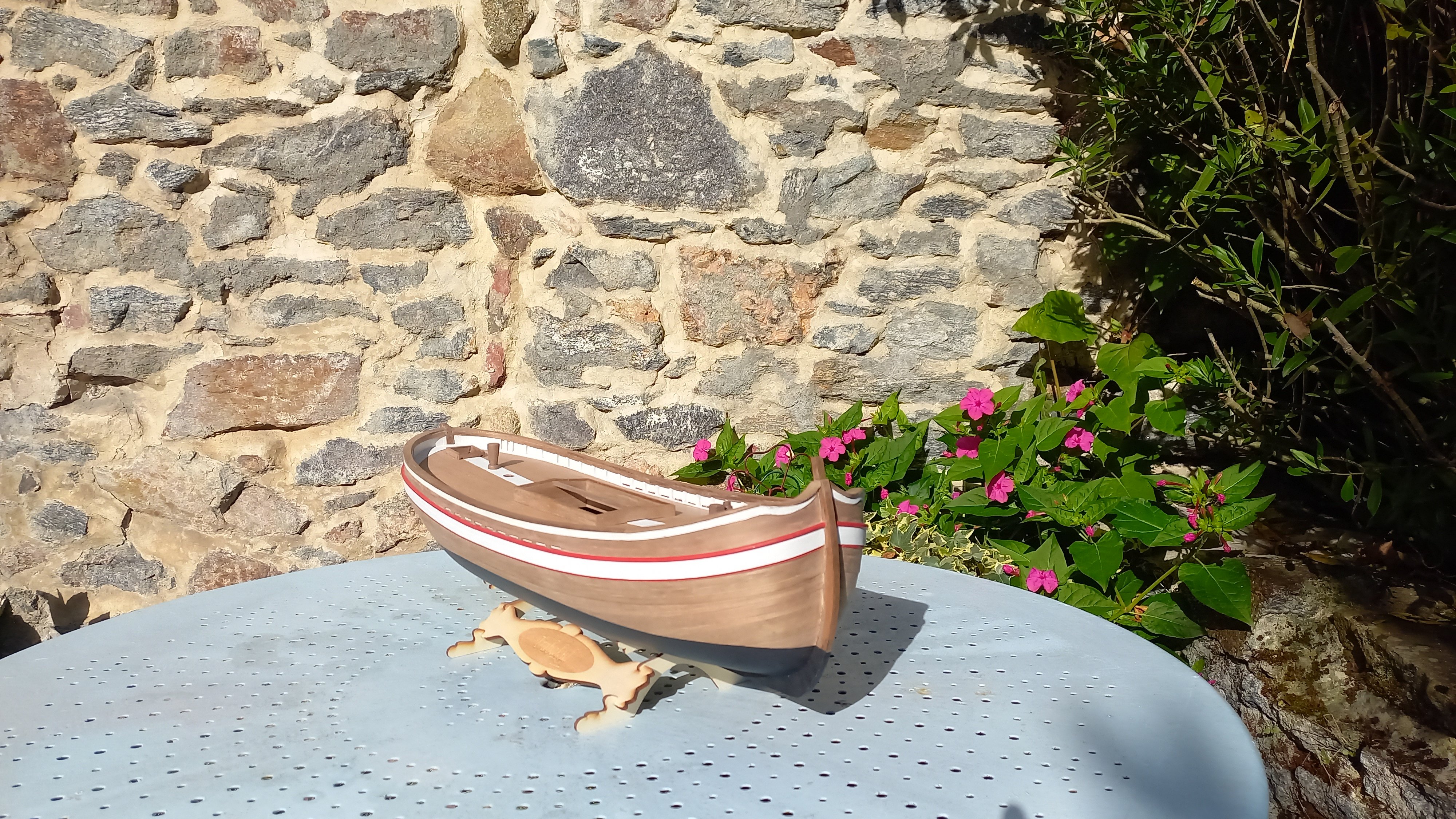

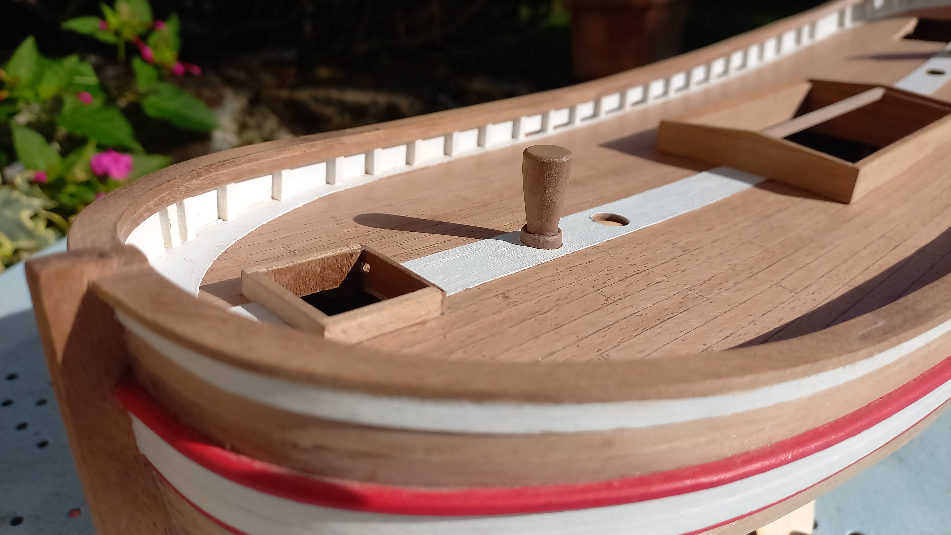

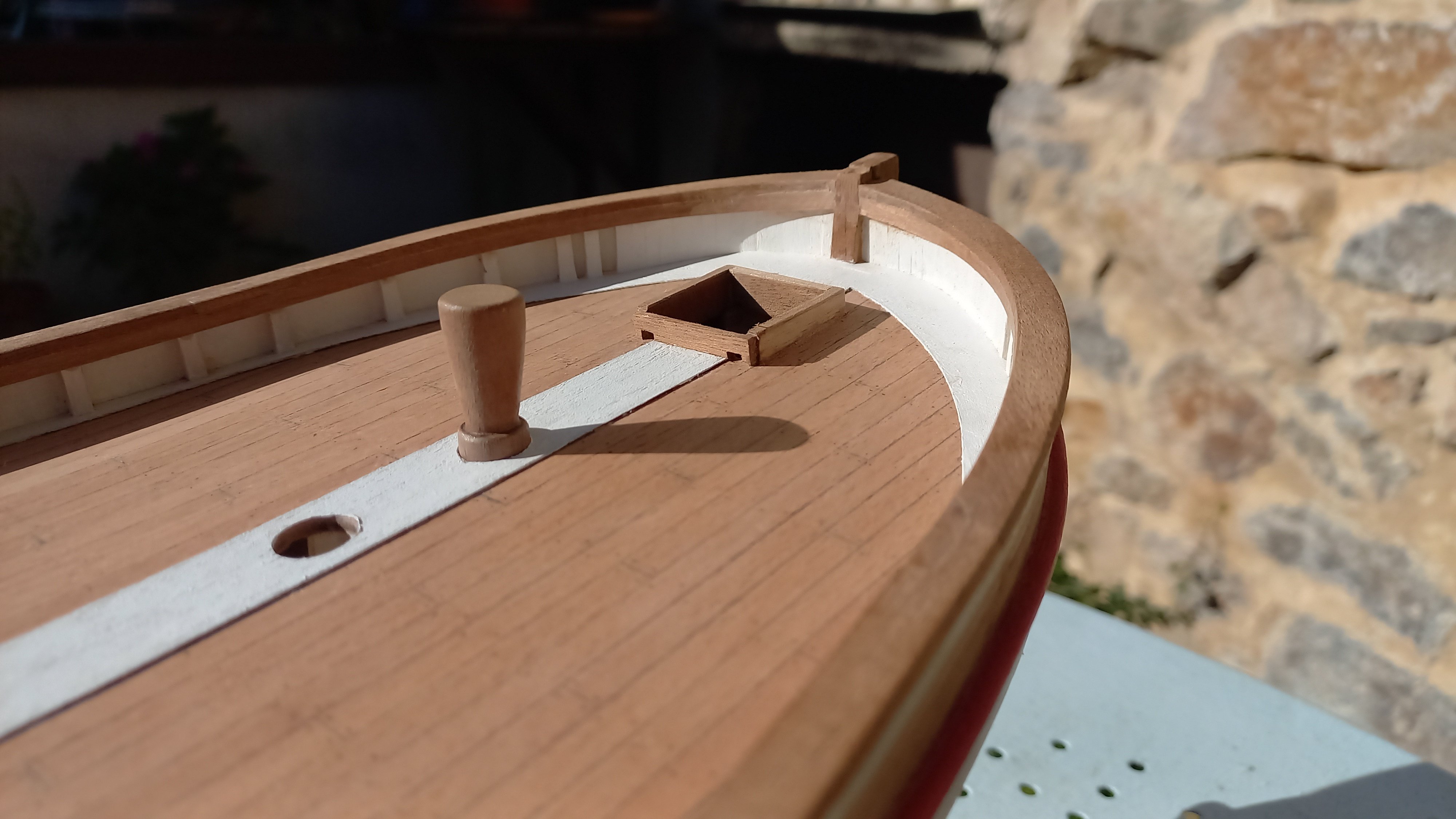

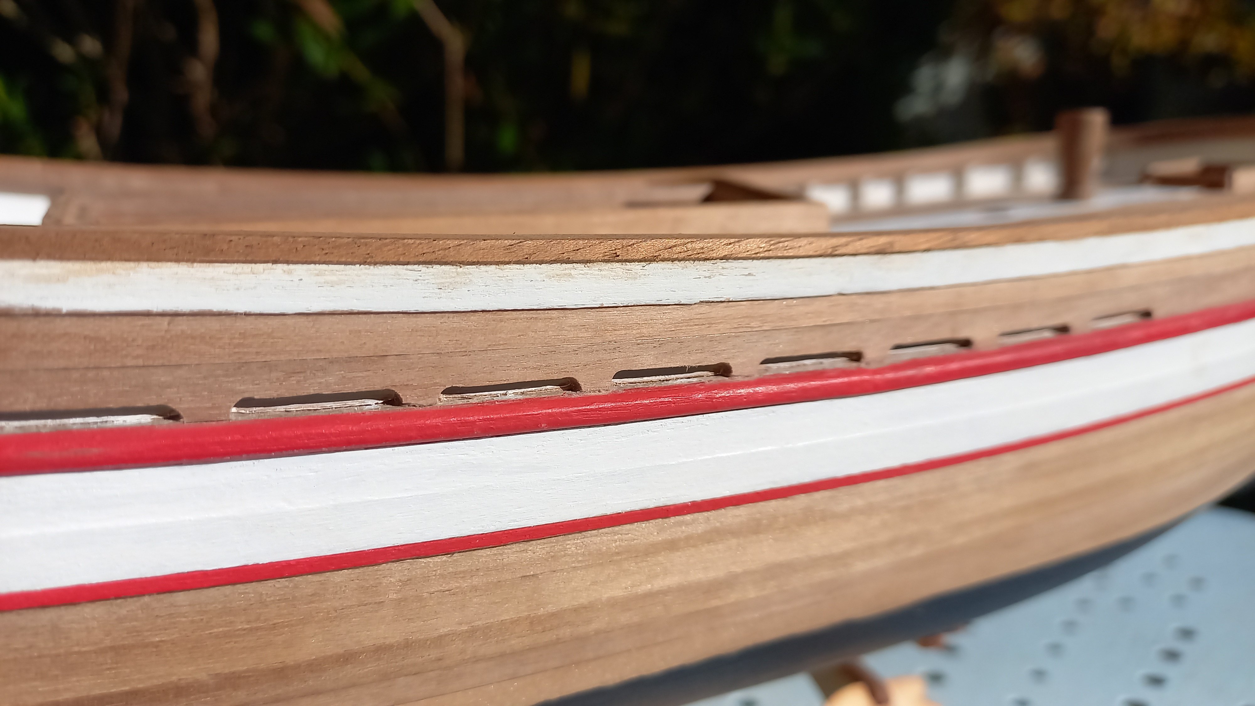

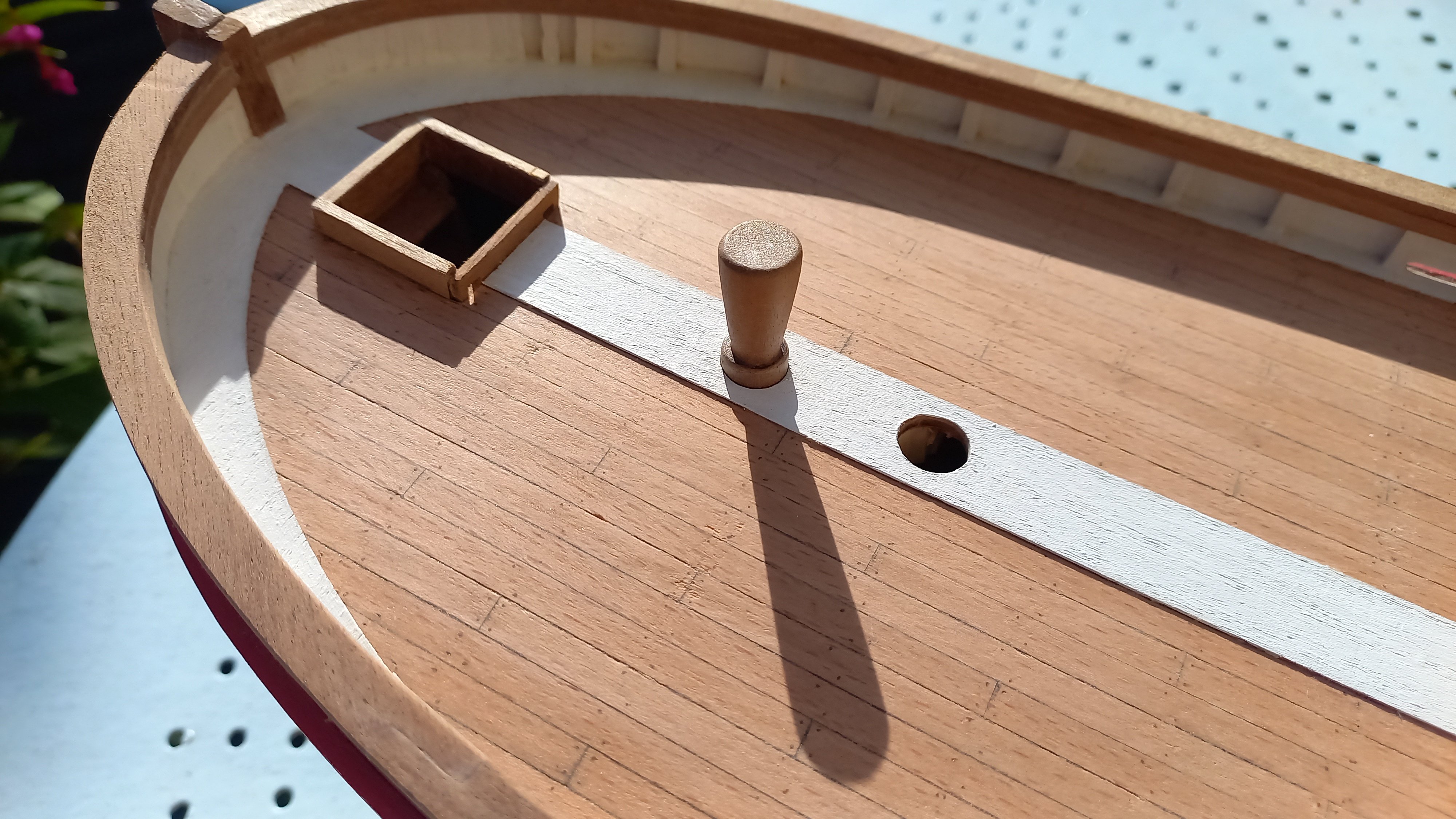

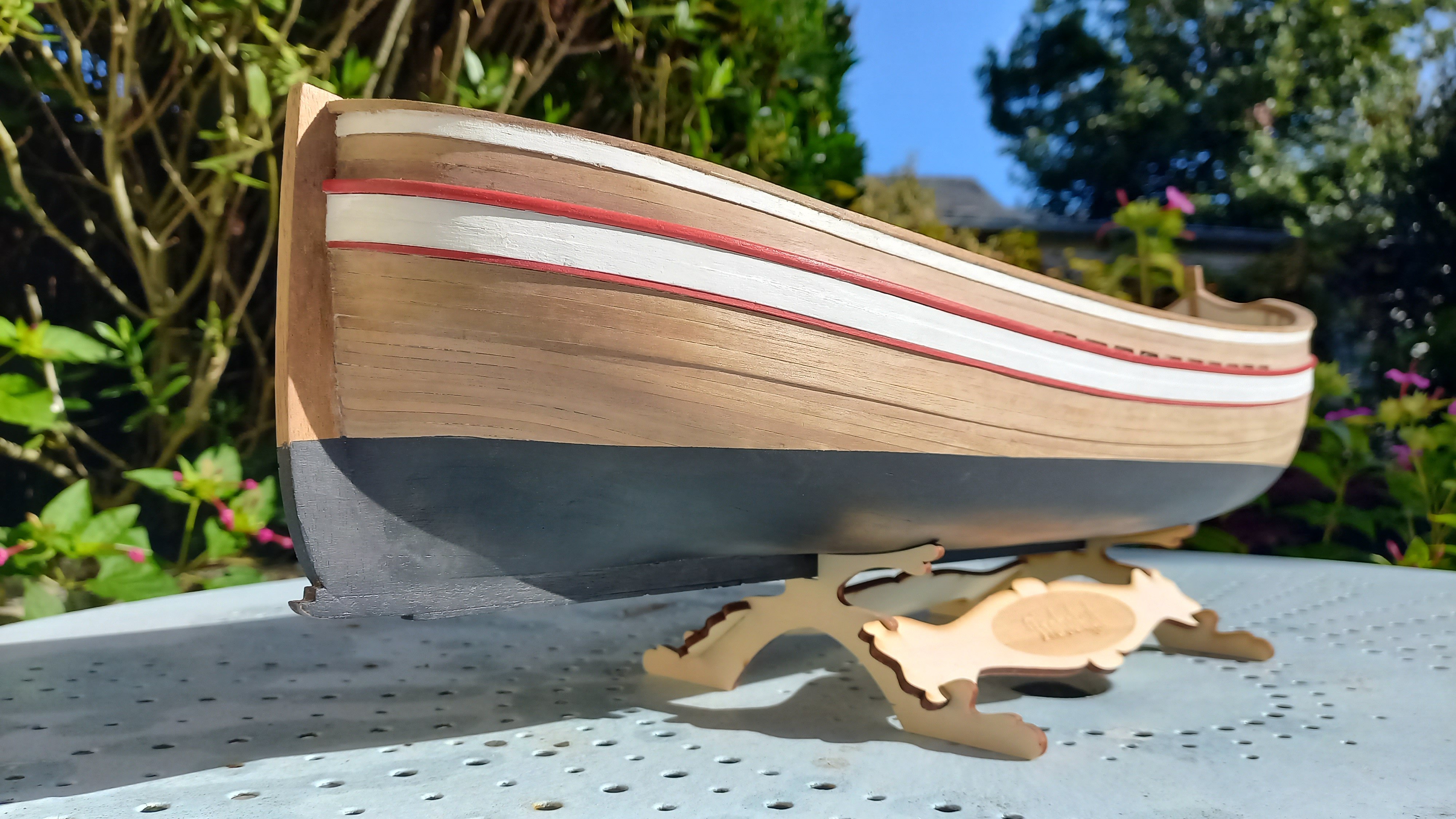

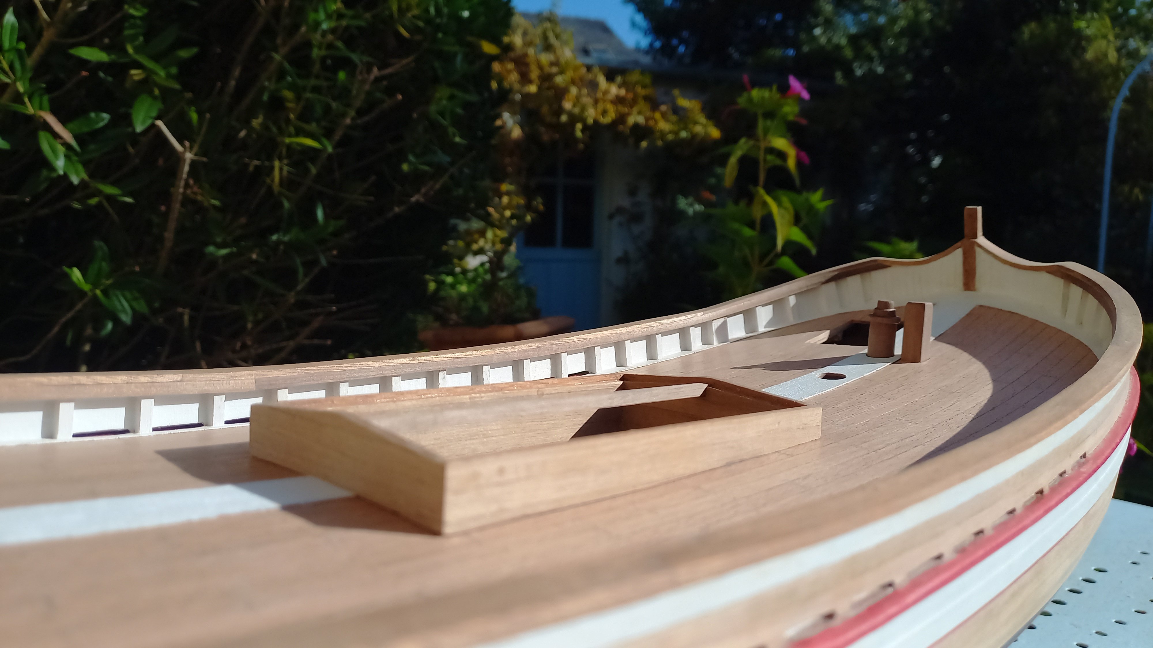

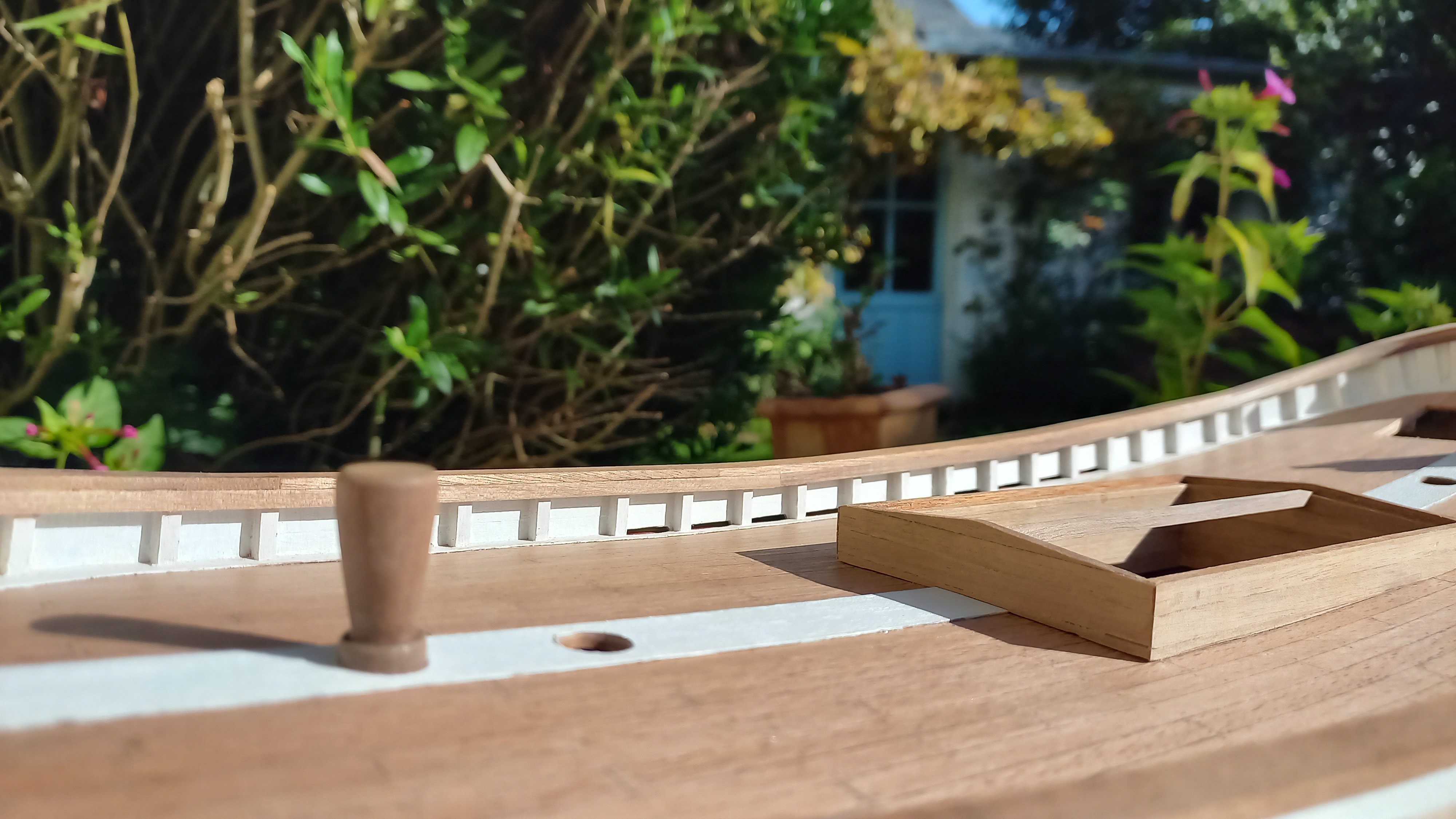

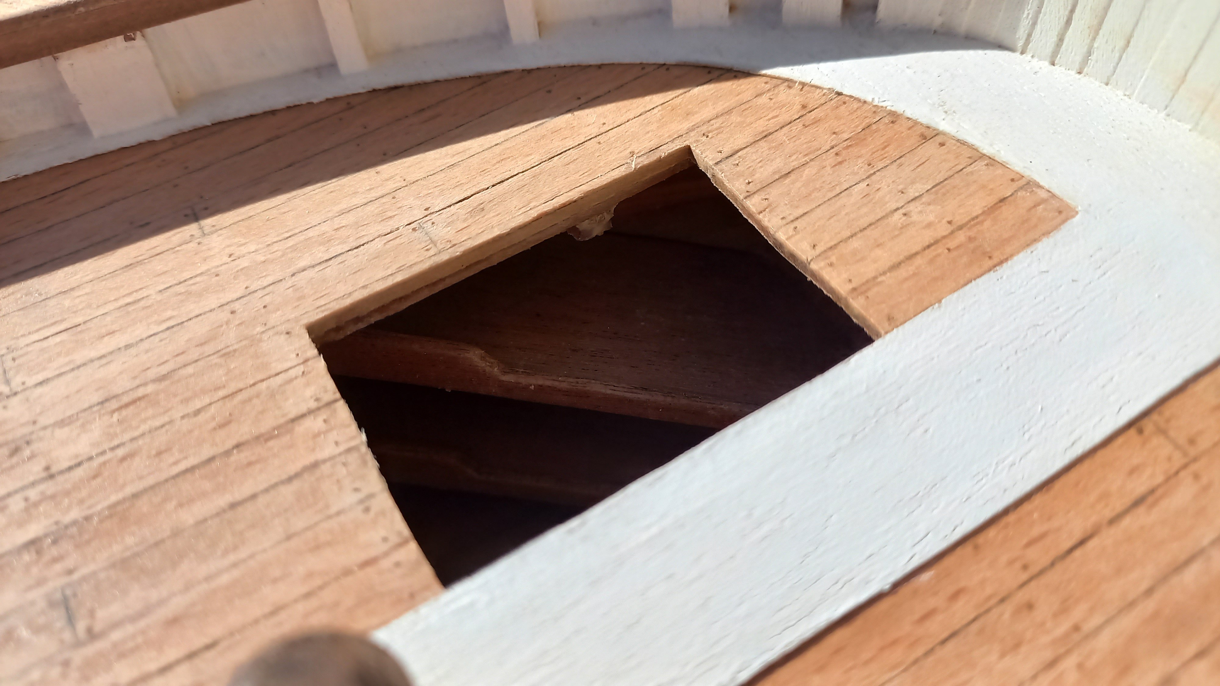

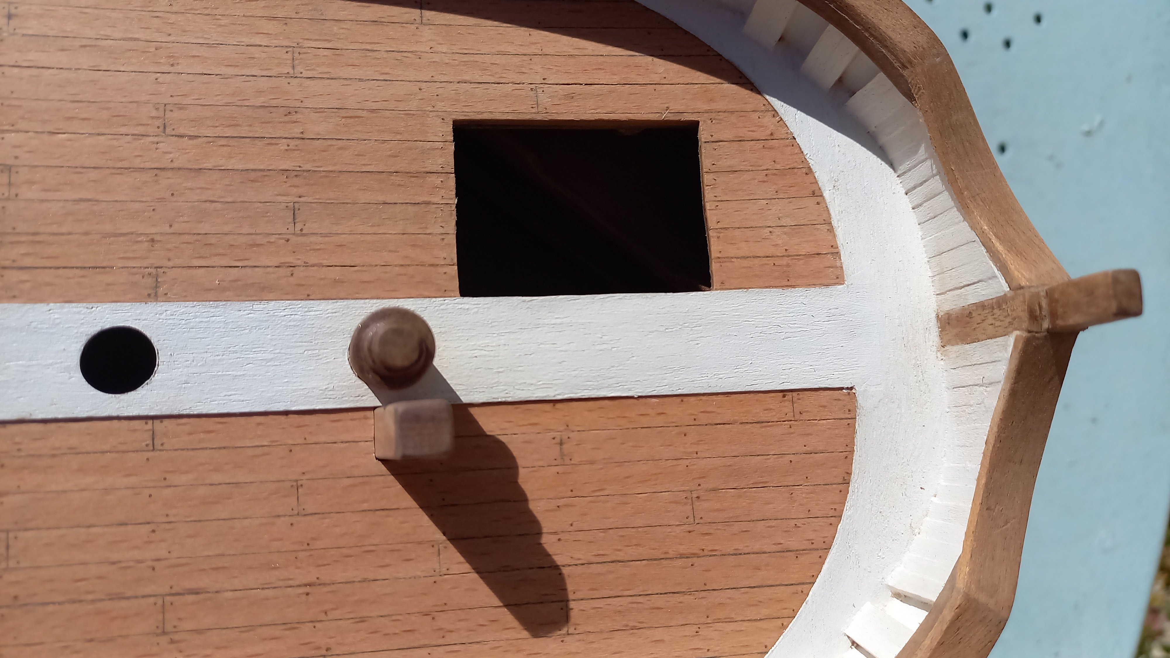

Hello,
The trabaccolo is ready to be launched! I took the pictures outside where the light is better.
Have a nice day. 😄
François

Beautiful work! I really like the natural wood tones mixed with paint highlights, it looks really sharp!
