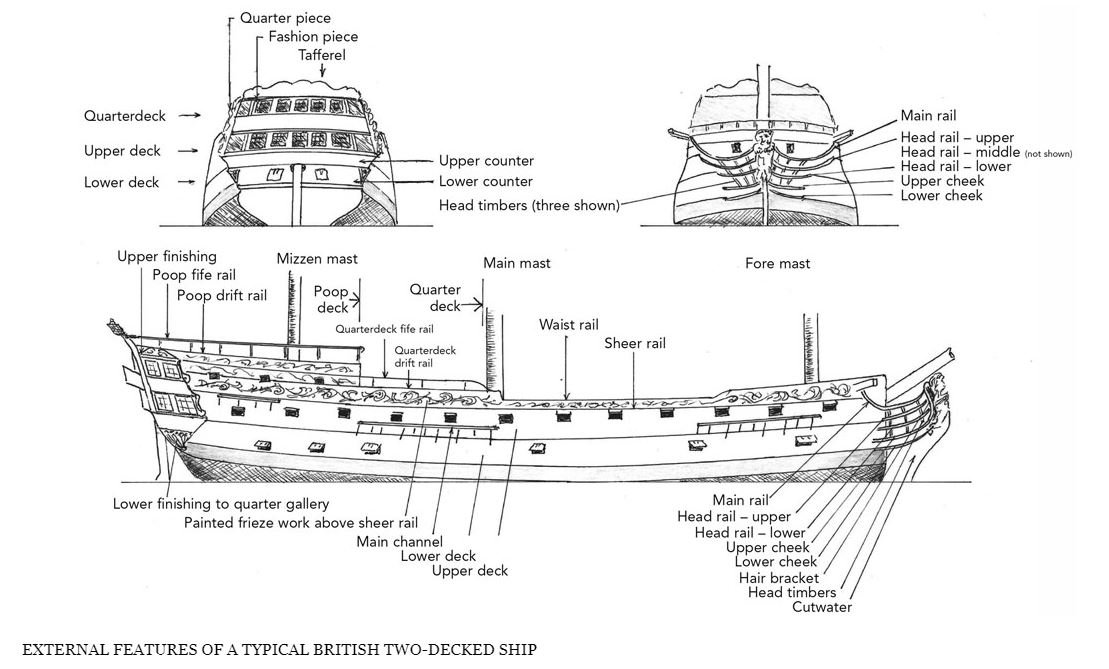

I've annotated the plans for you here and indicated which rails are which. Jon, please correct me if I'm wrong
I checked my "library" and found this diagram. I hope this helps.
Jon
Thanks Jon, a big help as always. This nomenclature is basically the same as what is in AOS, except there is no middle or lower head rail, so it is simply called the second head rail. Also, the diagram above does not show or mention a false rail, but I guess the AOS is correct in referring to the covering between the main rail and the top. Anyway, thanks for the diagram, alot of other good terms to know as well.

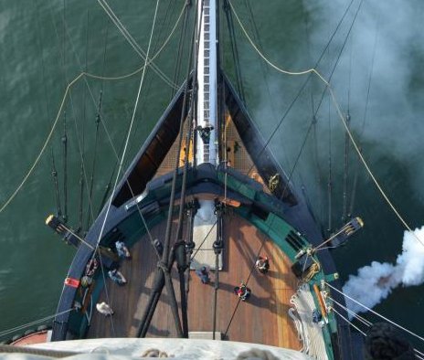

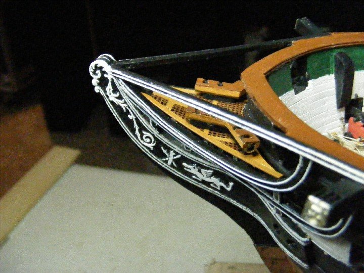

First, some definitions.  The straight rail which extends from the cap rail to the billet head is what I call the false rail.  The rail below that is what I call the main rail.  The lowest one that curves upward to become the cathead knee is what I call the second rail.

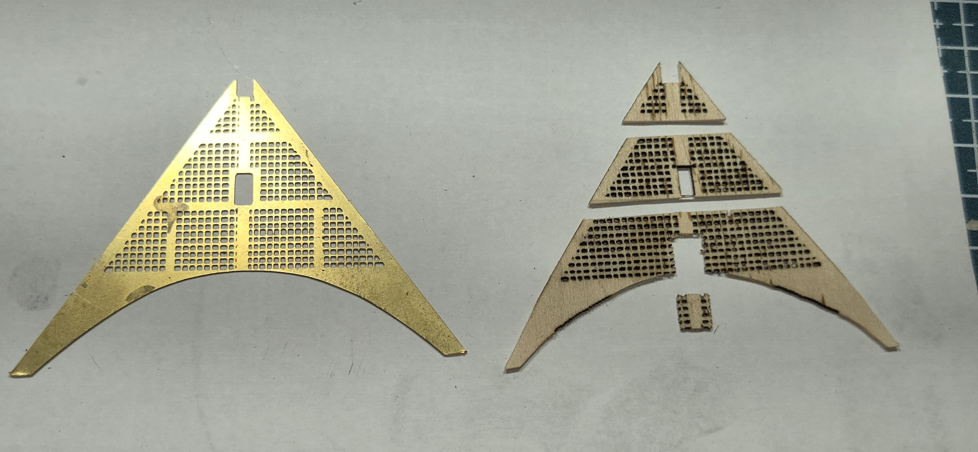

Looking straight down on the bow of the carved hull provided in the kit, you can see that it is semicircular.  The provided PE grating is designed to fit this profile.  You can see in this photo of the actual ship that this design is wrong:
Accordingly, I altered the profile of the bow when I did the hull shaping.  It looks like you did the same.  Consequently I made major changes to the PE piece narrowing it quite a lot and adding Britannia metal strips on each side to replace the framing that I cut away:
I did not cut any additional notches out of the center.  I believe that it sits on top of the stem, but I cannot remember for sure.  As you can see, I had to shorten the seats of ease so that they would fit into the reduced space.
My intention was that the grating would curve to match the curve of the main rail.
As you can see, it sits slightly above the rail.  This defect was fortunately masked when I installed the carboard (canvas) covering:
The bowsprit sits a millimeter or so above the grating on my model, but I see no reason not to have it sit on the grating.   However, since the angle of the bowsprit is different than the grating the only contact would be at the aft edge of the grating.

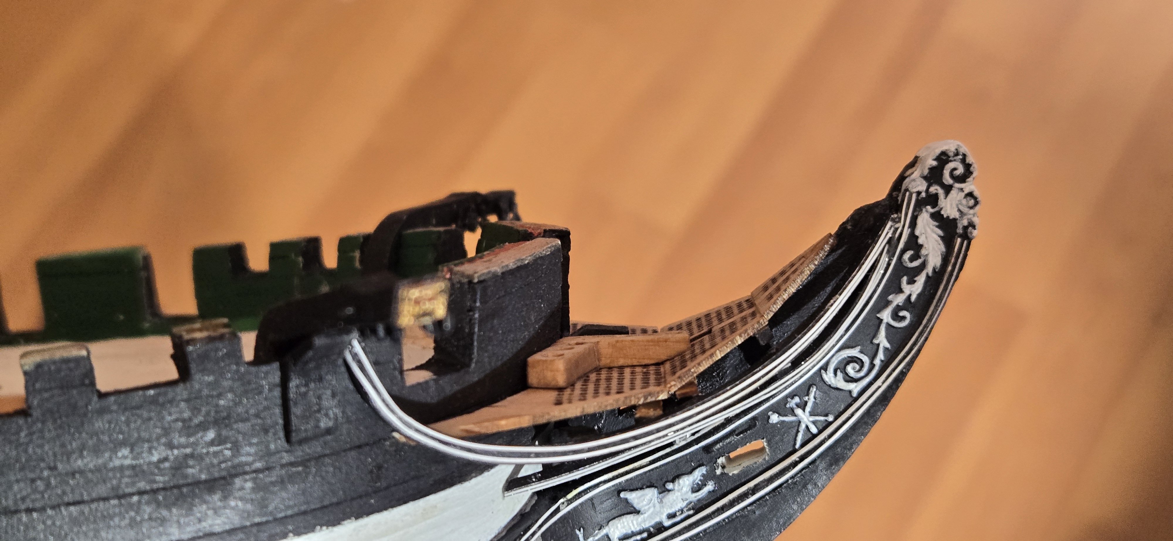

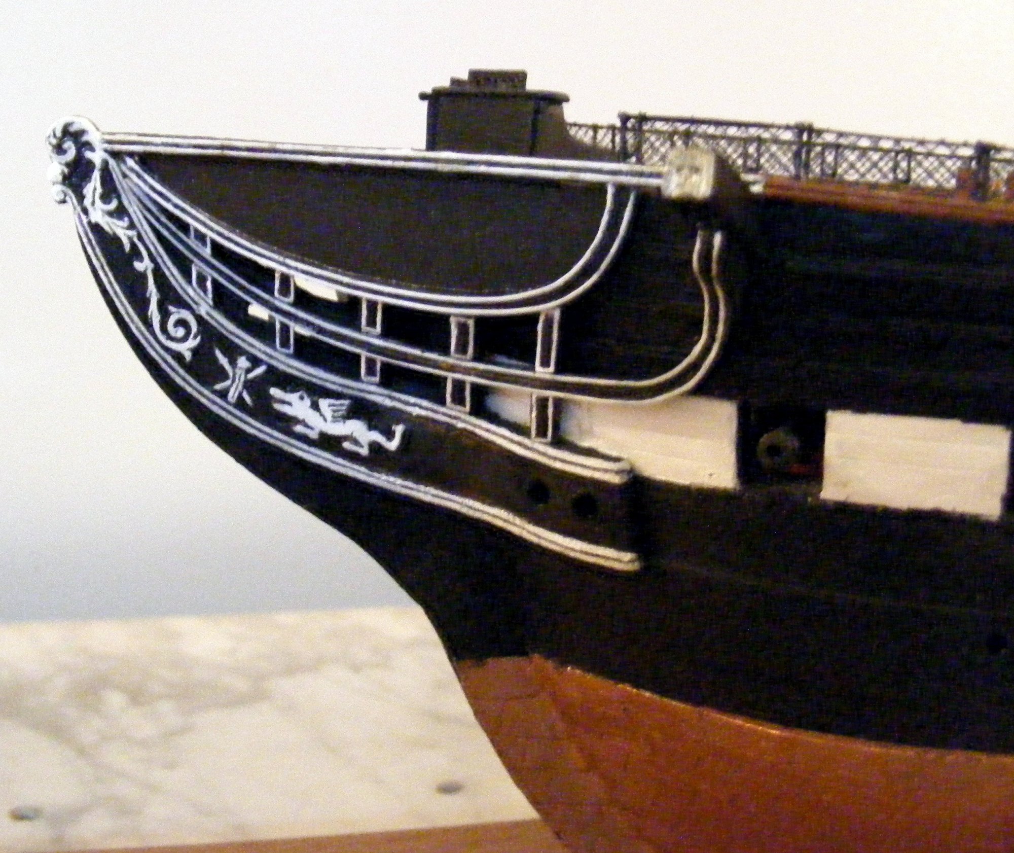

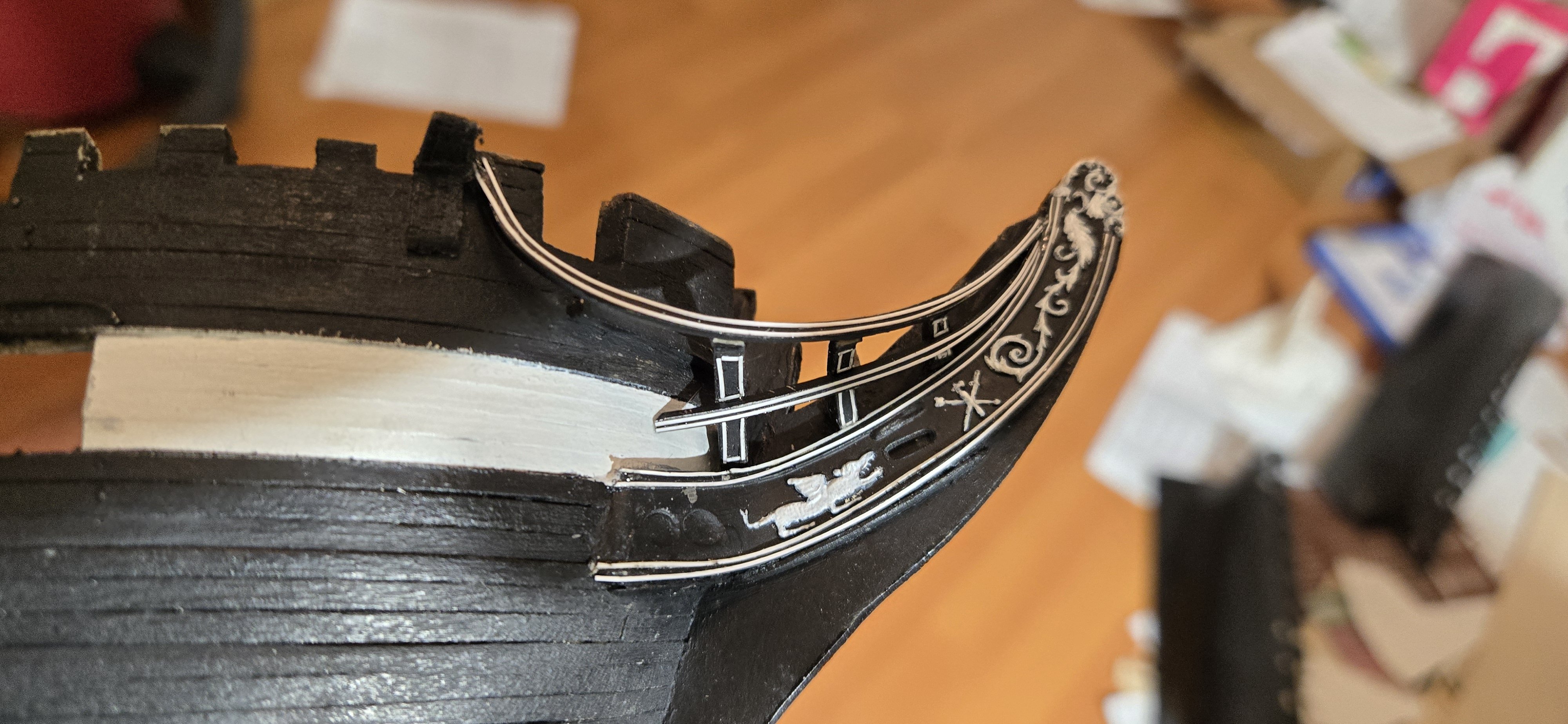

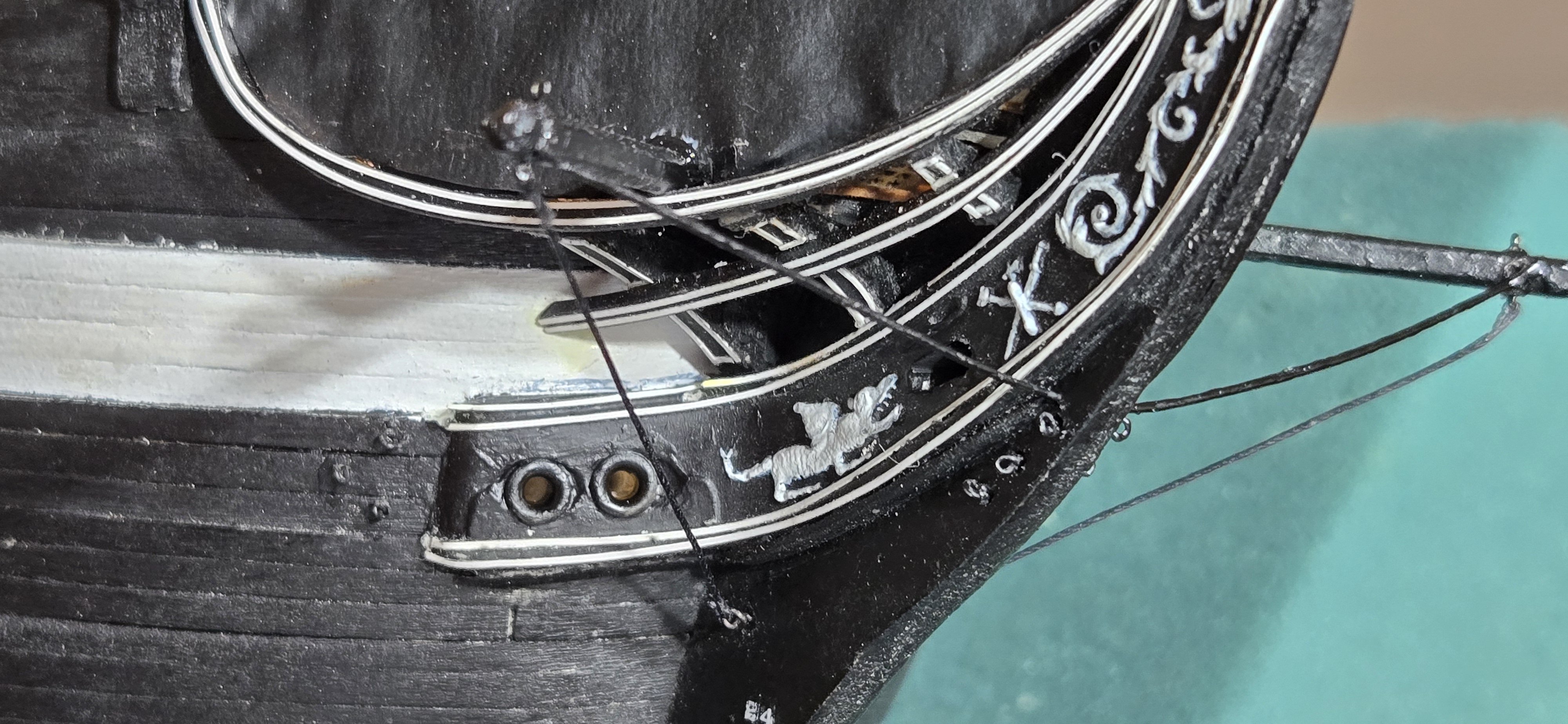

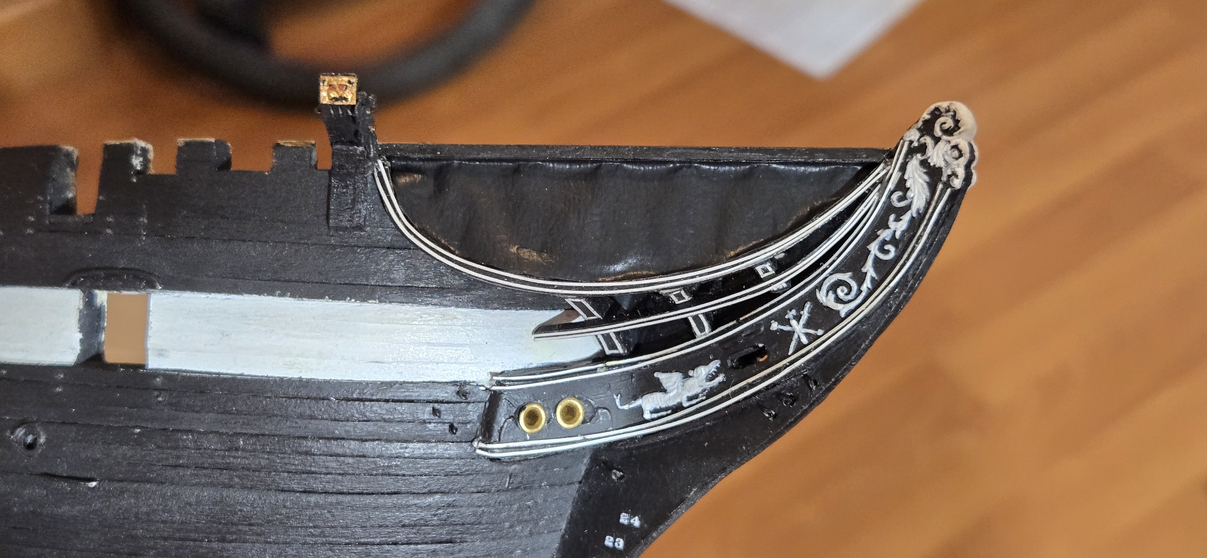

So, I've made alot of progress on the bow. @KurtH has stated a couple times that the first thing he looks at on a model ship is the bowhead. "if the heads are done well, the rest of the model is probably done well". With that in mind, I set out to make the best bow that my limited experience and skills would allow. To recap a little, I complicated the situation by deciding  to make the ship as she was in 1812, during the battle with Guerriere, my main reference being the Isacc Hull model and the Revell plastic model. This meant that I had no real plans for the head rail timbers, or the rails themselves. The Revell model has one integral piece for the rails, and I used this extensively to decide on positioning everything. When placed on my model, the part fit perfectly. This is the part:
I first made a template of the canvas cover to establish the shape of the main rail. From that template, I made a jig to shape the cast metal rails that I had filed down earlier. Prior to shaping them, I tapered the ends where they meet at the billet head. Here's where things got difficult for me. Although the piece fit perfectly between the billet head and the catheads, I wasn't sure how to position them laterally. Since the grating is supposed to fit just inside the main rail, I used this as my guide. Using the photoetched grating supplied in the kit, I made a template from cardstock. This was easily bent to follow the contours of the main rail and this allowed for the accurate placement of the main rails. Since at this point, these were just "hanging out in the wind" and only attached at their ends, I decided to beef up the connection. I drilled small holes in each end and using 28 ga wire made pins to reinforce the attachment. To ensure a strong bond, I used JB Weld to make the attachment. Once both were in place, I remembered that the back side of the grating needed a support along the hull. This was made from 1/16x1/16th stock and preshaped to fit the hull. Fortunately, I still had the jig I used to shape the planks at the bow.
Her's what I ended up with

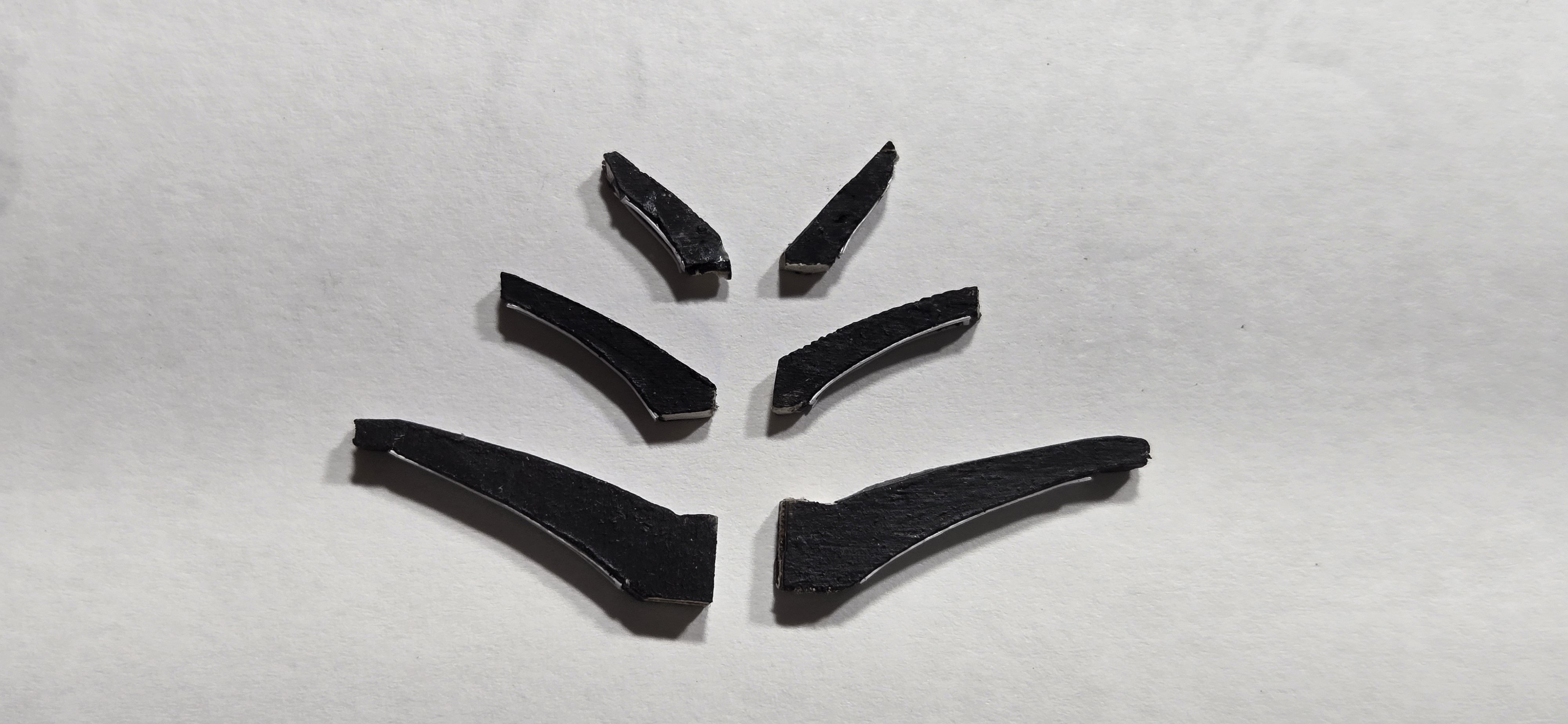

So far so good. Now for the bowhead timbers. The Hull model has only three bowhead timbers instead of the current five. One of these is obviously the one attached to the hull on the current ship. I assumed to other was the one furthest forward. With that in mind, I looked to the Navy plans provided in the kit. (I think these are also available on the museum website). Excluding the first and last timber, I fashioned mine based on sections 6,7, &8. Of course the initial pieces did not fit, they were tall enough, but did not reach out to the rails. After some back and forth, measuring and cutting, I finally got some pieces that fit. Before installing, they were painted and the initial white pinstriping was applied
20250618_160439.thumb.jpg.8c563dde2336a864e55910793fb86ce0.jpg20250618_161011.thumb.jpg.18d9656e9a5c5aa4b4f0cc31836e1051.jpg
Since I wasn't quite sure where the second rail was going to be positioned, I didn't yet make the notches for these. After thinking for quite a while about how to do that, I came up with a plan. Using the fabricated timbers, I made copies from card stock. These were lightly glued in place (easy to remove). I then made up the second rail. This was tapered quite a bit more at the end to fit in just under the main rail. Again using the Revell model as a guide, I bent the rail so as to fit against the timbers and meet up with the hull in the appropriate position. This is where I realized that the main rail was dipping down just a little too low. Based on the Revell model, the second rail should fair into the hull at the top of the gun stripe. If I positioned it there, the gap between the second and main rail would be very narrow and not look right. I had to settle for positioning the second rail a little lower. Since most folks don't see this version often and certainly anyone at my house would not know that difference, I figured I could live with this tiny discrepancy. Once in position, I marked the paper timbers. After removing the paper timbers, these were used to correctly position the notches for the second rail. After using a square file to make the notches in these tiny pieces, they were glued in place, fitting perfectly against the main rail.
The second rails were then double checked to make sure they fit properly against the bow head timbers and met the hull where they were supposed to.  Before attaching, they were painted and the pinstriping added. After getting both sides attached, here is what I ended up with
20250621_212013.thumb.jpg.921d656150161575864efef4c6bf8bd2.jpg20250621_212245.thumb.jpg.599ec2a371d67b7320da7cb9b3df2f55.jpg
It may not be the best looking bow ever made, but for me, I was very happy. It's pretty symmetrical and everything fit together.
Now to put the grating in and all the other details.
Frank

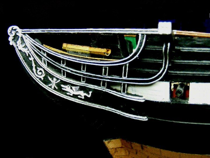

Wow!!  What a great job you have done with the bowheads!  Yours is the only bowheads with this configuration I have seen on any wooden model build other than the one by Herb Ebson a photo of which which I posted above.
Congrats!!

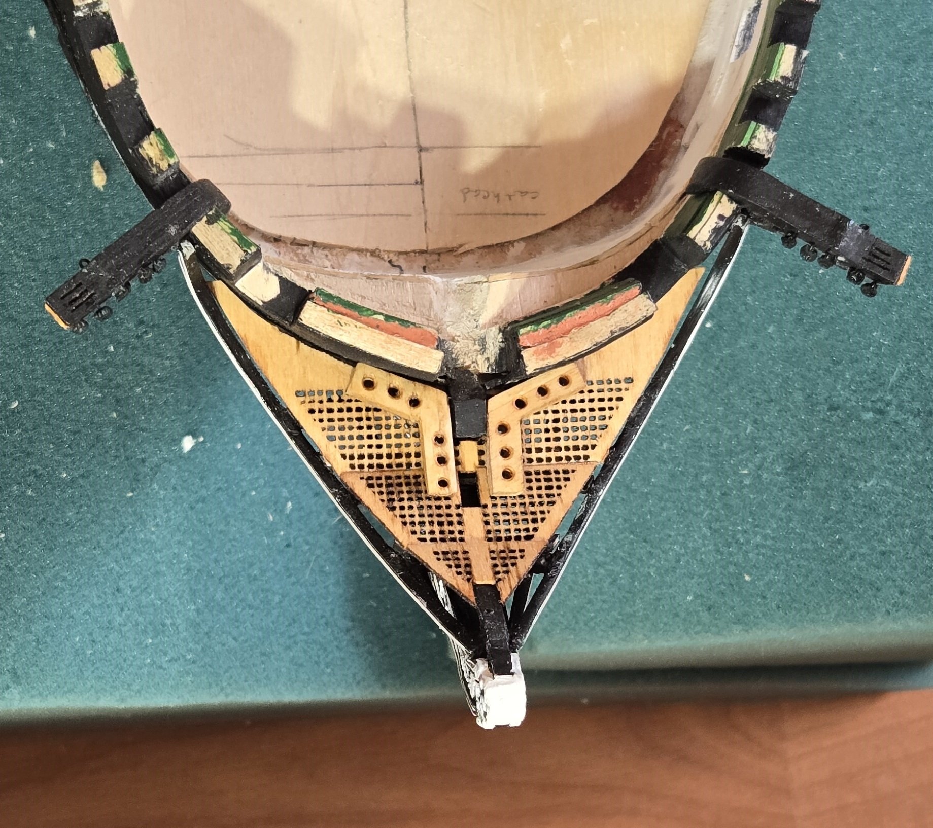

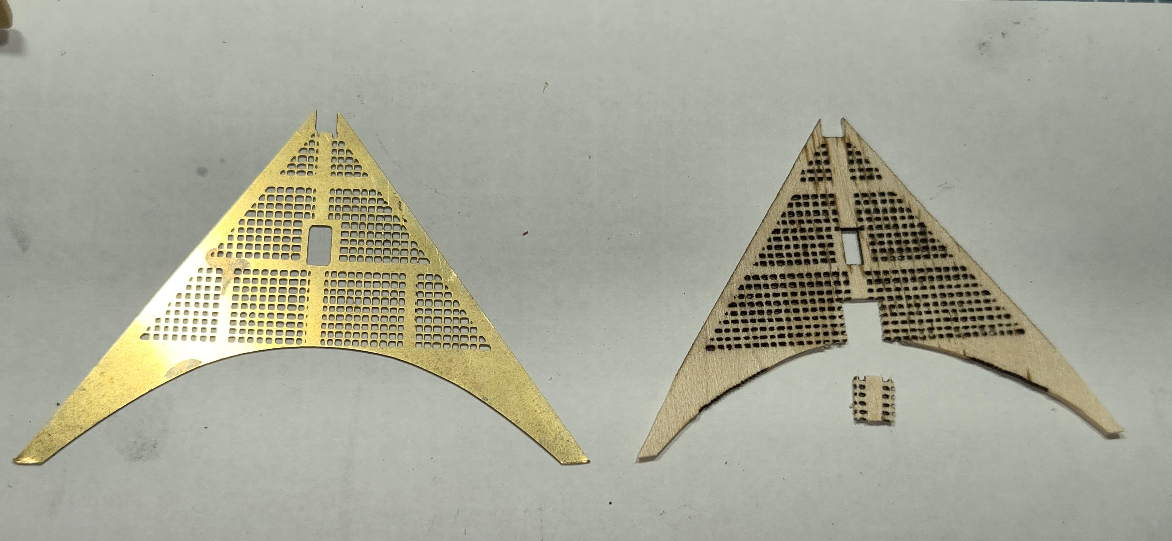

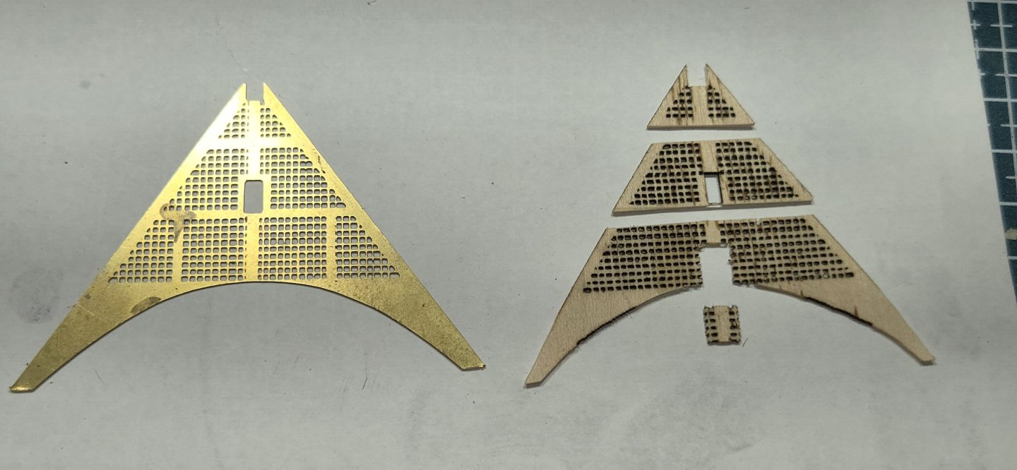

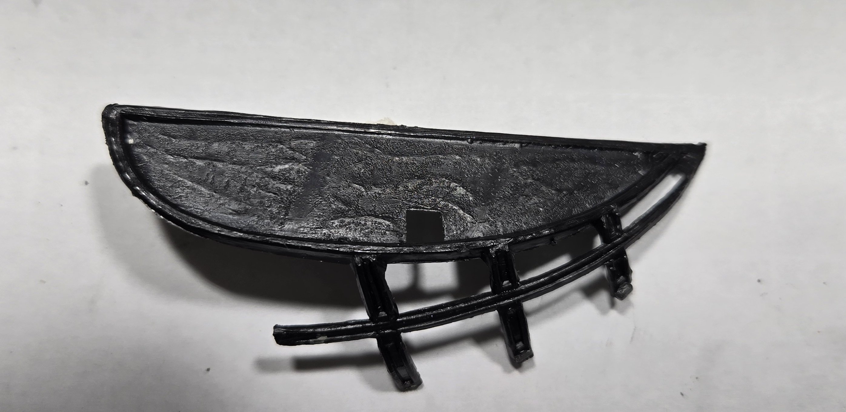

Got the gratings finished. I thought about using the PE piece that came in the kit, but I didn't think that I could do a very good job painting brass to look like wood, so decided to try to make the grating using my laser engraver. I made a photocopy of the brass grating to use as a template and from that I made the image to use with the engraver using Office - Paint. The grating was cut from 1/32 basswood sheet. Wasn't sure how the holes were going to come out, but I was satisfied with the final outcome. To make the grating follow the curve of the mainrail a little better, I used my fine razor saw and cut the grating in sections where the grating supports were. I also decided to cut out the back to wrap around the stem instead of cutting the stem down. The plans in the museum files definitely show the bowsprit resting on the stem. Here's what I ended up with20250621_162906.thumb.jpg.c83497b8f5814c9a952f984f99a513d1.jpg 20250623_085752.thumb.jpg.b640968177992f6ac09b8c90e2bed70d.jpg
I put the cross pieces in where the rail supports were. These lined up nicely with the sections. After staining, I glued the gratings in place. Although still slightly above the mainrail, this did provide a nice gentle curve
The angle of this photo makes the back section look tilted, but it is actually almost horizontal. The seats of ease provided in the kit were alos PE brass. Once again, I thought they would look better in real wood. Instead of making in pieces, I used a piece 1/8x7/16 stock. I used the plans provided in the kit for the dimensions. These were adapted from the Navy plan 452302. They showed a trough for the section alongside the hull, but made mine with seats. After photocopying the plan and sizing it to scale, I used a printed copy as a template. Carving the pieces out was a little tricky, as it wants to break when carving out the inside corner. A file was used for the final shaping. Holes were drilled in the appropriate places and after cleaning these up a little with a small rat tail file, the back end of a drill bit was used to make a small depressioin around each hole. I wanted the stain for these to be a little lighter than the grating, actually more of a yellow color, but I can't find anything close to that. In the end, they came out essentially the same color as the grating
If anyone knows a good wood stain that has more of a yellow color, I would love to hear as it would be useful for all the fittings that should have a "bright" finish. I managed to cut out the gammoning hole where it was located on the trailboards. Wish I had done that prior to attaching everything, since as you can imagine, they were not perfectly aligned. I also started opening up the hawse holes. The kit does not supply anything for these, so I plan to plan to purchase some very small grommets. They are the perfect shape and come in many sizes. I know the anchor cable was 7" in diameter (22" in circumference). Based on that, I am presuming the openings were about 12", which would mean 1/8" grommets. if anyone can confirm that, it would be great, because I have not been able to find the actual dimensions.
Frank

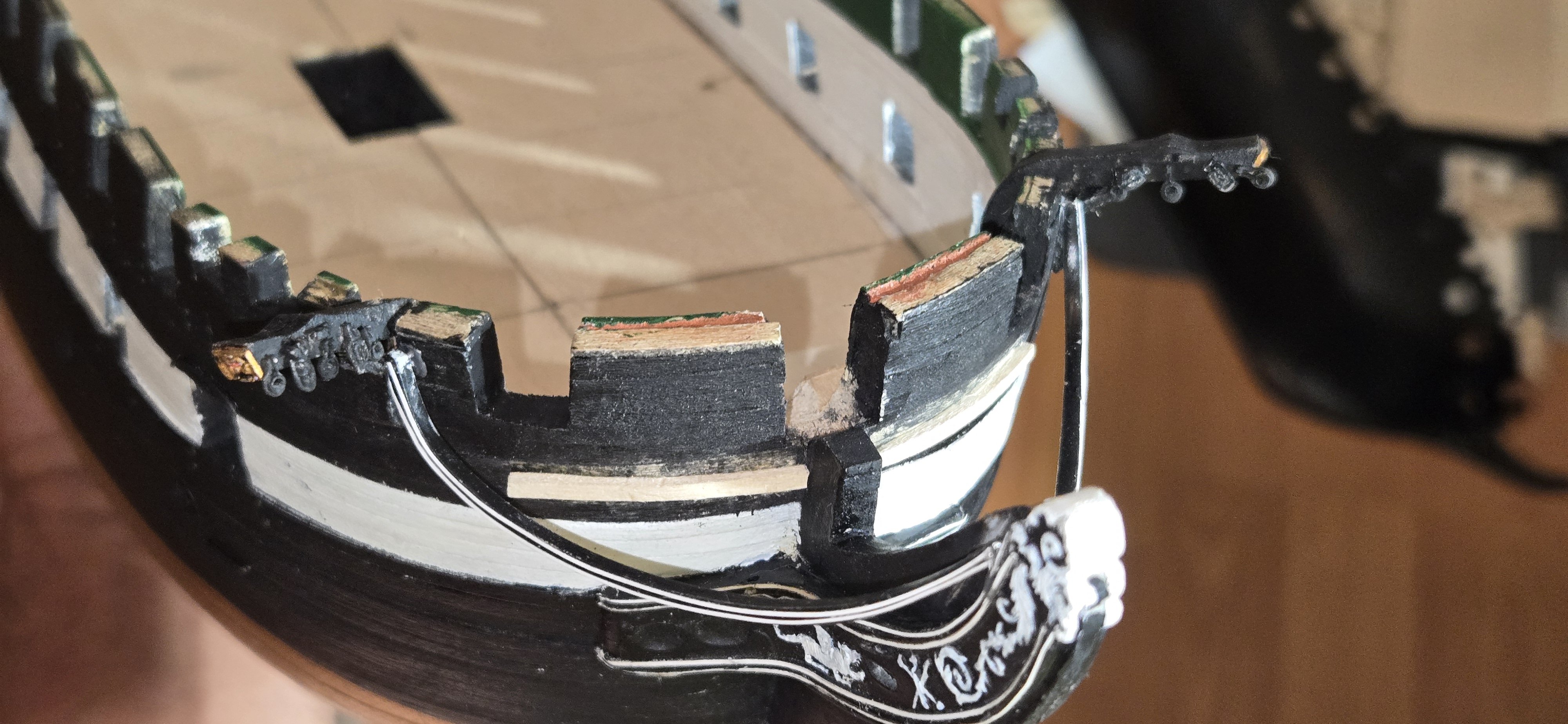

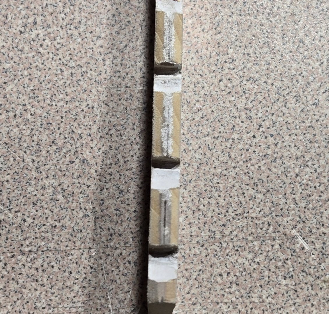

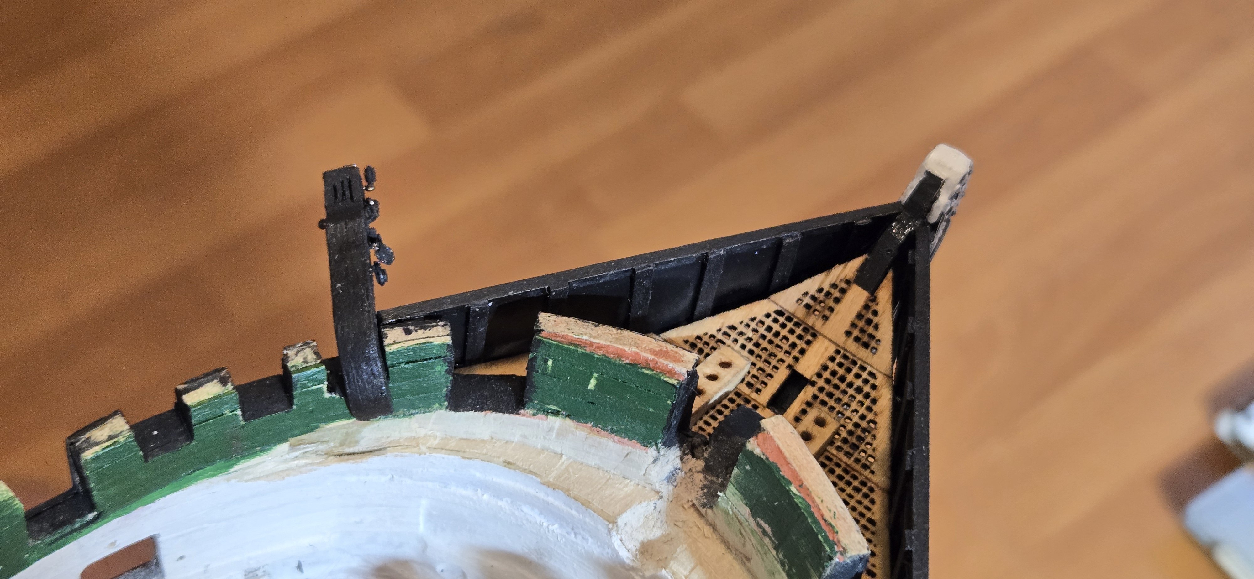

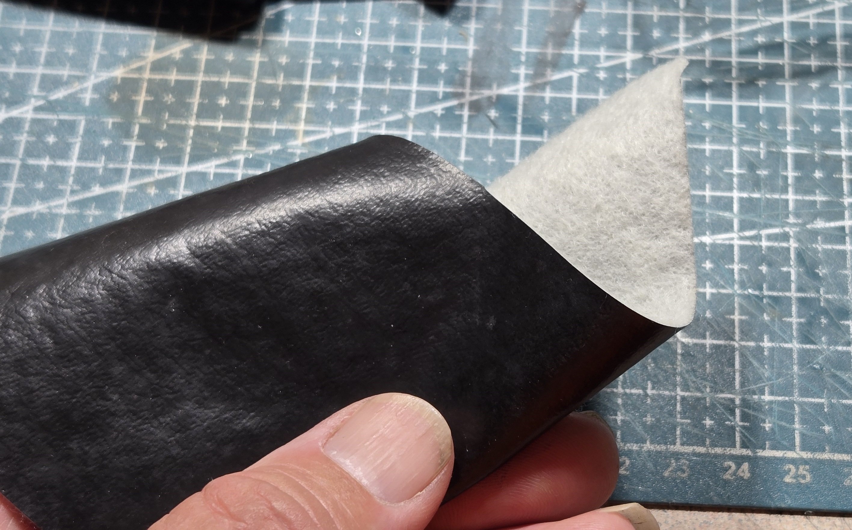

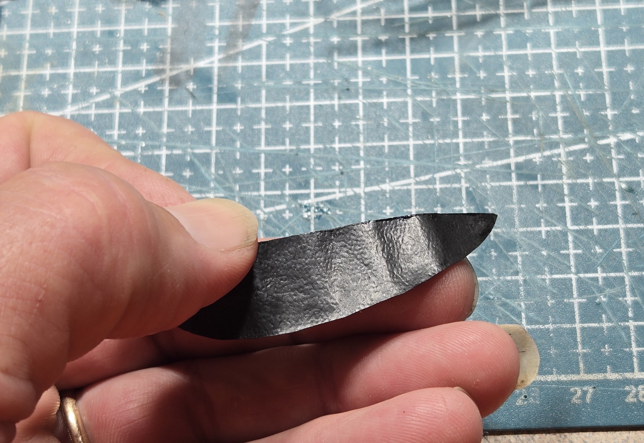

I still need to install the boomkins, but the bowheads are essentially complete. To make the false rail, which for this time period was supposed to be canvas, I used some fake leather upholstery material that I had left from another little project. The material comes with a cotton batten on the back, which is easily removed leaving a very thin layer of vinyl. Although it is supposed to be "leather", it is not too grainy and has just enough texture to look like canvas. I used the same template I had made earlier for forming the mainrail to cut the shape.
20250629_134200.thumb.jpg.6d6ccec149d2a39c86b20c643c93e5e2.jpg20250629_134128.thumb.jpg.e87ffdbb7d57e69efcbd95f3ecf06aab.jpg
After cutting the top rail to size, I made backing boards from 1/32x1/16 strips and attached these to the top rail. then the "canvas" was glued on and the whole thing glued into position
20250629_133849.thumb.jpg.7be9d81253b6022c9129edd37e87b602.jpg20250629_135520.thumb.jpg.910c67f5de50f888a84e0018fe553176.jpg
In addition to the false rail, the grommets arrived. Since all this stuff comes from China now, they were of course metric. I got 2.5mm, which is essentially 1/10th of an inch or very close to 3/32. Based on everything I could find, this was pretty close to what I should have had. The holes were drilled where to impressions were from the Revell trailboard. I think these are actually too far apart, but to move them closer would have left some funny impressions, so I have to live with it. I left them brass for the photo, but of course, these will be painted. I also added eye bolts in all the places that the Revell instructions indicated. There were 8 on each side - three at the end of the trailboards, three for the bobstays and two lower down on the stem. Not sure if I'll actually need all these but they add some character anyway. lastly, I put on the draft marks. Not sure if anyone knows a good source for these, but I found them impossible to find. What I settled on was some decals for HO scale trains, which is very close (1/87). The Reading Railroad boxcars had a font that I felt looked appropriate. I found a set that had about a third of the numbers I needed already as two number combinations. For the rest, I had to cut out individual number and apply them one at a time, making sure to get them aligned properly. Once all were in place, I gave them a good coat of Micro-Sol to seal them to the wood and get rid of some of the shininess

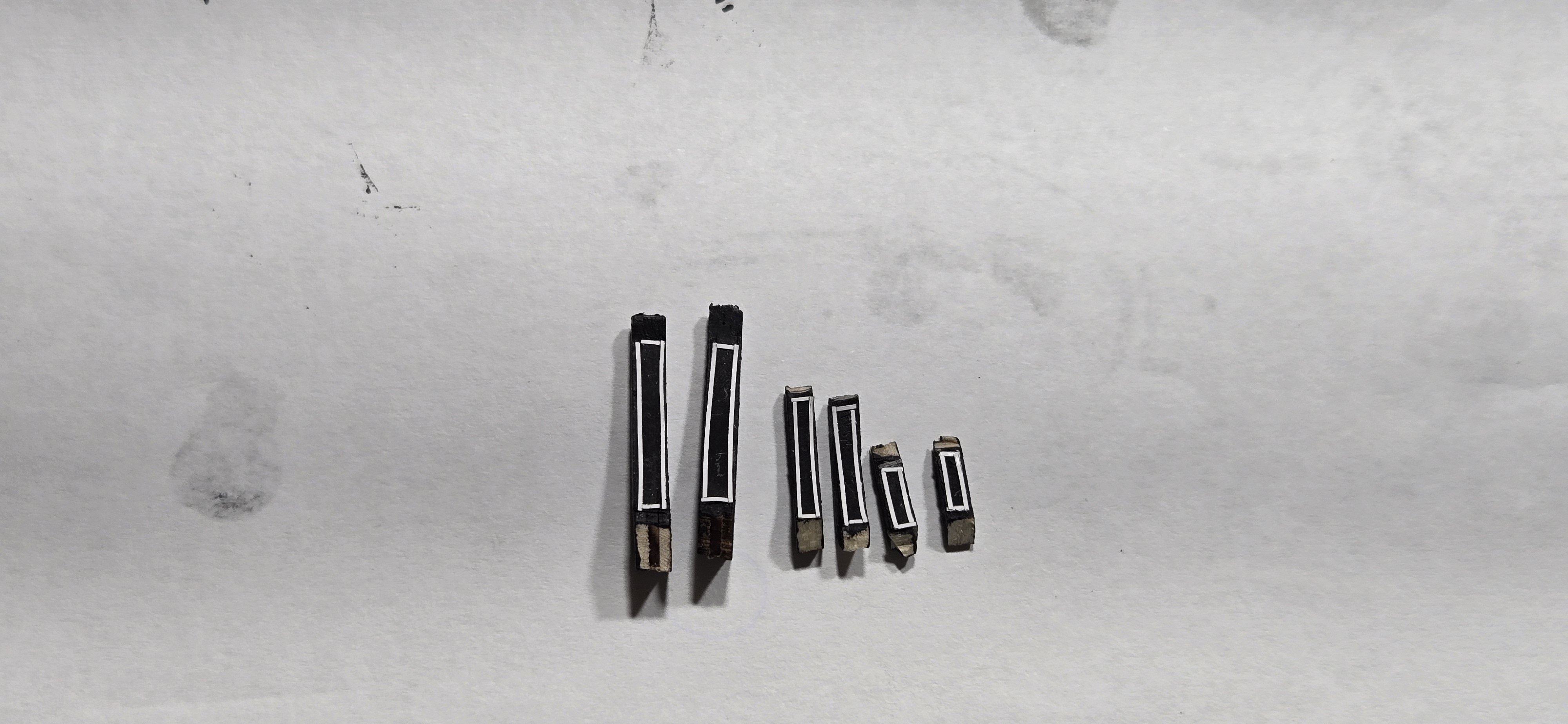

The boomkins are installed. Since these are meant to be 10" square, i used the left over cast metal rails from the kit. I used the Navy plans from the museum website to get all the dimensions and shaped the boomkin accordingly using a very fine square file. The end was shaped first with the fancy little "knob", then all the edges were chamfered. To make the metal band around the end, I used the copper tape used for plating the hull. After cutting to 1/32" wide, I used two layers to give it some depth. Then drilled holes for the three eyebolts. As these are pretty small, I used the fish hook eyebolts and attached with CA glue. The boomkins were then installed going through the canvas on  the false rail, but under the grating, as these are supposed to be attached to the underside of the grating support beams. A little creative thing of the boomkin ends was needed to get everything to fit properly. Finally came the supports. The Navy plans only called for one metal rod. Looking at the photos of the Isaac Hull model, there appear to be three supports, all made of rope. I ended up deciding on two, one rope tie down from the bottom eyebolt to the stem and the other a stiff rod (from .020" styrene) from the front of the boomkin to the cutwater. Here's what she ended up looking like
Frank

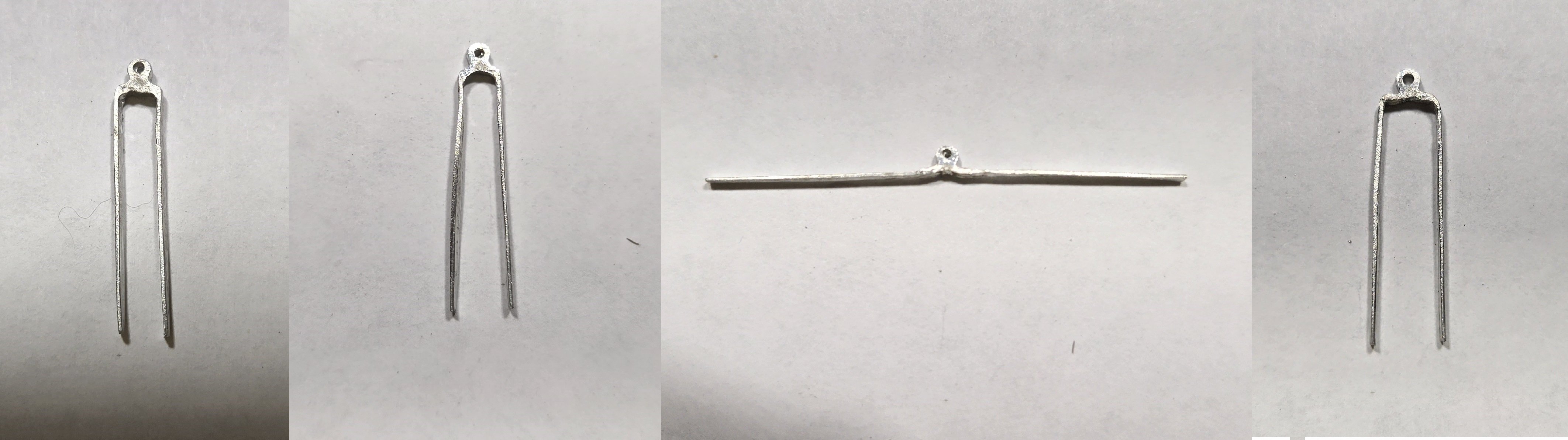

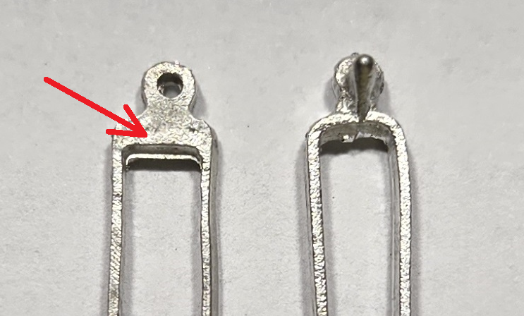

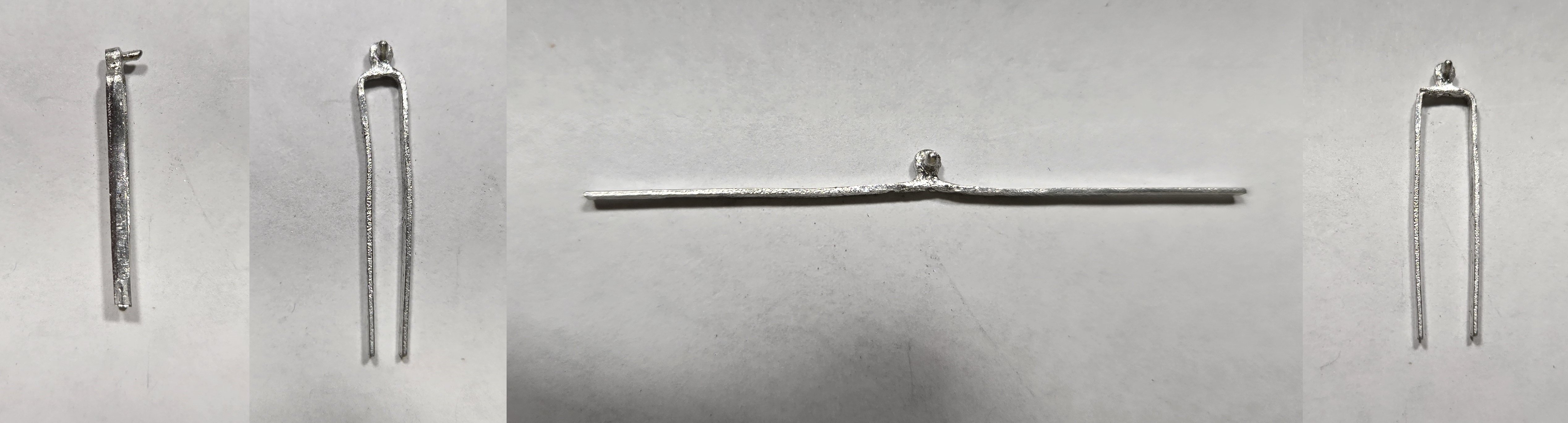

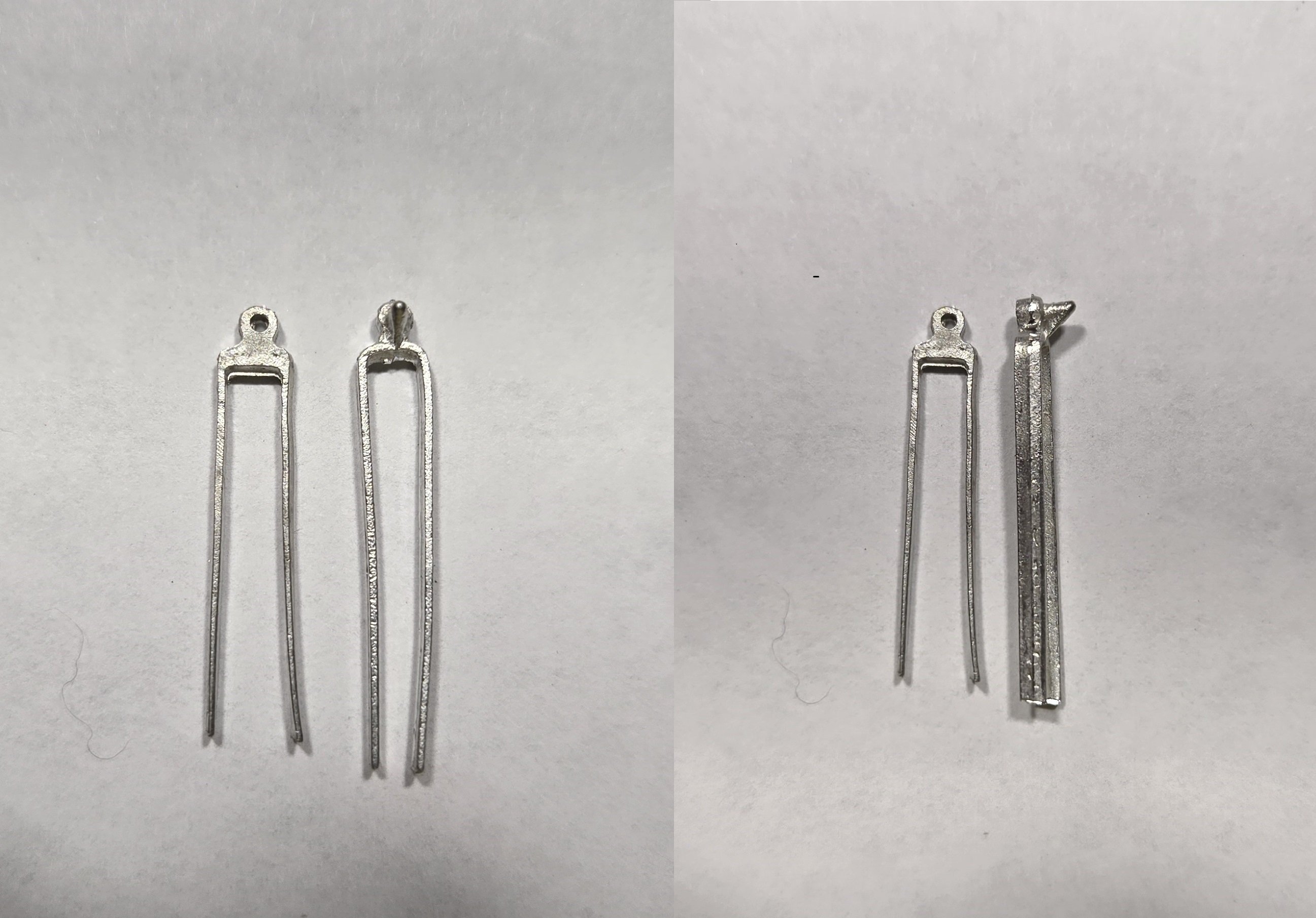

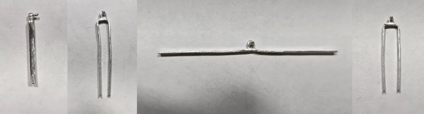

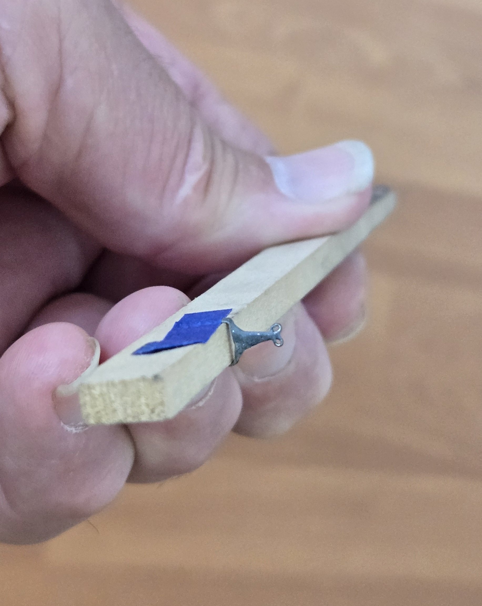

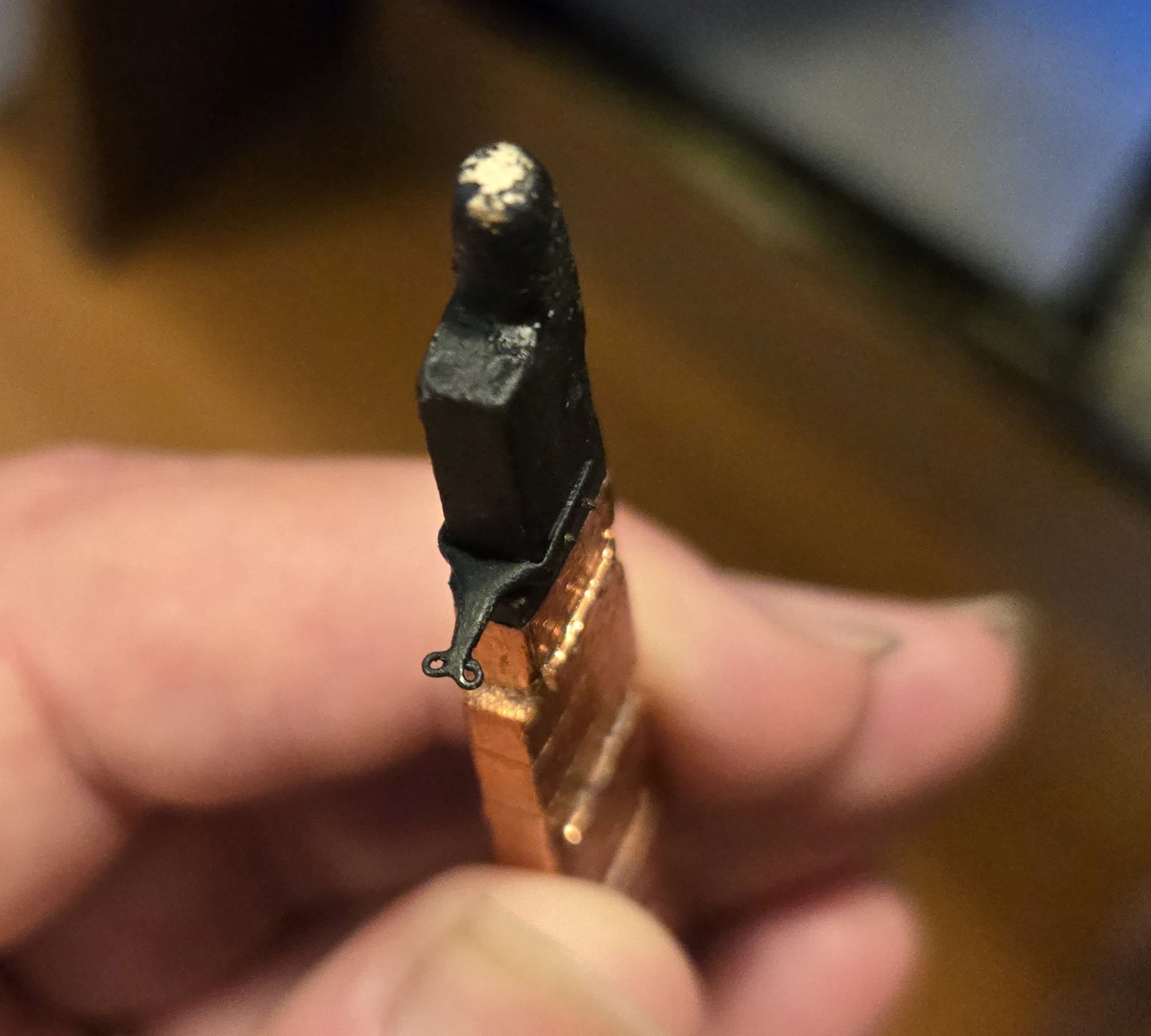

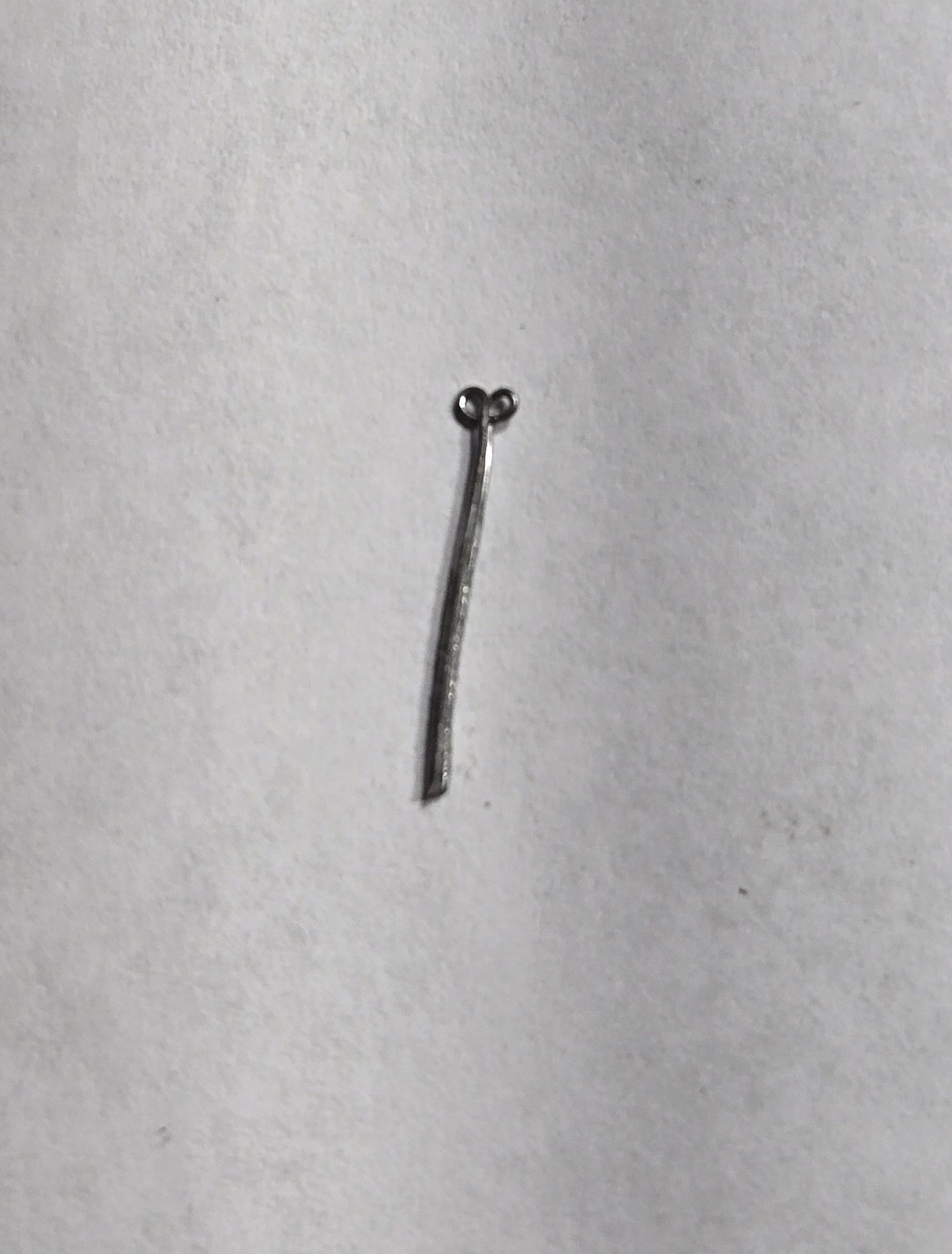

Next, I got started on the rudder. As @KurtH pointed out in his build, the pintles and gudgeons that come with the kit are 1/8", whereas the rudder is supposed to be 3/16". I considered doing the same as Kurt and buying the 1/4" sets and modifying them, but I just couldn't bring myself to shell out $22 for something that should have come with the kit in the first place. I convinced myself that I could modify the ones that came with the kit. All that need to be done was straighten out the straps and bend them back with the proper width...right??.
My first attempt with one of the gudgeons failed miserably. As soon as I tried to straighten the straps out, they broke. I tried again with one of the pintles, and this time, i was able to straighten them out with a little effort. After looking at it a bit closer, I realized that the problem was the gudgeons have a lot of extra metal at the end20250703.png.400721672ccbac94b9a9feab571bb6d5.png
Prior to straightening out the pintle, I had filed away all the flash, which had actually thinned out the inside, making it easier to bend the straps out straight. With that in mind, I filed the inside edge of the gudgeons to about the same thickness as the pintless and also rounded the "shoulders" inside and out to facilitate the straightening. The, with some fine needle nose pliers and a set of flat, blunt nose pliers, I very carefully straightened out the straps. Once straight, I used the flat pliers to bend the straps back to the correct position. To ensure proper positioning, I drilled a hole in my work bench that I could put a pin through to hold the gudgeon, then positioned the pliers with a mark that I had made 3/32" from the center of the hole. Once I made the first bend, I checked on the rudder to make sure it was centered and then grabbed the other strap flush against the edge to make to second bend. Here's the series from crude piece to finish:
A very tedious process. I had to work very slowly and carefully when making the bends, When straightening out the straps, it was critical that the pressure was applied evenly on both sides of the "elbow".
The pintles were a little easier to bend, but alot more flash to remove. The actual pintle looked more like a wedge prior to filing down. Here's the progression:
Unfortunately, after all this, I still have one broken gudgeon that I dont think I can repair, and I seem to have lost one of the pintles. guess I'll have to wait for replacements. Sadly, they wont get here before I have to have shoulder surgery next week. After that, I'm going to be out of commission for a while, so not much will be happening in the shipyard. I'll still be watching everyone else having fun.
Frank
Rebending Britannia metal is not fun nor easy. You look at it wrong and it will break. I'm not sure, but it might have been easier to scratch build the gudgeon.
Another thing, I wasn't aware of is that the metal will deform under low but constant load. I completed building the Model Airways Albatros D.Va WWI German fighter plane in 2004 which came with Britannia metal wheel struts. It's been in a display case ever since and hadn't paid much attention to it as it is protected from excess heat and dust. About a year or so ago, I noticed that the wheel struts had collapsed under the weight of the model. I ordered and got new struts from model Expo, but have decided not to use the replacements because I assume the same thing could/would happen again. Instead, using the replacement struts as templates, I fabricated new struts from wood. These will not collapse over time. I just need to install them, which would require I set aside my Conny build for a while, but I still haven't decided when that will happen.
Just be careful and mindful of the weaknesses of Britannia metal.
Jon

Thanks for the heads up. When I first read this, my heart sunk just thinking about all the work I had put into getting these reshaped. You are right, just look at it wrong and this metal wants to break. After thinking about it a little while, I think I will be OK though. Unlike your wheel struts, these pintles will see very little load. The rudder weighs very hardly anything. Also, I'm sure there is alot more leverage being applied to those struts, whereas the pintles are more or less straight up and down. Here's hoping anyway. I suppose I could reinforce the whole thing by pinning the rudder to the sternpost. The pin would not be very visible. Of course that means the rudder won't swivel, but I doubt I will be moving it anyway.

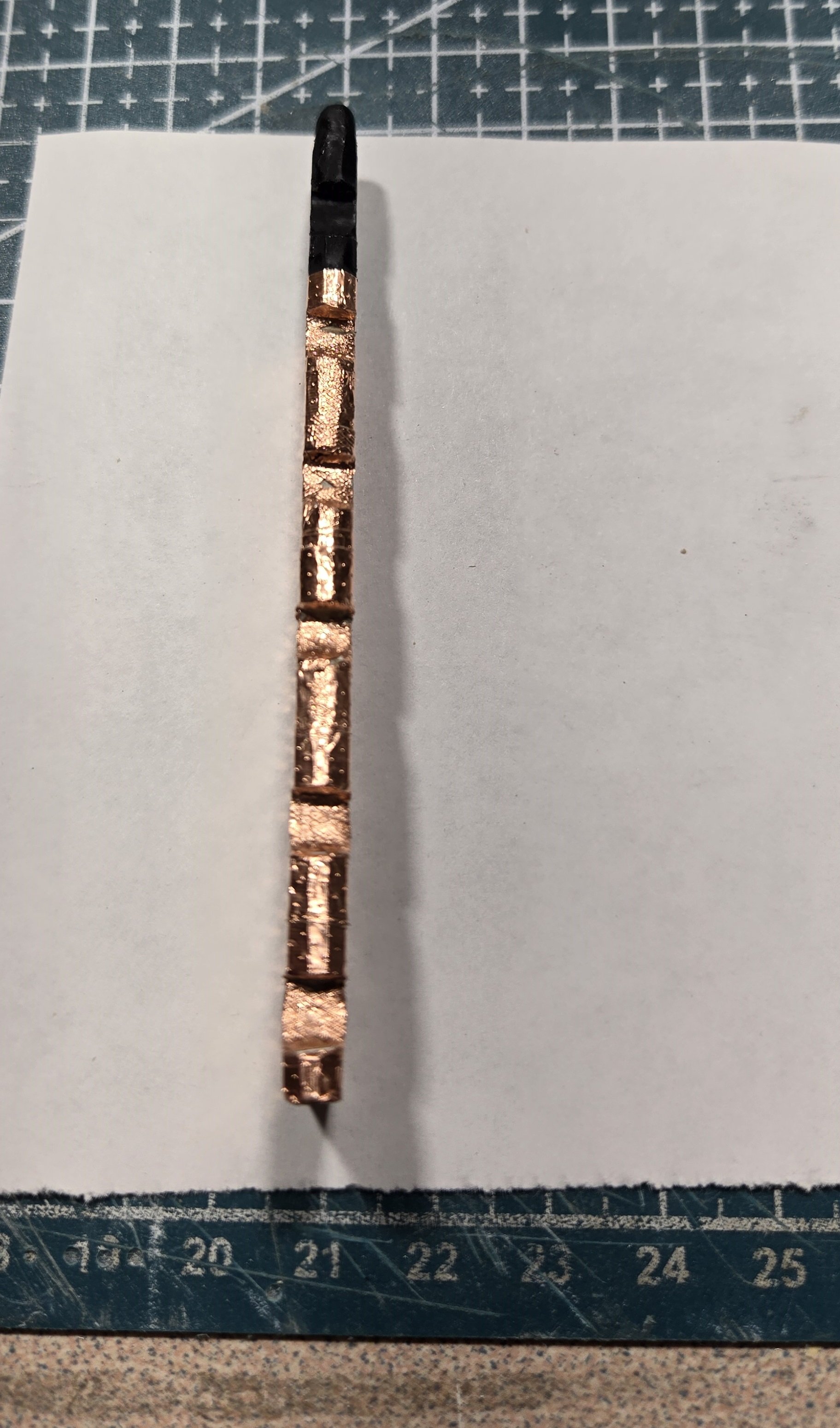

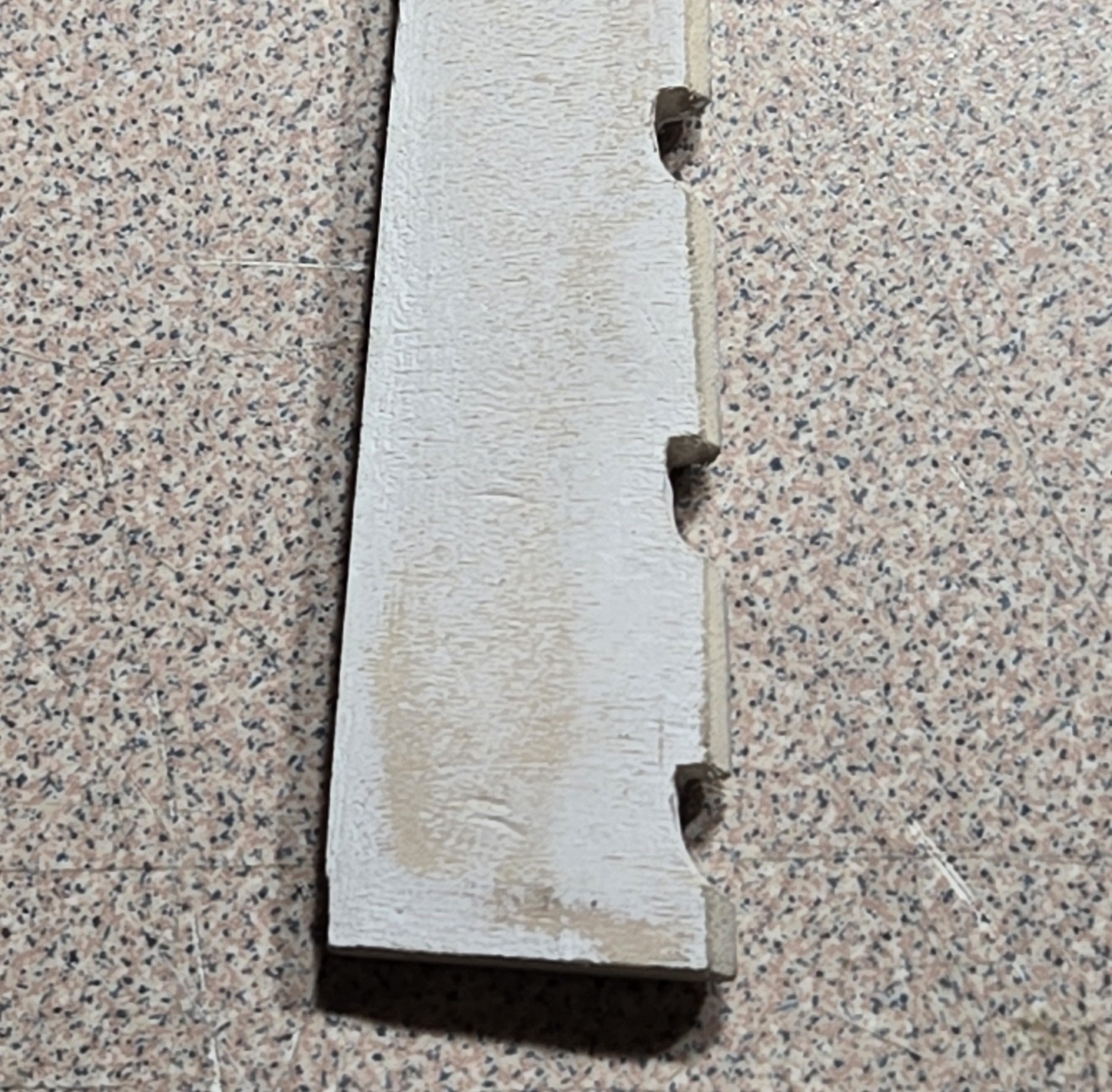

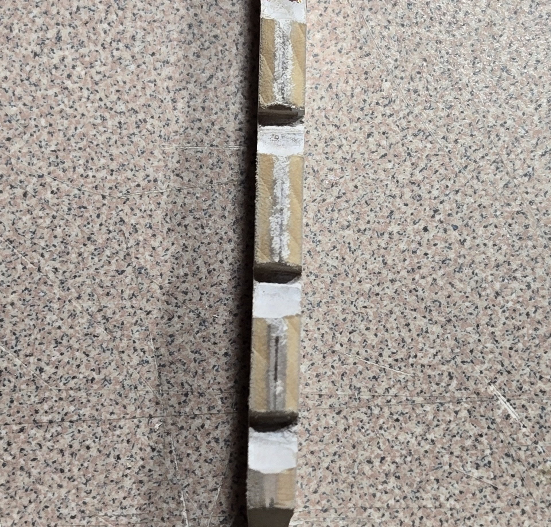

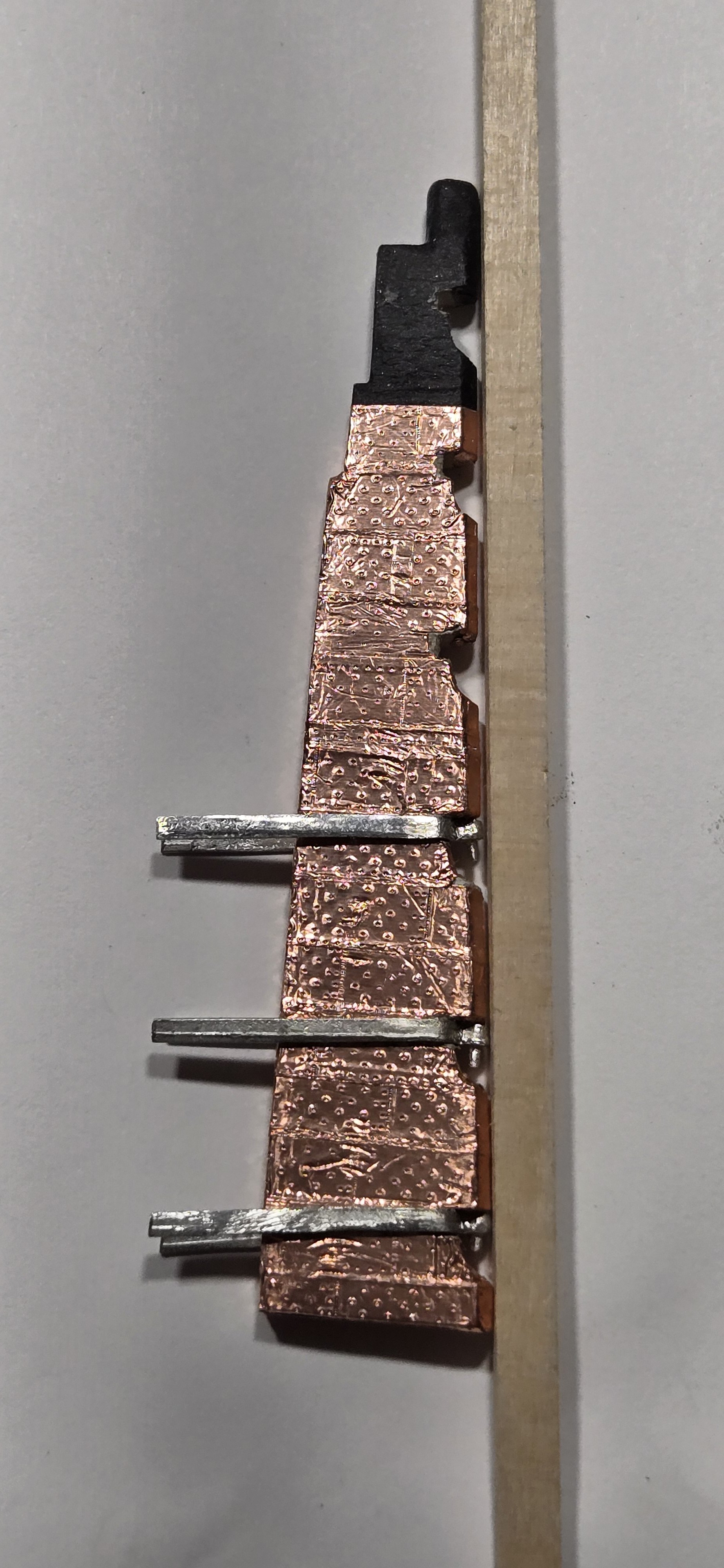

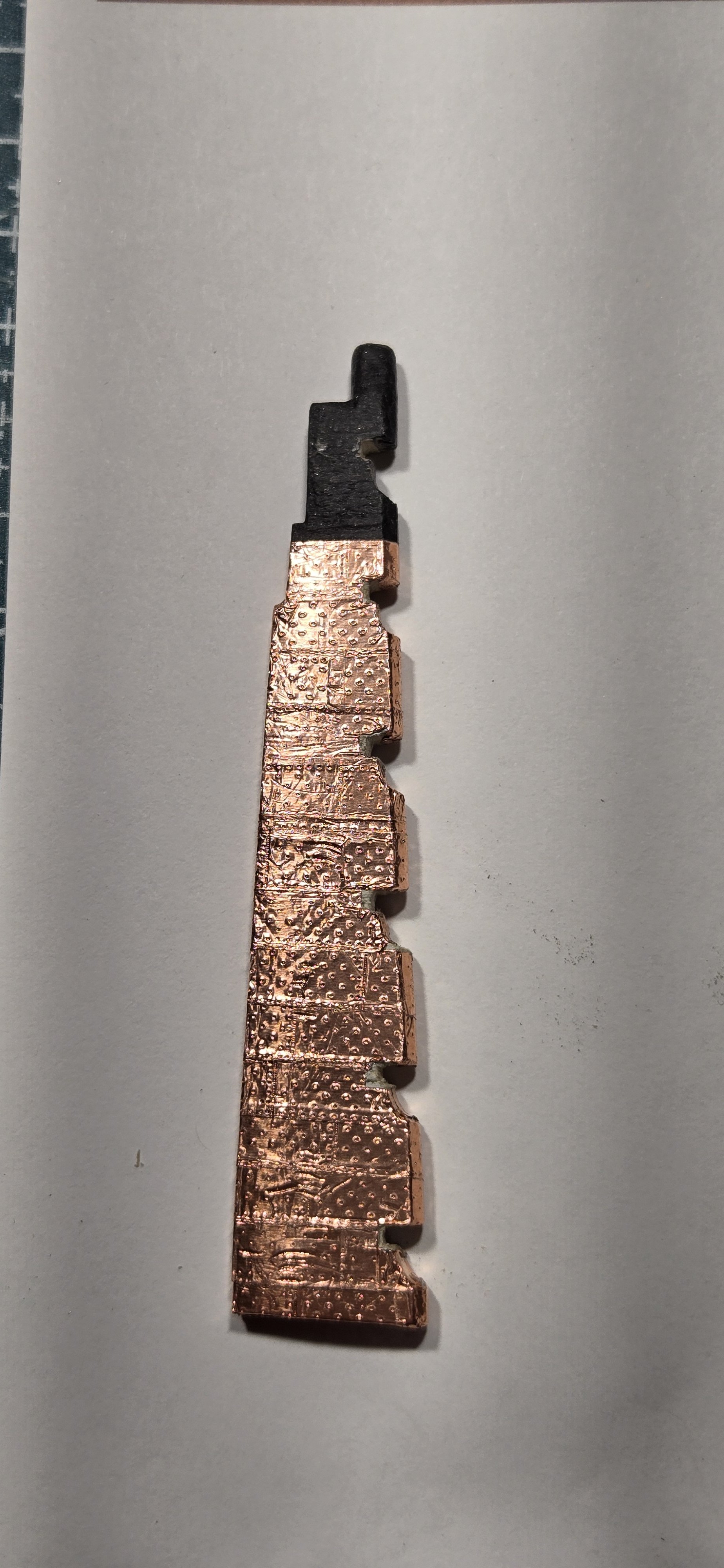

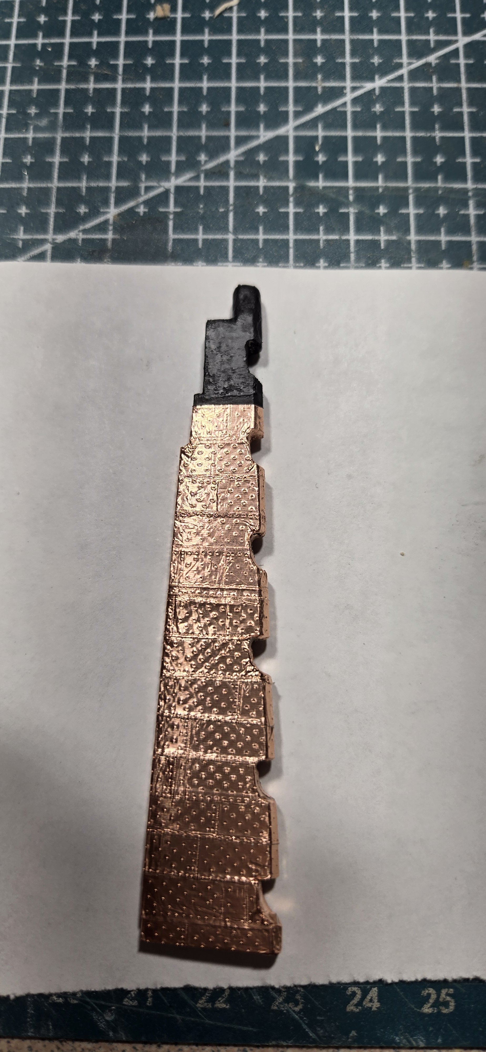

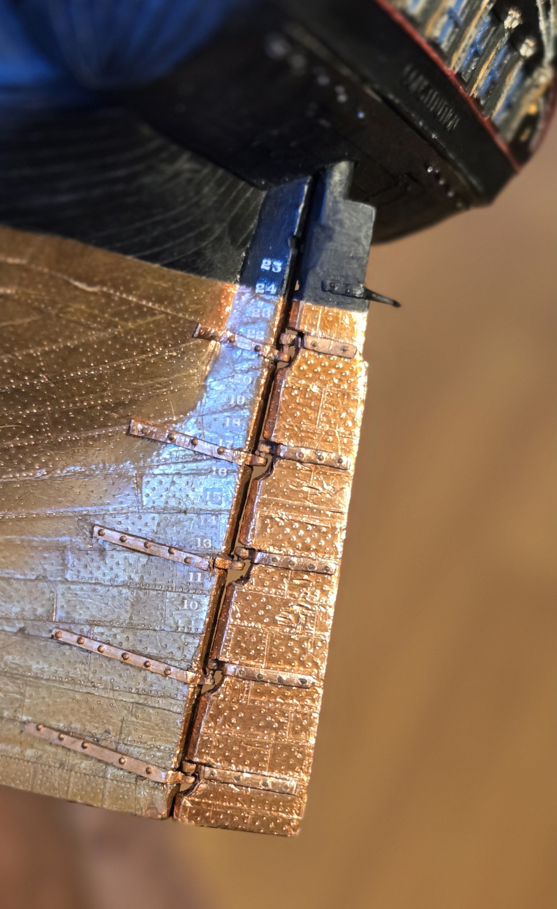

Rudder construction has progressed. Of course, like everything, it became a little project in itself. The initial shape was cut from 3/16 sheet provided in the kit. I used my very old and cheap Dremel scroll saw. For a pretty basic little saw, it doesn't do a half bad job. I have a much nicer Duracraft saw that I acquired from my dad, but it is missing one of the blade holders and as it is an older m model as well, I can no longer get parts for it. Anyway, I cut the piece with just a little around the edges and then fine tuned it with files and sanding sticks. The aft edge was tapered as it is supposed to be. Then using AOS as a guide, I cut out the notches for the pintles. These are oversized and curved at the bottom to allow for the gudgeons to slip under the pintles. Finally, the forward edge was chamfered to allow for the movement of the rudder.
20250705_212846.thumb.jpg.8167653233bf167e52e875a8eef1935e.jpg 20250705_212722.thumb.jpg.c3efddc3f3d5622fd5804ad1d15afd7b.jpg
In preparation for the coppering, I gave the whole thing a coat of Gesso and sanded it smooth with 150 grit sandpaper, then a applied another coat and sanded this down first with 220, then 320 grit to give a nice smooth surface for the copper tape. There were still a few deep scratches, but nothing to worry about. The copper plating was done just like the hull using the 3D printed stamp to provide the indentations for the nails. Once the copper was on, I painted the top portion. In hindsight, should have painted that first instead of having to be very careful on the edge of the copper.
20250706_083058.thumb.jpg.8824df729ace01e0efb196964aac991b.jpg20250706_083128.thumb.jpg.eb3041f724b6d069db81fe1661dcdc11.jpg
This should have been where I was done, but of course there was more yet to come. When I dry fitted the gudgeons and pintles to see how everything was going to look, there was still a significant gap of a bout 2.5mm between the rudder and sternpost. The rudder should really fit nice and flush. The isue was that even with the notches, the pintles still stuck out pretty far, and the same for the gudgeons. The notches I had cut accounted for the thickness of the actual pintle/gudgeon, but not the metal behind each. So, I set about creating slightly deeper notches to accommodate each. I didn't was to remove the copper that I had already applied, nor did I really was the openings on the rudder to be any deeper, so I only notched out the area where straps would go. To do this, I first had to very carefully cut away the copper covering the areas to be notched, then used a square file to make the notch. Of course, Murphy had to chime in one last time. When I started to notch the sternpost where the 12 foot mark is, I found that this was exactly where I had used a nail to attach the sternpost. So, I'll have to use a punch to set that nail deeper before making that notch. In the end, everything fit nicely and actually provided an added benefit, as now I had an exposed wood surface to glue to. When I dry fitted the pieces with the new notches, everything looked perfect, although I am going to have to bevel the edges of the gudgeons to get them to fit under the pintles.
20250708_092159.thumb.jpg.55497e3e3a80138070db435b56c6babf.jpg20250708_092458.thumb.jpg.3f1586ddbb15912b91dfb52c3523cc22.jpg
20250708_092731.thumb.jpg.54bb45635bf5413f555307aab9e05dfe.jpg20250708_092411.thumb.jpg.5951ef911c6ee316d3b2c04c1400aa4f.jpg
Now I'm just waiting for some additional pintles and gudgeons to arrive (thanks @KurtH for the generous offer) then I can finish it up.

Very clever and effective technique for making the nail dimples on the copper strip.  I'm going to have to remember that one.  Your Connie is coming along nicely.  You're going to have an outstanding model when you've finished.

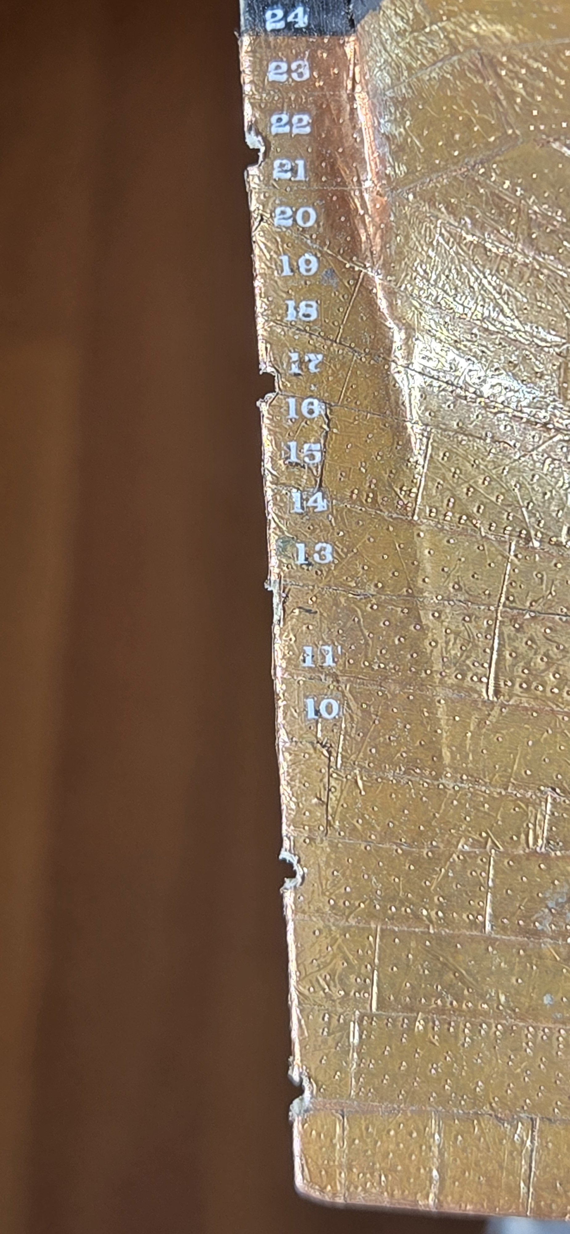

OK, so I'm not totally recovered yet, but enough that I can get some things done. Prior to my surgery, I had not quite finished the rudder. It amazes me how every little part of this ship becomes a project in itself. Something as simple as the rudder has so many little pieces to it. When I left off, I had reshaped the gudgeons and pintles to fit properly. I'm not exactly sure what these are made of for real, but photos of the dry dock ship make them appear to be copper. The navy plans from the museum website simply say "Comp.", what ever that means, but definitely not steel. I decided to make mine copper. I didn't want to just paint them, because the paint would always stay shiny, whereas the copper plating would develop a patina with time. I first tried my hand at copper plating. This is a seemingly simple process, however, in practice not so. The parts have to be absolutely clean and preferably have a polished surface. I was able to get one piece that was acceptable, but nowhere near what I really wanted. The sharp edges don't take the copper very well and the curved surfaces where the actual hinge was were difficult to get really clean and polished, so they also did not take the copper very well. The flat surfaces of the straps looked very good, especially after a light polish. After many attempts, I came up with plan B. Using the same copper tape for making the plating on the hull and rudder, I covered the straps up to the point where the shoulders curved in toward the pintle/gudgeon. What I couldn't cover with tape, I just painted. This worked very well and the tape is so thin, it doesn't add hardly anything to the thickness. I first glued on the gudgeons to the hull using a thin wire to line up the holes. The pintles were just eyeballed and I simply tried to make sure they were centered and lined up with each other. After everything had dried, I was relieved to find that it all lined up and with a little filing on a couple of the pintles, I was able to get the rudder to slide into position and drop down perfectly. Once I was sure everything fit well, I took the rudder back off and drilled holes for the bolts using a #77 drill bit. The bolts were Tichy-Train rivets (0.02") that I painted copper. The final touch was the "monkey tail" for attaching the rudder chain. A while back, I had toyed with making my own eyebolts. At that time, I also came up with a pretty good way of making the "double" eyebolts that the gun tackle is attached to on the gun deck. I had made quite a few of these from 24 ga. wire and thought they would be perfect here. Using a strap from one of the broken pintles, I drilled a hole and inserted one of the double eyebolts. After gluing in place, this was then built up using a little  J-B Weld epoxy to give the shape of the monkey tail. Once that was shaped up and hardened, the strap was bent to fit around the rudder and after gluing in place, bolts were added similarly to the gudgeons/pintles
20250908_145159.thumb.jpg.cb62febdedc5df397b1482abaffa3847.jpg20250904_155820.thumb.jpg.148d9af5efded4c30d3bb6df271c9122.jpg20250908_094925.thumb.jpg.287ba8cce5729c28489e546b05a5d203.jpg
Here's the end result:
Frank

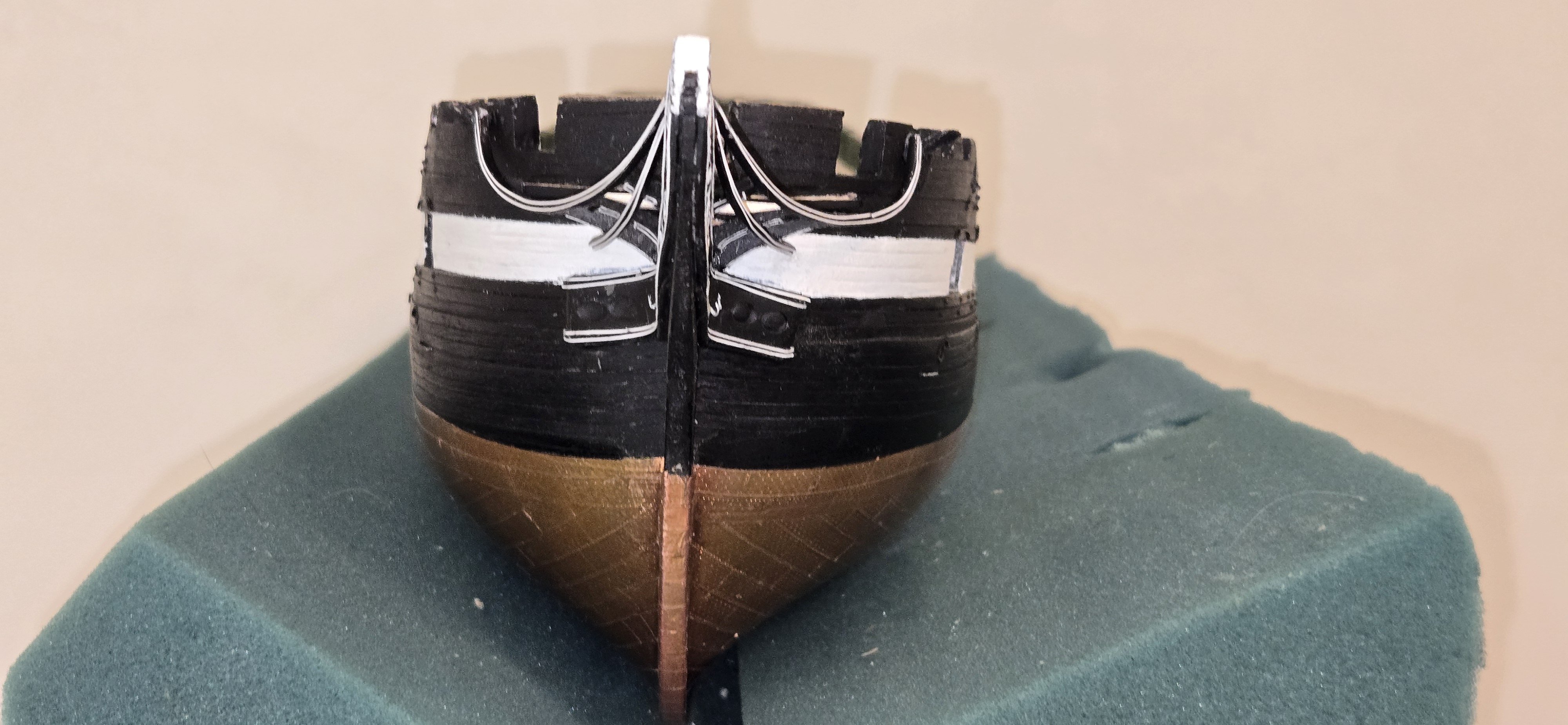

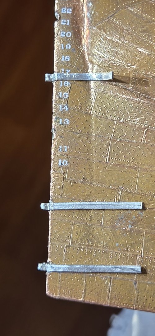

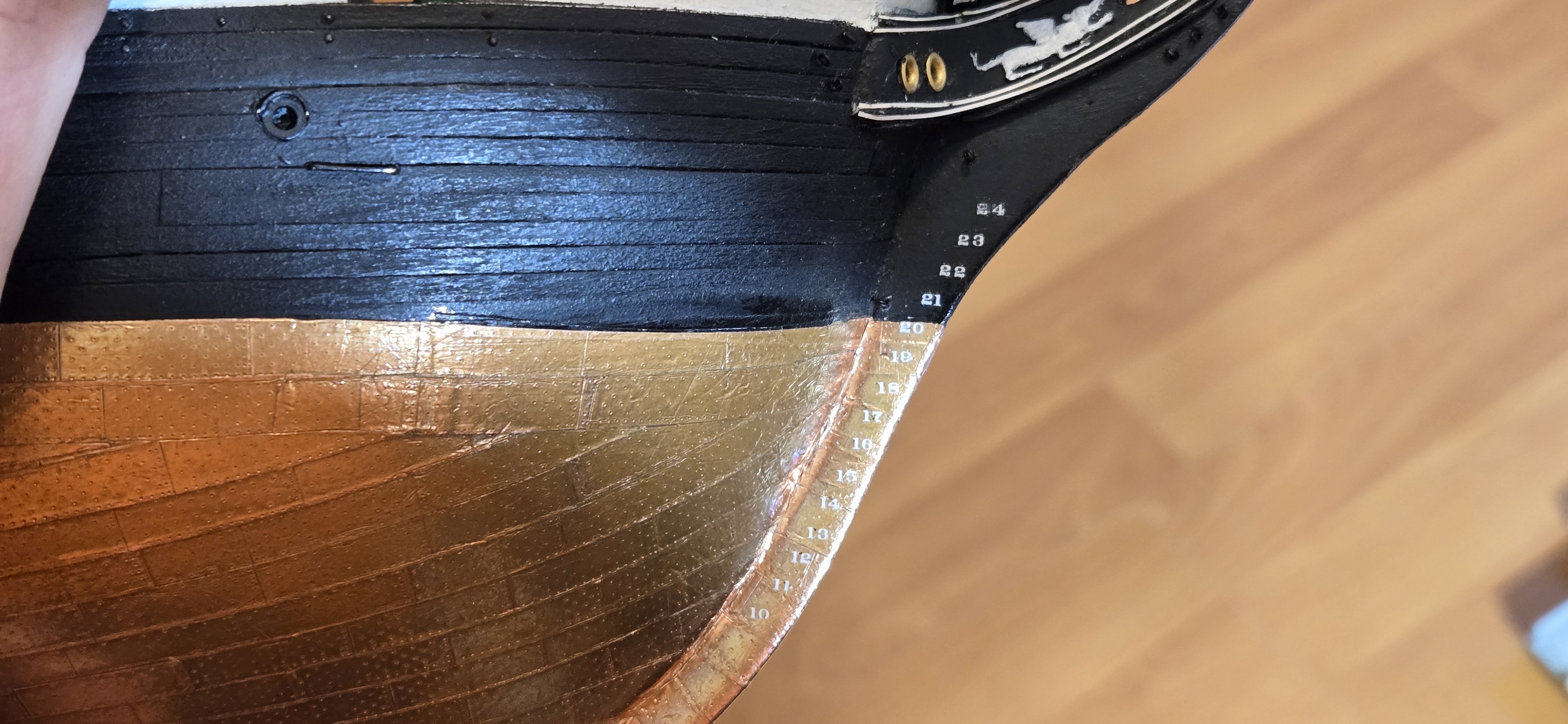

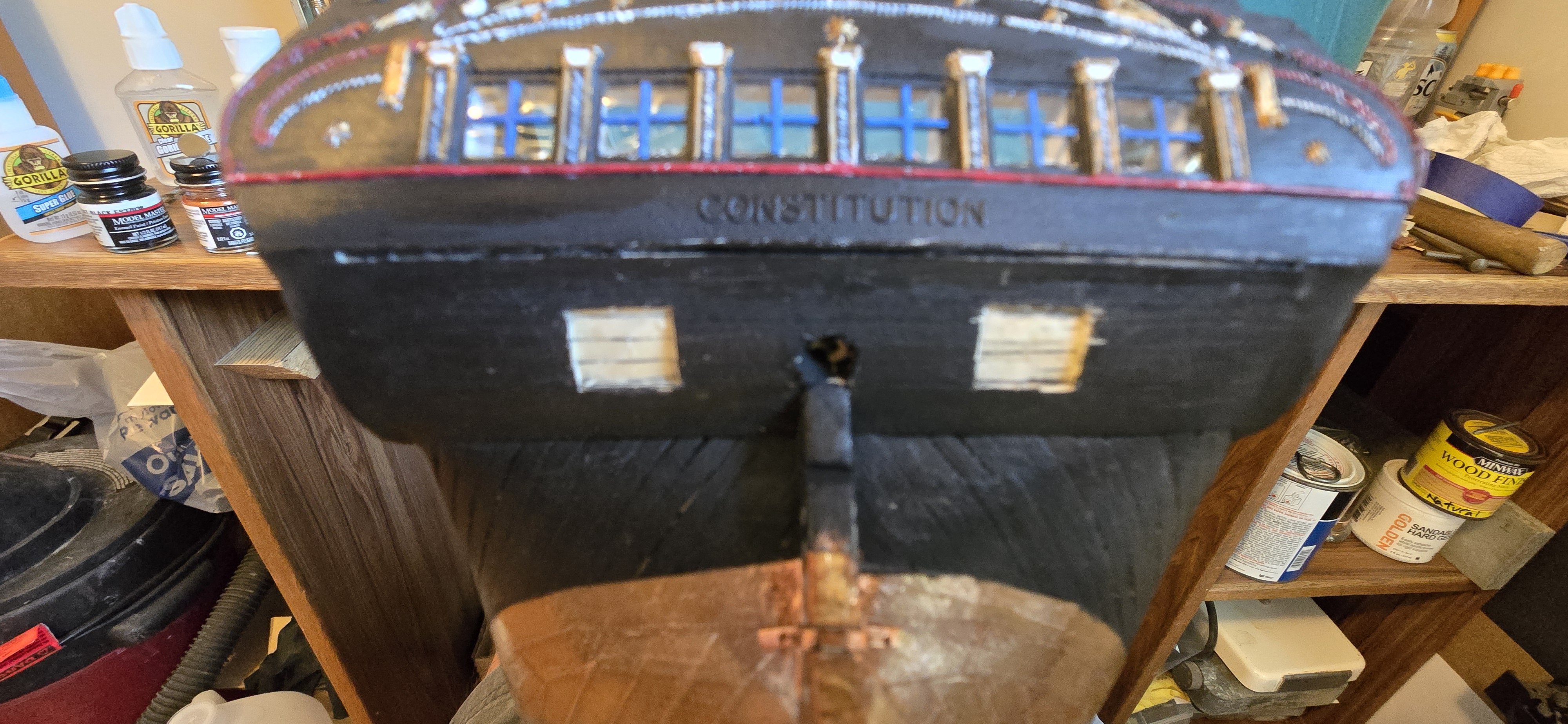

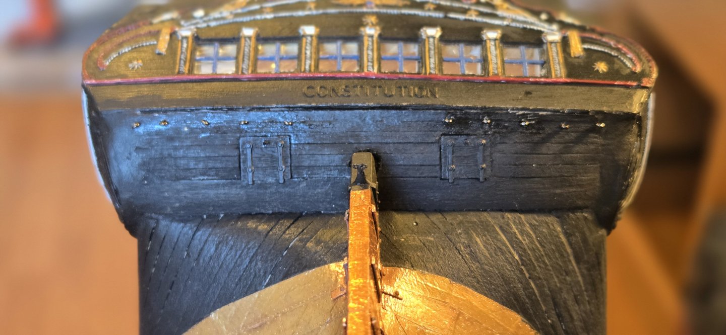

Having completed the rudder, next was the rudder chains. The kit supplied chain is 24 links per inch. Using photos (thank you @JSGerson) I calculate that the chain should be more like 36 LPI. I was able to find a chain that was 30 LPI and already blackened, so I ordered that and am still waiting for it to arrive. Meanwhile, I went ahead and installed the eyebolts on the hull. For this, I used #10 fish hooks. The eye on these hooks has an O.D. of 0.065" and a hole that is 0.023" and they come in a black nickel finish. My plan is to make some tiny jump rings from .02" wire that will be used to hang the chain from the eyebolts. Finally, there were the stern ports. I considered making these from scratch, but decided to use the gunport covers from the Revell model instead. These have excellent detail and made the task much easier. Using a very sharp chisel, I removed the planking from the hull to create the openings. The sharp edge of the chisel allowed me to make crisp edges and then carve the opening down to the appropriate depth. The plastic model has grooves on the gunports where the hinges would be. The straps on the covers stick out and would fit into these grooves. I didn't want to make these grooves, so I simply filed down the "tabs" leaving a little less than 1/64th of an inch. Once glued in place, they looked perfect (IMO).20250903_113036.thumb.jpg.7cb1967ef9c043fedea8ee41b0f4d768.jpg20250908_101857.thumb.jpg.a89df9114d16dd4f7a7bb0aa904b1e51.jpg
Some of you may notice that the white trim line is missing from the bottom of the transom. I didn't really like my hand painted lines, so I painted over them and will go back and add the lines using the architectural tape I used for the bowhead trim.

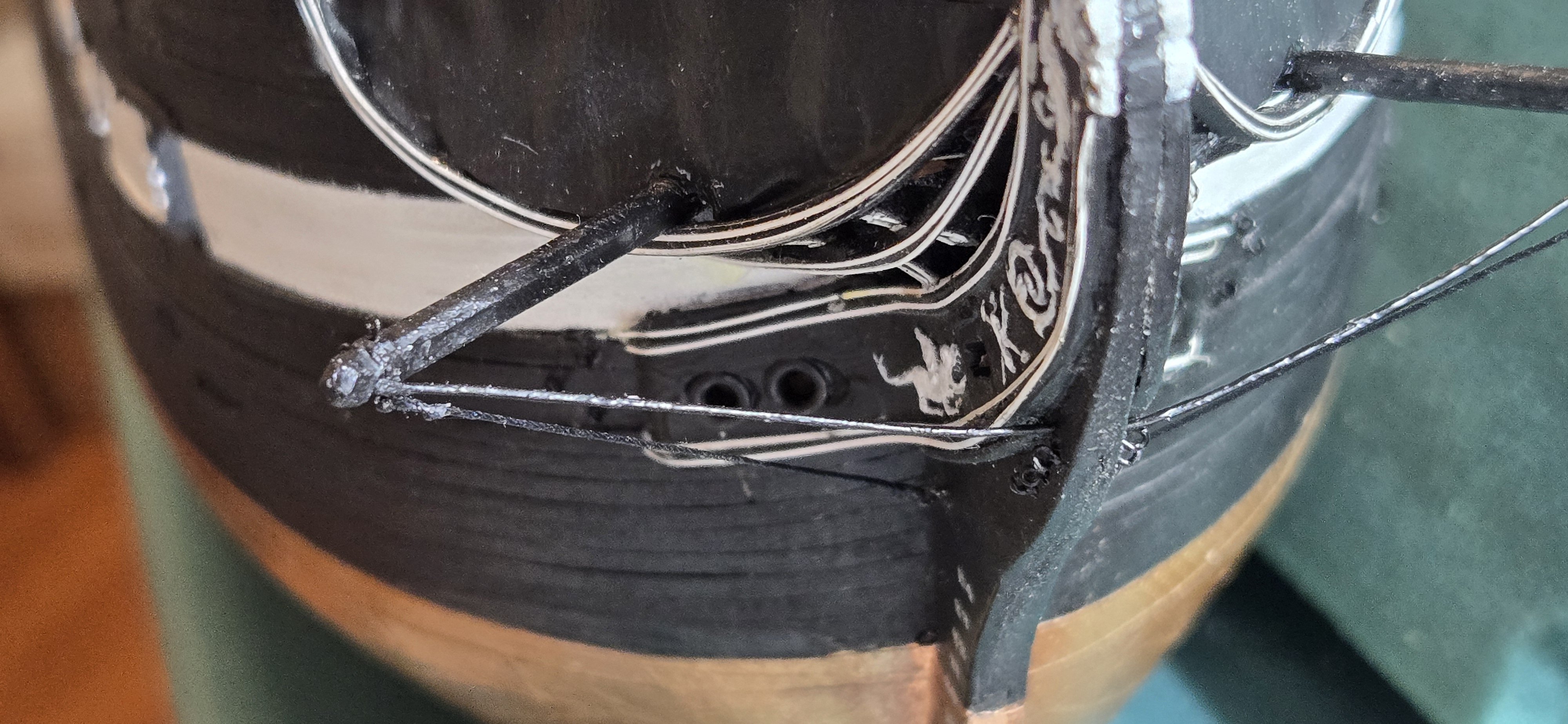

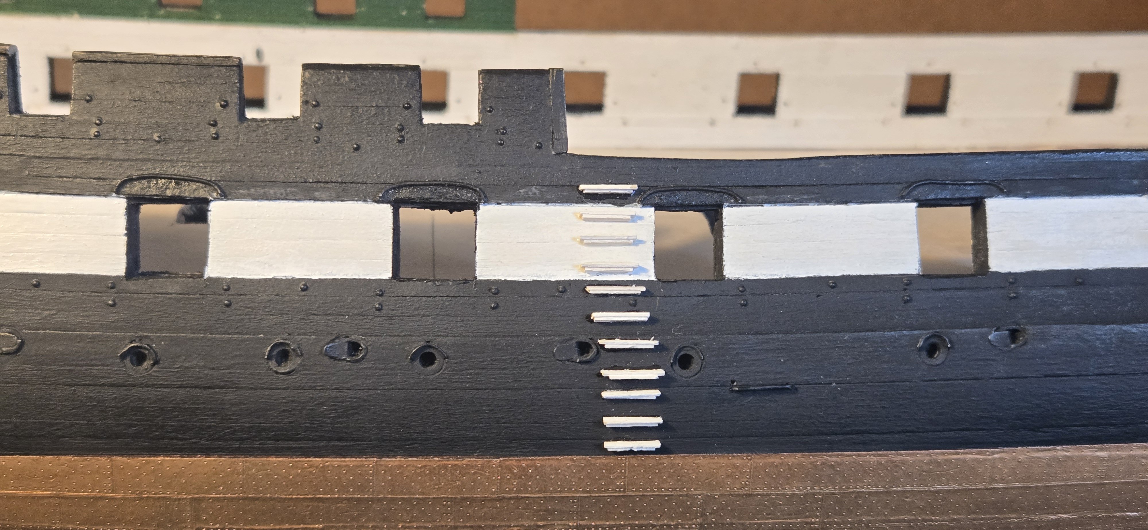

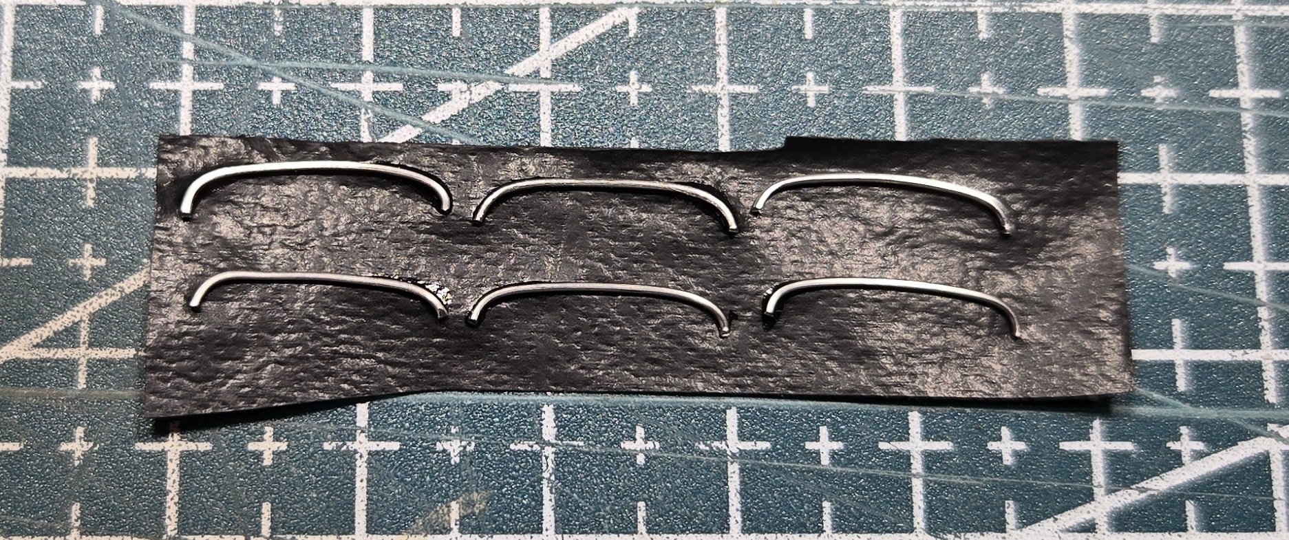

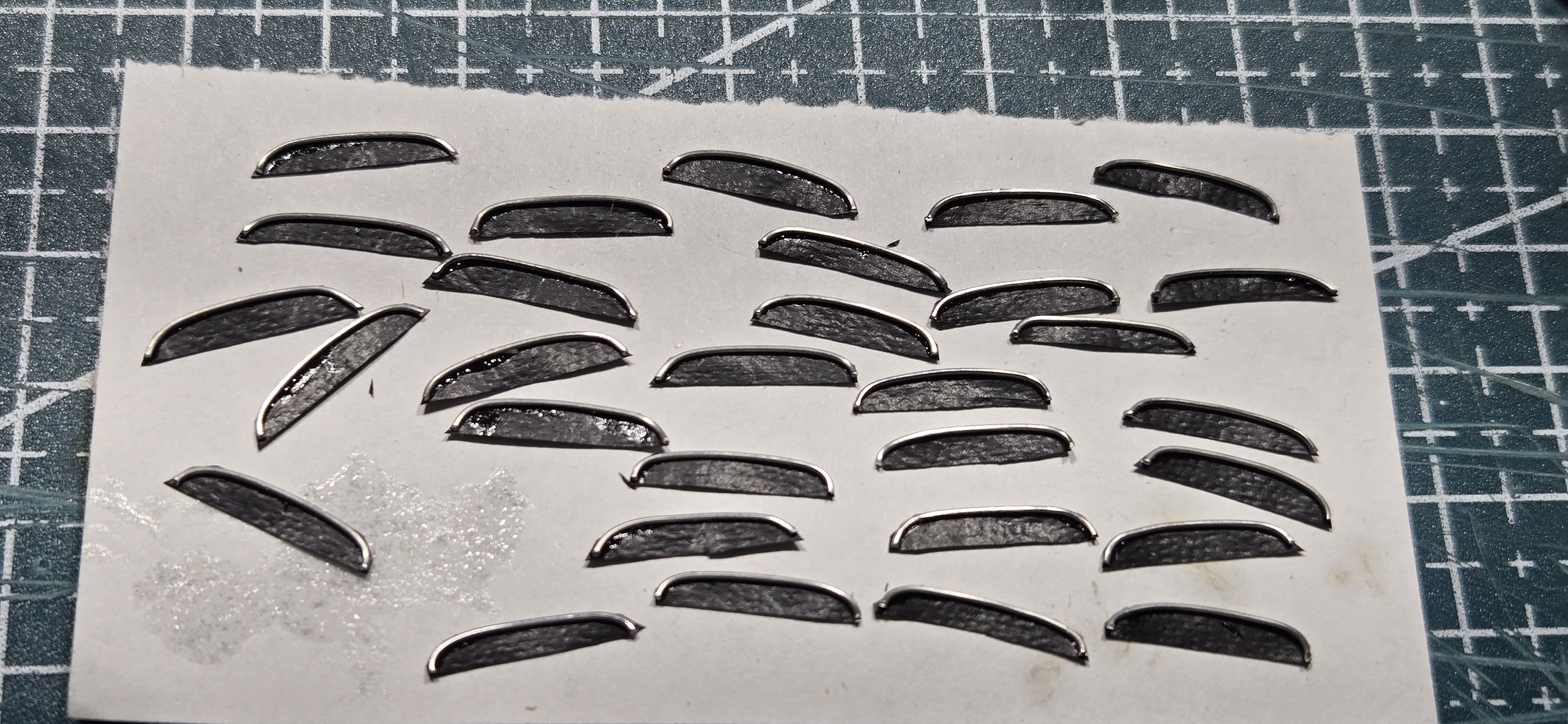

With  the rudder and stern completed, I wanted to tidy up the hull and finish the "outside" work before moving on to the gundeck. Until now, I have had the ship in a foam cradle so that I could easily pick it up,  move it around etc while working on the bow and everything else. With al that handling, I rubbed the paint of the sharp edges of the air ports, scuppers and the mooring staples. i was just going to repaint these and as I was looking, I really wasn't happy with the paint job I had done on the gun stripe or the inside of the gun ports, so decided to just repaint the whole outside. It was worth the effort and Im happy with how it looks now. The last detail was the rain gutters (eyebrows) over the gun ports. These are not supplied in the kit, so had to be fabricated. I used the same material I used for the false rail on the bow (pleather with the cotton backing removed) to simulate the canvas cover and fine wire to make the eyebrow part. I shaped a piece of wood with the correct width and just bent a piece of 20 ga. wire over it to give the proper curve. After glueing the wire to the fake canvas using CA glue, the whole thing as attached to hull also with CA and painted to match the hull. All in all, I was pretty pleased with the outcome.
20250531_154034.thumb.jpg.a7d763e6f2333664342c0189dea37037.jpg       20250601_124031.thumb.jpg.1c758e74e22f3c3cdb4207b589c04b23.jpg
I think at this point I'm ready to get started on the gun deck, where I plan to put alot of detail. Fun stuff for me.
Frank
Those "eyebrows" look great! And yes, there are a lot of "fun" to make for the gun deck, each one a miniature model unto themselves. The only downside is that a lot of those nice details are hard to appreciate while partially hidden under the spar deck due to limited viewing accessibility, at least on my model. I look forward to your future posts.
