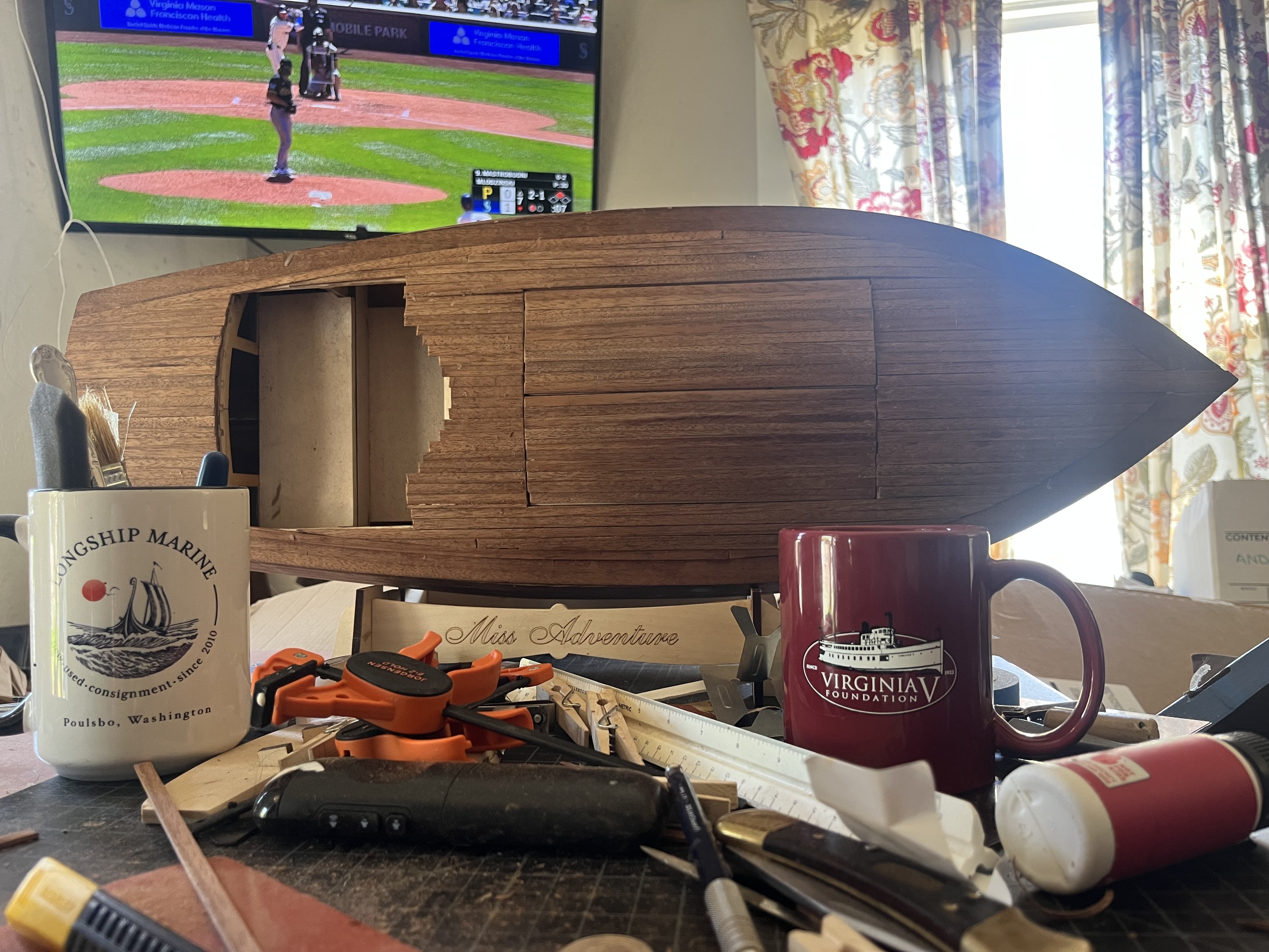

Slowly going at it picked up a dremel to help and don’t know why I had not got one before. Almost done with the hull planking and will do some sanding and filling before I start with the resin.  Today I’ll be by a boat shop and plan on picking up some west marine resin and hardener but not sure if I was the slow hardener or the faster

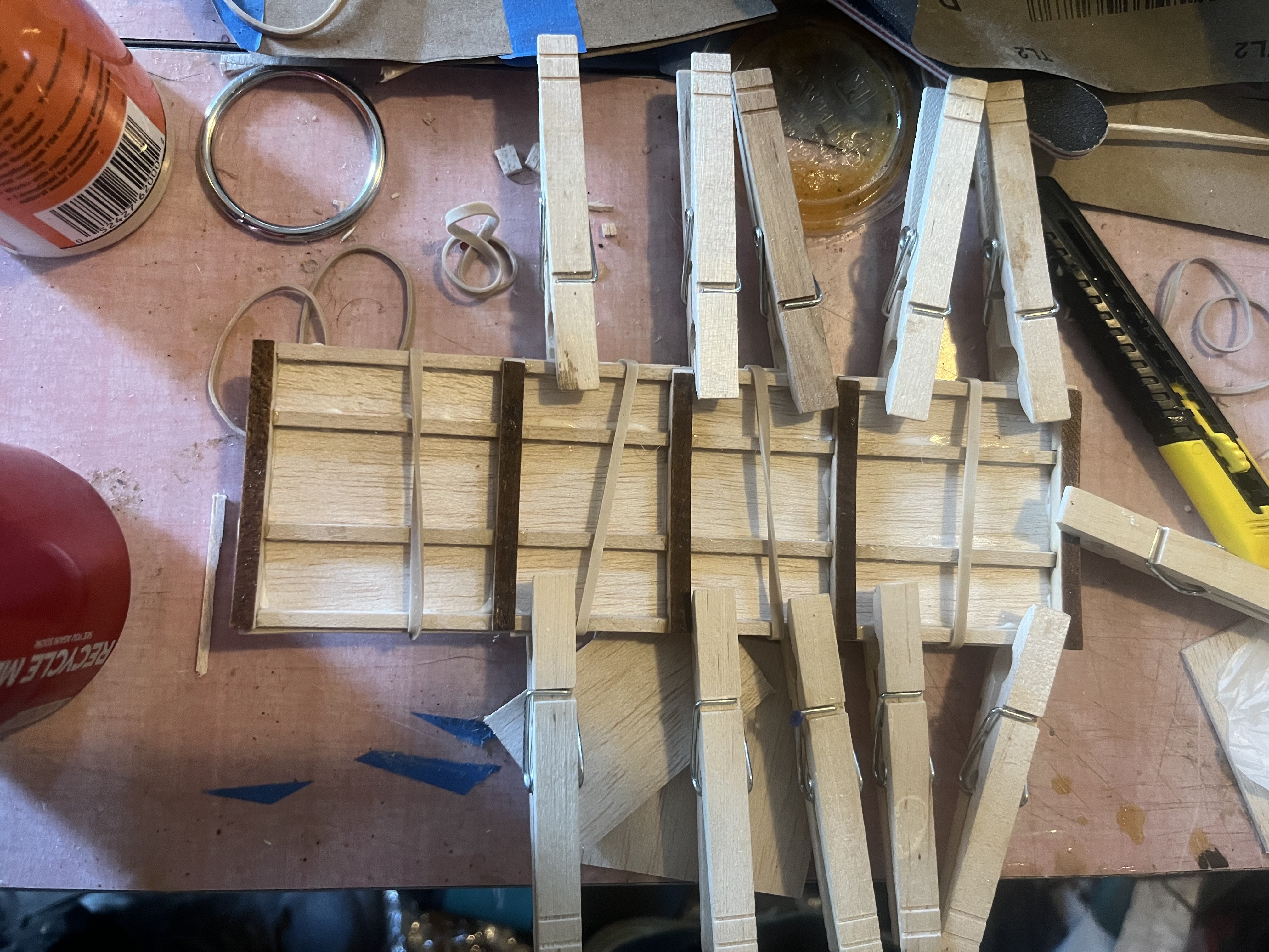

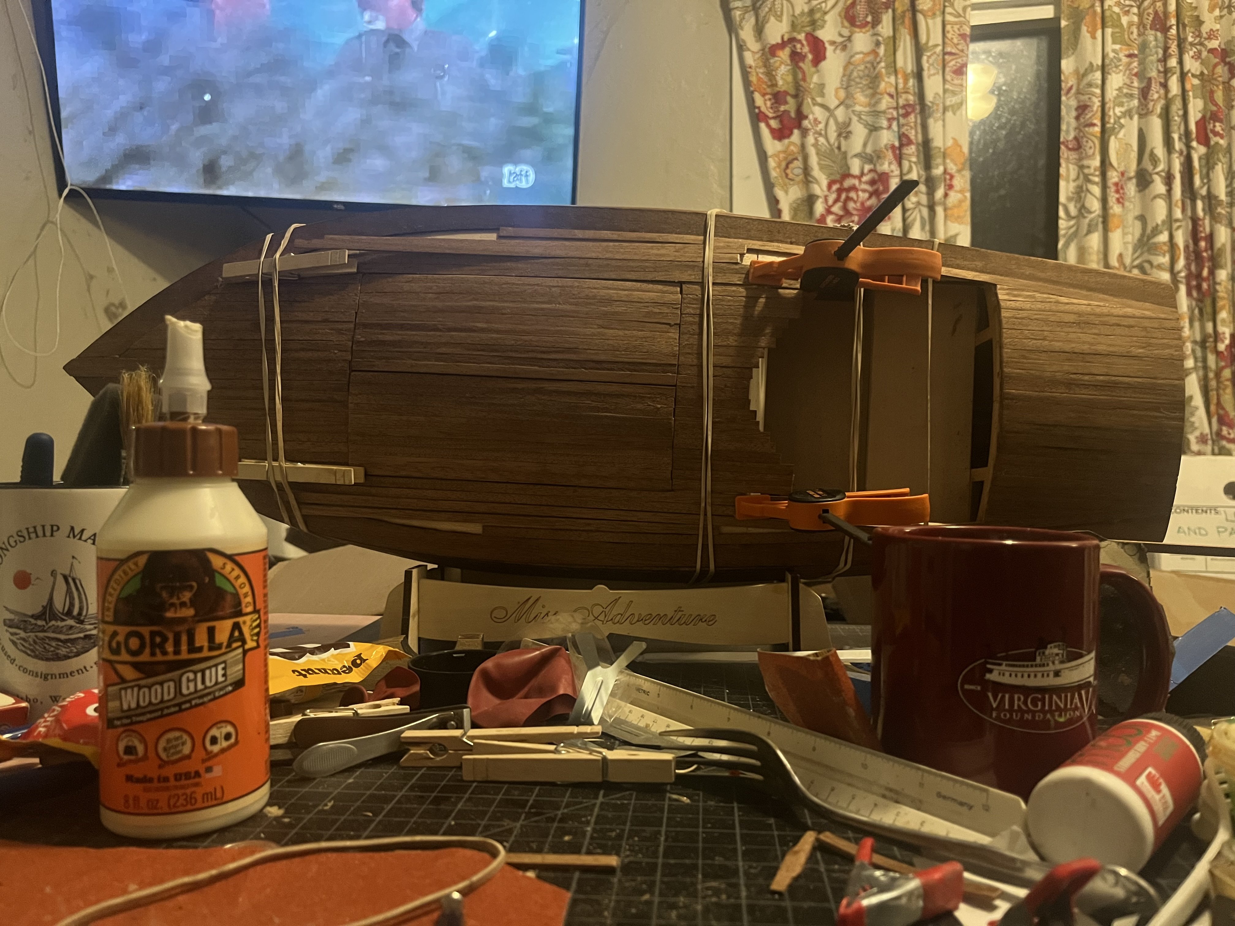

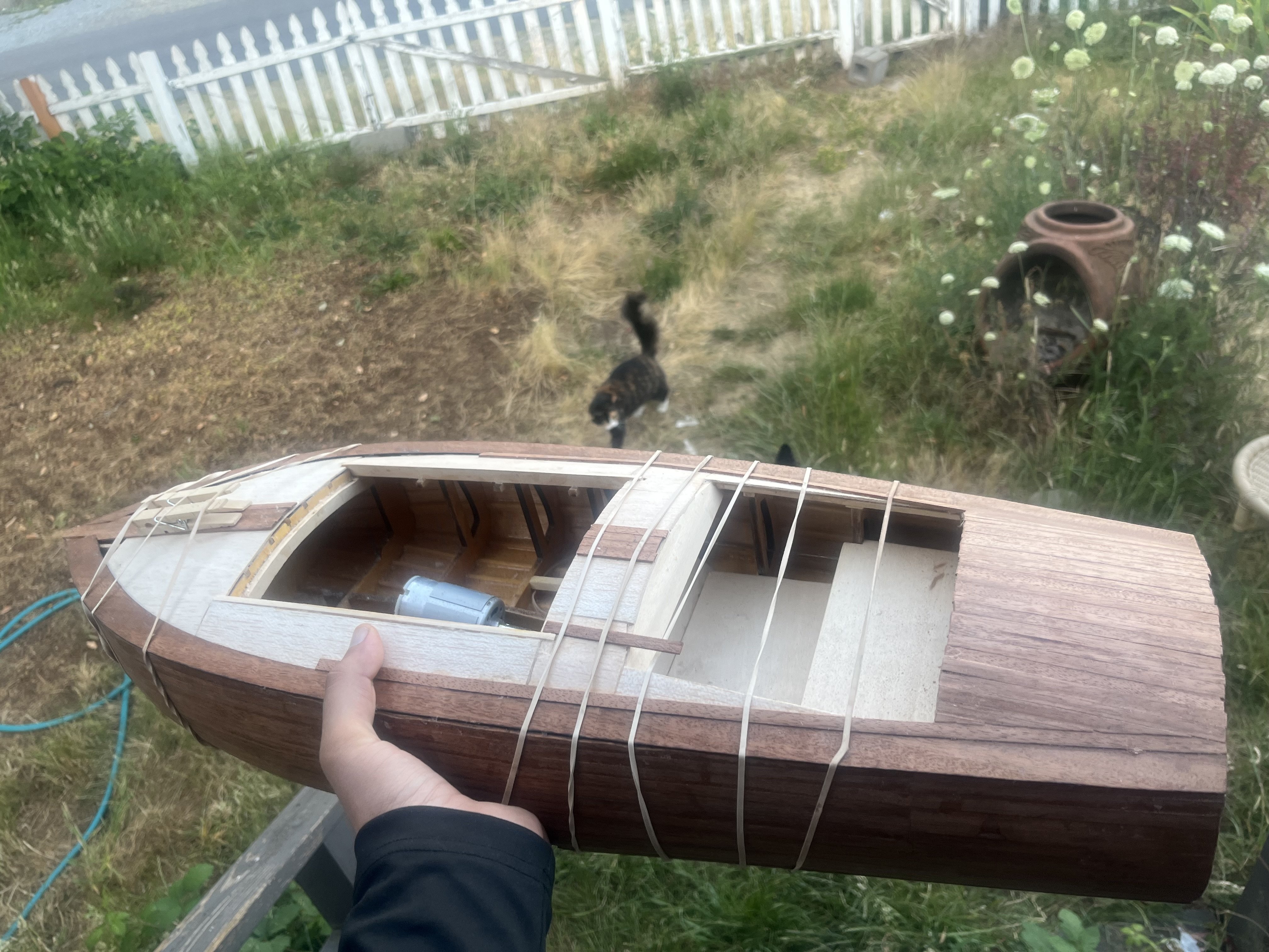

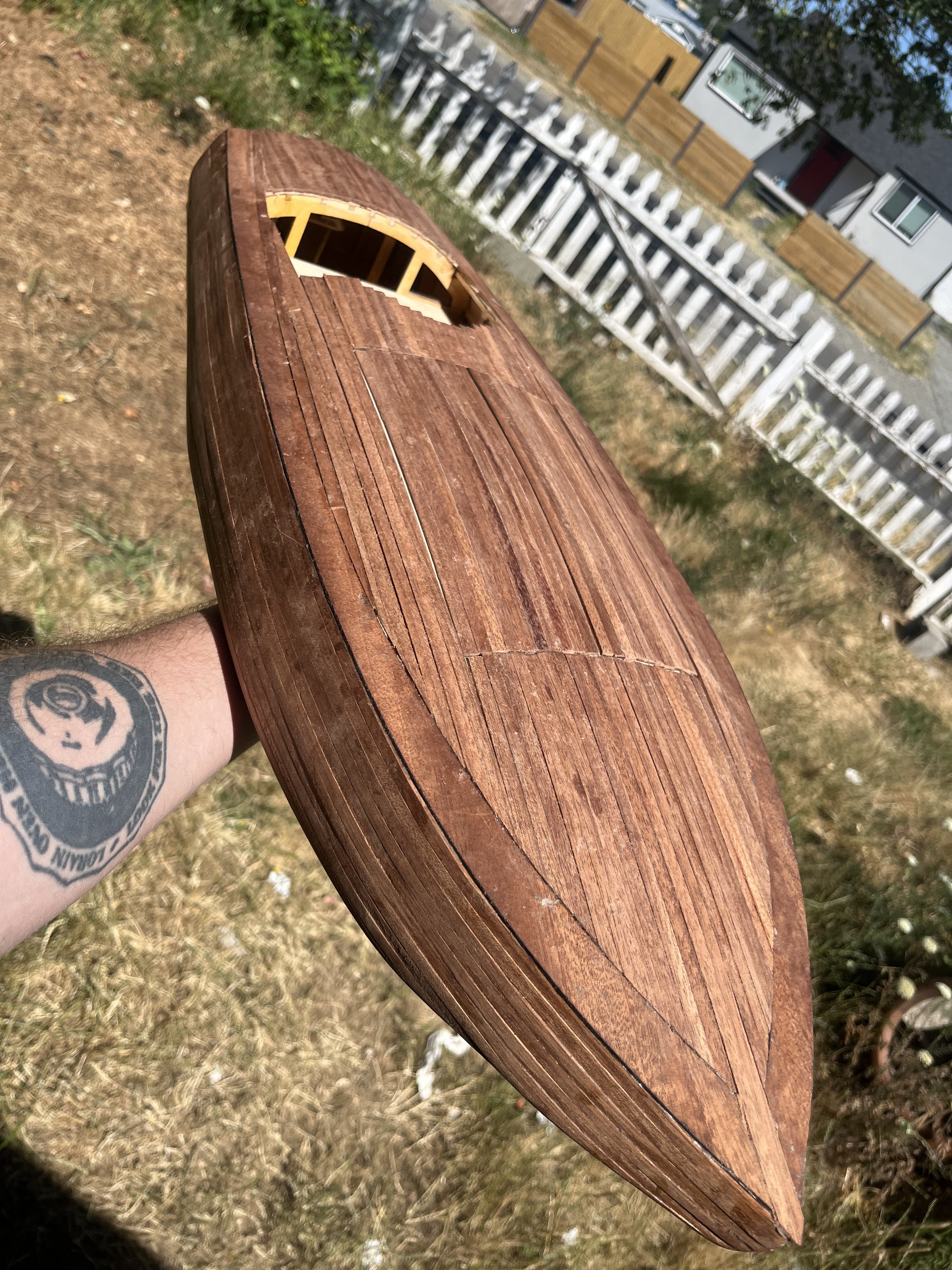

Finally have the bottom almost fully planked just a couple more on the rear but my sniper snapped so I stopped. The dremel made quick work of some trimming and I’ll be filling a bit and thinking of the best way to do so in between some planks that are a bit further apart than I had hoped.

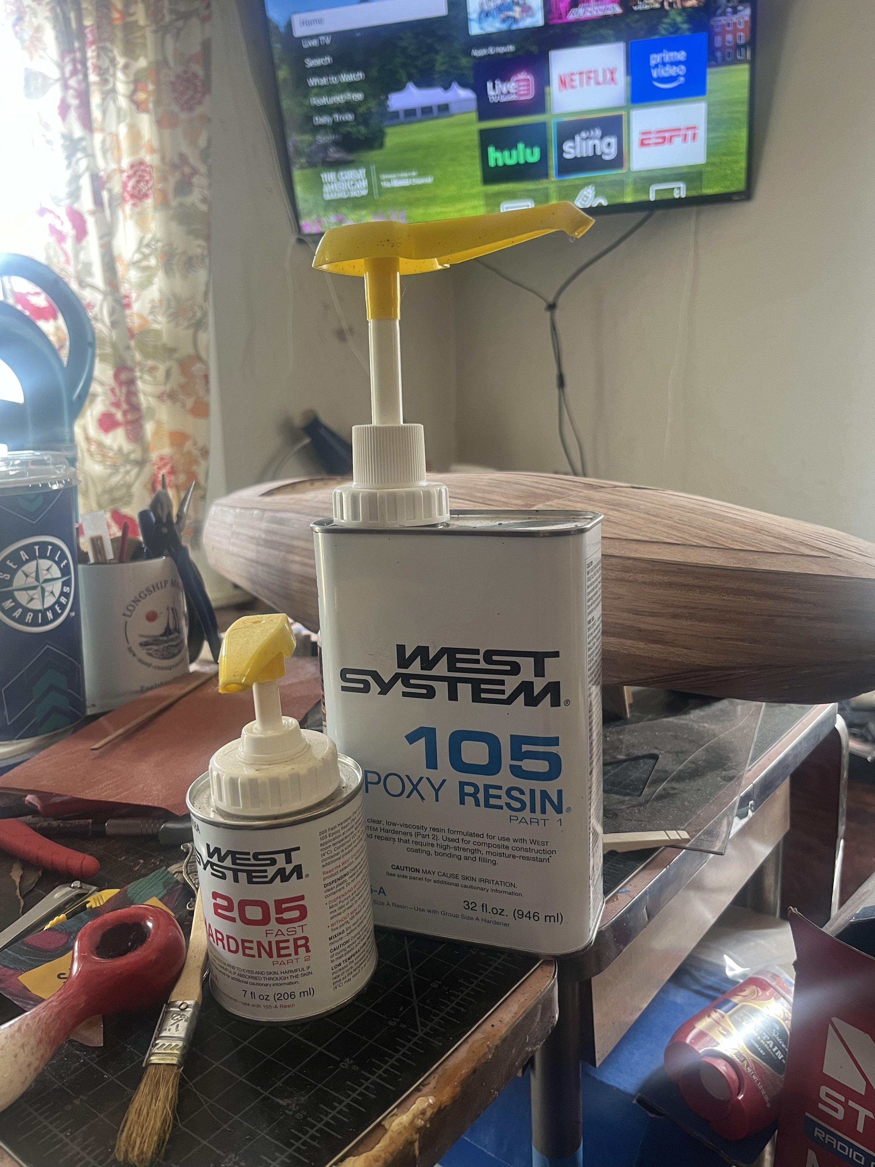

I was able to pick up epoxy and will be ordering their pumps for proper mixing easy from what I’ve read

Got a bit of filling and cleaning up the planking done and it’s looking better and better. Line of glue on the gap wipe and sand has done wonders on how it look. The bow needs some more shaping done that I am reluctant to do. Decided to test out the resin as I have never used it before and I slapped some on the dory over the paint and have started a small section on the inside of the miss adventure to see how that will go. I was using a sponge brush not sure how heavy or lite to apply. I was expecting to be totally gassed out by the epoxy but has no noticeable odor which makes me extremely happy I won’t have to work outside on in the basement.

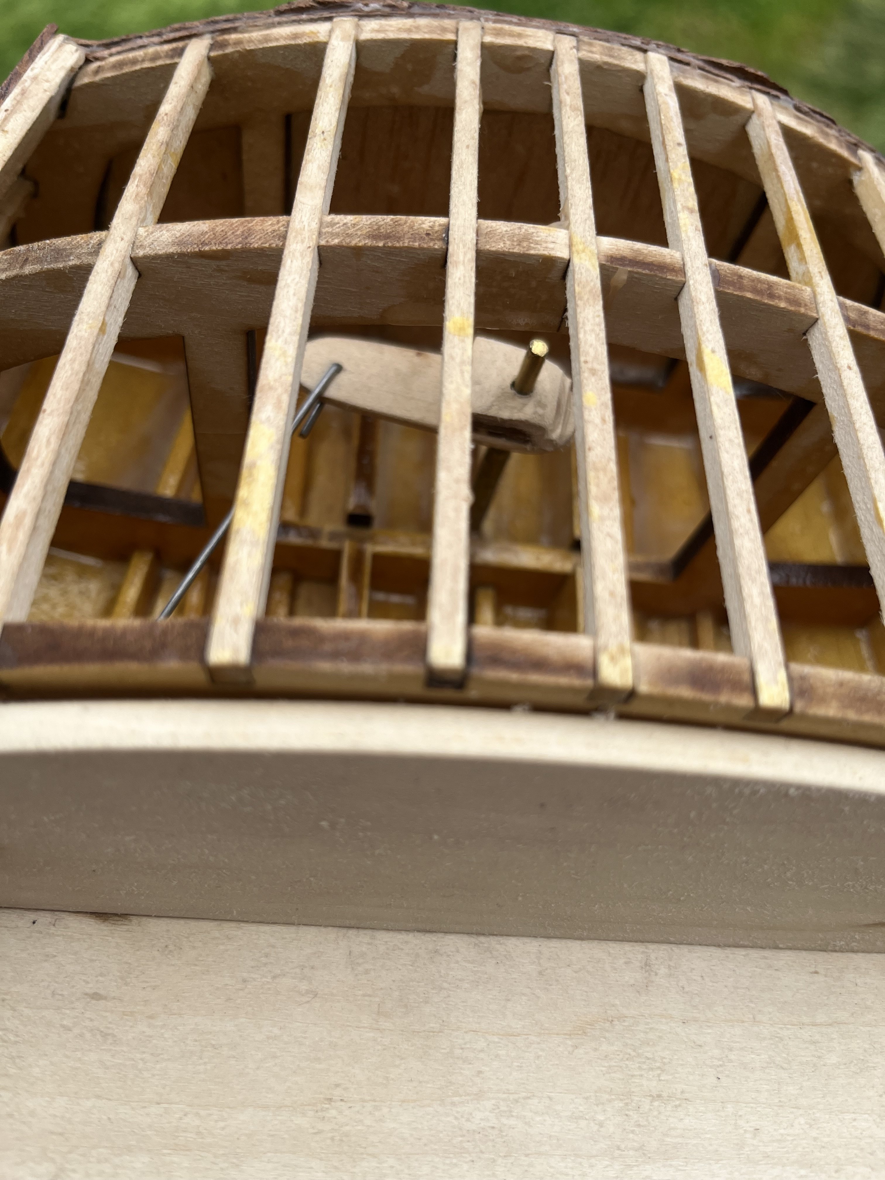

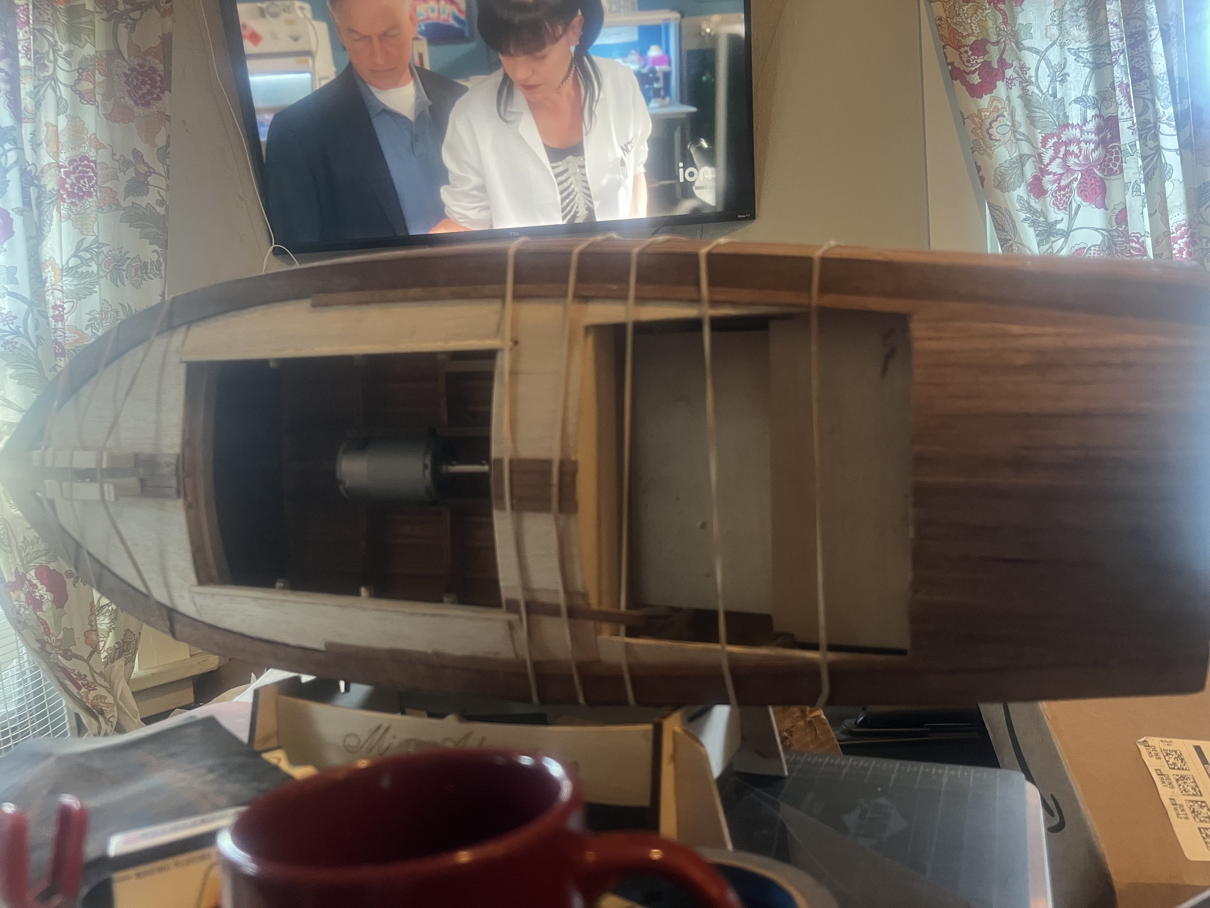

Roughly installed the steaming servo and need to remake the steering arm a bit longer so it can fully function. I’m thinking of making it from wood may be better than the thin sheet metal it says to make it with. What will be the best way to connect it to the prop shaft I’m thinkin a little superglue with a blob of regular glue to hold it. I am thinking that because how hard it was removing the smallest amount of resin from inside the rudder shaft tube. Feeling good about the placement of everything else and will remove and start building the cockpit this week.

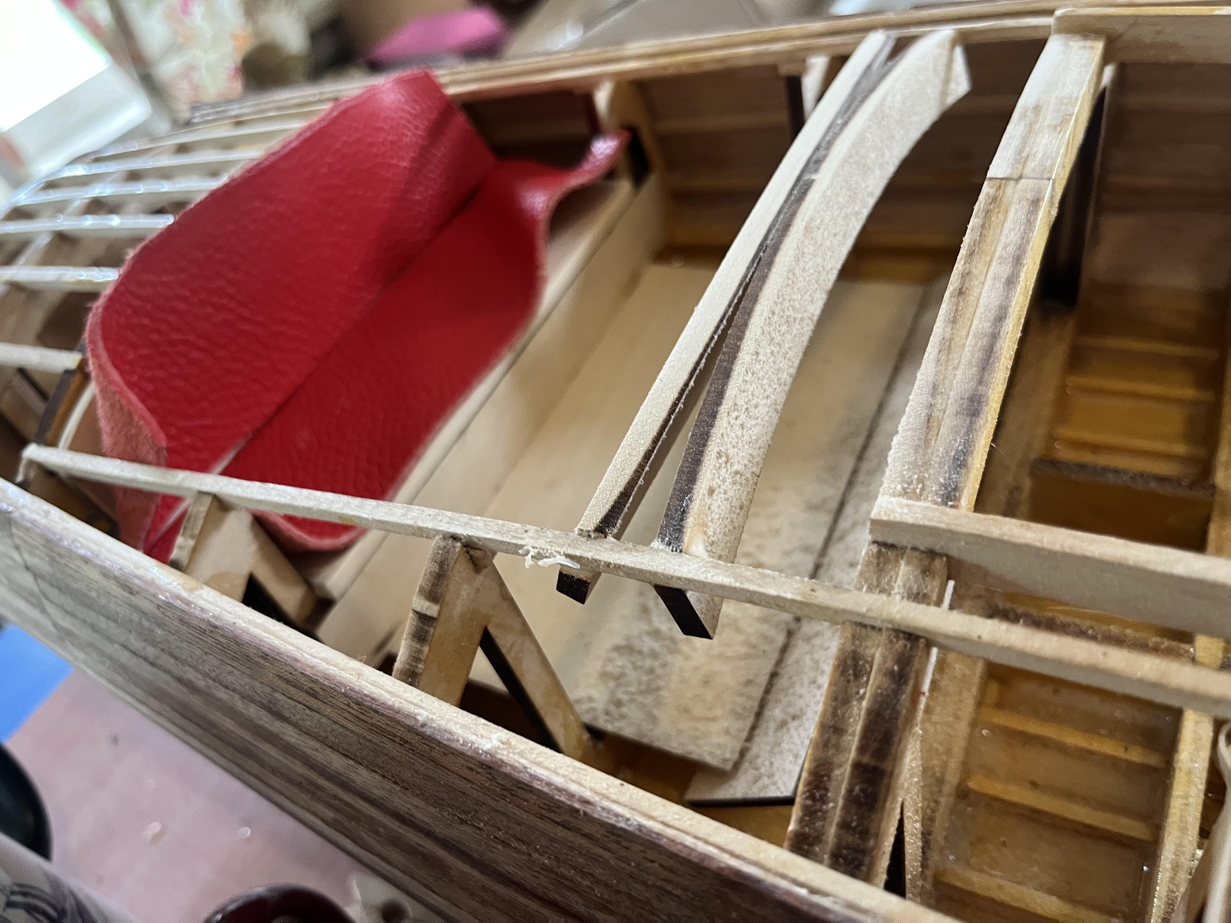

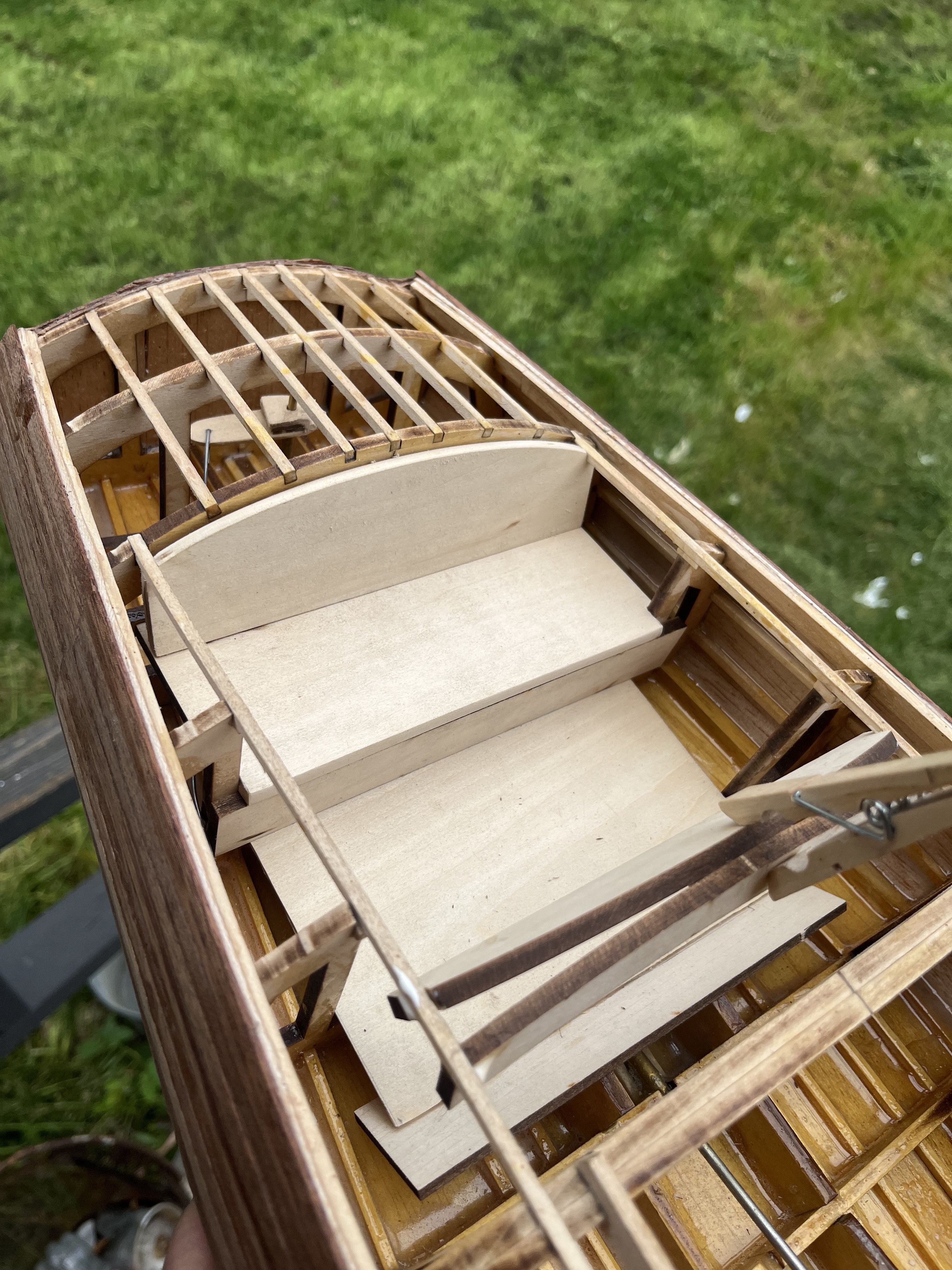

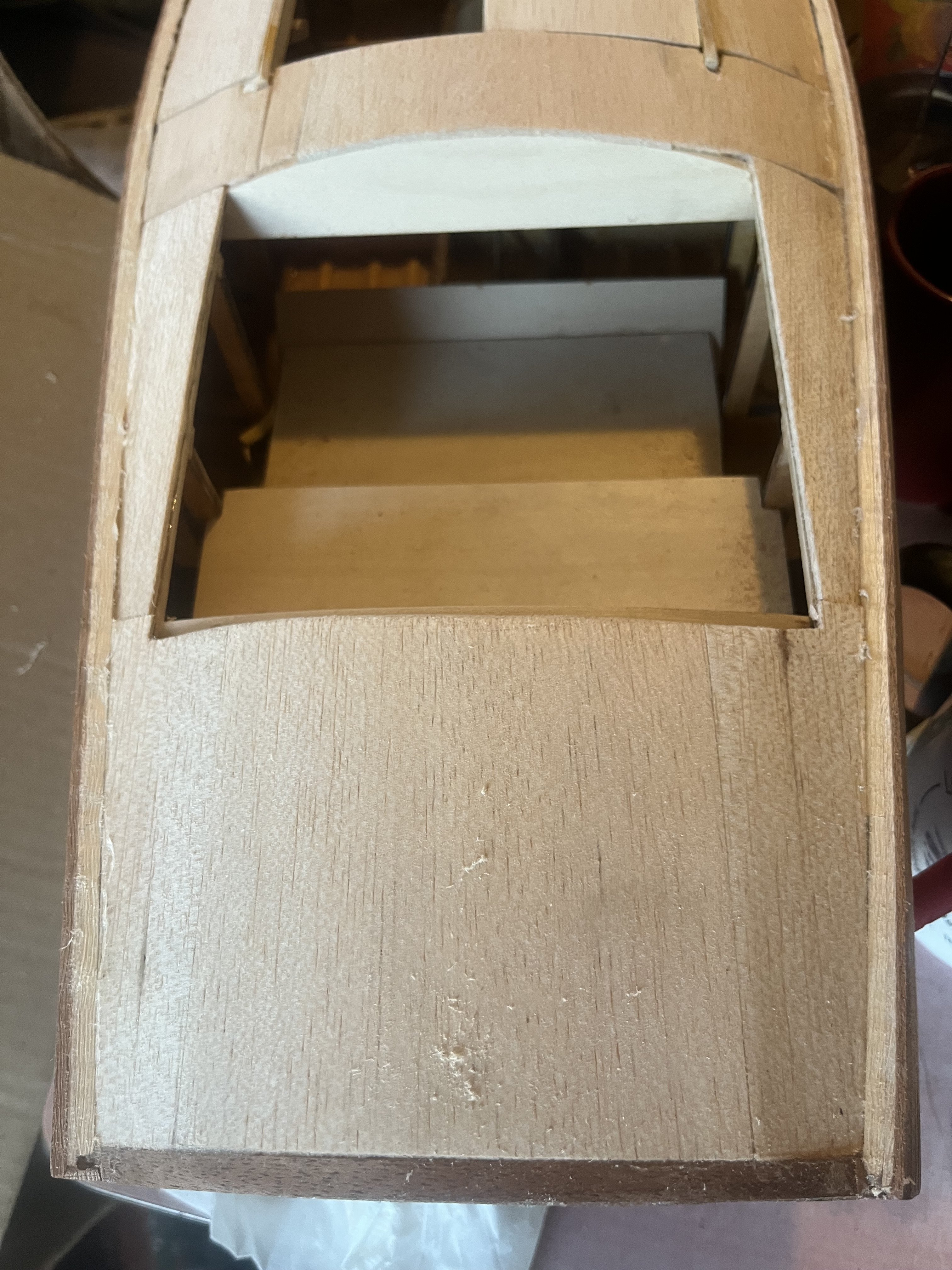

Installing the cockpit today went pretty smooth. The seat will be removable for access to starting system held in by friction. I have any leather I want to use for the seat that I hope will work but not sure if I want to fix it to the seat or have it as a separate removable cushion.  Up next work on decking one layer balsa under the planking like everywhere else even though that’s not what the plans say but I am excited to get that started.

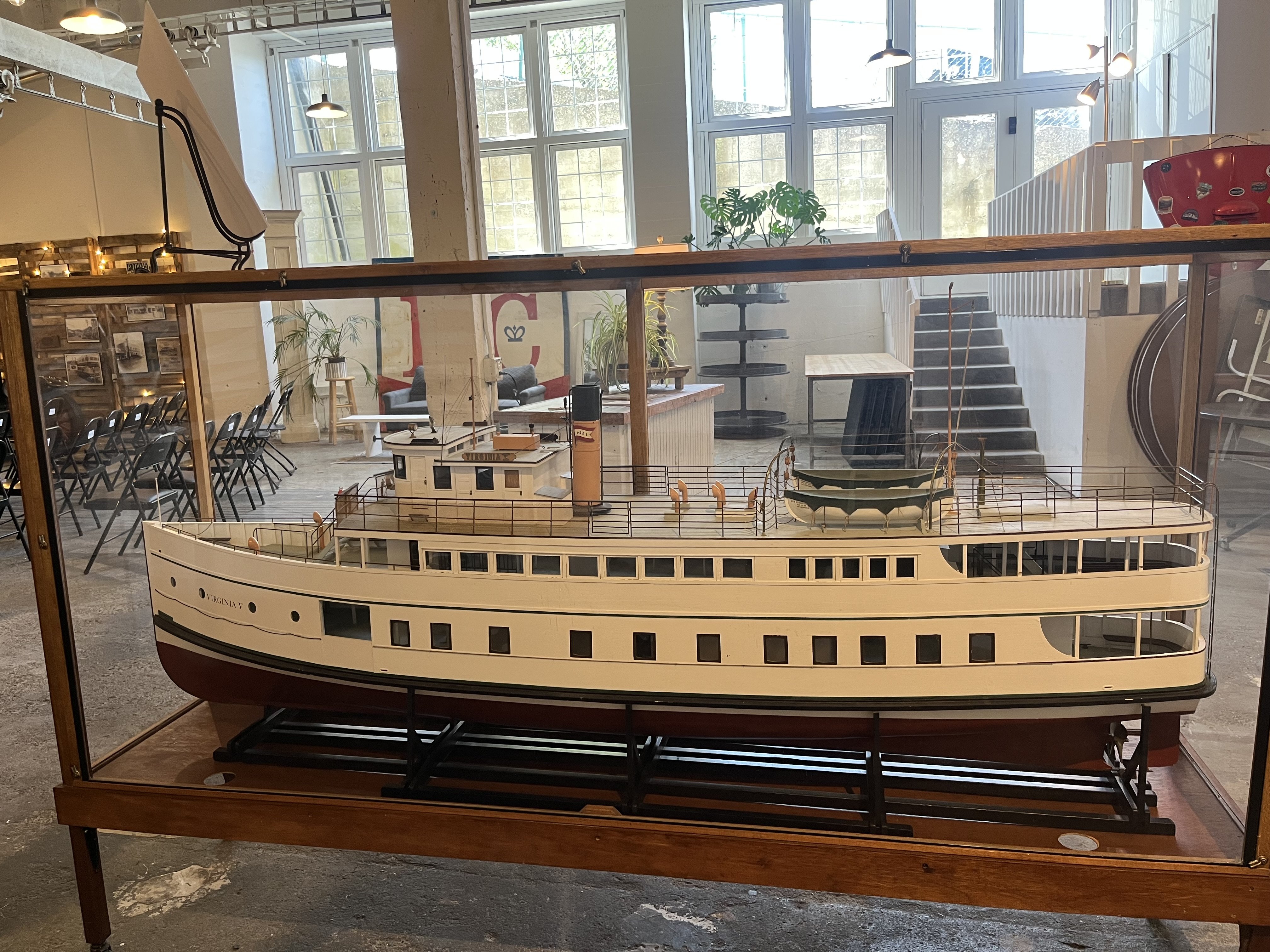

and for this weeks boat adventure we went of 4 different boats from old and slow to a newer fast passenger ferry to port orchard for a mosquito fleet festival where I saw a giant model of the Virginia v that I’ve never seen before and was very well done. Really couldn’t have been a much better day on the water without a boat of my own
That is an amazing model of the SS Virginia, went onboard her last fall at Olympia Tug Boat festival.

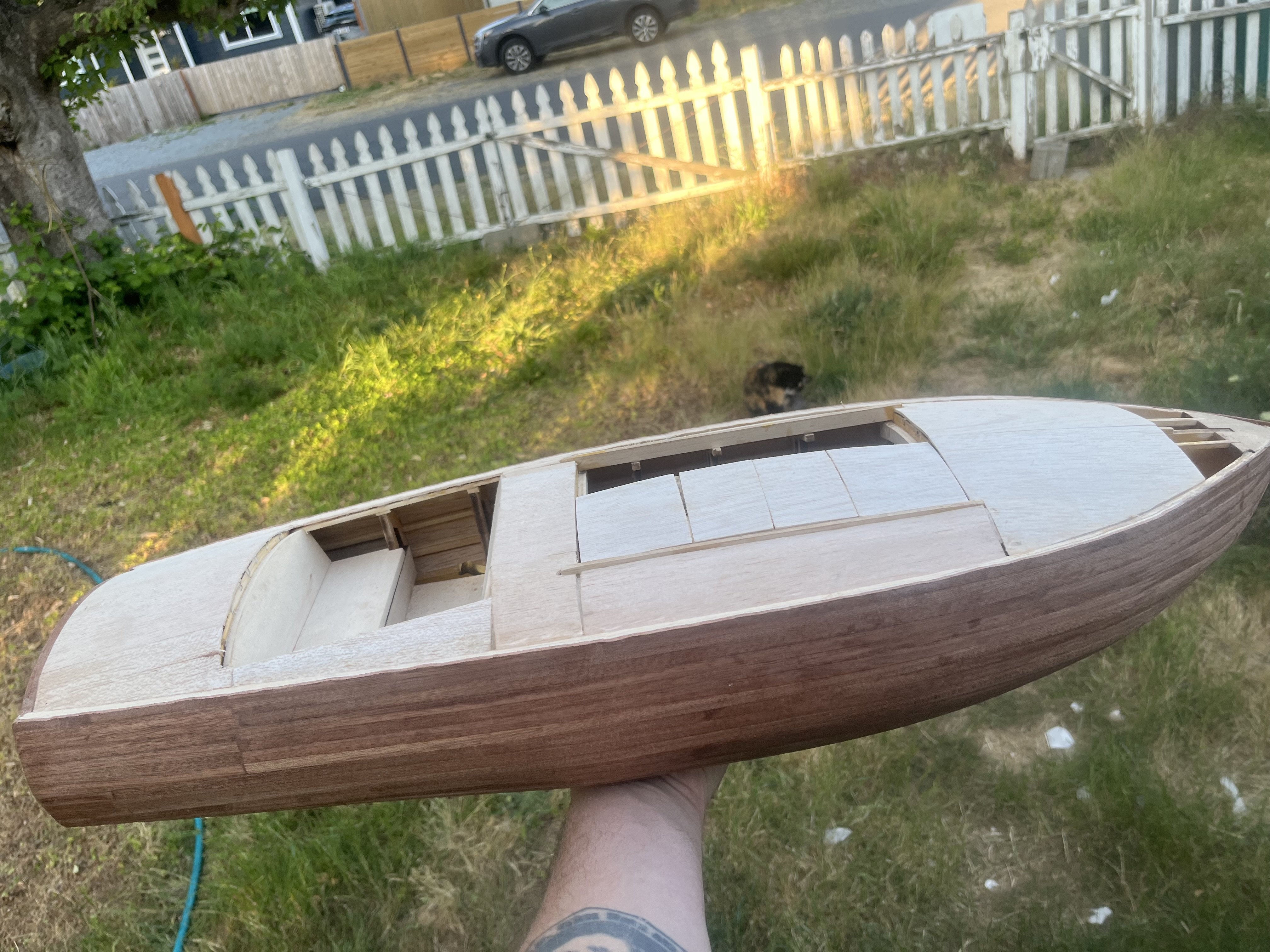

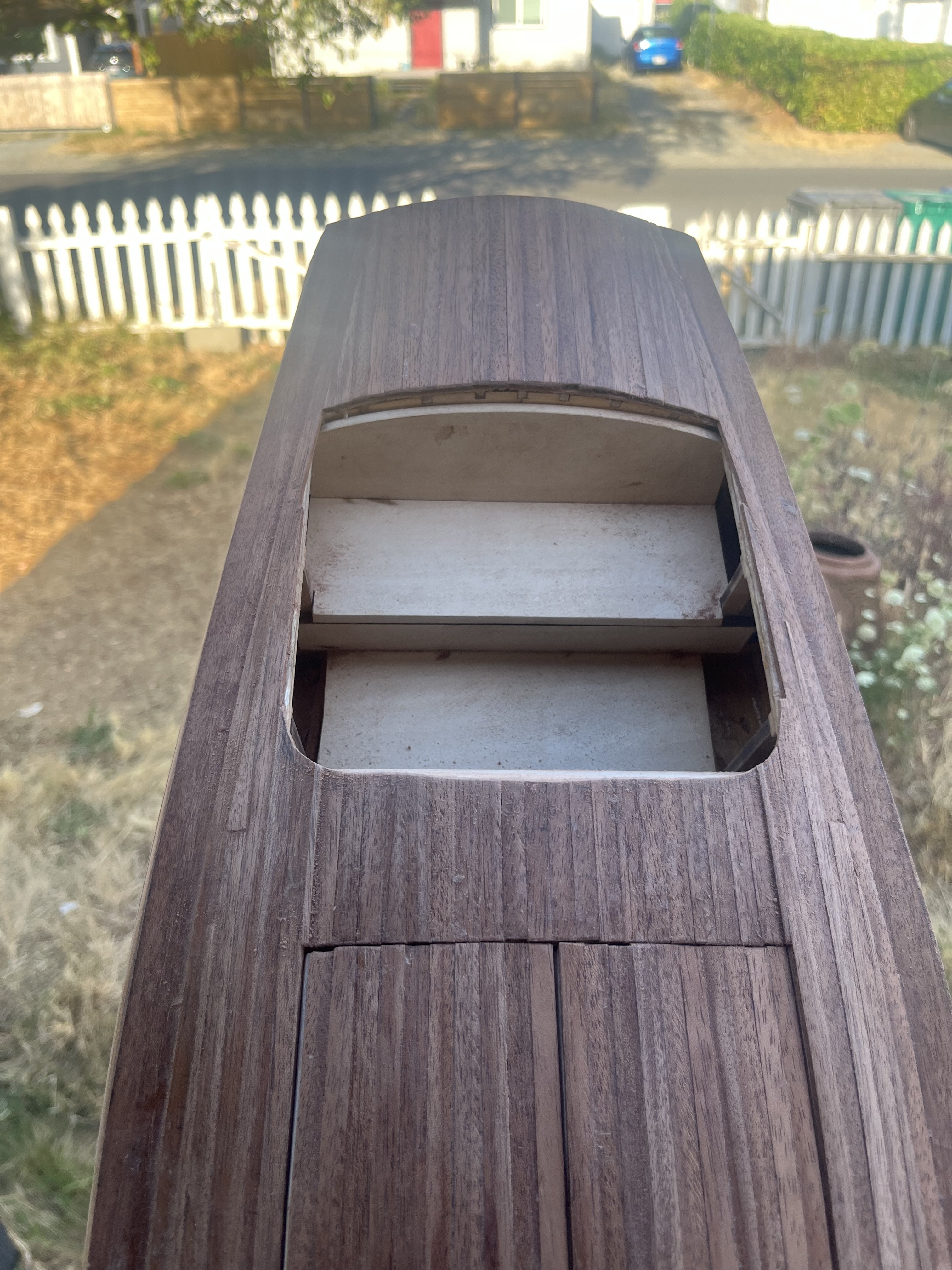

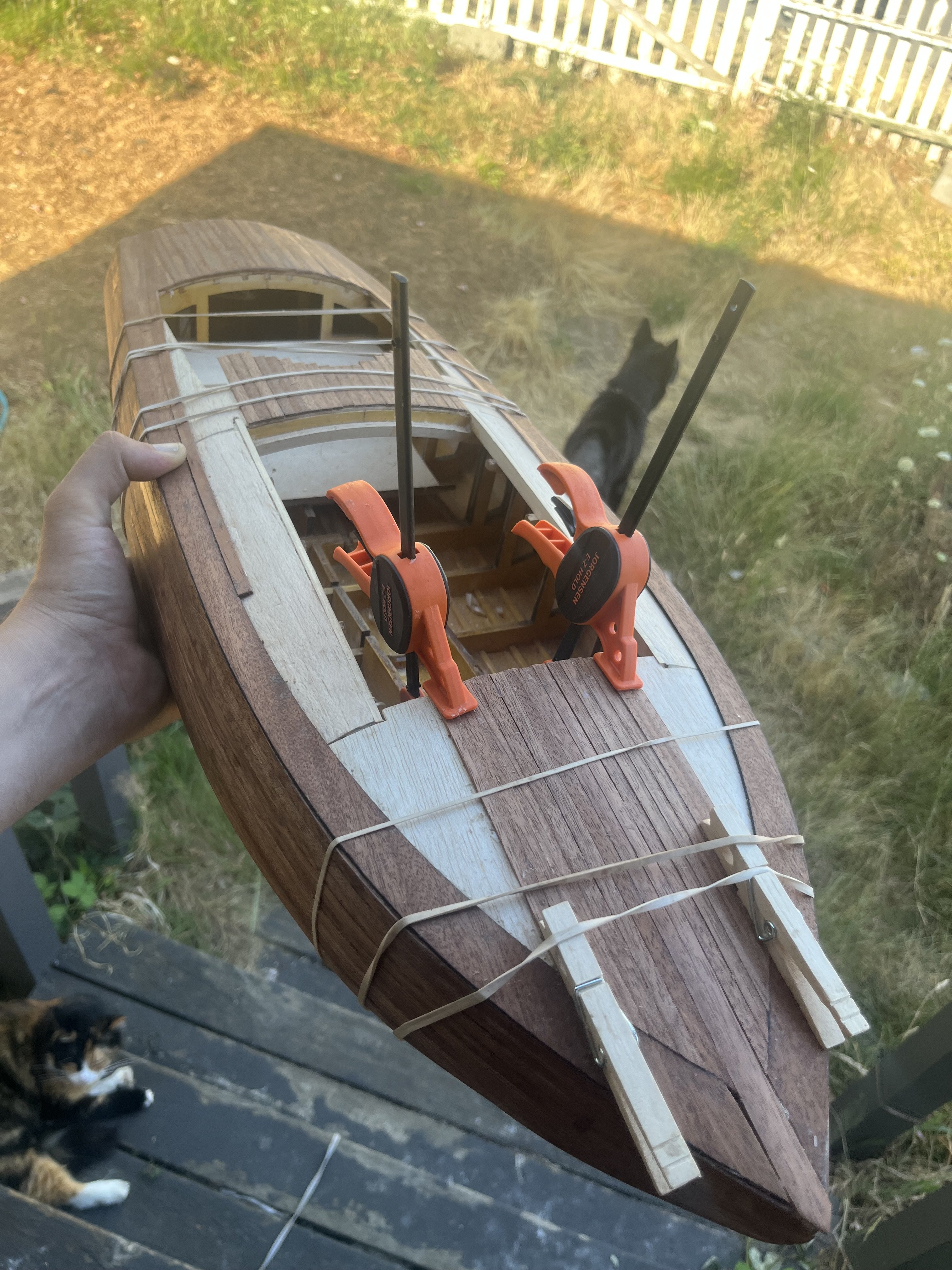

Making a bit of progress adding sheets of balsa as a base for planking may not butt up perfectly but it will all be hidden. Carved down the walls of the hull to be flat. Up next more planking, and sanding but feels like I’m getting a lot done and closer to epoxy and paint.
its boat season hear in Seattle so getting distracted on weekends but it is totally worth it.
Every weekend I look and think if I just sit for more than an hour I could just get so much done but then I look out and it’s just too nice and so I glue a stick or two and go. I like where it’s going but I should really get going so I can actually use it.
Anyway more planking and hoping thinks line up

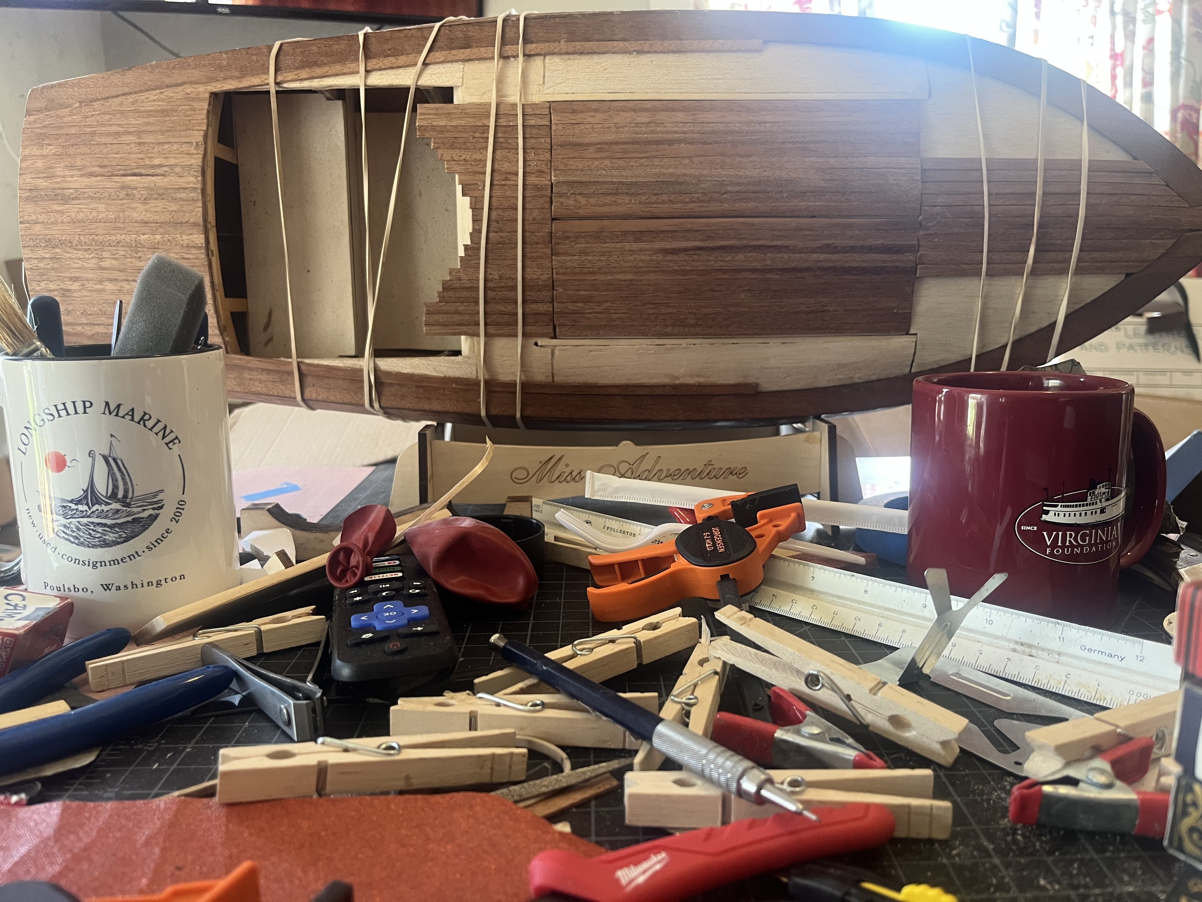

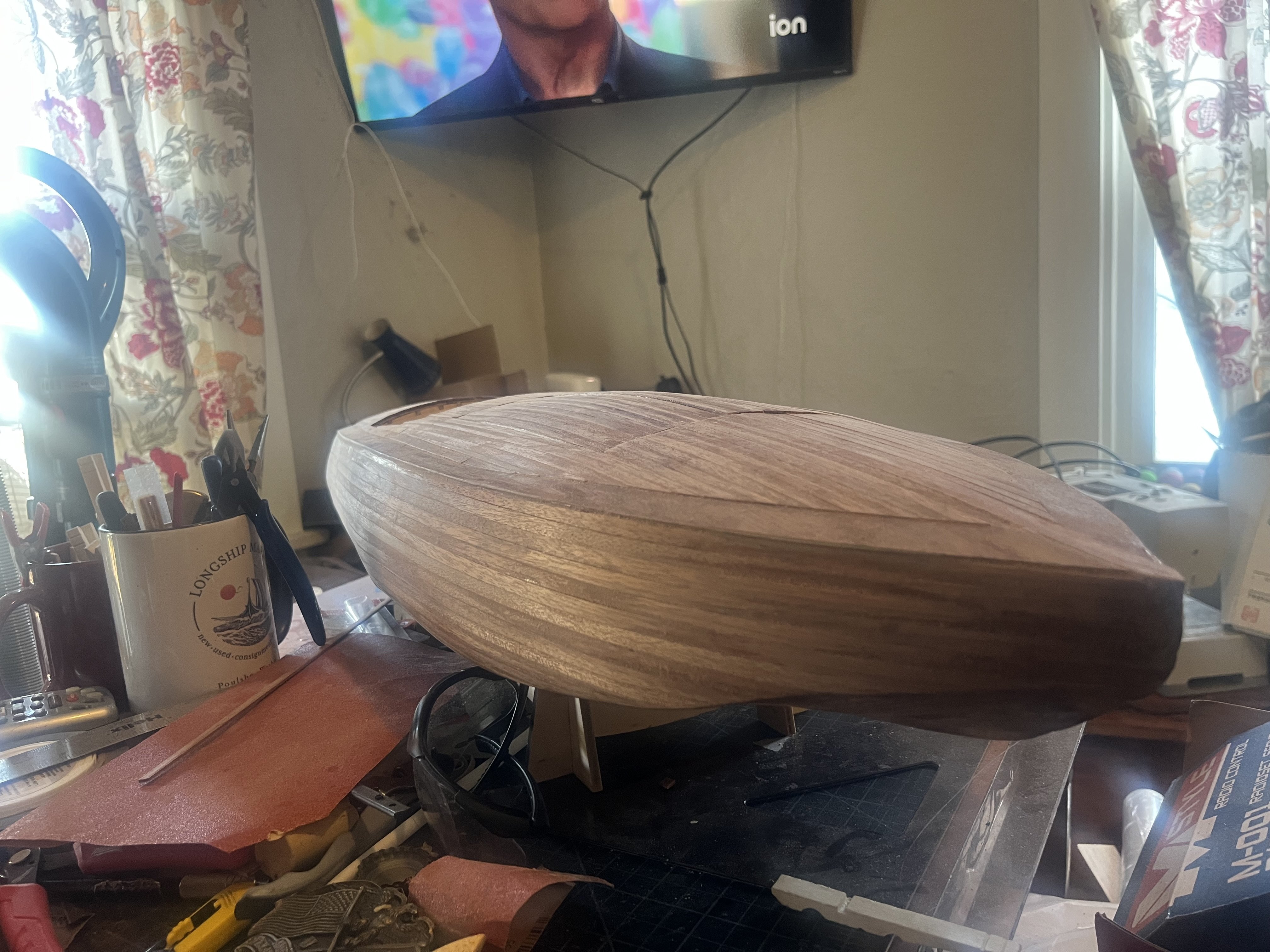

I am so close! All it took was sitting here all day cut glue wait and repeat for a few hours. It’s getting really close on the strips and I will have to piece together the last bits to make it work. I am determined to finish the planking tonight.
this was my weekend plans and so worth it to take the time to get the planking done
Ok I think I have filled my gaps sanded what I could and need to stop before I make things worse. Going to give it a wipe down and cleanup inside then onto epoxy this week I suppose.

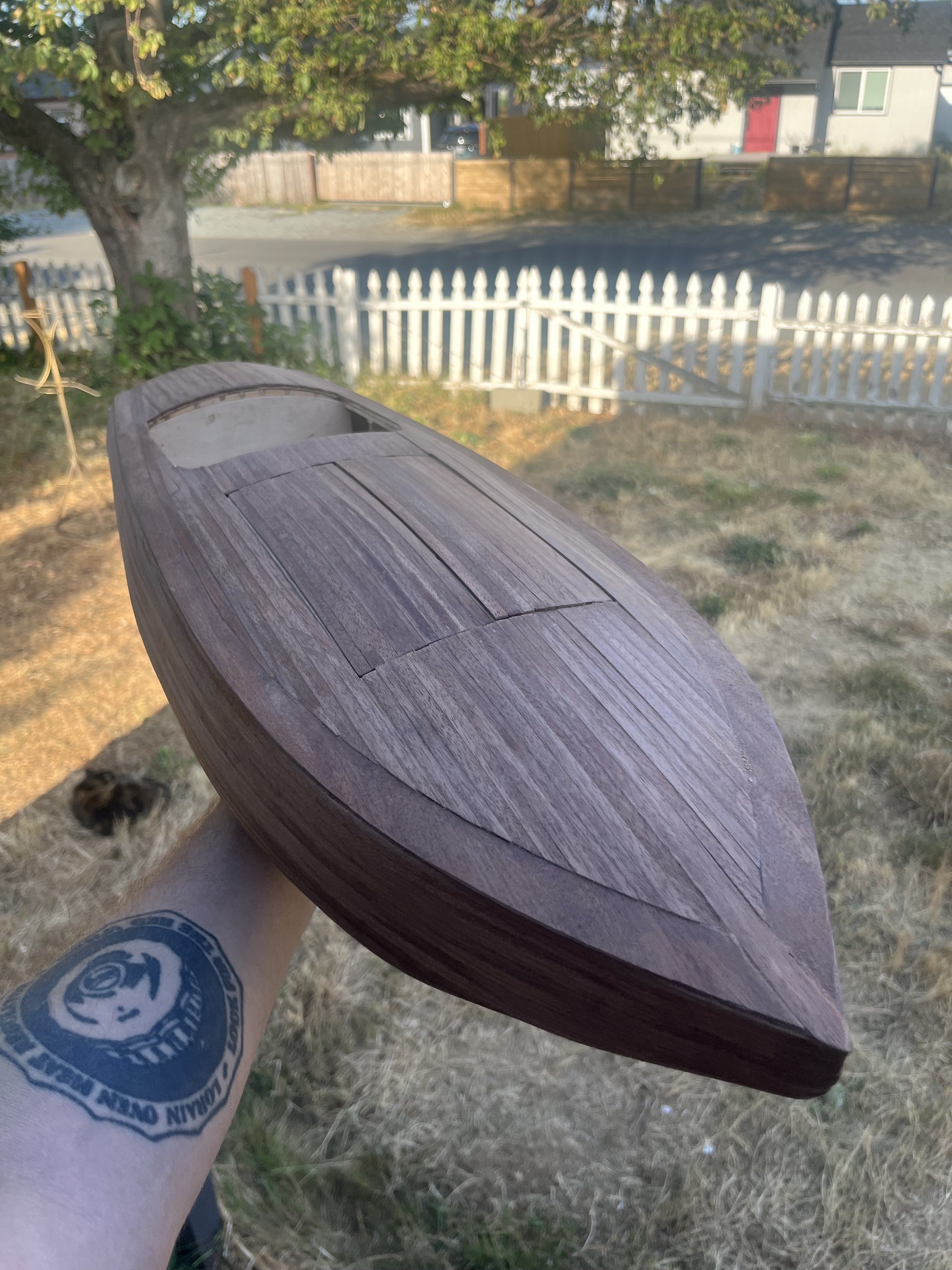

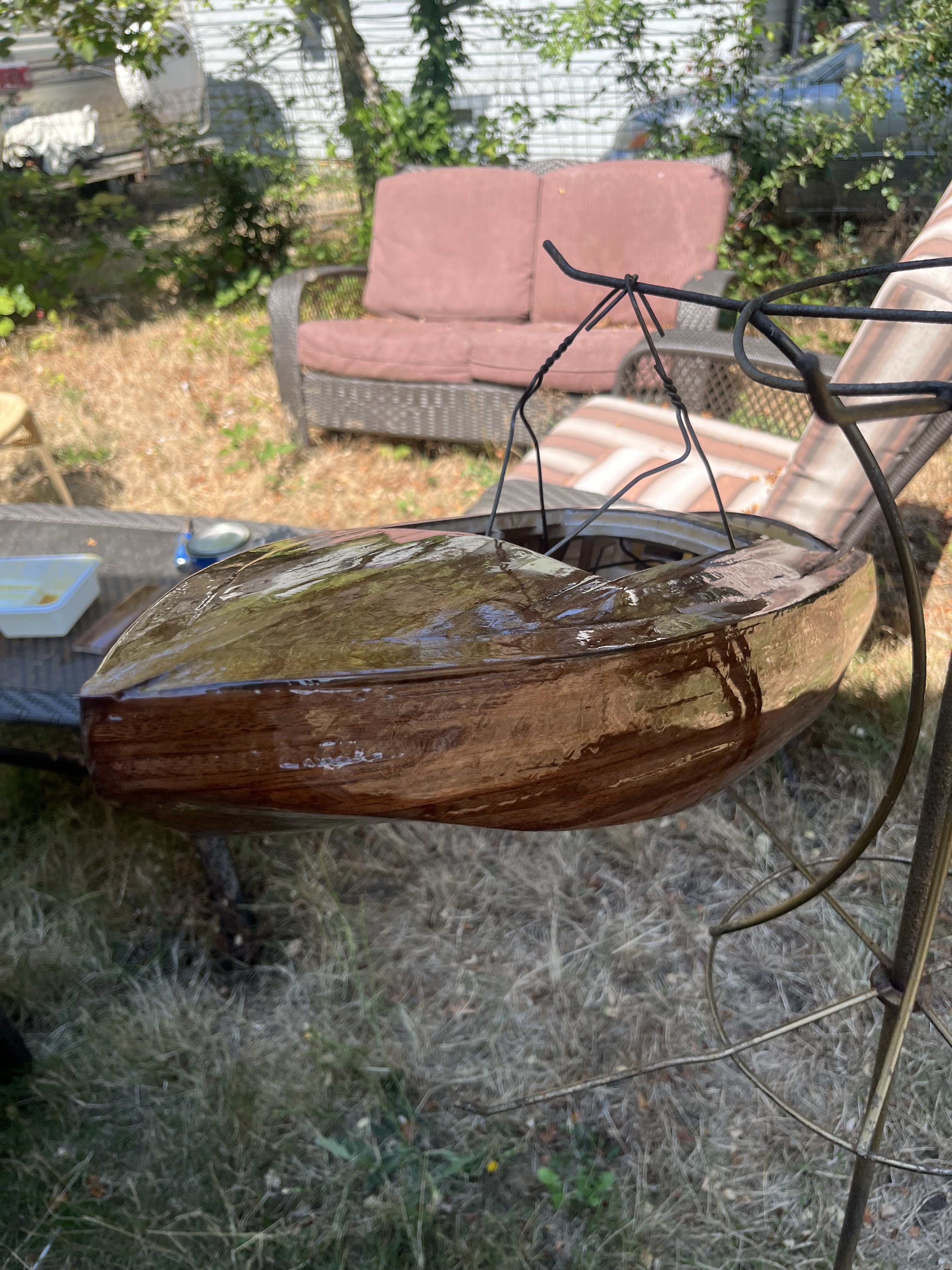

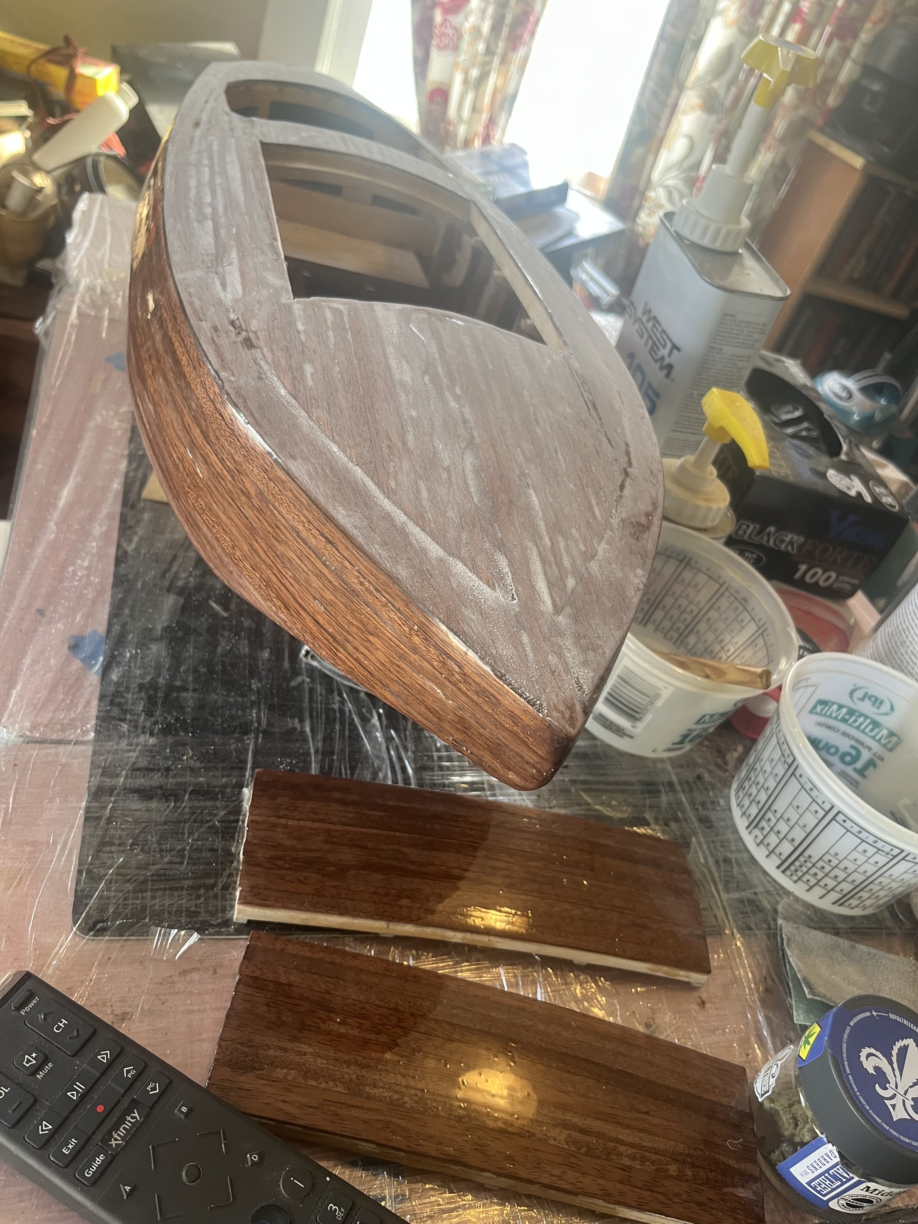

I see a ton of sanding in my future after my first layer of epoxy. But wow it looks great even lumpy. Wasn’t sure how to go about it I saw others just pour and spread so that’s what I did with a playing card. After the bottom cures I will do the same on deck hopefully later tonight so I can sand and repeat tomorrow unless it needs more time to cure
I don't understand why it applied so unevenly.
Alan O'Neill
It’s my first time so I may have just poured too much and spread it out and not as smoothly as possible. Also probably my poor planking as that was also my first time. I think it will sand out and the next layer will be better
You need a helper you can blame it on! 😏

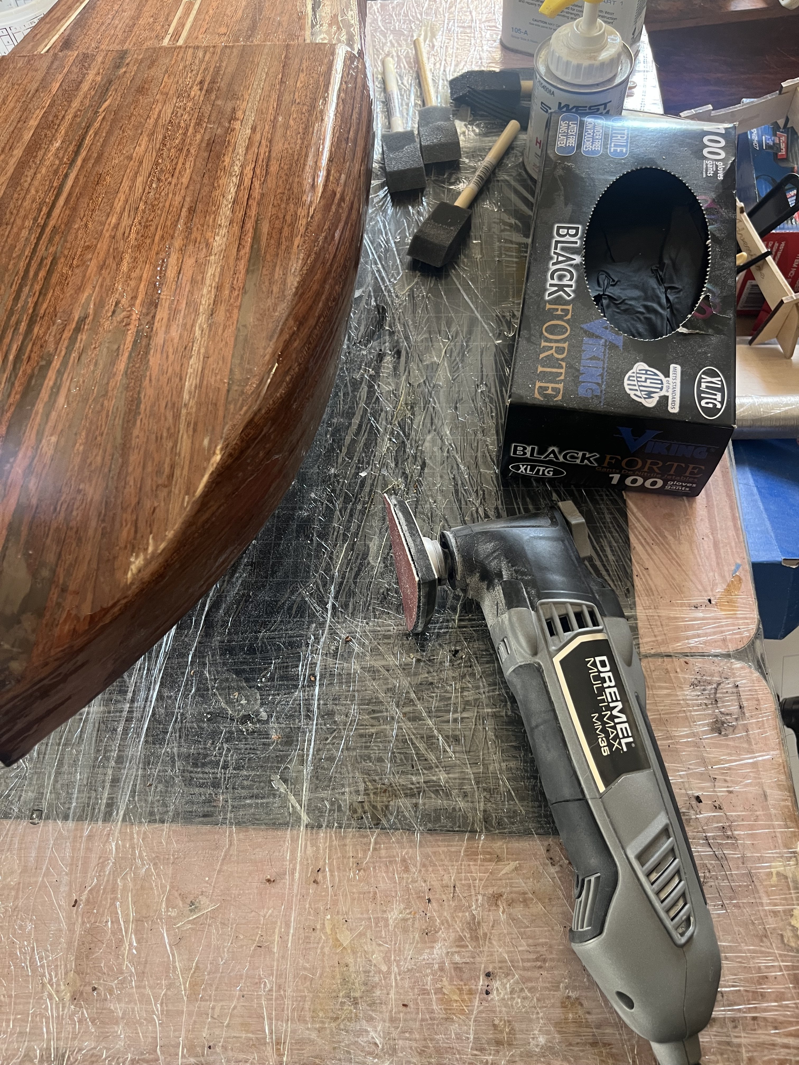

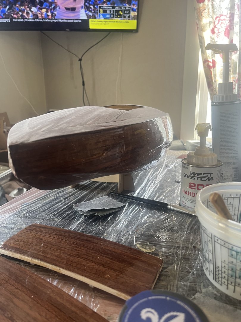

More sanding and epoxy getting smoother each time but I’m still dealing with drips but three layers in on epoxy slowly filling low spots. Not too sure on how many layers I will be doing I figured until it’s nice and smooth all around. This part is boring and messy and my next project has arrived so I’m eager to get this done.

Onto the final push and I finally broke down and got a sander and it is way better than doing it by hand. Just put on two layers of epoxy letting the first layer get slightly dry then adding another as I saw t done like that on a finishing video I watched. I’ll be knocking this back smooth and if I like it I will go ahead and start with layers of varnish. If not another layer of epoxy. Decided no paint and to just finish this up how it is. I am really excited to get started on my next project and need the table space

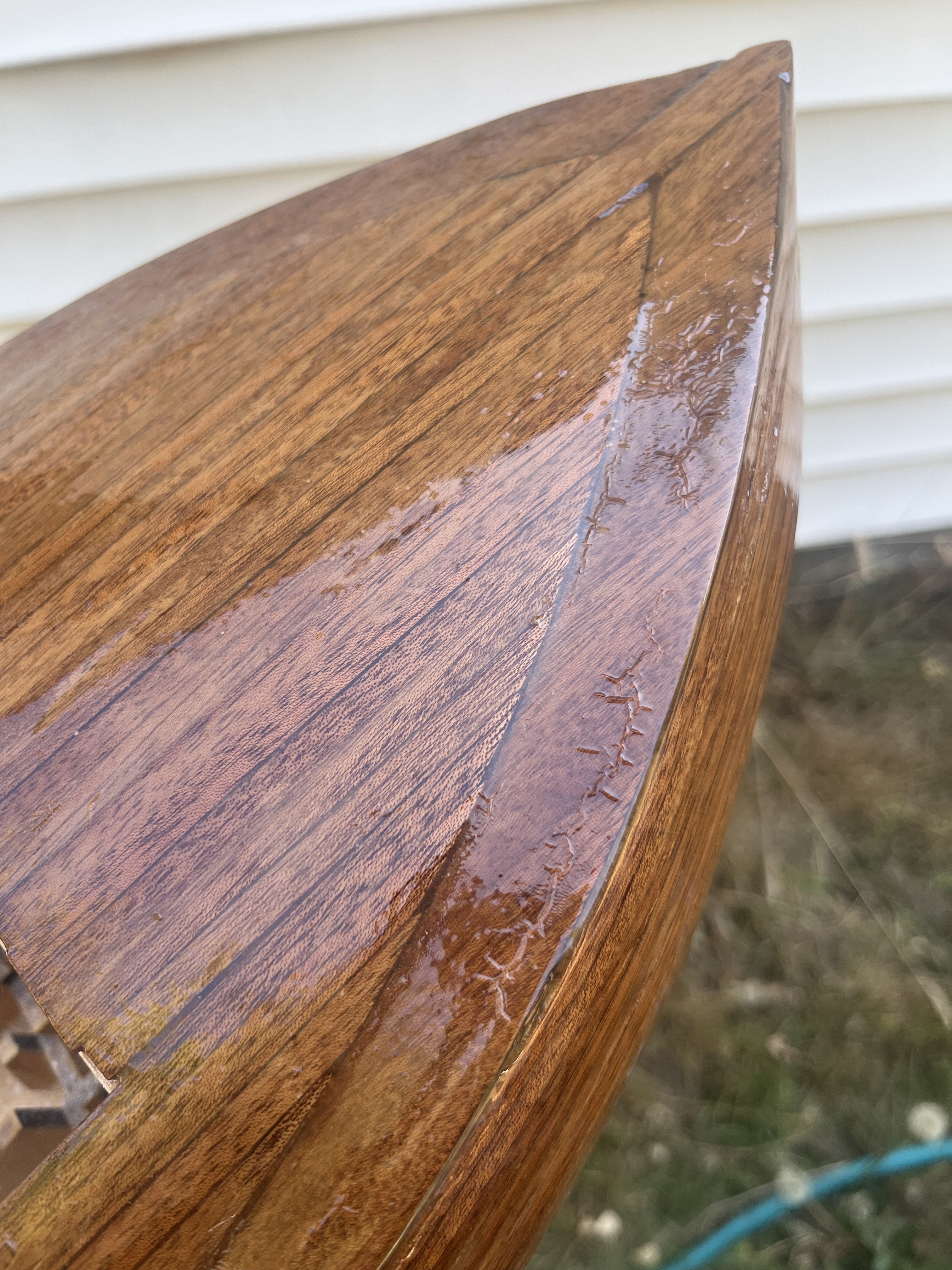

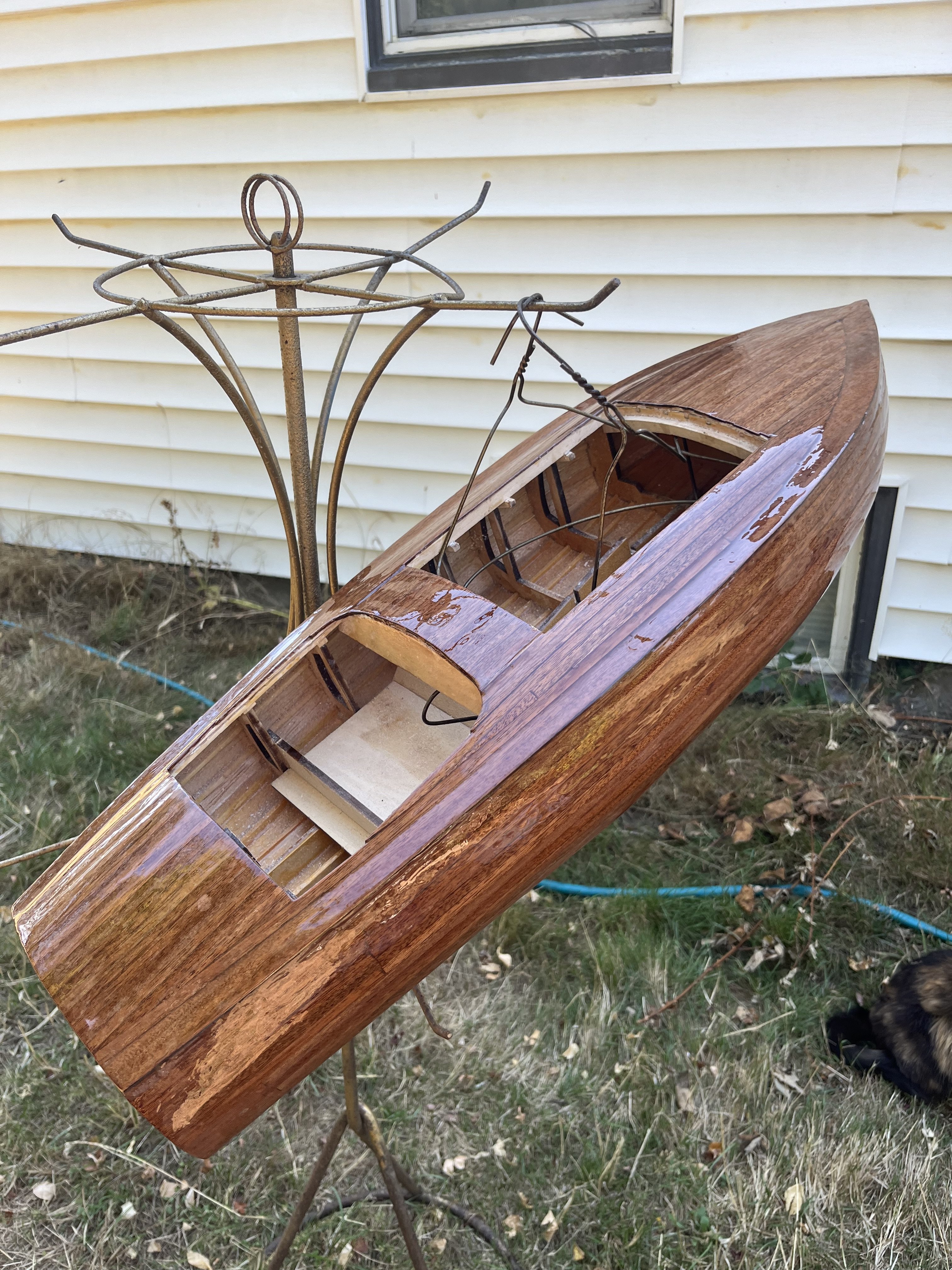

Sanded off most of the blemishing and gummy varnish that I created and found a spray spar varnish that I will be trying instead as I’ve seen it will be more forgiving. After three lighter coats I am liking the evenness and think after a few more done like this with a sanding in between it will hopefully polish up nicely in the end.
