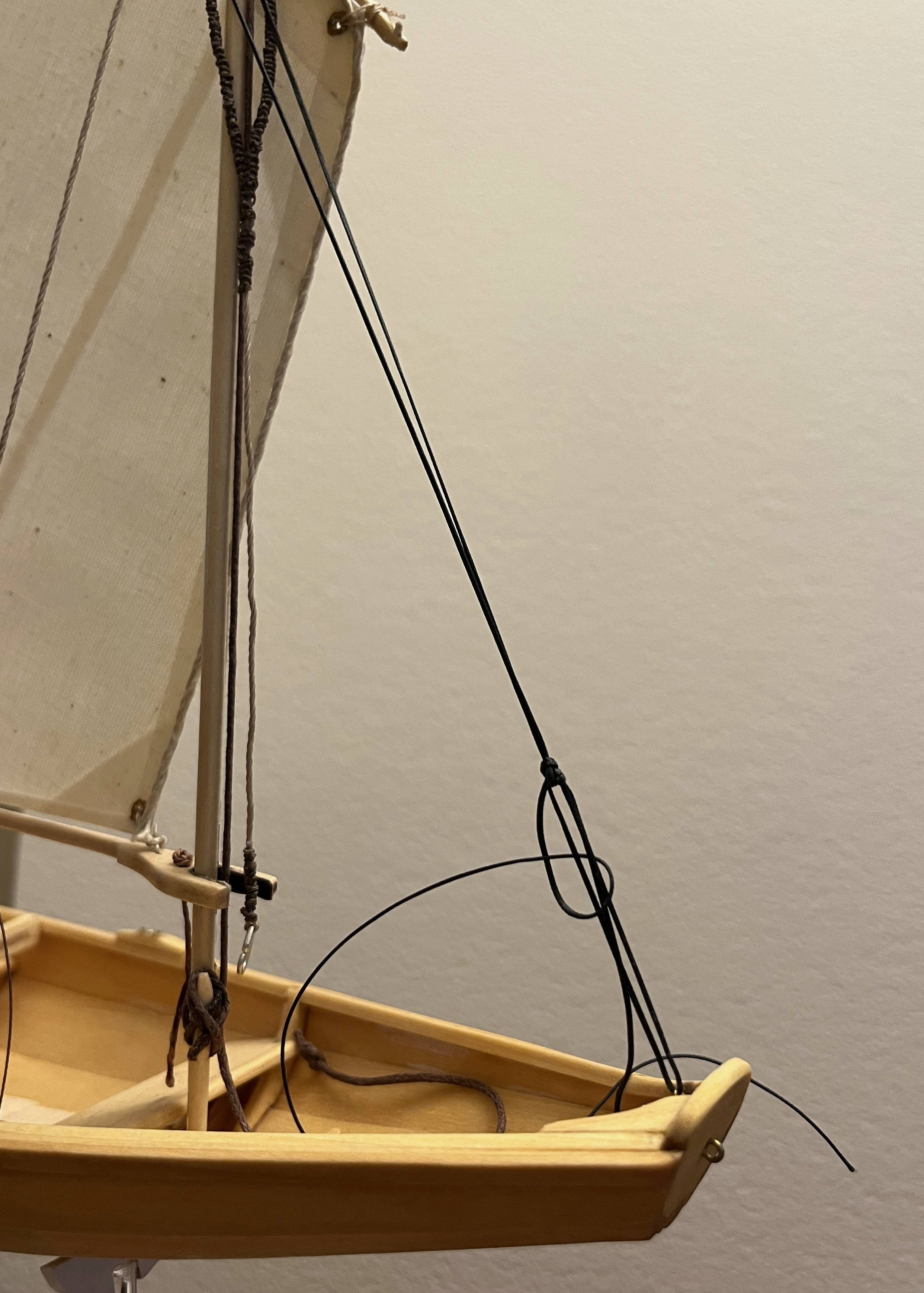

Since my last progress report, I have finished the pram's standing rigging but the result is far less than "satisfactory". I have got the detailing quite nice but the overall effect is way off. And that's a stupid mistake to make.
I thought I had figured out a solution to the challenges but it hasn't worked, so I'll explain what I have done -- not so that others can follow my path but as a warning, in the hope that the next builder of the kit may succeed where I failed.
With mast, sail and one end of each piece of standing rigging prepared, the first task was to get the mast temporarily stepped, so that I could measure the required lengths. Playing that game with a 20ft mast of solid pine (!), I attach the shrouds loosely, then get the mast up while maintaining tension on the forestay, finally adjusting and tensioning everything. I figured a similar approach would do. So I caught the ends of the shrouds under a rubber band, stepped the mast and clipped the forestay around the mast and over its cleat. Then clipped the sail more or less in place and adjusted everything until I was happy with the result:
The forestay largely sets the rake of the mast (though pulling in opposition to the shrouds) but the shrouds alone determine any tilt to port or starboard. I figured (1) that I could live with more error in the rake than with any tilt, and (2) getting the shrouds both equal to one another and the right length to set tension in the rigging once the forestay was finalized was too much. So the sequence was one shroud to the right length for the desired rake, then the other to exactly match, and only then the forestay made to the length needed for reasonable tension. So I moved one shroud from its rubber band to its chainplate and marked there.
So far so good, then the trouble started. The forestay had fed through the hole in its hook without trouble, so I figured the shroud would too. Wrong! In fighting with it, I pulled on the end when only two strands were through the hole, wrecking the line. Smoothed that down but the mark was lost. Got everything together and went back to the model to re-check lengths but with less care than in the above image. "Spliced" and "served" the end of the shroud. Then carefully matched the length of the second shroud and attached that to its hook too. So proudly returned the rig to the model ... only to see:
Way too much forward rake! That will completely ruin the appearance of the finished model. Nothing to be done, however. Attempting to cut away that rigging and start over would only make things worse. I still don't know what went wrong. Maybe the shroud slipped slightly before I got it glued. Nor do I know how to avoid the same problem another time, if I did do it over (which I won't).
So ... Put that down to a learning experience and persevere with the forestay.
With that hooked in place at the bow transom knee and looped around the mast, passing over its cleat. I marked where I wanted the glue "splice" to fall. I went for a very large loop (1) because I could , (2) because I feared that I might have to slip the finished loop up the mast, passing over both (horned) cleats near the foot, but also (3) because I realized that the halliard needs to pass through the forestay loop. The instructions don't have that but it ought to be done on a full-size boat of the pram's design, so on a model too.
Most dinghies have forestay and shrouds meeting the mast together, at the "hounds", often with a jib halliard just below. If the mainsail is Bermudan, it will rise higher but its halliard will likely run down inside a hollow mast. Or else the belaying point of the halliard may be offset to one side or the other. The pram has the halliard sheave very near the masthead and the halliard cleat on the centreline of the mast. The yard hangs below the shrouds (and far enough below that it can swing freely from side to side, when the sheet is eased) but the forestay is (oddly) set much lower still, presumably so that the forward end of the yard does not get caught between mast and forestay. Yet that leaves the forestay and the halliard cutting across one another (on the centreline of the mast), leading to friction, wear and failure.
Simple solution: Lengthen the forestay loop and reave the halliard through it.
With the marks made, I removed the forestay from the model and "served" the whole of the loop -- as I would in full-size to prevent wear of the stay against the mast. Then I re-assembled everything, glued the "splice" with the forestay in place, such that I could control the tension in the rig, and even "served" over that "splice" with the mast stepped and rigged:
That much went well, even if the "serving" is too lumpy. However, even perfection in the forestay could not resolve the excess length of the shrouds:
It won't look quite as bad once the boom is rigged and the tack of the sail brought abaft the mast. But a huge disappointment all the same 😭

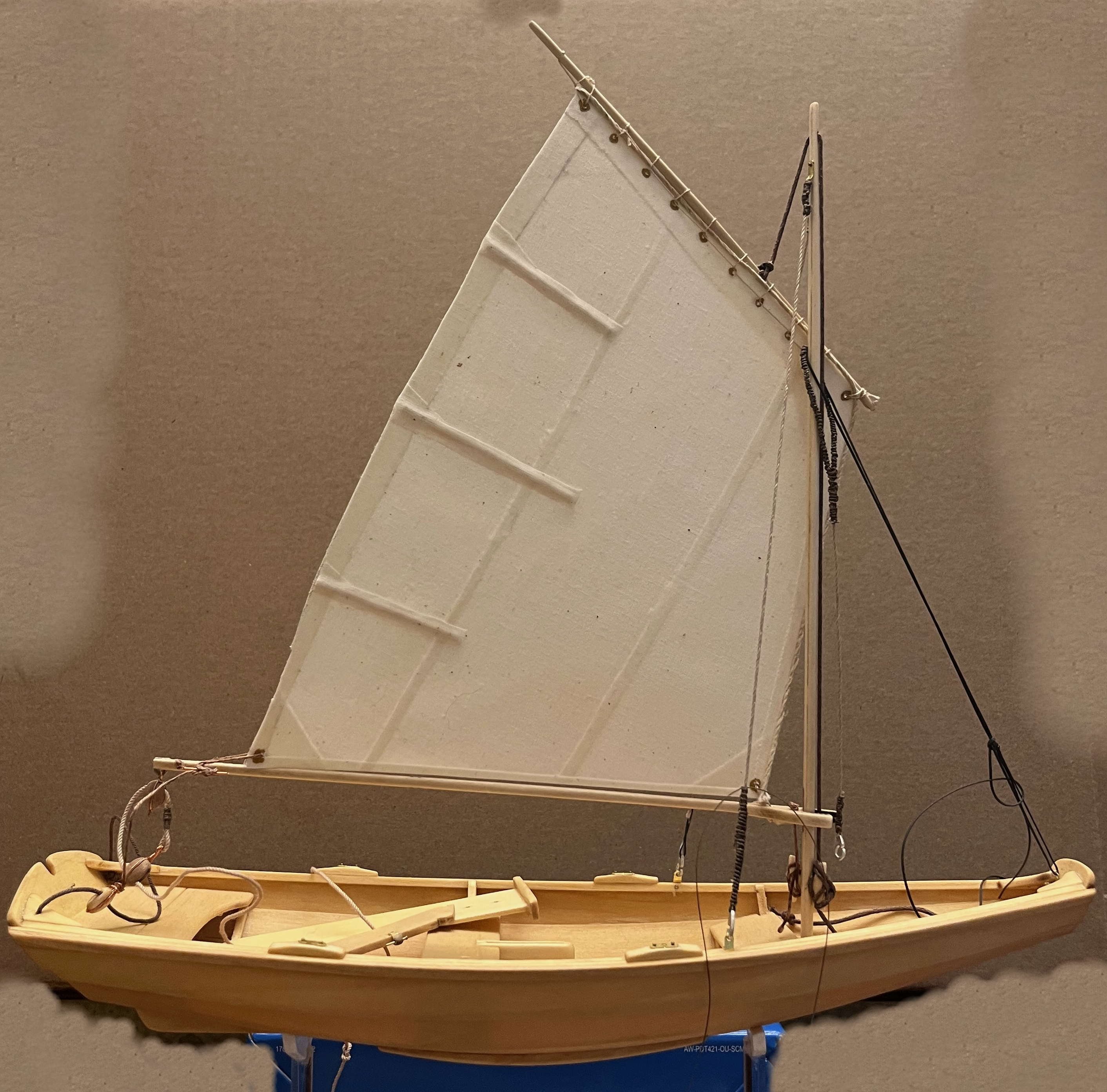

I'm not yet ready to belay the halliard, nor the tack downhaul, but the pram looks about ready to sail away anyway:
Maybe next time I'll carry her down to the shore and get a more maritime background 😀
Tiller still to be worked on, of course.
Trevor
Thank you for the "wow", King Derelict! Not sure that is deserved but it's welcome all the same!

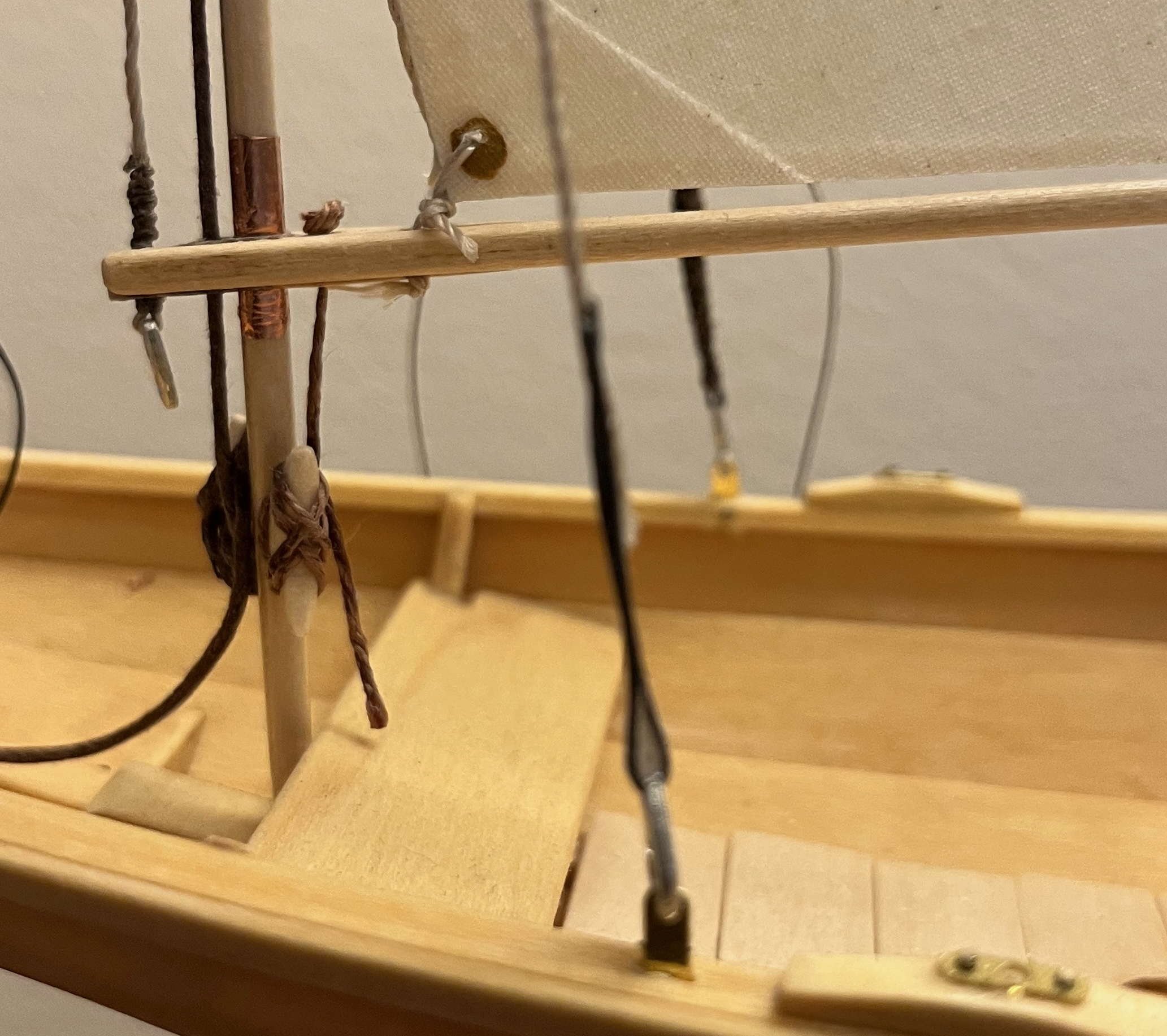

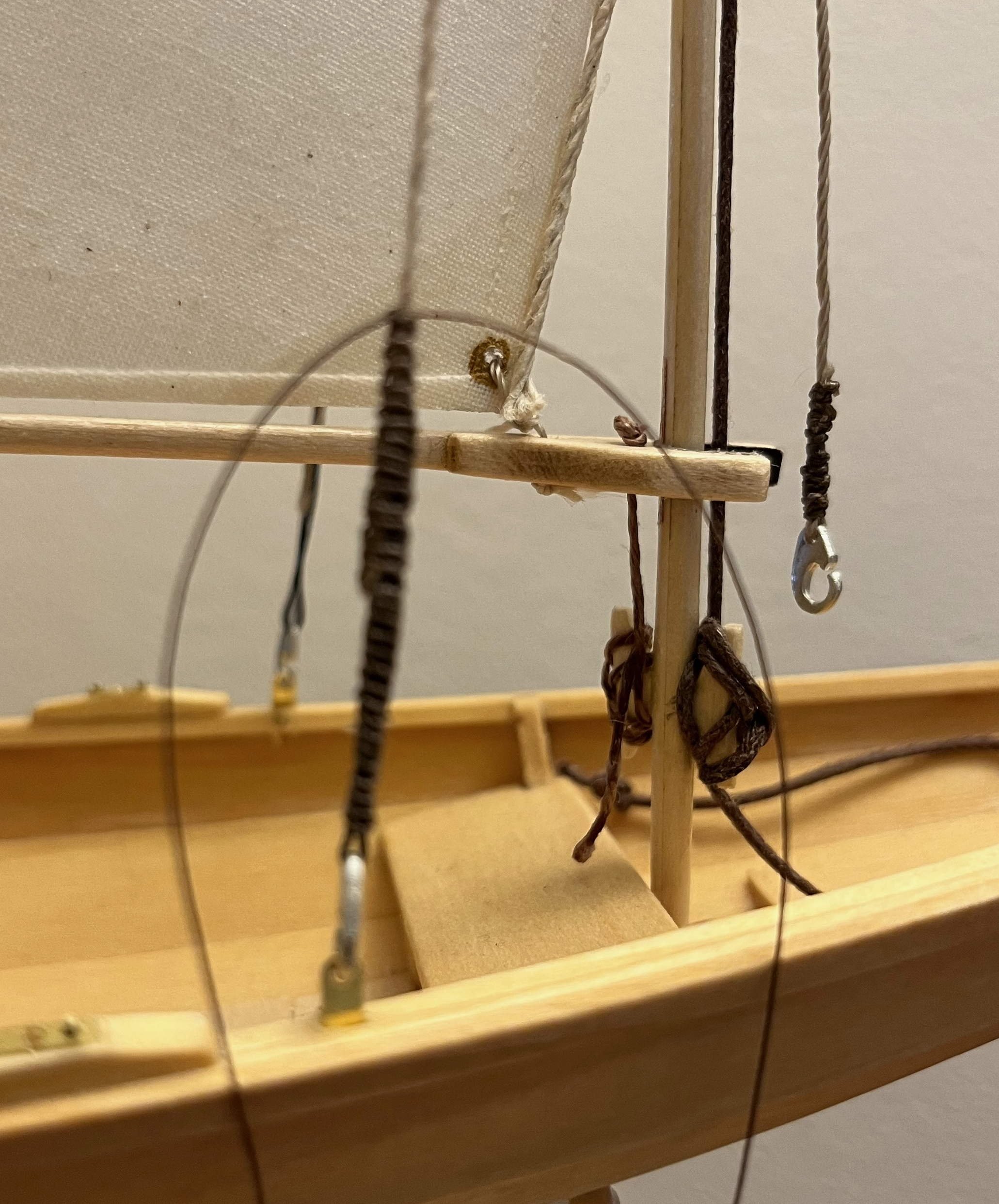

Six months gone since I last made any progress on my pram. Like others, I have been caught up in a whole mess of tasks (some rewarding, others less so) that have drawn me away from ship models -- from model building, though they have not stopped me being an annoying know-it-all on MSW!
Back in April, I had come to accept the forward rake of my pram's mast and finally stuck when my attempts to produce the sort of tiller that I think the boat deserves proved more demanding than I had expected. However, staring at the model all through the summer, I decided that the rake had to be adjusted and that that would be an easier route back to re-starting work on the pram. So ...
I still think it is best to get both shrouds the same length, hence the mast upright when seen from ahead or astern, then worry over tension in the rigging while finalizing the forestay. But it is clear that the rake has to be set approximately before starting on the shrouds. So I began by unhooking the existing forestay and rigged a length of thread in its place, adjusting that until I got the rake I wanted:
Next, I cut away one shroud where it passed around its hook, at the chainplate in the rail. I cut away the "serving" (which I had faked with a length of Westcountry whipping) and "spliced" on a length of thread by gluing it to the cut end of the shroud with CA. Passed the thread through the eye in the hook, pulled until the mast was upright (port to starboard) and glued the other end of the thread back to the shroud:
(Phone camera decided to focus that one on the mast, not the nearer shroud, but you can see the repair.)
Next up, repeated that with the second shroud -- judging the mast upright by eye, though it proved to be as close as made no difference when I later checked with a small square laid across the rails. I have hidden the mess of glued ("spliced") ends with a lengthened "serving", though that's awaiting a touch of CA before I clip the ends of the serving thread:
Again, the focus is off and the "serving" is lumpy where it passes over cut ends. Still, I now have the mast in a far preferable position:
Still have to "serve" the port shroud, then make a similar adjustment to the length of the forestay. The mainsheet and the rope sheet horse will need adjustment ti suit the lower position of the boom end, but that shouldn't pose problems.
