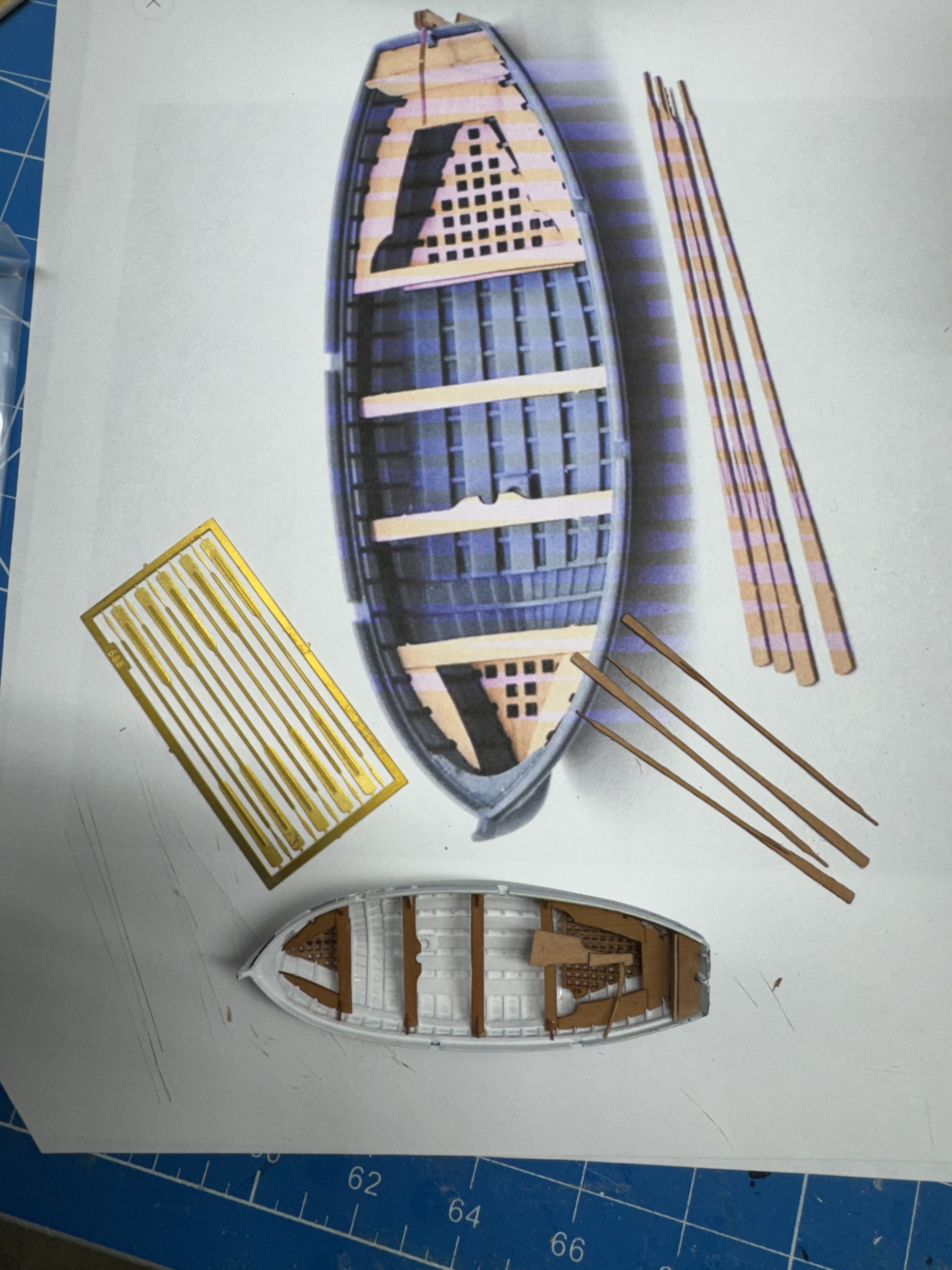

Hull is back in the paint booth so I decided to detail the lifeboat. I got the outside painted during the hull's late paint booth tour.
As I mentioned before this is the 1/64th scale 18' cutter from Vanguard which is an almost exact match at least in length with what is shown on the Simpson drawings as the "lifeboat".
Here is the more or less completed lifeboat positioned on one of the pages in the vanguard online instructions. I am going to add an ocre strip at the top of the gunnels on the outside as the white spra paint failed to cover that very well and the boat needs a bit of color.
The boat kit includes four oars but they are so tender I am afraid to do anything with them but maybe paint and even that might be a struggle. I did find a set of brass oars (Amati) which are the exact size so I will use them once i get them cleaned and painted. Probably no more than four as there are only four openings in the gunnel for oars. And I am reluctant to believe that the Simpson carried the boat in the stern davits with the rudder "hanging in the breeze". Rudders are to critical to operating the boat to risk it being carried away or damaged by a rouge wave. I am going to paint the lower portion of the rudder white but leave it in the boat once it is in the davits.

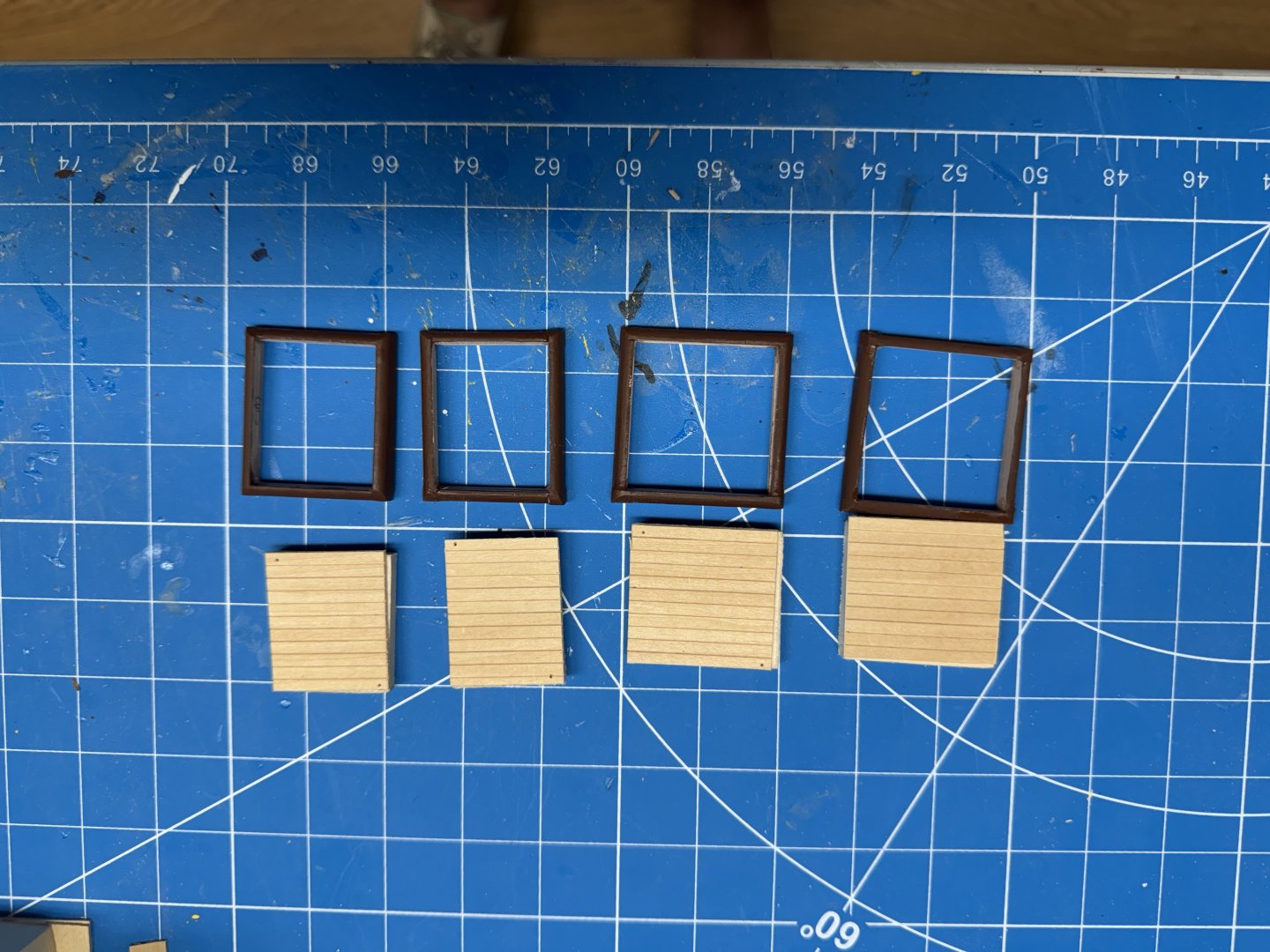

The four hatches are complete except for painting of the covers and adding eyebolts and rings so there is a way to lift them besides "Swedish steam".
The hatch covers are 1/8" deck planking from Northeastern Lumber Supply. Sadly I had to buy a whole sheet but used less than 25%, even having to do two of them twice.
Hatch coamings are painted Vallejo Flat Brown (70-984) and they probably need another coat which they will get when the hatch covers get their gray. I have several shades of gray coming later this week so there will be no hurry to get them painted. Whatever gray goes on the hatch covers will also go on the deckhouse roof and the forecastle hatch roof both of which will be made from ship deck planking. I just can't abide solid pieces of wood several feet across.

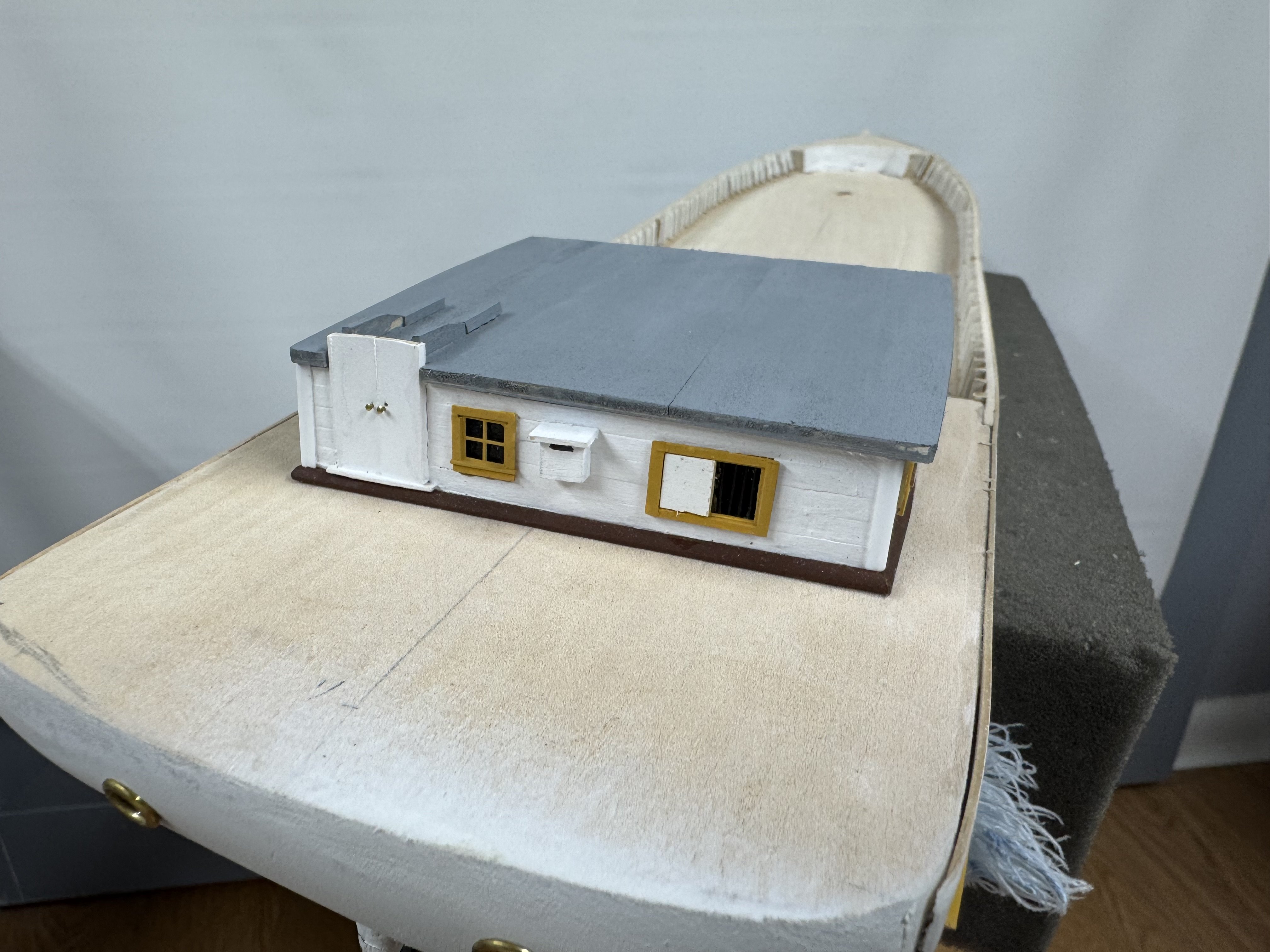

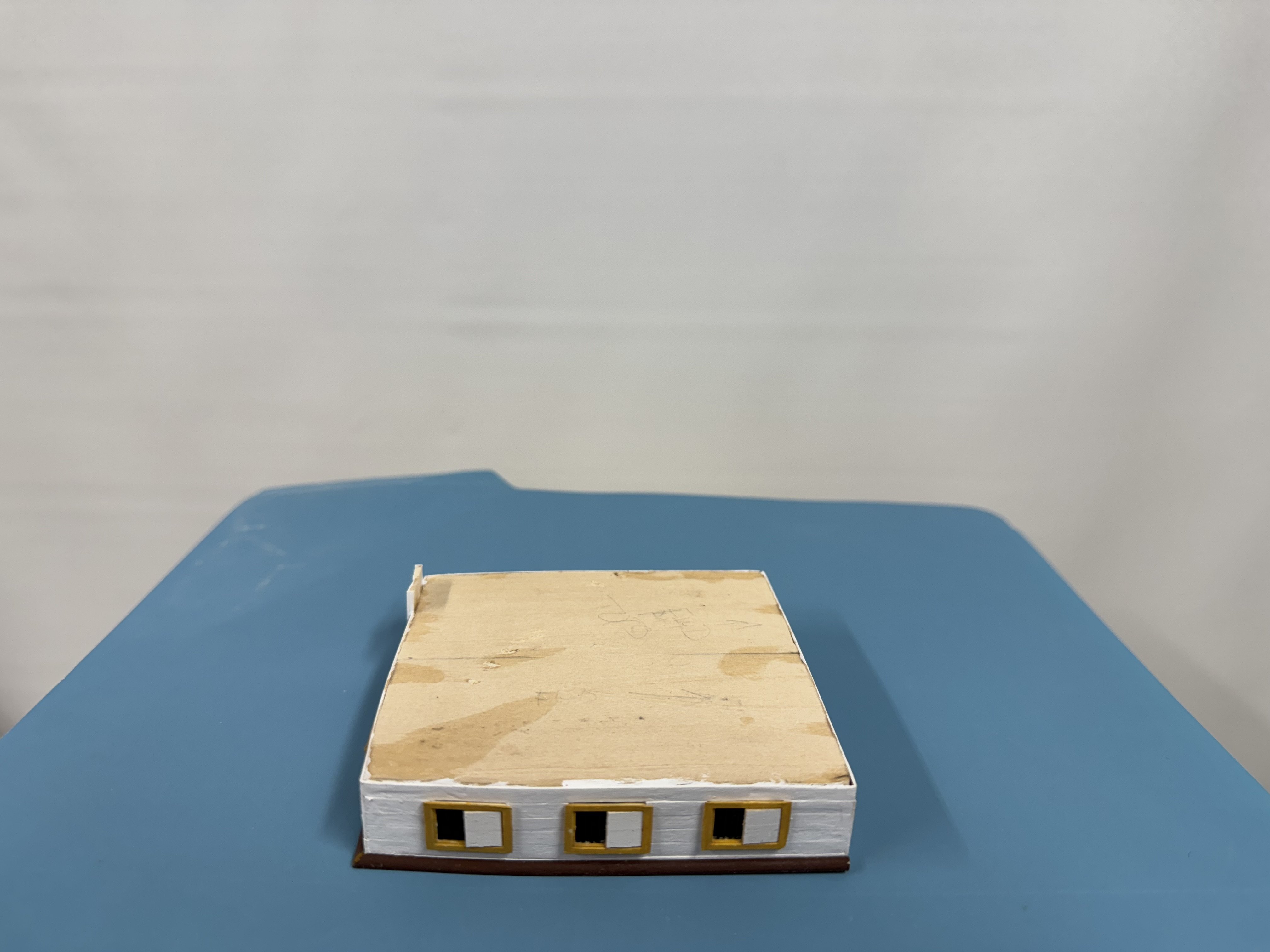

Aft deckhouse is done except for the roof which is awaiting some grey paint due here Wednesday or Thursday.
I cropped these to look better but the site refuses to upload the edited version so...
Also thew binnacle box needed another coat of paint so it is not yet on the aft side.

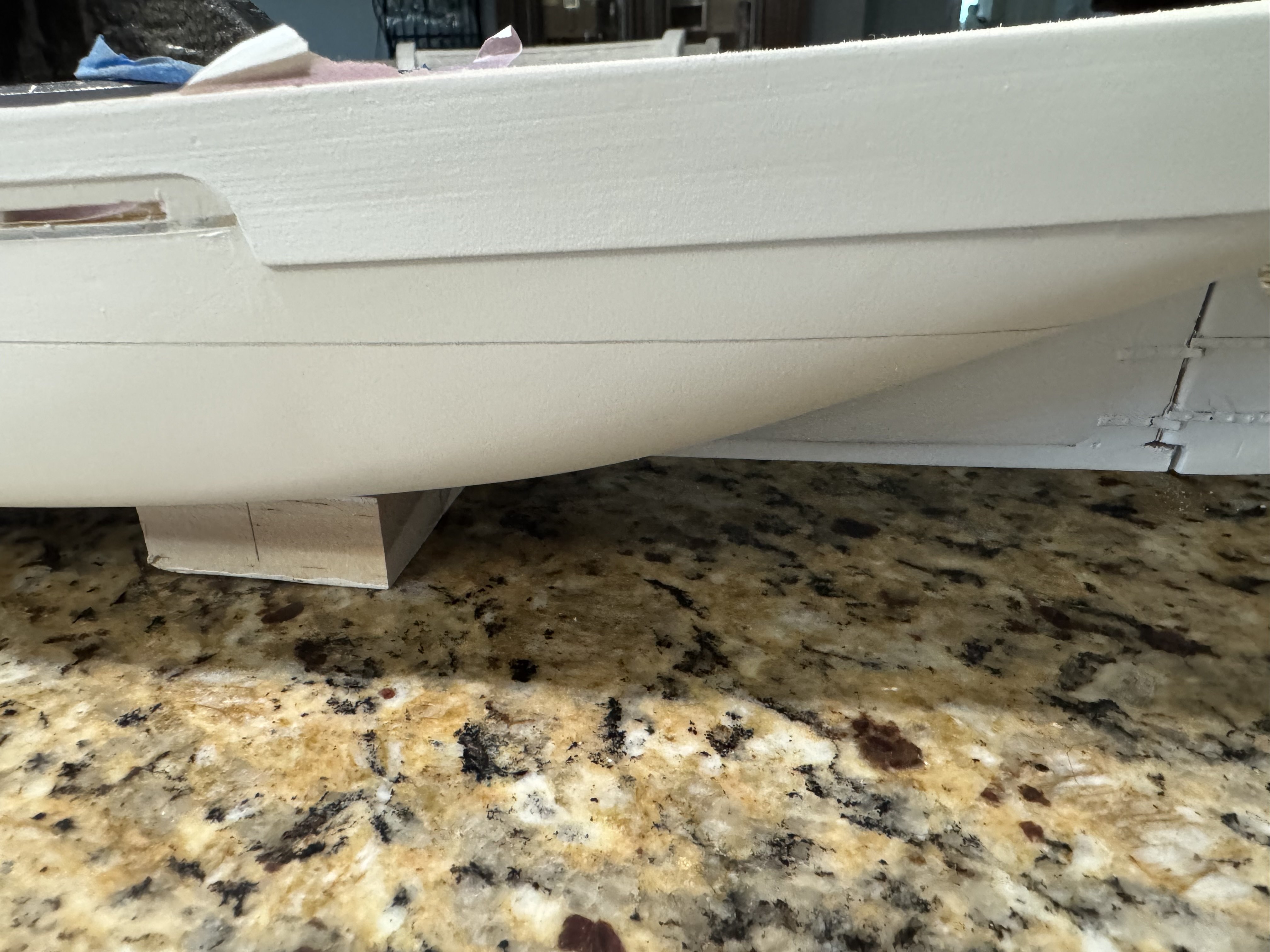

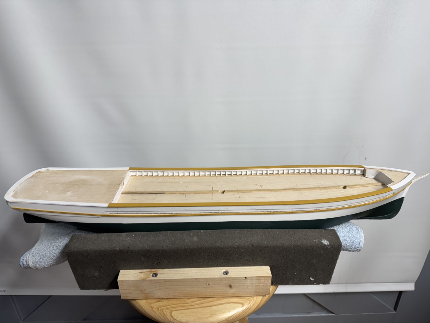

I added the molding stripe to the hull now that the painting is done.
The instructions call for a 1/16" X 1/16" strip from bow to station 91/2. I found this less than satisfying.
So I created a 2mm X 2mm piece of boxwood and used a molding cutter to form a "U" shape into the wood. I painted it ocre and glue it on but stopped at the overlay stripe at the stern. Had I looked more closely I would have seen that the overlay stripe was not supposed to extend as far down the hull as mine does but IMHO I think this looks "okay".
Here is a closer look at the molding stripe
The holes were from the pins I used to hold the strip ion place while the glue dried. I think a dot of paint will cover them.I am considering painting the cap rail the same ocre as the molding stripe but that decision is a ways off yet. The paint job does not look all that good this close, so I plan on having this model on the top shelf where it is hard to get really close.

After I looked at it enough I came to the conclusion that having the molding stripe stop at station 8 just was not going to work.
So I created another 2mm X 2mm piece of boxwood and ran it through the same molding cutter I used for the first piece. Then I went back to the thickness sander and (making sure I kept the flat side against the sandpaper) thinned the piece down until it was just over 1mm thick. Doing this was to avoid an abrupt change in thickness at the junction.
I think this looks much better IMHO.

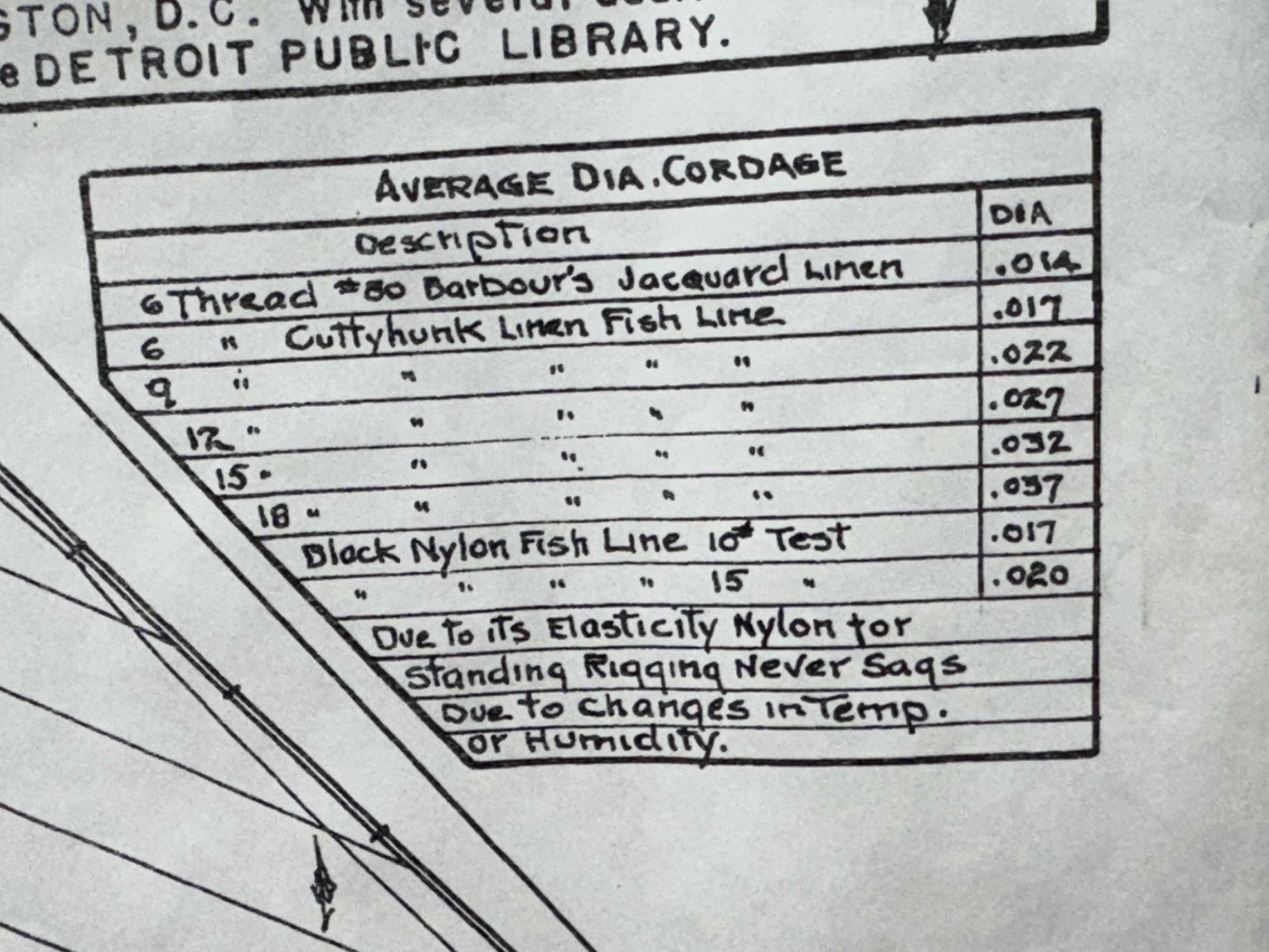

Considering the rigging to come.
I started a spreadsheet of all the standing and running rigging needed and found the rigging drawing somewhat confusing. Yesterday I discovered on sheet 3 (of 3) there is a drawing showing how the throat and peak halyards (one of each on all three masts) are supposed to be rigged.
This drawing answered one of the questions I had about the throat halyard (raises the gaff to spread out the fore, main and mizzen sails attached to the respective booms). On the rigging drawing (sheet 2) it shows there is a triple block at the top of the throat halyard tackle. Try as I might I could not figure out how that would work and all of the reference material I have was. no help.
From the ships I have built it was common practice to have the "jig" end as referred to in the drawing (I would call this the standing end but...) terminated at a becket on the upper block of a throat halyard. Not so on the Simpson - the jig end and the tackle on the hauling end terminate at the pin rail and thus you need a triple block at the top. Unfortunately I did not have any 4mm triples so I ordered some from Model Expo. I have plenty to do before I need them but I feel much better having solved what was to me a mystery.

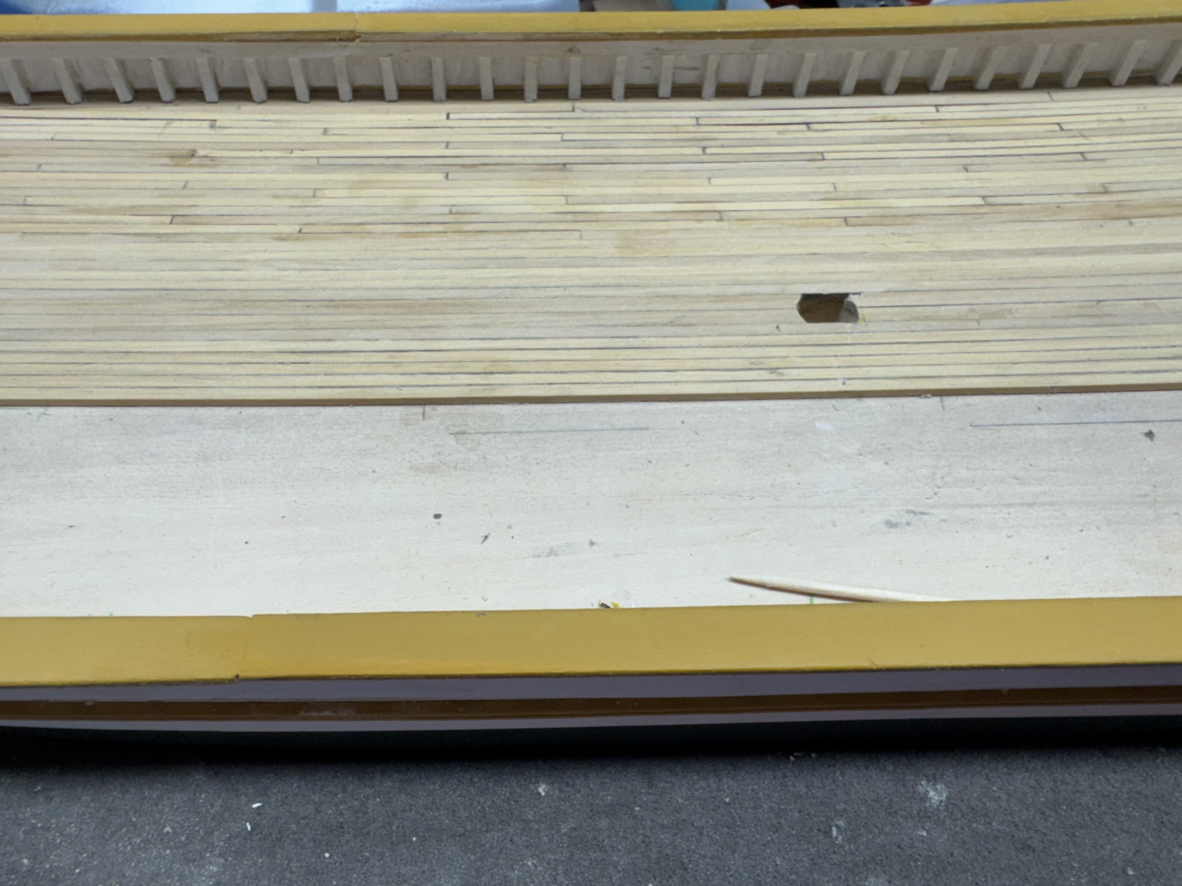

The grey paint arrived today and first up was to paint the deckhouse roof. As seen here it does not yet have the sliding cover in place as there was a minor issue after it was painted.
Also of note is I got all the timberhaeds installed and sanded down flush with the bulwark. Next step is to paint the inside bulwark, plank the area below the aft deckhouse leaving an opening where the forward facing door will go when the deckhouse is truly installed. Hatch and smoke stack will also go on during actual deckhouse installation

Nine pieces of the deck furniture are complete (more or less for the deckhouse) and headed for the "To Be Installed Later" storage bin.
Thanks,
Gary
Current Build - Rainbow 1934
Prior Builds:  Lucia A. Simpson (Great Lakes Schooner 1875)
                       HMS Sphinx
                       HMS Winchelsea
                       USF Confederacy
Nice work! Interesting overhang on the front of the deckhouse roof.
Thanks Jacques.
Even more interesting (to me) is that the entire deckhouse is racked aft 5 degrees according to the drawing. I made no attempt to model this as the forward portion is partially the machines hull.
I doubt anyone will notice.

While reading through the instructions for the third time I noticed sort of in passing that the double blocks under the booms are supposed to have a becket for the standing end of the boom sheet lines. No mention of this on the drawing so I got the booms out of the "To Be Installed" box and added a becket to each block.
Having done that I wondered about what size line should be attached as the booms will be lashed down with the furled sails and gaff on top so getting at them to run the line later is unlikely to be successful.
There is a table on the rigging sheet (sheet 2) that purports to cross from the cordage descriptions in the rigging table (#40 Linen for example) to diameters.
Unfortunately the description in the table and the running rigging table do not correspond (the rigging table uses numbers like 30, 40, 100). So just looking at the diameters it looks like the running rigging called out is very "heavy" based on building a number of ships at this scale.
I am going to use the Syren Ultra line for this build (I have a bunch of it) and I have never dealt with nylon fishing line - monofilament but not nylon. The question is what sizes to use.
The standing rigging table gives diameters so that is easy - just pick the Syren size closest to what is in the table.
For the running rigging (even though the kit only has two sizes of tan line which are approximately .009" and .014" in diameter) the major hauling parts .018", the minor hauling parts and the tackles supporting the major hauling parts .012 and for downhauls and other minor lines the .008.
I am going to use the .012' for the booms and attach the line before the booms go aboard.

I got the cap rail completed on both sides - now on to the main deck planking.
In case anyone is wondering the two-tone paint job on the cap rail is because I want the upper rail to be ocre not white. Since there are rails above the cap rail at the bow and stern I chose to paint those portions of the cap rail white and will use ocre on the stern top rail and bow splash rail so there will be a continuous "ocre line"when viewed from above.
The pencil lines are approximately where the hatches will go. It appears there will be six or seven rows of planks on either side of the king planks before I have to start worrying about plank length and stagger.

Half the deck (actually a little more) is finished but still needs a good sanding and a few coats of WoP.
I started with the 1/8" wide king planks on each side of the centerline.
The boxwood material I bought (from Modeler's Sawmill) is 3/32" X 14" long so it would not reach all the way from bow to stern on the main deck. Since much of the centerline area is covered by hatch covers I saw no reason to worry about plank length of sequencing until I reached the outer limits of what the hatches will cover.
So I laid down six rows of the 14" lengths on either side of the king planks. And then filled in the area left open to the stern. I did not try and keep the planks continuous since the joint area is covered by the "small" hatch.
Outside that area I choose 4" plank length (~22' at scale) and a four drop sequence of plank ends If I had it to do over again I would choose a somewhat shorter plank length as my Byrnes table saw cannot cut something 4' long without removing the rip fence which I am loath to do. In the end I cut each piece as it went on the hull anyway so having pre-cut lengths turned out to really be required.
I thought (briefly) about adding another 1/8" wide plank at the outer edge and using that as a nibbling plank but in the end just went with sharp points on the outboard planks. I have not tried a nibbling strake on a solid hull before but remember that it was quite a chore cutting into the nibbling strake on a plank on bulkhead model when the area that required nibbling was on a bulkhead. Here EVERY nibble would be over a solid surface. Maybe if I could figure out a way to not get the nibbling strake glued down except on the very outer edge. In the end I chose the "easy" way.
When I got to the outer edge it turned out I needed the extra 1/8" wide strake anyway since the 3/32 would have left a very narrow gasp so having the extra 1/8" pieces really worked out.
