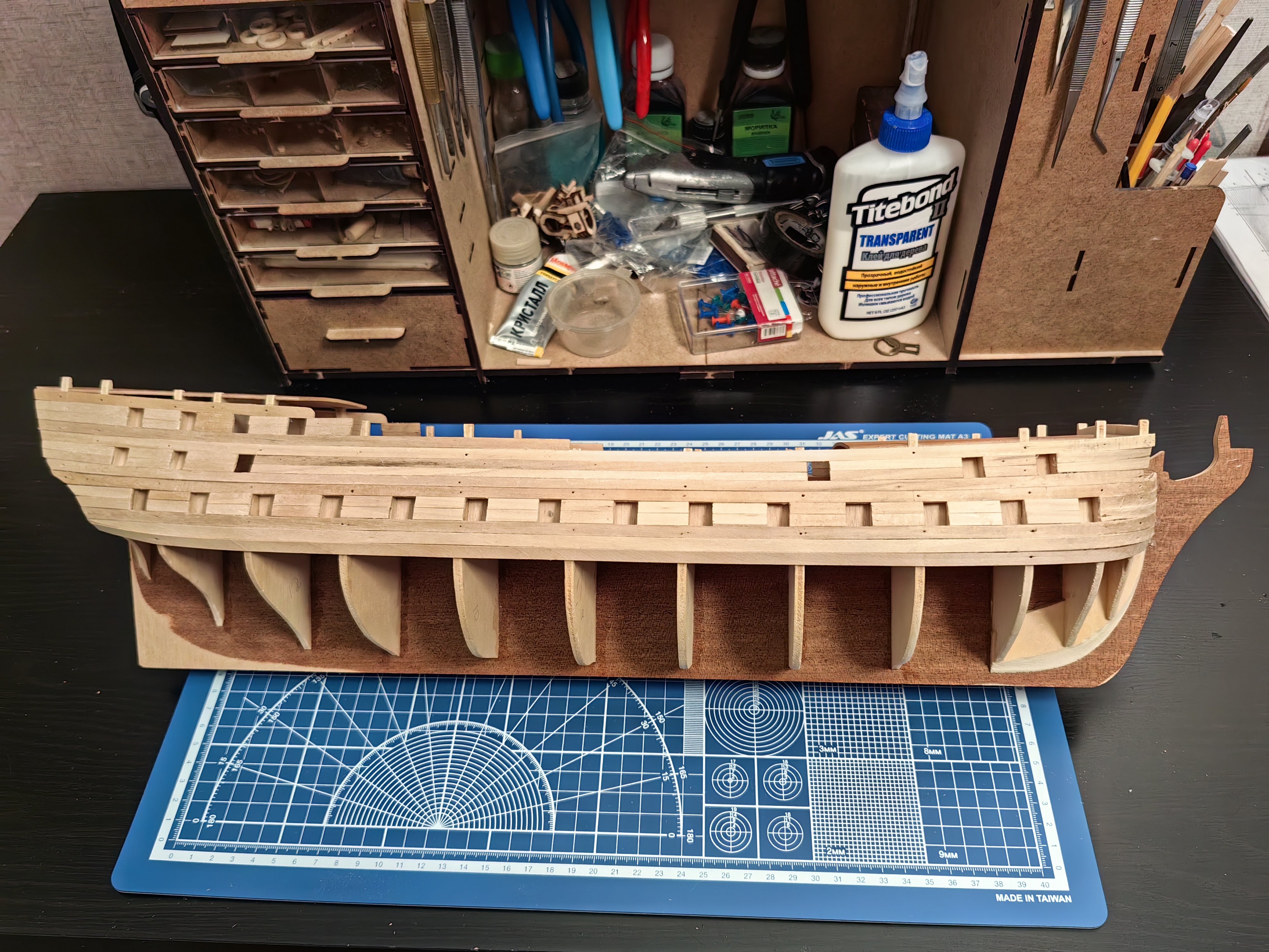

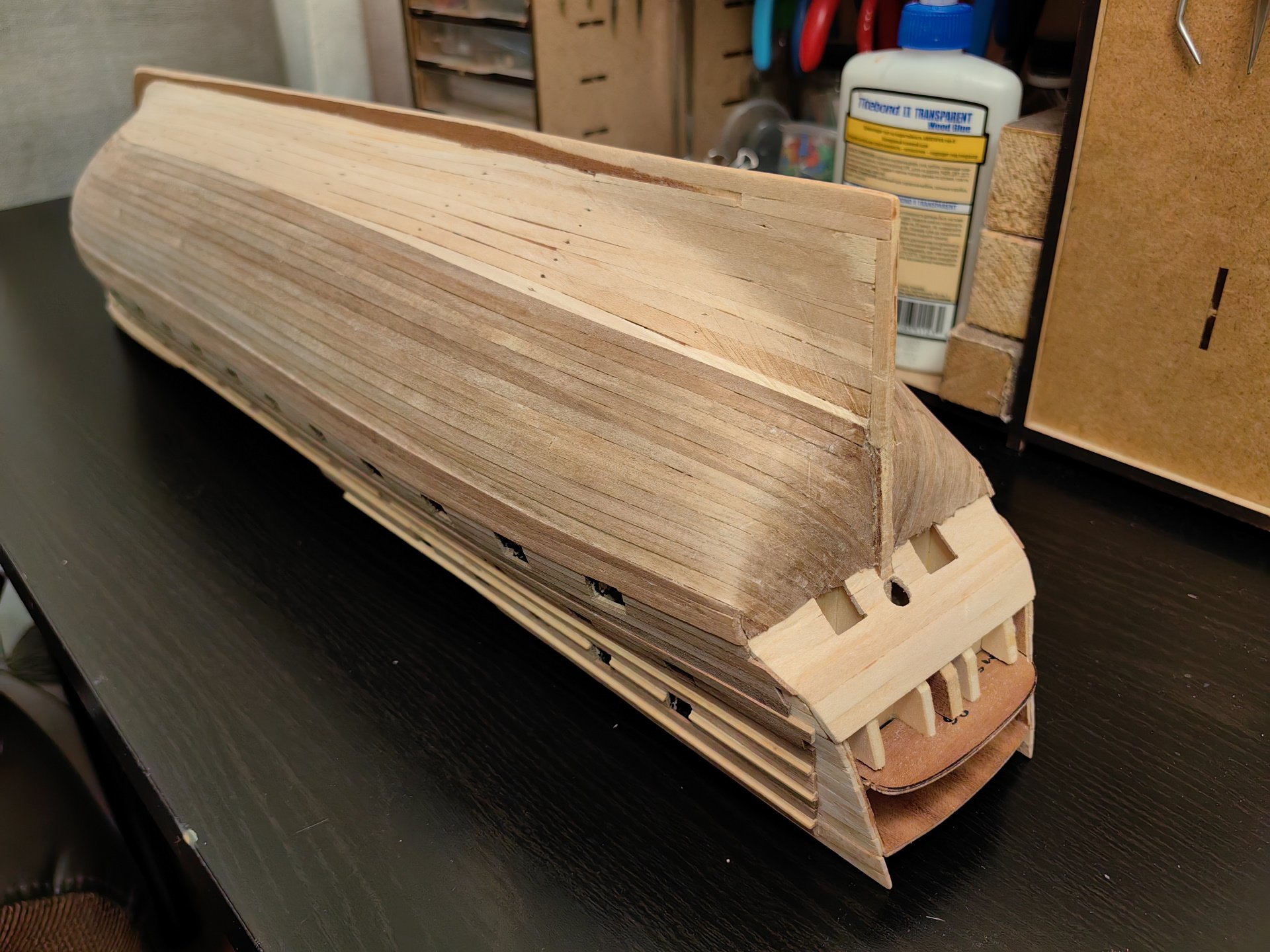

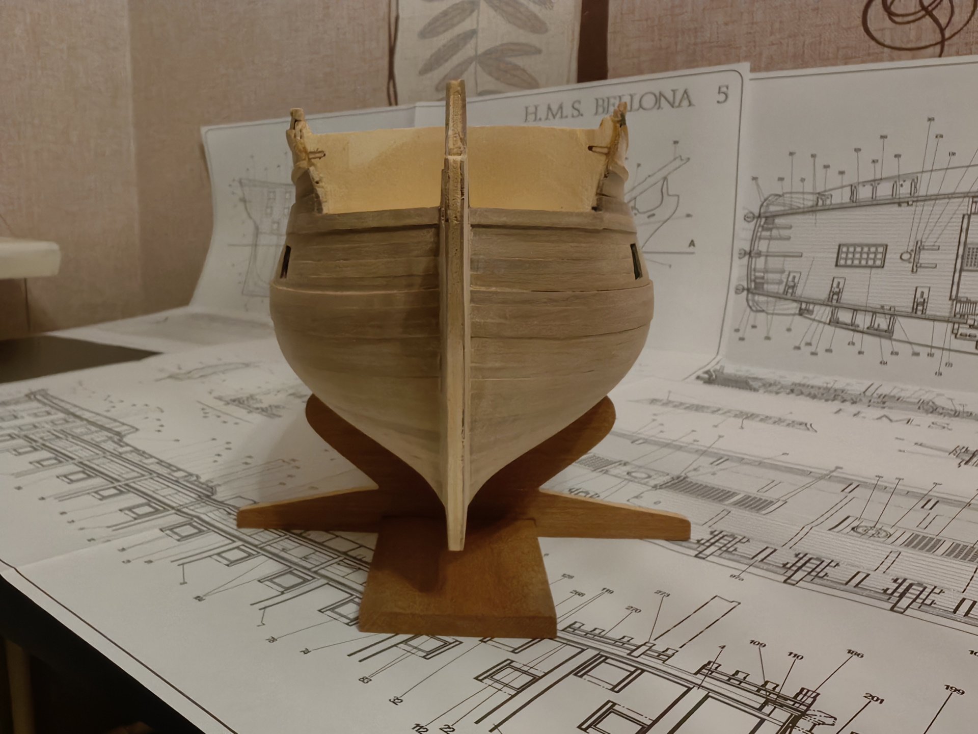

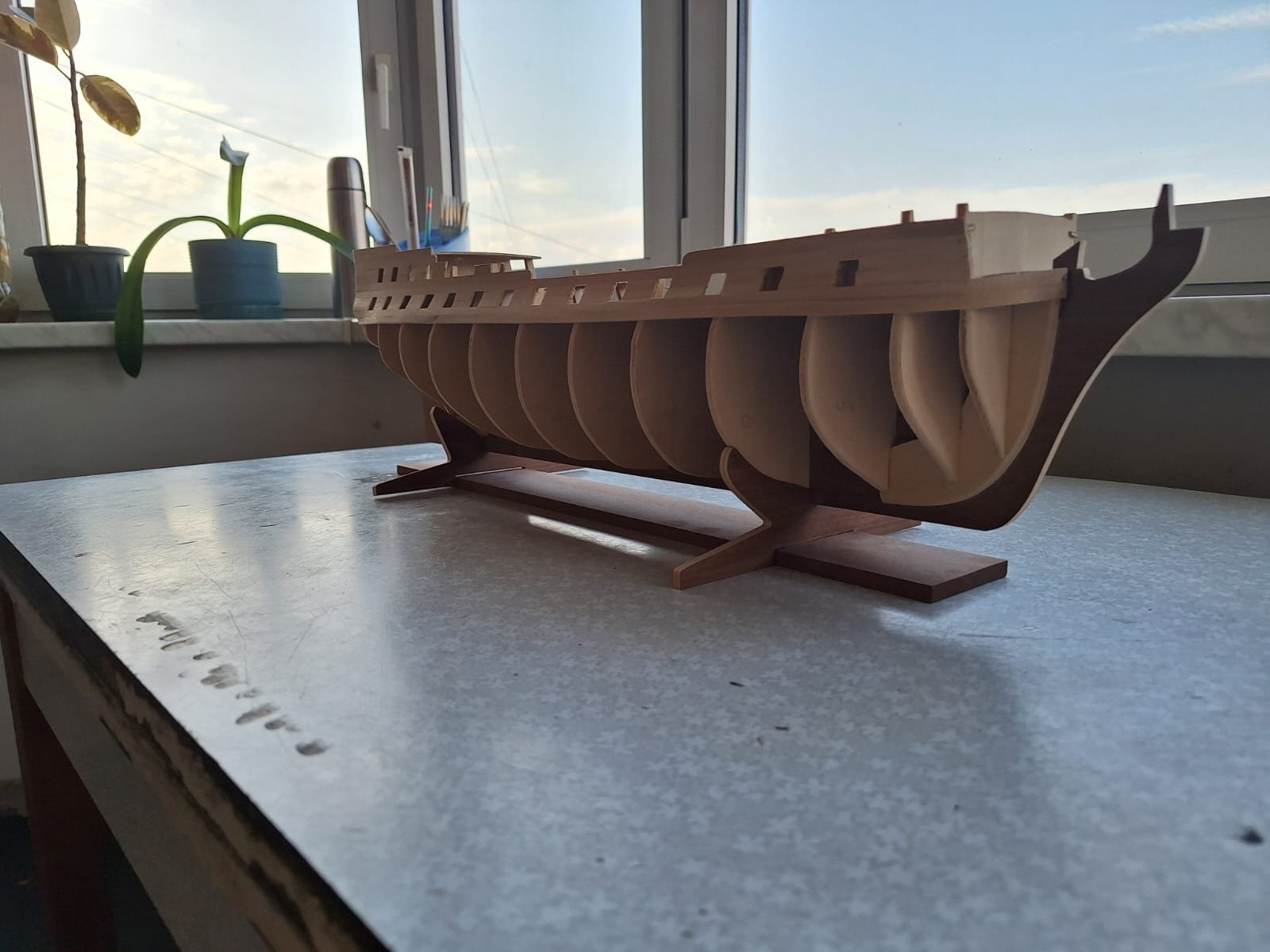

Hello everyone I bought a Bellona set from Corel for the occasion. The previous owner started assembling the ship, but apparently quickly came to the conclusion that it was not just necessary to assemble ready-made parts to make a beautiful model. The enthusiasm ended at the stage of assembling the frame with several slats of the first skin belt glued to it. I am also not an expert in ship modeling. But I have some skills, and I hope that I will build this model anyway. Why Bellona? As I said, on occasion. Specifically, the price turned out to be too attractive compared to the price of the set from the store. Besides, I looked at a lot of options, the sailboats are all beautiful, but for some reason it was the Bellona that caught my eye with its appearance. Having already started to assemble the model, I began to search for information about similar projects on the Internet in various forums. As it turned out, there are quite a lot of them, as well as various information about this ship. Of course, I will use all this information in my work. So, I'm getting started.IMG-20240928-WA0060.thumb.jpg.9ea3839ade6acfc7638dab9d96fdb295.jpgIMG-20240928-WA0066.thumb.jpg.41556004d99a81fa95cc91f5e427c462.jpgIMG-20240928-WA0058.thumb.jpg.c472b469f8ddff6b14bc9114826d4d79.jpg

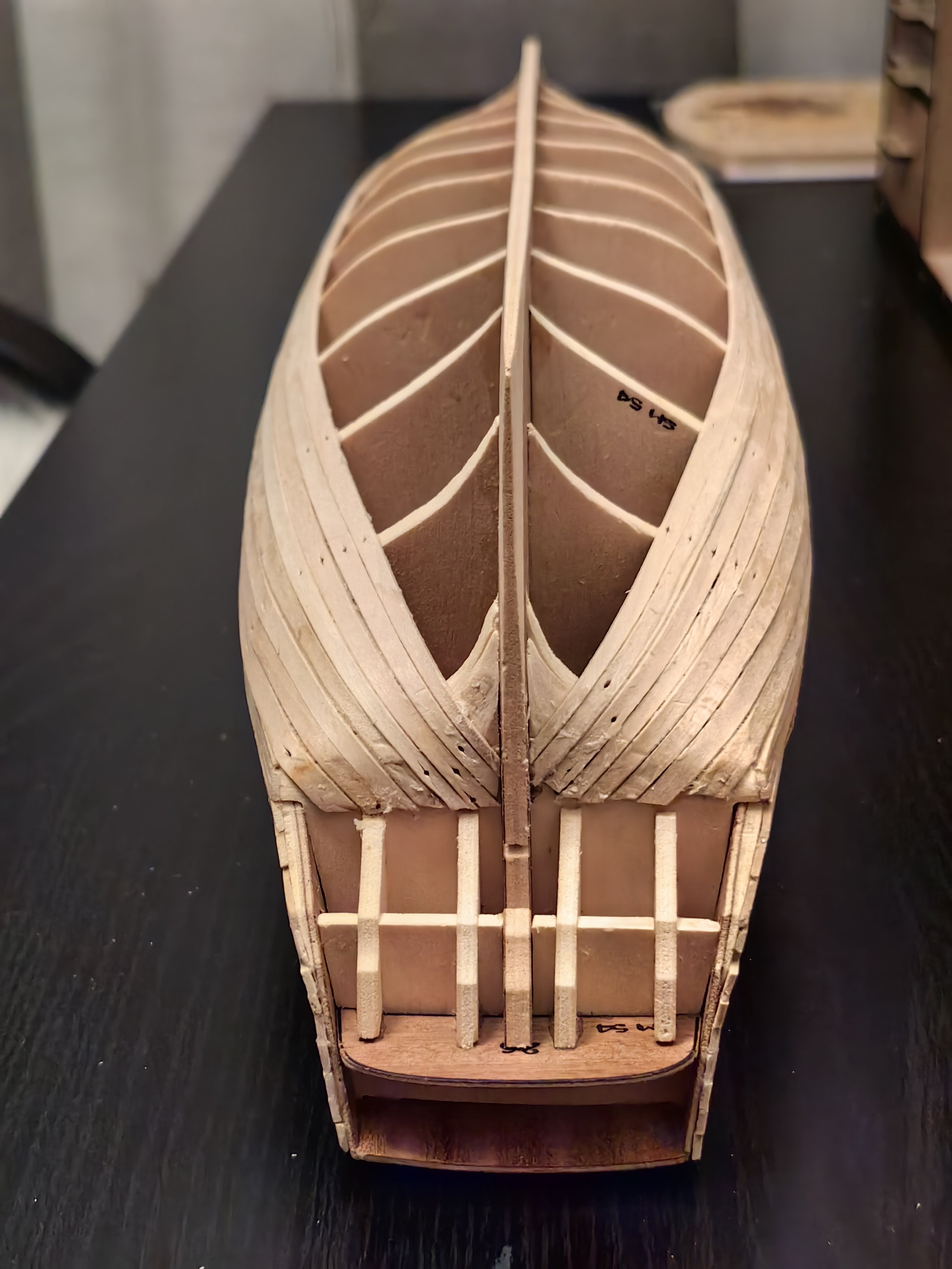

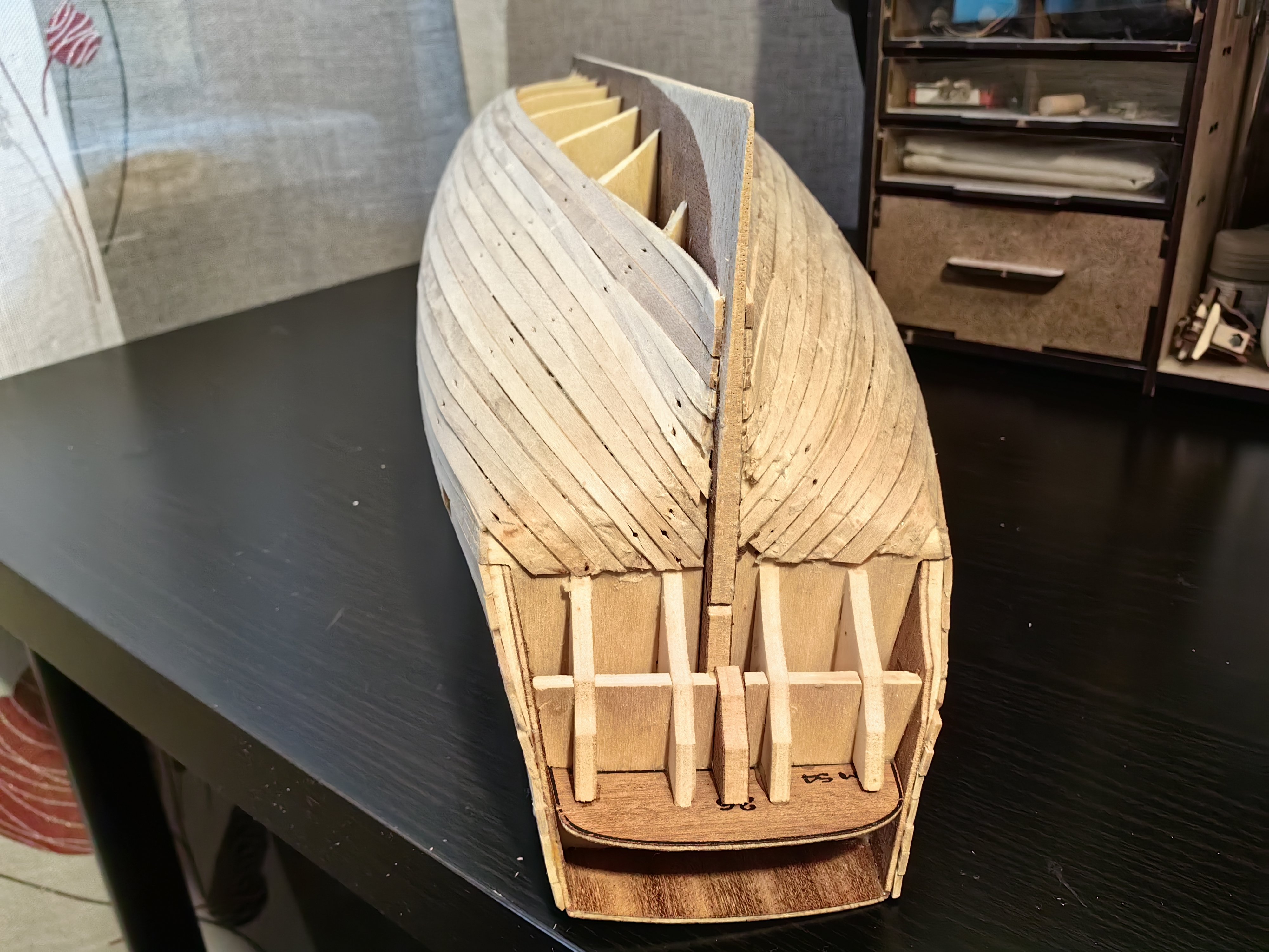

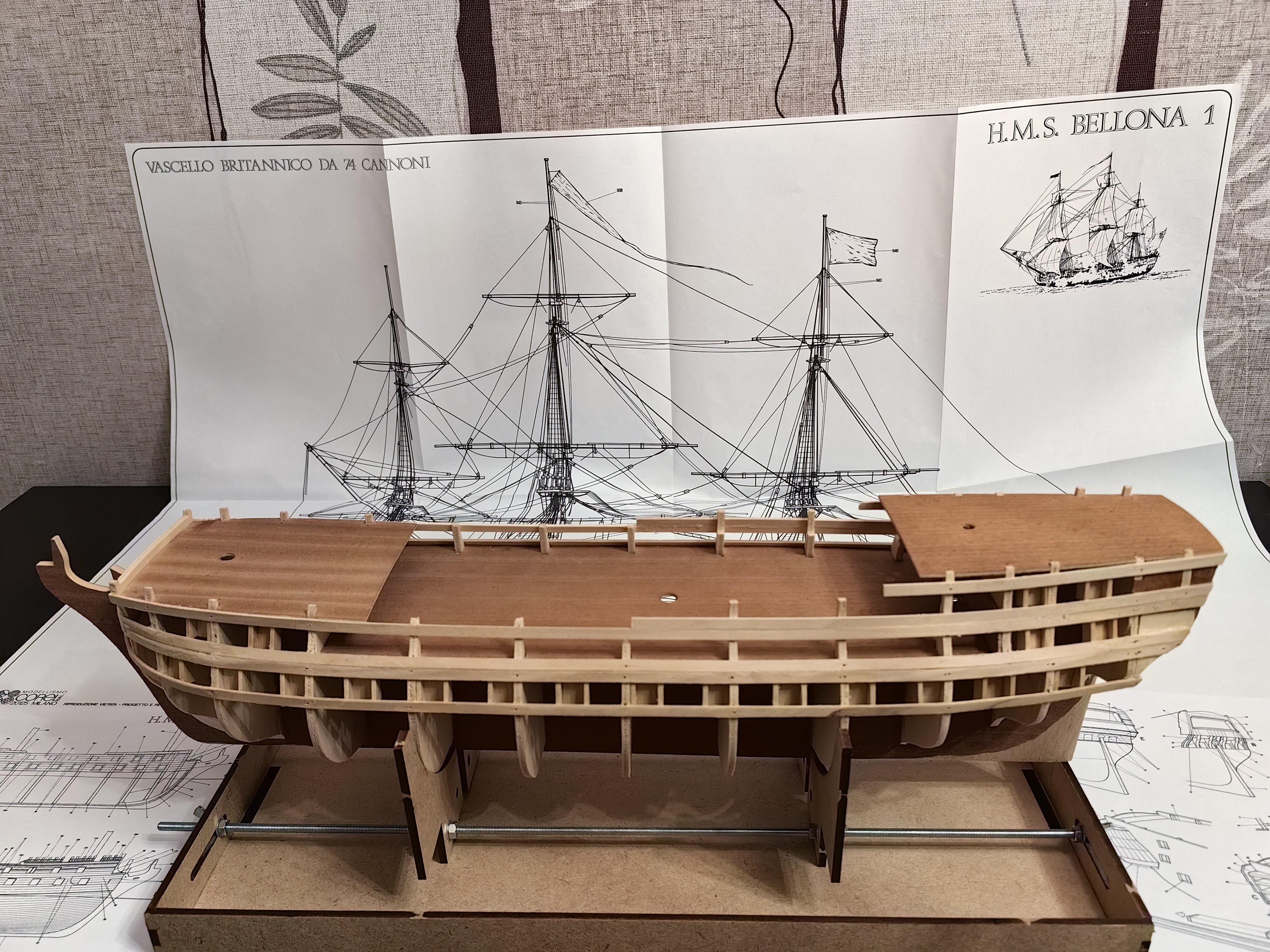

The person from whom I got the model started gluing the first layer of the cladding incorrectly, so I tore off all the slats. I decided not to disassemble the frame, just glued all the joints, removed the small ones where necessary, and started the first layer of cladding again.IMG_20241016_205207.thumb.jpg.f80c7c2093c6af6004d78e141469de7a.jpgIMG_20241016_205506.thumb.jpg.b19817647aefefe109ad59f1b8e3935c.jpgIMG_20241016_205430.thumb.jpg.2fb352318aa866613618cec009119f27.jpg

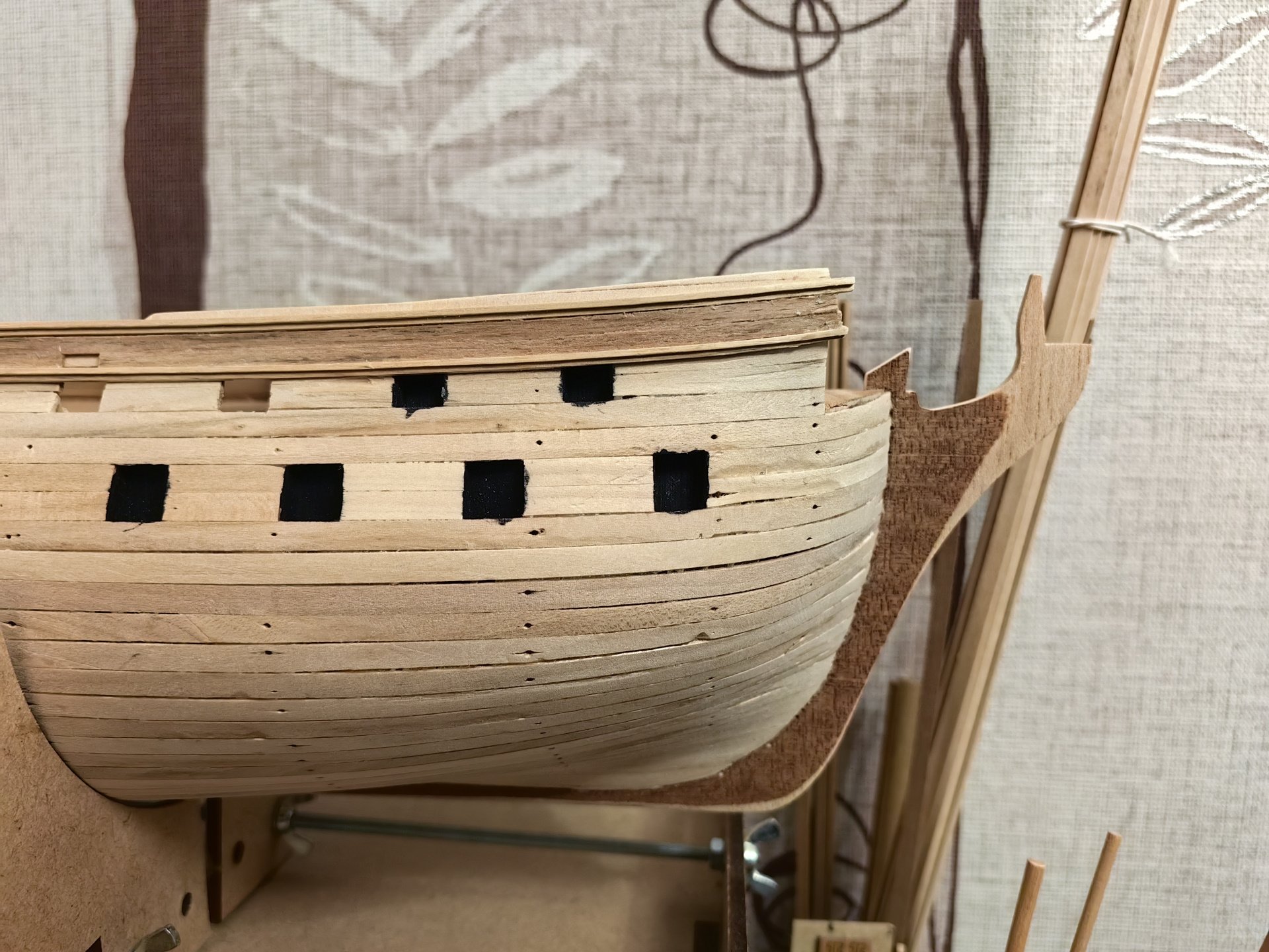

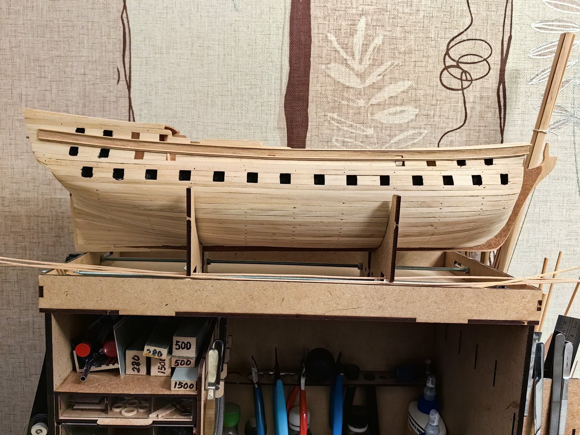

When I started assembling the Bellona model, I studied a lot of material on the history of this ship, as well as the history of the models that are stored in the NMM. In addition, I looked at several options for assembling the Bellona model from different craftsmen, both amateurs and recognized luminaries in this field. Accordingly, I decided on the concept of assembly for myself. I want the model to be aesthetically beautiful. At the same time, somewhere it is possible to sacrifice historical authenticity. To justify this fact, I can put forward the following argument: this ship has had a very long century, during which it has undergone many repairs and its appearance has changed significantly over time. Corel's kit can't provide all the nuances, so I'm going to manufacture many of the parts myself.

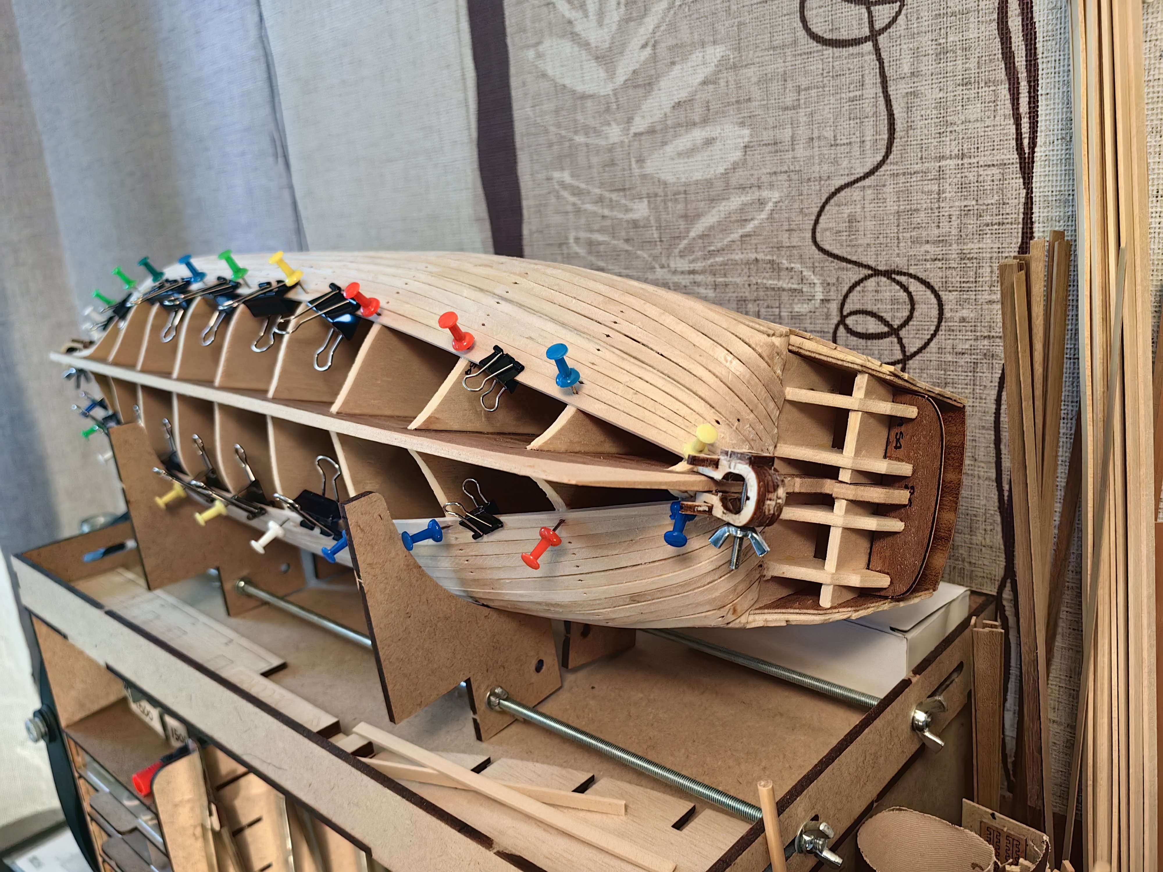

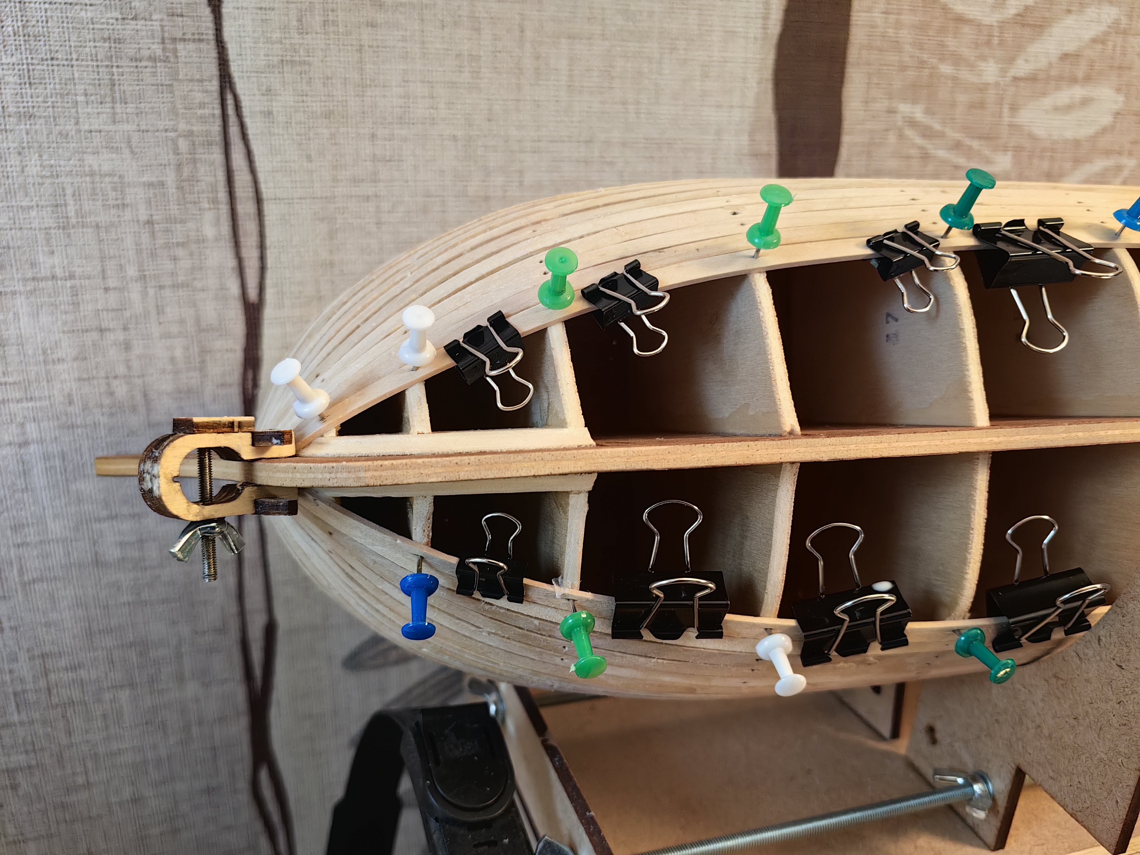

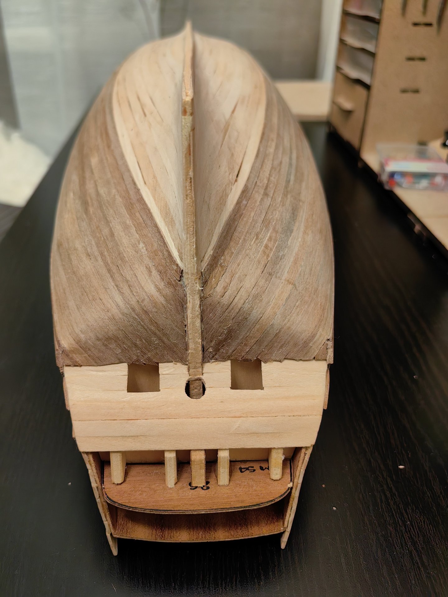

First of all, this concerns the magnificent bow and stern decors, the painting on the sides and many other details. The photo etching sheet and the poor casting from Corel will not ensure that the beauty of this wonderful ship is properly conveyed. The final result is still very far away, but for now I'm continuing with the first layer of hull cladding. I glued an imitation of the gun ports of the gundeck and the upper decks, layer by layer I glue the lime slats, after soaking them in hot water and bending them with an iron. Some slats have to be bent in three planes to get the right shape. The case is progressing slowly. I glue 1-2 slats on each side per day.

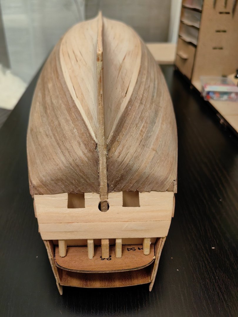

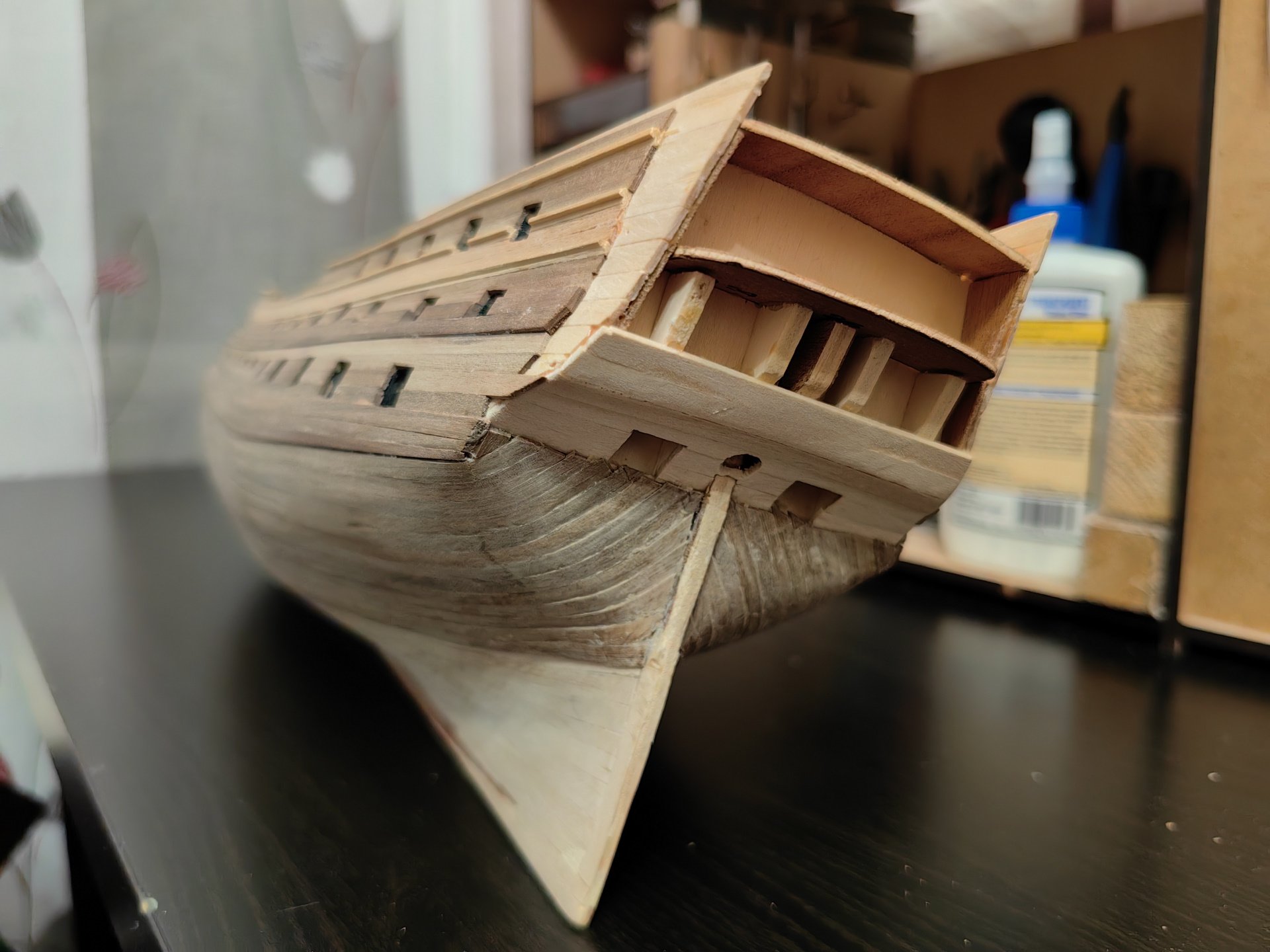

On many ships in general, and on Bellona in particular, the stem and afterstay are narrowed from top to bottom. This is seen, for example, in Brian Lavery's Anatomy of the Ship. In the whale from Corel, this is not in the drawings. I decided to make this narrowing, but I obviously overdid it) I'll have to make overlays later.

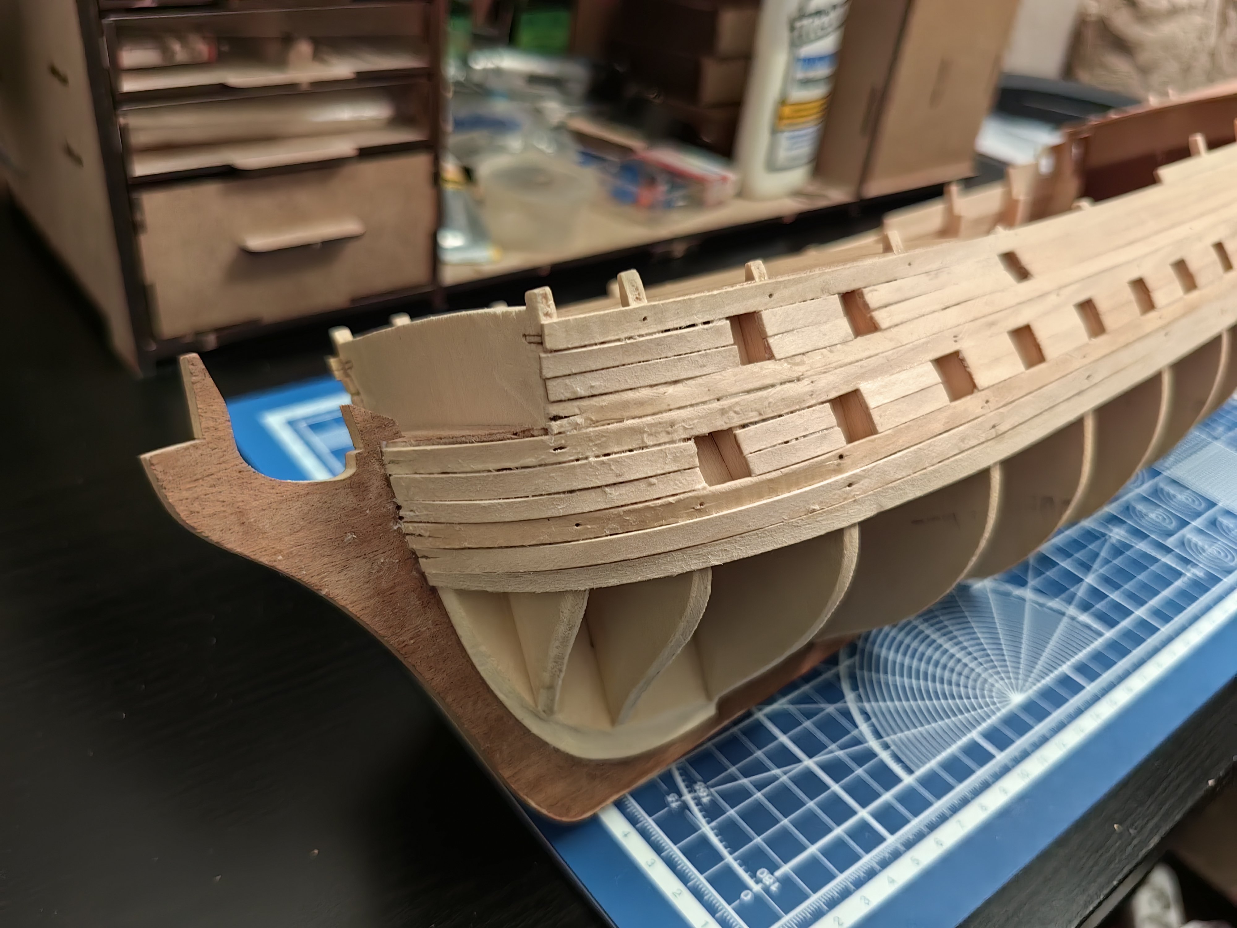

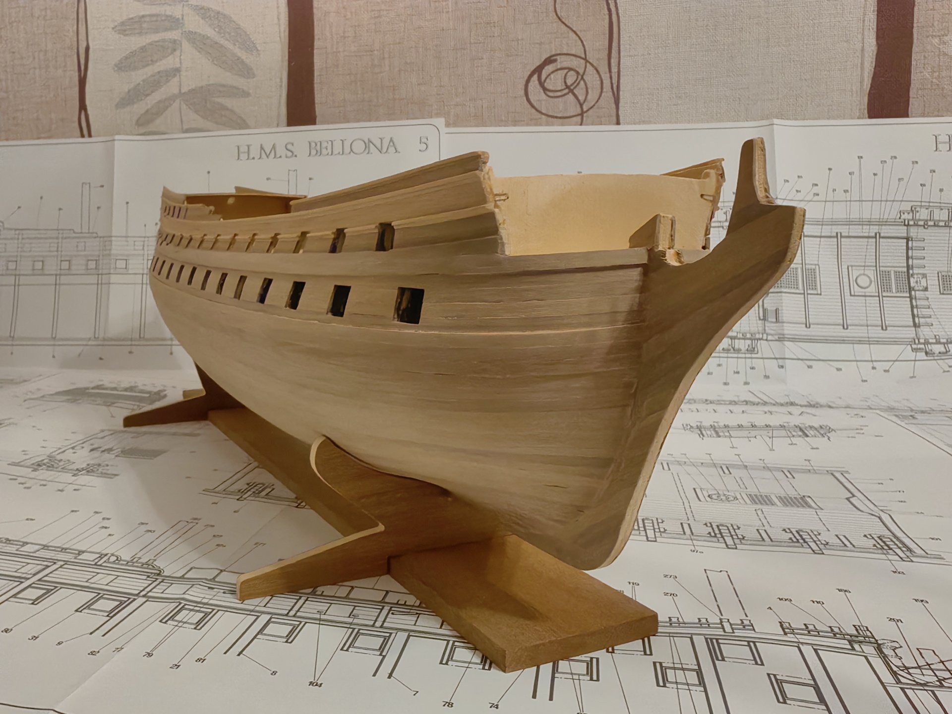

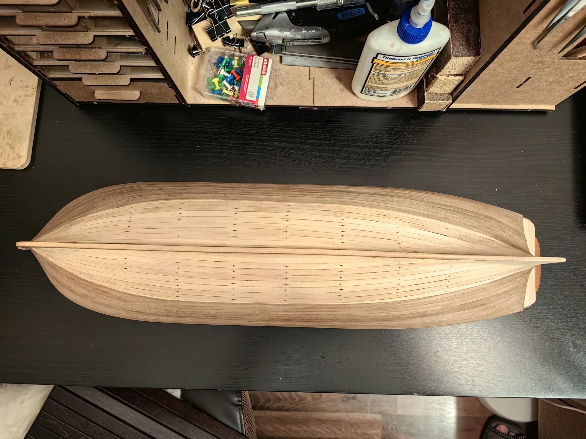

Well, I've finished the first layer of cladding. Treated with sandpaper. The hull takes on the shape of a ship) For some reason it looks rather rough in the photos, although tactile - everything is smooth. Well, as it turned out, so it turned out... I'll try to fix the flaws with a second layer.

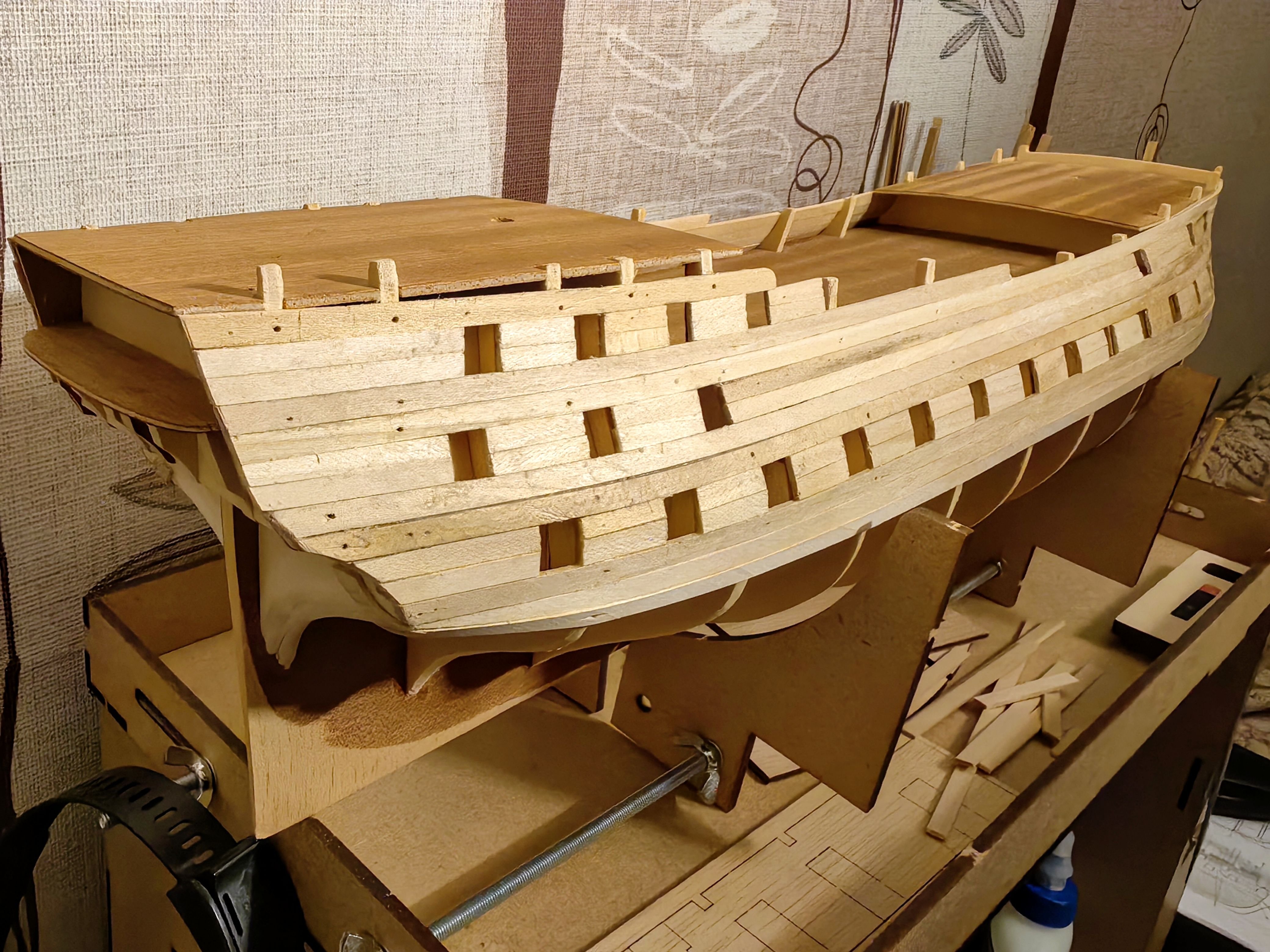

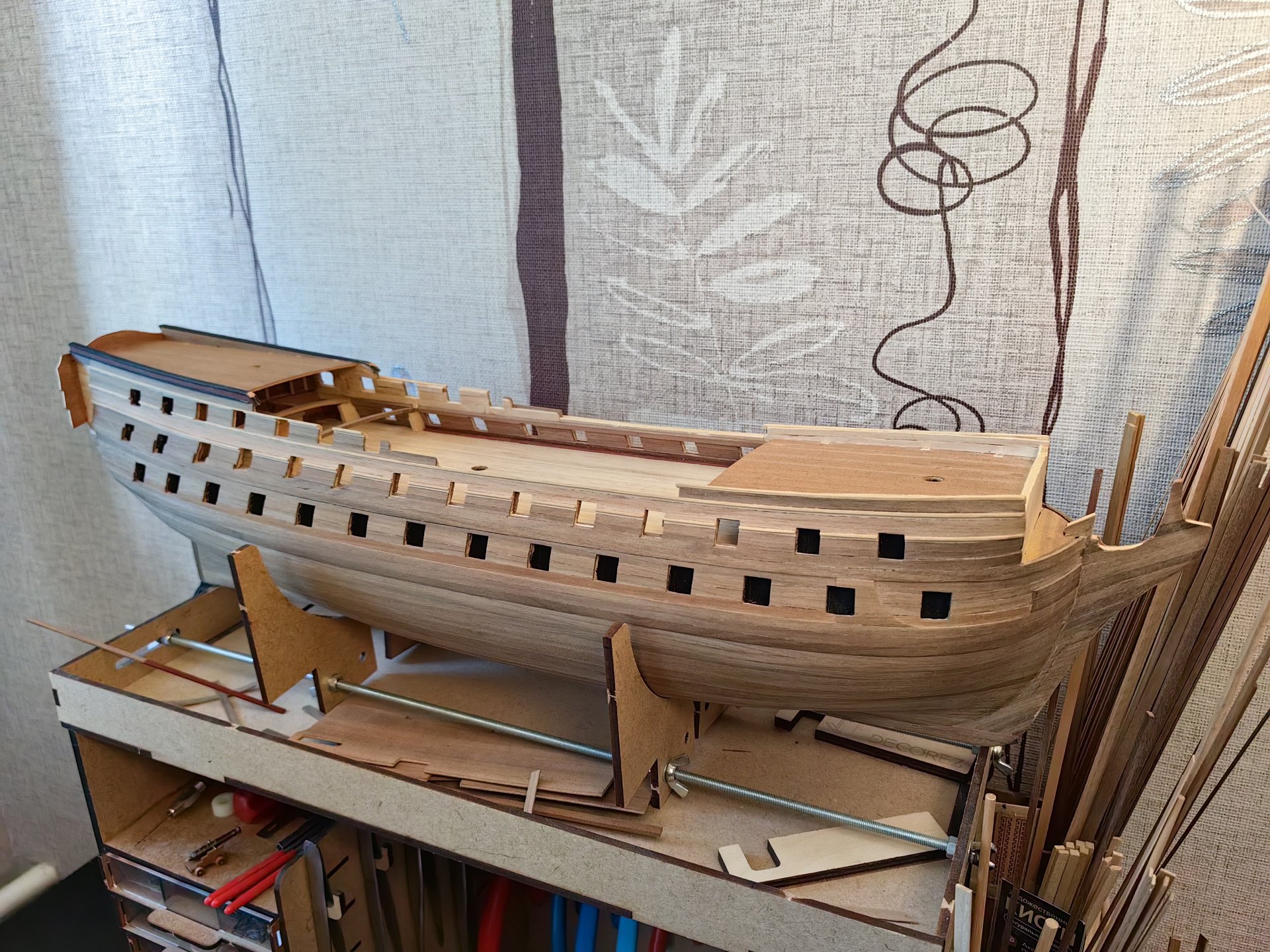

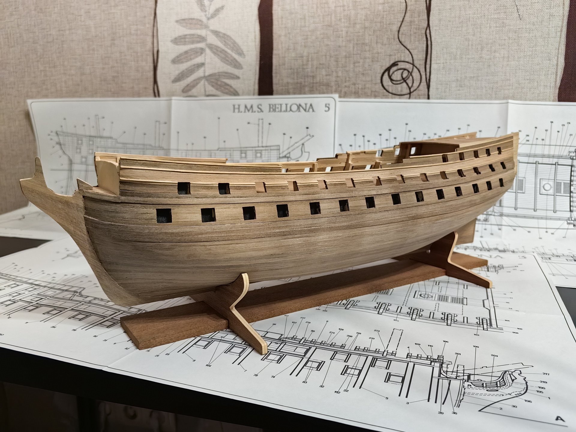

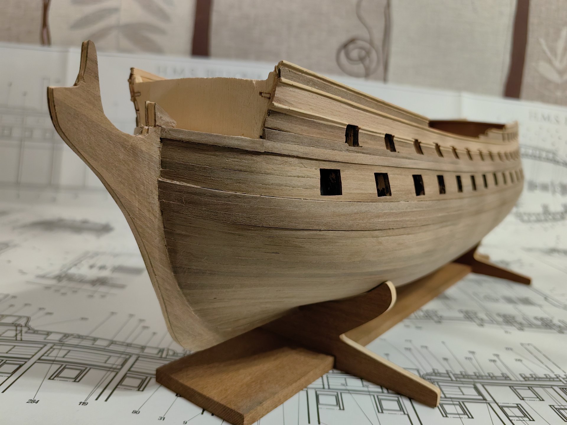

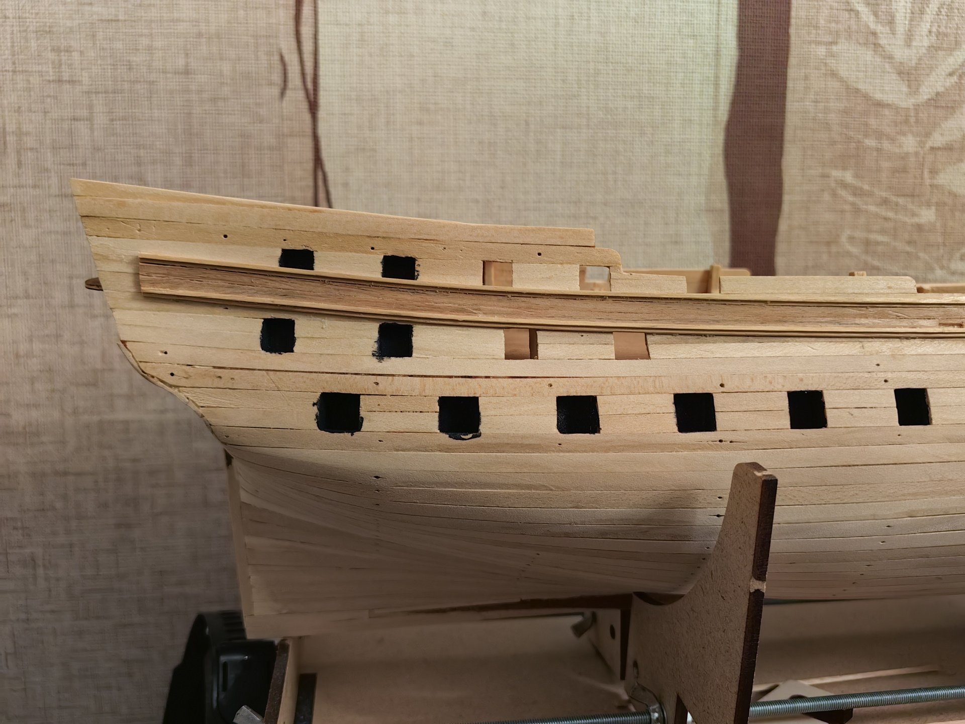

Before starting the next stage of assembly, I thought for a long time about what to do first – to mount the aft gallery, or finish the hull cladding with a second layer. After carefully examining the models of various ships, including the Bellona model by Charles Middleton from the Greenwich Museum, I came to the conclusion that, after all, the gallery structures are located on top of the hull. That's why I'm starting the second layer. Before that, I painted with black acrylic paint inside the gun ports of the forecastle, quarterdeck and gundeck. And I started the top layer with moldings No. 56, 58 and two slats between them.  Unfortunately, at the very beginning I took the wrong slats for the cladding. Beech, instead of the dark walnut intended in the trim kit. Well, that's fine. Anyway, this belt will be colored blue. Next, I will use the right rail.
Edited by Frecap

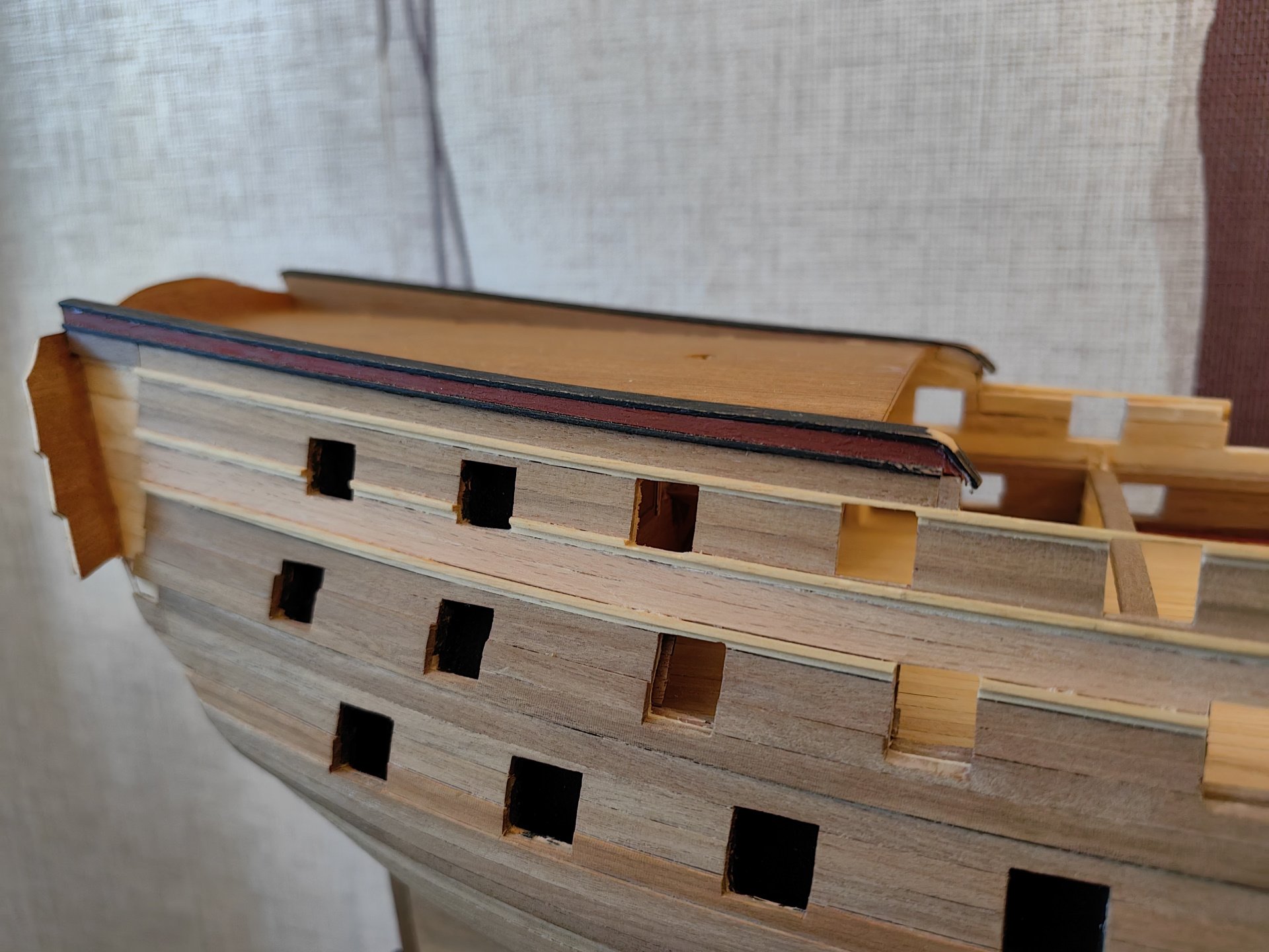

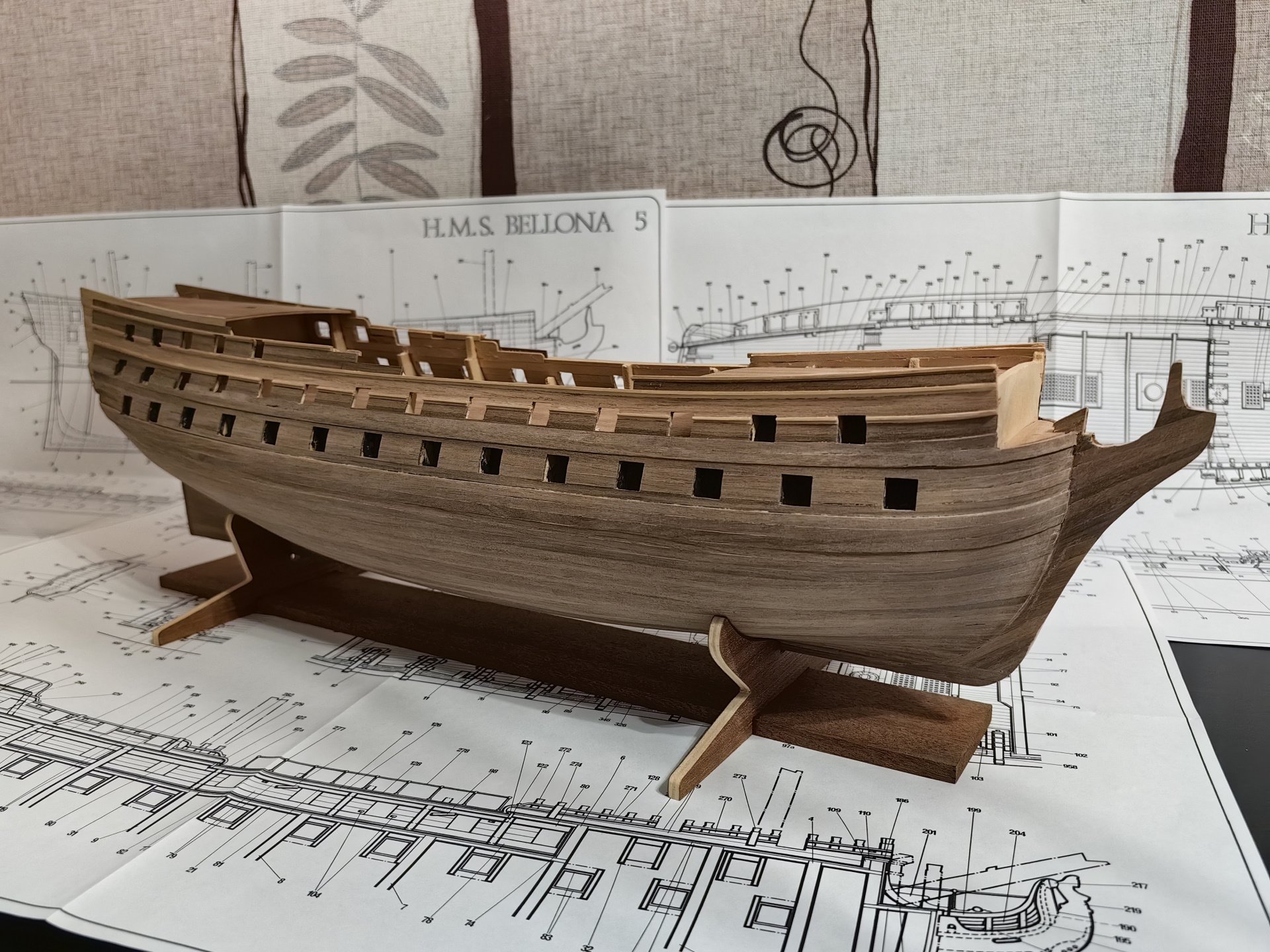

 I continue to trim the model with a dark walnut rail. I use PVA glue and an iron. I glued the pads to the narrowed keel and achtersteven. Then I'll give them the right shape and hide them with a finishing trim.

Greetings, Ronald-V! Yes, I want to keep the natural wood. I'll just paint the barkhouts  black and the upper part of the sides blue with decor. Like the Charles Middleton model, but without the copper plating

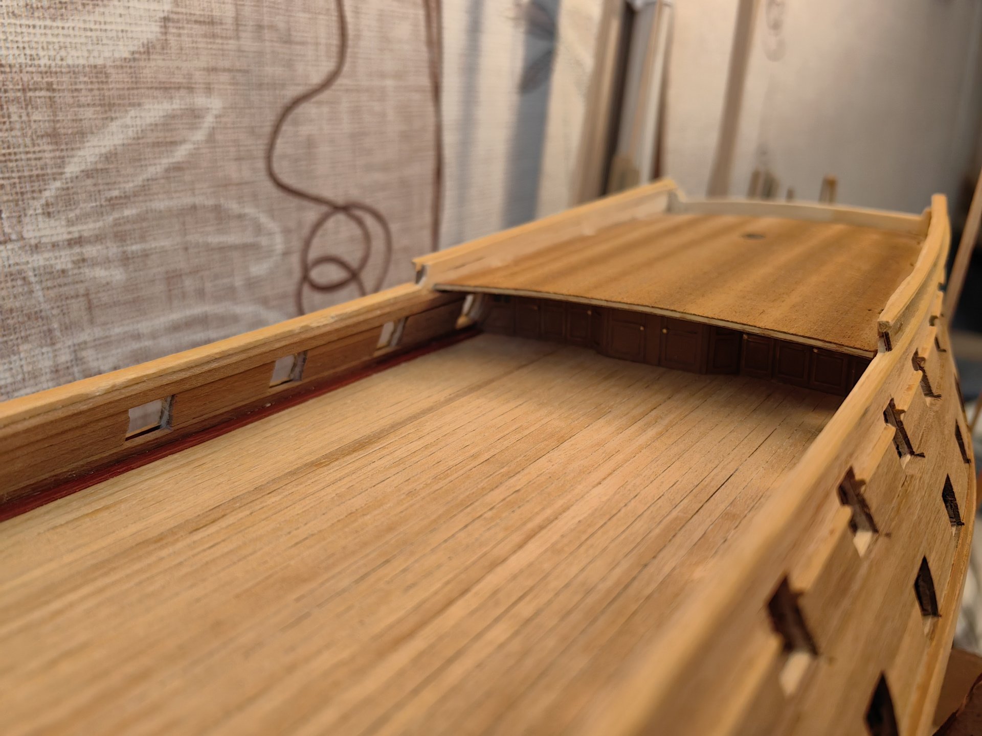

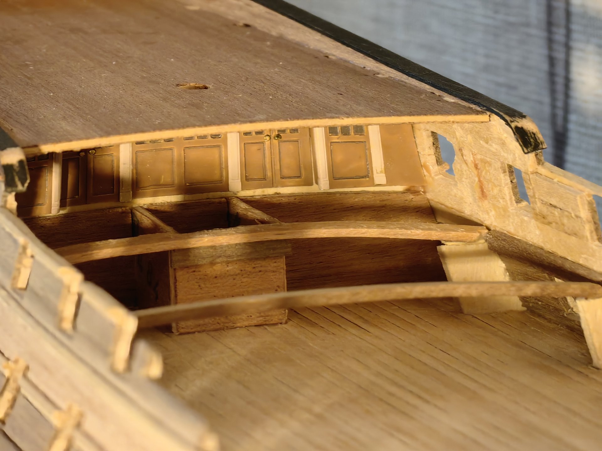

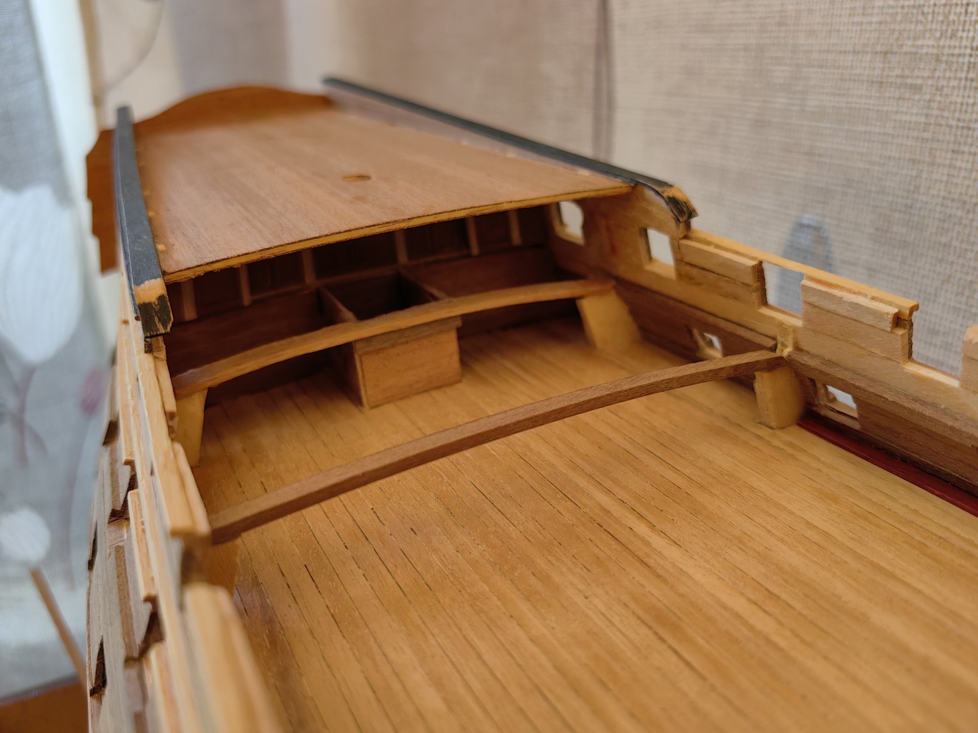

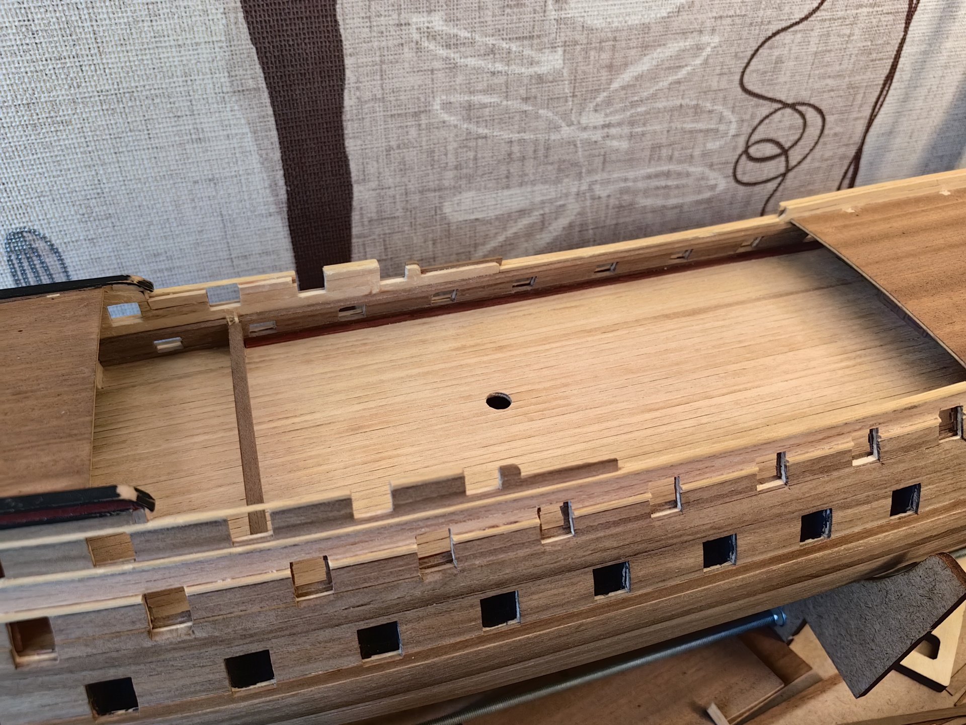

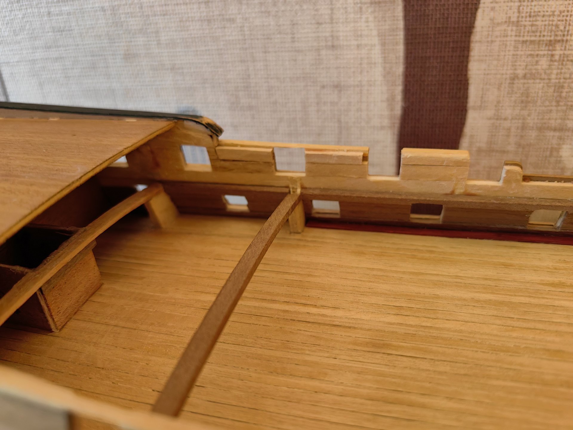

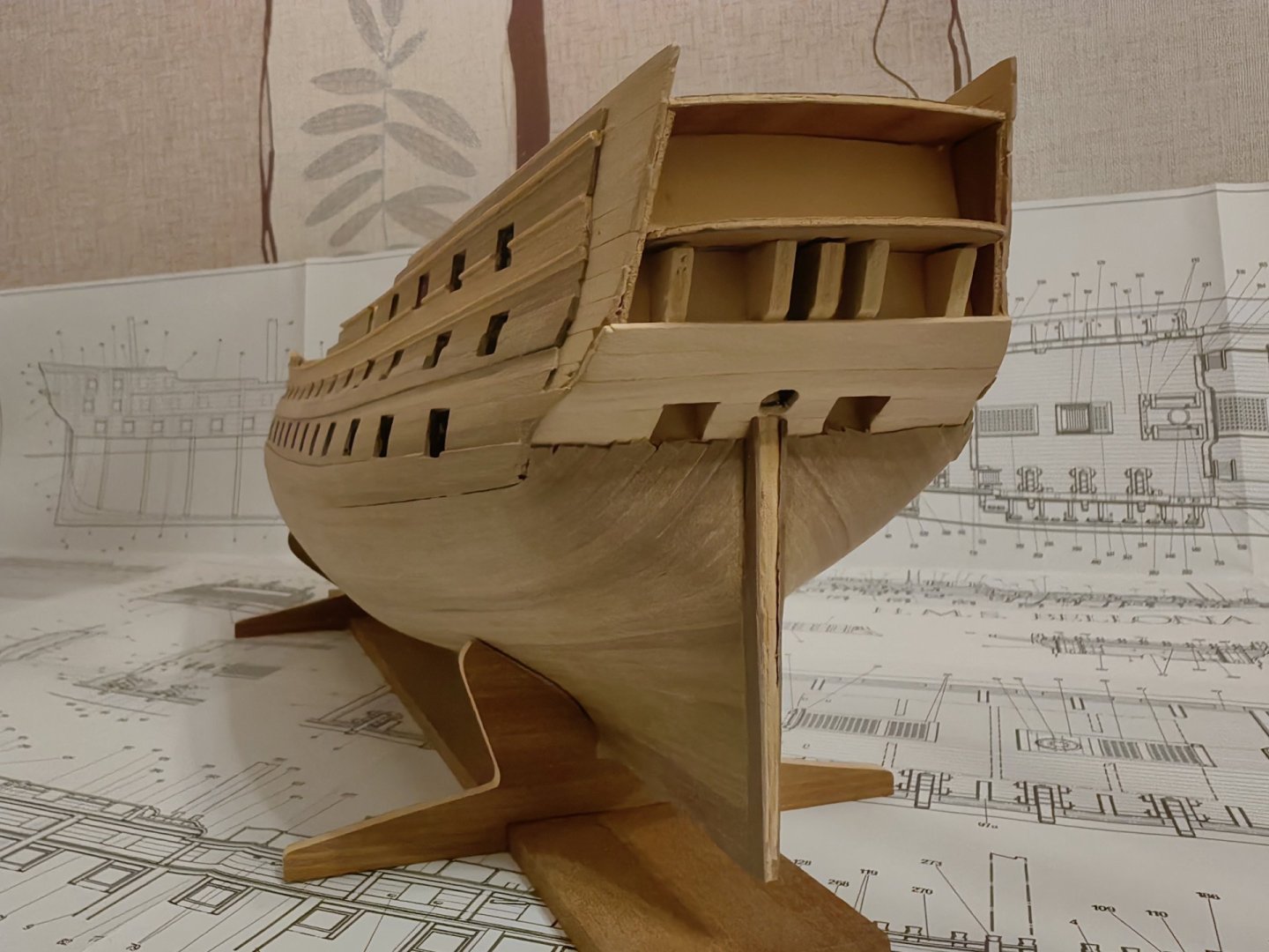

Hi All!                                                                                                                                                                                                                                                                      So, the work is moving. Since my last post, I have lathed the main deck, the inside of the bulwarks, installed the waterway and the afterdeck gunwale. From the outside, I installed anchor cushions, alignment of the cleats and a False wale. Glued the transom board and installed the bulkheads of the forecastle and quarterdeck. I don't like the fact that the bulkheads are made of brass plate, which doesn't paint very well, but I thought that both of these details are deep in the structure and don't catch the eye. I painted them brown (to look like wood), shaded the window openings with a simple pencil, and painted the columns on the quarterdeck bulkhead white. Maybe I'll add some more details to them later. The waterways were also pre-painted so as not to suffer on the assembled model. After sheathing the main deck, a very unpleasant problem came to light. Apparently, I hurried to cut through the main deck gun ports. After assembling one cannon and trying it on, I saw that the port was cut very low. The cannon barrel rests against the bulwark above the port… Cutting the port up 2-3 mm will not be any problem. But then it won't be square in shape, but rectangular. We'll have to make some kind of inserts to close the undersides of the ports.
