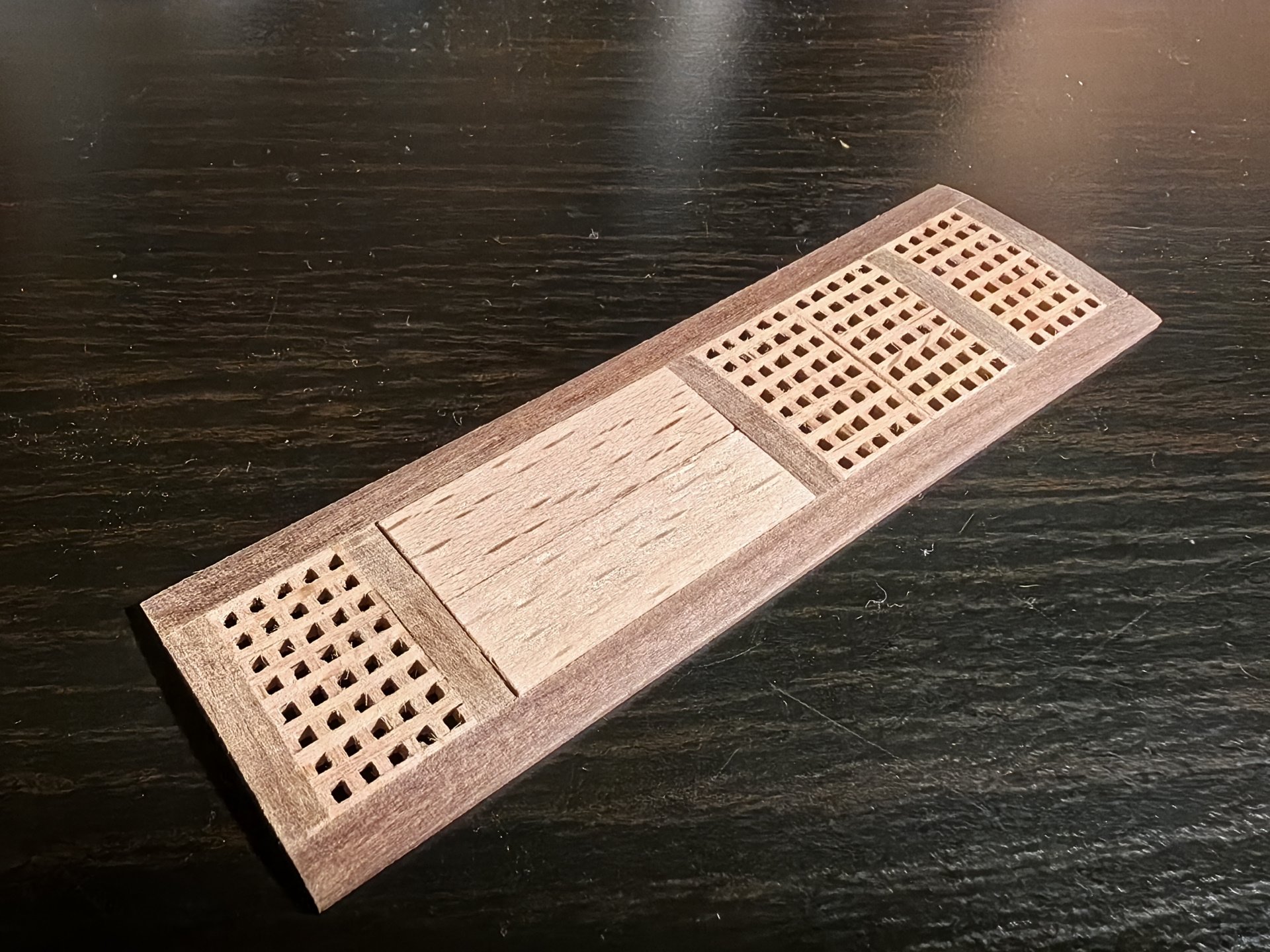

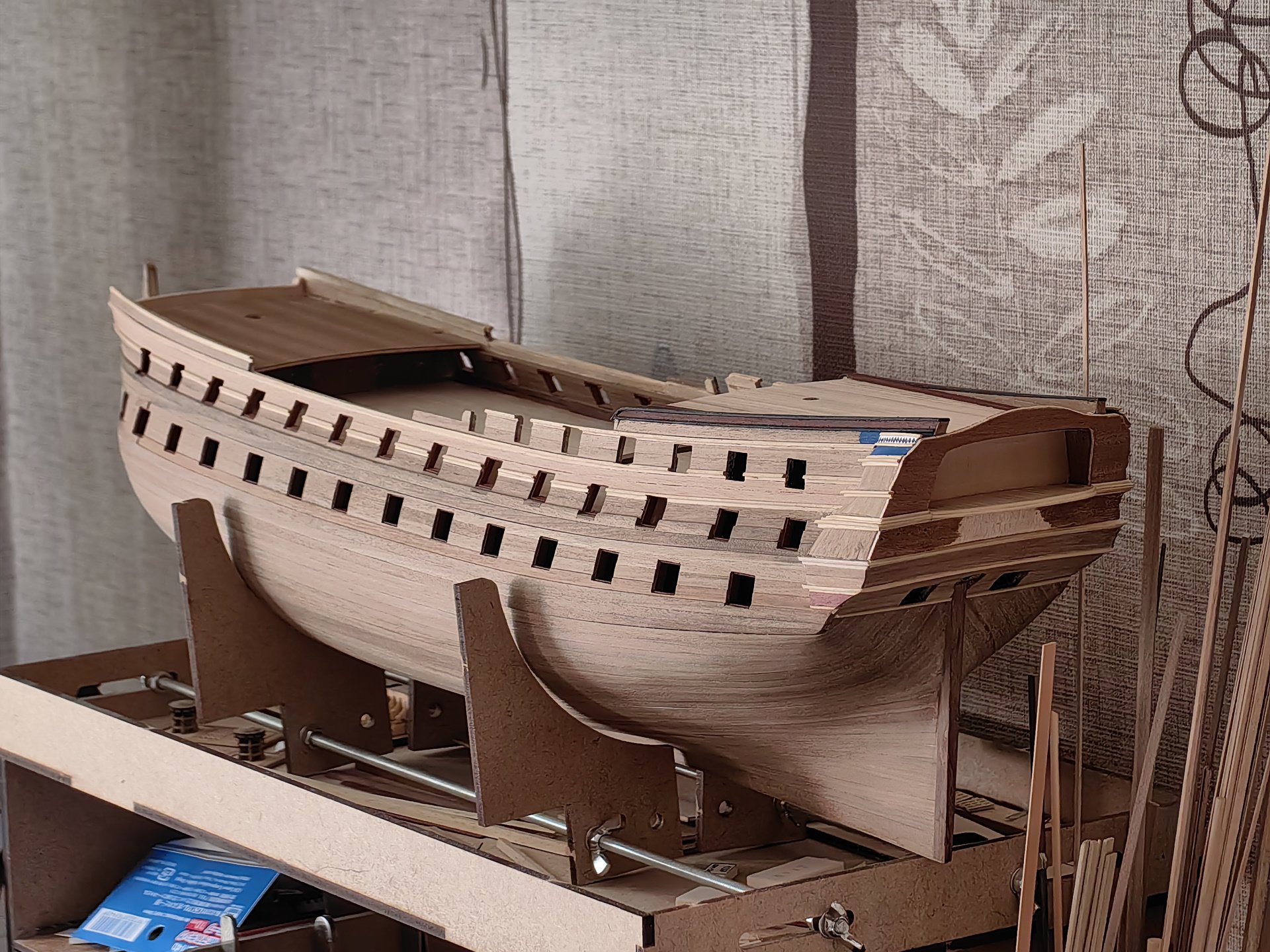

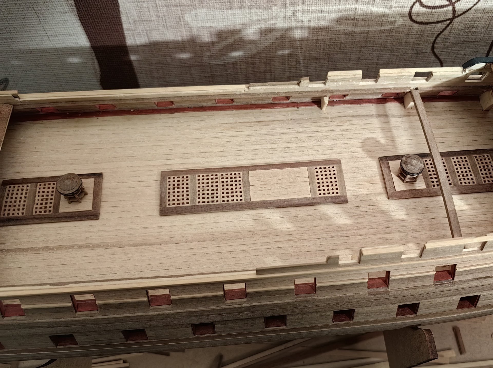

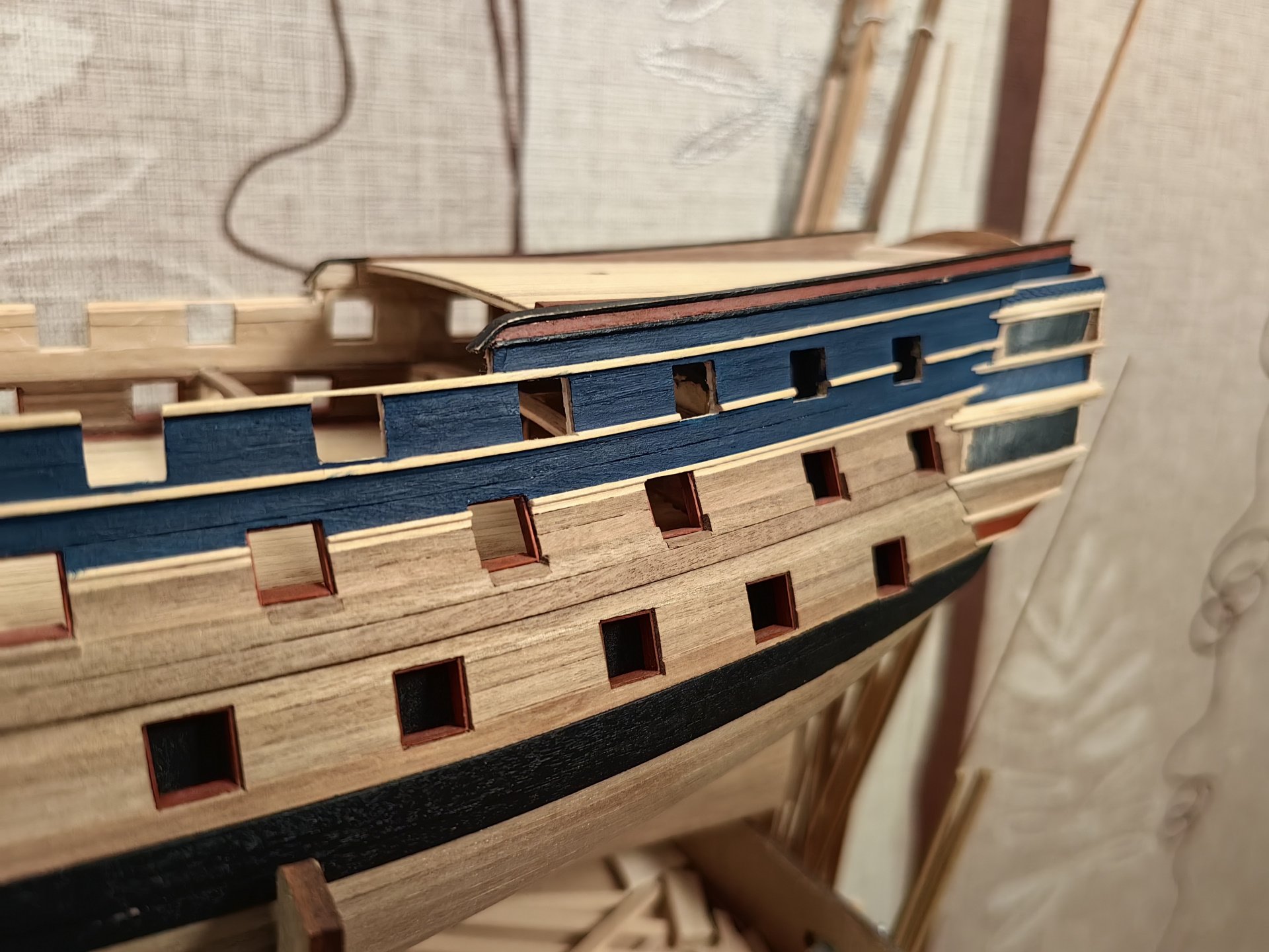

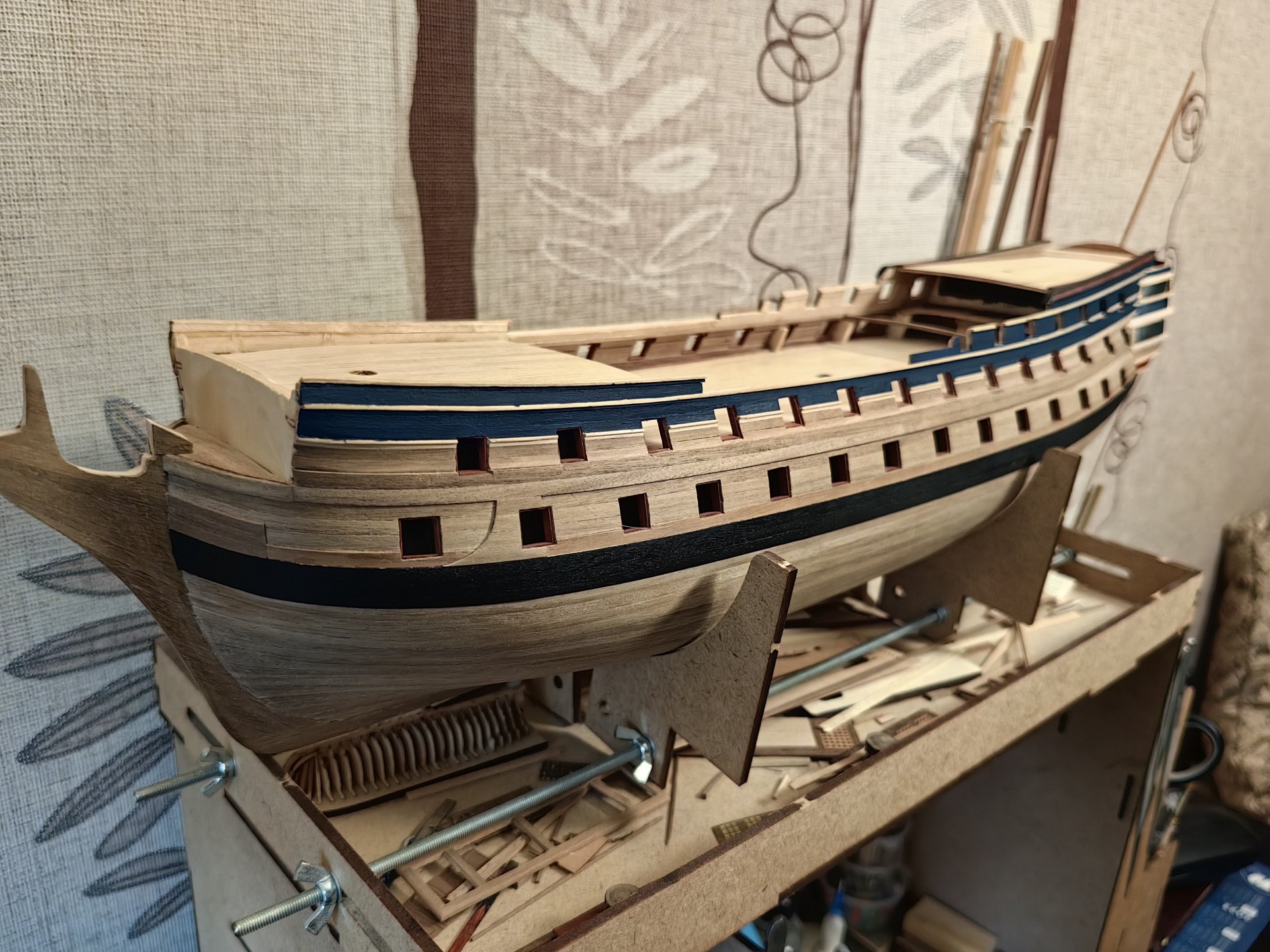

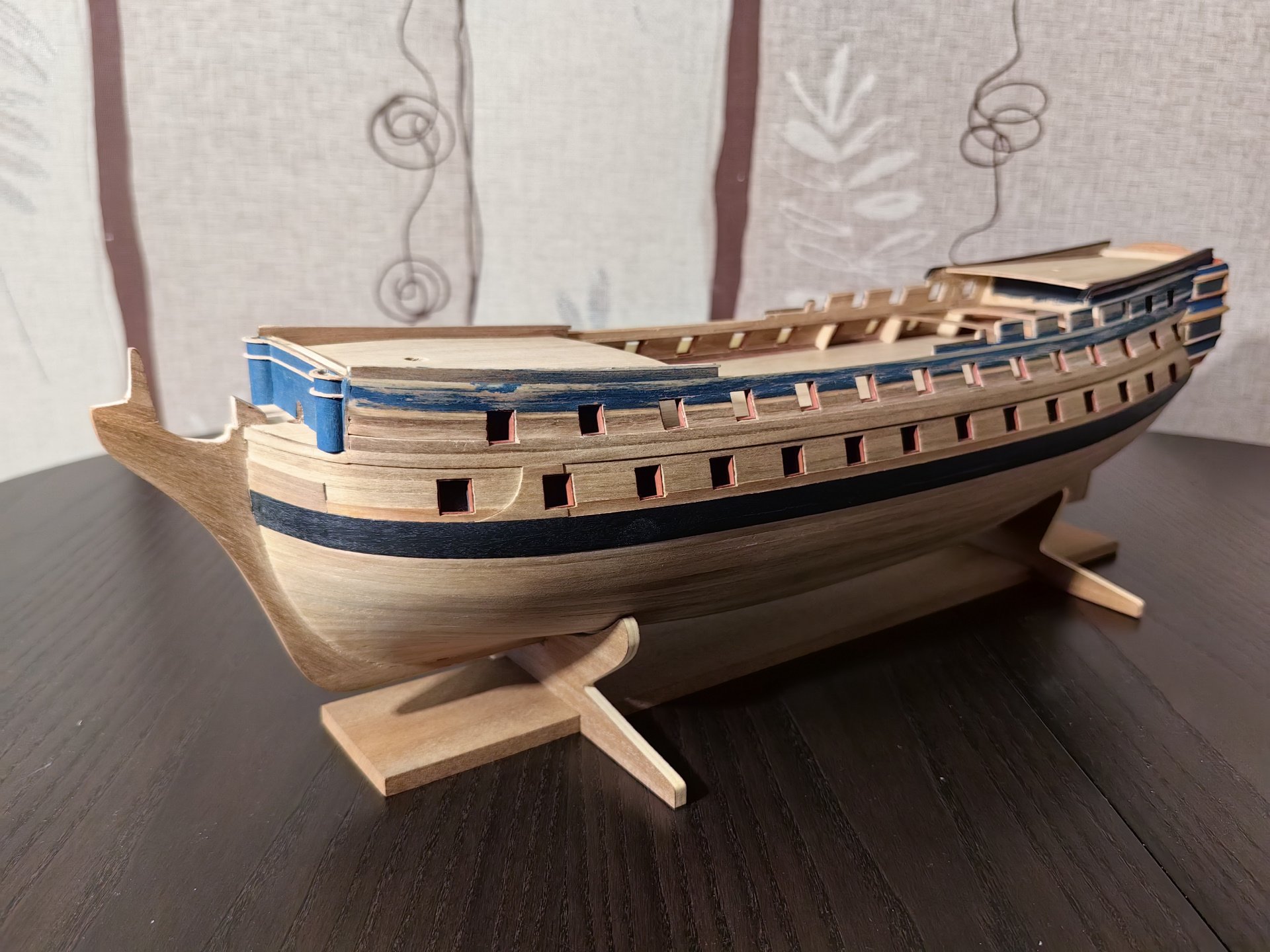

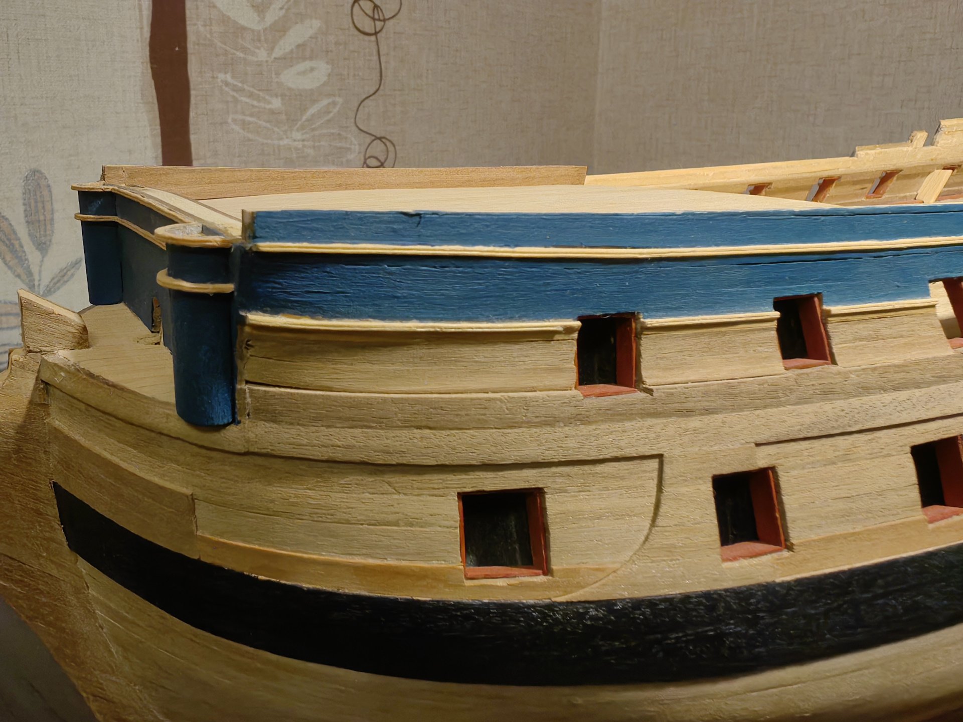

Hello everyone! I spent the past week fixing the location of the gun ports on the main deck. I had to raise them 2-3 mm and cover the bottom part with a walnut rail insert. I probably should have matched the rail better in color, but it turned out the way it turned out. The inserts are visible in the photo, but the general appearance of the model does not catch the eye.  I also started making frames for the main deck gun ports. The slats for them were previously painted in a dull red color.
24 minutes ago, harlequin said:
gun ports looking spot on....i had several issues with my gun ports which is documented in my build log, but yours are coming along nicely.
Hi, Harlequin! Thank you for the feedback, I'm trying my best!) Before building my model, I carefully reviewed everything I could find on this topic. Including your excellent work. I've learned a lot from it!) And I'll keep learning more!)

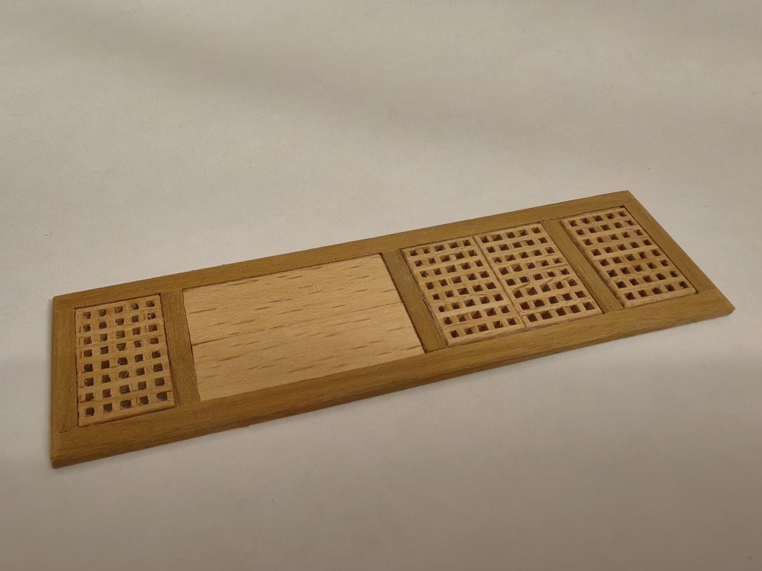

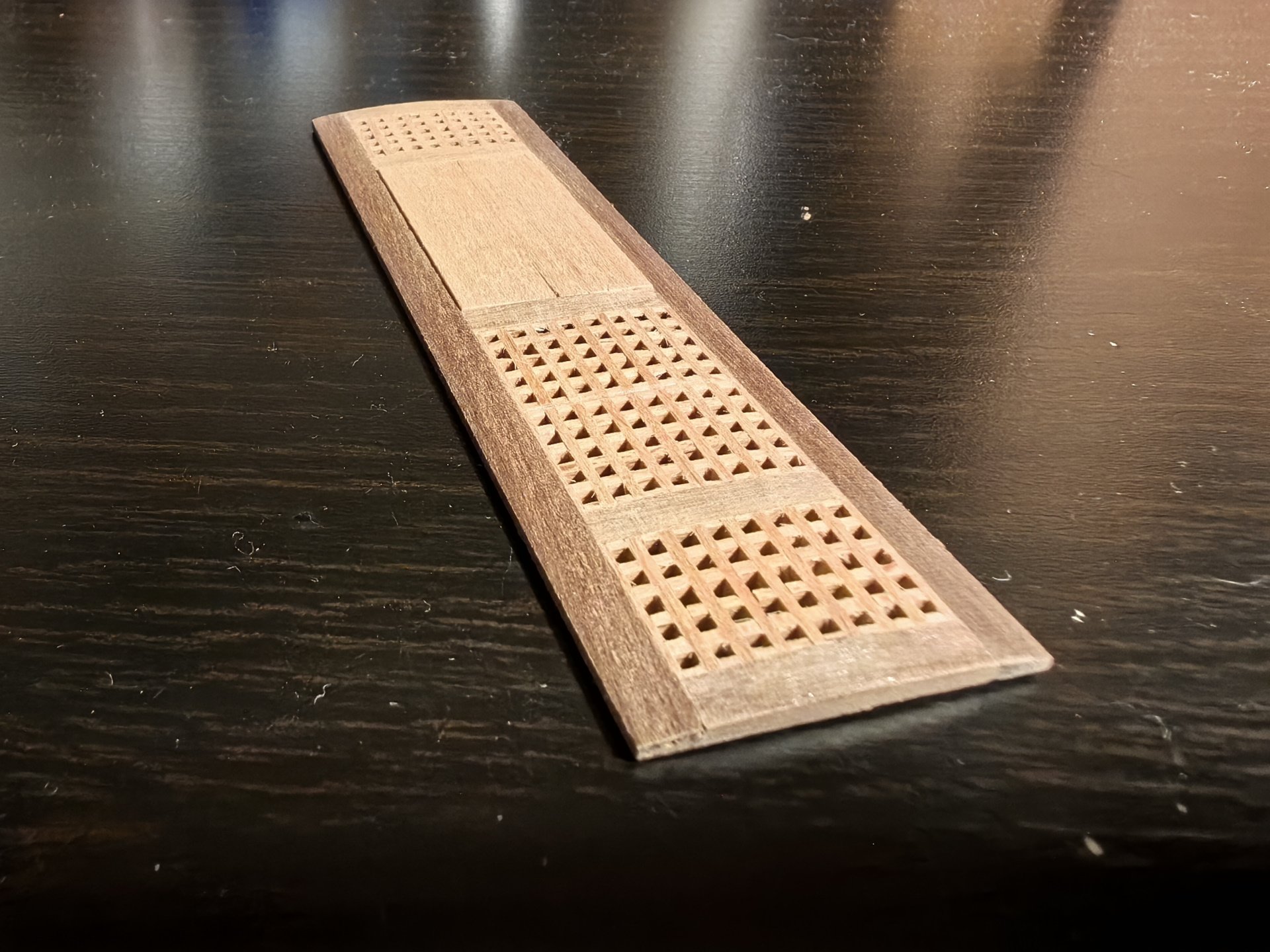

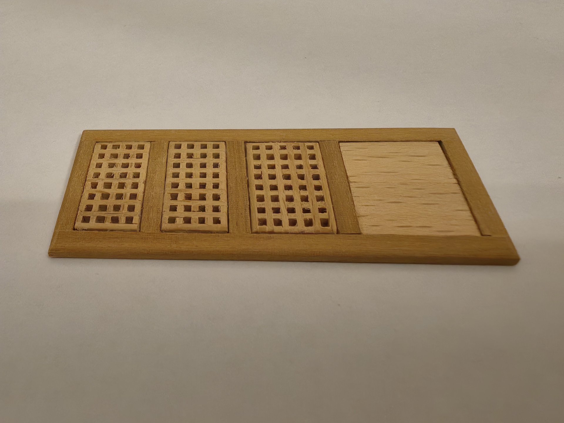

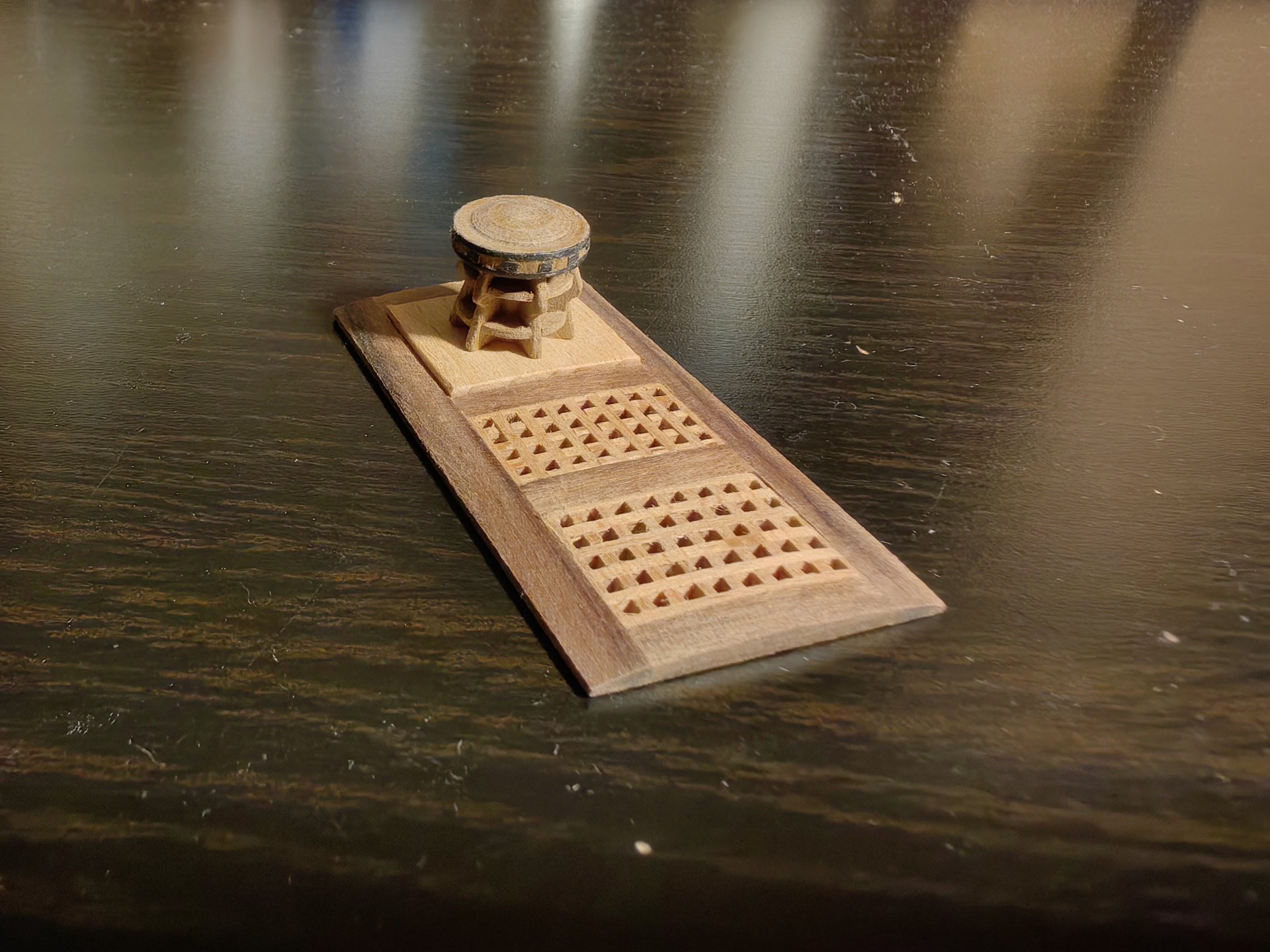

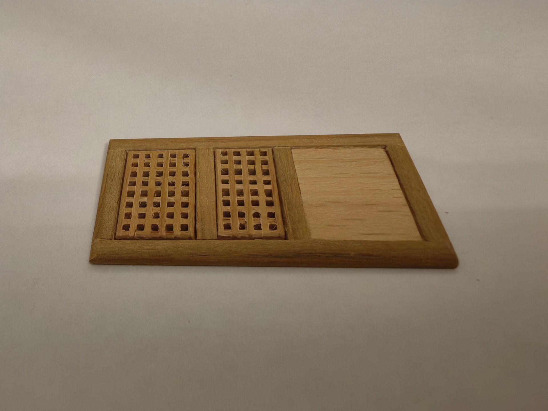

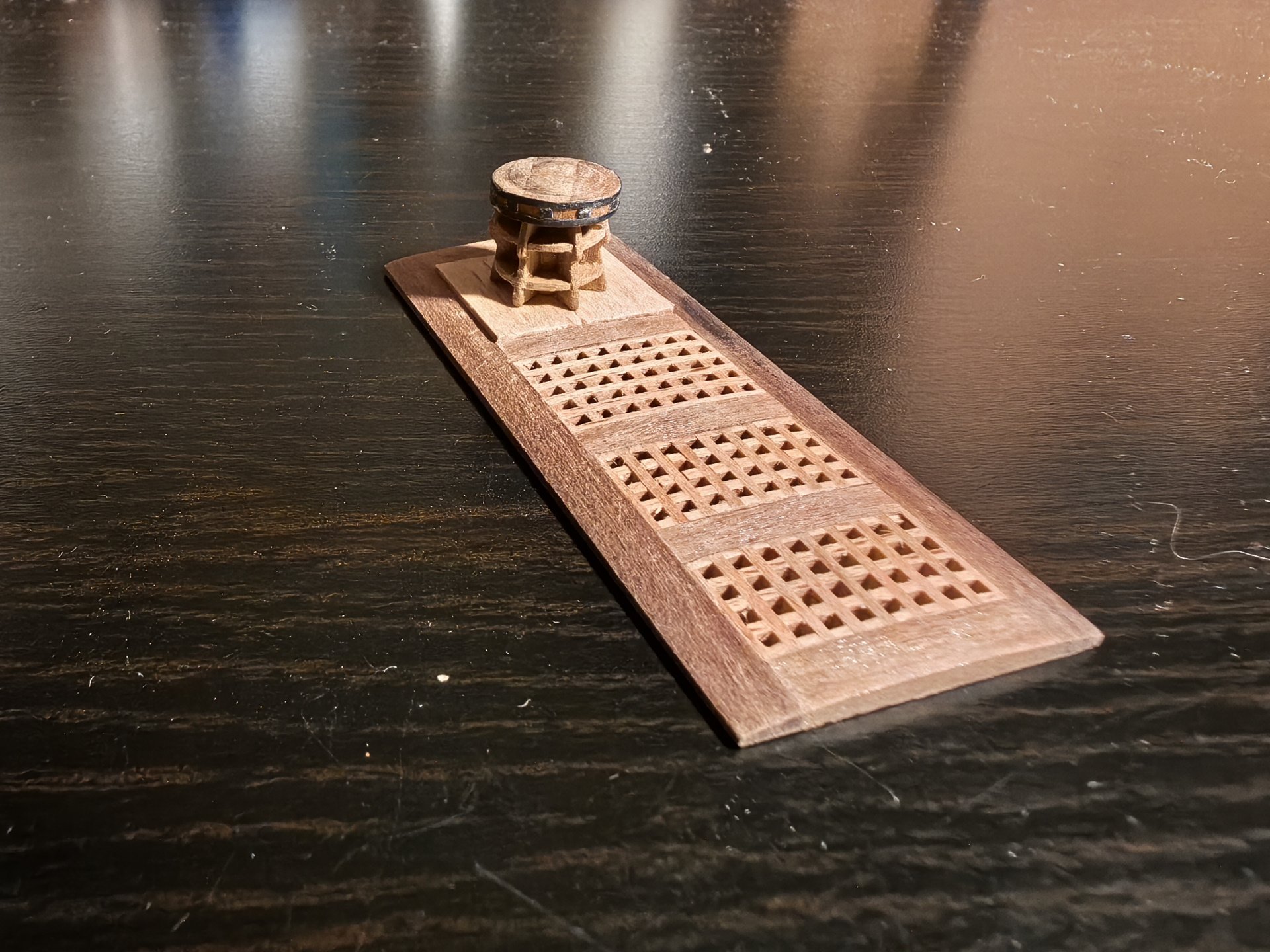

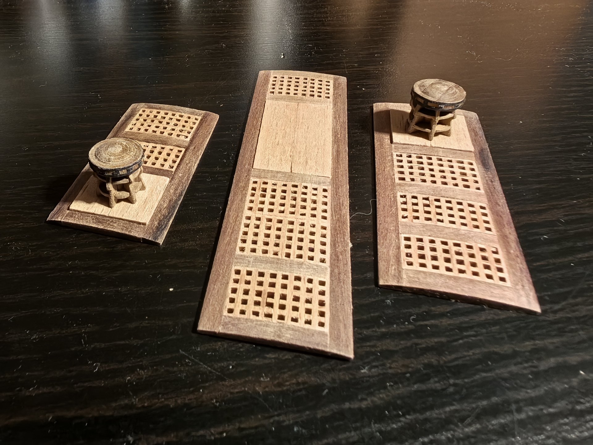

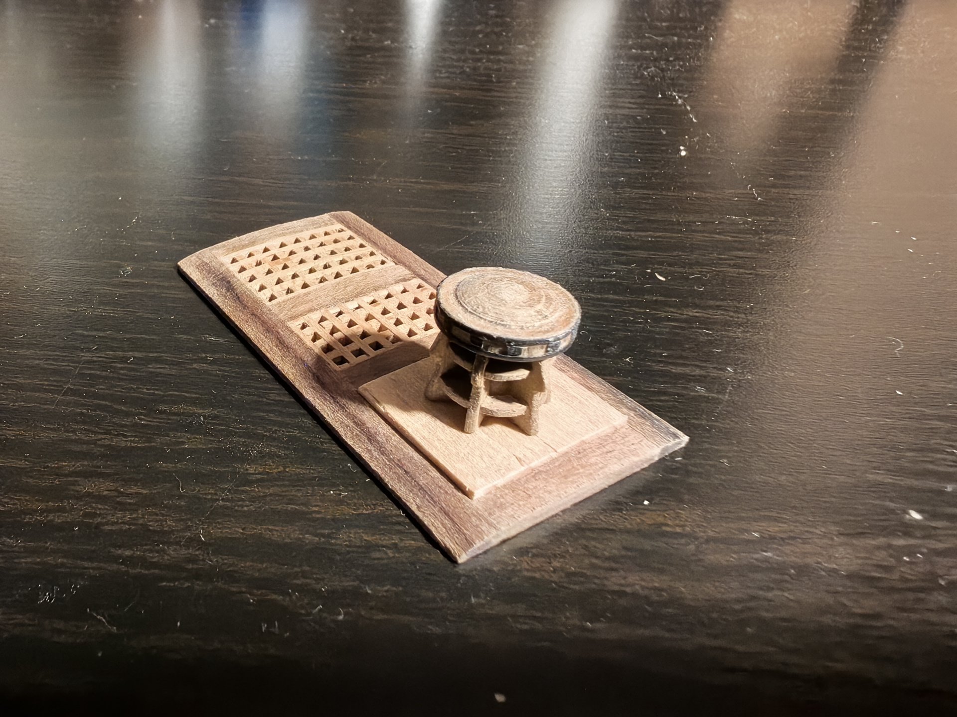

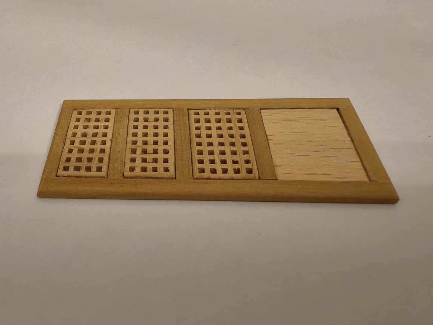

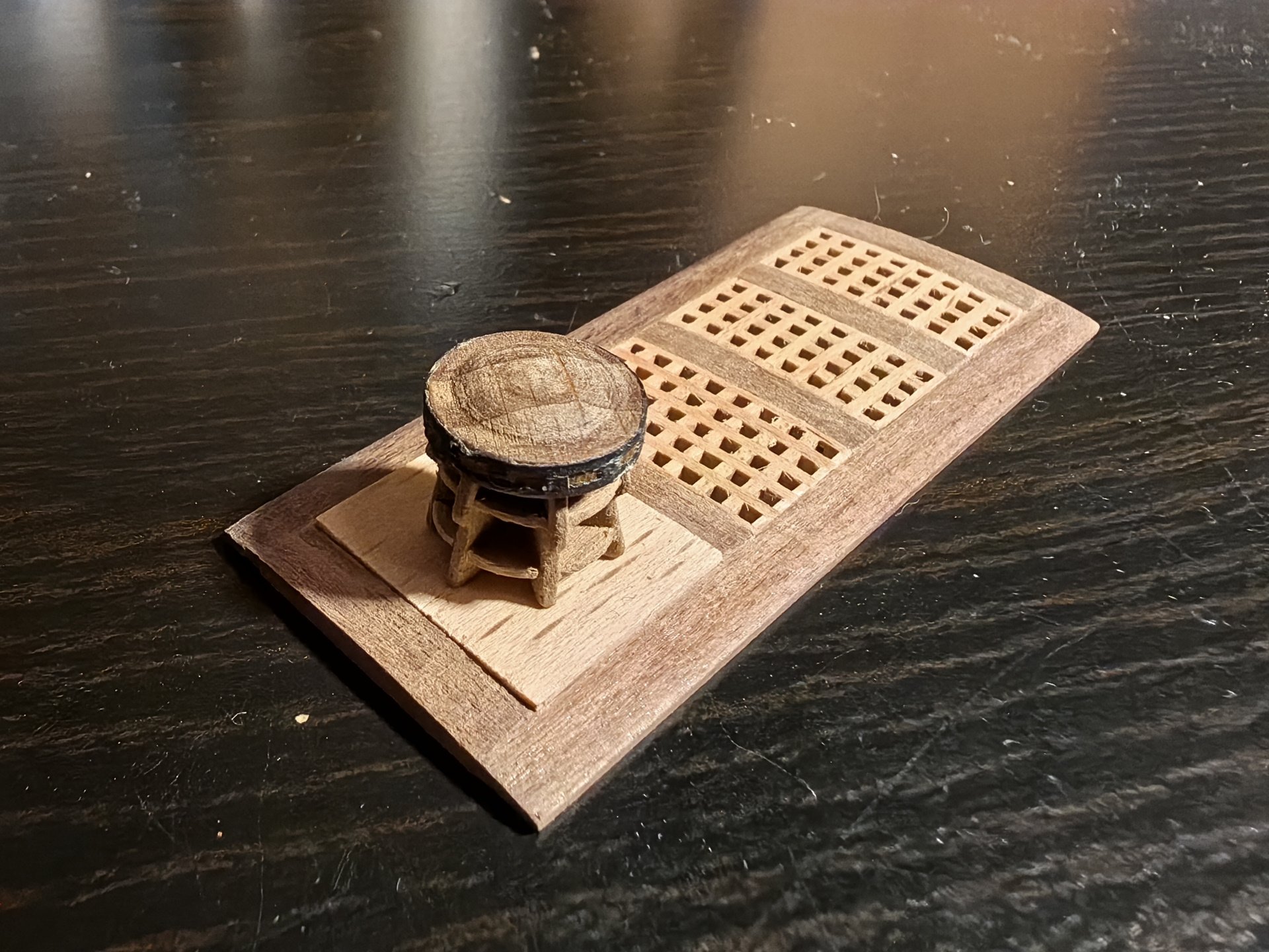

I wanted to see more small details on the model. I decided to start with the gratings on the main deck. As suggested by Corel, I made the grate comings out of light beech wood. However, I was disappointed with the result. The finished product almost blends in with the light deck. It doesn't look good. Therefore, I decided to add a thin, darker rail on top. Here's what I got.
But then, looking at the photos of the museum models, as well as the photos of the HMS Victory, I decided that the shape of the grates should be the same as it is there – rounded at the top. During the processing, all the thin slats were worn down, and the grates became light again. Therefore, I had to redo them for the third time. I made the camings out of dark walnut and gave them the desired shape. Here is what I got:
16 hours ago, Paul Le Wol said:
Hi Frecap, I think they look great. Fine work!
Hi, Paul! Thank you for your feedback! I think the  comings of the gratings should be lighter. I'll try some bleach.
12 hours ago, Nearshore said:
Hi Frecap,
I think the grattings look great. I like what you did with the capstans. I will have to rethink mine, i like the detail you are presenting.
Nearshore

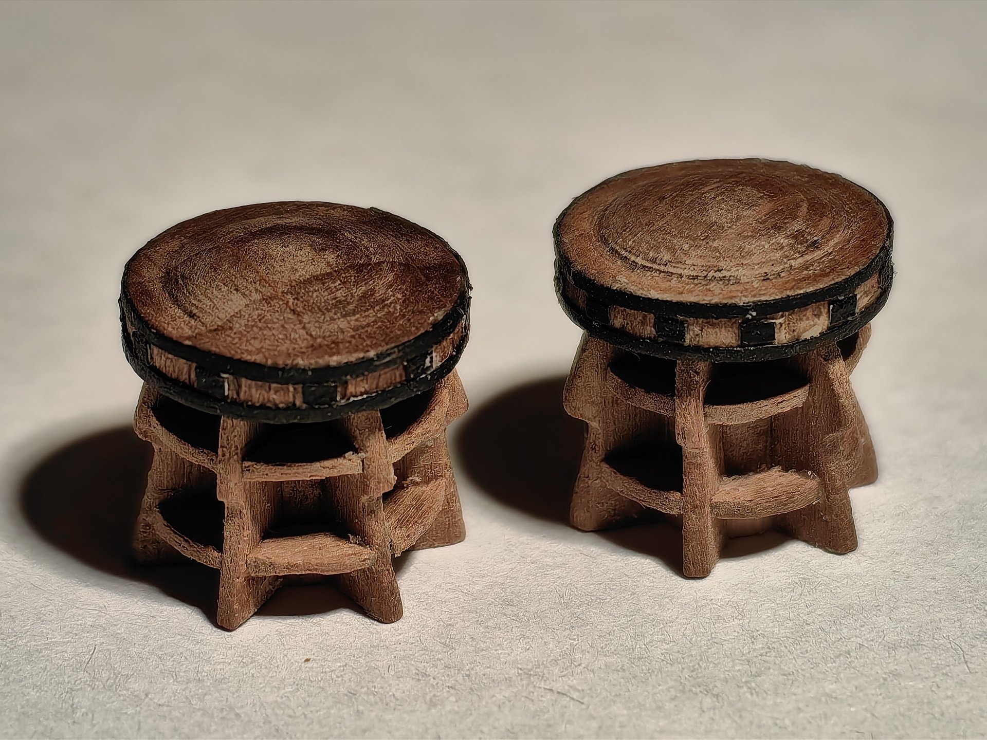

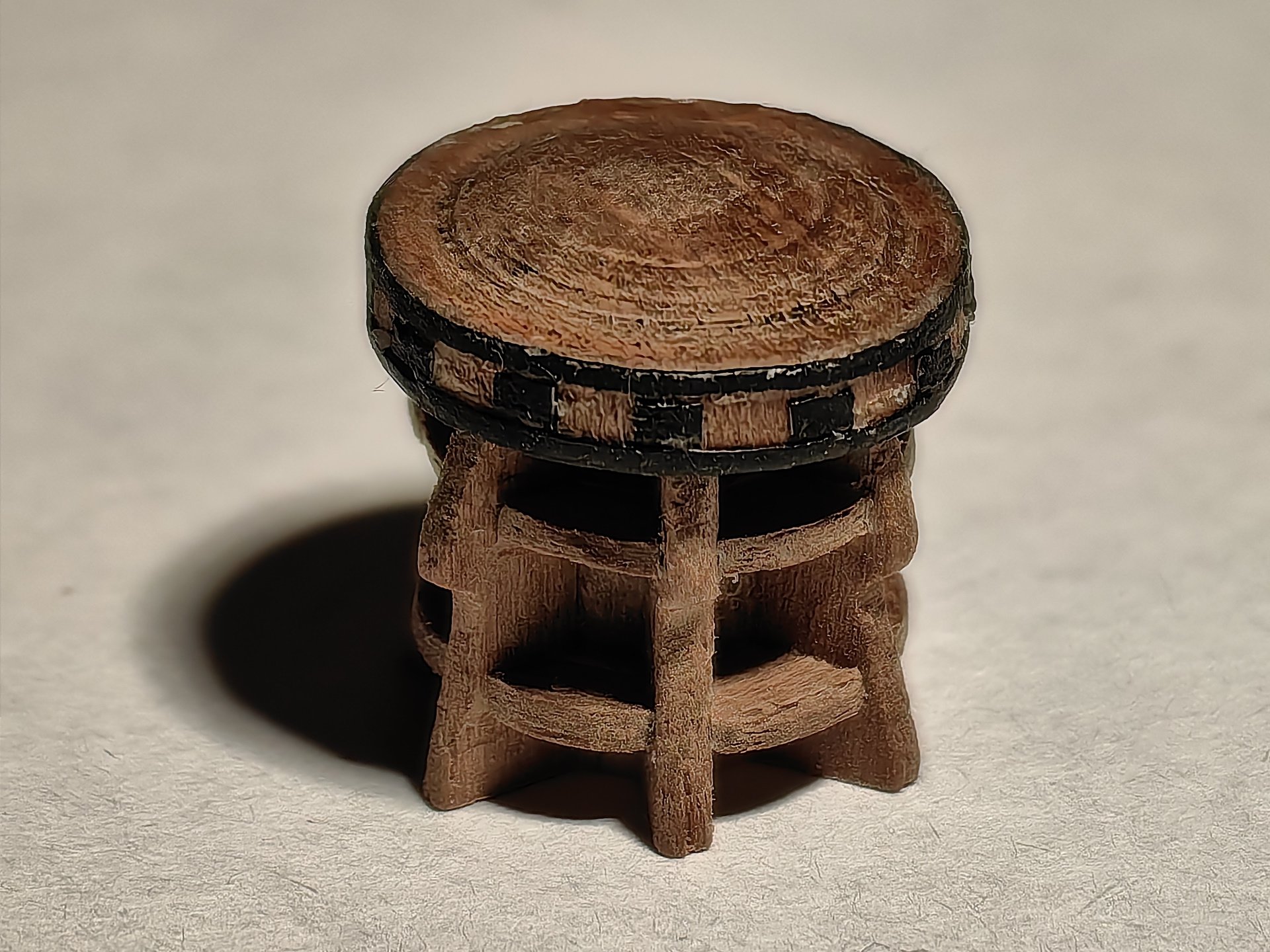

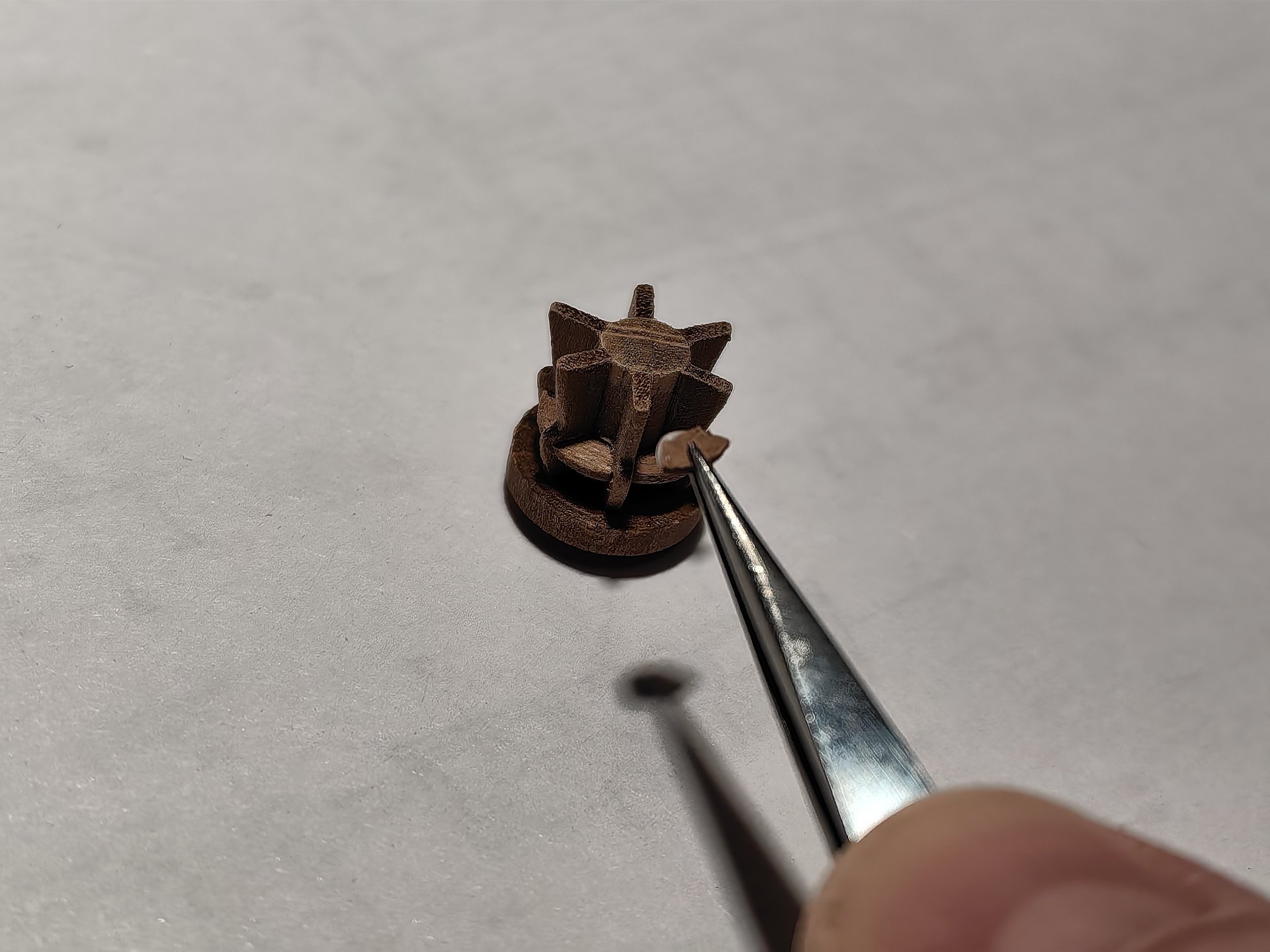

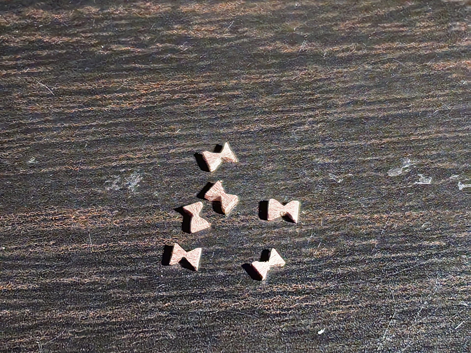

Hi, Nearshore! Thank you for your feedback! When making the cable reels, I didn't use all the details suggested by Corel. I made  the cheeks them from walnut wood planks, following the shape described in Brian Lavery's book "Anatomy." I used squares of black paper to model the holes for the bars.
I really like your work. It looks great! I've been following your publications with interest even before I started creating my own model.
Edited by Frecap

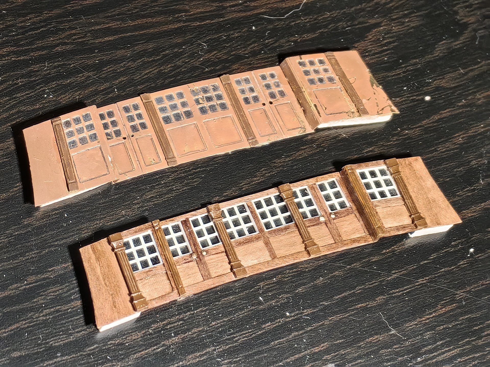

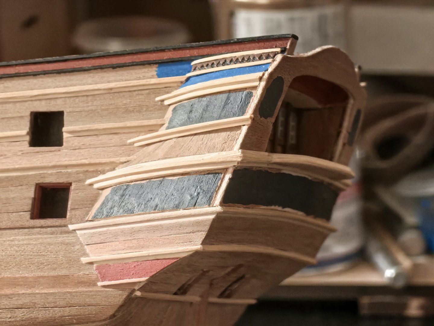

 I haven't figured out how to make the  moldings of gratings  lighter yet, so I've been busy with other things. I've made the afterdeck and balcony decking and started working on the aft gallery. I've attached the parts that give it the desired shape, and to achieve the correct positioning of the moldings, I've used double-sided tape to attach the windows and brass photo-etched decor. I don't like the way it looks, and I won't be using these parts. It's just to help me understand where to attach the moldings.
Hello everyone!

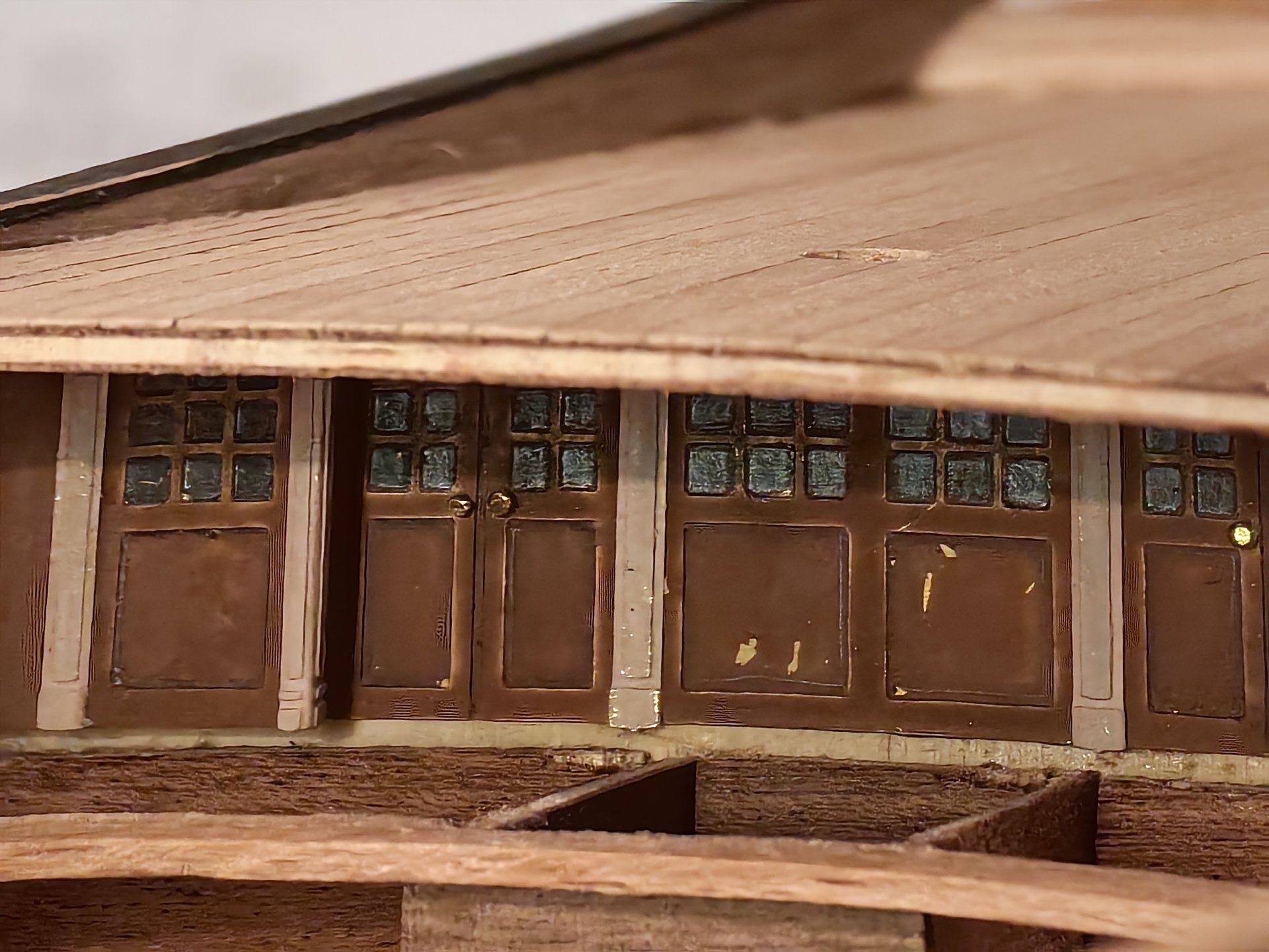

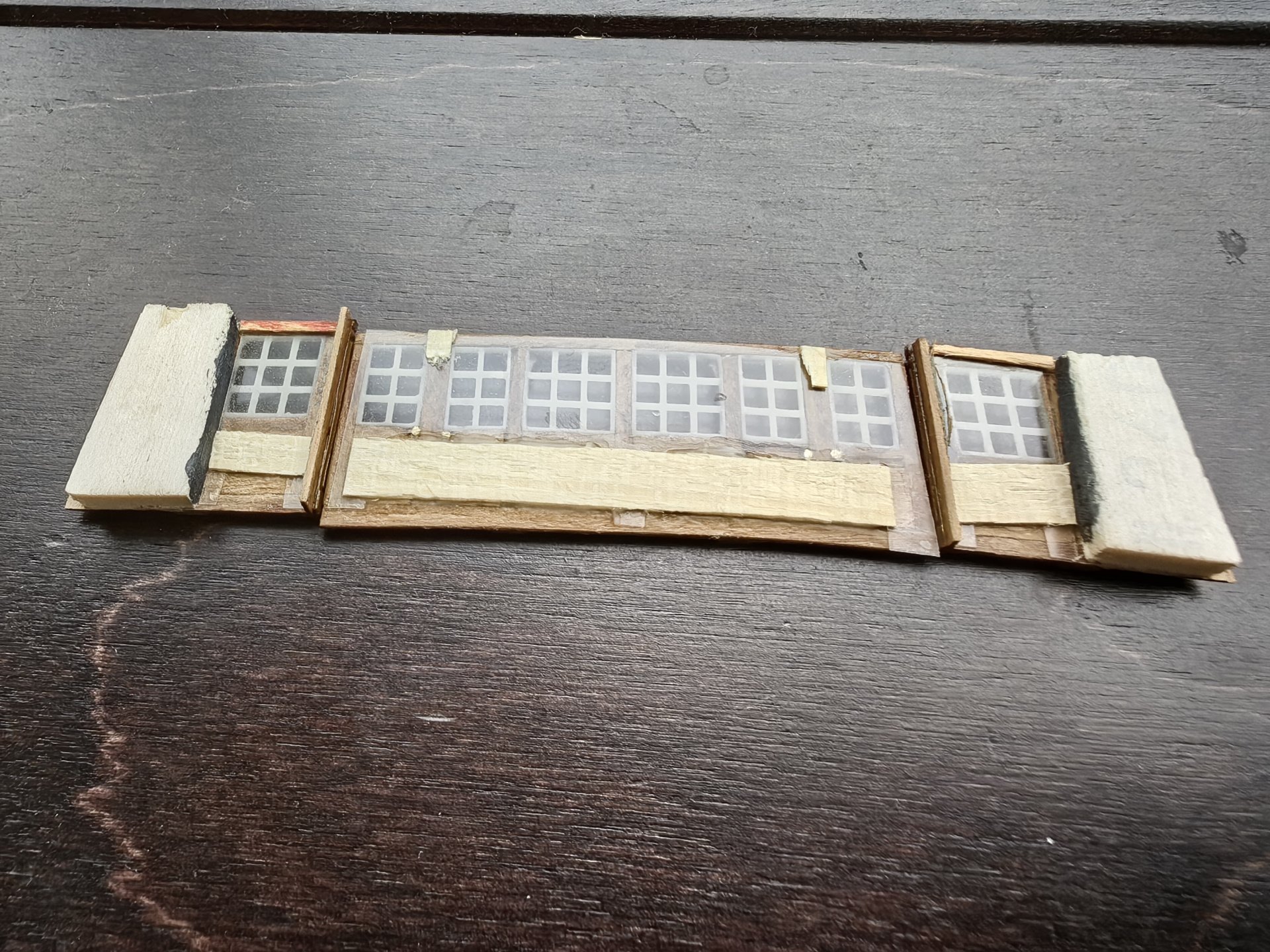

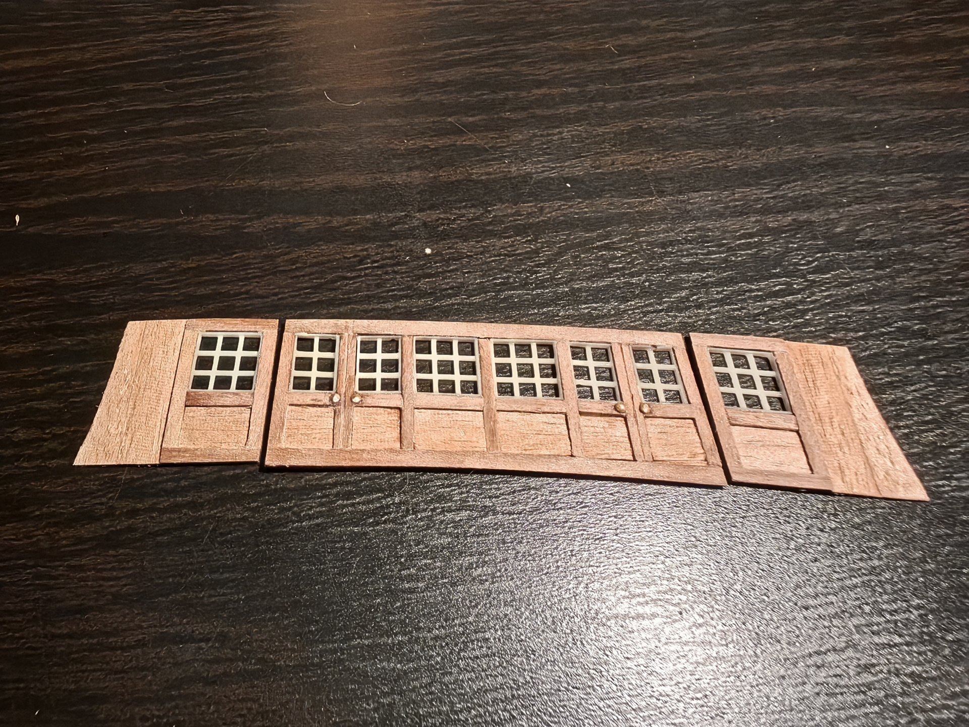

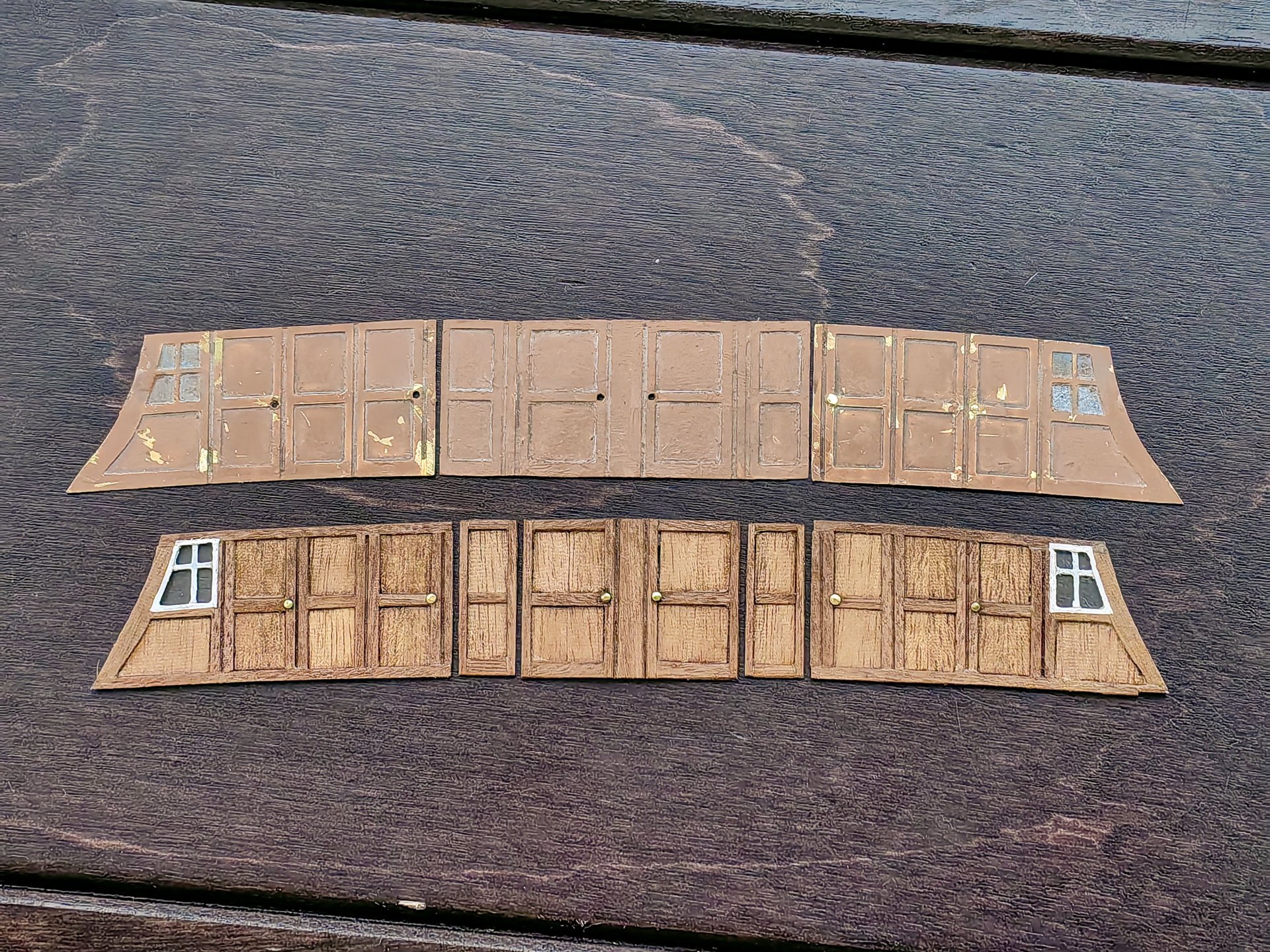

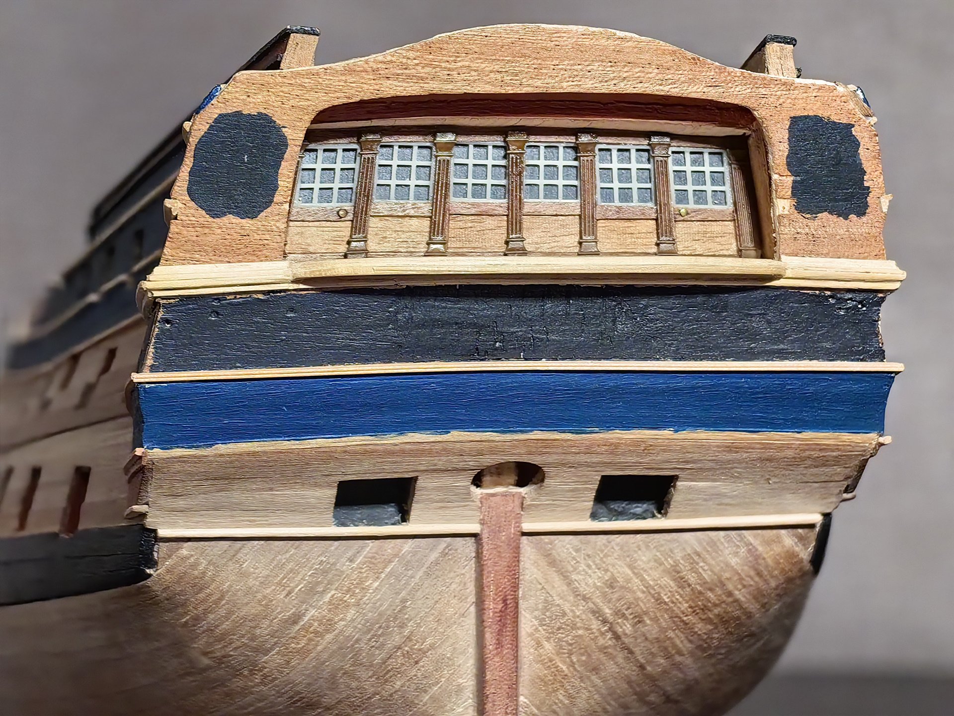

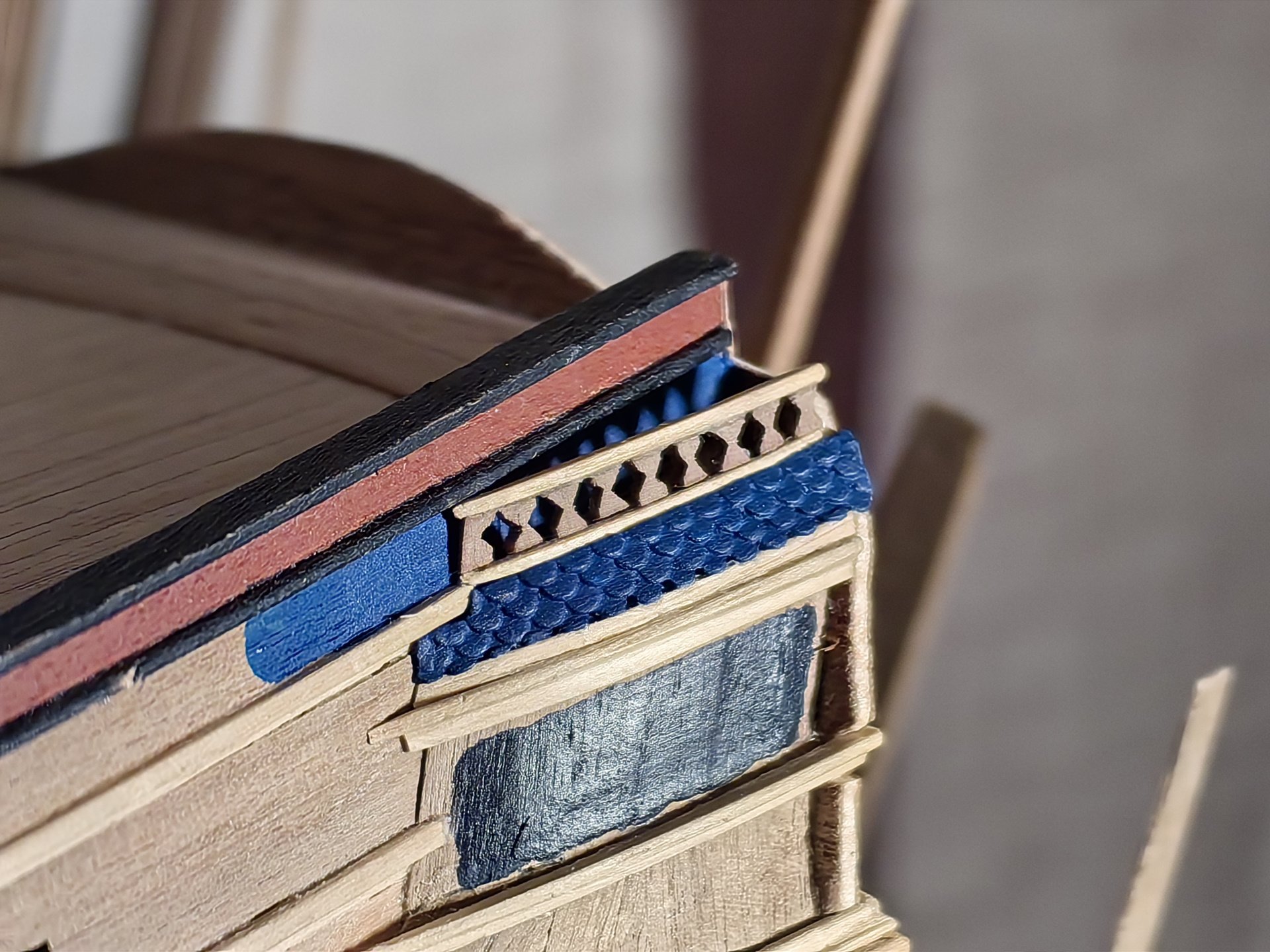

I decided to make a stern sink, not an imitation, as Corel suggests, but as it was on the prototype and on the museum models. To do this, I had to cut out a part of the afterdeck deck. There is a beautiful decor on the inside of the sink, but I'm not a good artist, so I just painted it red. I may add an applique later. I also experimented with the colors of the exterior paint and the decor of the side balconies. I'm not very satisfied with the result, so I'll probably redo it.

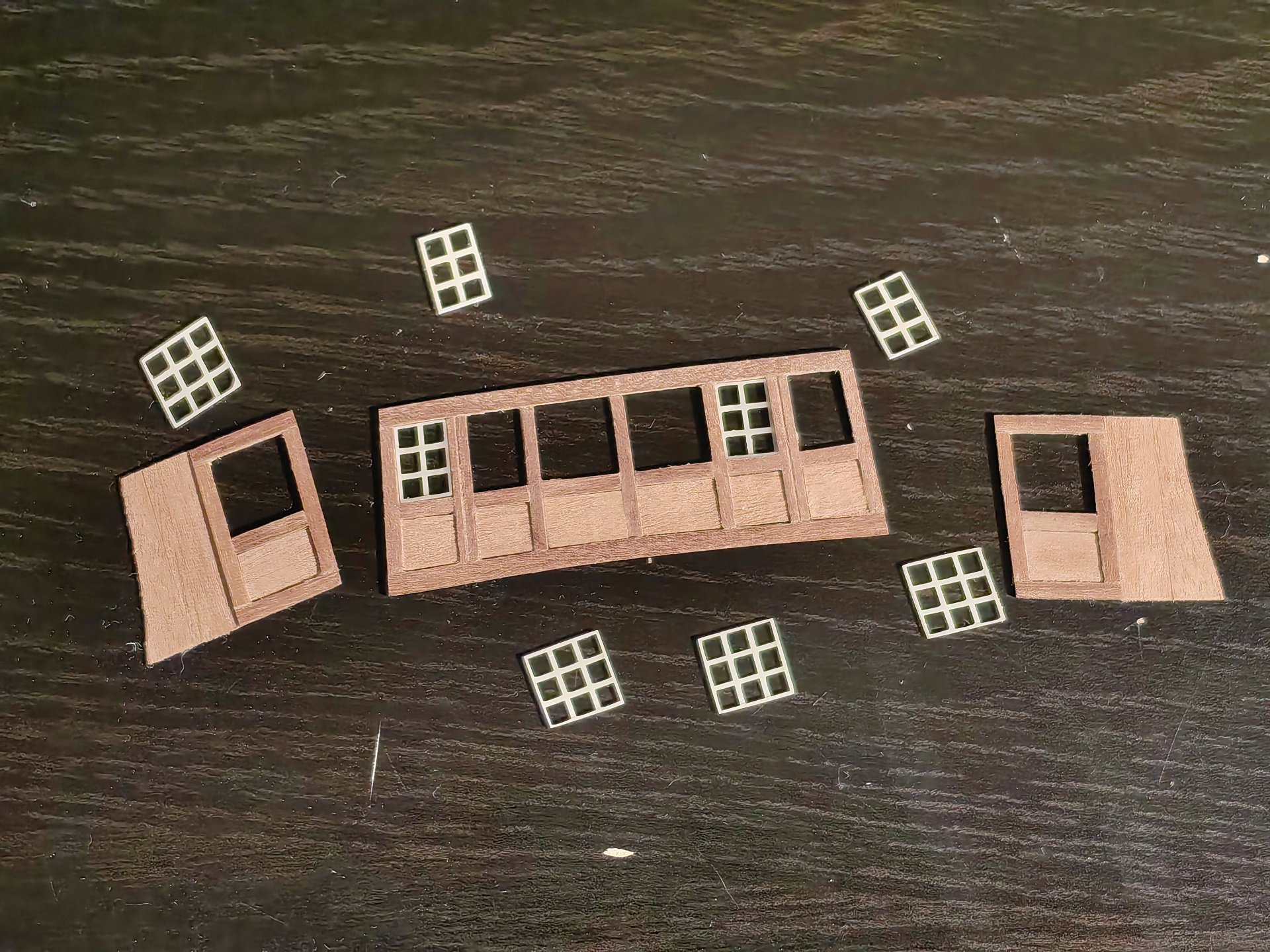

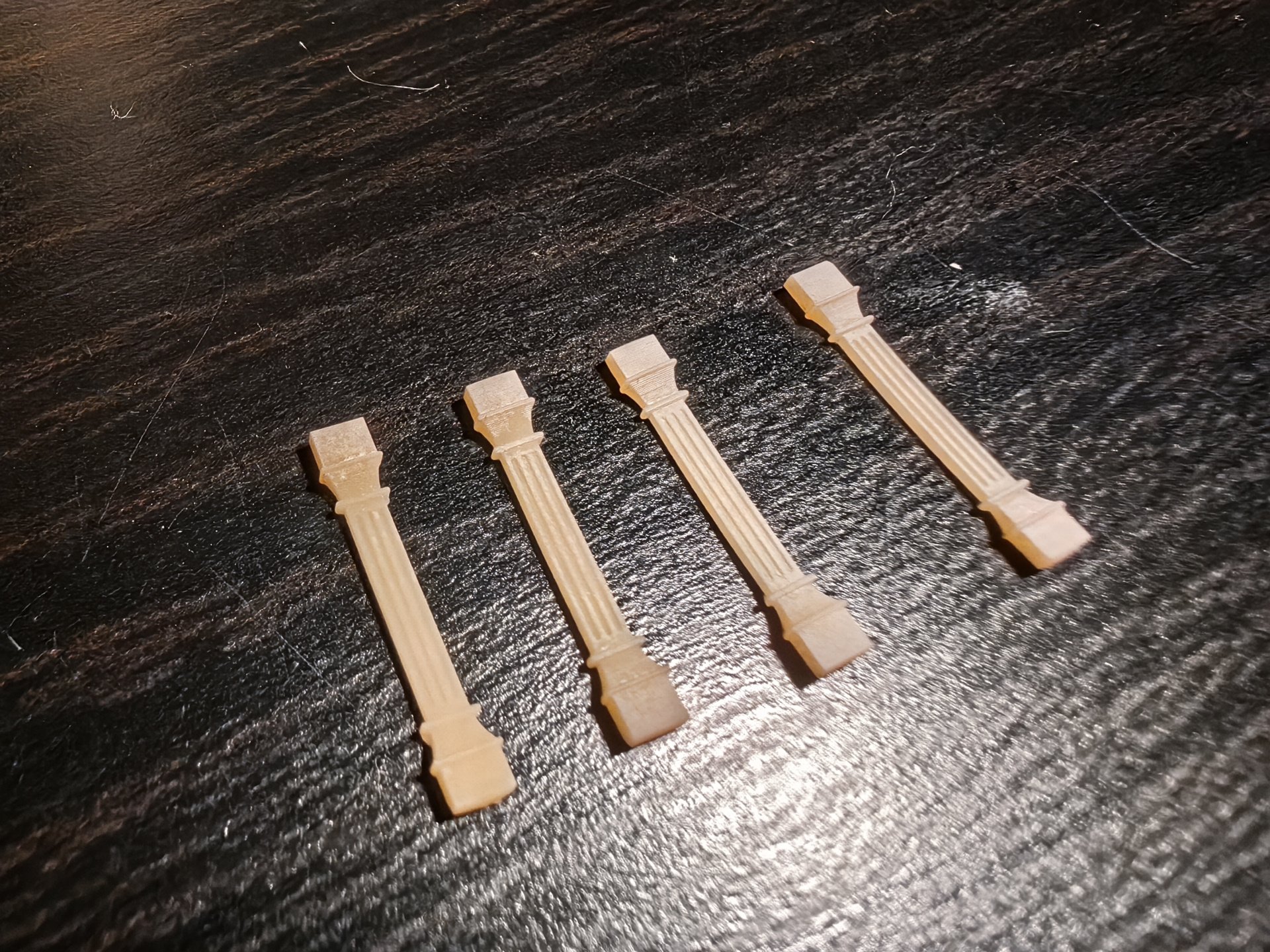

I don't like the way Corel's proposed aft gallery bulkhead looks, so I decided to do it my way. At this scale, the window frames should be very thin. I don't know how to make them out of wood, so I printed them on a 3D printer. Same with the columns. I used a smartphone screen protector as a glazing simulation. I painted the wall of the frame opposite the window frames a dark gray color. In my opinion, it turned out better than the stock version. I like it. I think I'll tear off the stock bulkheads of the forecastle and quarterdeck and make them the same way.

Hi Frecap
I love what you've done at the stern on your Bellona model!  You've really got the curvature in the wood done excellently.  I hope I can achieve the same with my build, though I'm a long way behind you, so that'll come much later.

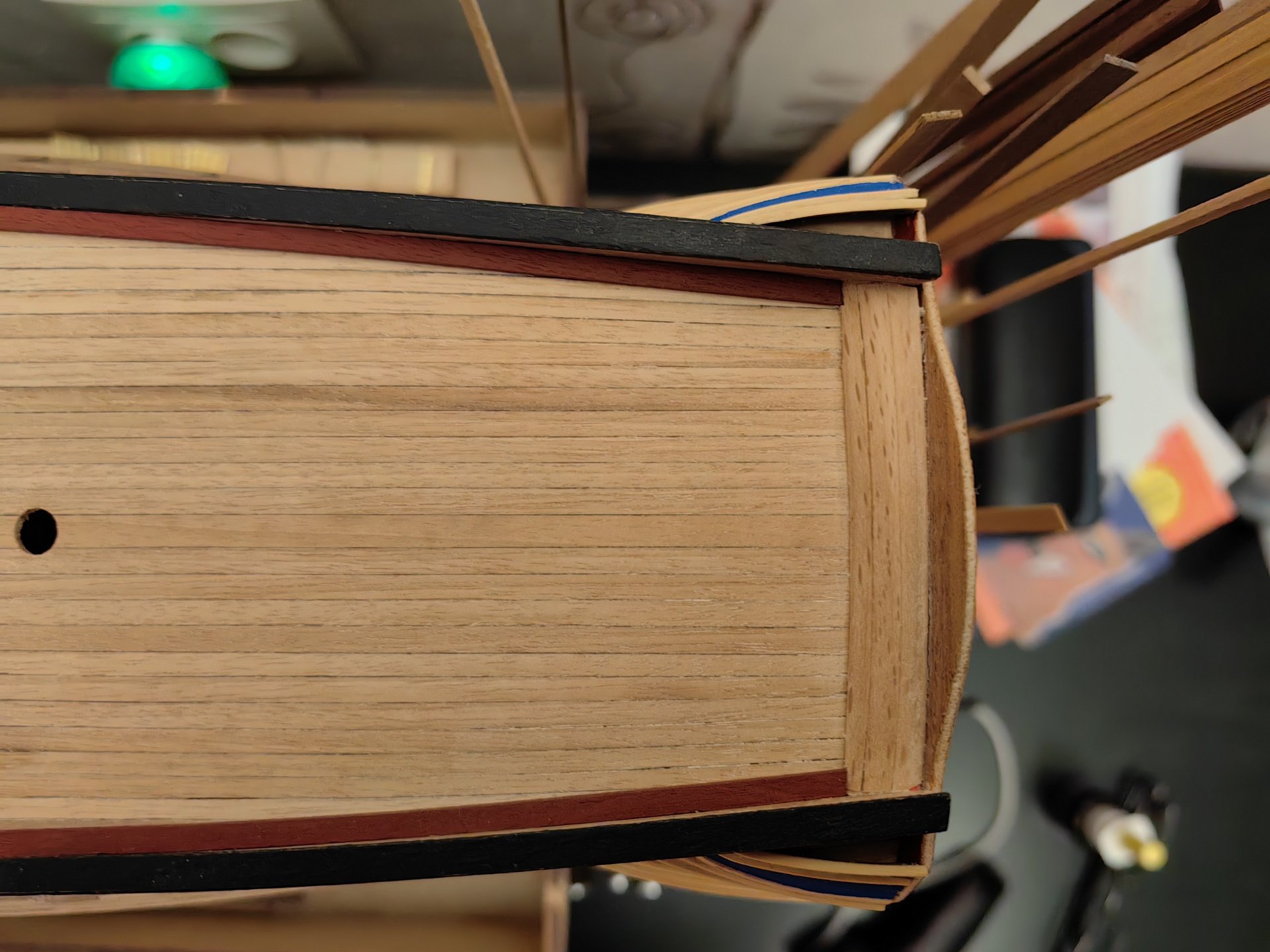

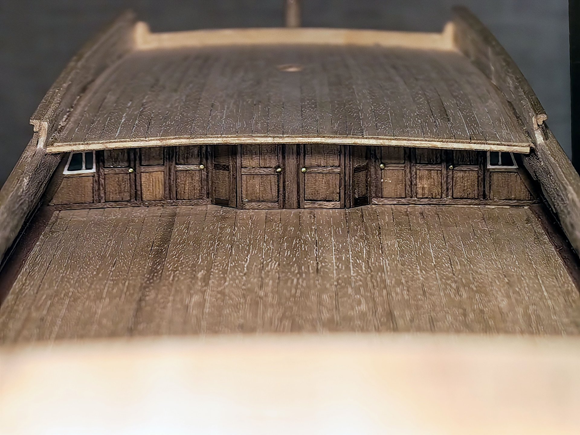

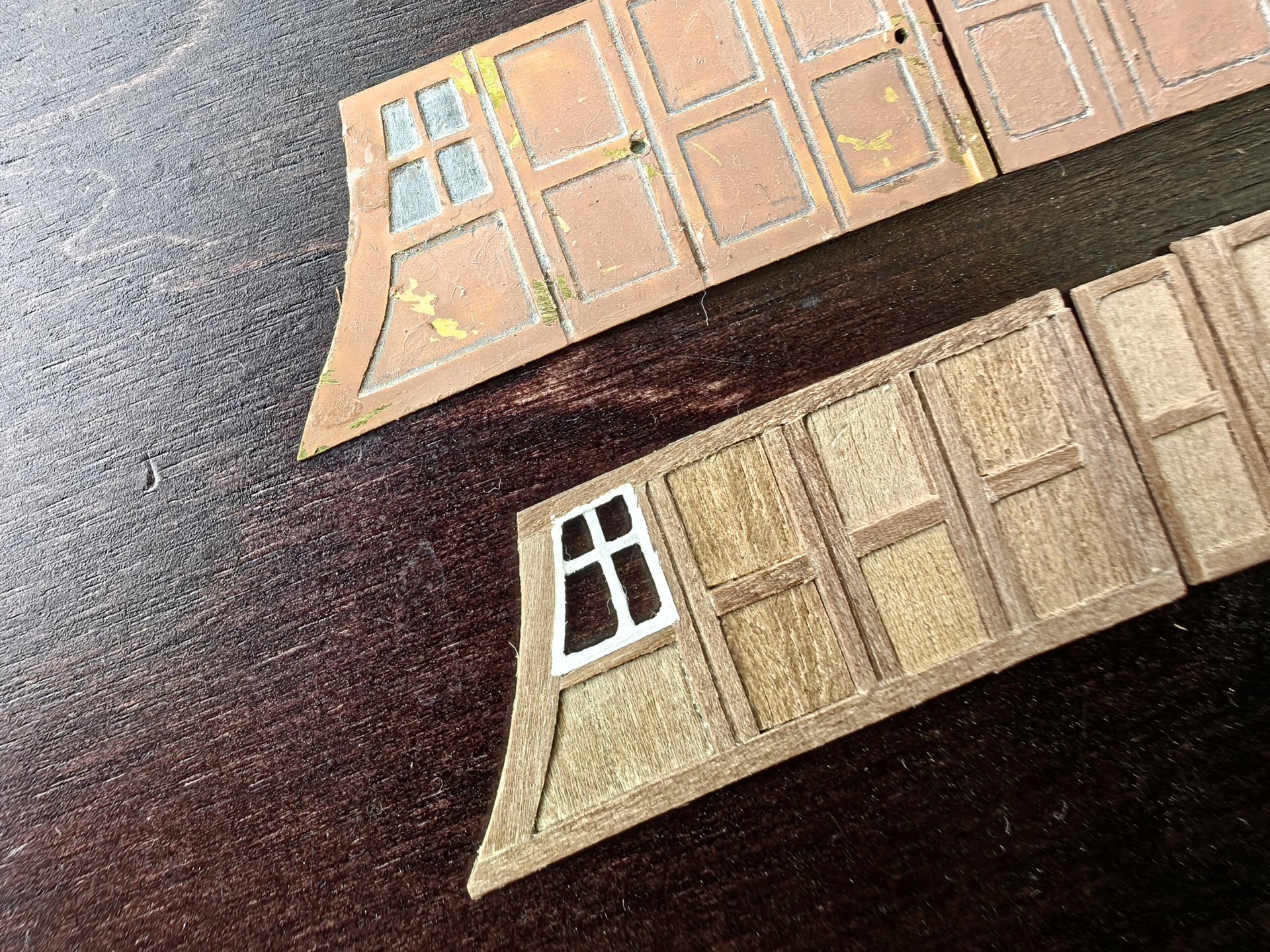

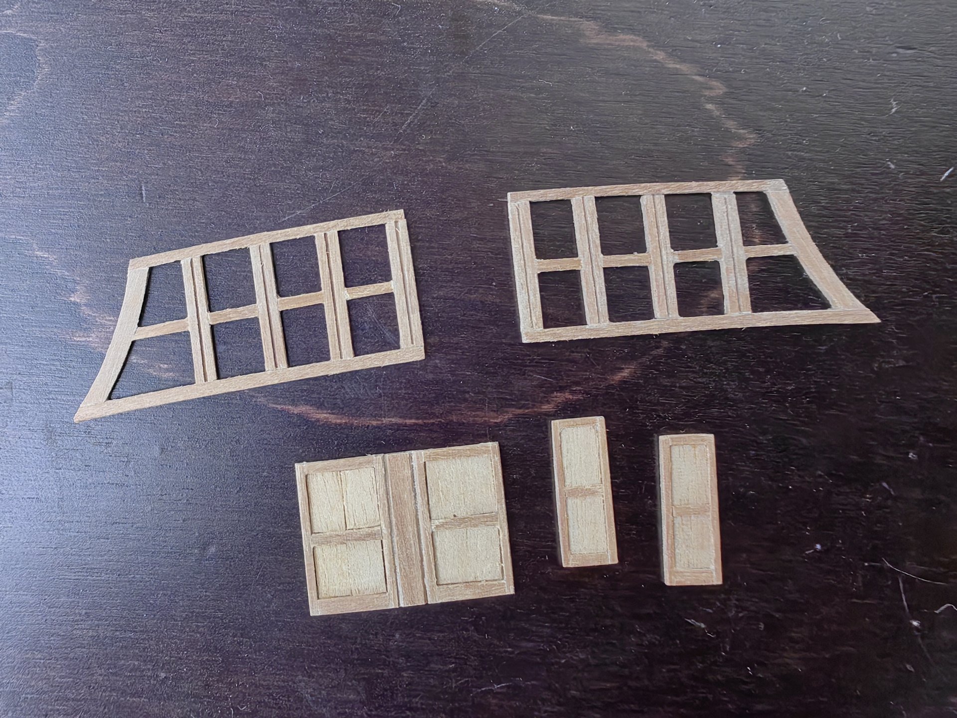

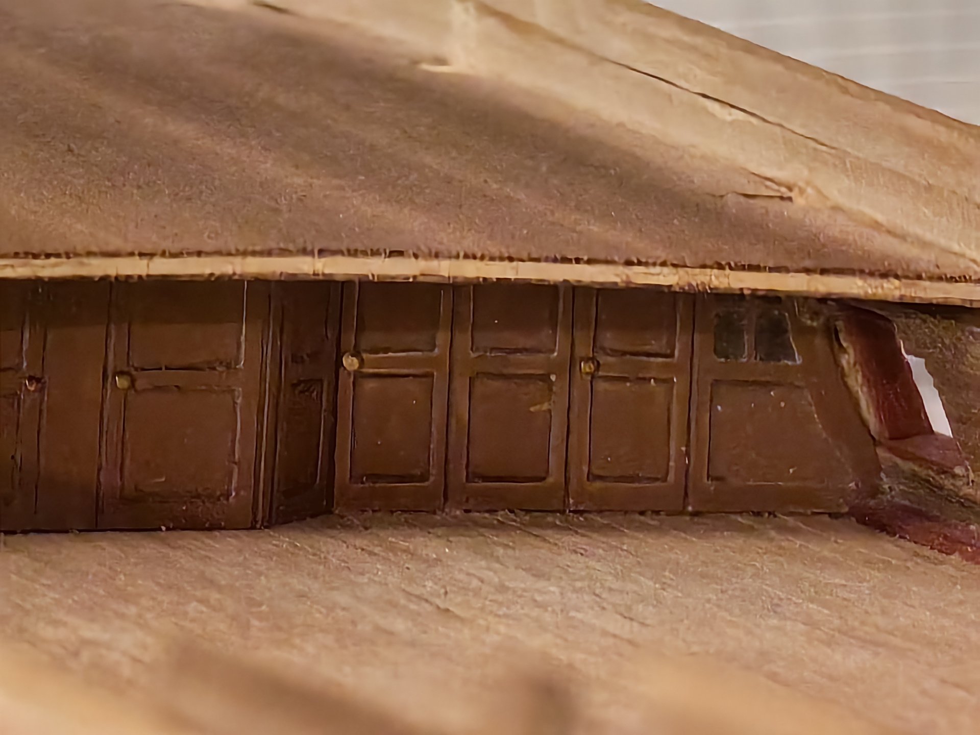

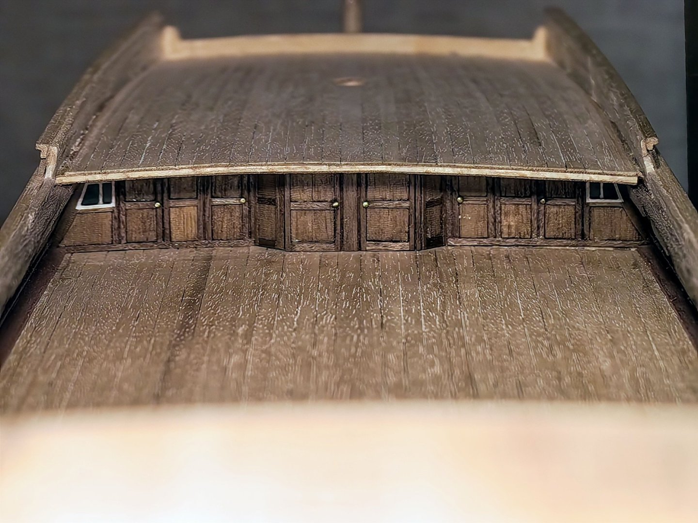

 While I'm trying to figure out the sequence of work on the quarterdeck deck, I'm slowly getting into various small tasks. For some reason, nothing happens until you put your hands to it) So I started working on the cannons, but I'll post photos of these projects later. In the meantime, as planned, I replaced the quarterdeck and forecastle bulkheads, making them similar to the aft gallery bulkhead. I've already installed the forecastle bulkhead, and I'll install the quarterdeck bulkhead once the deck is completed.
Hi Frecap,
I really like what you have done with the bulkheads. They look much better than the PE parts that are supplied with the kit. You are doing a very nice job and you are inhancing the look of this kit with the parts you are making from scatch. Looking forward to seeing more of your inovated ideas and technics. Your Bellona is looking great!!
Nearshore

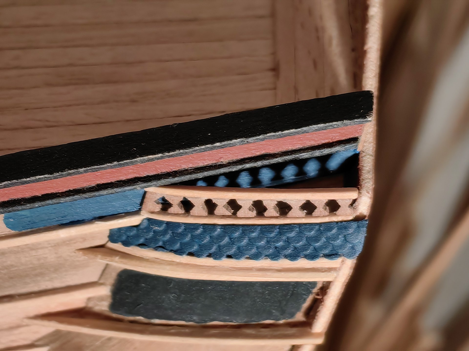

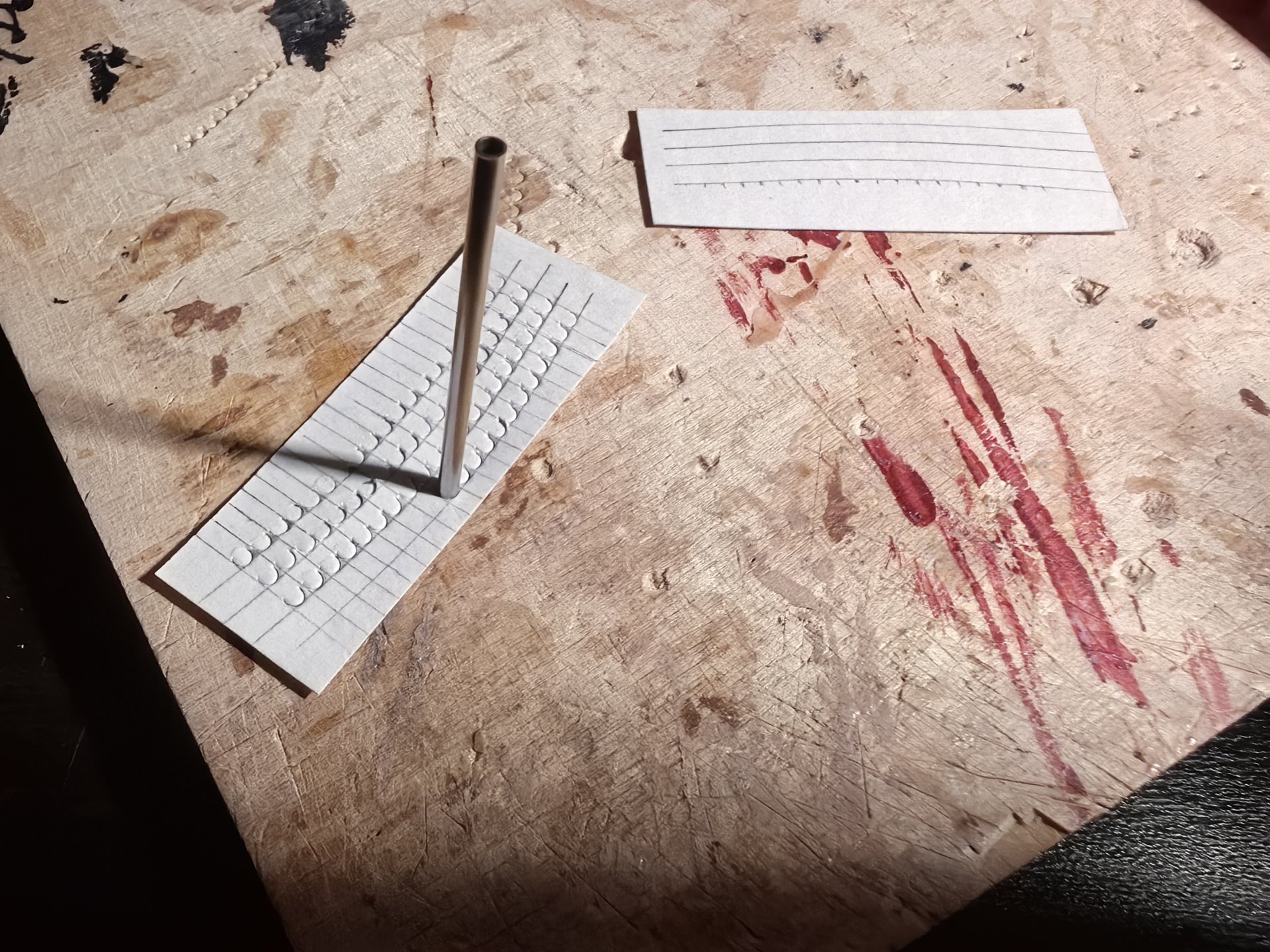

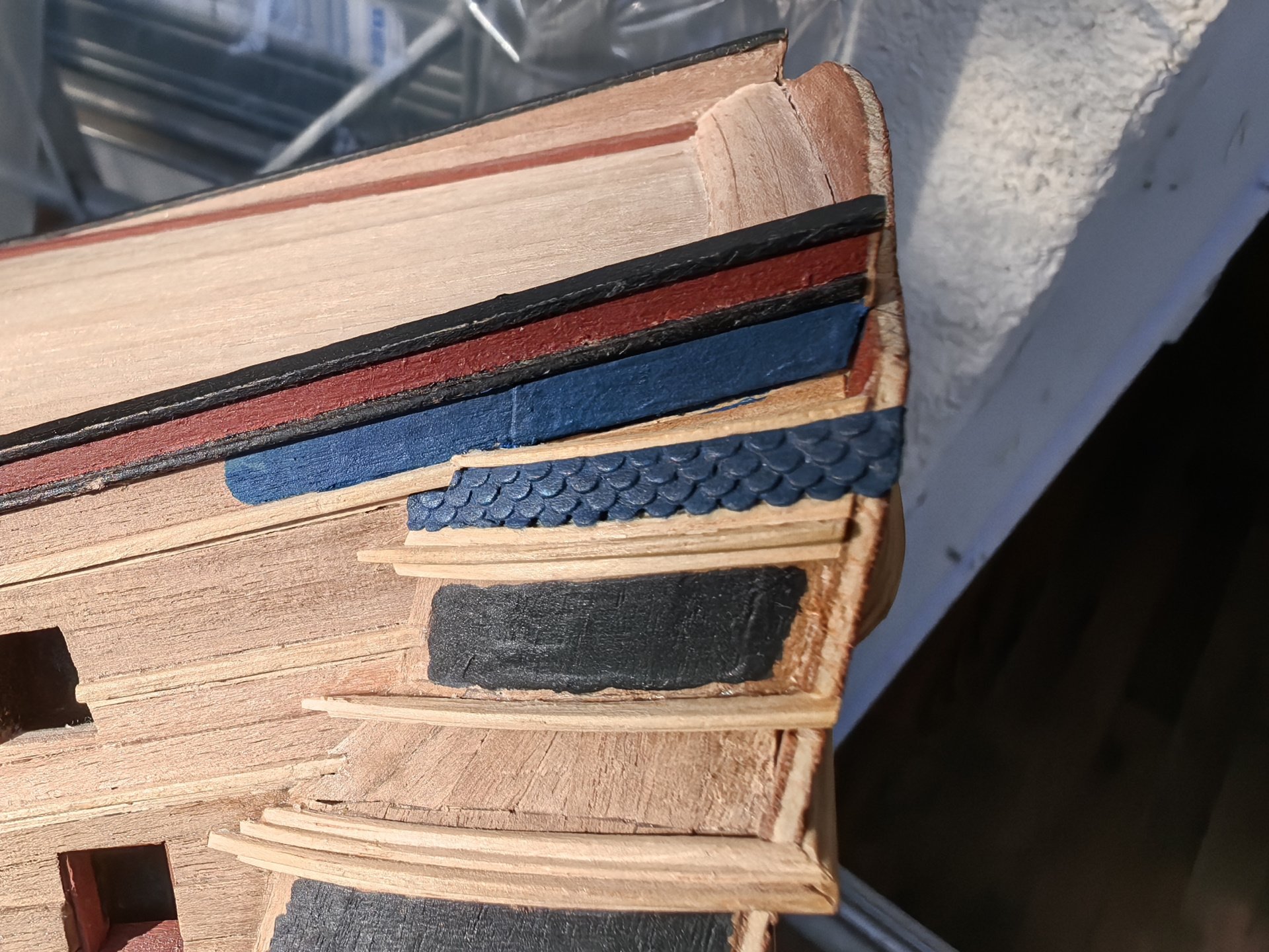

Bellona had a long sailboat-like life. Apparently, she went through a number of repairs during this time. The original painted bottom was covered with copper sheathing, and the pattern on the sides changed several times... Although Charles Middleton's model is not a Bellona-class model, it provides us with an idea of one of the possible paint schemes. I believe that each modeler has the freedom to determine how their ship will look. I would like to follow historical accuracy, but at the same time I want to do what I like personally. And the color scheme of the Middleton model is not very satisfied. In addition, the material that I got in the set of Corel is completely inconsistent with this model. But I want to observe some points. Such as the black color of the barhout and the blue background with ornamentation on the bulwarks, stern and fore. I don't know if I'll be able to draw an ornament on a blue background, but I've decided to create the background itself. This is the point where I have to make a decision about the sequence of further work... Until the quarterdeck deck is installed, I can't accurately calculate the location of the gun ports on it. In turn, it's better to paint the outer side when the gun ports are in place. And the main deck guns should be installed after the painting. It's a vicious cycle. Therefore, I've decided to paint the sides first and make adjustments later. So far it has turned out like this…

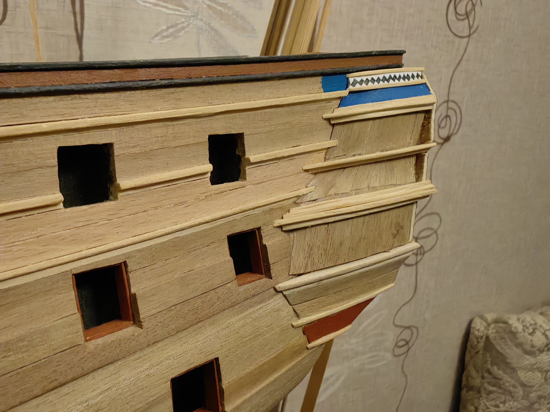

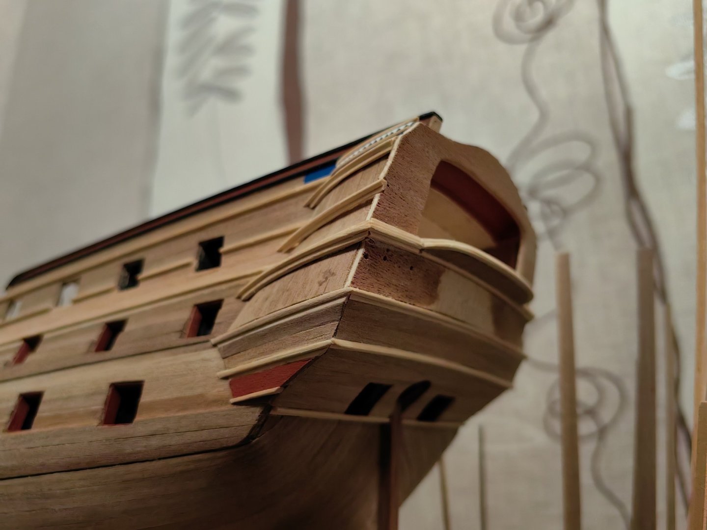

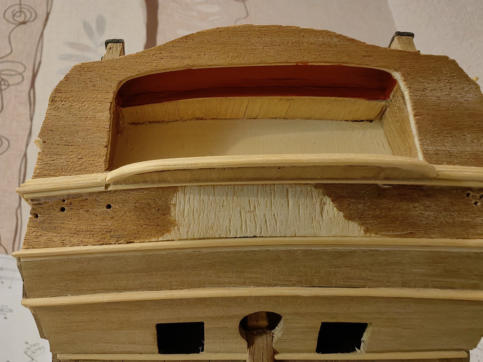

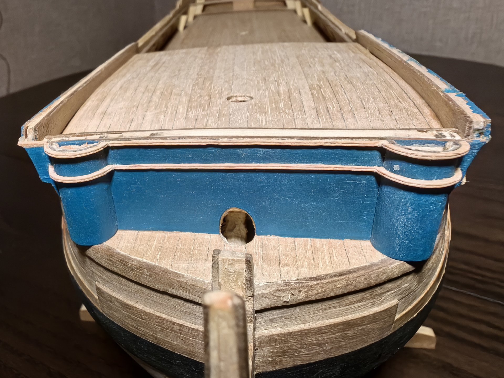

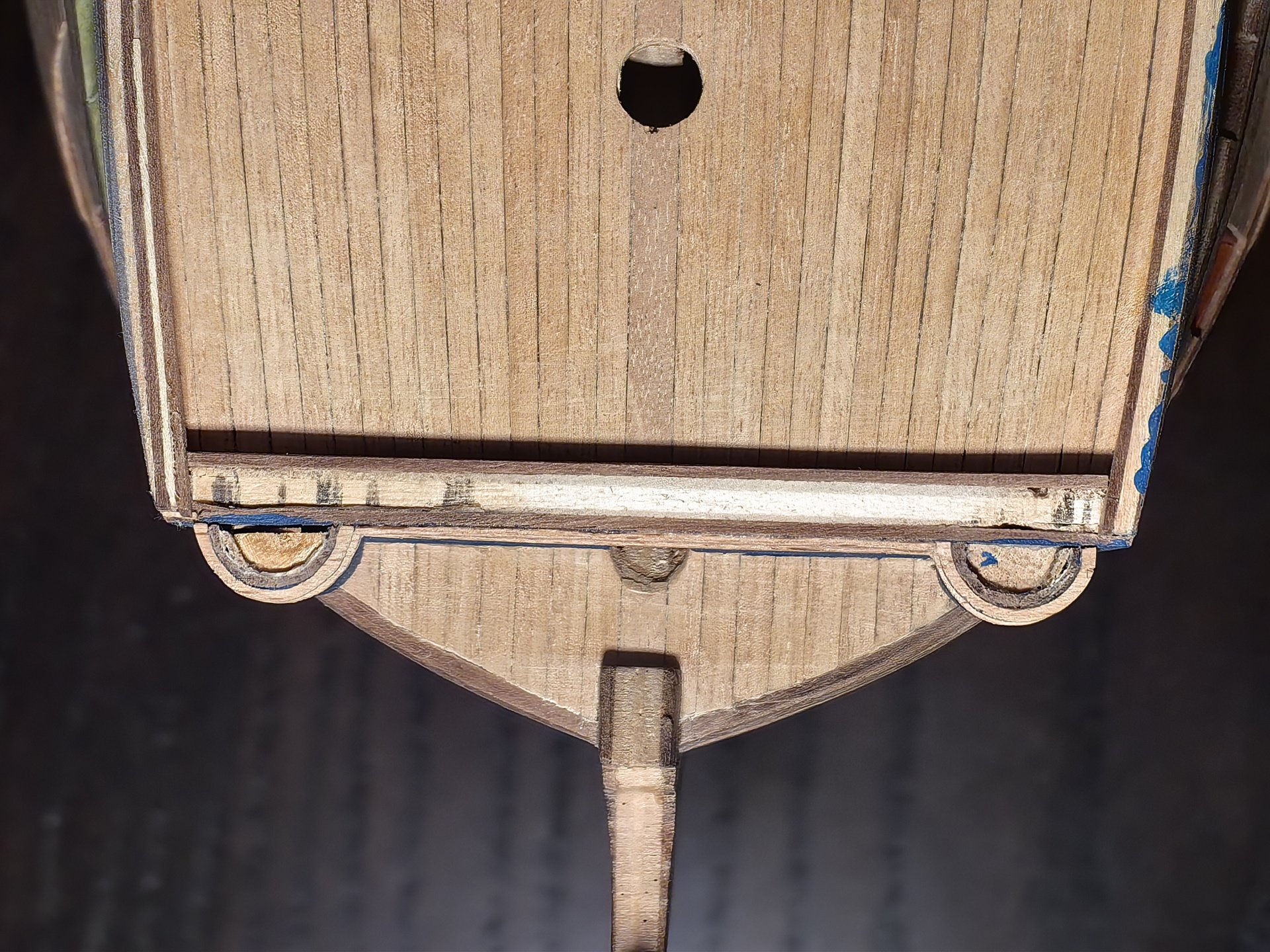

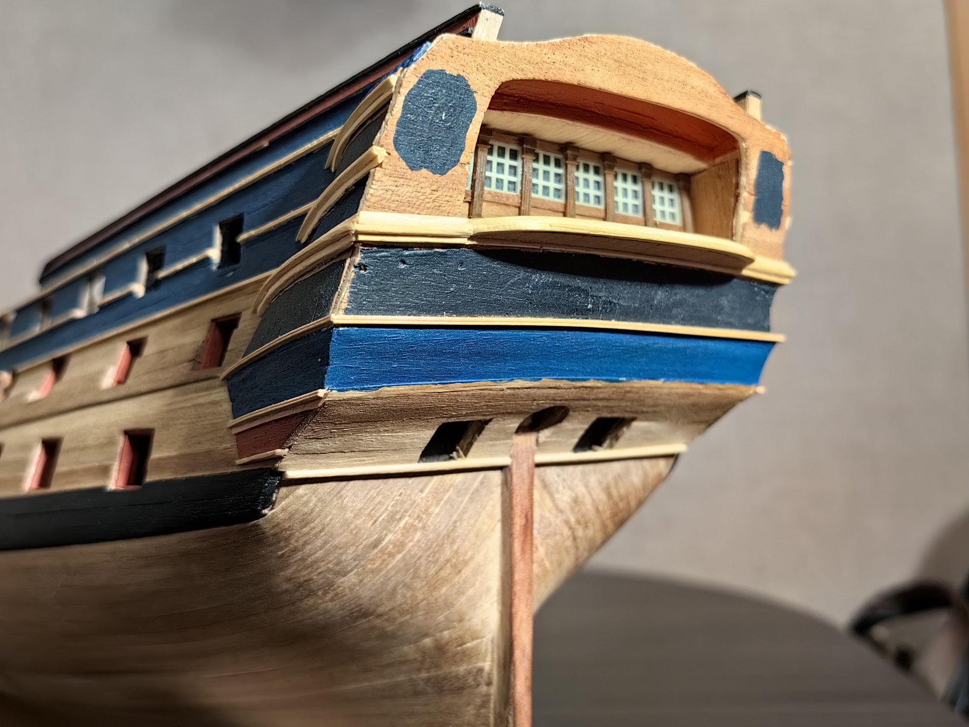

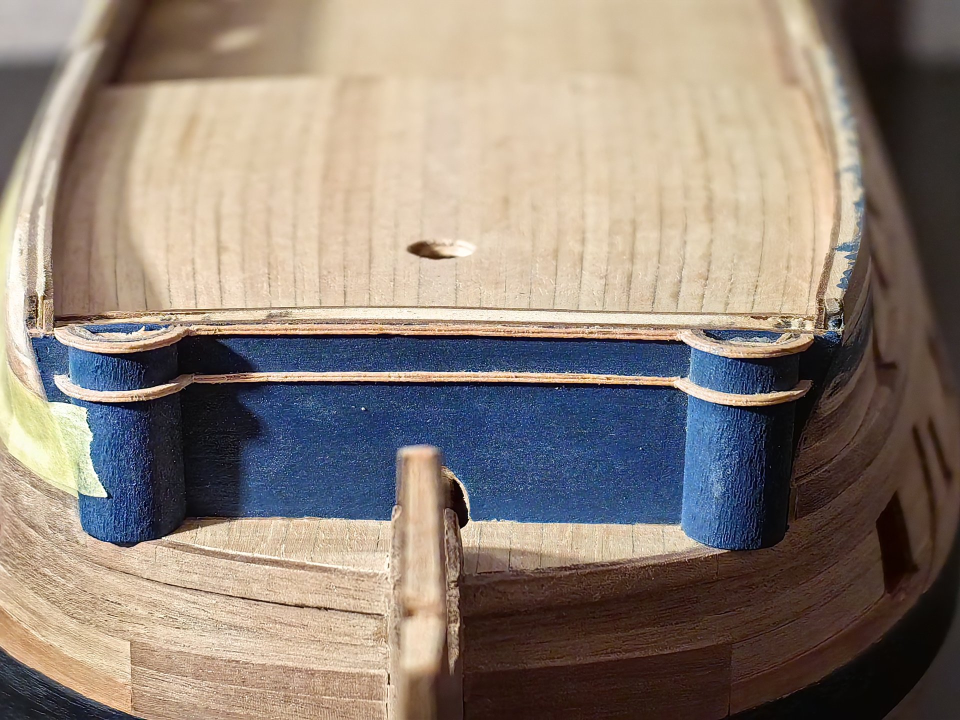

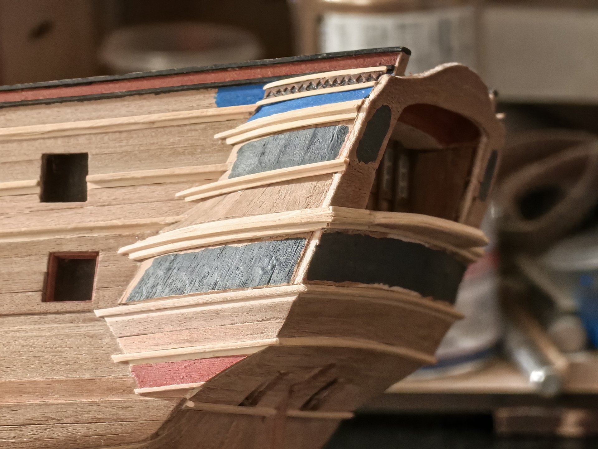

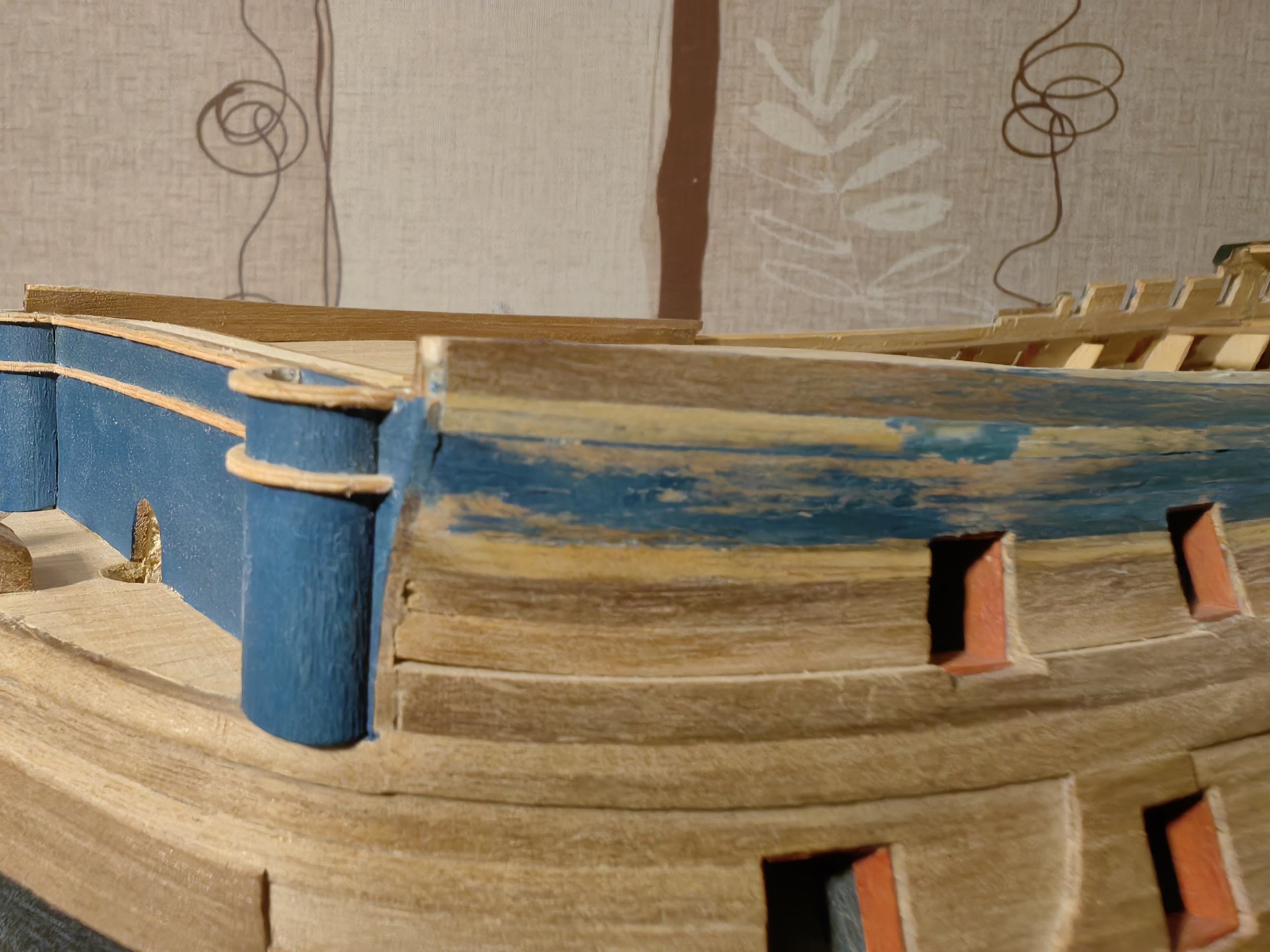

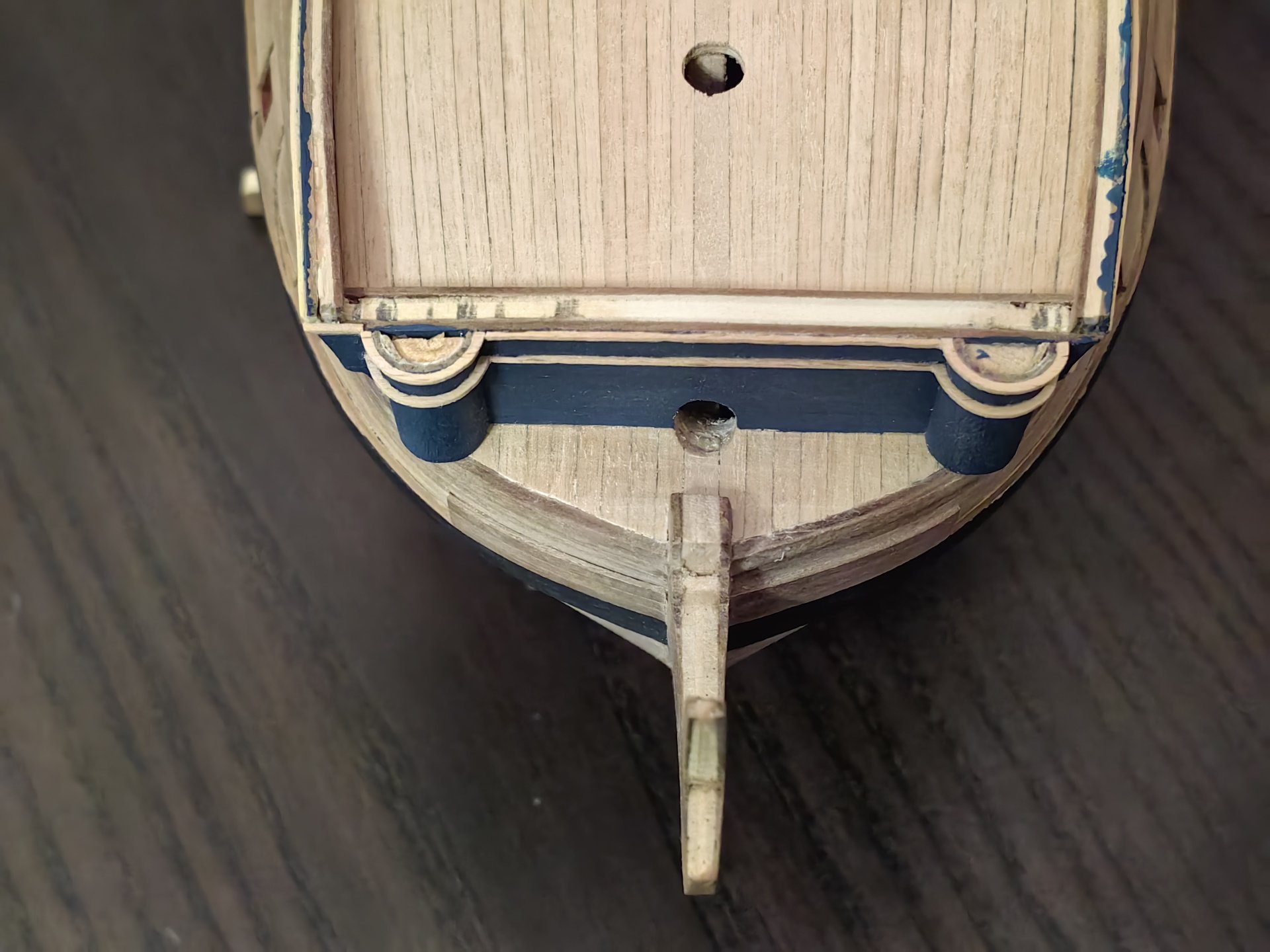

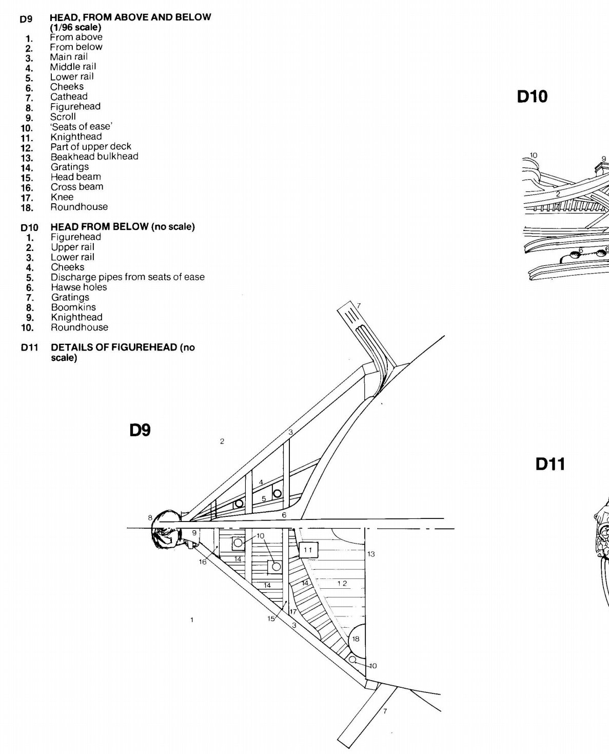

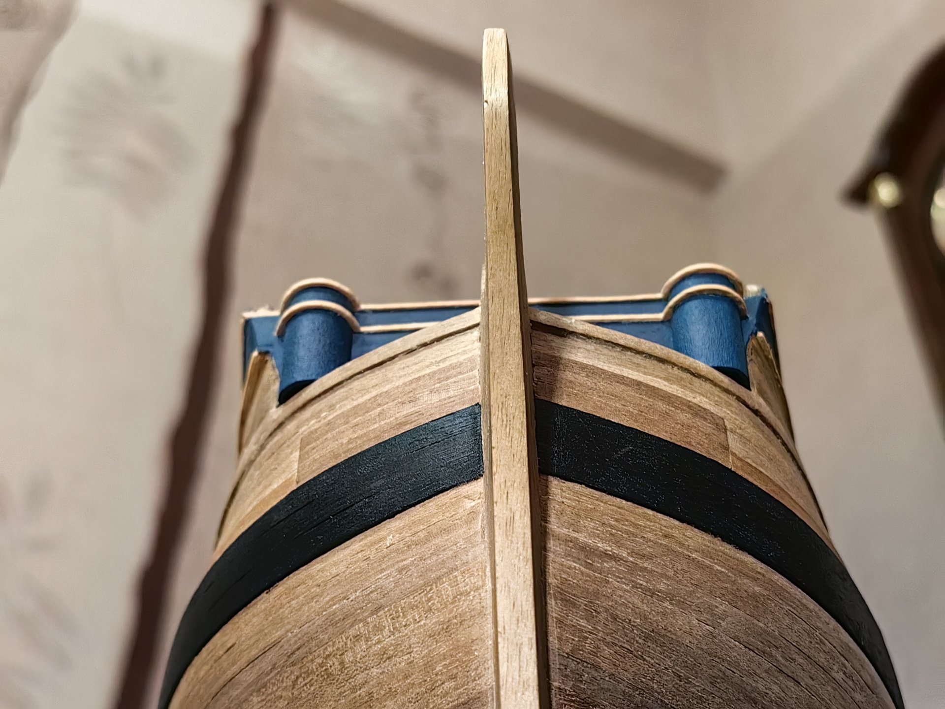

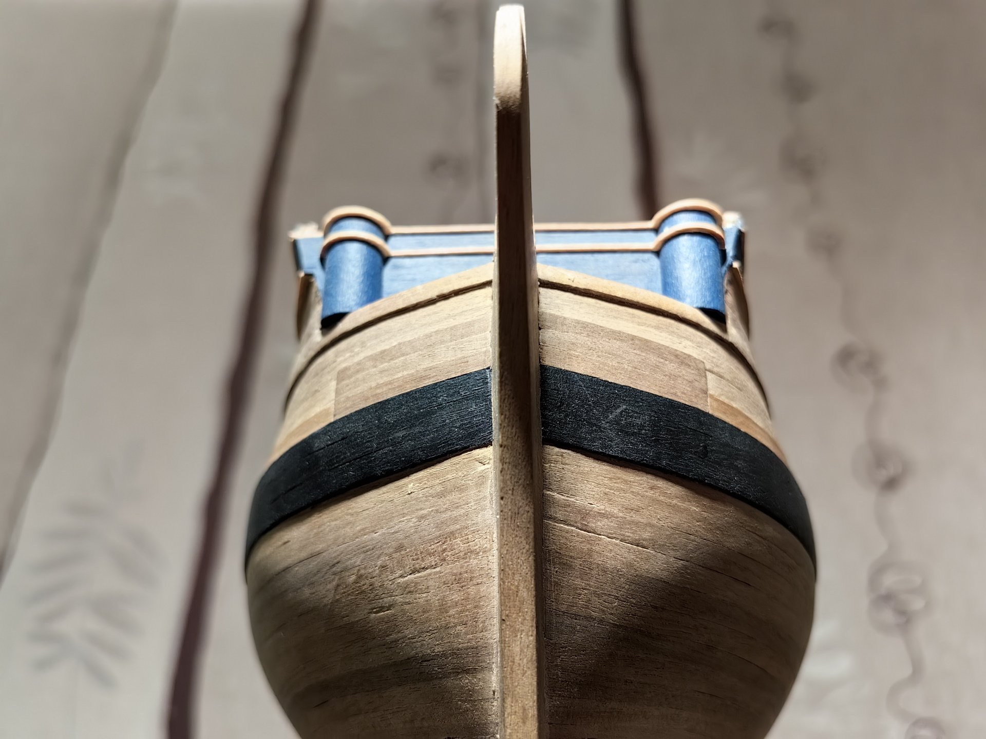

 When painting the model, in addition to the sides, the bulkhead of the Beak-head should also be painted blue. Therefore, I focused on this part of the model. I laid the deck and installed the roundhouse cabins, decorating them with rails. However, after assembling the Beak-head, I noticed a serious issue. In previous steps, I had made a mistake during the assembly process. As you can see in the photos, the upper part of the right bulwark has shifted significantly to the right. This definitely needs to be fixed while it's still possible. I'm thinking about the best way to do this. It might involve cutting off a portion of the bulwark from the outside and adding to it from the inside. It will take some time, but I hope the result is worth it!

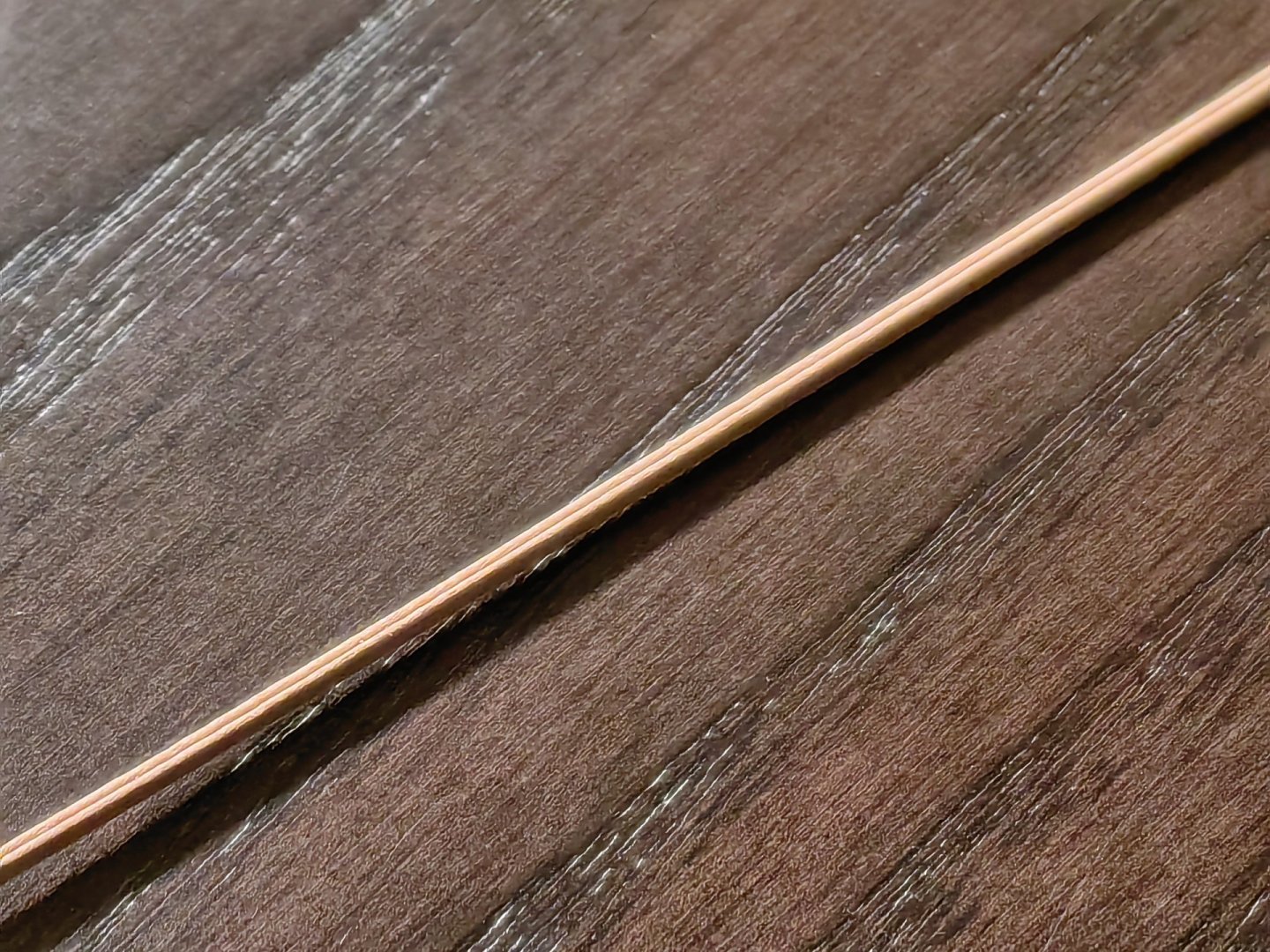

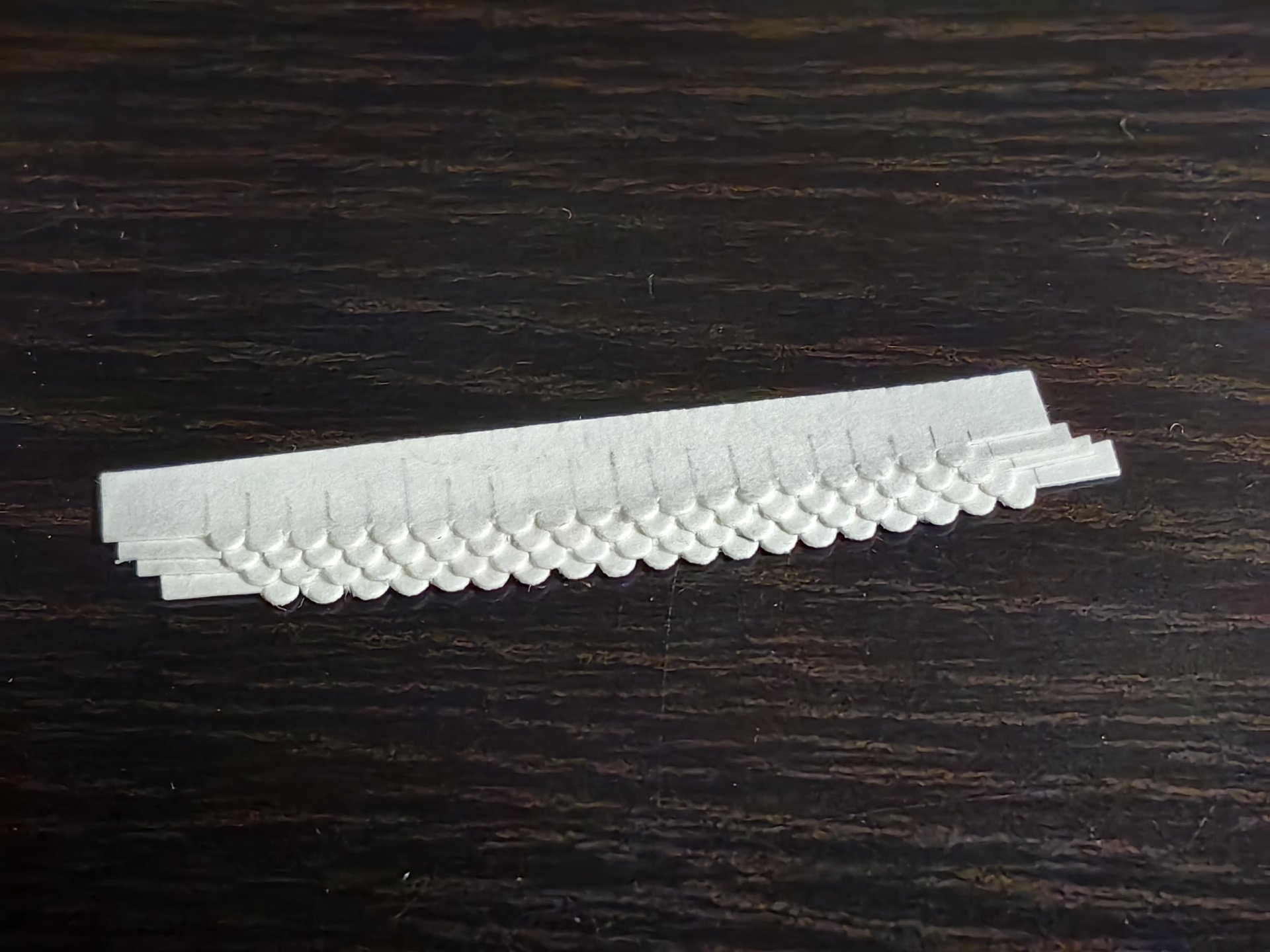

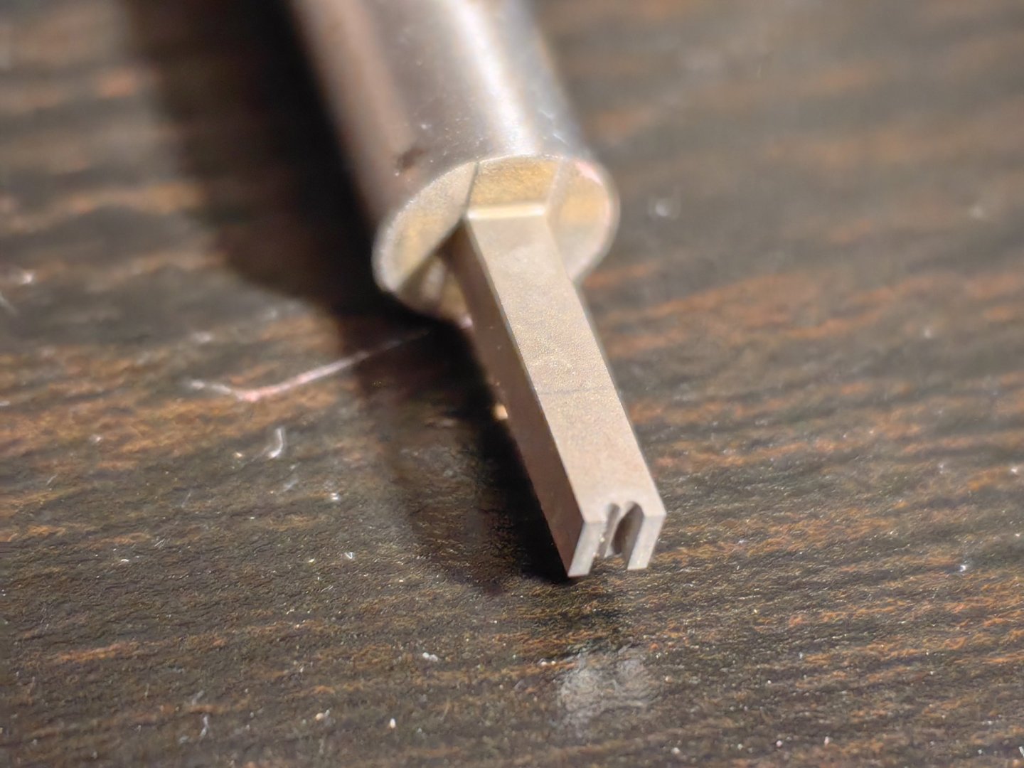

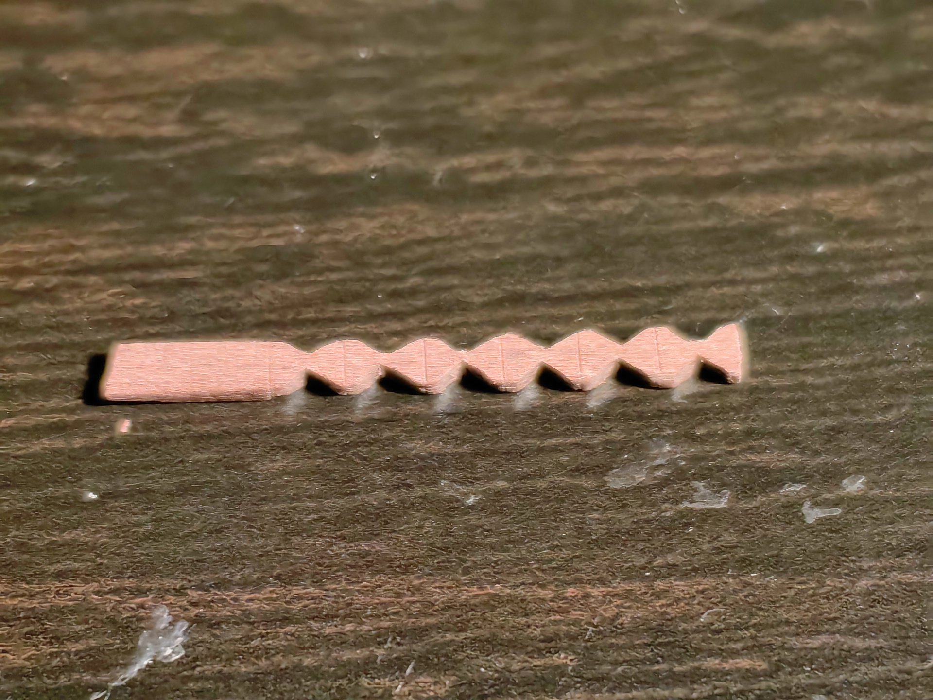

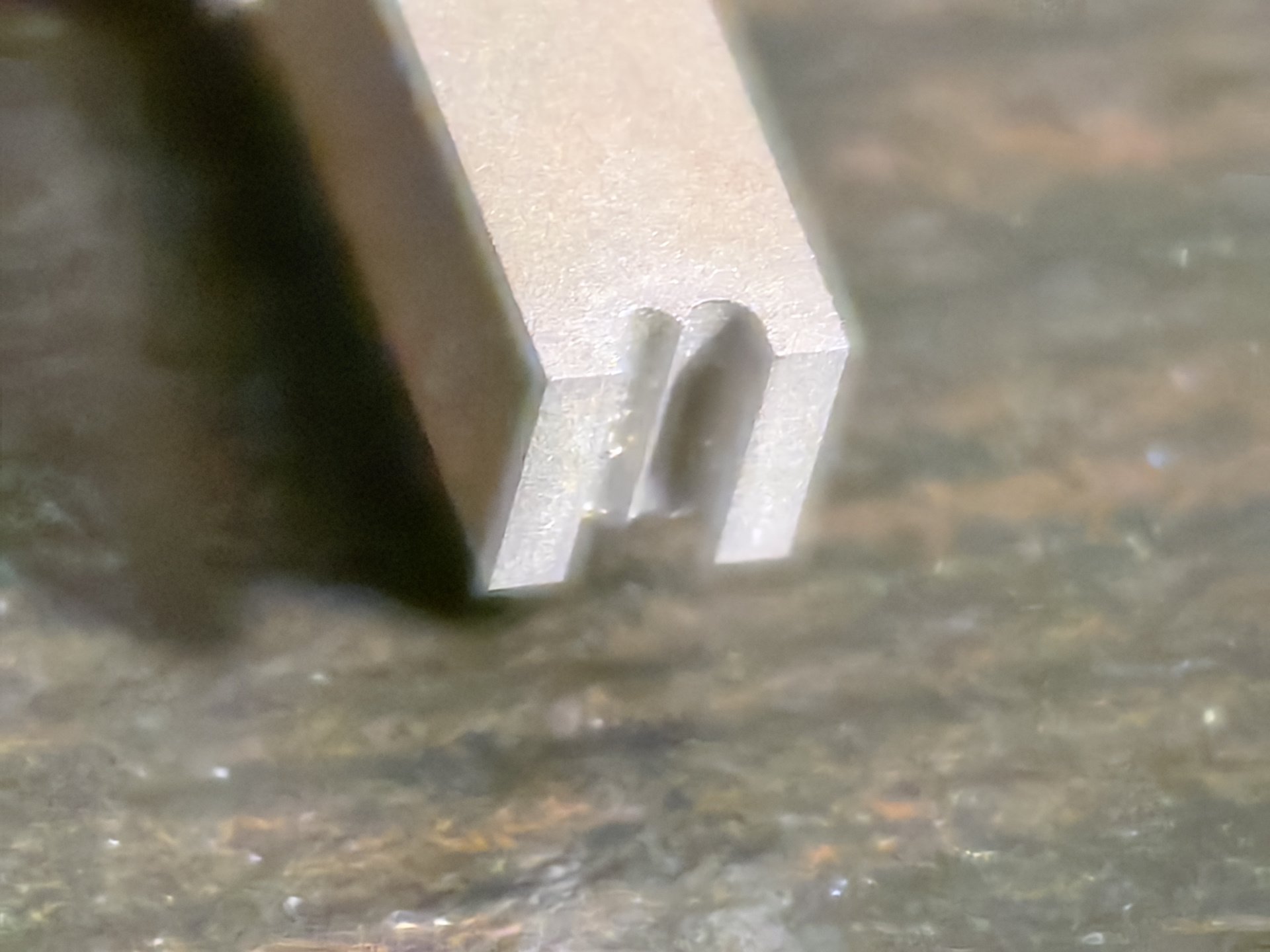

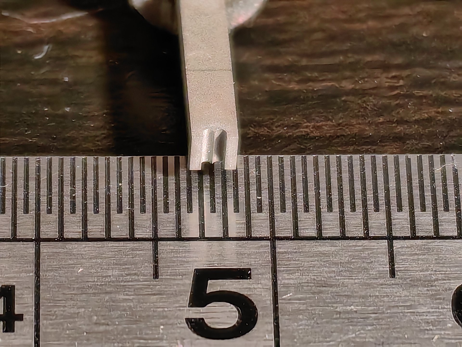

After analyzing the results of the painting, I realized that there were some nuances in my work that I didn't like. During the installation of the final trim, I encountered a problem where the L-shaped rails for the rails were difficult to bend, and in many places, they broke, causing chips and a less-than-ideal result. Although subsequent sanding improved the appearance, the rails still had a non-square cross-section. I don't have extensive experience in such tasks. I wouldn't use L-shaped rails now. I would simply stick a square rail on top of the skin and use a pear rail. On prototypes, rails almost always have a non-square, but a figured profile of various shapes. In a hundredth scale, this can certainly be neglected, but as I think, small details always decorate the model. I decided to make a profile on the rails. To do this, from an old valve from the engine, I made an appropriate tool with a profile groove 1 mm wide. 00111.thumb.jpg.70bbb4c964154b7ce775930225ec45a9.jpg00112.thumb.jpg.907c83707aa1530b5cb565a23e76e847.jpg00113.thumb.jpg.3ed7744600fd0791b0c20153382ba49b.jpg

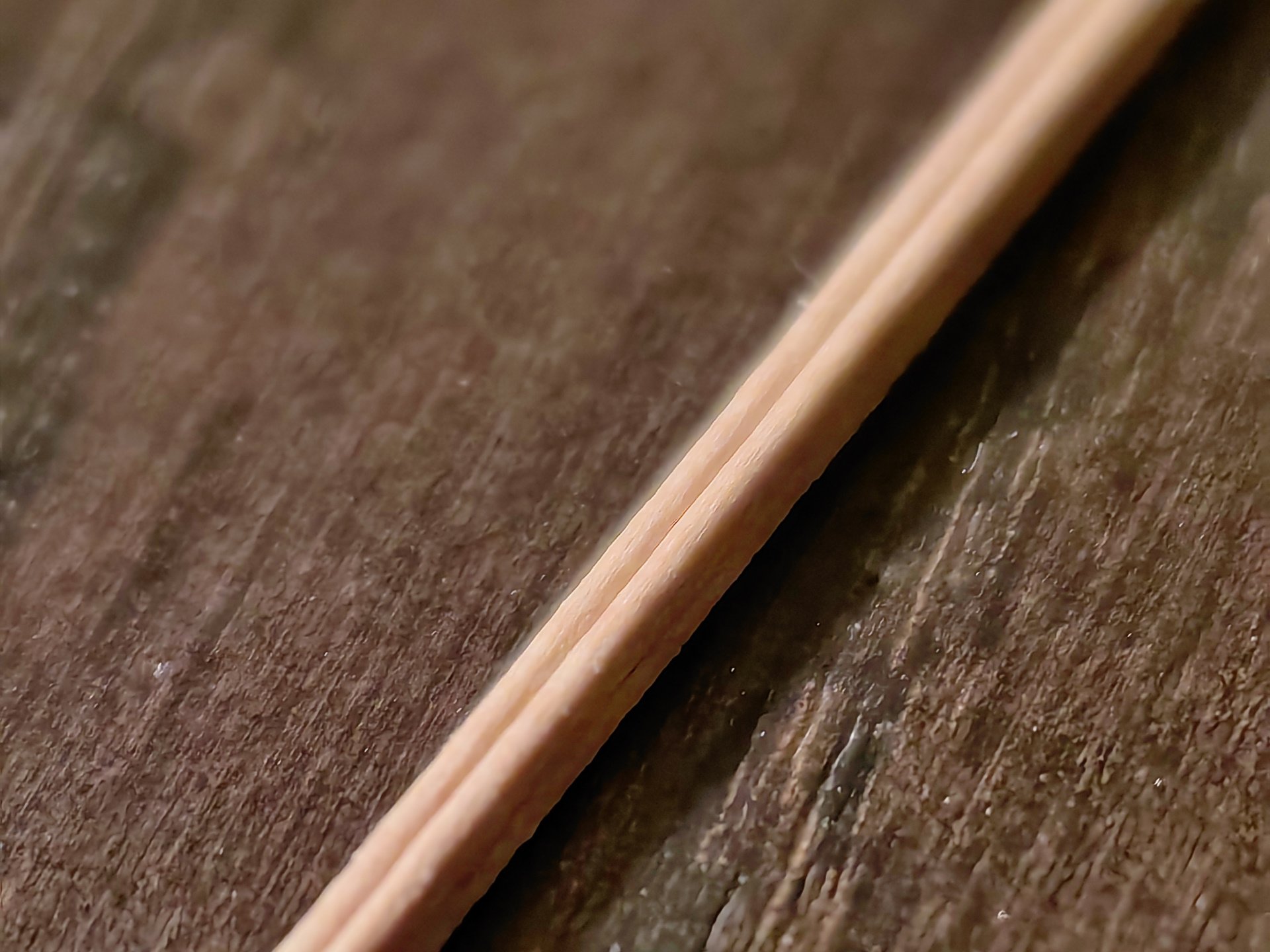

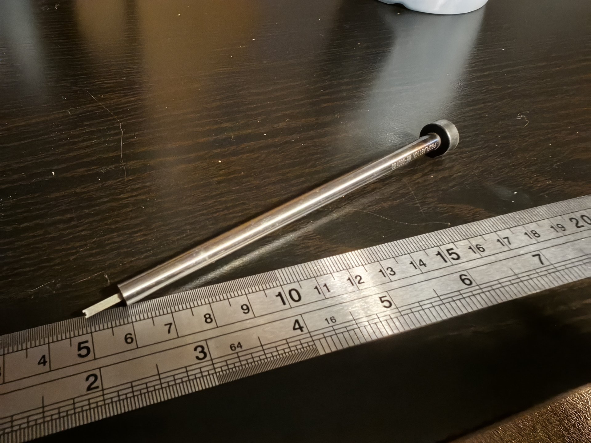

By using this tool to cut a rail along its length, i can create a corresponding profile.
This can be done on the model, but it's much better to do it in advance and glue the finished profile. The rail from the COREL kit is quite loose, crumbles, and the profile is of poor quality.
00116.thumb.jpg.f48ef80e2424b28cab853133f8ec6857.jpg00118.thumb.jpg.ff2e72c5f3fc50fb28aff1b0aa172ada.jpg00117.thumb.jpg.66c758d6ff4754eeba9f7318e4a2994d.jpg

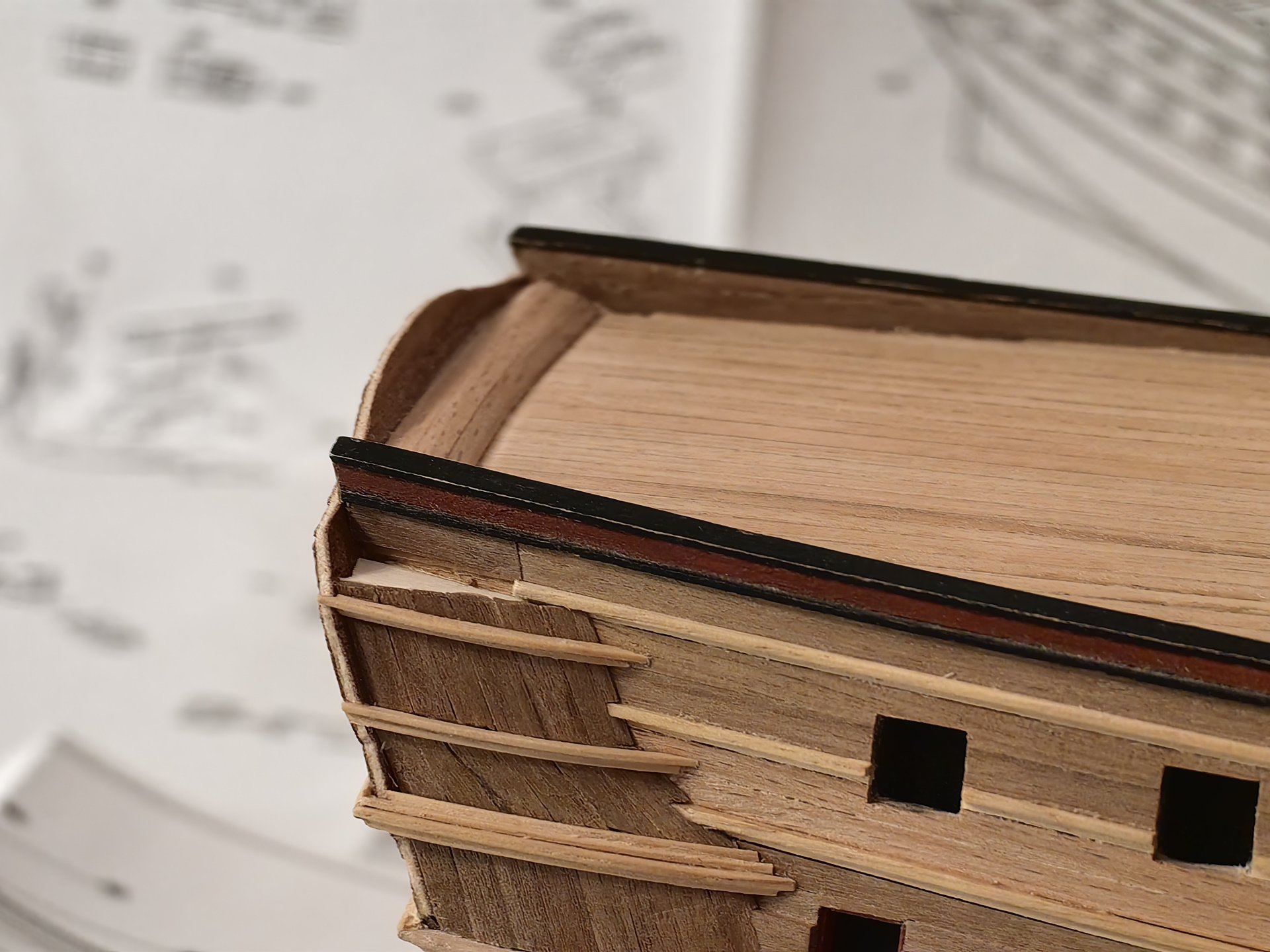

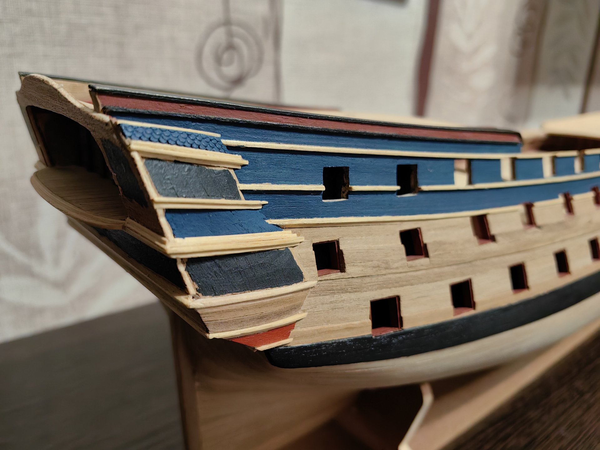

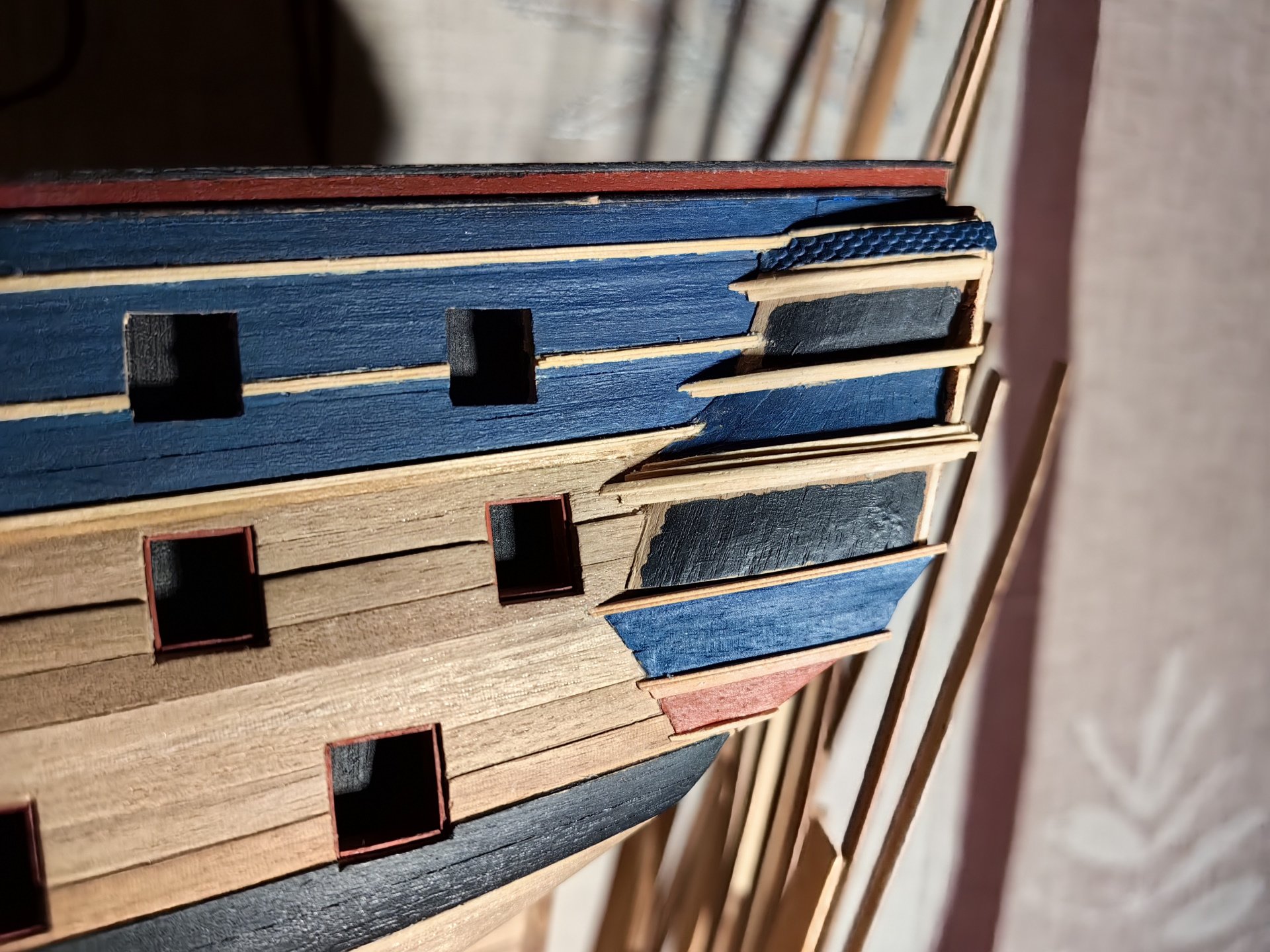

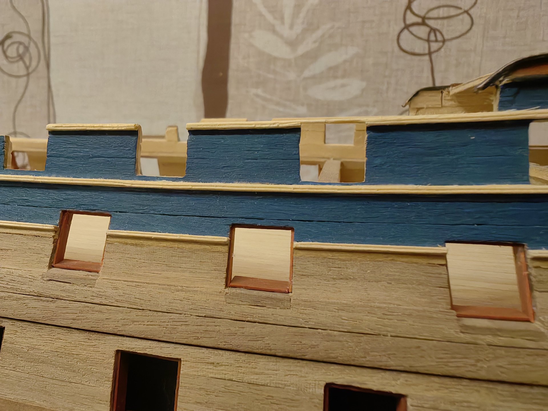

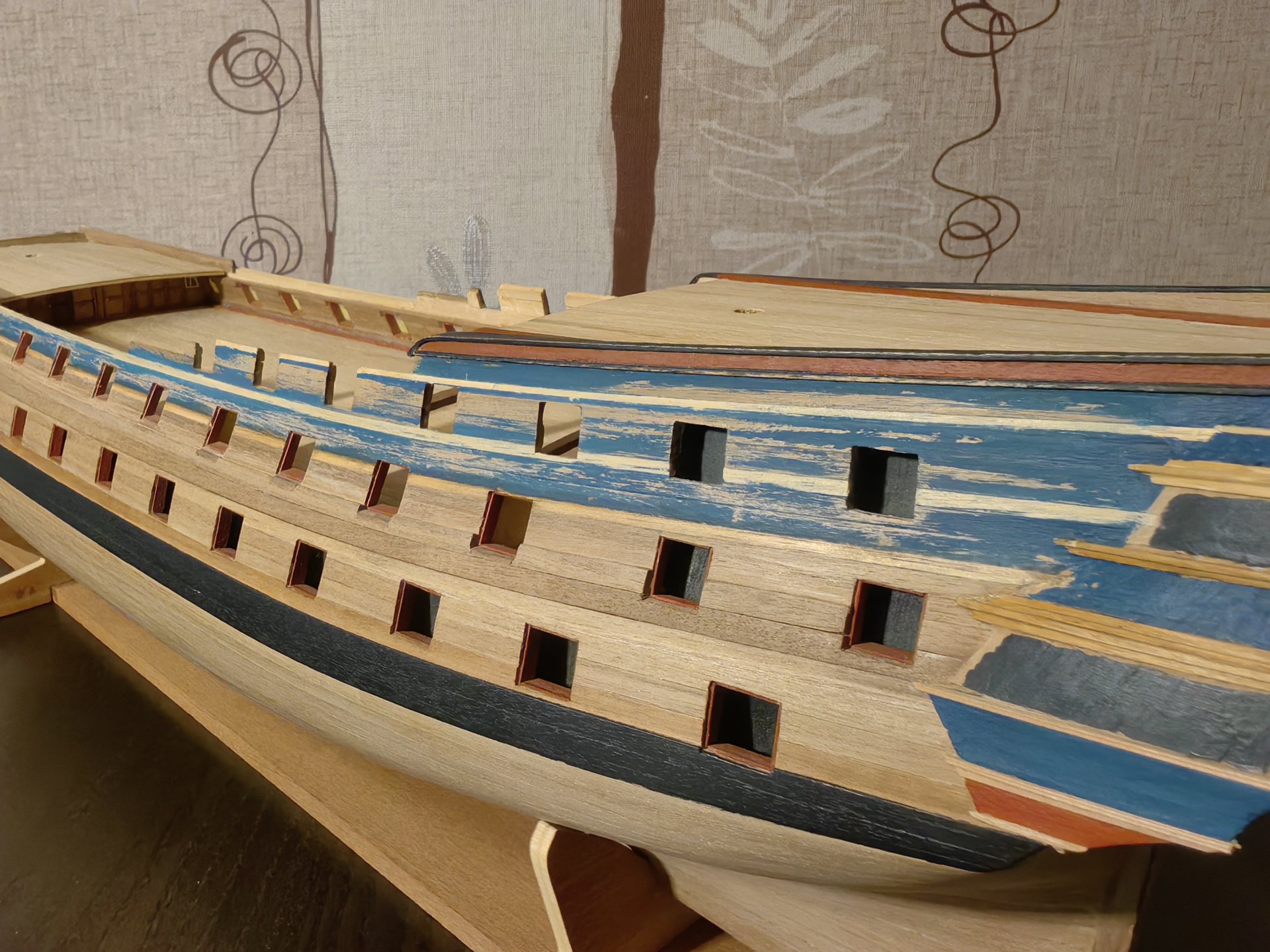

Since I still need to fix the bulwark on the beak-head, I decided to replace all the rails on the sides and stern. I will have to cut off all the old rails and glue new ones in their place. To do this, I purchased 1x1 mm pear rails. They are perfectly profiled by my tool, and their color is more suitable to the overall color scheme of the model. In addition, I hope that this will allow for a more accurate distinction between painted and unpainted surfaces. I have already replaced some of the rails on the aft gallery and on the stern.
00122.thumb.jpg.23d73dc16eeb45f1b70ac3a1ead707a9.jpg00123.thumb.jpg.a4df3f8594ef9dc1affd5ee31008d40b.jpg
I'll try it on the sides.

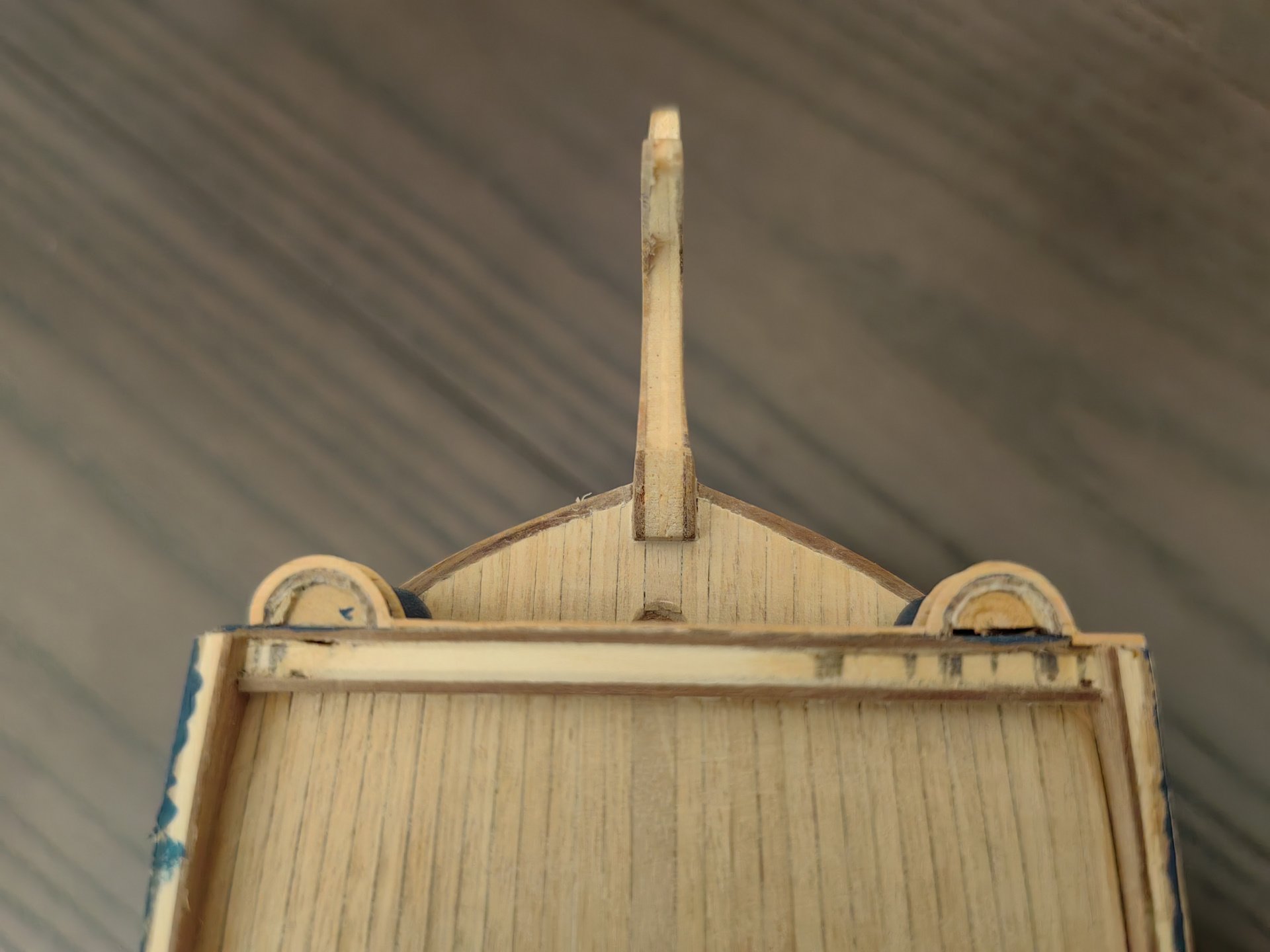

Hi Frecap,
I like the molding tool you made. It looks like it produces great results. i am curious about one thing. Your roundhouses seem to overhang past the bow deck. I am thinking that this may cause you some issues when the time comes to install the headrails. You may have a plan already for this, but if you don't you may want to look at their positions and move them inboard a bit.
Nearshore
Hi, Nearshore!

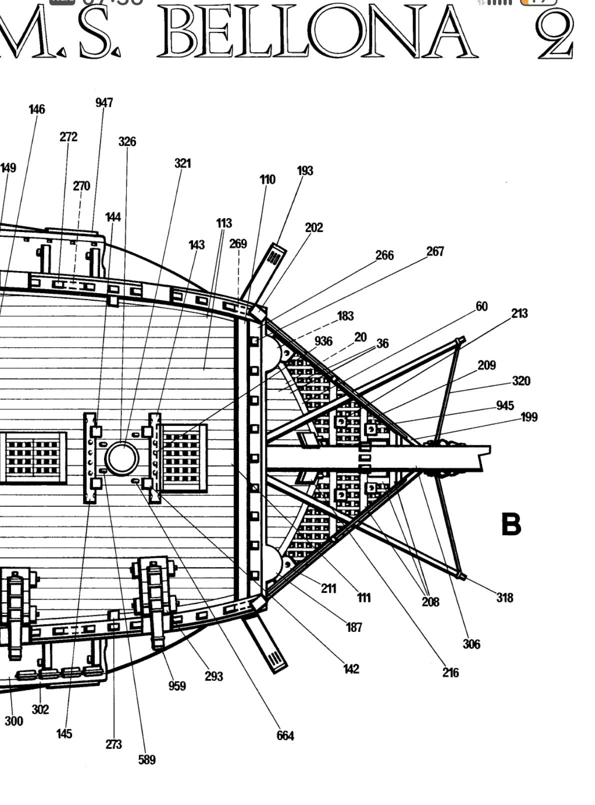

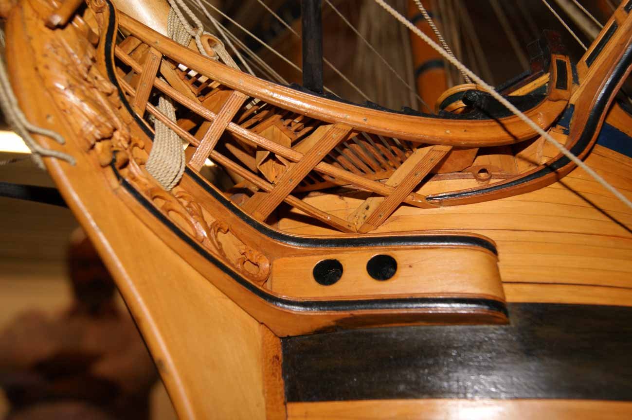

 Thank you for the feedback! Actually, I would have made the tool with a groove of 1.2-1.3 mm. It doesn't seem like a significant difference, but the 1 mm wide rail looks thinner than I would have preferred. However, I won't be making any changes now. Regarding the placement of the roundhouses, I intentionally chose this location. These structures were used on ships as latrines for junior officers. It was necessary to provide a place for removal of feces. Therefore, on English ships of the 18th century, they were often placed in this way. This can be seen on museum models from that time.

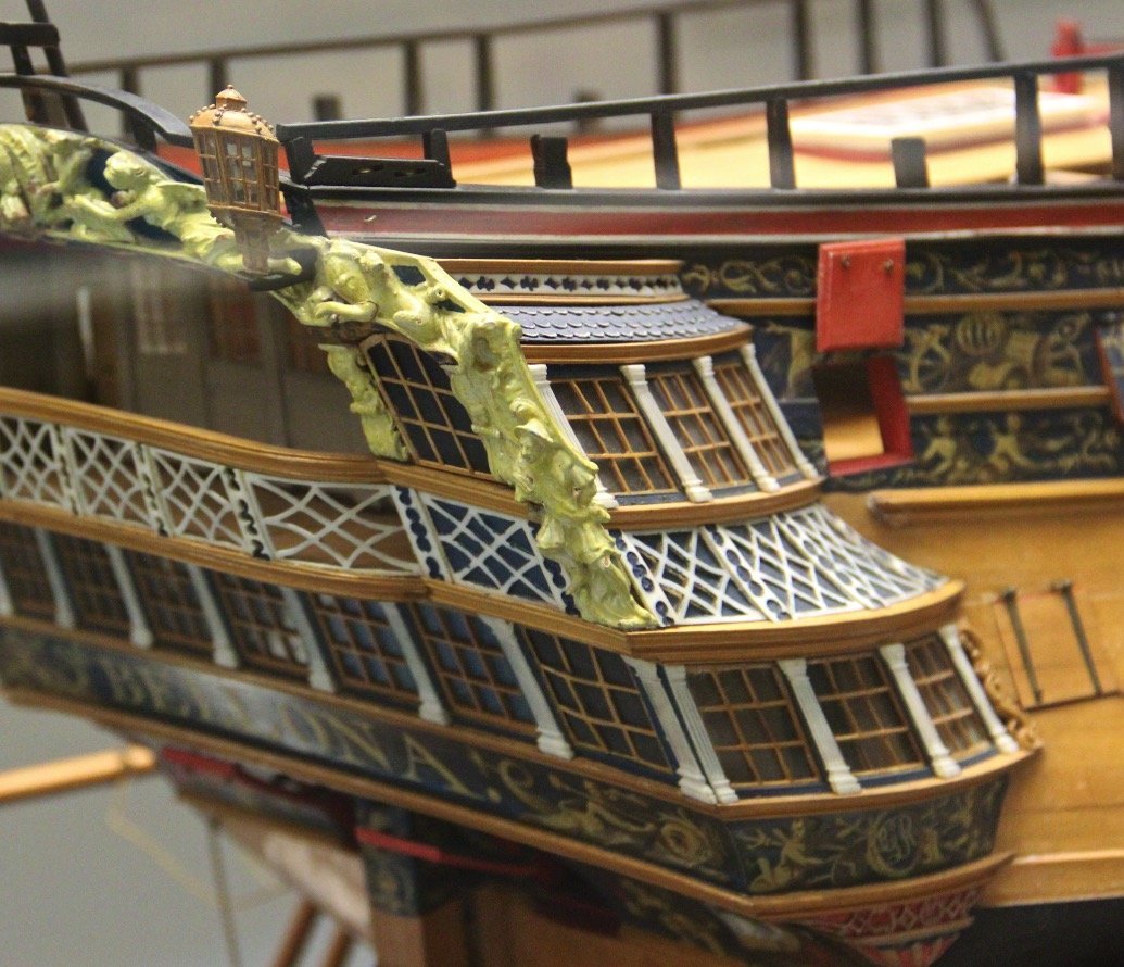

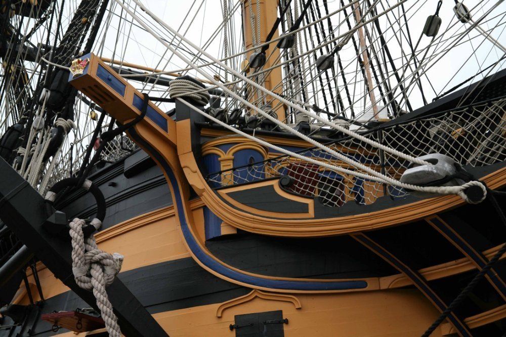

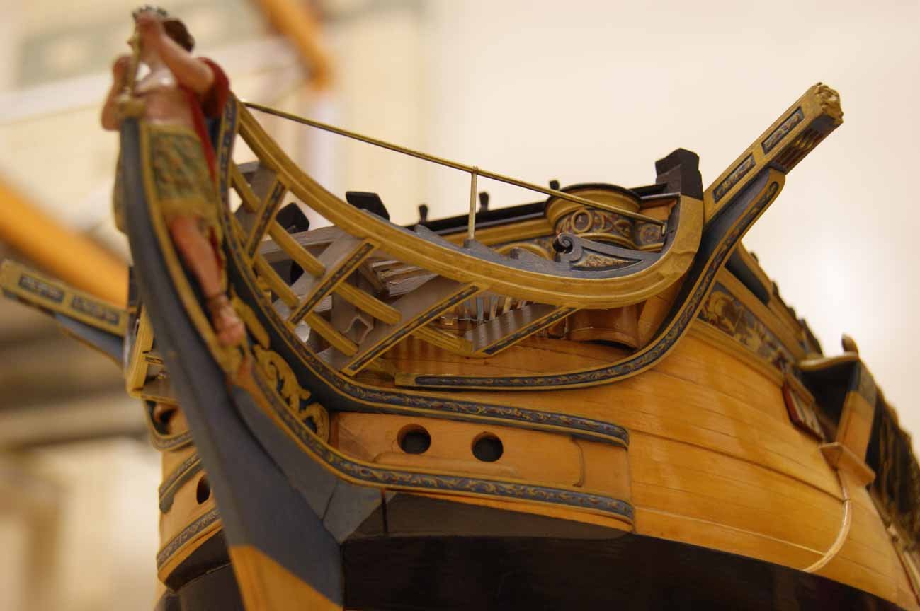

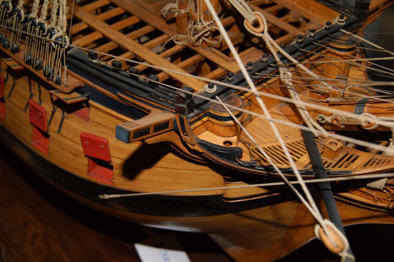

gallery_10197_918_78230.jpg.75ab1e1e4f3f4173b60ab70009925f04.jpgFor example, here is one of Bellona's Sistership.
Аnd this is Victory.

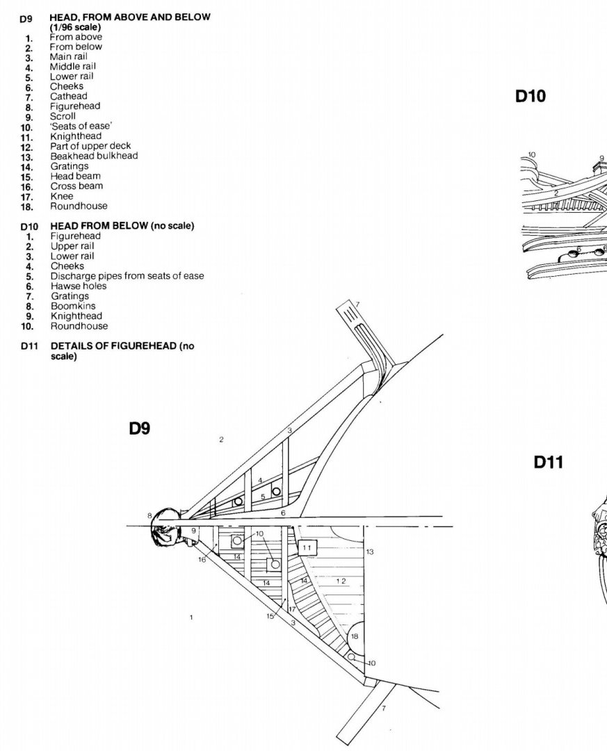

By the way, despite the fact that the Corel company does not always follow historical accuracy, in this case, their drawing shows that the roundhouses protrude slightly beyond the edge of the beakhead.
But this was not always the case, sometimes roundhouses were installed within the framework of a beakhead. In such cases, the feces were excreted by the scuppers.
In the Anatomy of Brian Lavery's Ship, the drawing shows exactly that.
Unfortunately, there are no rownhouses on Thomas Slade's model, so we can only guess what it was like on BellonaI think. Every modeler can do what he thinks is right. By the way, the round houses also housed observers in case of bad weather. They had round windows for this purpose. They were also used to punish misbehaving sailors. Roundhouses protruding beyond the edge of the beakhead should not interfere with the head structure.
Main head reil should be attached to the outside of the side. By the way, this is how it is done on your model. You can see that there is enough space between the beam and the beakhead. I think I can do it right too.
Sincerely, Frecap.
Hi!
As we say: Eyes are afraid, but hands do!

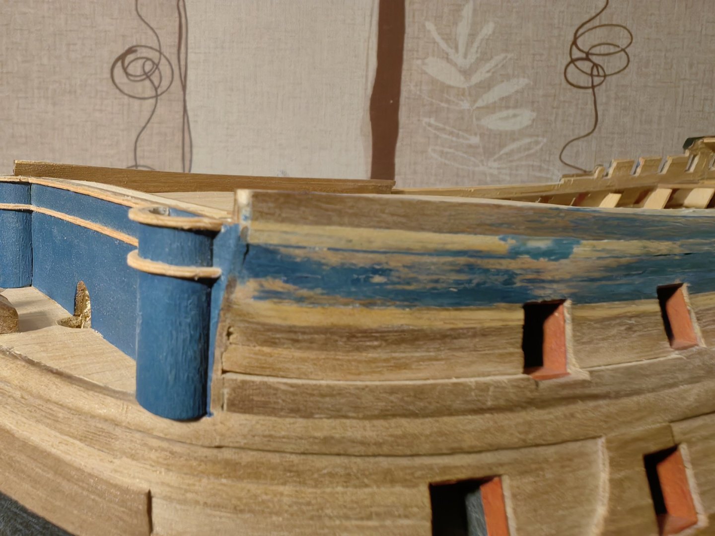

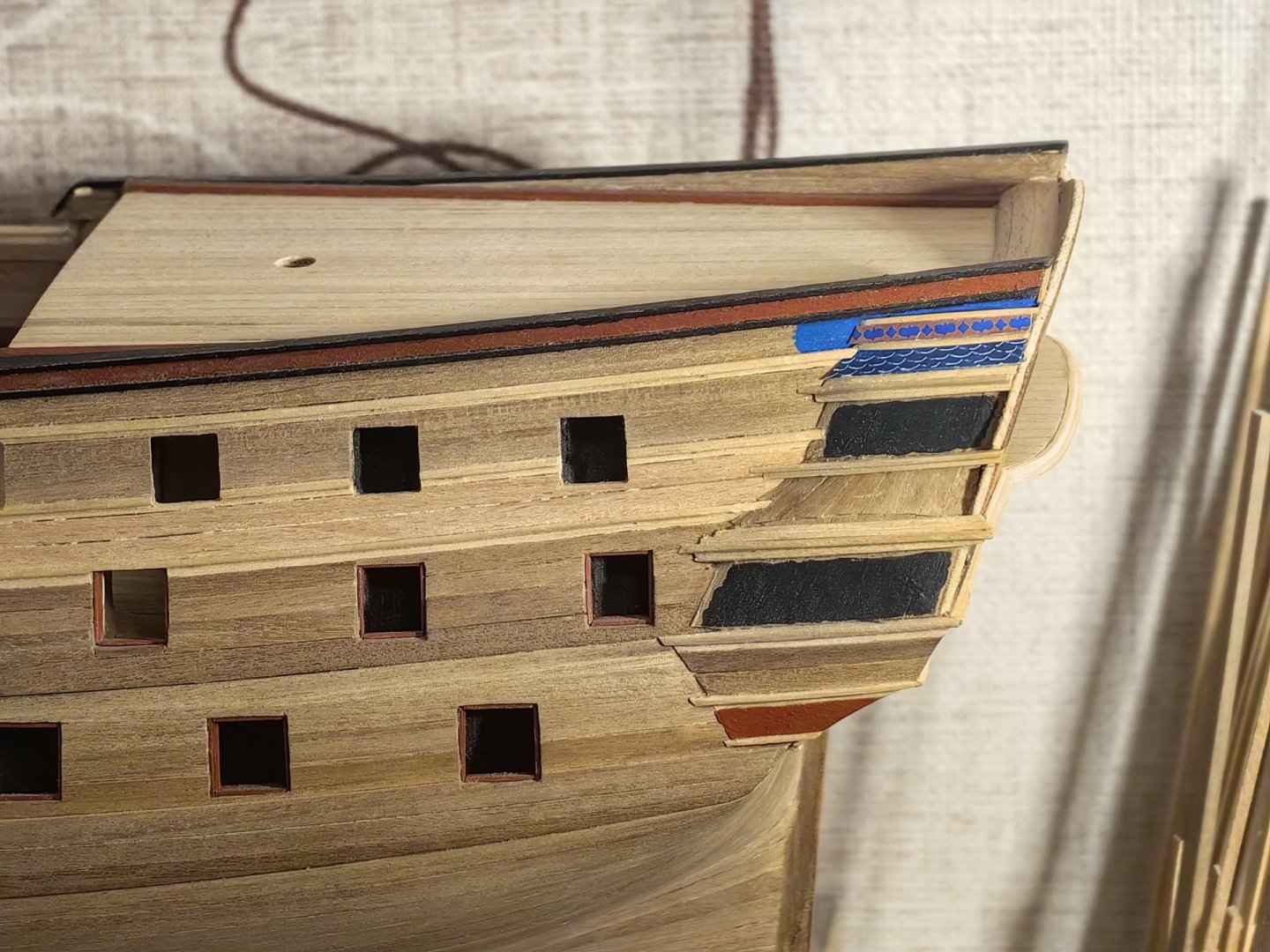

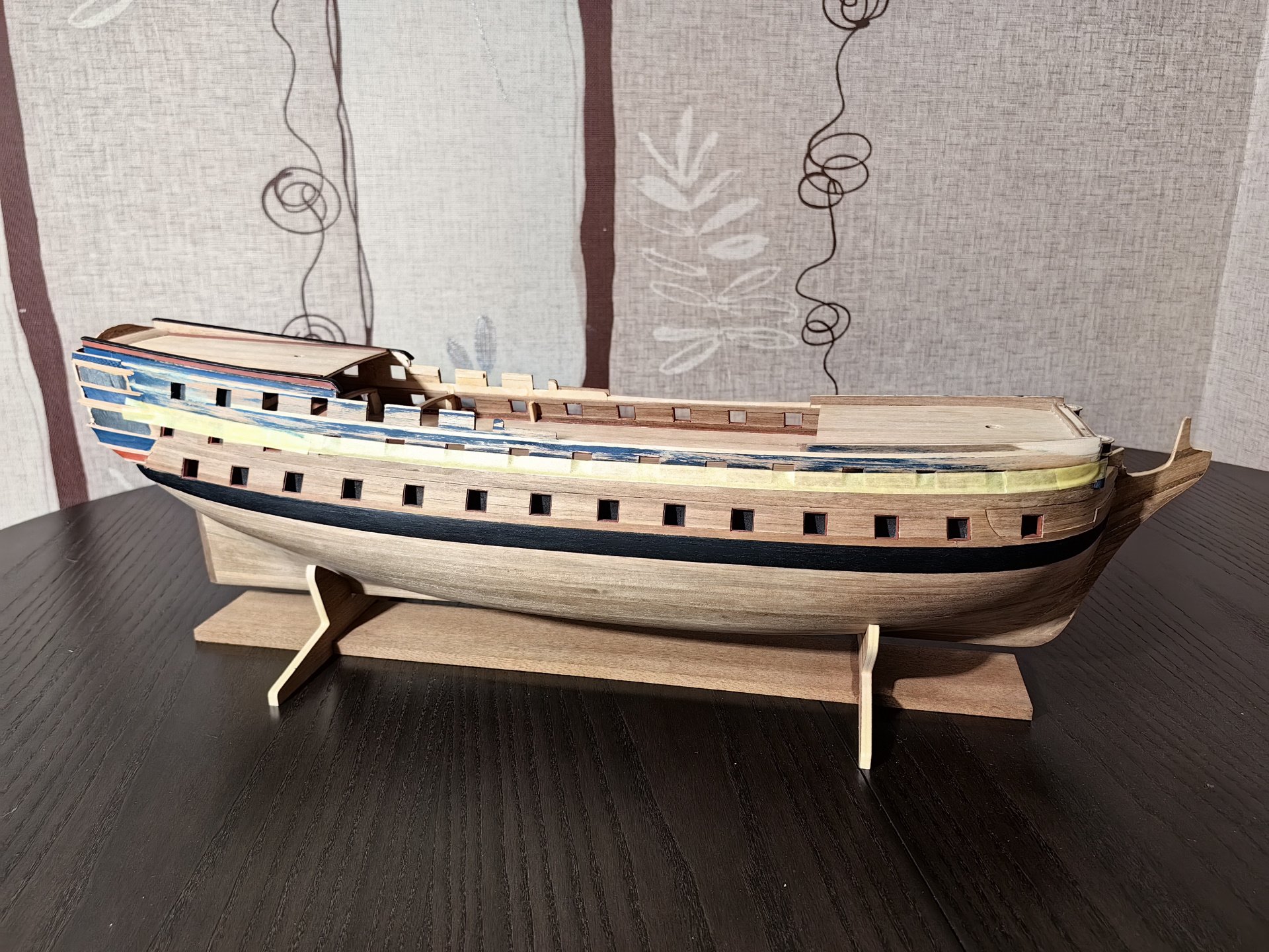

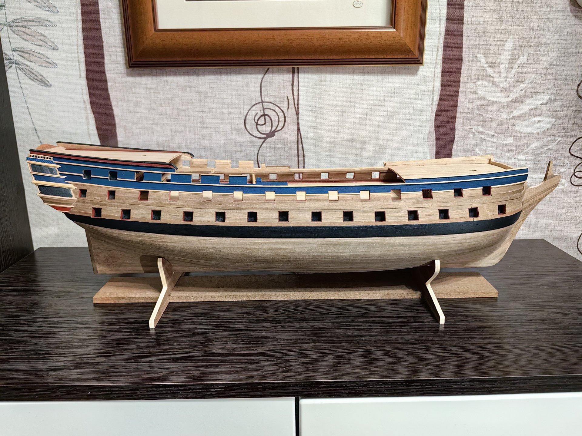

It's not very pleasant to do the dirty work on the already painted hull, but it didn't really take much time. Just a weekend) I cut off all the rails on the sides and stern. Only on the stern galleries I left everything as it was. Put in order the right upper part of the bulwark. Now the beakhead looks symmetrical. The partially scraped paint doesn't look very nice, but I think the new paint will be of better quality, as it's easier to apply masking tape to a smooth surface.
