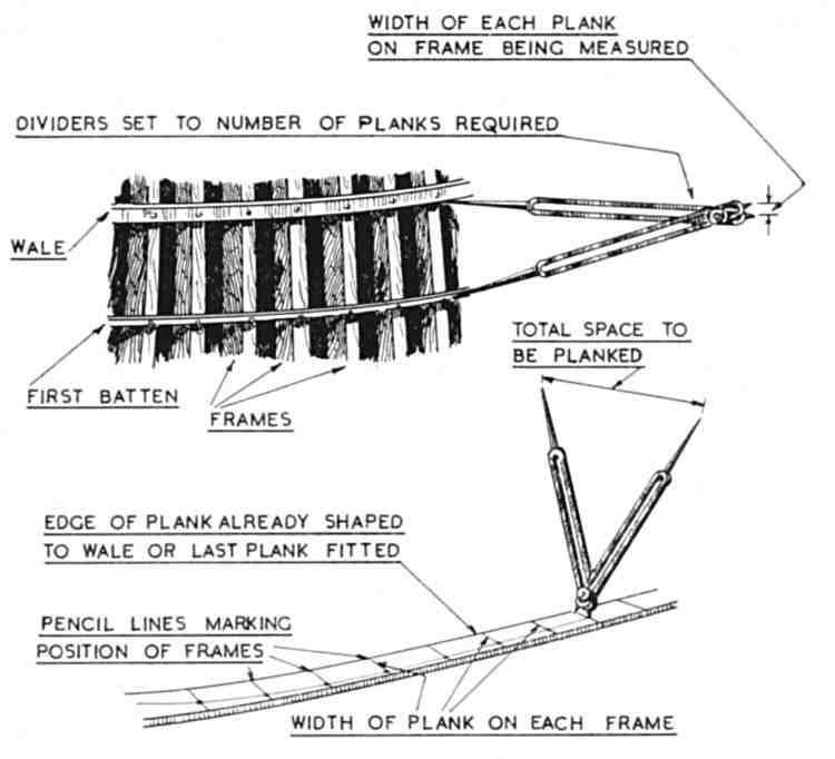

I don't know D. Dressel's book, but I first learnt the planking technique from the brochure by Jim Roberts "Planking the Built-Up Ship Model".
Basically, after you VERY PRECISELY! installed the wale and the garboard strake (make sure they are perfectly symmetrical on both sides of your hull), you proceed to determine the runs of your battens (very thin temporary glued wood strips). If you chose three spaces (two battens), that's OK.
Very important is that they run symmetrically on both sides, along the entire length of the hull, and equidistantly to each other.
In other words, the spaces between the battens should be the same, and not like you say, one is 52 for the top space, 66 for the middle and 52 again for the bottom space! All spaces should be 52 (or something else, in your case). Reposition the battens.
I assume, these measurements are for the edge of a middle frame/bulkhead, the one that is the bulkiest. Do the same for the remaining bulkheads, taking precise measurements in between the lower edge of the wale and the upper edge of the garboard strake, taken with either a strip of paper or dividers, and then divide the distance into three to obtain the width for each ellipsoid space - for the corresponding bulkhead/frame. Do this for ALL frames, make a pencil mark on each frame and finally connect them all into a curve delineating the run of your batten.
