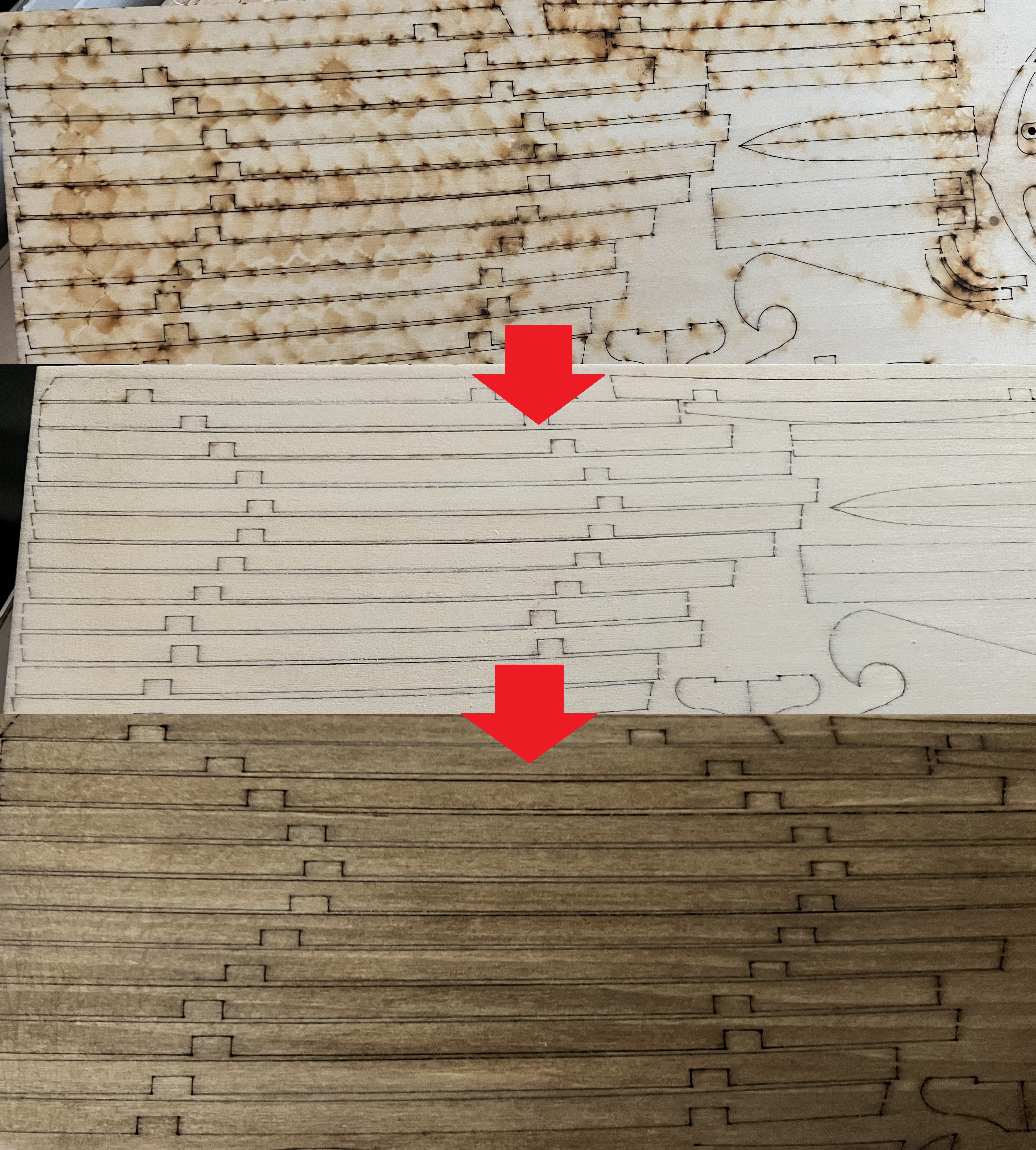

Before I did anything I firstly sanded away the laser scorch marks on the back sides of the wood sheets with 200-600 grit sandpaper, then I stained them with Minwax golden oak.

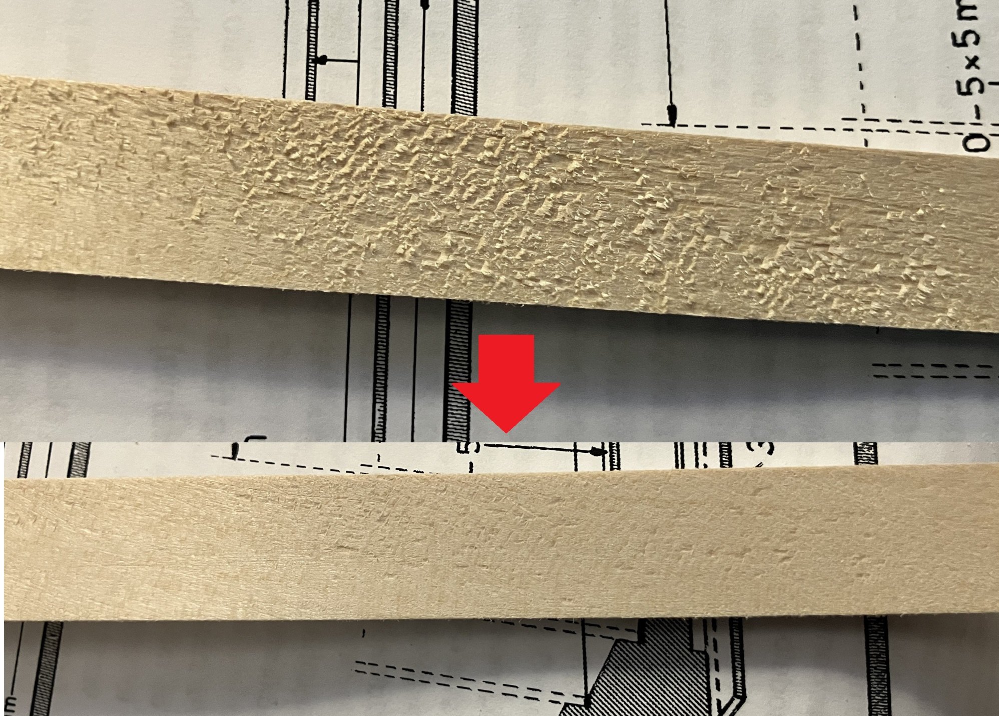

The keel lumber provided was oddly bumpy and required sanding.image.thumb.jpeg.2e79f958a97ba7eea7eaf92c8f1dd82d.jpeg

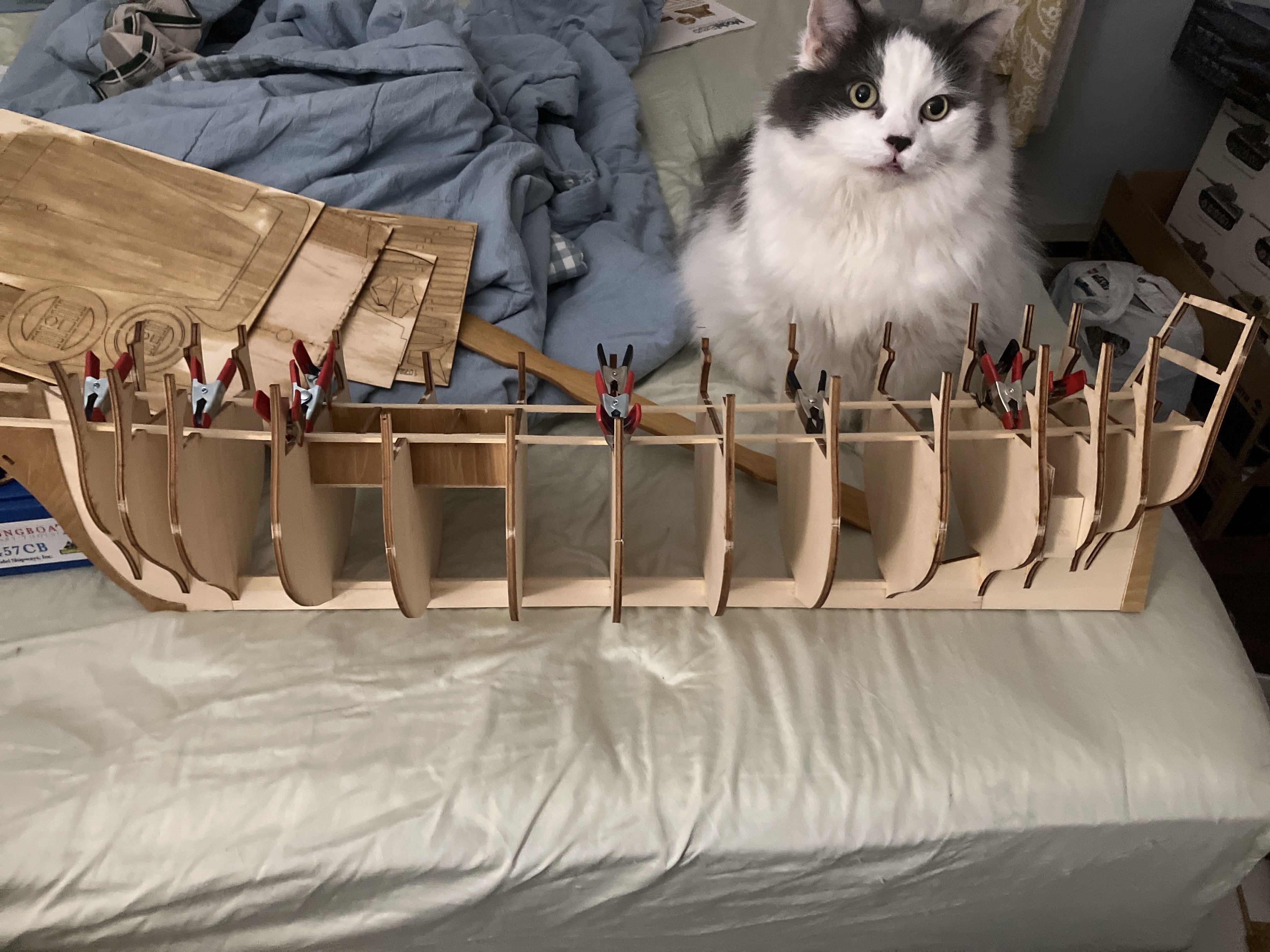

Week 2 update: I have finished fairing the bulkheads and attached the deck and first hull plank. I had to remove the two upper structural beams because I glued them before I had test fitted the deck, and they would not fit. I also took a bit of time to identify and label every type of strips included in the kit.
It was pretty much impossible to apply enough downward force to the beams as the glue dries while making sure the bulkheads are correctly spaced for the deck, so I ended up doing this using spring clamps. image.thumb.jpeg.4cf690cdab6bfc5bfbabf8e5acac6c93.jpeg
After I made sure the beams are dried and the bulkheads are correctly spaced this time, I glued the deck in place and held them down using a bunch of pennies I had collected. image.thumb.jpeg.f7f4f30fae0330872910ca3e99087e9f.jpeg

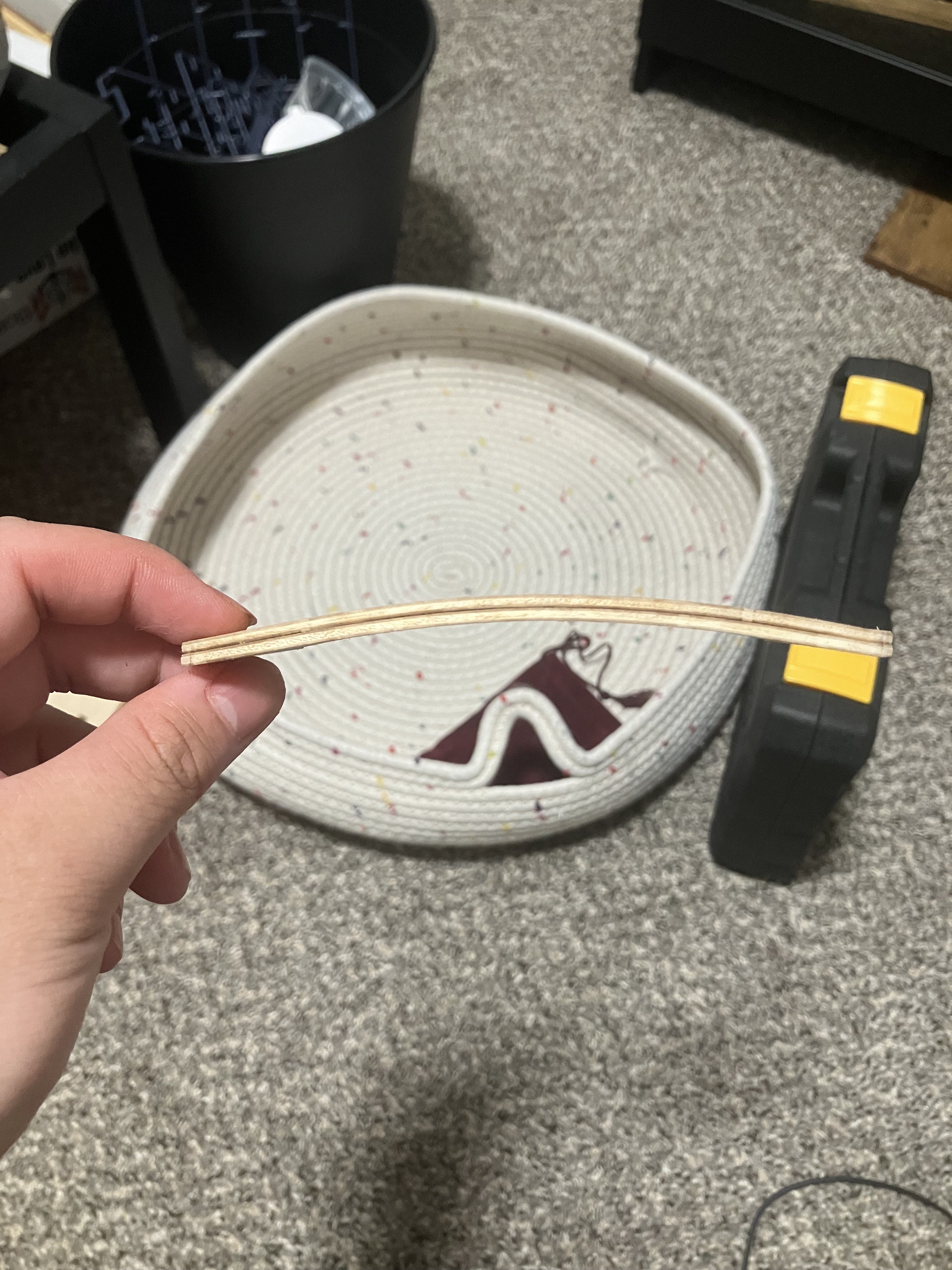

Lastly I created a jig with scrap plywood to bend planks length wise, which have so far been such a huge pain that I have only done the center planks which required little to none bending in that direction, hopefully this will speed up my planking process.IMG_2390.thumb.jpeg.5aa91c1499041300c3e525322a58d7ab.jpeg

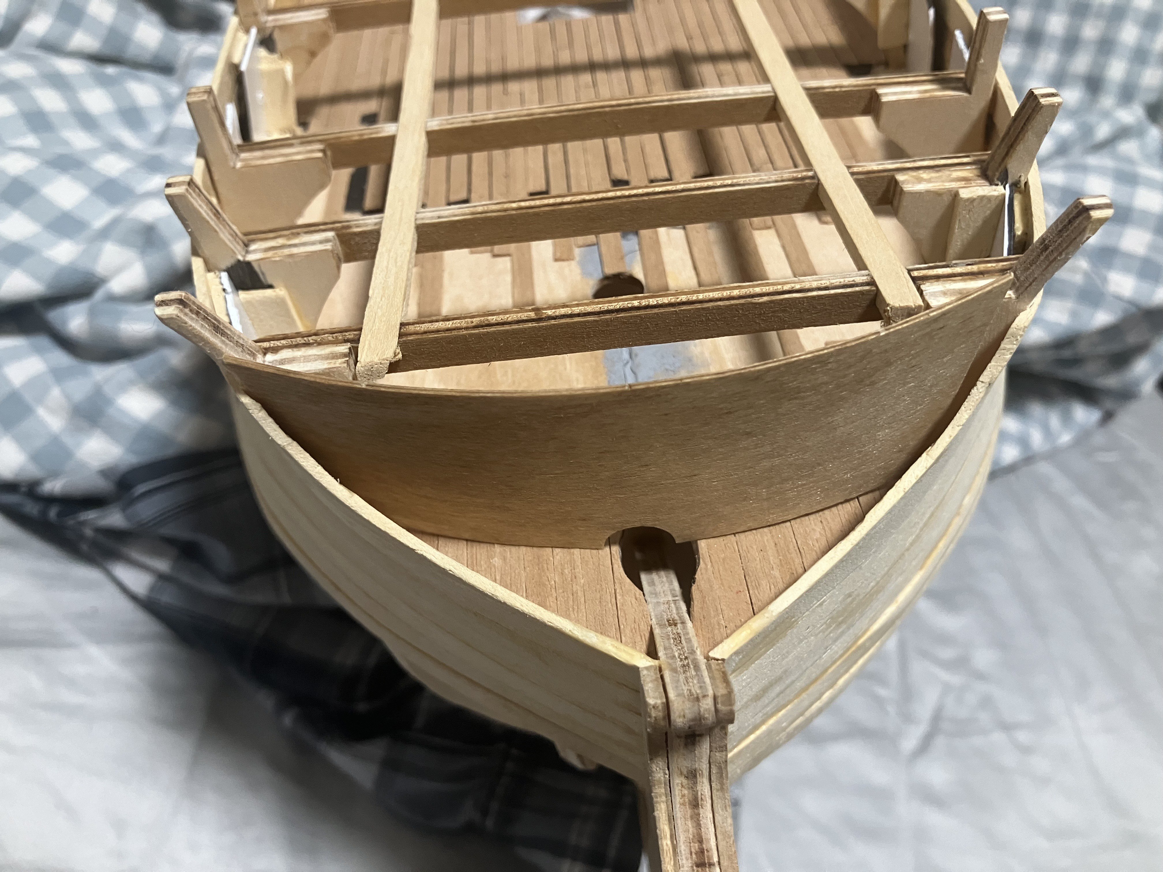

Week 7 update: attached the base piece for the stern gallery, and added beams for the forecastle and quarter decks.
This piece was quite a challenge to fit into place, I had to cut and sand much of the side gallery base to make it fit.

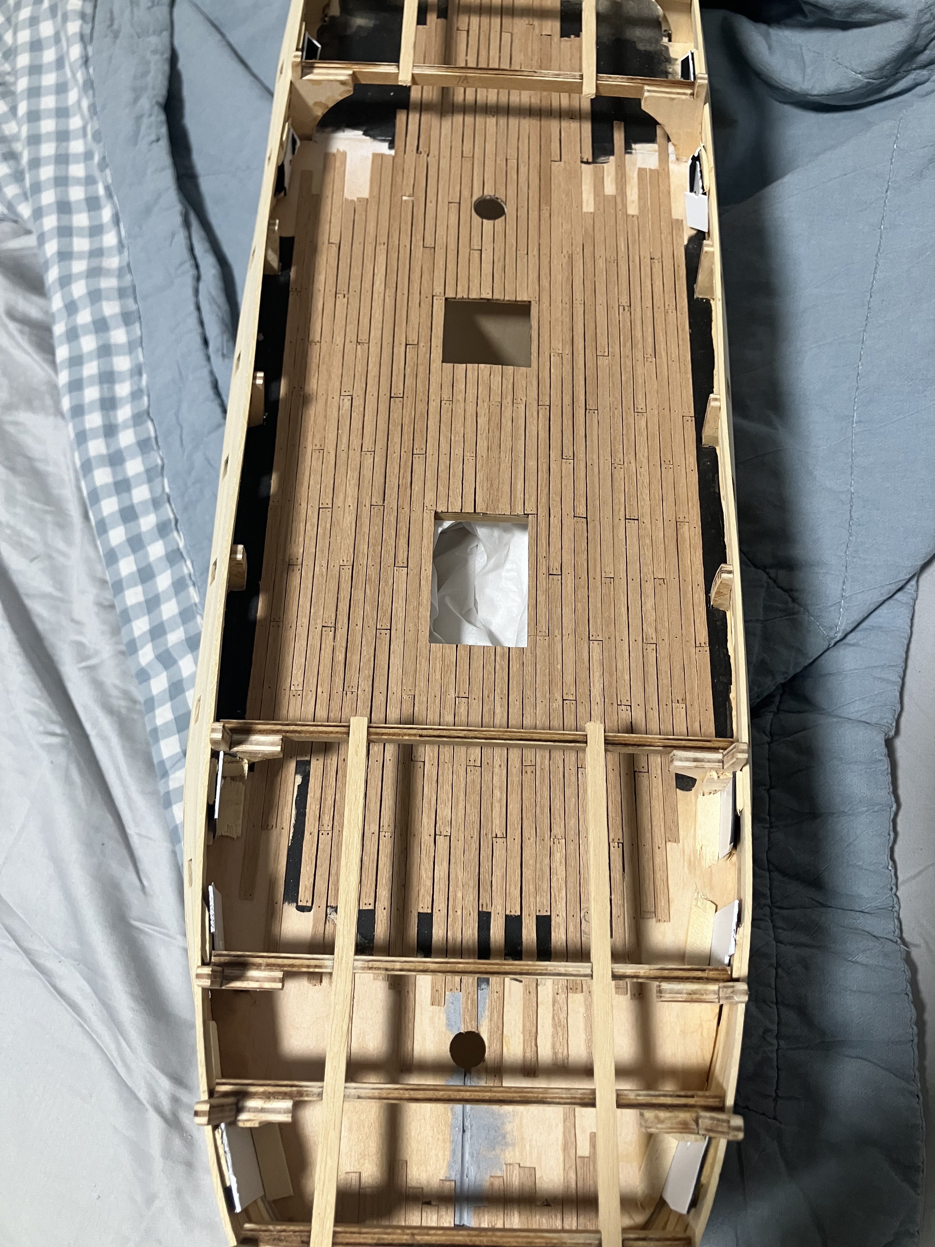

Week 9 update: added the gun fixtures and their bracings, started work on the deck planks.
Mostly done with moving, still assembling some cabinets as of now but I did manage to get some work done on the ship. IMG_2575.thumb.jpeg.2ca00c16e48347fa388de1e541dd73dc.jpeg
I looked through the instructions and I do not see anywhere where these thin annegre strips were to be used so I am assuming these are supposed to be the deck planks. I am going with a three butt pattern.IMG_2577.thumb.jpeg.92c5e8874d299deb7c416e97a7d13940.jpeg

Week 10 update: finished most of the planking on the main deck
image.thumb.jpeg.892469279af3bb710241fdb4e84f2c31.jpegimage.thumb.jpeg.5b2880c39e878e1cfe871c50475e31a3.jpeg
Hopefully I will be able to finish the deck and start to work on the quarter and forecastle decks.
Next up: still more deck planking

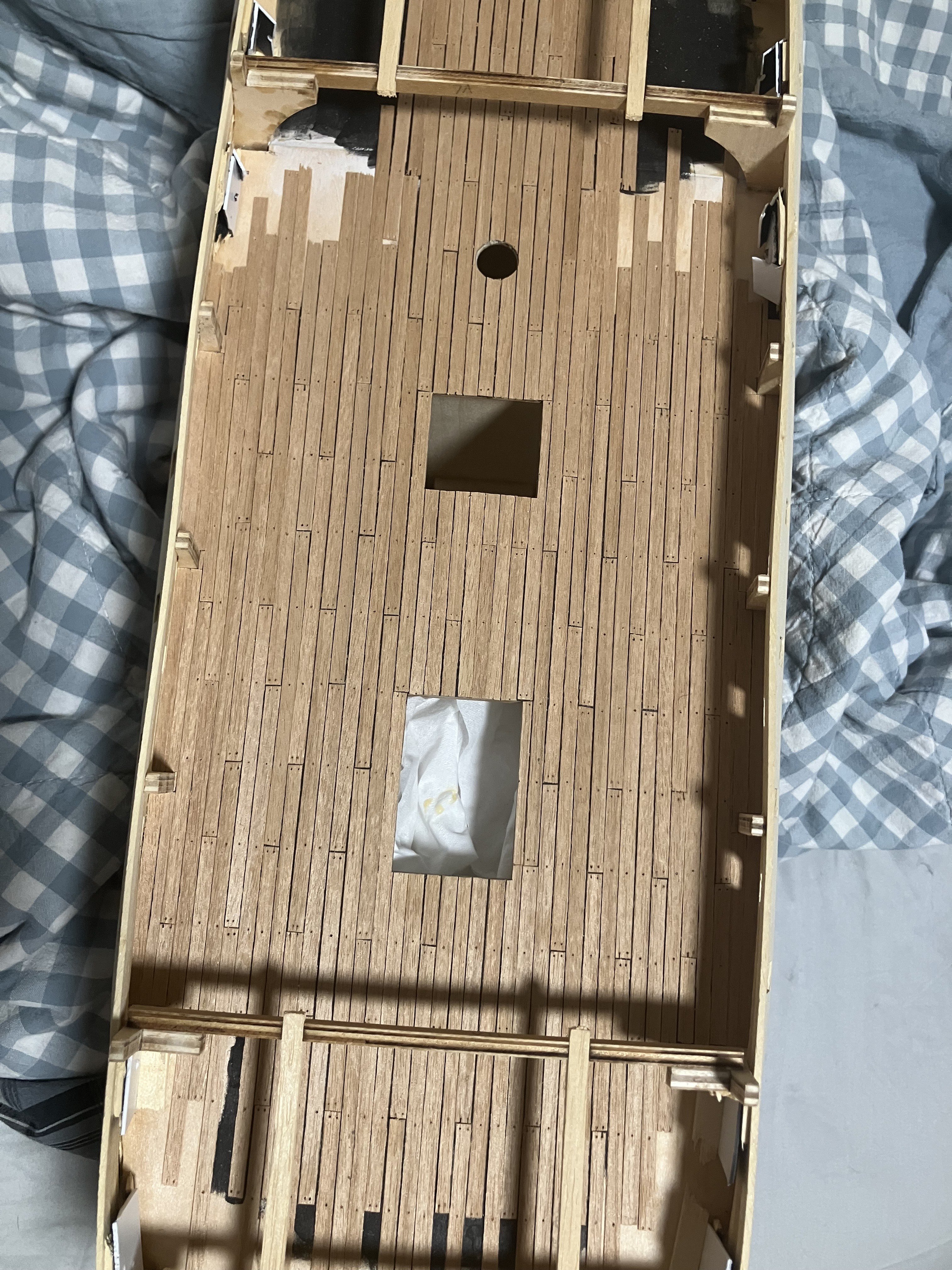

Week 11: finished the main deck planking.
Progress has been slow since I have been working on other plastic models. IMG_2640.thumb.jpeg.cb93ad287084a0a45ae42b72ff525592.jpeg

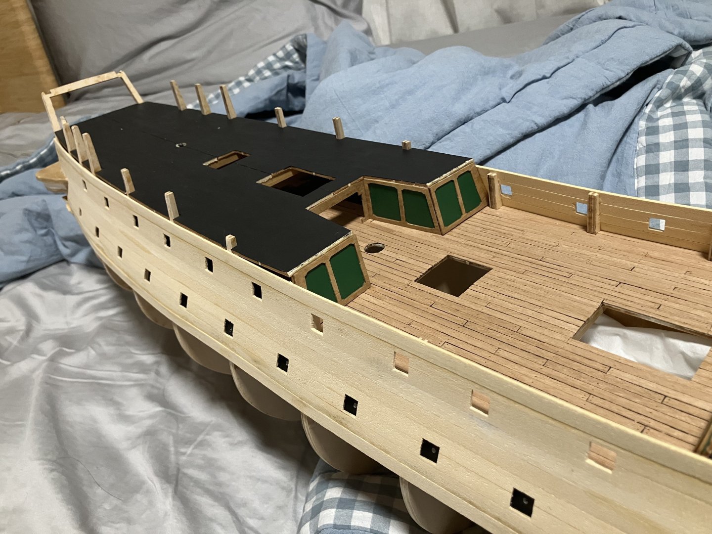

Week 13: quarter and forecastle false decks down.
I also somehow managed to lose my instruction book during the move, and for the life of me could not find it. So there goes all the time I spent labeling the strips and marking on the instruction book. Now I have to rely solely on the digital copy.

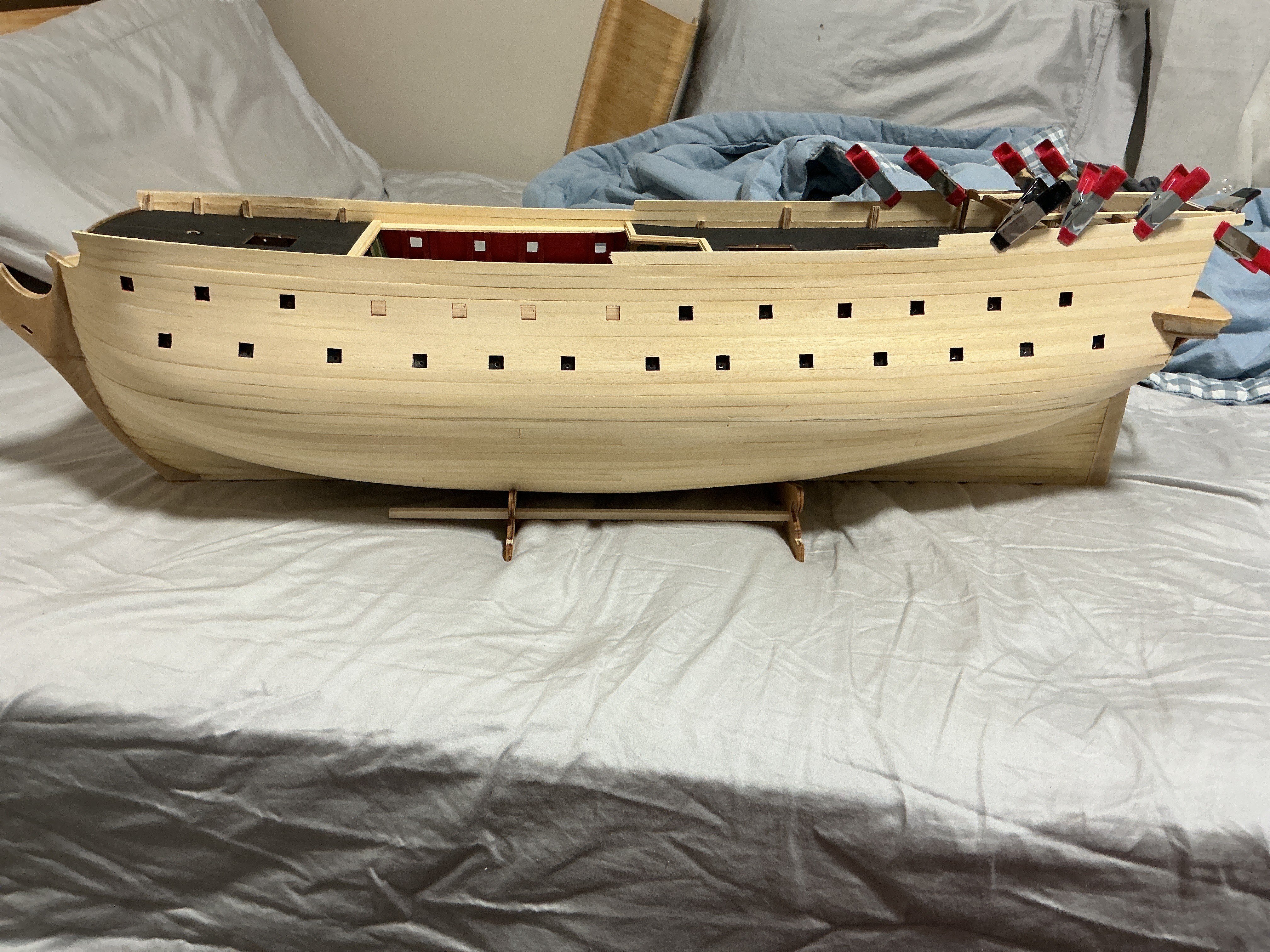

Week 31 update: finished the planking on the starboard side of the ship. About halfway done with the portside.
Hopefully I can finish it by December.

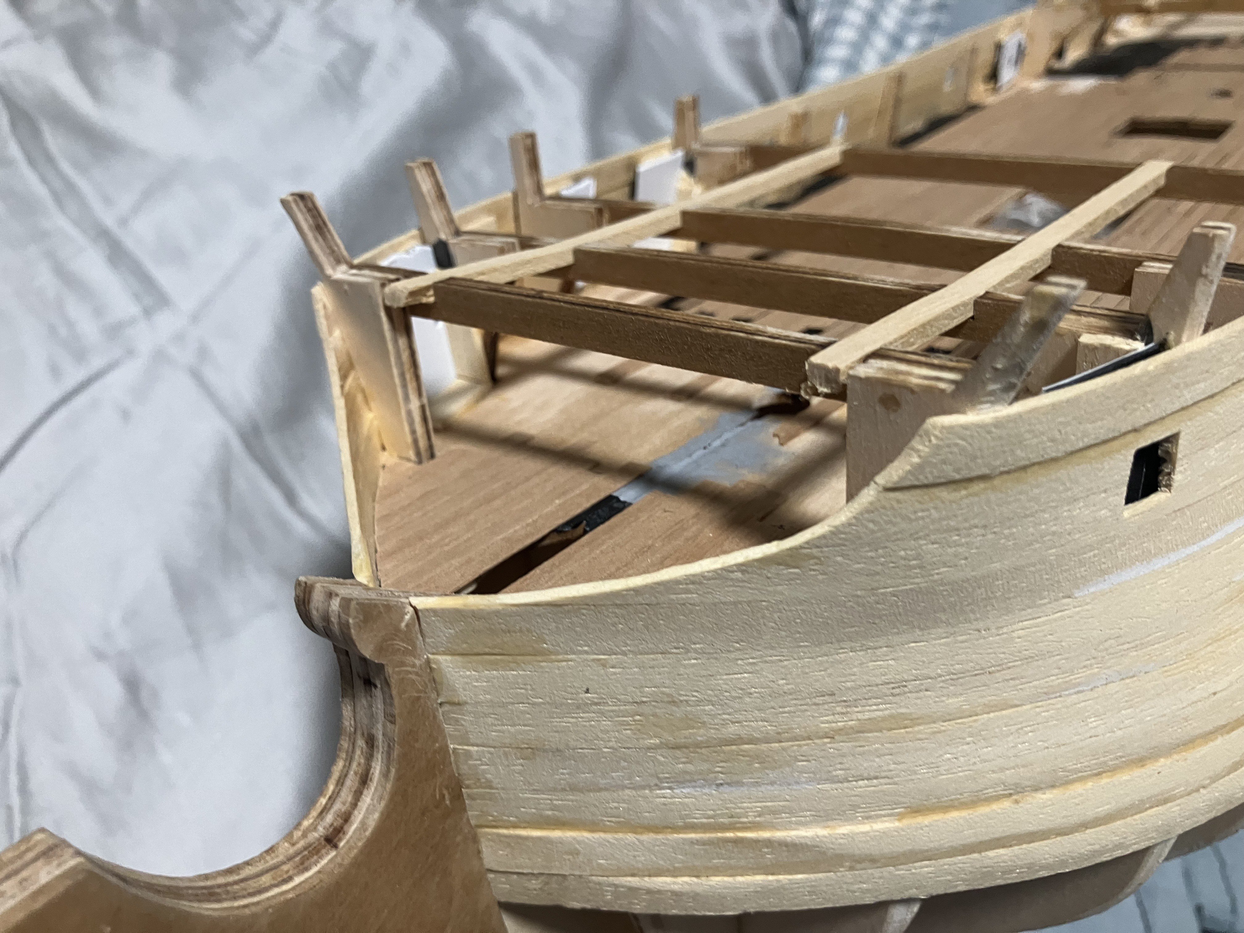

Week 35 update: finished planking the portside, started on the display stand and the poop deck. Will update again when I have some progress to show for the stern. Might have to rip out the stern gallery base and shape the piece again since the plastic decoration pieces under it simply won't fit with the current placement.
