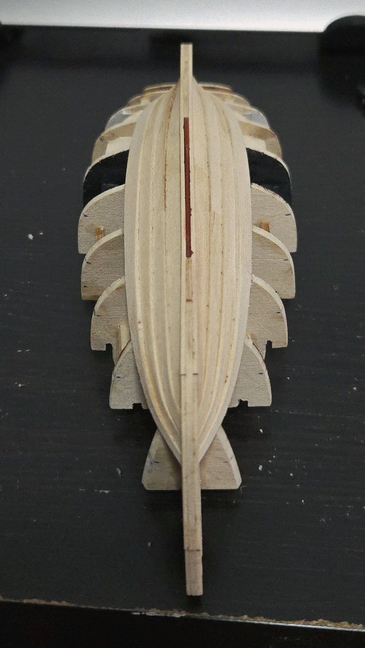

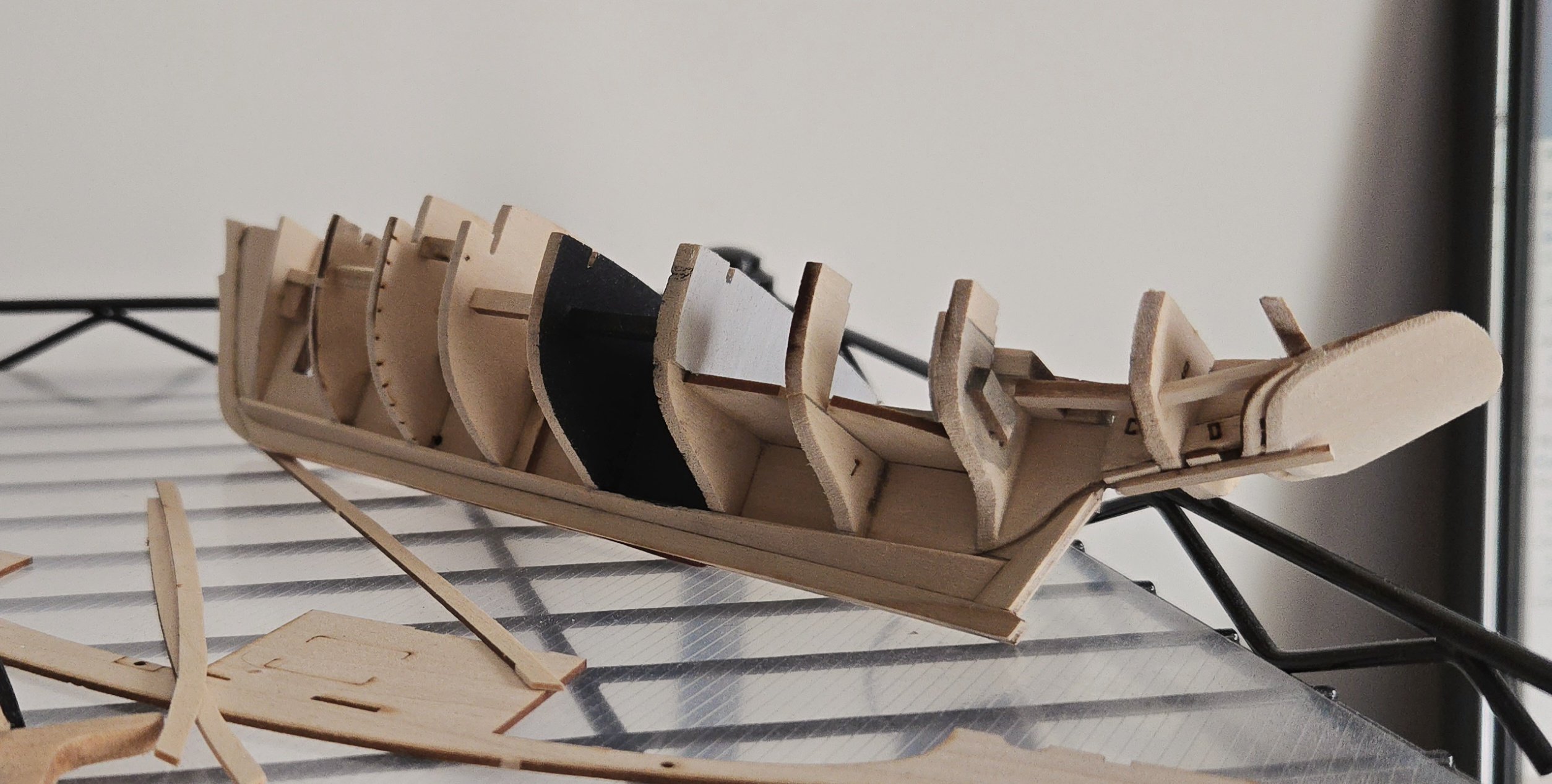

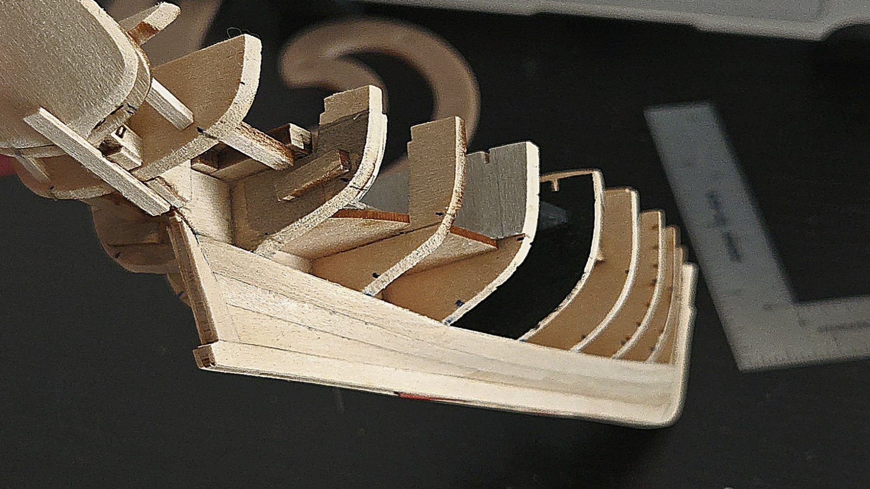

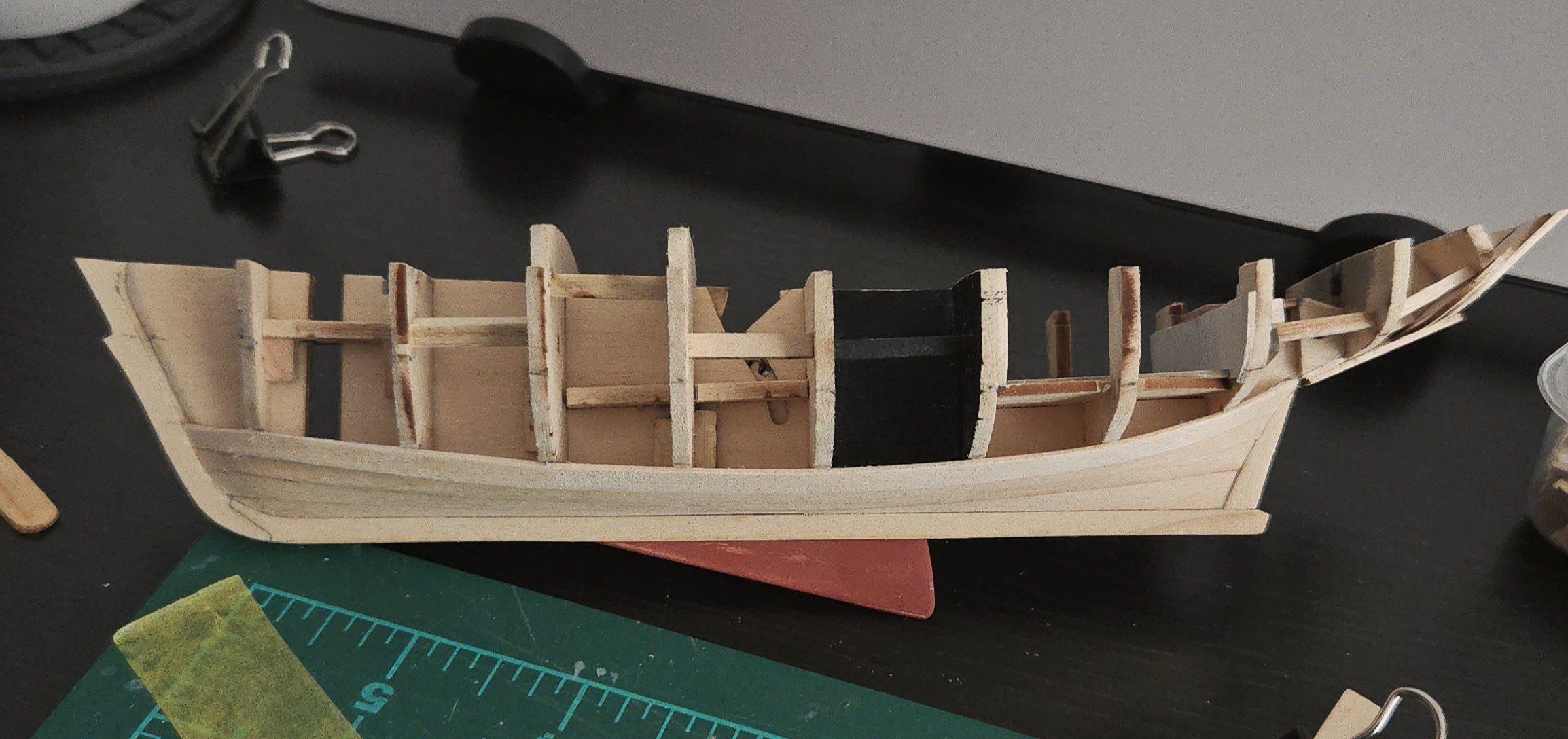

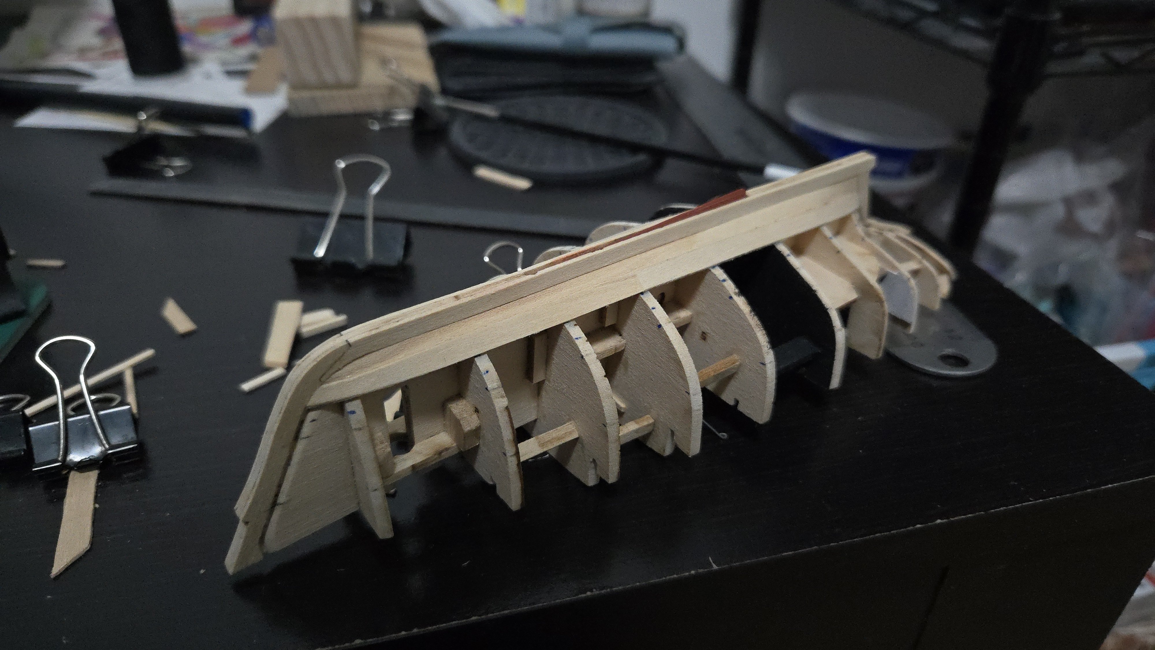

After a bit more work with the sanding sticks, both sides are now faired. This hull has been much, much easier to fair than my Lancha Chilota build was. The only real issue has been that I think I didn't quite get bulkhead 2 seated properly so it ended up being less sanded than the other bulkheads.
I also realized that I needed to build up the area around and just aft of the opening for the rudder, as it was a bit low. I added some scrap and sanded it fair later.

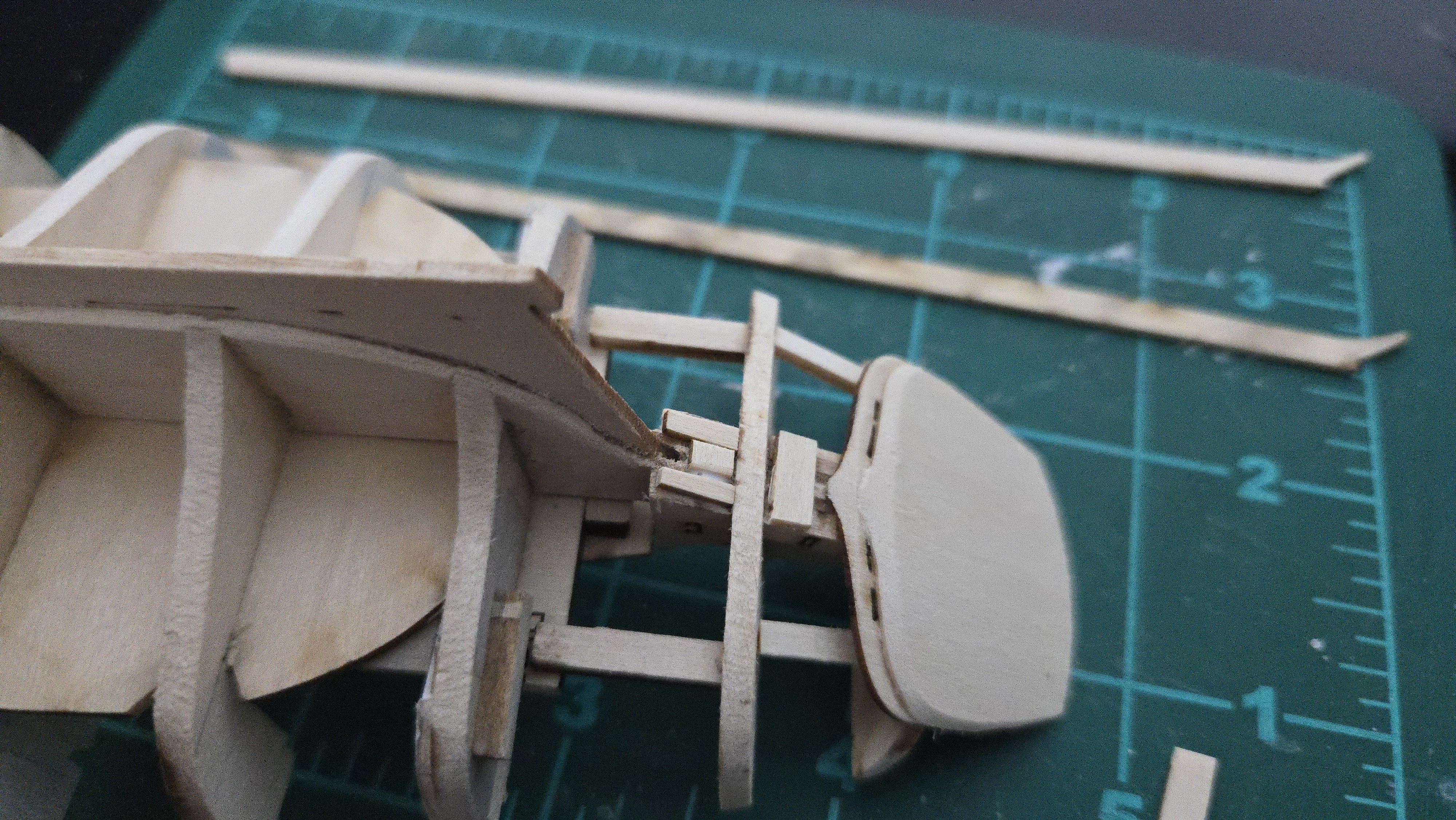

Next up, attaching the outer pieces of the keel, stem, and sternpost.
The joint of the stem turned out nice and tight. It's good to see that my rescaling and conversion for laser cutting didn't ruin these parts!

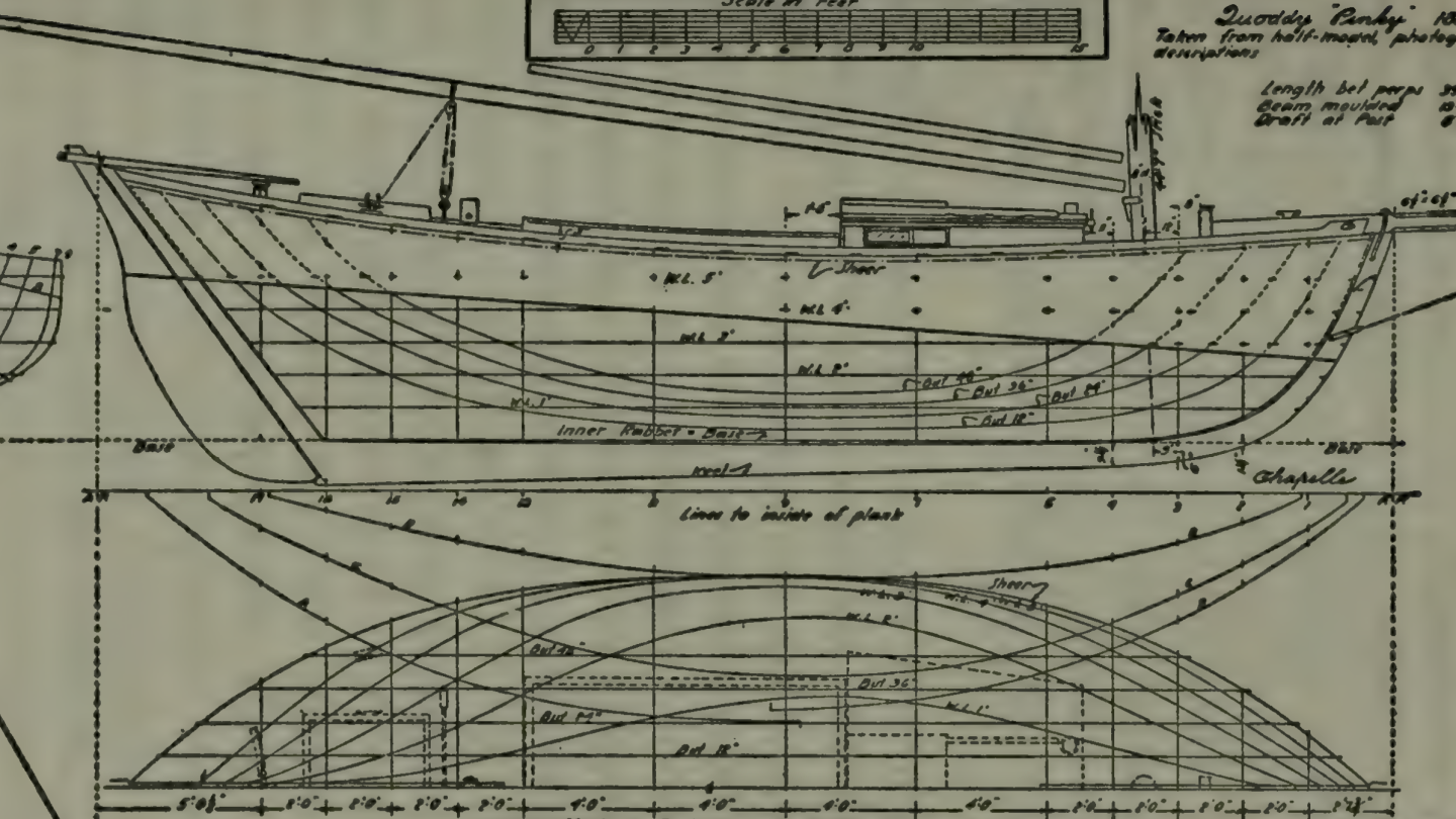

I was curious to know whether the kit designed precut planks could be at all modified to serve as the basis for at least some of the lapstrake planks. This could in theory help a little with the complexity of the stern, and would also enable me to use the wood that's already been laser-cut. Looking around at images, it seems like most vessels had around 15-18 strakes of planking. (See below, for instance--granted, this is a deeper Friendship Sloop.)
Source
The kit design has 11 including an extra-wide sheer plank (which could be split in half or so to be about doubled). Both photos and kit are, of course, caravel planked. I'm assuming that a lapstrake planked vessel would probably use a similar number of planks, or perhaps very slightly fewer (as I'd imagine that it would be easier to use slightly wider planks rather than narrower ones, given the need to overlap planks. Taking a few preliminary measurements, it looks like the largest bulkhead measures around 2 inches. The precut planks are generally around 3/16-inch wide. So, if they were overlapped by, say, about 3/64‐inch, that would lead to around 15 strakes per side. Of course I need to do a lot more planning work, but I think I may be able to use the precut planks as the basis for at least some of the planks. I'll have to line off the hull and check how things look first, though.

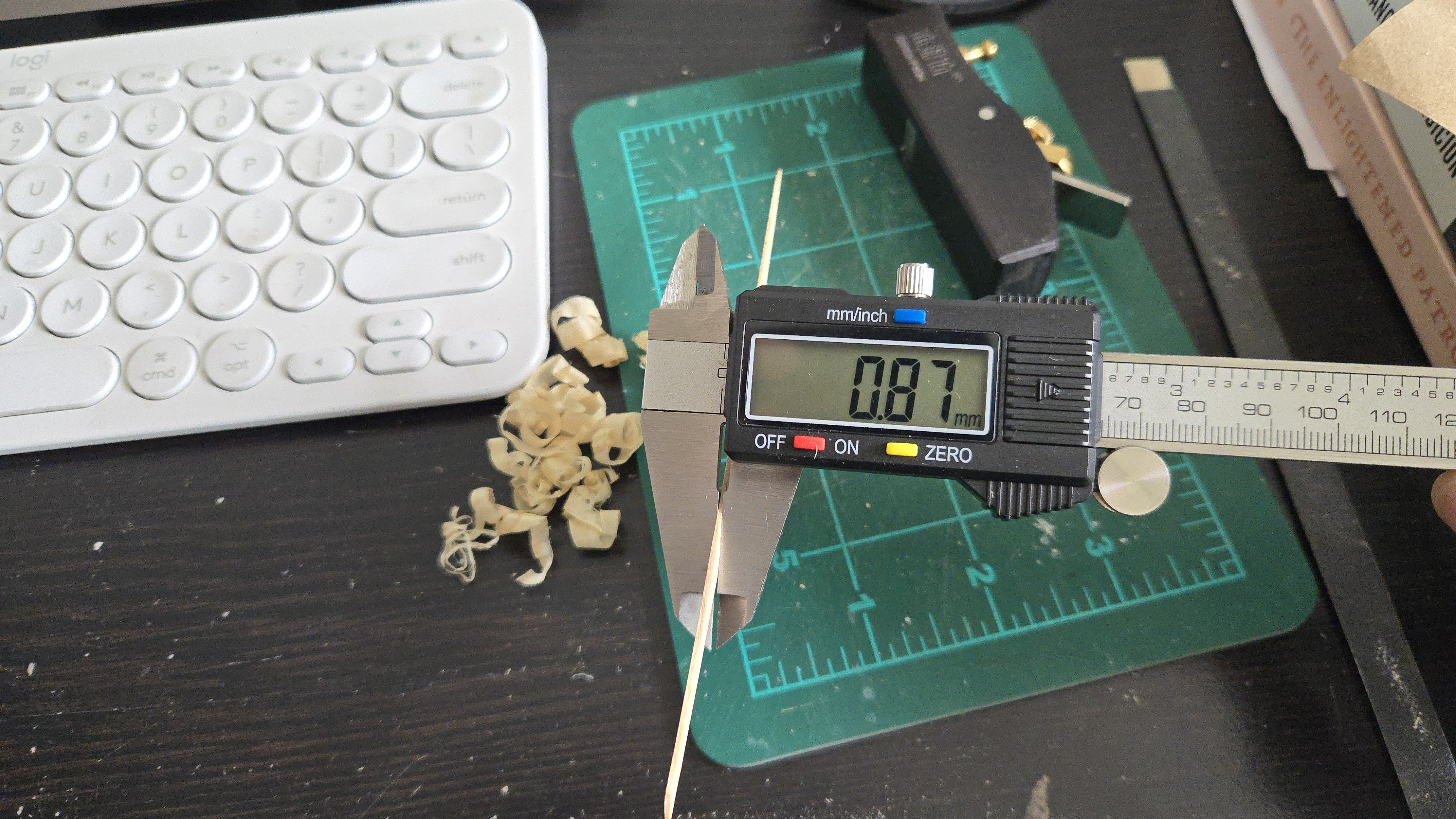

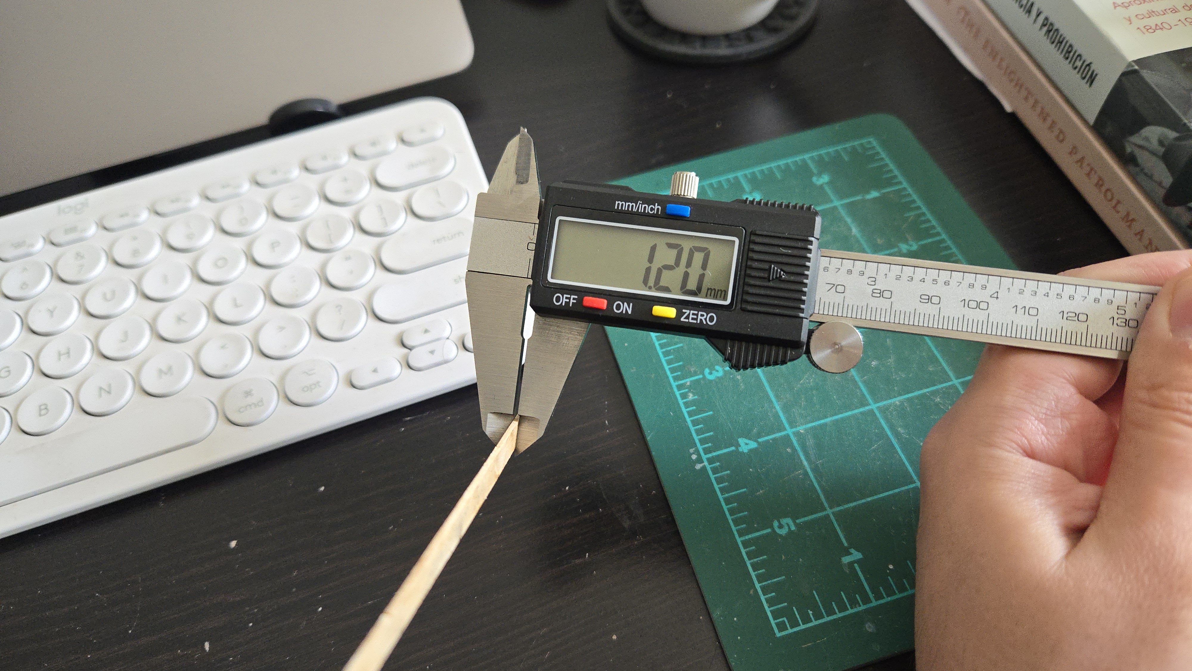

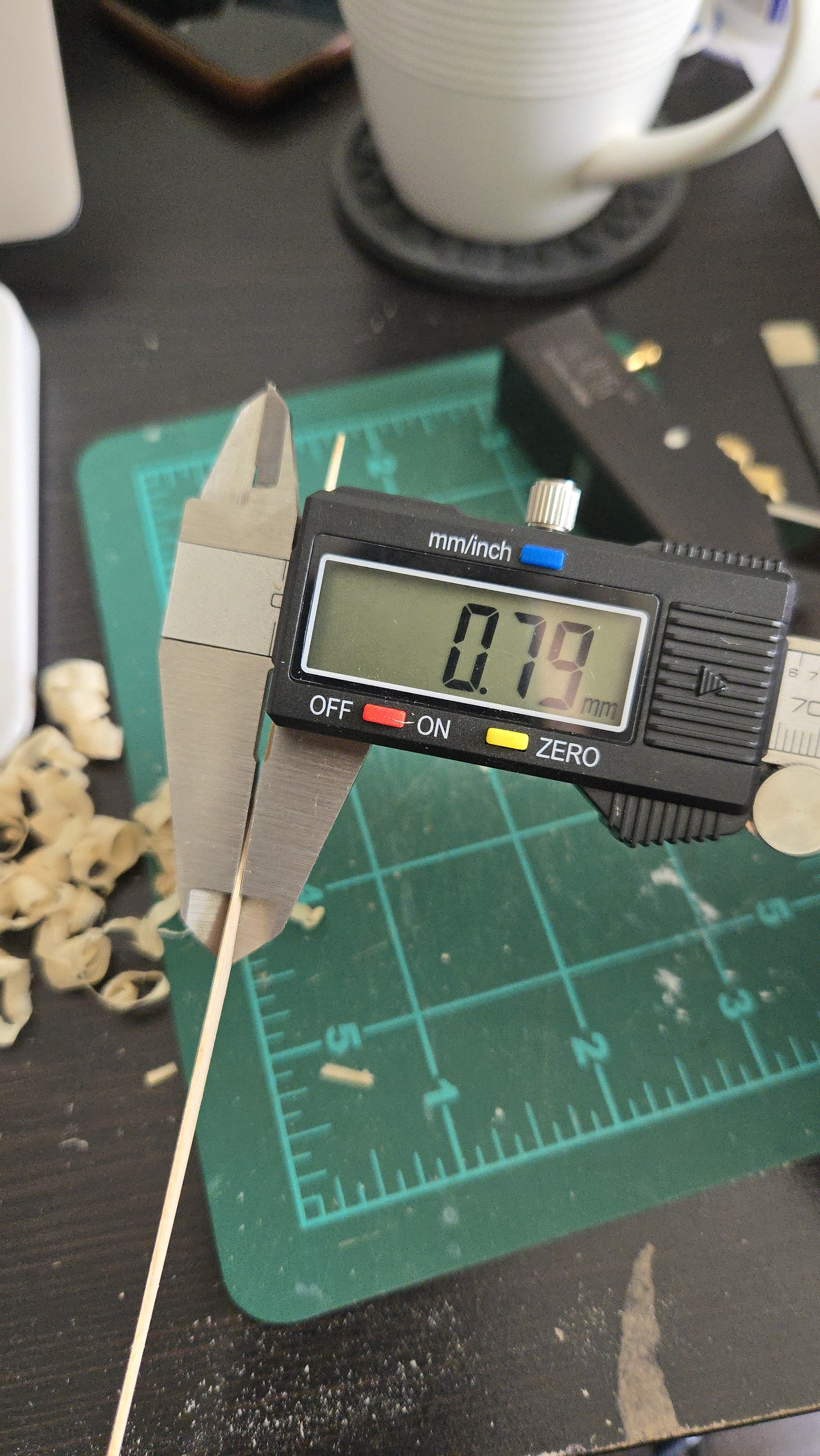

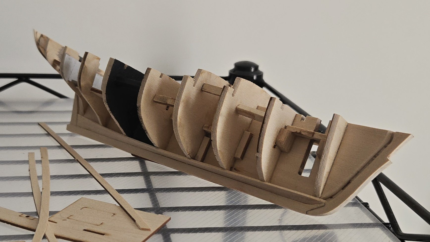

I thought I would try to dry-fit a precut garboard strake just to see what it would look like. I found it extremely difficult to bend into shape, even when soaked and heated. There's a pretty drastic twist from the stern to amidships, then another at the bow, over a fairly short distance of a little under 6 inches. I then checked with my digital calipers and found that the 1/32-inch thick basswood I had bought was actually 3/64 inches thick! (Dimensions shown in millimeters. 3/64 in = 1.19mm; 1/32 in = 0.79mm).
I began planing it down to size with my mini-plane. This went pretty quickly, although I had to check repeatedly to make sure I wasn't angling the wood and creating an uneven thickness. Below: getting closer.
And finally there!
After being thinned, the plank bent easily into place even without being soaked or heated.

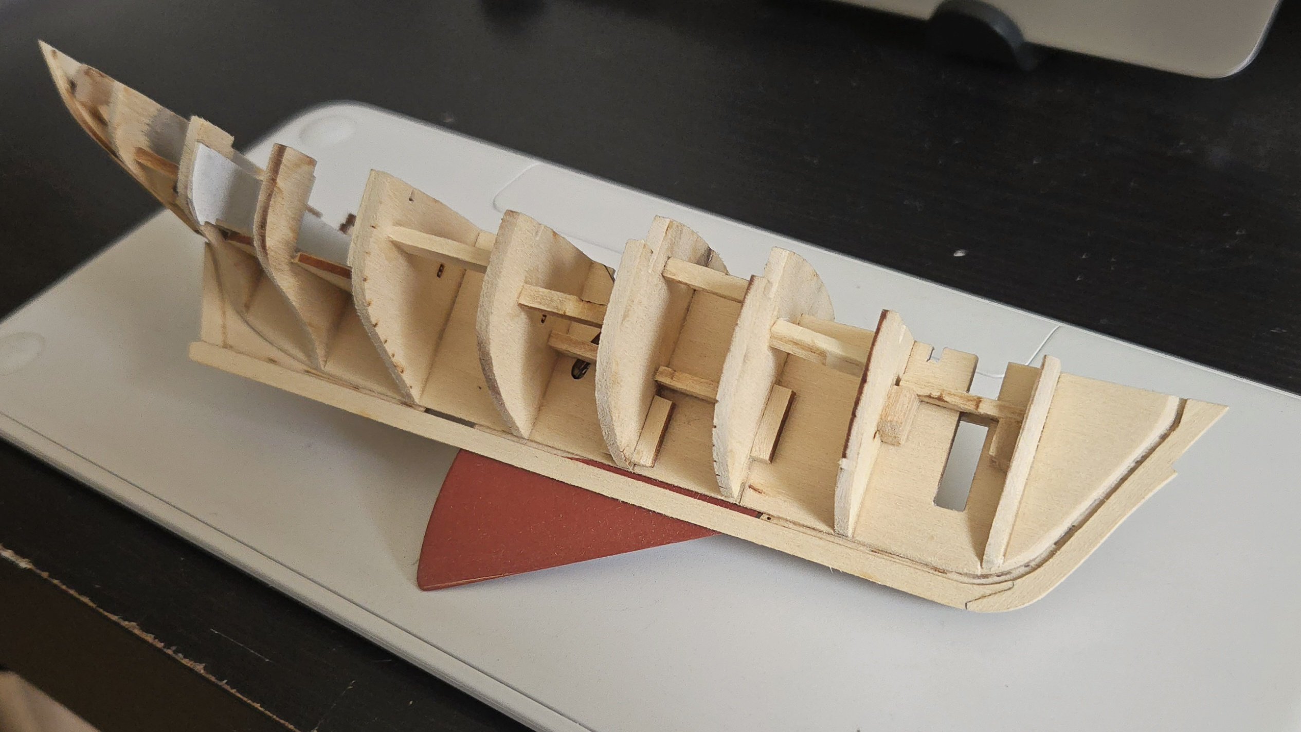

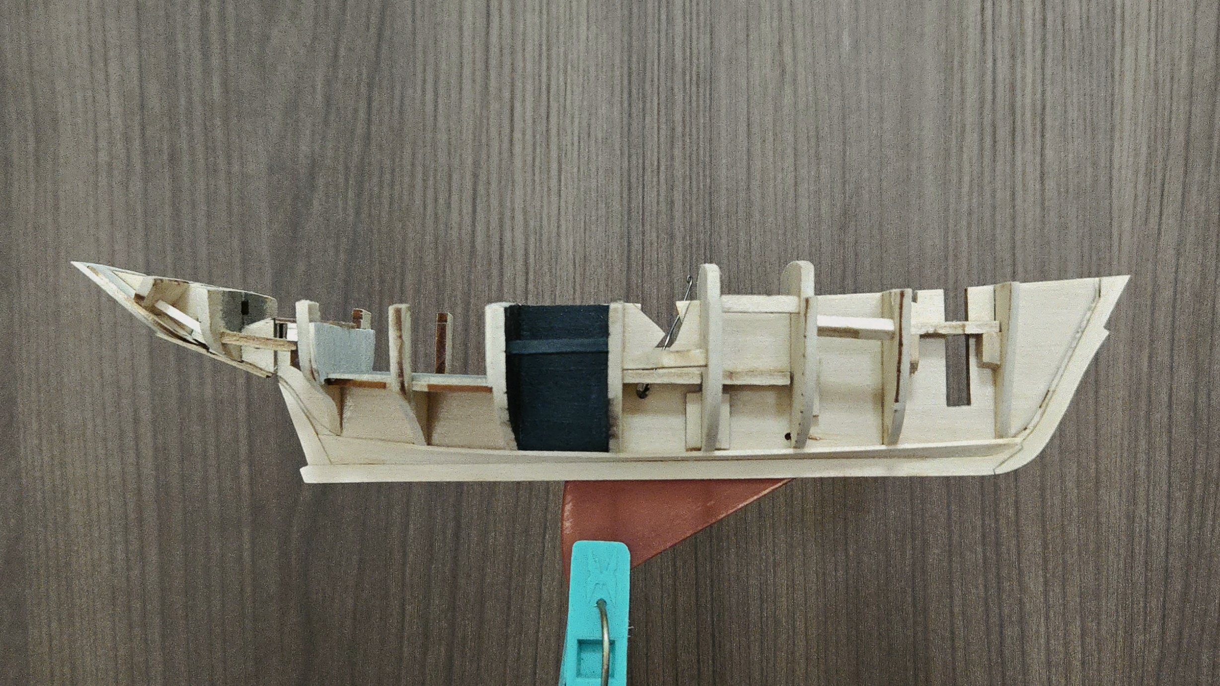

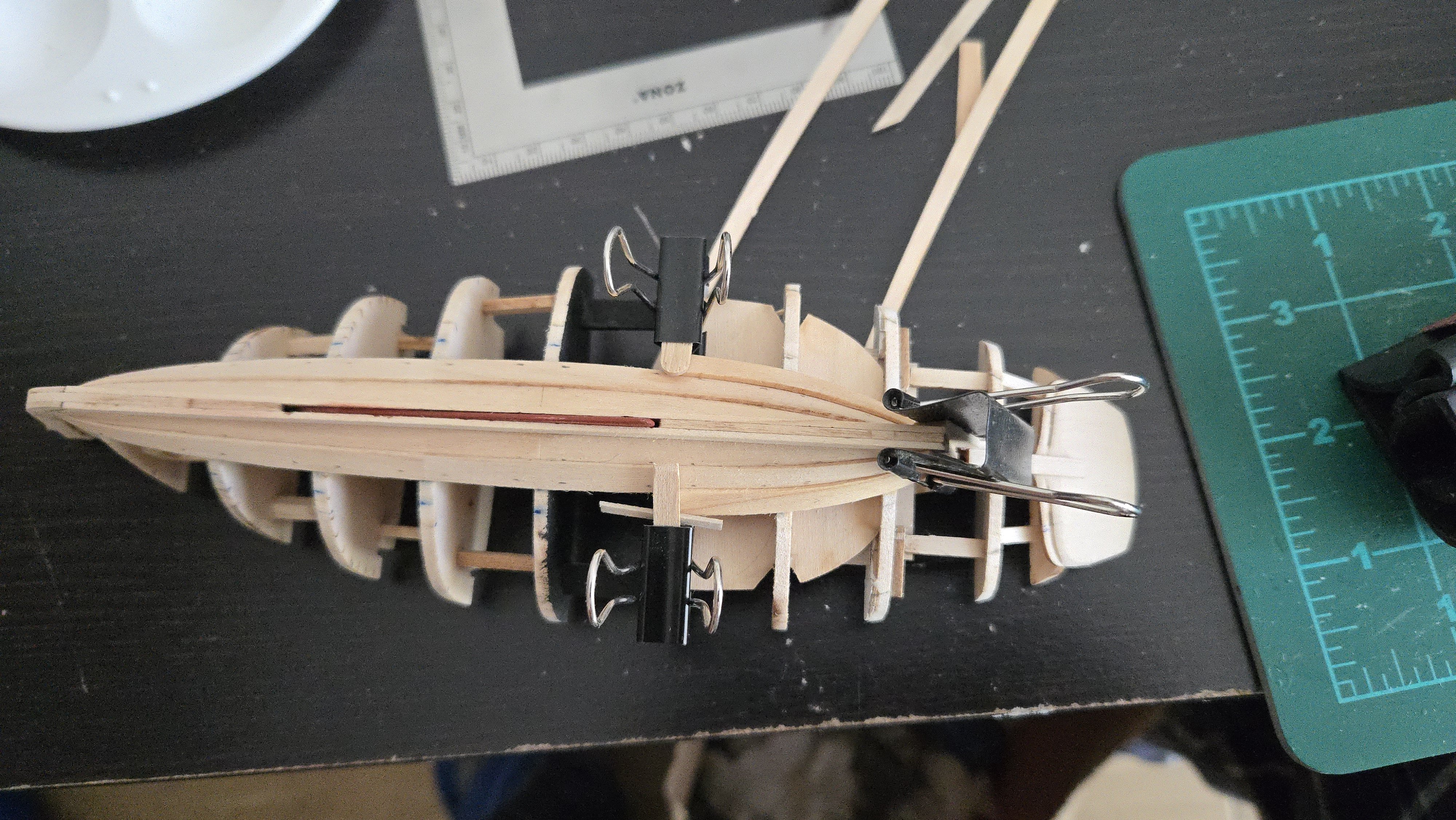

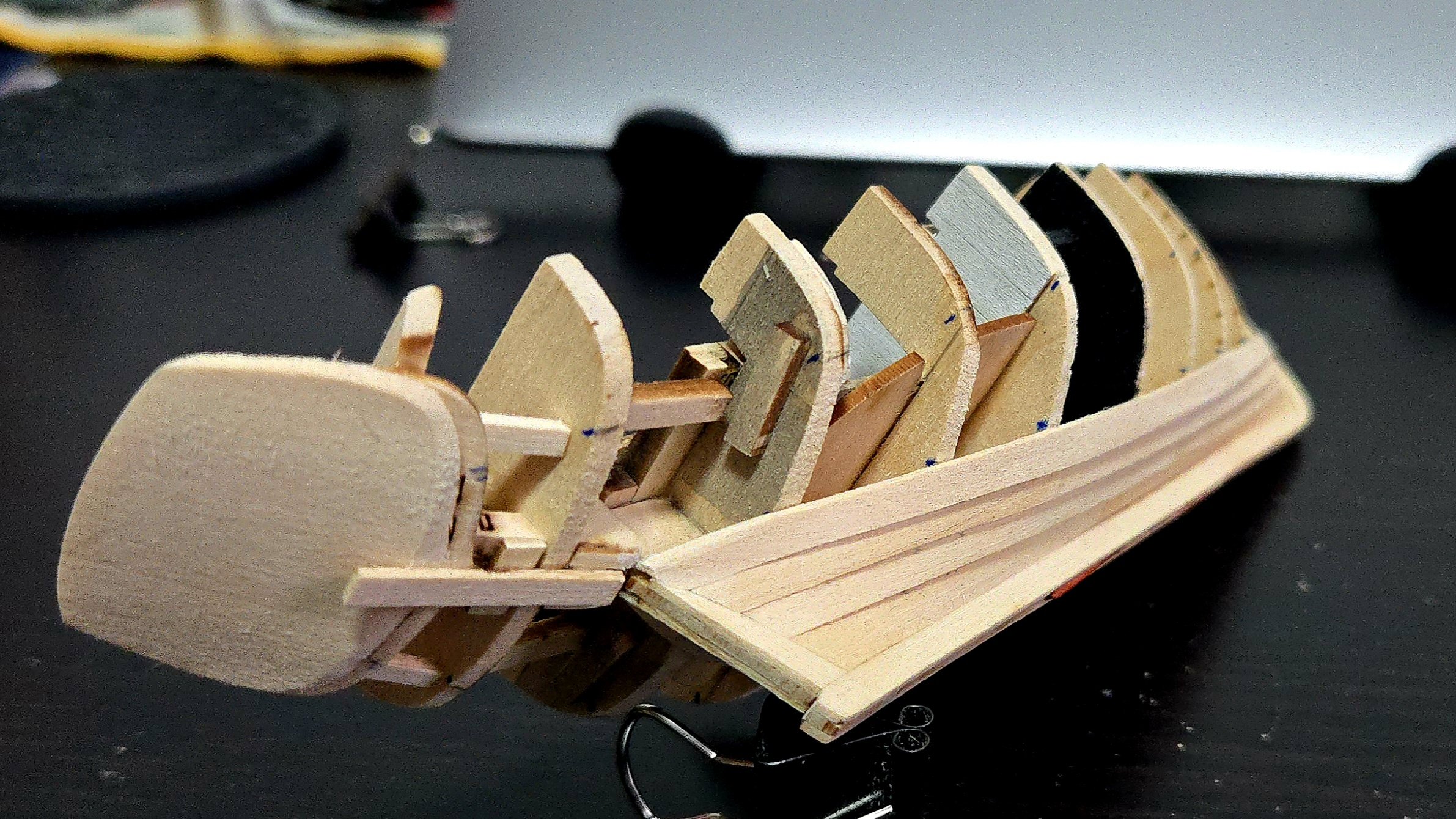

I've finally gotten the garboard on. This ended up being a more complex process than I initially thought it would be. Looking at the kit designed garboard, I couldn't shake the feeling that, while it would work perfectly for a caravel-planked hull, it didn't quite have the right lines for lapstrake planking. It was a little wide in parts, had some bulges, and nosedived a bit toward the bow--which, besides giving a slightly awkward run, also made it very difficult to properly twist the plank there as it narrowed so much that there was almost no leverage. I also found that the thinned plank looked a little too thin next to the keel.
So, I reshaped the plank quite a bit, narrowing it and removing bulges to get a nice, smooth line. Once I was satisfied with the run, I marked its edge on the bulkheads and marked out a slightly higher forrward tip. I then transferred the markings to semi-opaque Tamiya masking tape, so as to cut a new garboard. I decided to thin these planks to 1mm instead of.79mm. I also decided to make the garboard in two parts so as to better handle the sharp twists. Below, the aft garboards are drying in place. They still need some final shaping along the upper edge, but given the pronounced twist, it's easier to leave them slightly wide for now, and shape them to the line once they've had the twist added.
While working on the garboard, I also painted the interior of where the wells will be located. I'm considering leaving one well partially opened, and thought it would be easiest to paint everything I could now before the hull is closed up (although of course I'll still need to paint the inside of the planking). This isn't an original idea, @Desertanimal did the same on his kitbash (and it looked great) so I'm copying him on this.
Here we can see the full garboard strake. I think it has a nice smooth run that should provide a good basis for the other planks, without going too high at the stem. (As can be seen, the centerboard has gotten a bit banged up, and was briefly stuck in the raised position due to excess glue. The paint needs some touch-up.)

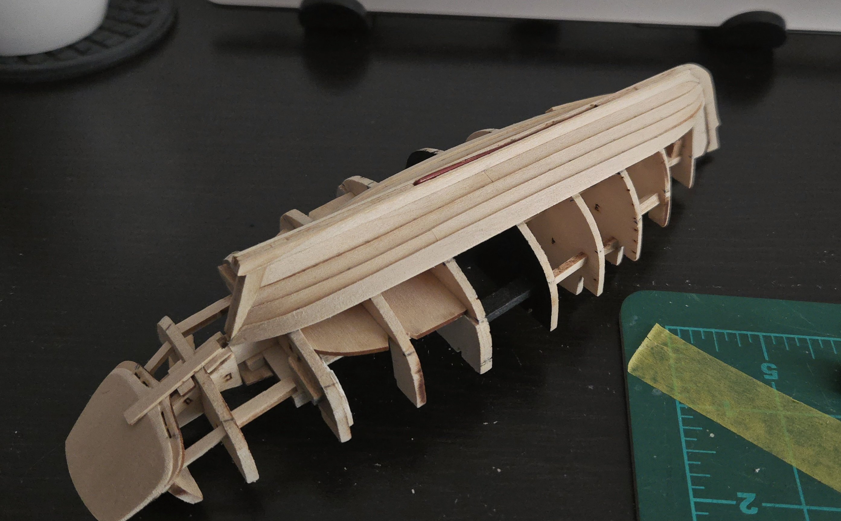

Now that the garboard is on, I need to line out the remaining planking.

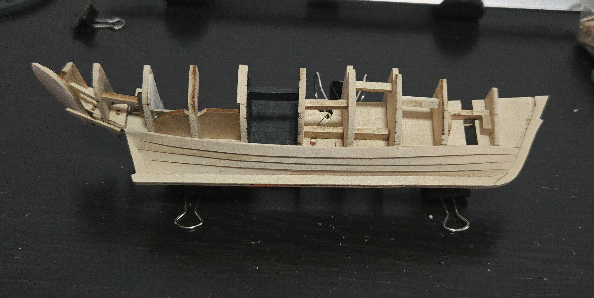

I've been working on trying to line out the hull planking. It looks like a lower band of 3 strakes, and two upper bands of 4 strakes each, should work well and will end the lower band right at the top of the sternpost.
That said, I've been having some trouble lining off the hull. Close to the stern, the chart tape has to be basically "edge bent," which it doesn't at all want to do, leading to a lot of buckling that makes it tricky to see whether the lines are fair and even to bring the tape in line with the sternpost.
3 hours ago, druxey said:
Use thread instead of tape.
Thanks! I've tried using thread soaked in glue and dampened before, but I never got it to stick. This time, I decided to just secure it at each bulkhead with a small dab of white glue, which I could then dampen to loosen when I needed to adjust the run a bit. The thread is much more precise than the chart tape, which is nice. For instance, in the photo below, the run is very slightly off at the bulkhead just aft of the black-painted portion, being slightly too close to the keel. I hadn't been able to see that before with the chart tape, but thanks to the thread, I was able to adjust.
The runs of the planking bands look pretty good now (the slight wonkiness at the sternpost is because I had trouble gluing the thread down there, so one side glued in at a slightly different angle than the other).
I'll let it sit overnight to look over with a fresh eye tomorrow, and then it will be time to mark everything out and begin planking.

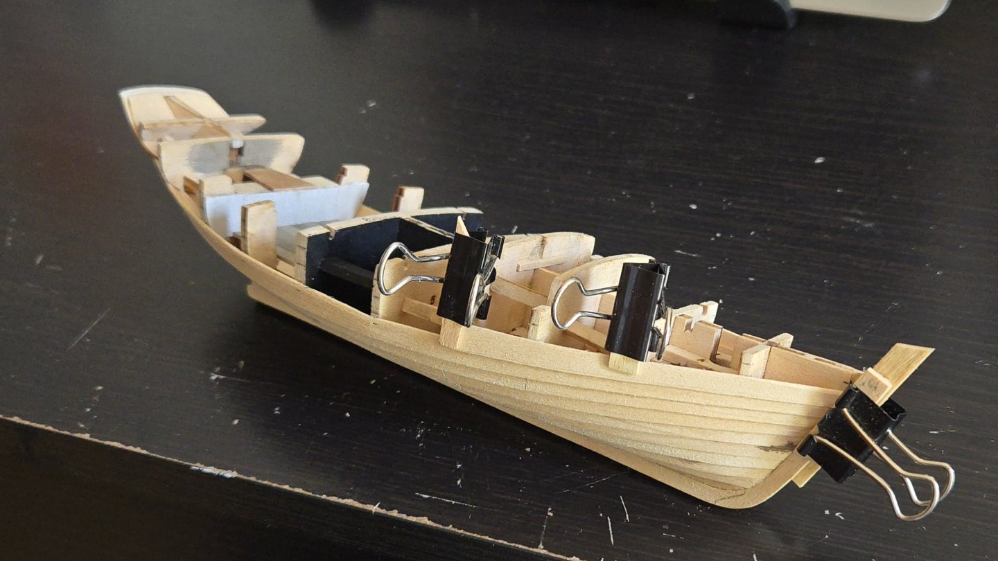

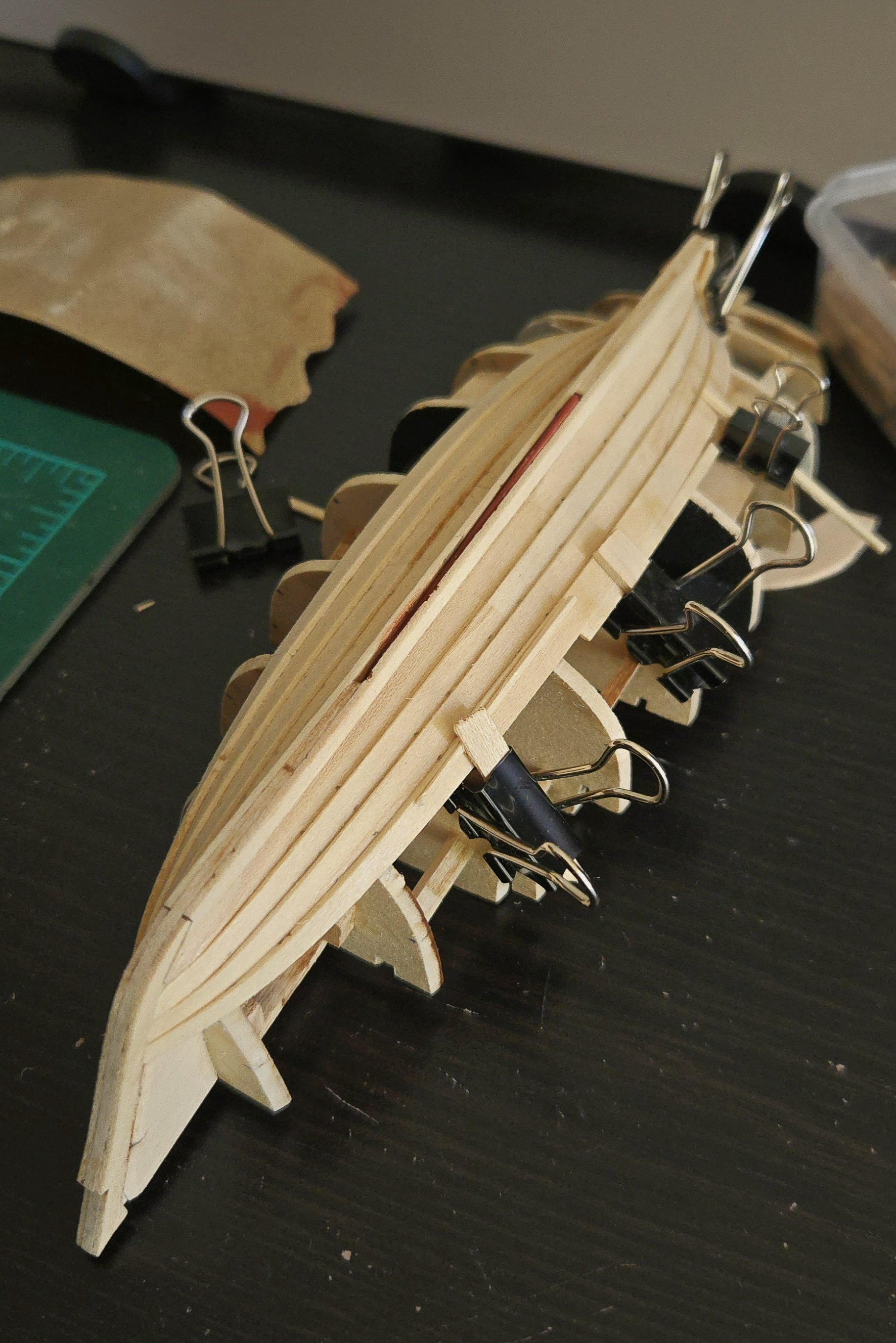

I've started planking!
After making some adjustments to the run of the threads, I was happy with my planking bands. Before I could start planking, I needed to prep the lands on the garboard. I'm doing a somewhat simplified lapstrake construction in which the planks are beveled at a 45-degree angle at the bow and the stern, so that the strakes lie flush there. (This part I shape before the plank is attached to the hull). Over most of the strake, though, they overlap, and the lower strake needs to be slightly beveled for the upper strake to overlap it over a flat surface. Following the example from Druxey's Greenwich Hospital Barge build, I made a small sanding block about the width of a plank, with sandpaper over half of the surface. That way I can place the sandpaper-less side against the bulkhead and sand the lands into the lower strake at the correct angle to receive the upper strake.
Once I sanded the lands into the garboard strake (which is barely visible in the photo below), I marked the overlap so that I could properly mark and fit the next plank.

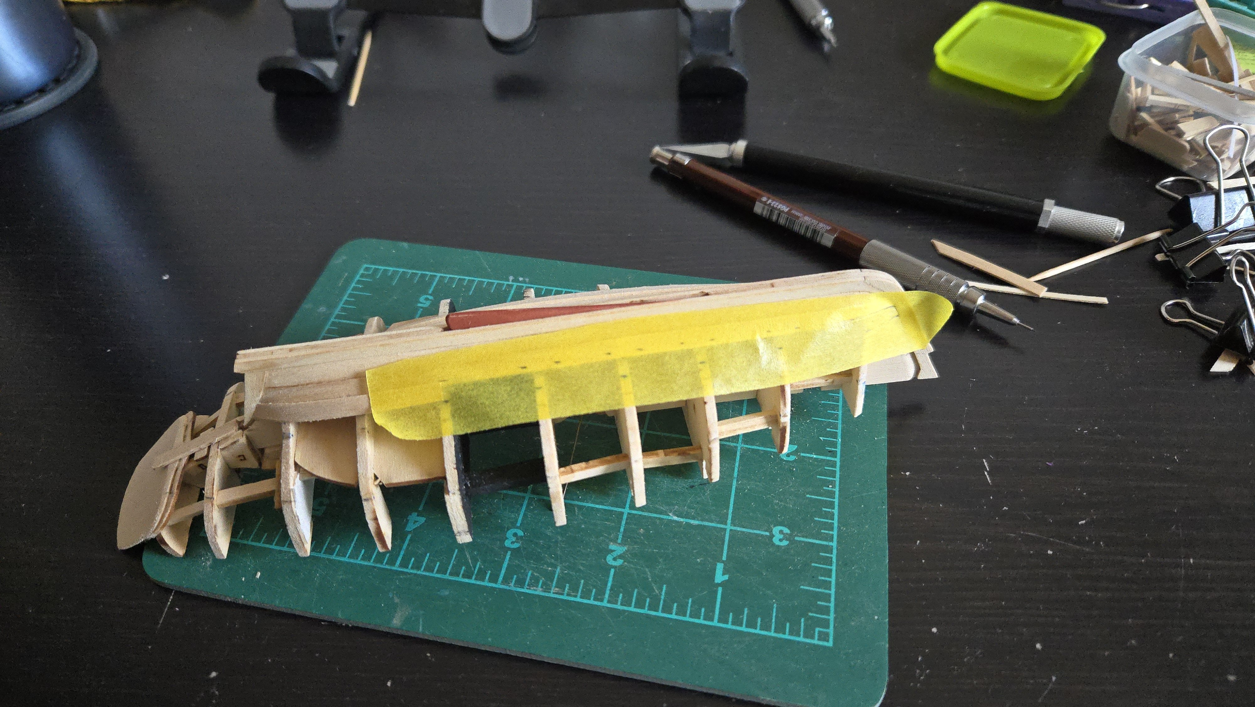

I then used masking tape to mark off the plank shape. I found that the plank shape nearly matched the kit design for the next plank, which is not surprising. The one issue is that, as can be seen below (kinda--the marks on the tape are very faint), the kit designed plank is a bit too narrow towards the bow.
So, I decided that this strake will, like the garboard, also be made of two planks. Looking at photos, it seems that it wasn't uncommon for similarly-sized Friendship Sloops to have multi-plank strakes (usually a bit more irregular than the nicely laid-out butt shift patterns we strive for in modeling), so I don't think it's unreasonable. It also makes fitting the planks substantially easier. So I chopped off the too-narrow fore portion of the kit-designed planks and did the required adjusting, and then soaked and bent them into shape.

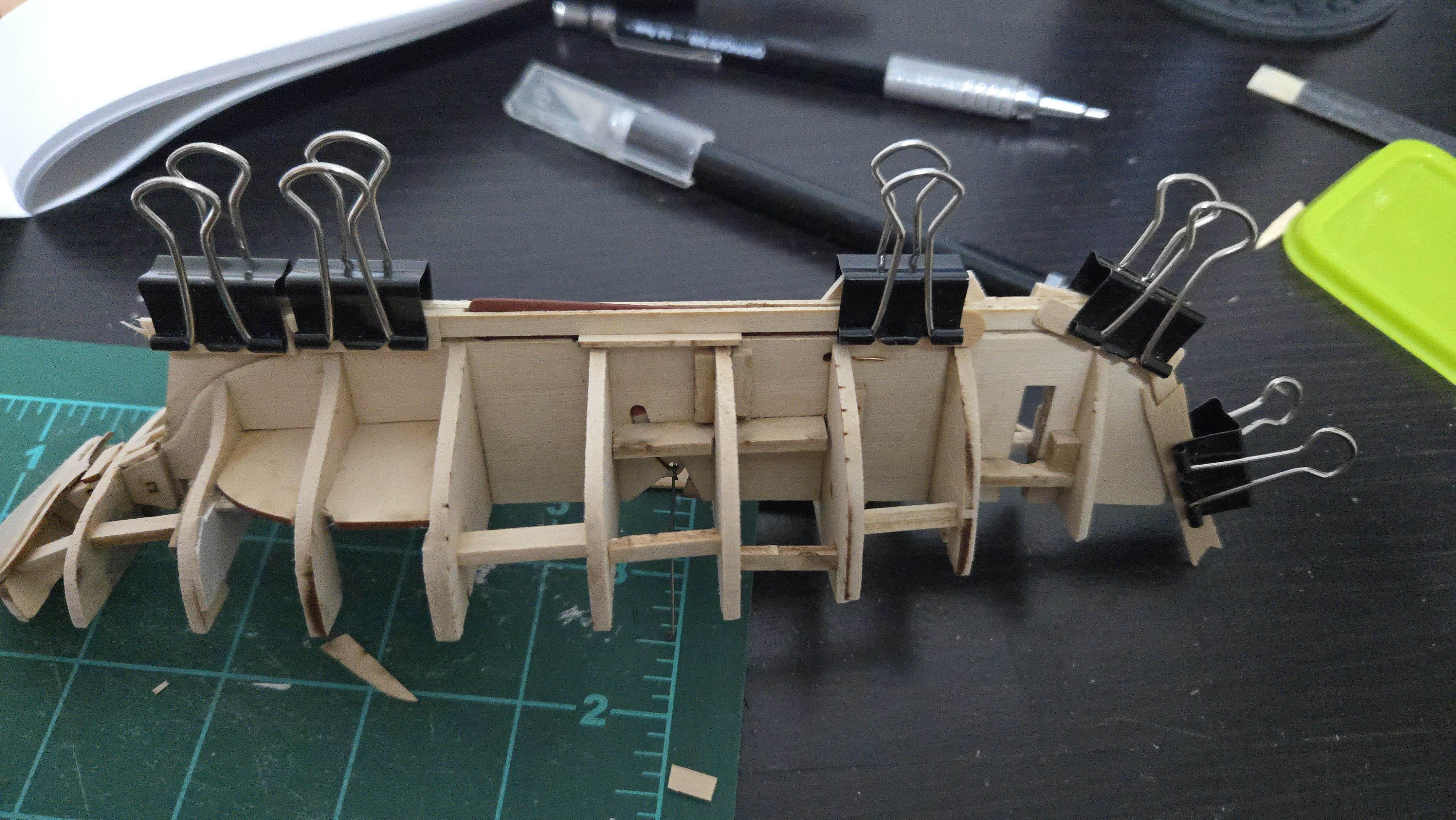

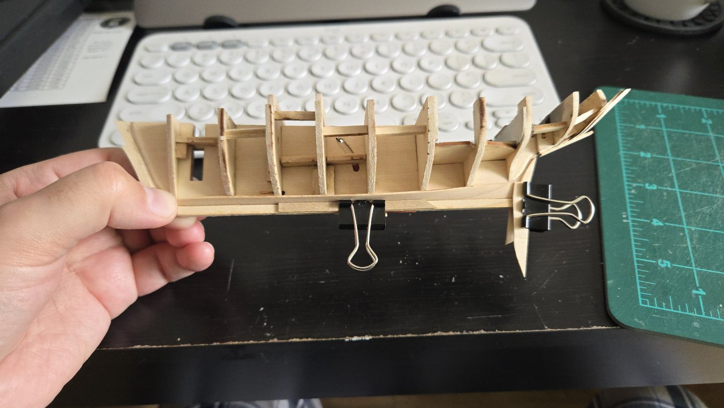

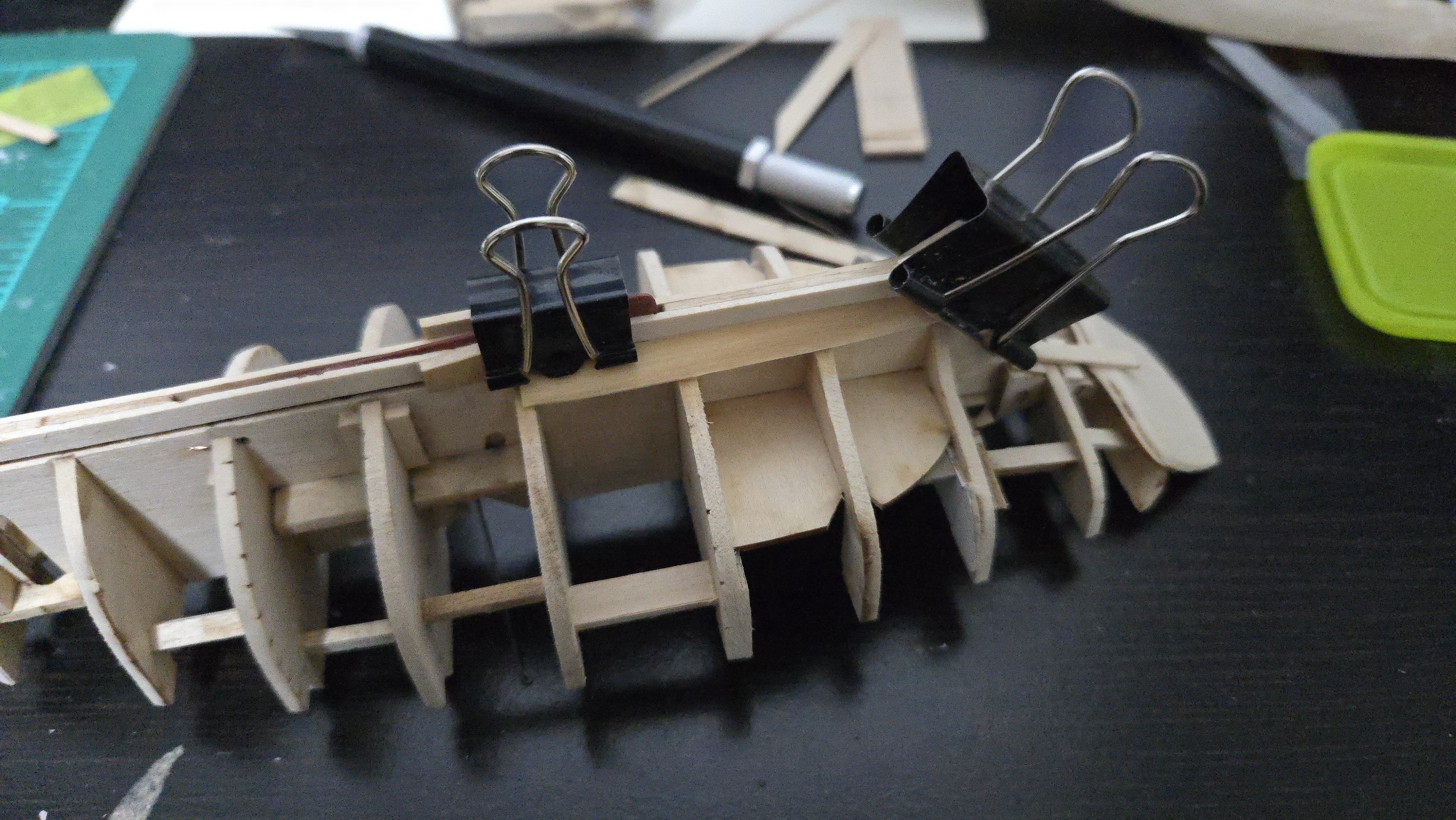

After both aft planks dried, I went ahead and glued them in place. I realized that clamping lapstrake planks is a little different from carvel. With carvel planks, you're not just clamping against the bulkheads, but sideways against the previous strake. With lapstrake, you can't really do that, because there's nothing to keep your plank from just sliding down. I had a very slight adjustment to make to the curve of the plank, and ended up using a block of scrap wood, as can be seen, that happened to be the right size to fit between the plank and the keel. In further strakes, this won't really be possible.
With the aft plank on, the way the plank transitions from overlapping to flush at the sternpost is visible.
