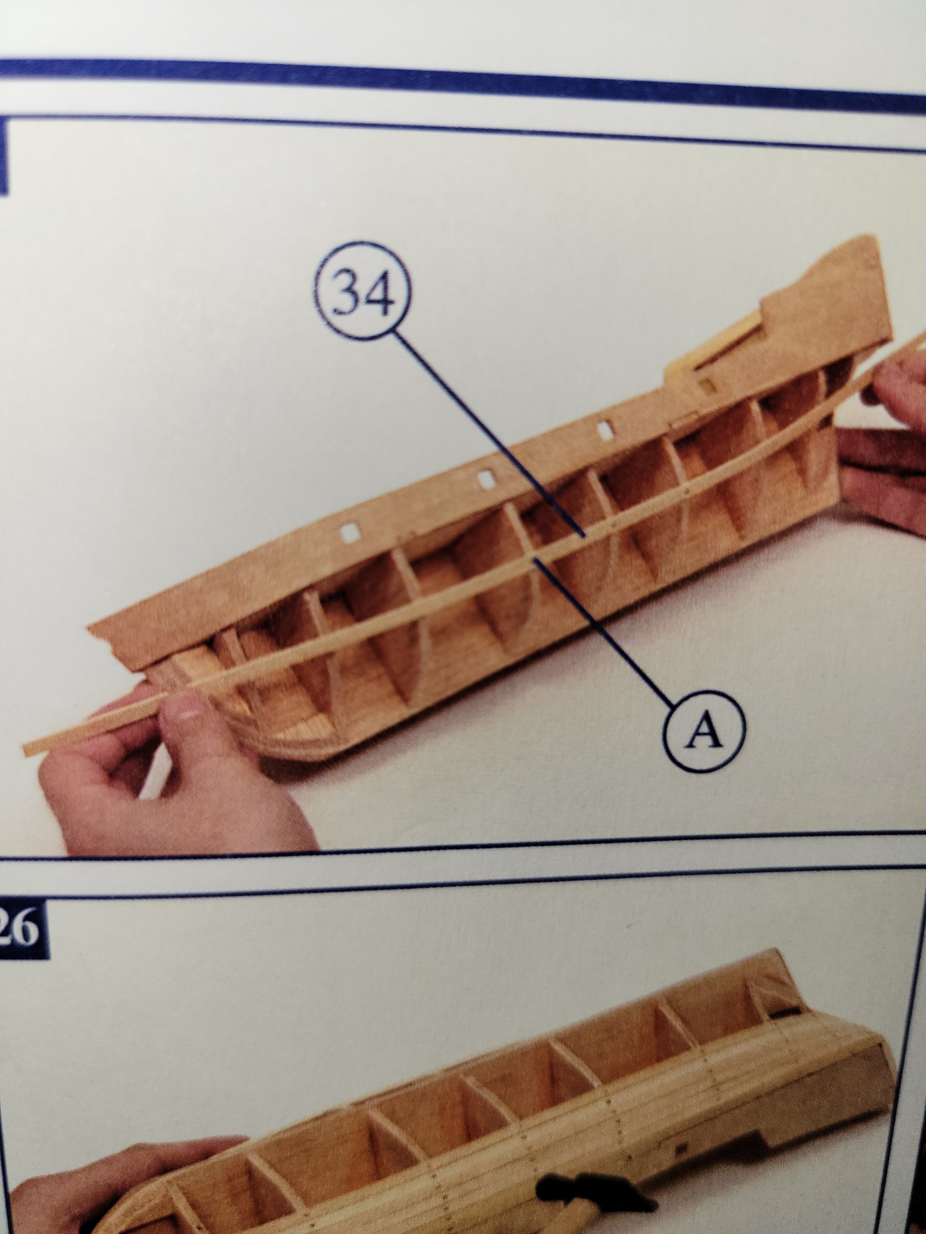

Being new to all of this could anyone explain why it is that I'm to start planking in the middle and not start from like maybe the bulwarks?
What brand of model is this? Olha Barchvarov on her Youtube channel recommends starting with the gunwale in the middle sometimes. For doing planking, I'd say do what seems to work, and best to follow some good examples from build logs or videos or documents. I can't imagine given what you're showing that it matters. A challenge of starting in the middle would be making sure you have everything straight. But starting at the top (which I've done before) or bottom would also mean making sure you're staying straight.
A way of planking boats and ships is to mark a straight plank somewhere in the middle of the hull. This way the planks above and bellow will not have excessive curves during spilling or in your case will not need to be bent sidewise too much.
Notice this plank (wale) is probably the same width from bow to stern, and probably easiest to install.  Planks from the wale above probably are not tapered (width reduced) amidships, and at the stern; and probably are towards the bow.
Think of a picture frame when considering planking from the Wale to the Keel.  This first plank is the top of the frame, the Keel the lower frame, and the stem and stern post the sides.
The skill is understanding where the lower planks need to be tapered (width reduced), and doing it.
There are many postings in this site, and books have been written on how to do this.
From my experience AL kit instructions do not show this.  Hence builders of these kits, usually beginners, may not get the results they imagine.
