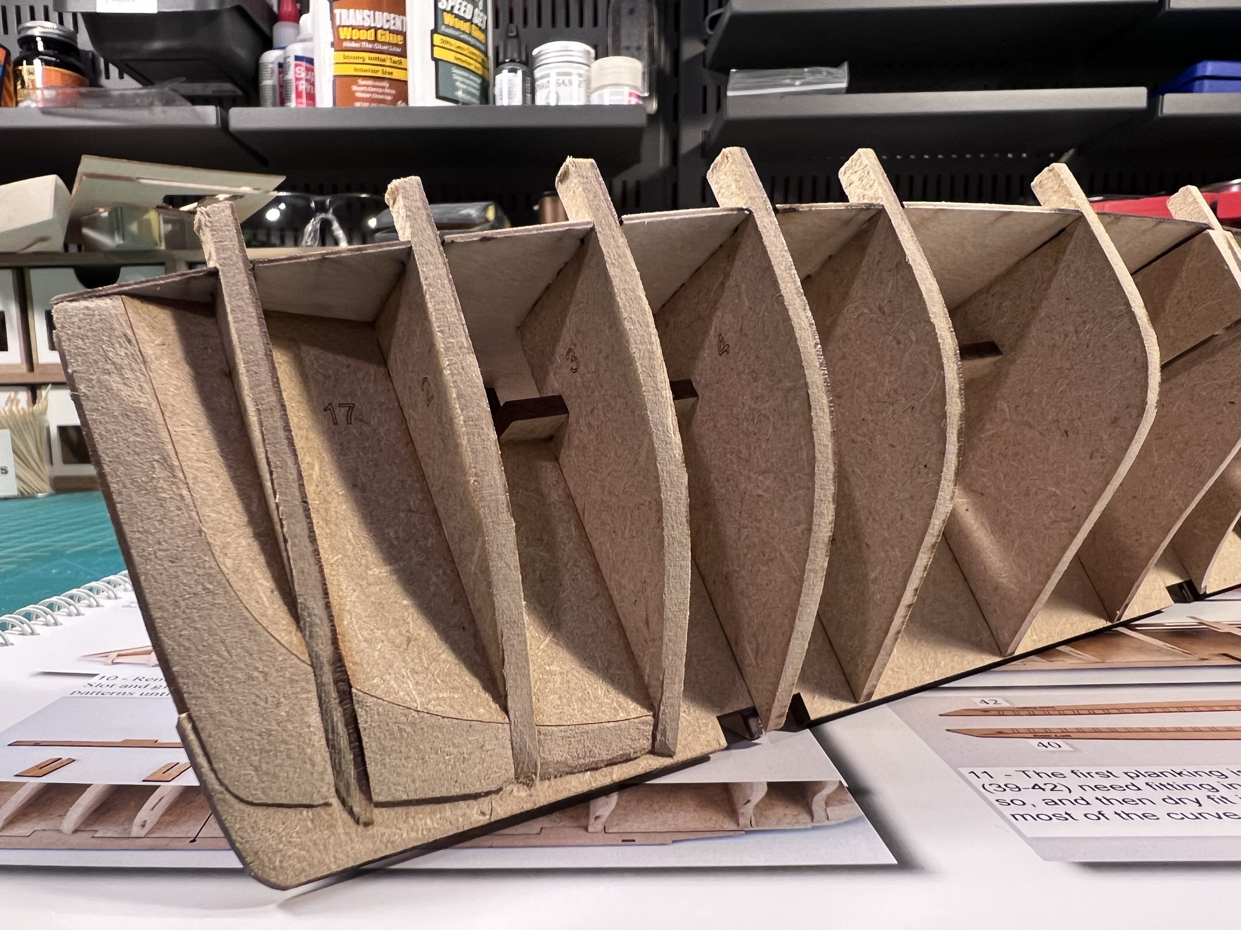

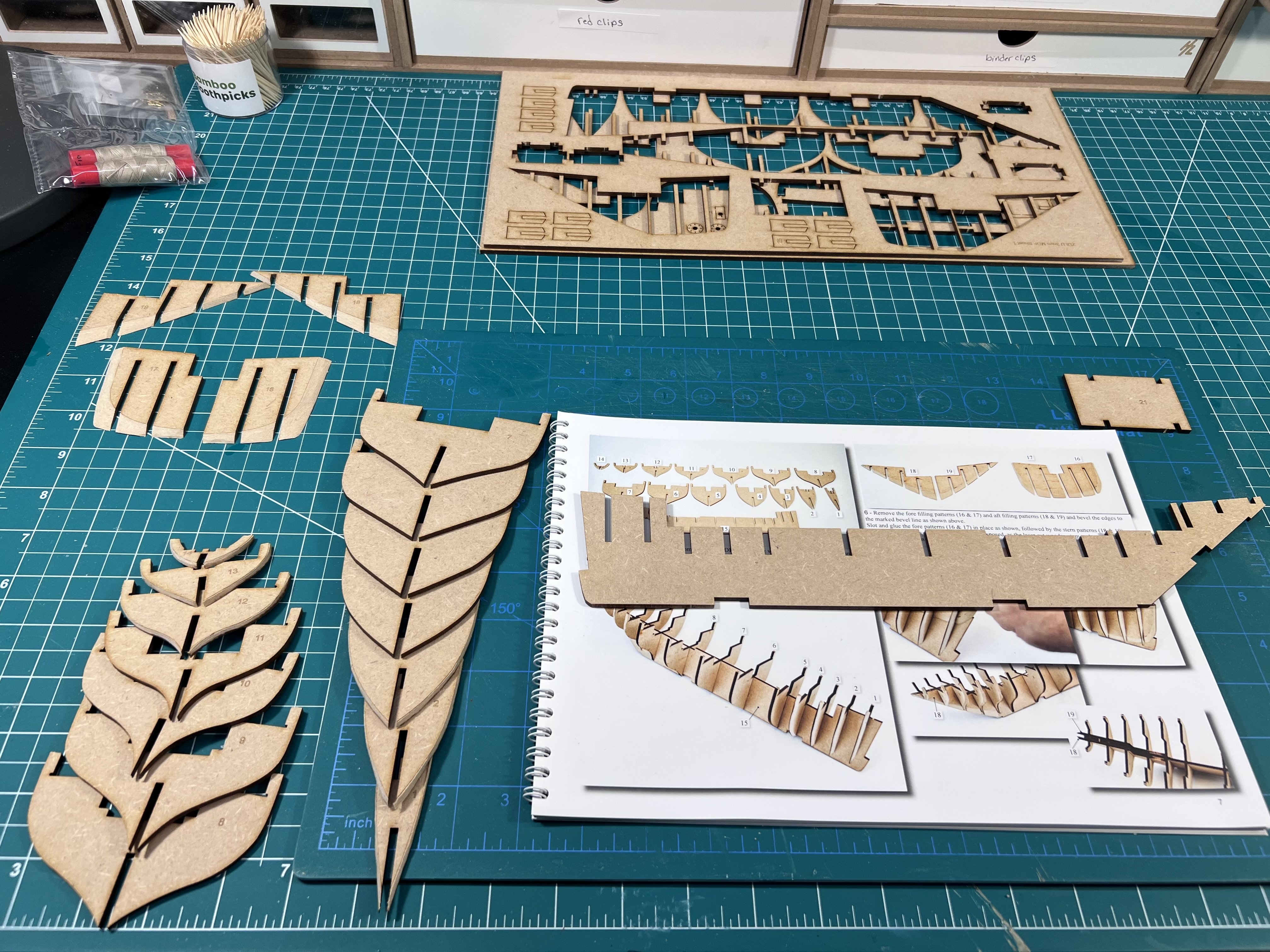

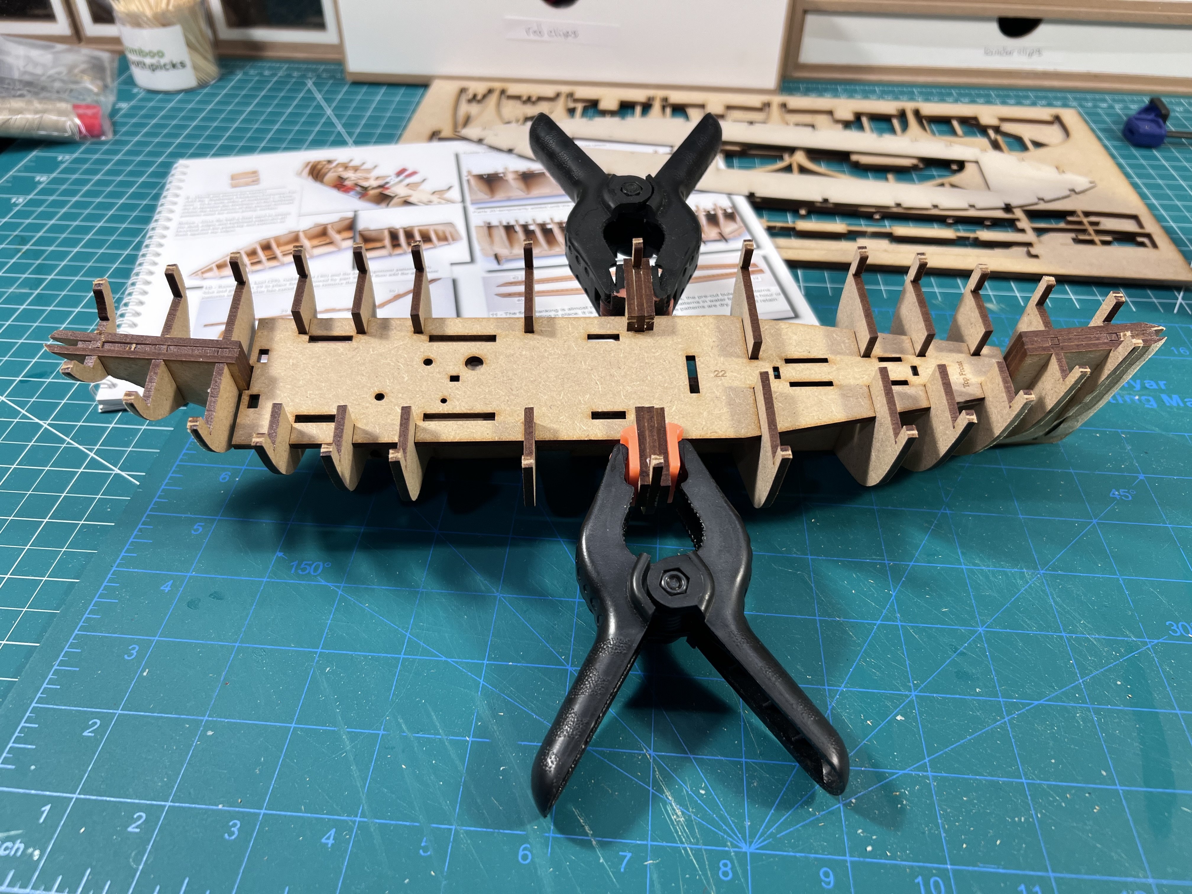

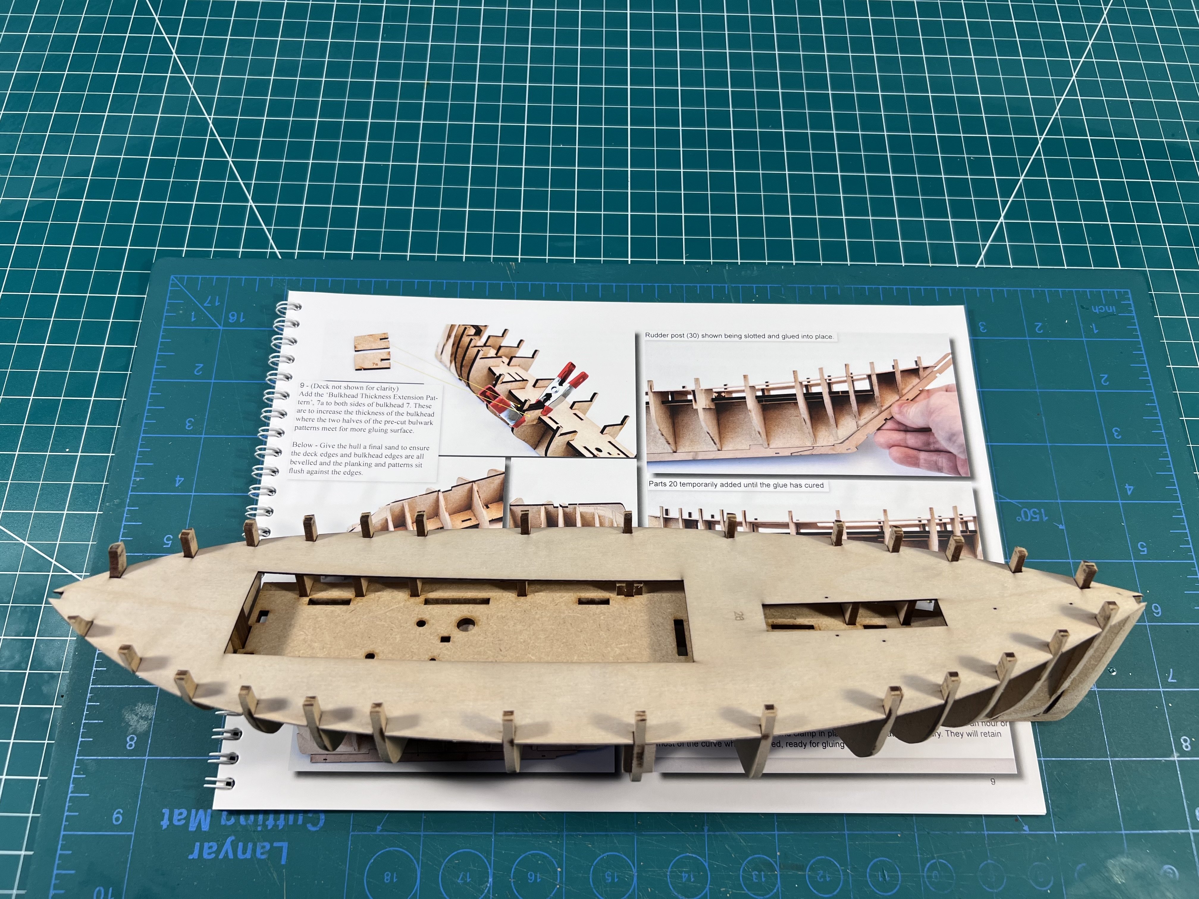

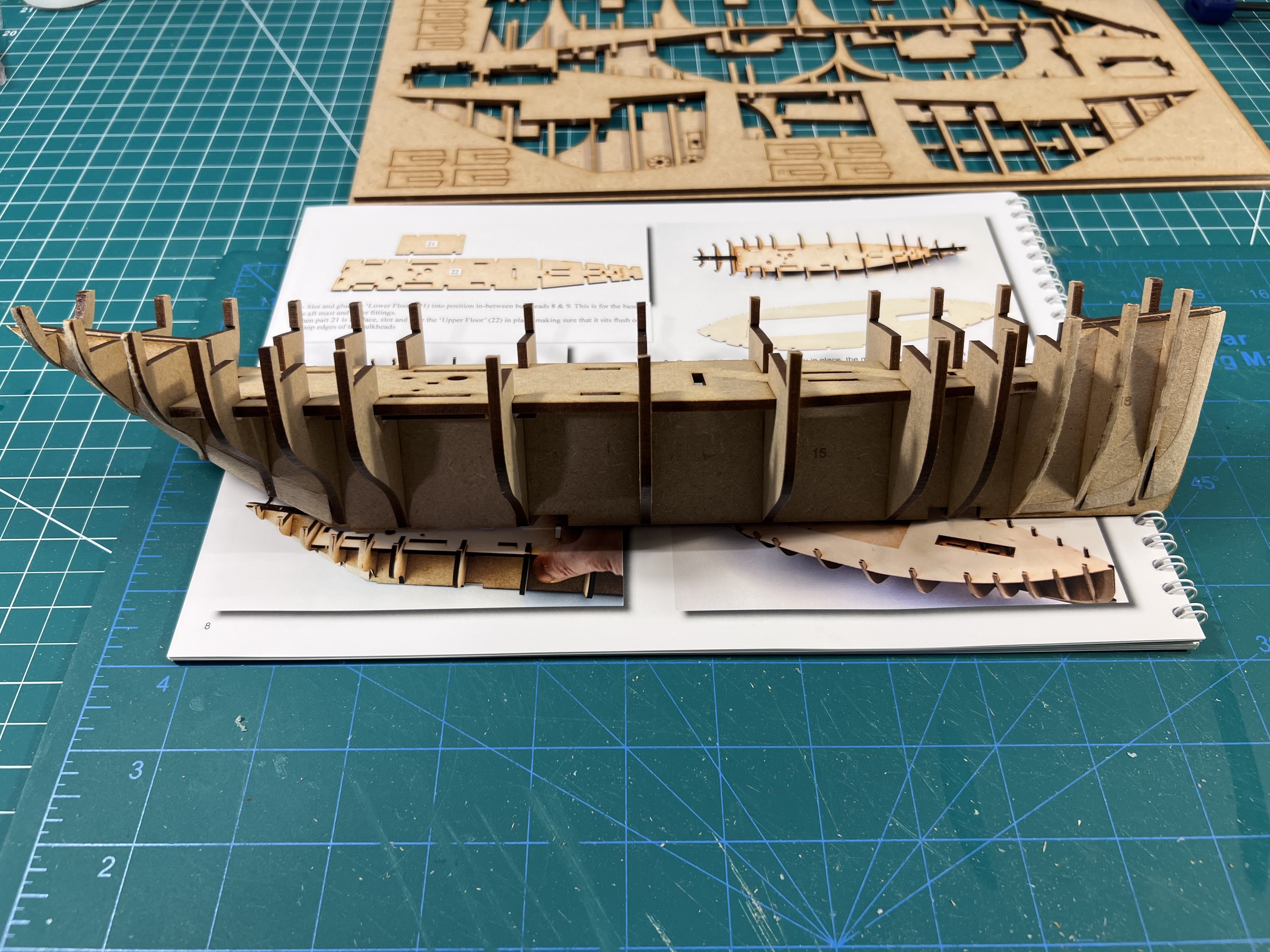

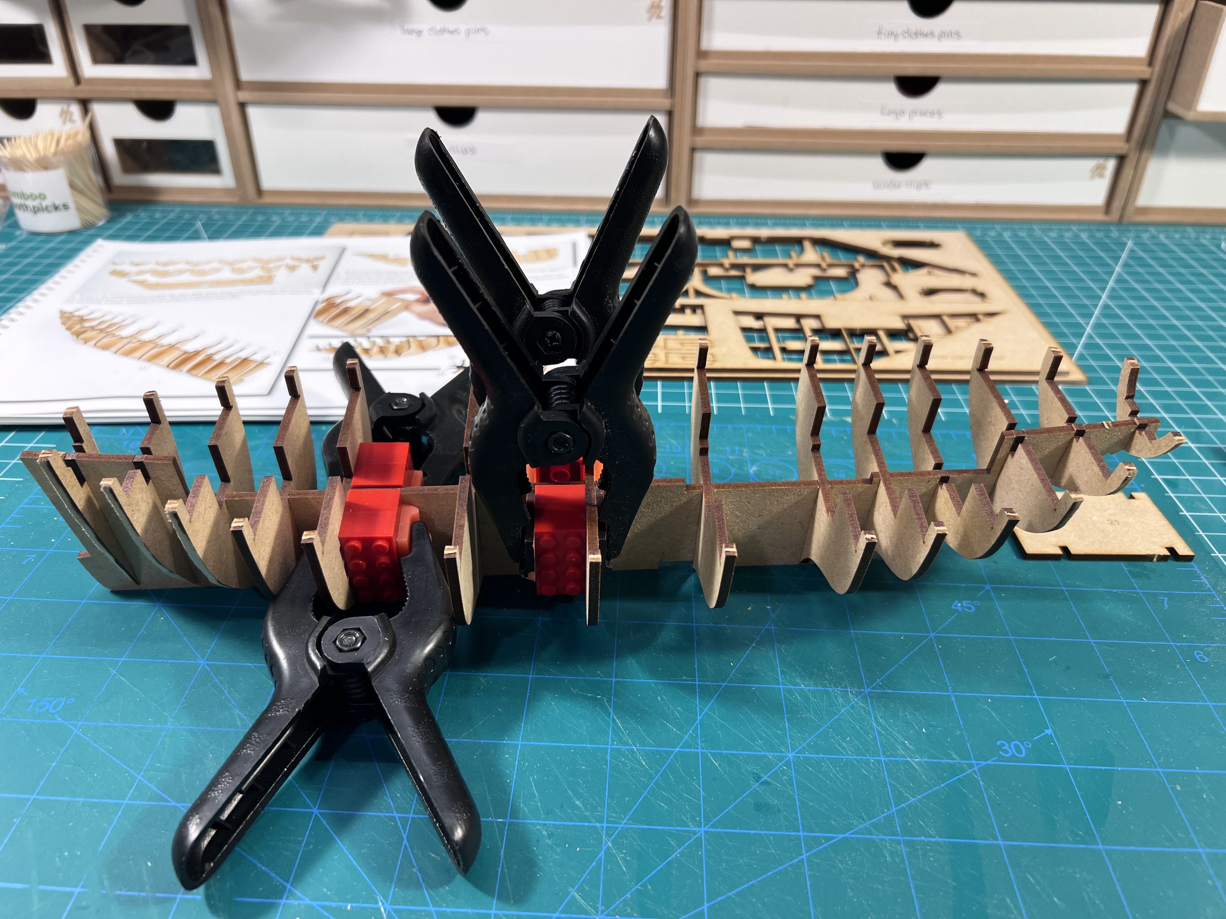

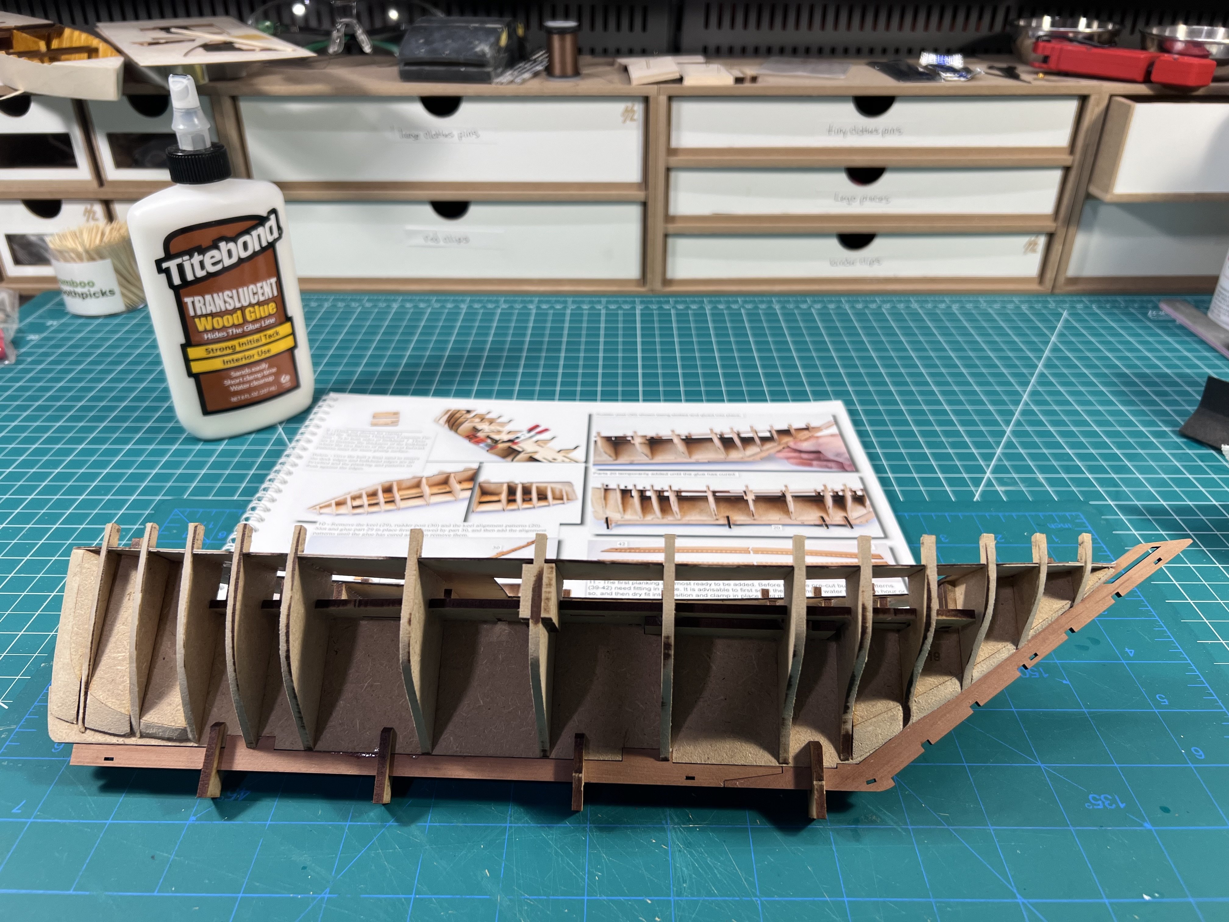

Putting together the bulkheads and other supports. I can see the engineering genesis from this early model (one of the first Vanguard models) to the more recent models in terms of the various kinds of supports and internal architecture. Thus one goes together really well and the bulkheads essentially go into place square, but these ones are glued into place whereas the Sherbourne and Ranger were assembled without glue and then glue was added later to where the pieces come together for some redundancy.

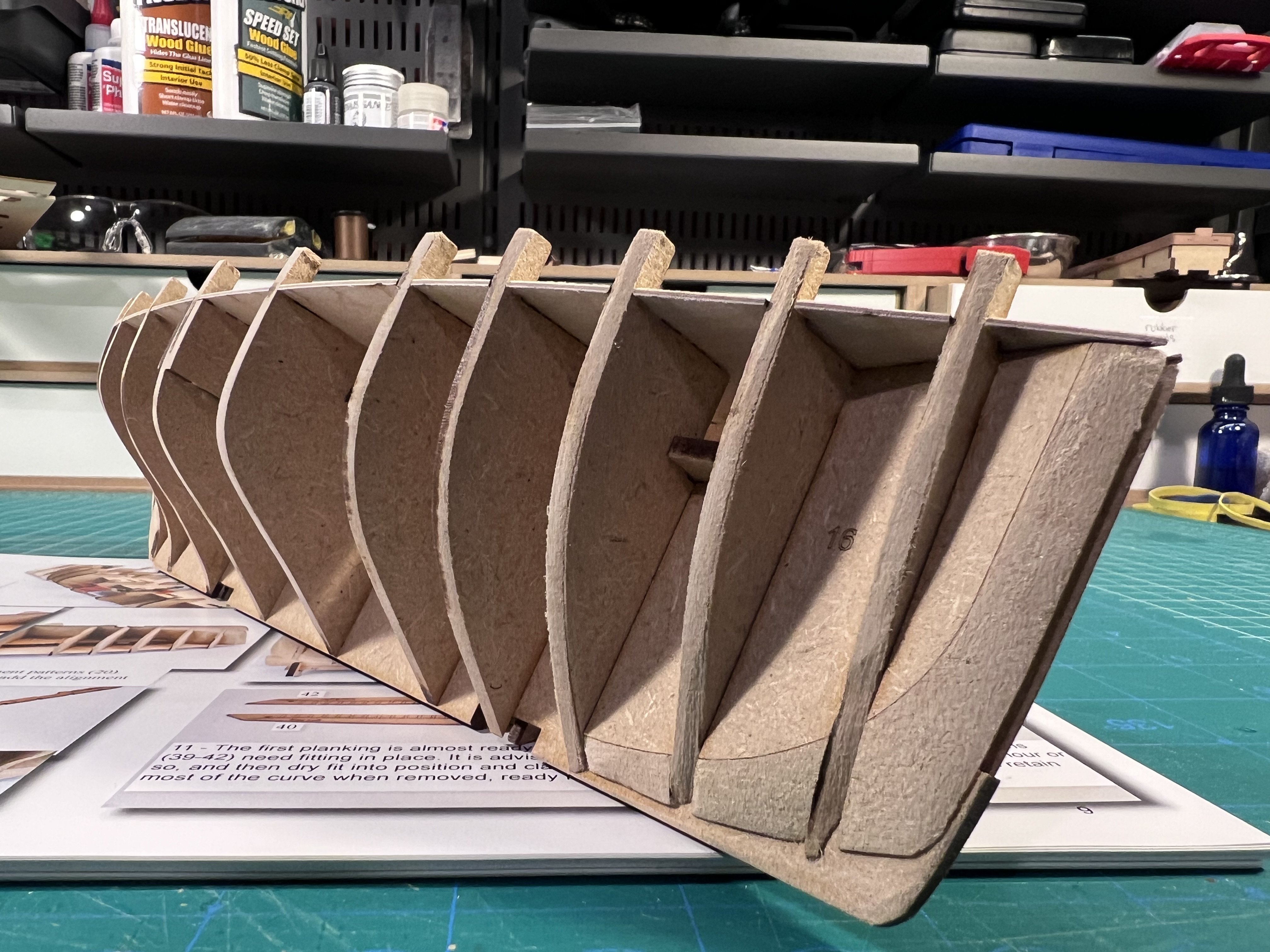

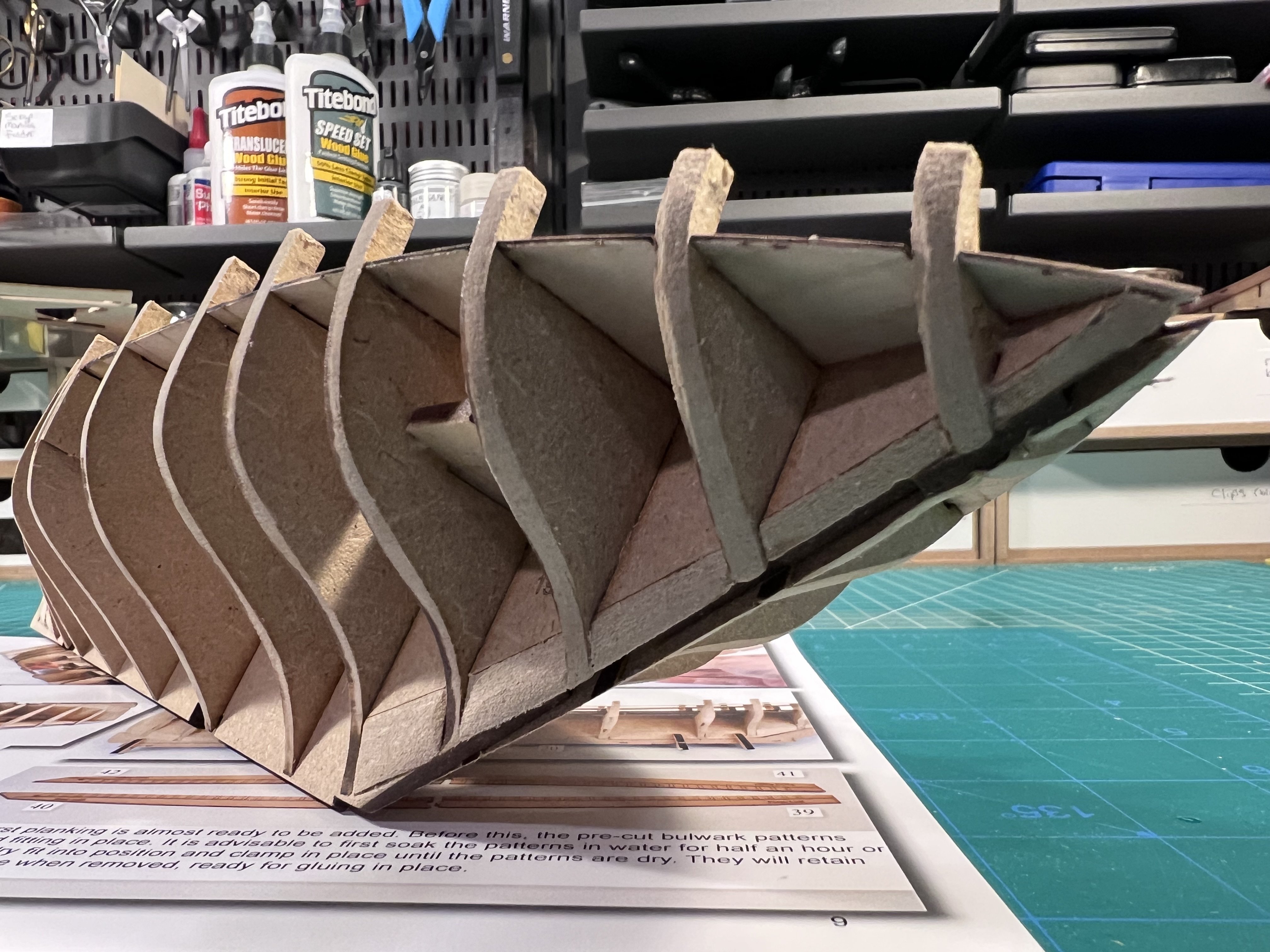

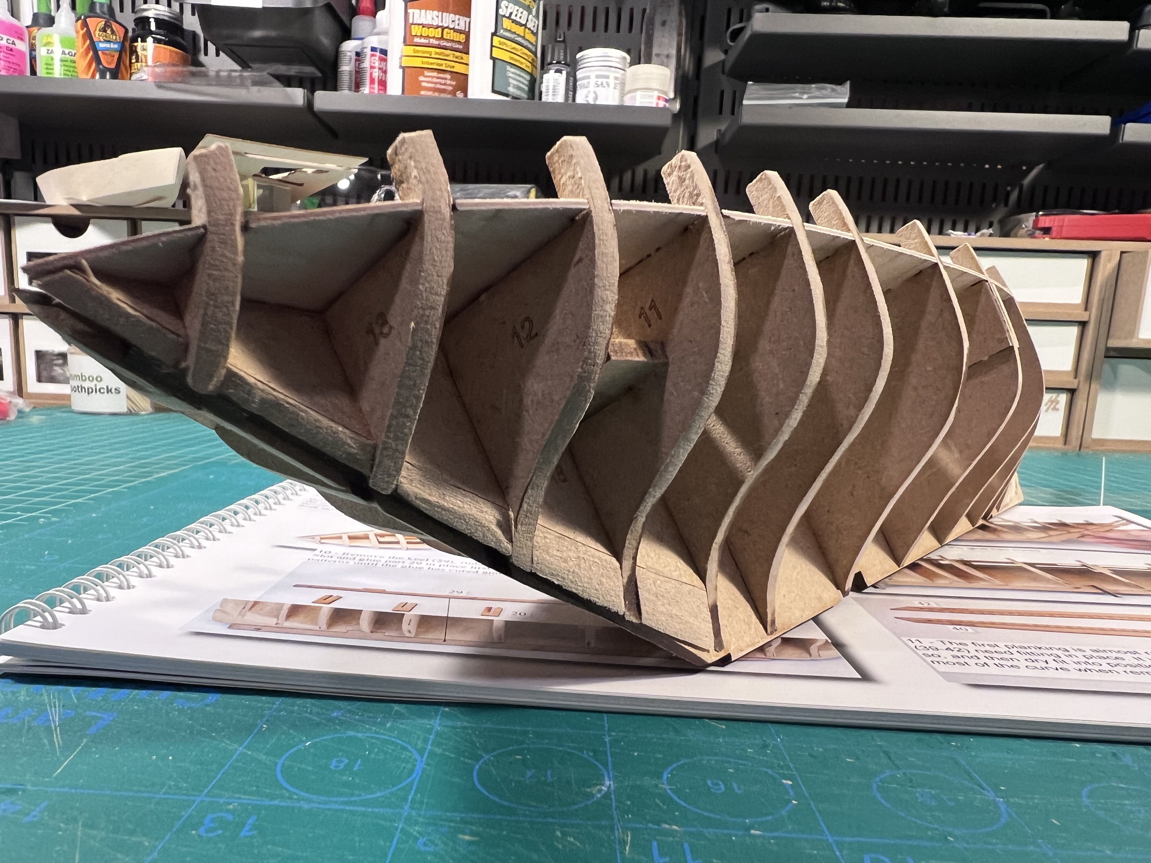

It’s interesting that the instructions don’t really describe “fairing” the hull - just sanding to ensure that all the bulkheads are bevelled (I know that’s the same thing). This is certainly the easiest hull I’ve faired. Now looking, I have a few spots to fix but it’s close. Thought I’d include photos in case someone new doing this model wondered what it should look like.
As recommended, I’d definitely recommend “pre-fairing” the bulkhead pieces - easiest to do using a Dremel with a sanding cylinder. Only a few need to be done. The most extreme are the filling pieces front and back to secure everything tight. These pieces would be a hassle to fair from scratch on the model.
It's definitely an interesting hull shape. I have to wonder what purpose the sharply raked stern served.

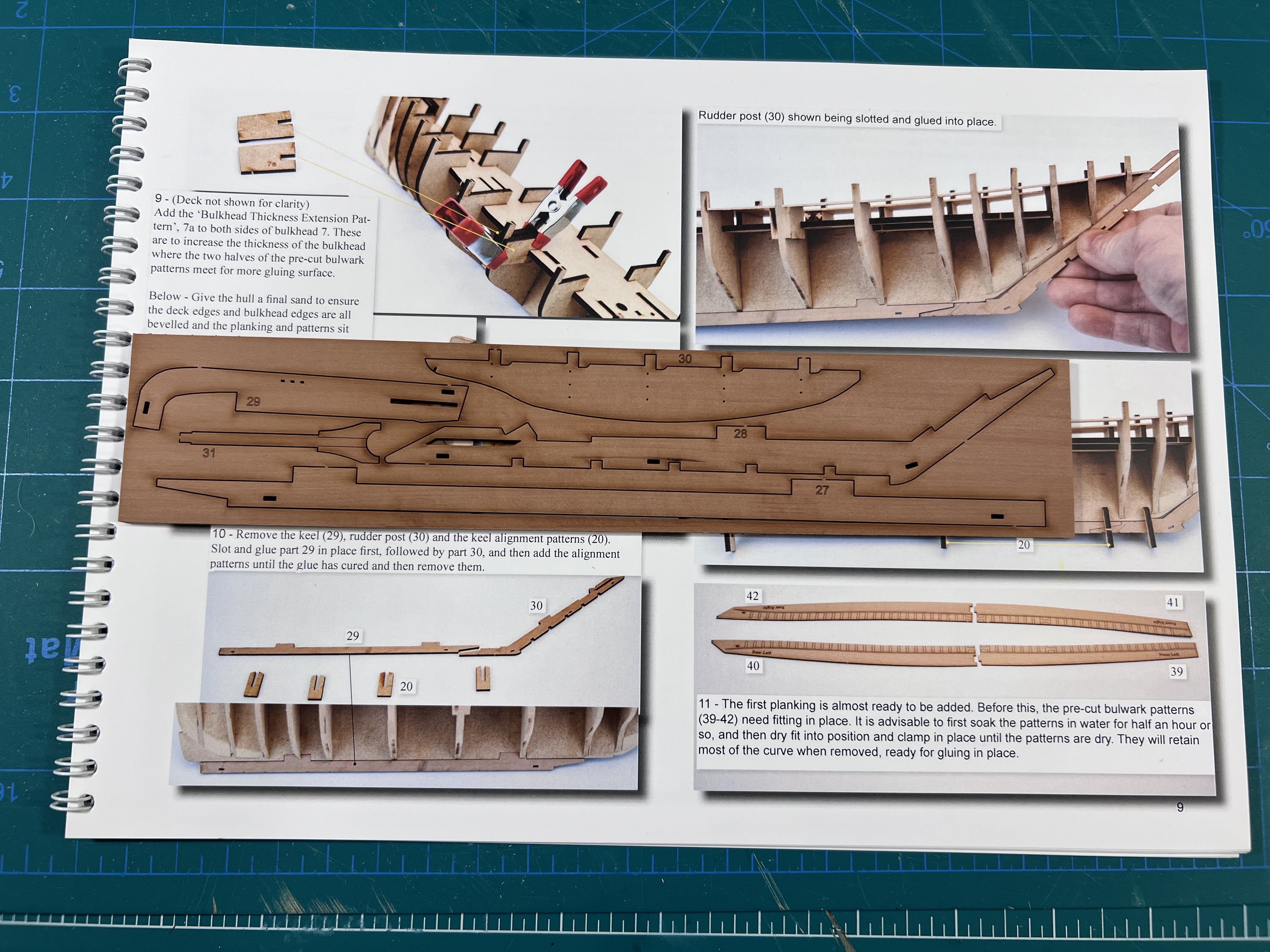

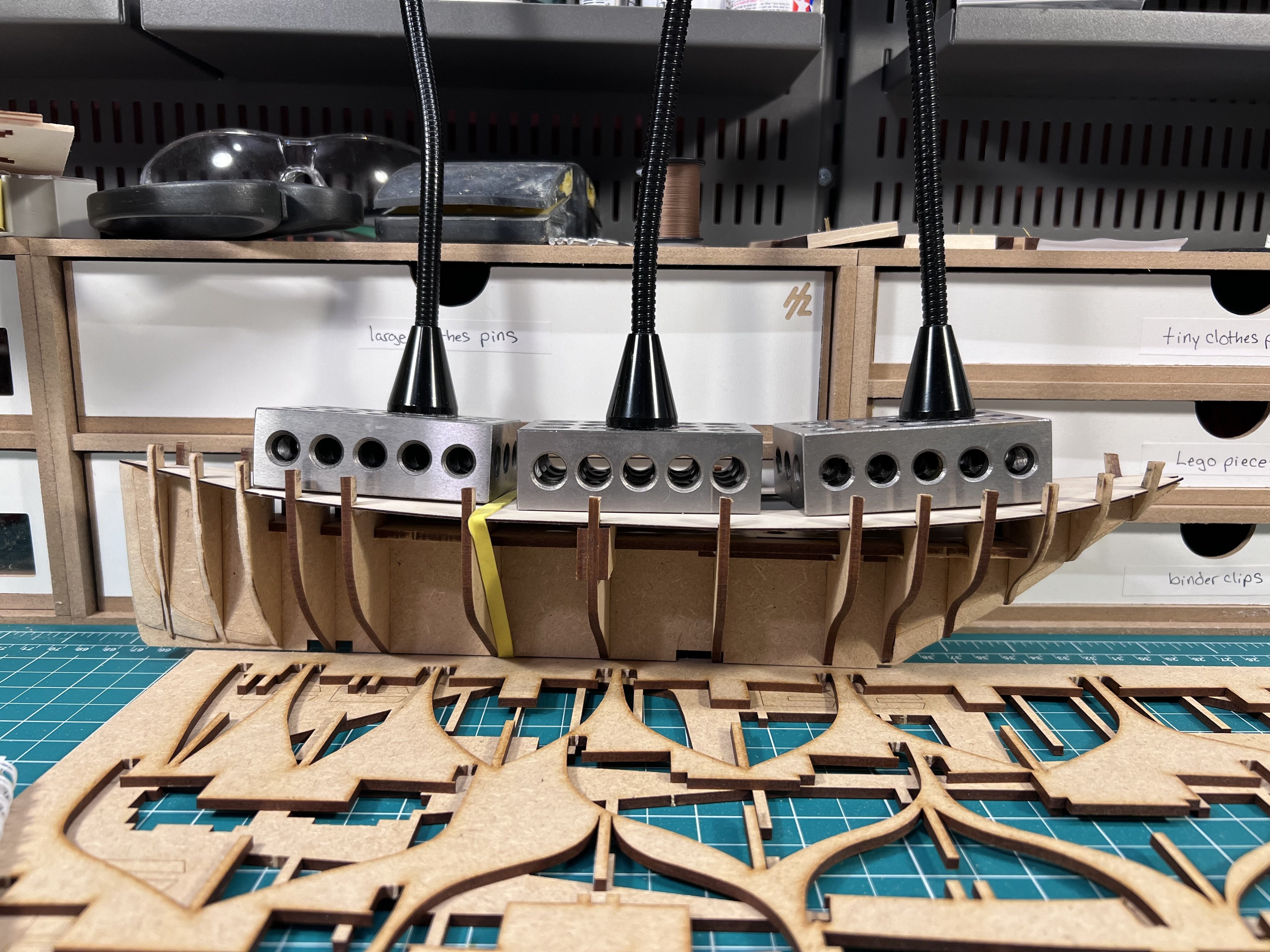

I shaped the bulwarks to the hull overnight (having soaked them in hot water for maybe 15min). Now they’re glued and clamped in place and I’ll let them dry overnight. Like the instructions say, you don’t add glue to the top tabs where the red clips are secured because those tabs will be removed later.
The shape of this hull continues to confuse me. The end shown in the photo above is the front and the heavily angled end on the other side is the rudder. When adding the lower planks, I forgot that and was thinking the end shown here was the rudder end and left some of the planks short since those usually end up being sanded down quite a bit. That's not the case here. I'll add some filler wood. Thankfully this is just the first planking.
The instructions don't mention anything about doing any edge bending (really any bending whatsoever). In some ways it's not needed since this hull is small and straight. And since this is the first planking, any clinkering can be sanded out. The instructions in fact point out some clinkering in the photos and say not to worry about it - they'll be sanded. I did end up doing some edge bending on a couple of planks. I'm definitely going to do edge bending on the second planking.
