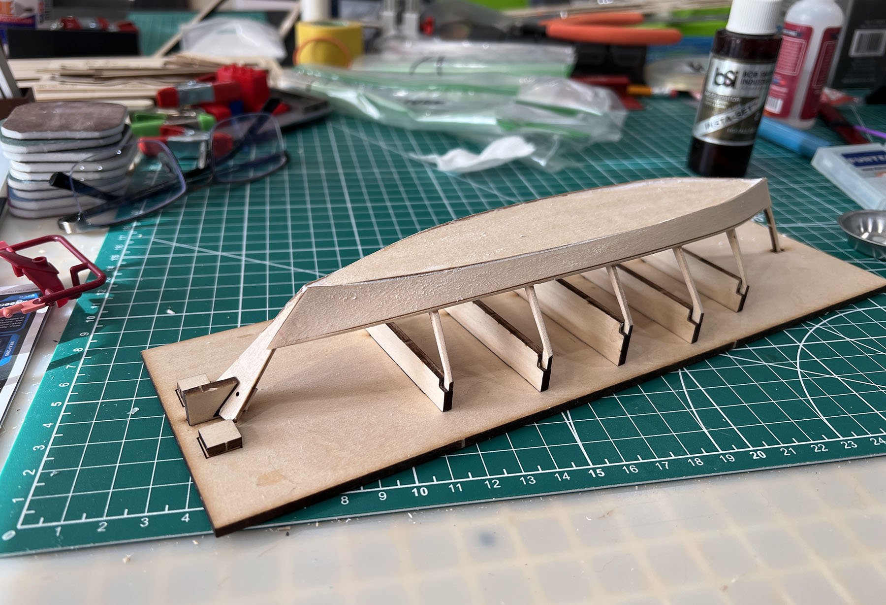

Last night I did the bevels on the frames. I've got one frame that's not perfectly centered, but I think it will work out ok after dry fitting the garboard planks.
Looking at how thin the planking sheet is, getting the bevels on them right is going to be exciting...
Nice work!
If a frame's out of alignment, it would be much easier to correct it now before it throws off the run of the planking. If you've been using pva glue, you can loosen it with rubbing alcohol. It's hard to tell from the photo how misaligned it is, though.

Thanks! I will see if I can loosen the frame piece. This is the only one far enough off that I could actually measure it.
@JacquesCousteau @palmerit
Thanks guys. I managed to get it apart without breaking anything or cutting myself. :)  Didn't see the tip about waiting 24 hours before it was already reglued and clamped in. I'll make sure it is bonded solid before I start on the planking.

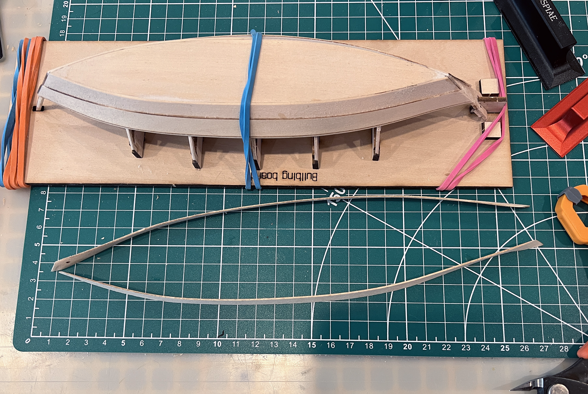

Did the beveling on the garboard planks last night, and worked a little more on beveling the frames. I'm going to start the shaping this evening. The whole rolling bevel thing in the instructions didn't really become clear until I started working on it, then it made sense.

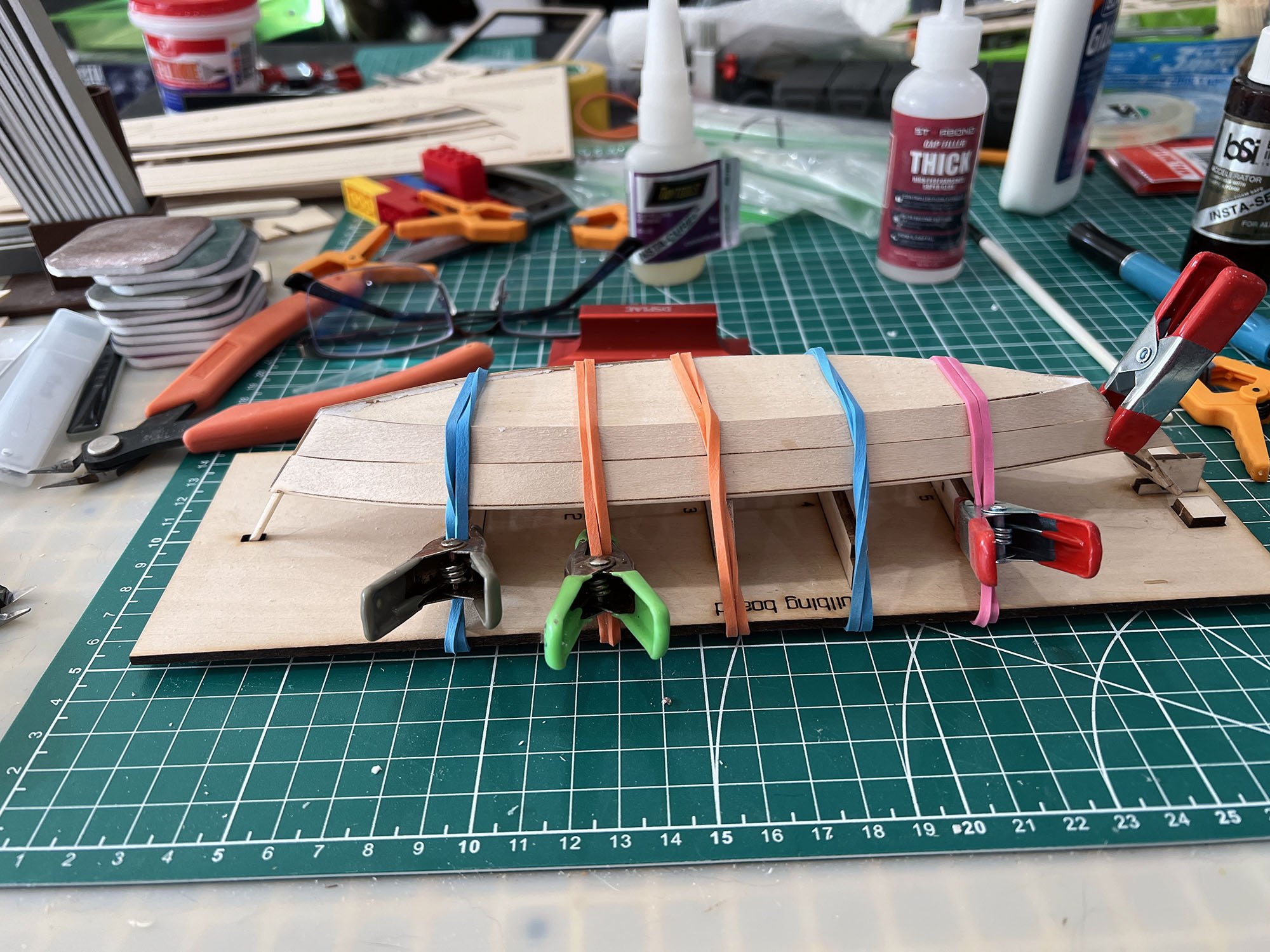

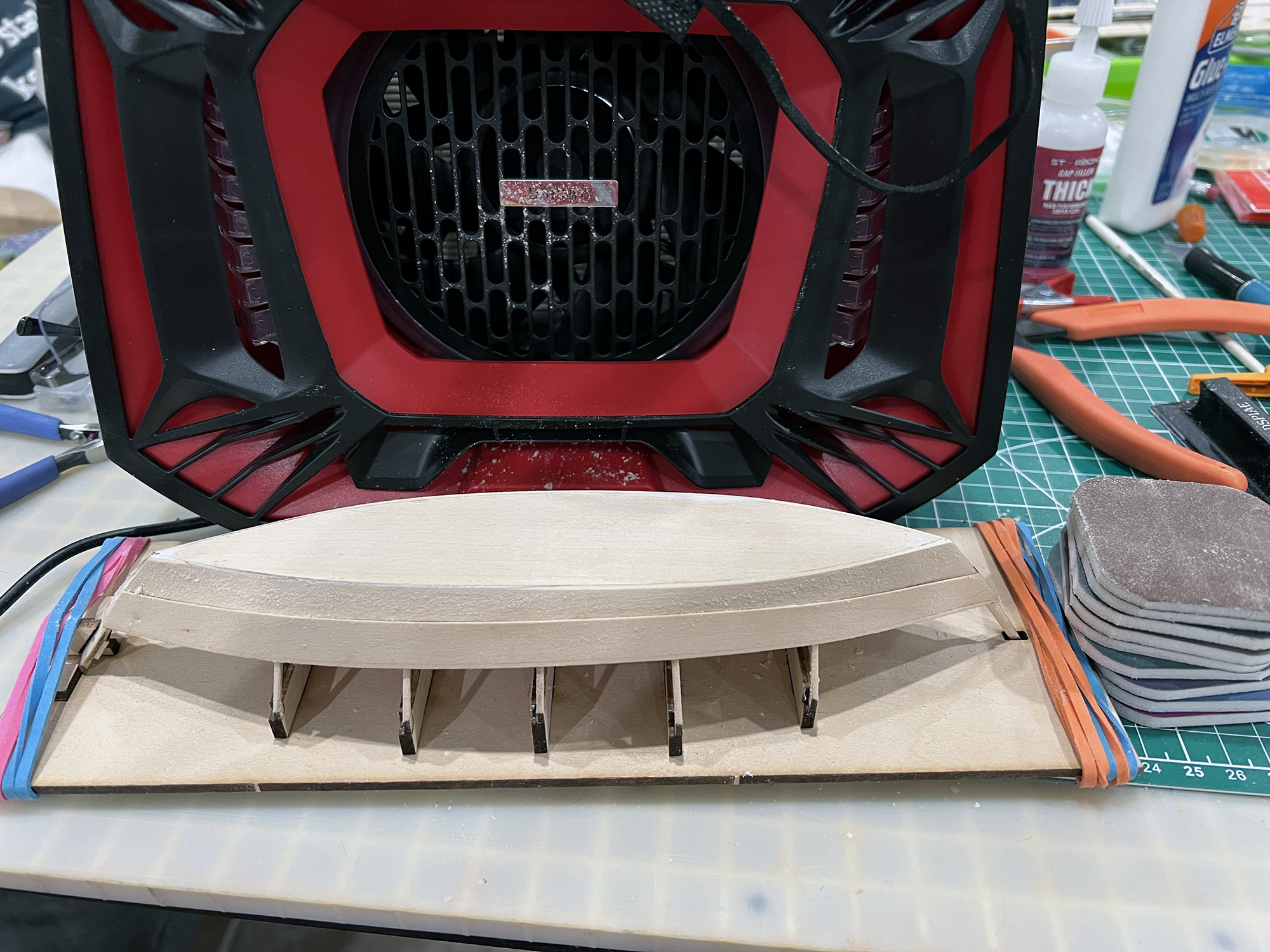

Put on the second broad plank. With it added, I finally felt the cradle was stable enough to sand the bottom smooth without risking the cradle breaking. I need to start sanding and beveling the sheer planks now.

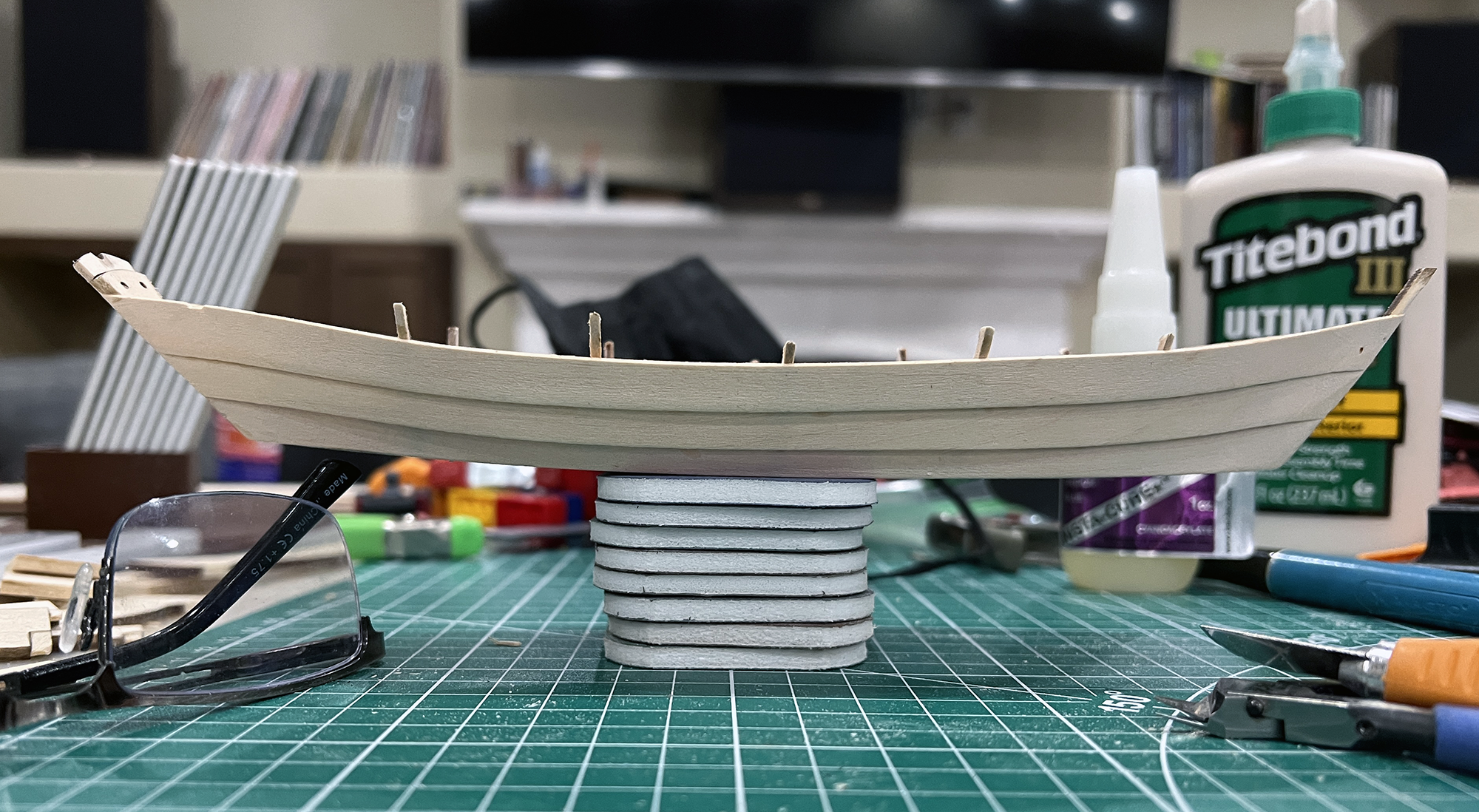

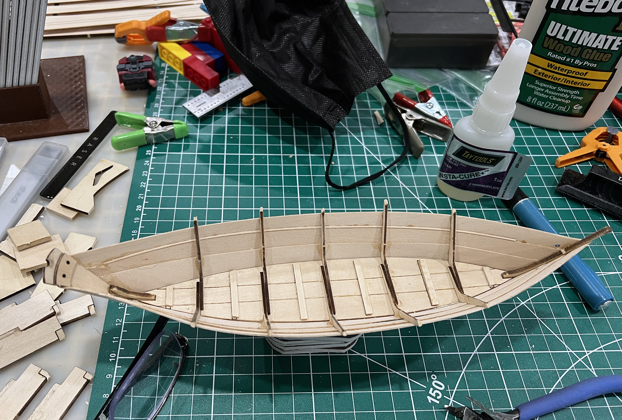

Ok, finished off the sheers last night and released from the frame. The exterior has been sanded through the entire micromesh set.
ANYONE READING THIS LOG IN THE FUTURE PRIOR TO BUILDING:
The planking is incredibly thin/delicate, and using clamps on it is a crapshoot at the bow and stern. It's mostly not visible from the exterior, but the interior view shows plainly where breakage occurred. What I eventually did was use superglue to tack down the plank on the bow, just using finger pressure to hold until it sets. Then wood glue for the rest, except the last one on the stern, which was back to superglue.

Sure is! I got by without turning to Superglue but it needs a lot of care, first to only use the minimum required pressure and then to have the force bear on the stem or transom, not on the unsupported plank. I didn't do a build log for my dory but, looking back at the photos I took, I did the garboards with the kind of rachet clamp that allows you to only squeeze as tight as you choose. Later planks that couldn't be grippe that way got rubber bands, with a clamp to the baseboard to control both tension and the angle of the force applied.
For me, and probably most others, the dory build is a lesson in creative clamping!
