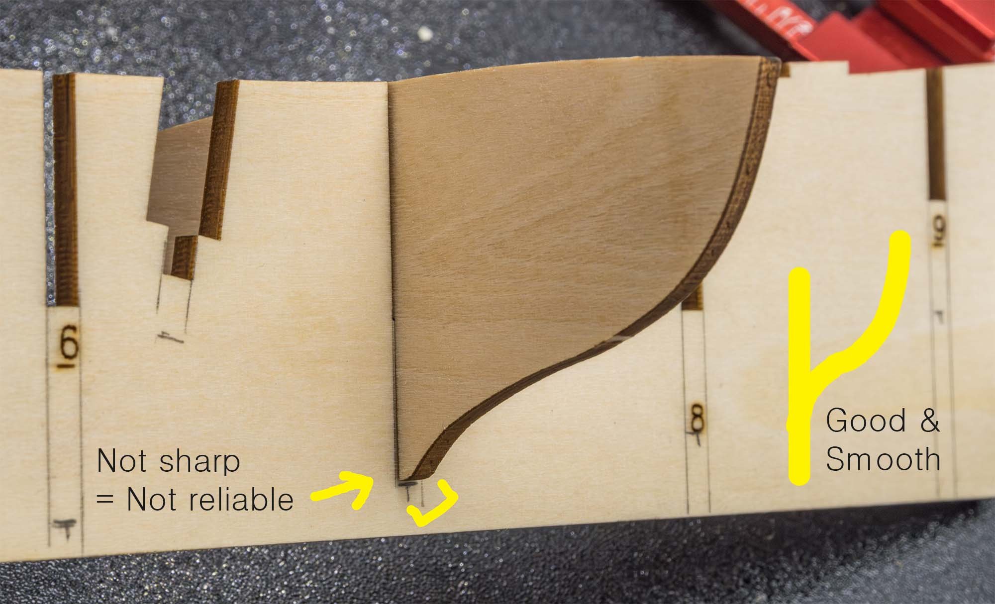

This post won't be a tutorial-like build log. I'm studying my building technique. I hope you skim my post quickly, and I'll be much obliged if you find any interesting point.

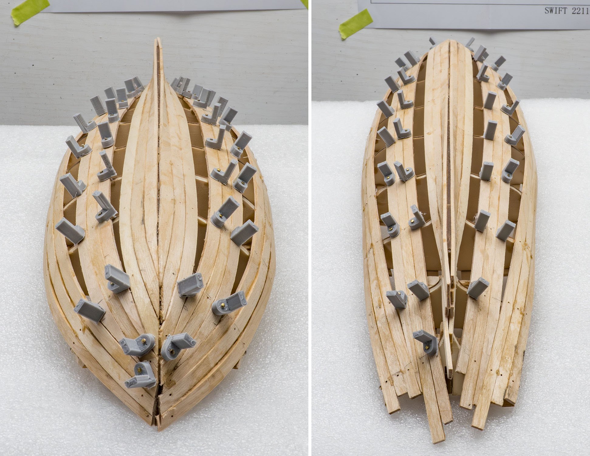

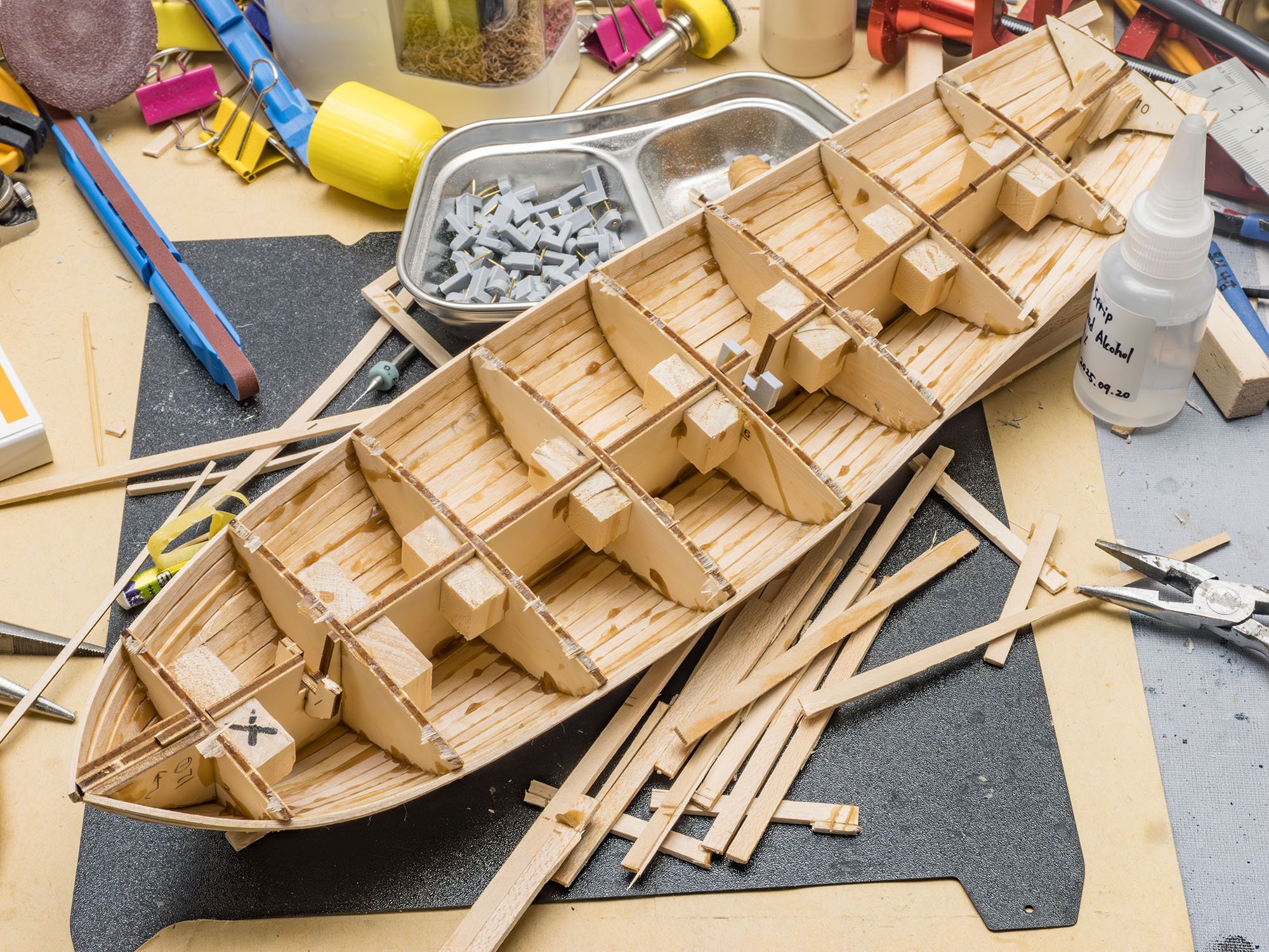

sw401.thumb.jpg.ca96a63d212f99cf174206ea8893a4ec.jpgsw405.thumb.jpg.8c37155f6a22cfc78b2997207cecca1a.jpgsw406.thumb.jpg.ad73da9edd40bfeba14e0879f2350e1d.jpgsw407.thumb.jpg.fac5978bbea57d2c612ed885ba48fb78.jpgsw408.thumb.jpg.de6e3279bd8a623f0c443db4116d2a2d.jpgsw409.thumb.jpg.78ffd565078215872c222f2158876dda.jpgsw411.thumb.jpg.97be5085c7da169e25c0a29681284f77.jpg
sw413b.thumb.jpg.bb7fafe4e74e258b4da449d7dcb324aa.jpgsw412.thumb.jpg.d218efc4cd7449f59c8ebc4afb13ded8.jpgsw414.jpg.97c559dc67161050831eee01519fd3c8.jpgsw413.thumb.jpg.6f81a29a26eef62e9adca0d4d0036ee0.jpgsw415.thumb.jpg.8c92426ac6b2b96b9d49c493326611a7.jpgsw416.thumb.jpg.34e82b5ba23cac6b2b3c161402fab1c1.jpgsw425.thumb.jpg.42c3063d71b42d30efe3a8590e1d7f74.jpgsw426.thumb.jpg.7982716702b38ad8fac25758a19b76a3.jpg
3-Dimentional error checking
Fixing errors

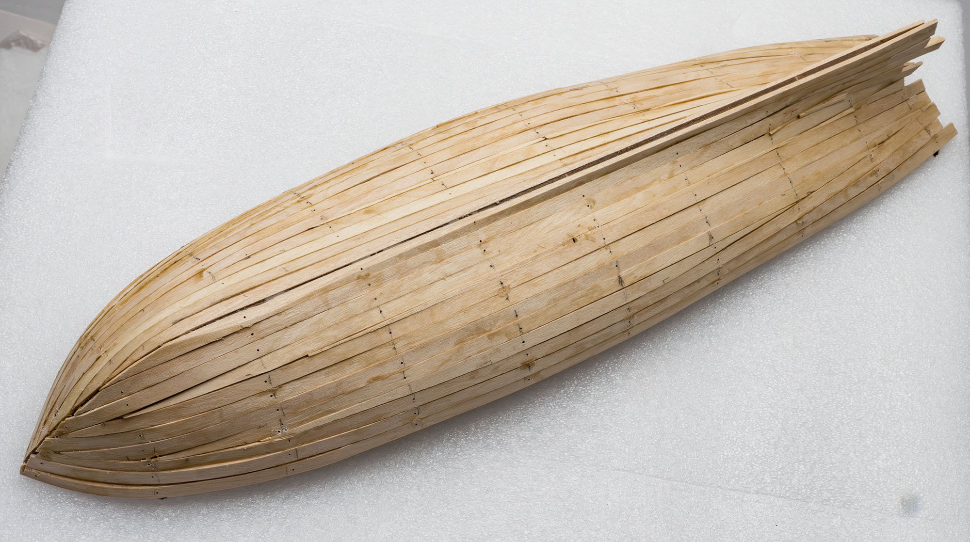

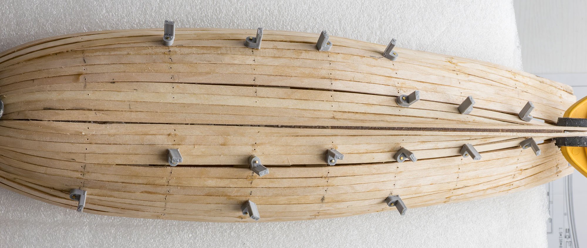

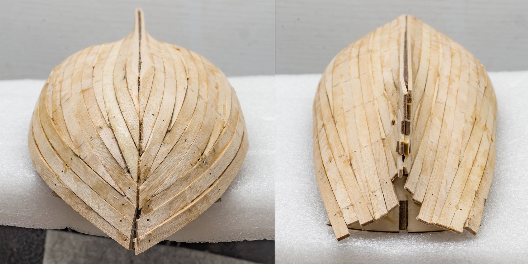

Plank battens
This is a small ship. :)
Temporary planks are done.
The end of hull framing.

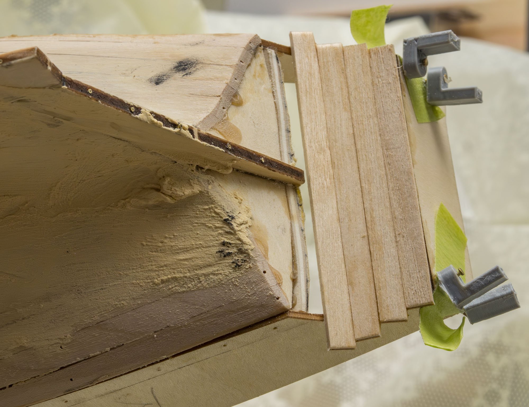

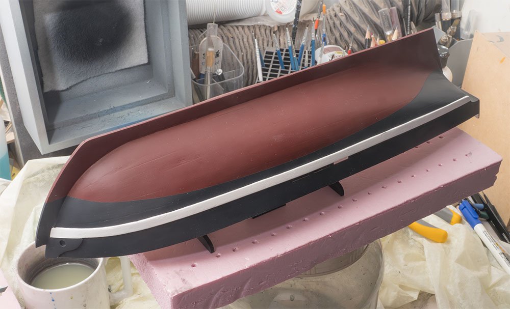

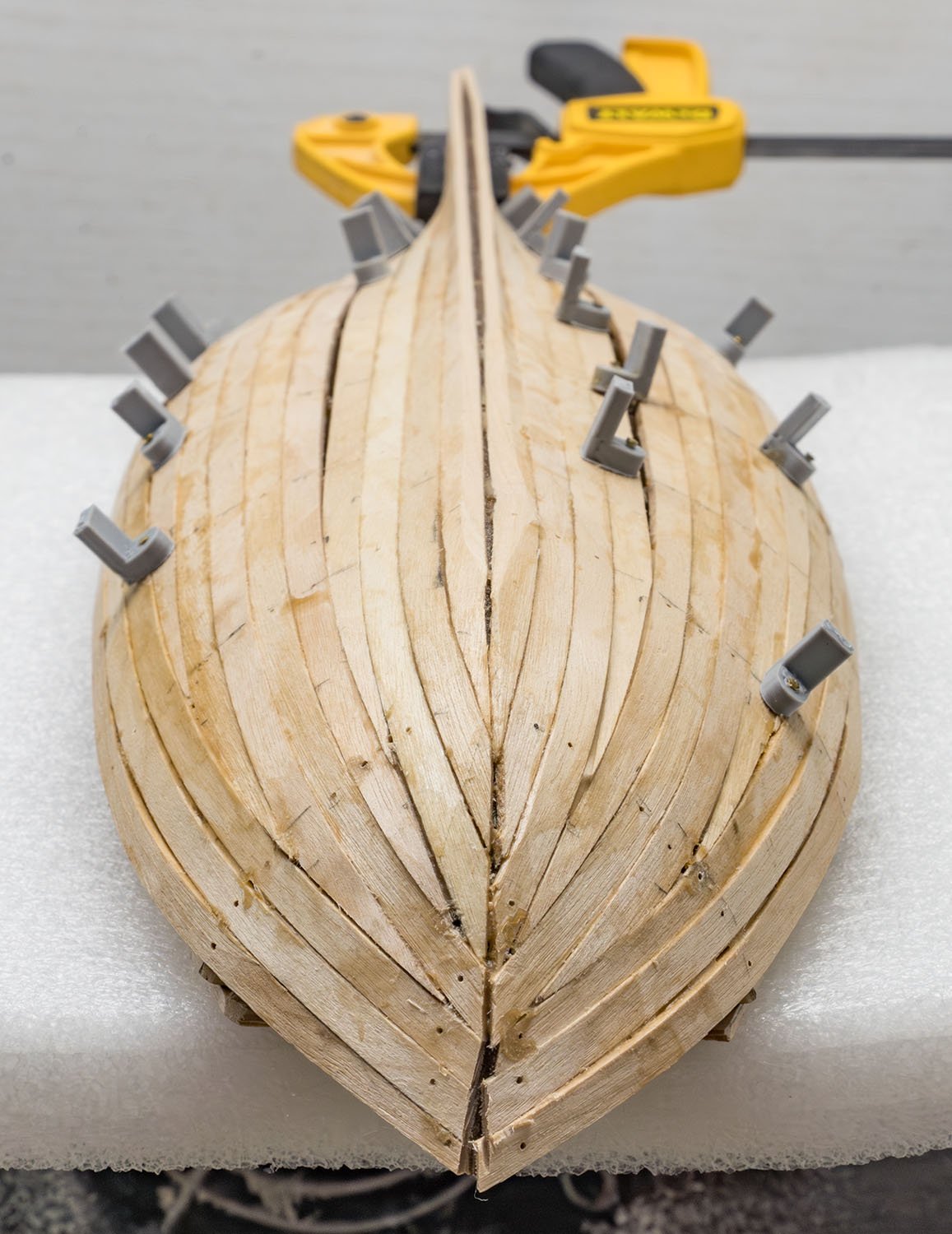

I filled all the large gaps before I applied a wood filler.
After I finished planking, I removed all the plank battens.

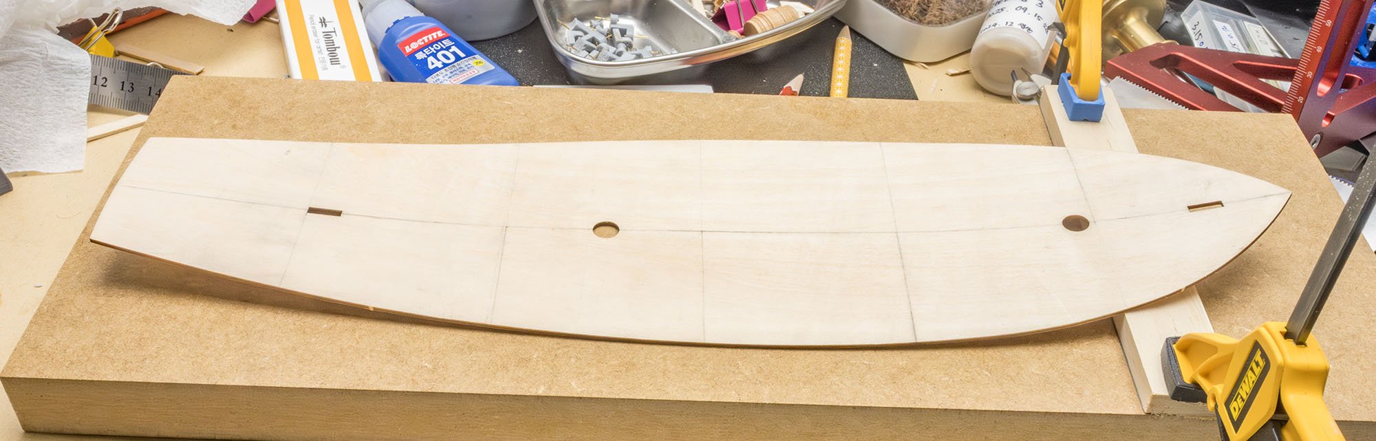

sw523.thumb.jpg.7649765d45b7fb9cb2488bafe7af6229.jpgsw524.thumb.jpg.788e69ffa7aec399805f8bc894f9b776.jpg

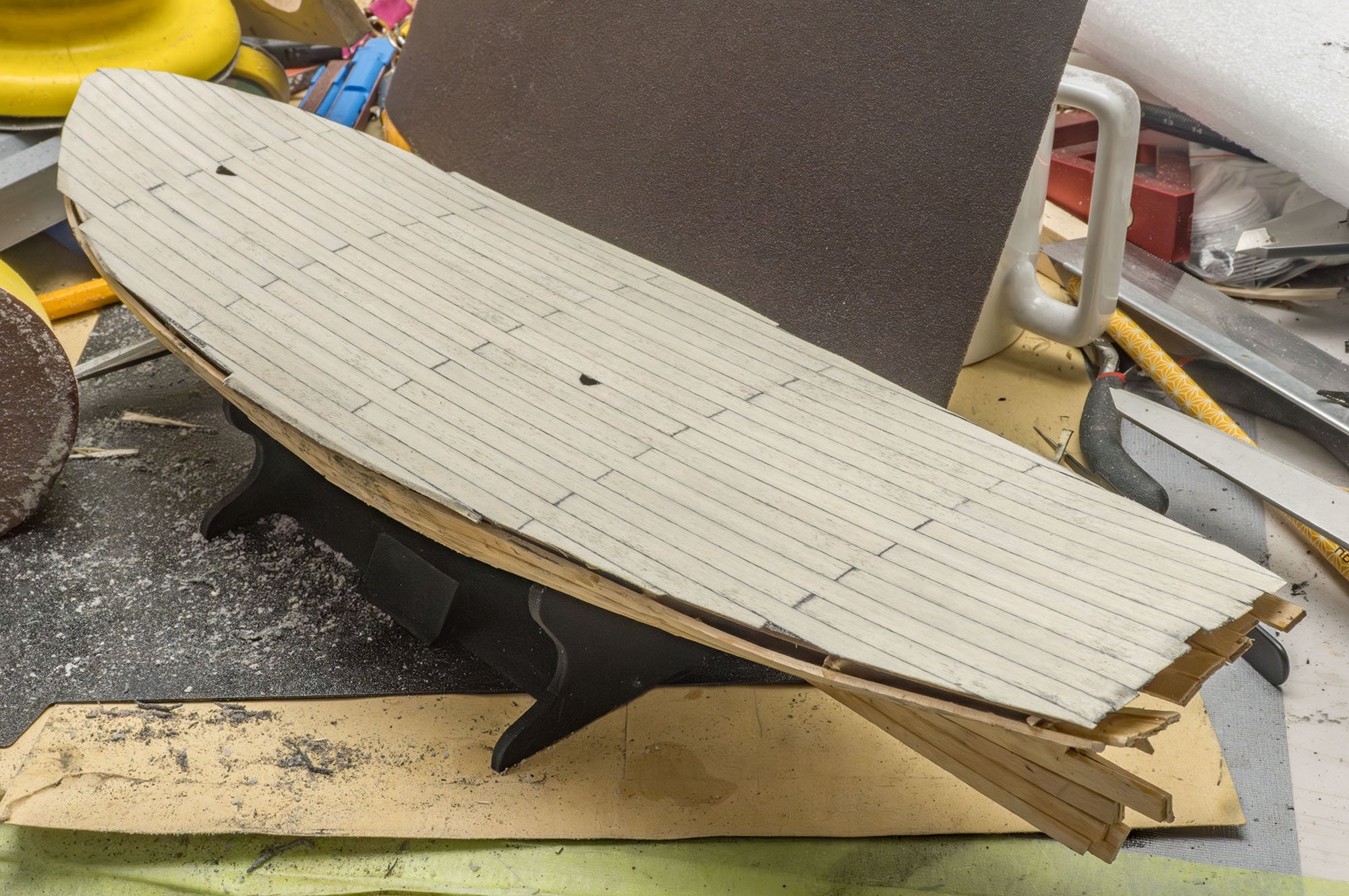

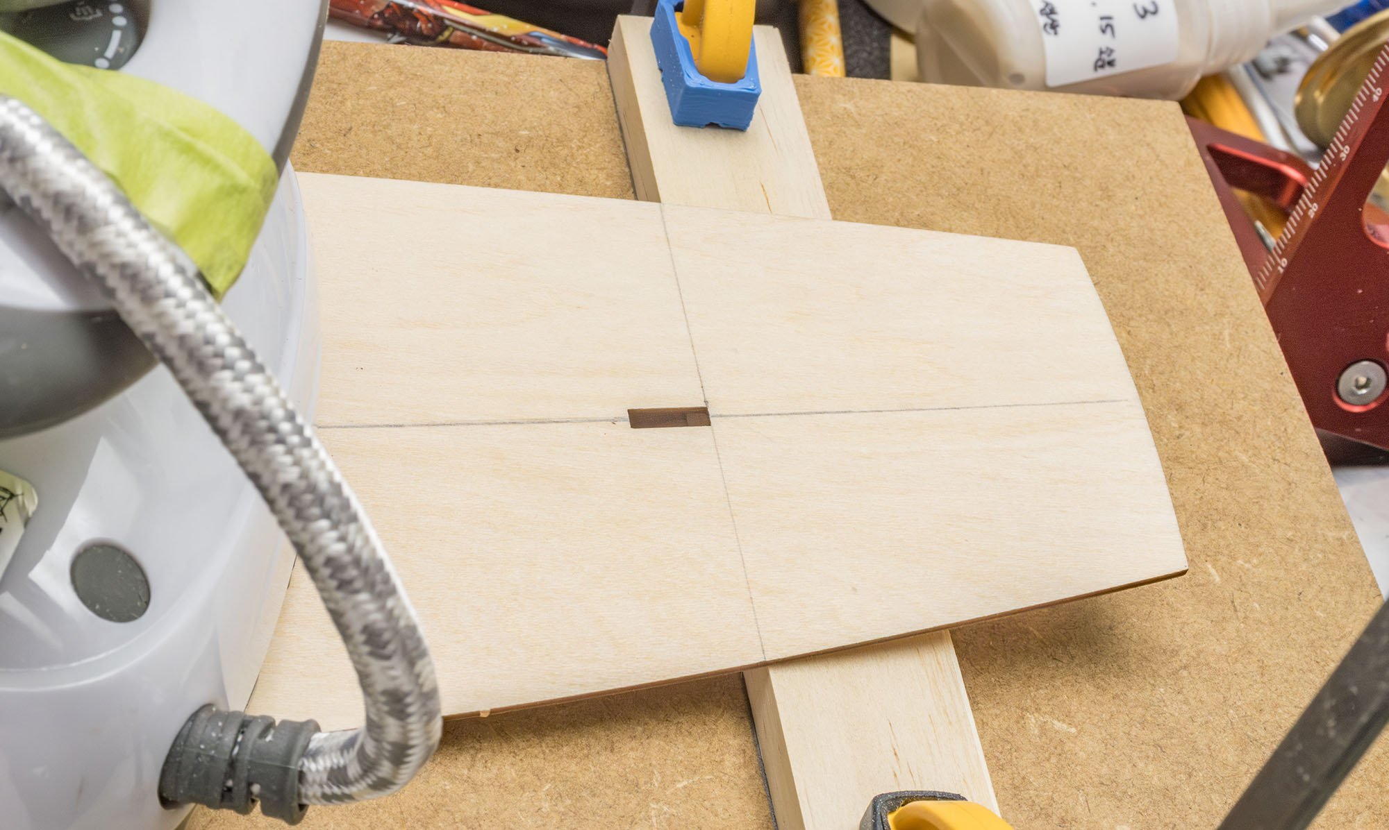

I warped the deck using a mini iron. The mini iron is really useful! It's over 300 W!

Deck installation

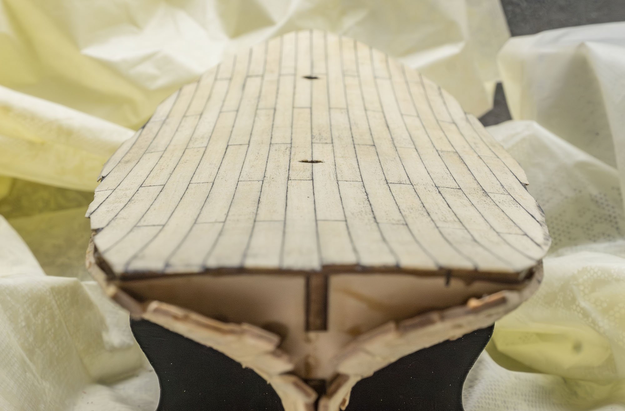

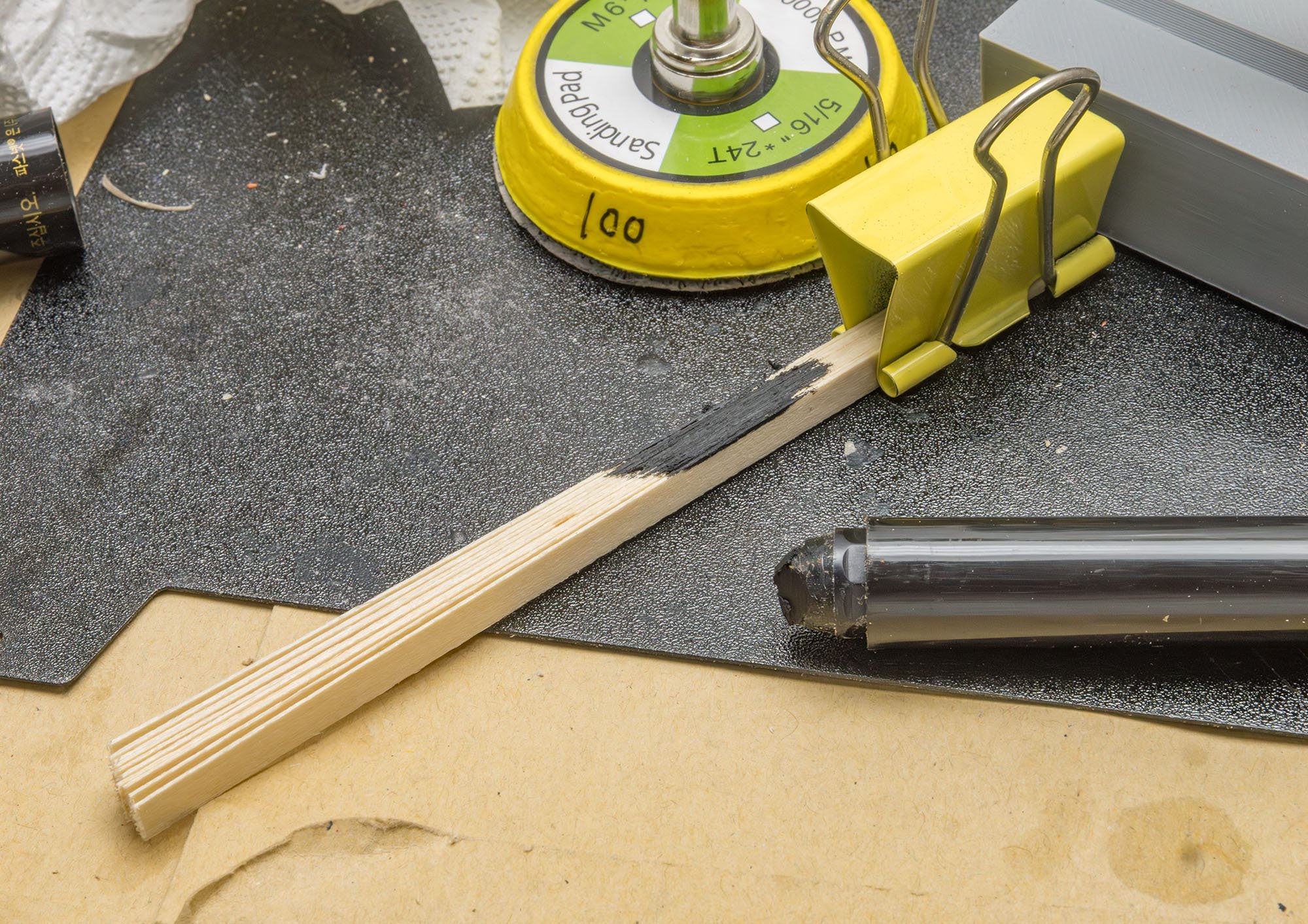

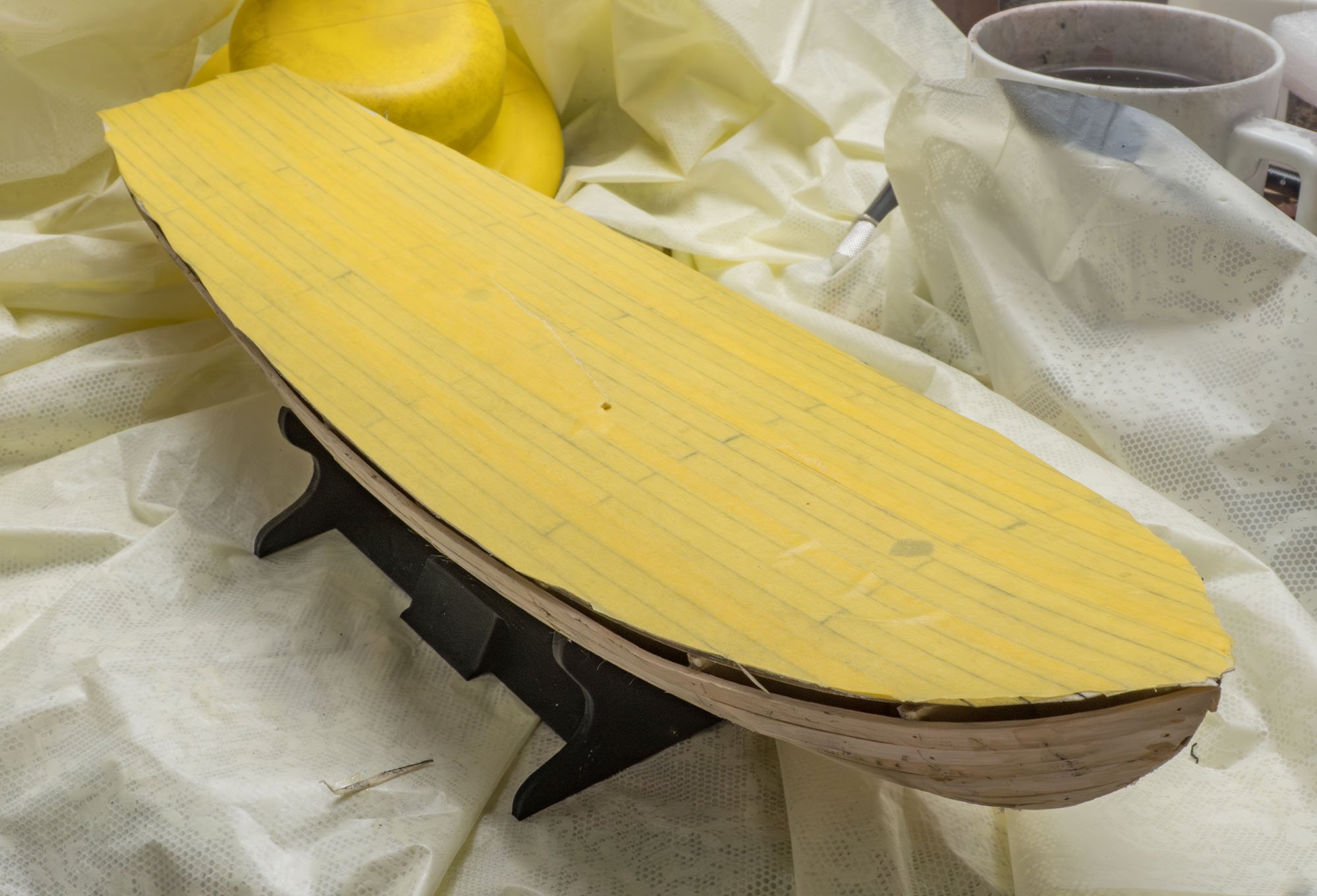

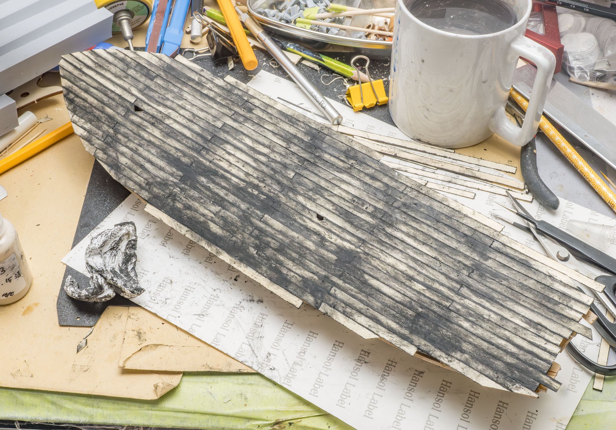

Deck caulking.
I used an wax oil crayon.
It's really dirty, but it can't penetrate the wood layer.
After massive sanding...
Not clean, but weathering effect. :)
I added protective masking tape before I did hull sanding.

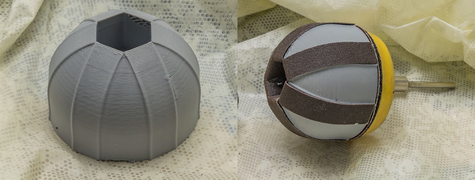

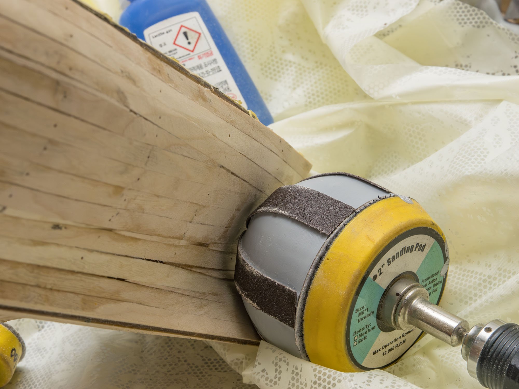

I made a sanding ball to sand concave deadwood area.
But it didn't work well....
The sanding detailer is the only valid option in the progress.
The brass rods reinforce slim keel parts.
I roughly sanded the hull. I'm checking the hull line carefully to attach the wide bulwark part. 🔎

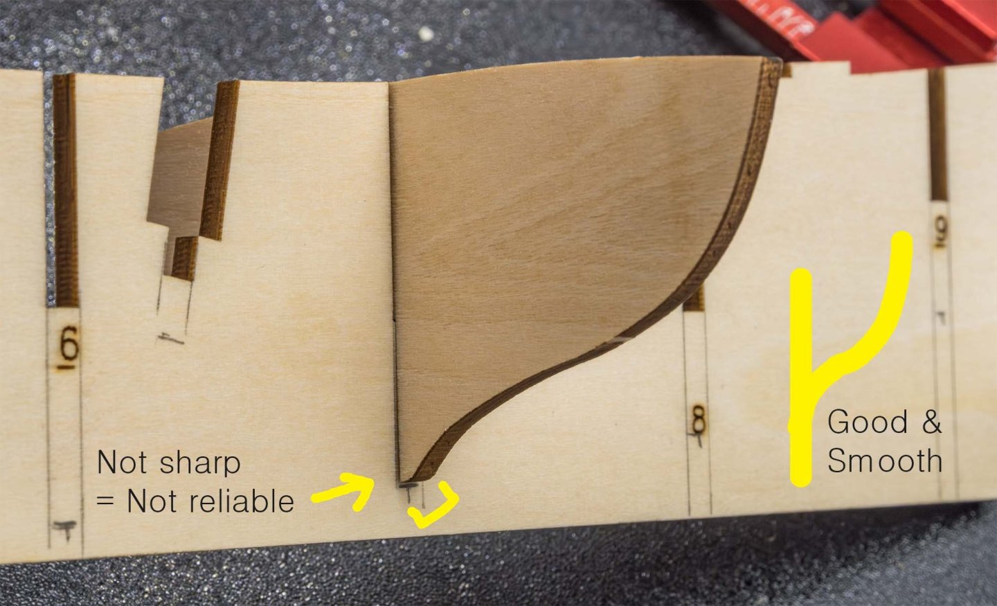

I watched all the Tally Ho videos before I started this project.
I found that the garboard rabbet in this kit is different from the Tally Ho project. Tally Ho has a very smooth rabbet line, but this kit is not designed in that way. I don't know much more...

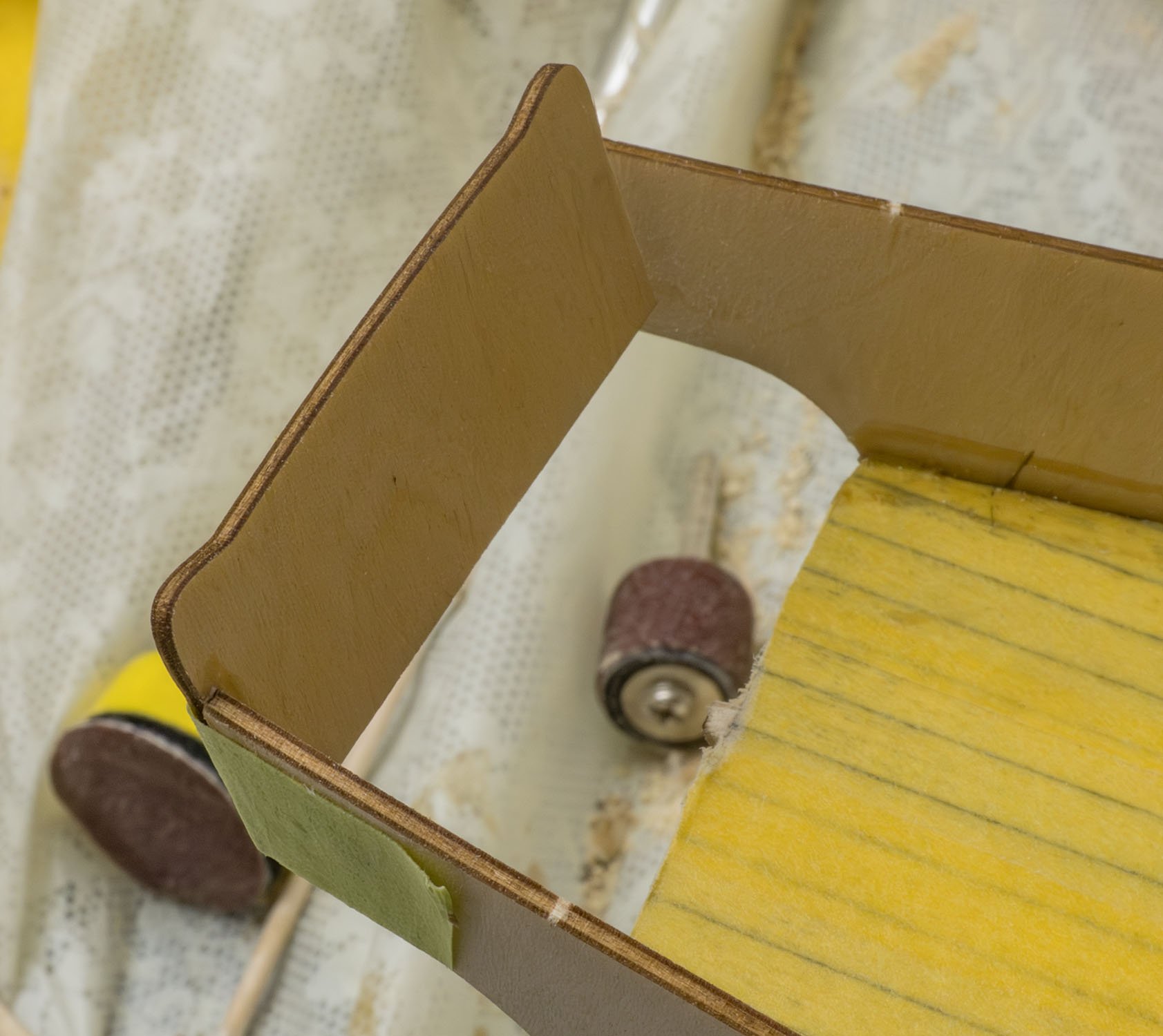

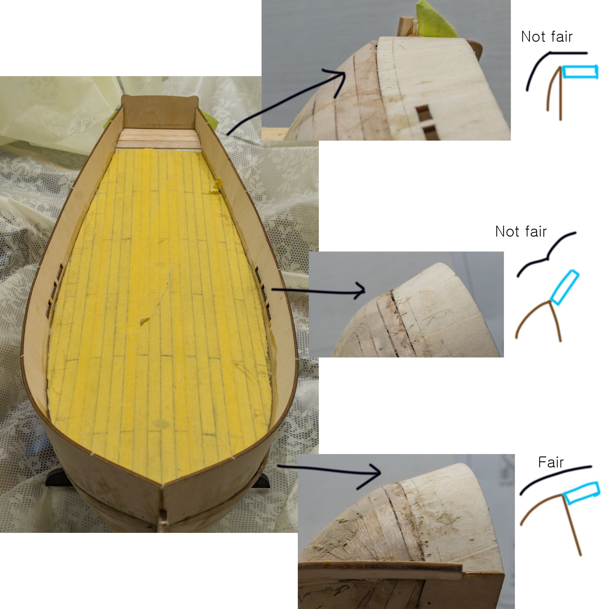

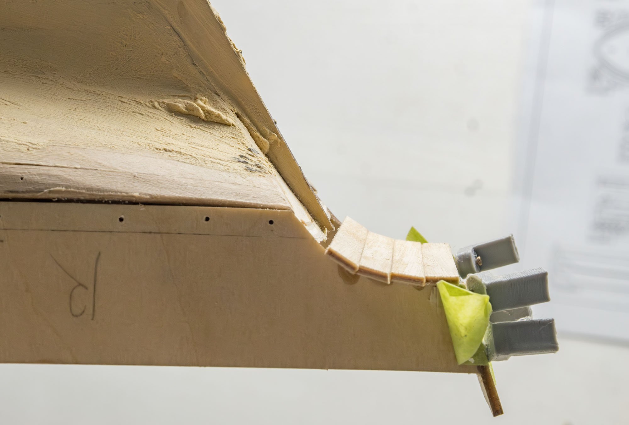

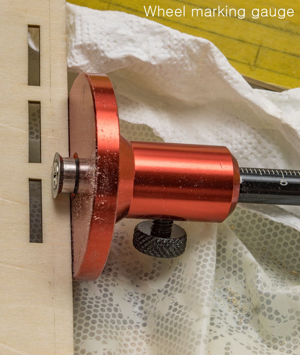

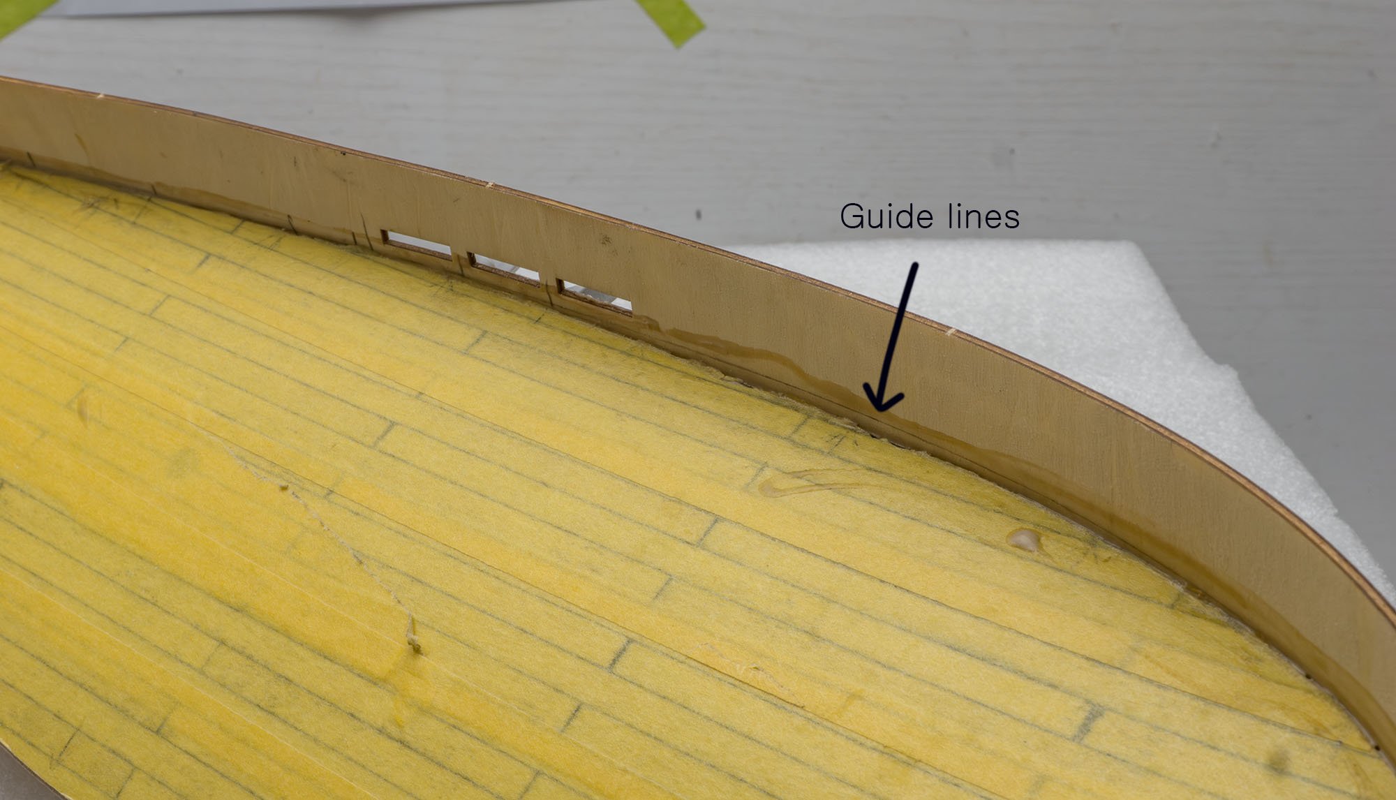

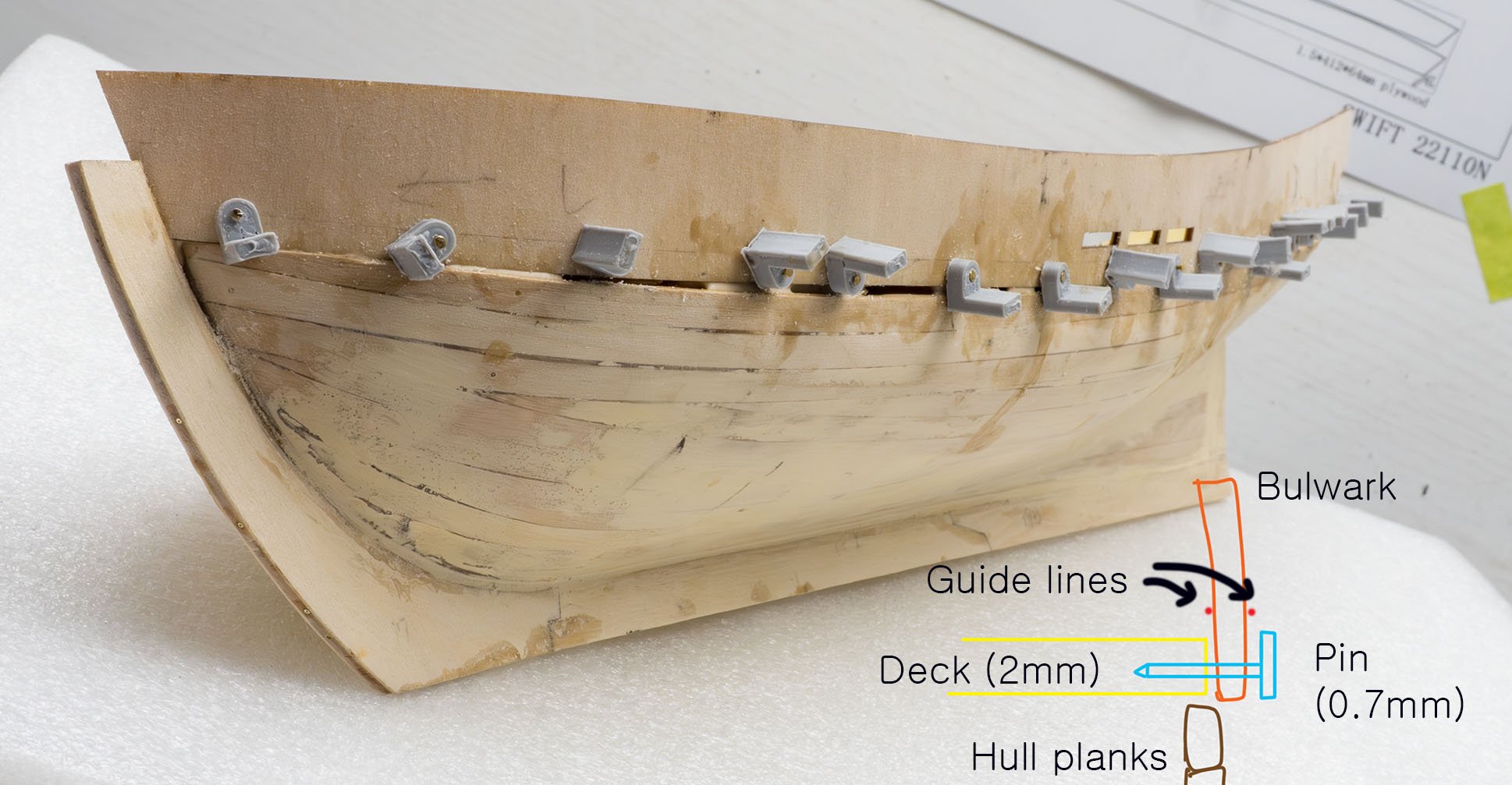

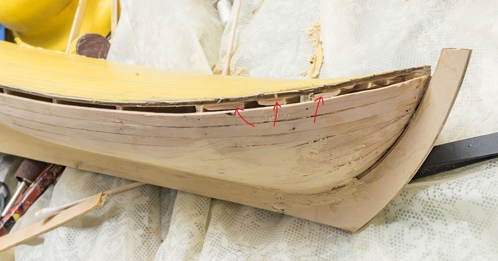

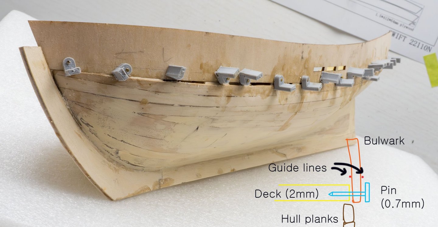

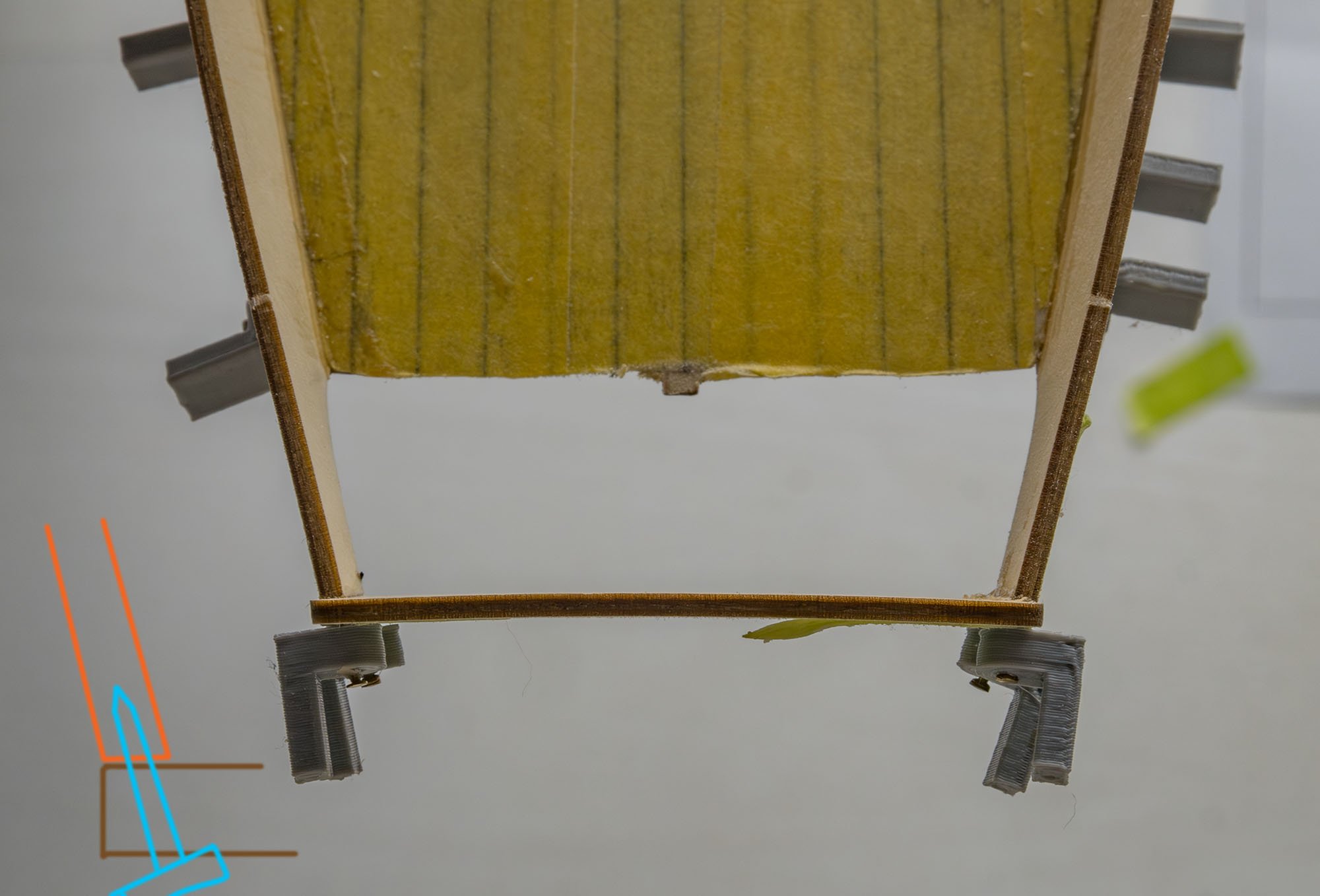

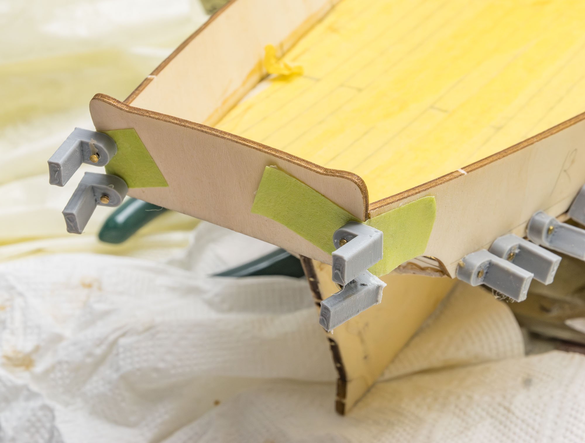

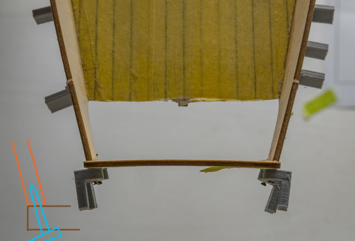

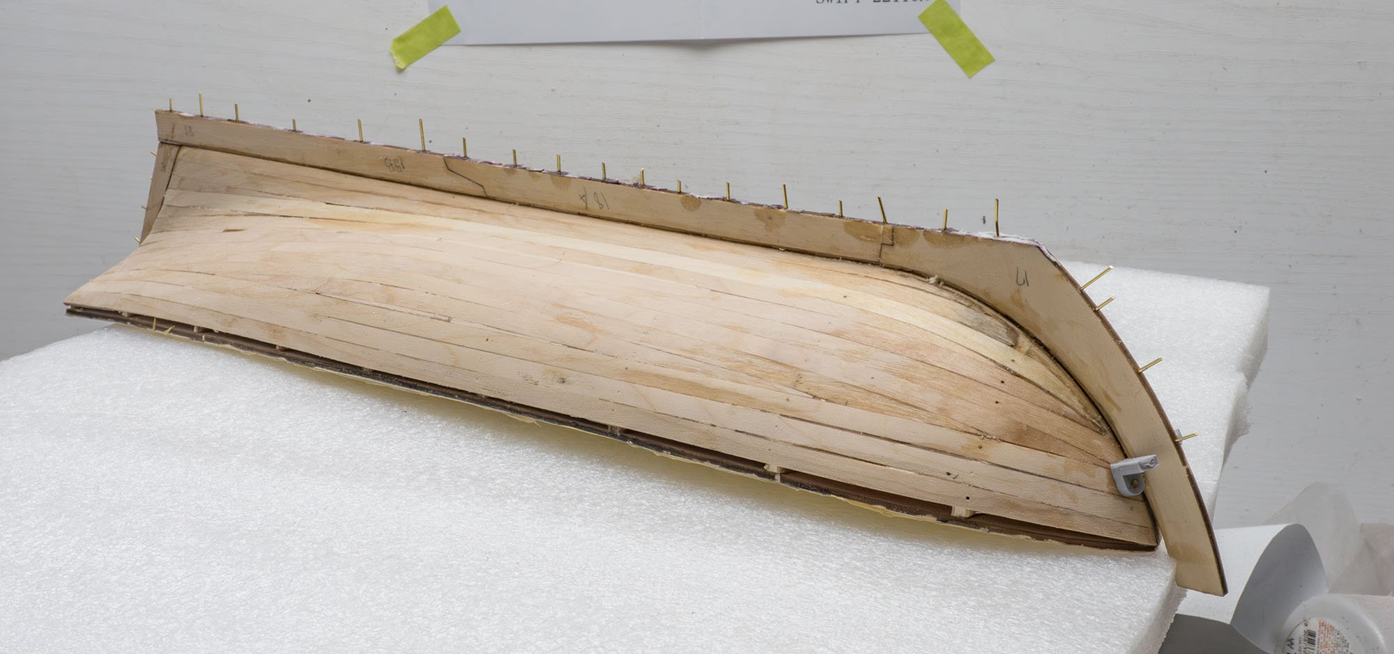

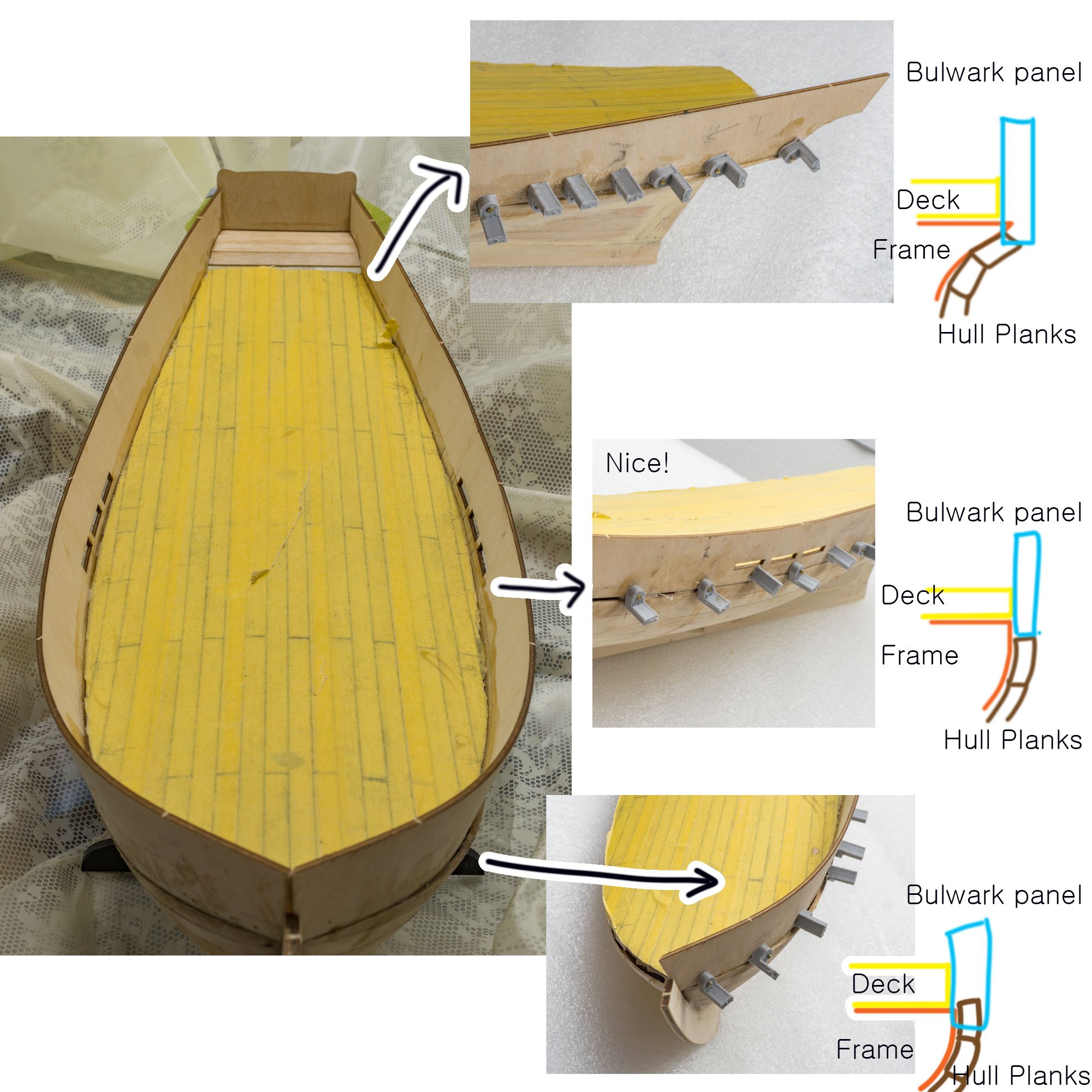

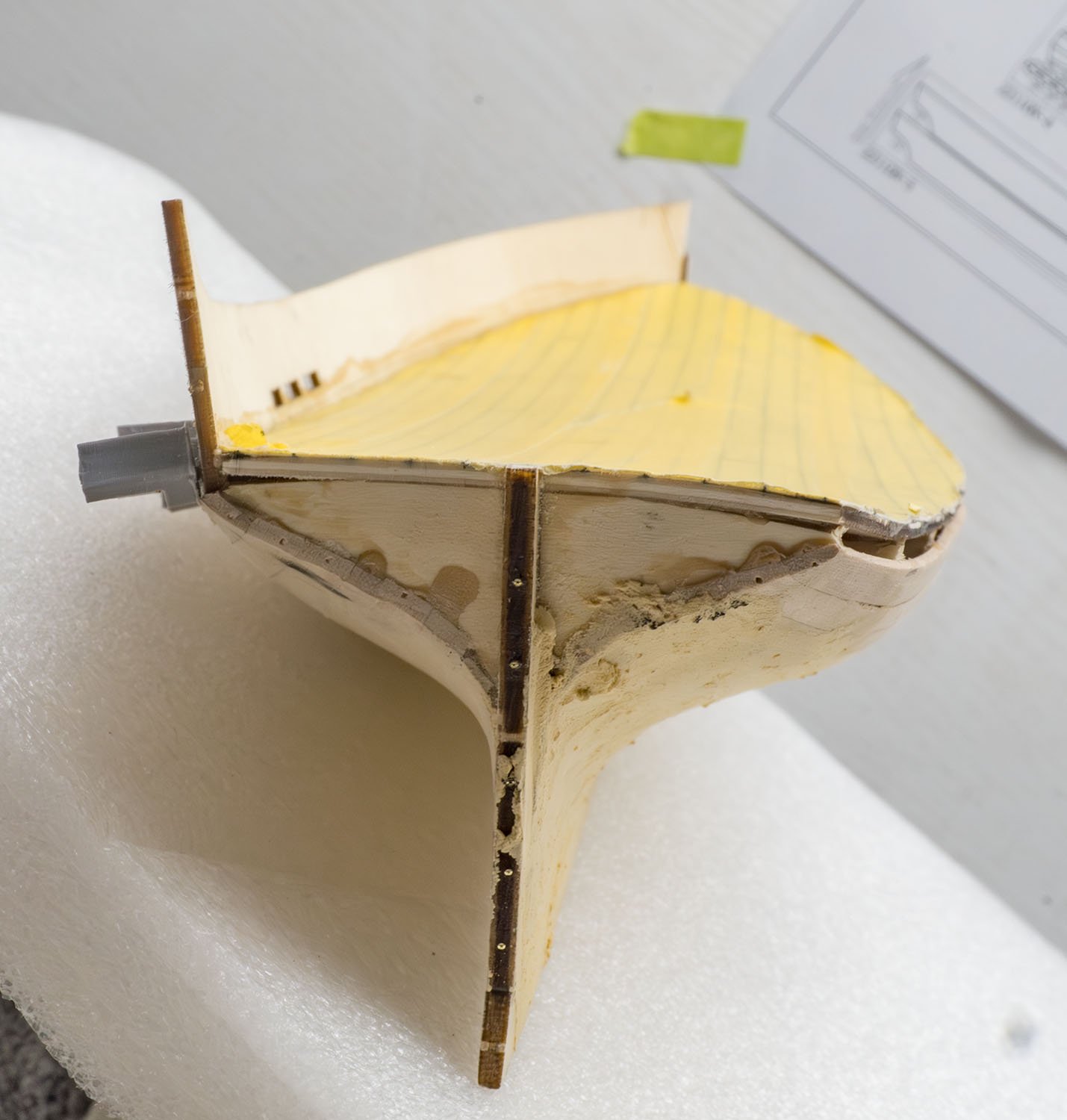

The bulwark installation was tough work. I forgot to add wooden blocks under the edge of the deck plates. (Red arrows)
I precisely pinned the bulwark panel to the deck.
I drew guide lines using a marking gauge.
This is the reason I didn't make holes on the deck planks.
sw1006.thumb.jpg.6b20b380093d3e1710b9c6533dc64b3f.jpgsw1007.thumb.jpg.8920a0556986c0d2a305f8ae3b8efb69.jpgsw1008.thumb.jpg.8974b66754857d565acf26591240003d.jpgsw1009.thumb.jpg.d2b2377759f6dcb30028fa13be936f35.jpgsw1010.thumb.jpg.b50077184dbe67e5c61be5da99d47a8b.jpgsw1011.thumb.jpg.088d61114321a04fe8bf875647ba90e9.jpg
The transom part was easy work.
sw1005.thumb.jpg.ee94806a4c85fafdb52ff40fa2acf7ca.jpgsw1012.thumb.jpg.e796a0baf6533fe48b80f3848a3ca45f.jpg
I summarized the issues related to the bulwark component. I made some 3D printed guide parts for a bulwark installation. I'll use them in future projects.

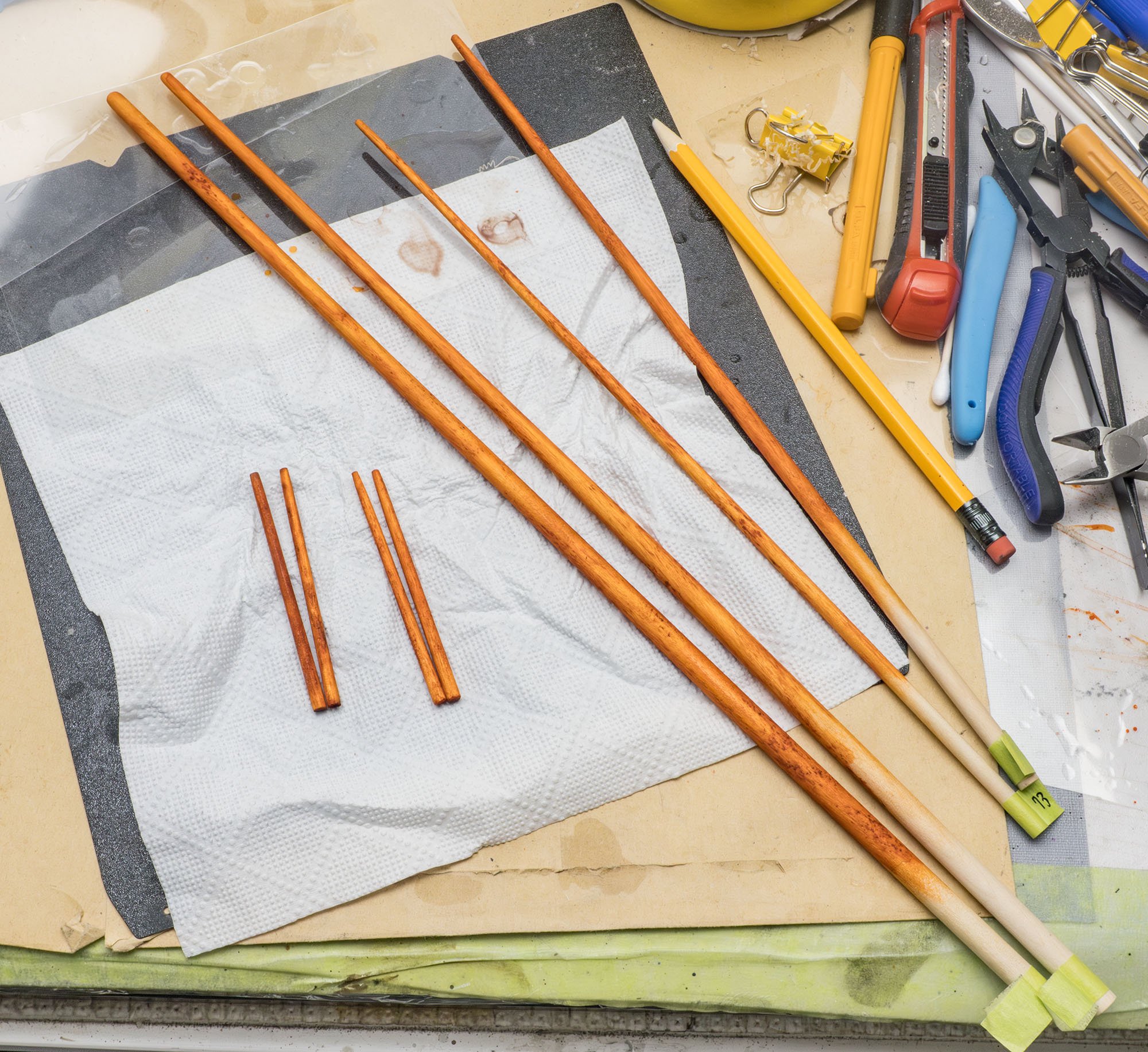

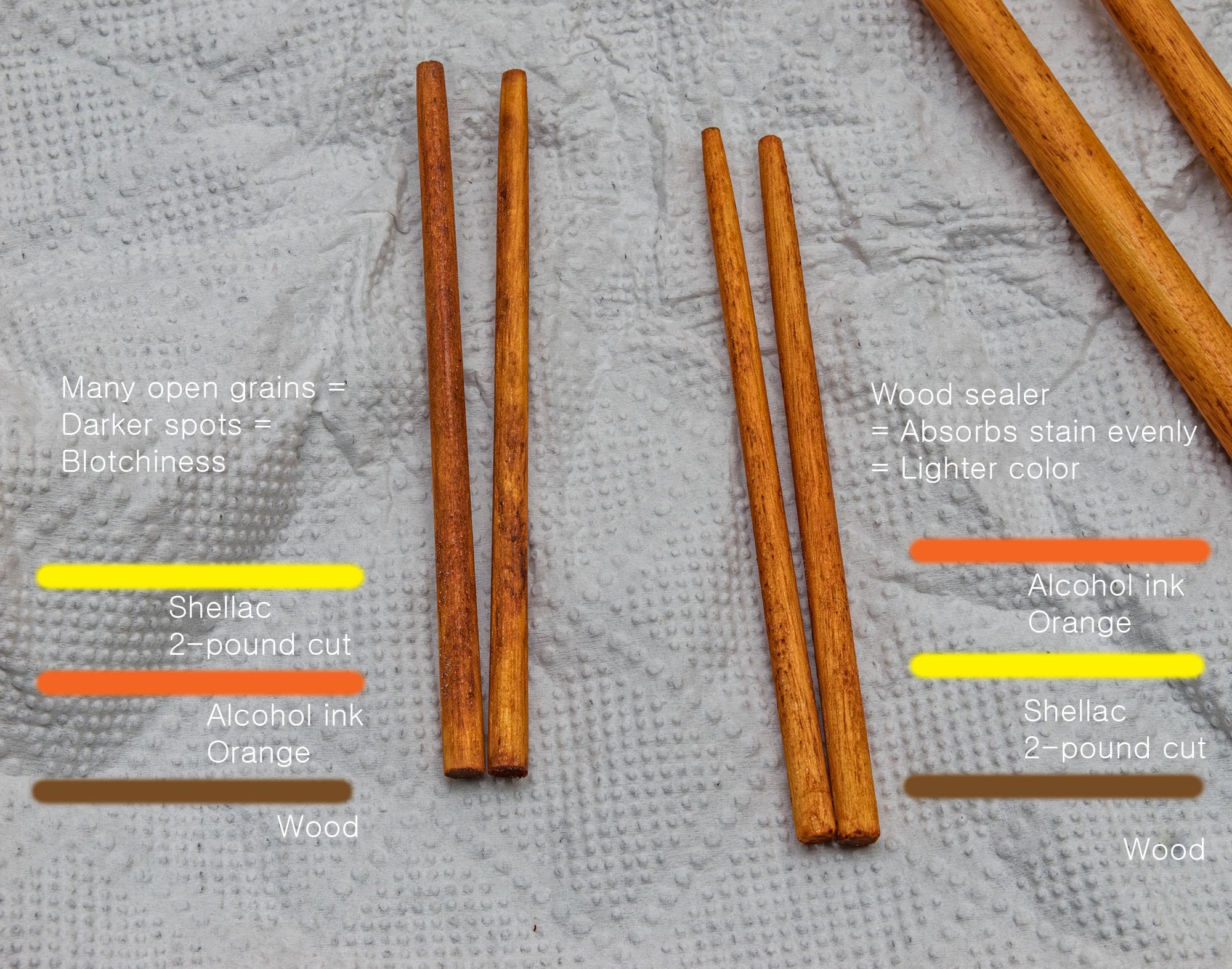

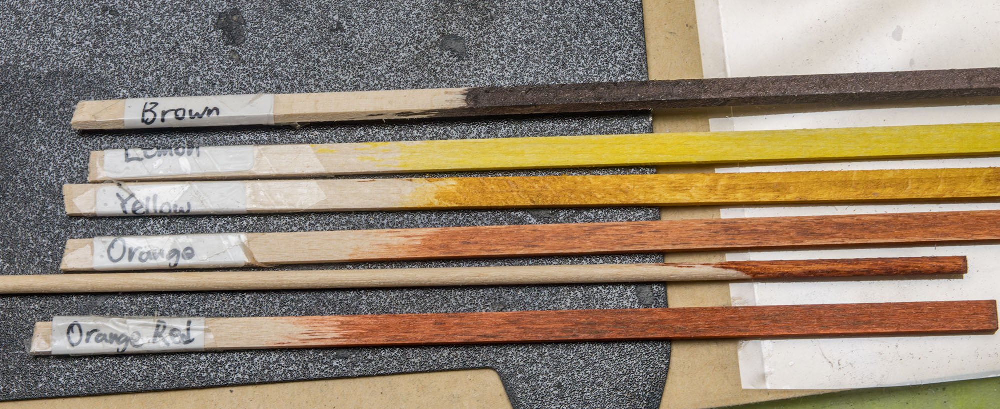

It is the first time I use the alcohol based ink.
Masts and bowsprit.
The alcohol inks penetrate wood very well, like the oil based stains. It is essential to apply wood sealer before I use the alcohol inks.
