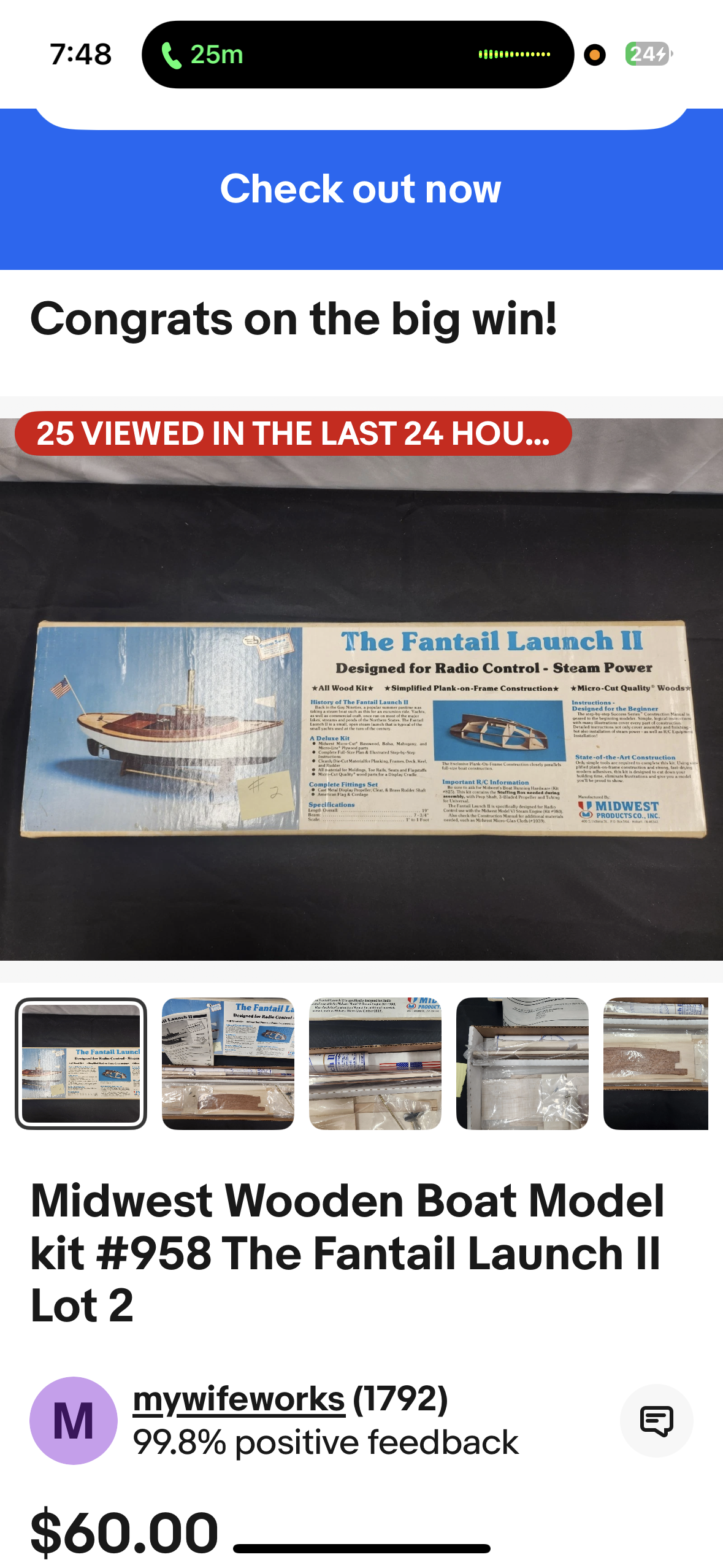

Hi Terry
Out of nowhere this appeared on my EBay site and I won it for $60 ( a really great price for a vintage kit. All the ones online are in the $200 range) Not my next build but it’s waiting in line.

That's fantastic Rick! I'll be pulling up a chair for that build. Congrats!!  I hope you can find the steam engine kit to go with it. No problem with the money you just saved

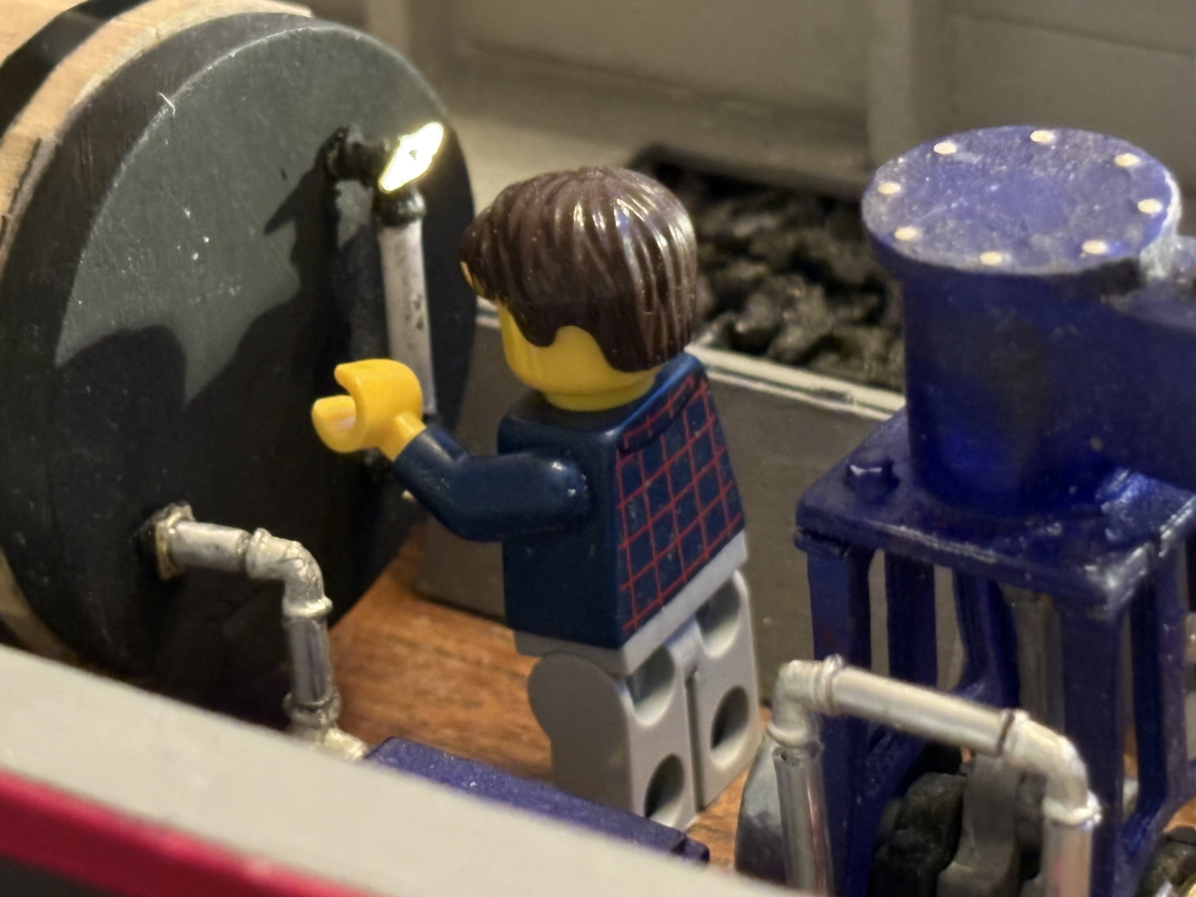

Well after a hard day at work my granddaughter became unhinged because of my anal compulsive behavior making sure my hinges were working and straight on the coal bins. Since she stressed me out and knowing tomorrow we will head to sea again I decided to take a jacuzzi bath to relax before bed.
As Always Best and Good Night Rick

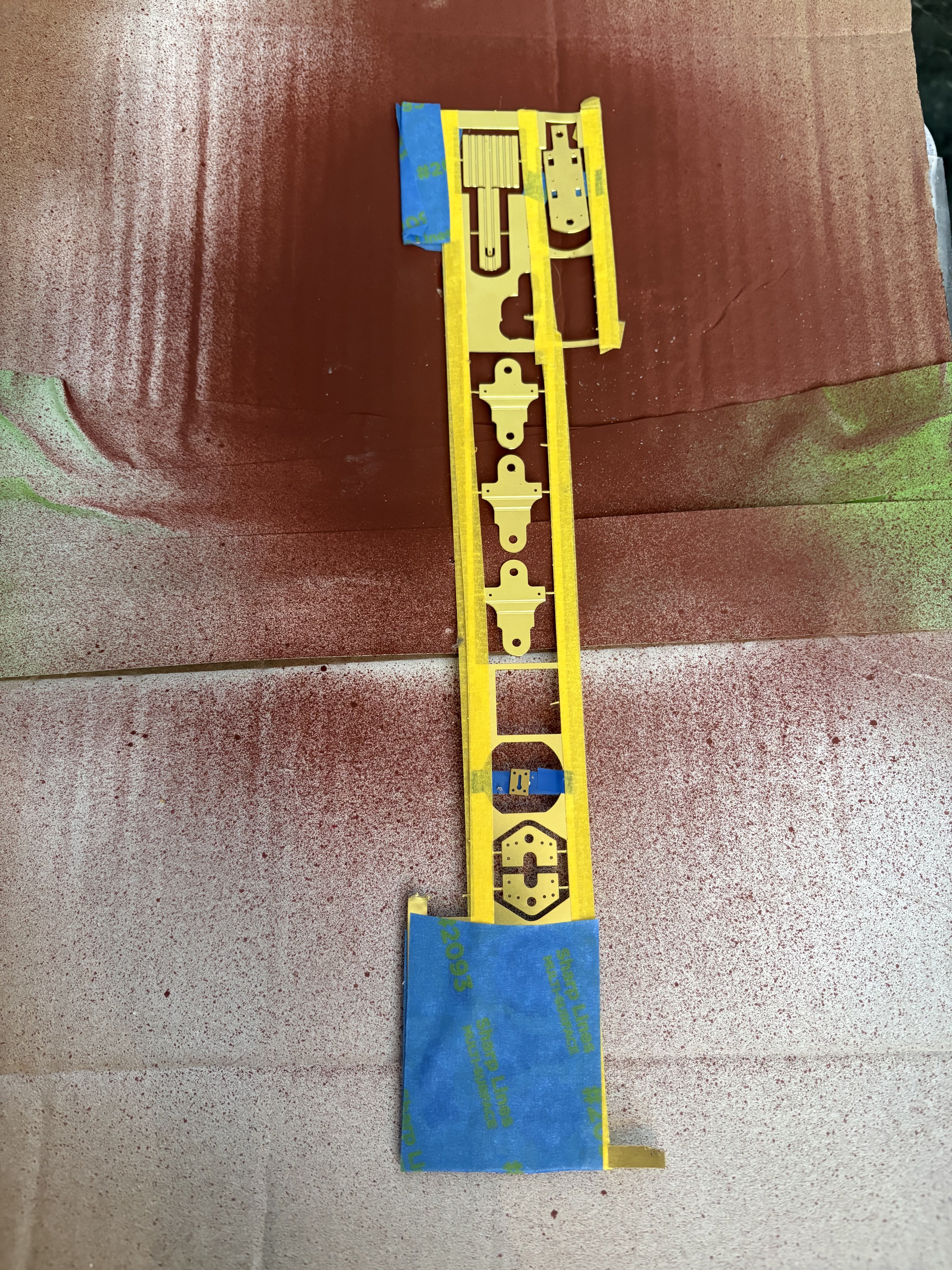

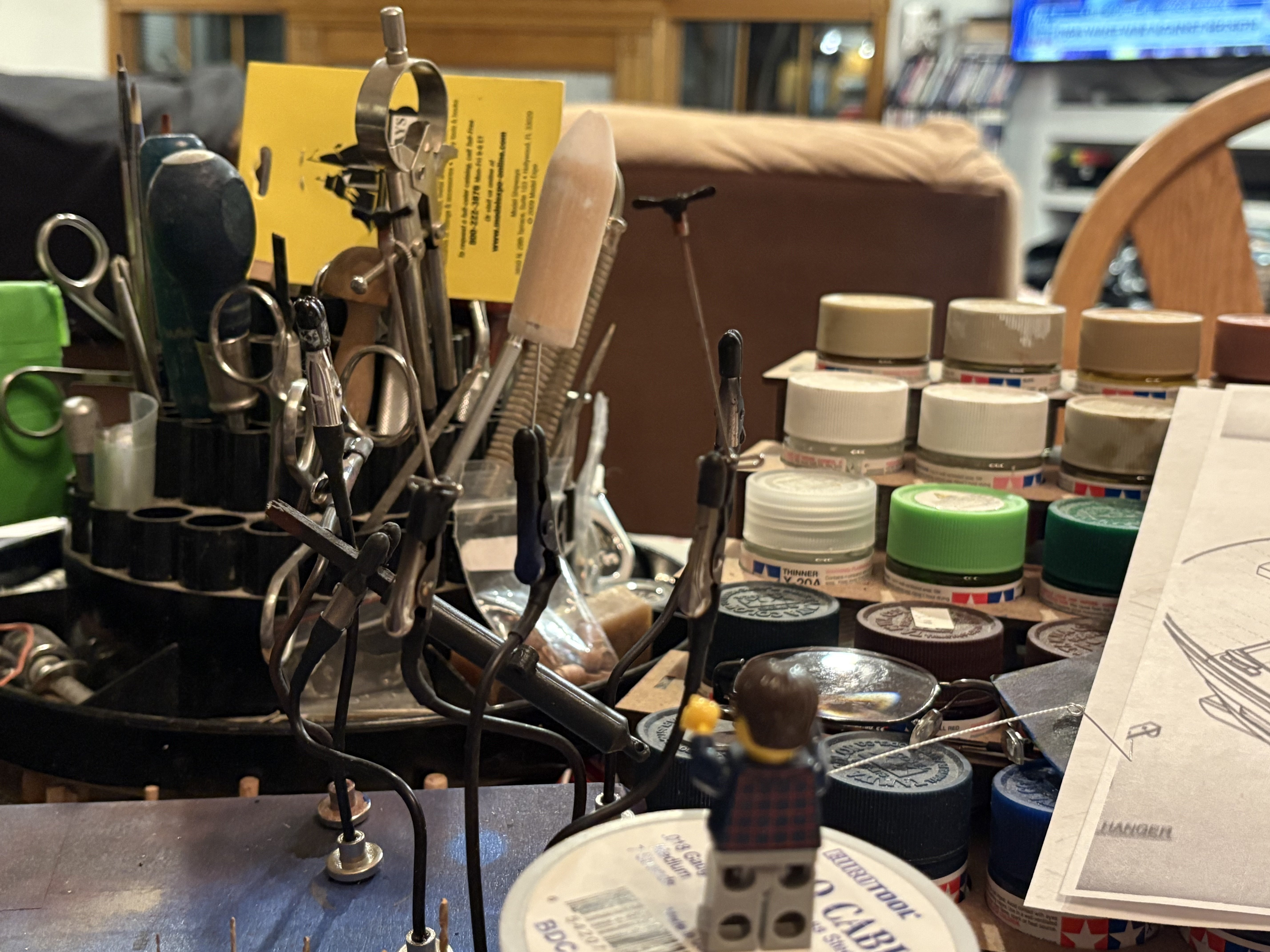

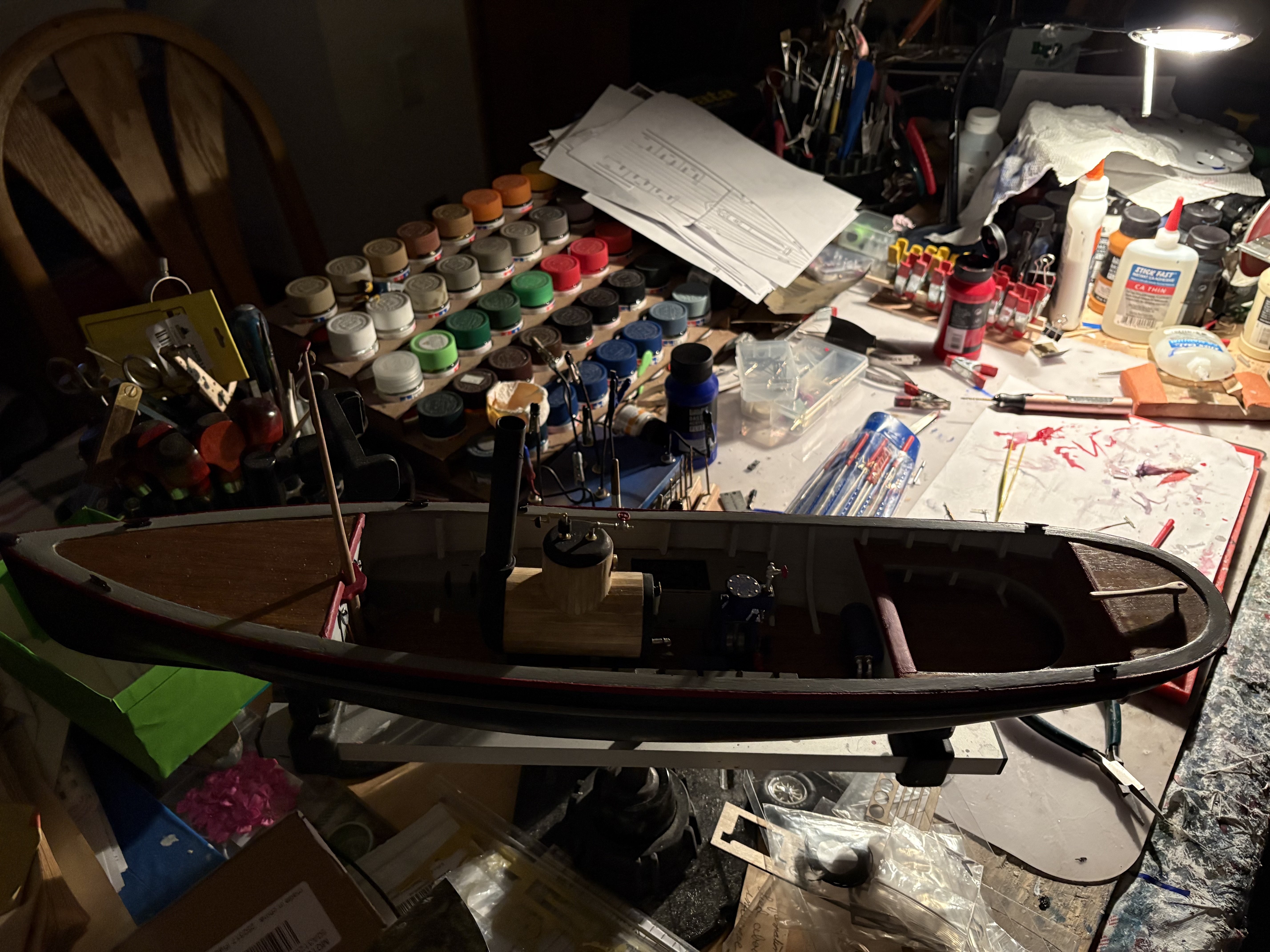

By the way notice the magnetic part holders. They are made for holding parts when airbrushing but I use them for everything from painting to holding small parts when I’m working on them. I even hang them from my work light when I run out of room on their stand. One of the best things I ever bought. The kit is very cheap on EBay.
Best Rick

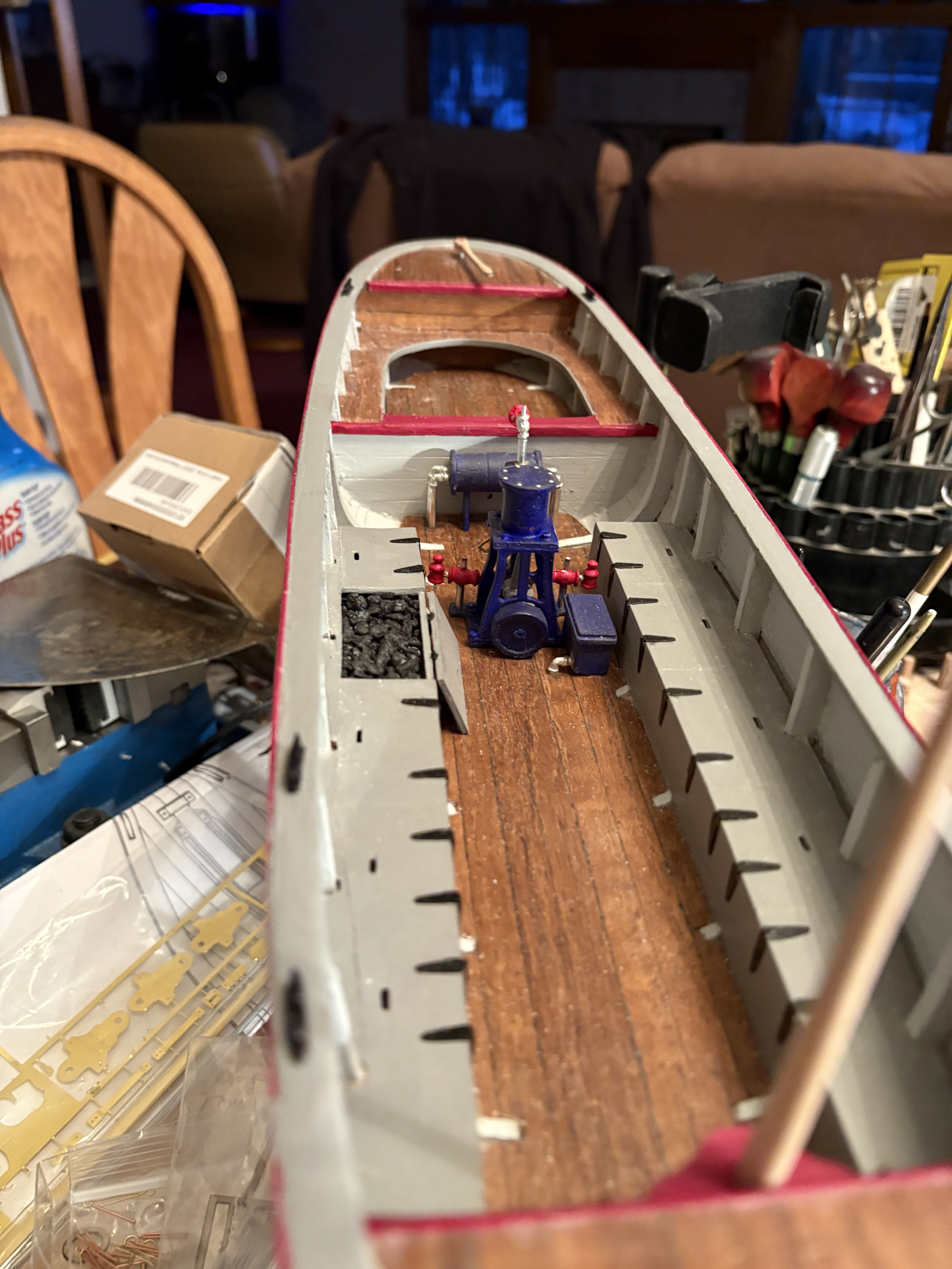

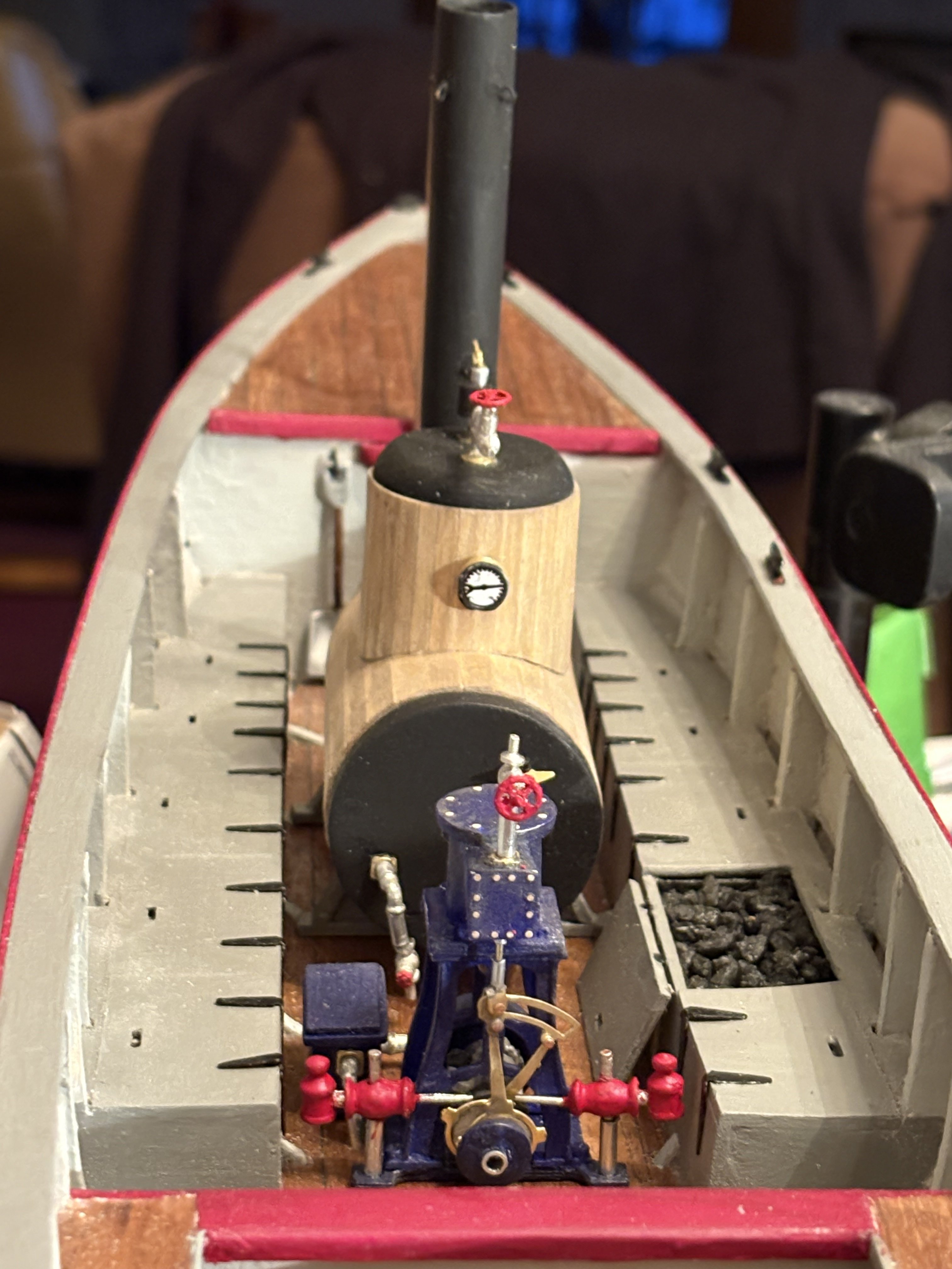

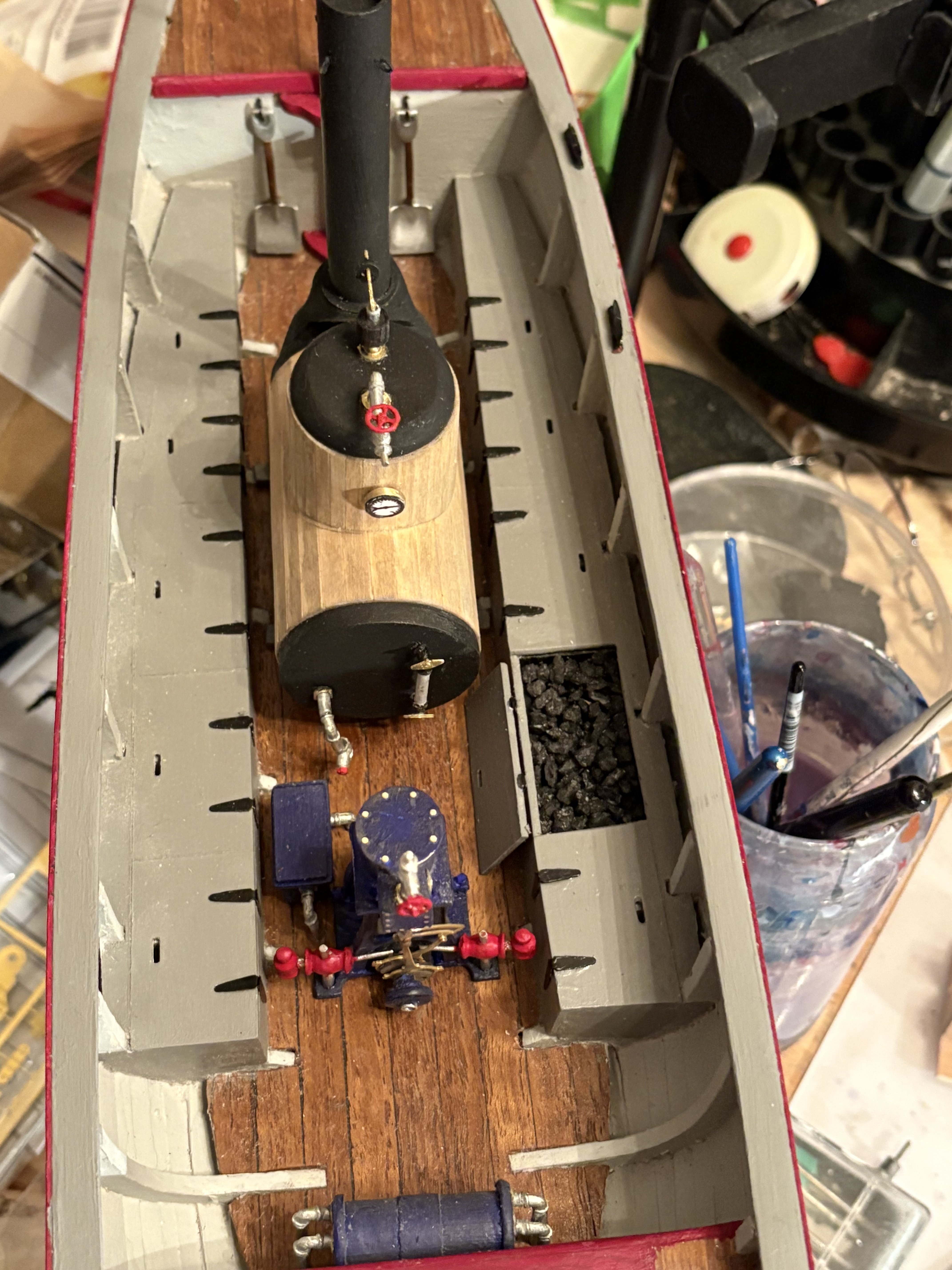

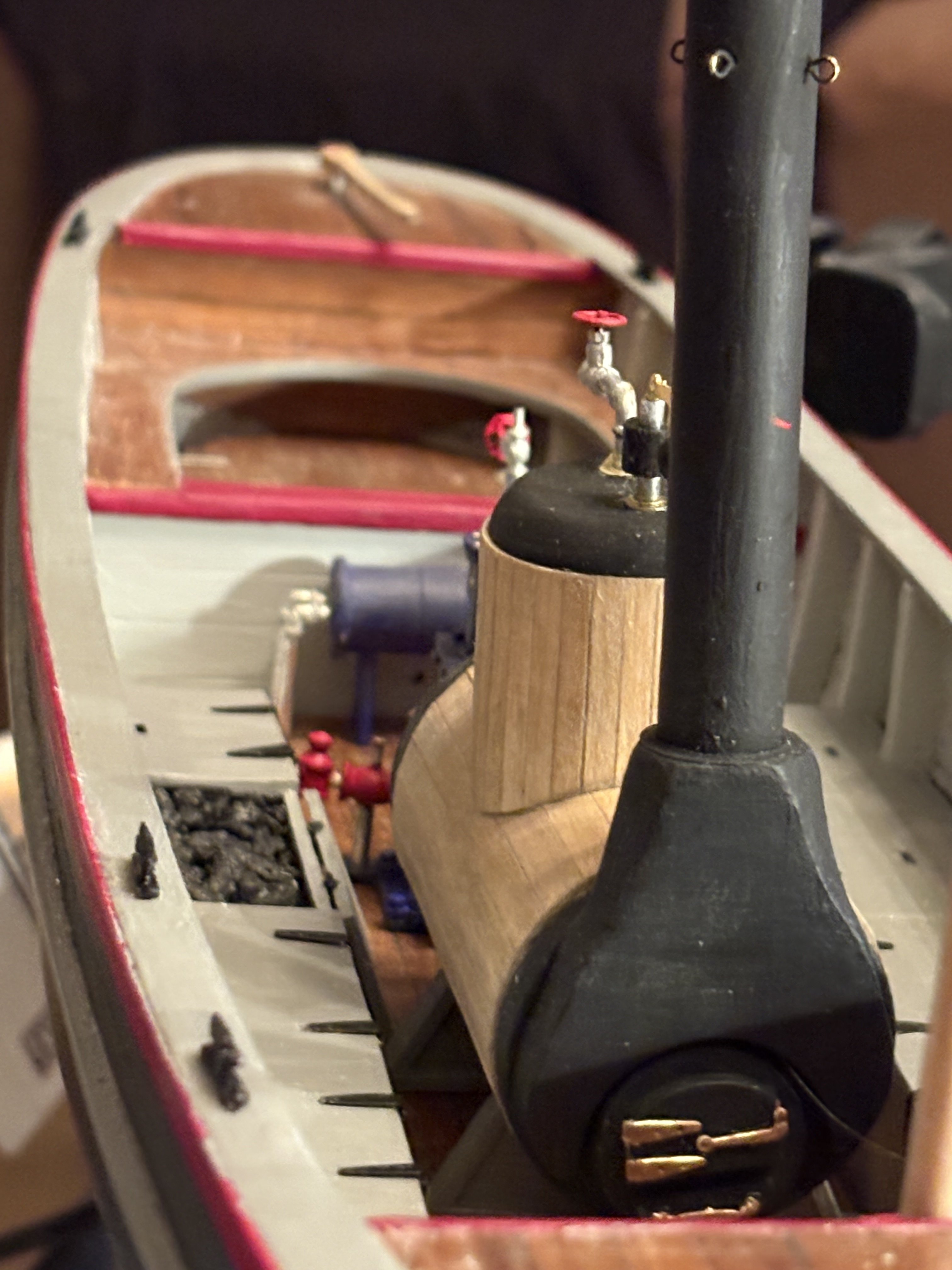

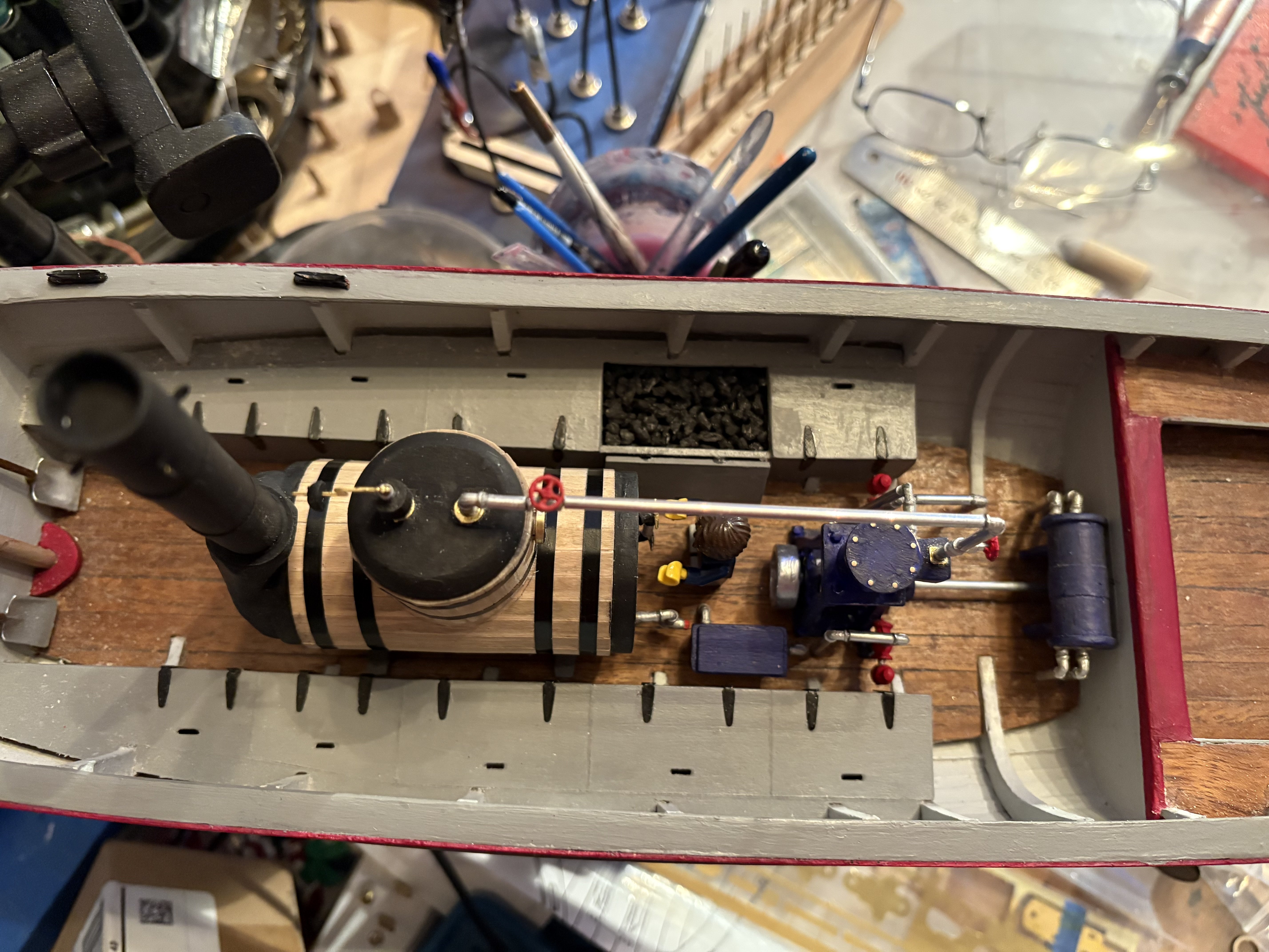

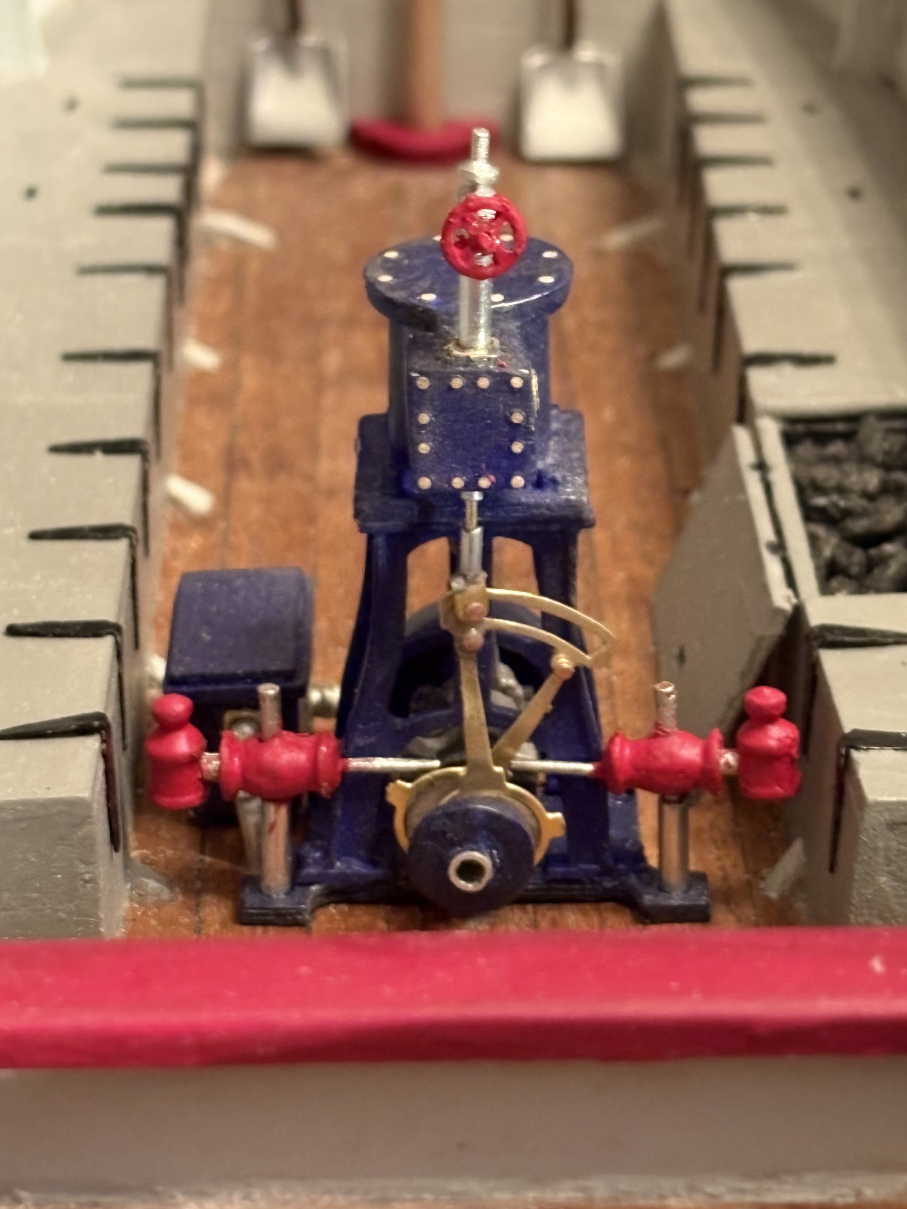

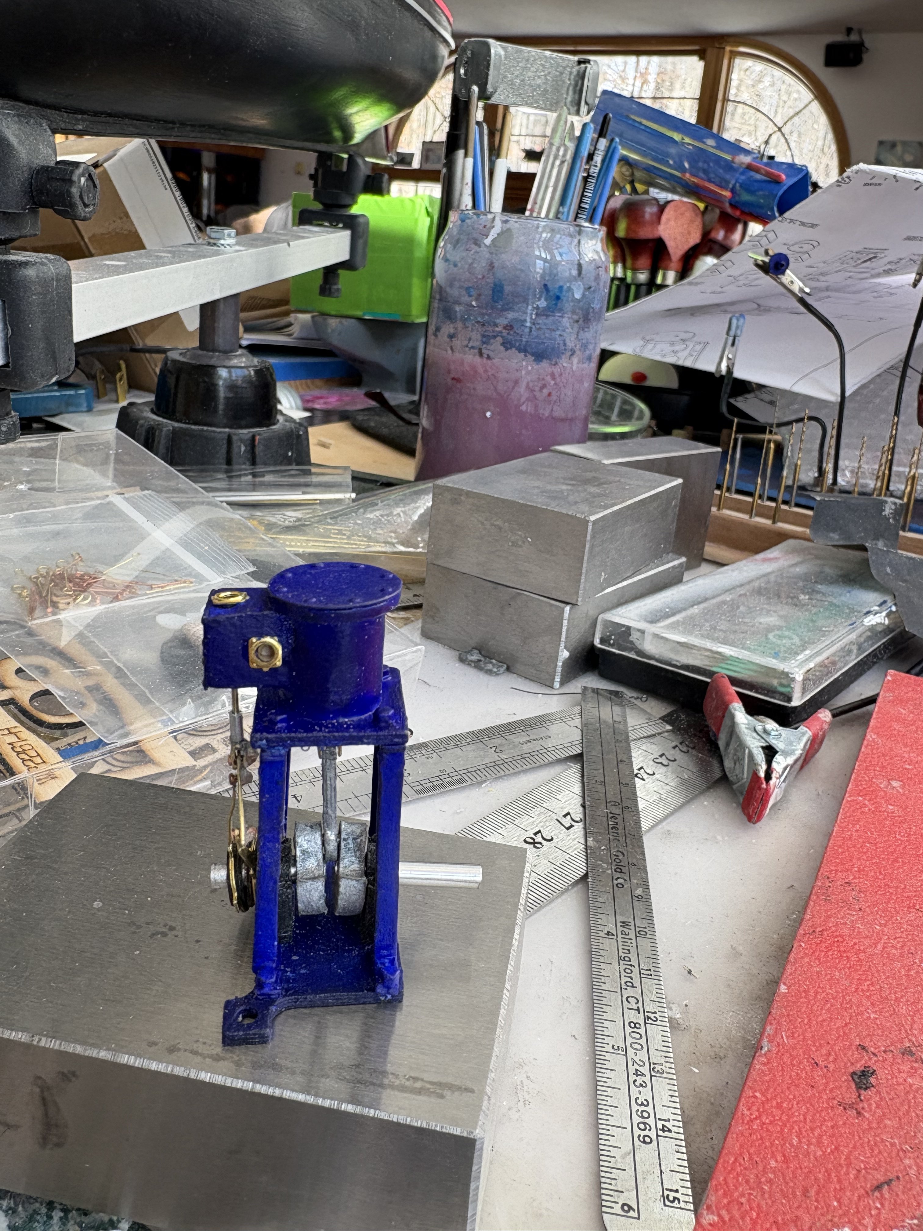

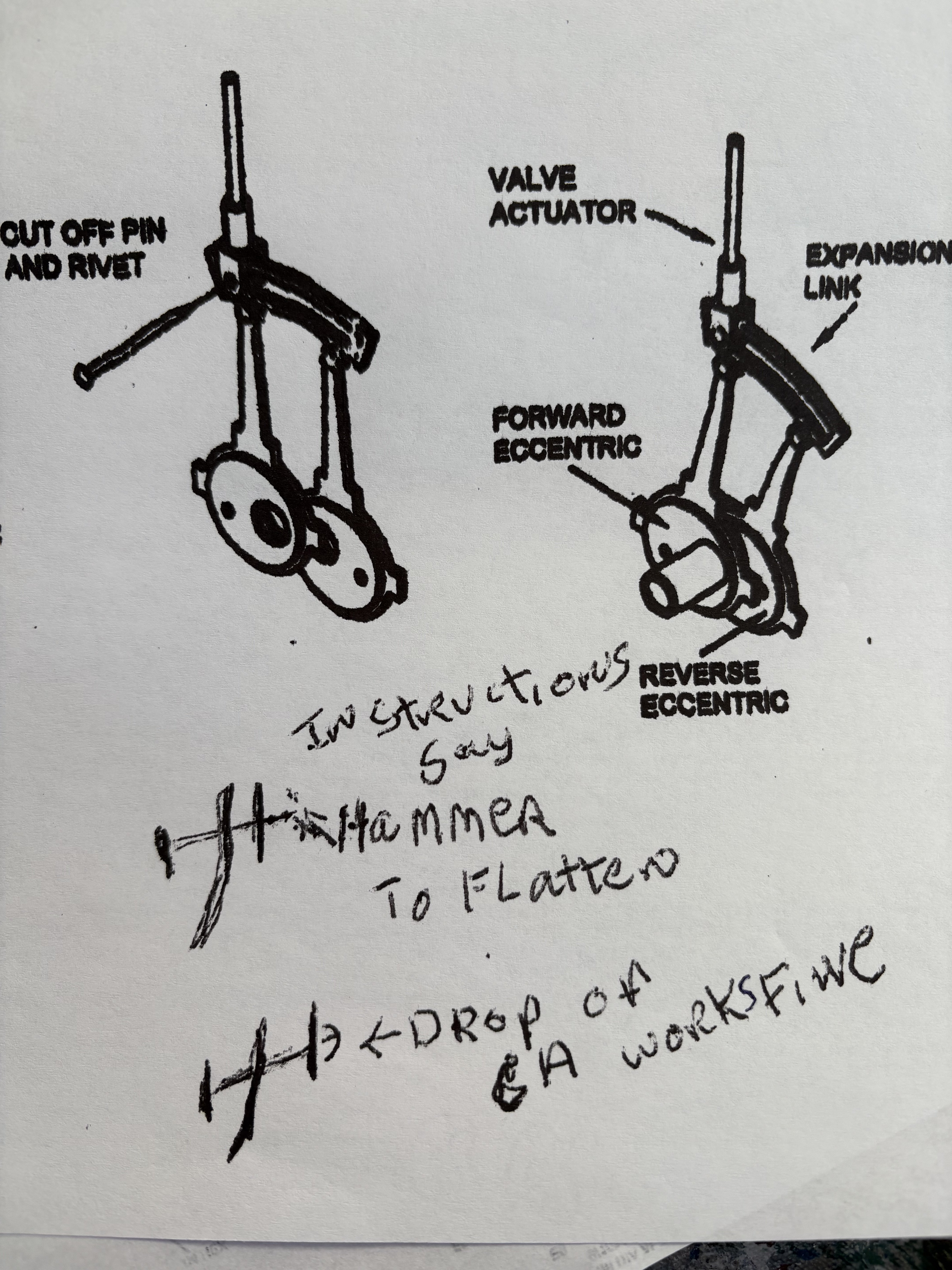

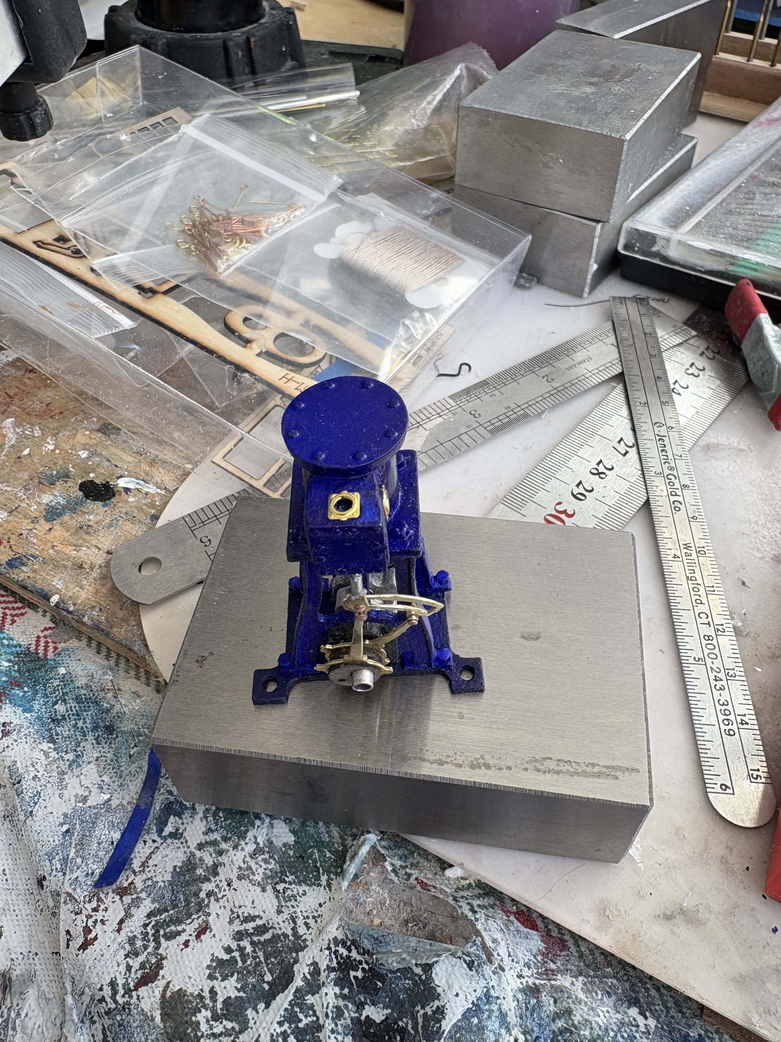

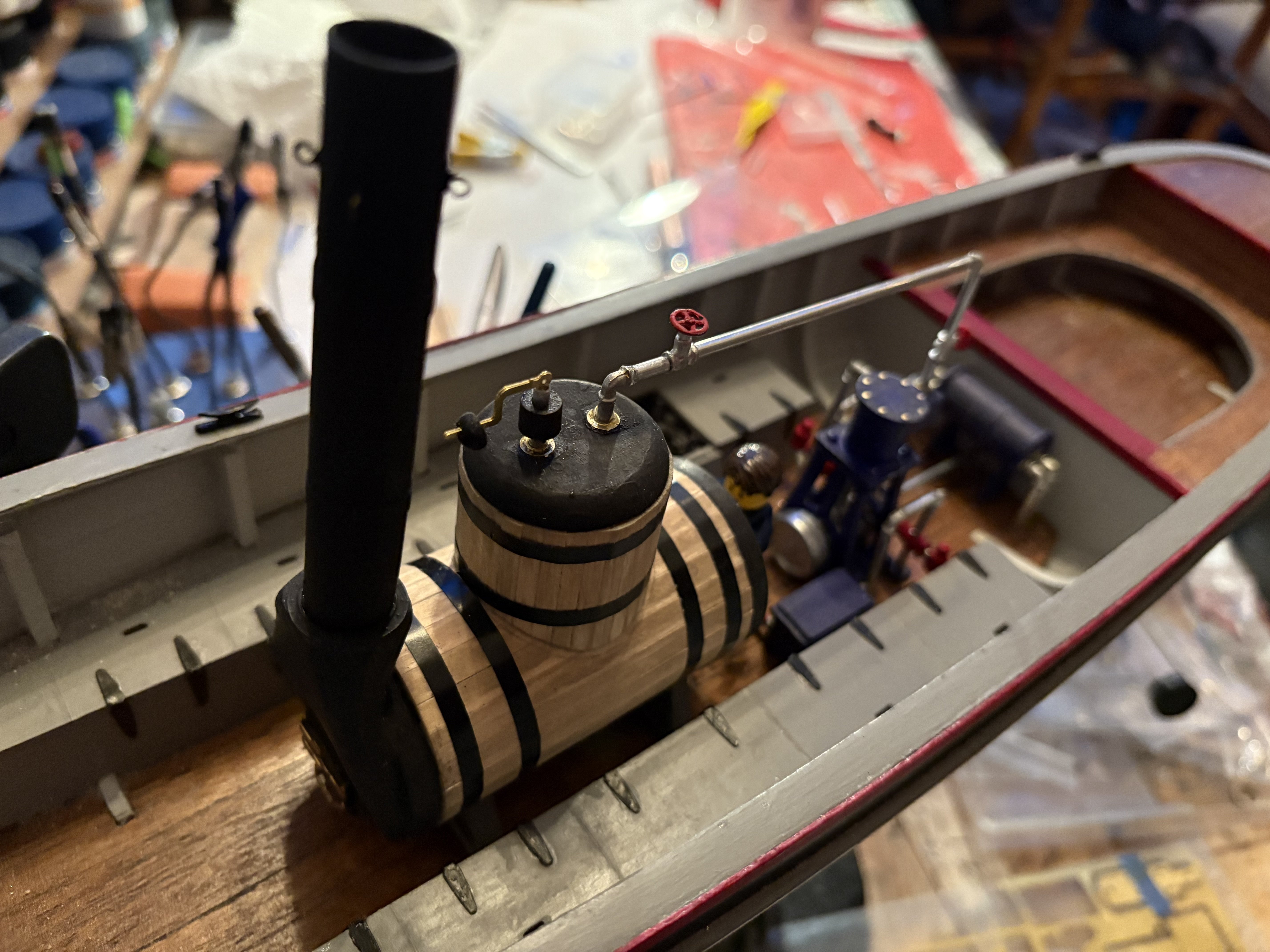

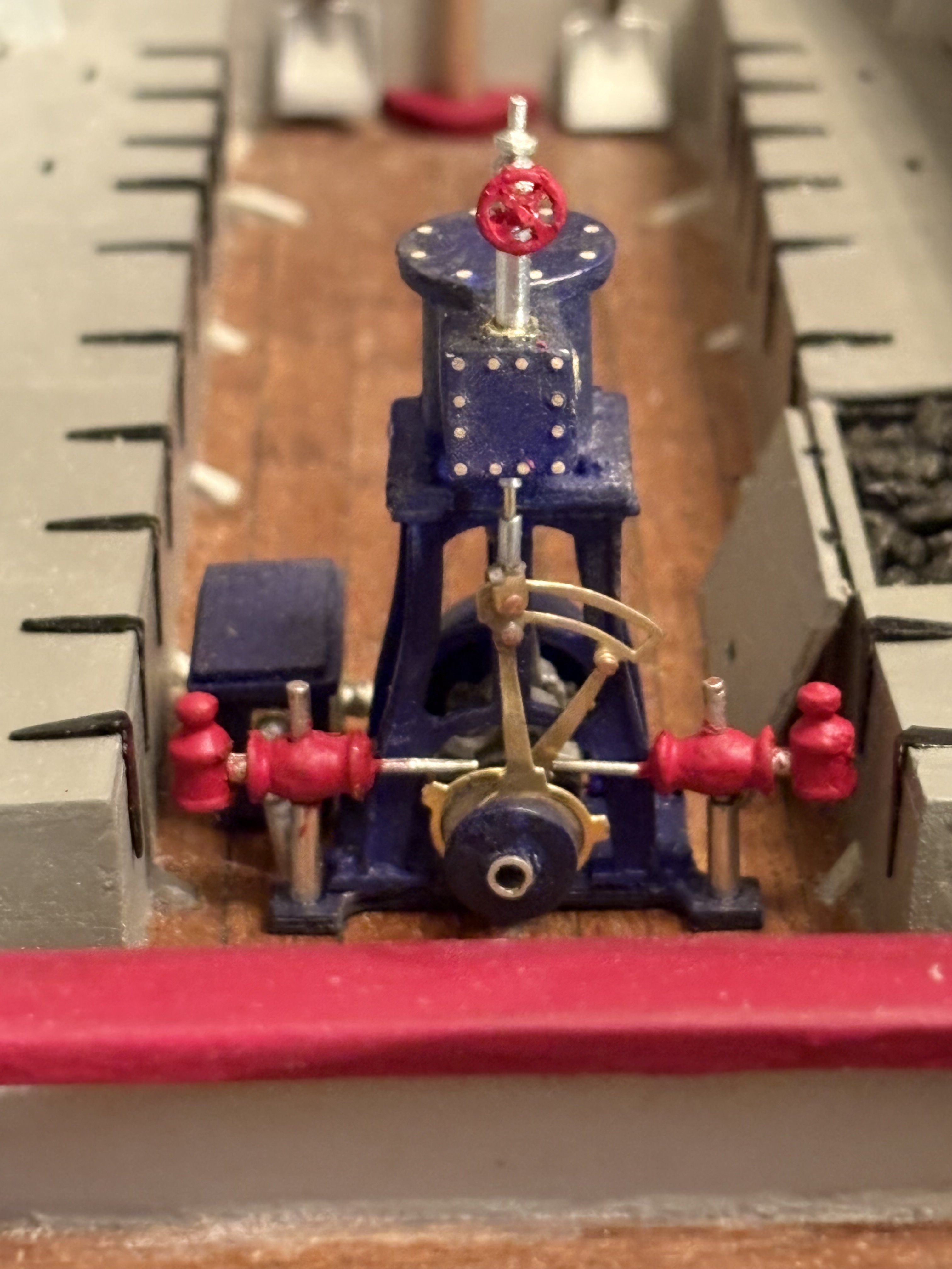

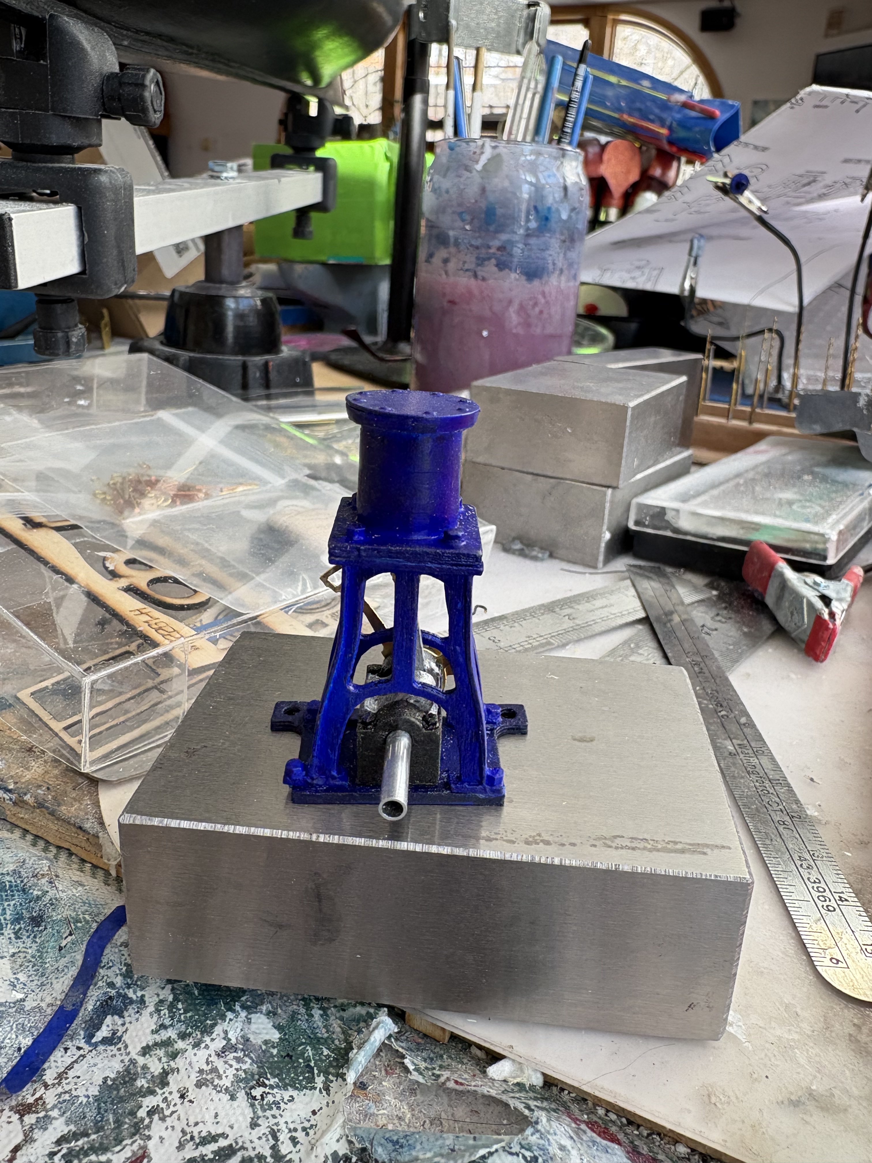

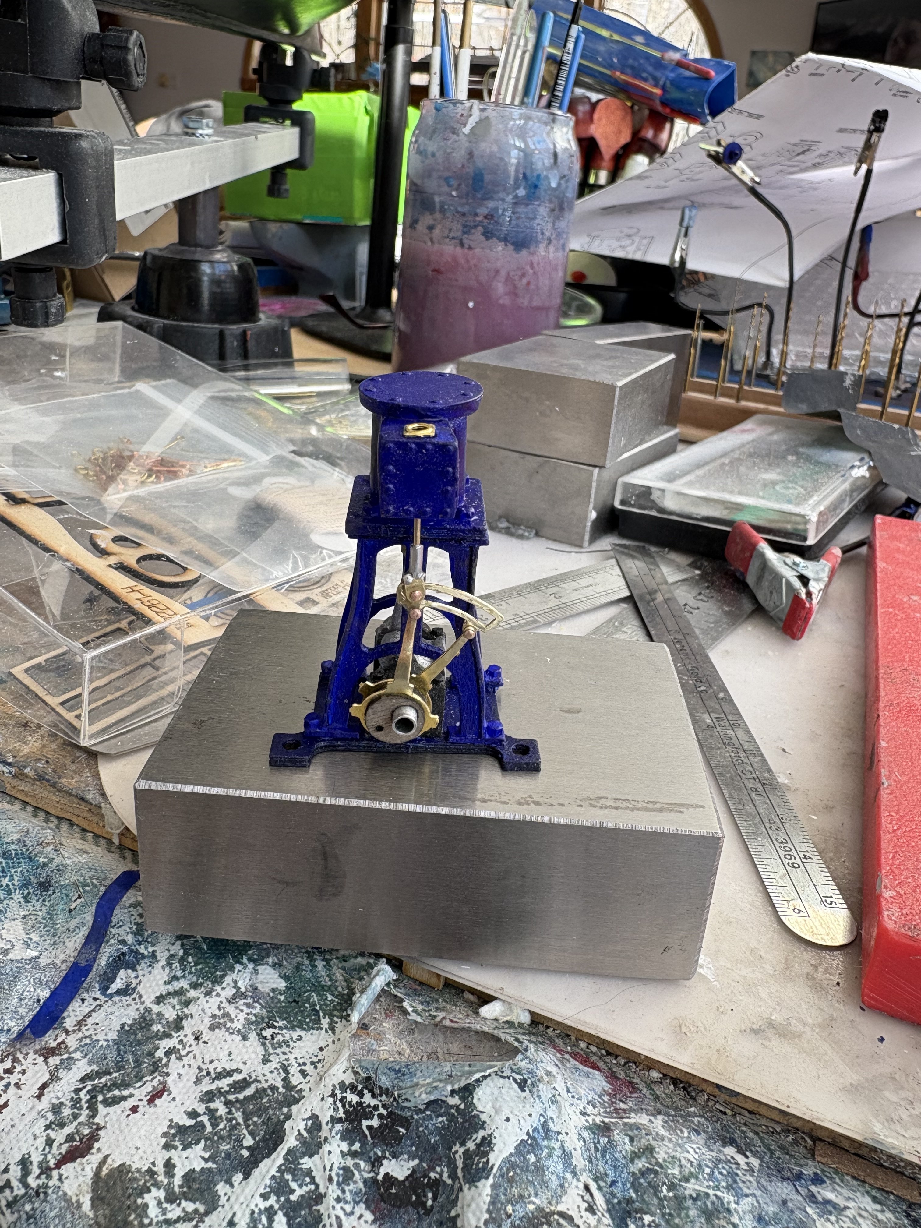

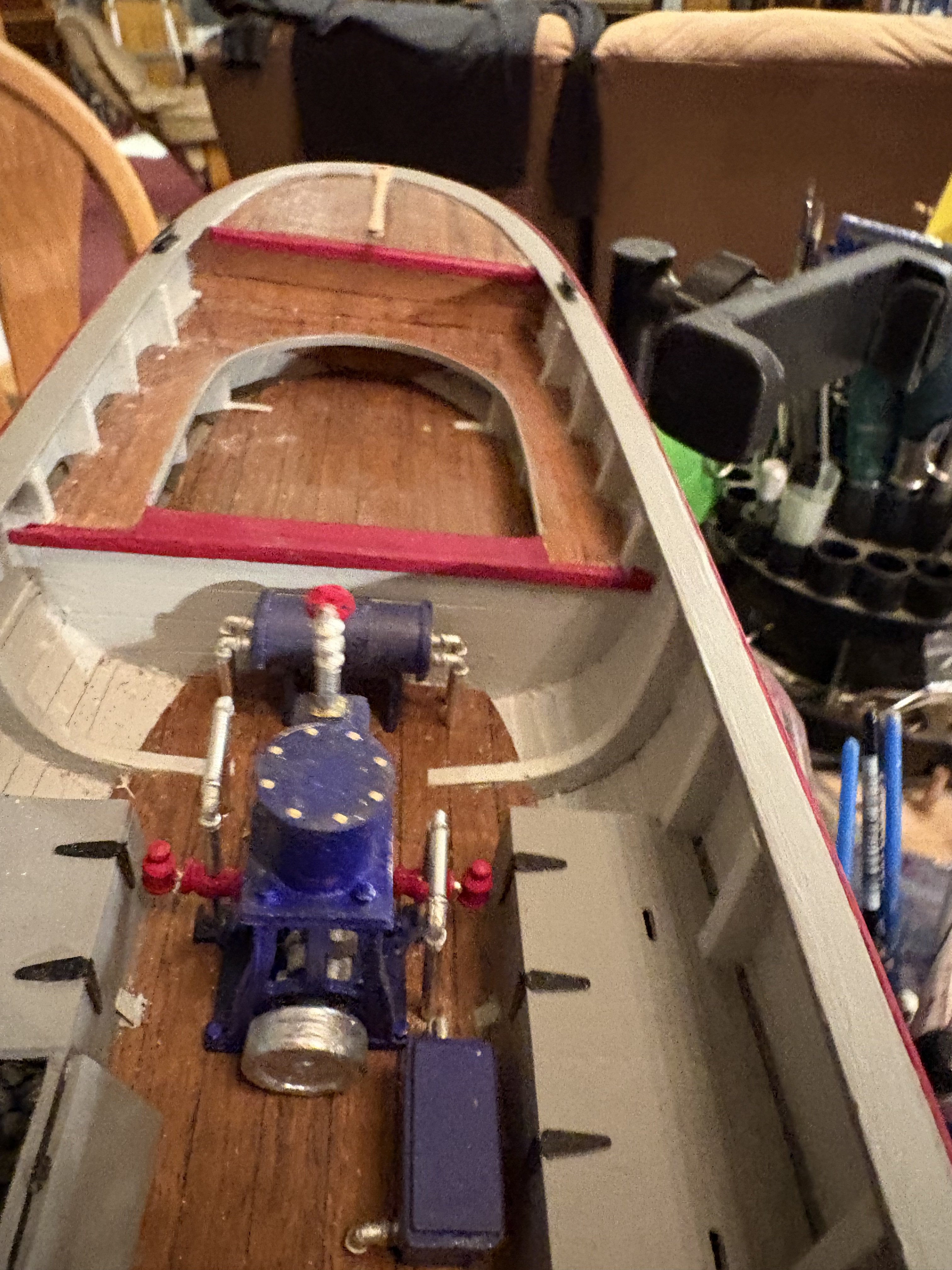

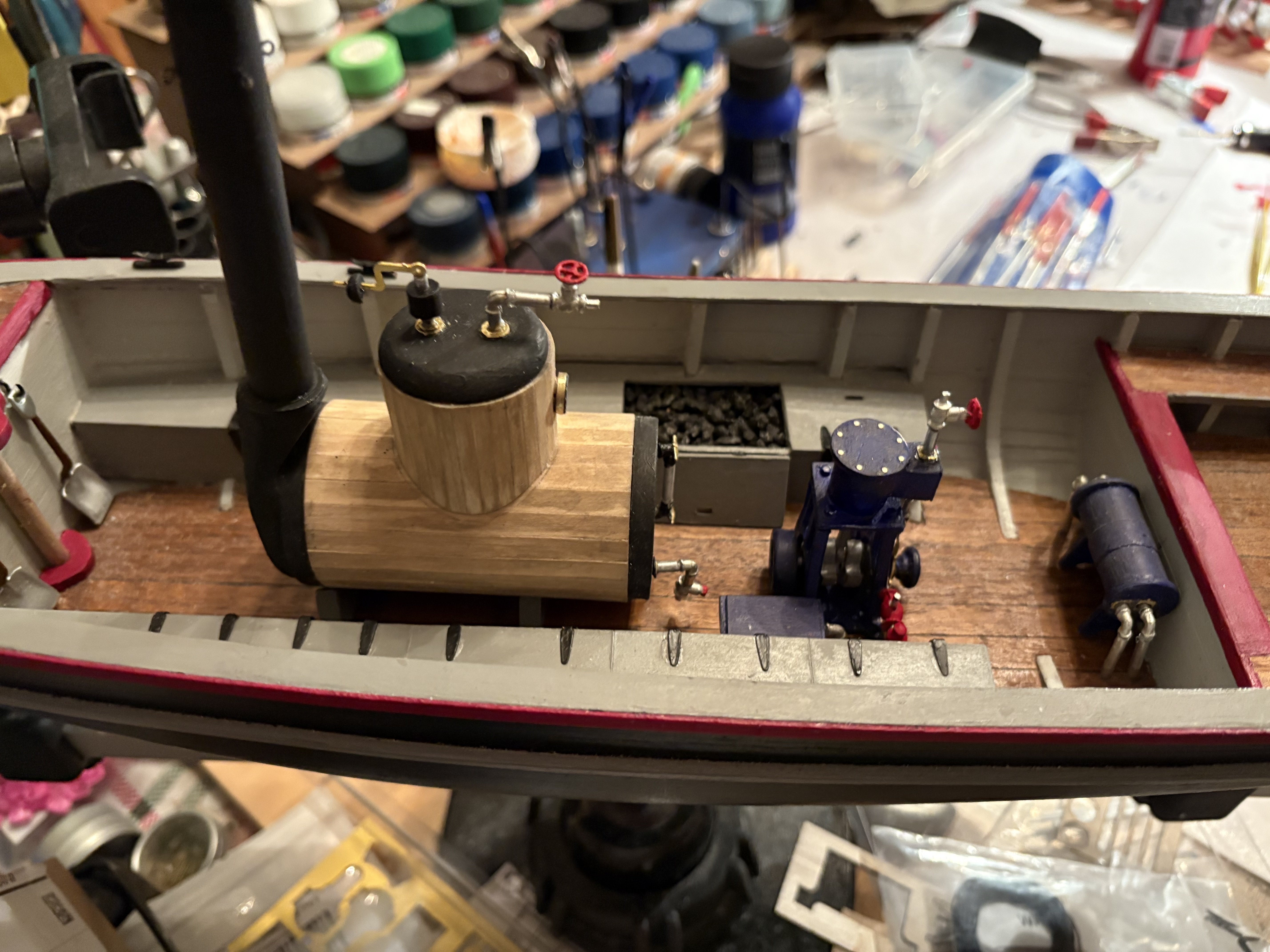

Another nice day and anxious to get back on my adventure. Spent the morning reassembling the steam engine. I’m a great mechanic but this little steam engine is a pain in the neck. There is something great to be said about sail power. Having raced a Vanguard 470 you can actually feel the power in your arms and butt as the sails fill. You don’t get that with this little steam engine when it’s running.
Edited by RVB

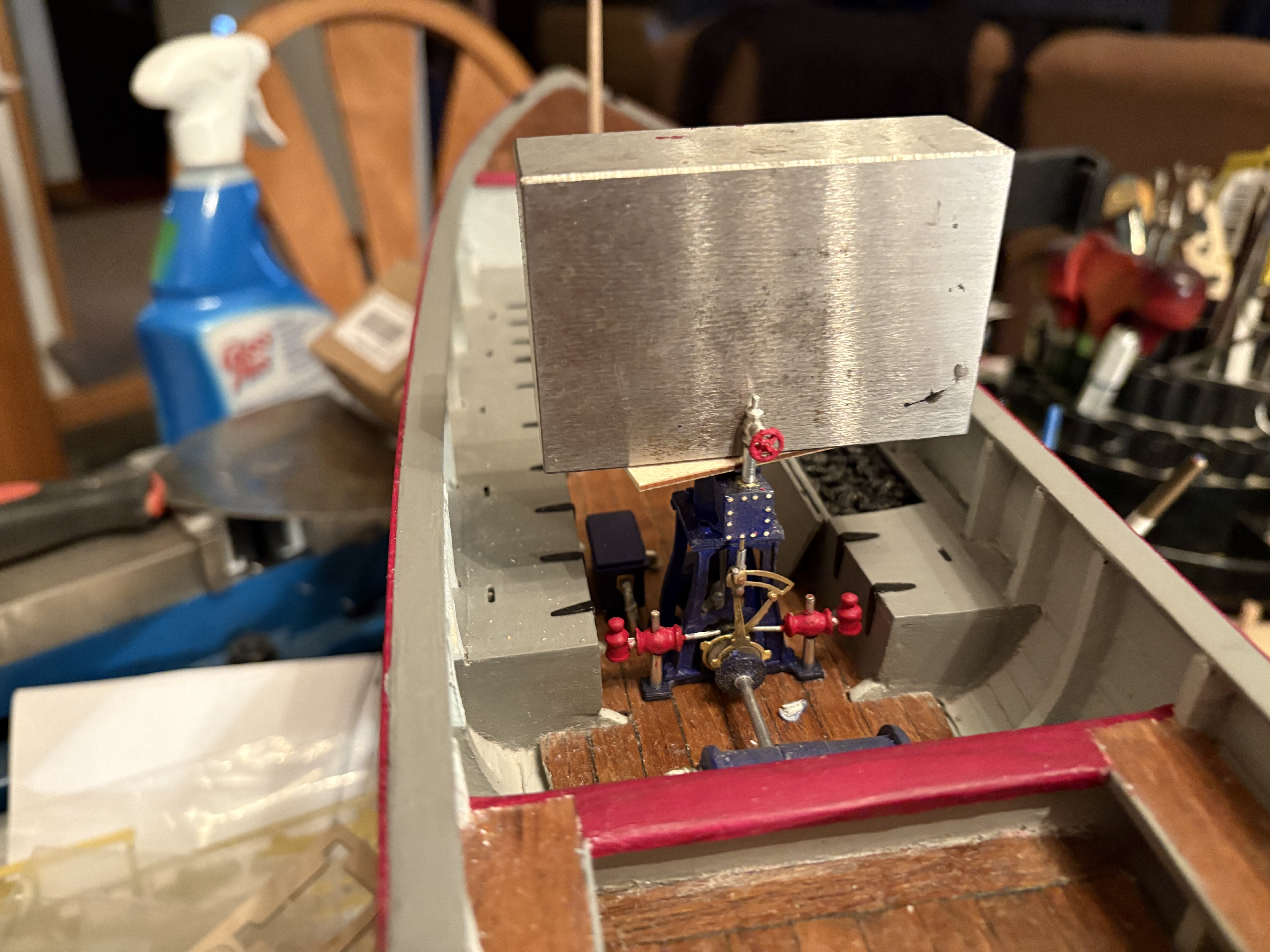

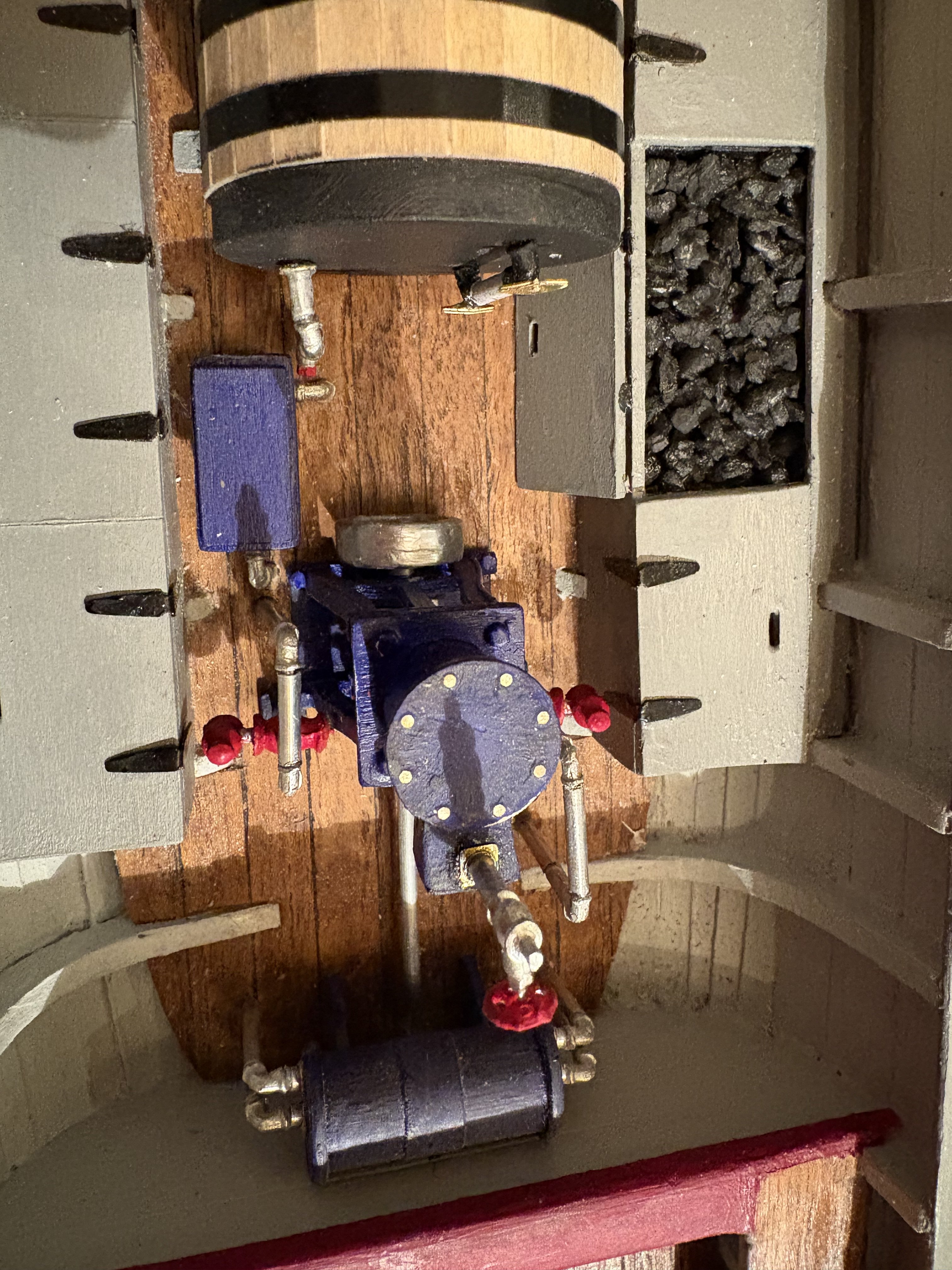

Thanks Phil for the mechanic encouragement. This morning working on the engine was traumatic to my health. I’m sure you have been there. The riveting was a pain in the      — — S. After a very frustrating hour I ended up making the rivet heads back up with CA. They are  hidden and you can’t see them because they are in the back side. Sure worked a hell of a lot better than trying to hammer a tiny copper nail on a 1-2-3 block to create a flat head to secure the parts.  5 minutes for all 3 rivets instead of an hour plus repeated failures.
Best Rick
Edited by RVB

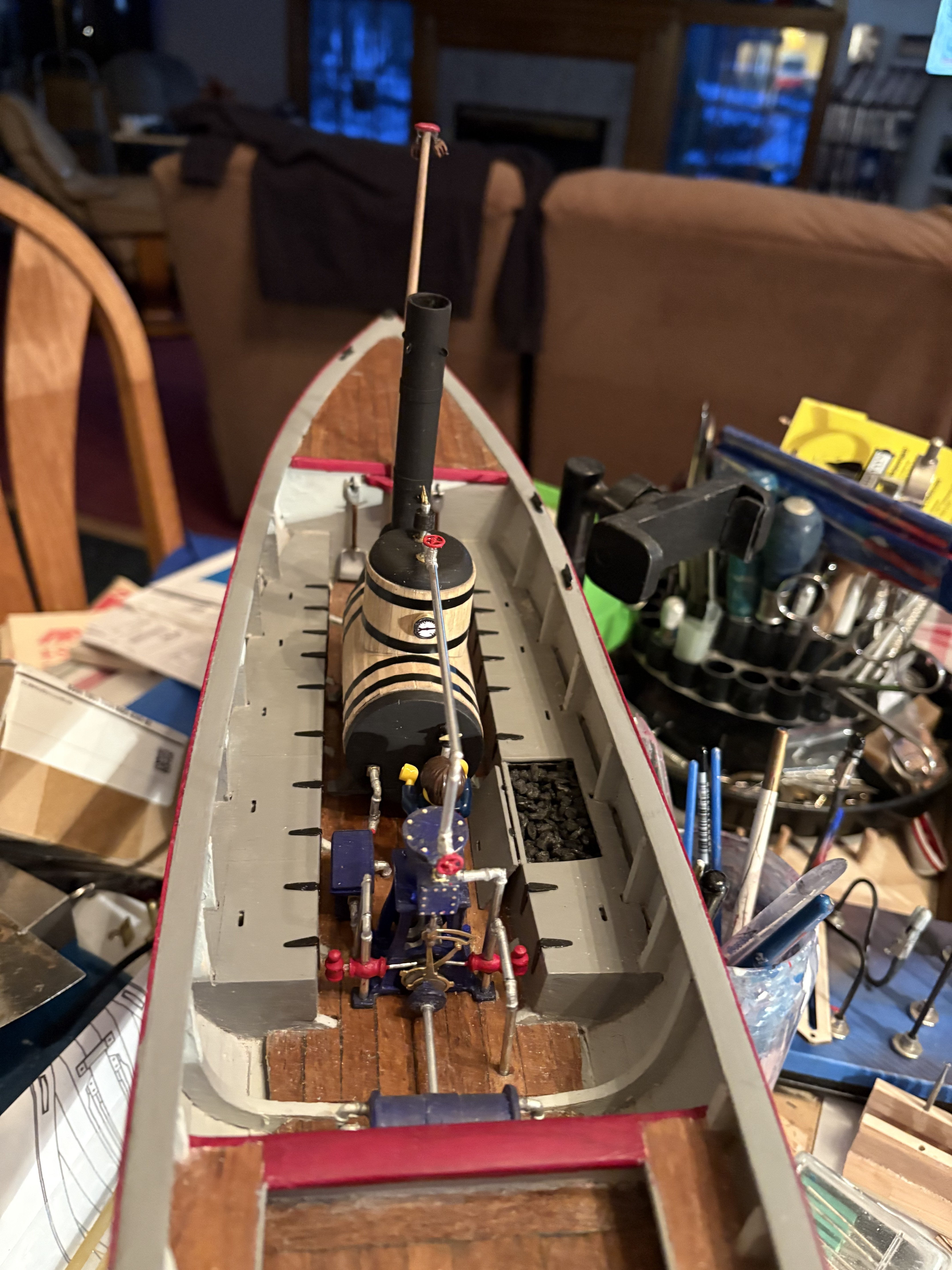

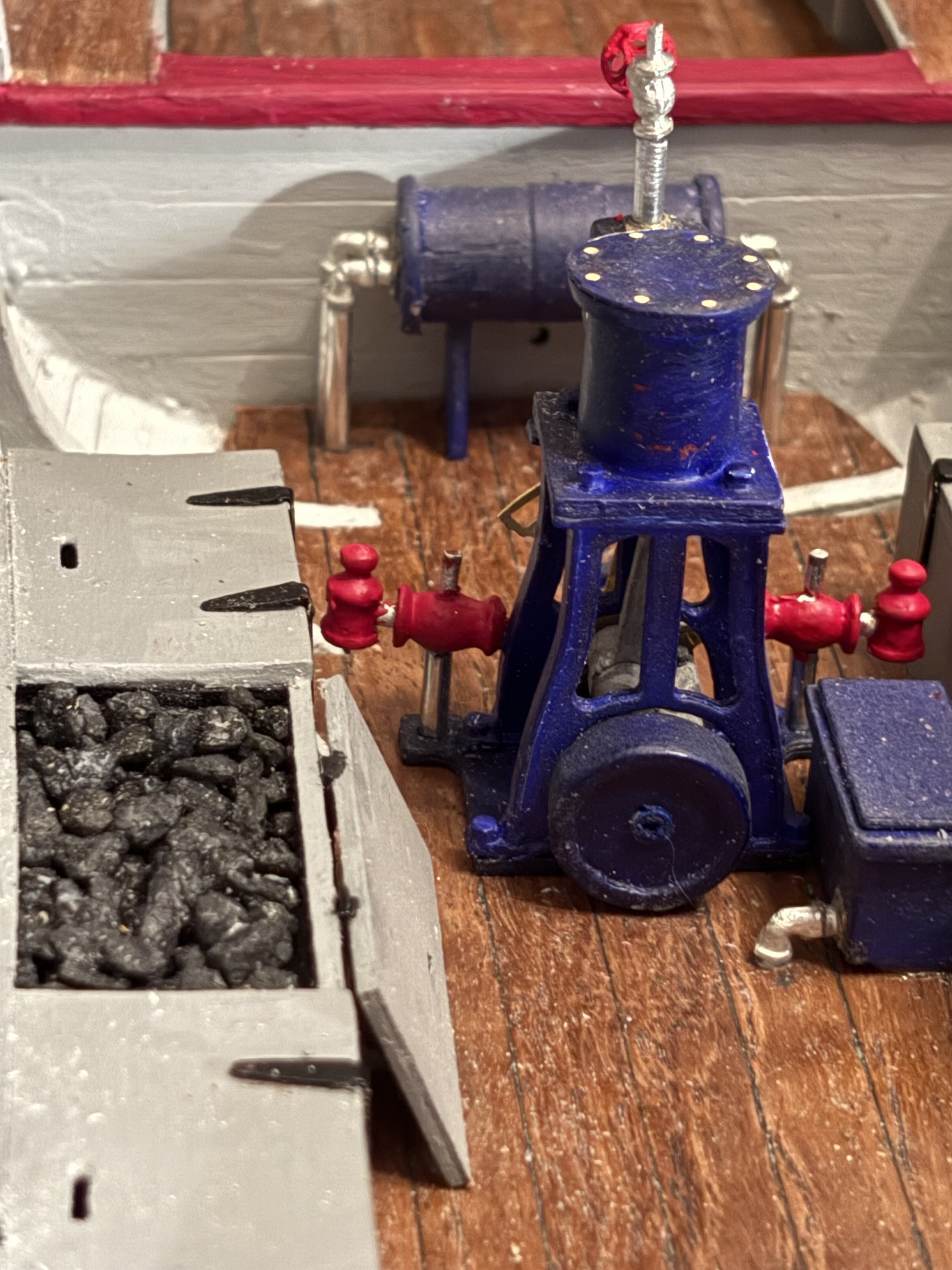

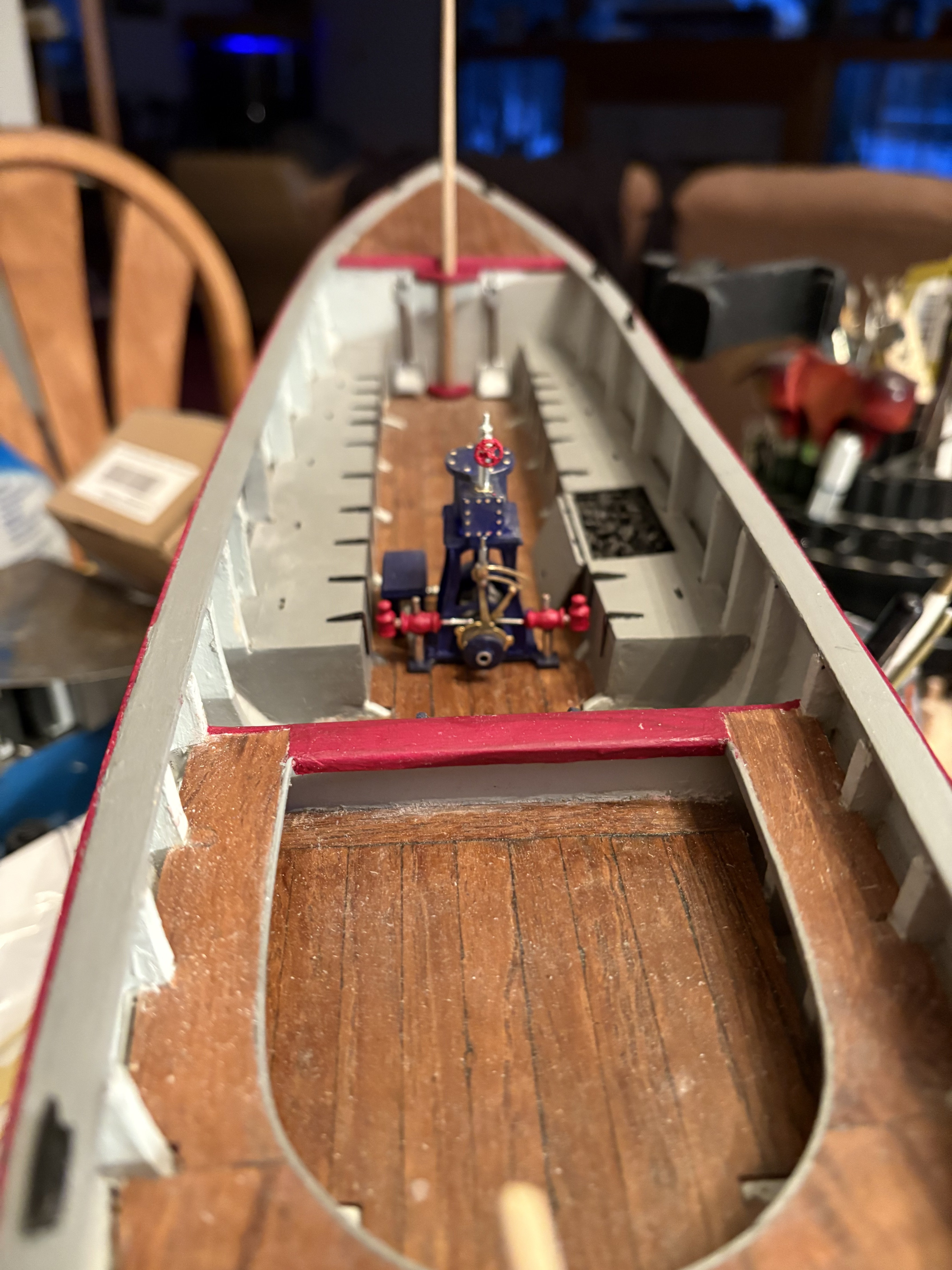

Weather suppose to deteriorate Tuesday with snow squalls predicted. Anxious to get back to sea hopefully tomorrow at the latest before the storm my granddaughter actually got up early today. The steam engine is almost back together.A wee piping to go. Will put it off until tomorrow since the sun is setting.
Until tomorrow AM Best Rick

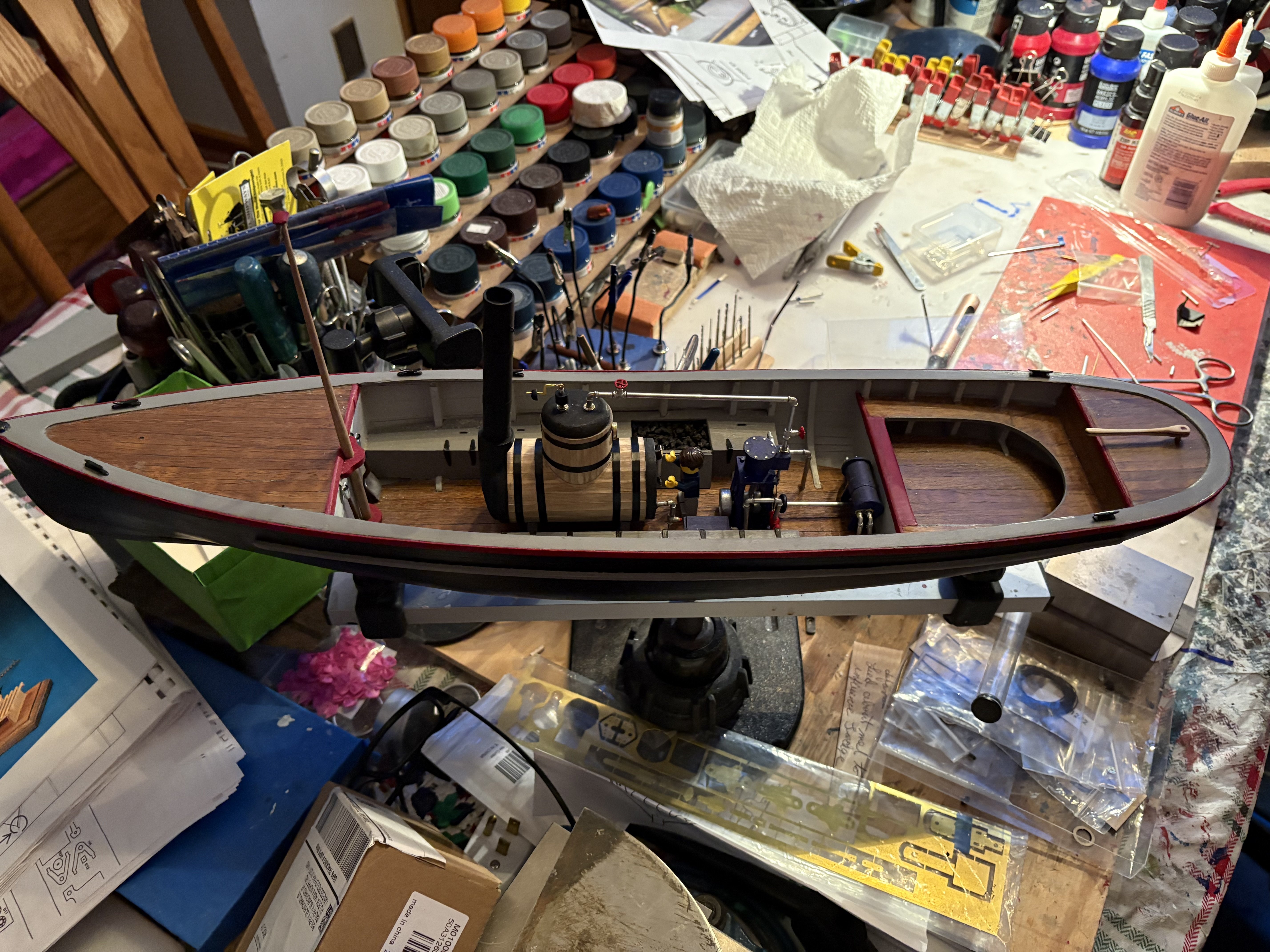

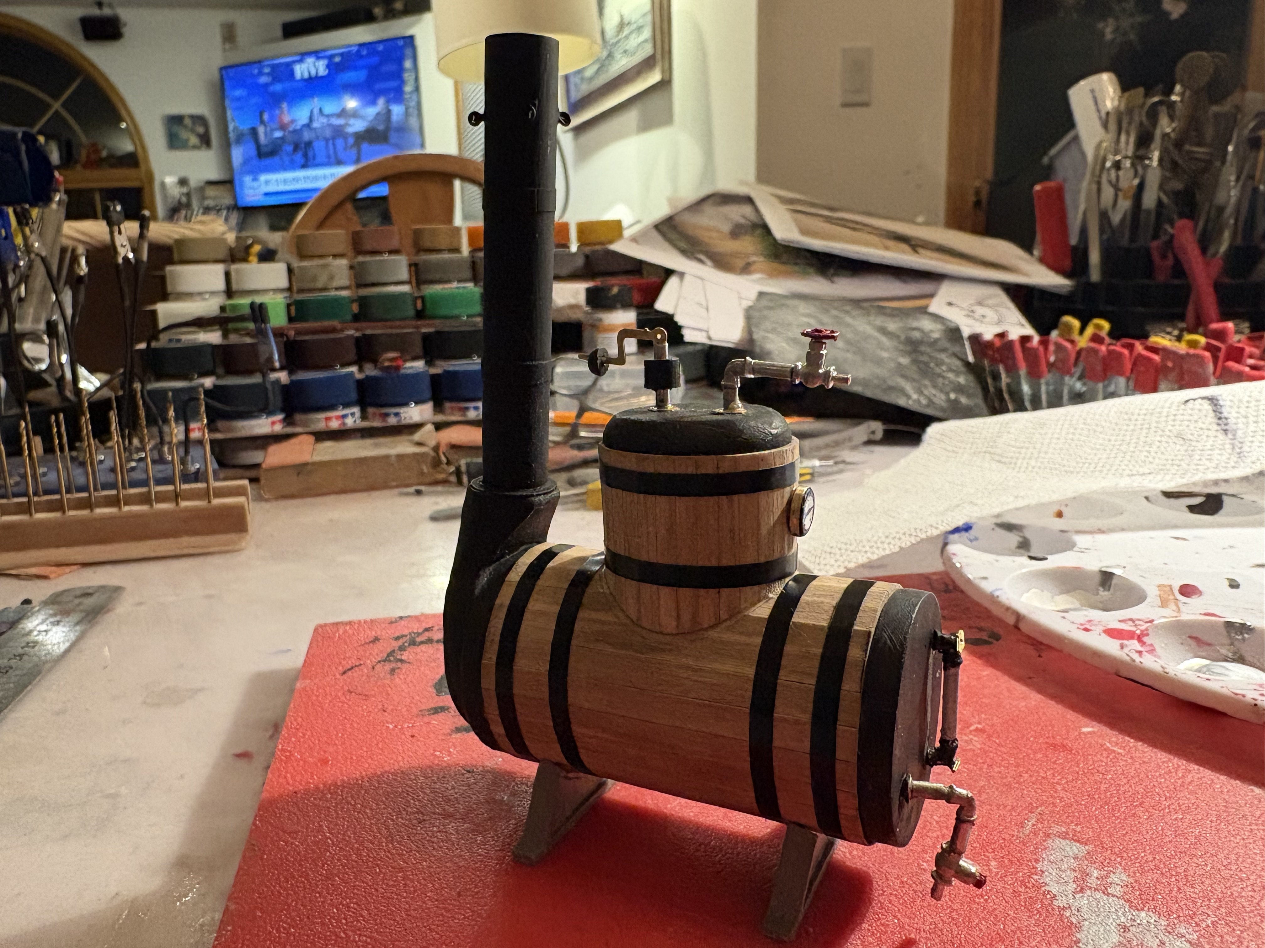

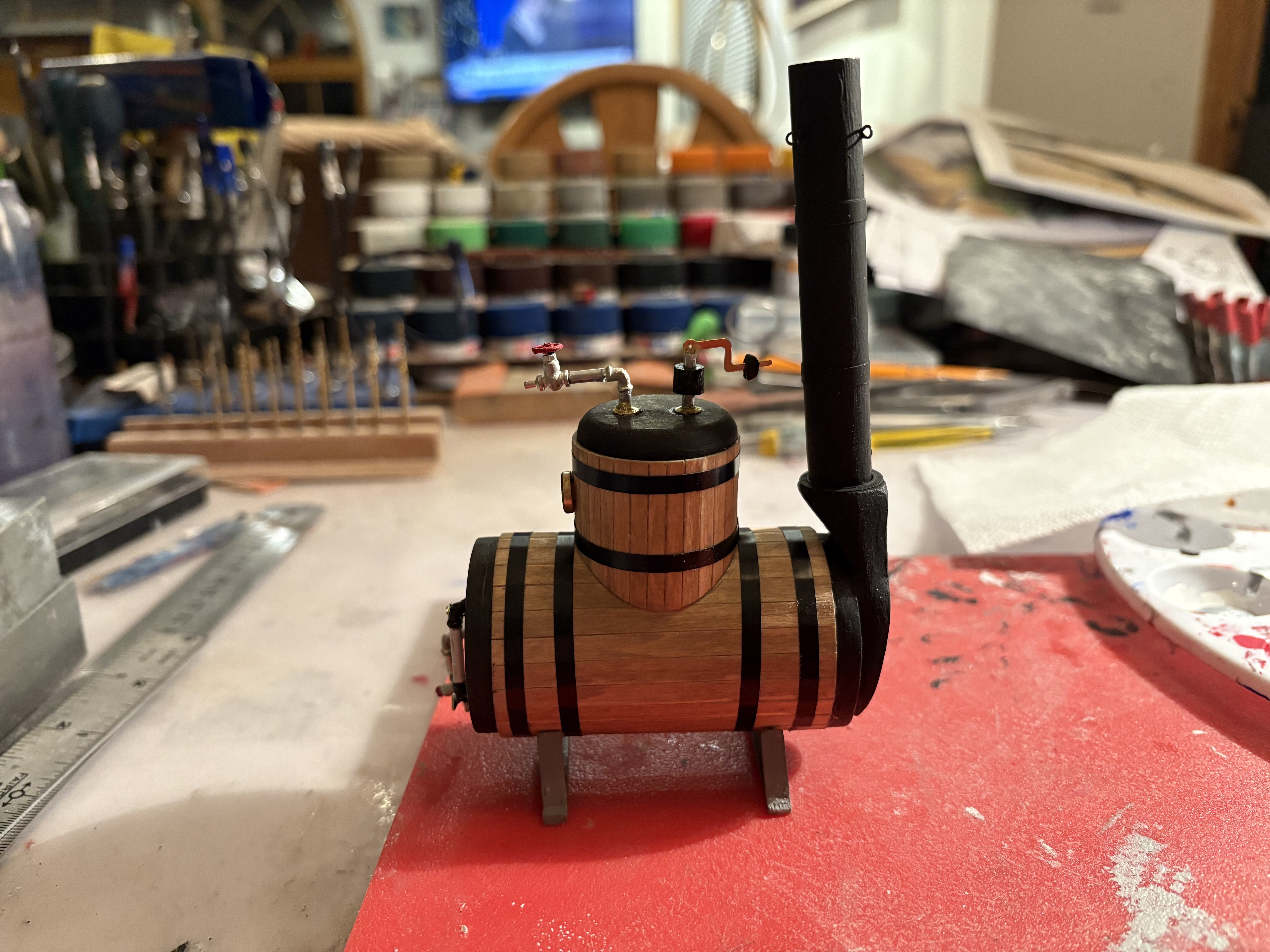

Big storm coming tomorrow so will stay in port for another day. Almost finished the steam engine just a wee bit of plumbing to go. Will finish in the morning. Put new iron straps on the steam boiler (3mm satin black auto pinstriping.  Sure beats painting cutting and gluing card stock. May try using it for waterline in the future. It work great for the iron straps and comes in multiple widths from 1mm on up.  Would be great to get a very crisp waterline with out all the headaches  associated with painting   Time to turn in for the night because 5AM comes quick.

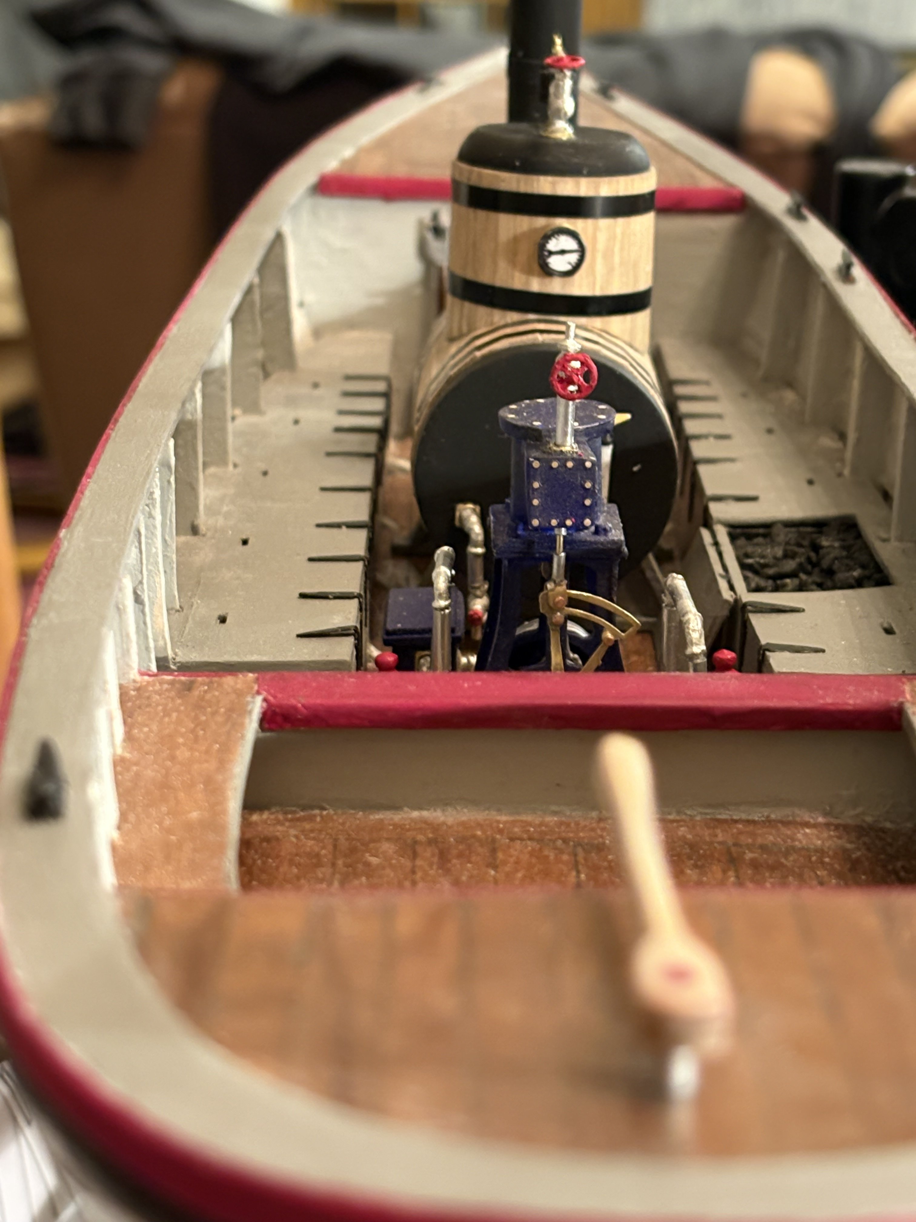

That steam engine looks spectacular Rick, well done. Stay warm through the storm!

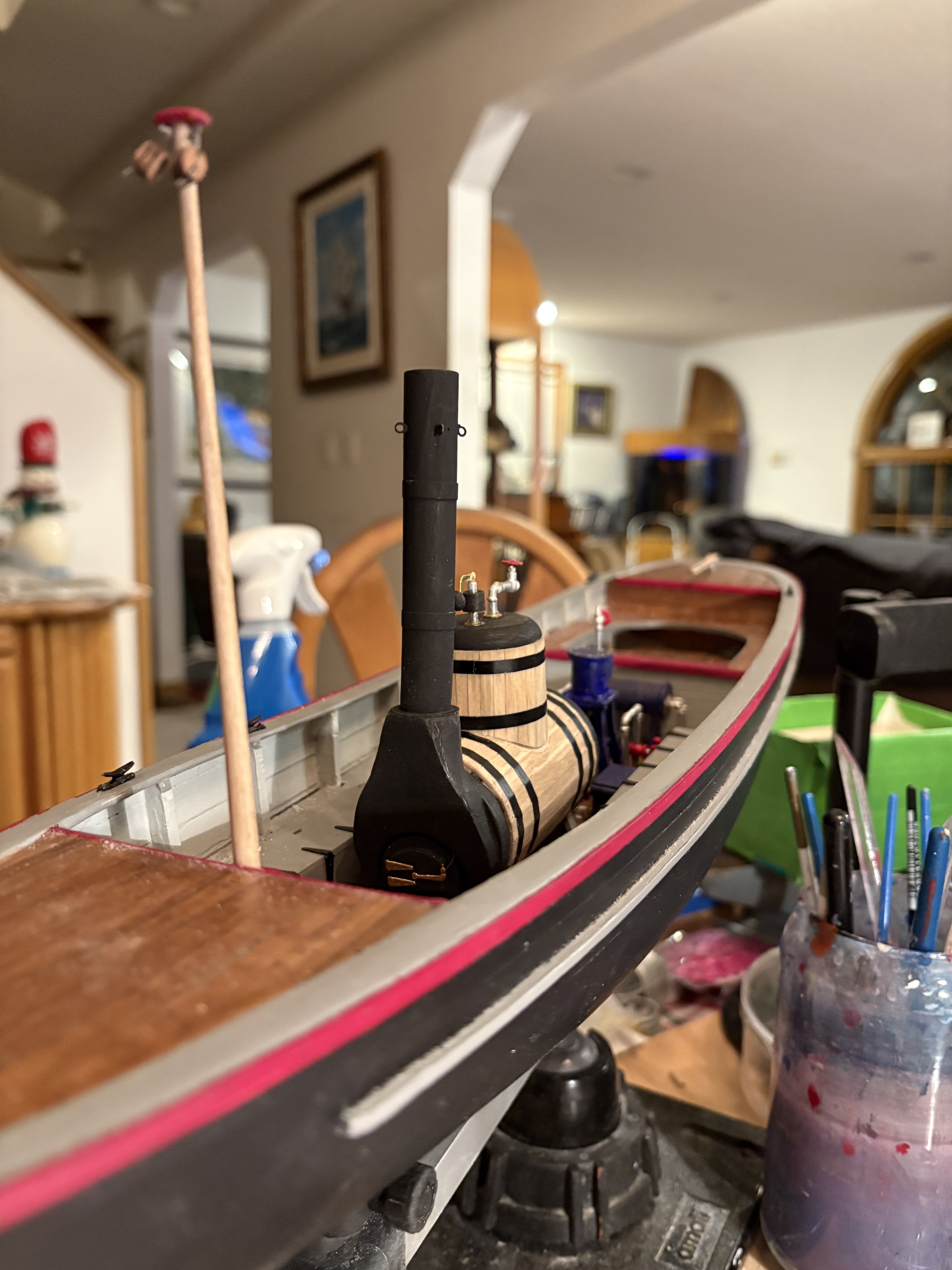

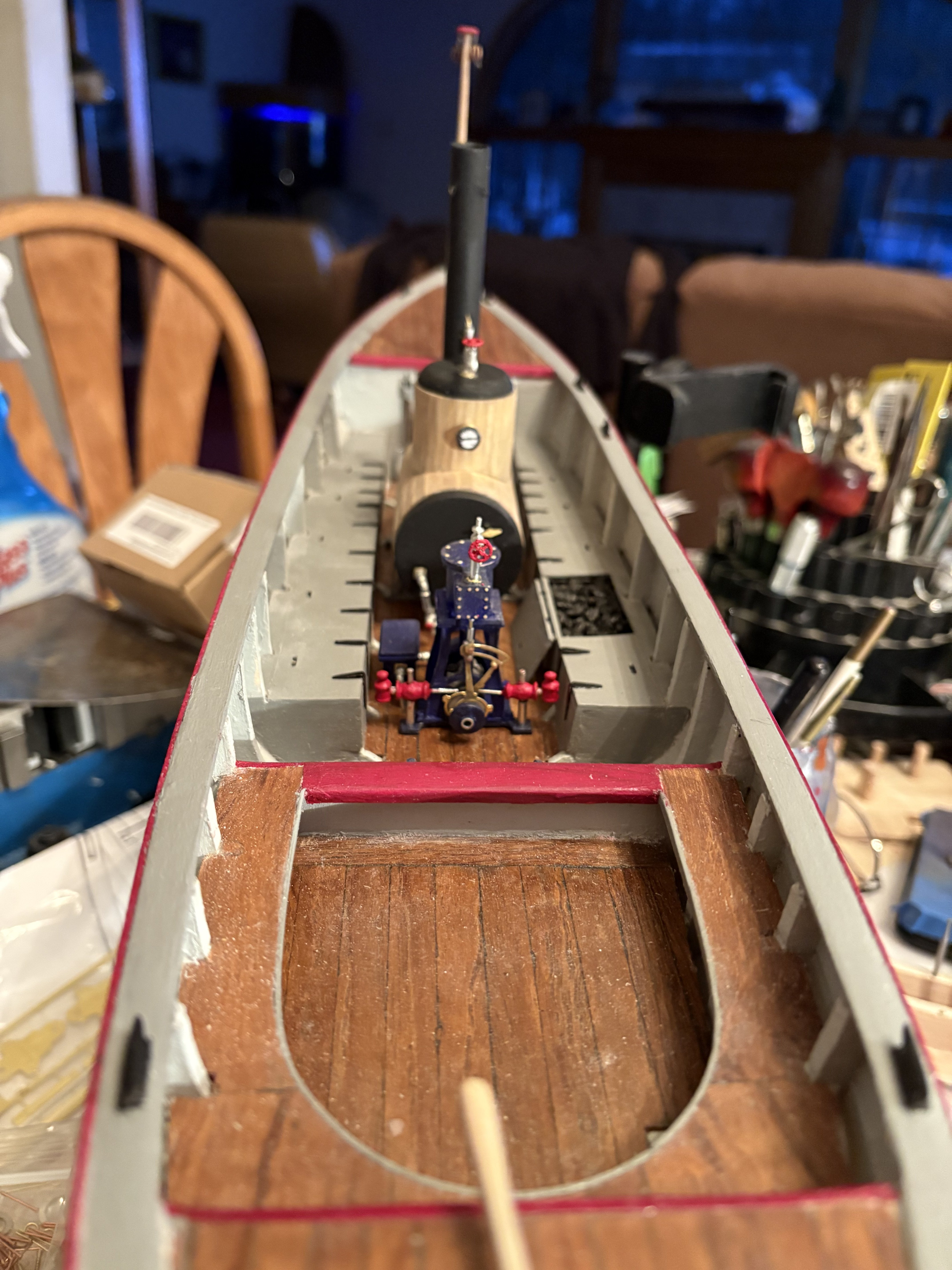

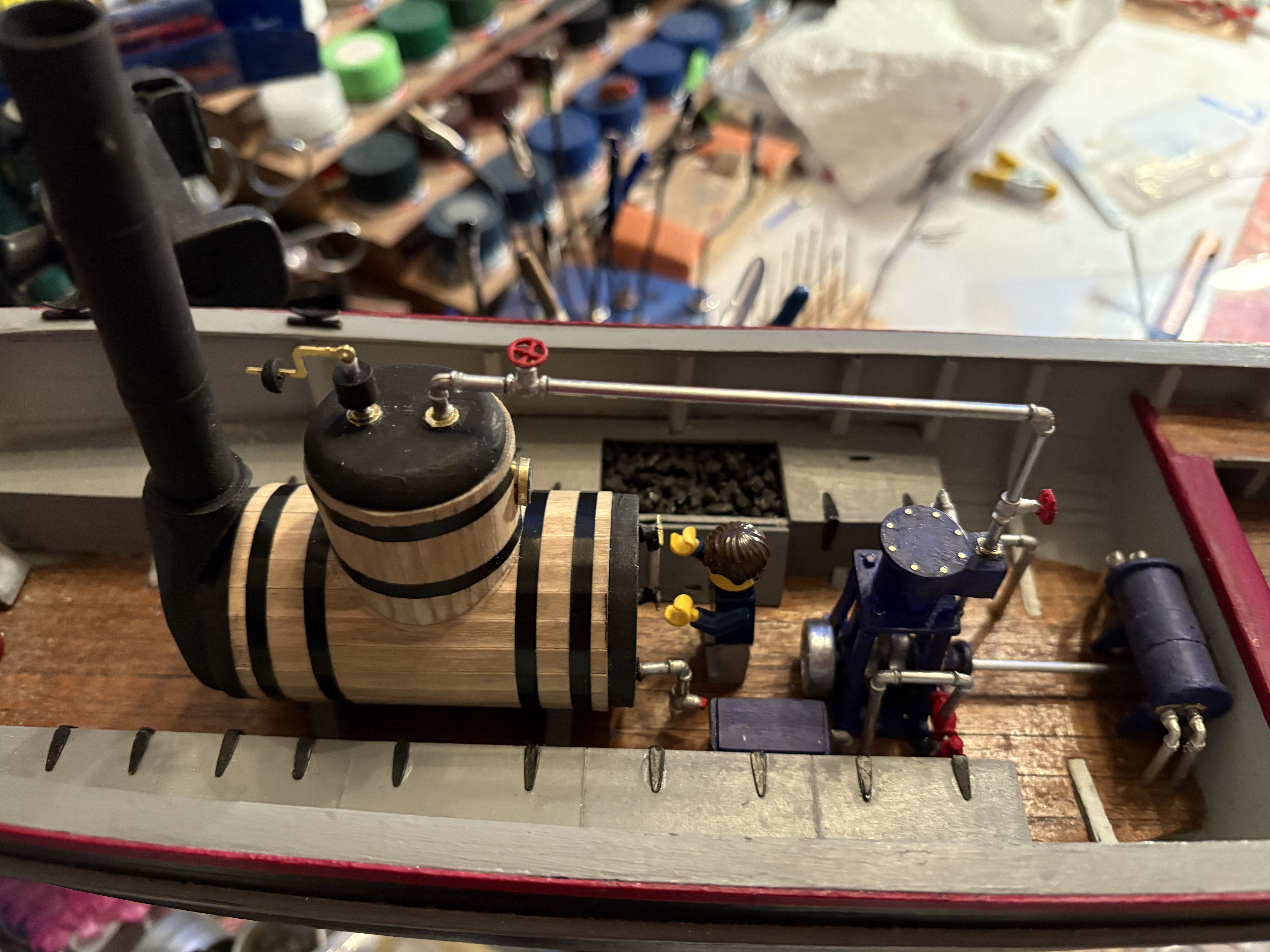

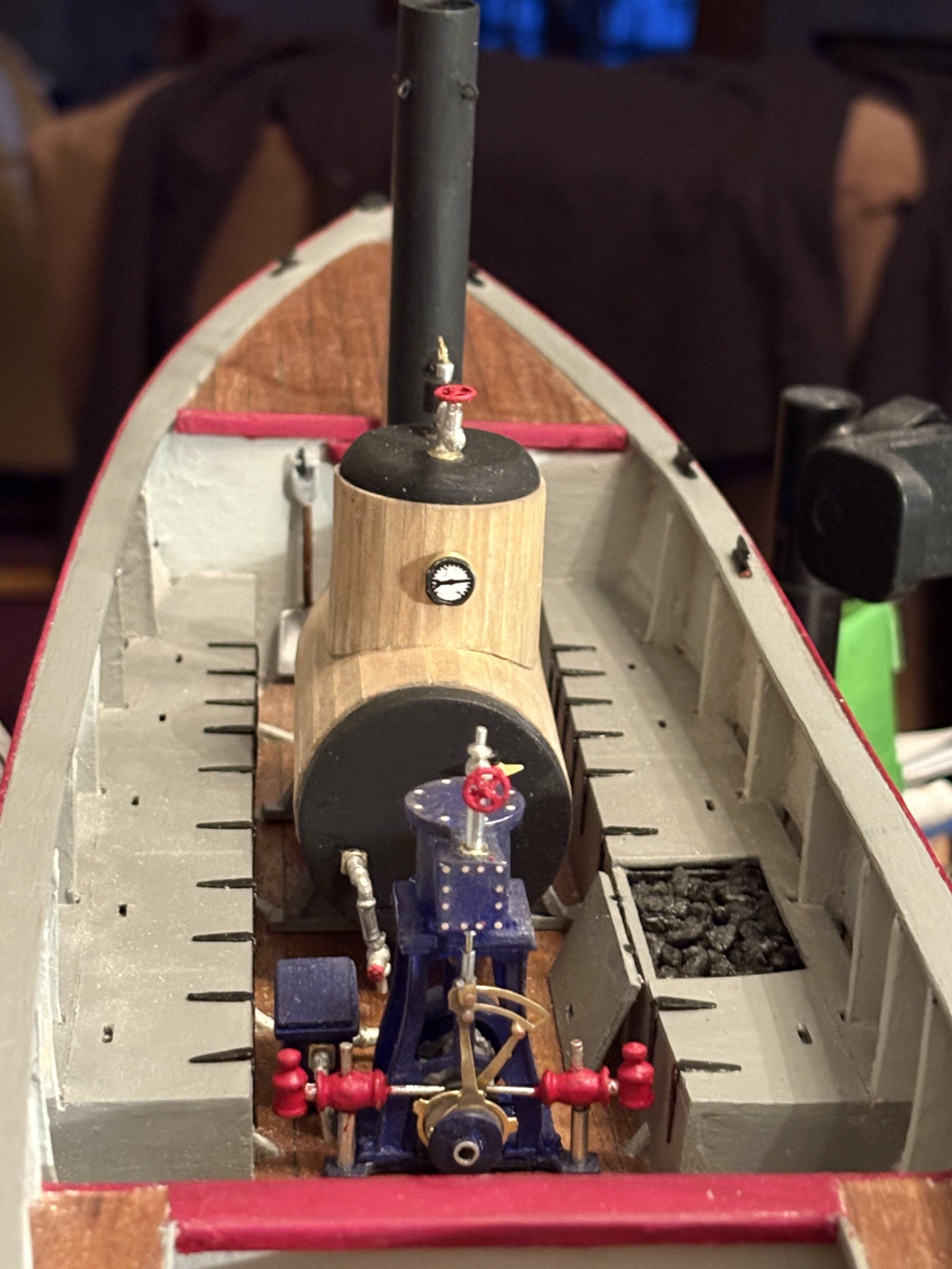

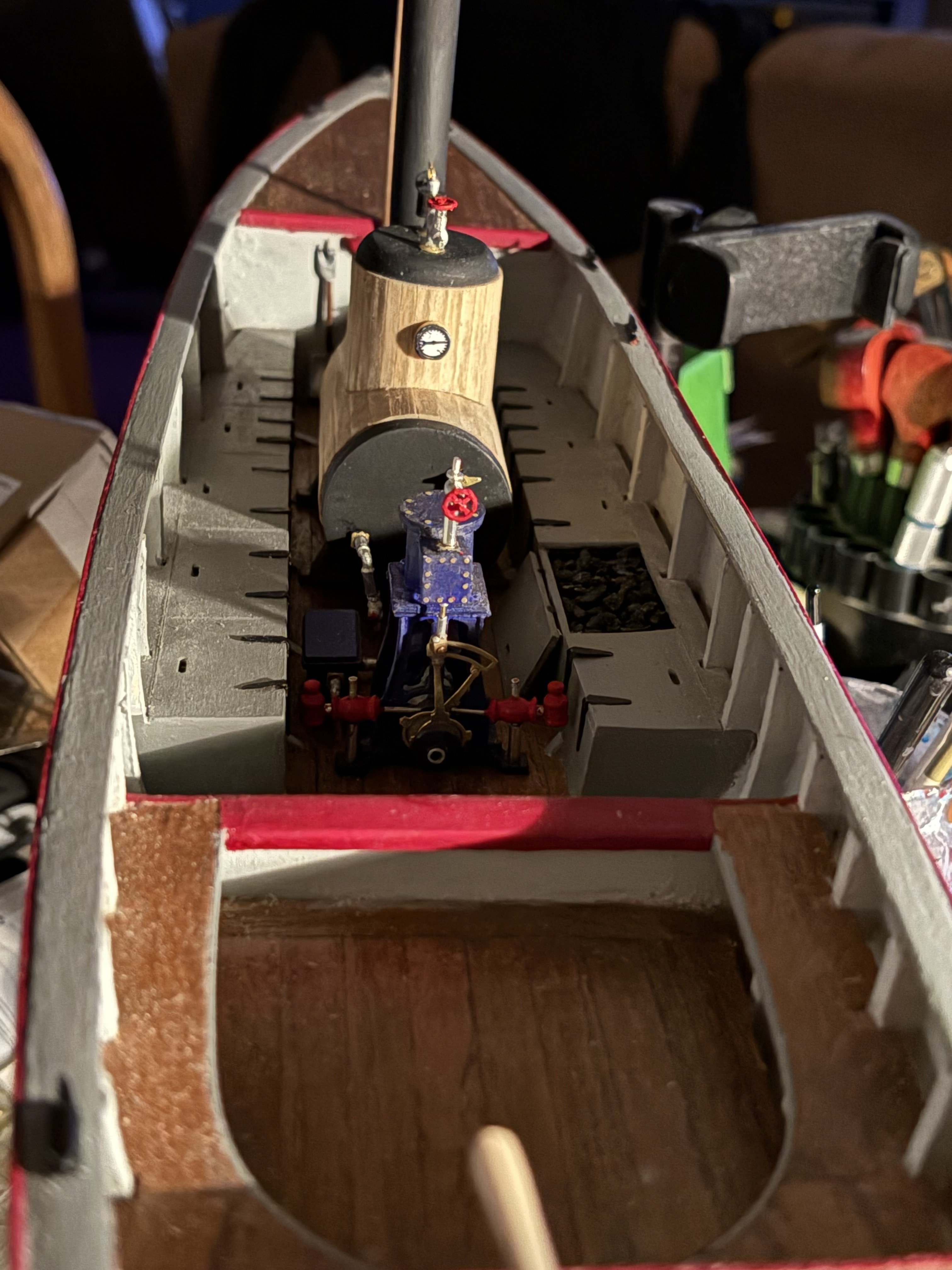

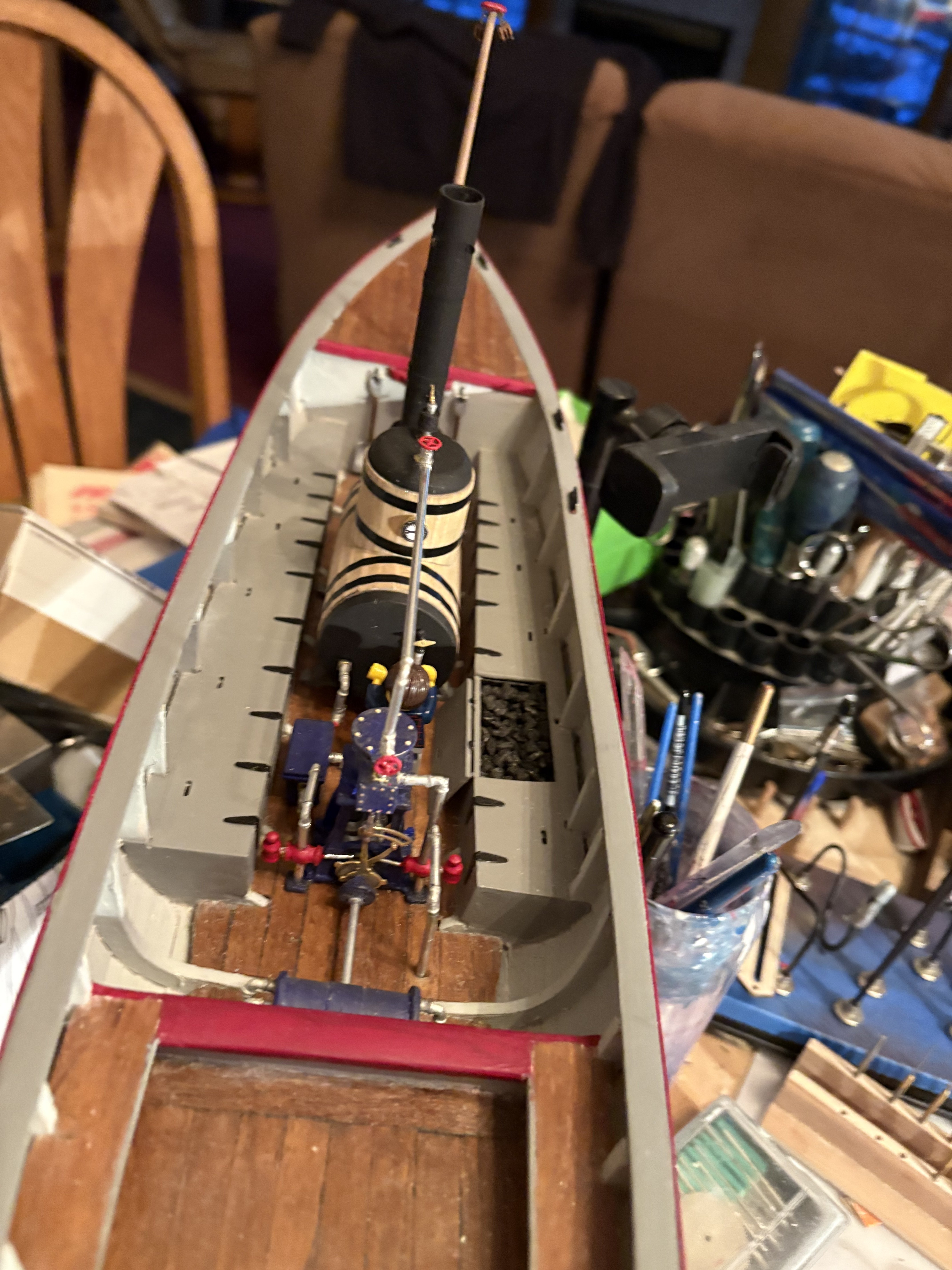

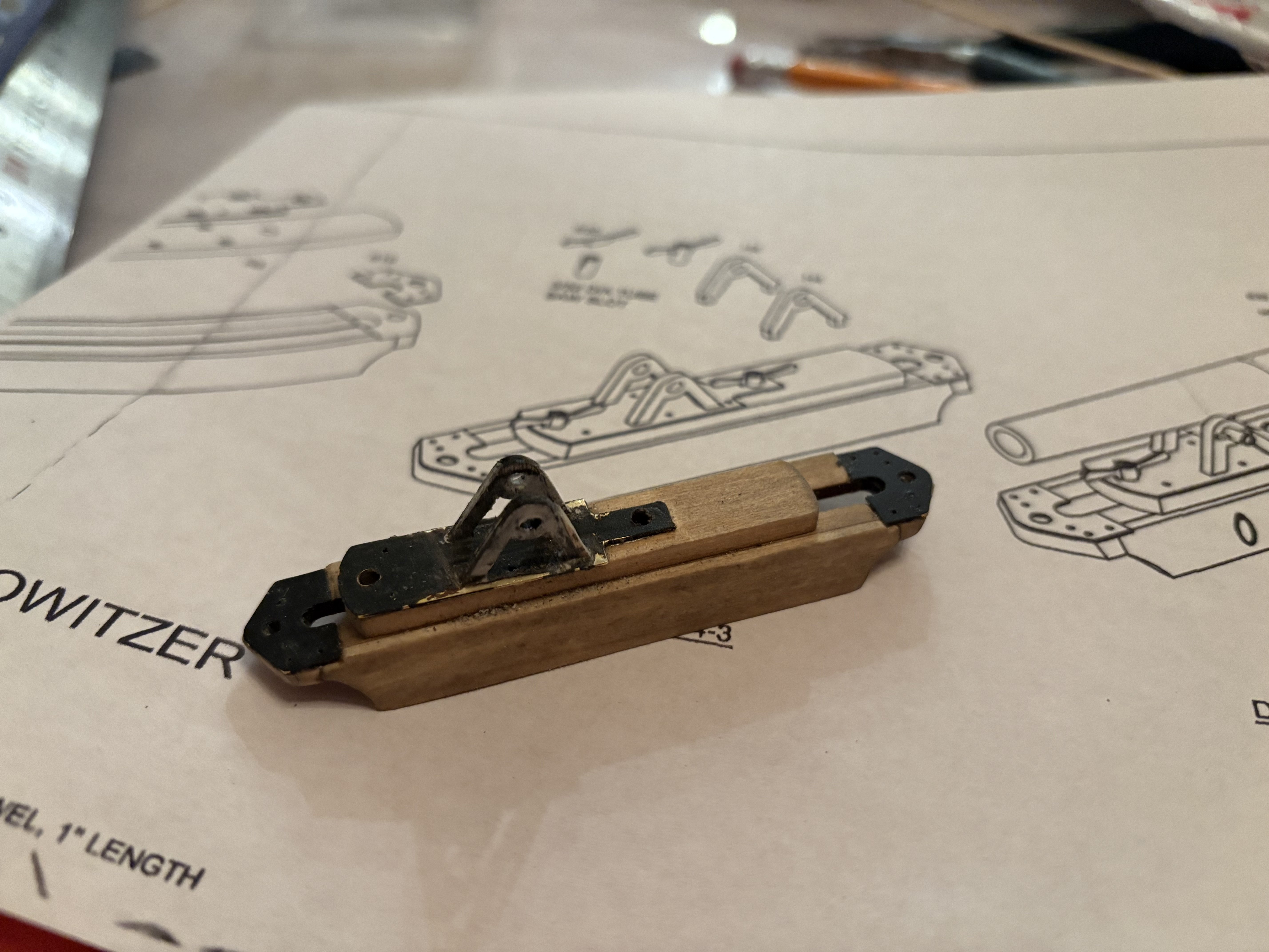

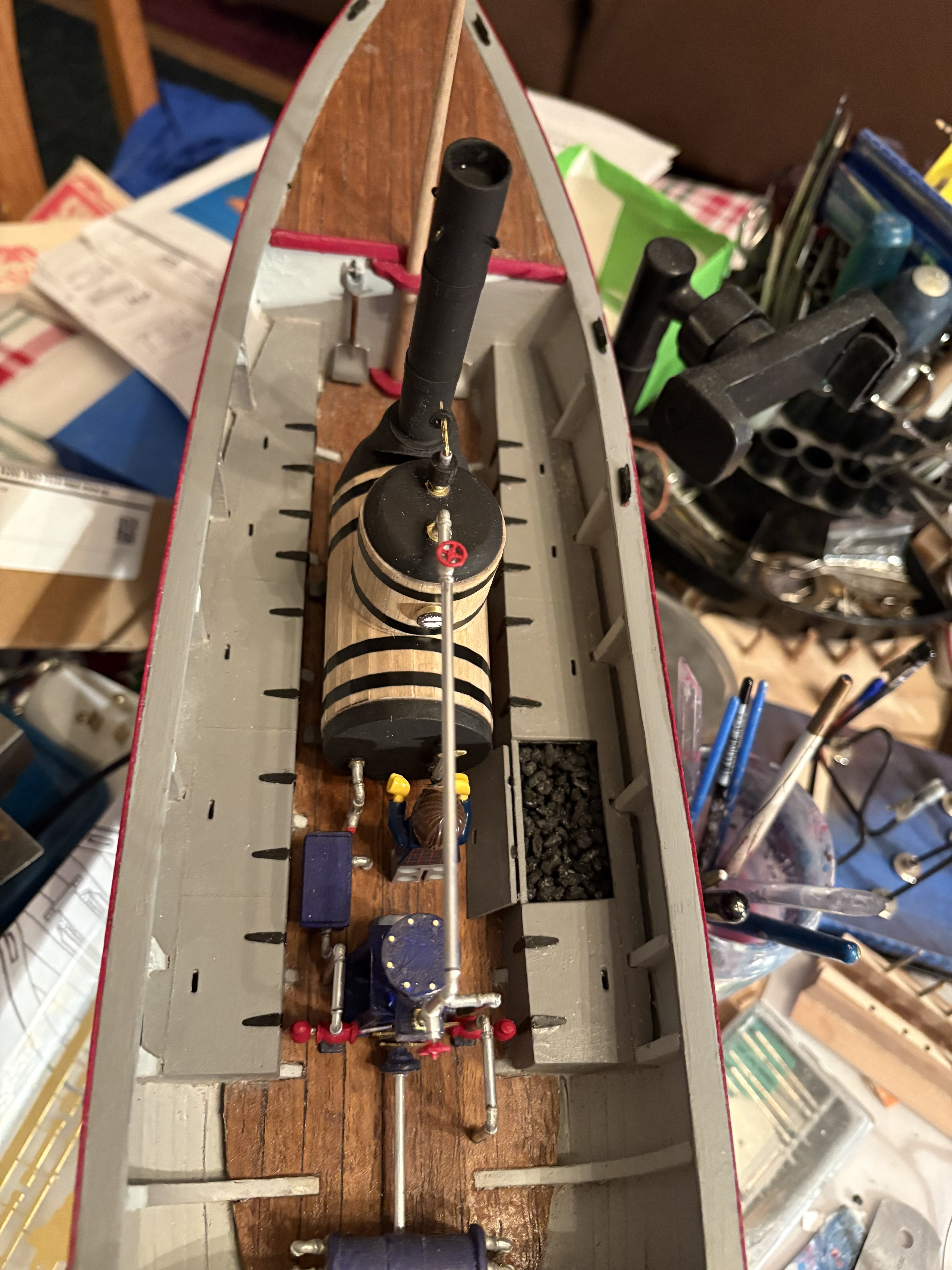

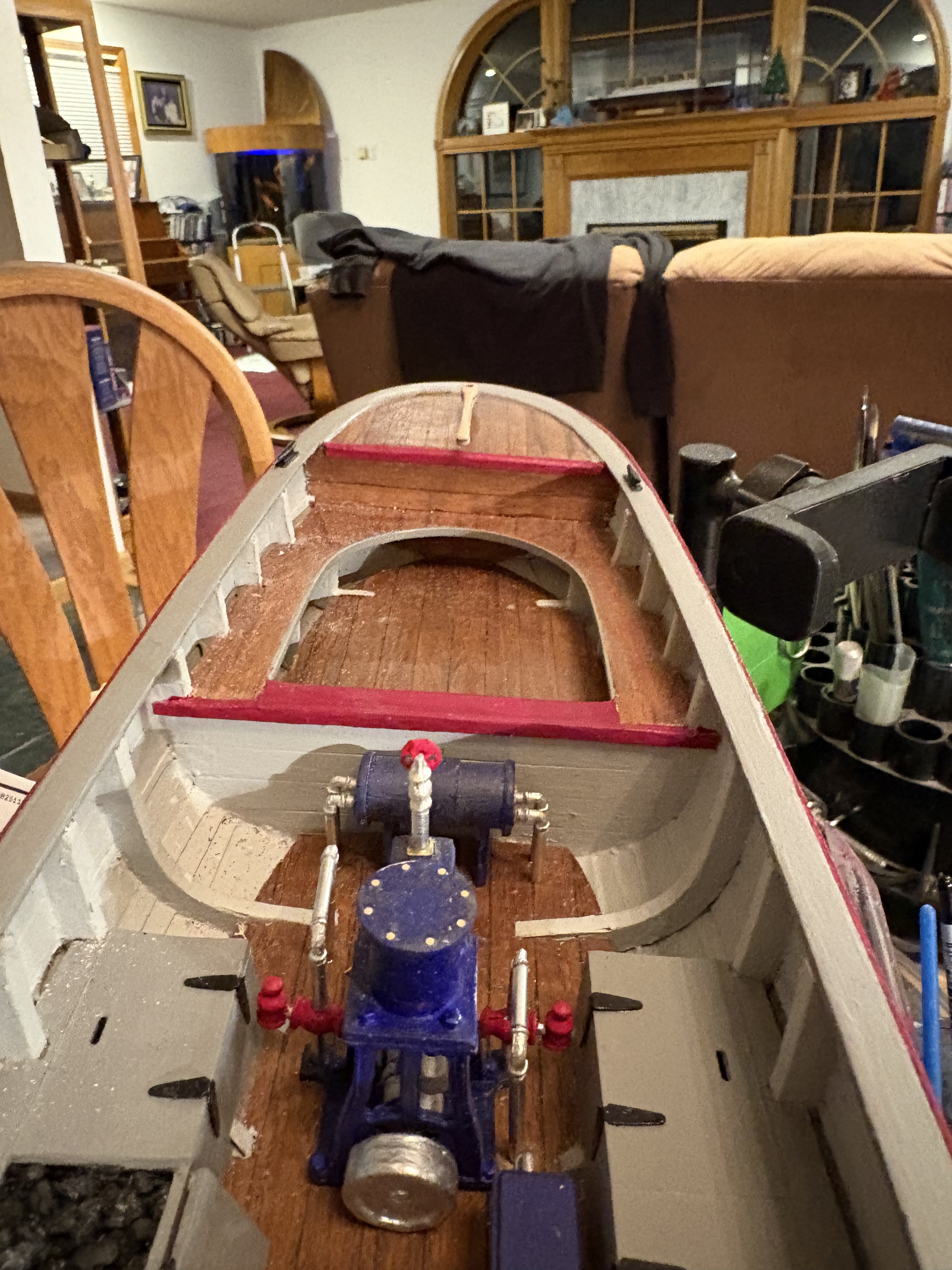

Been up most of the night and finally got the engine together. Starting it up for a test run. Granddaughter and I hoping to get out of port before the storm hits. It appears to run pretty good. While at sea today we need to arm the vessel with a cannon and torpedo to fend off sea PIRATES.
Until later at sea. Best Rick
