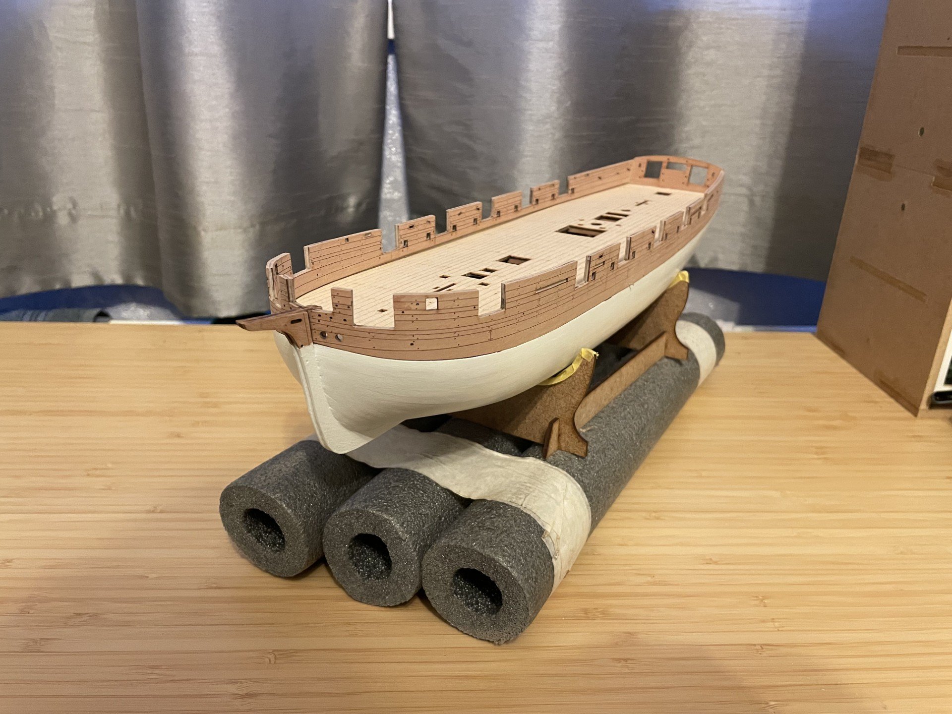

Here is Adder where she currently stands. Any and all advice is welcome.

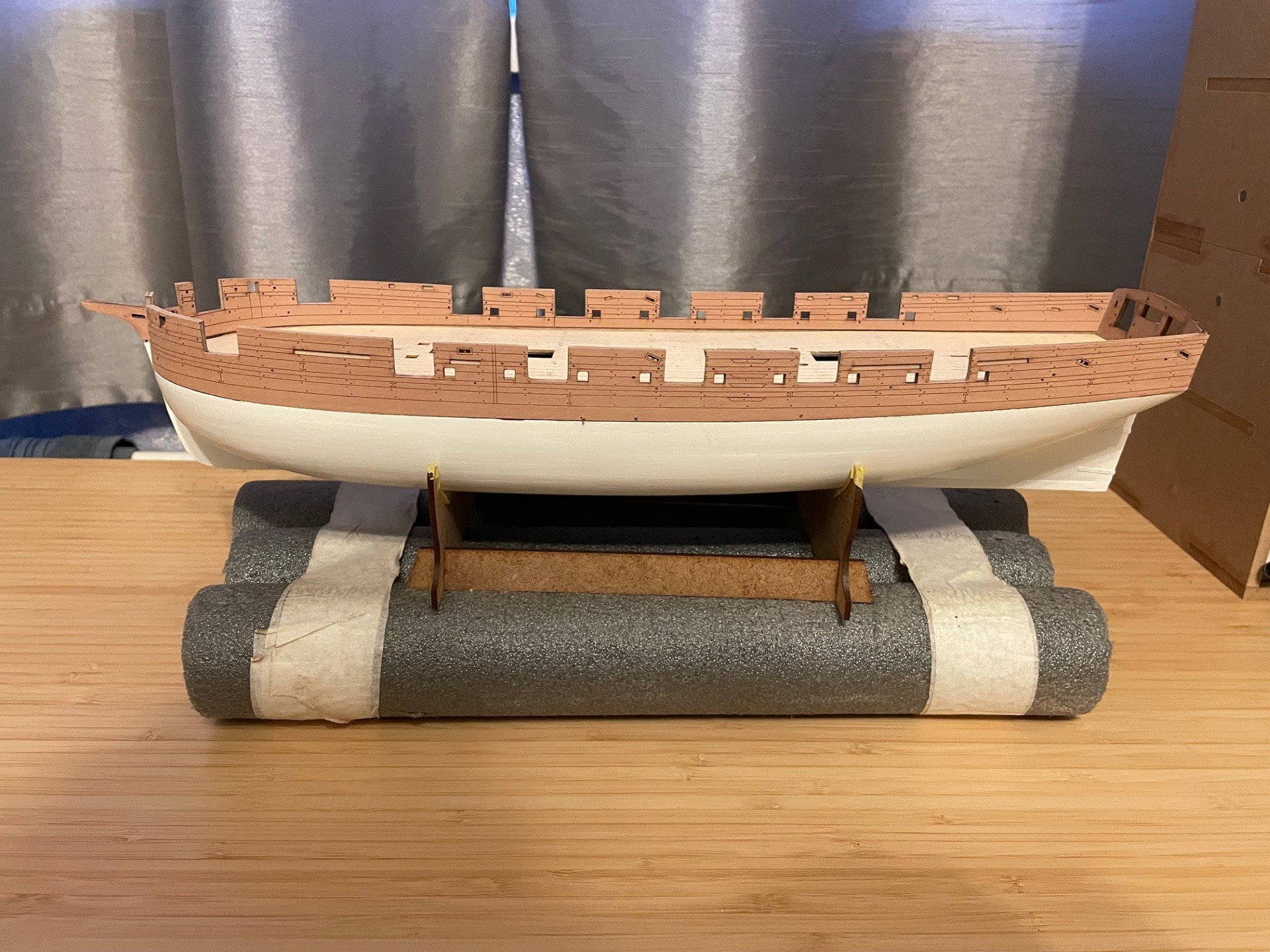

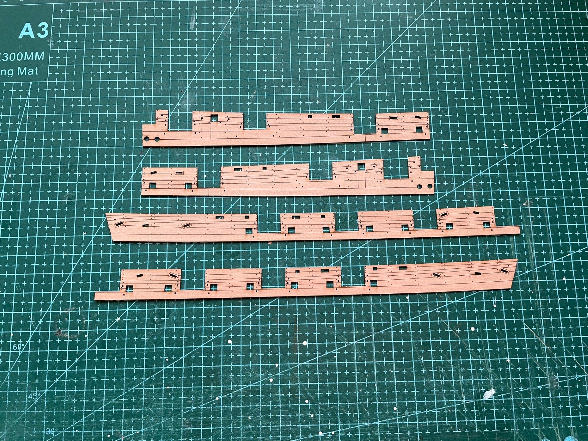

Bulwark patterns have been glued in place with watered down PVA (Occre PVA). After 24 hours, I removed all bulkhead tabs and sanded down using 240 grit sand paper.

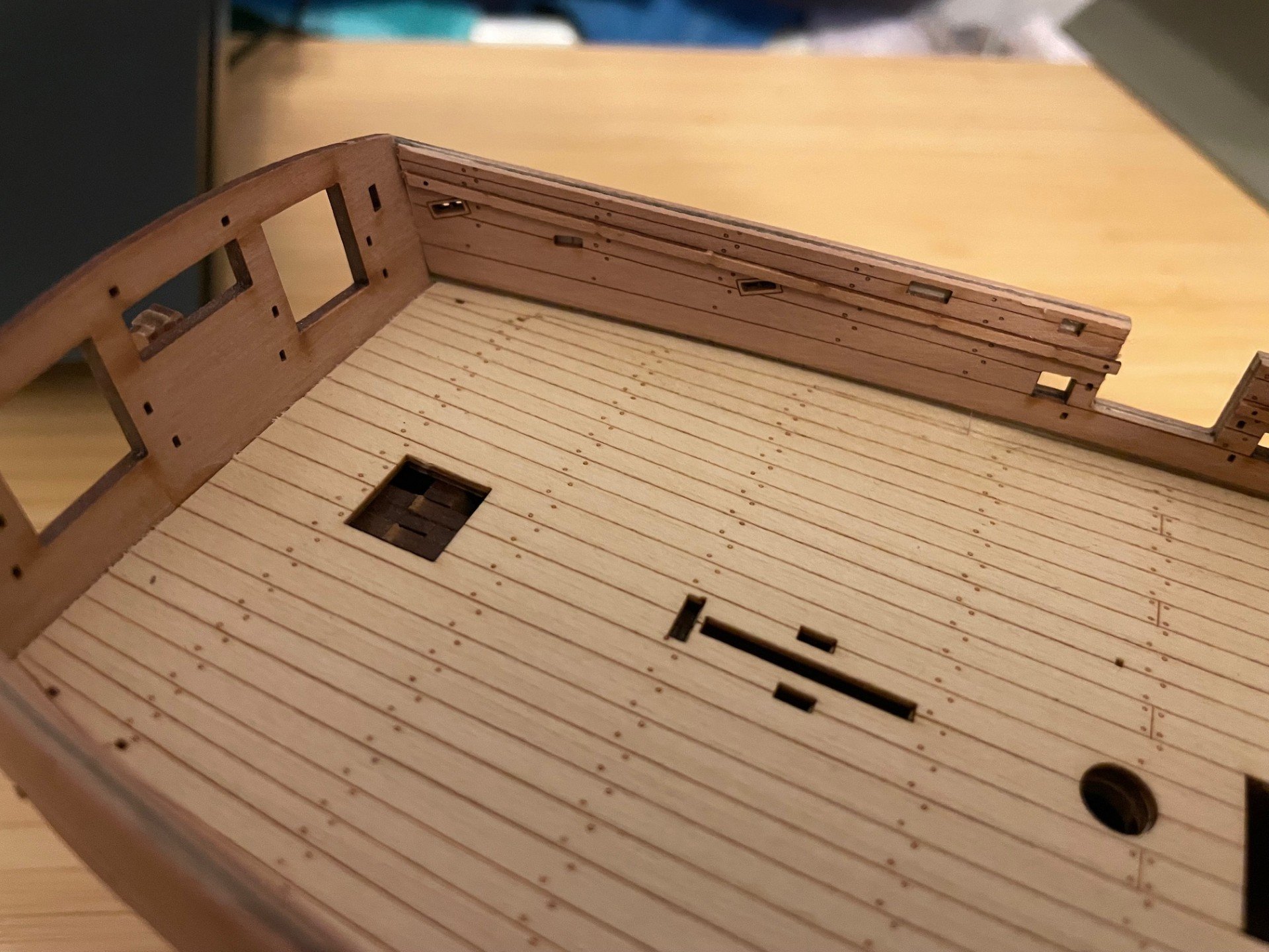

Using a tip from @Glenn-UK build log. I made a template of Adders deck to check the fit of my engraved deck.

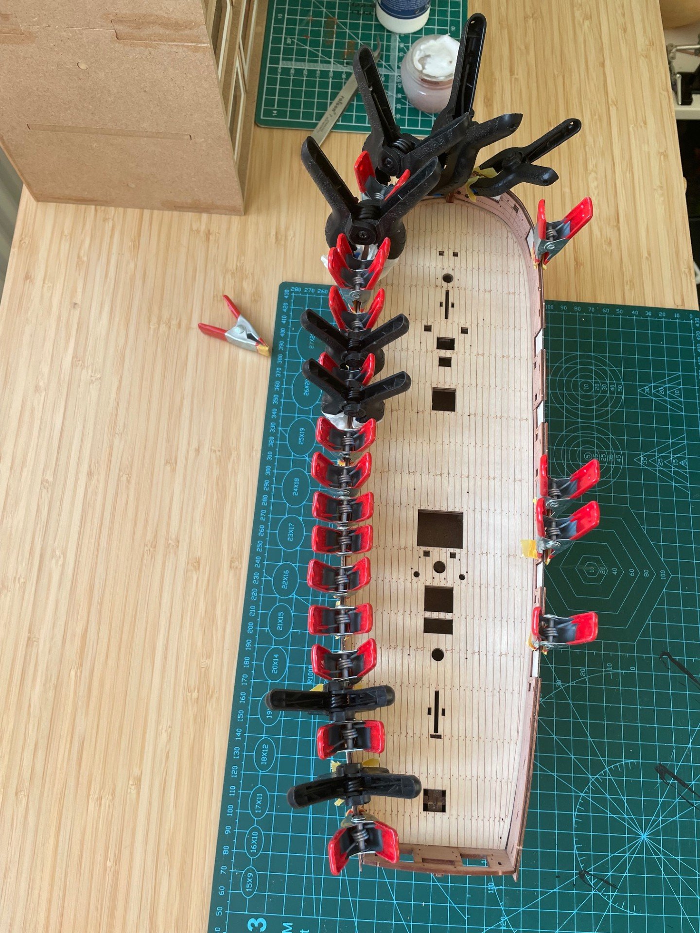

After adjusting the engraved deck, I then glued (PVA) and clamped it in place.

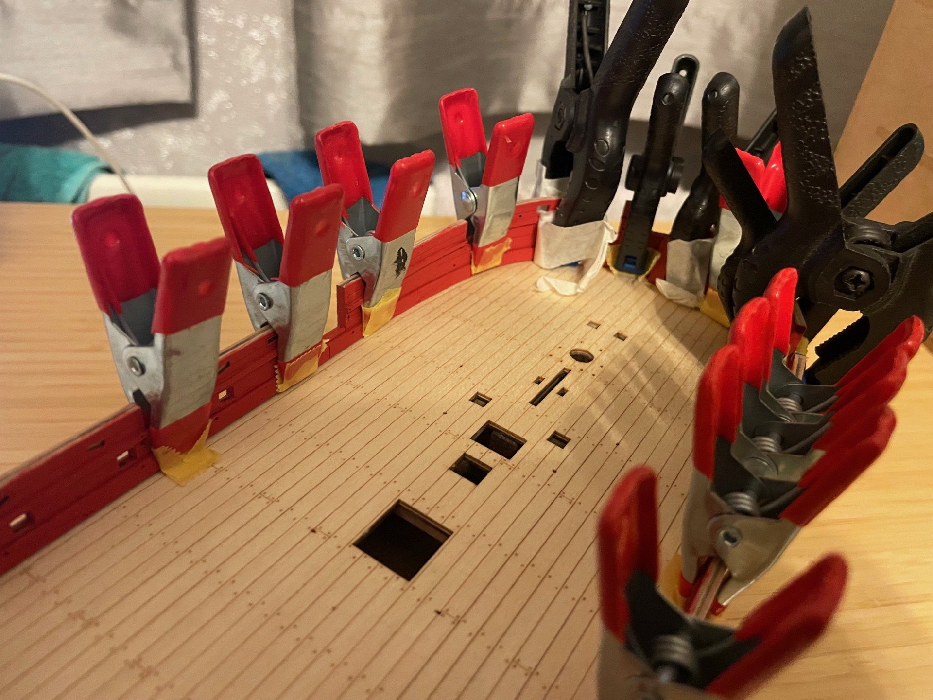

Bulwark patterns glued and clamped in place for 24 hours.

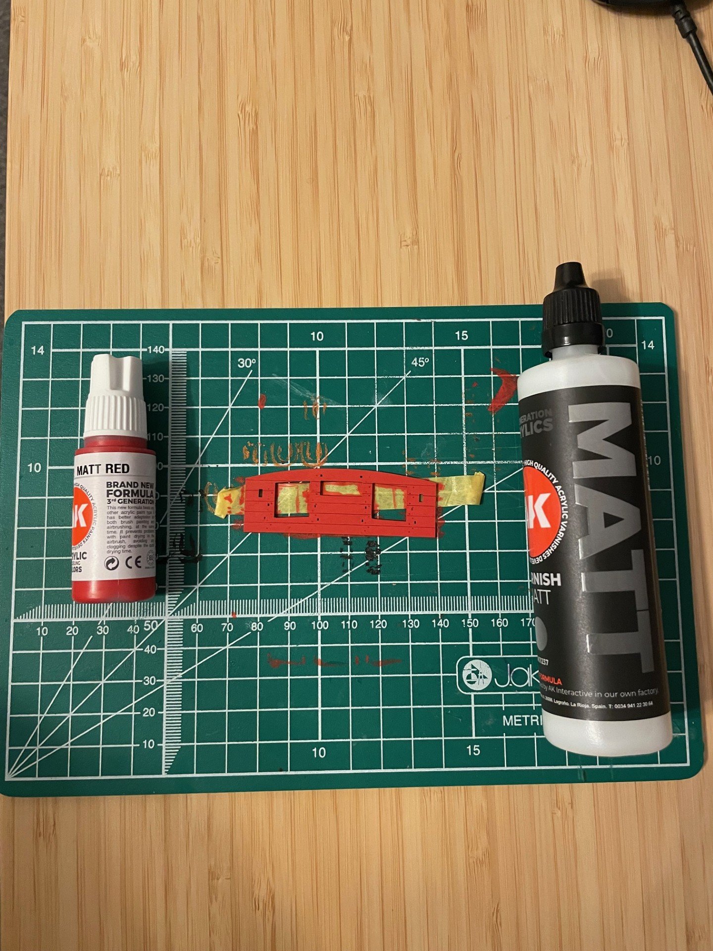

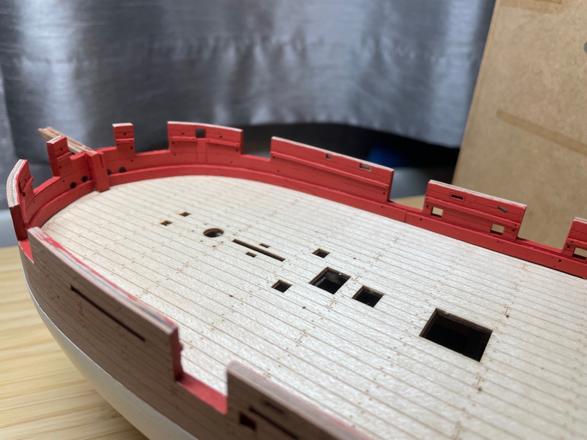

Inner stern board. This piece was given a coat of AK Interactive Matt Varnish. It was then given 3 thin coats of AK Interactive Matt Red.
MISTAKE 1 - I then fitted the inner bulwark rails with PVA glue. This was my first mistake, as I should have fitted the inner stern board first. Luckily, I was able to rectify this with some careful cutting with my knife. I did debate trying to work the inner rail off with warm water but was worried about warping or staining the inner bulwark pattern.
The inner spriketting patterns were given a coat of varnish and then given 3 thin coats of Matt Red. They were then glued to the bulwarks and clamped in place for 24 hours.

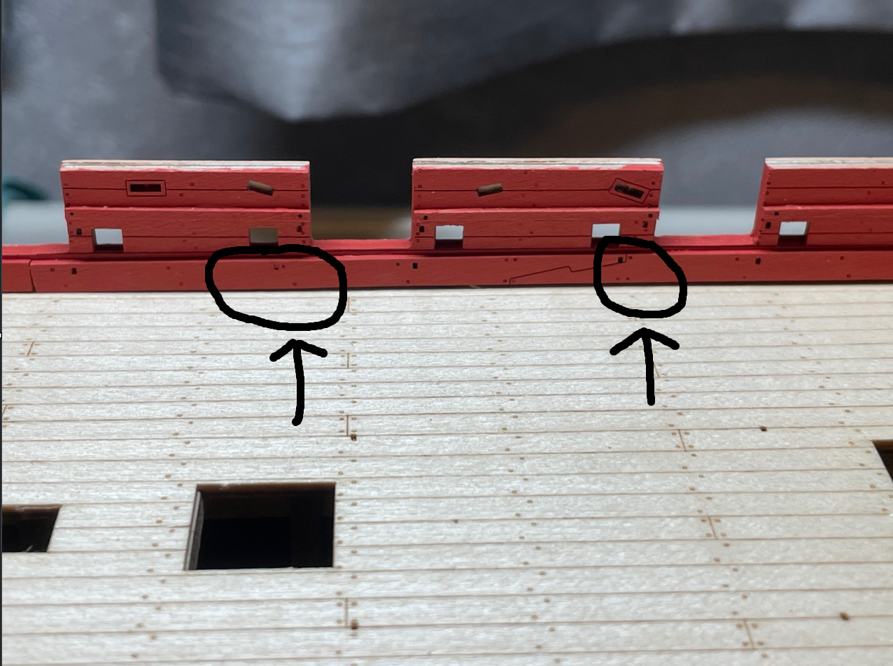

Mistake 2 - After removing the clamps, I noticed that the eyebolts on the starboard side spriketting pattern did not match up. This is nothing to do with the kit and everything to do with me sanding down a piece without double checking the alignment. I will rectify this by filling the misaligned eyebolt holes and using my pin vice to make ones in the correct position.

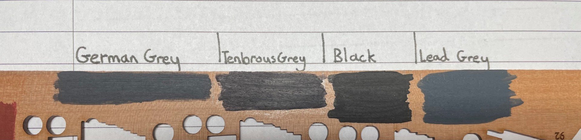

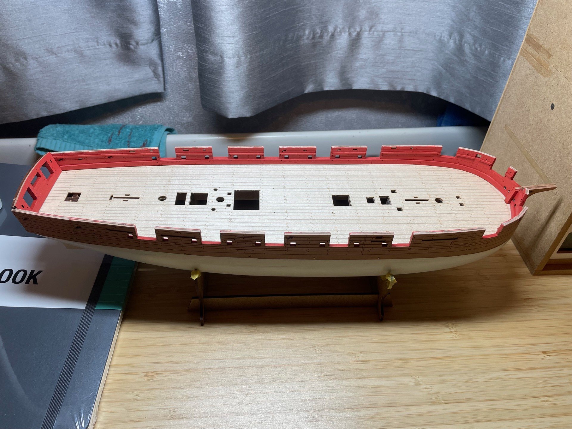

This is how adder looks as of now. Next up will be adding the wales after settling on a colour of black that is to my liking. Below is a test strip of the various blacks in contention. Currently I am inching towards German Grey. All the colours shown are from AK Interative.

I'm next up to use the AK matt red; curious about your experience as I tend to have trouble with AK paints and use Tamiya 99.9%.  Did you thin (I'm reading 50-50 recommended for airbrush), and by how much and with what?

Interesting you are experimenting on the various blacks to use.
I have used "Tenberous Grey" on my HMS Bounty I'm building now; it has a nice warm tone to it that I think suits wood.  Also used the "Smoke Black" and "Rubber Black" from AK which can be used for surfaces that receive good illumination to provide some contrast to the more standard dull blacks.

With regards to the Matt Red. I did thin the paint with a 50/50 water to paint ratio. The piece to be painted was given 3 coats. Prior to that, I did also Matt Varnish the pieces to be painted. I used AK Interactive Matt Varnish. All painting was done by brush as well.

I have whittled it down to either Tenebrous or the regular AK black. I did apply German grey as a test to the wales, however this ended up looking to dull for my tastes. It seemed to have too much of a dull blue tint to it. Another idea could be mixing  my own black with a blue and burnt umber. Although I think this is delving far to much into the weeds.

First, I did thin 50/50 with water.  Worked a charm.  I think my previous (and very limited) lousy experience with AK must have been because I used ISO to thin, probably not bothering to check.  Anyway, it thinned nicely and went on so smoothly, I'm gobsmacked.

I am glad the AK Interactive paints have worked out for you. They seem to be a good acrylic paint range so far. I have ended up using the regular black for my wales now. It does look like a nice colour so far. I think for my next ship, I might still have a go at mixing my own though.
