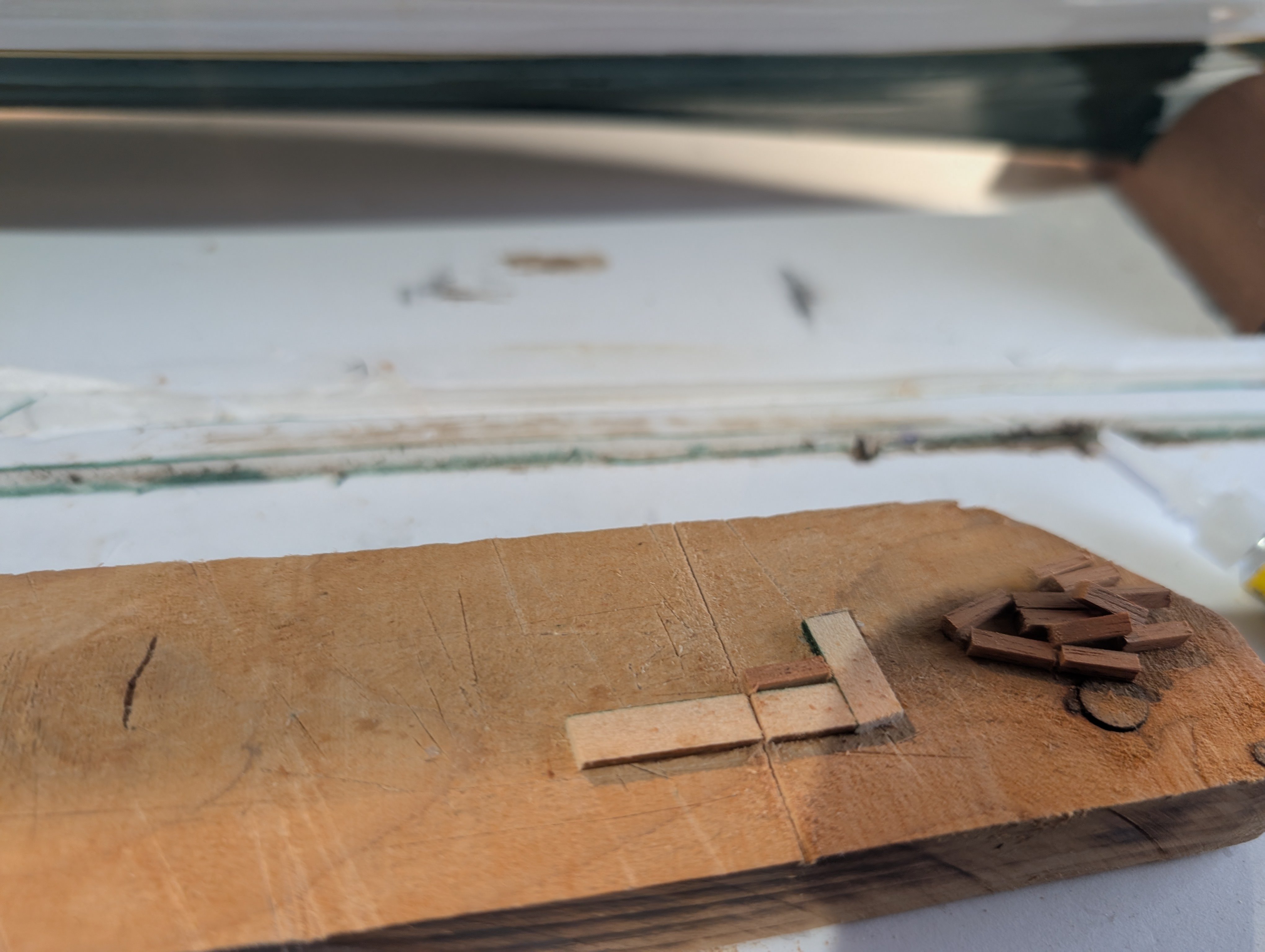

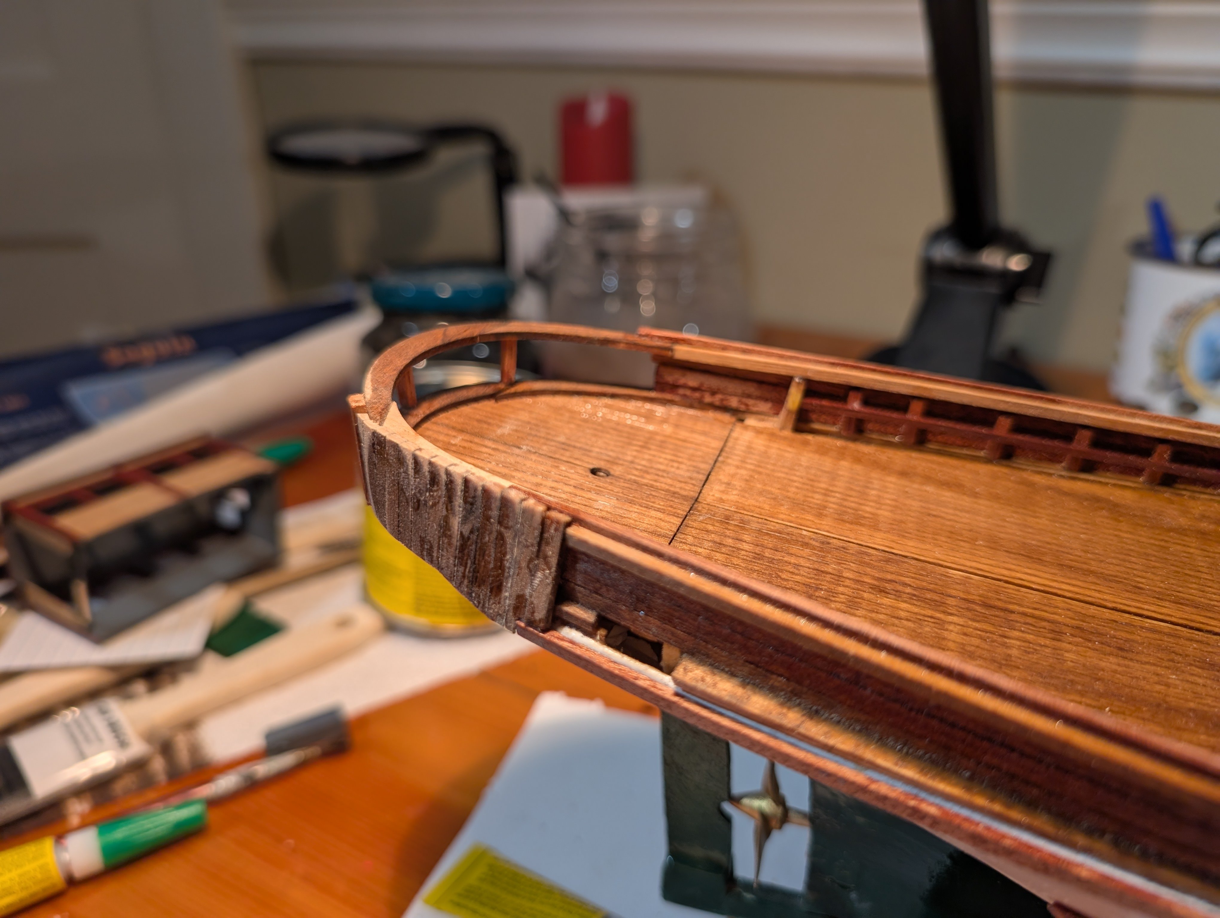

Started working on the transom. I was happy with the way the stern rail came out although I did have to cut it down a few mm. Started the vertical planking which I'm a bit iffy on but with sanding and cosmetics it should look alright.

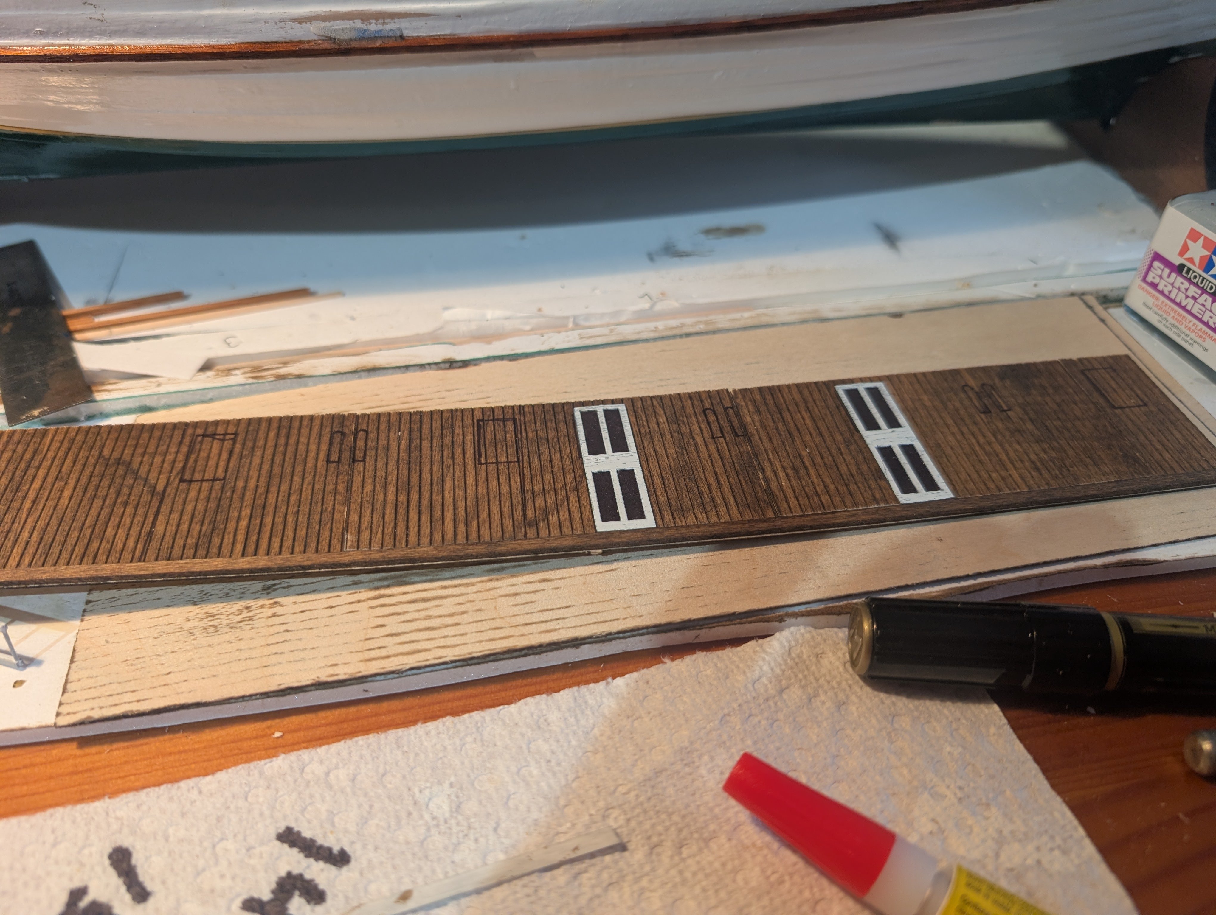

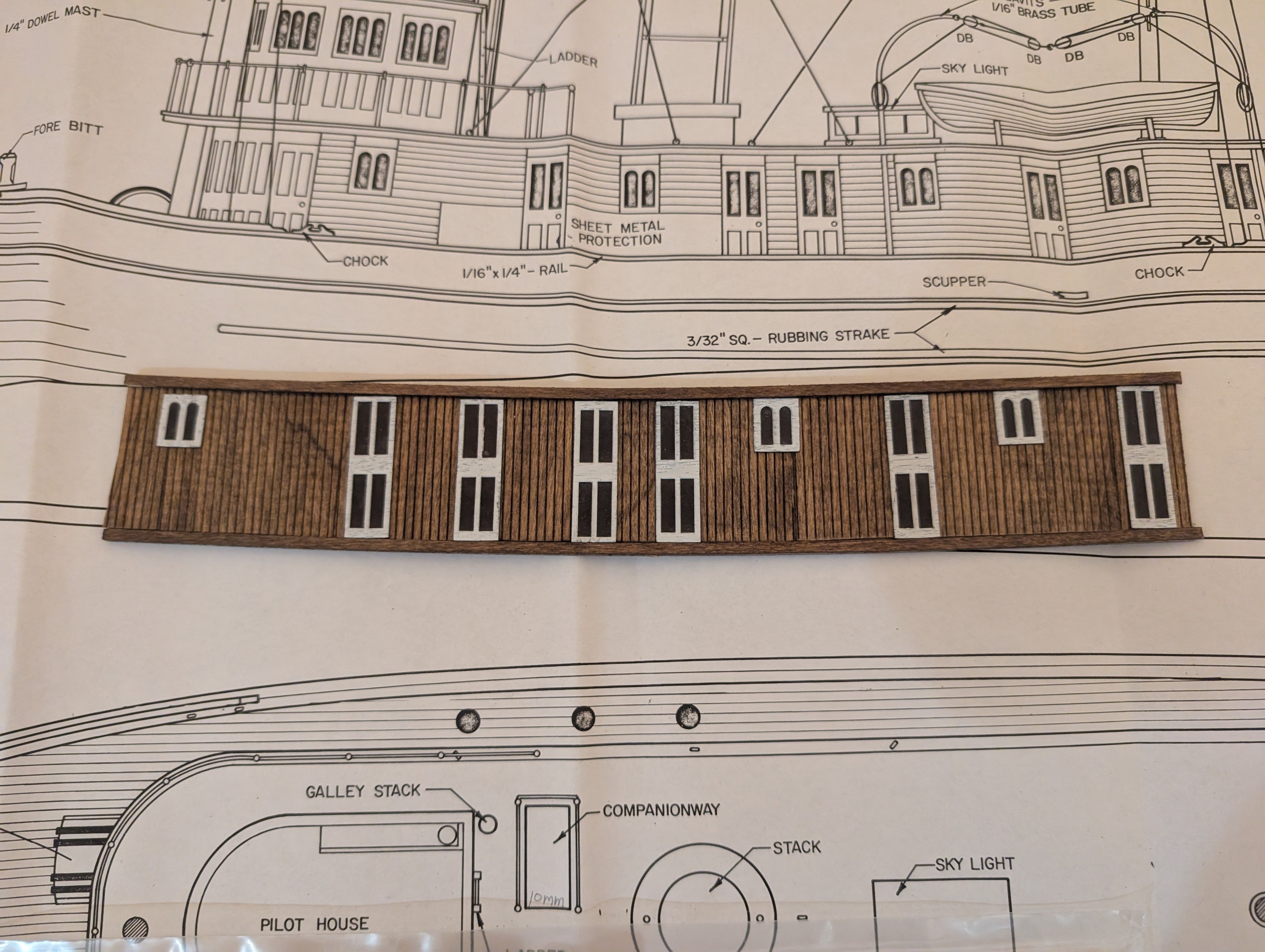

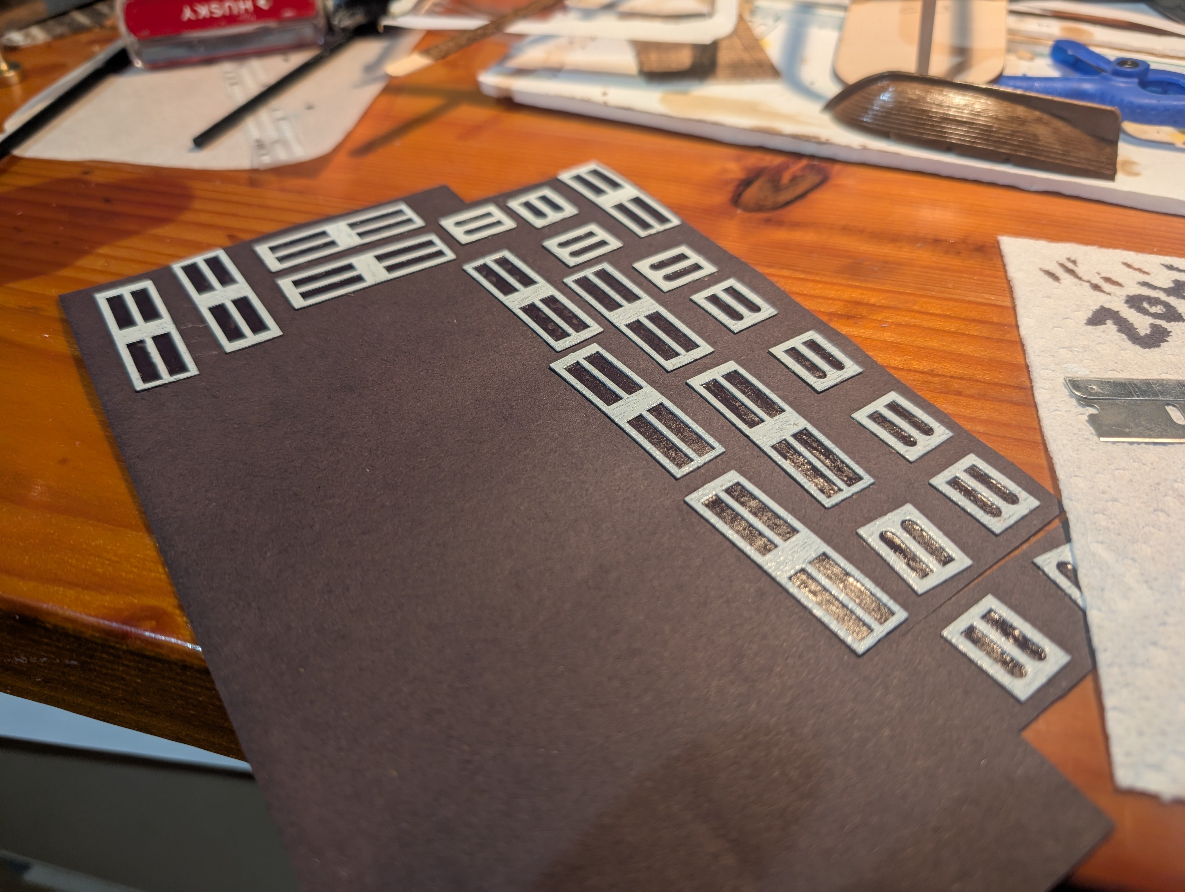

As a scratch builder/kit basher ( which is code for can not follow directions) I have taken a few liberties with the Seguin build. Installing the siding horizontally around the windows and doors on the deck house was more effort than I was willing to put in to it. Not only that, I knew the results would be dubious at best. So instead i installed the siding vertically, covering the laser cut window openings.
I glued black paper to the backside of the doors and windows. PXL_20251205_190553382.thumb.jpg.1547d63e7bad6c34abddff757b556bdc.jpg
When I needed a window or door I just cut them off the paper and glued them to the bulkhead.
I know its probably not historically accurate, but at least it got done.

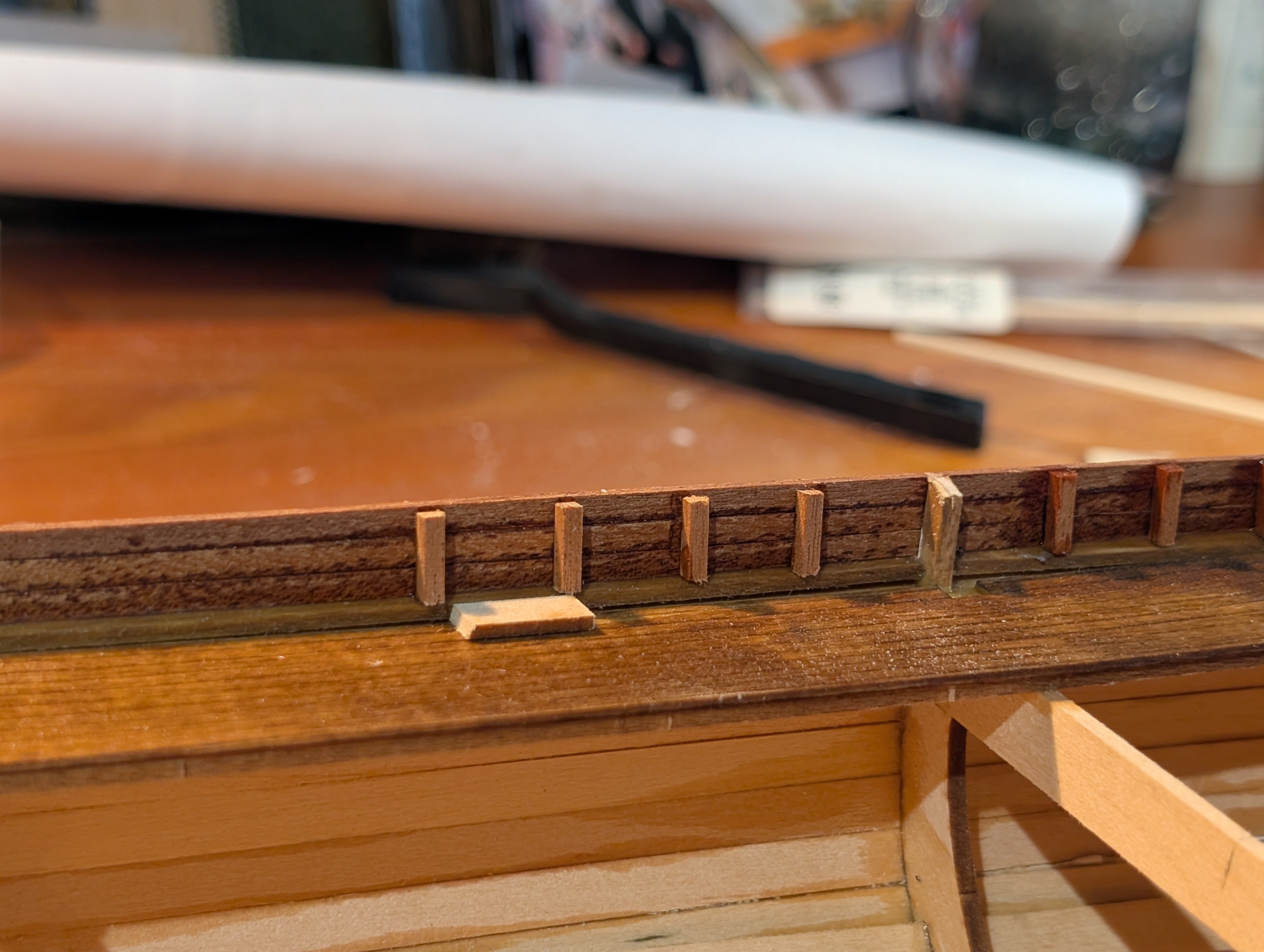

Taking a little break from the Seguin build (Big day coming et al). Gave me a good excuse to tidy up the work table. Took the opportunity to order some additional items. Decided to put scribed boards on the top deck rathers than just painting the bass wood. Also ordered nice brass stanchions from Harbor models.

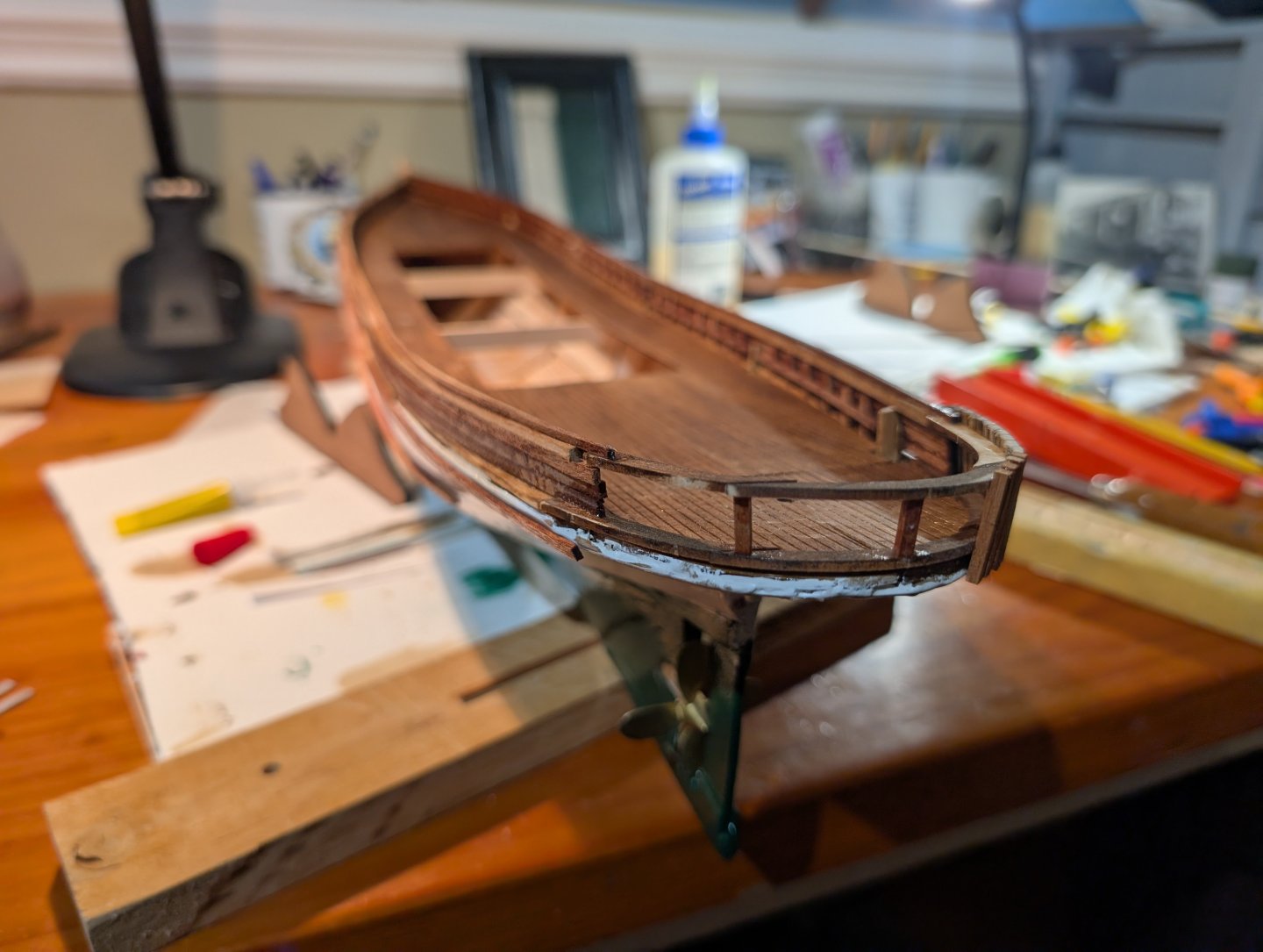

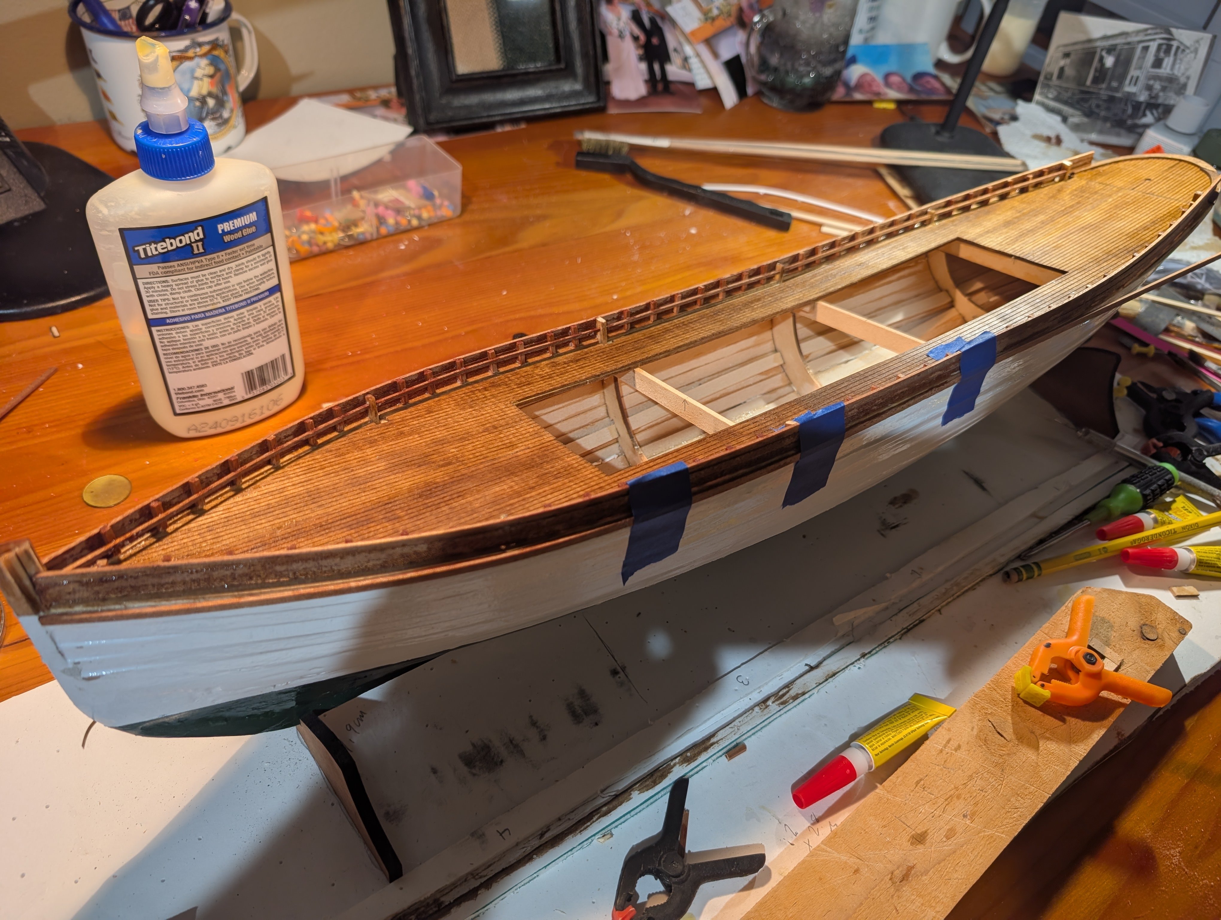

Here's a few more pics of the Seguin. While waiting for parts I mounted it on the oak base I made. The front pedestal is a little taller than the one in the back. I did it that way because the sheer makes it look like the stern is either to high or the bow to low if you use the same size pedestals.
  I added a length of Pactra gold trim tape at the waterline.
Little brass pins worked for door knobs.
