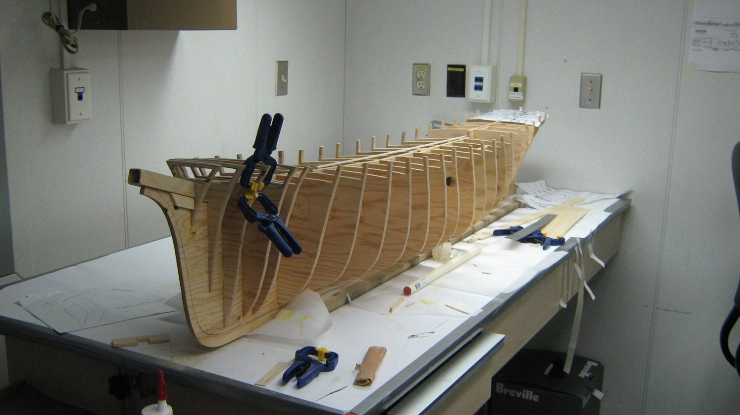

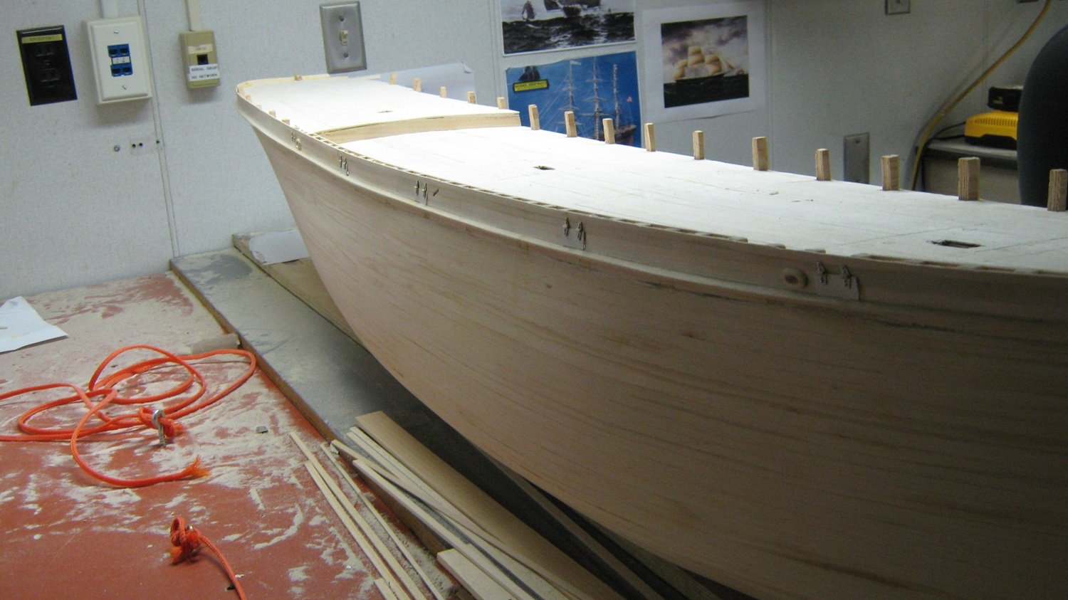

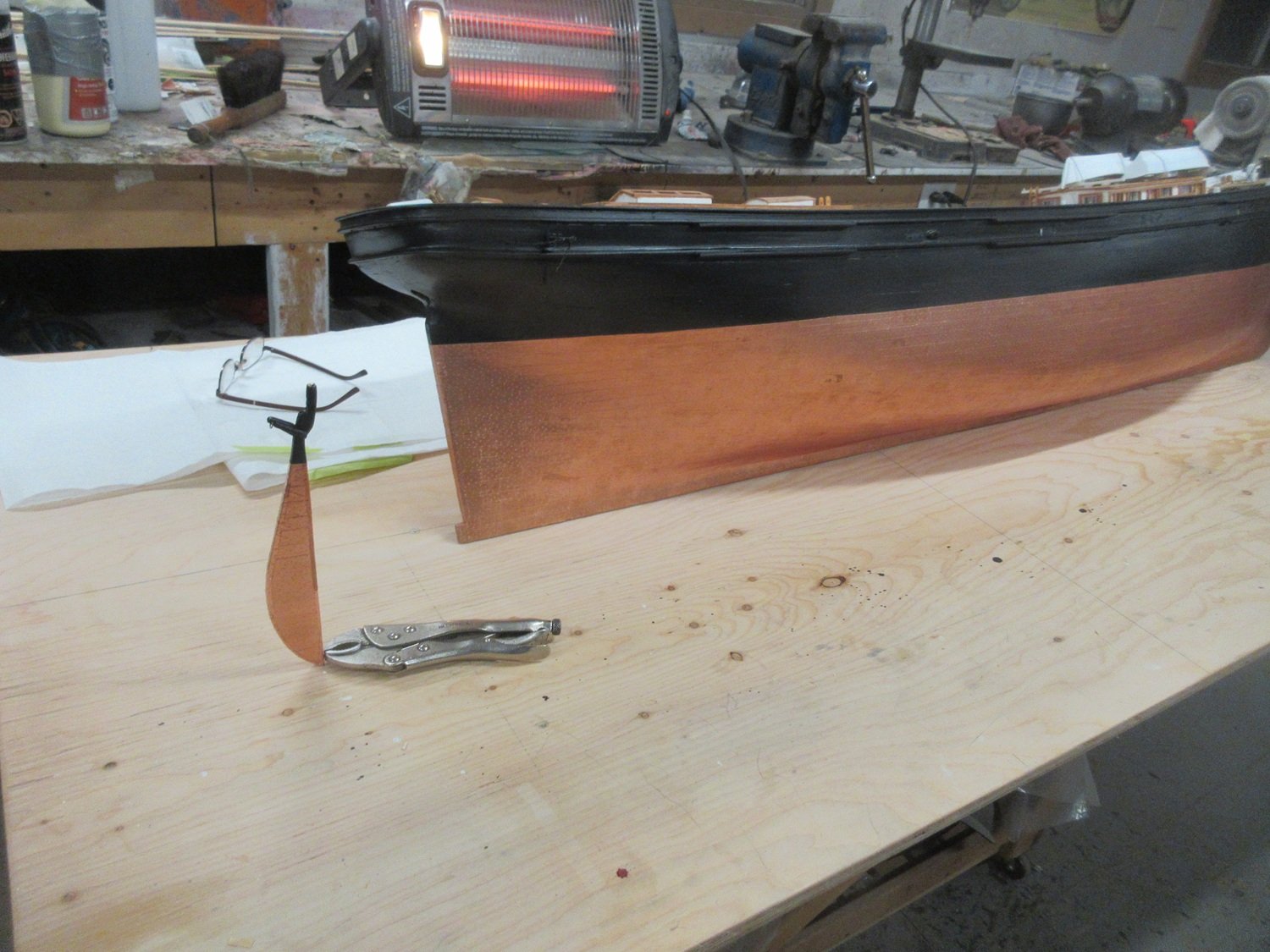

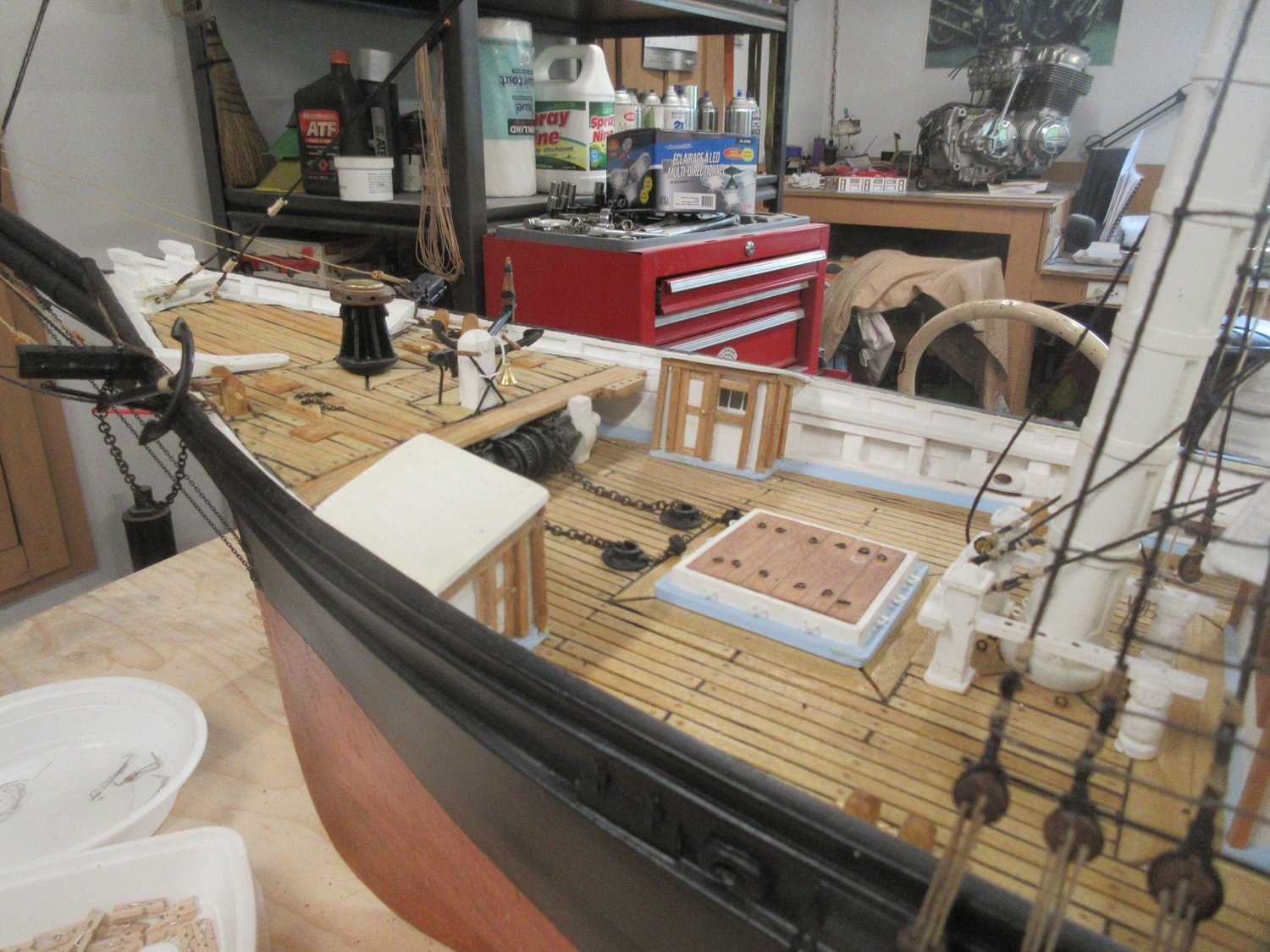

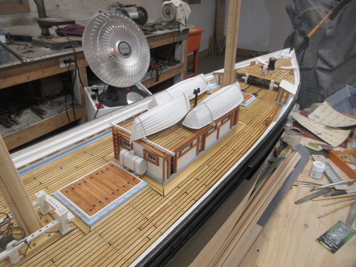

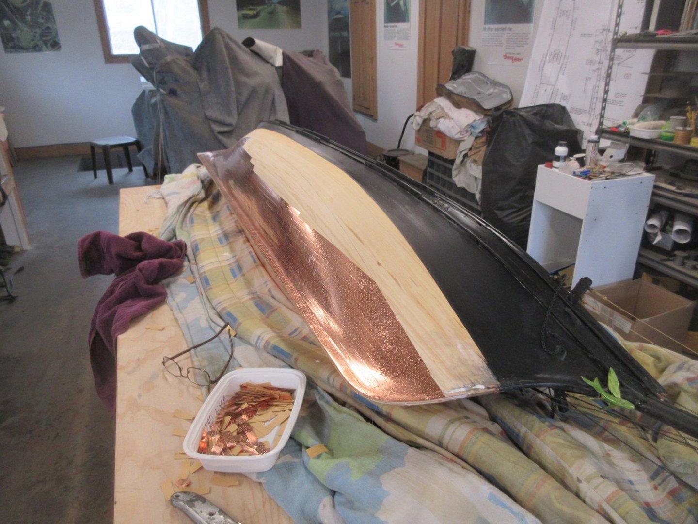

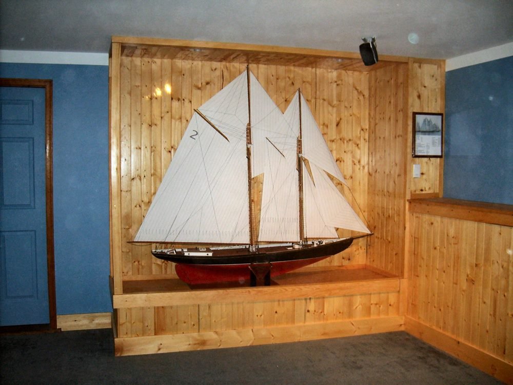

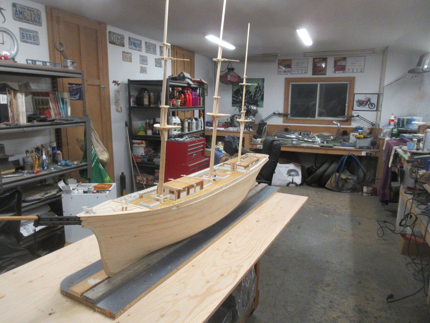

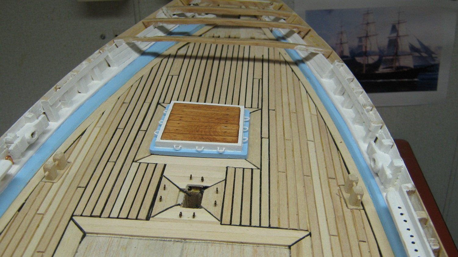

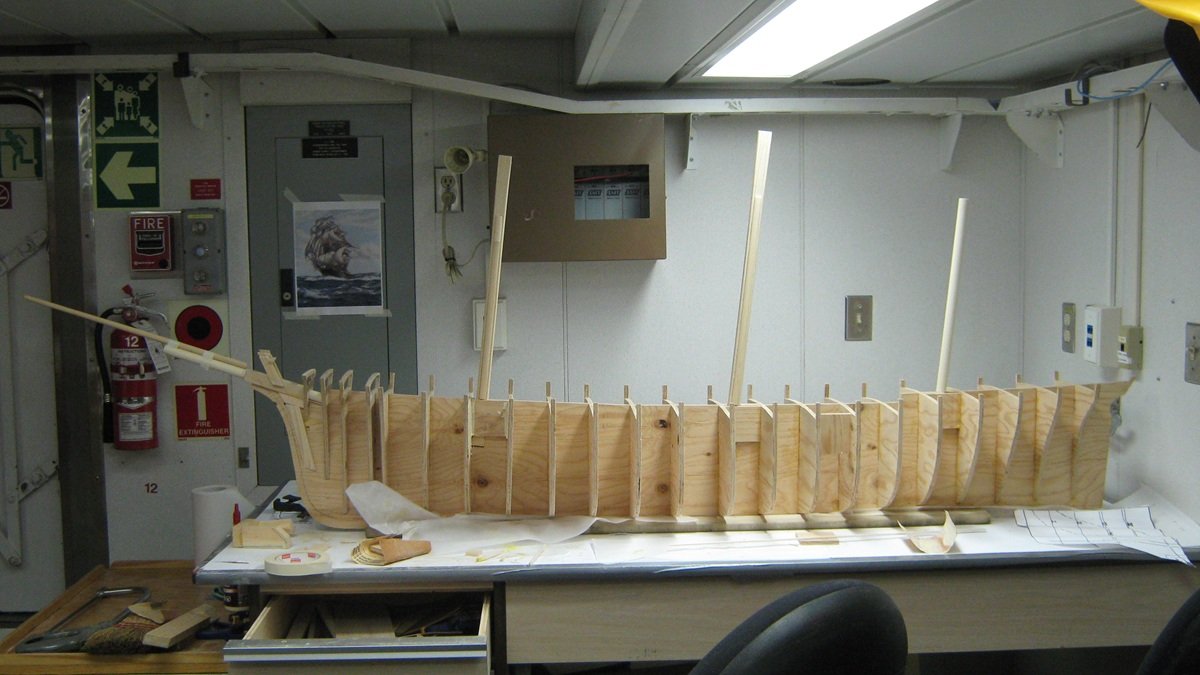

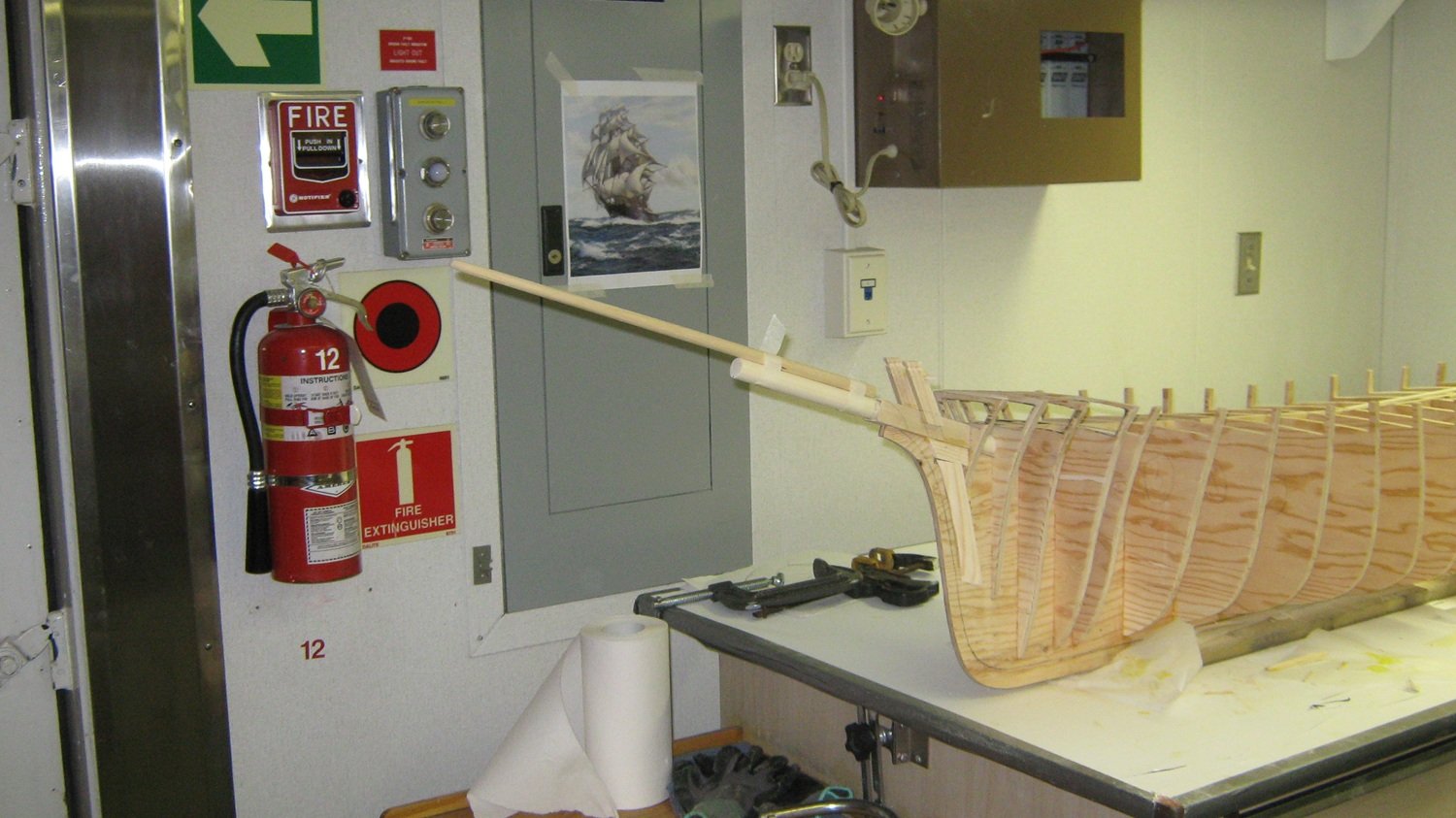

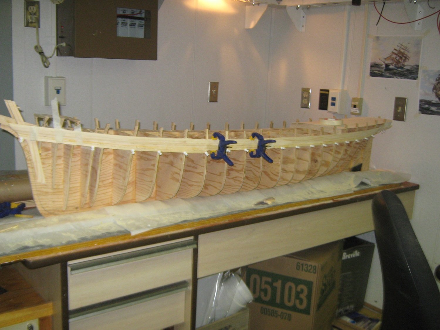

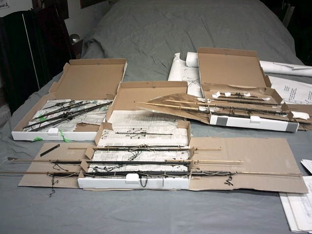

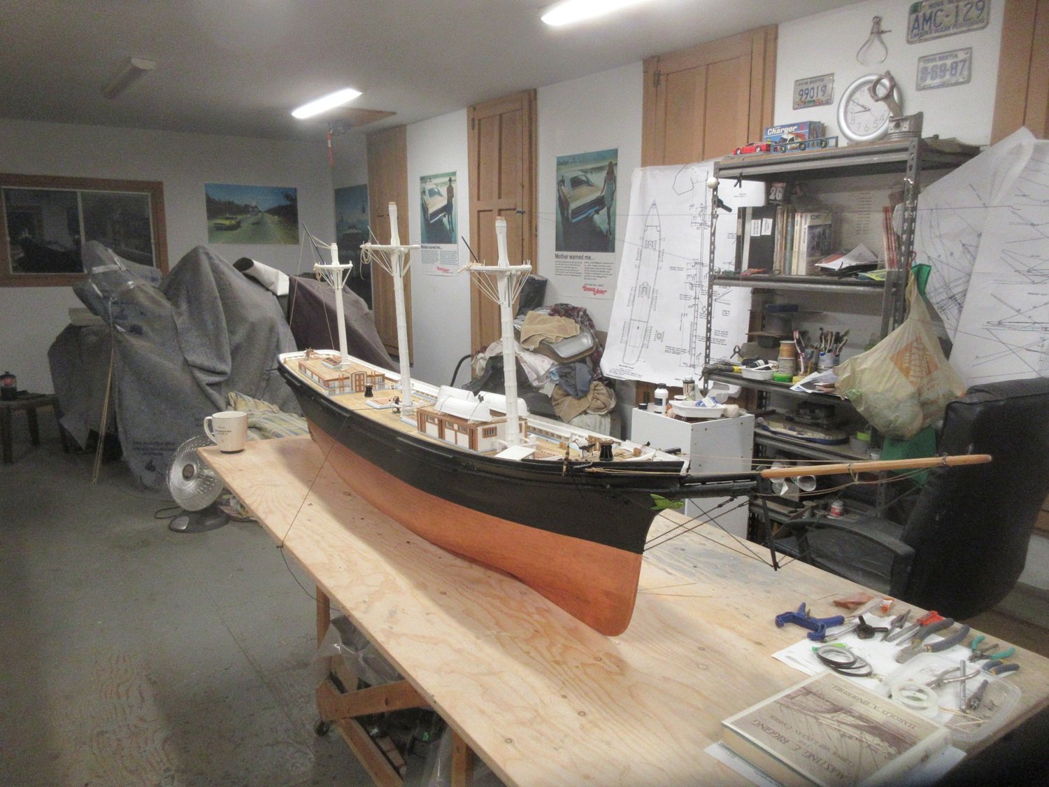

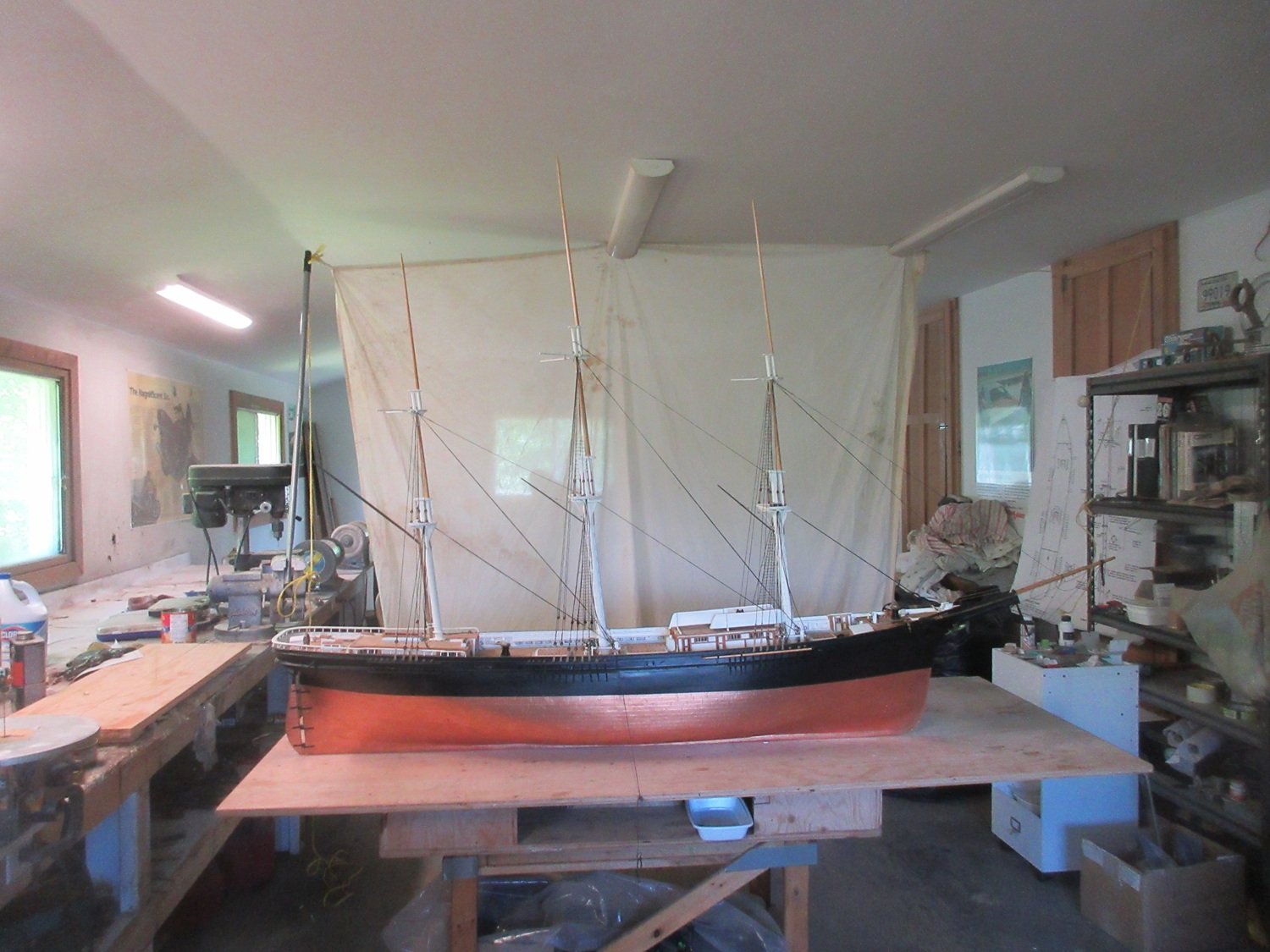

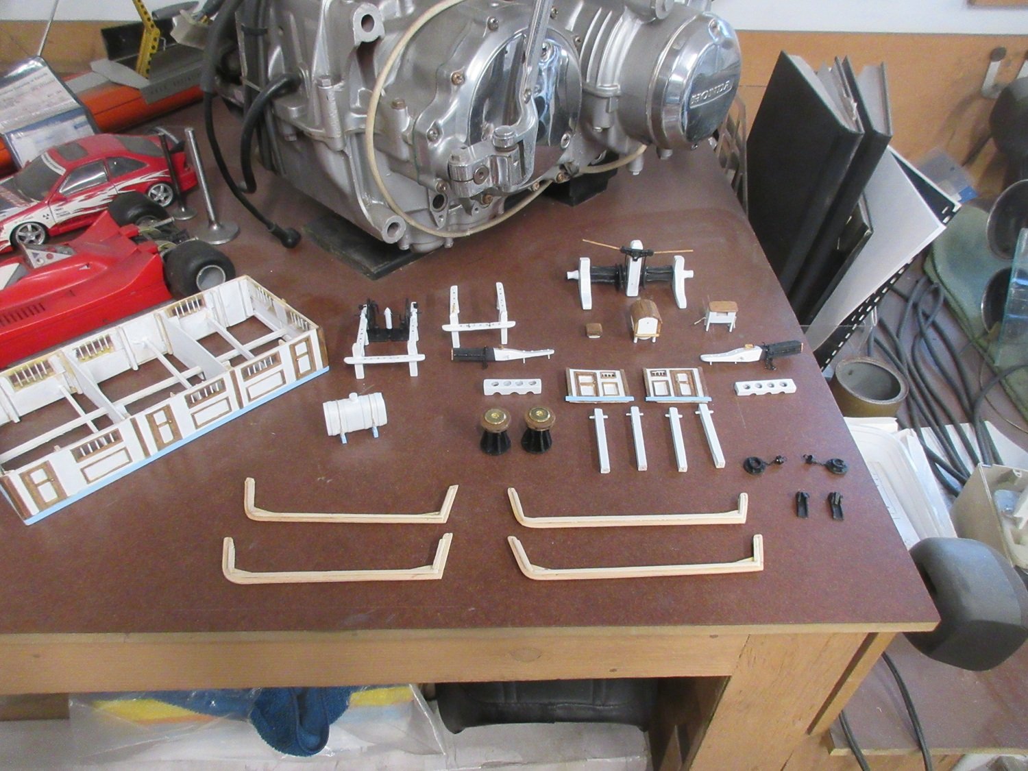

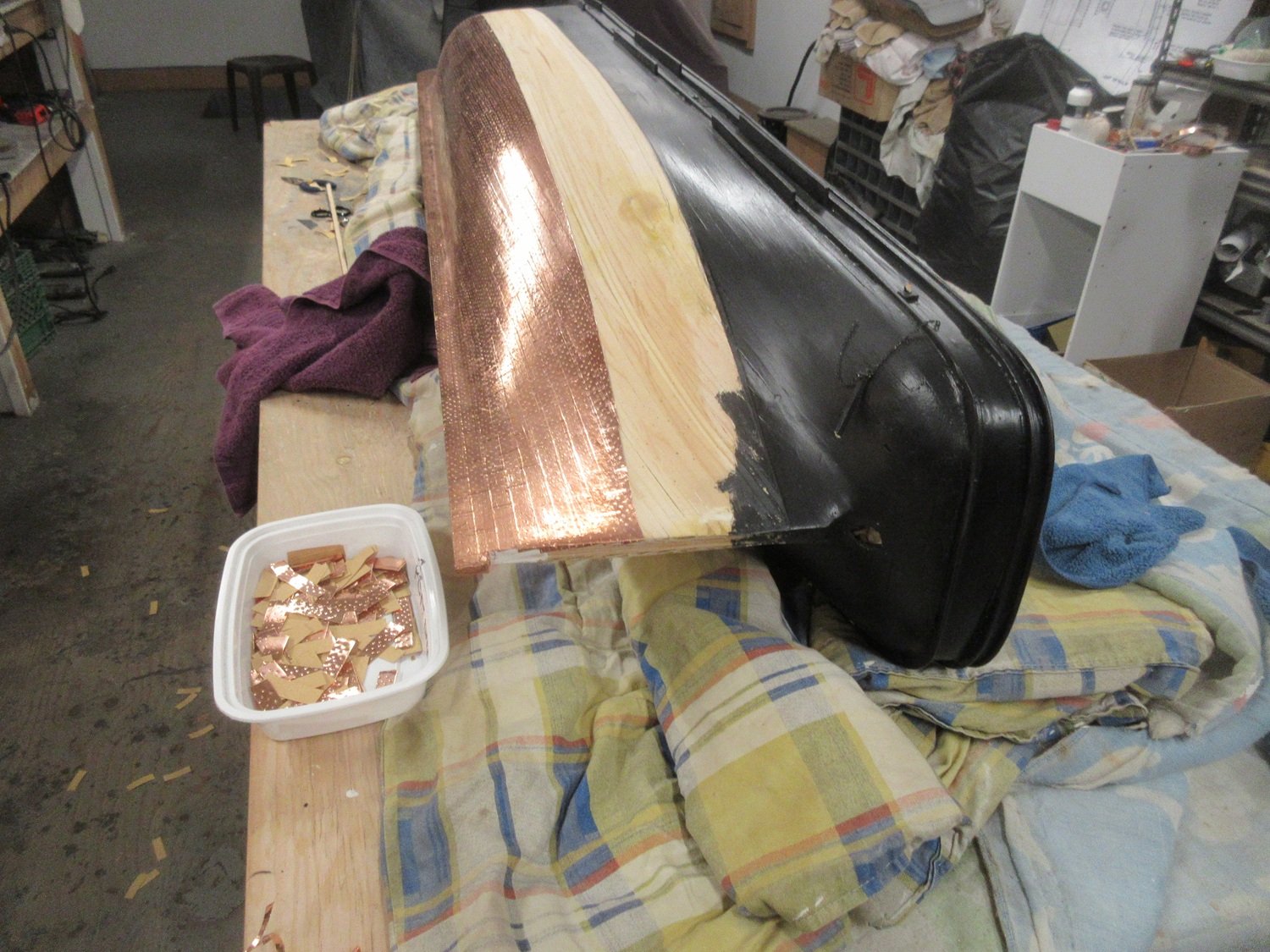

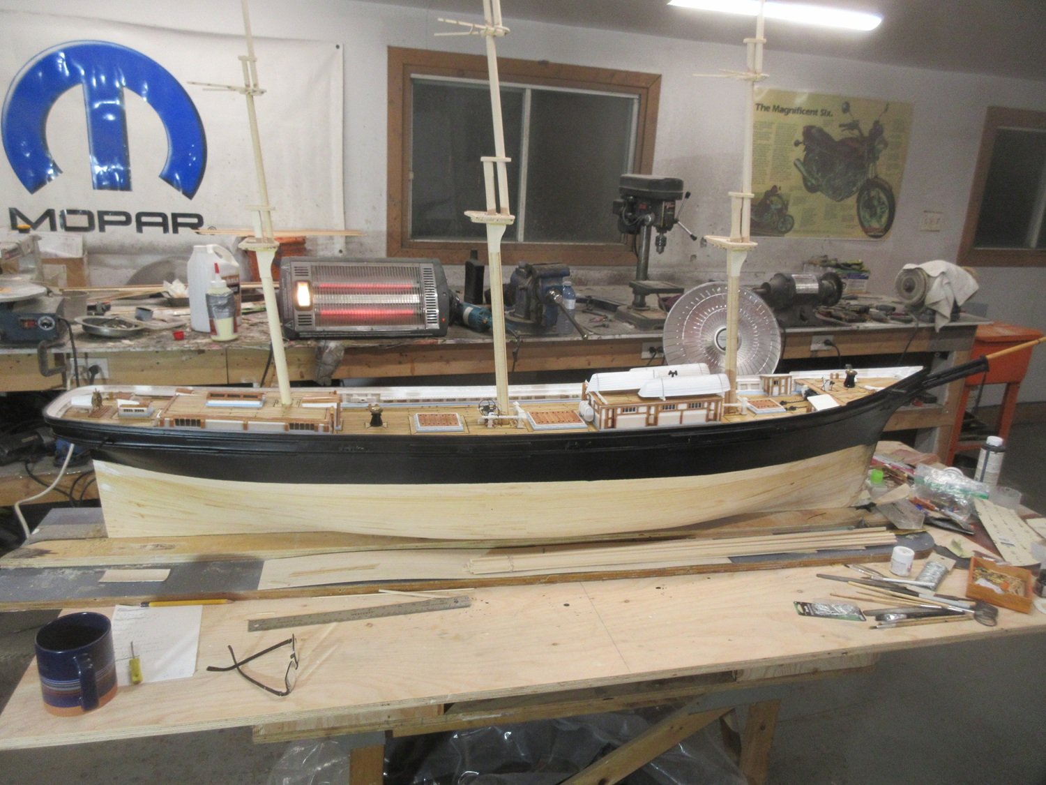

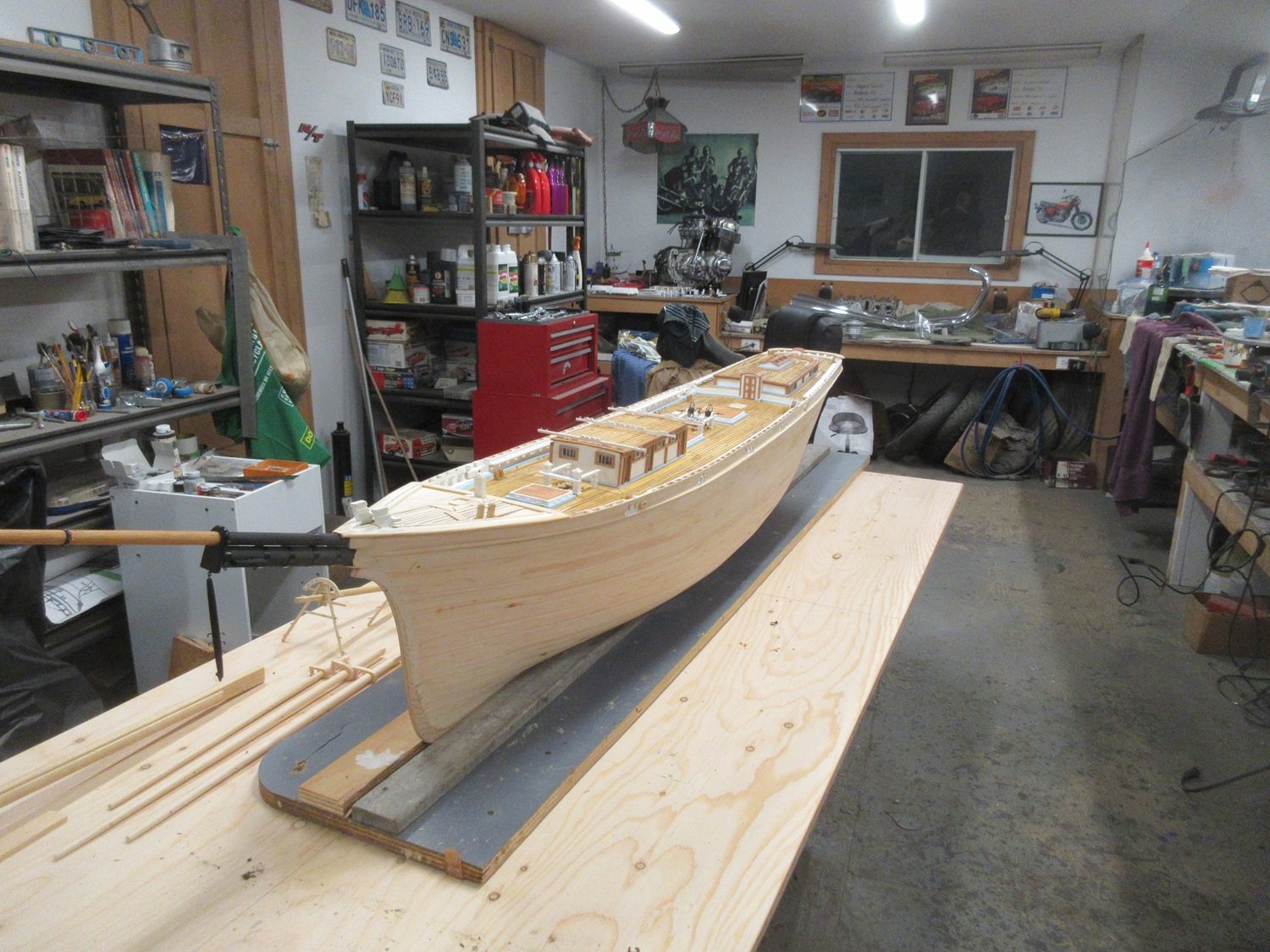

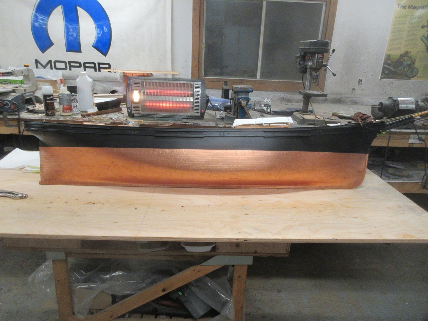

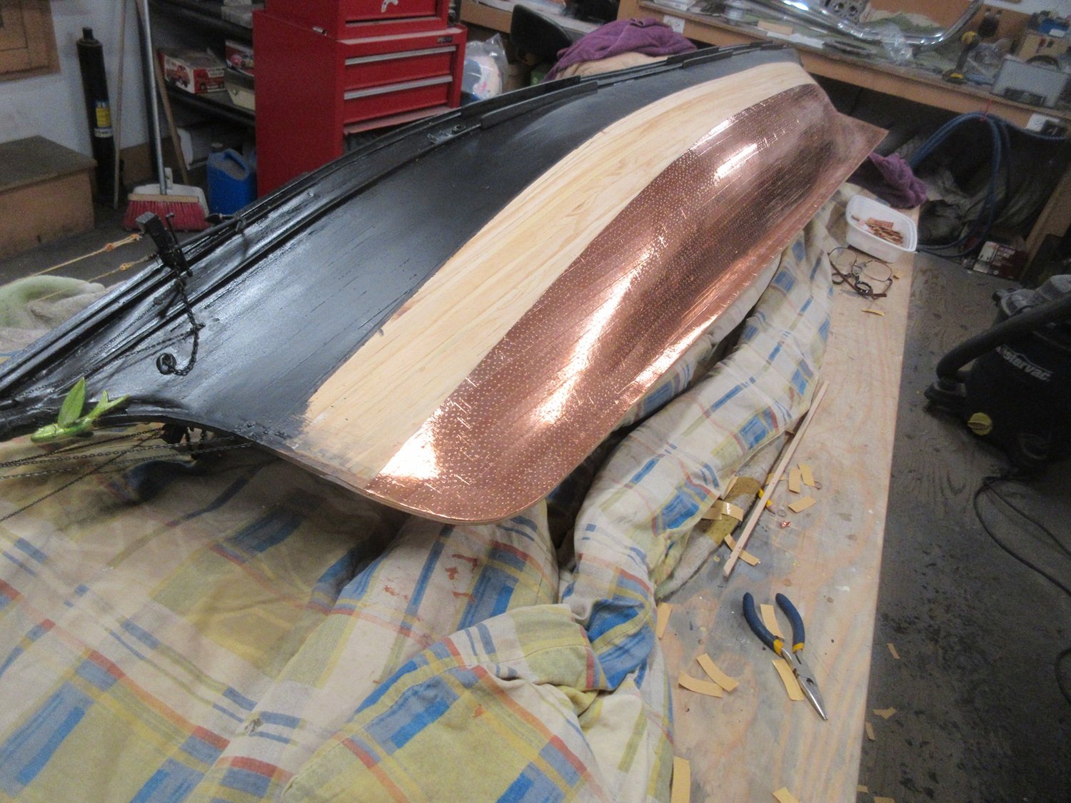

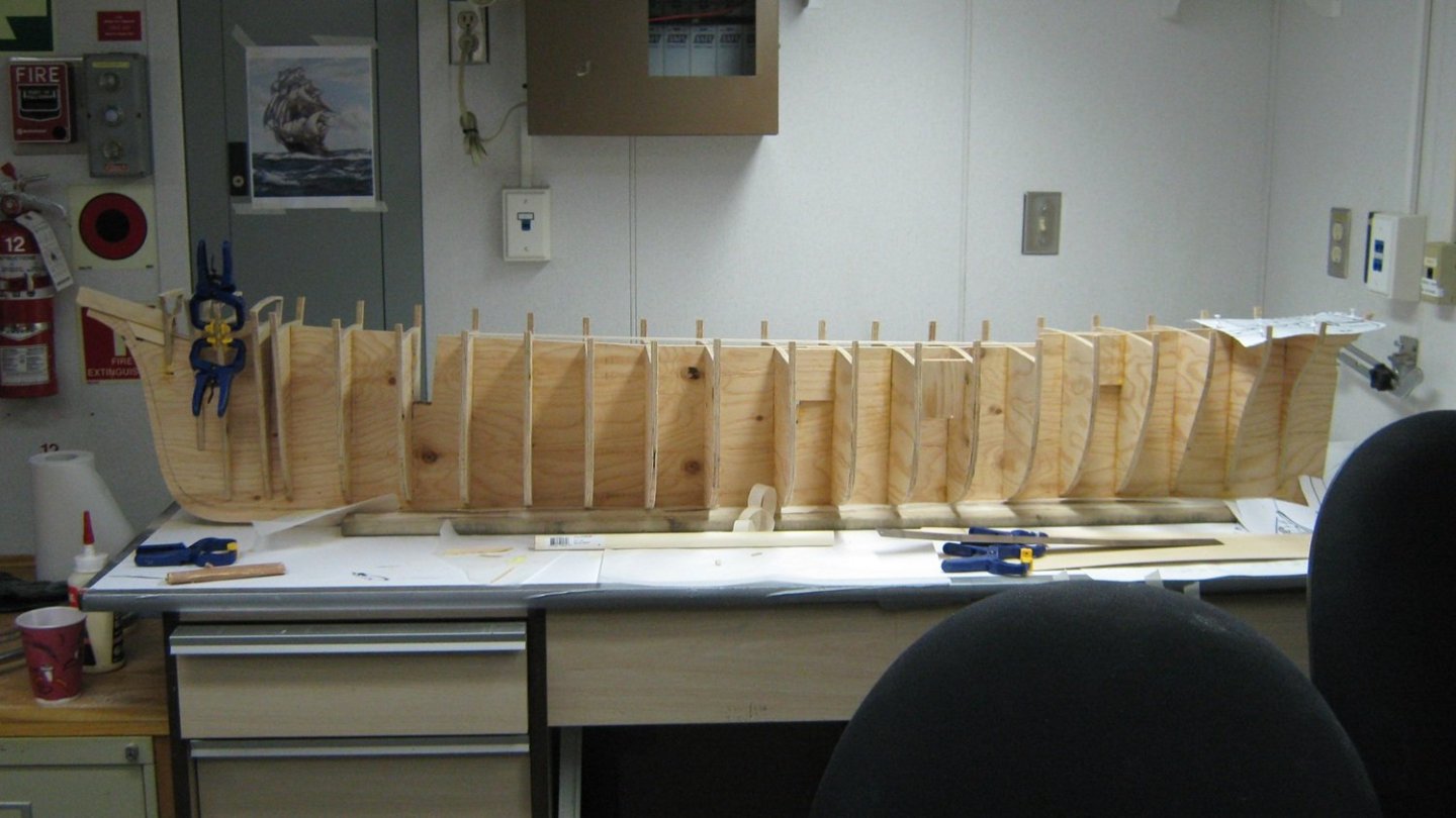

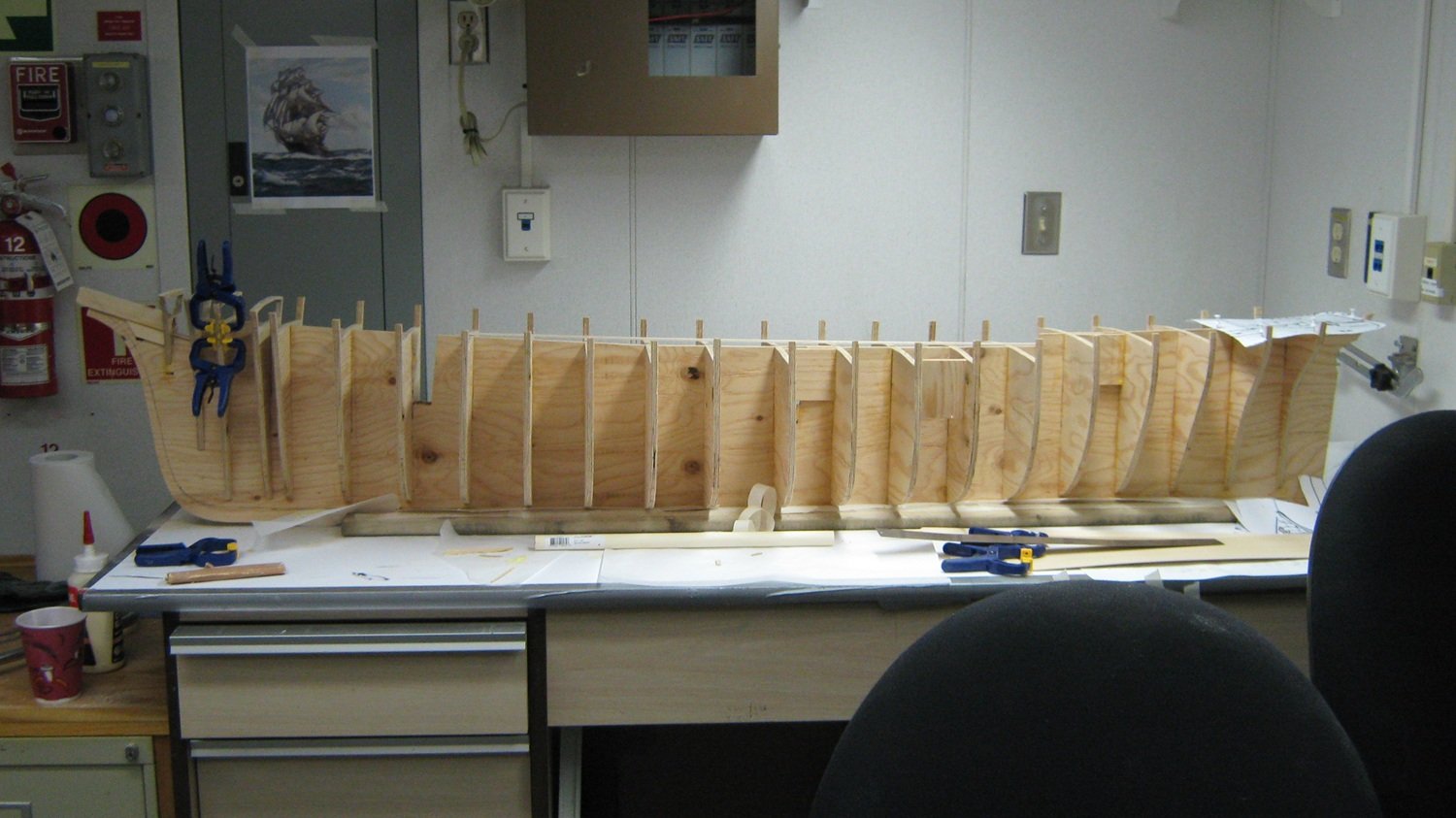

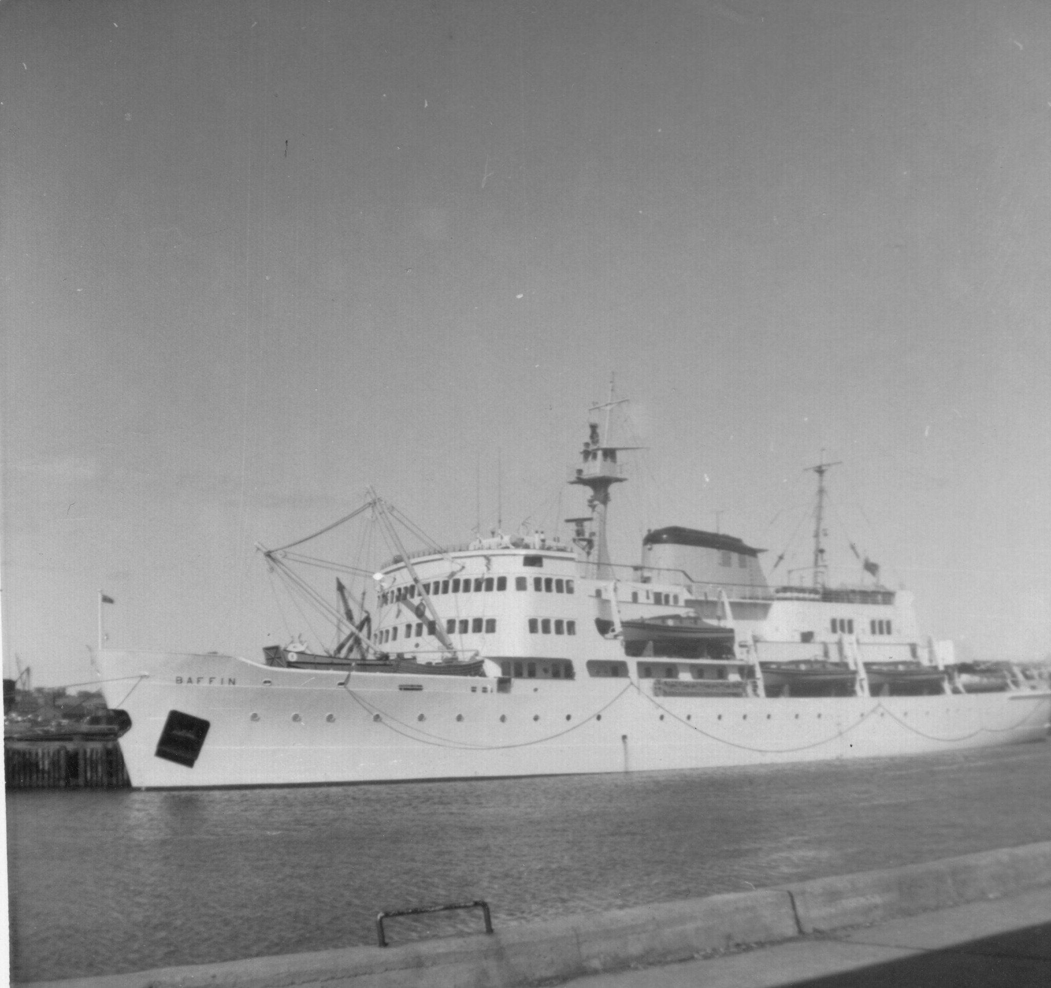

I've been building wooden ships for 48 years. Usually these are built on ships, before I was retired. I've built several Bluenoses and the Cutty Sark onboard the C.S.S. Baffin. Baffin had a woodworking shop on her and I did a lot of the work using her facilities. However in 1990 the Baffin could no longer be feasibly kept up and she was sold to India where she carried on as a passenger vessel for a while. After her I started the Flying Fish onboard the C.S.S. Matthew. She did not have a workshop and the keel and bulkheads were cut out onshore and a friend had a mill where he made me the pine planks. I started the Flying Fish in 2010 and worked on her for 3 28 day trips (84 days in total). In 2011I worked the same schedule of 3 trips; 28 days each. It was them crated up and left in my rec room until 2023 when I restarted her. I was retired then and worked from June 2023 to July 2024 - 384 days in total. Then it went through another crated period until June of 2024. Hopefully this is the last go at her before she's finished.
The first photos show the C.S.S. Baffin that the Cutty Sark and Bluenoses were built on and the second is the C.S.S. Matthew that the Fish was started on. The 3rd and 4th images show those two as they now sit in the rec room.

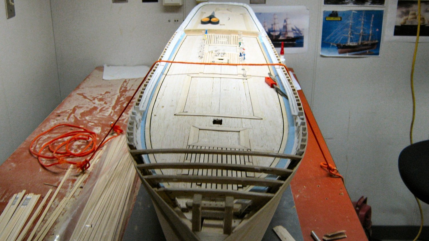

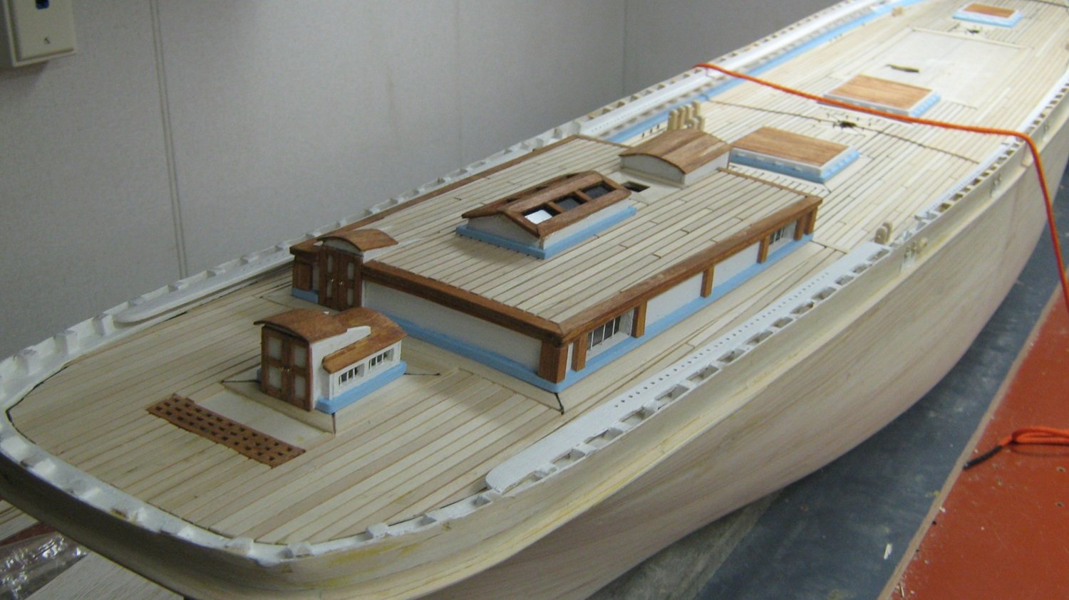

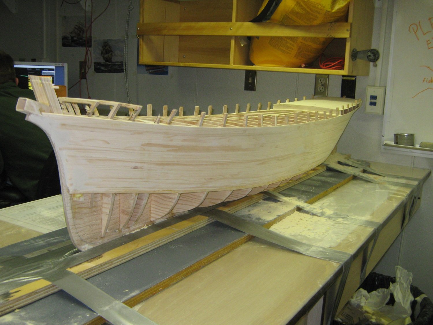

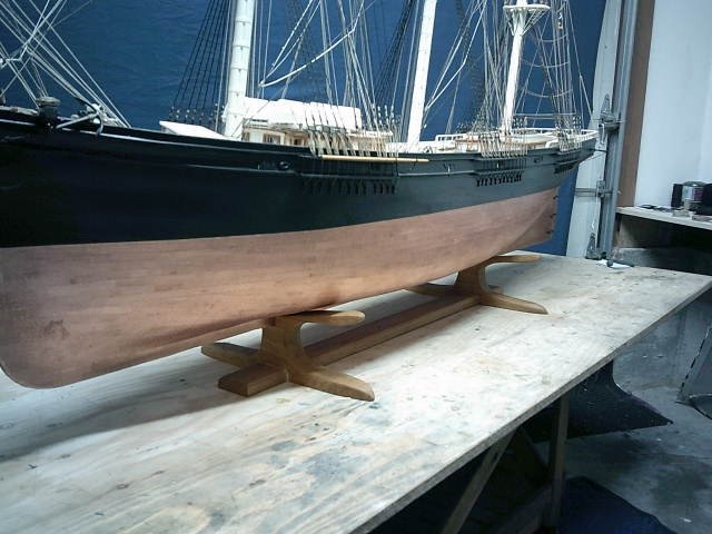

The rest are just a rough assemblage of chronological images of its construction over the years.

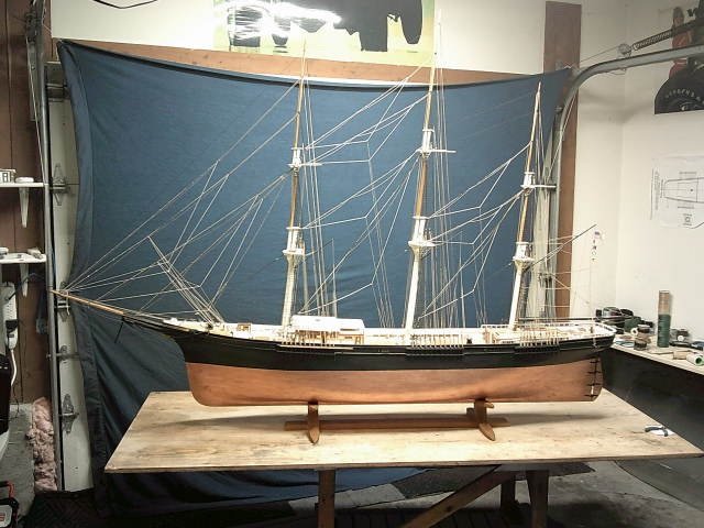

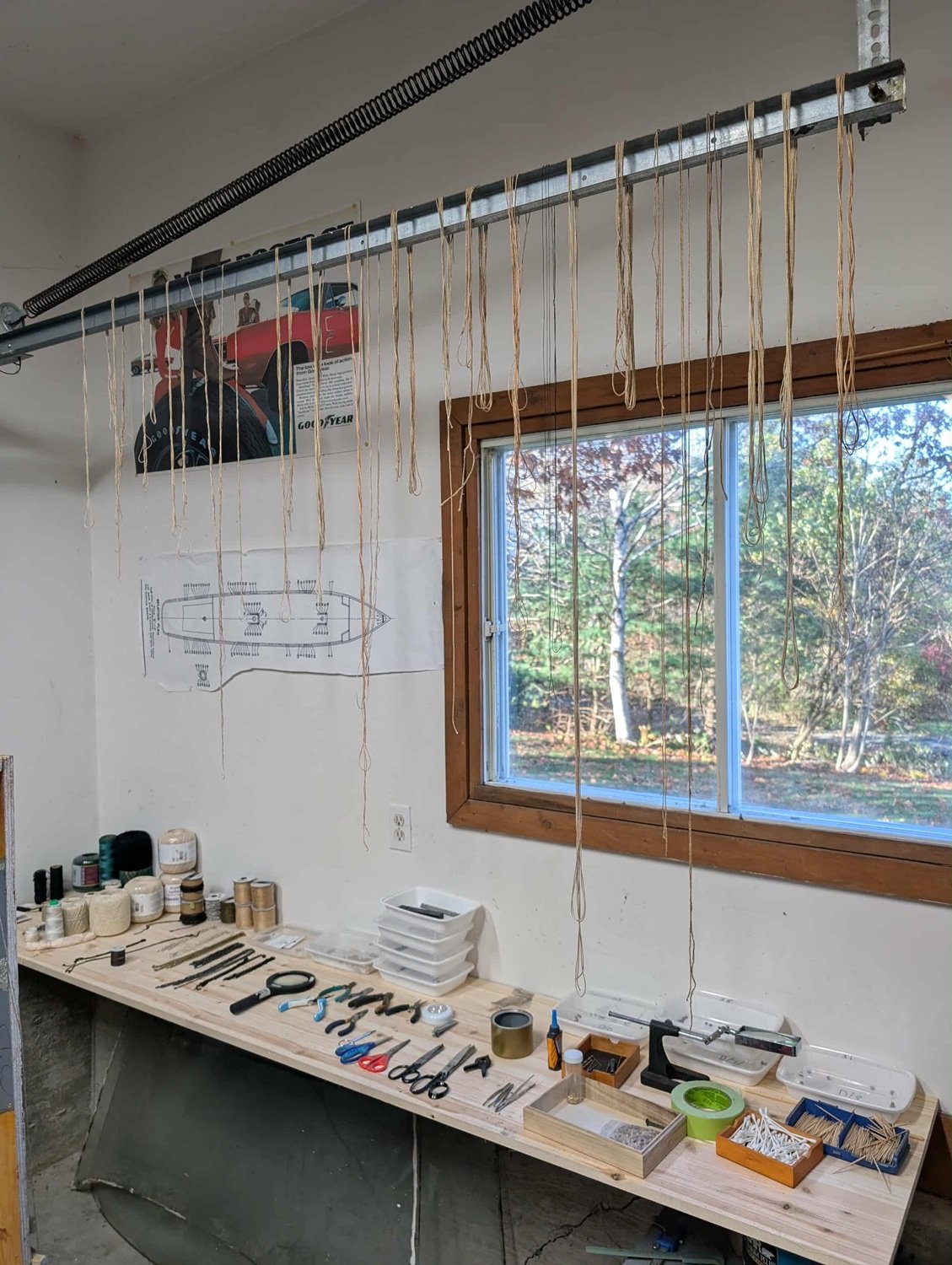

I want to show her with all the running lines attached, even to the point of being erroneous. The staysails and studding sails will be used in conjunction. Also the sails will only be outlines in white so one can view all the lines in their entirety. As of now the staysails are done, but I am looking for a method to solidify rope for the rest. The bottom arc of the sail is the main area of concern. I've tried many solutions and potions, but none will make the rope rigid enough to handle. The second last try was using 18 gauge wire up from previous attempts with 22 gauge. The 18 gauge hobby is also too flimsy. I'm currently trying epoxy on the rope line and will see if this works.
This was started from a set of 1951 Model Slipways plans that I had enlarged. I had researched the Flying Fish for over a year before I started her. There has been a dramatic change in her plans from the 1951 MS versions and also current findings have altered her again from those. So in areas of doubt or uncertainty I filled in the blanks with my own interpretation. The figurehead is a good example. It has been described as a "greenish gold flying fish". That's it. I have seen many images of what it may have looked like, but I went my own way. If it were the Flying Cloud, there's tons of research and items available. But I wanted the less traveled road. In the last decade of so there's been many who have picked up on the Fish also.

I was a hydrographer/cartographer during my time with the Canadian Hydrographic Service. Whenever possible we worked 12 hours a day and I'd do 5 or 6 hours, after I was back on board from a 34 foot survey launch. During weather, or ice, we'd either hide, or get blocked in by ice. In both cases that freed up a lot of time for me.
And Holy Crow - the Lady Hammond. I sailed on her for nearly 2 years doing Fisheries Research before becoming a Hydrographer. Max Baker was her captain when I first went aboard and Neil Barnes was chief officer. She was a cork. Once I got sea legs on the Lady Hammond, there was no ship that bothered me. Used to jam yourself into the rack as she'd darn near go rail to rail in Bedford Basin. Worst sea vessel I've ever been on for sea manners.
Se was originally the Hammond Innes built in England during the Cod Wars. All sides involved figured the fish would long be gone before the courts dealt with it. And they pretty much were. England just cranked those things out hoping to out fish the other nations. We'd do 12 days on 2 days off trips year round.  Off of Scatarie Island or Sable Island in February in a cod wars trawler is no fun. But I did build one Bluenose on her.

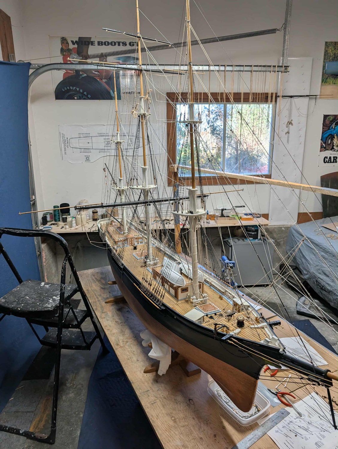

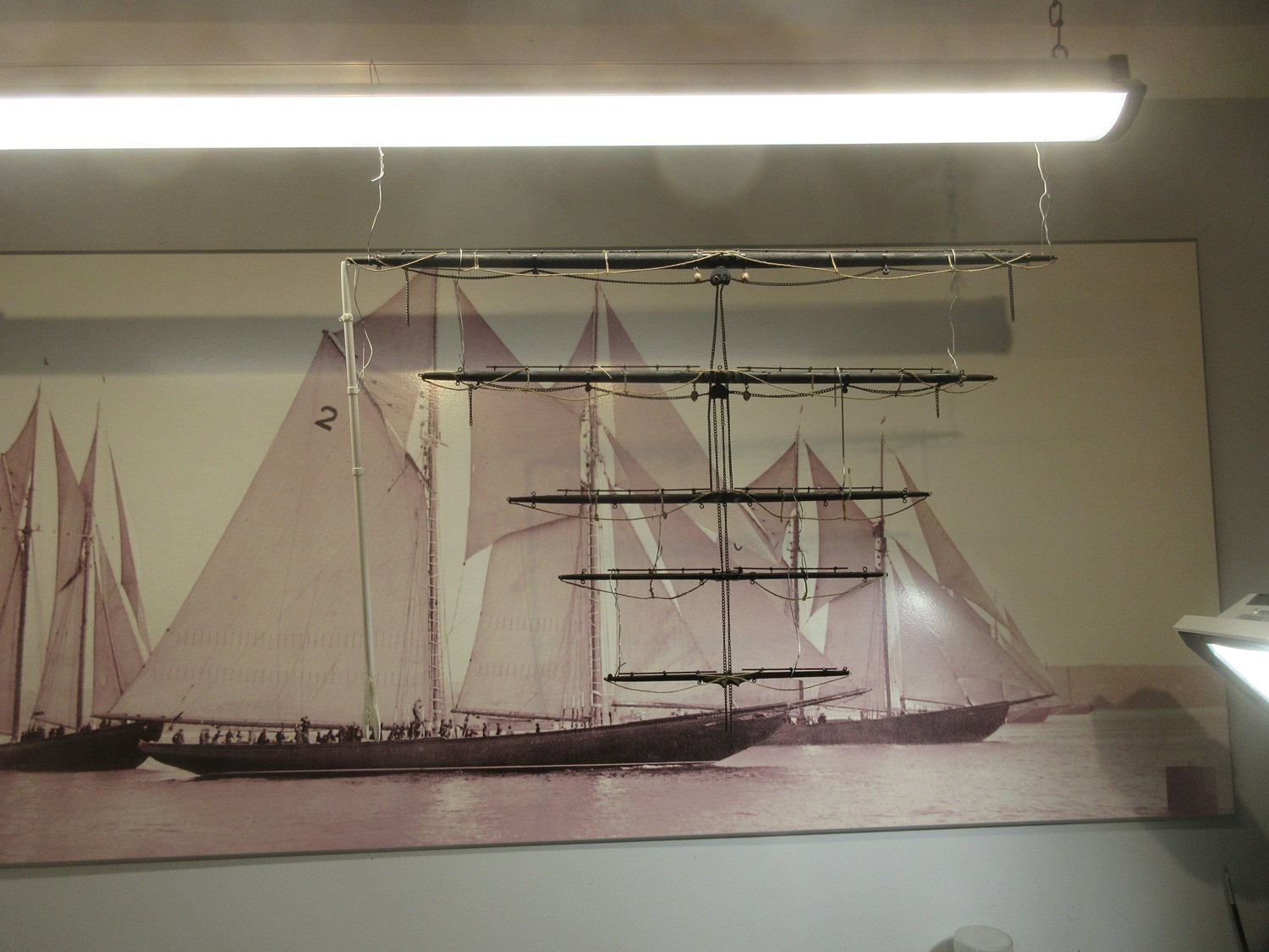

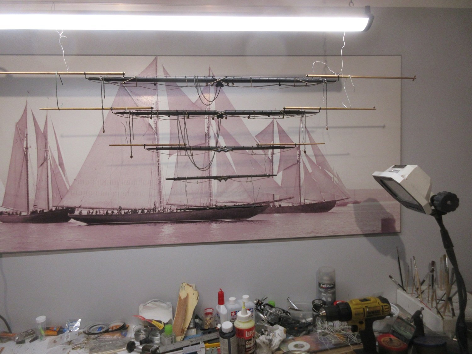

Below are 3 images showing 4 sails per mast on  Flying Fish. And colors of the rainbow.
Good thing its the love of ships that is the real driving force for our replicas. And no one can really prove one wrong. Thank you for your valued imput.

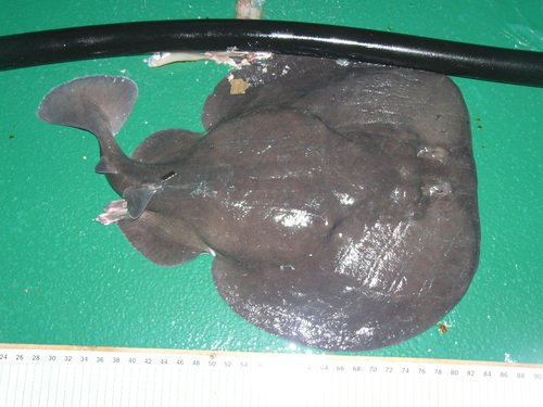

The weirdest that shallow tows produced was the Atlantic Torpedo. They are a ray and carry 220 volts around the perimeter of the oval head area, for stunning prey. The deep tows produced some really strange stuff, but most of it exploded on the way to the surface. But the luminescent colors and the fangs on these things are stuff from horror novels.
The first two show her rigged for 5 squaresails on each mast: course (cro'jick on the mizzen), topsail, t'gans'l, royal and skys'l. The first has the skys'l yards crossed but the sails furled (as are the fore and mizzen royals). The second shows all royals, plus the fore and mizzen t'gans'ls furled, while the skysail yards have been sent down -- as would be expected if stronger winds are forecast to persist for more than several hours.
In typical square rigs, any time there is a stay (leading forward) and shrouds, they mark the upper end of a "mast" (even if that is made of the same continuous pole as the mast below and the flagpole above), which is there to carry a yard and sail. The skys'l-mast stays and shrouds are clear in that painting, showing where the skys'l yards would go if they had not been sent down.
I think you can be sure that, in terms of terminology of the time, she was a "three-skys'l yarder".

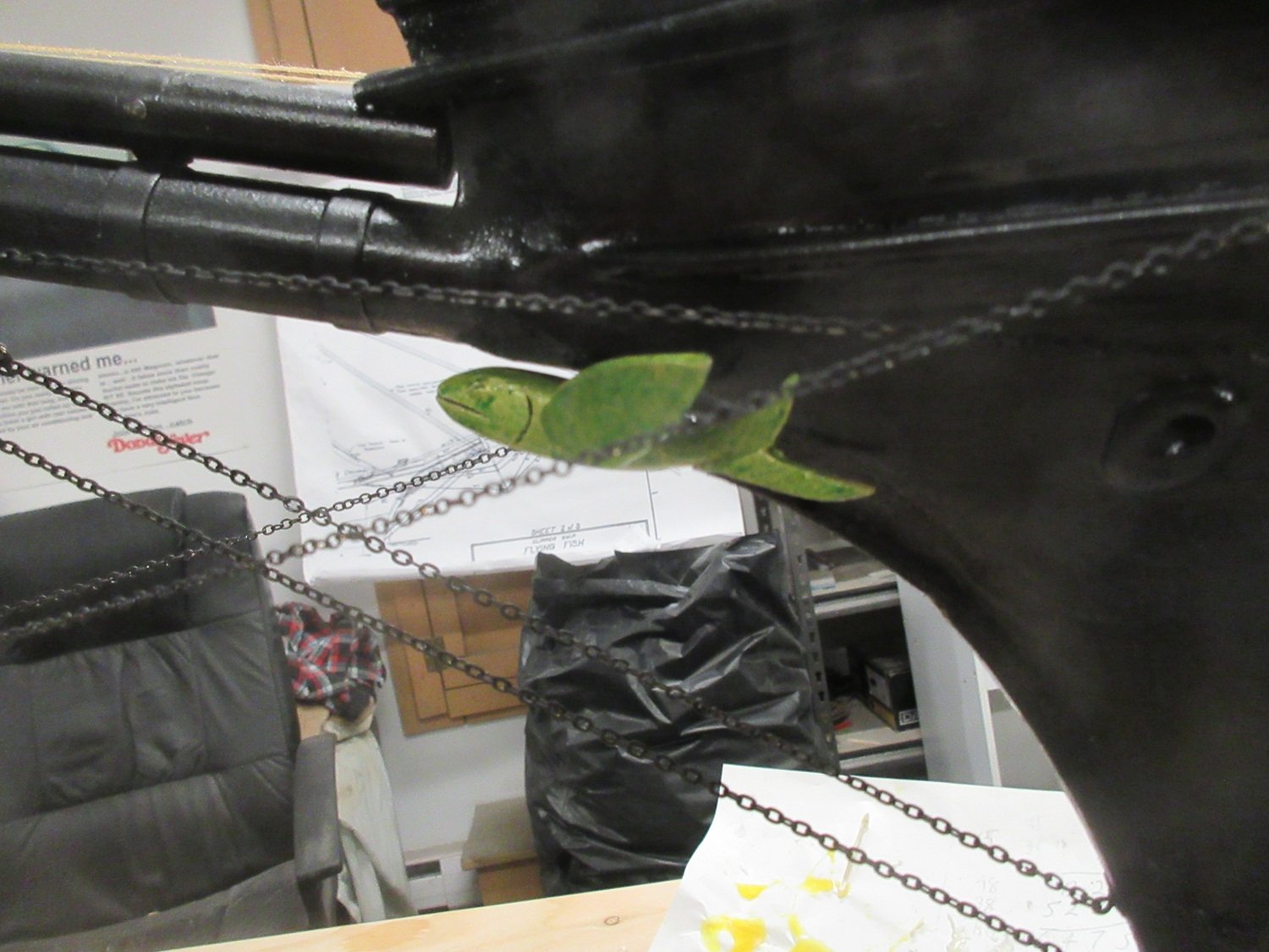

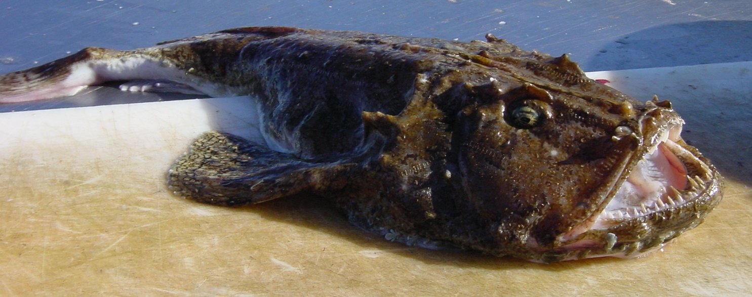

Now its just a stroll down memory lane. We had an large pregnant Angler Fish come up in the trawl, and they had to go through the same level of tests as the profitable commercial  species. The female weighed 47 kilos (103 pounds). While hanging by her jaw she spawned. Her weight dropped 27 kilos to 20 kilos (44 pounds). 27 kilos of spawn slurping over the wet lab deck. It took the fire hoses to get the slime off - like Jell-O but goo and the ability to adhere to anything that came in contact with it. It was Crazy Glue that never dried.
The image is just to show the species, not mine.
Are you saying the skysail booms are off? I count 4 booms. Oops - the first is 5 booms, I own it. Looks to be not near the same vessel but for floating. The two images are Butterworths. Look at the background vessel. I panicked and jumped. The second only 4 are shown. There would appear to be room for the skysail yards. but they are not shown?
*EDIT* I do wholeheartedly agree that standard practice is for three booms on the topgallant mast.
Edited by Michael Collins
Technically "yards", not "booms", though I would be hard pressed to define the difference. (Yards spread the heads of sails and booms the feet, maybe? There are probably multiple exceptions to any simple division like that.)
But, yes, I am saying that the ship in the second image was rigged to carry skys'ls but the yards are not shown. When the wind was expected to be unsuitable for such light-weather canvas for an extended time, instead of the yard being left aloft, the robbands cut and the sail sent down to the deck, the sail was left furled on its yard and the whole thing sent down as one package. It could readily be send aloft again when needed. That was entirely normal in the clipper era (and for centuries before) but became impractical with the heavy, steel rigs of the late 19th Century.

The key element on all of these paintings is the large single topsail.  This clue, alone shows us that these vessels were painted before they received their upgrades to the Howes double topsail design.
In many cases the area covered by these four sails....ie...main, topsail, topgallant, royal, was sufficient to propel the vessel at a moderate 10~15 knots.   It is true, many captains reduced the skysail/yard to reduce stress on the mast....but most paintings we see do not depict vessels in such a dreadful affair.  Some paintings that do depict such an extreme weather condition, also show damage to royal and topgallant masts...not to mention loss of said yards and sails.
Hauling down skysail yards were a routine practice....however, some first hand descriptions from Duncan McLean, report that many of McKay clippers were originally only fitted out with royals.  One can assume, skysails were added later to aid in achieving greater speed.   Clipper Lightning achieved some of her record speeds, while missing her skysails during a particularly horrific passage.
When modeling any one particular vessel...it would not be inaccurate to depict her with or without skysails. Dependent, on the era you are modeling your clipper.
I would fully encourage anyone not familiar with Donald McKay's remarkable naval hoods, to look up clipperfan..(Richard Jones), for his full explanation and research on the matter.  He and I both agree...McKay built all of his clippers with this structural feature.  It was his trade secret and he even asked artist to not paint it on his vessels to, in essence not reveal it to any competitor.   There is much evidence provided by Duncan McLean in his first hand accounts to verify the structures presence on McKay clippers.   Glory of the Seas is a fine example. We have loads of evidence this fact s true, if one cares to dig deep enough to find it.
The simple fact that model kit designers leave it off their kits, is evidence they are not familiar with Donald McKay's ingenious design and application.  Following paintings of the time cannot be your only source.
