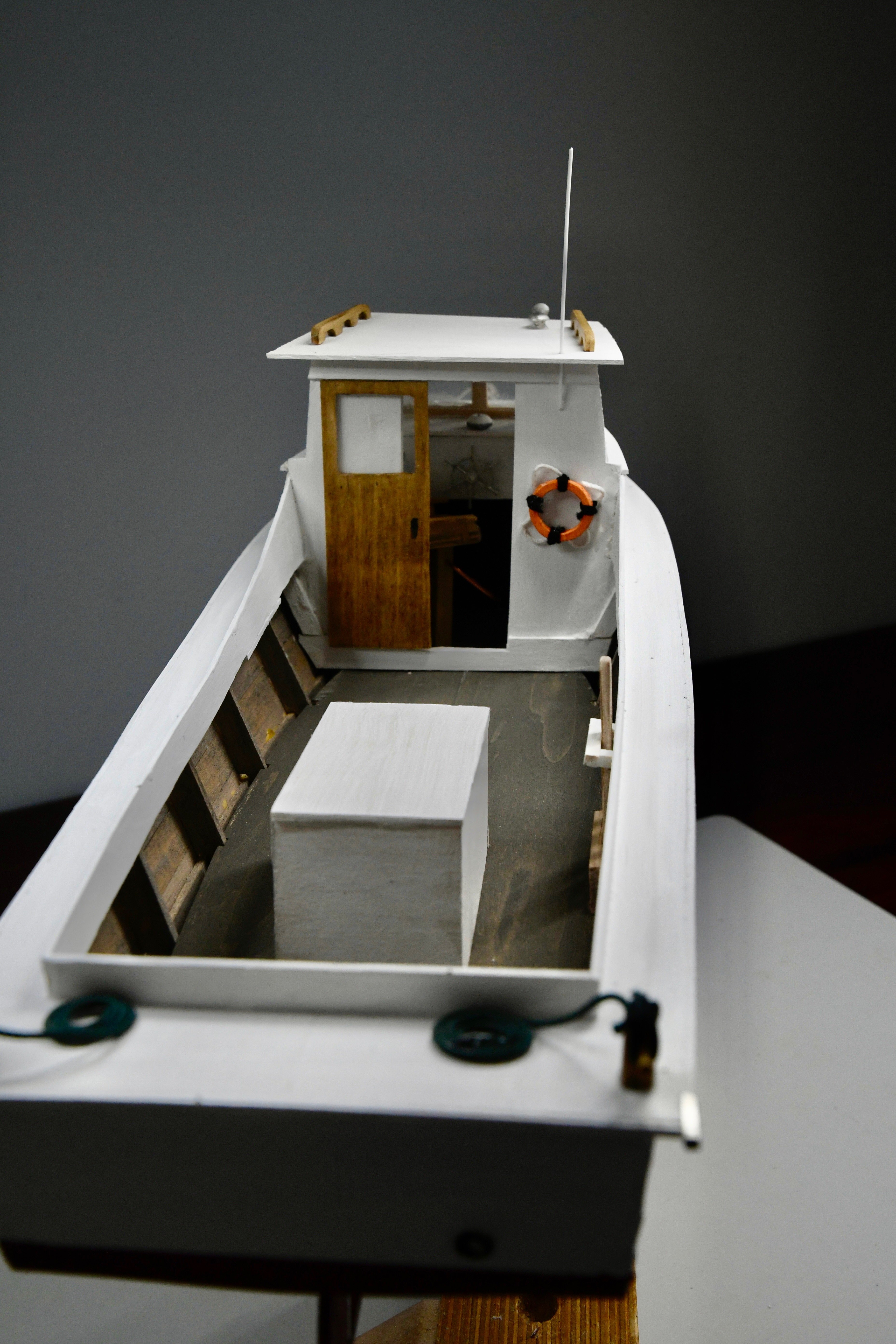

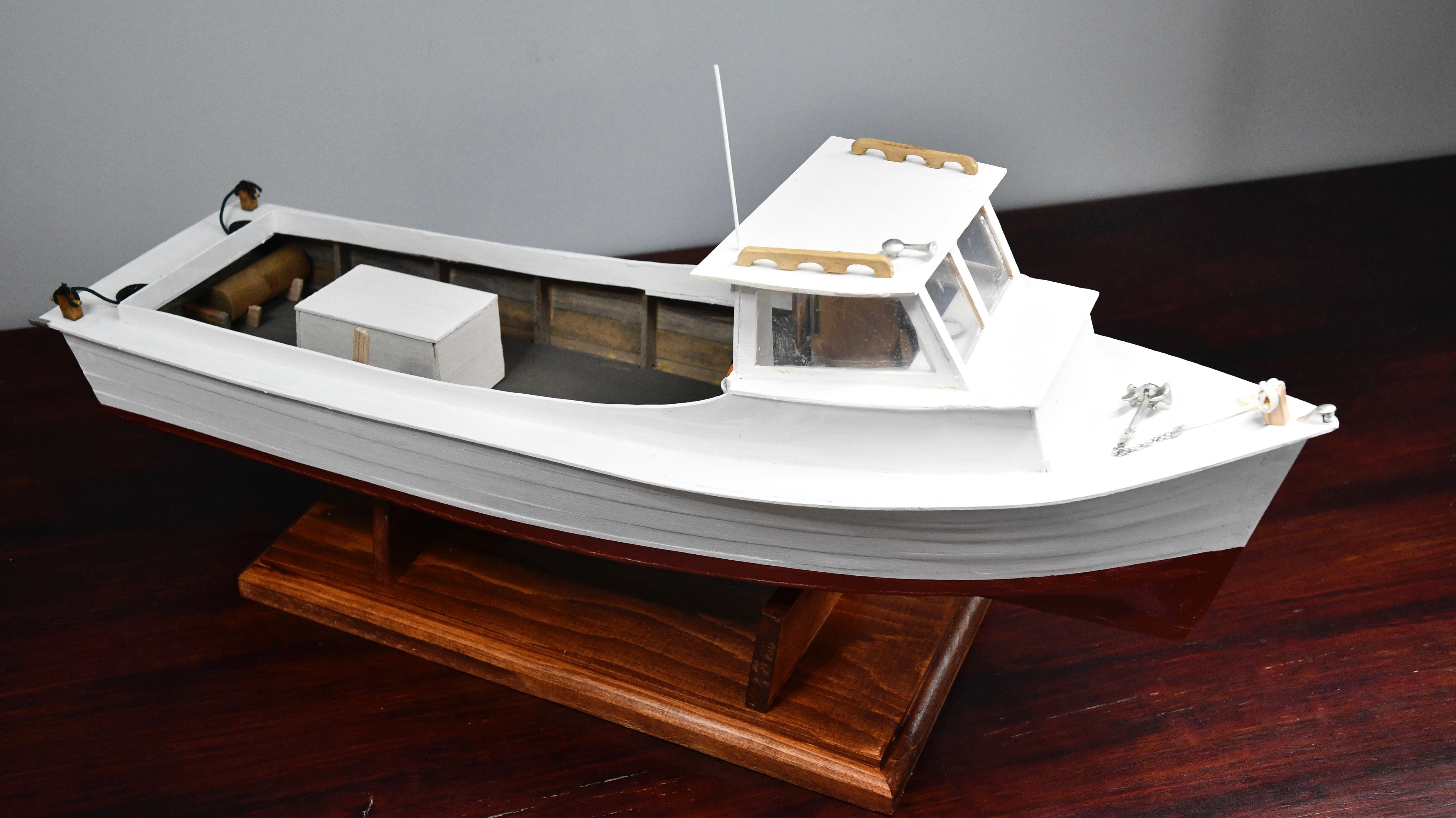

I saw this model and wanted to put it on my build list since these boats frequented Hampton Roads where I grew up. I also spent time on one of these boats that the Virginia Institute Marine Science chartered while we studied the changes that hurricane supplied freshwater had on the local rivers and Bay.

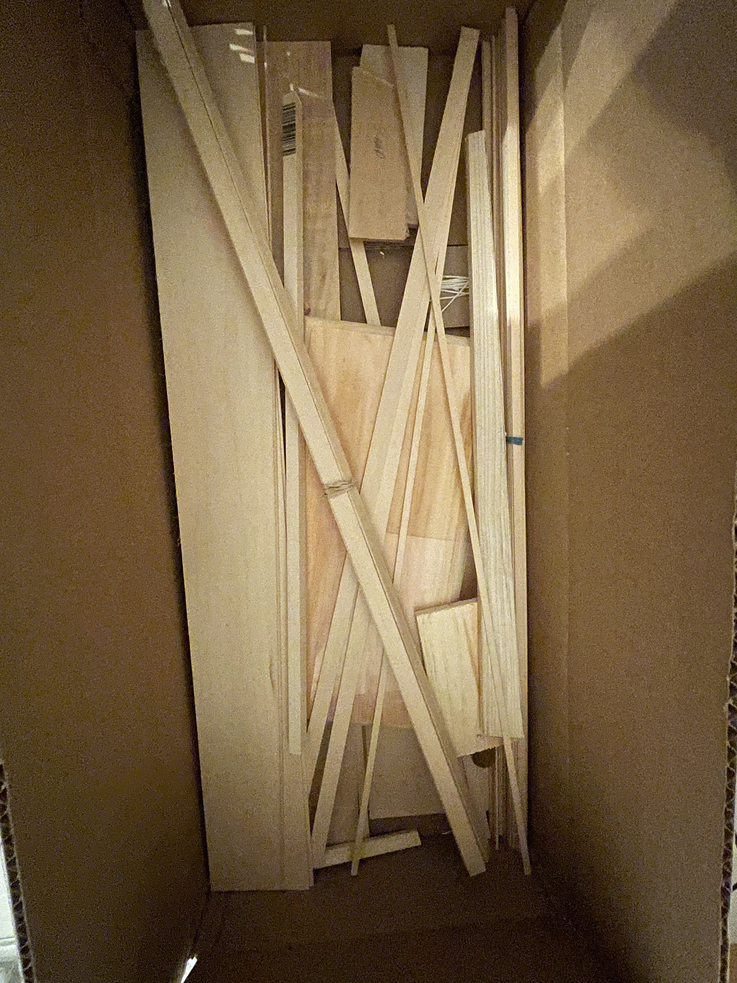

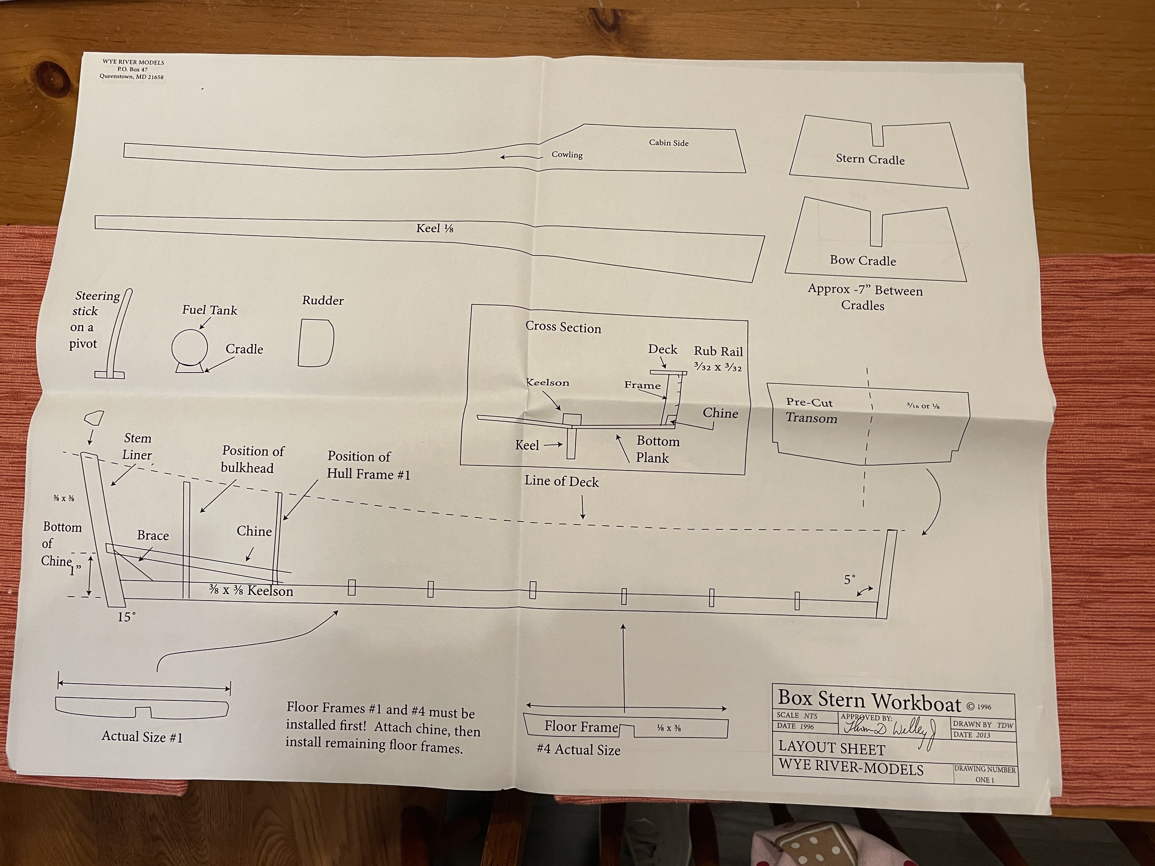

Having some unexpected time off from my part-time job, I decided to start this model for my second build.  I was a little concerned because I only saw one build log for the box stern and the log only documented part of the build. The kit arrived with an instruction manual (just pictures with no detail building instructions) and drawings along with a material list and supplies. I spent time reviewing the material list and handwritten changes to the list that didn’t jive with the material supplied. The material question was 1/16 x 3/8 strips of Balsawood, which is readily available so I don’t expect to have a problem.  Review time ~1.5 hours IMG_6379.thumb.jpeg.7468fee75f5fef26165d9711b0f2397d.jpegIMG_6378.thumb.jpeg.b651323dc2317ec6b1062b61e9c4568c.jpegIMG_6380.thumb.jpeg.88a494641d81f18bb87395e4ca5c0c31.jpeg

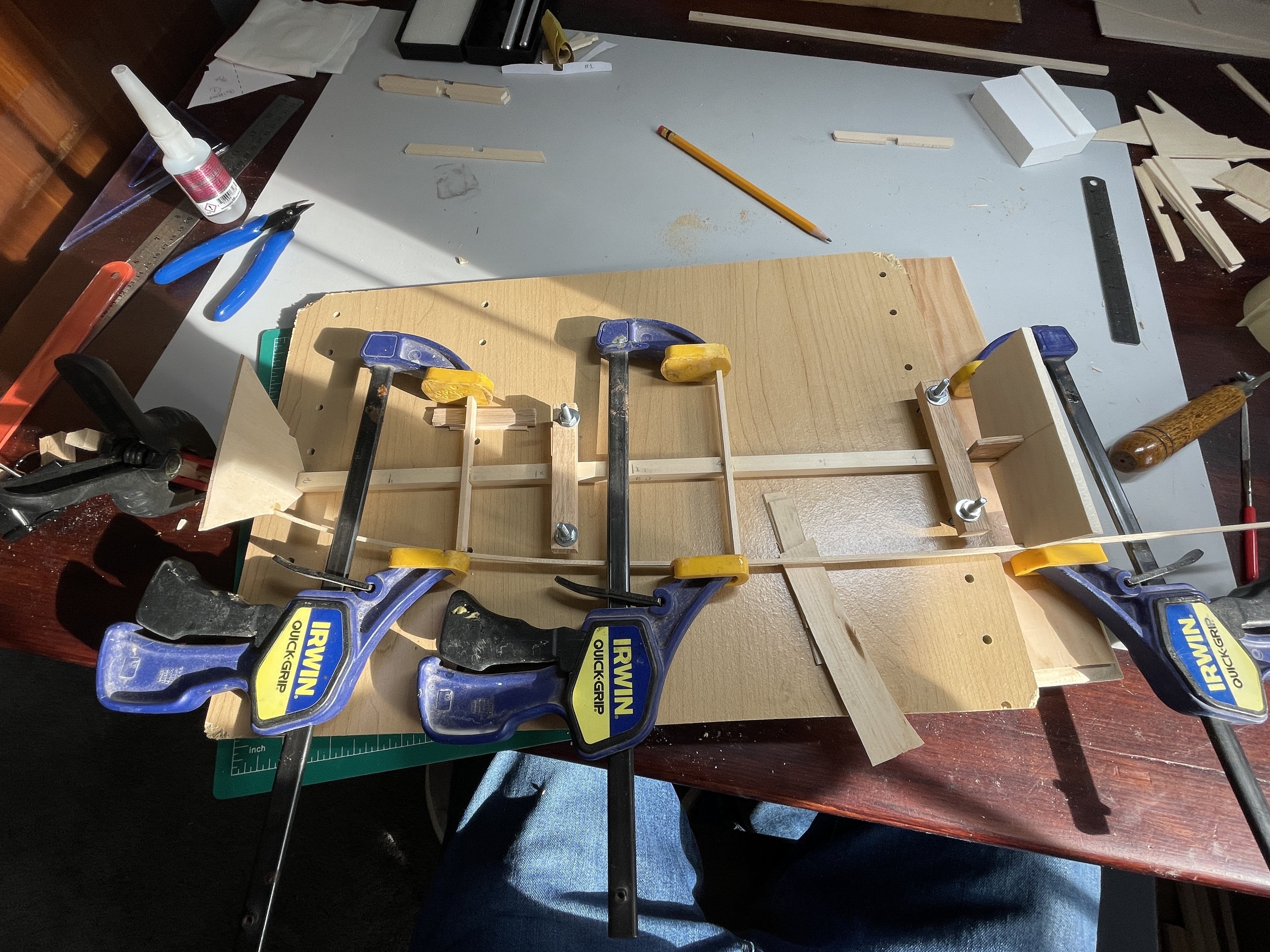

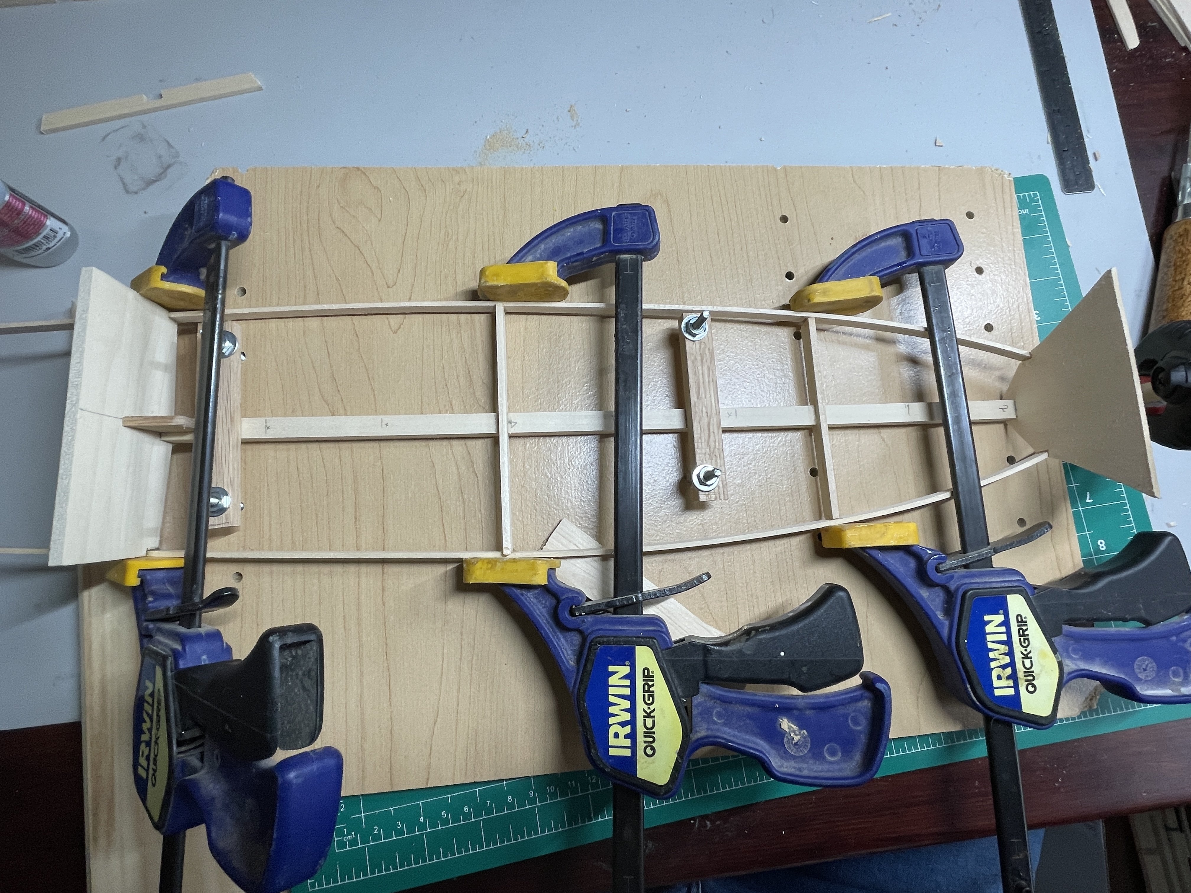

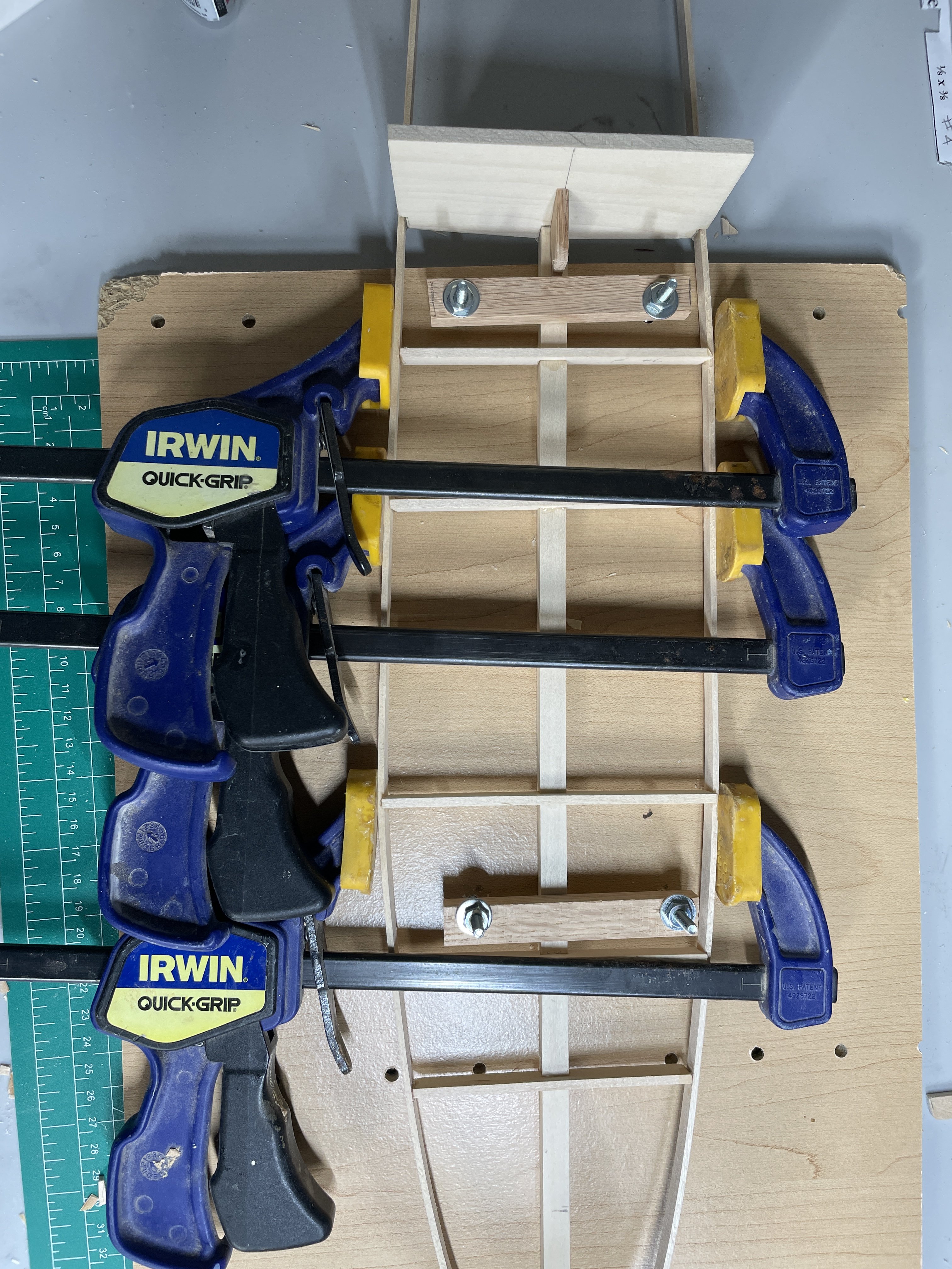

I built a table which allowed me to clamp the keelson for this part of the build. Installed the bow stem, bulkhead and the transom to the keelson. The plans called for floor frames number 1 and 4 to be installed first so that they align to the chine. I glued the chine to the bow stem, # 1 and 4 frames and the transom.  Time for this build ~3 hours.IMG_6390.thumb.jpeg.6a38e938dfd22cbff3153d08347c54cb.jpegIMG_6392.thumb.jpeg.2f2e50060ab48c41d3ad8a7e423b0729.jpegIMG_6393.thumb.jpeg.fece8b0c420ff6ca8afa7bd39e2e30b3.jpeg

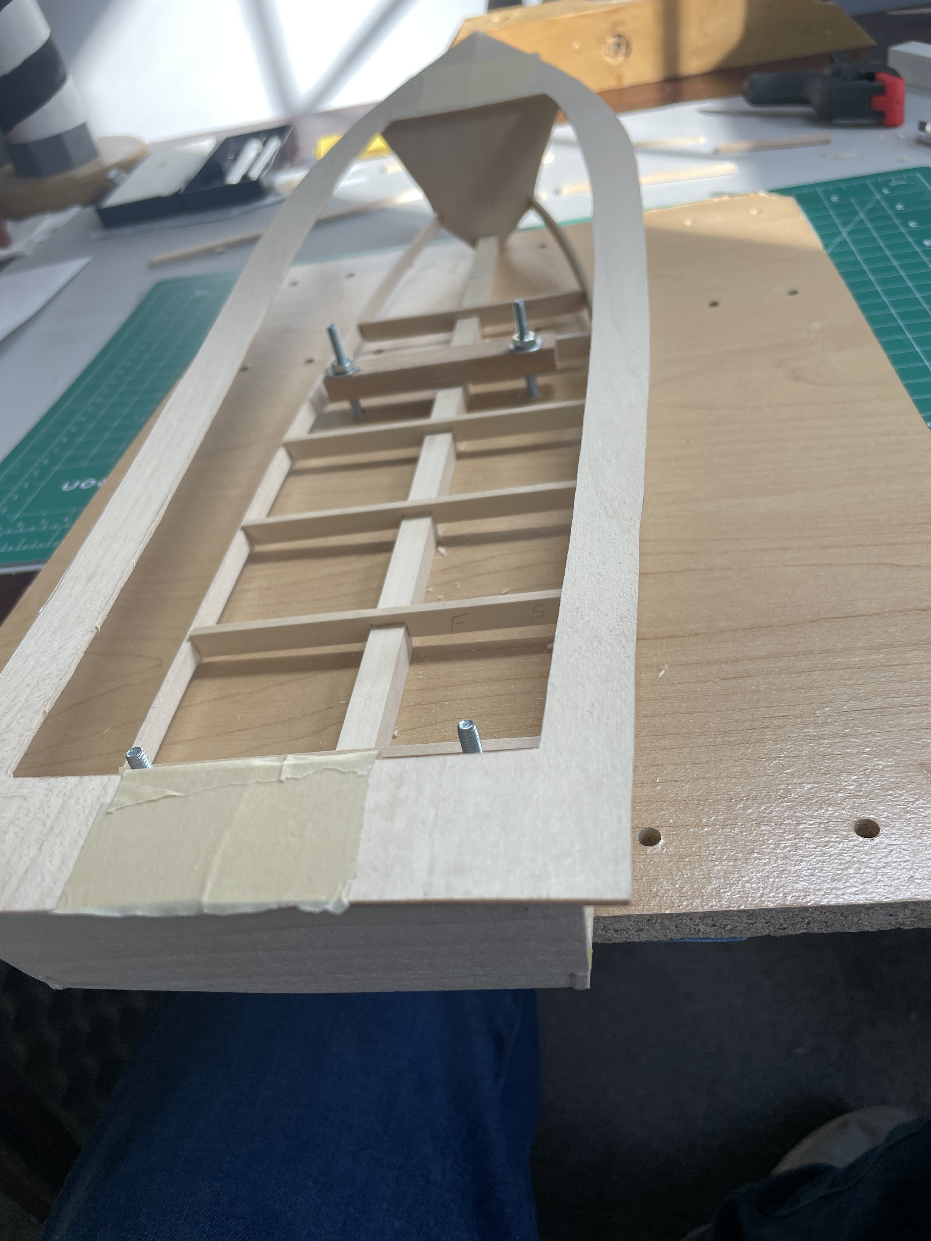

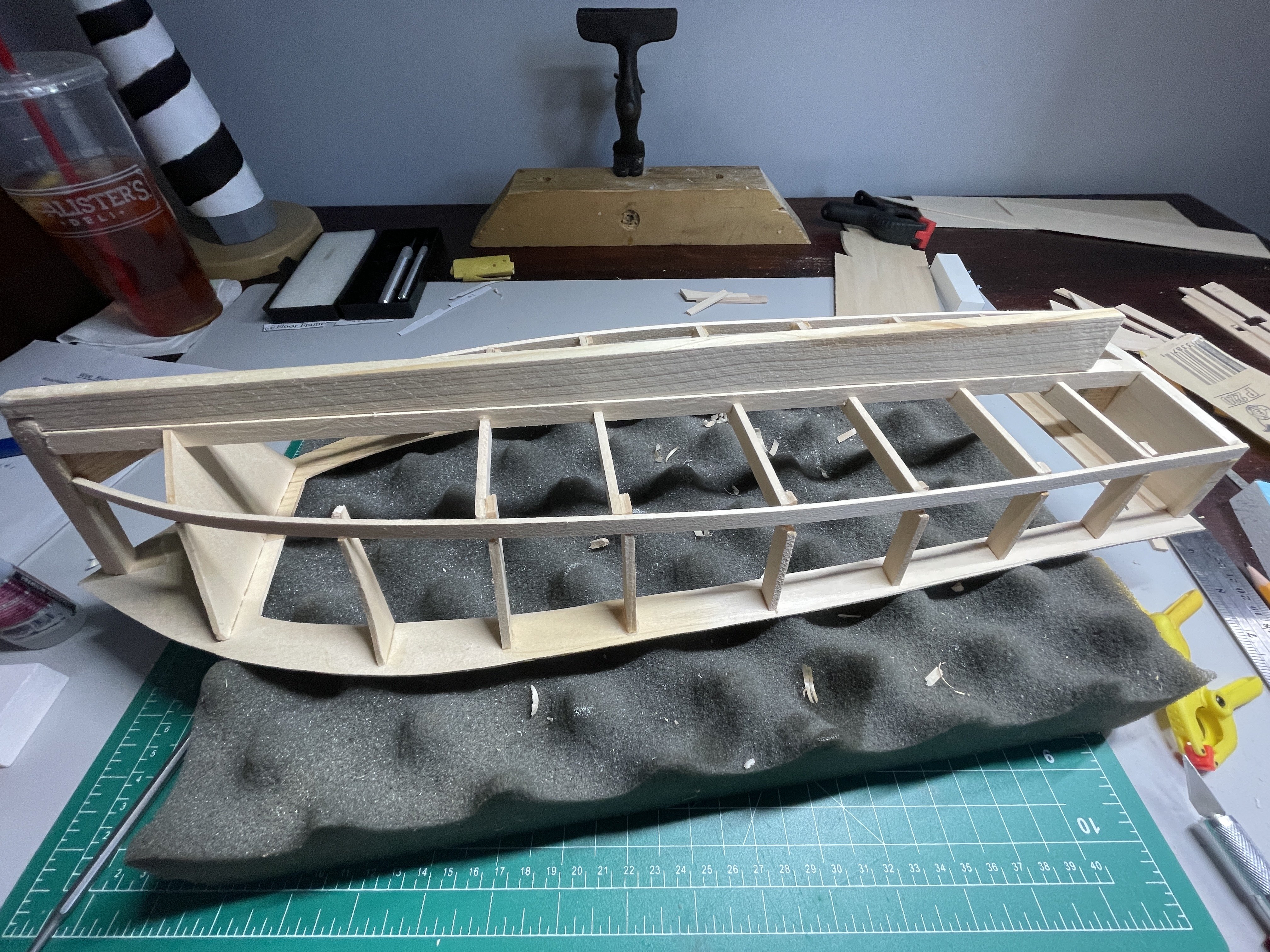

Cut floor frames for the other 4 members which had to be individually fit to the chine on the port and starboard side. Positioned and glued remaining frames to the keelson and chines.  Several of the floor frames were high so were plained down so the floor will lie flat.   Next, the 2 pieces of the deck were joined with a cross brace at the bulkhead and at the transom. Positioned and glued the deck to the bow stem, bulkhead and transom.  Shaped the keel to fit flush to the keelson and glued.

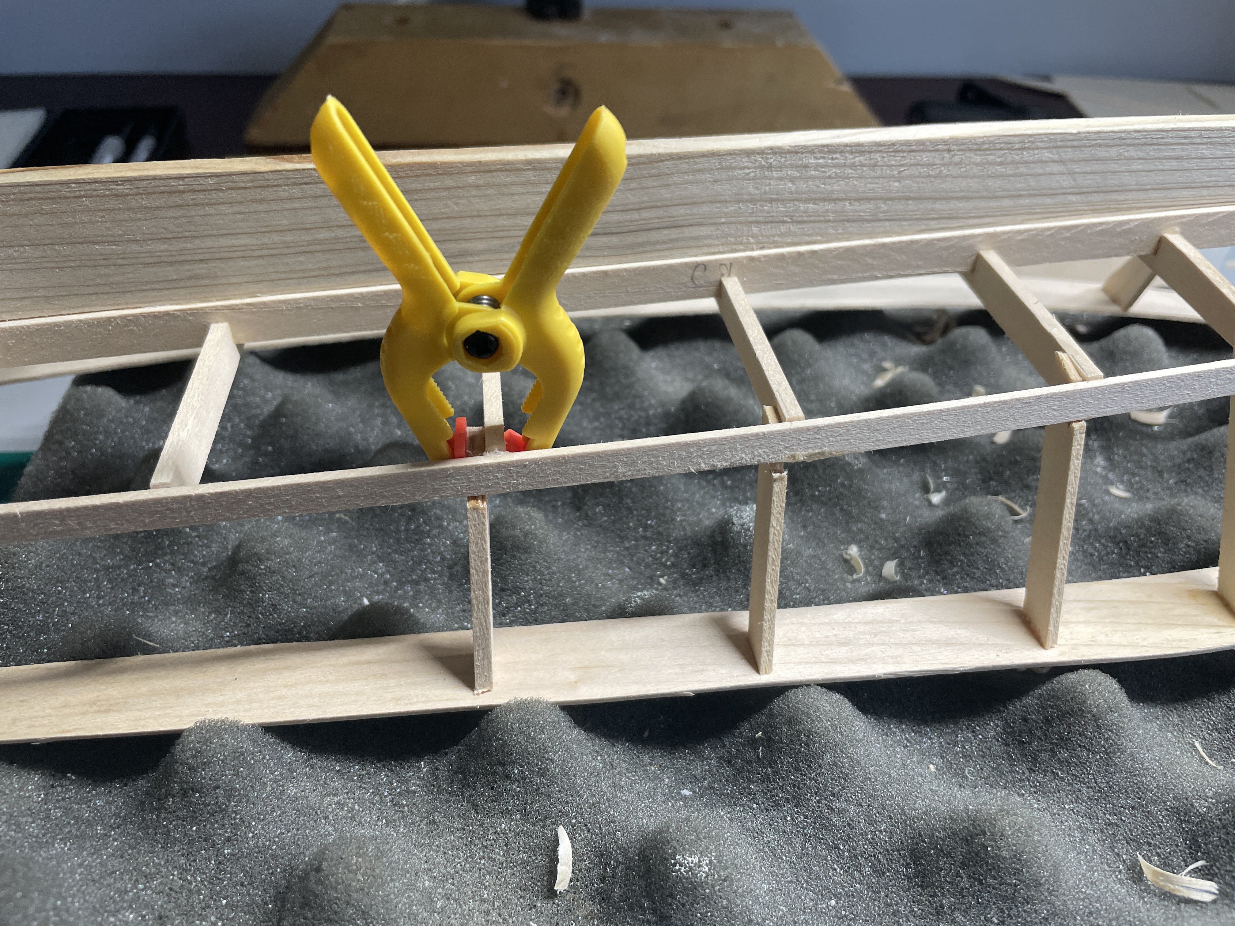

Cut and glued individual deck supports at each floor frame. The angle and position of these braces relative to the edge of the deck needs to be consistent so that when all planks are attached, their position relative to the deck is consistent.

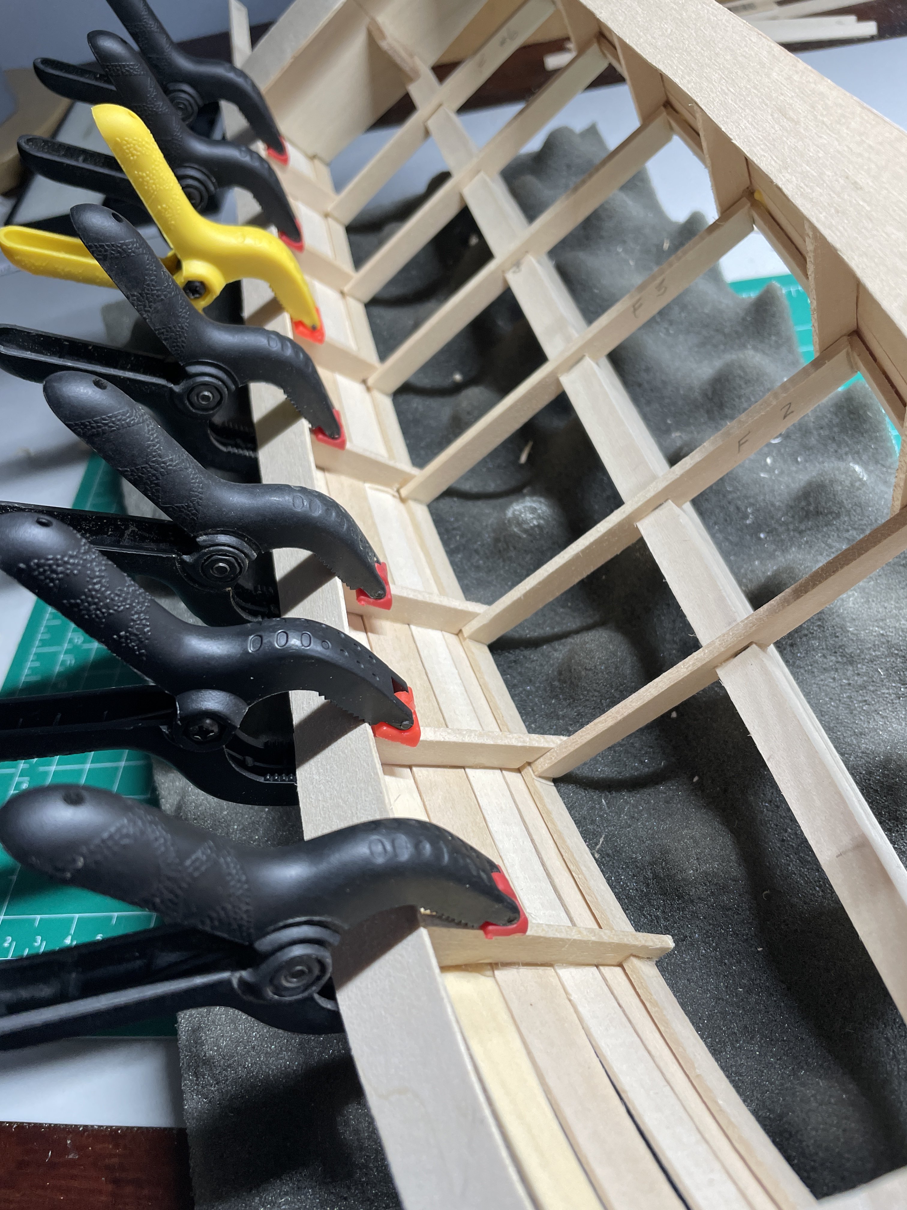

Installed one 1/2” hull plank to each side. In review of material provided, determined that 1/8” wide strips were provided instead of 3/8” wide. I will need additional 24” strips of 1/2” or 3/8” wide to complete the hull planks.   Time for this build ~4 hours.IMG_6394.thumb.jpeg.8d746c64c900f10e9d9128ad8c1f1199.jpegIMG_6395.thumb.jpeg.9aa5b5d9d0badc91dd48ffcde5e550d9.jpegIMG_6396.thumb.jpeg.ba8c1de703f0772bd1eee74c6c340268.jpegIMG_6397.thumb.jpeg.746b57a475f09fb6f9b2c60080c303ac.jpeg

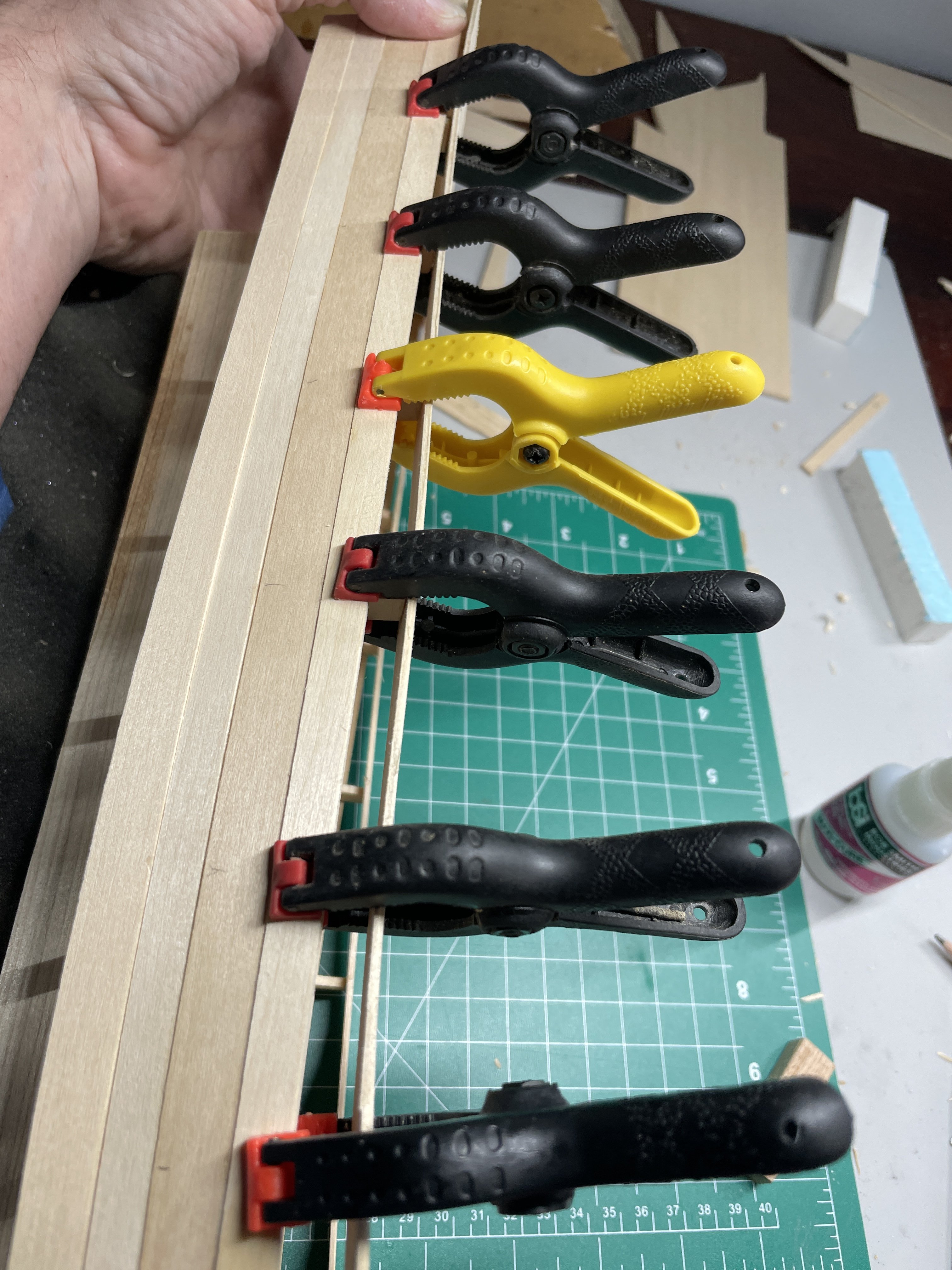

I finished installing hull planks using 1/8 inch strips cut down to fill the gaps. I’m not sure how much time to spend trying to cut strips to fill or should I just use model filler. Build time ~1 hour.IMG_6423.thumb.jpeg.761e88ec9d659e9b49c5598451c56611.jpegIMG_6424.thumb.jpeg.a5b1929a2c7e5522deaf61d5bd961461.jpeg
My humble opinion (and limited experience): I think cutting the filler planks for larger areas like you did in the top photo of the topic #11 is the better way to go.  That is because I get too carried away with applying filler in gaps and end up with a mess.  Your results may vary. I just think it's worth the time.
The bottom photo in topic #12 where you see the filler 'plank' looks very nice to me and will probably need minimal sanding to smooth it out.

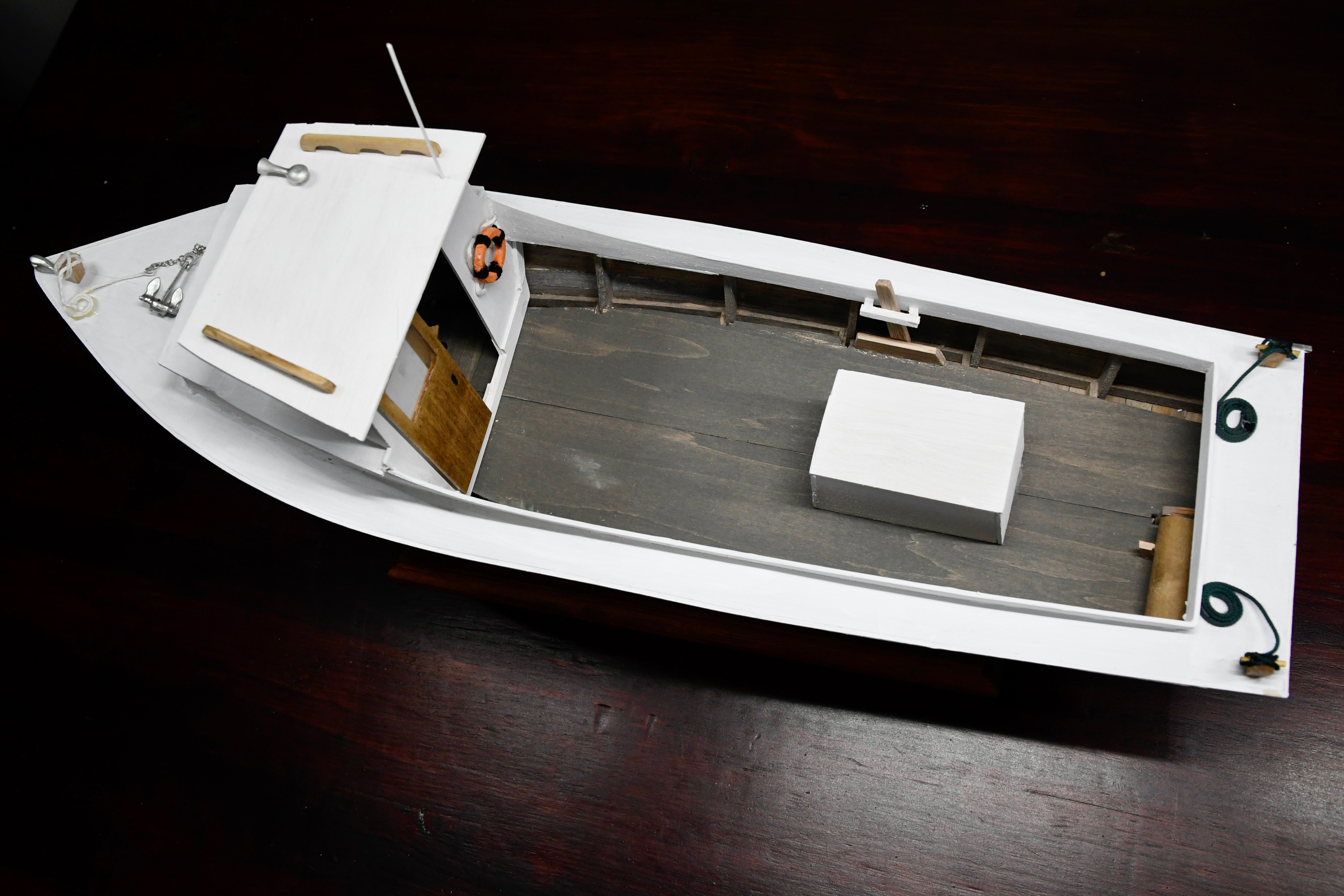

Next step is building the cabin. And looking at the instructions that’s all there was “build the cabin.“ Needing to have the cockpit floor installed before the cabin, I fit that and stained it using Graystone (General Finishes). I also stained the interior hull Aged Barrel (Minwax). I’ll need to clean up the bleed through on the outside of the hull.  Build time 1 hour.

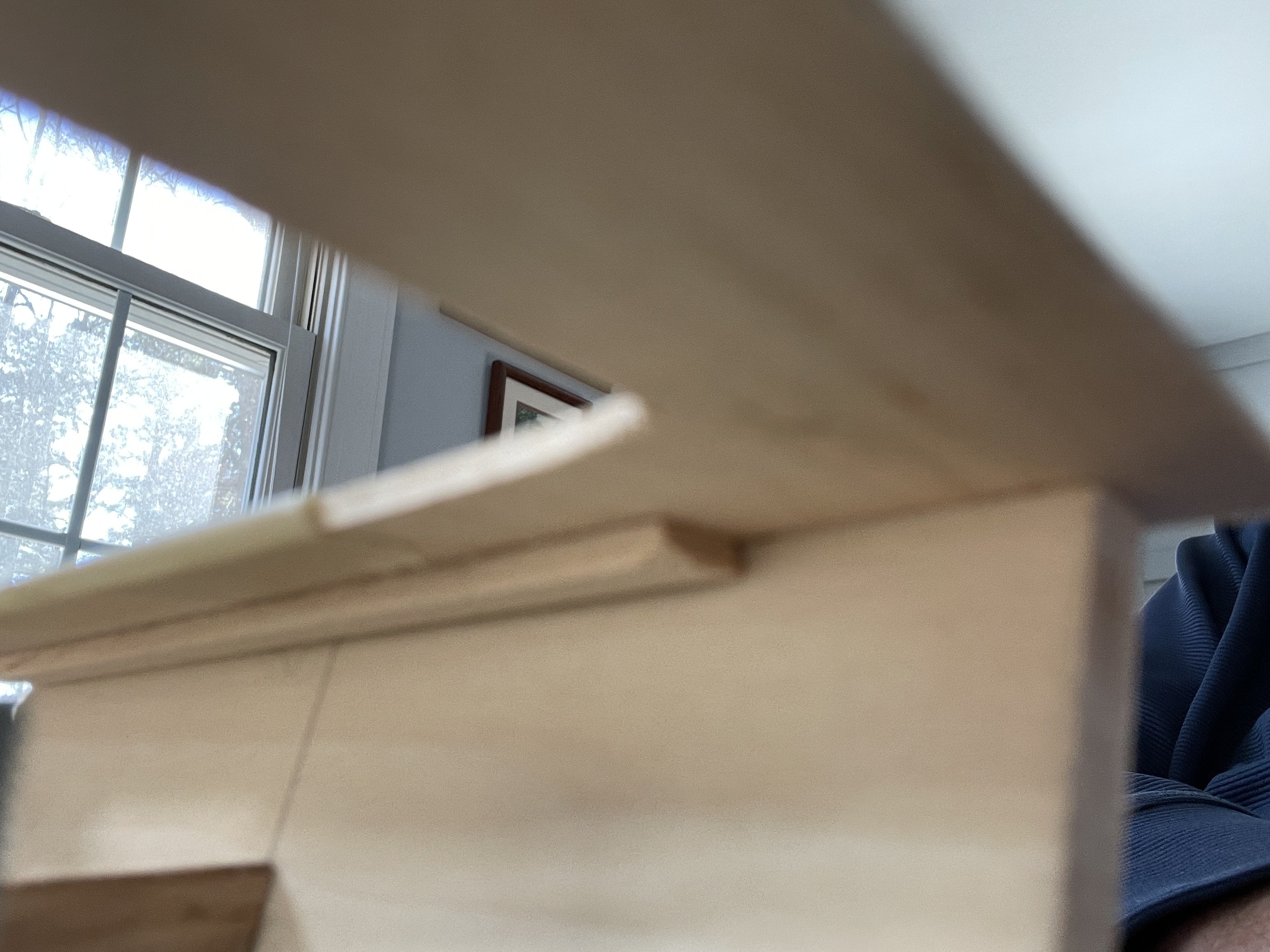

I prepared the cowling by soaking and shaping. I was concerned that trying to glue the cowling to a 1/16 inch thick deck board was gonna be next to impossible. I added support plates under the deck at the bow, stern, and on either side midship. It turns out that this worked OK – I could’ve used more support along both sides. Any overhang on the support can be trimmed flush with the cowling.

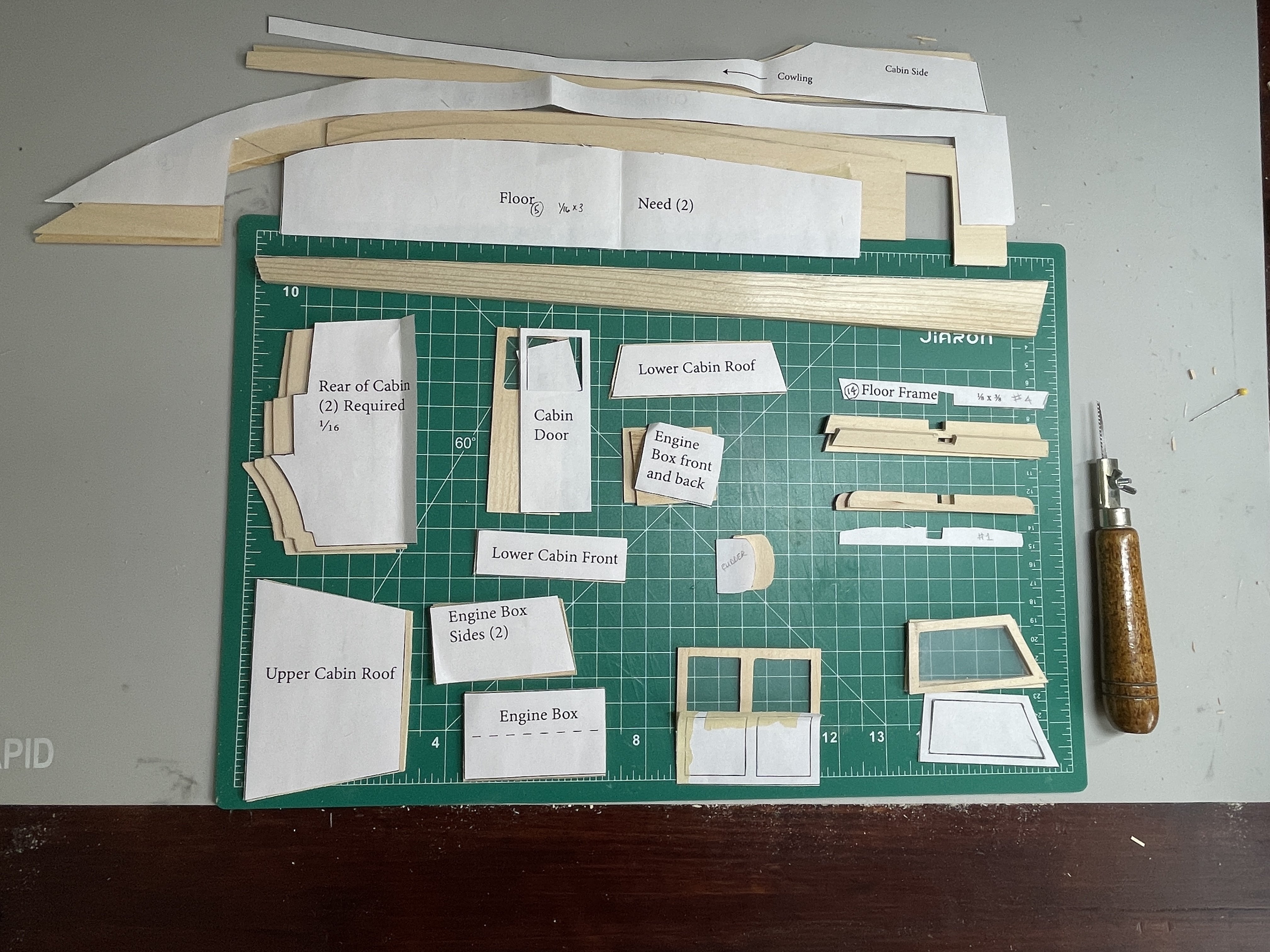

I had to recut the lower cabin front to fit as the plans were too short. As an afterthought, cutting many of the pieces early may result in ill fitting situations although this is the first to short (several have been long). The lower cabin roof was installed.
I needed to add to the roof in order to get back to the rear of the cabin and to have someplace for the front and side windows of the upper cabin to sit on.
Had to make adjustments to the rear cabin on each side to fit the hull and cabin roof line. I assembled the rear cabin and decided to cut a space for the door out of the center. I added supports on the top and bottom of the rear cabin in order to join the two pieces together.

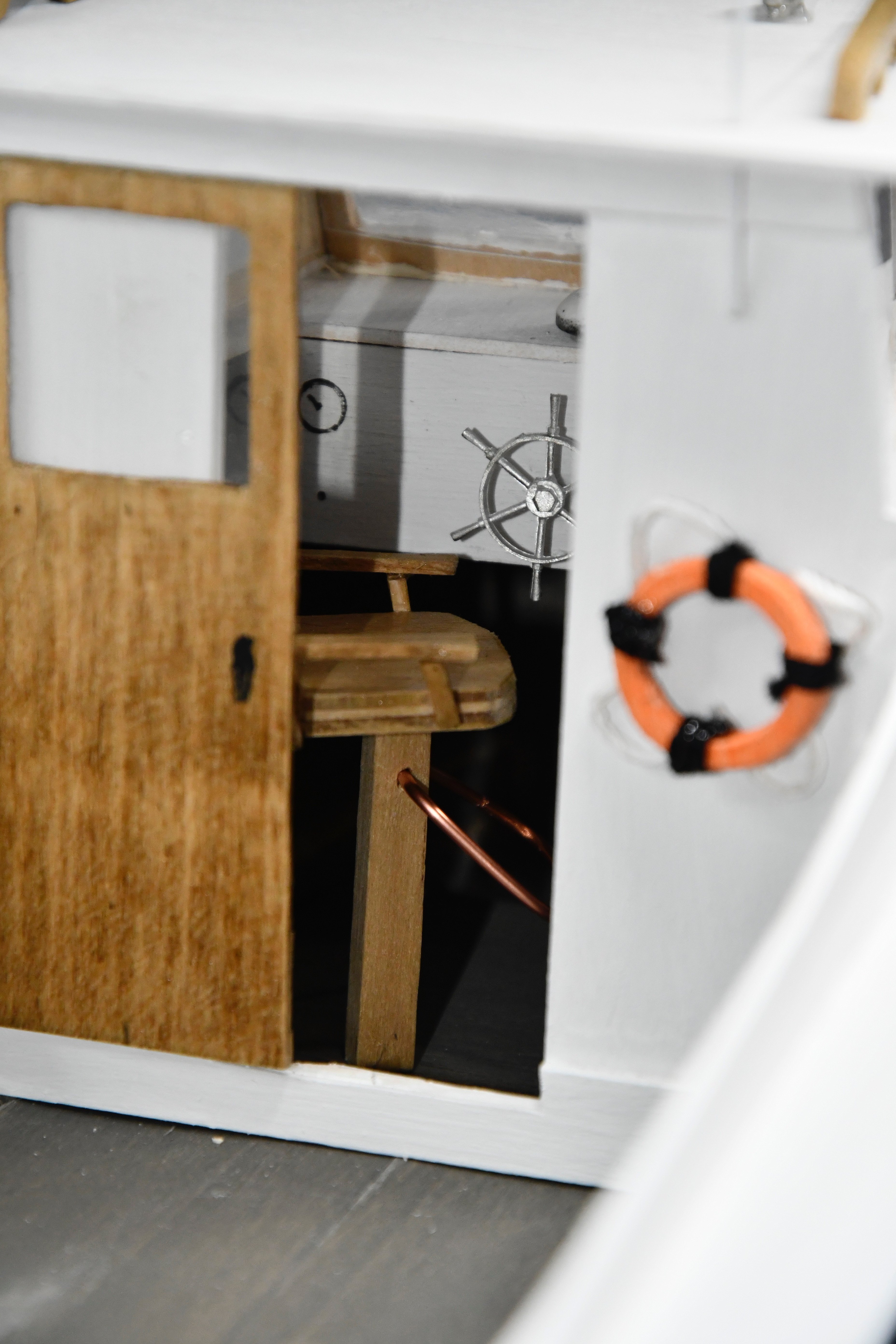

Before I finish up the cabin, I need to decide on what accessories for the cabin  I want if any. I’m thinking as a minimum a helm and seat in the cabin and also some pre-cut items for the deck. If that’s the case, I’ll have to find some to order before I complete the cabin build.
