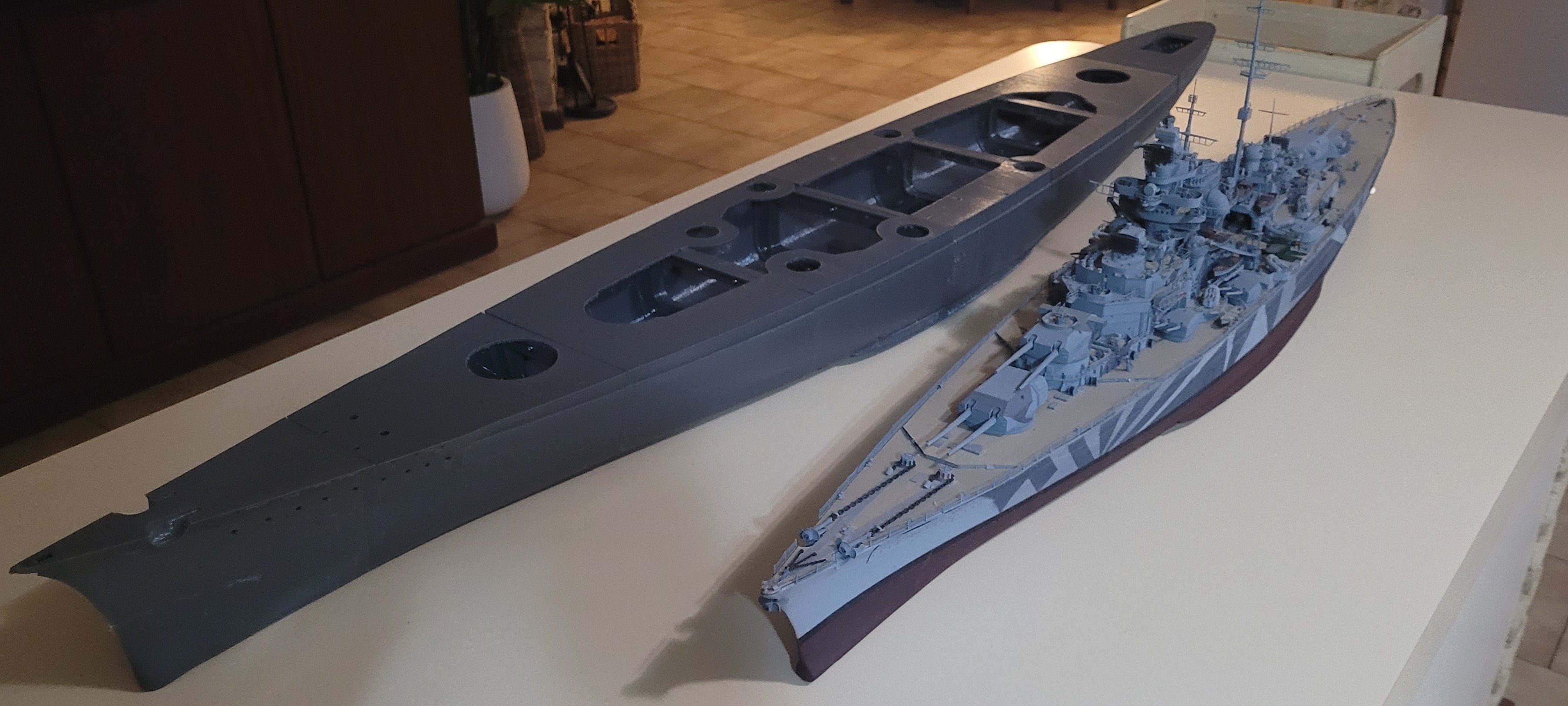

This is a complete re-design correcting some minor issues in the hull and making it more friendly for remote control use.
1:150 versus 1:200 doesn't sound like much of a difference.

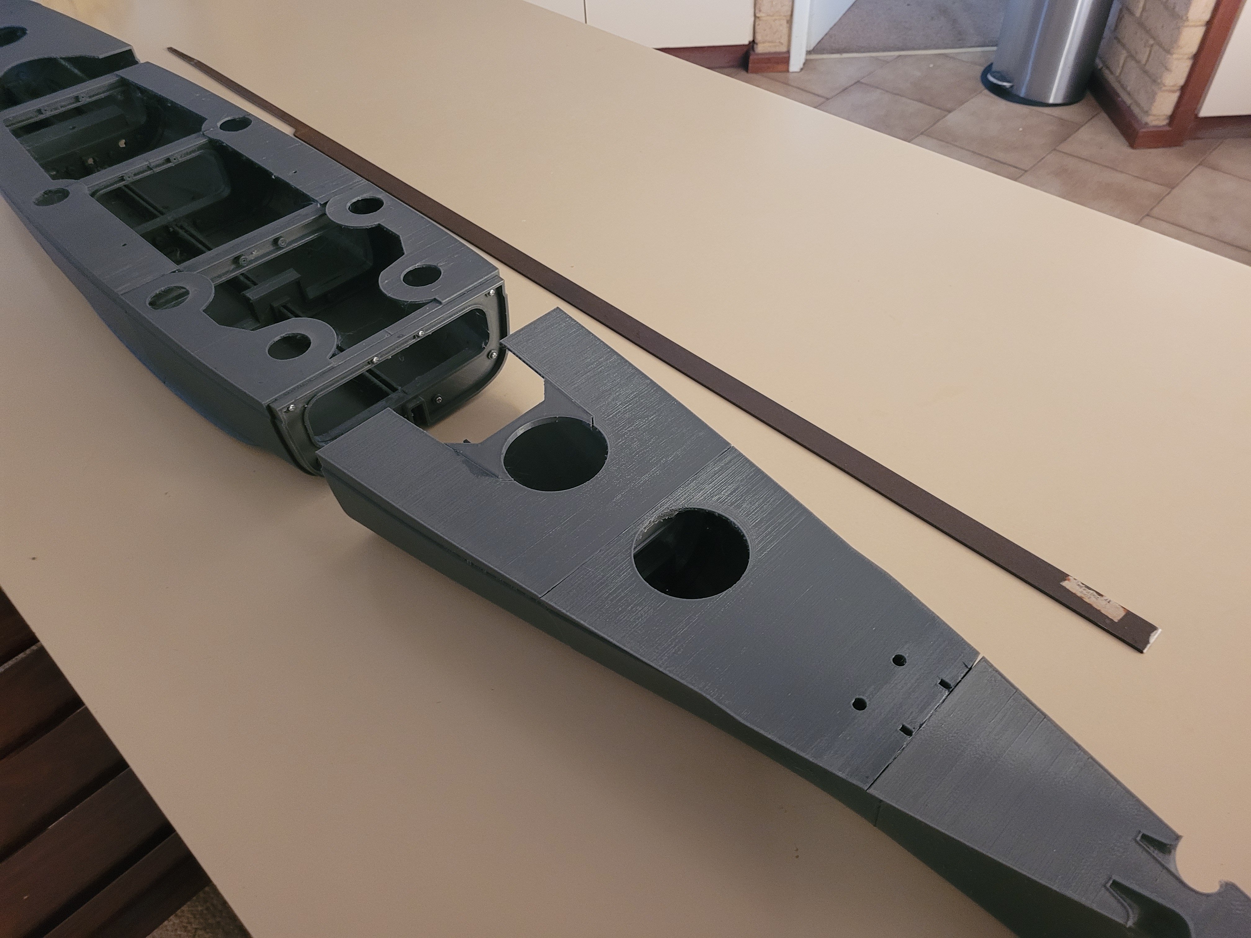

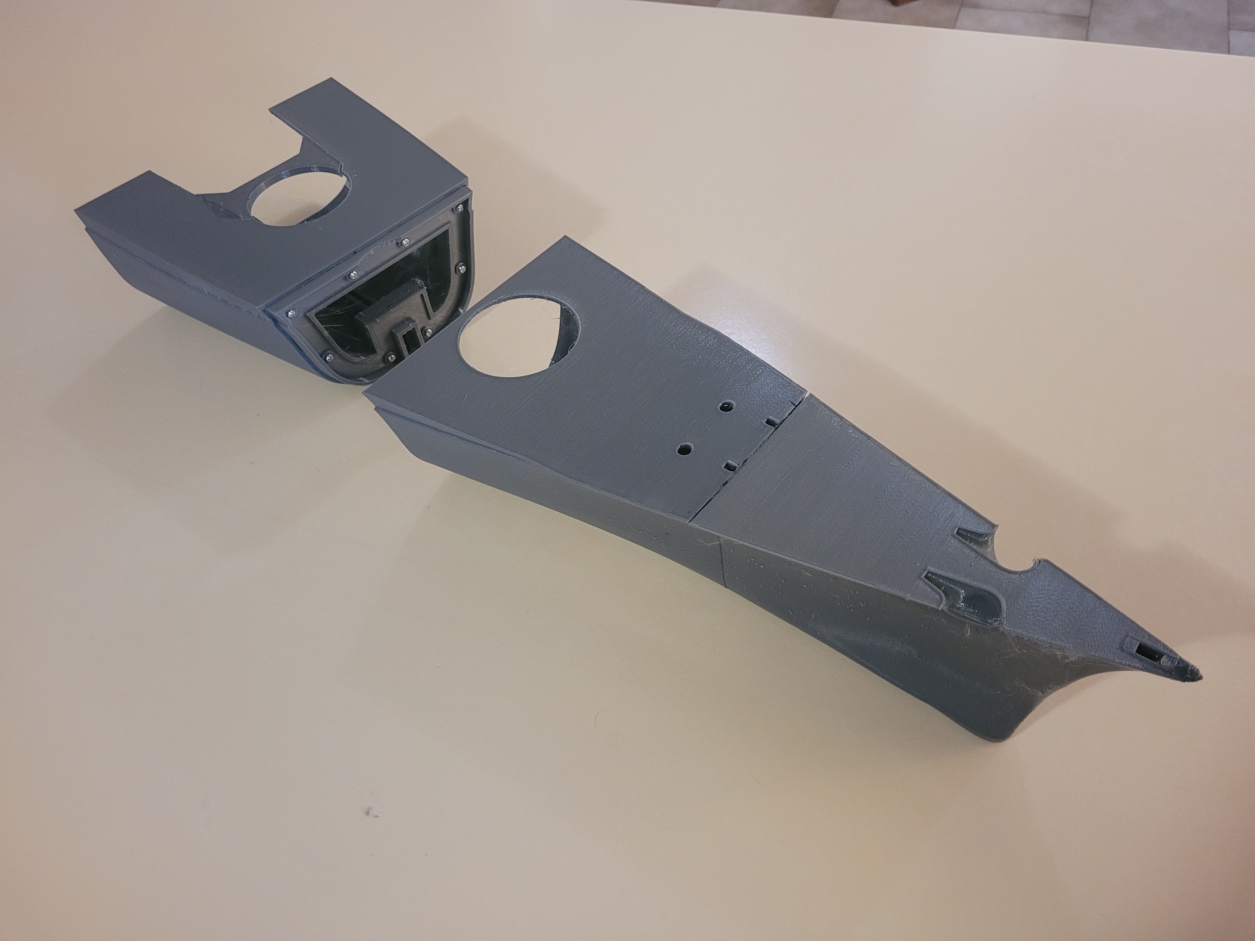

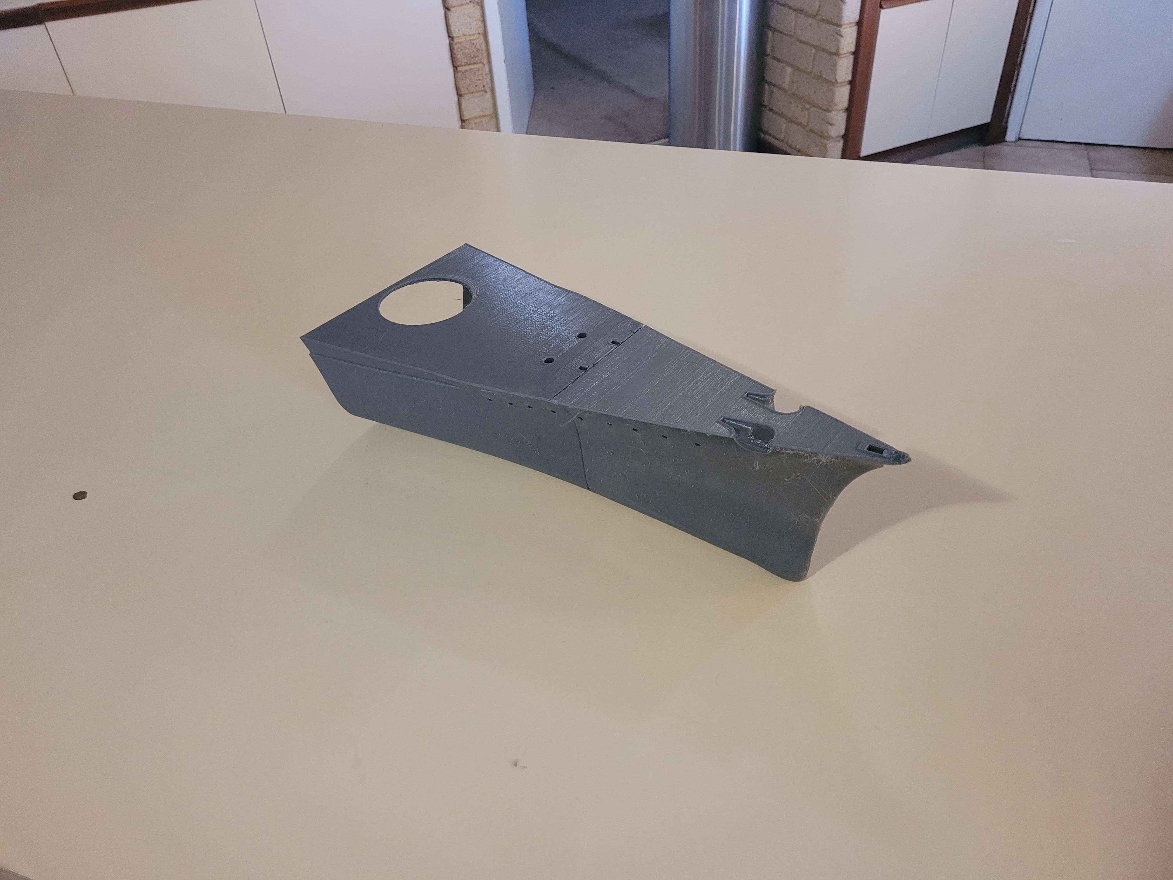

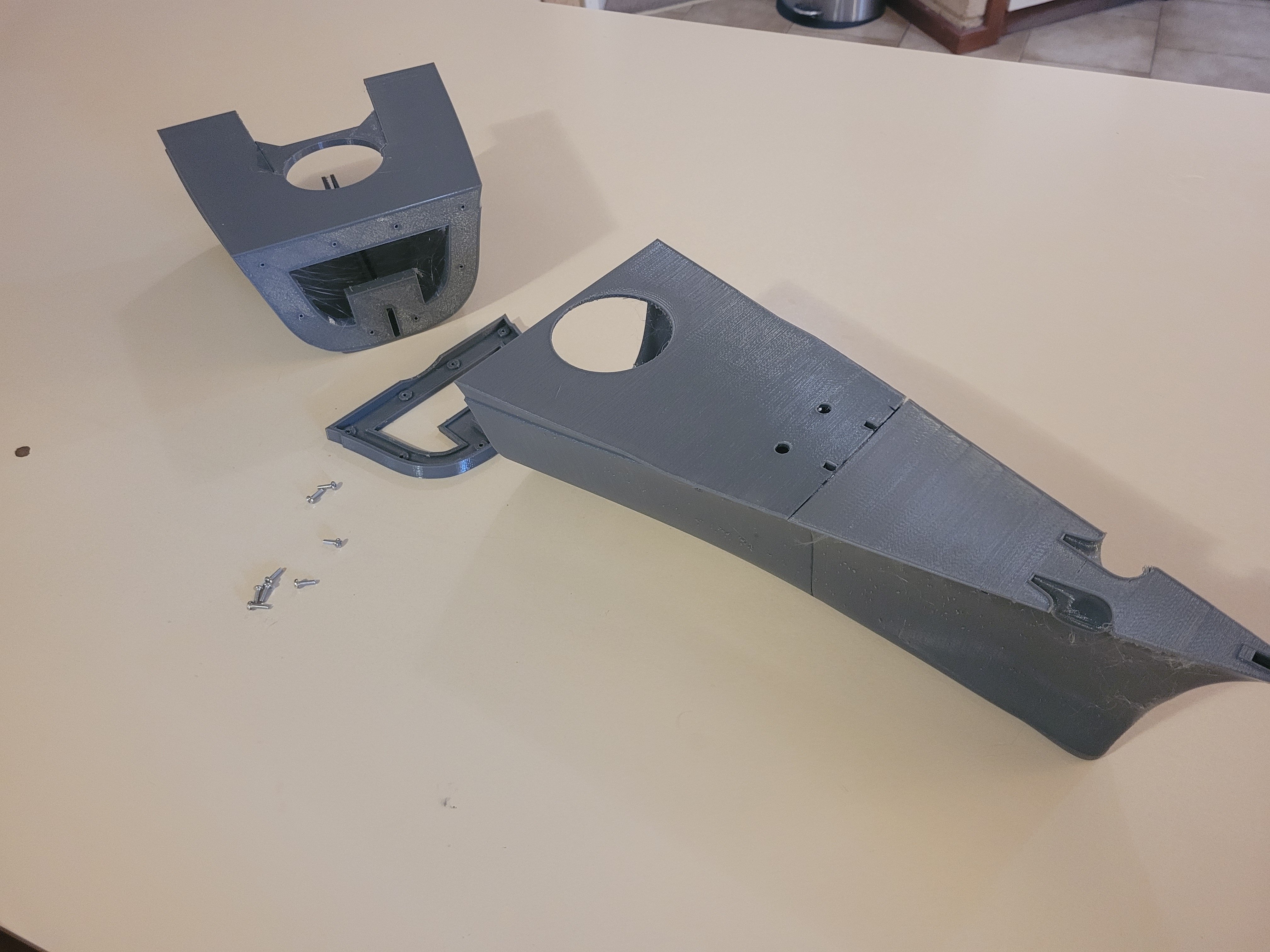

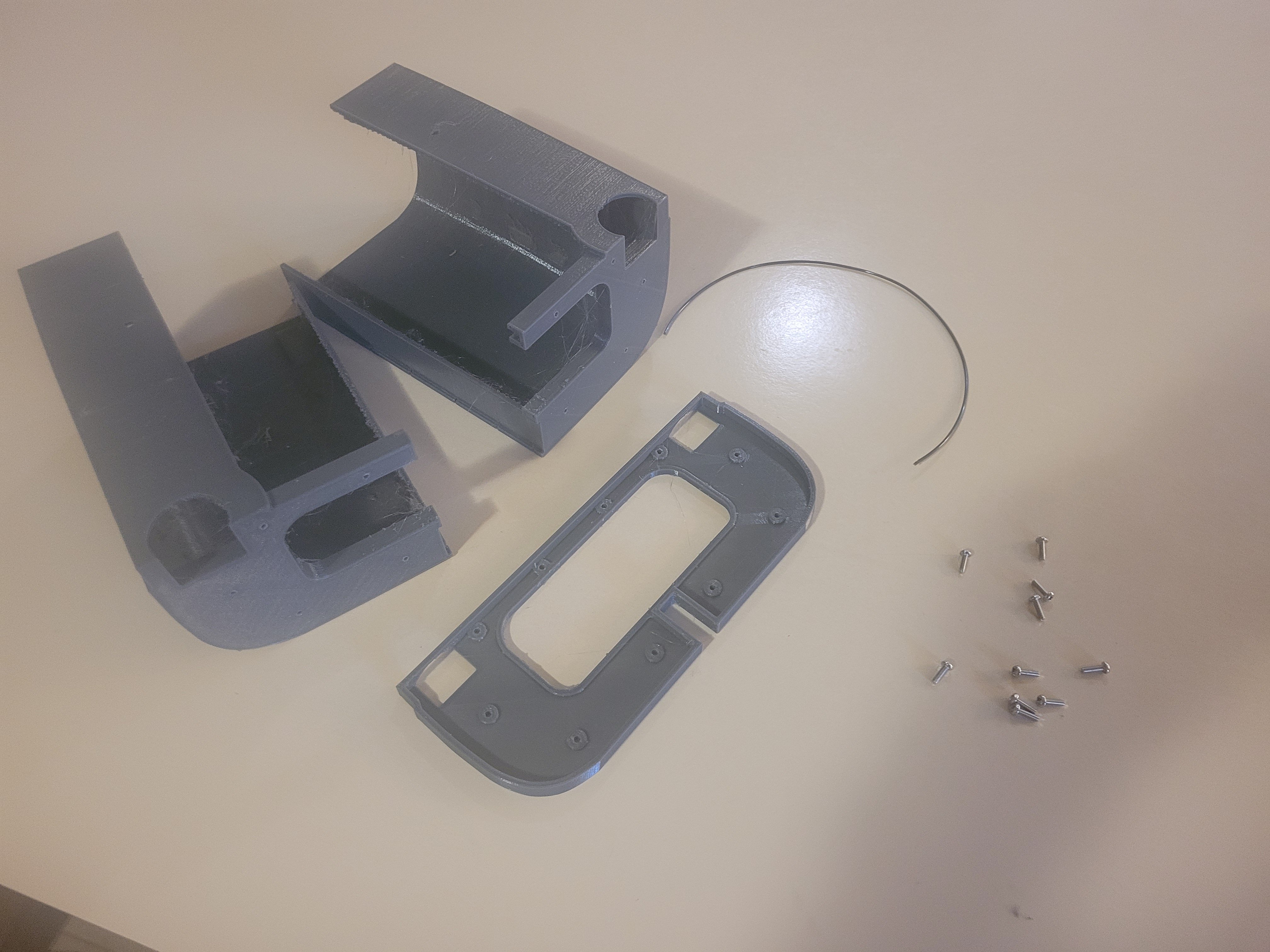

The hull is printed in PETG, I used a layer height of 0.3mm with organic supports on hull 1 and 8. I don't recall using supports on any of the other sections.
The hull pieces are printed from the bulkhead upwards so there is no issue with build plate adhesion even though some parts taper out from the first layer (Like Hull 2 in the picture below)
Hulls 1 and 8 are printed from the open end so there is a risk of instability due to the small amount of bed contact. I did have an issue with Hull 1 lifting slightly, you can see the gap when it is glued to hull 2. This is easily filled and the deck will be laminated with a detailed deck plate so should not visible going forward.

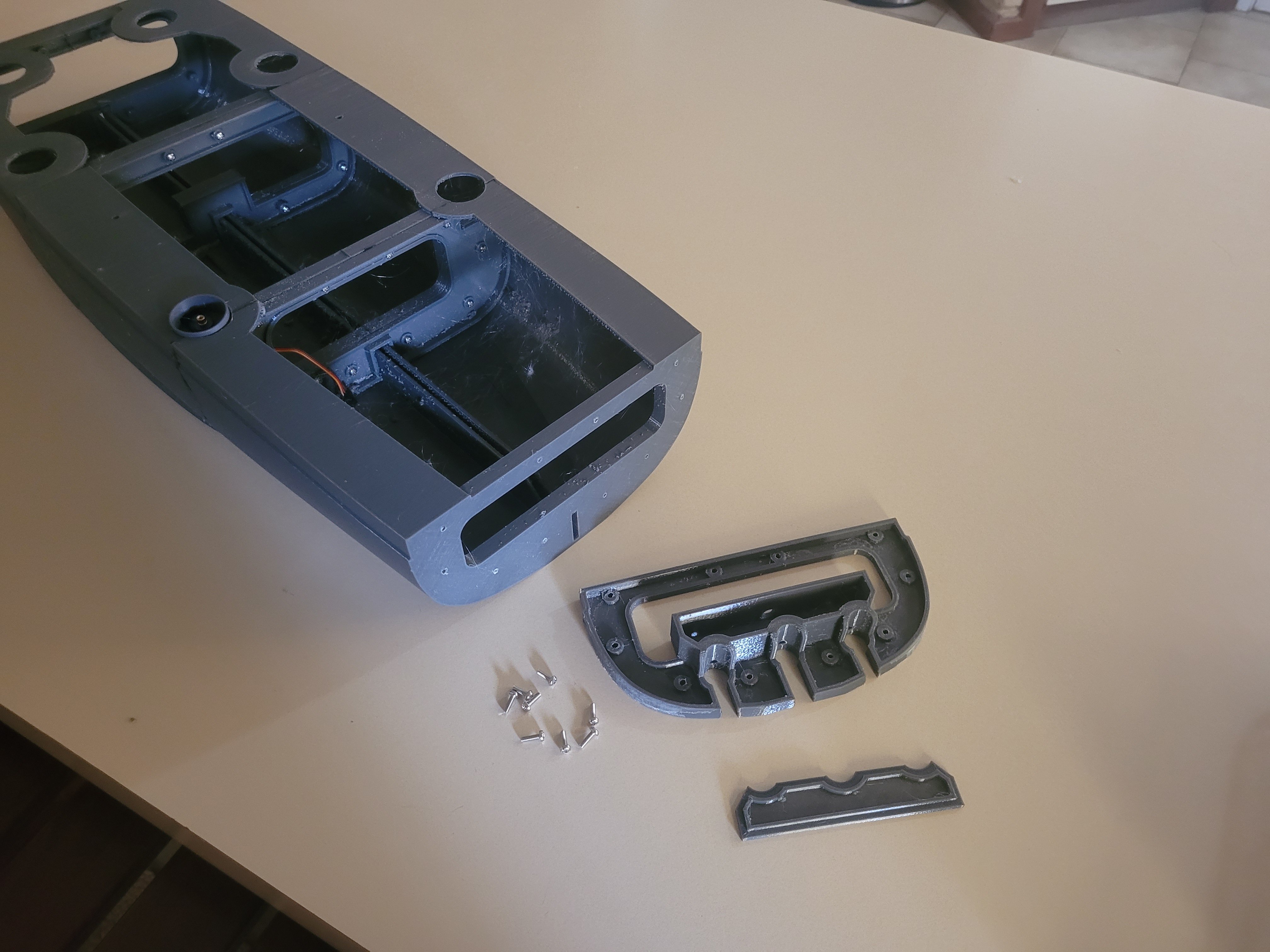

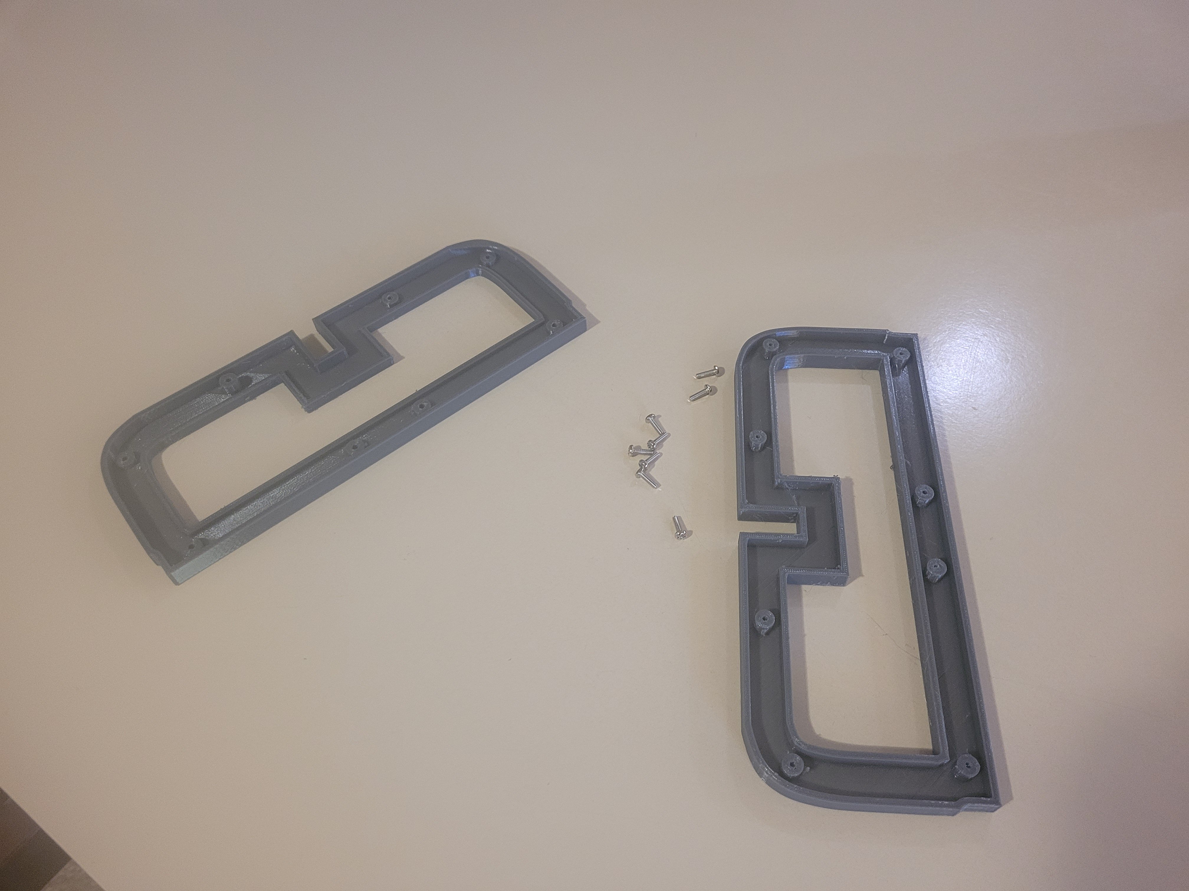

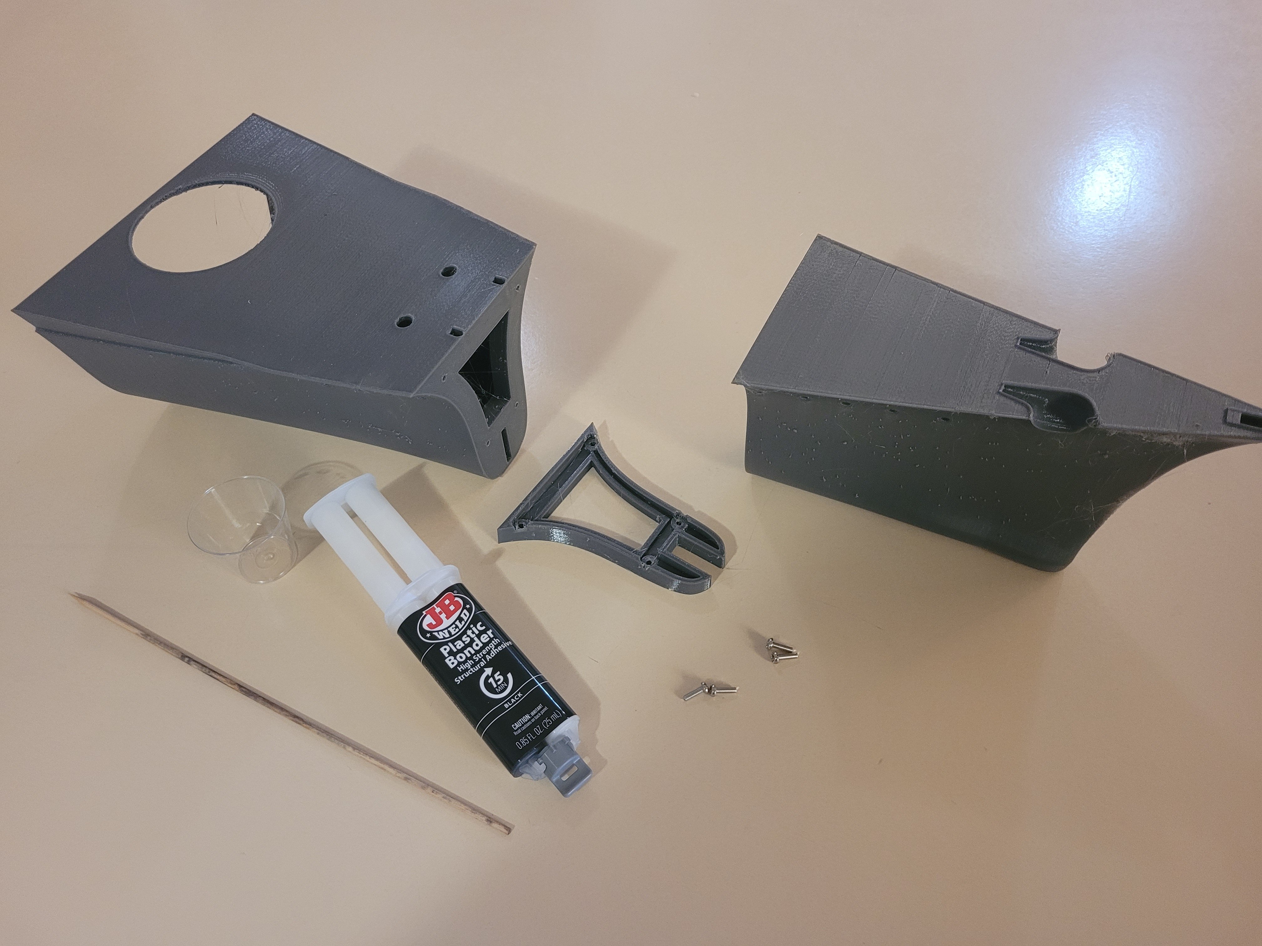

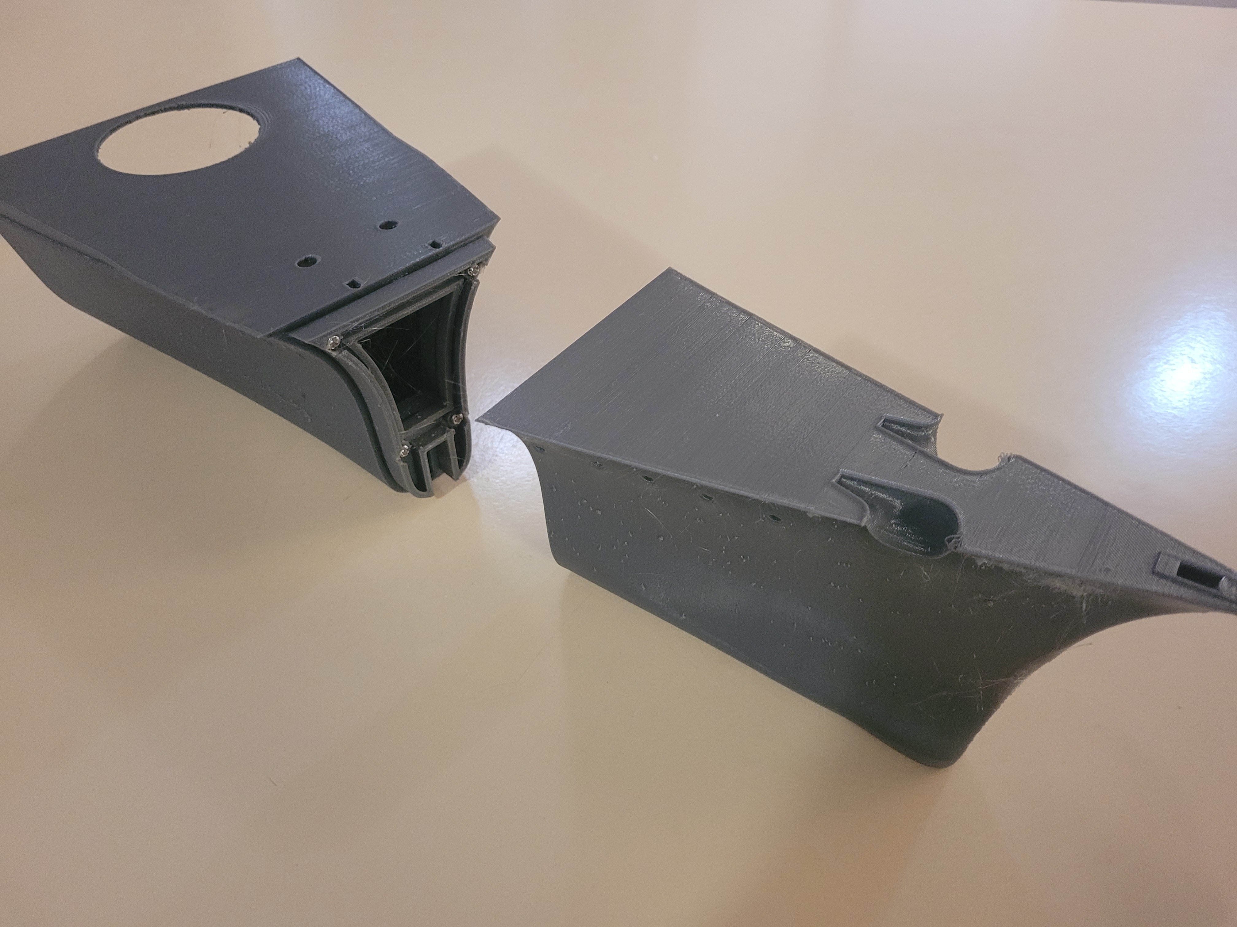

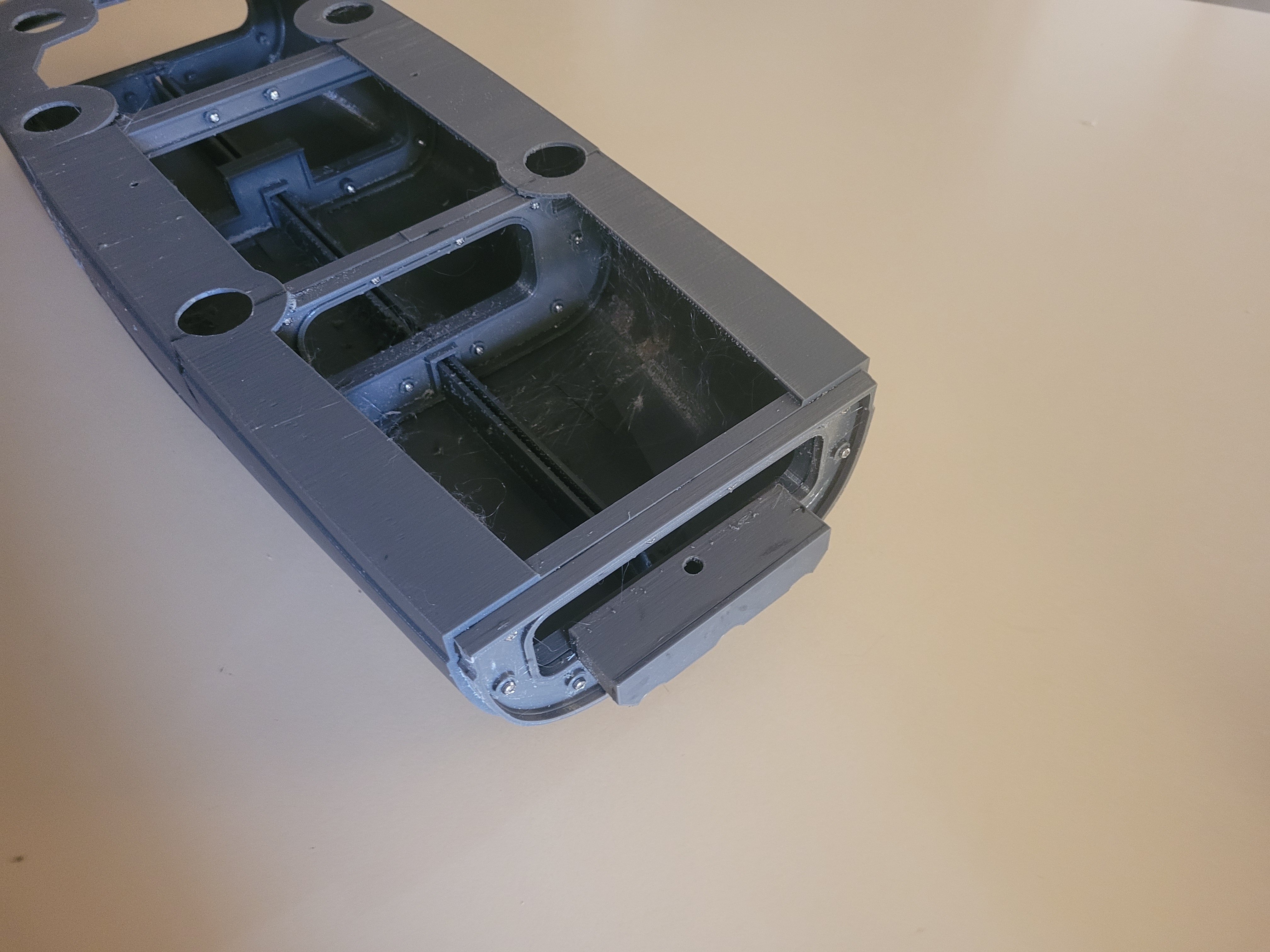

Mating hull parts have a joiner that is attached to the bulkhead on one of the parts using JB Weld and M3X10mm machine screws.
This is then JB Welded to the other part
Etc etc..

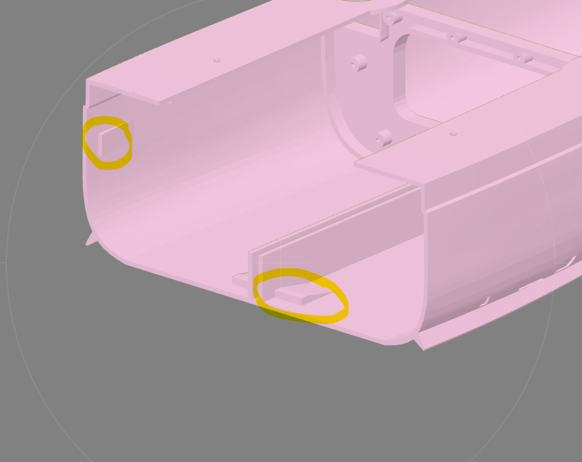

Hulls 4 and 5 were right at the extent of my printers bed in width so I elected to split the pieces with PrusaSlicer vertically using 1.75mm dowel joiners.
There is steel keel stringer epoxied into a channel at the centreline when the hull is fully assembled so the chances of this join leaking when assembled is low.
Hull 6 Bulkhead has an oil reservoir for the prop-shafts that will feed into the prop tubes which needs to be glued into position.

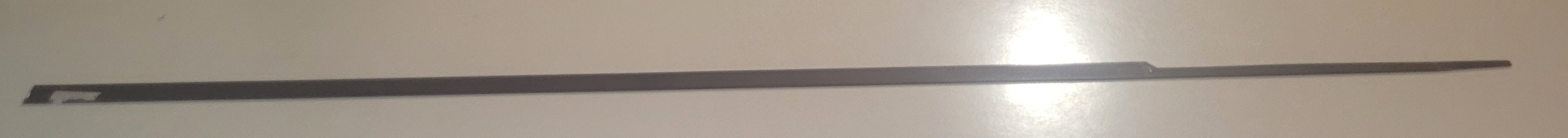

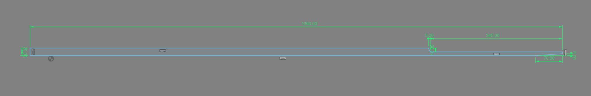

The keel stringer is a simple black steel M3X20mm flat bar with some angle grinder cuts to get the correct profile.
Measurements of this are not critical. If its 5-10mm shorter  or has the corners rounded to get a comfortable fit it is of little consequence. Weight is not an issue. This thing will need a ton of it to settle at the right level.

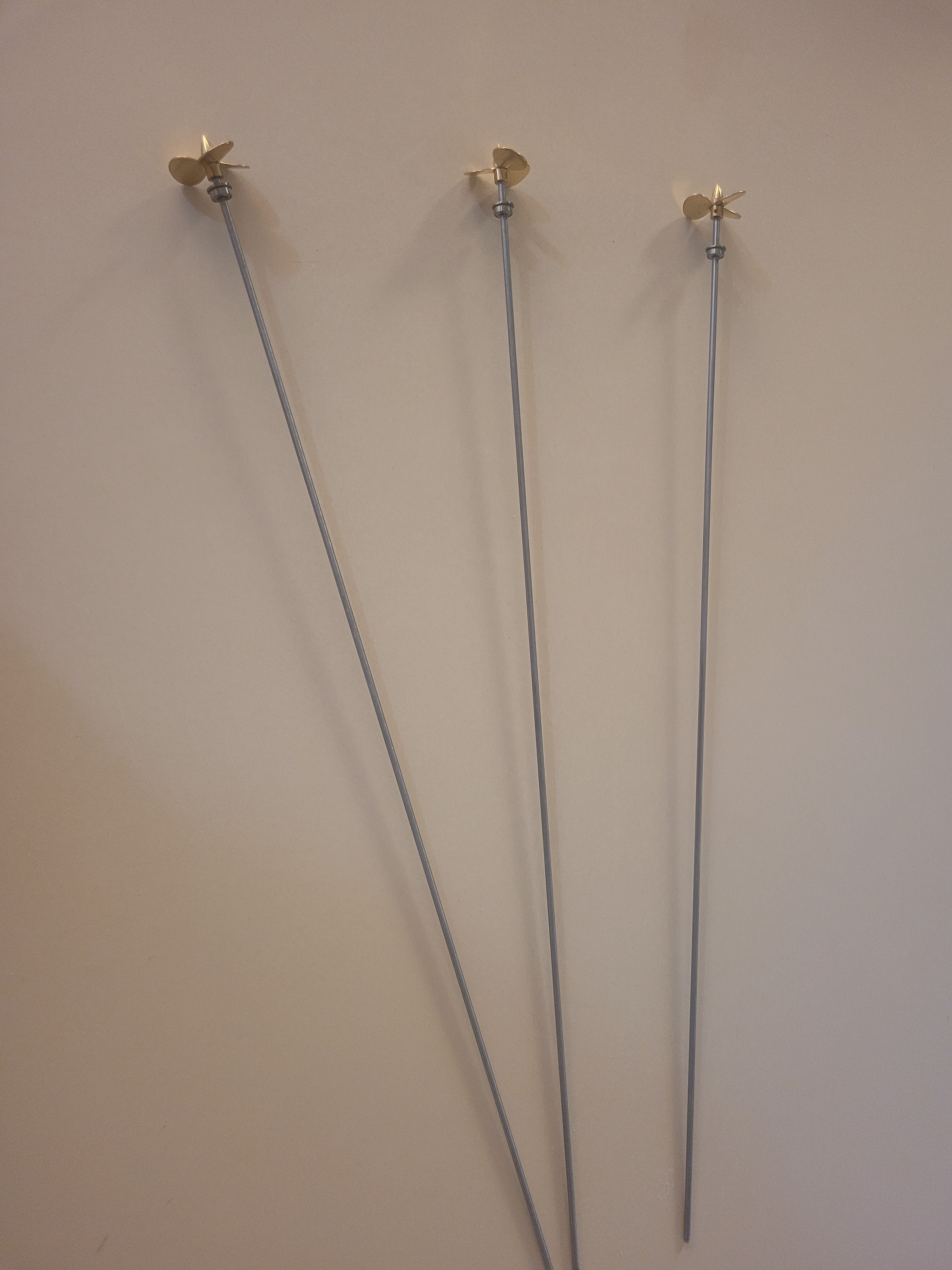

Prop shafts for this I decided on 3mm, although 4mm is an option, with a length around 440mm. An exact length I won't know until I actually couple them to the motors, so I made them 500mm for now.
Each outer shaft has 4 F693ZZ 3X8X4 bearings heat fitted to the propellor support and tube, while the centre prop has just 2 of the same bearings for the tube.
Doing your own shafts is straightforward but do not try it without a split HSS die (ask me how I know:)). I just did them by hand although I could have just as easily mounted them in the lathe with a die holder. If doing it by hand make sure you use a soft grip in the vice to secure the shaft while threading (Ask me again how I know, mine is just a squashed bit of 10mm aluminium tubing).
3mm stainless rod into 3mm bearings is a heat fitment. Freeze the shafts and put the bearings in the oven and after 10 minutes the bearings just slide right on. I choose to mount the shafts in a power drill and go back and forth with emery cloth to take a poofteenth off the shaft so the bearings slide on and off cold. Alternatively you could probably just use 2.8mm stainless rod.

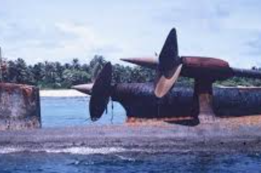

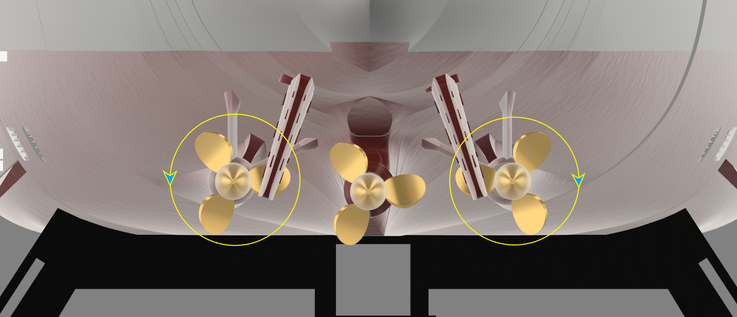

Two of the propellors (32mm)  are clockwise with the port screw counter-clockwise. Typically in multi screw naval vessels looking from the stern the outer tip of the blades travel down to reduce turbulence.
There are several photos of Prinz Eugen when there were 2 screws on the wreck. The ship is upside down, but the port screw (nearest) clearly rotates counter-clockwise when going forward looking from the stern.
Looking at you Steam - Ship Explorer - Bismarck :)

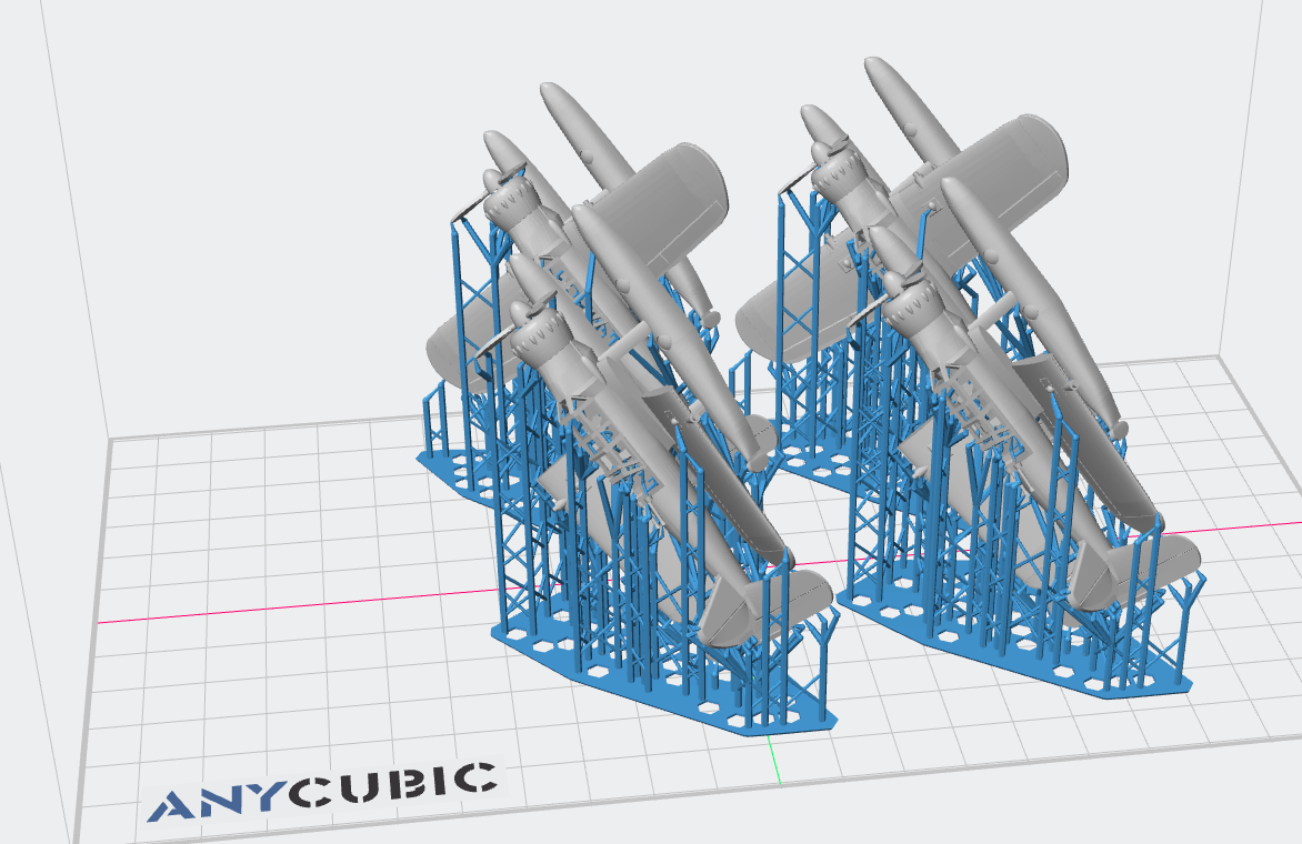

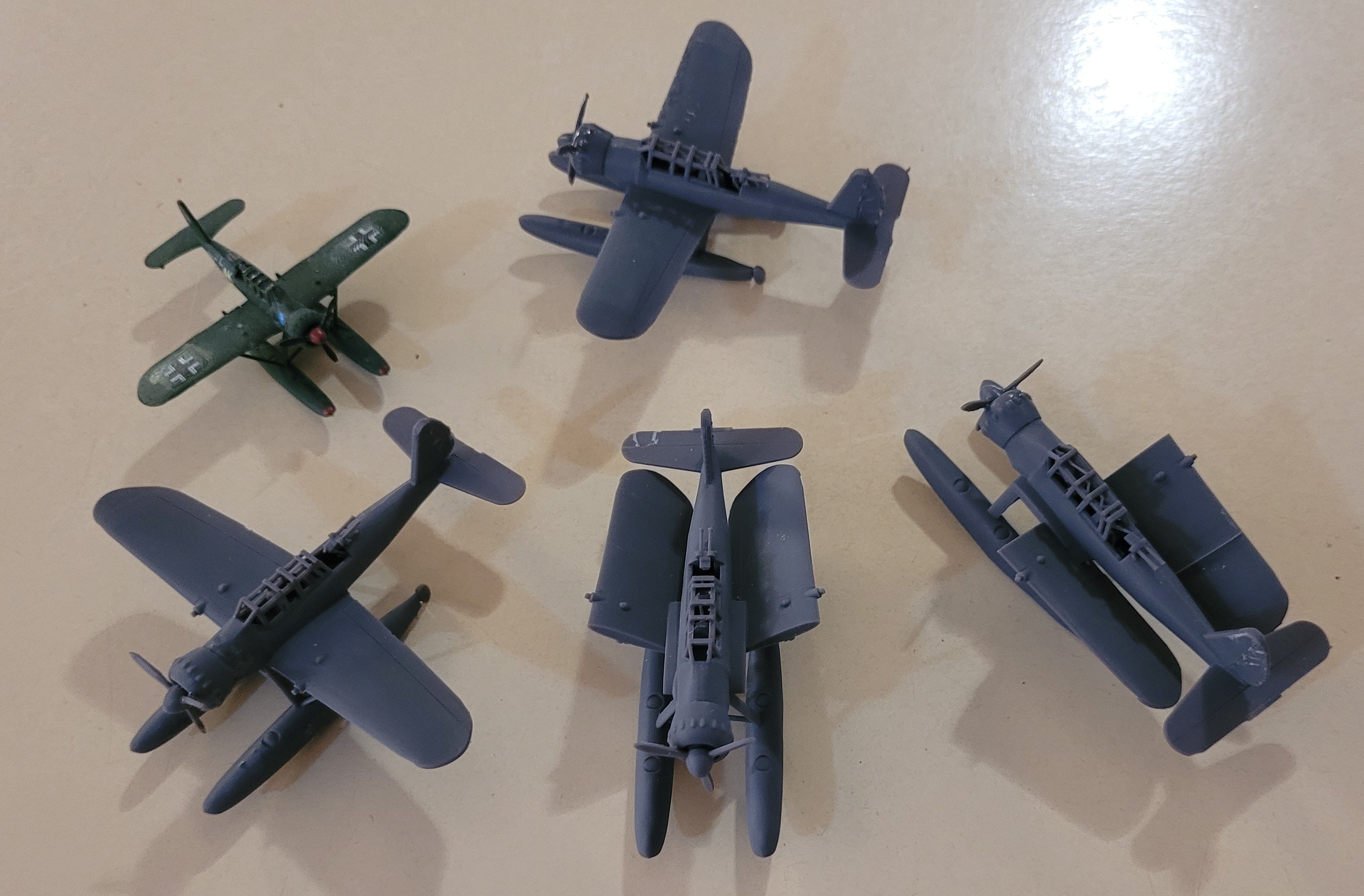

One of the many resin prints to come. I used an Anycubic M5S with a 0.05mm layer height and printed all 4 in one hit.
These just need to be painted up, decals applied and glass mimicked with Microscale Krystal Kleer. A 1:200 completed one included for reference.
My print layout resulted in some warped wing tips (Not bad, passable), next time I would probably try it like this:
