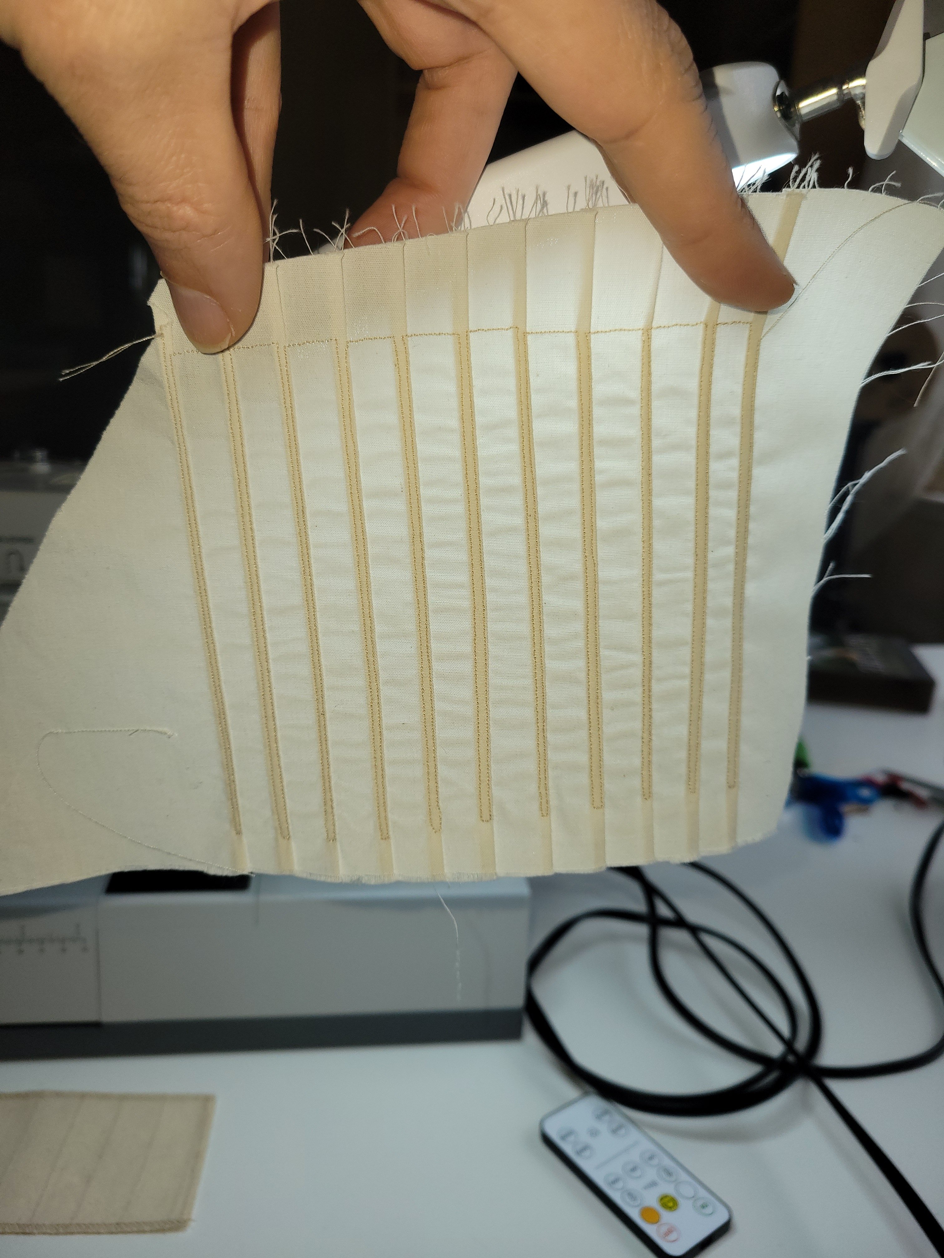

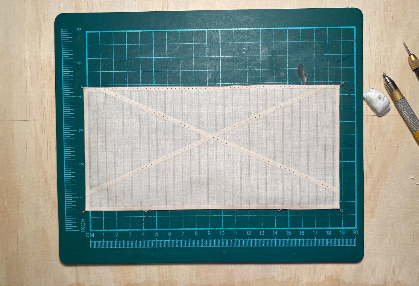

Looking for some community feedback.  I'm starting sails for my third build, Occre Apostle Felipe.  So approx 17th century spanish galleon from the silver fleet (mexico).  Each build I've tried a different sail strategy.  This time, I've used a lot of reference on this build from Wolfram Mondfeld's book,  historic ship models. I noticed he has a unique sail making approach that i don't think I've seen on any posts here.  His approach is press/steam a seam for each panel of the sail and then straight stich those seams.  So a bit more than just using the stitch to create the panels but an actual hem.  It's a lot of work.  Also quite hard to steam the small seams at a consistent width and sew the seams.  In my attempt, I have a 3mm overlap of fabric which results in about 12mm panels (model scale is 1:60).  Interested in everyone's feedback before I commit to all the sails.  This one is a spritsail.  First image is the sample before hemming the edges.  Second image is the sail supplied by occre which is of course to heavy a fabric.  Constructive criticism acceptable!
You've done a very neat job, but there is basic problem of scale. You mention 1:60, and one can never stitch that finely to be even close to scale, as well as the material is over scale thickness. What youa re doing is also very labor-intensive. Now, if that's the way you want to do it, read no further!

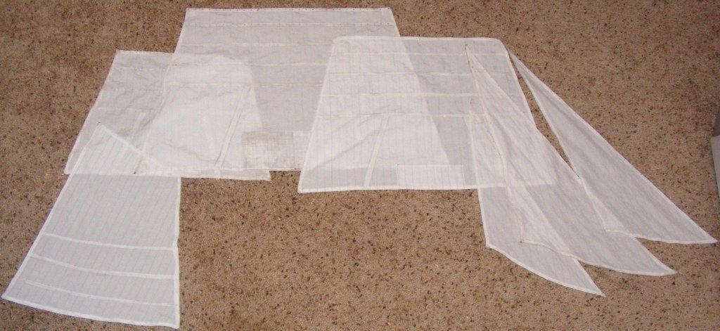

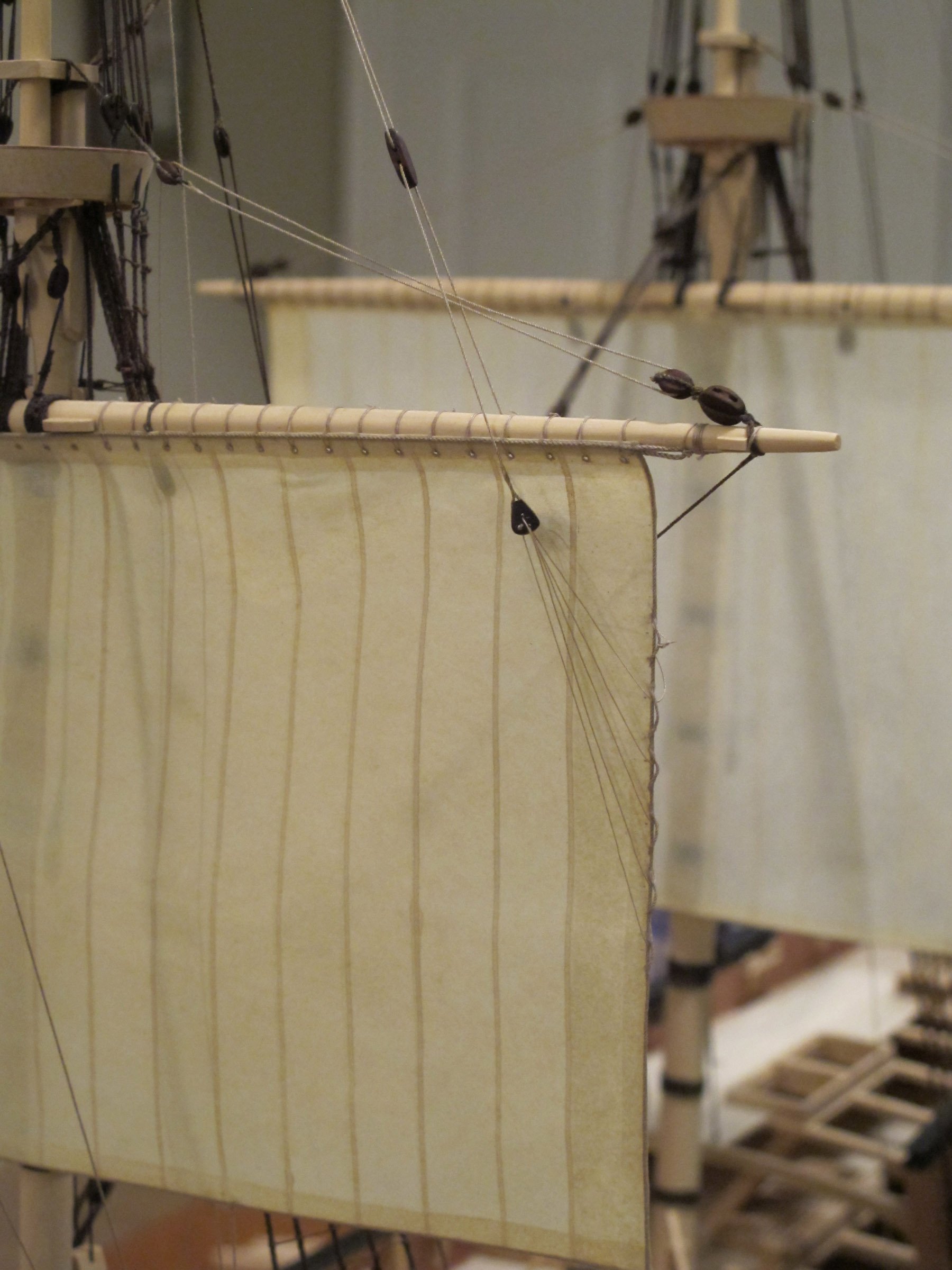

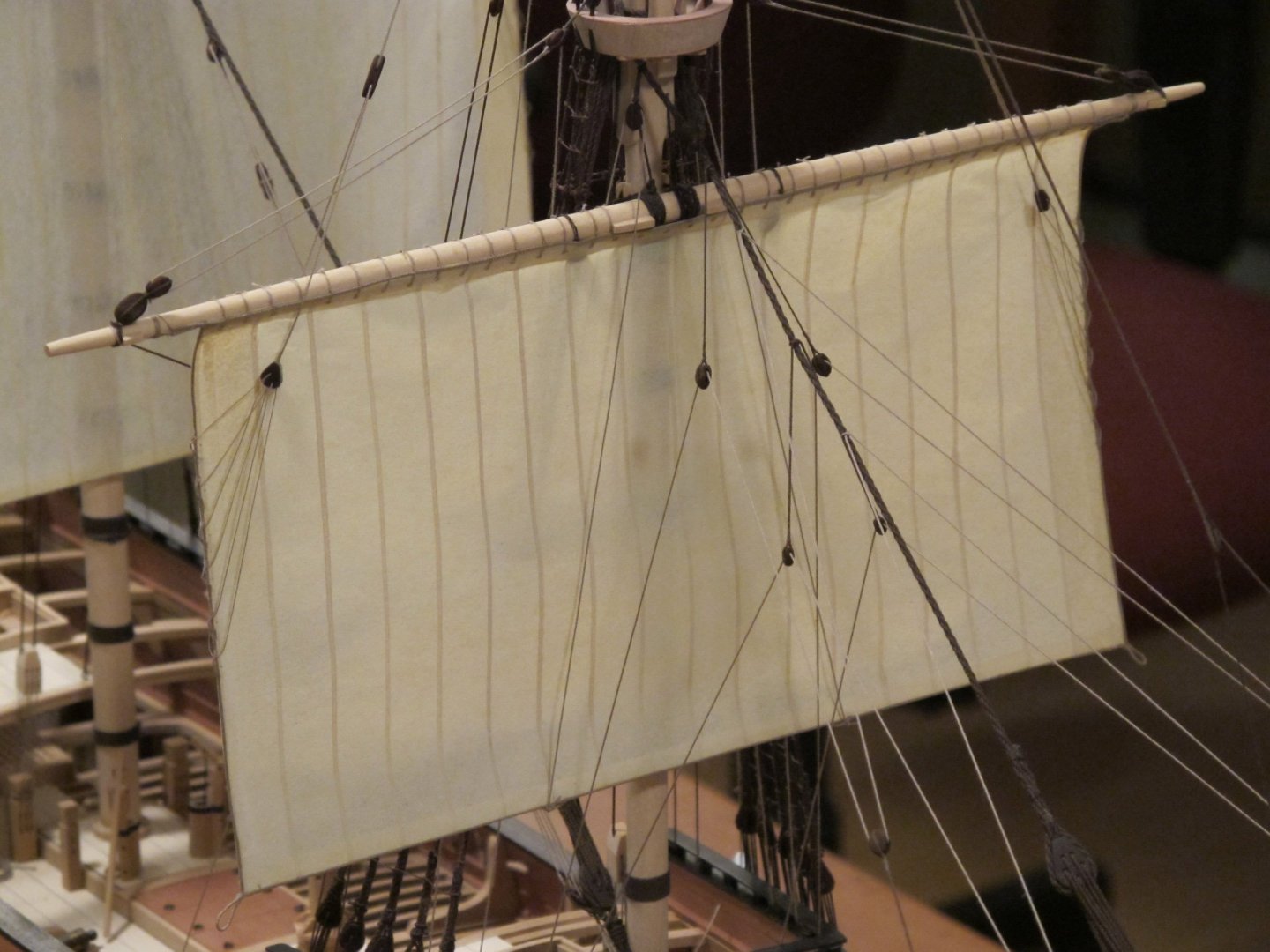

A better way, IMHO, is to uses the material called SilkSpan. It is essentially a thin but strong paper product. The overlaps can be easily simulated with acrylic paint applied using a bow pen. The reinforcing edges are glued and rope also applied using white glue or matte acrylic varnish. An example is pictured below at 1:48 scale. Instructions of how to make sails using this technique are available through SeaWatchBooks:
https://seawatchbooks.com/products/swan-iv-sail-making-supplement-from-the-revised-and-expanded-edition-by-david-antscherl
Sails1.thumb.jpg.09e5539790878542202ce127e4774eeb.jpgSails2.thumb.jpg.eae878e2576ea6bd9cc04d197c200b3c.jpg

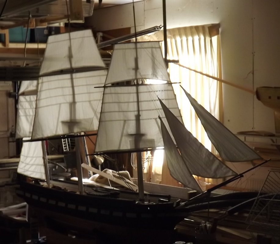

Maybe I should add some other evidence. These are modern synthetics (probably Dacron) and machine-stitched but a full-size squarerigger's sails, when in use, can look like:
Note that seams, tablings and various reinforcing pieces are visible but stitches are not.
Alternatively, in close-up, the same sails look like:
Hand-woven flax-and-hemp sailcloth would have a much coarser weave, of course (and hand-stitching doesn't give the zigzag effect). But an argument for the Silkspan approach anyway.
Trevor

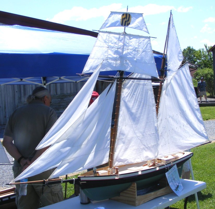

There's way too much focus on seams.  The only reason you see seam on real sails is because the material is 4 layers thick (2 layers on modern sails), and that's when the light's behind them.  When the light's in front, you see the shadow of the edge of the seam.  Most kits run in the 1:64 to 1:48 scale range, for square-riggers, and the thread in those stitch-line "seams" scale from the size of a man's wrist, up to nearly the size of a tow-cable in diameter! - a bit much to represent a shadow.
Most kits, especially the ones anyone can afford, are filled with parts-bin parts that don't match the model's scale, and wind up being much to oversized and clunky looking, and in rare cases, under-sized and diminutive.  Any sail-cloth included is usually some burlap looking muslin scraps from an upholstery shop, that sometimes they run some anchor-chain through to save you the time making them even worst.

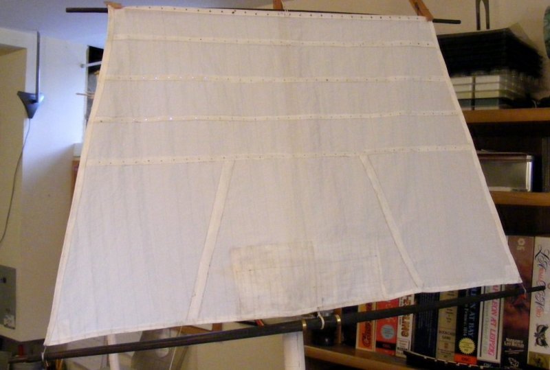

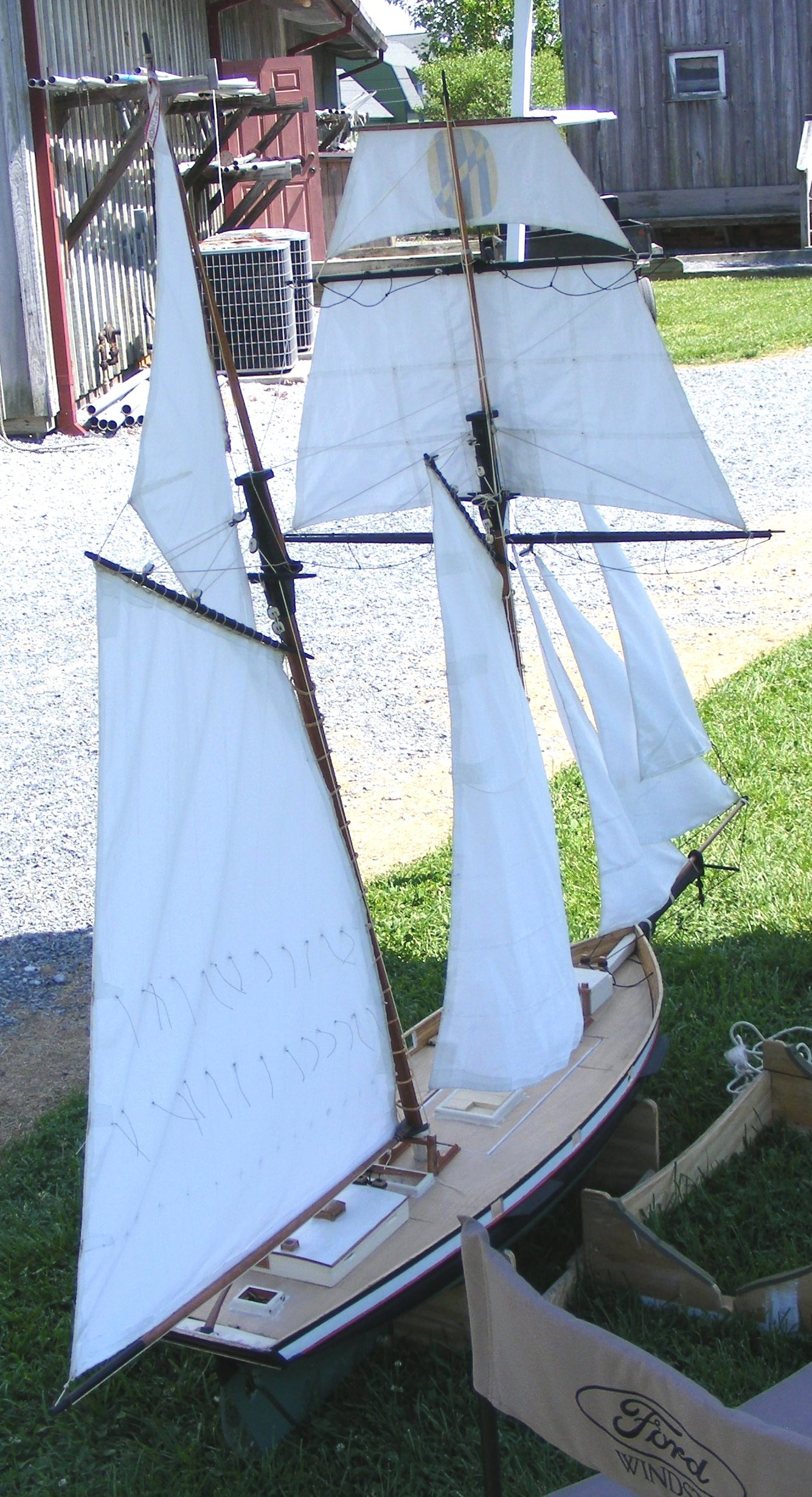

I personally think the best approach is to imply the shadow of the seams by drawing them on with fine (.03) permanent marker.  I draw all the seams on one side of the sail, and again on the other side just a little off to imply seam width.
My sails may not be fair representations as they are made for working models at a larger scale than most static models (1:36 & 1:20), but they do show the effect of drawn seams, which also don't suffer from puckering the way stitch-line seams do.
(click the pics till you get them full-size)

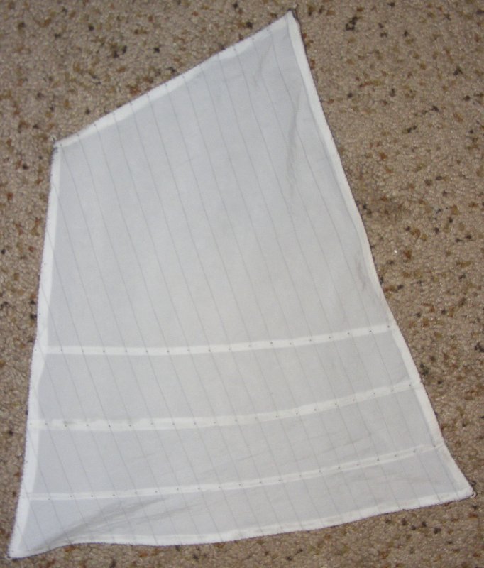

Thank all, I keep reading about silkspan but hadn't gotten the initiative to give it a try yet, in part becuase it's not a available at the local hobby shop and there seems to be a lot of "fake named" products online? Just trying to find a good supplier thats in the US (darn tarrifs!) thats not overcharging or excesive shipping.

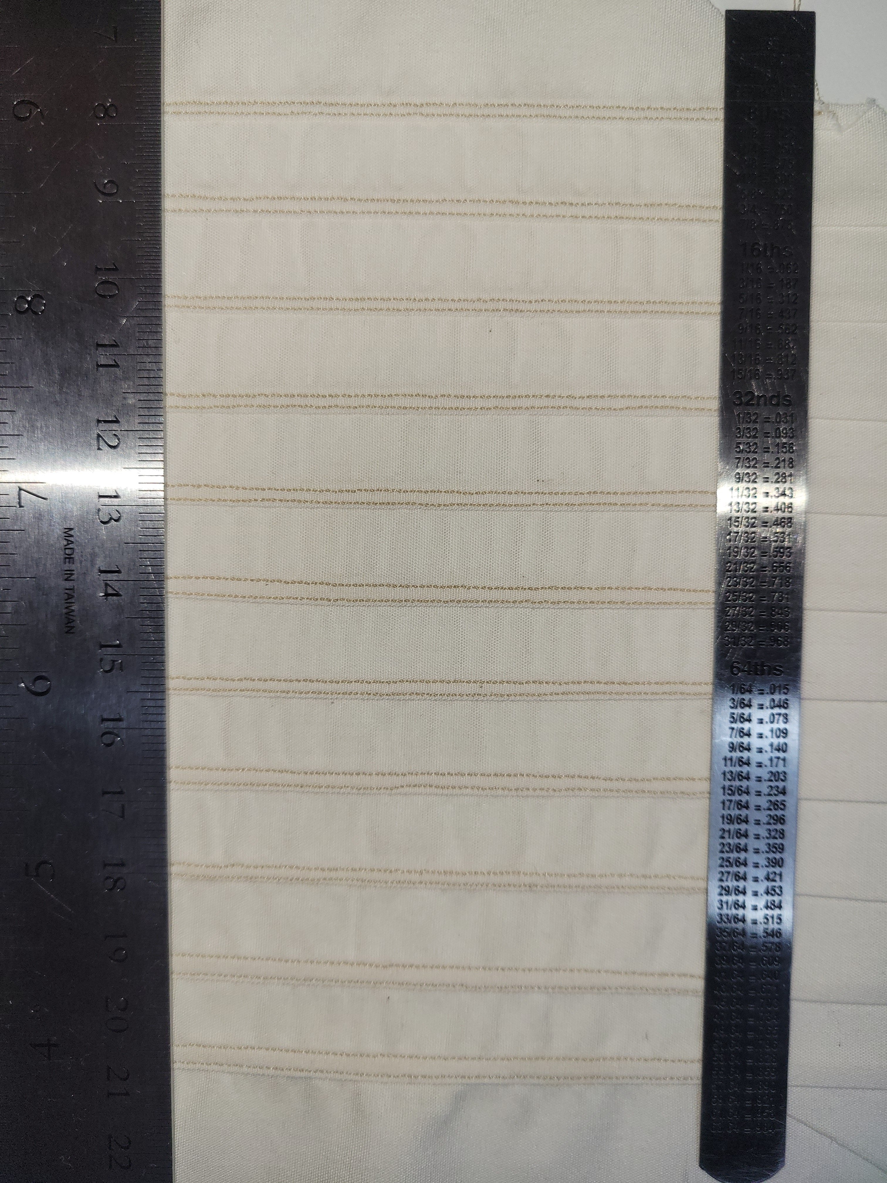

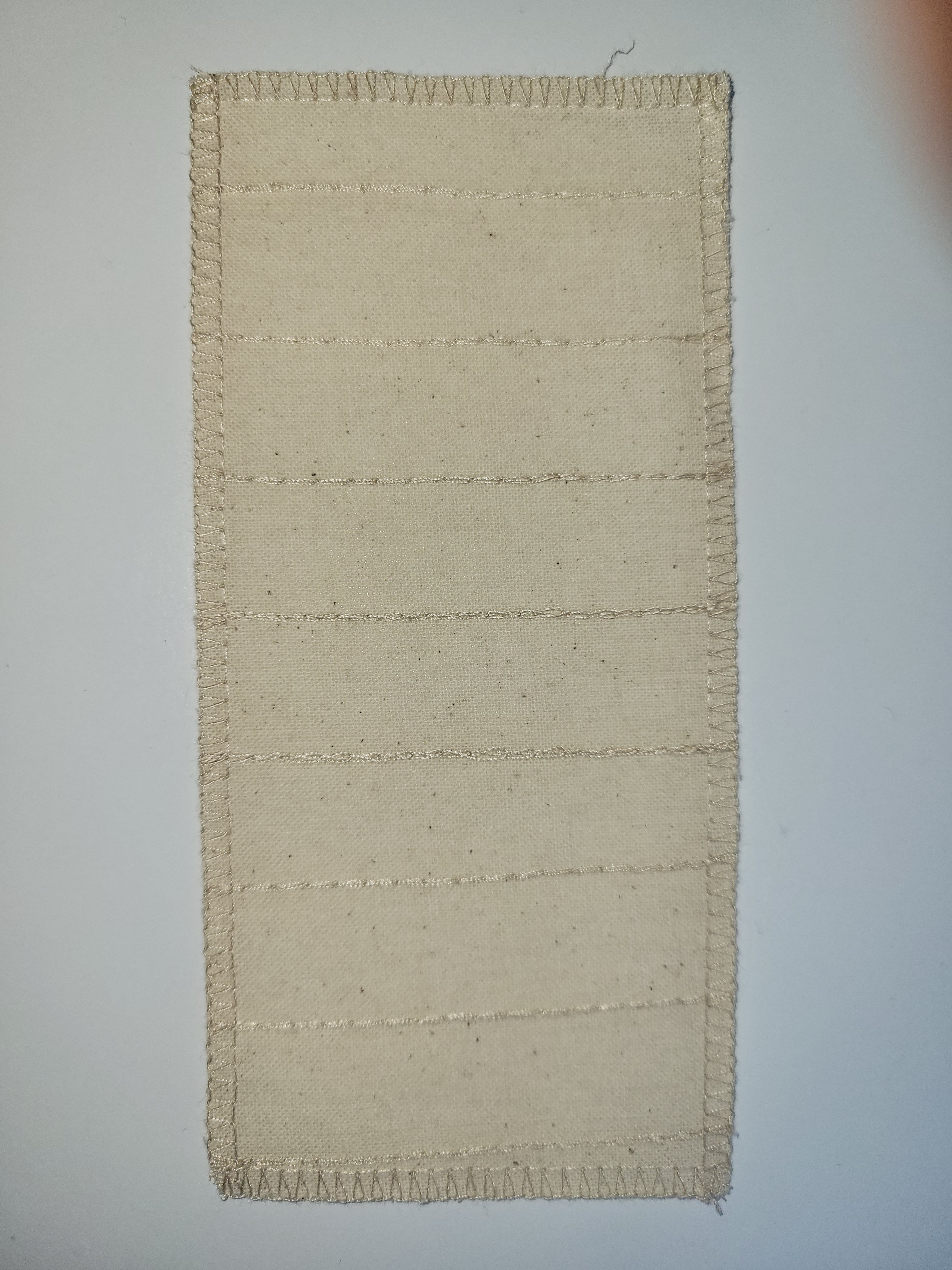

I did try an interesting aproach on my first build (a schooner).  On that one i used a light fabric and carefully "pulled" a single thread out where each seam would be.  Still of course out of scale but a pretty cool look for a larger scale build (1:40 I think?).  Can't get it to work on a tighter weave fabric though.
I think i will make a try for sourcing the silkspan/modelspan first and if that doesn't work out I'll go for the penciled fabric.

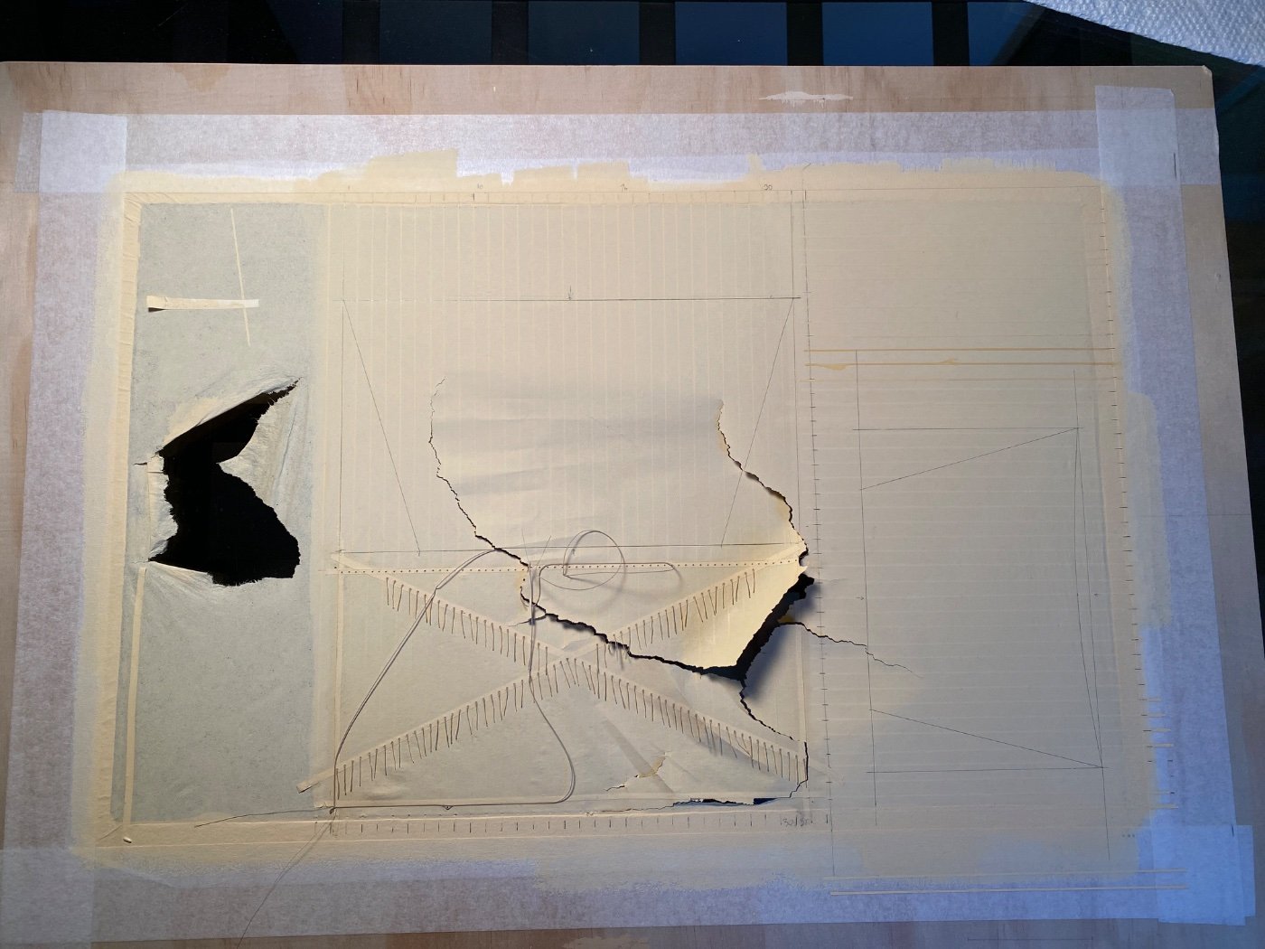

I just want to warn you that from my own experience I tried making the sail from it and abandoned the idea later. Silkspan is way too brittle and impossible to repair. I spent a week working on one sail and got it torn off in a second. Since then I abandoned the idea of silkspan. I work with very light batiste. You can look at my endeavors here. First picture of broken silkspan sail. Next is from thin fabric. Scale is 1:90

As I said earlier. I will no longer consider any paper product for sails unless may be for furled sails. It is easy to tear and cannot be repaired if damaged. The full story of my Silkspan use attempt is here:

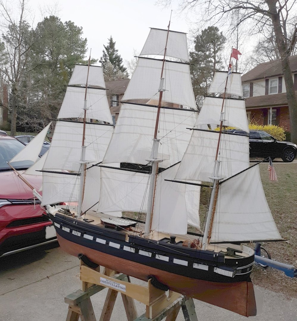

I have used both fabric and silkspan for sails and a flag on four of my models and agree that the silkspan, following David Antscherl's method is by far the best.   The fabric sails were sewn by a friend of mine, an expert seamstress.  She did a beautiful job but, still, the stitches are way out of scale.  Using the Swan Class books addendum I went through the entire process to see how it would go, even though they are furled on the model.  It is true there are some tense moments while the paper is wet, but they are surprisingly strong when dry.  One other thing:  I bought additional paper to make sure I didn't run out and the new product was much weaker and difficult when wet than the first batch.  That was Guillows brand.  I'll try the Sig brand next time.
