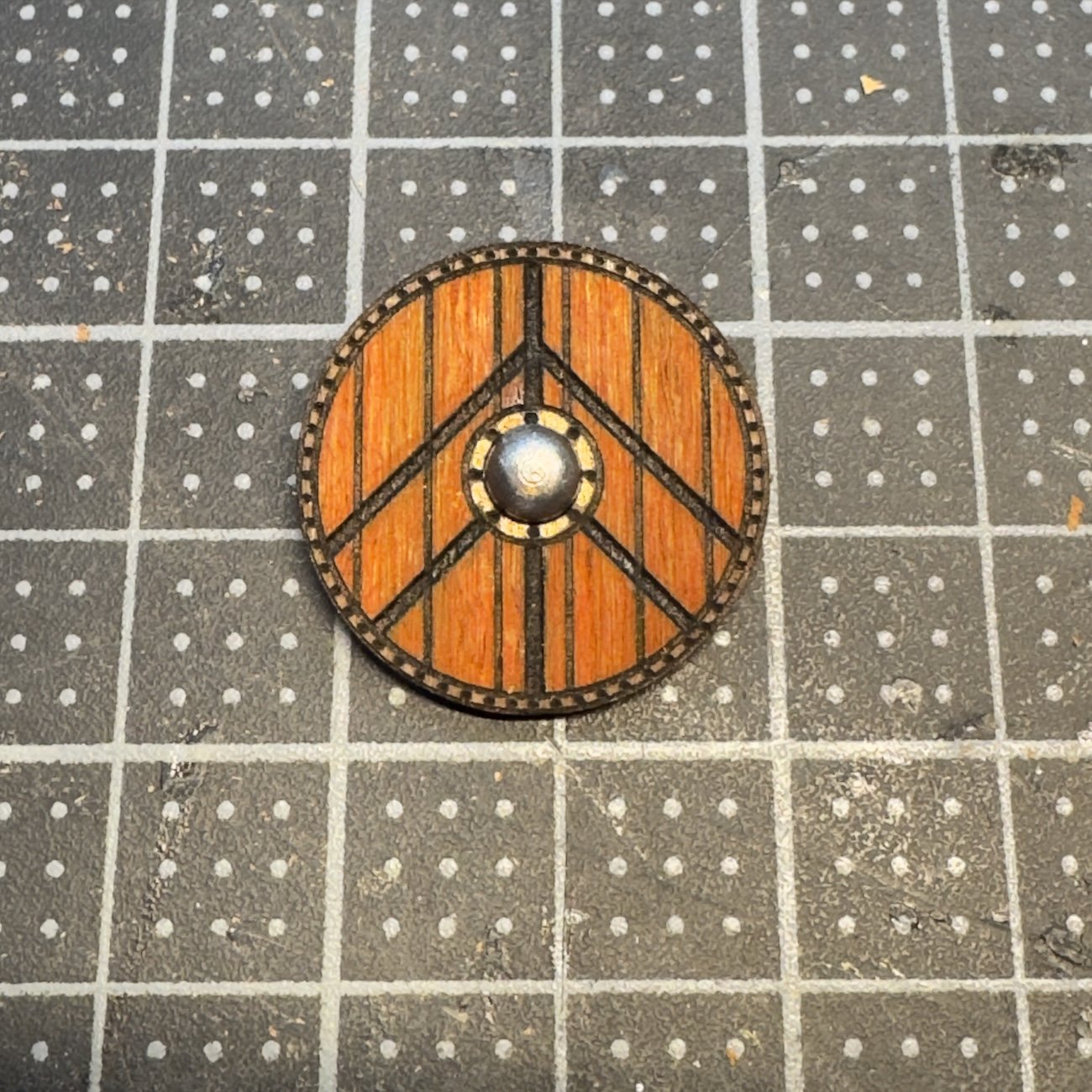

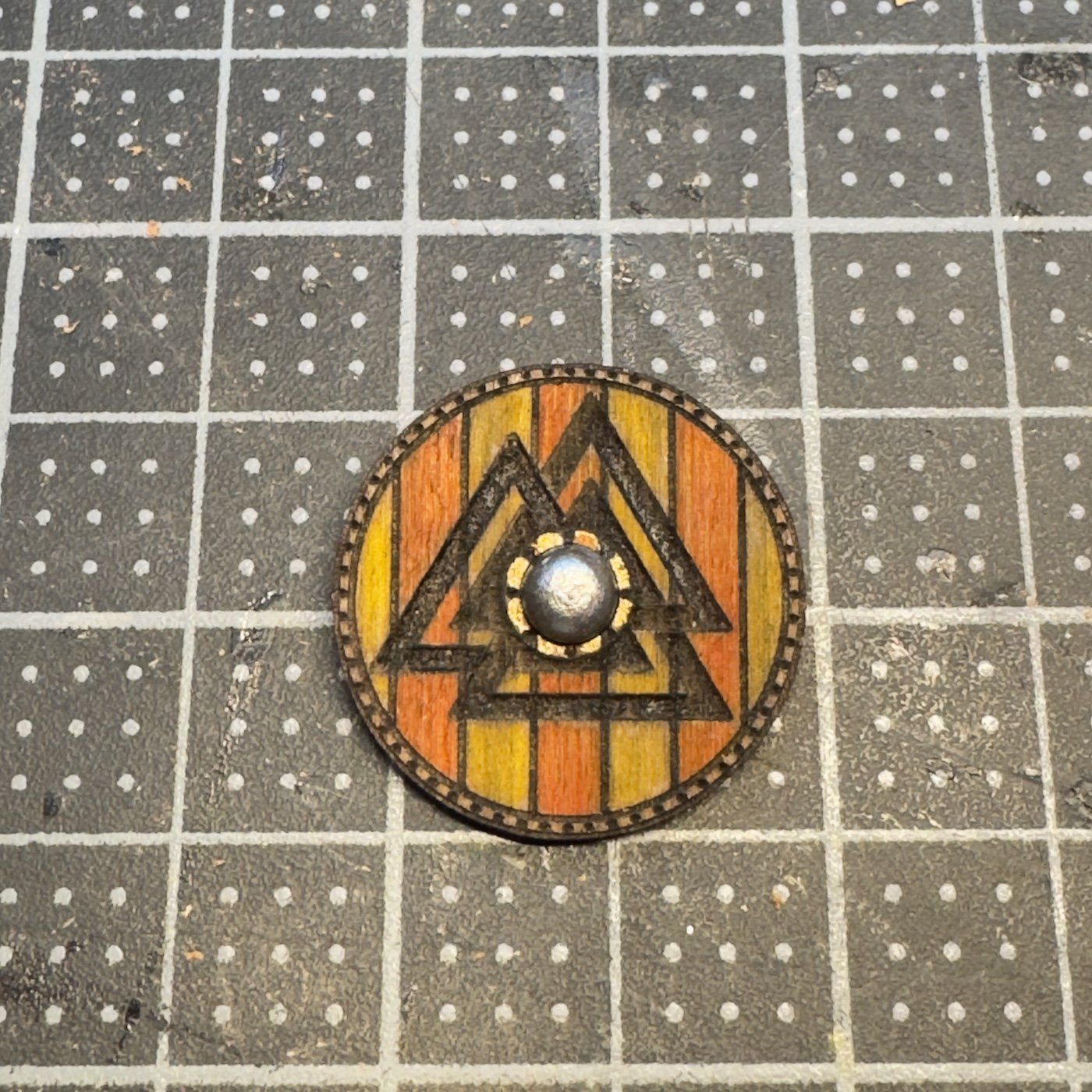

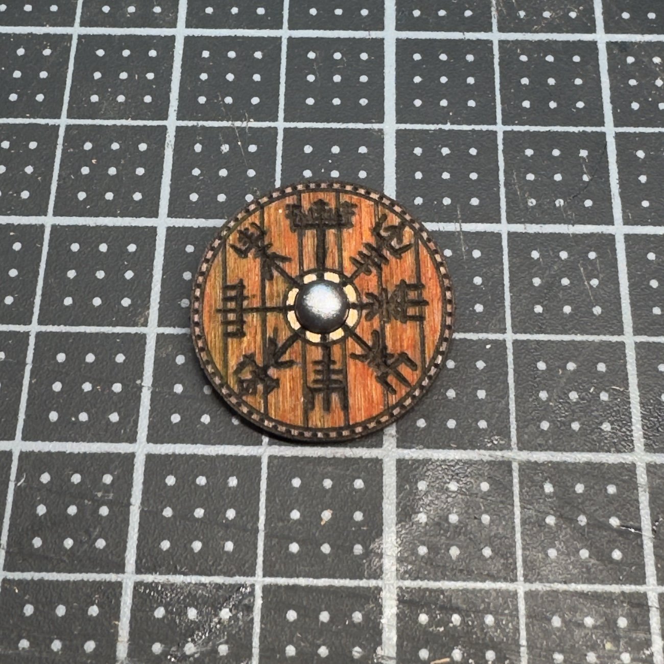

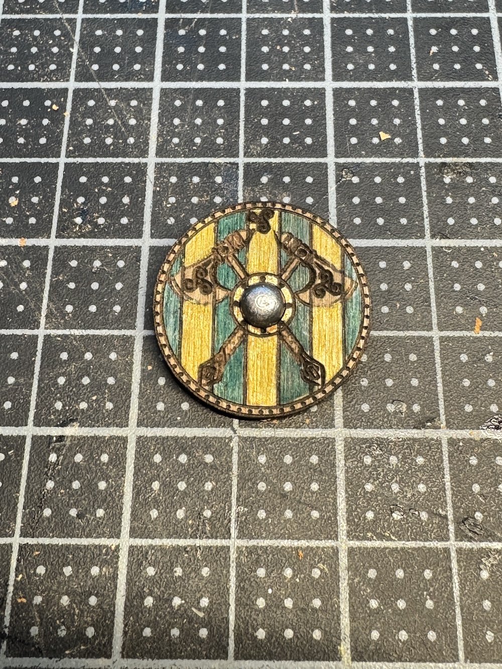

Continuing with the shields - 32 are included - the Lazer face etchings - and cut-out bits are all perfect. Lots of work went into producing such great out-of-the-box bits - Kudos to Pavel and his team.
15 shields will attach to outer hull per side, and only half of each back of shield will be visible once mounted (this will save me LOTS of extra detail work time that’s coming up)
Wanted to add colors to the faces. According to some historical information that I found - shield colors did have specific meanings;
Most Common Colors & Combinations:
  • Red & Black: A very common, striking combination symbolizing courage and protection.
  • Yellow & Black: Also popular, seen in the significant Gokstad burial.
  • Red & White: Another frequent pairing, possibly representing purity alongside strength.
  • Blue: Less common but found on high-status or royal shields, sometimes with white or red.
Symbolism & Status:
 Red: Courage, strength, warrior valor.
  • Black: Protection, defense.
  • White: Purity, peace, divine favor.
  • Blue: High status, nobility (associated with Odin).
·       Evidence:
Archaeological finds, like the 64 shields from the Gokstad ship burial, show solid yellow and blue shields. Archaeological digs confirm the use of red, white, black, and blue, often in simple geometric patterns or solid fields.

Shields moving forward - looked for some historical images - very few, and sketchy information at best. some FYI below...
Its known that shields were made from thin planks of wood (linden, pine, fir) butted together, sometimes with support braces on the back
PS: Re: P. Nitikin kits --- Probably the only advantage with the larger 1/25th kit is in regards to the shields that have two bits - their faces and separate outer rims - that would have been a nice way of adding further detail, especially to the back rim of the shields.......
But since the 1/32nd does not have a separate outer bands - needed to add some detail that would help the look of the outer  edges. Black marker was indeed helpful as well
Next up --- adding further details to the backside of each shield, including the mentioned cross braces. That should then let me move on to next area of work.

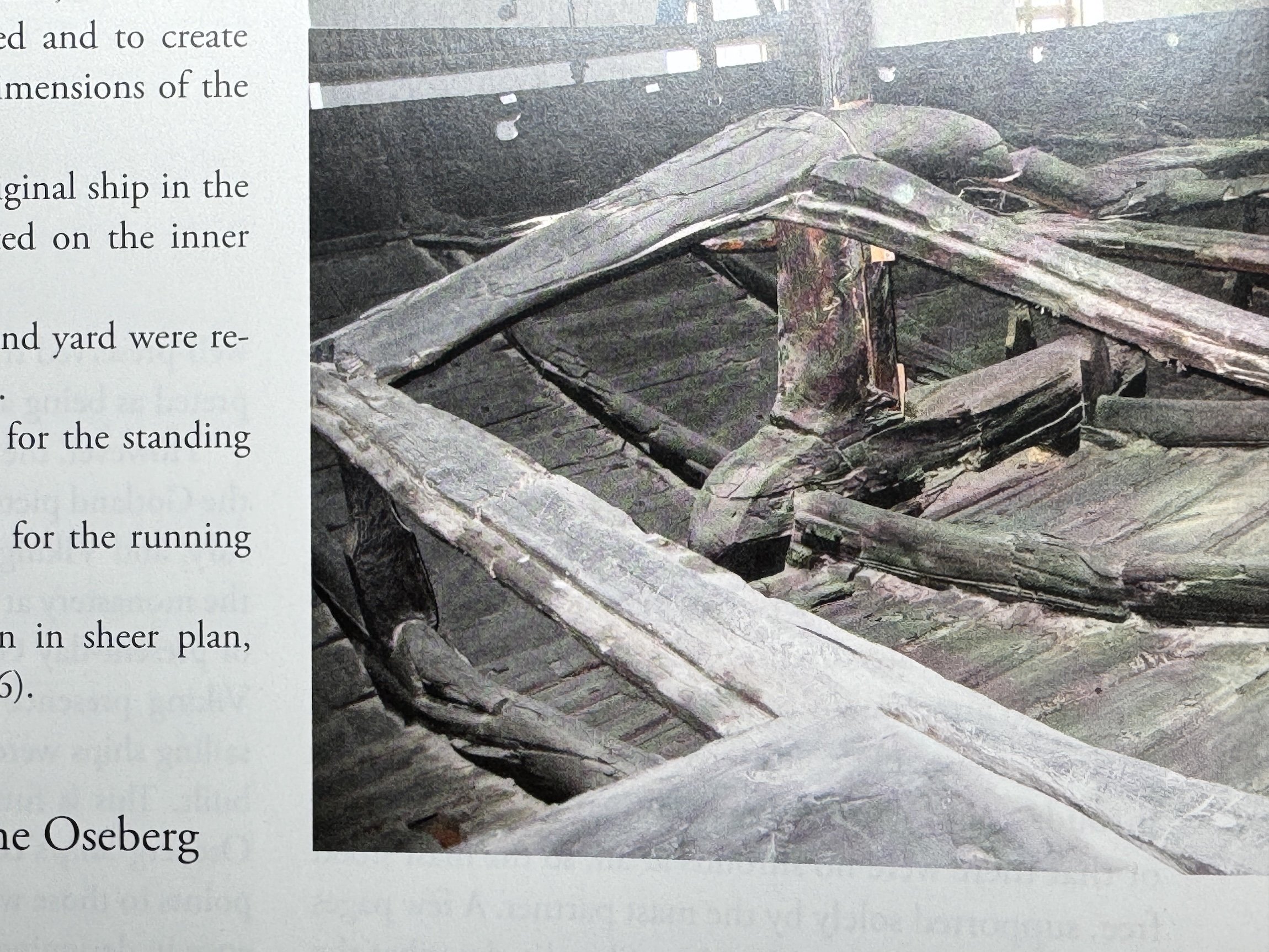

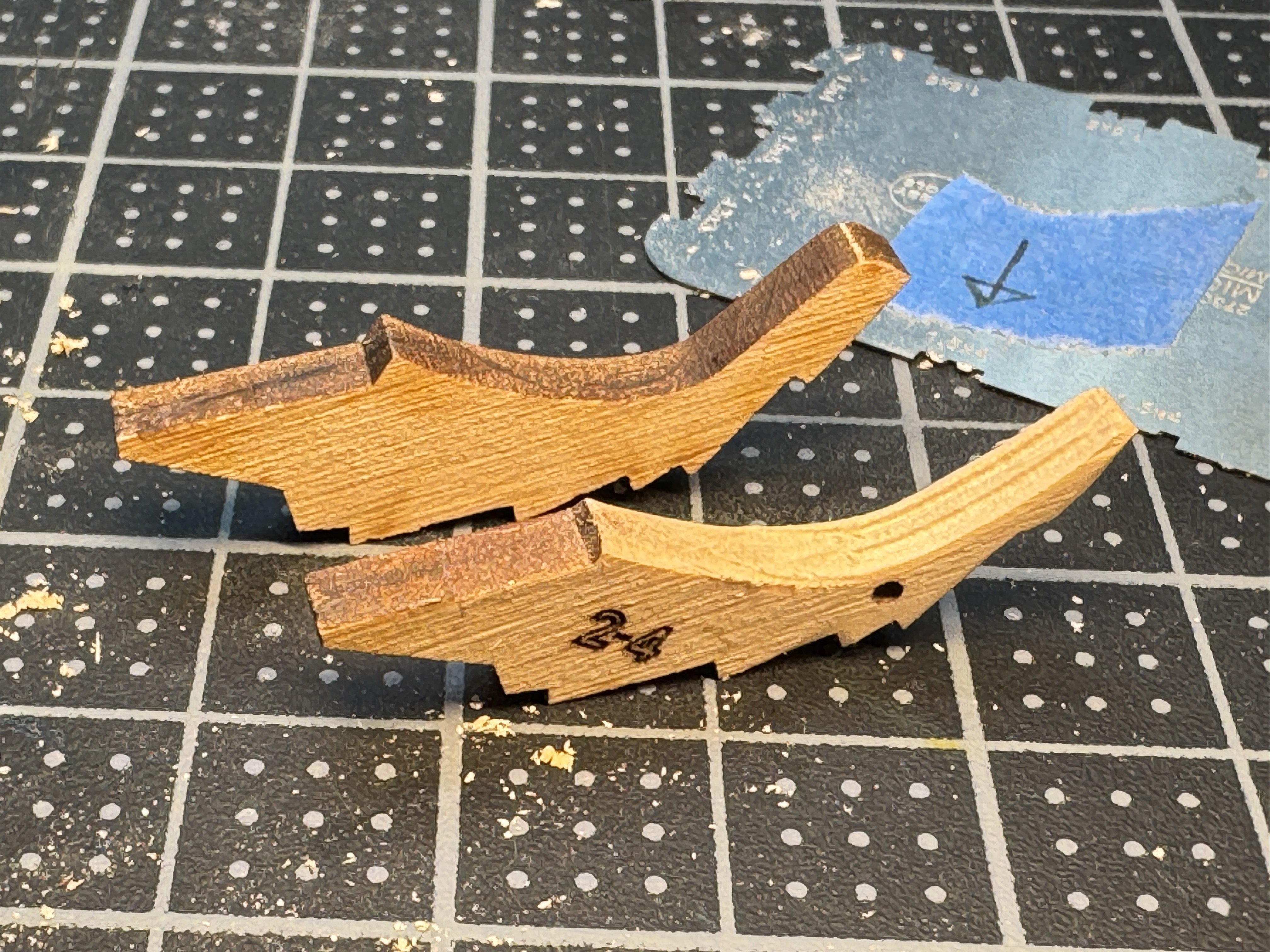

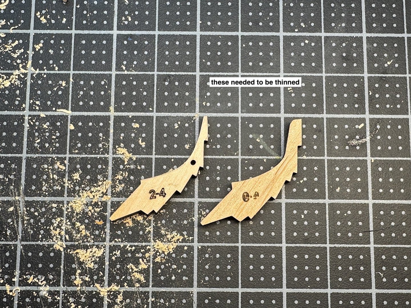

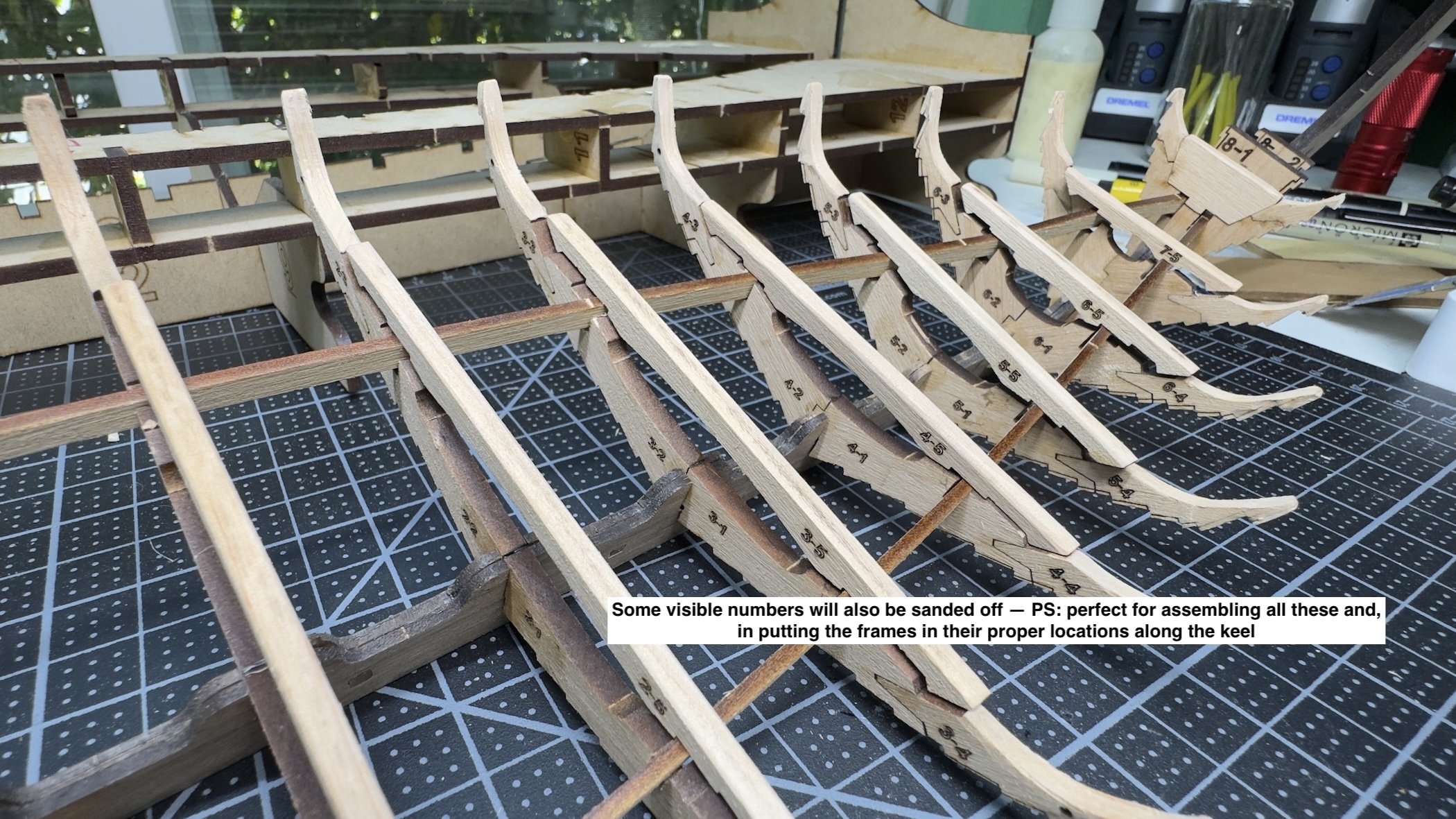

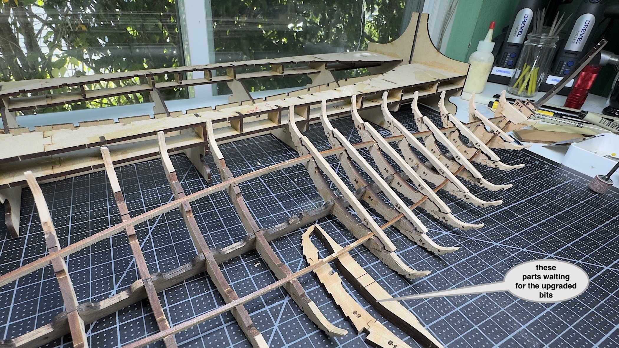

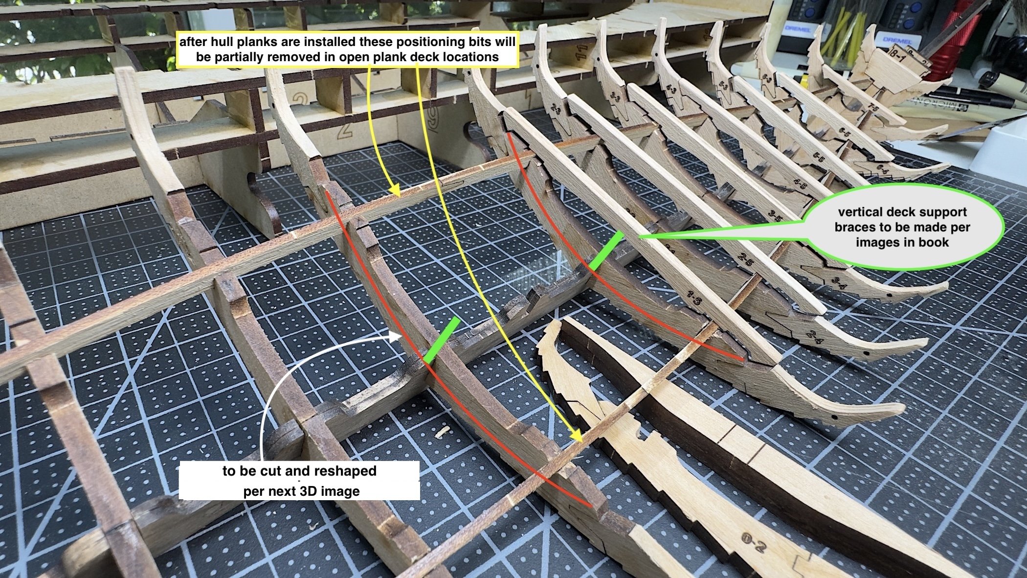

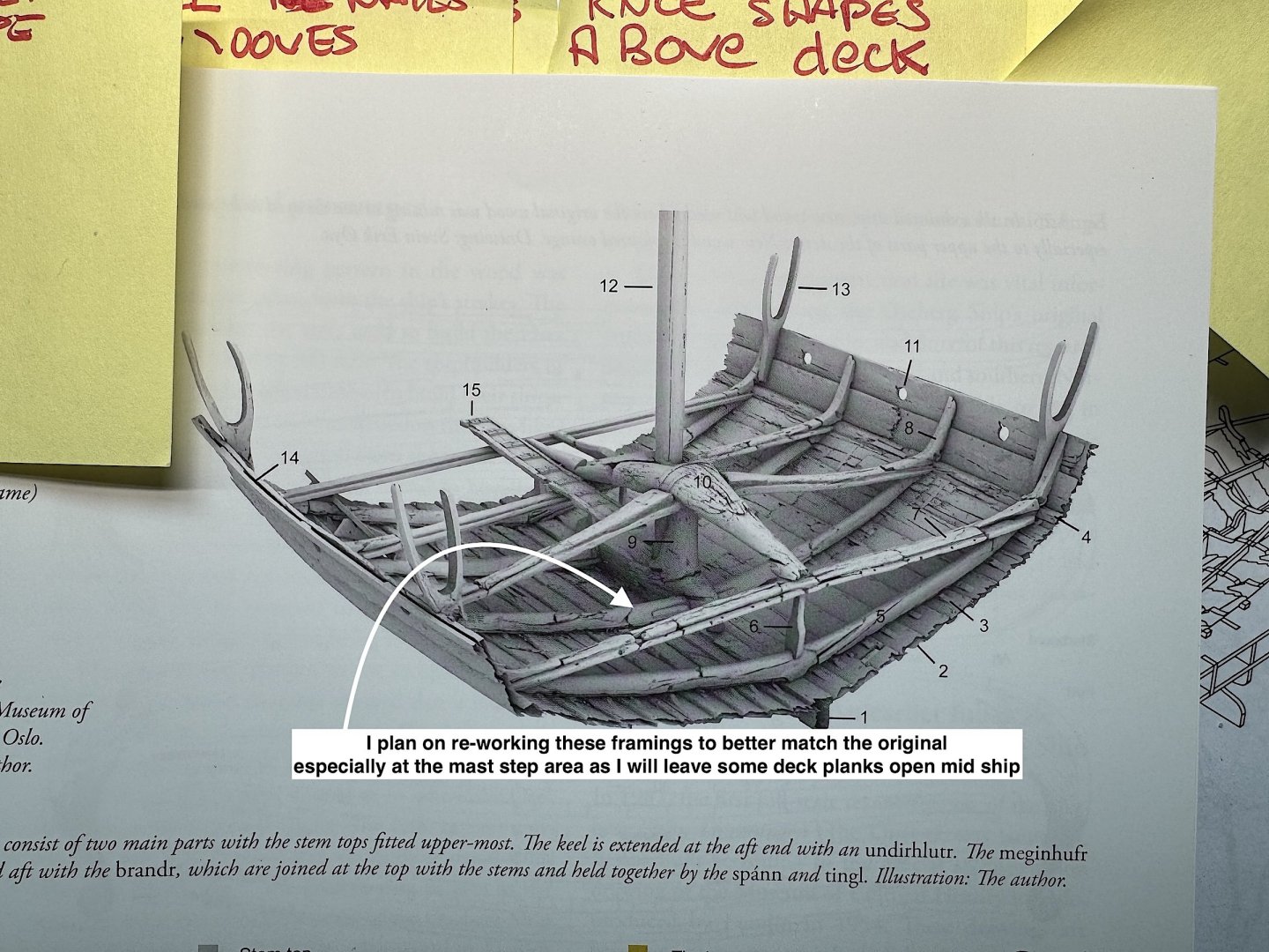

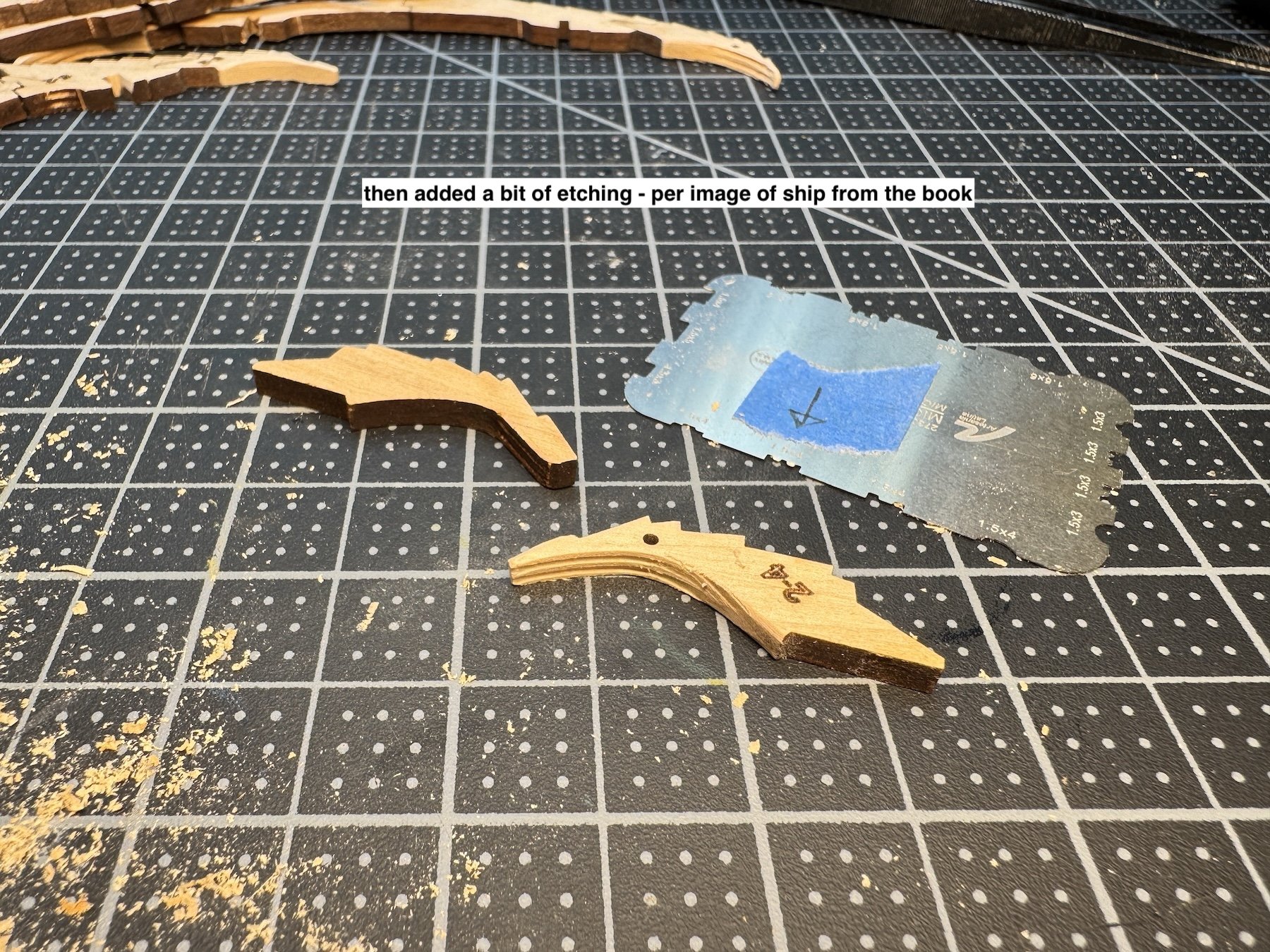

Hi,
Leaving shields for a bit - a few more details need to be added ---no rush.....
For now, initially working on framings, and to think about how to add details to some of the inner cross timber bits as I plan on leaving several of the deck’s planks off to the sides to view mast stem, rocks for ballast, ropes, and other types of supplies that were certainly stored below the deck.
As prefect as Pavel’s framings are for this kit - when deck planks totally cover - I’m hoping to replicate a better look as how those hull floor cross members looked per images of the ship, and from that 3D image taken as well (below).
I need to receive the mast step bits for center mid ship area first. I checked my order  and apparently it should ship mid month, January. In any case hull planking is on the short “to do” list, and most deck planks will actually be laid across the deck - but for those few that are not - want to add better details..TBD
