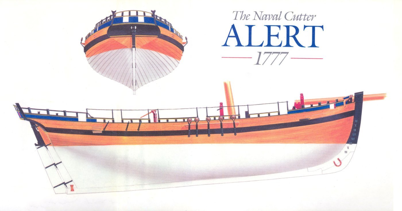

My project is a model of the Naval Cutter Alert, 1777.
I was thinking about building something similar from plans...
…but there are no plans for this particular cutter, but there is the Anatomy book, and that is what I will build from — however!

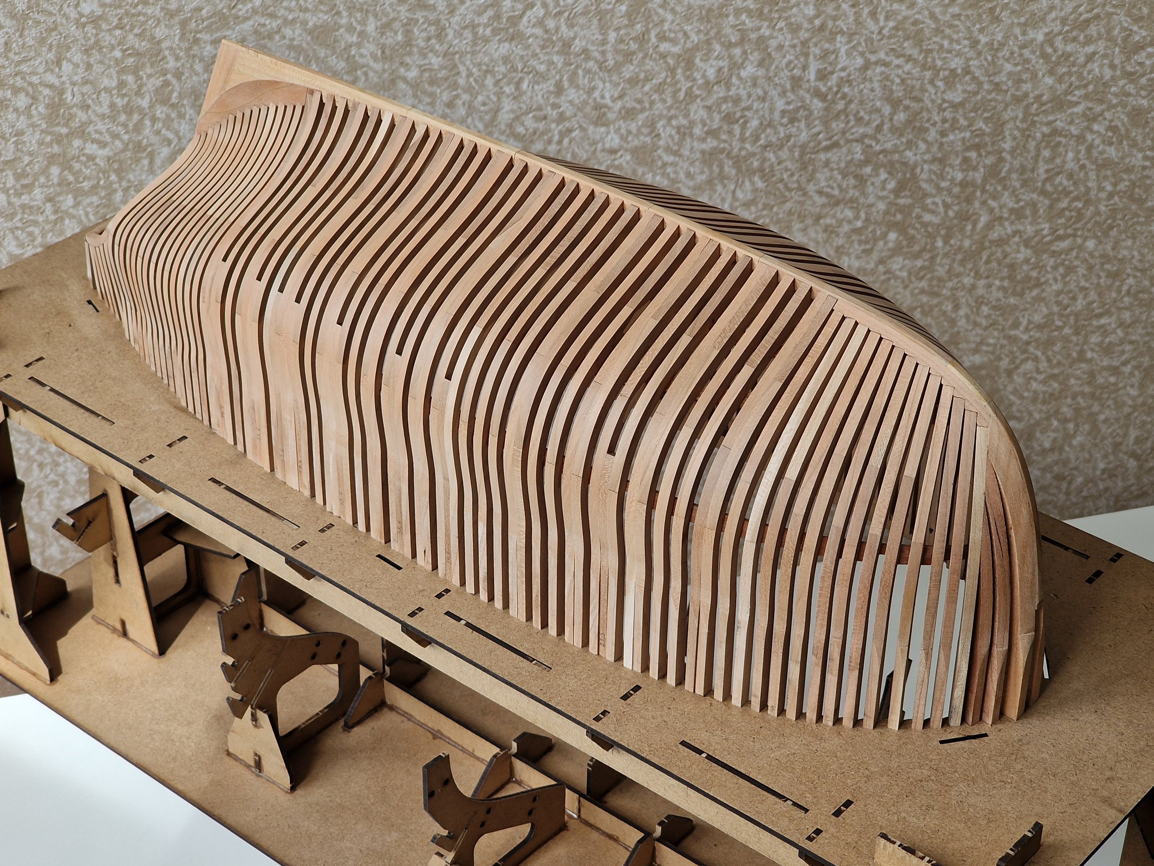

A small spoiler showing what both hulls looked like a few months ago:
And this is what my models look like now:
The beginning of the project was in March 2025, so I will be posting the build log until I reach the current stage and, afterwards, will post in real time.

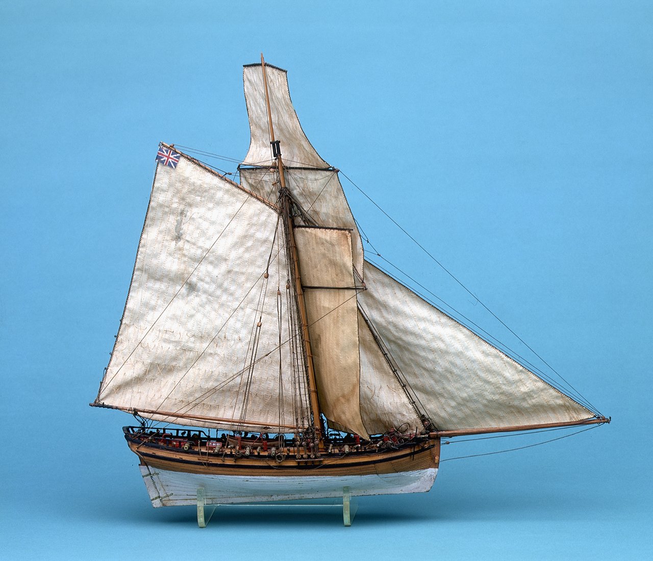

As I already said, the first hull will be a “skeleton” in Admiralty style, to show the entire interior of the vessel. And the second hull (the main one) will be maximally adapted to a museum look (with bitumen finish and aged styling). As an example — this cutter.

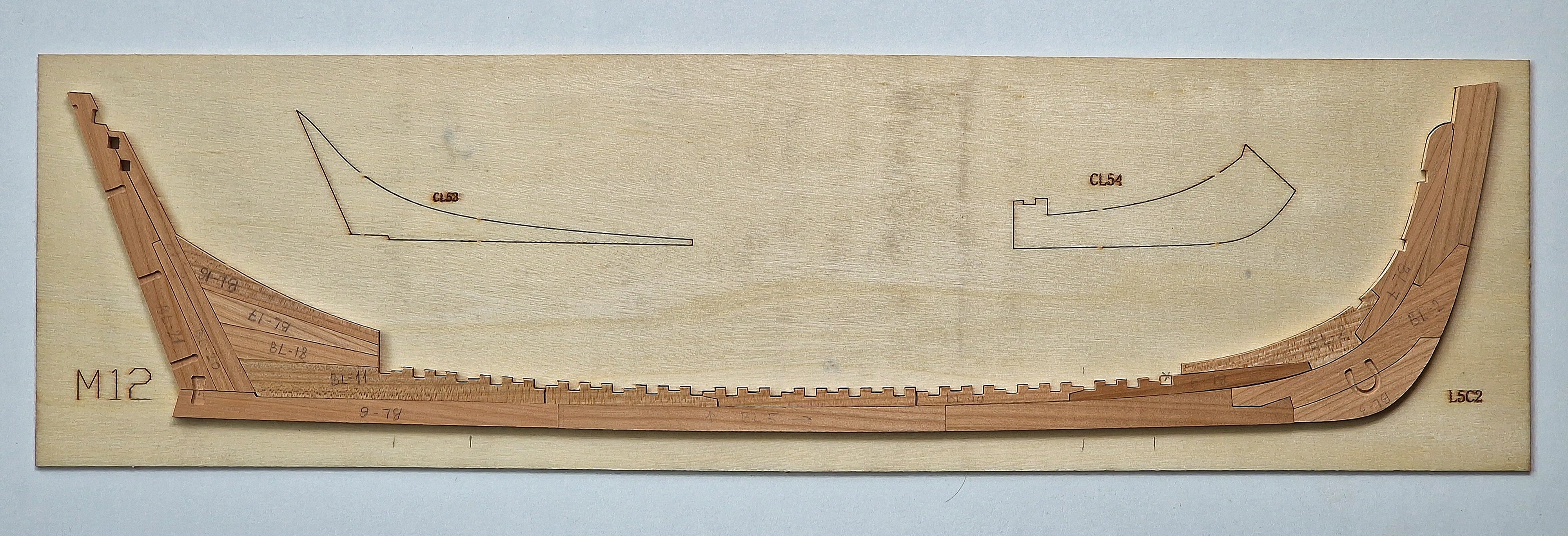

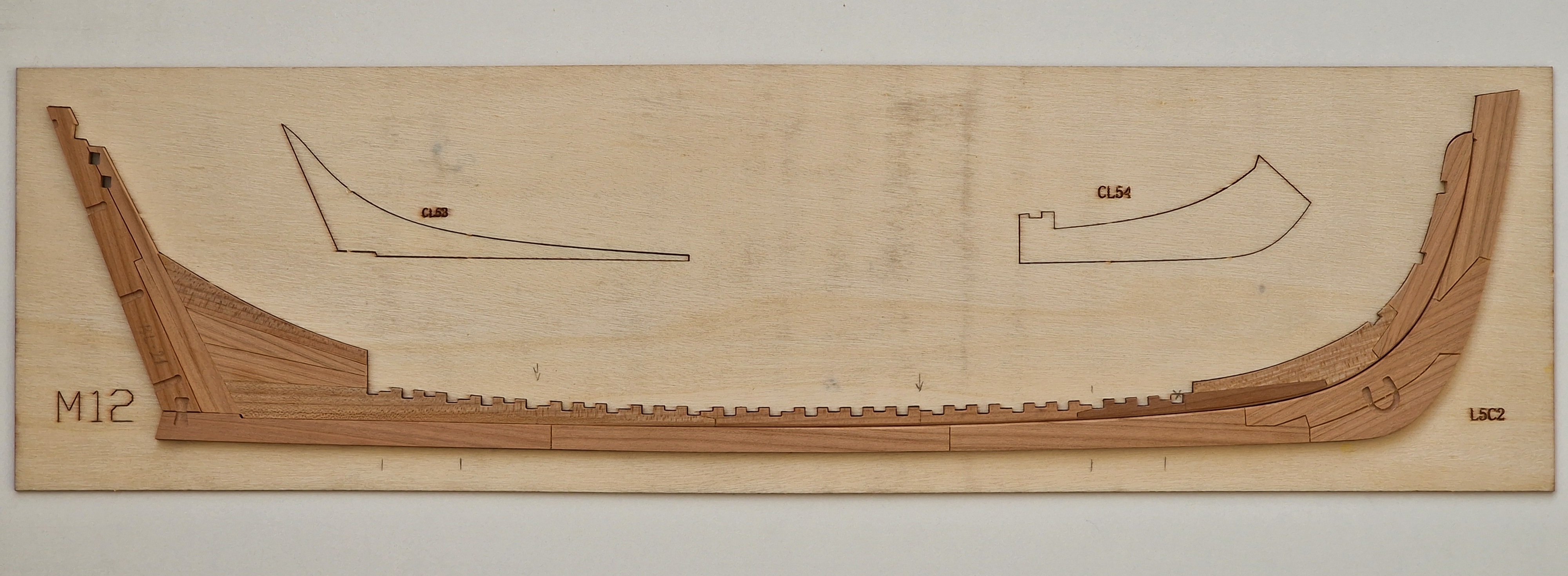

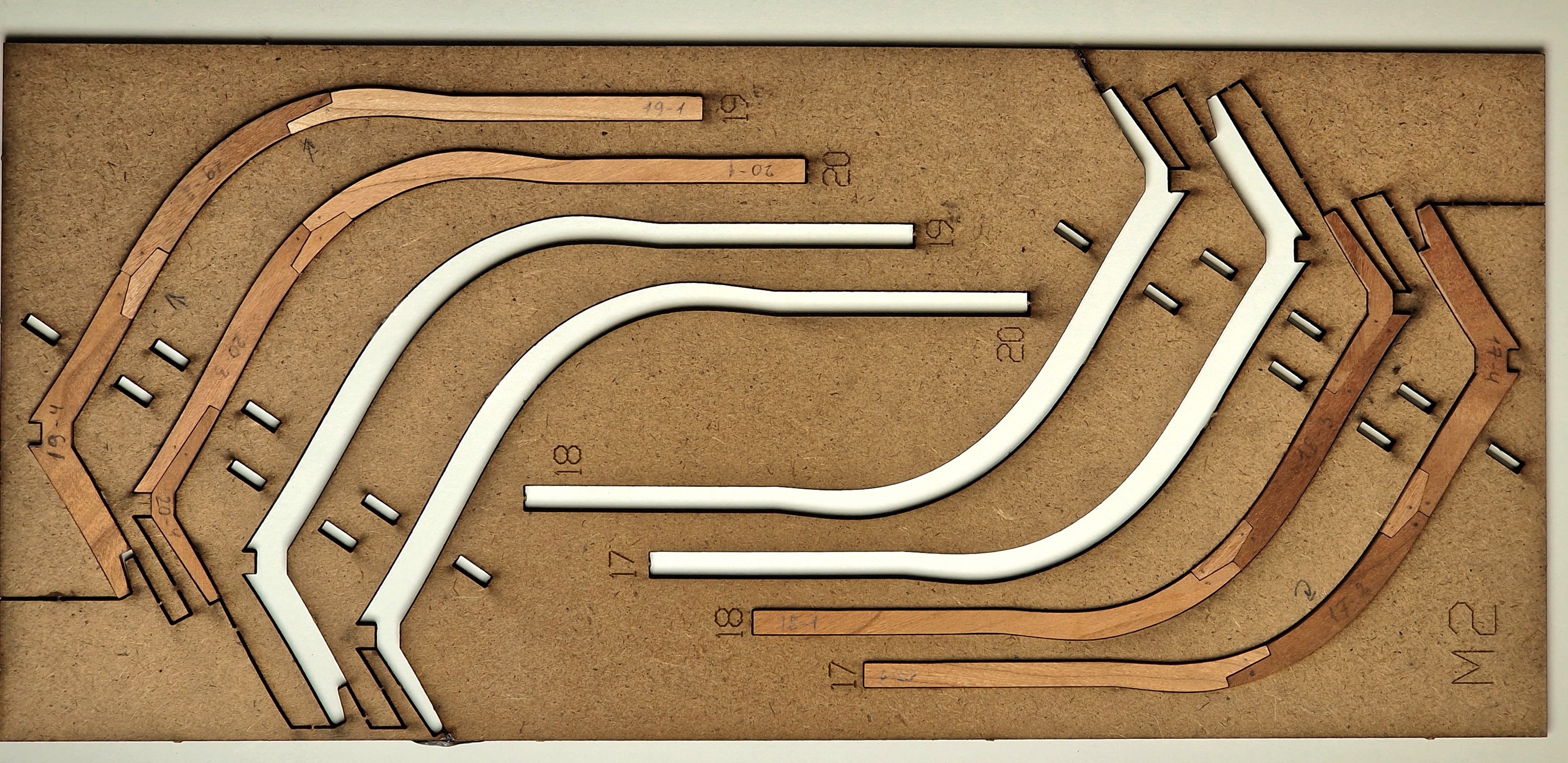

So, briefly about the kit from Trident Model. There are many reviews on the internet about this kit, including build magazines. But for me it is only a base, and here I will explain why I chose this particular kit. All the parts (gratings, carriages and other deck fittings), although they are not bad quality, I will still make according to the Anatomy… as well as the entire second hull.

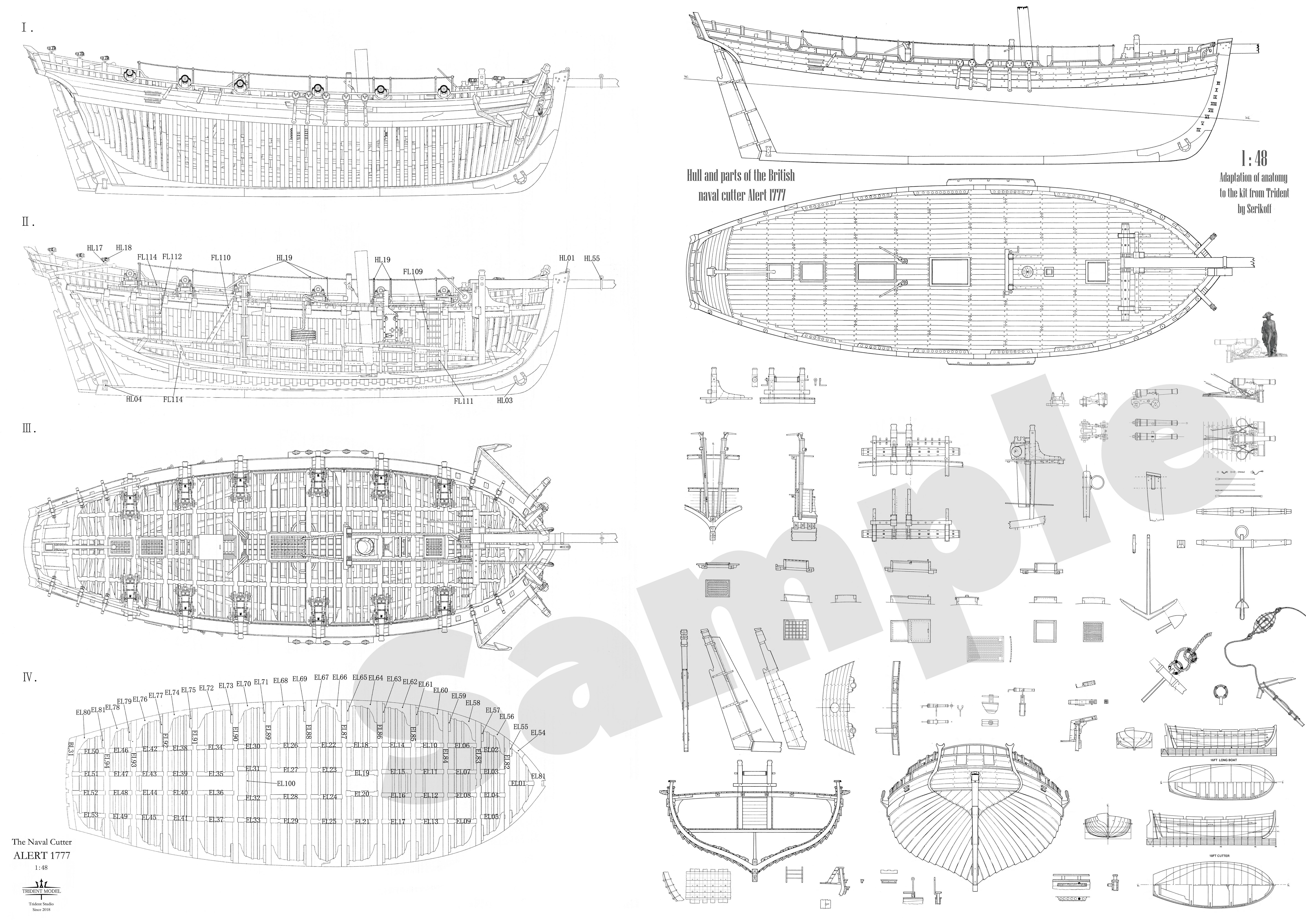

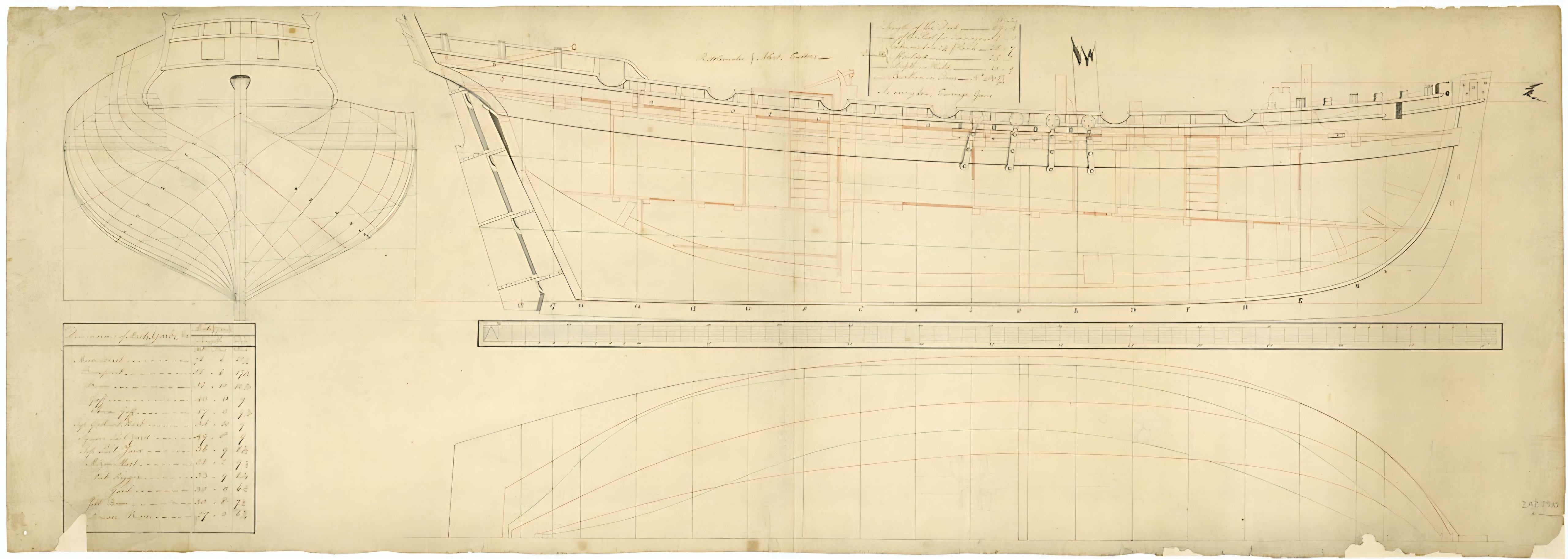

I scanned the Anatomy of Alert 1777 and created my own drawings, adapting them to 1:48 scale.
I also worked on the masts, sails and rigging.
RiggingCutterAlert1777bySerikoff(sample).thumb.jpg.70f054b786f90993541482d0a2abc7ca.jpg
All these calculations are under constant correction and I will share them once I bring them to the highest quality.
I printed these drawings in A0 format (118.9 x 84.1 cm). Here is their size for clarity:

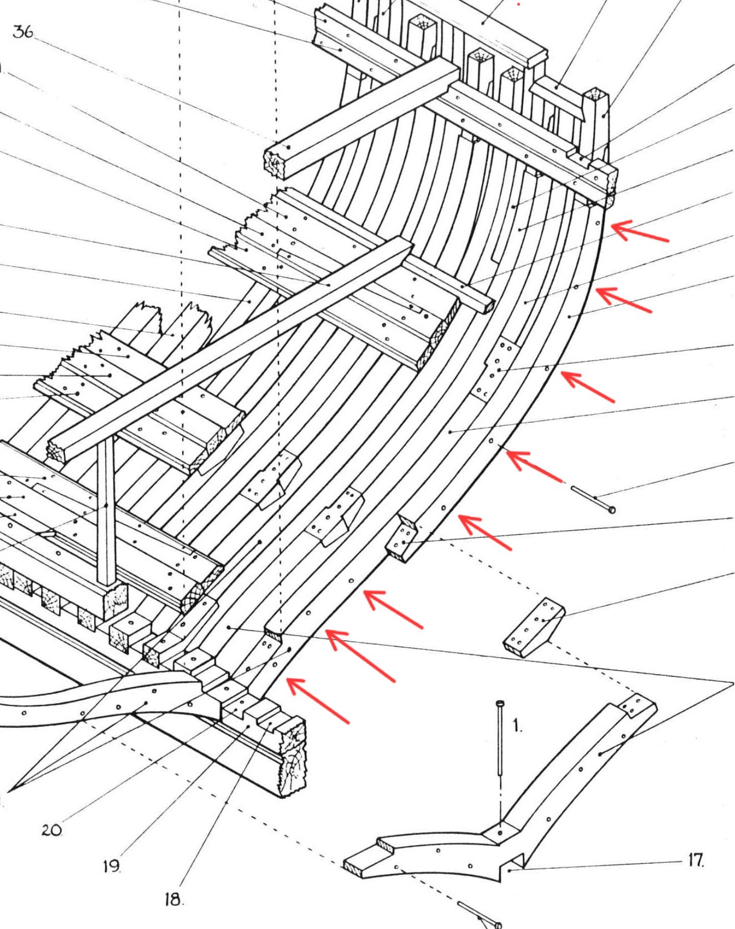

But first I needed a hull as a base. And, as I see it, Trident Model managed to reproduce its geometry very well in their kit. If you apply any frame or profile of the ship — they very precisely repeat the Anatomy drawings from which this kit was created. Yes, the frames in the kit are not laid out exactly like in the Anatomy (a bit simpler), but such layouts exist in other Anatomy books, and again — the general geometry is reproduced as accurately as possible (as far as it is possible).

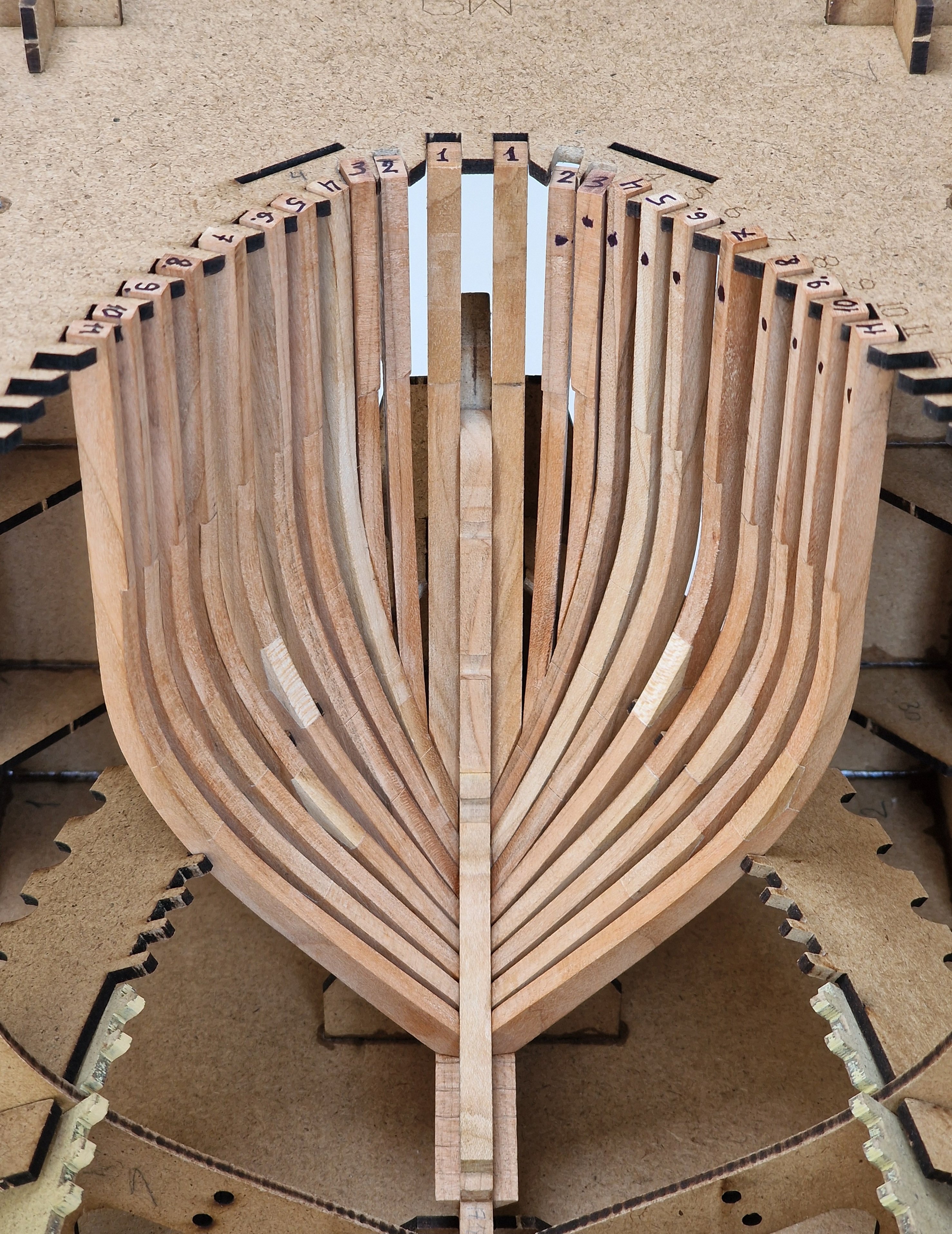

As I already mentioned, the basis for my main hull will be the hull from the kit, and first I need to make it, adapting and correcting it as much as possible according to the anatomy.

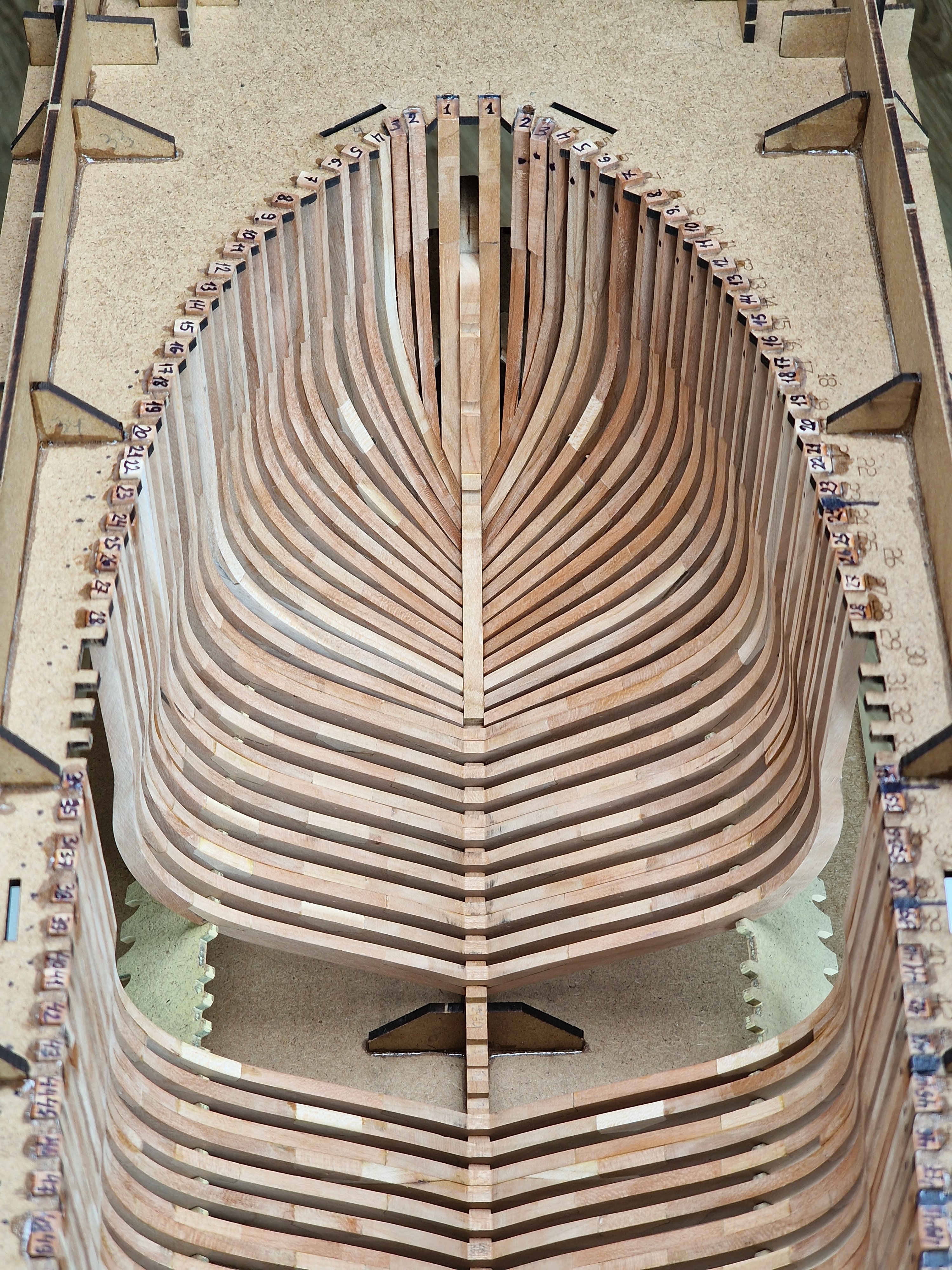

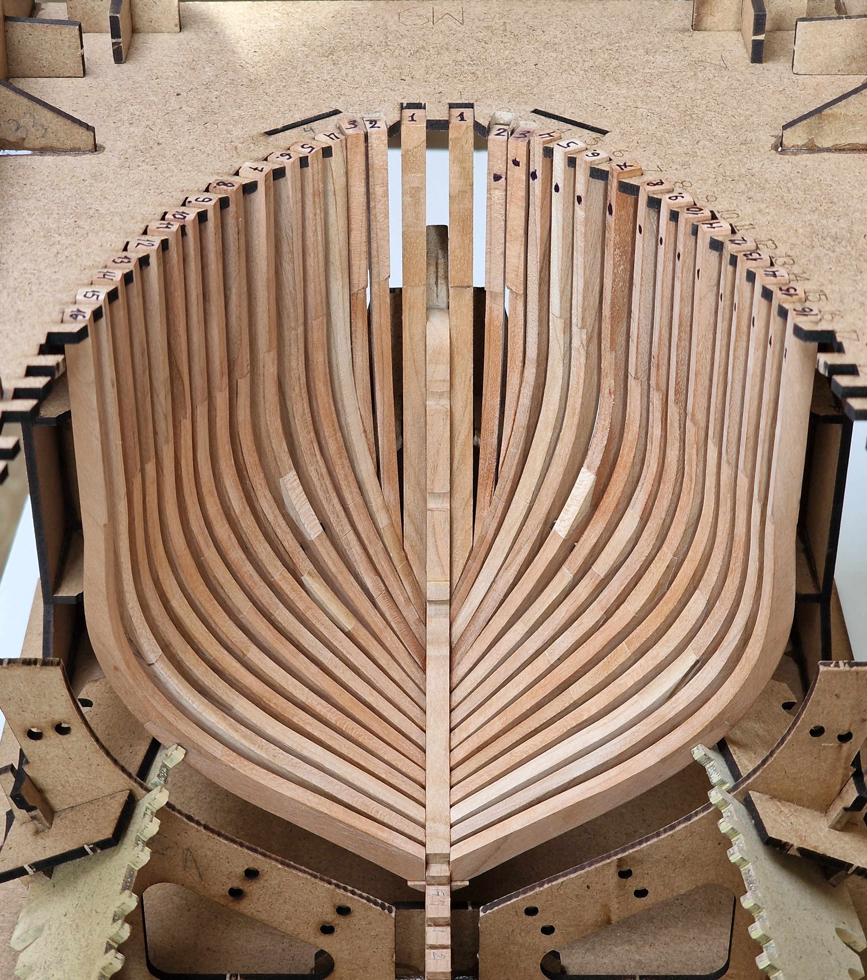

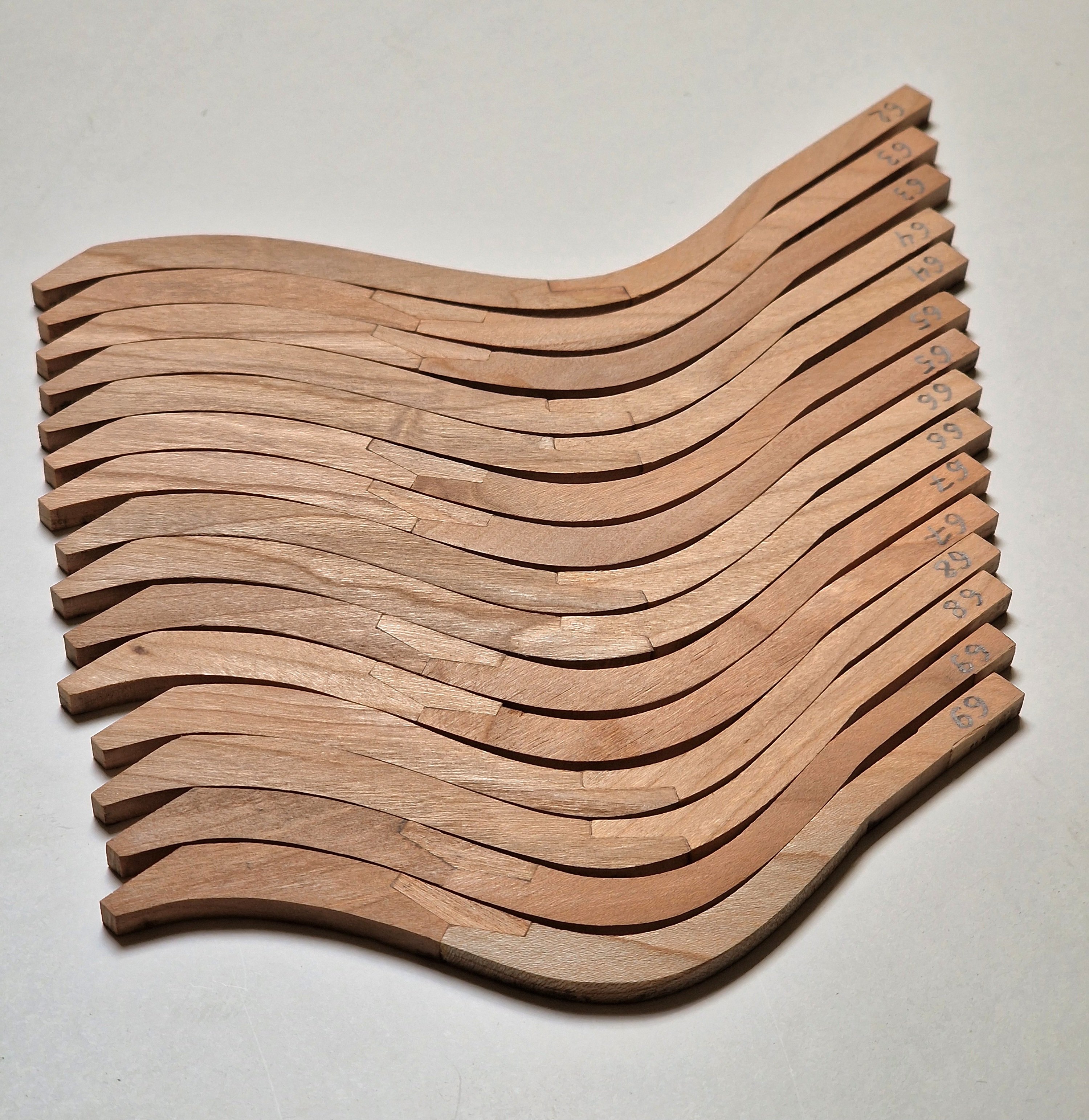

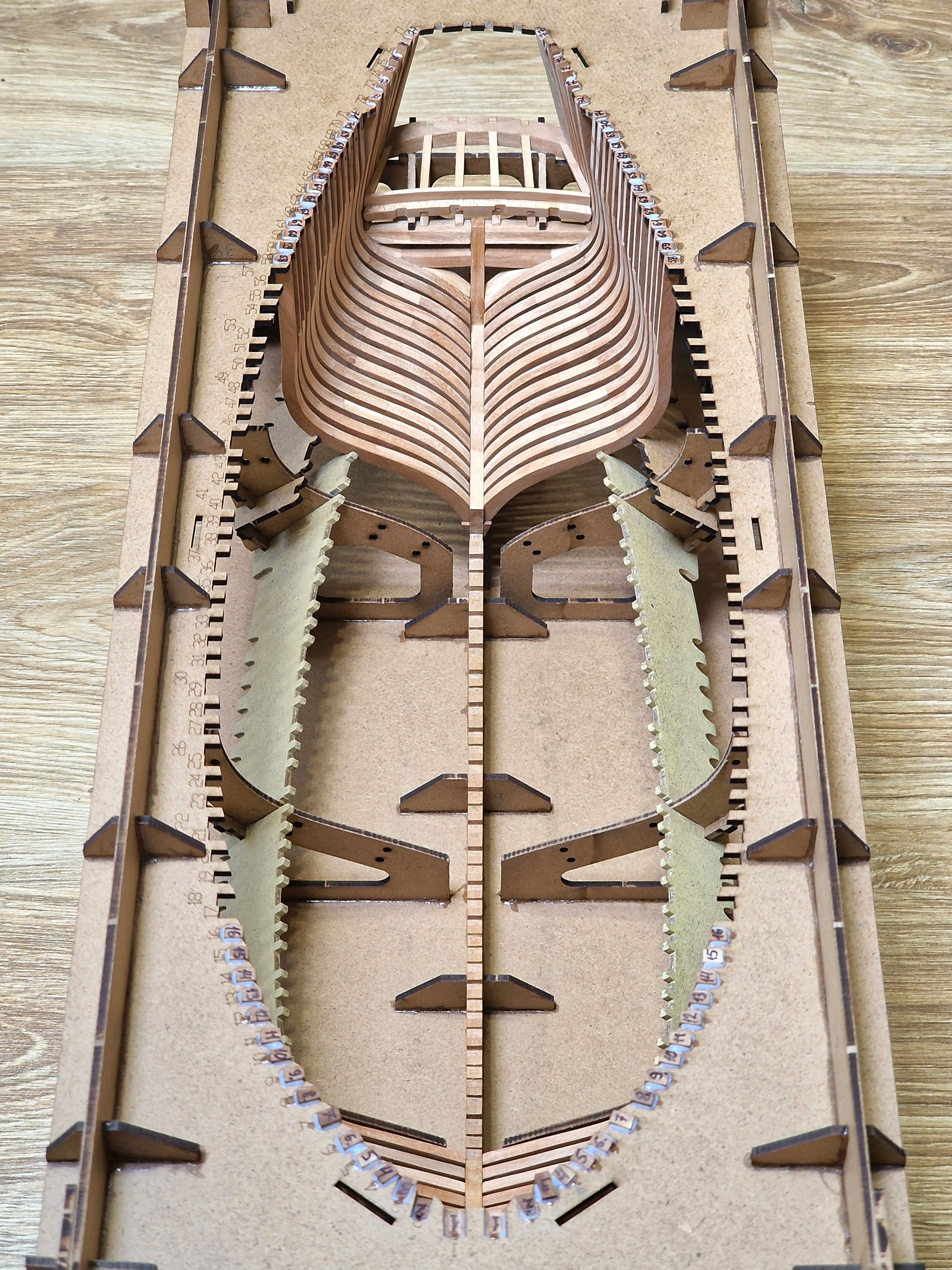

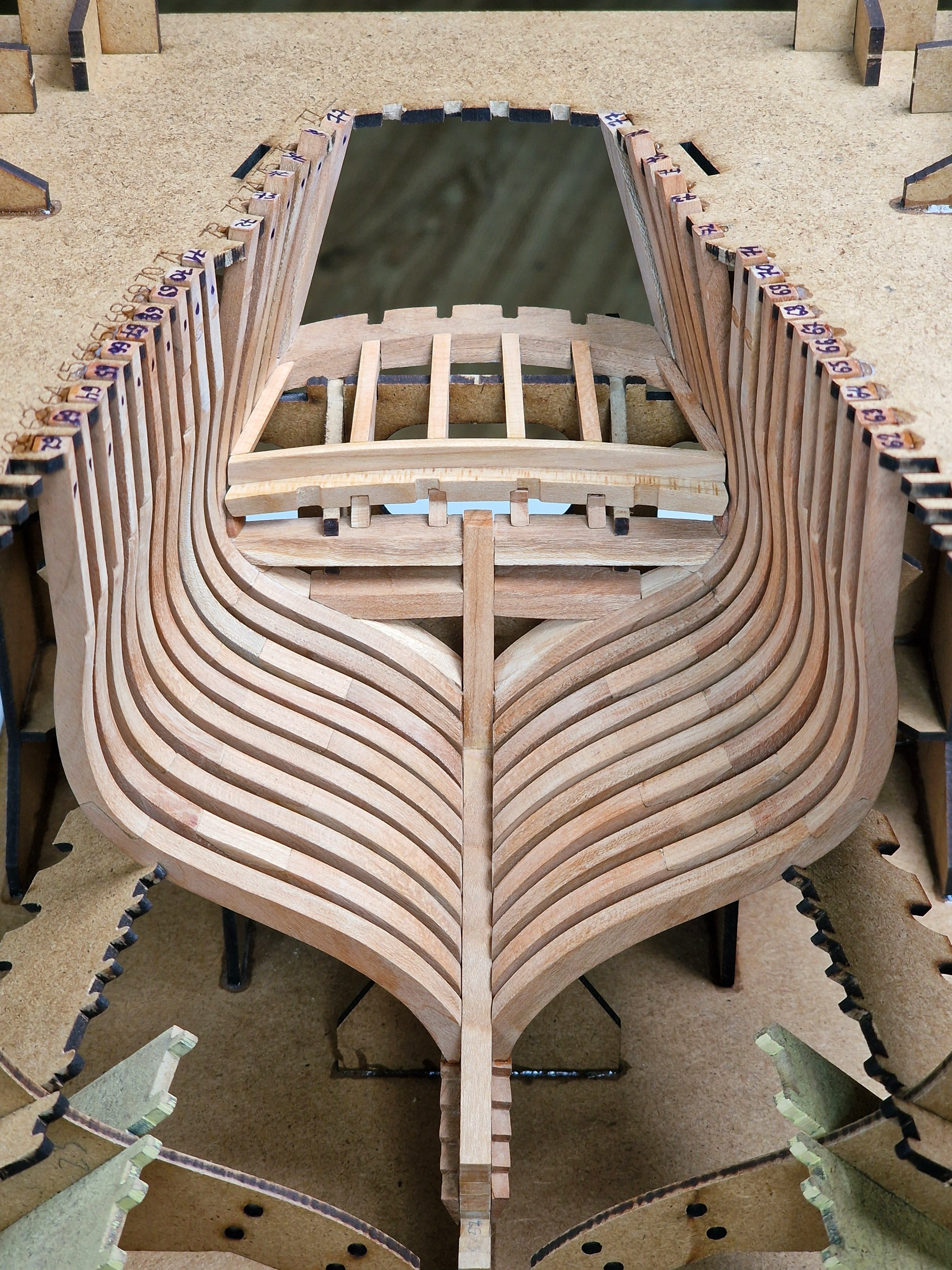

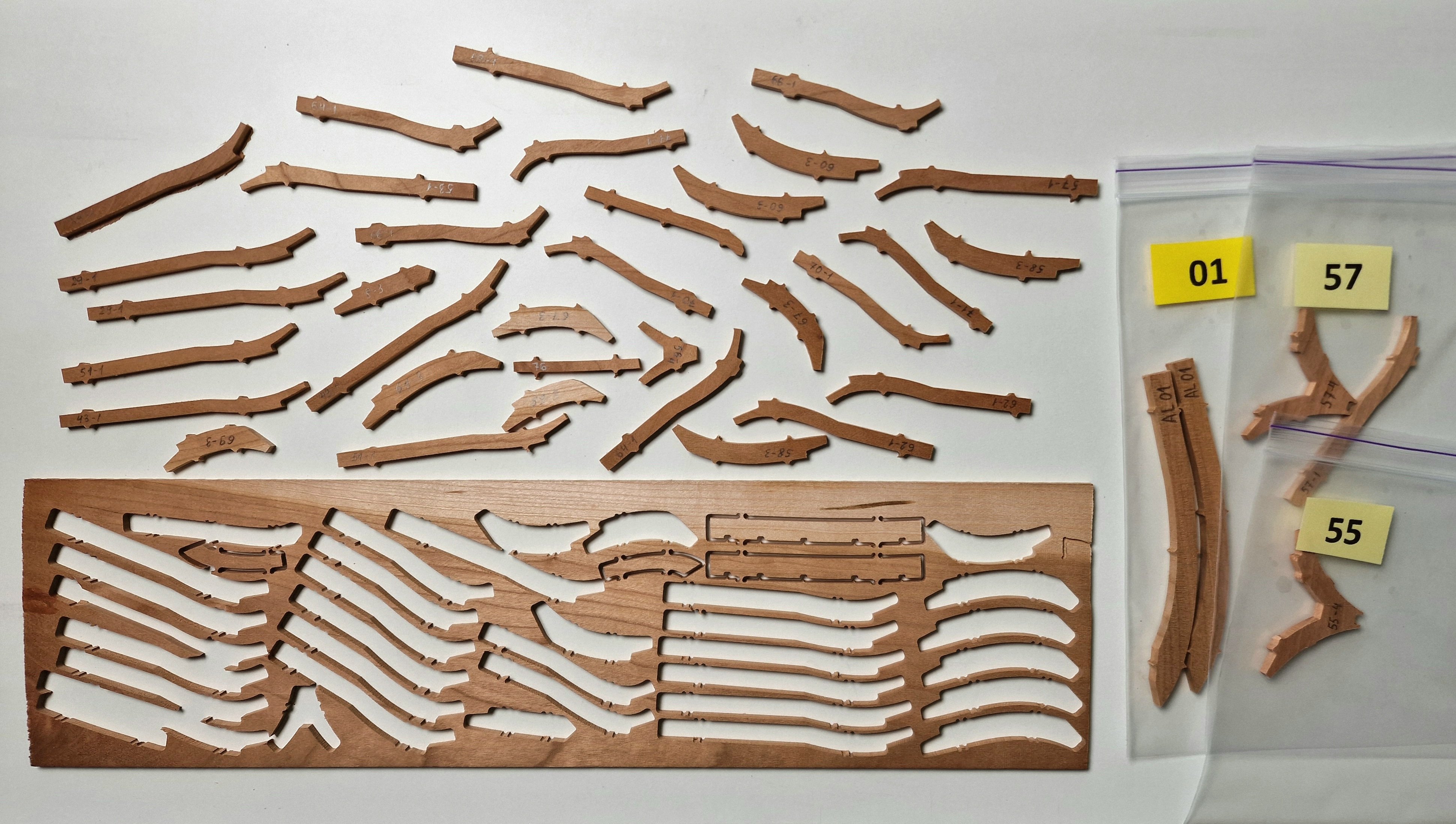

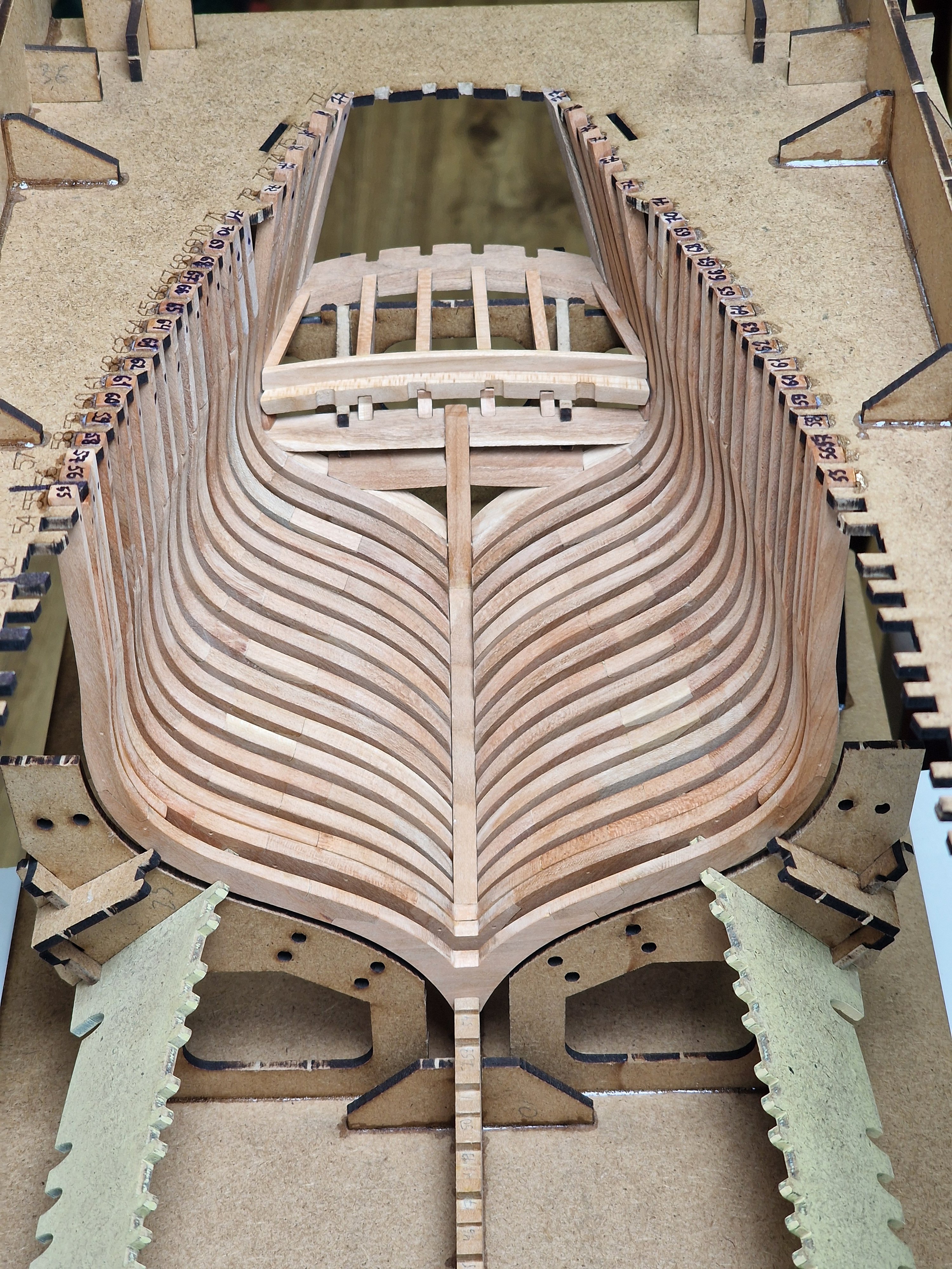

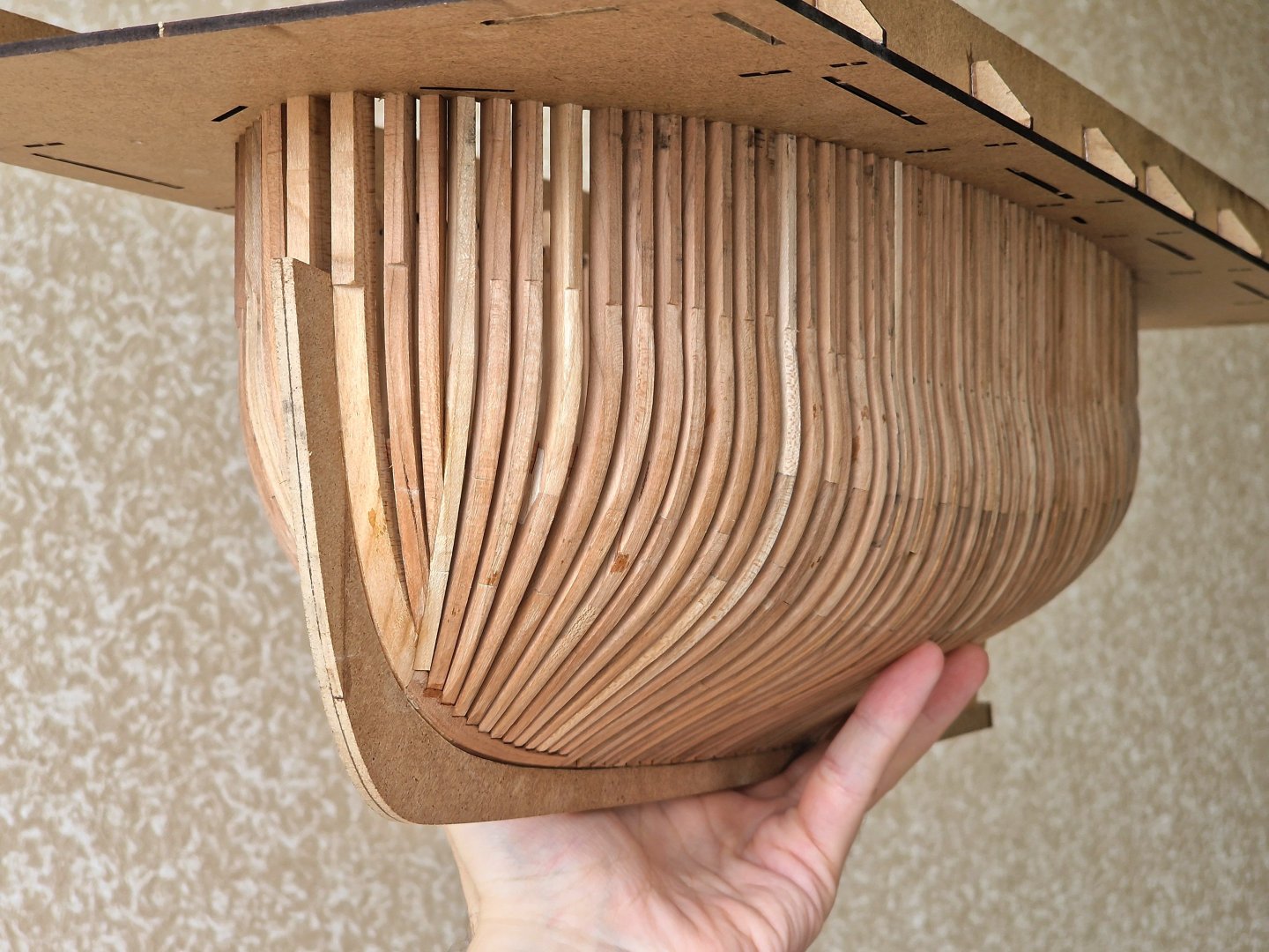

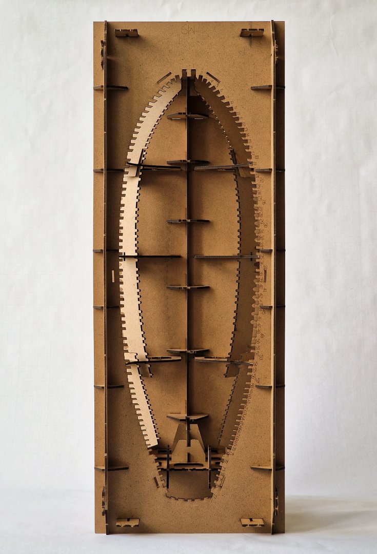

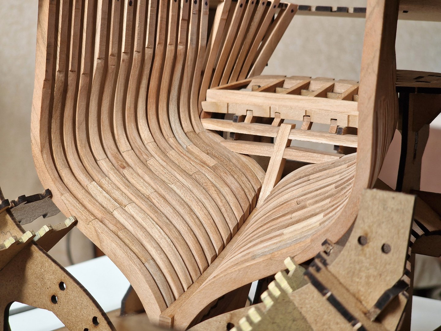

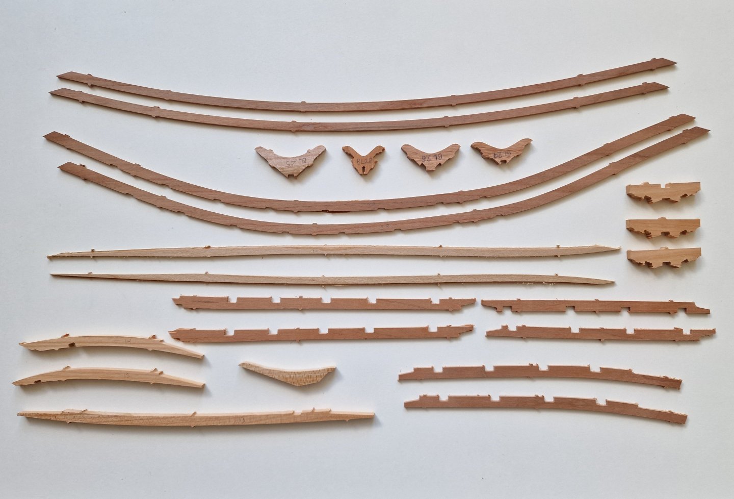

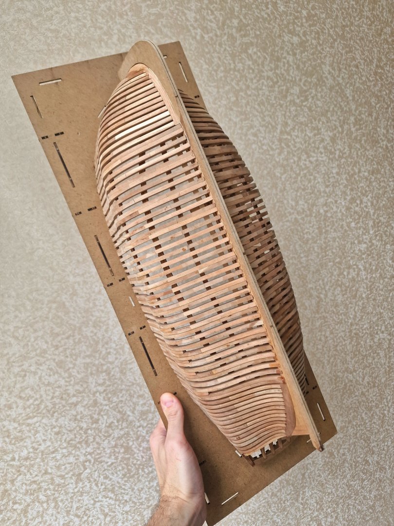

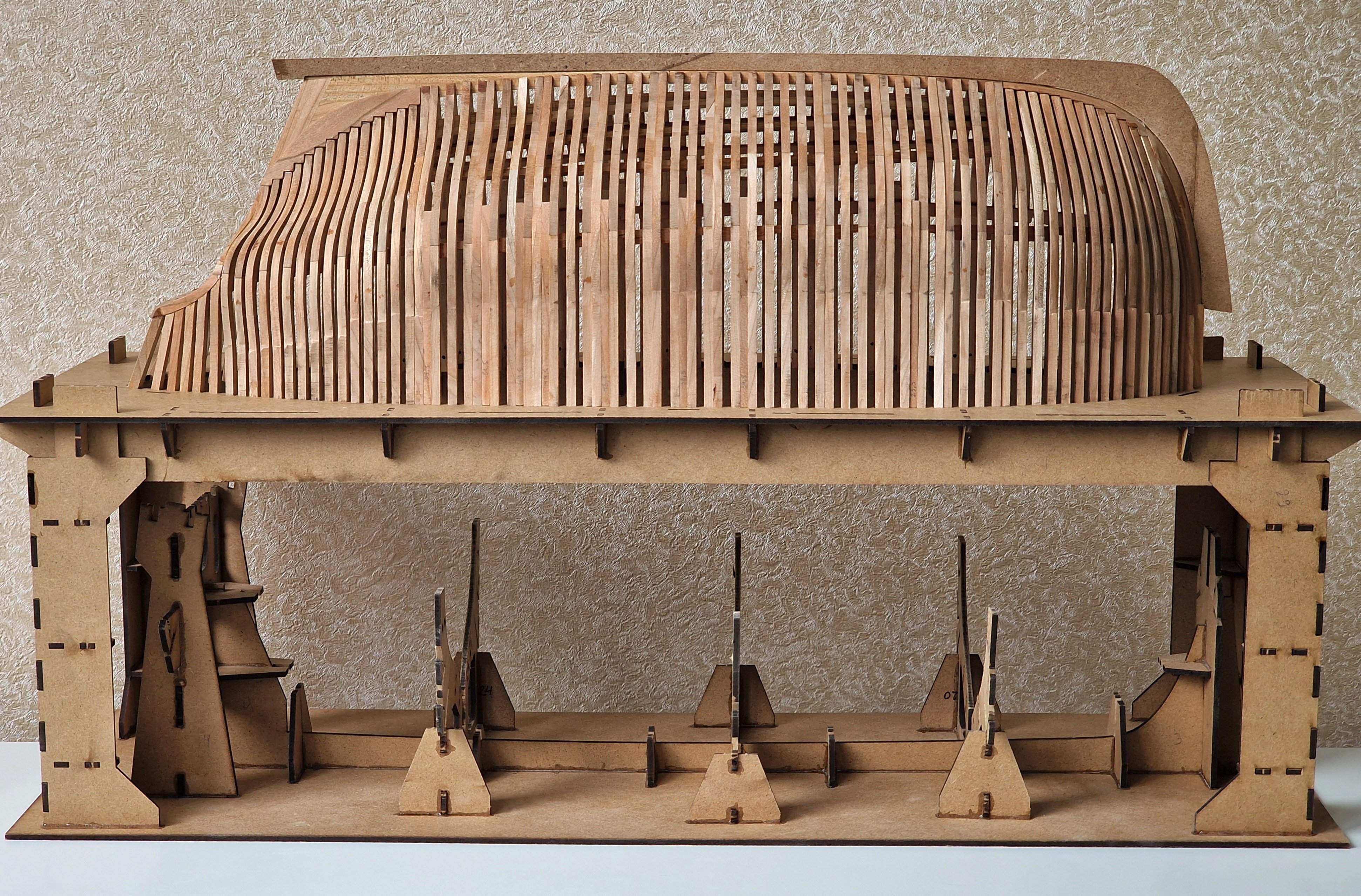

After cleaning from sawdust, separating from the base, numbering and grouping into separate packets......

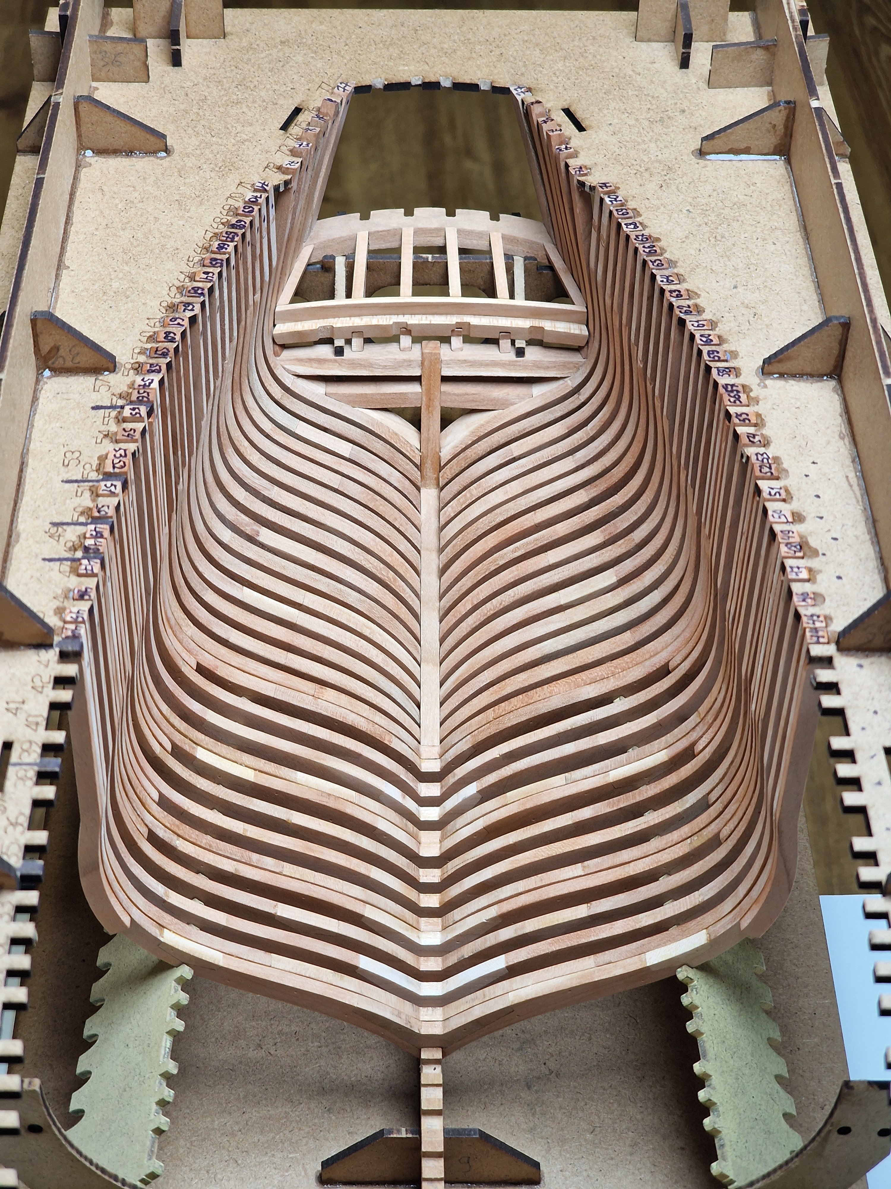

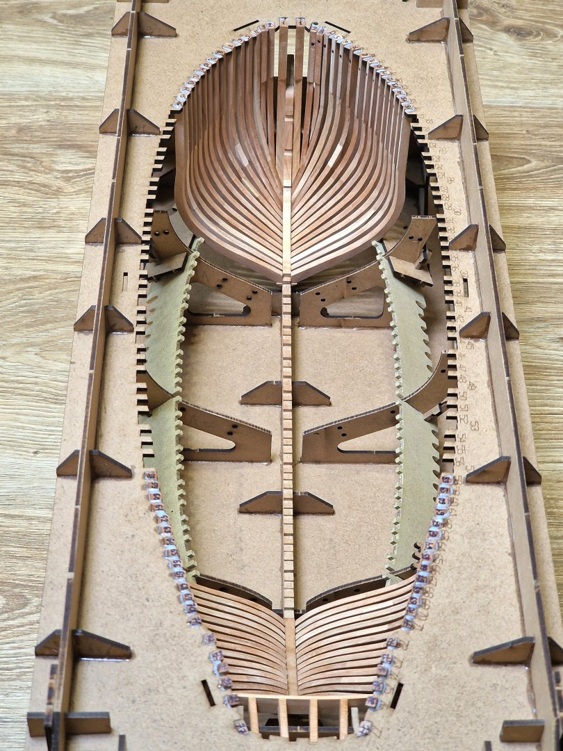

…I began assembling the frames.

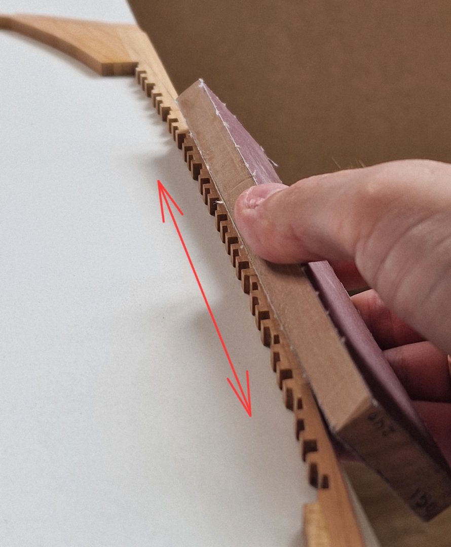

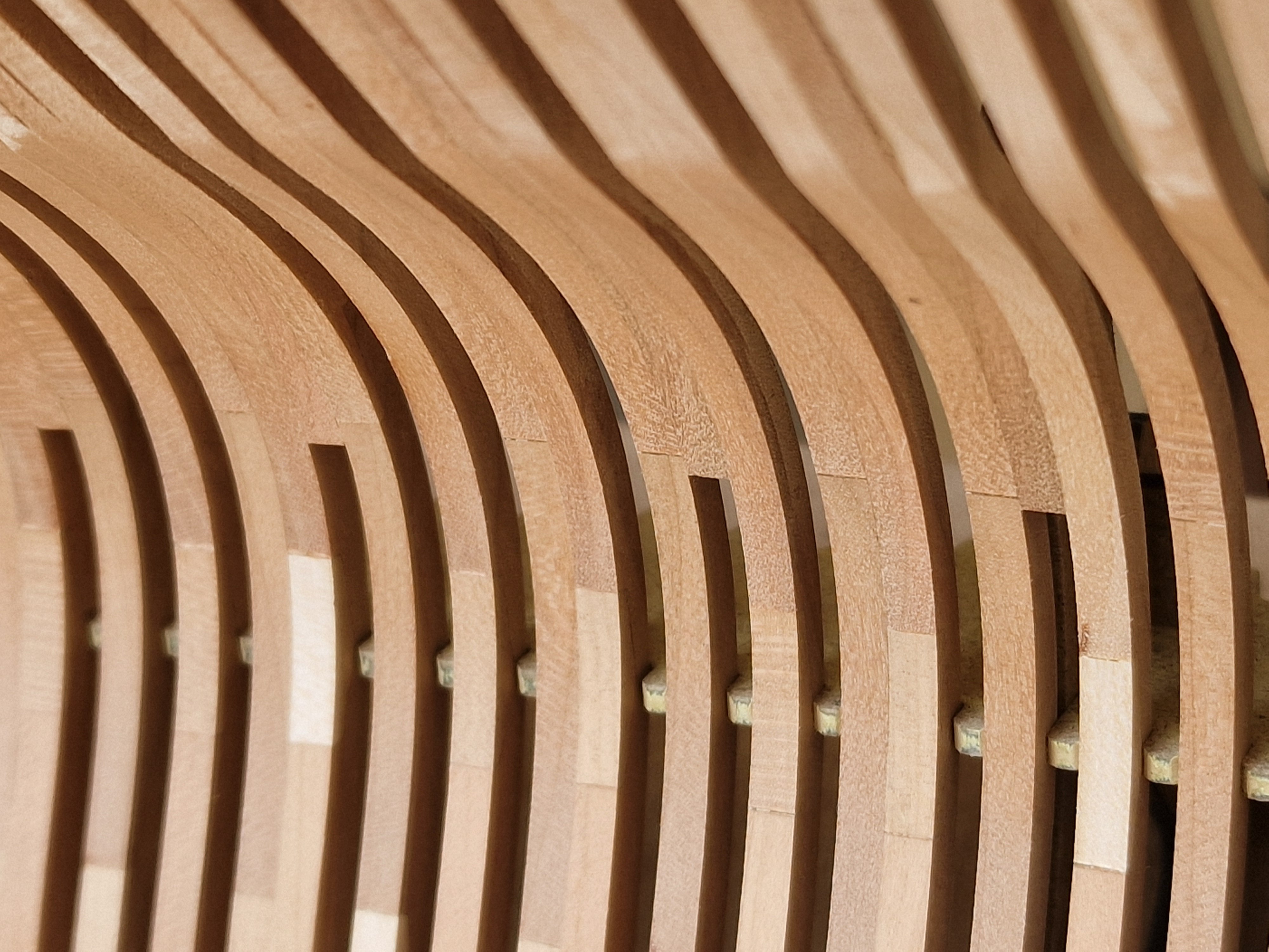

There is nothing complicated here, considering that it was necessary to carefully join them in the jigs, removing all excess. Then I glued everything with PVA Titebond II, placing food wrap in between so it wouldn’t stick to the jig.

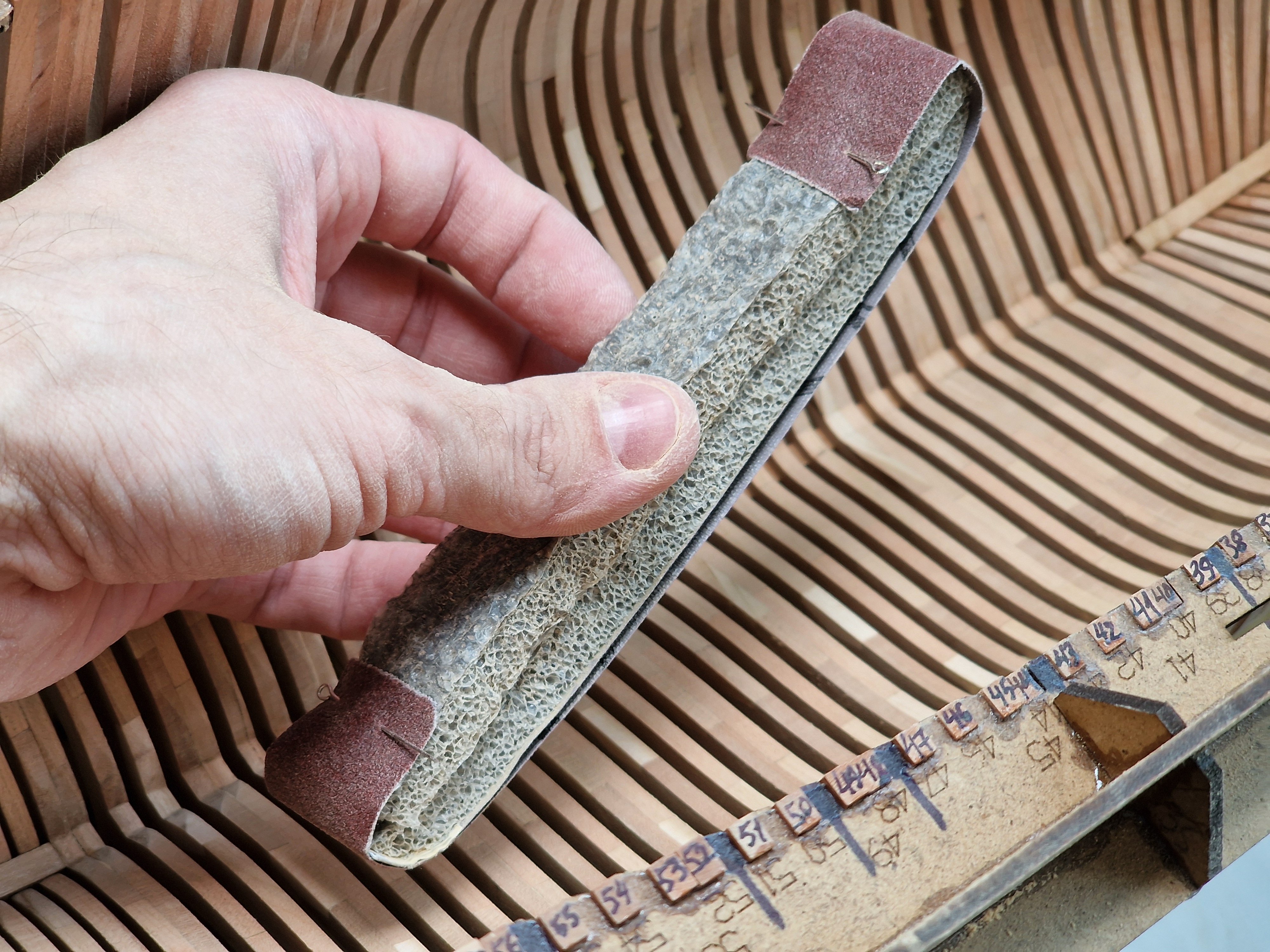

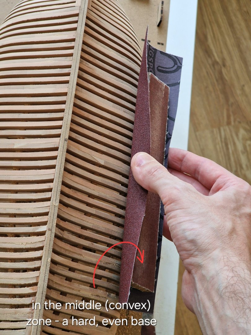

And after sanding...
…I got this result:

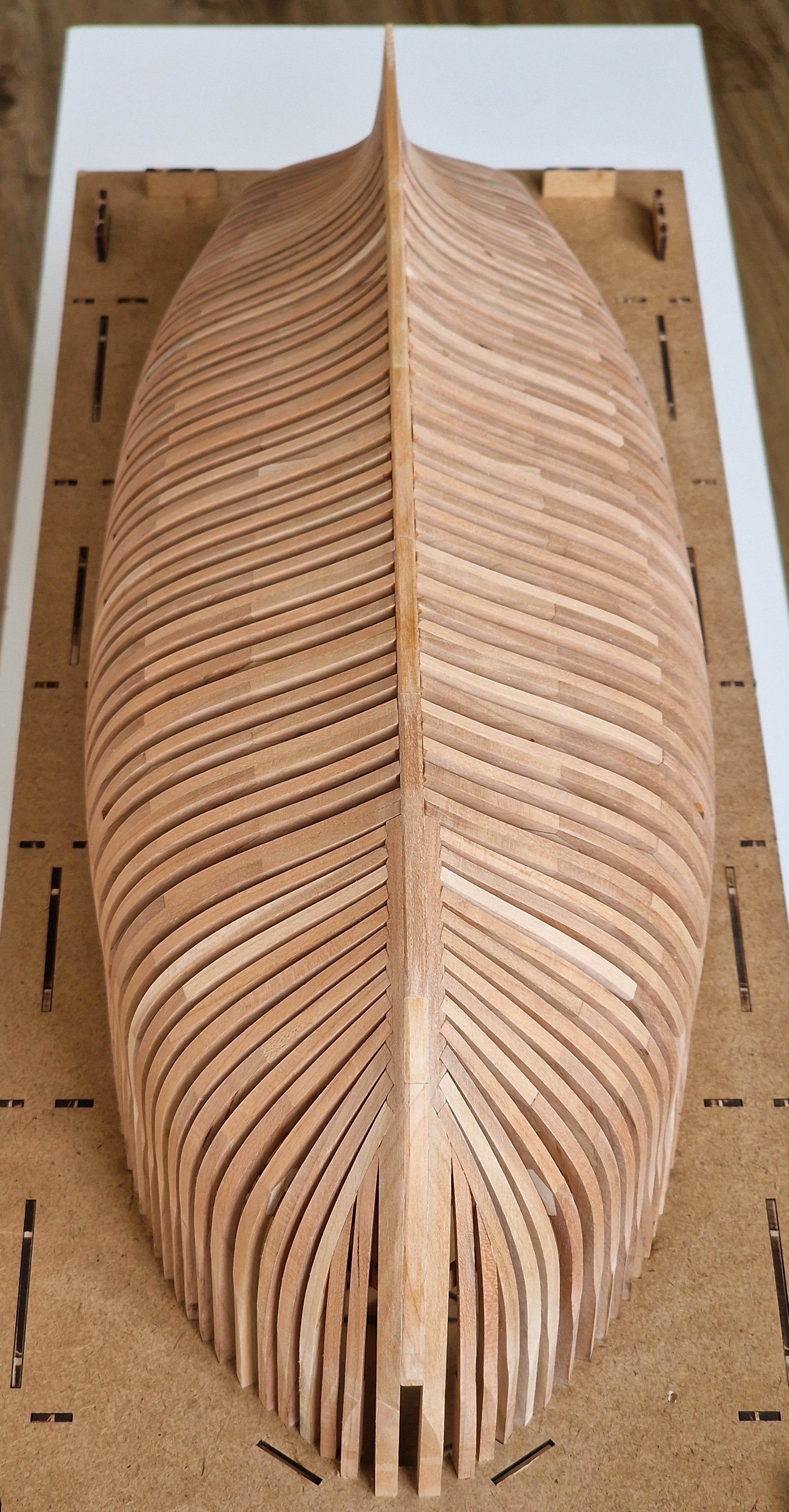

April 2025

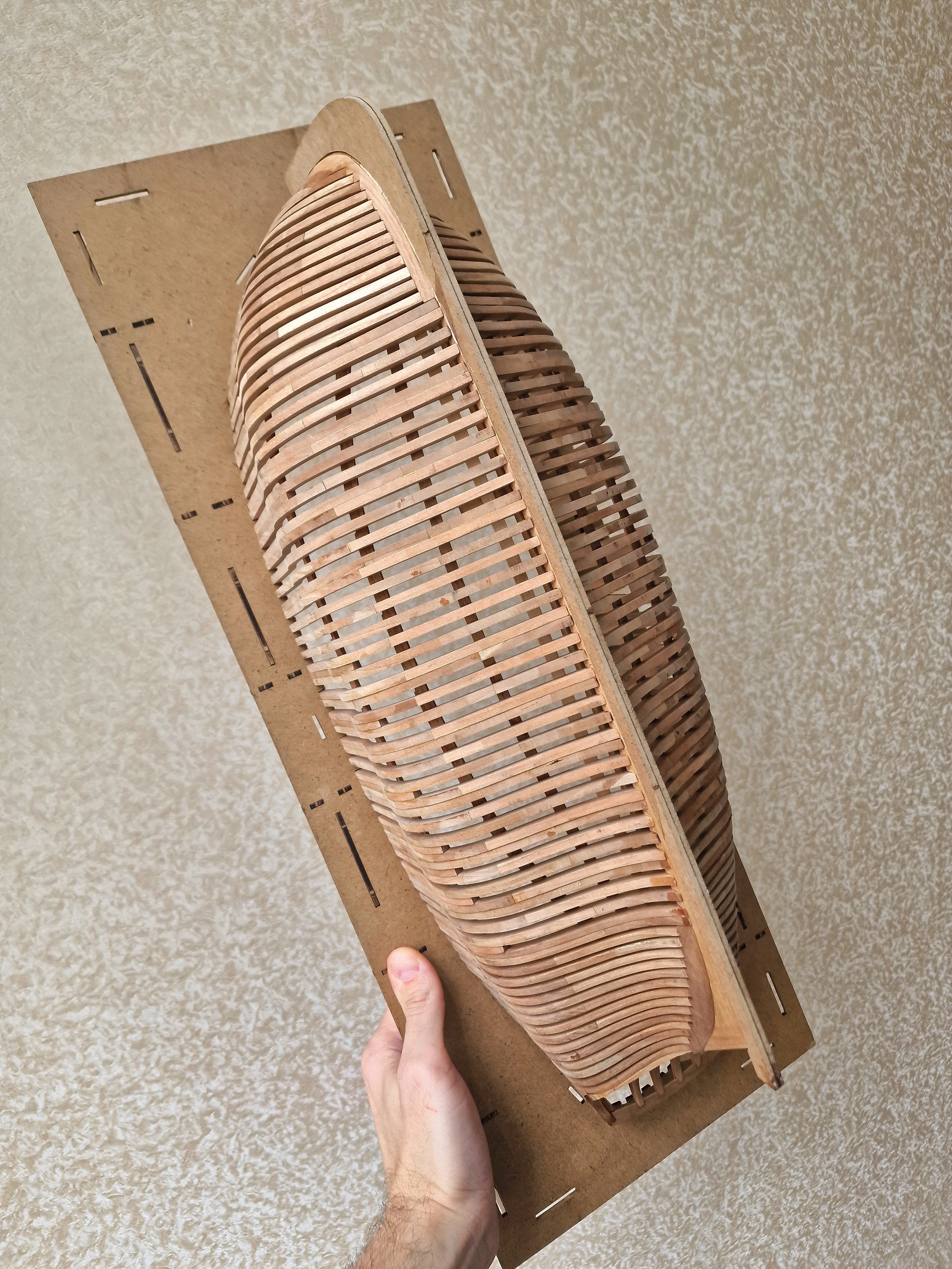

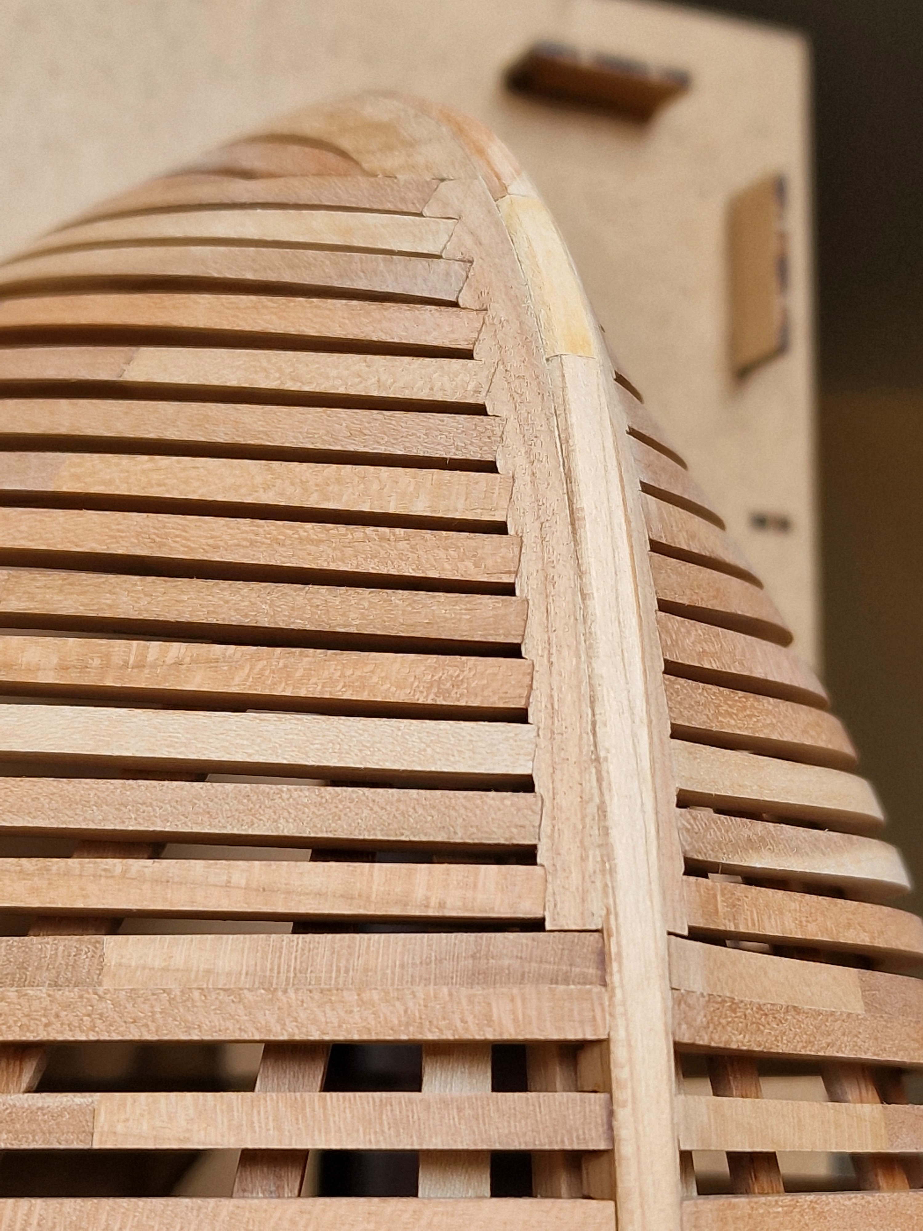

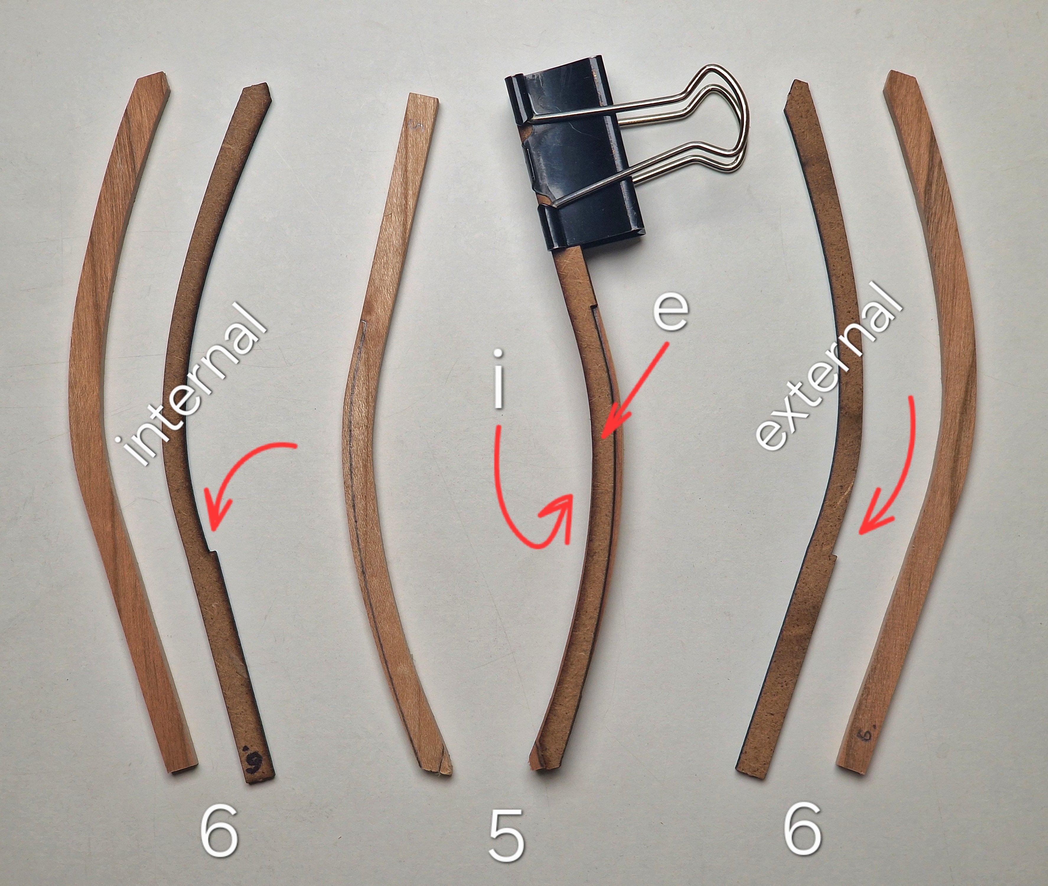

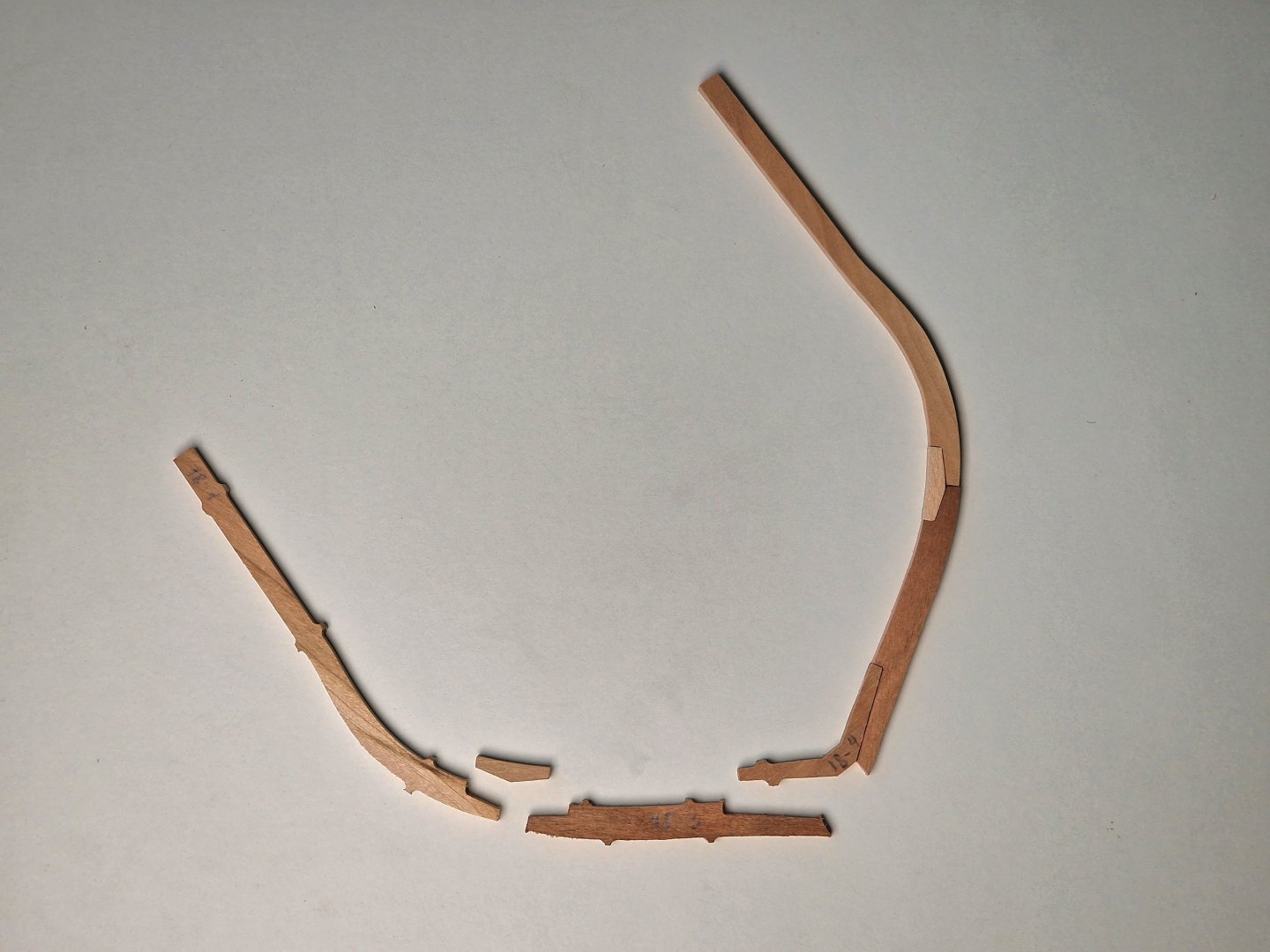

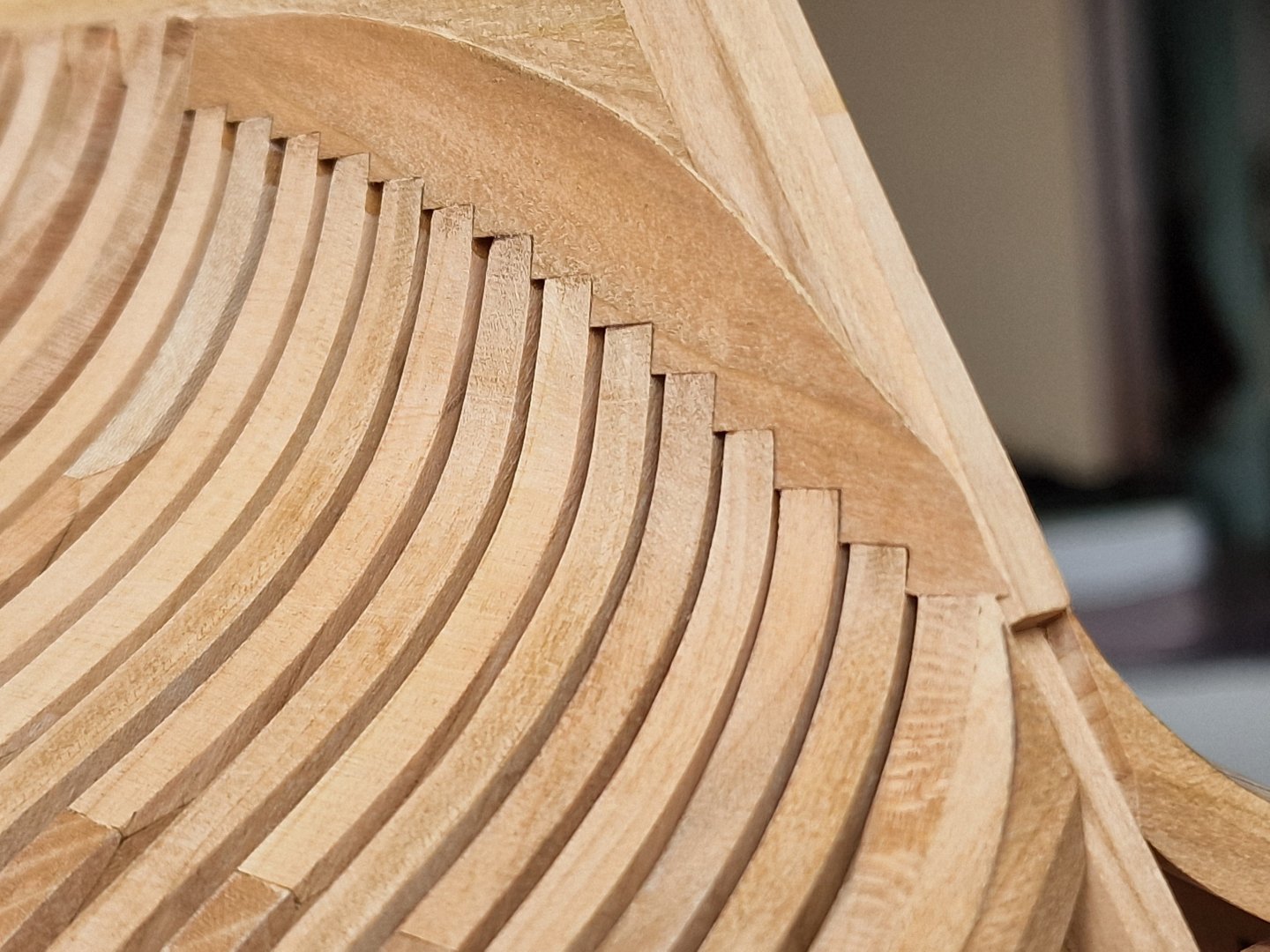

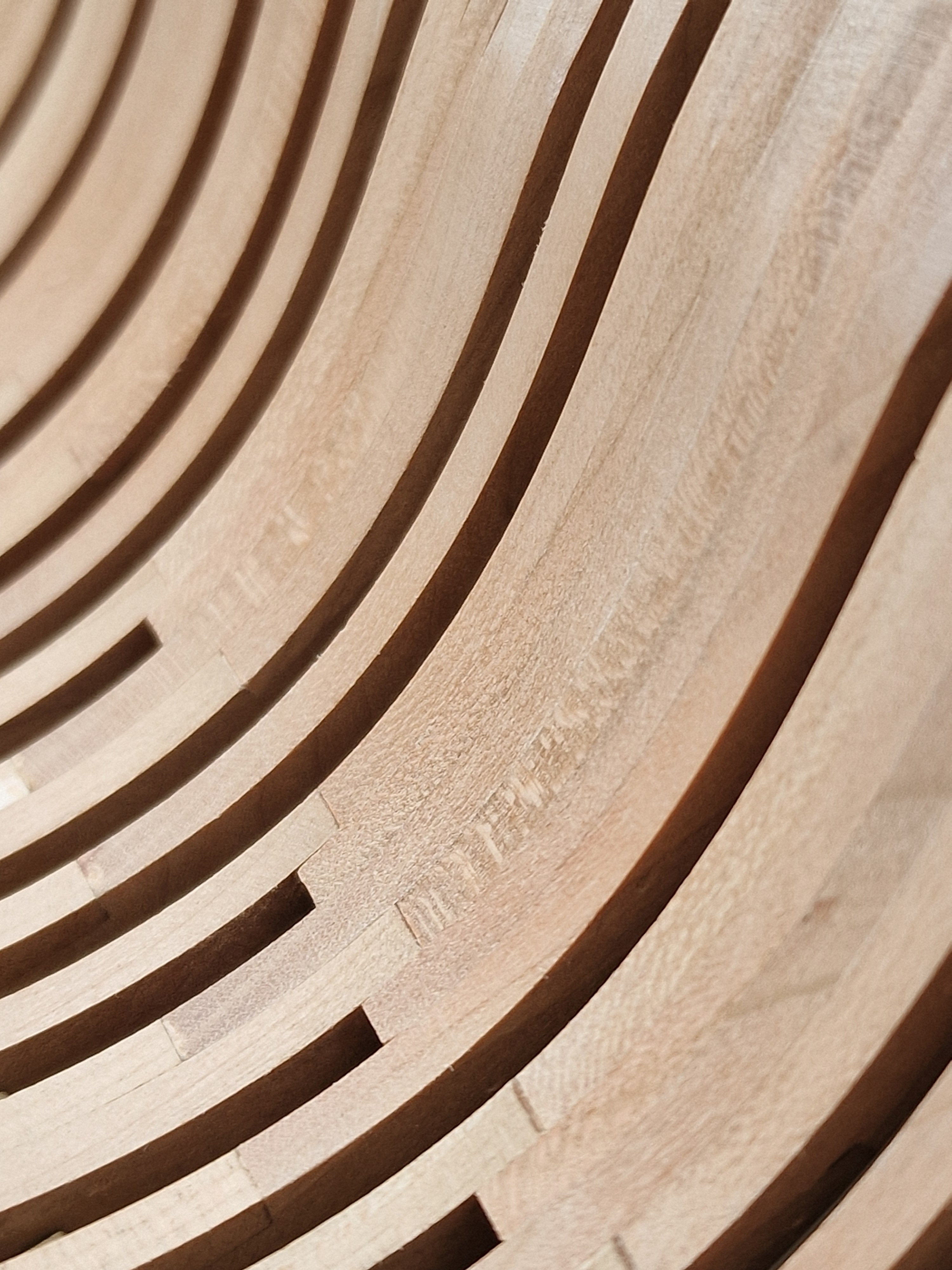

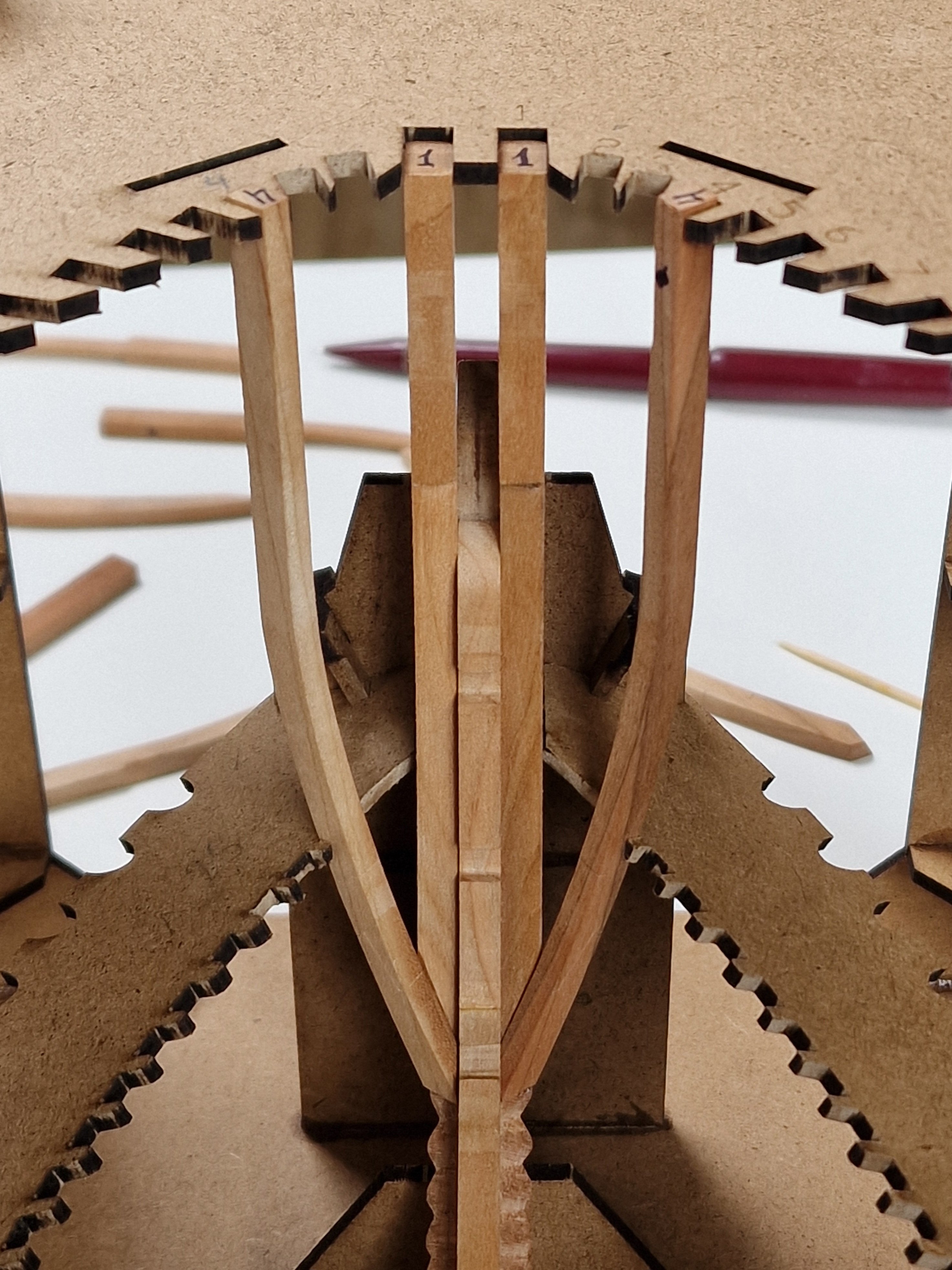

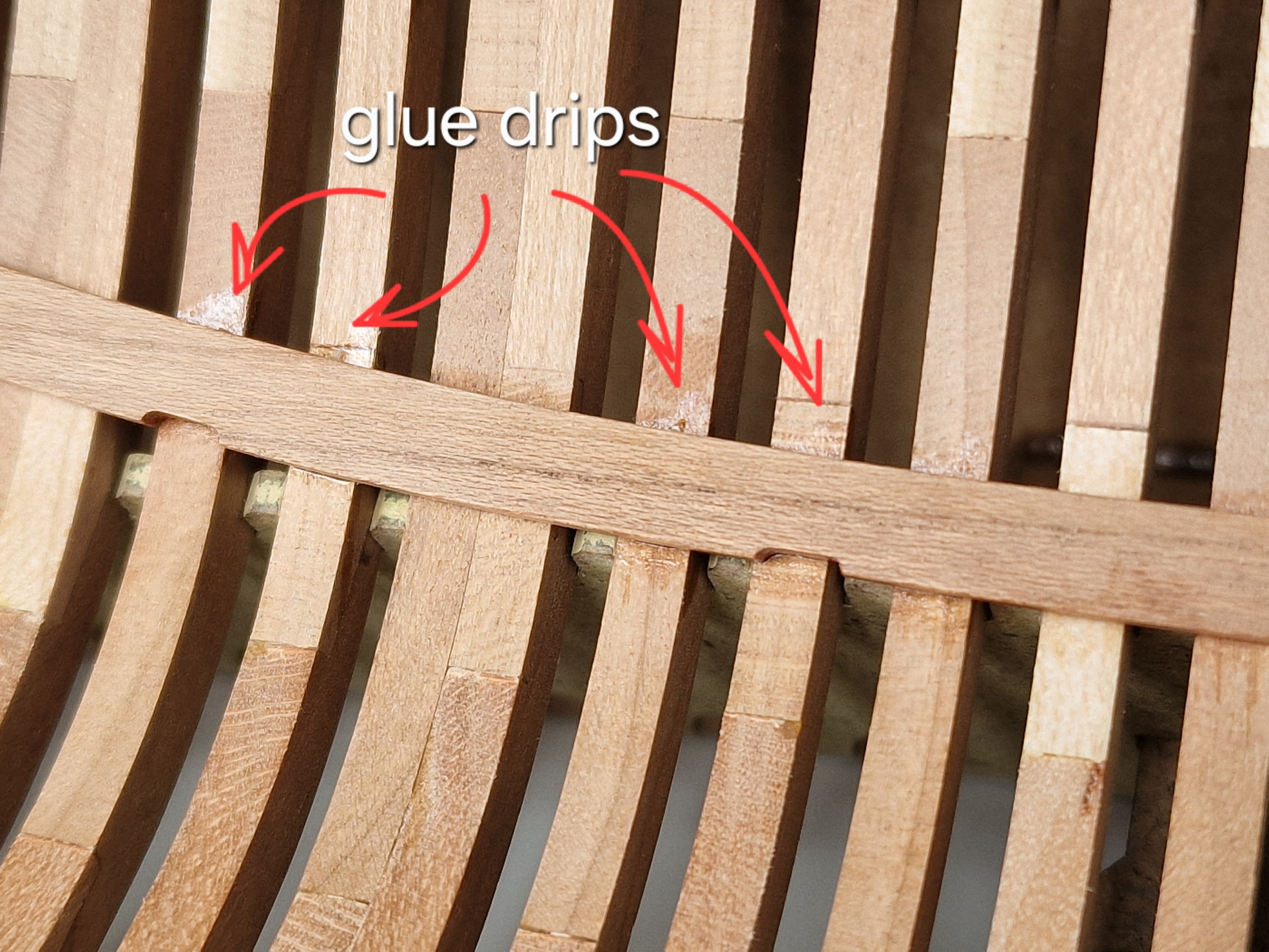

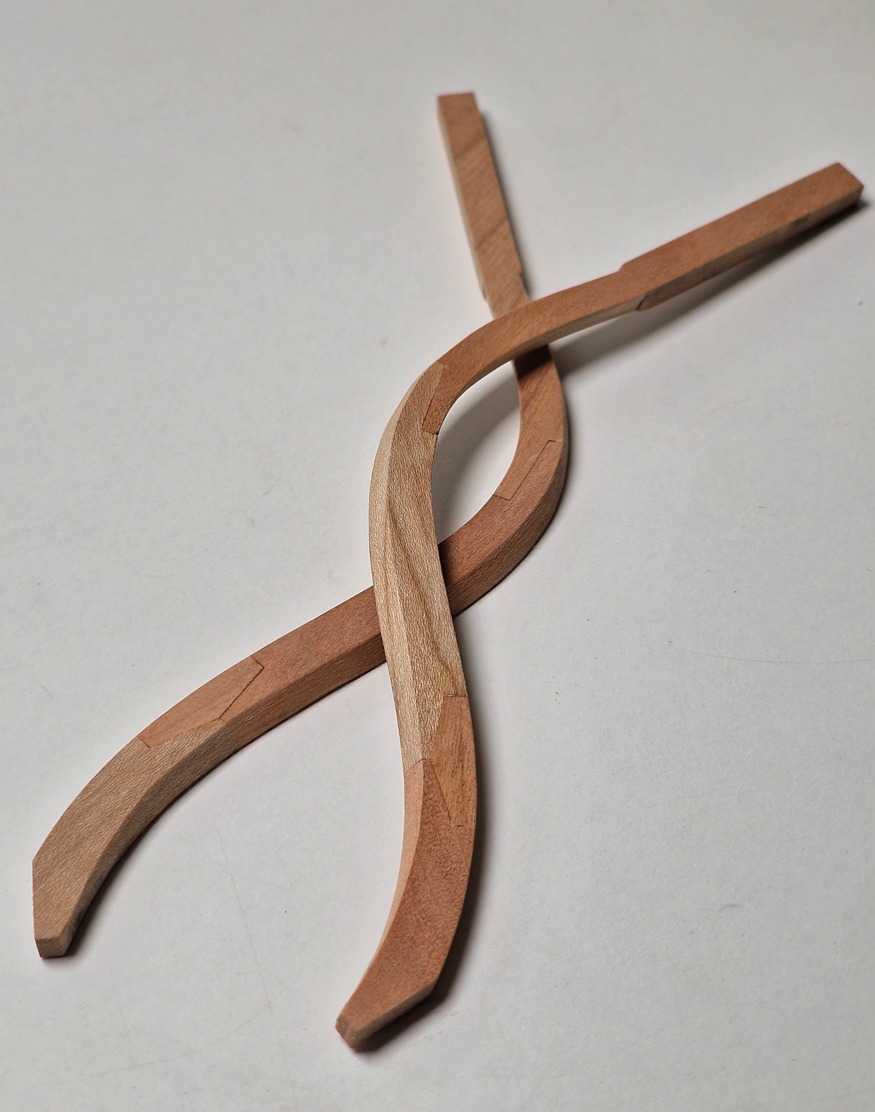

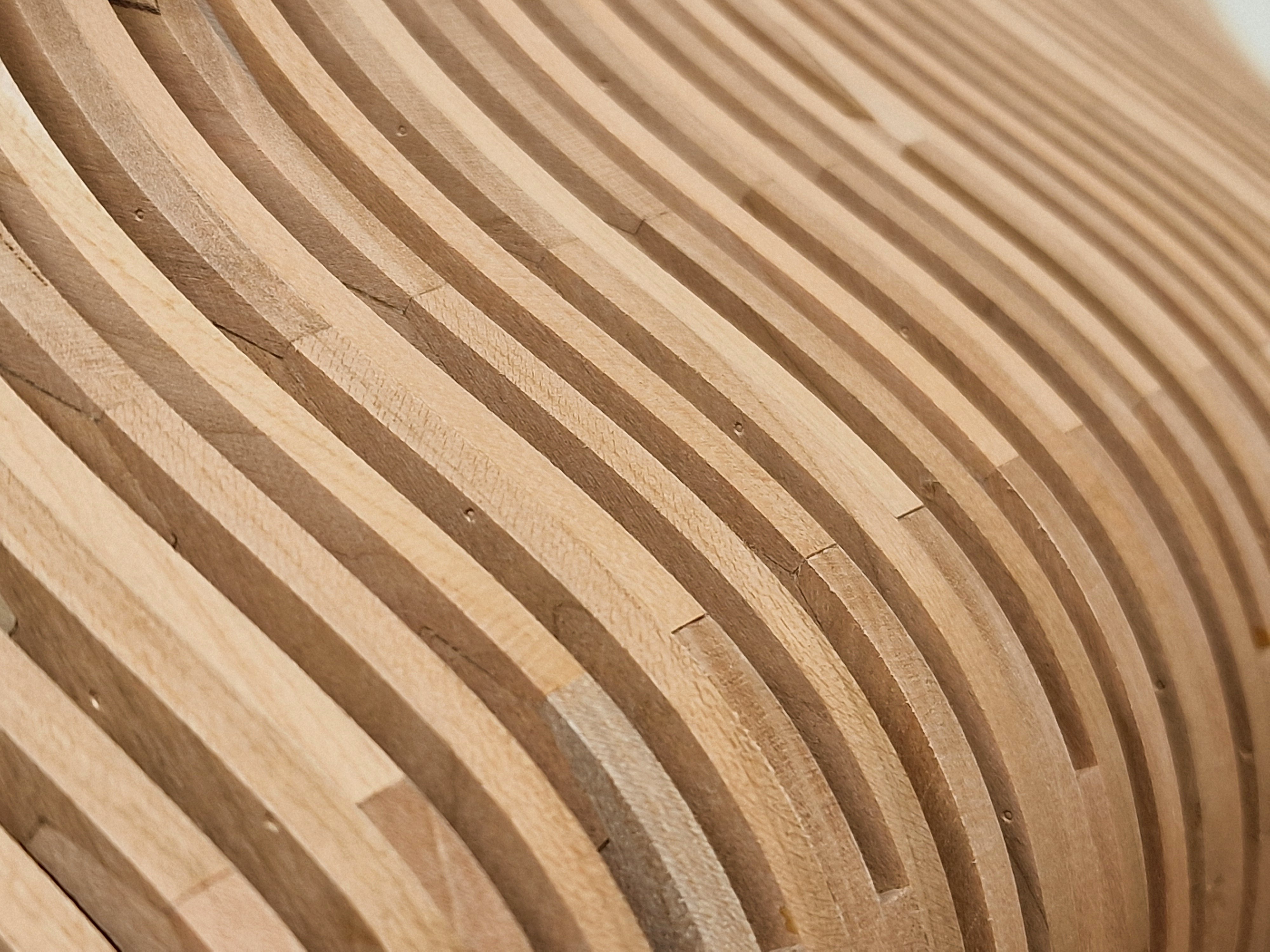

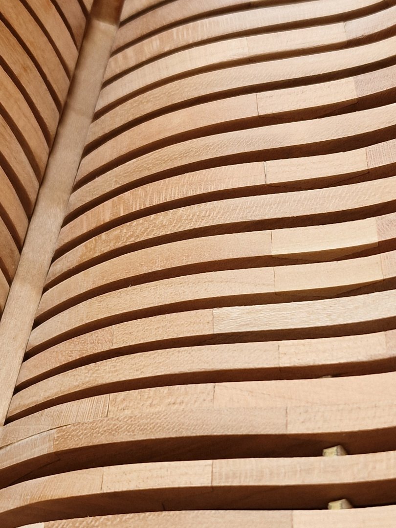

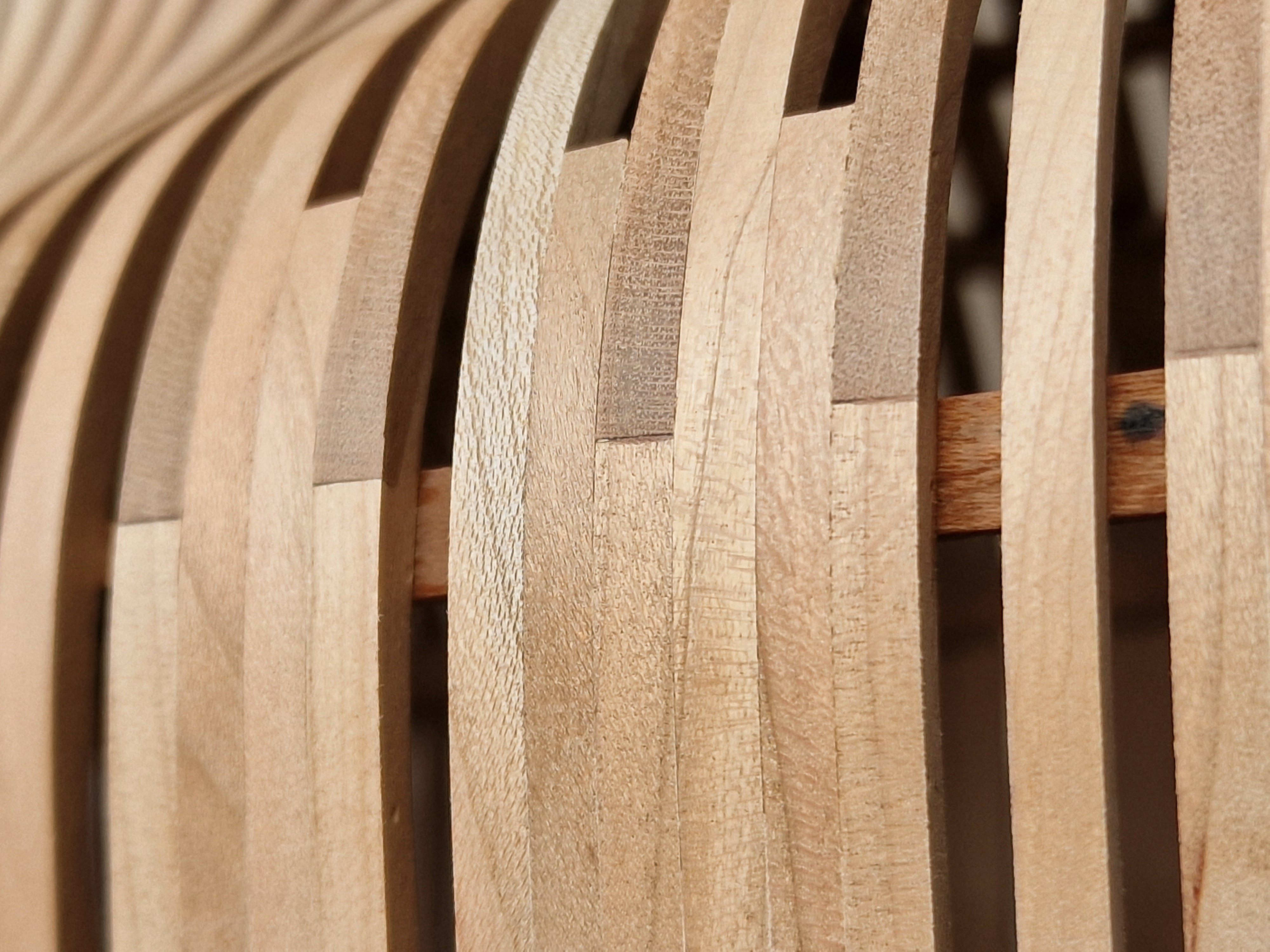

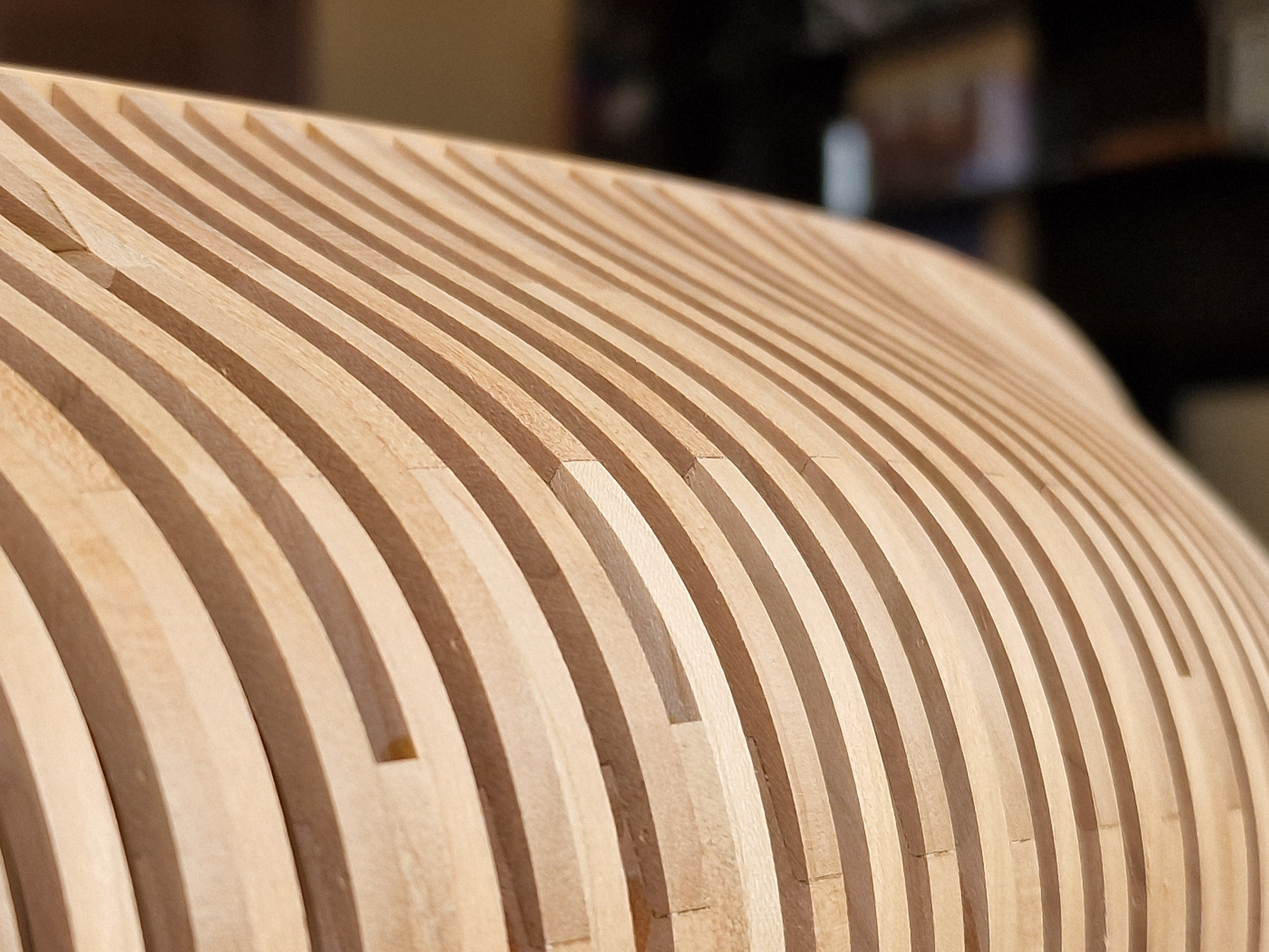

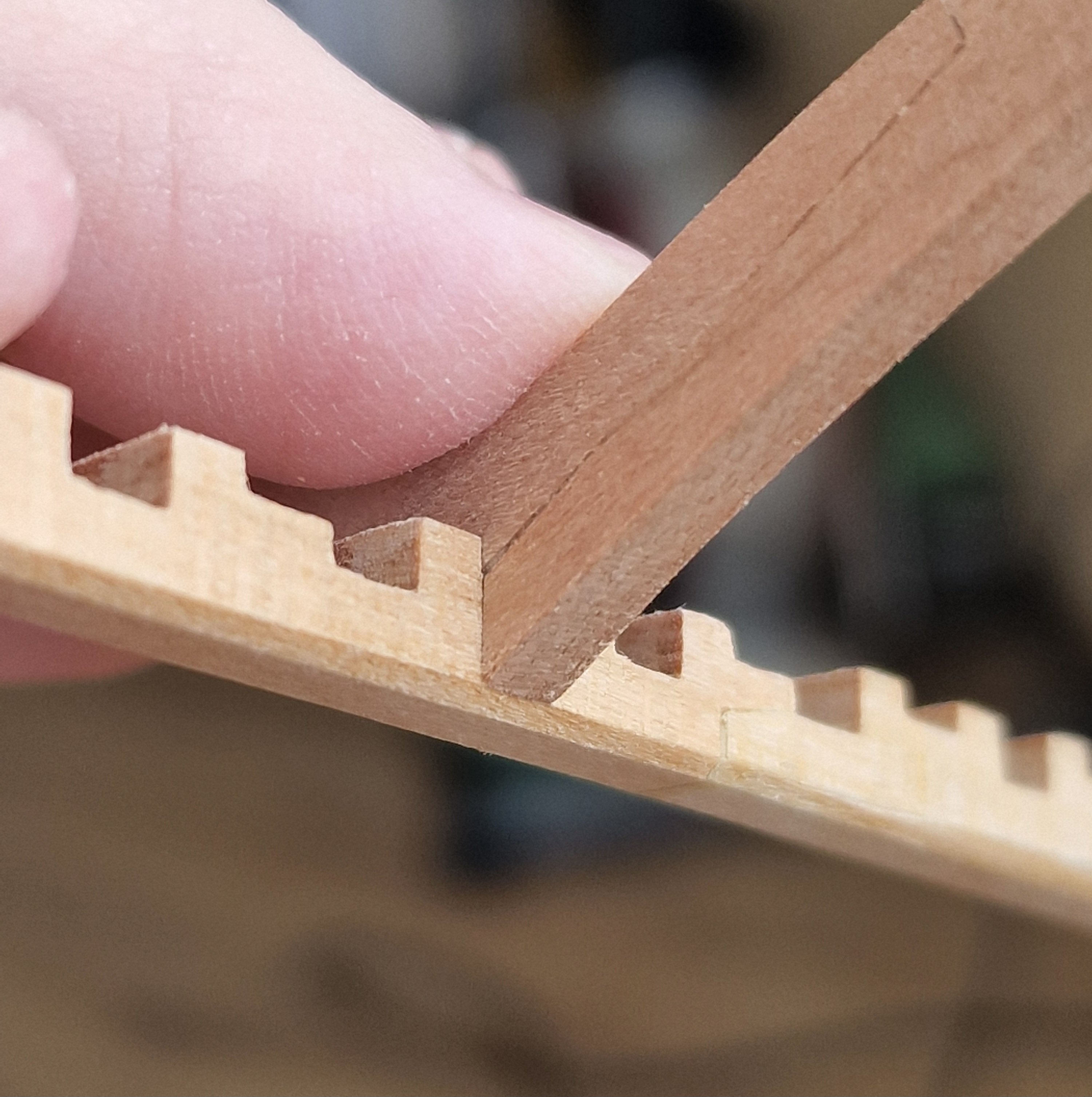

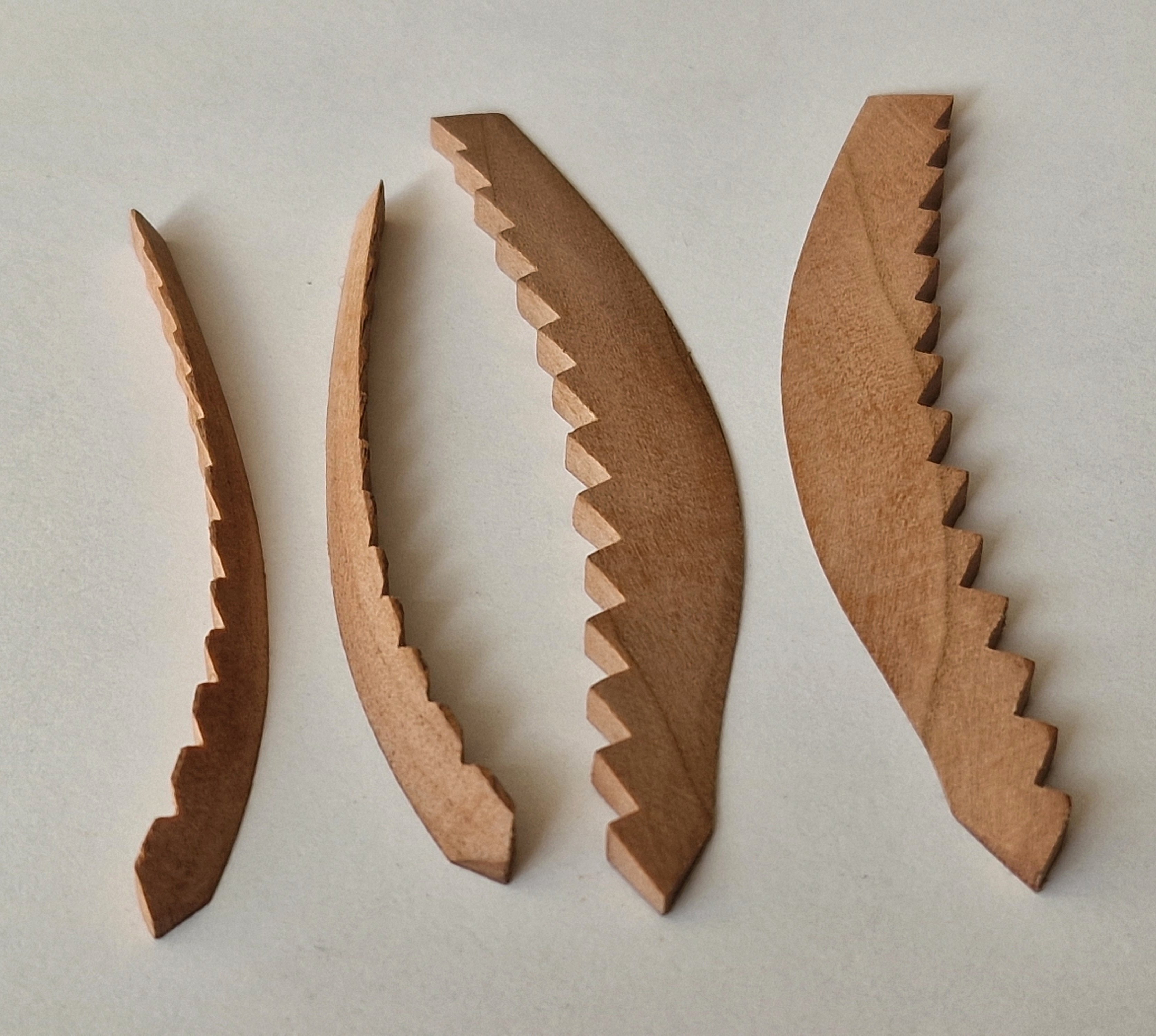

With the solid frames it also wasn’t difficult. First I had to glue one side, flip them in the jig and glue the other side.

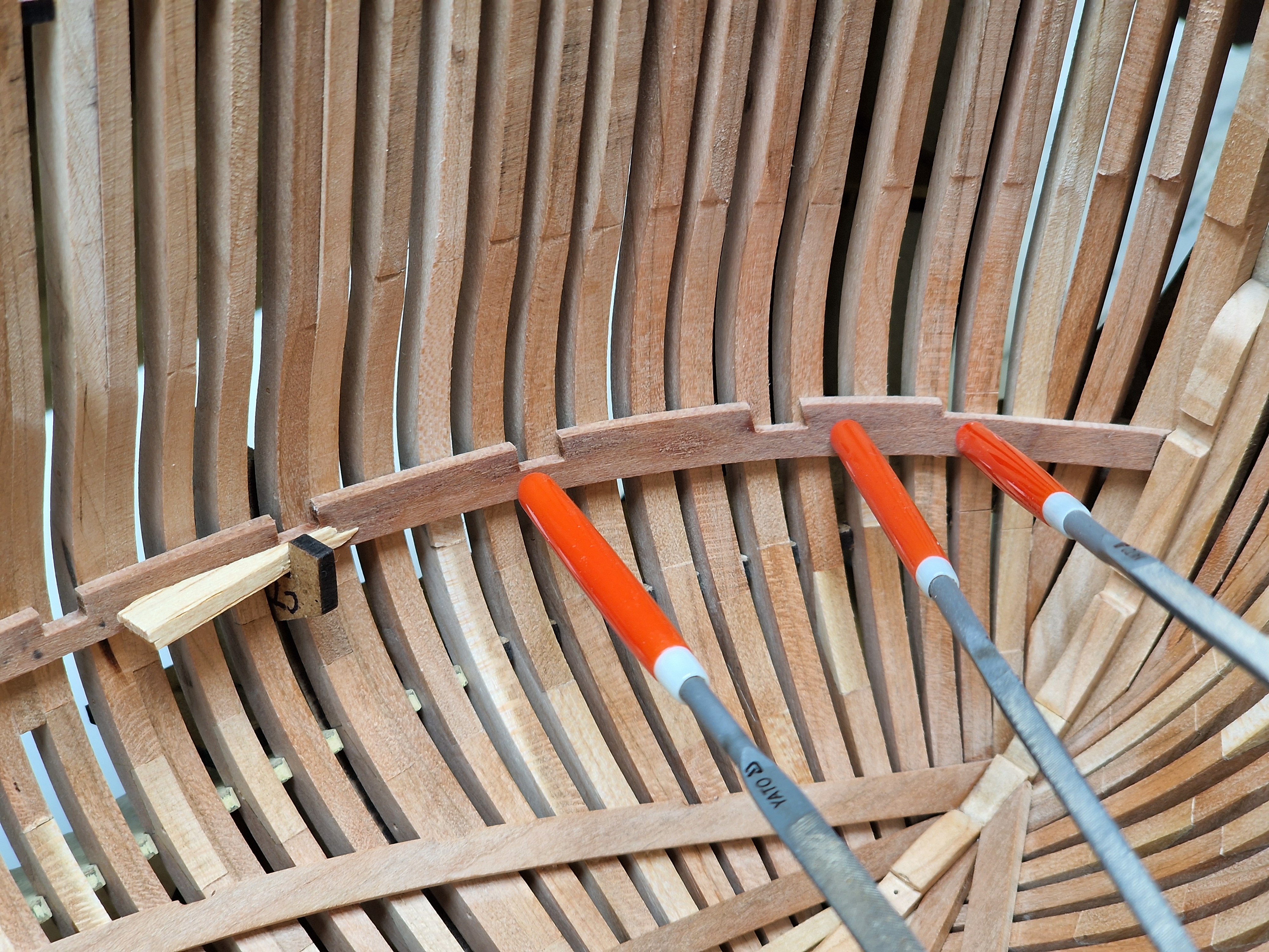

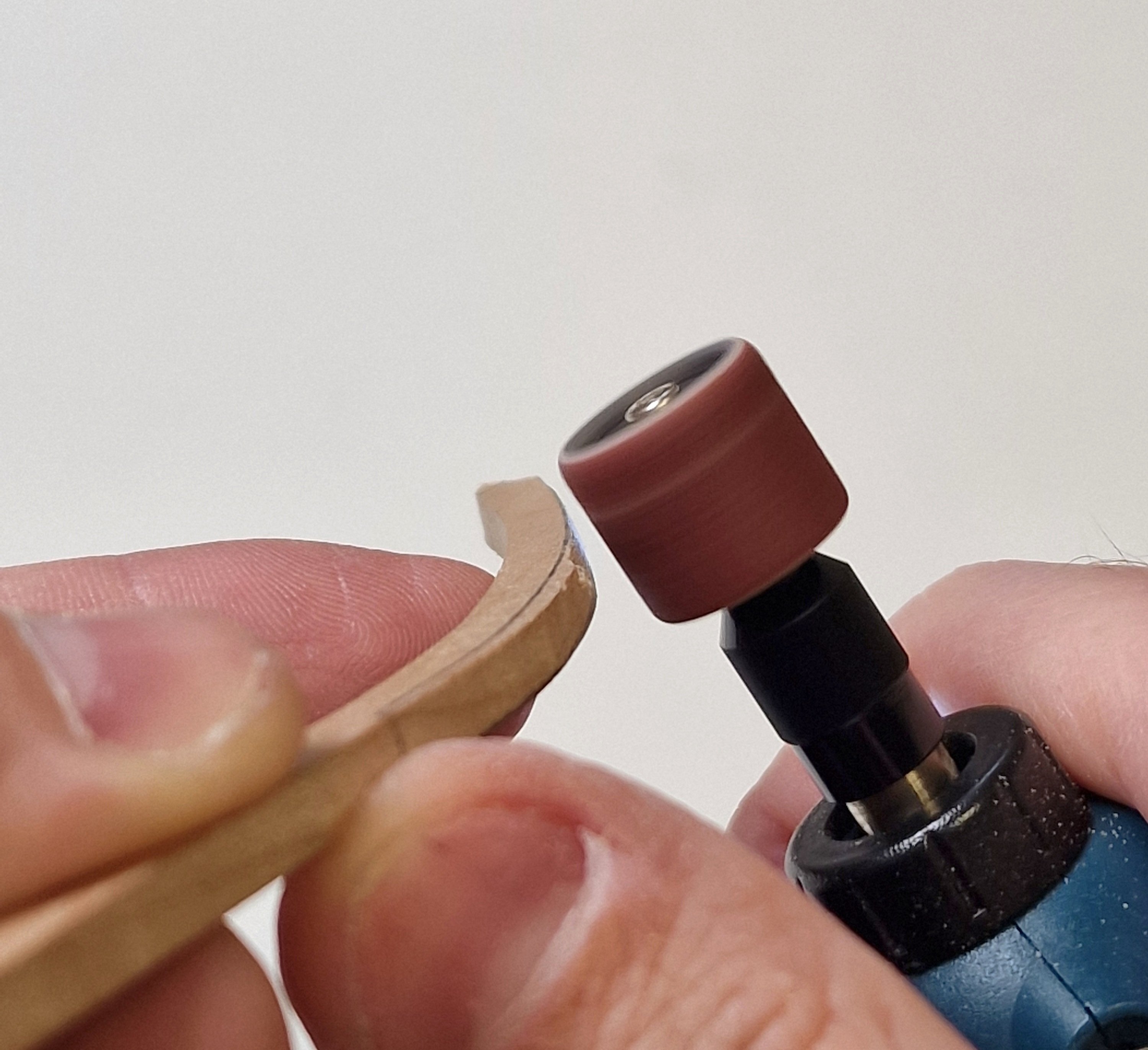

Then the frames needed to be faired. For this there were special templates that needed to be traced, and along this line the excess was removed.

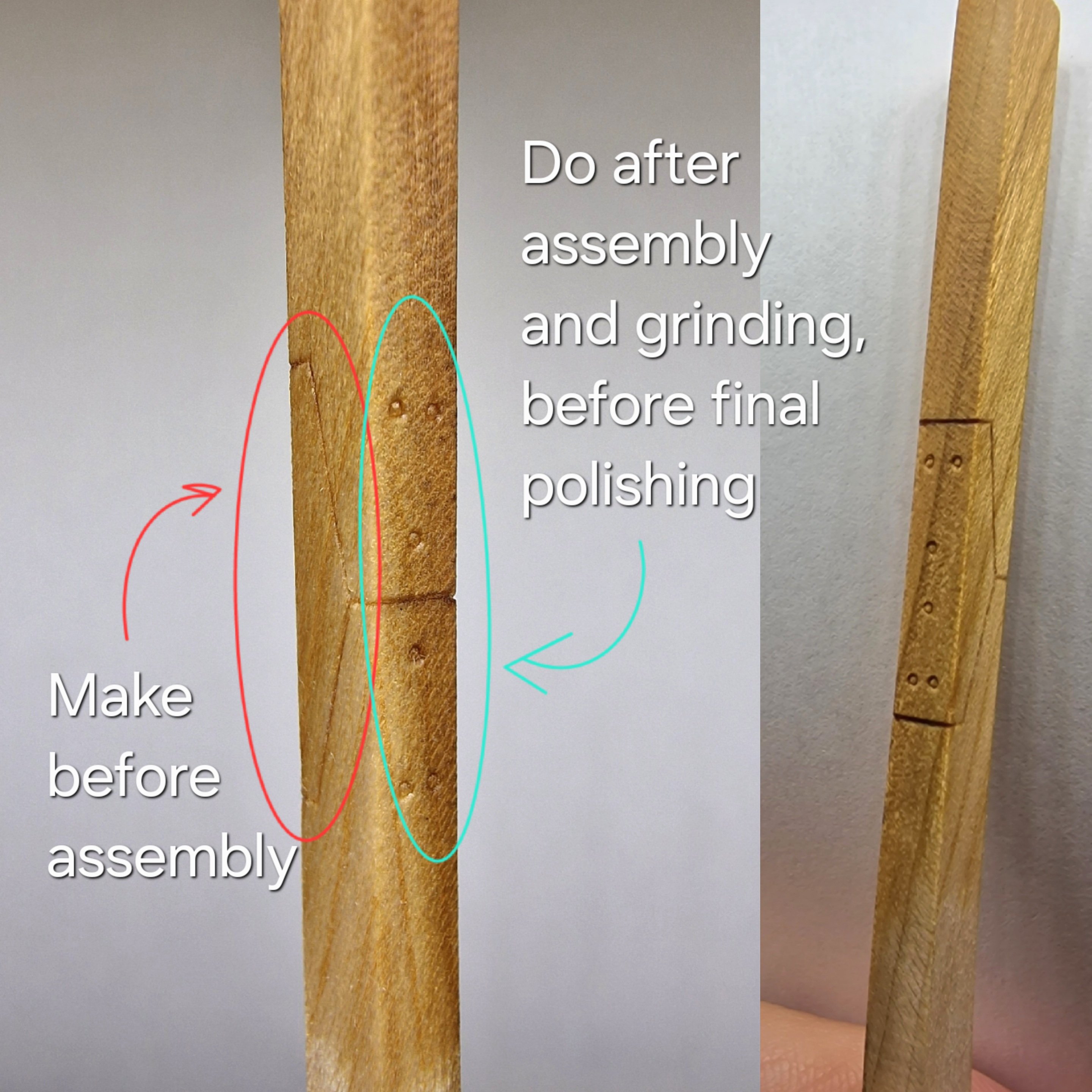

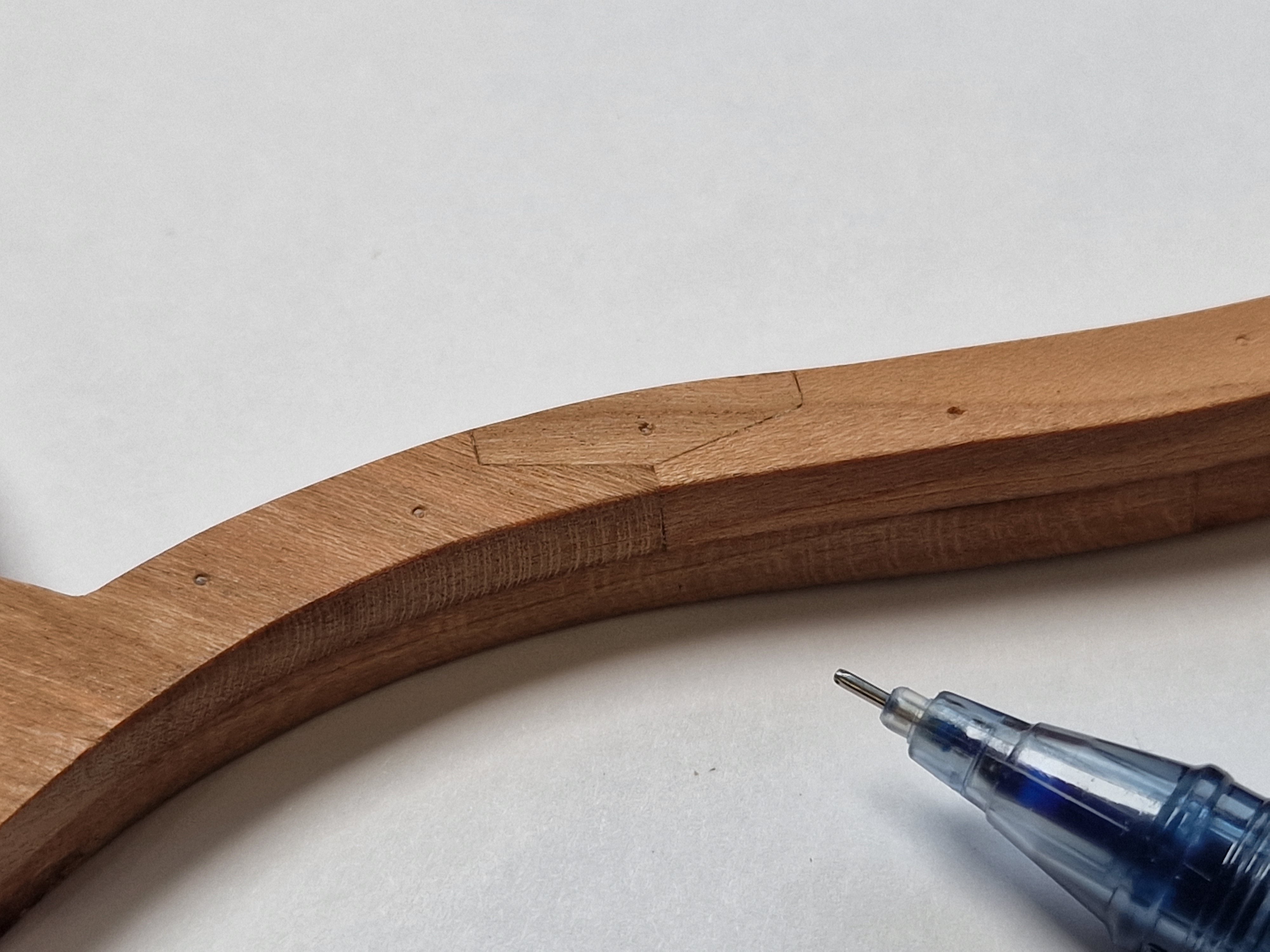

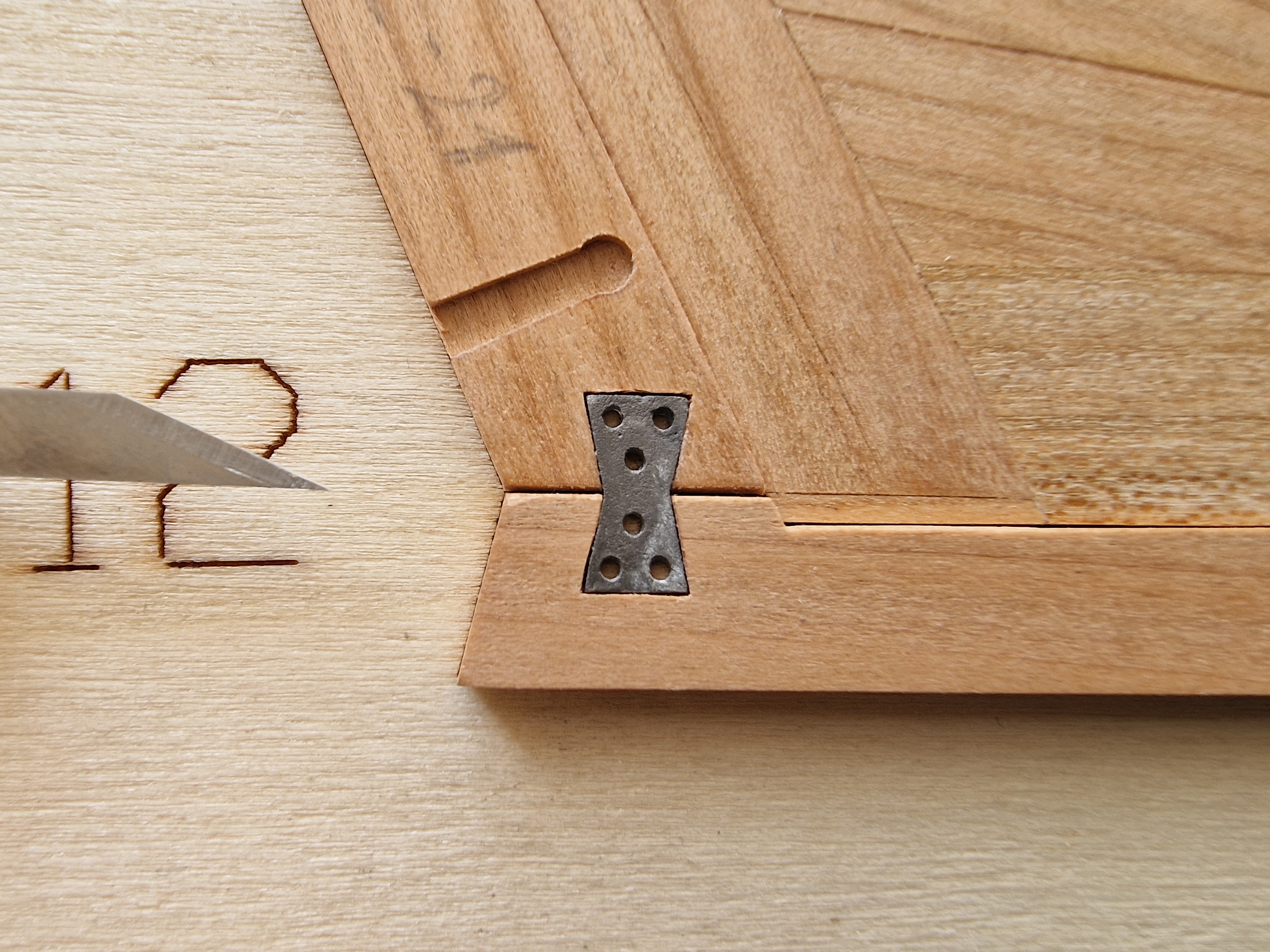

In some frames there were no joints, but according to the Anatomy they were supposed to be there — so I added them (as an imitation), and also made imitation bolts. I did this with a gel ballpoint pen after removing the ball.

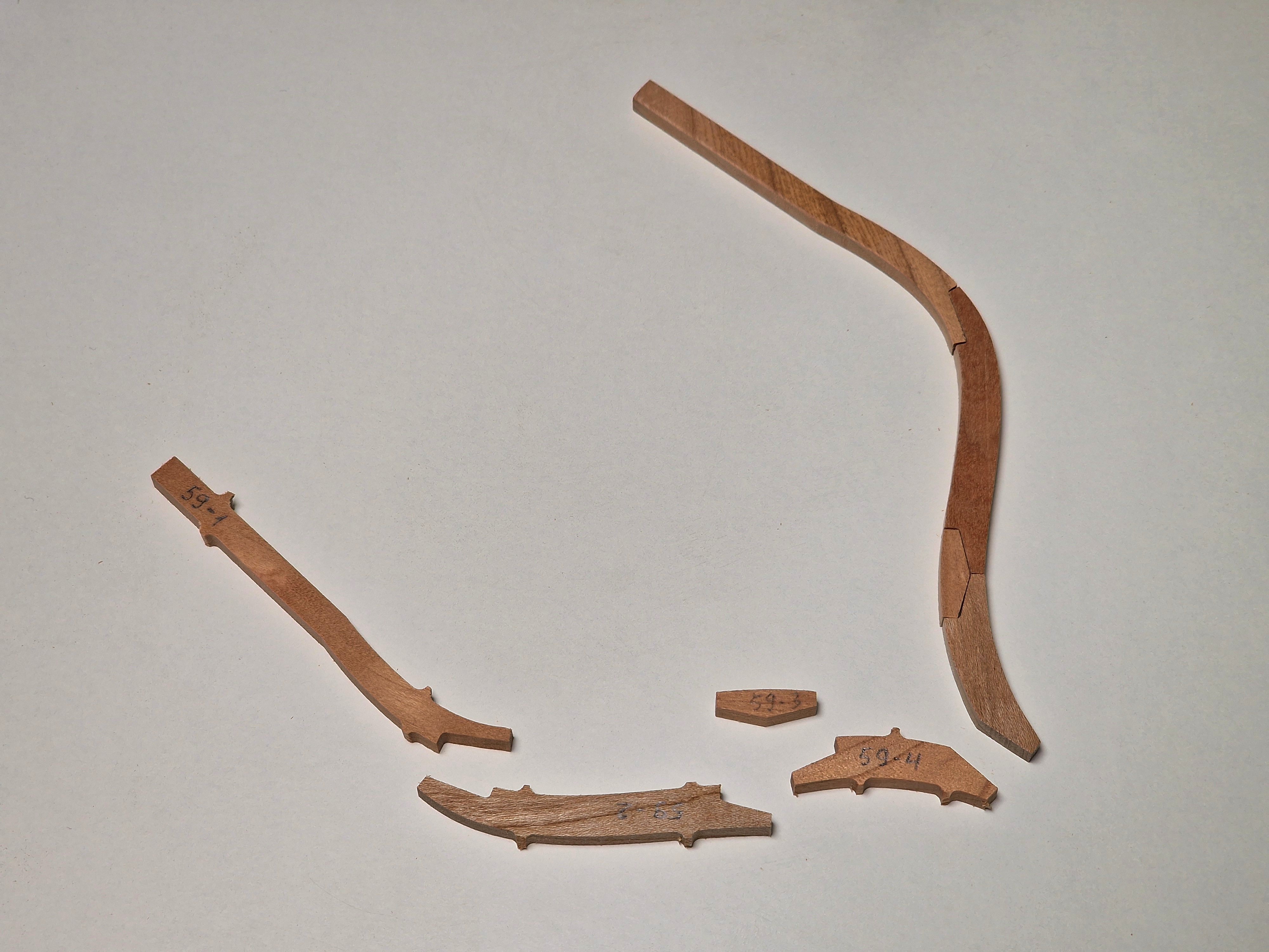

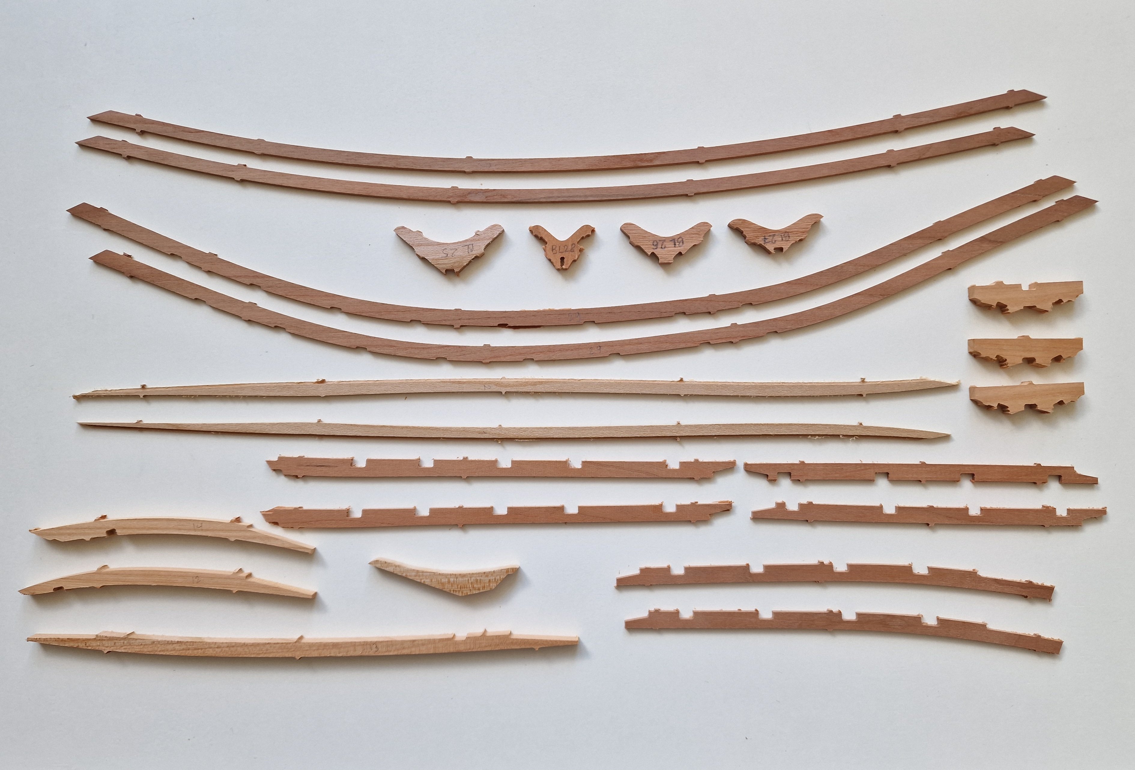

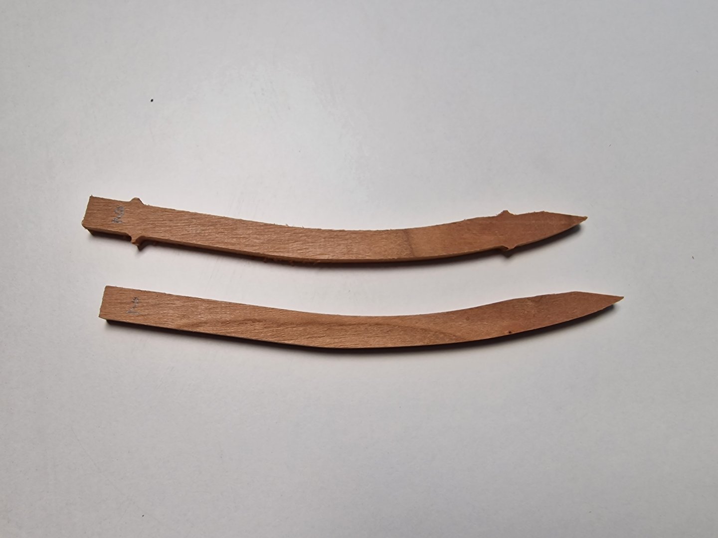

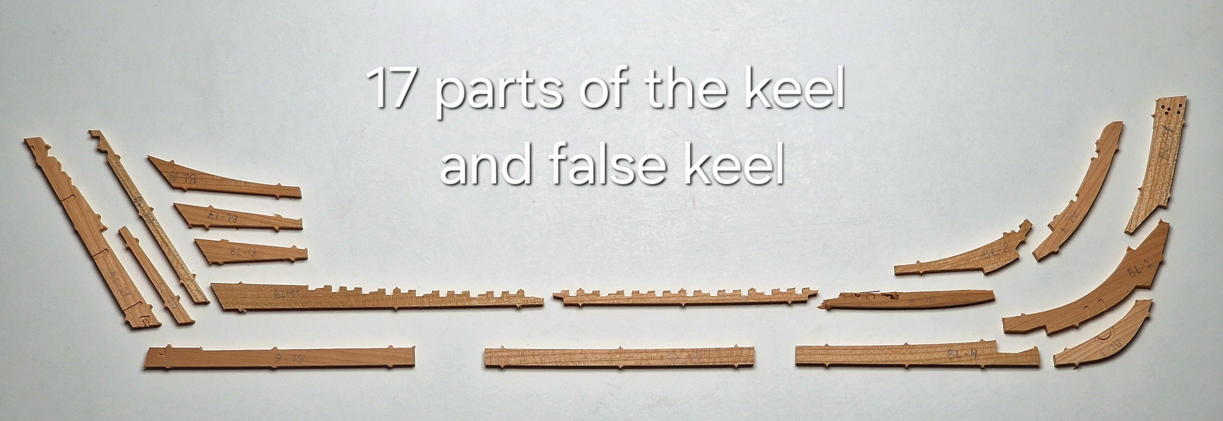

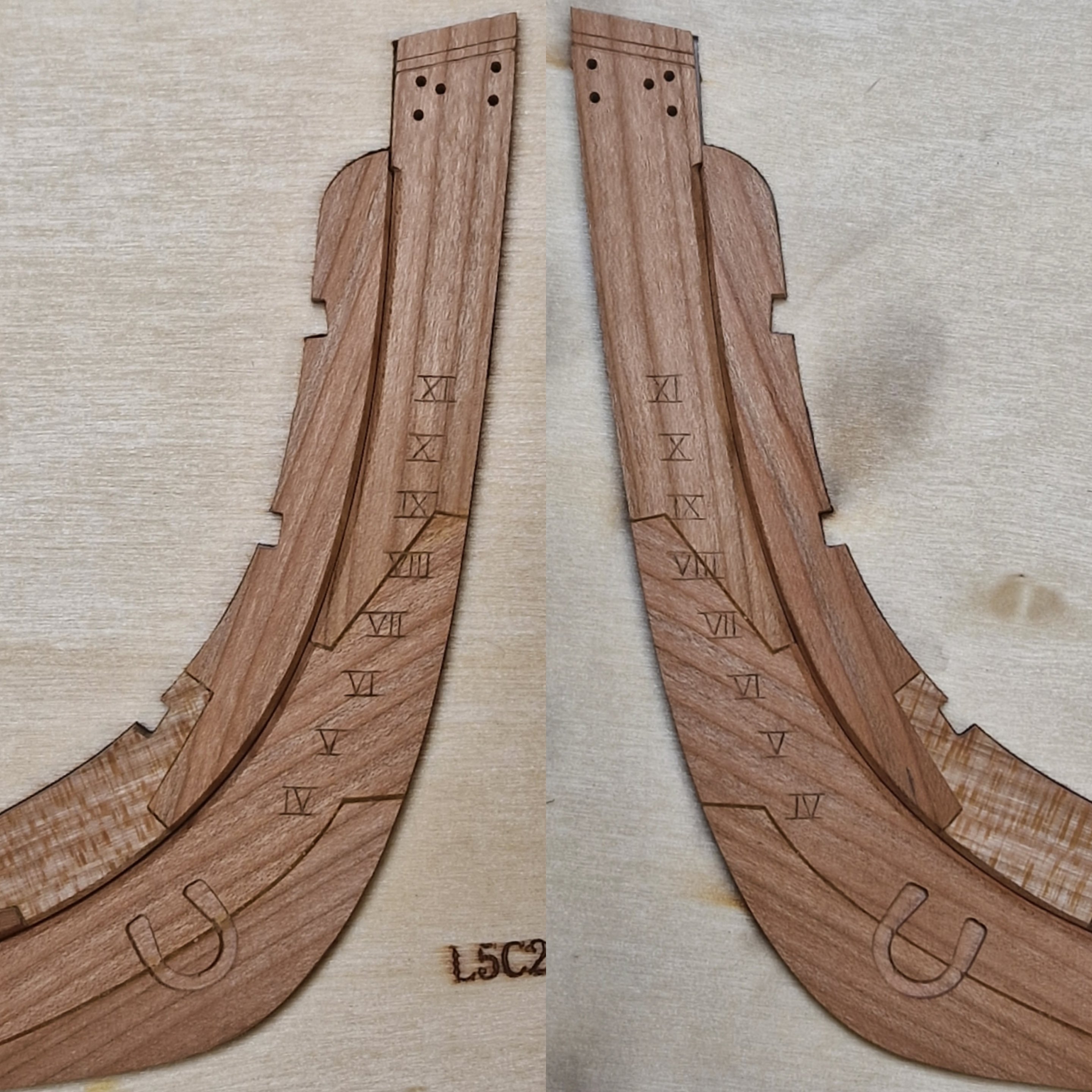

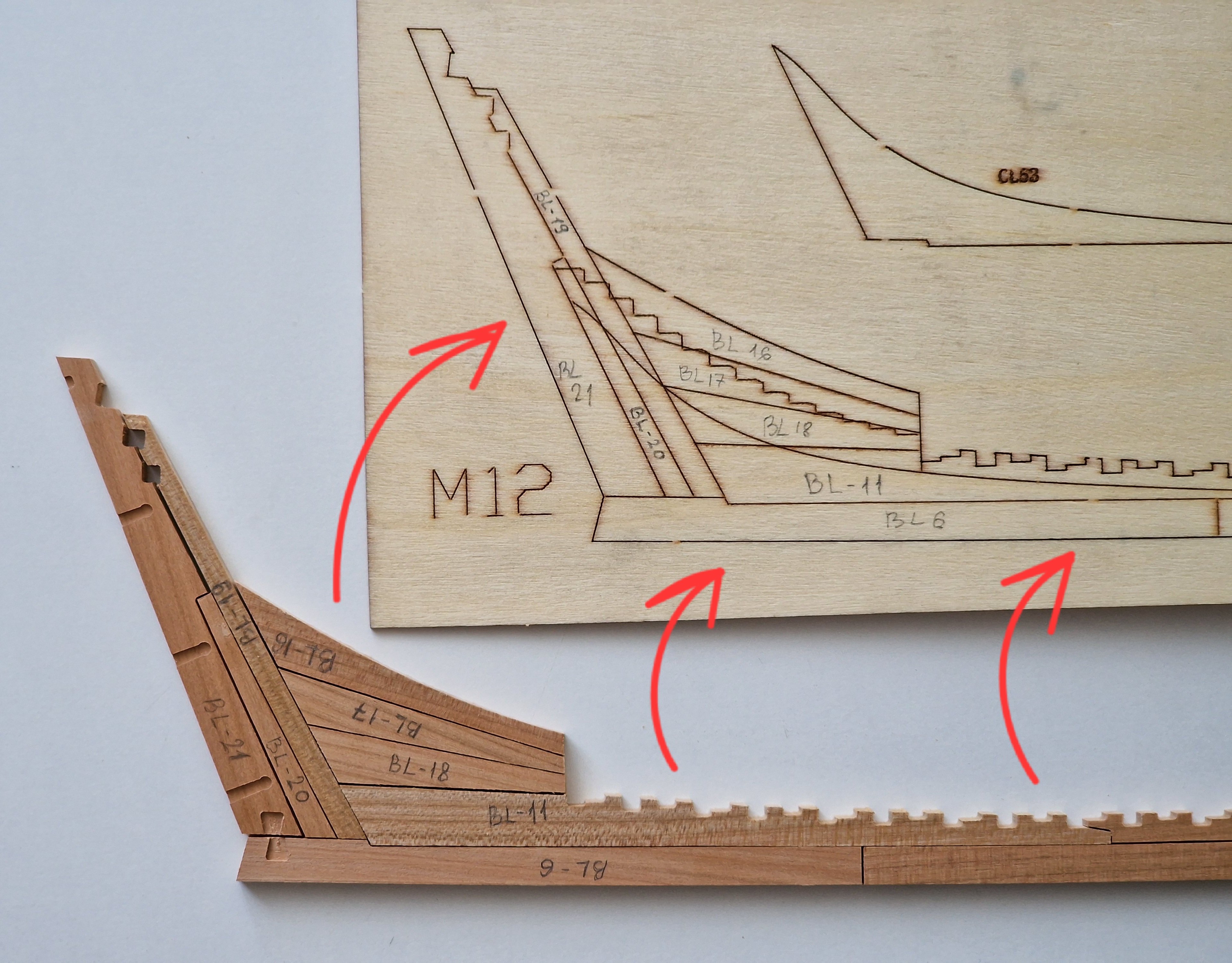

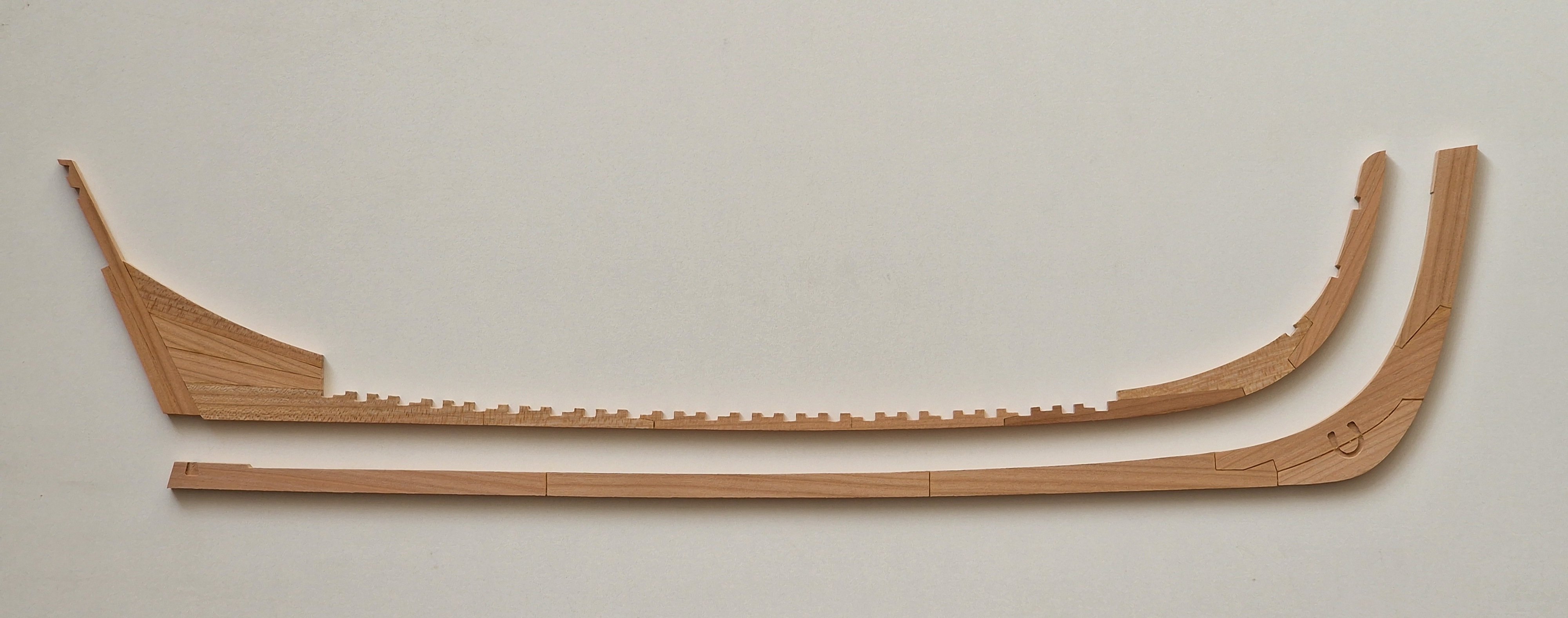

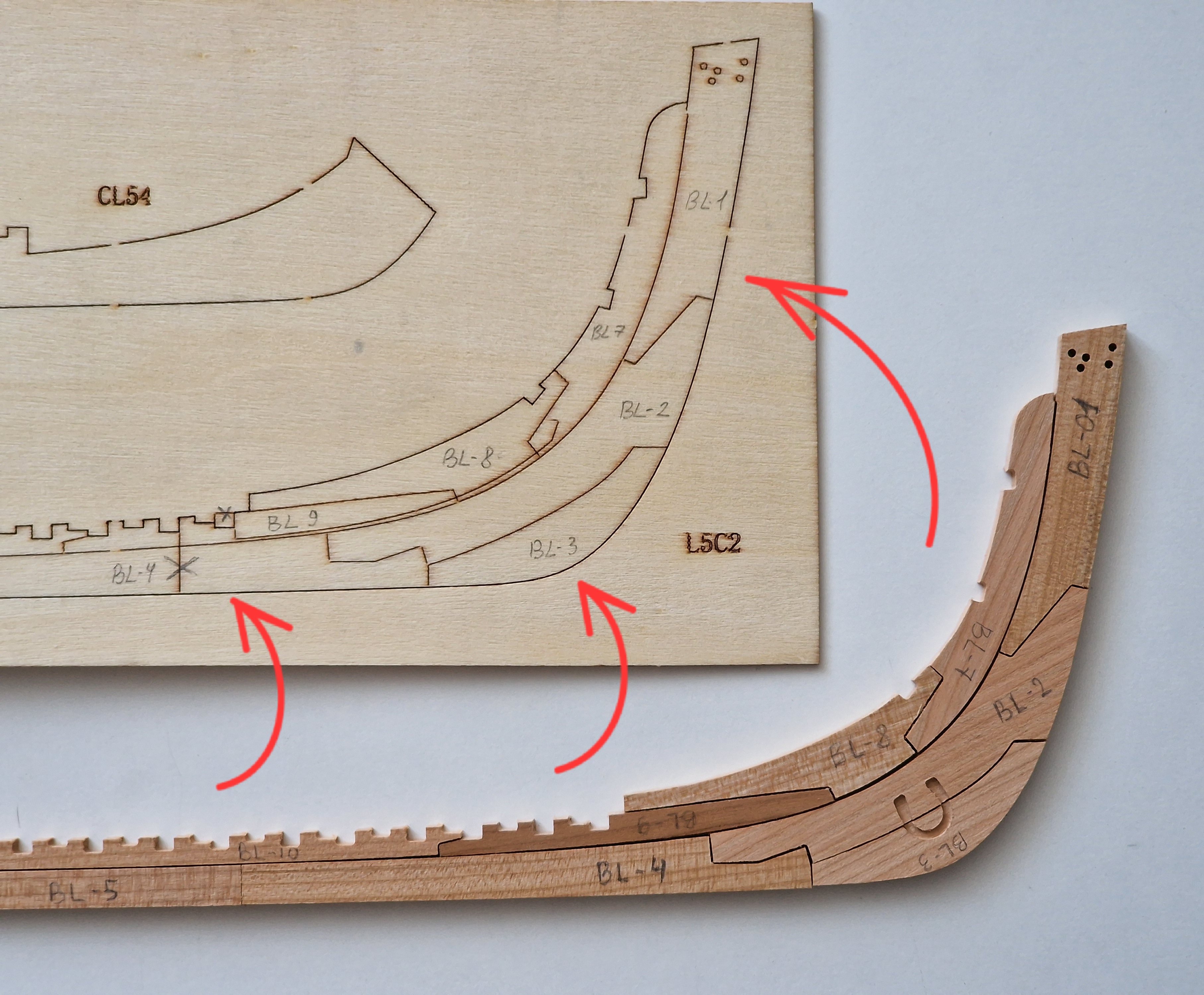

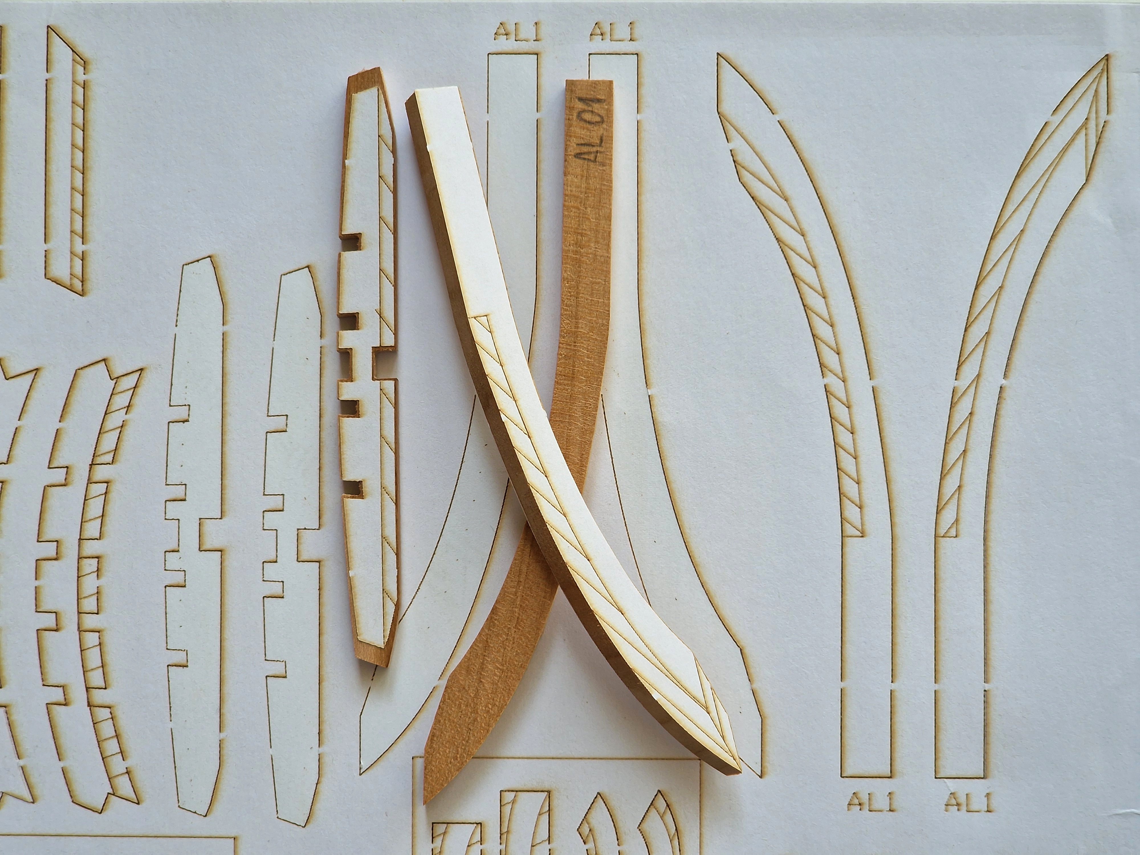

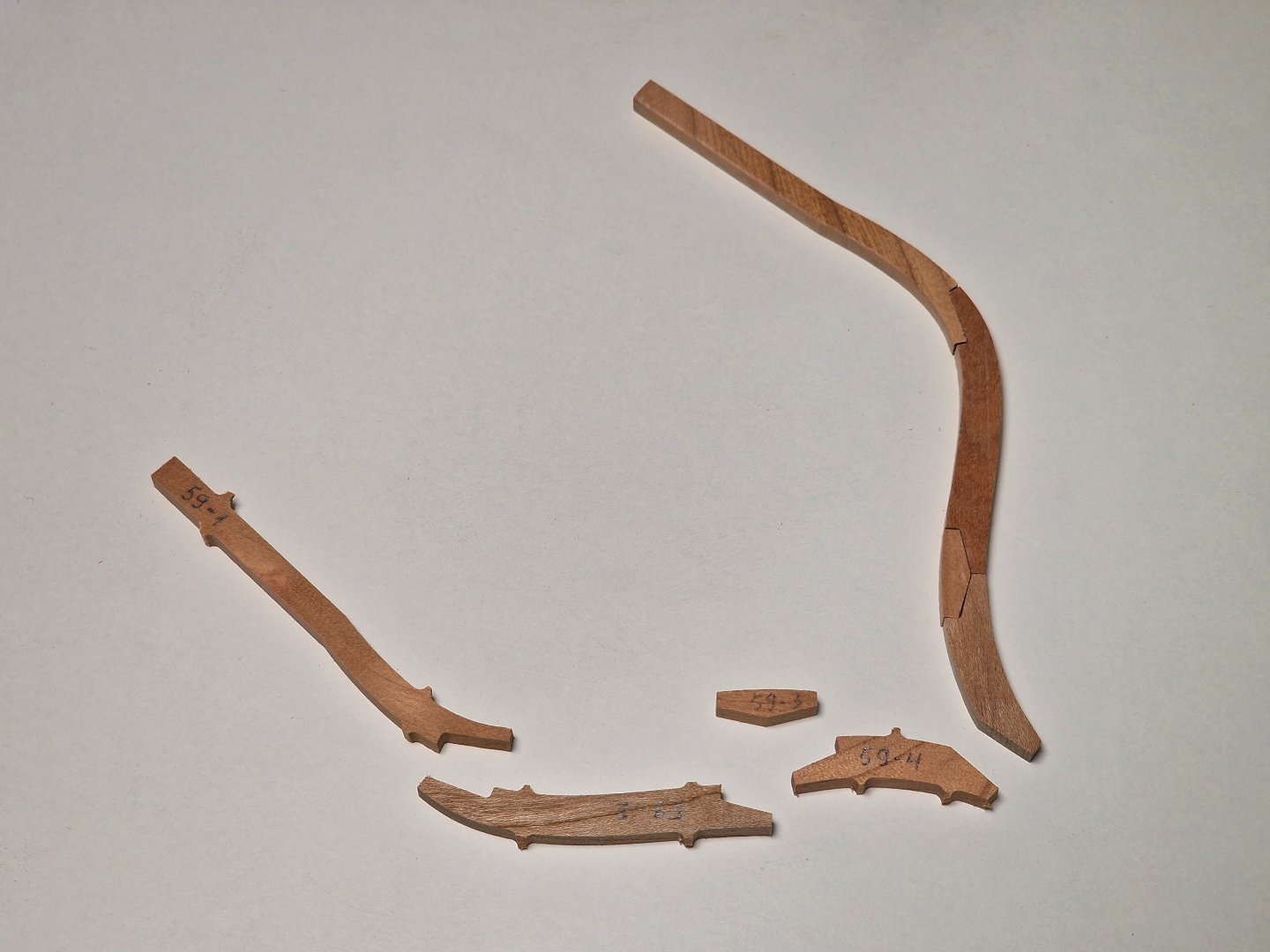

Keel.

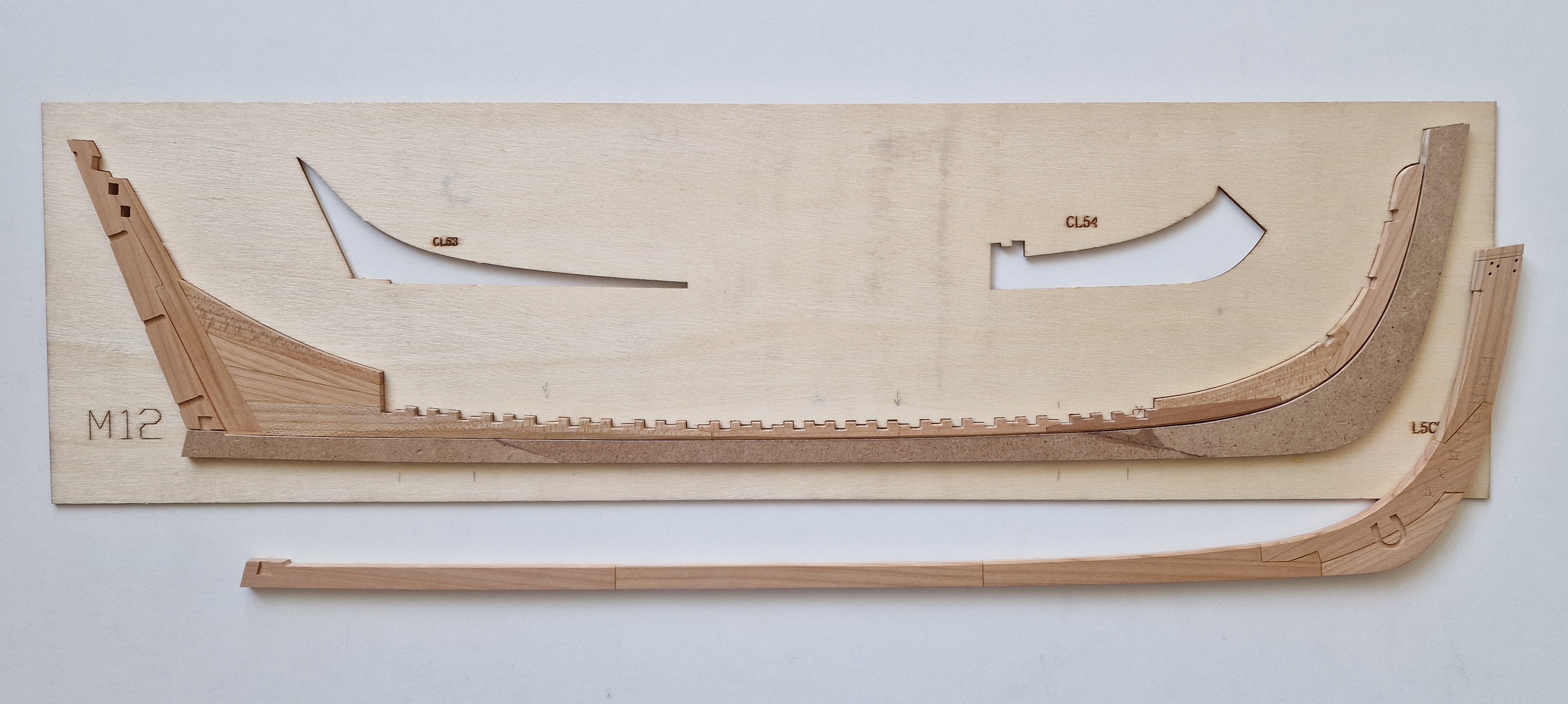

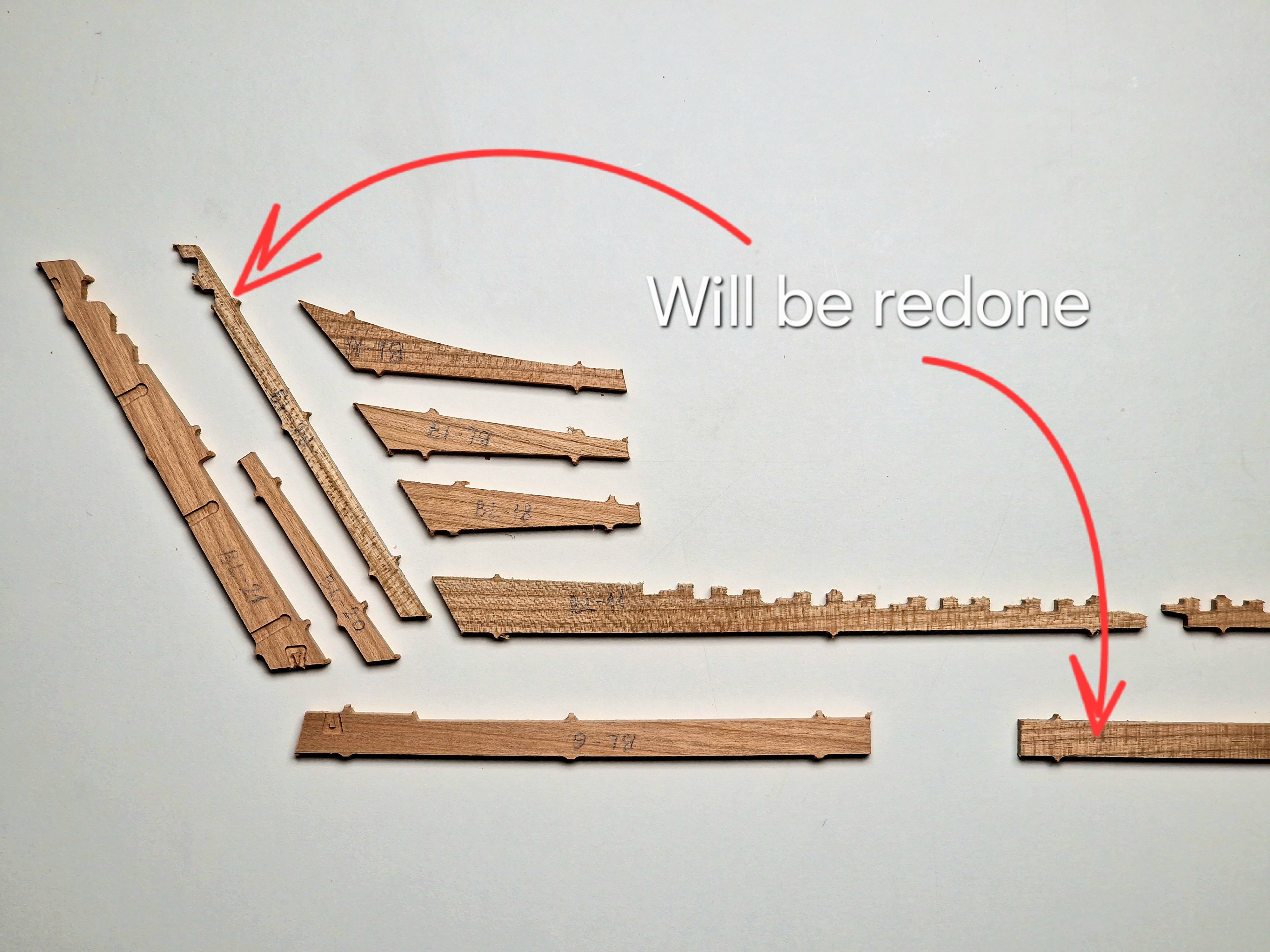

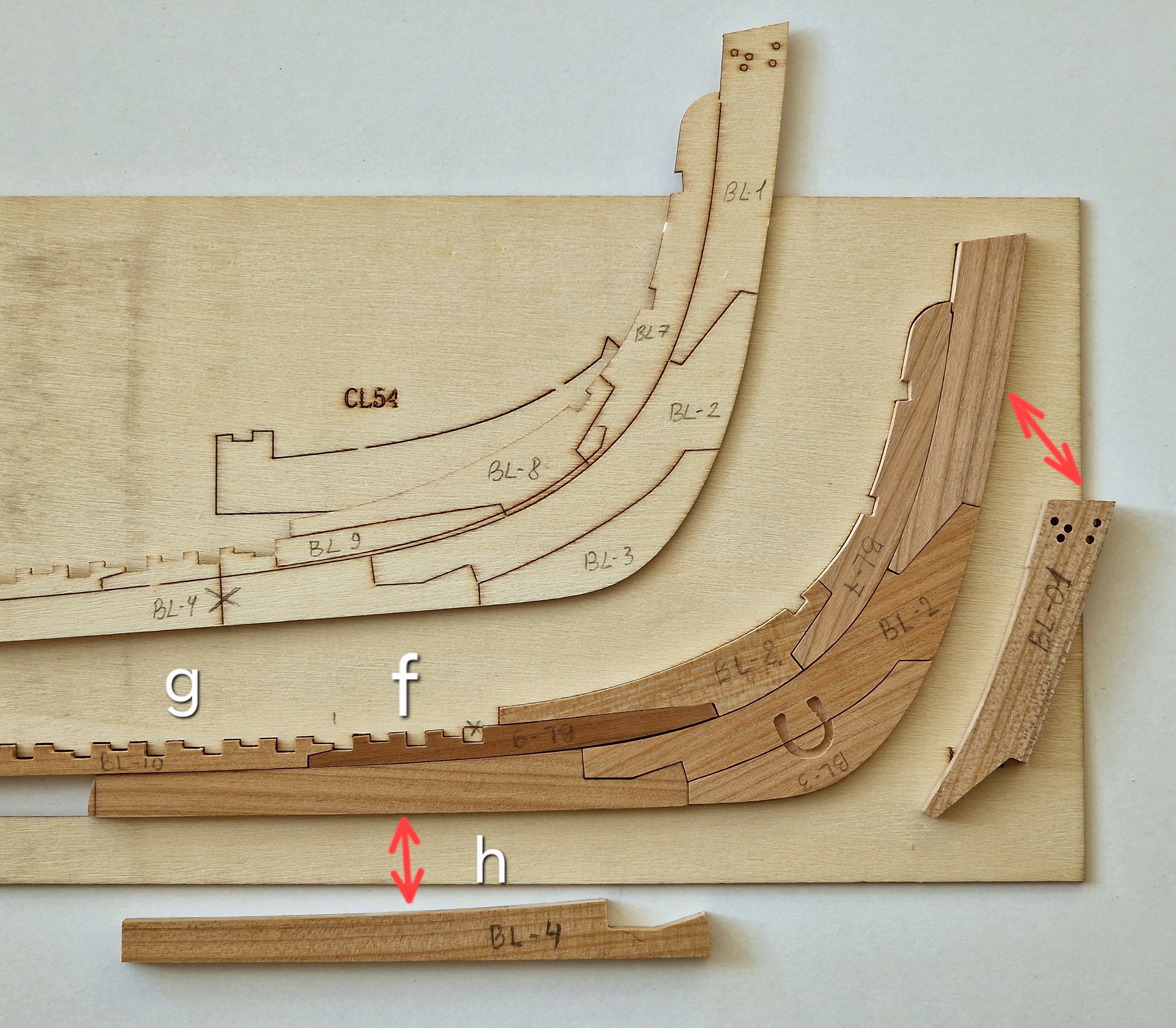

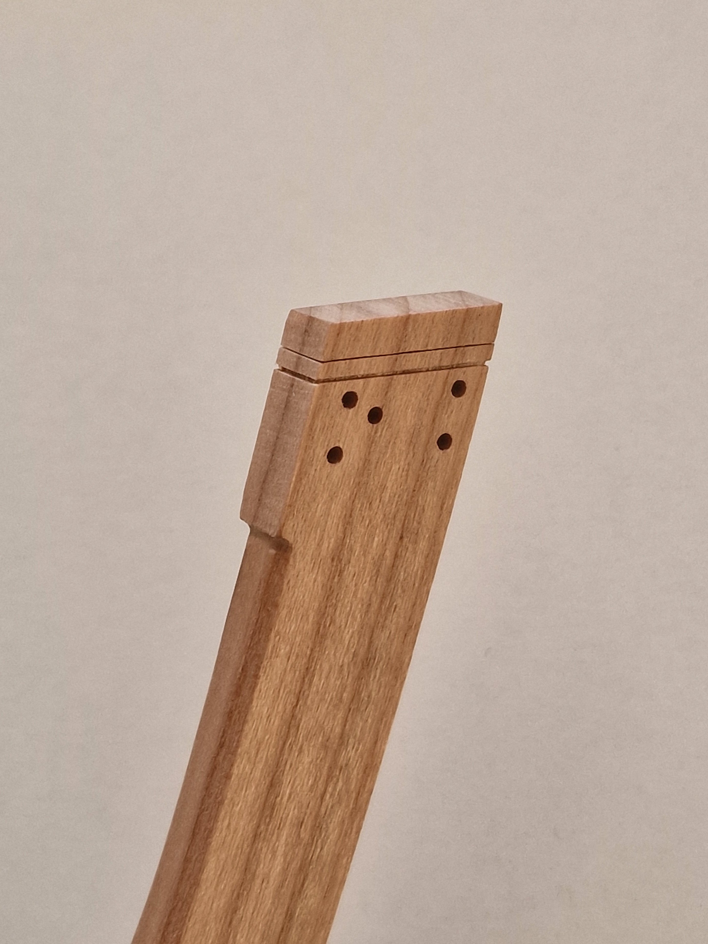

Some keel parts had to be remade because they were from wood with bad structure, but overall everything was fine.

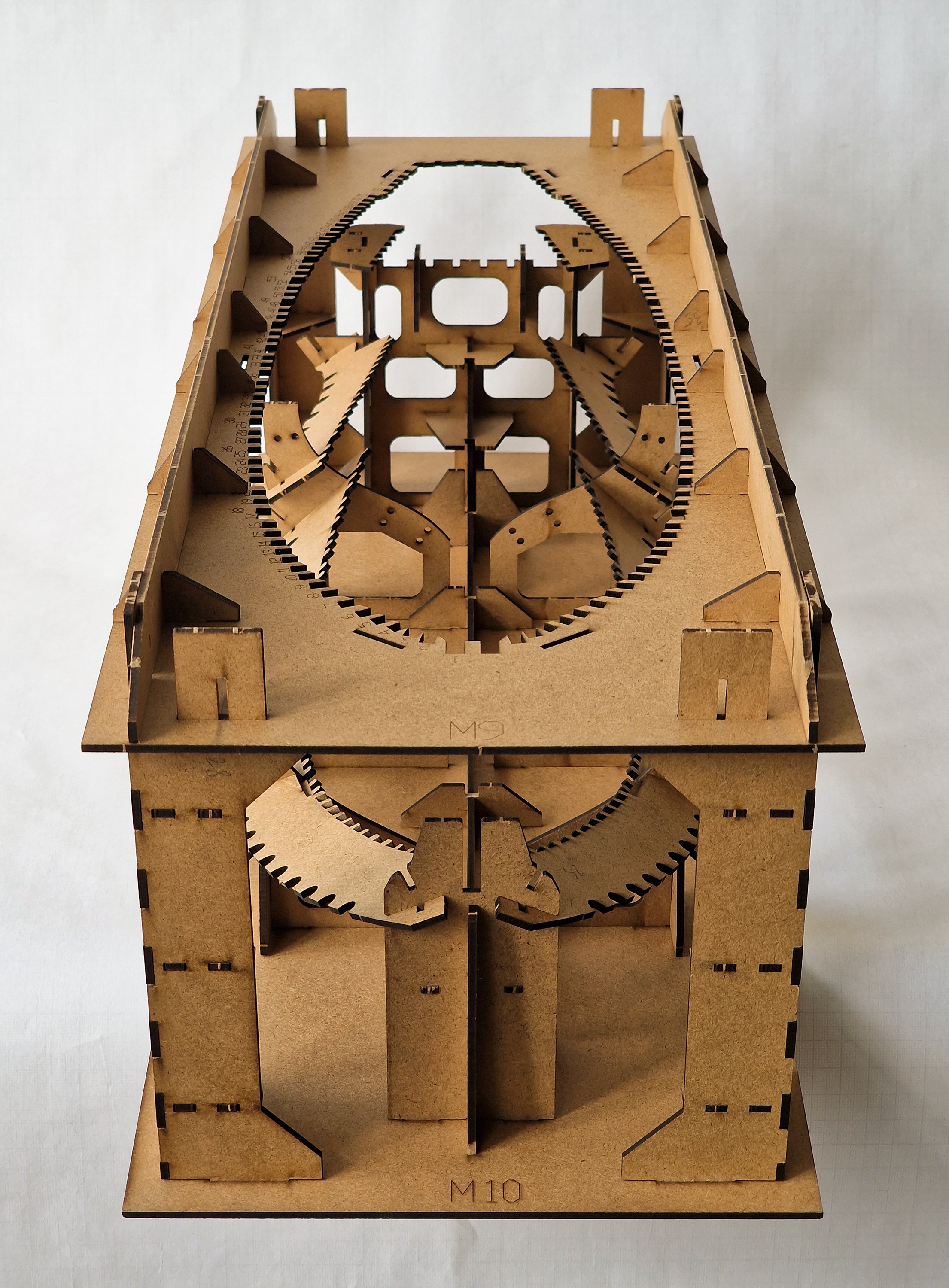

The keel was assembled in a special jig, so nothing complicated here either.

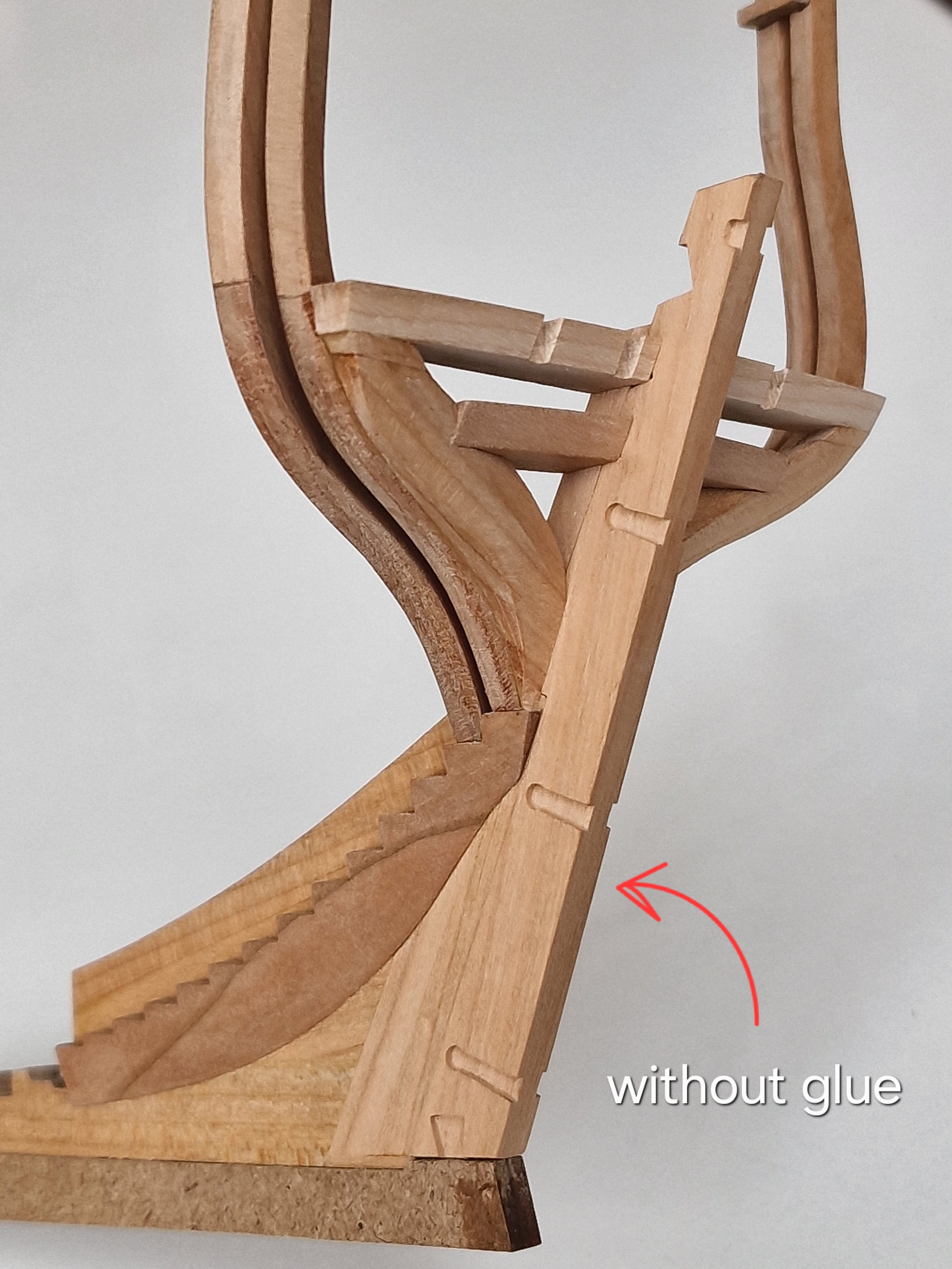

I glued the keel with PVA Titebond II, again isolating with film. But I did NOT glue the keel to the keelson! Because later it is very important for them to remain separate.
  • The title was changed to Naval Cutter Alert 1777 by serikoff - 1:48 - two hulls: skeleton and fully planked and rigged - based on Trident Model hull

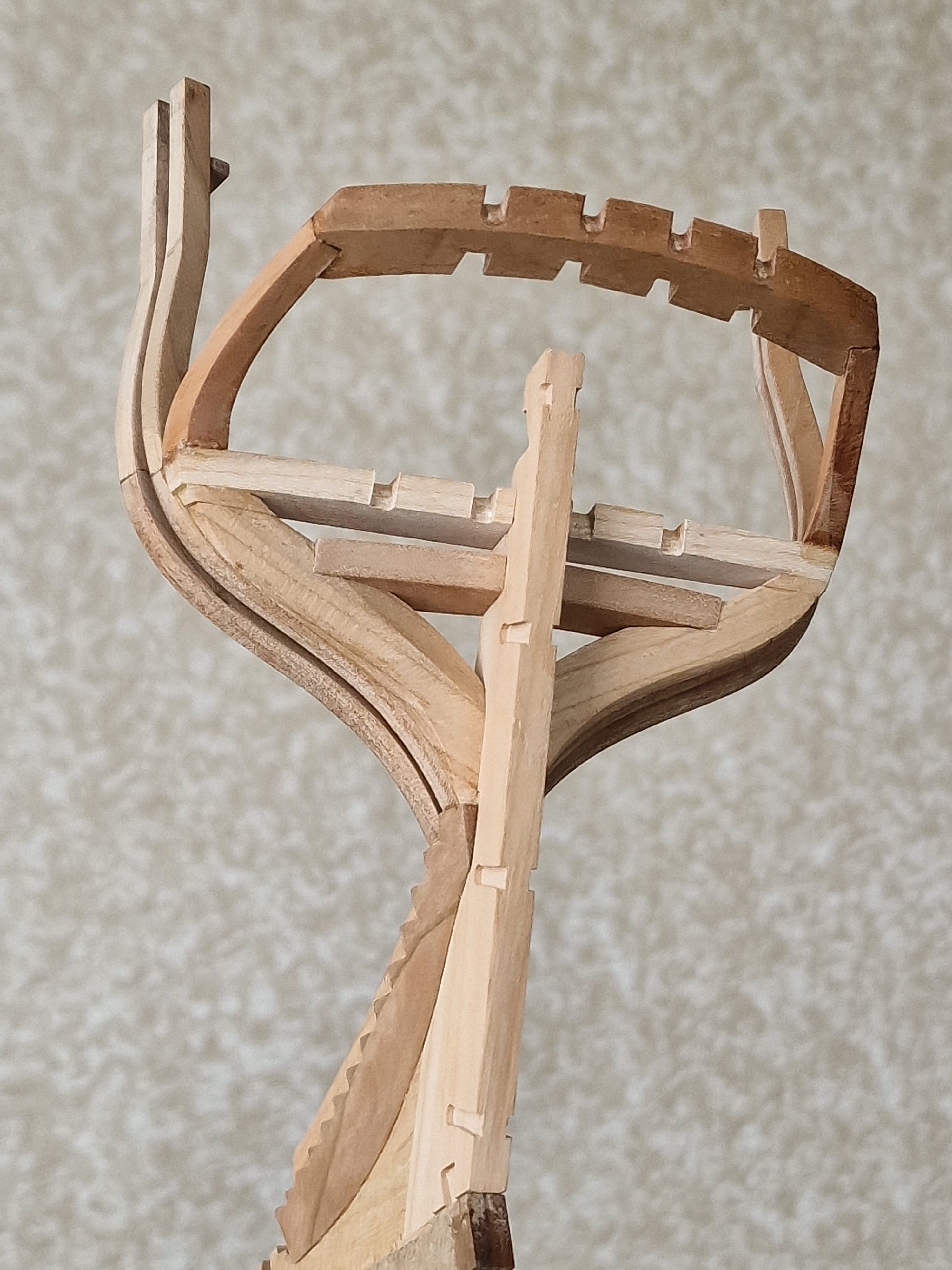

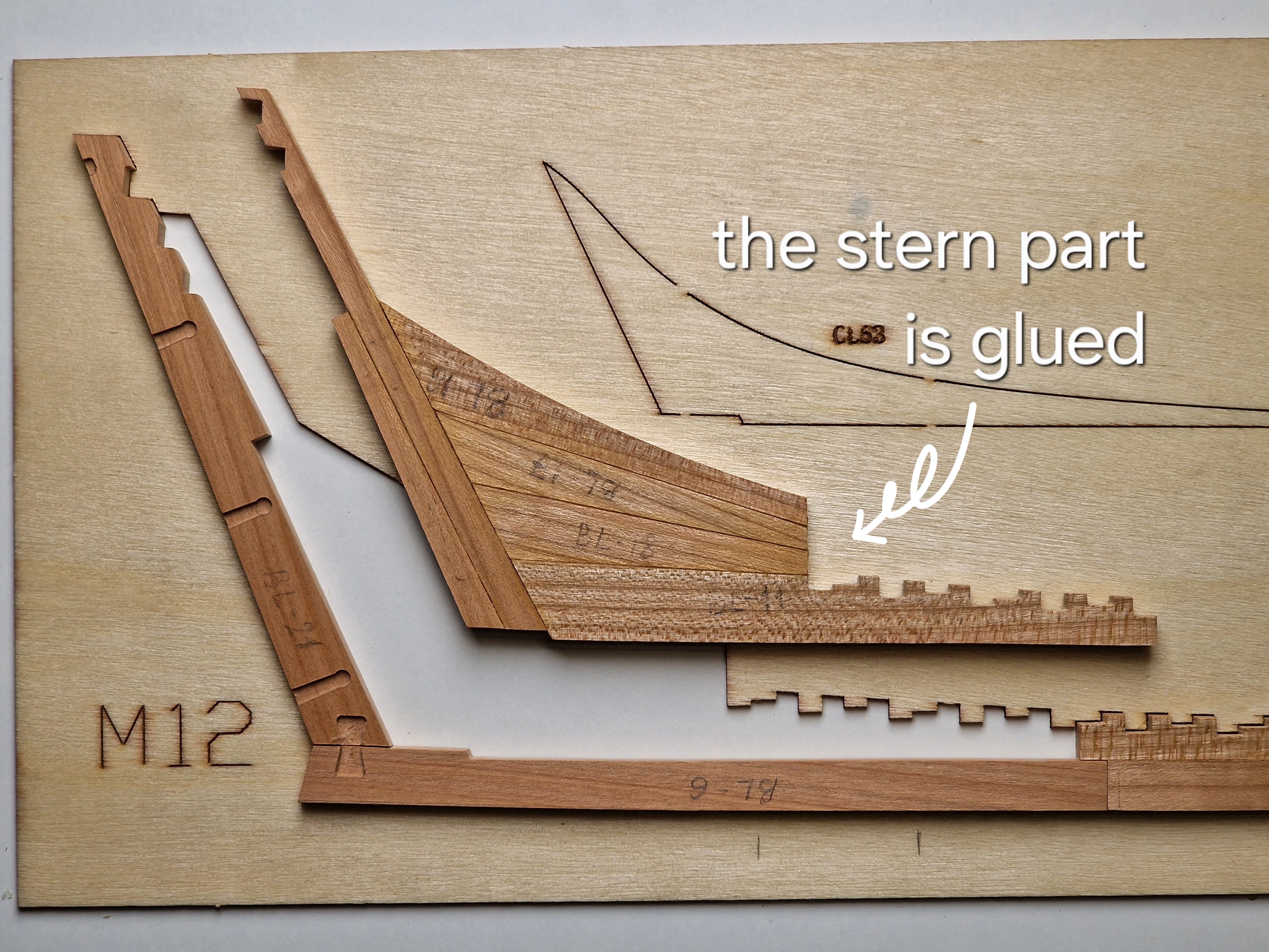

Continuation with keel.

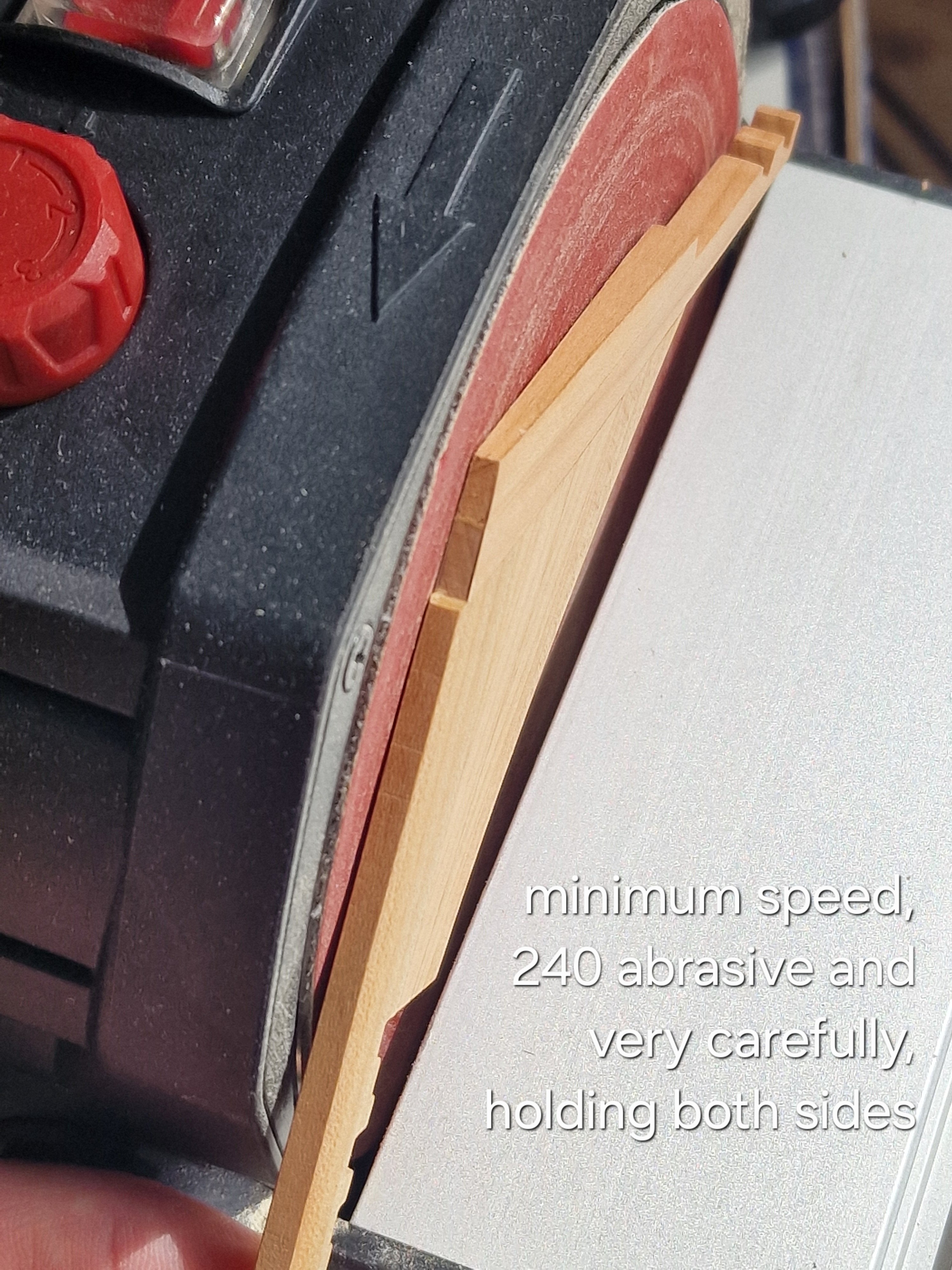

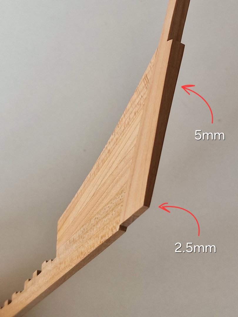

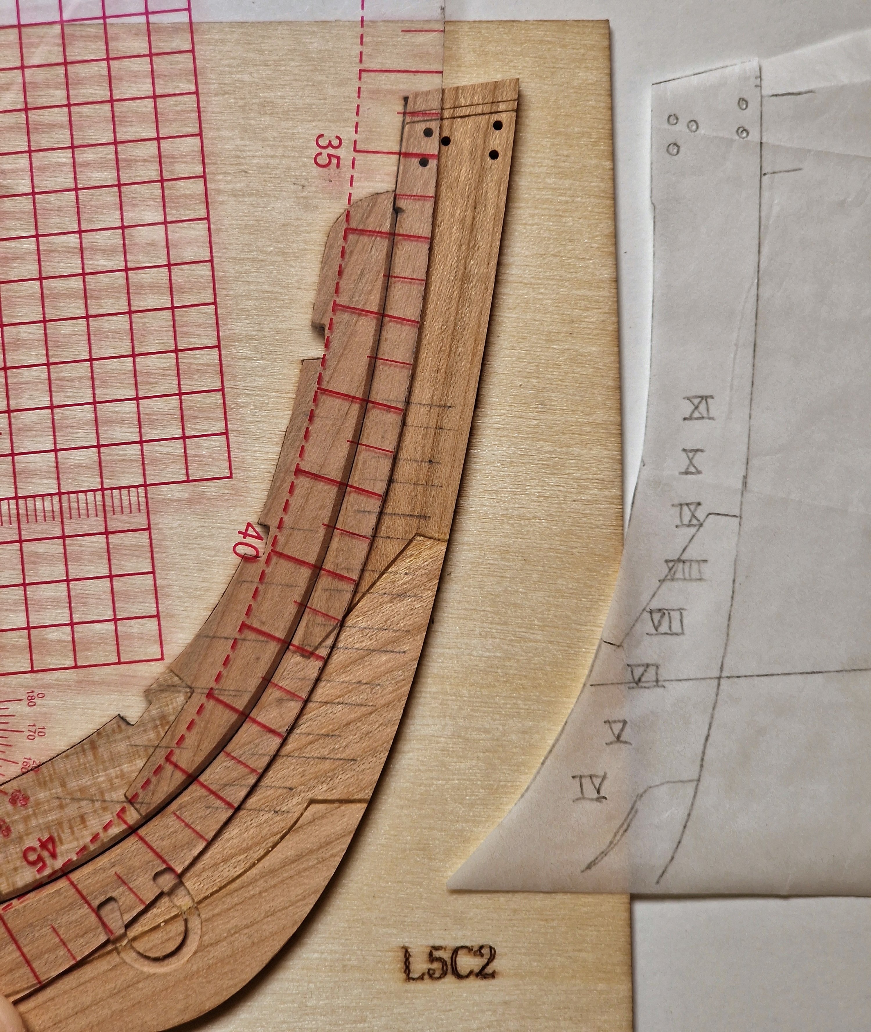

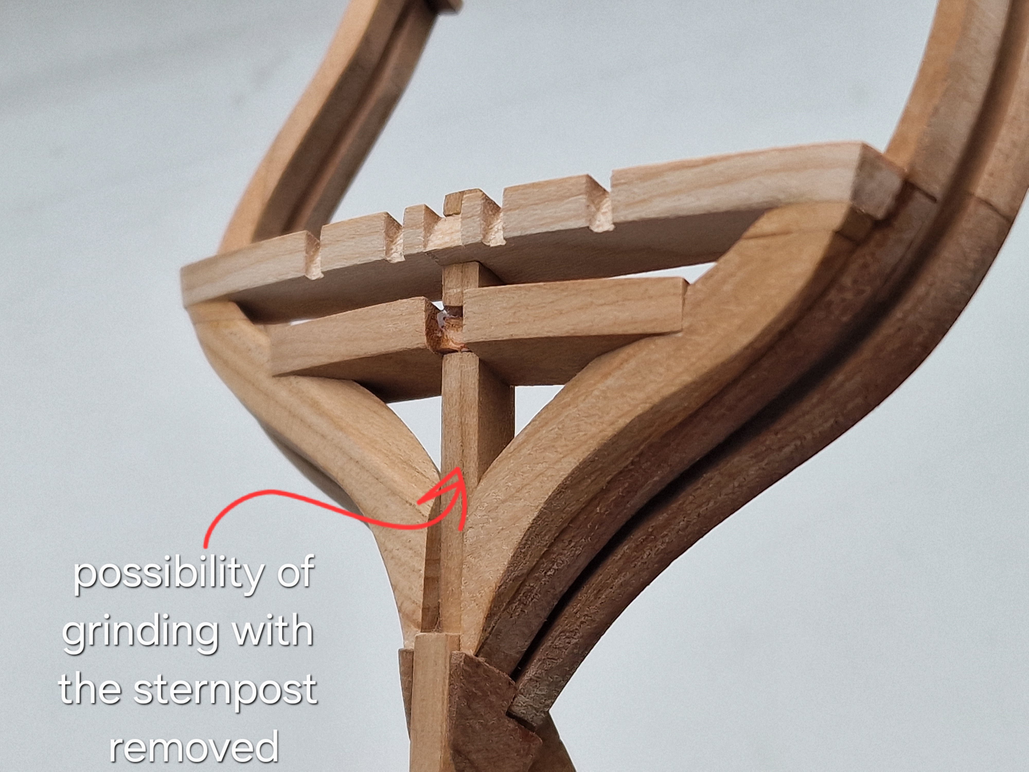

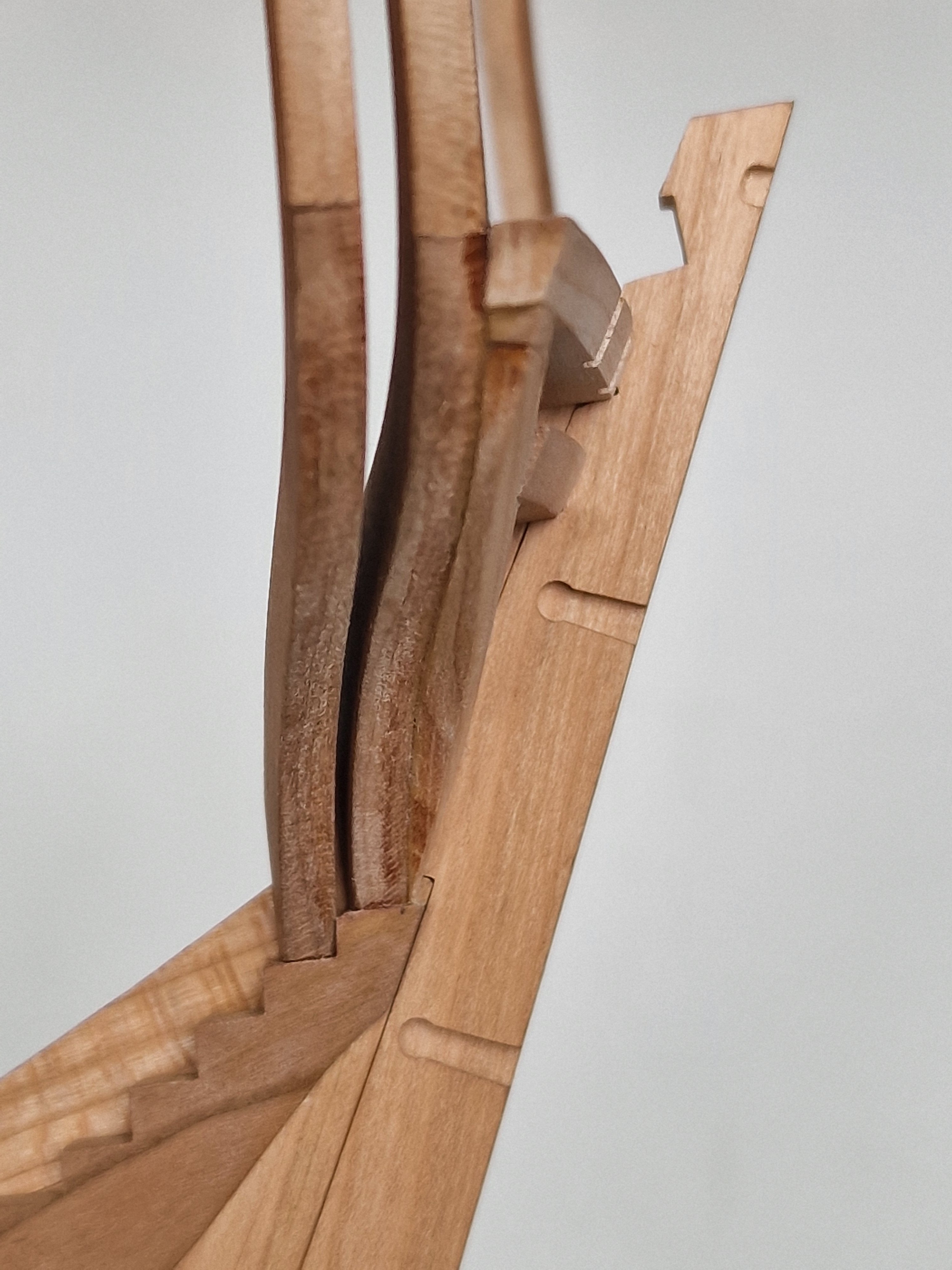

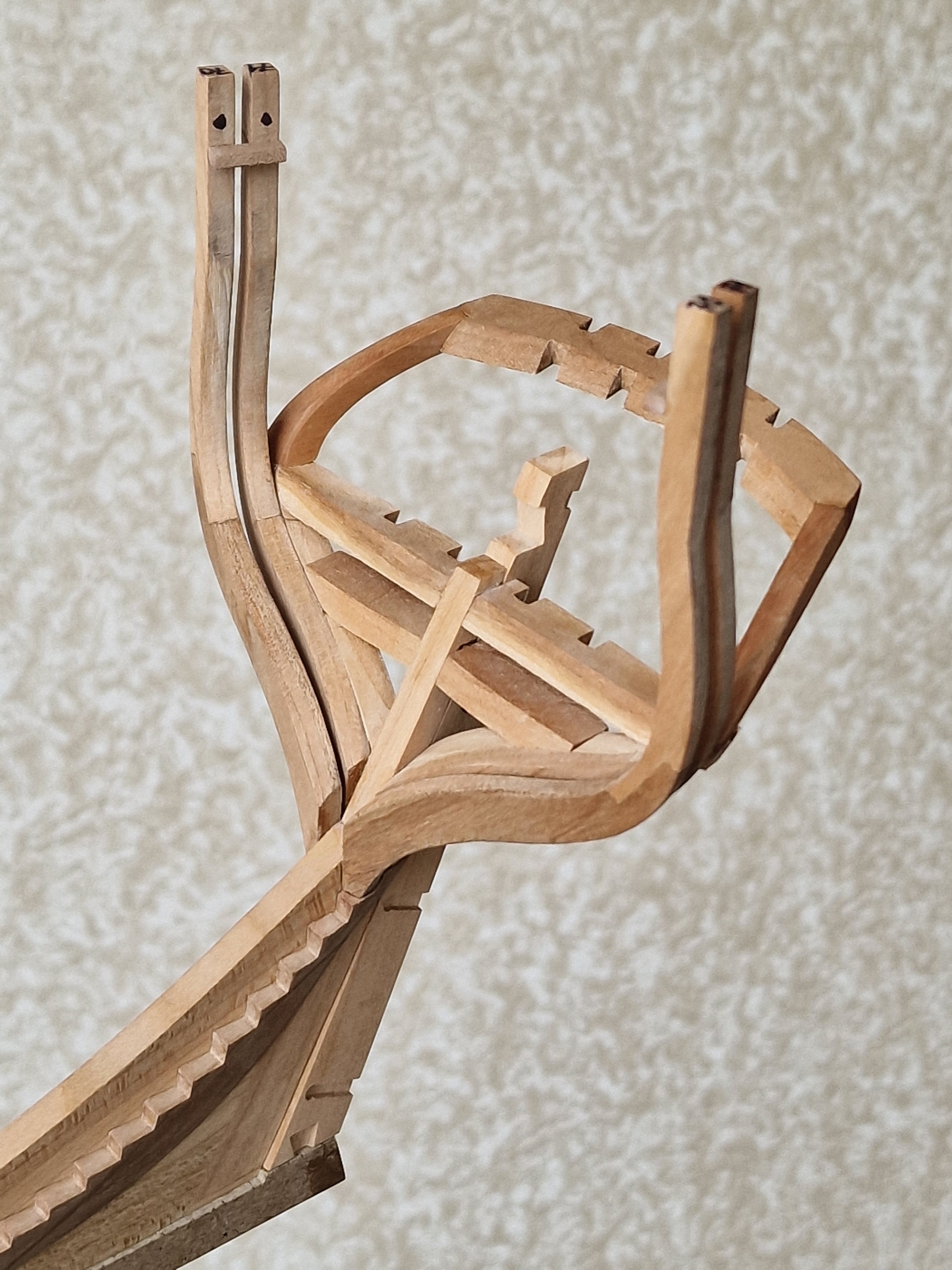

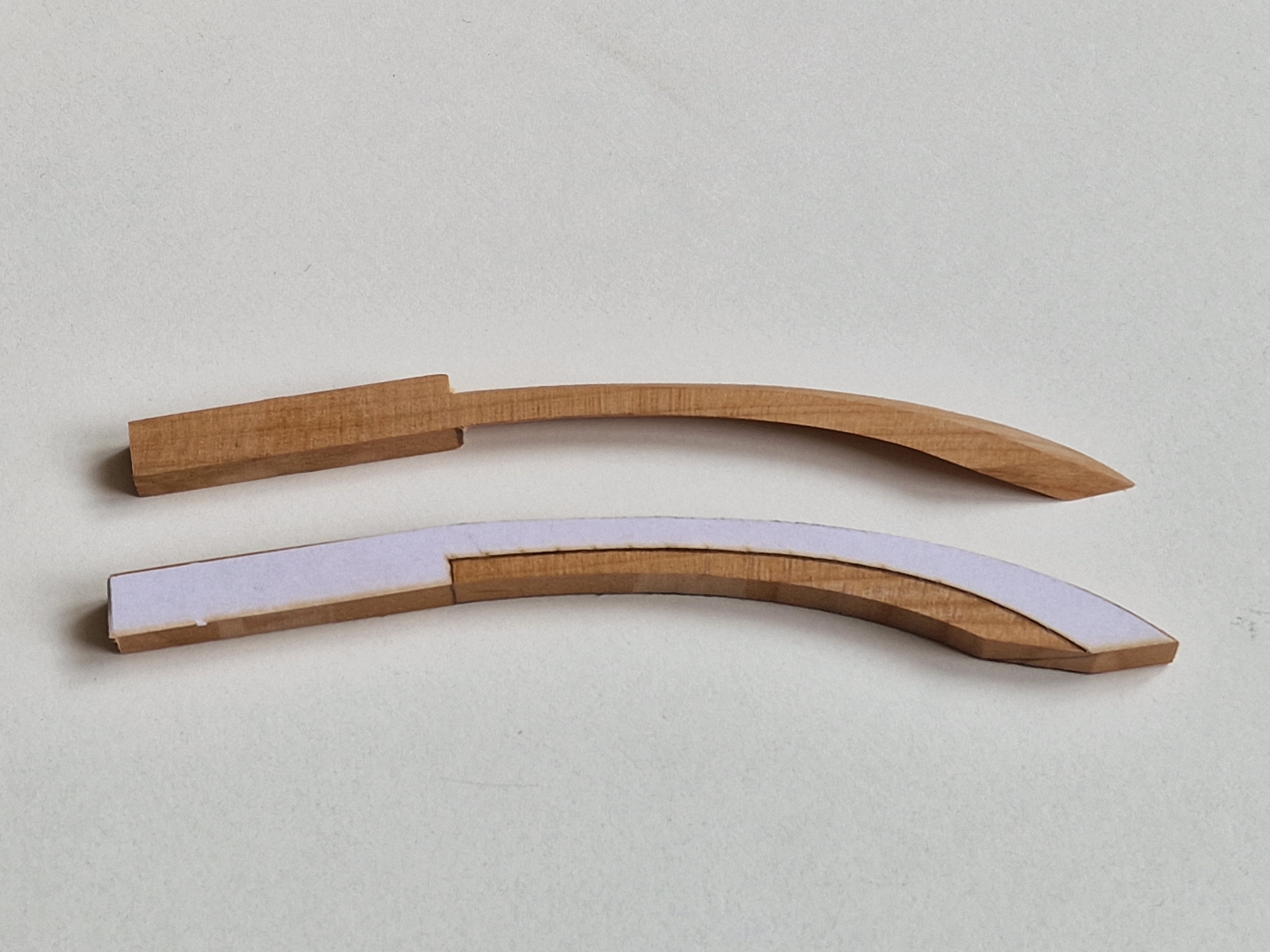

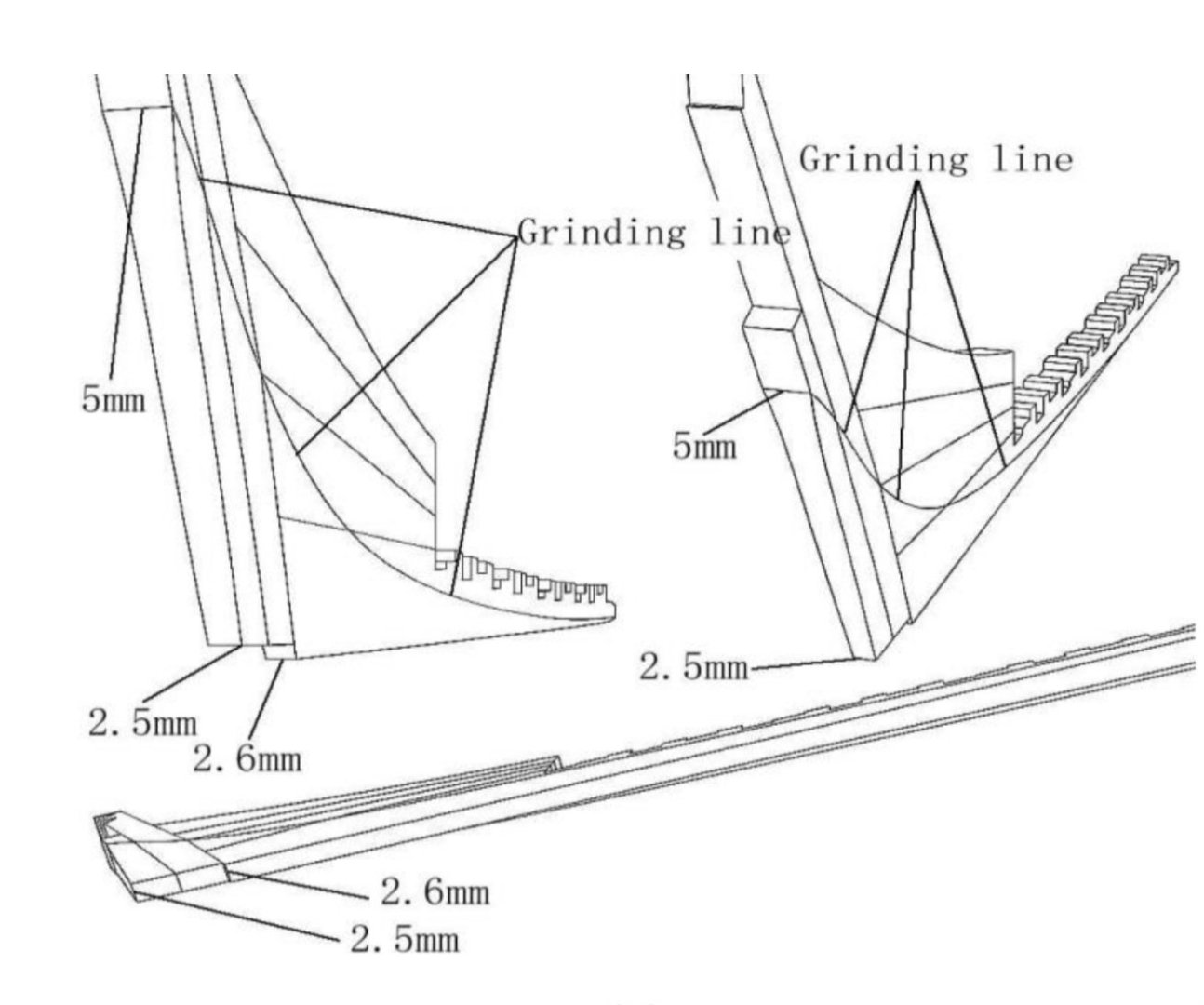

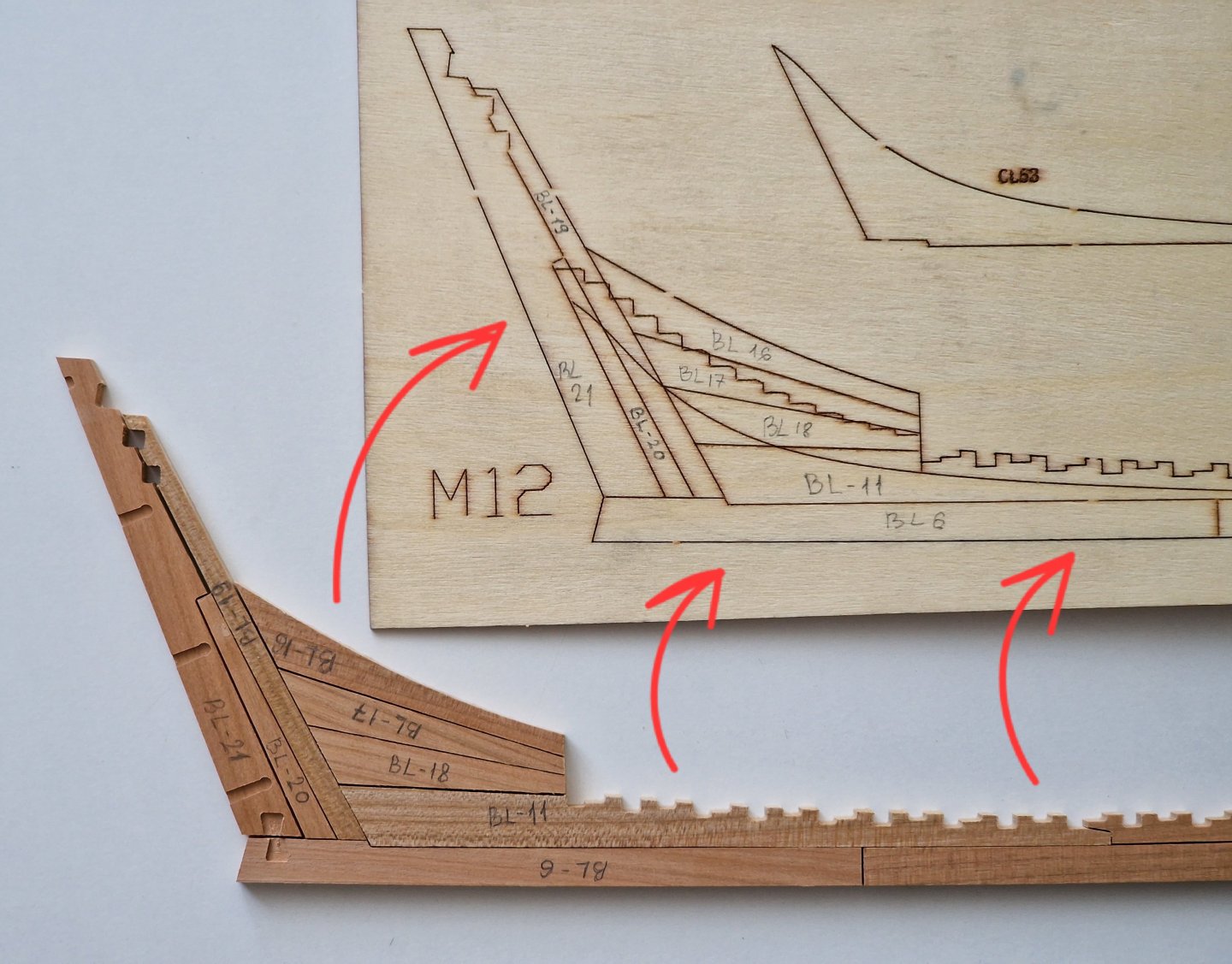

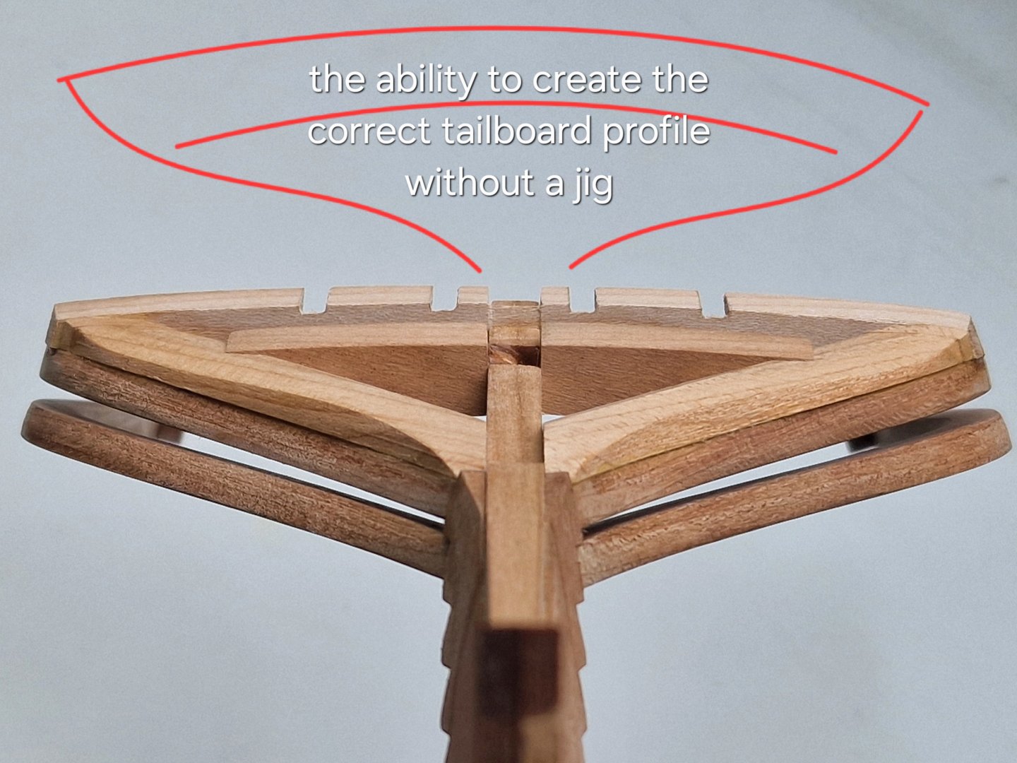

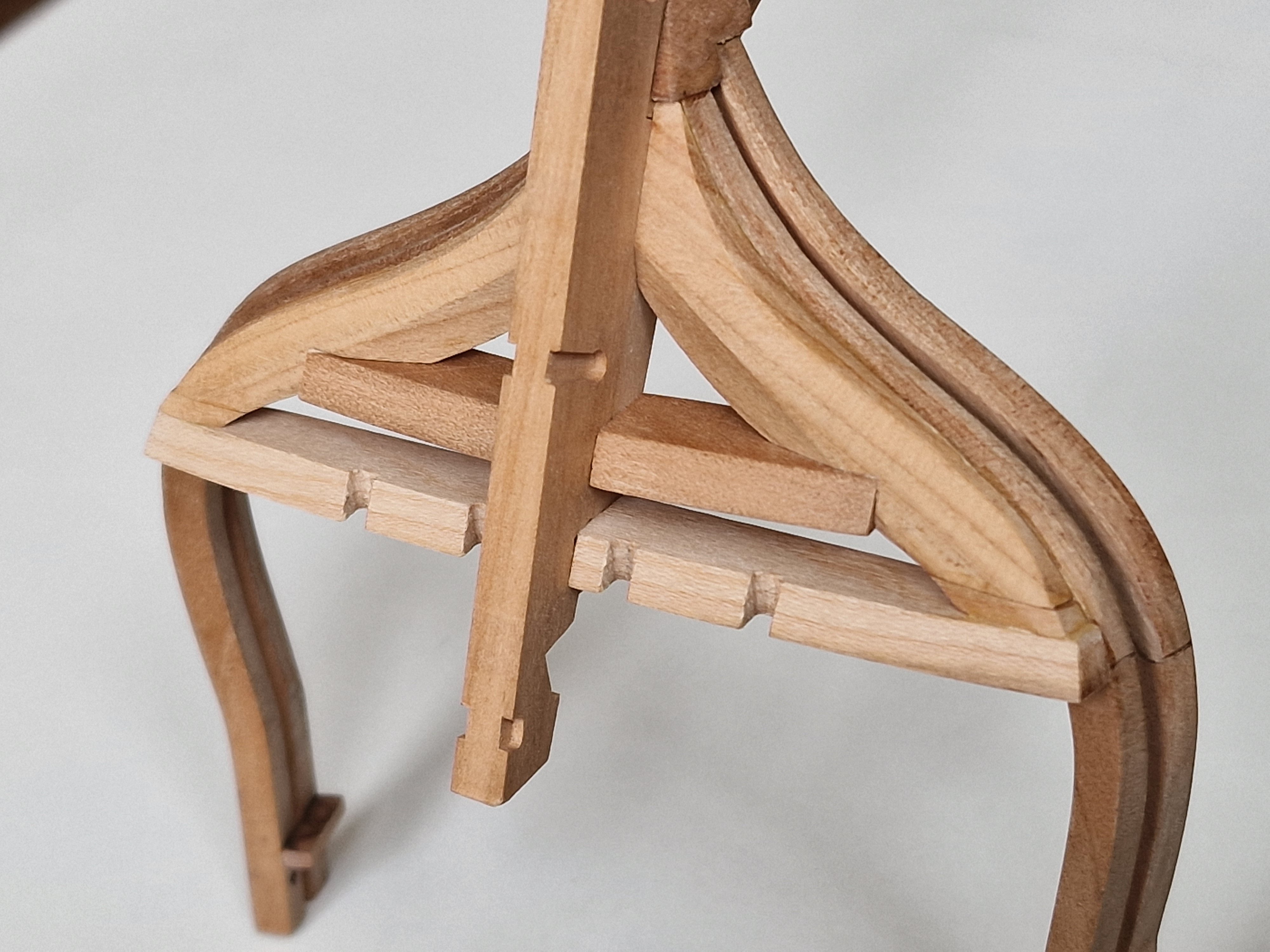

I also corrected an error in the kit.

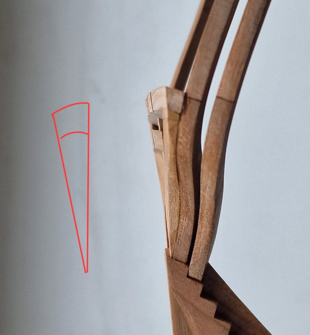

And shaped the top of the stem.

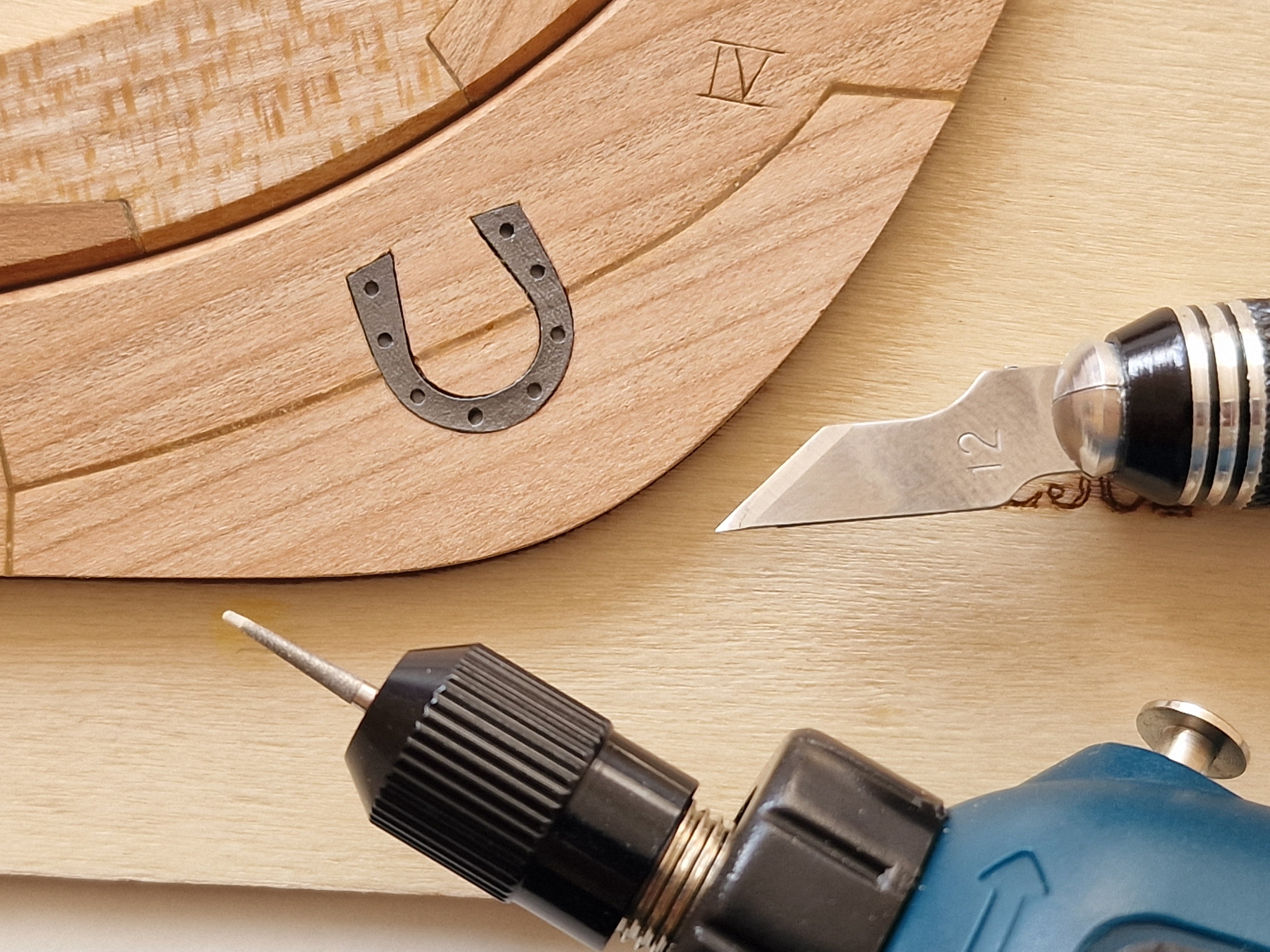

I also applied Roman numerals for the draft marks...

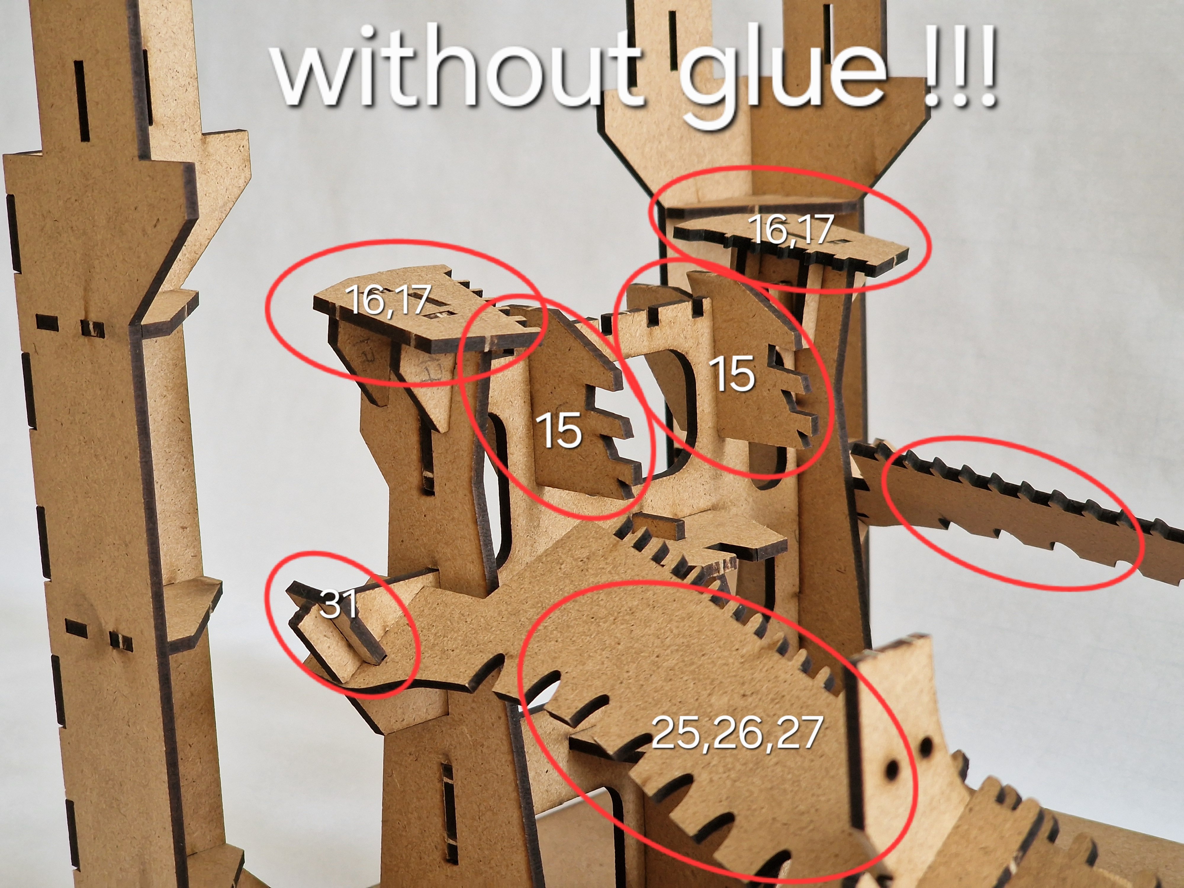

...and fitted metal parts, but did not glue them.

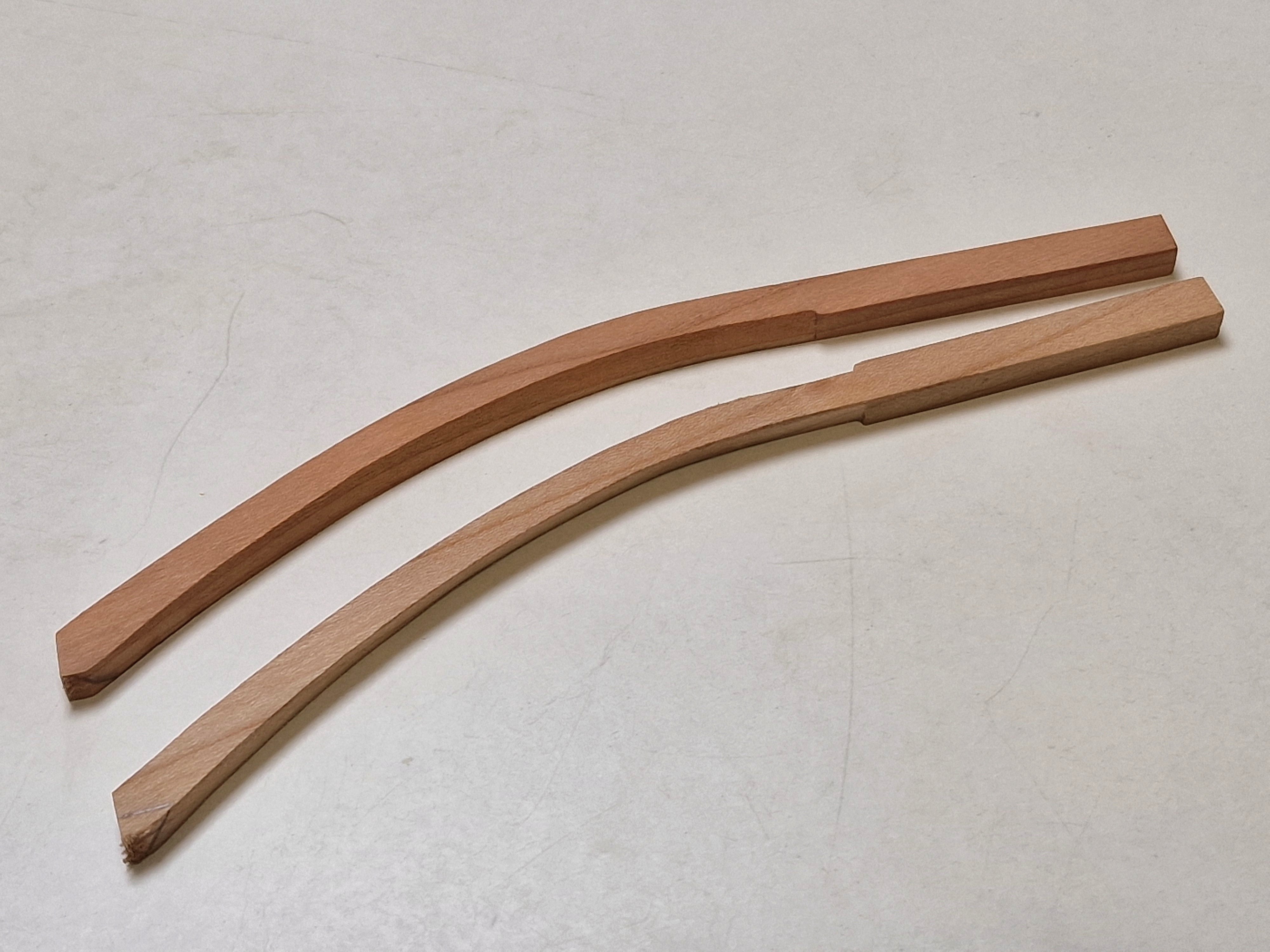

I also made these parts ...

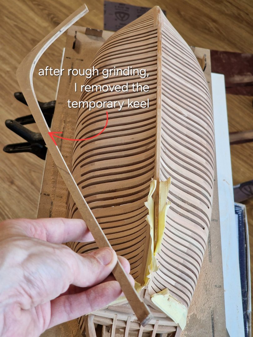

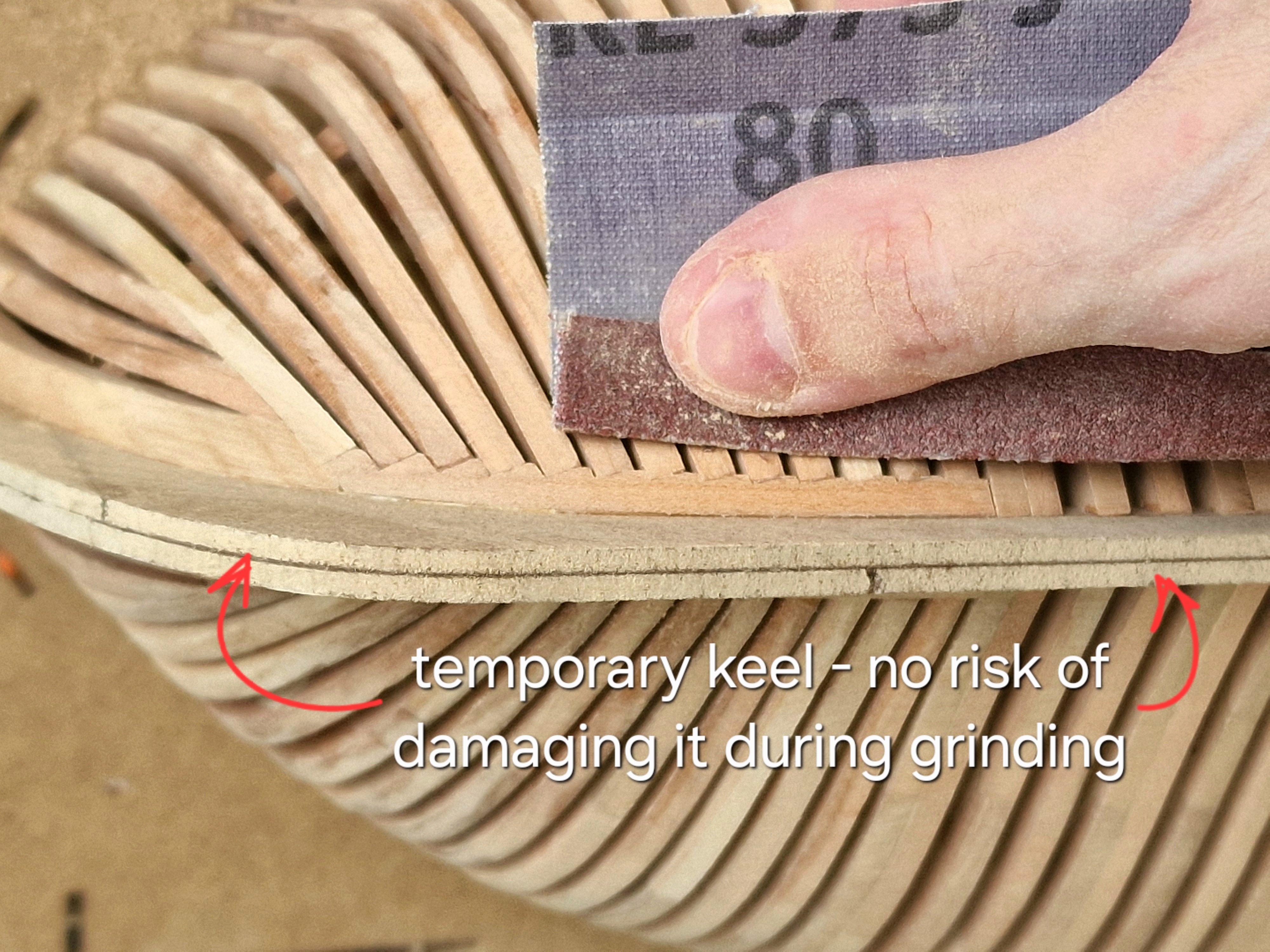

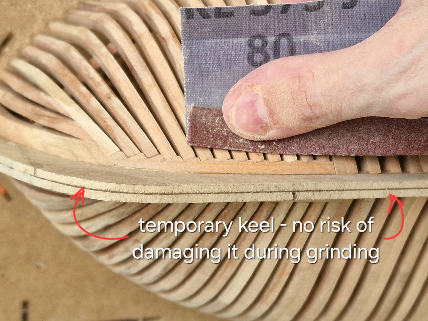

and a temporary keel.

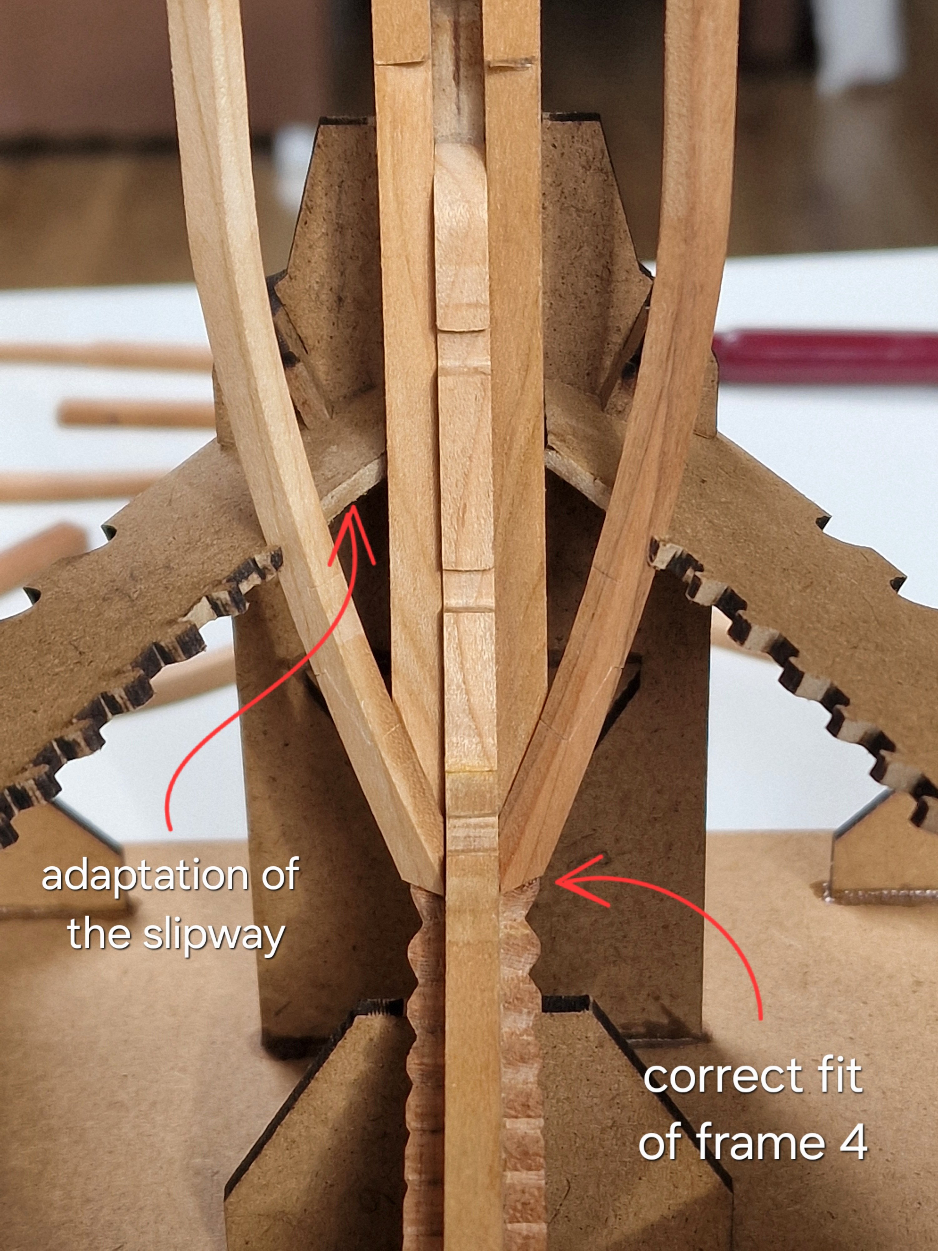

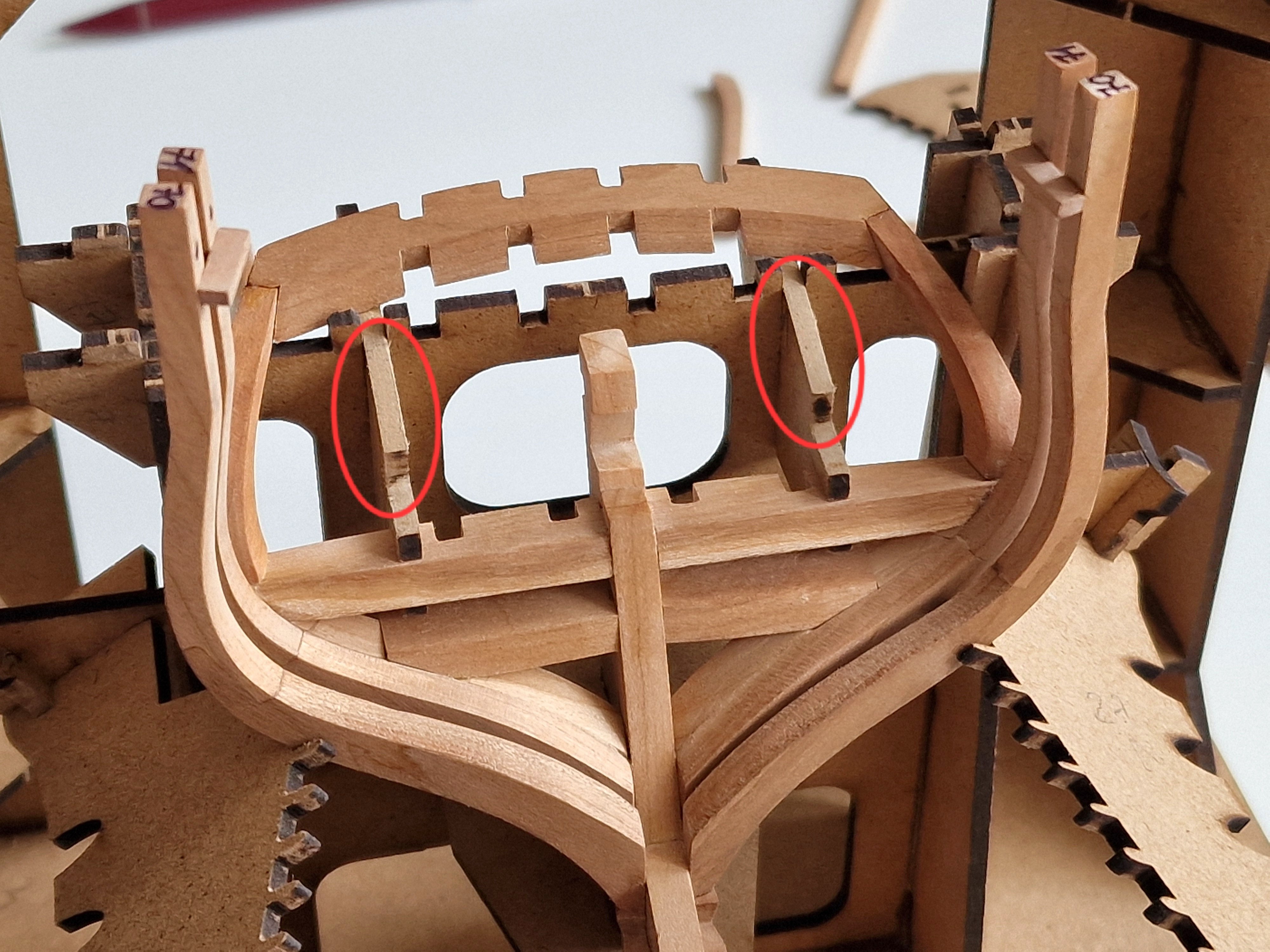

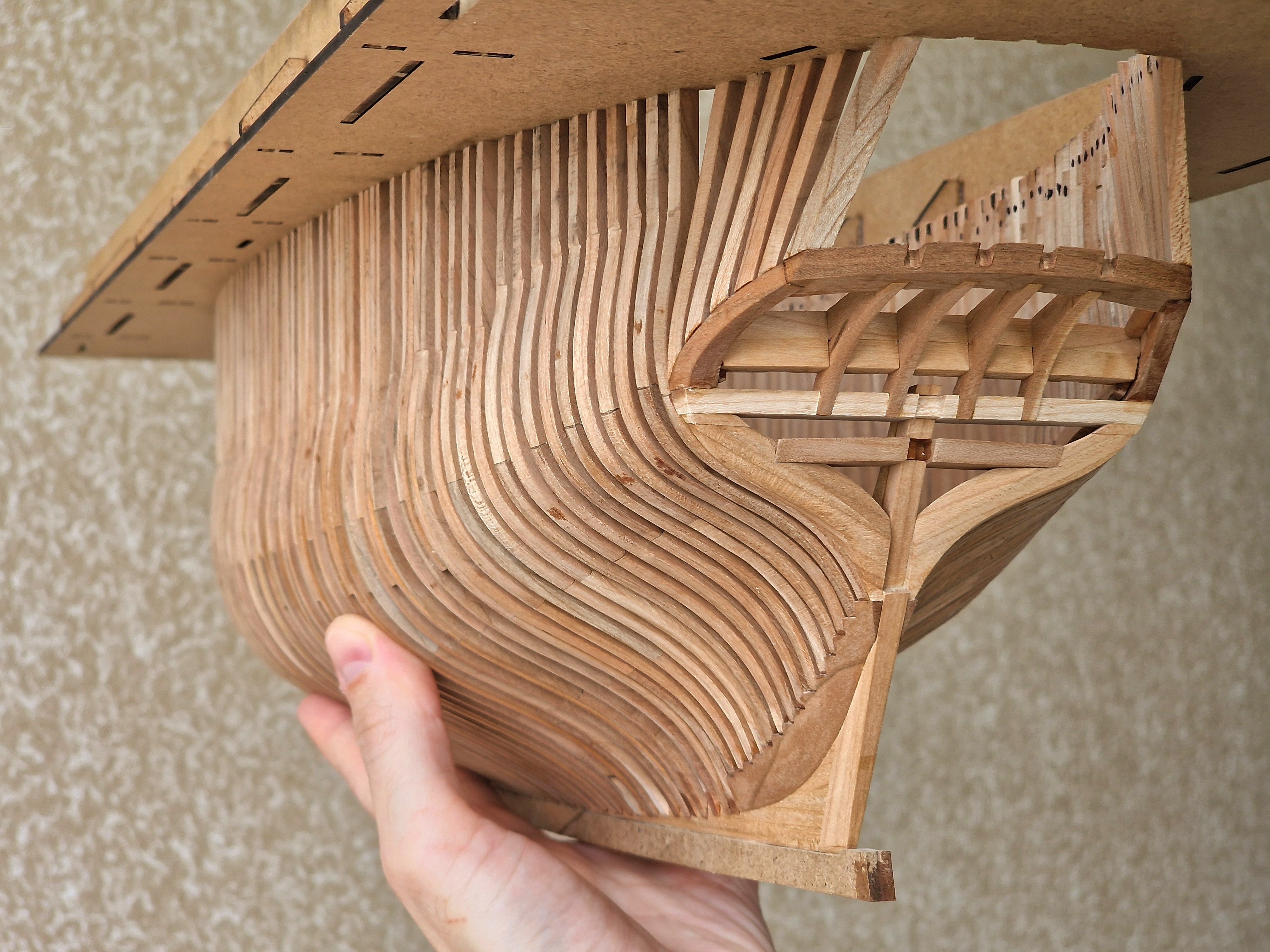

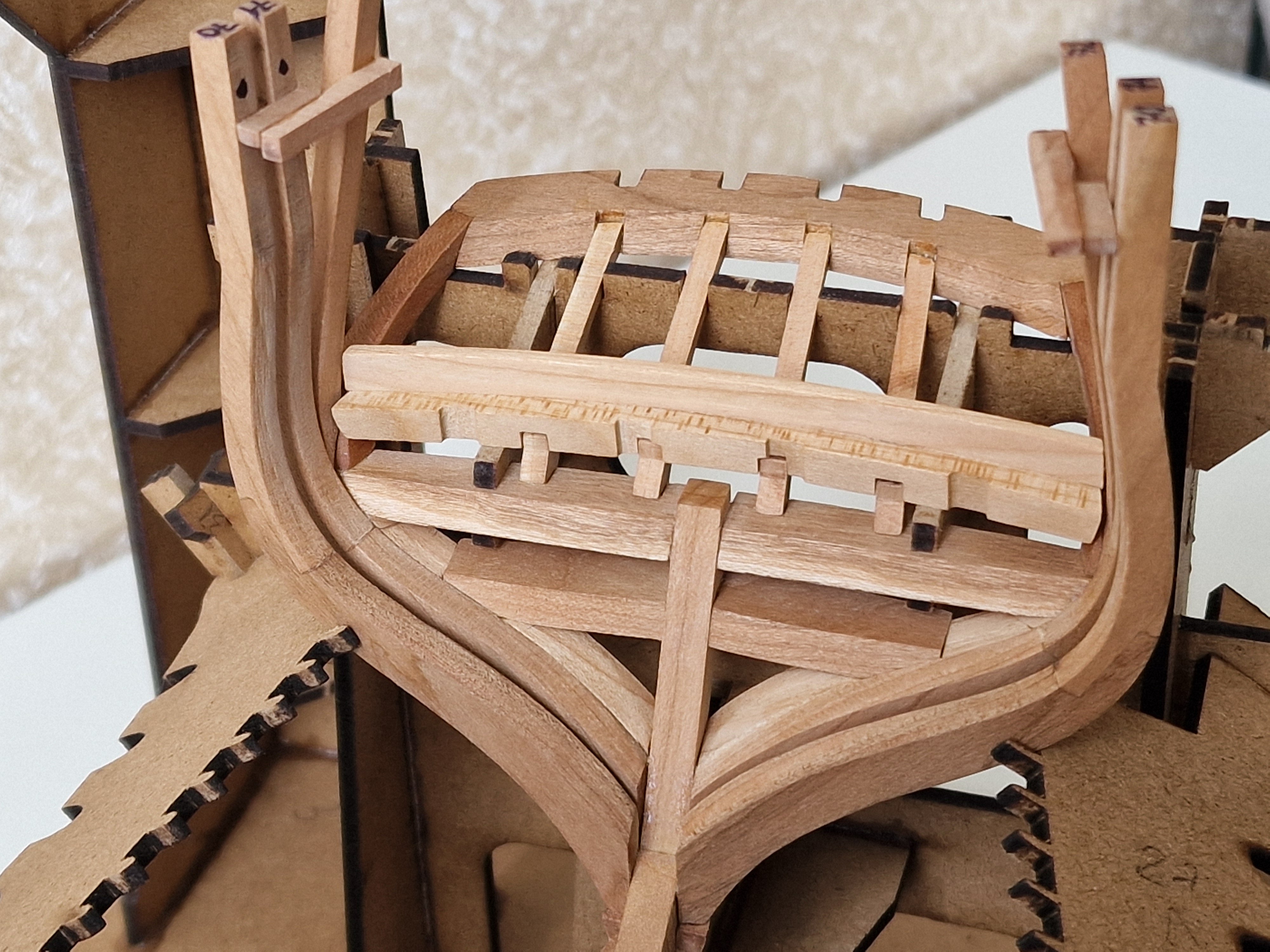

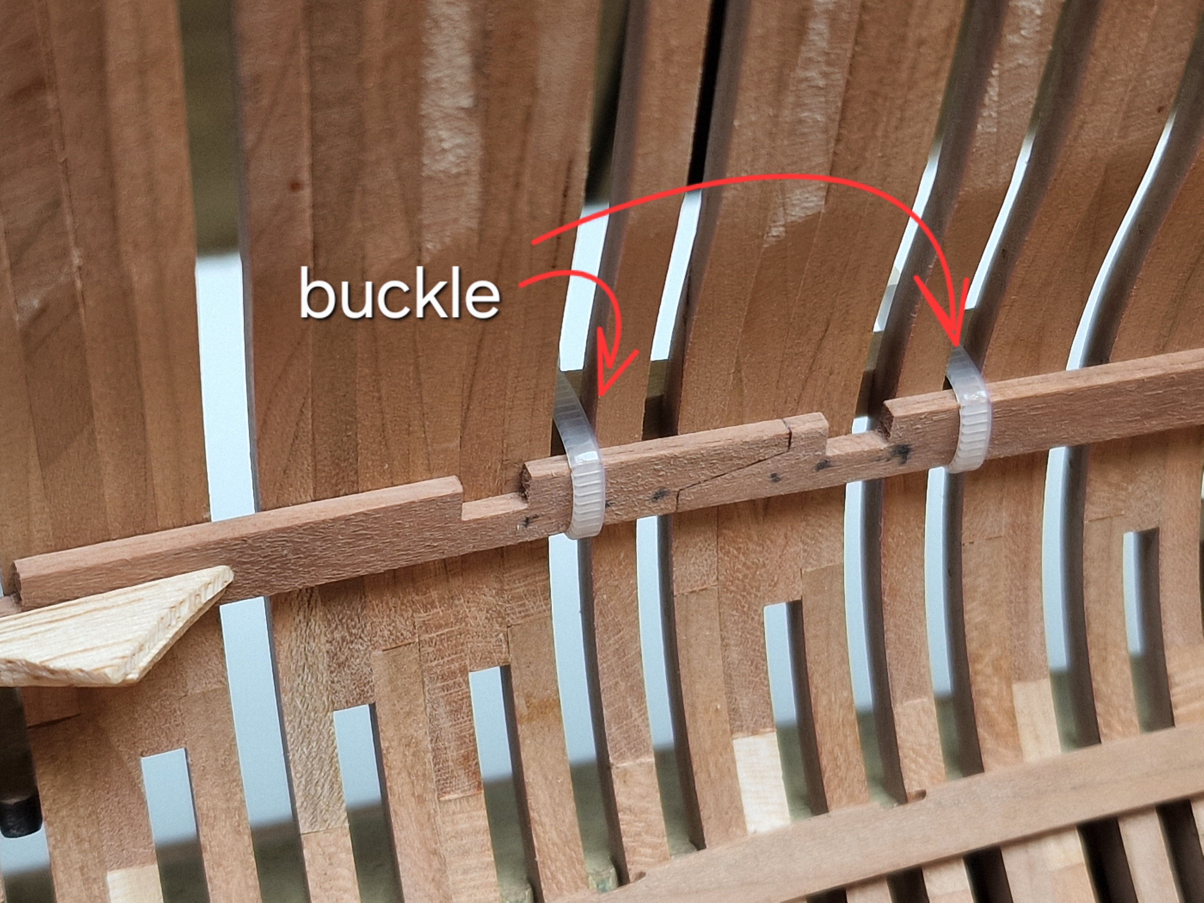

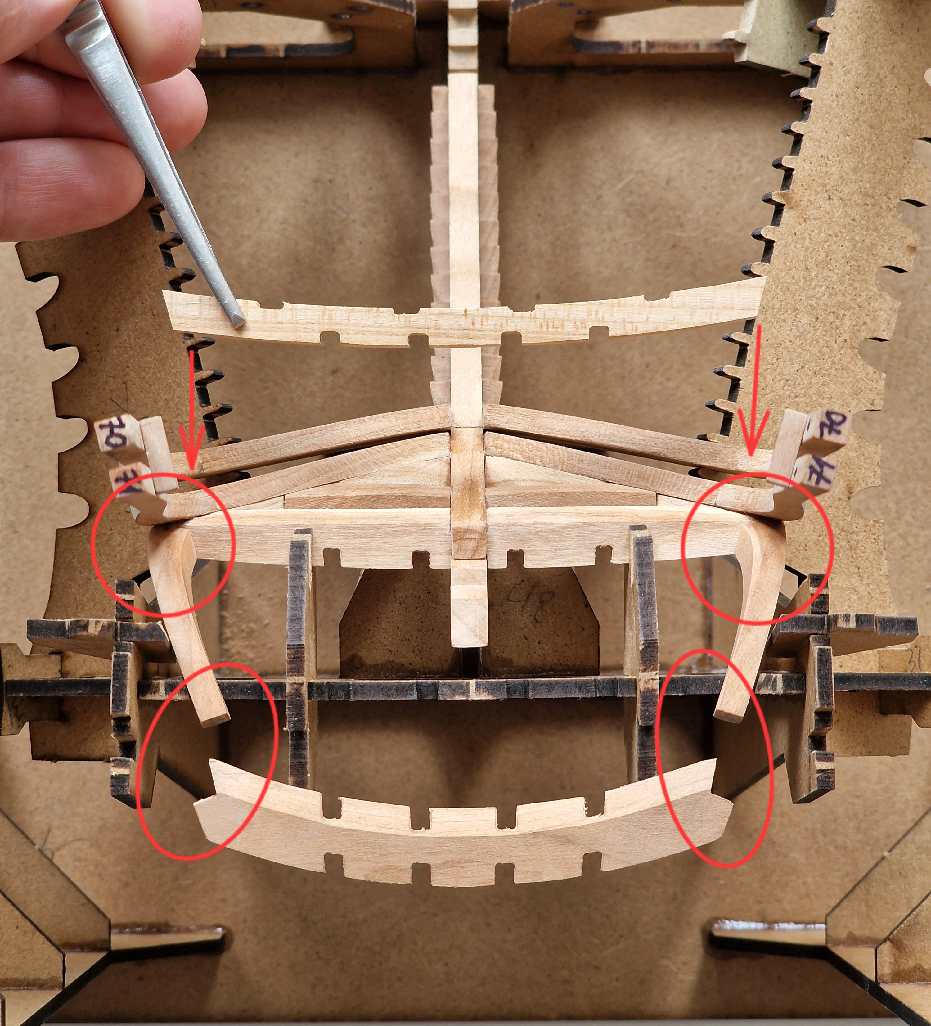

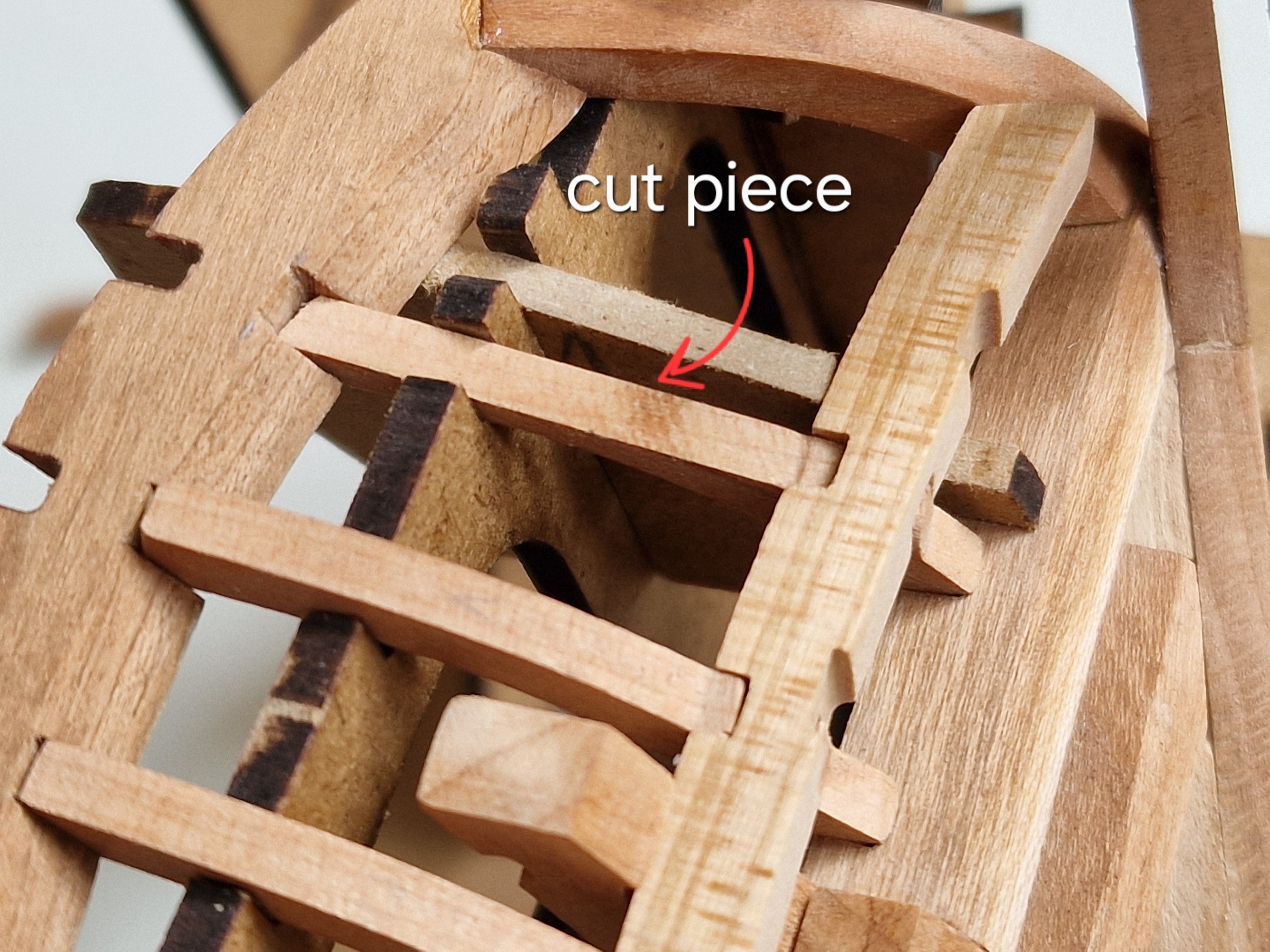

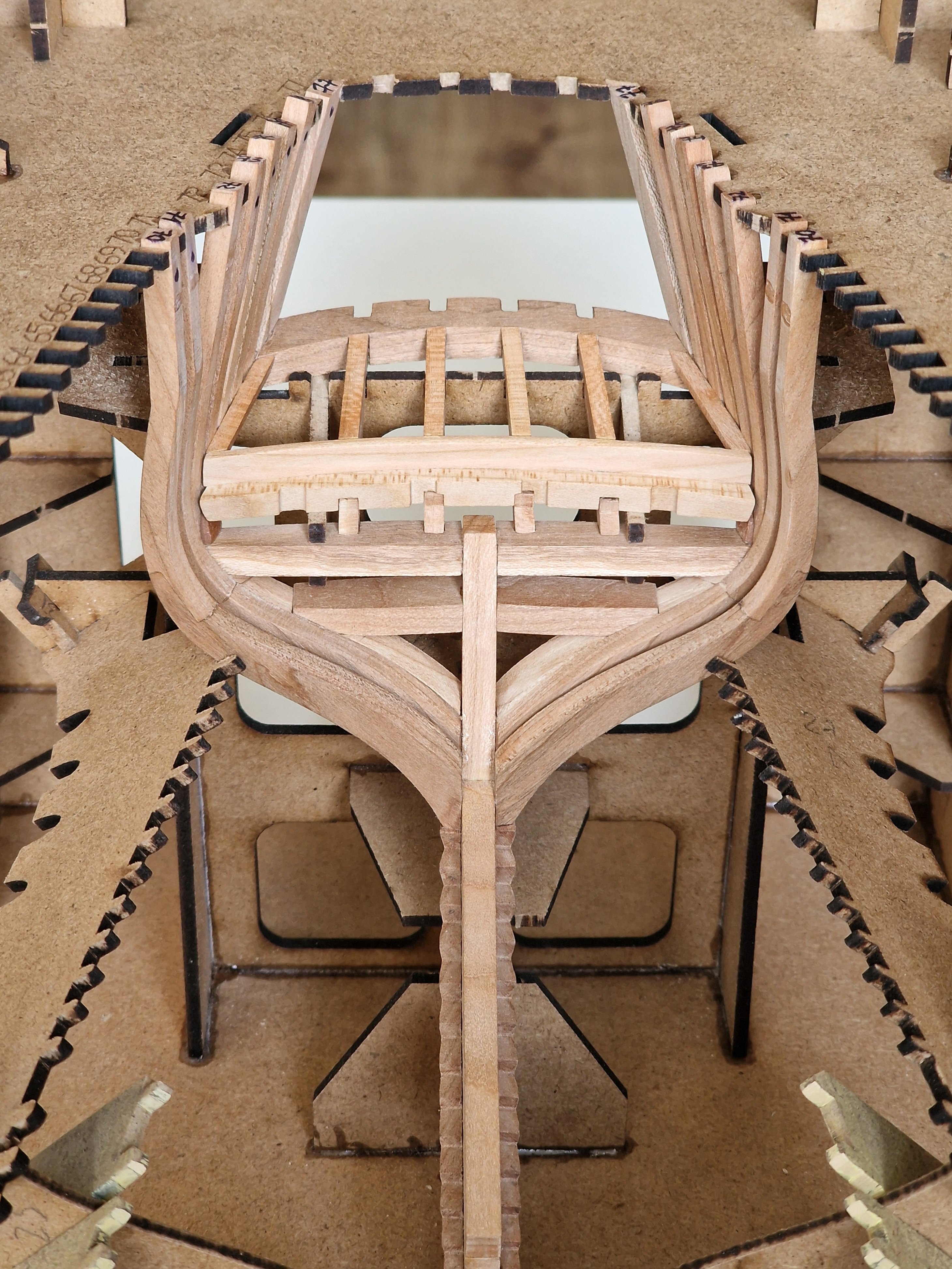

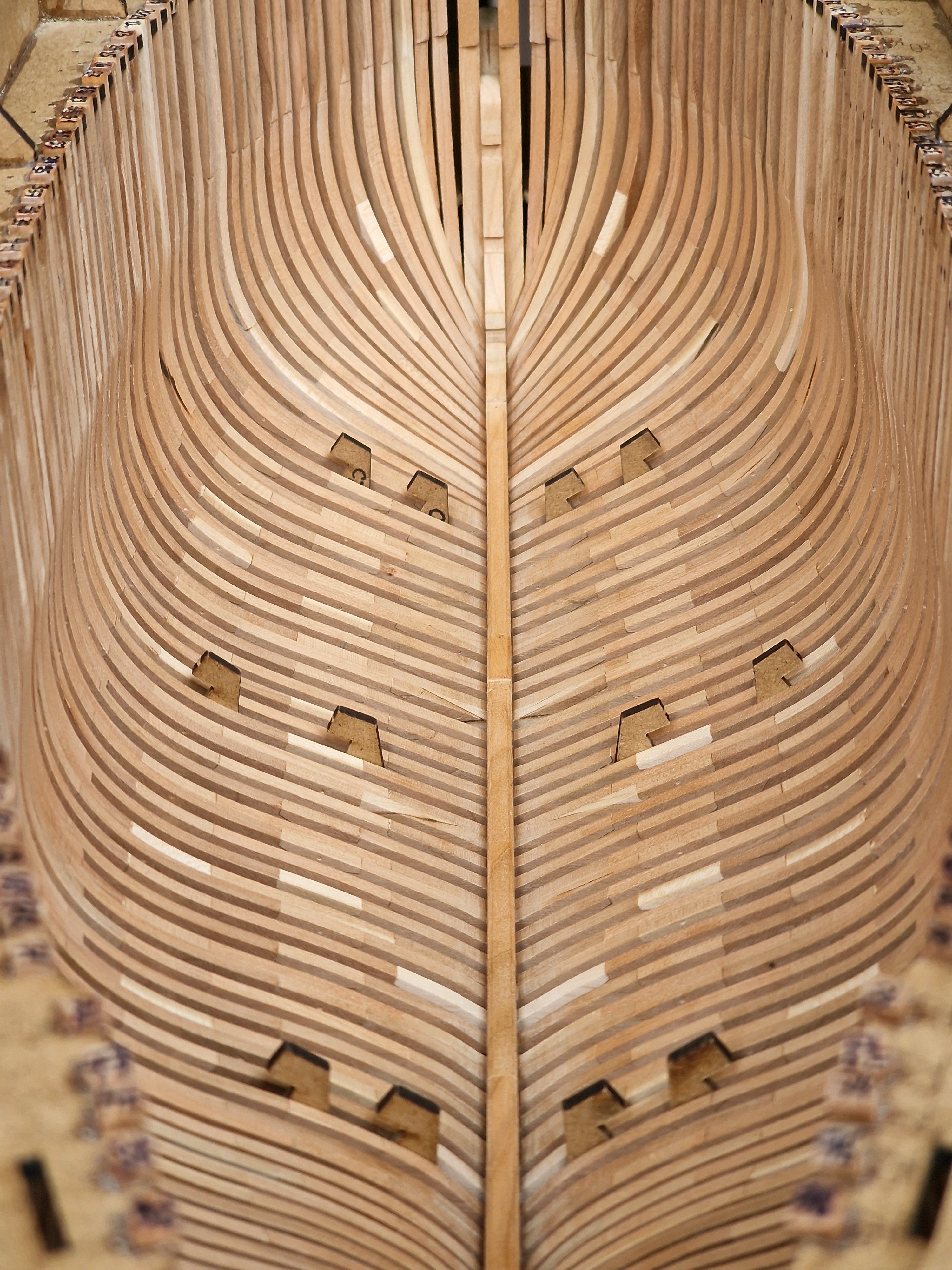

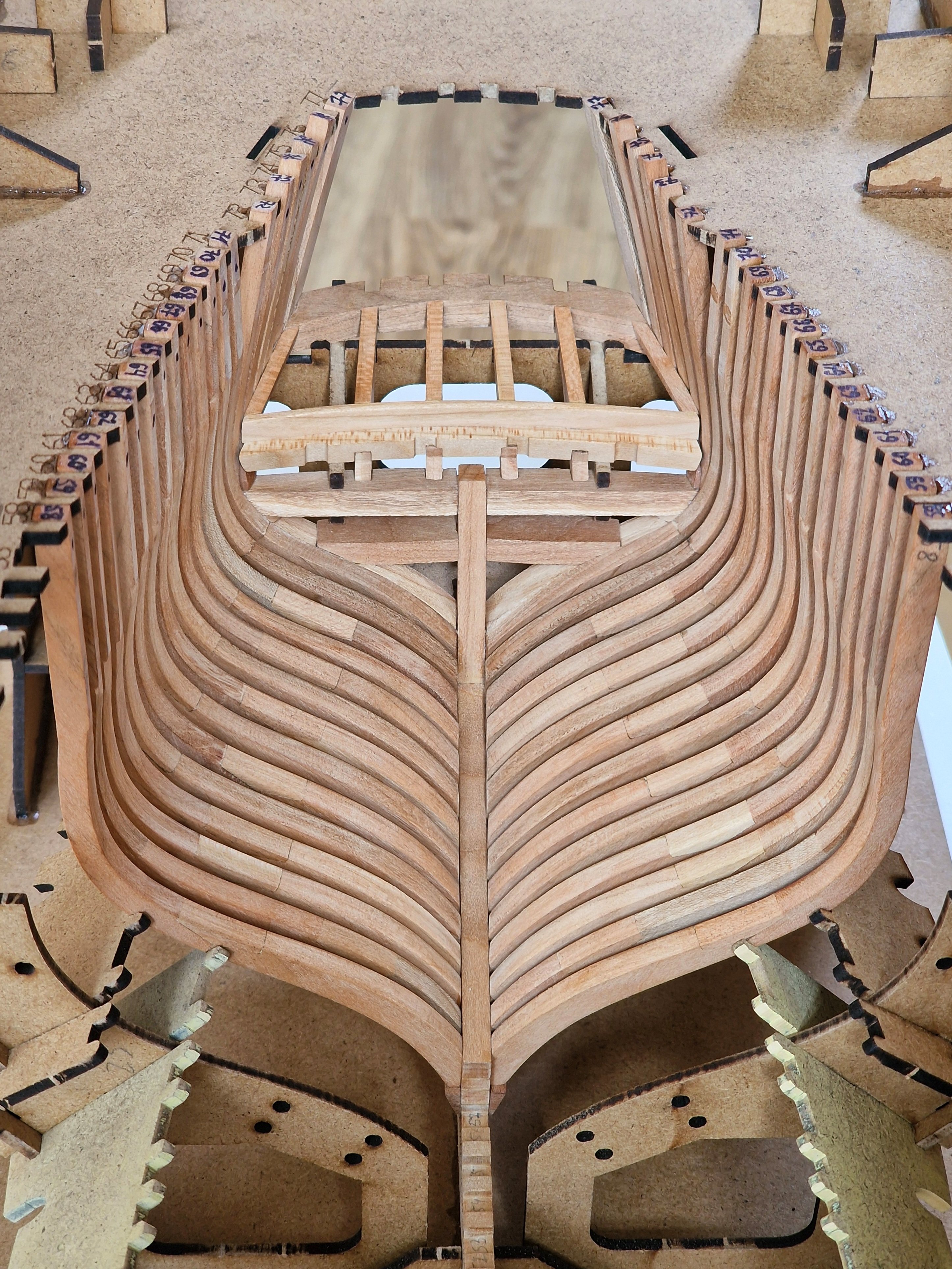

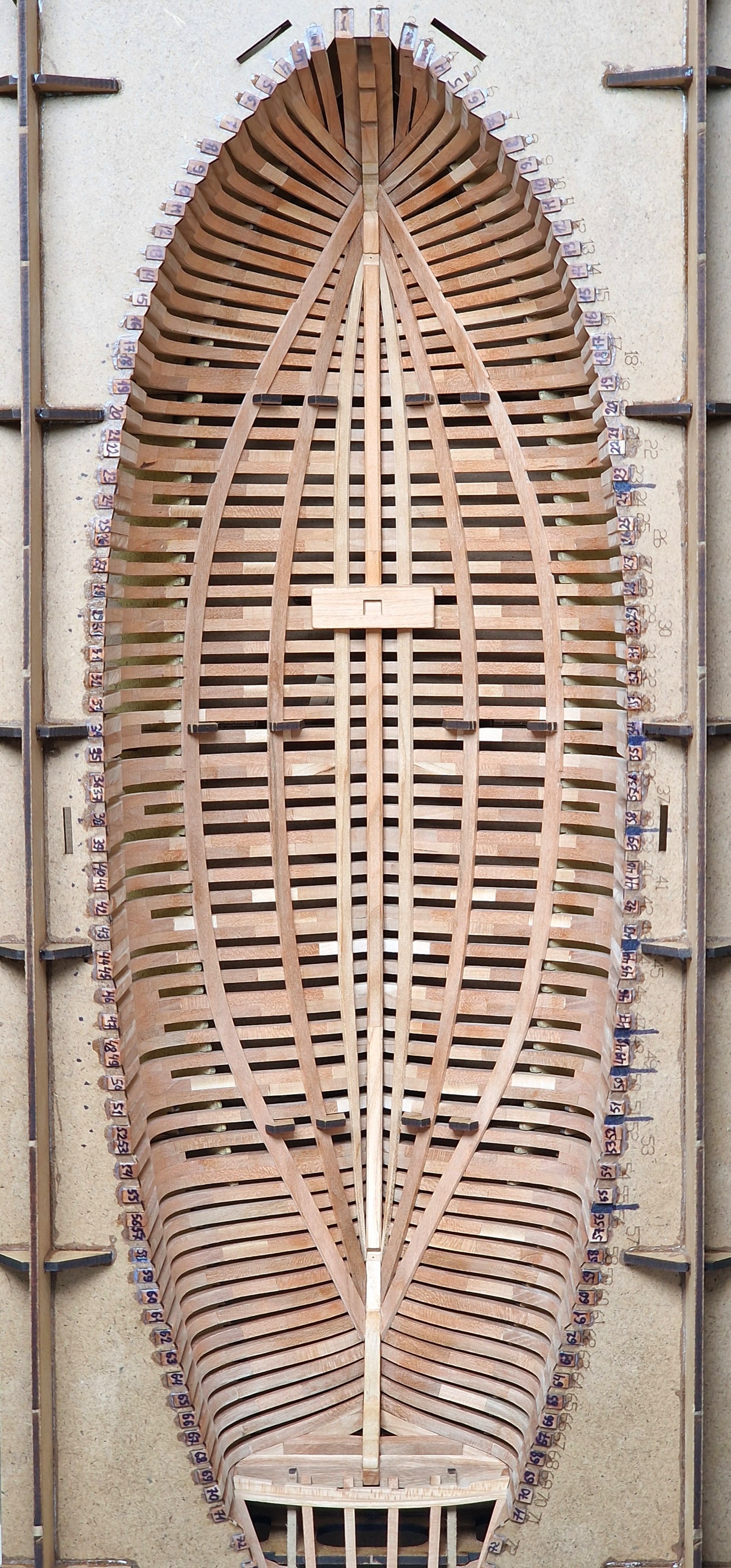

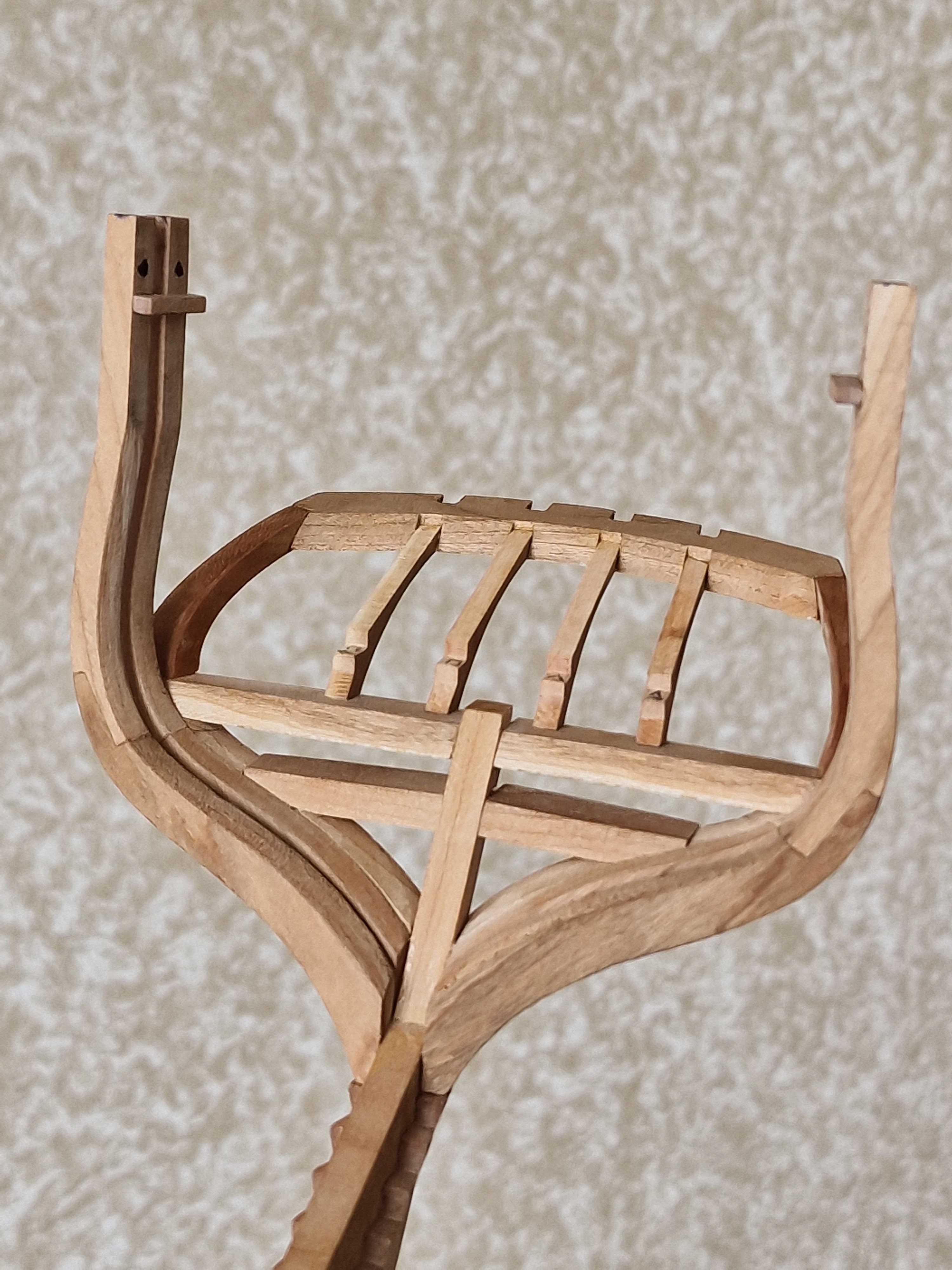

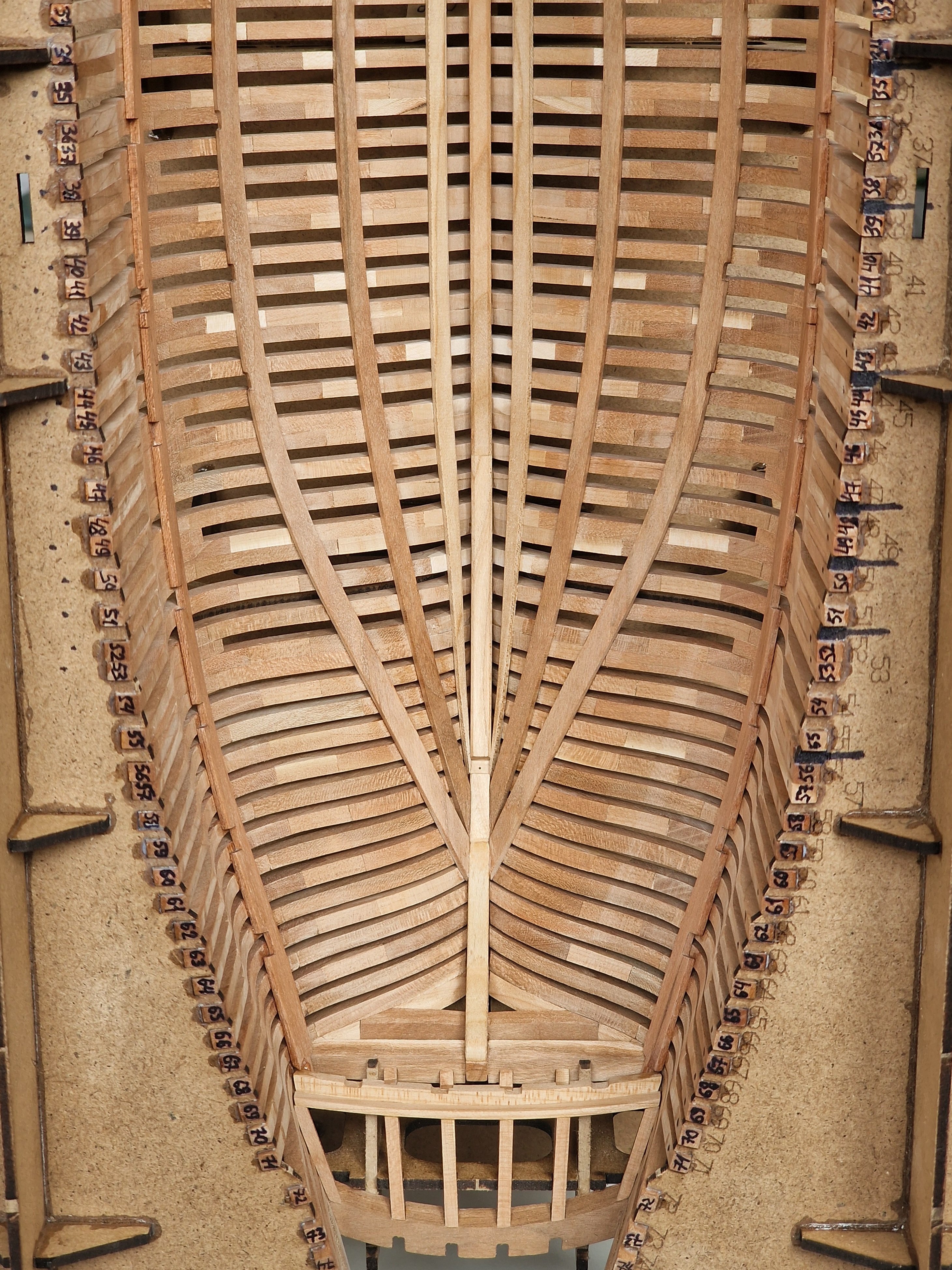

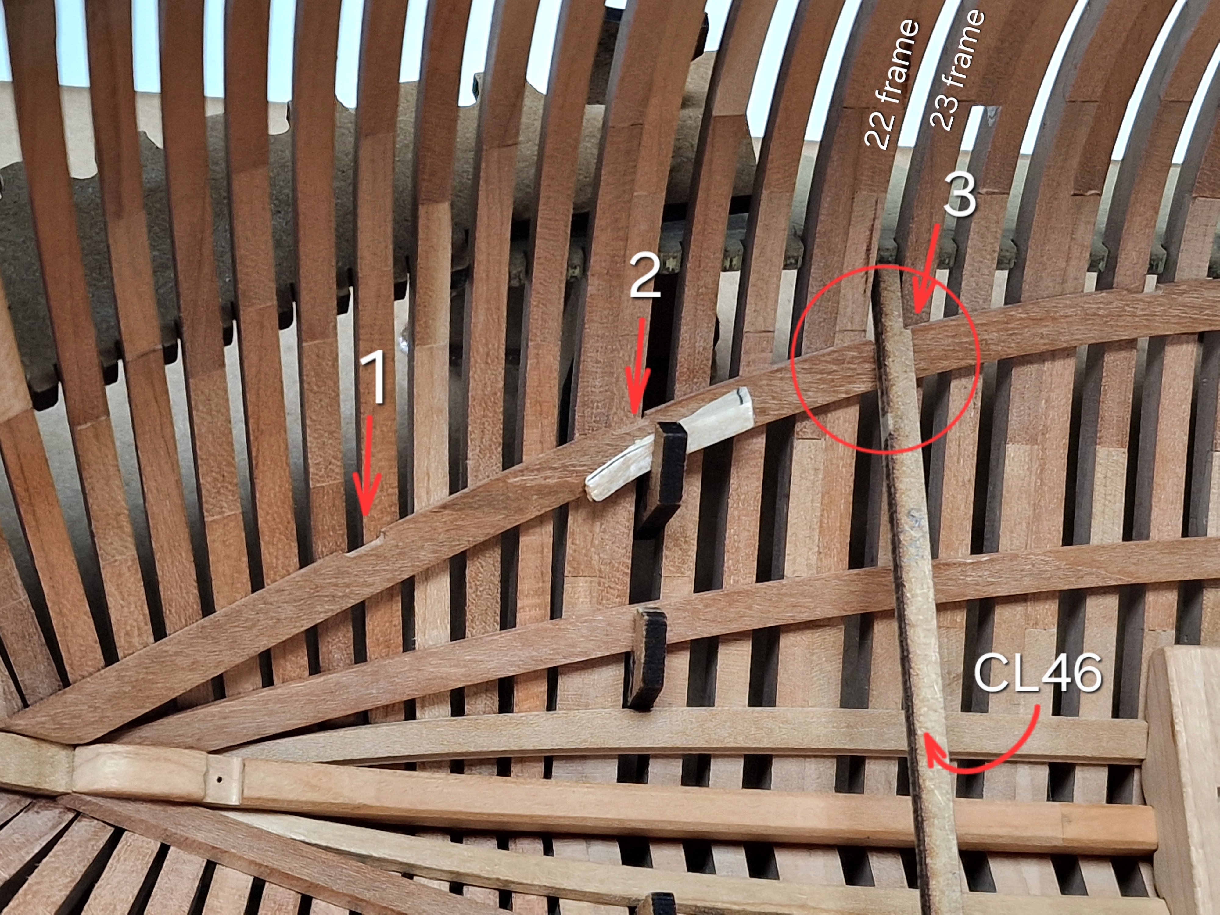

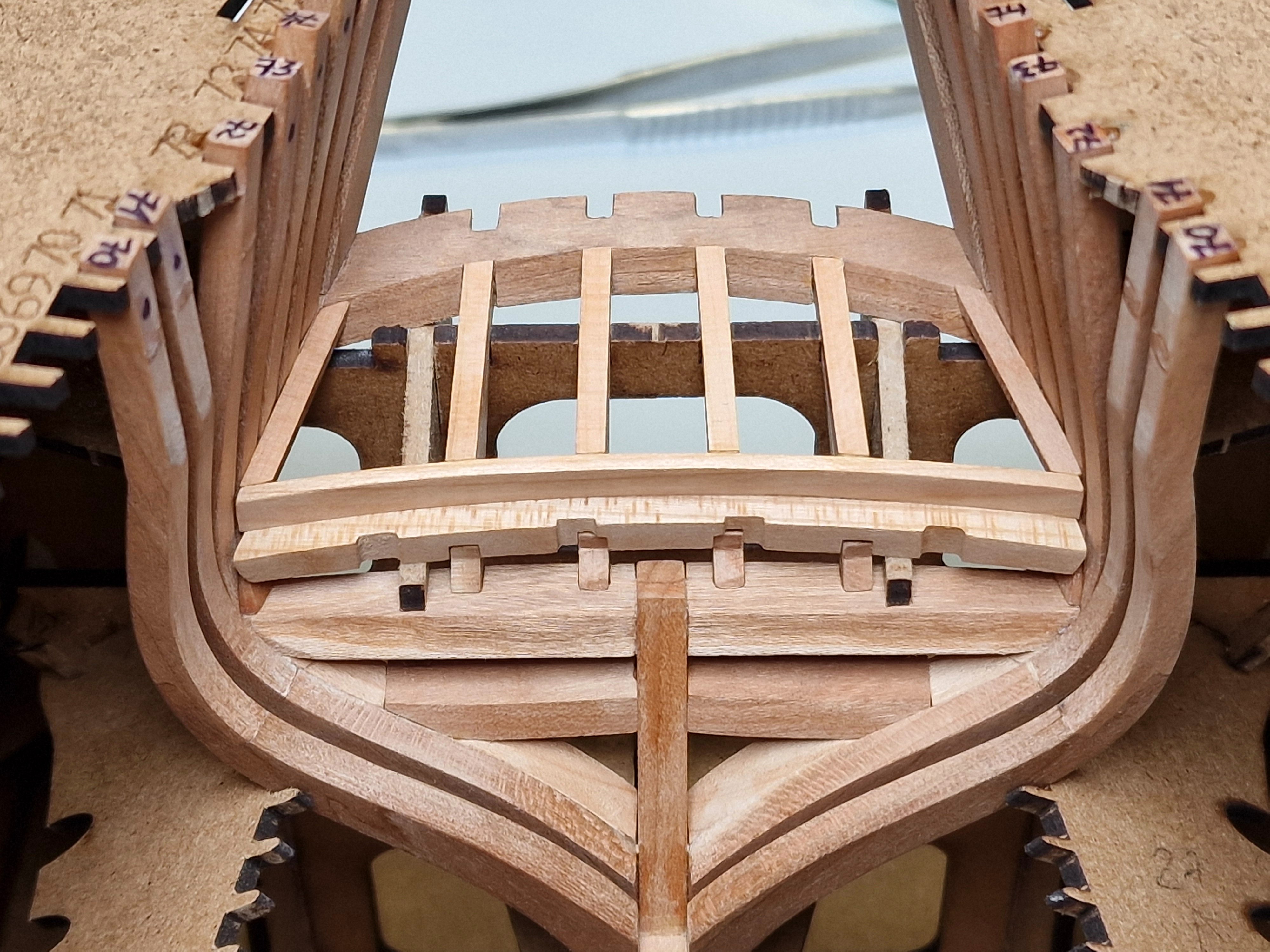

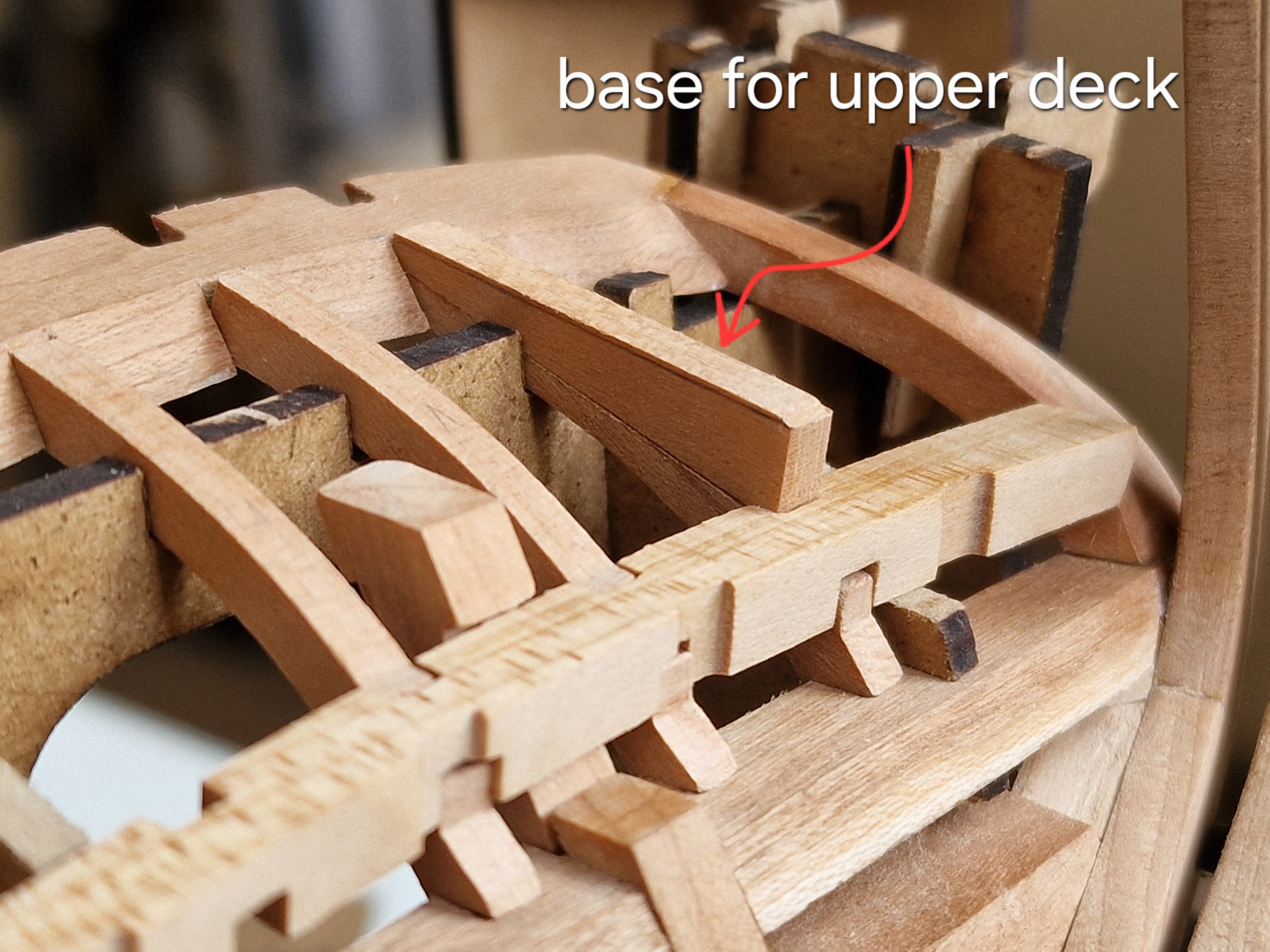

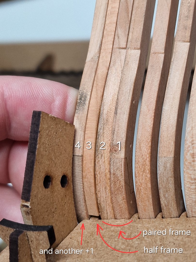

Fixing the middle frames.

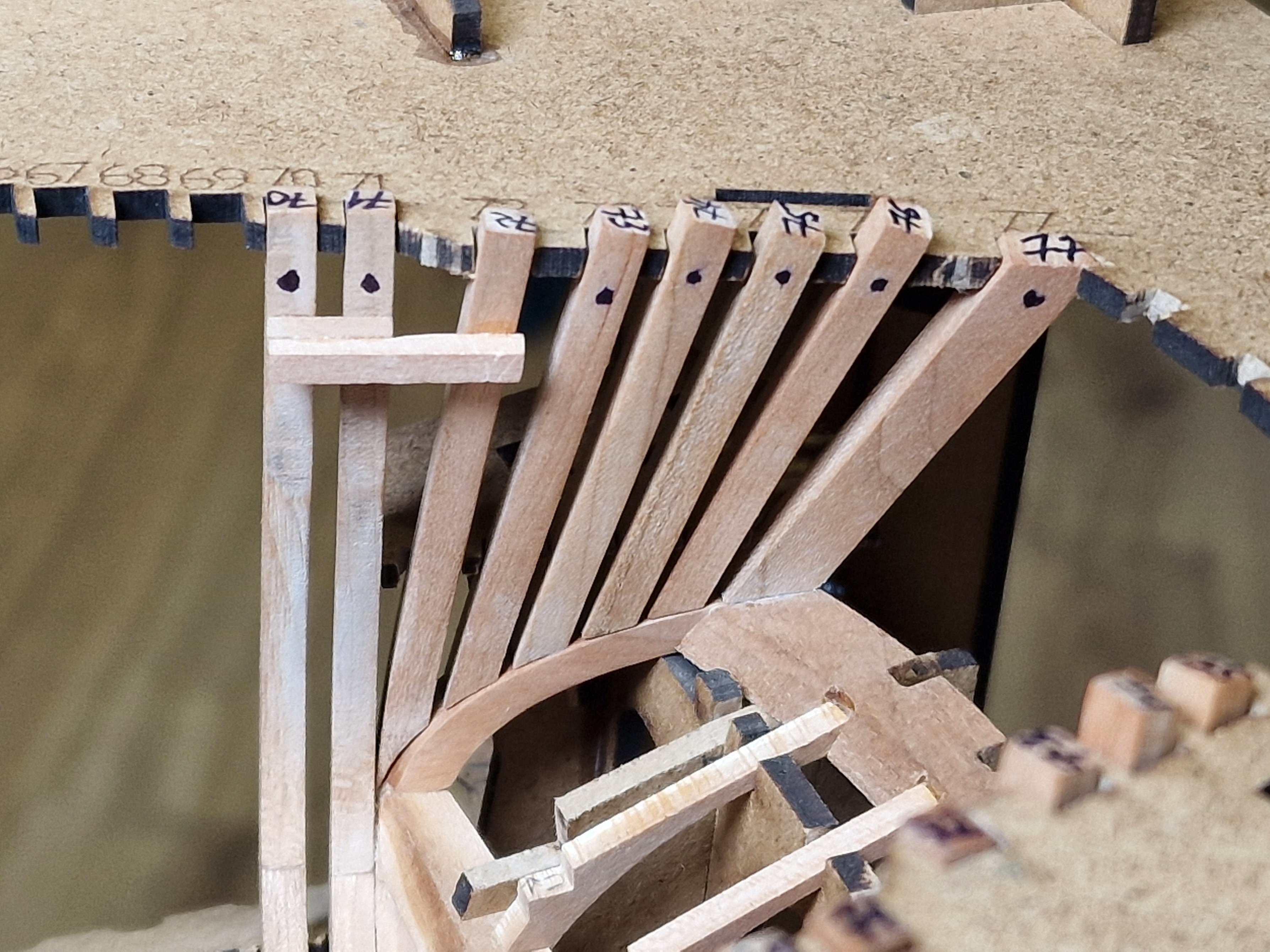

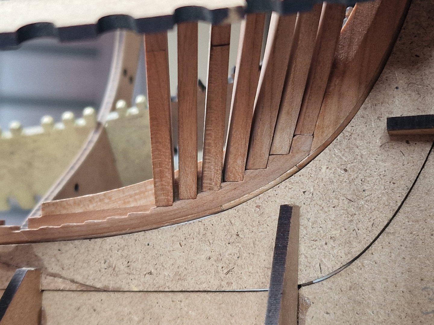

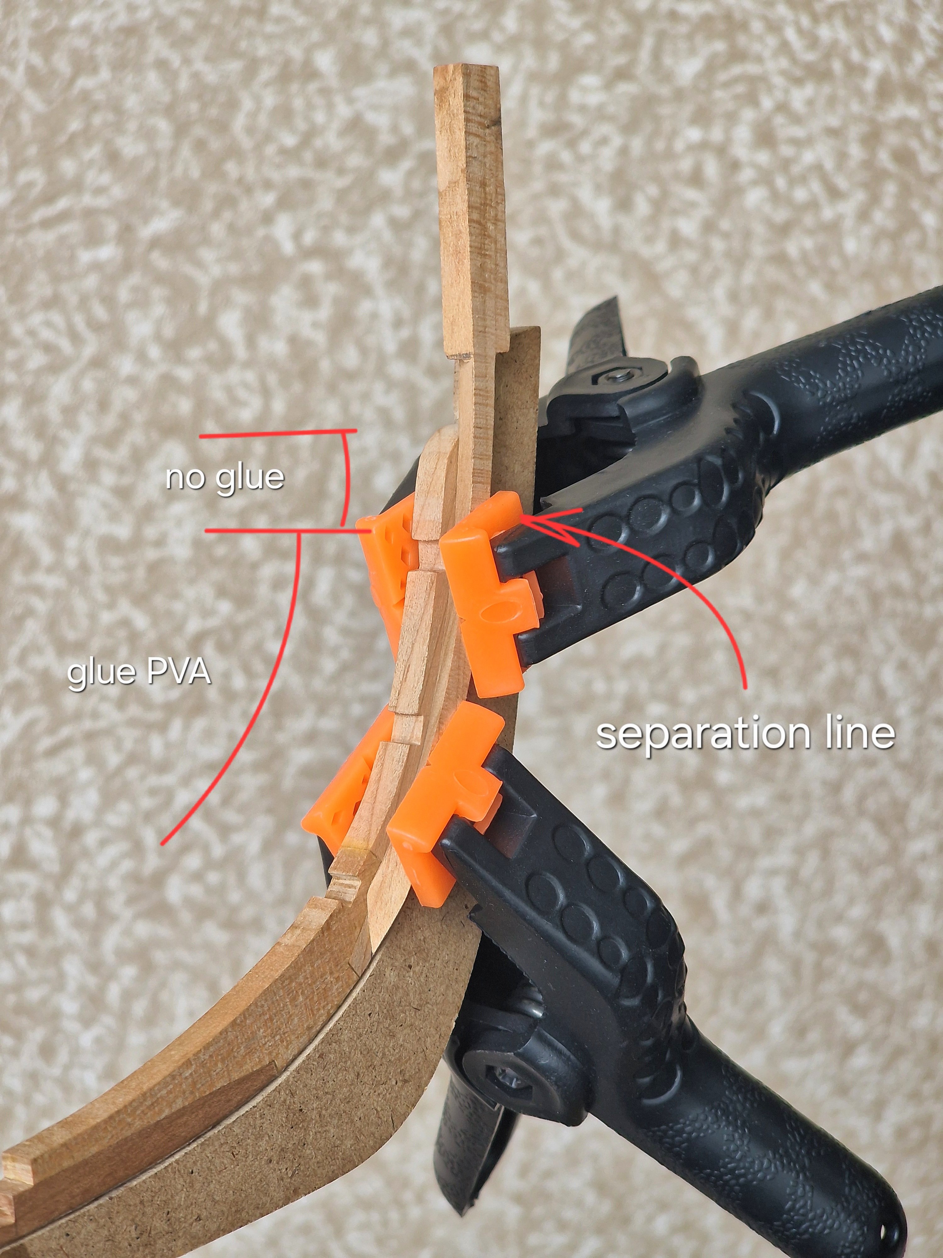

In the middle section there are paired frames alternating with regular ones. On the paired ones, while I still had access, I made imitation bolts.

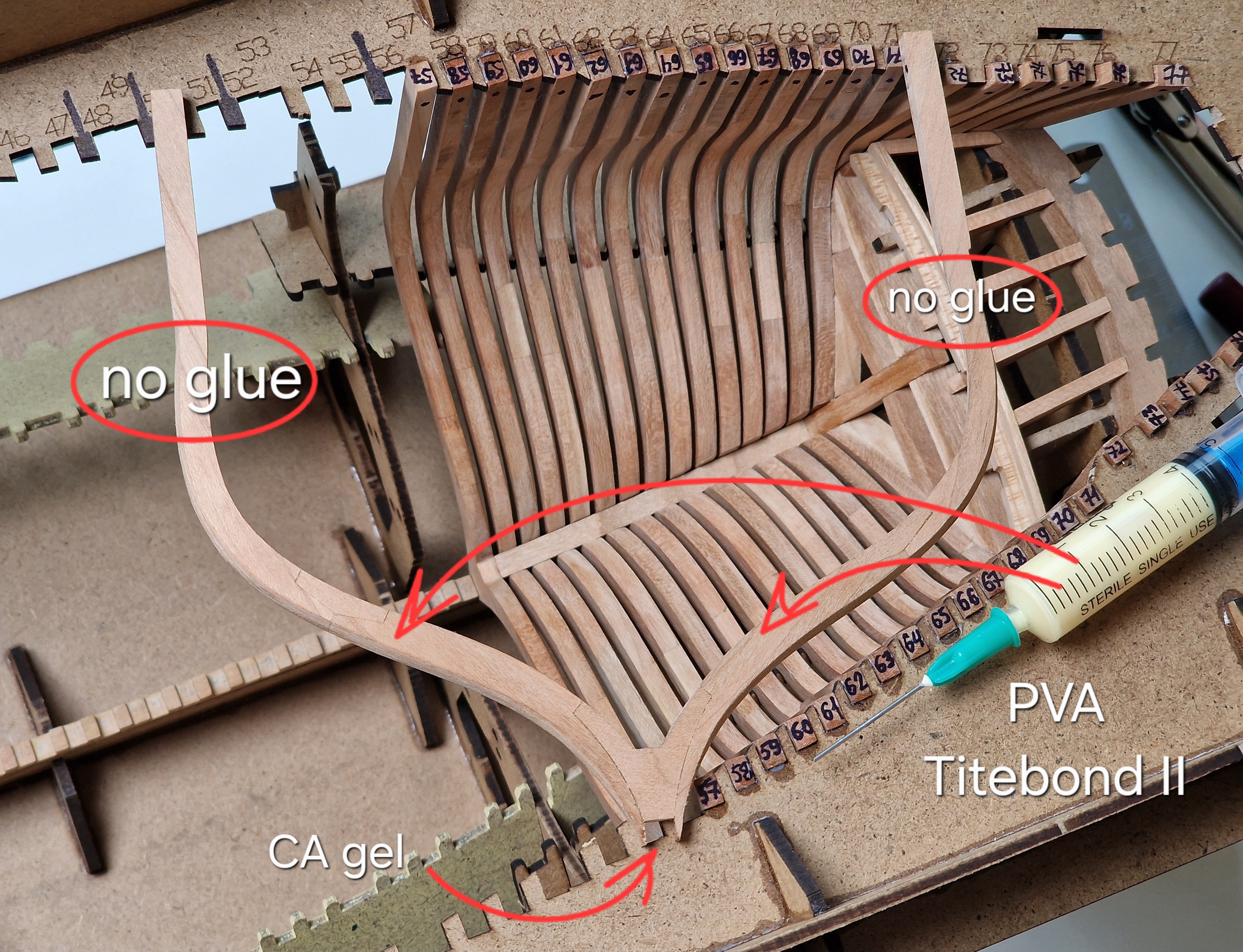

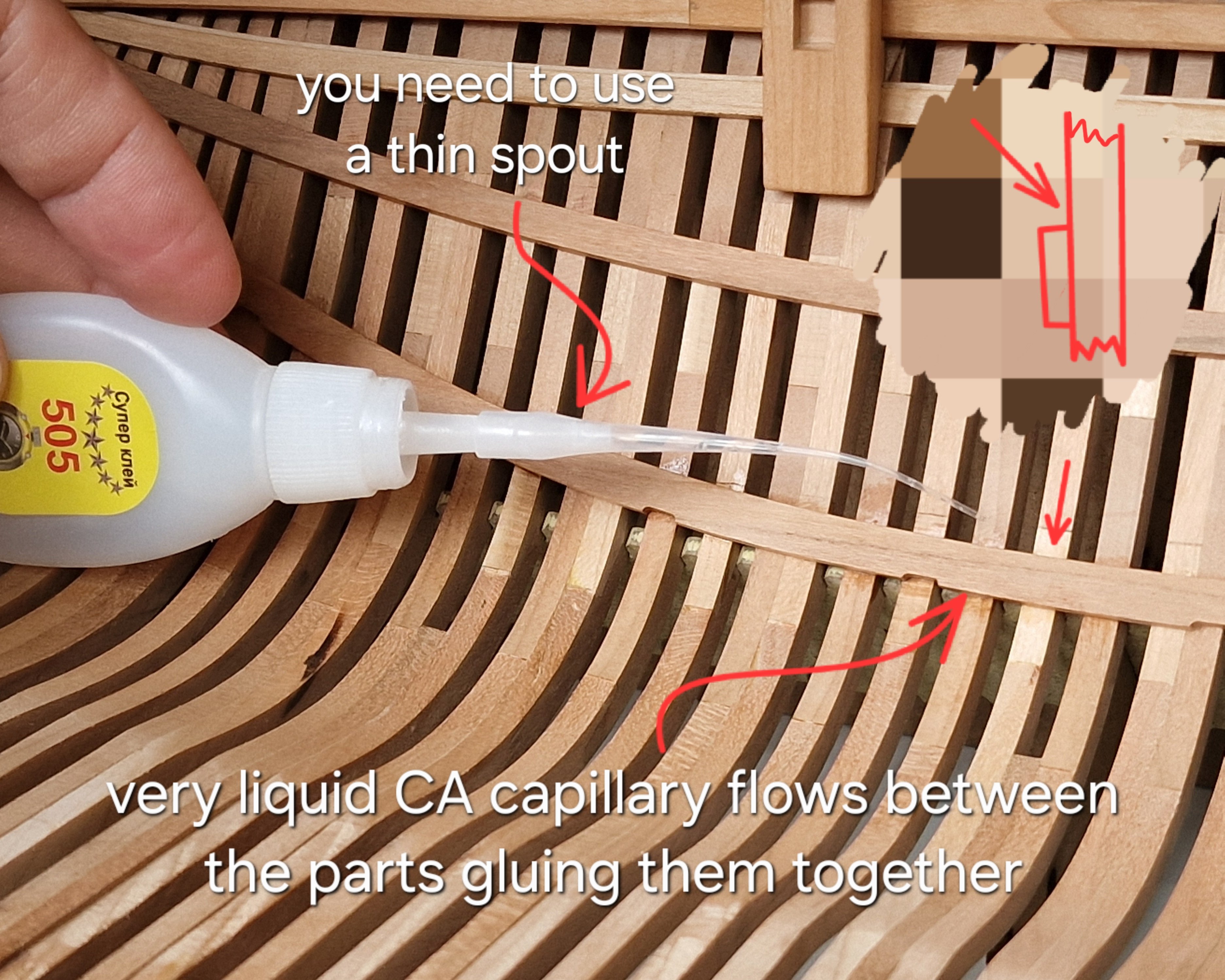

I glued the frames with the same CA gel to the keel and the slip. But between each other the paired frames were glued with PVA, leaving an unglued section for easier separation later after trimming.
In the same way I glued in the toptimbers.

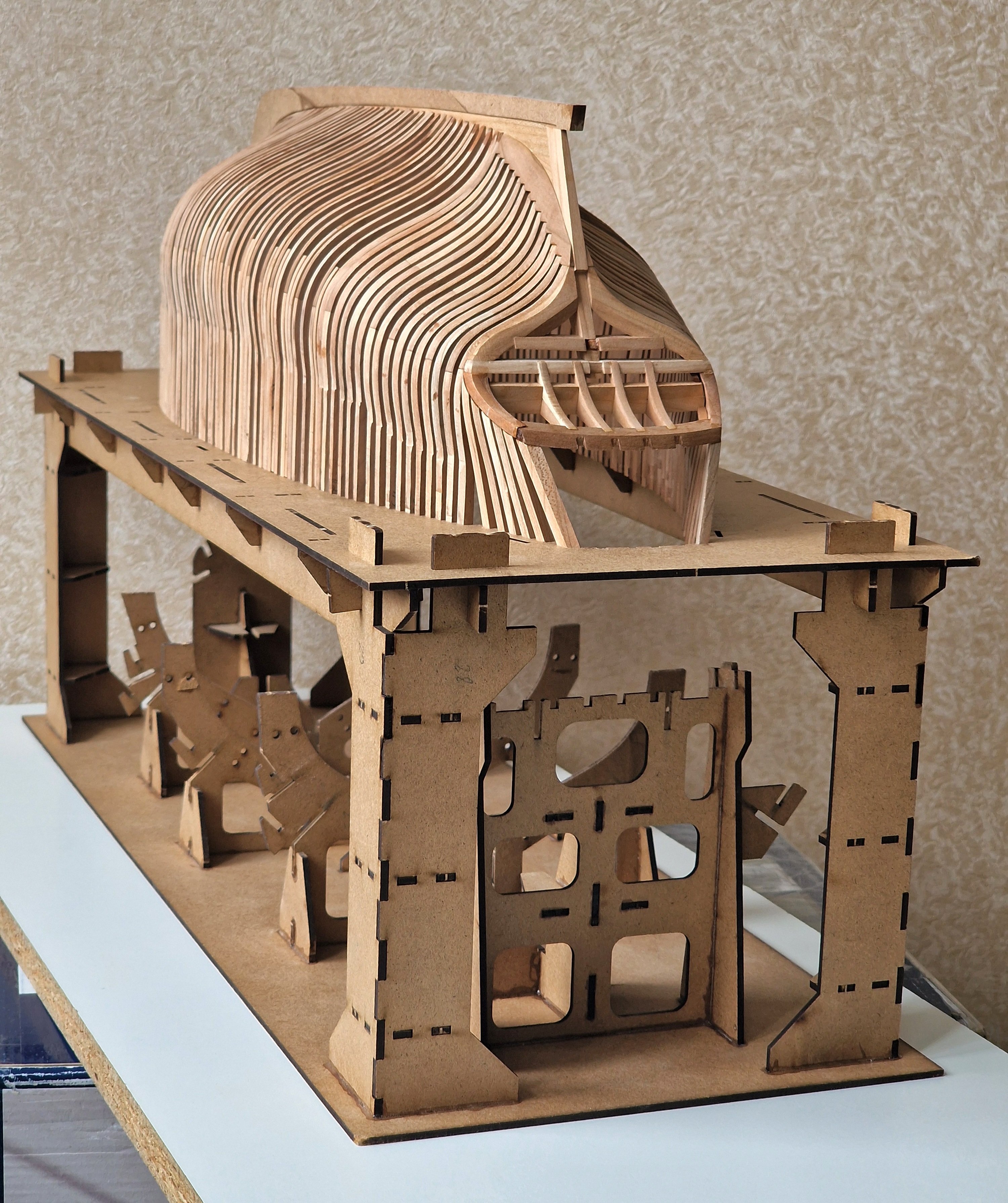

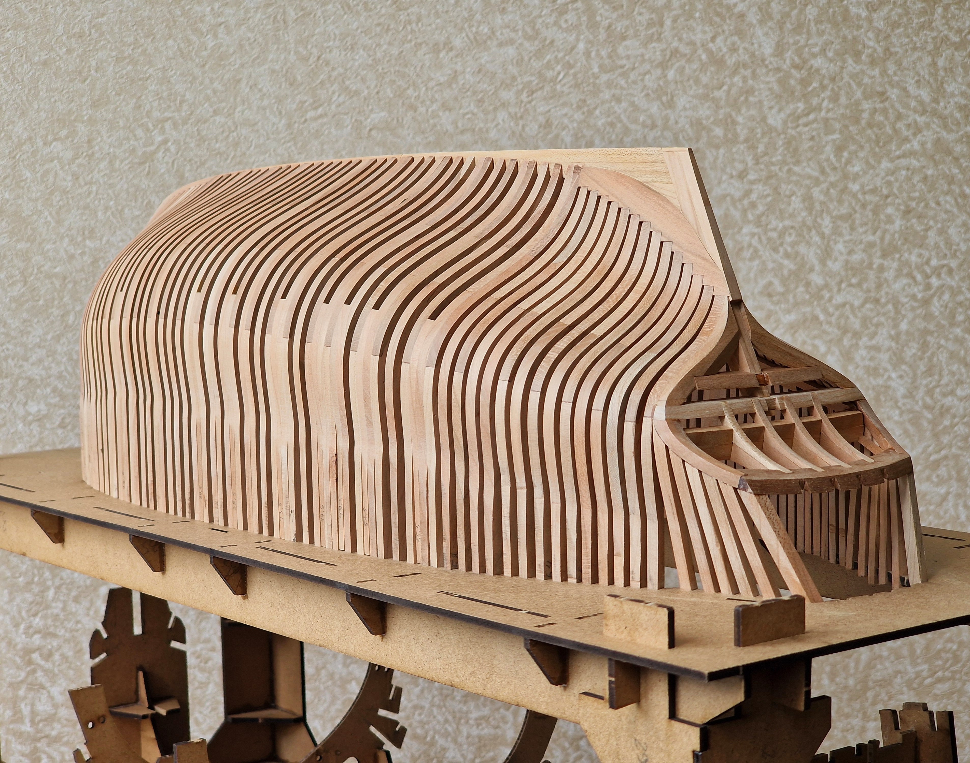

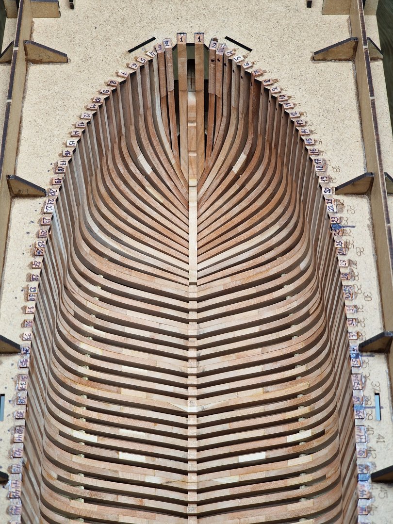

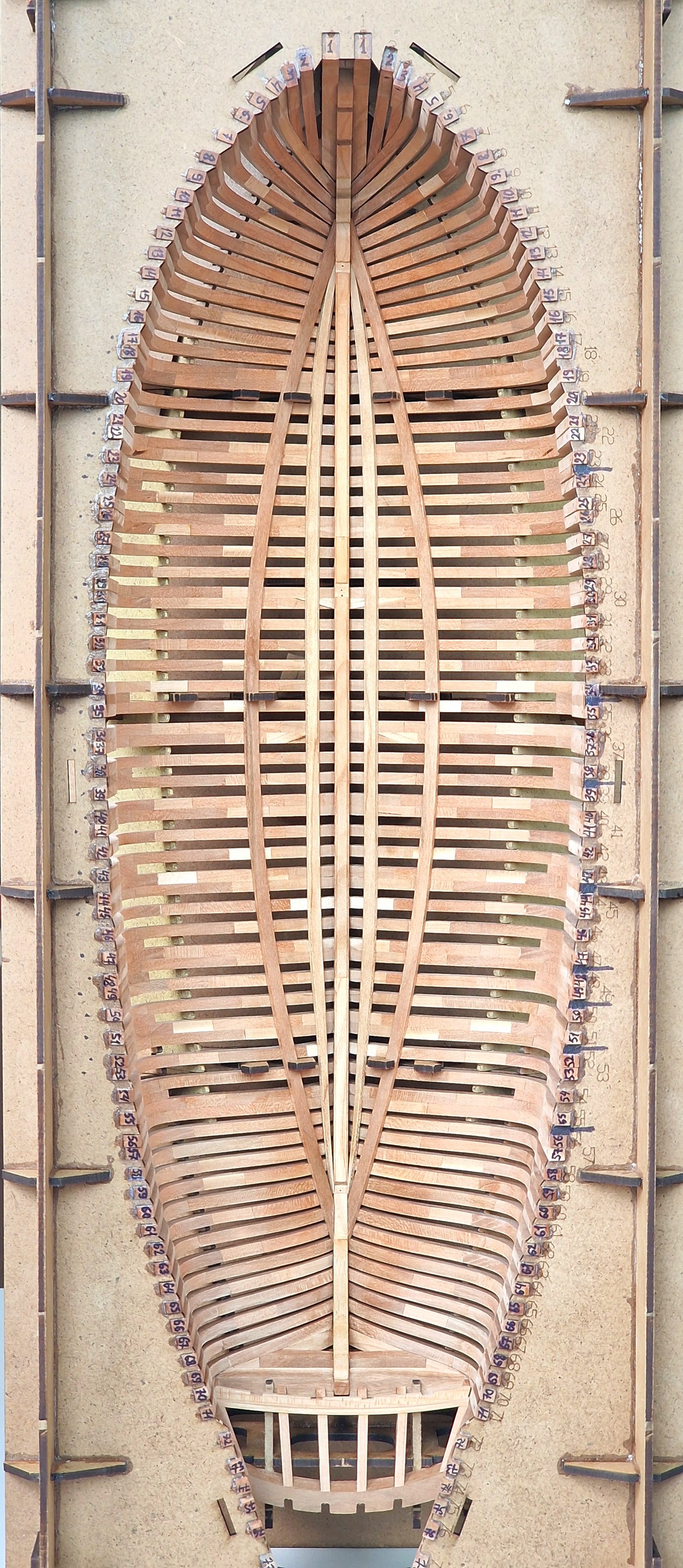

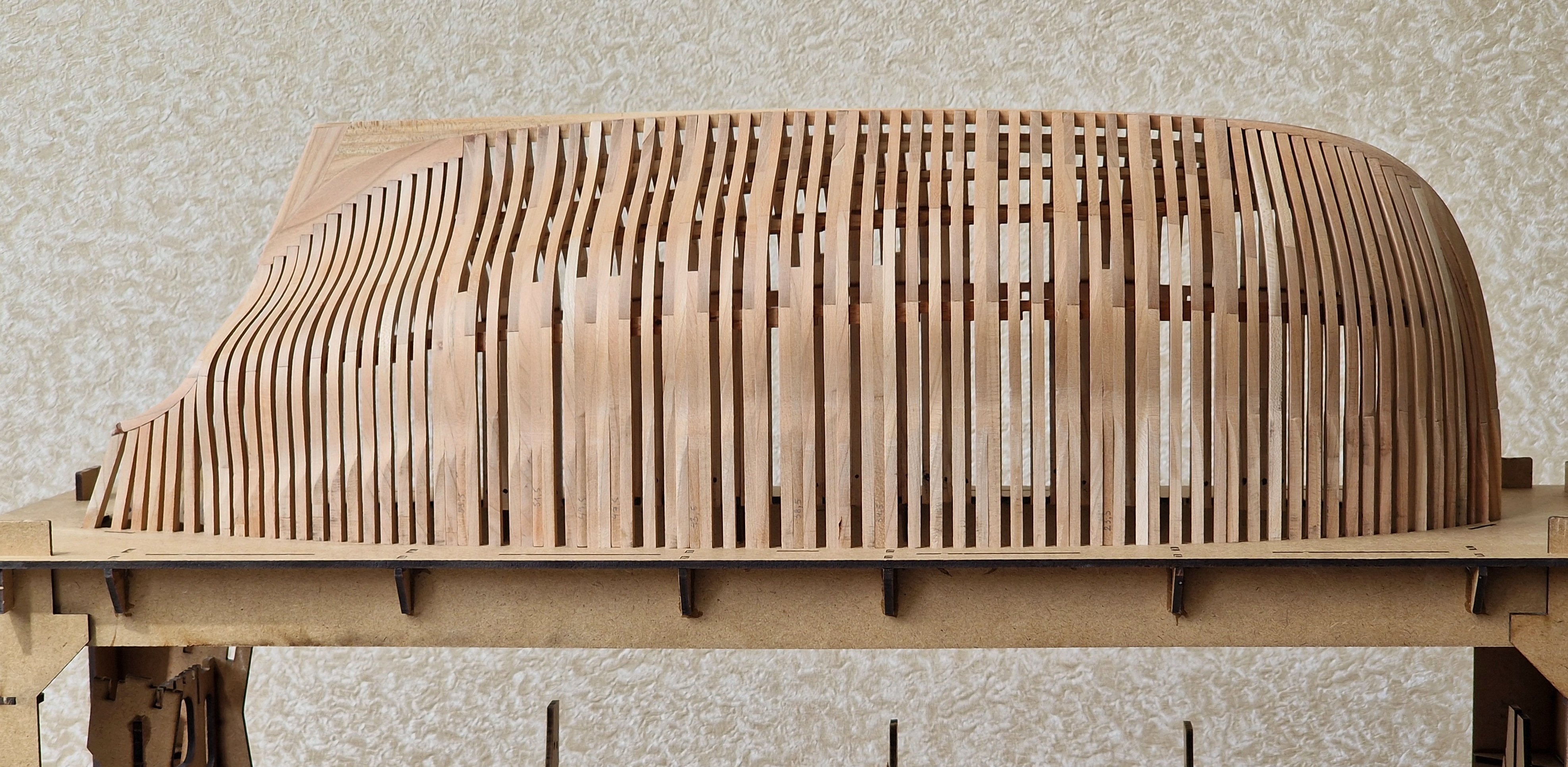

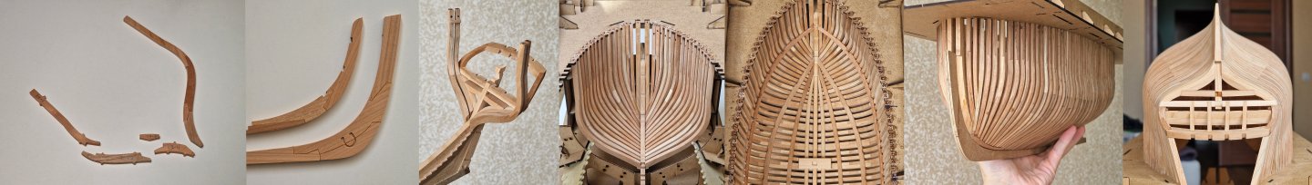

So, let's summarize:
50 days of construction (2.5 months),
499 parts on board...

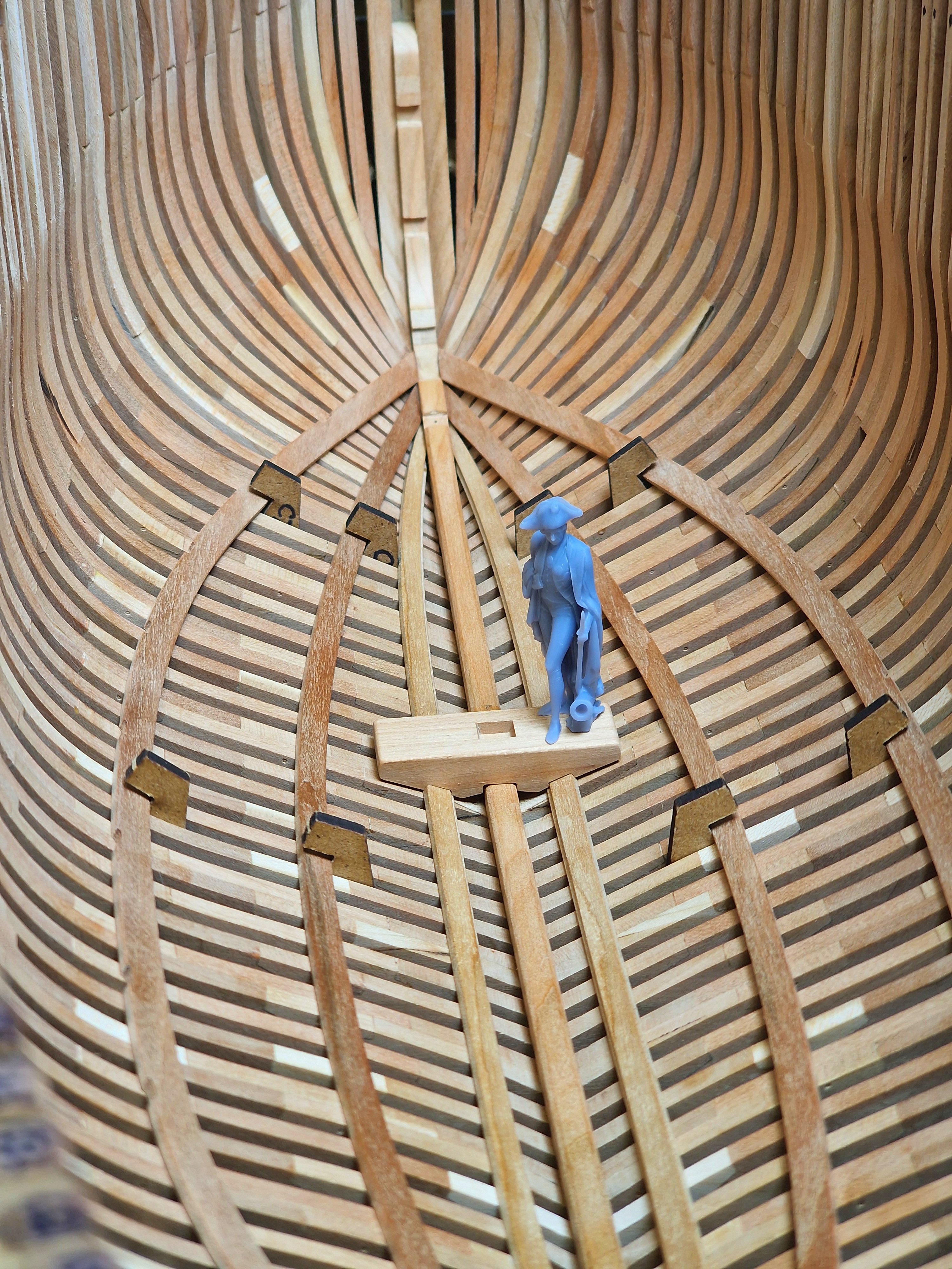

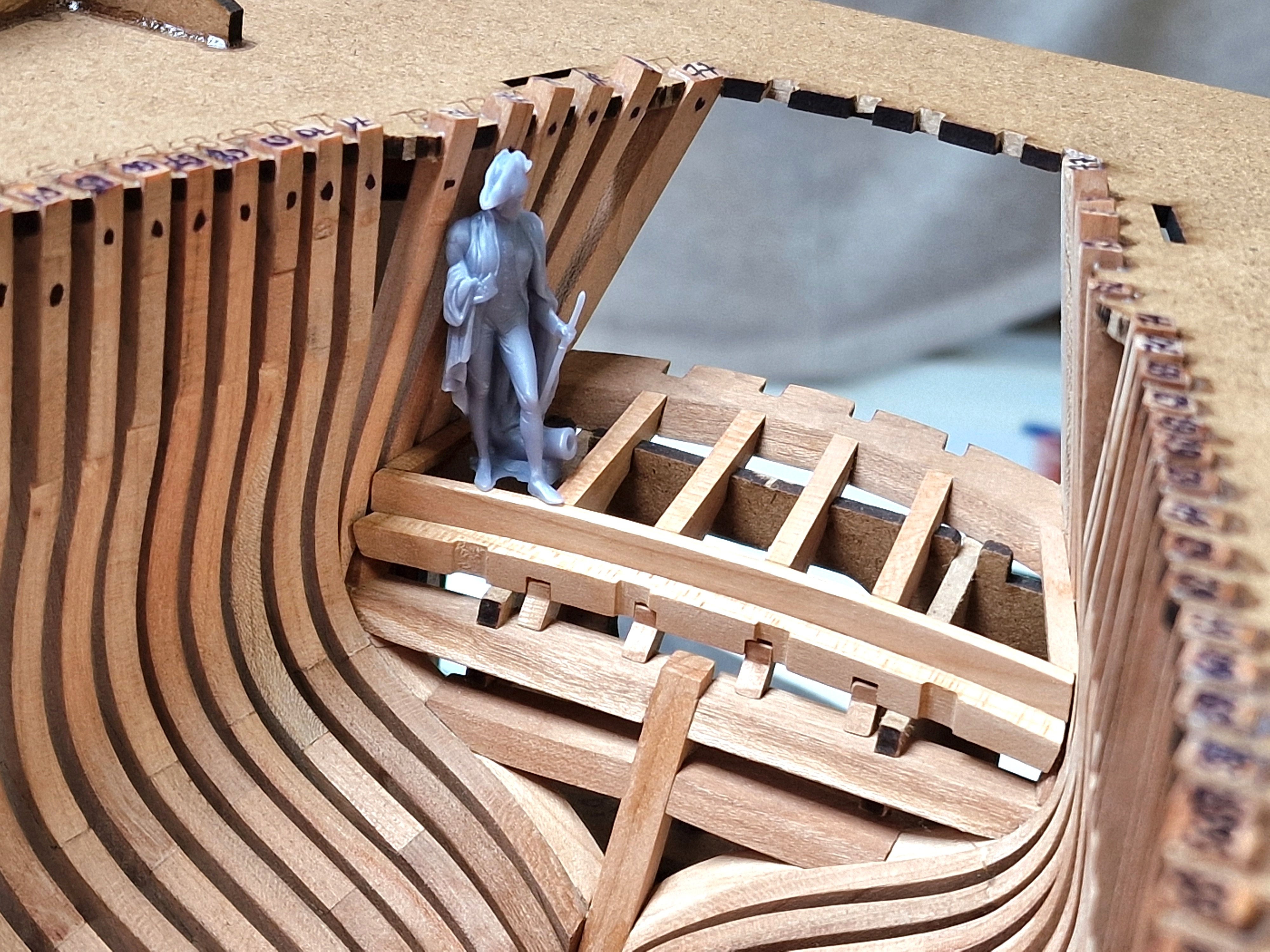

...and now Horatio Nelson himself has come to the inspection 🤣

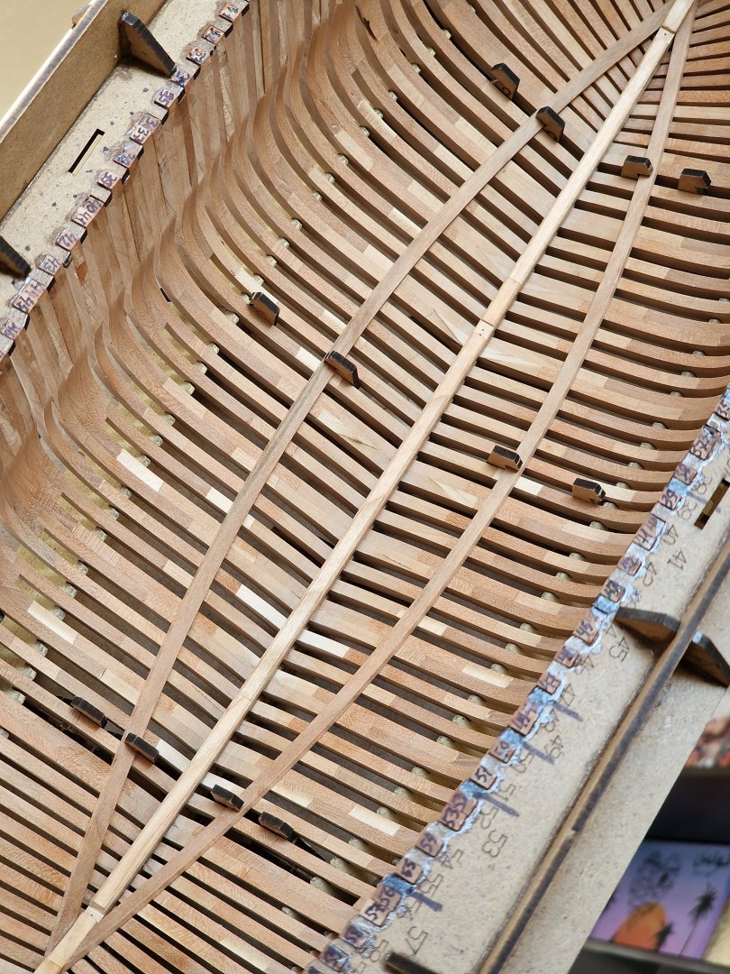

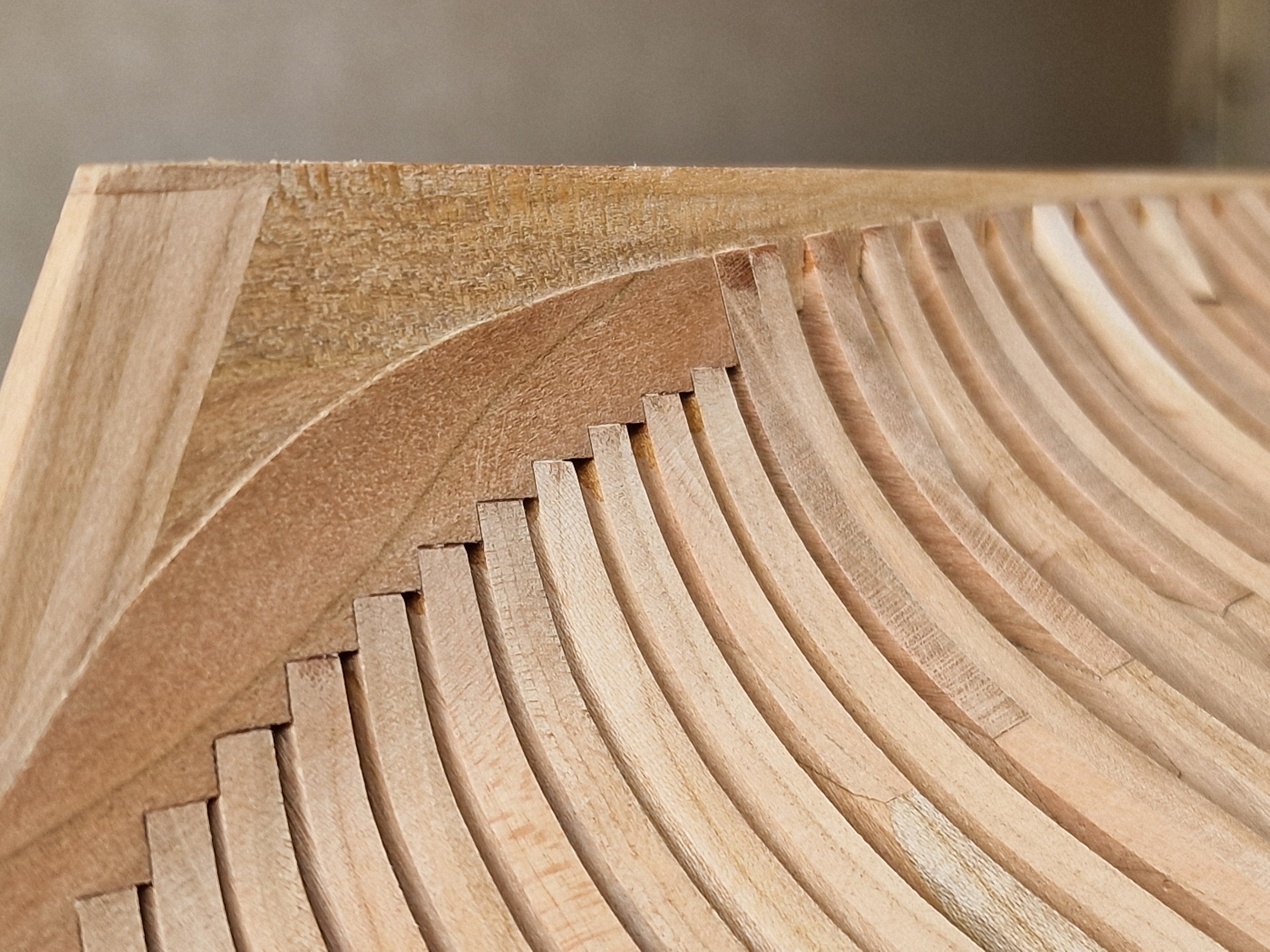

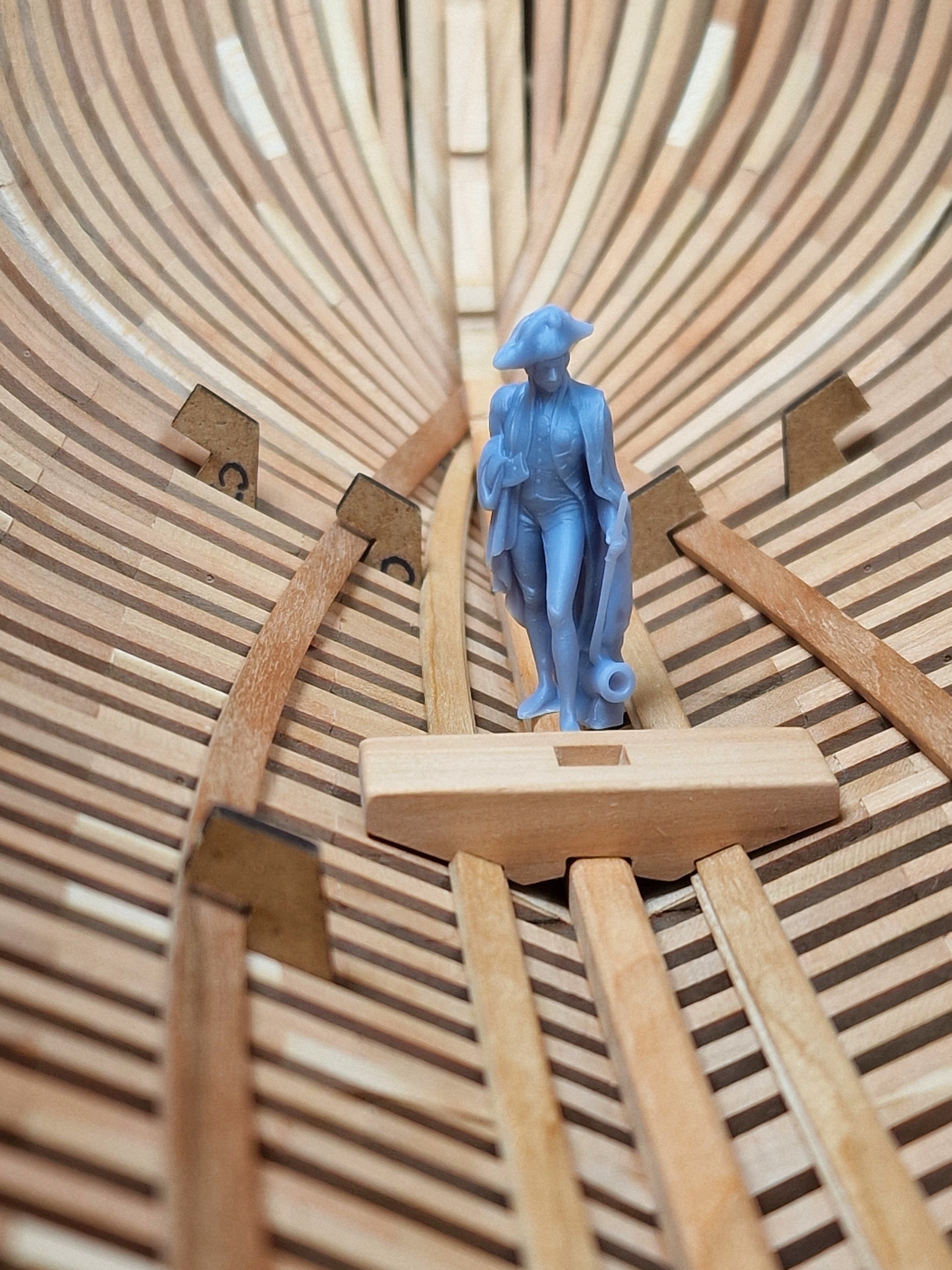

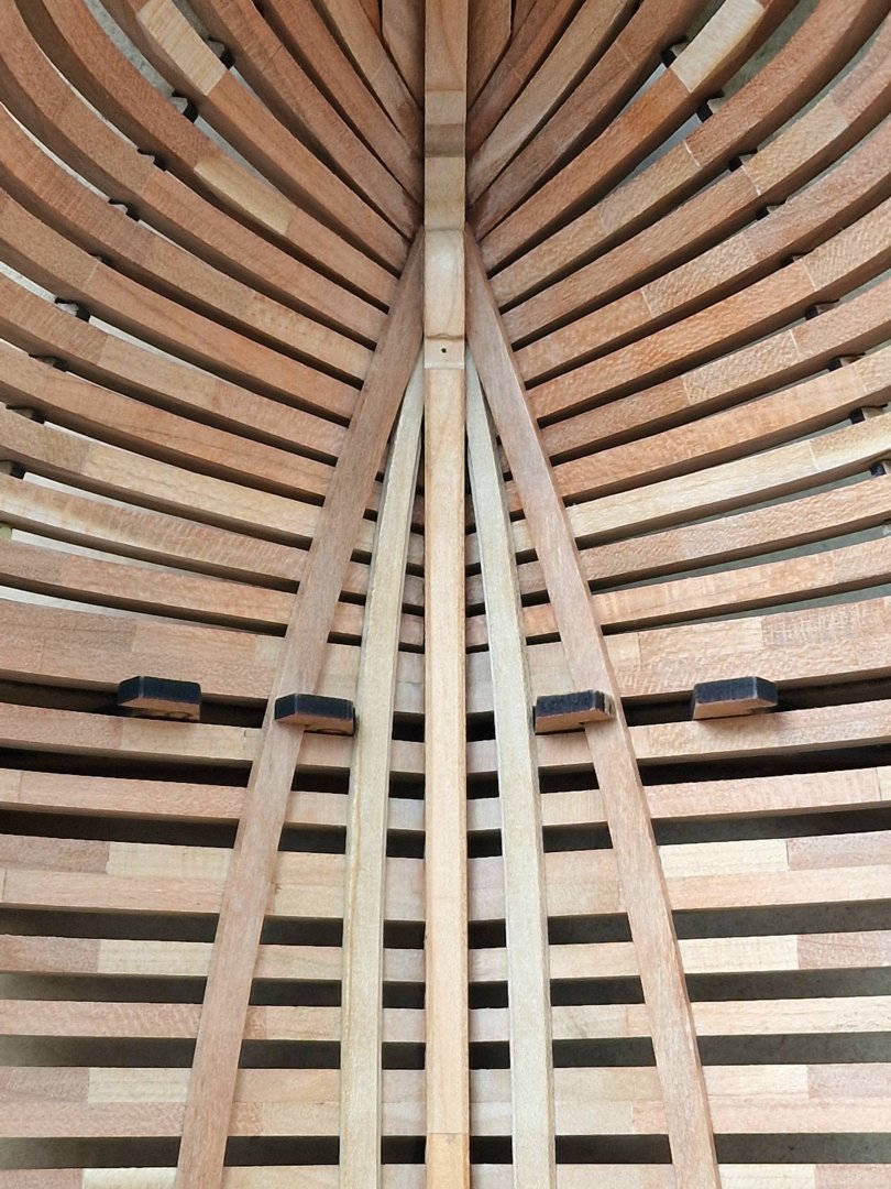

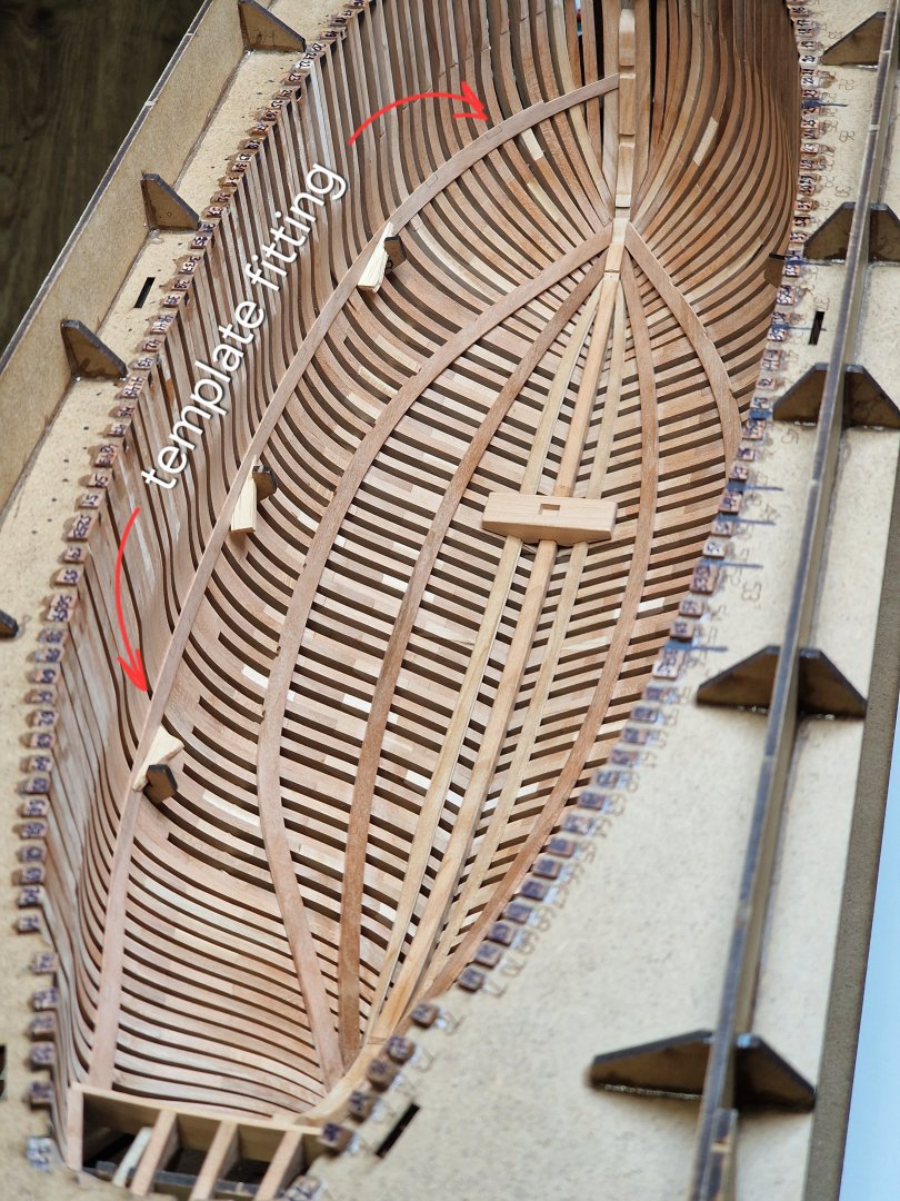

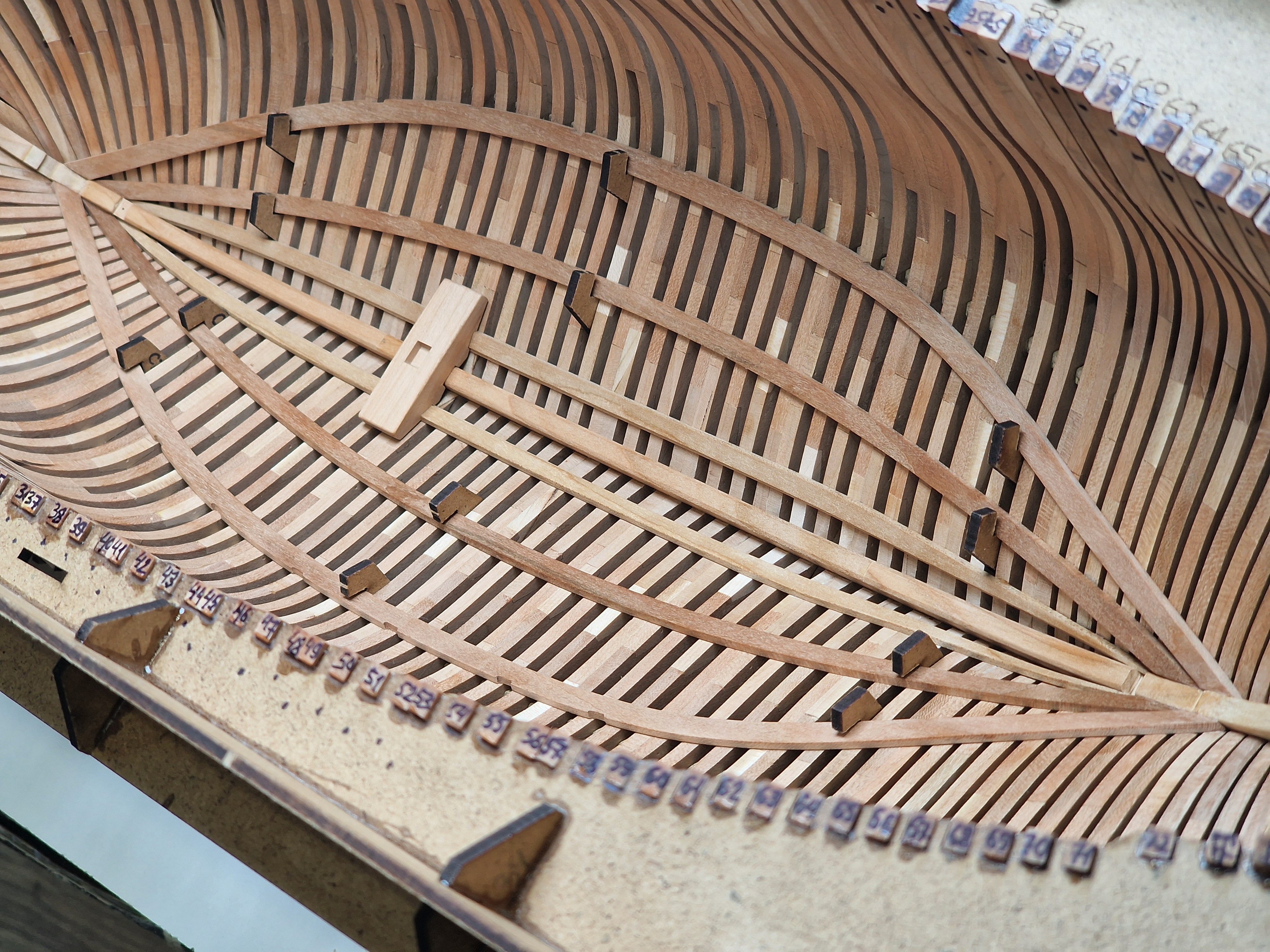

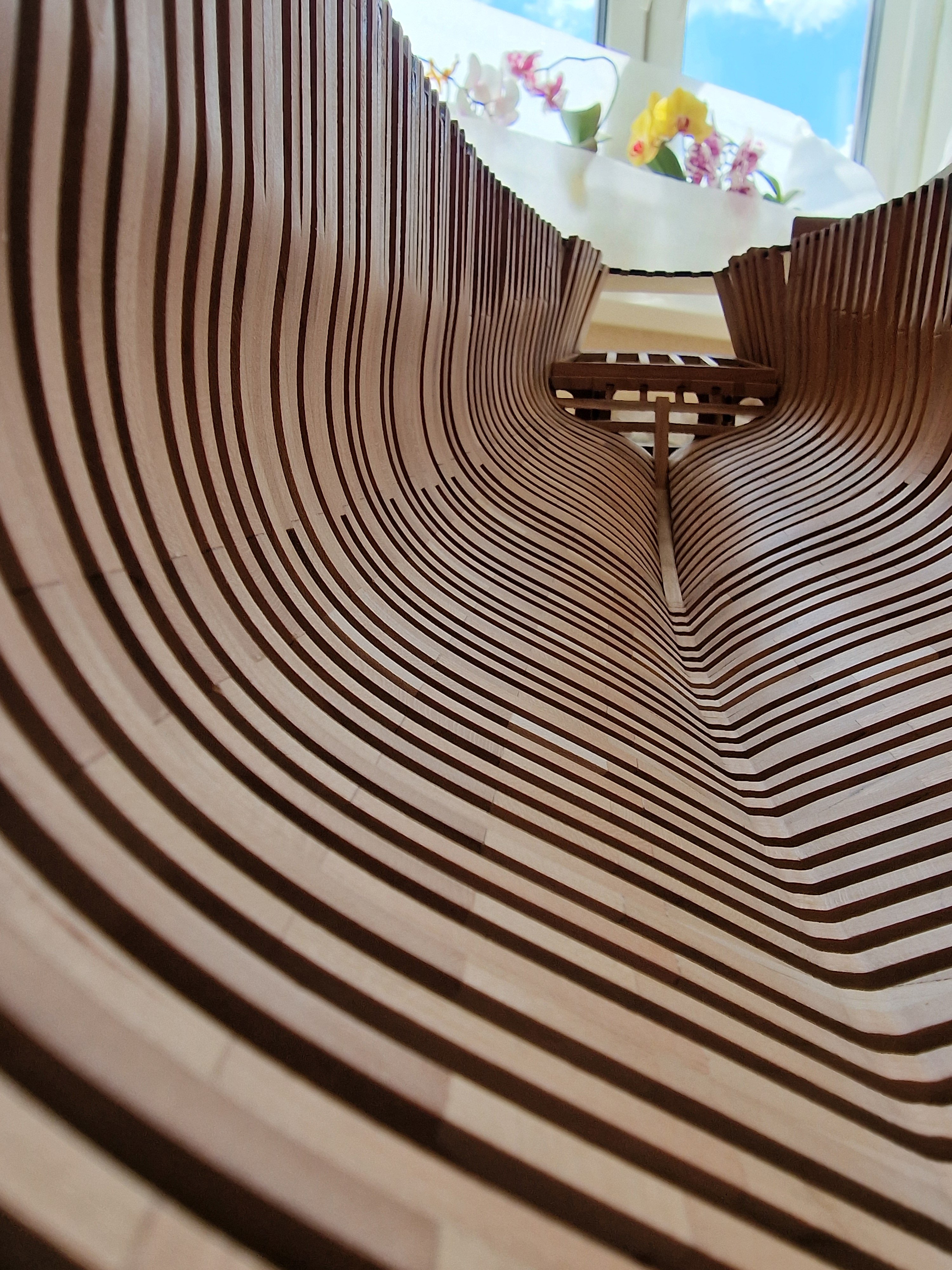

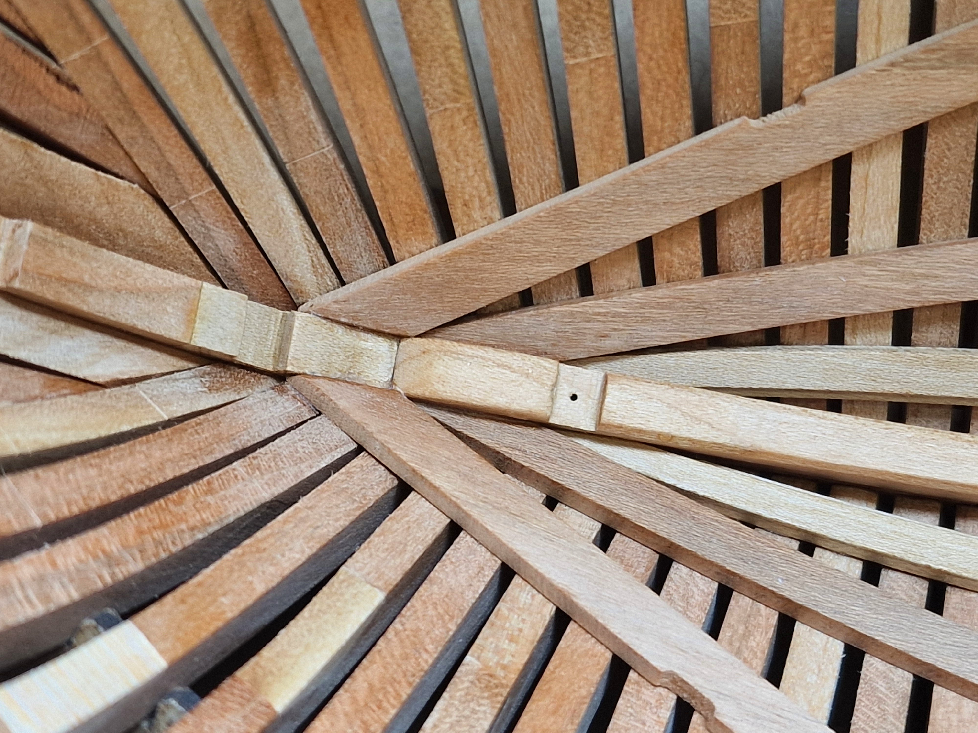

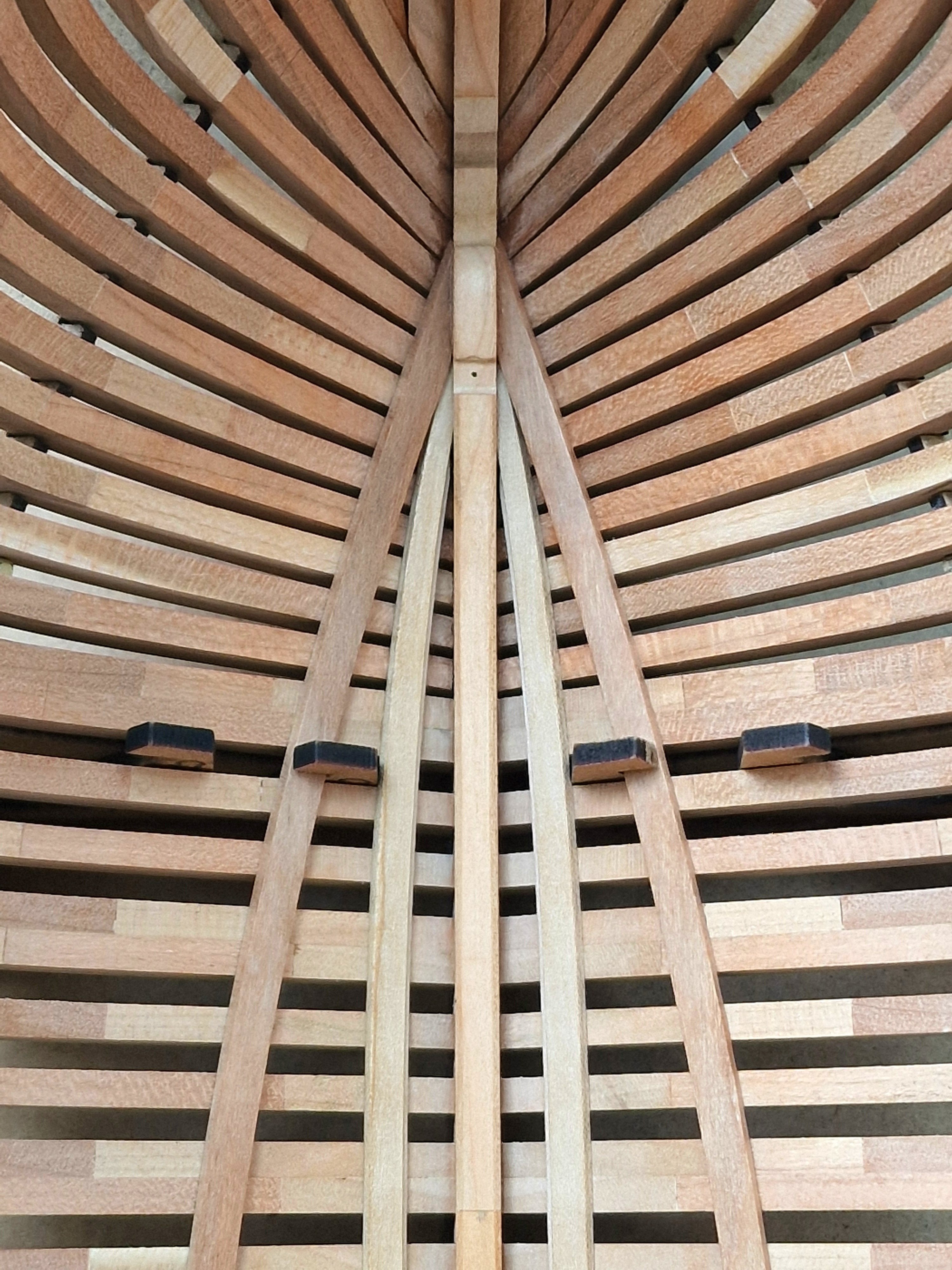

Inner planking and keelson.
Before the hull is ready, these parts need to be installed.
First I prepared the place for the keelson and gave it the correct shape, and also made the mast step.

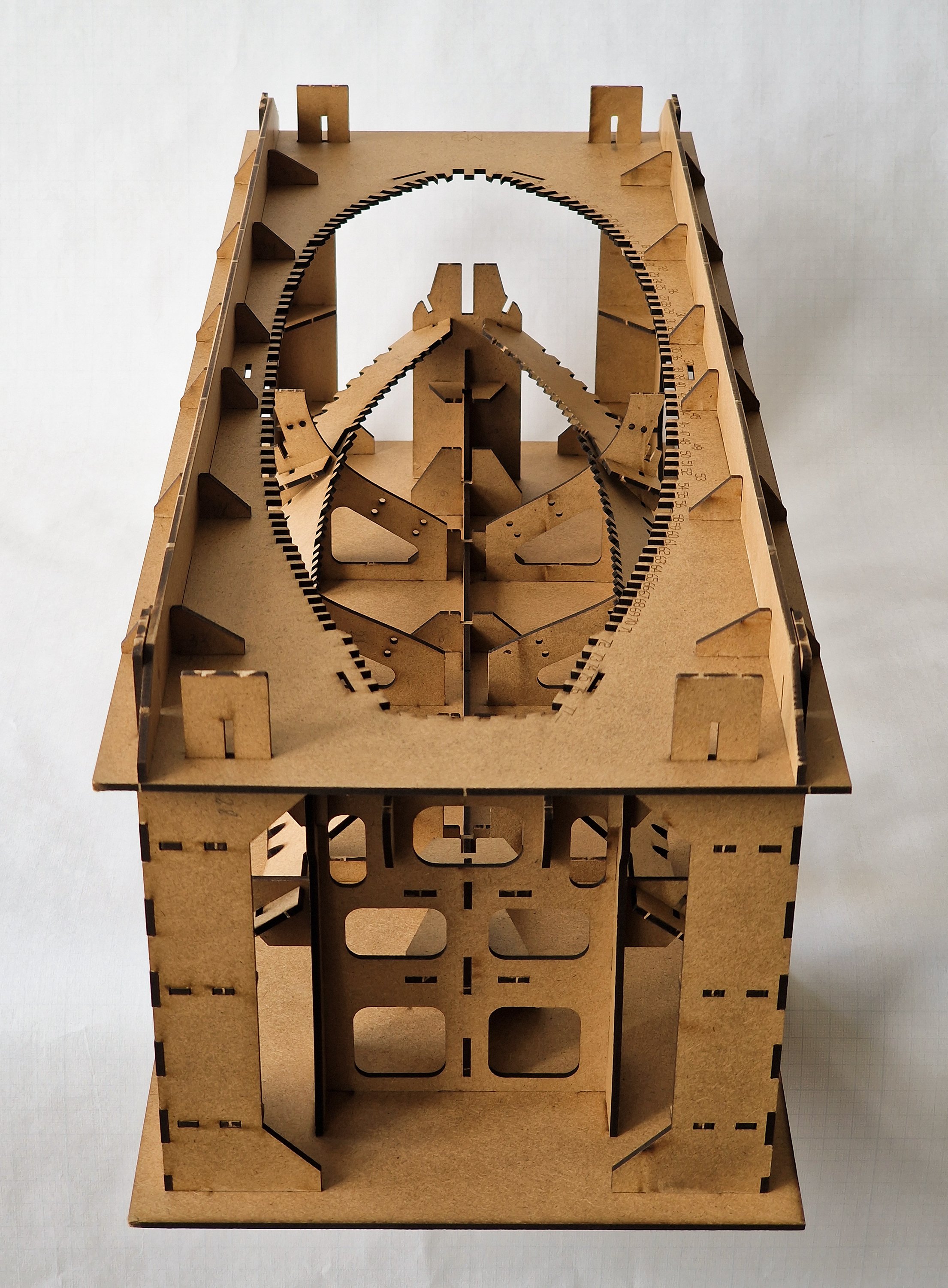

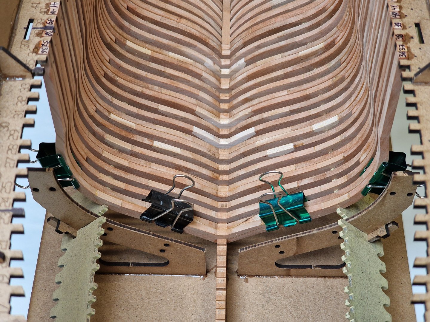

After installing additional fixing equipment on the slipway...
…I glued several reinforcing planks. 1/3
Edited by serikoff

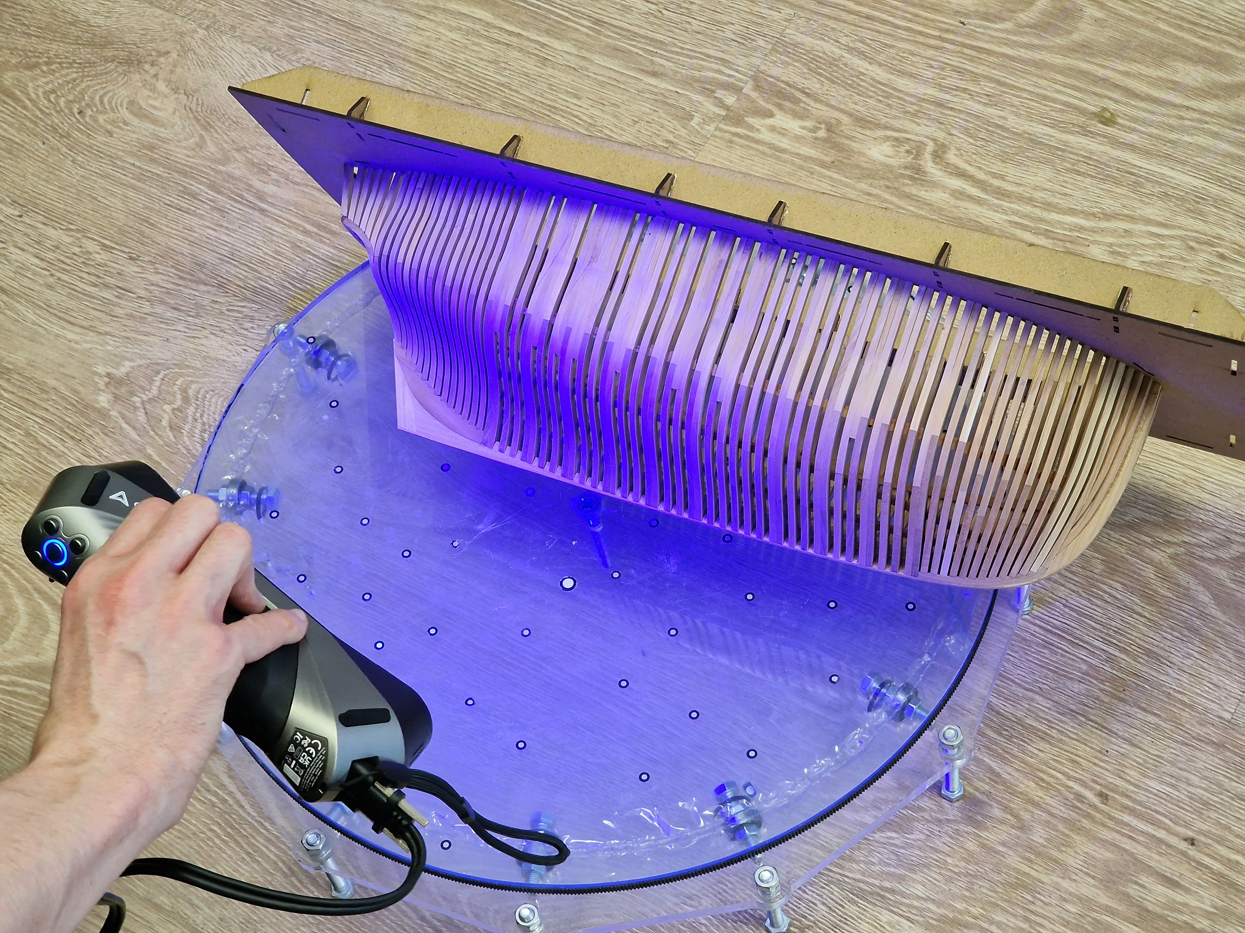

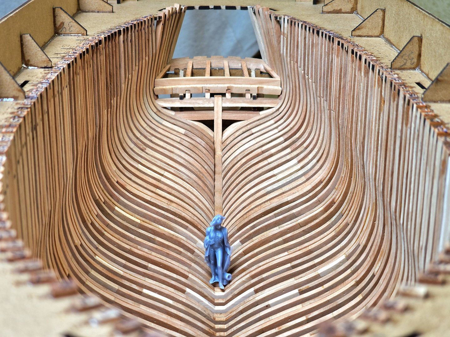

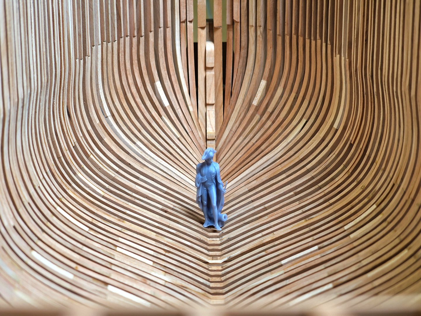

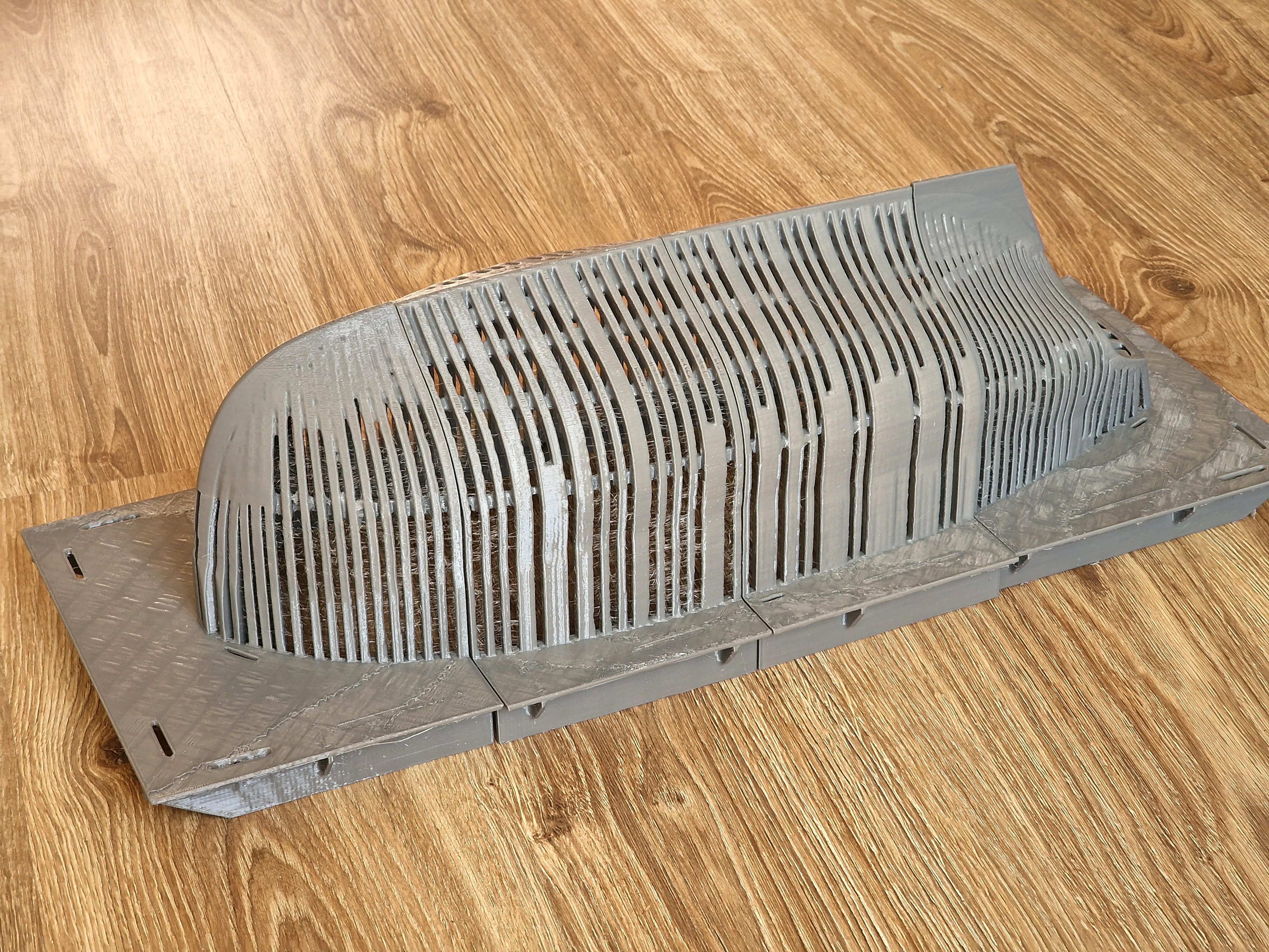

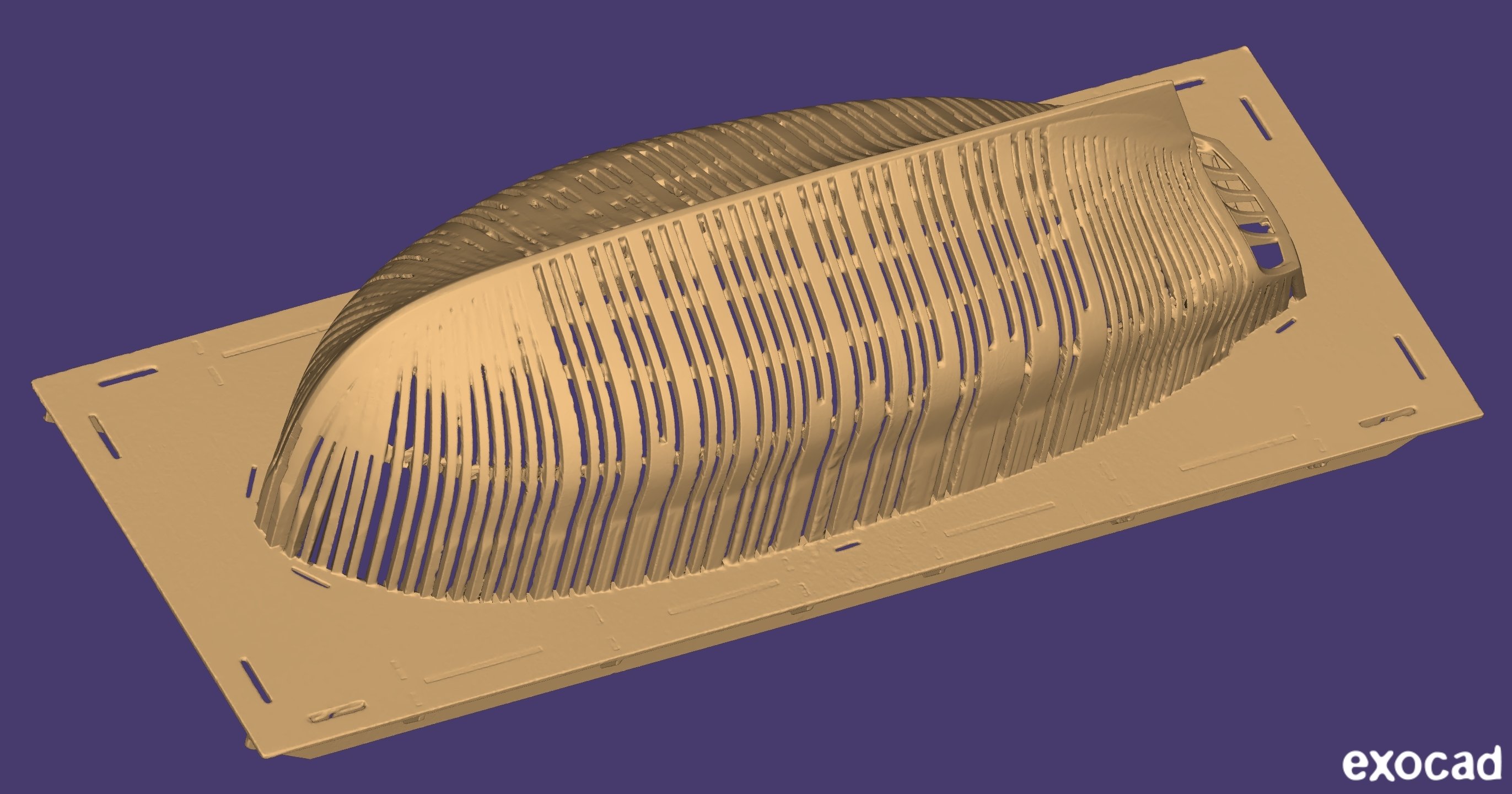

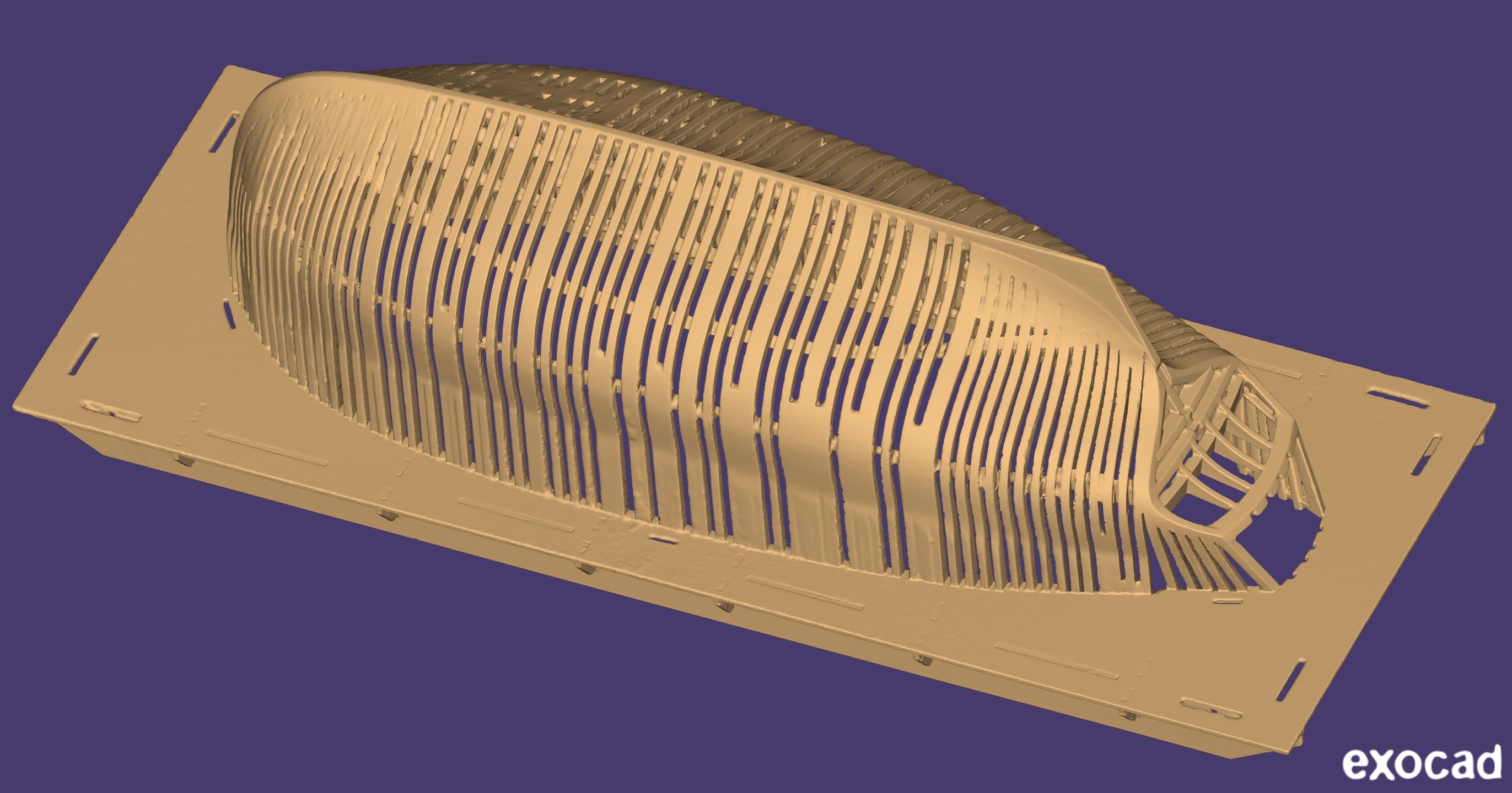

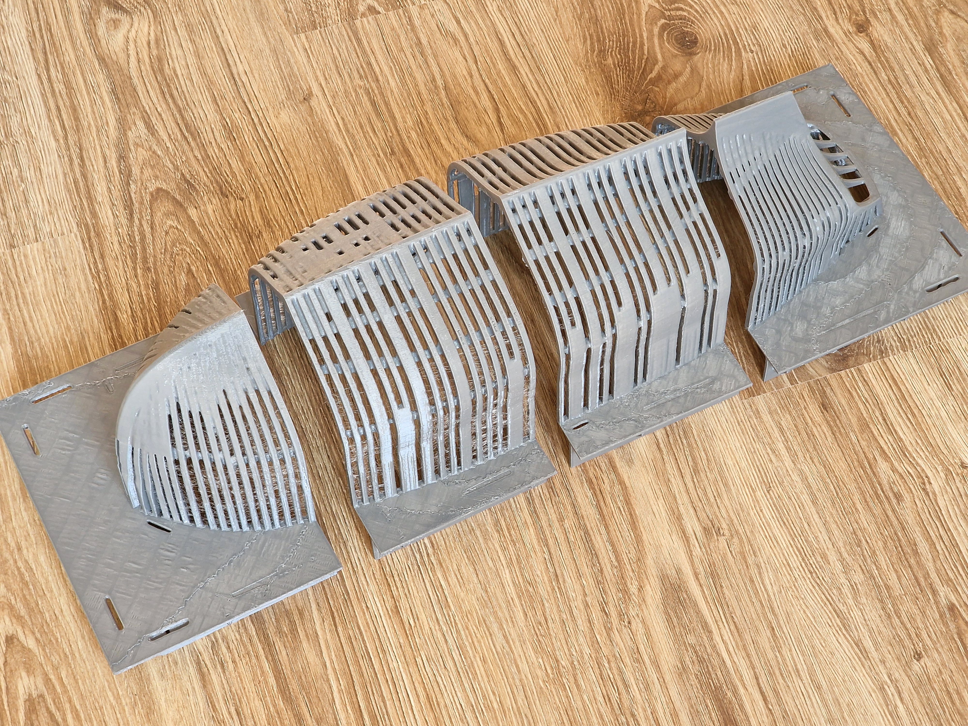

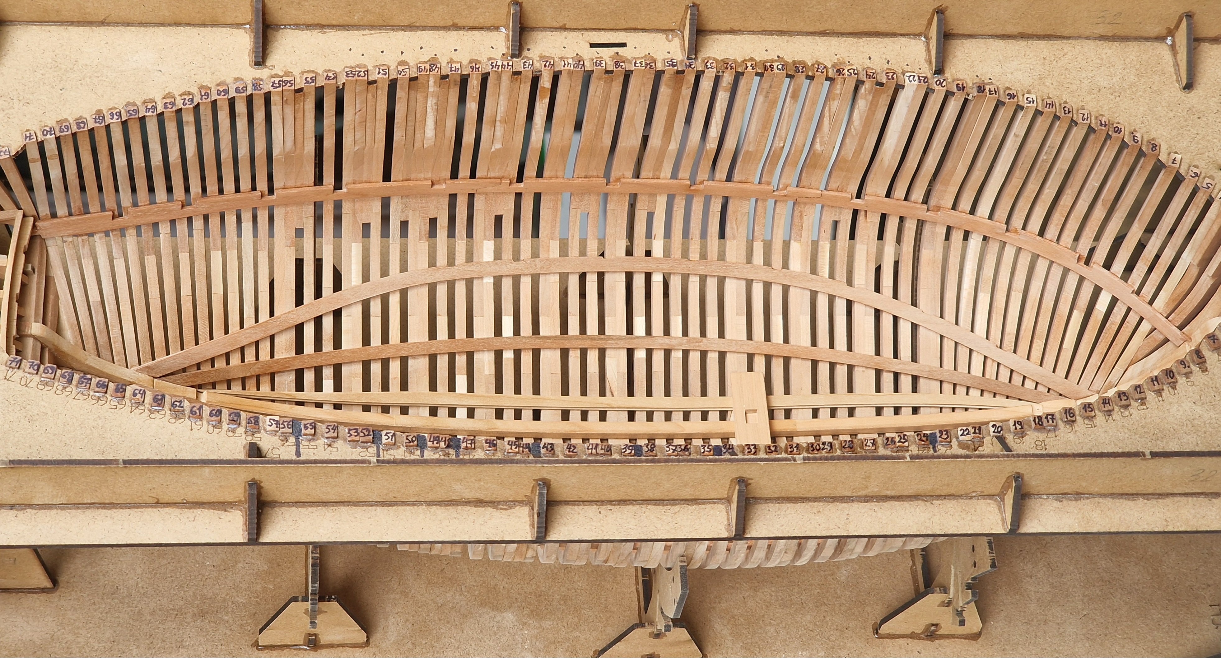

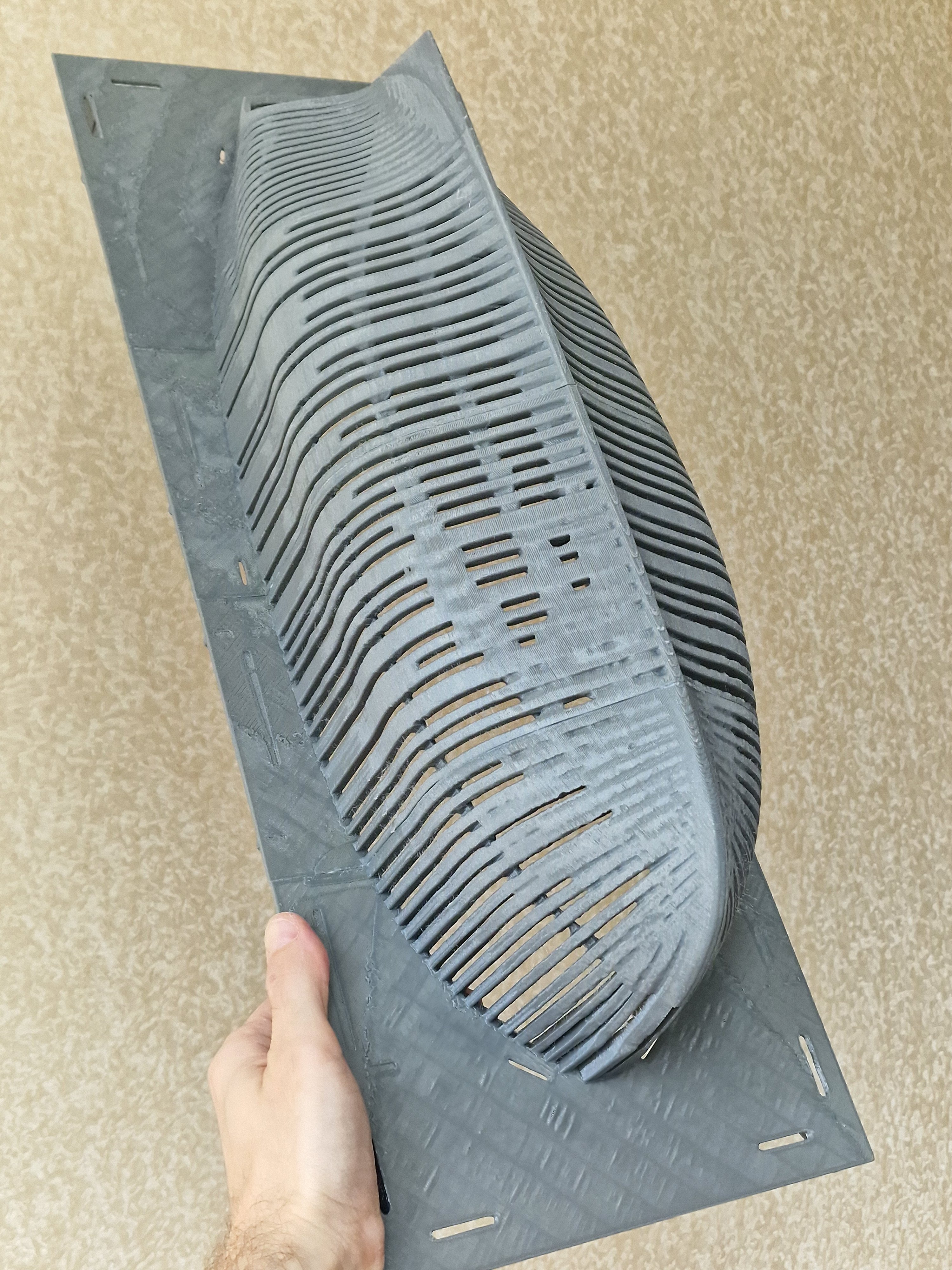

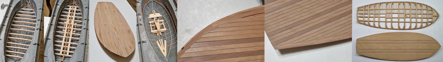

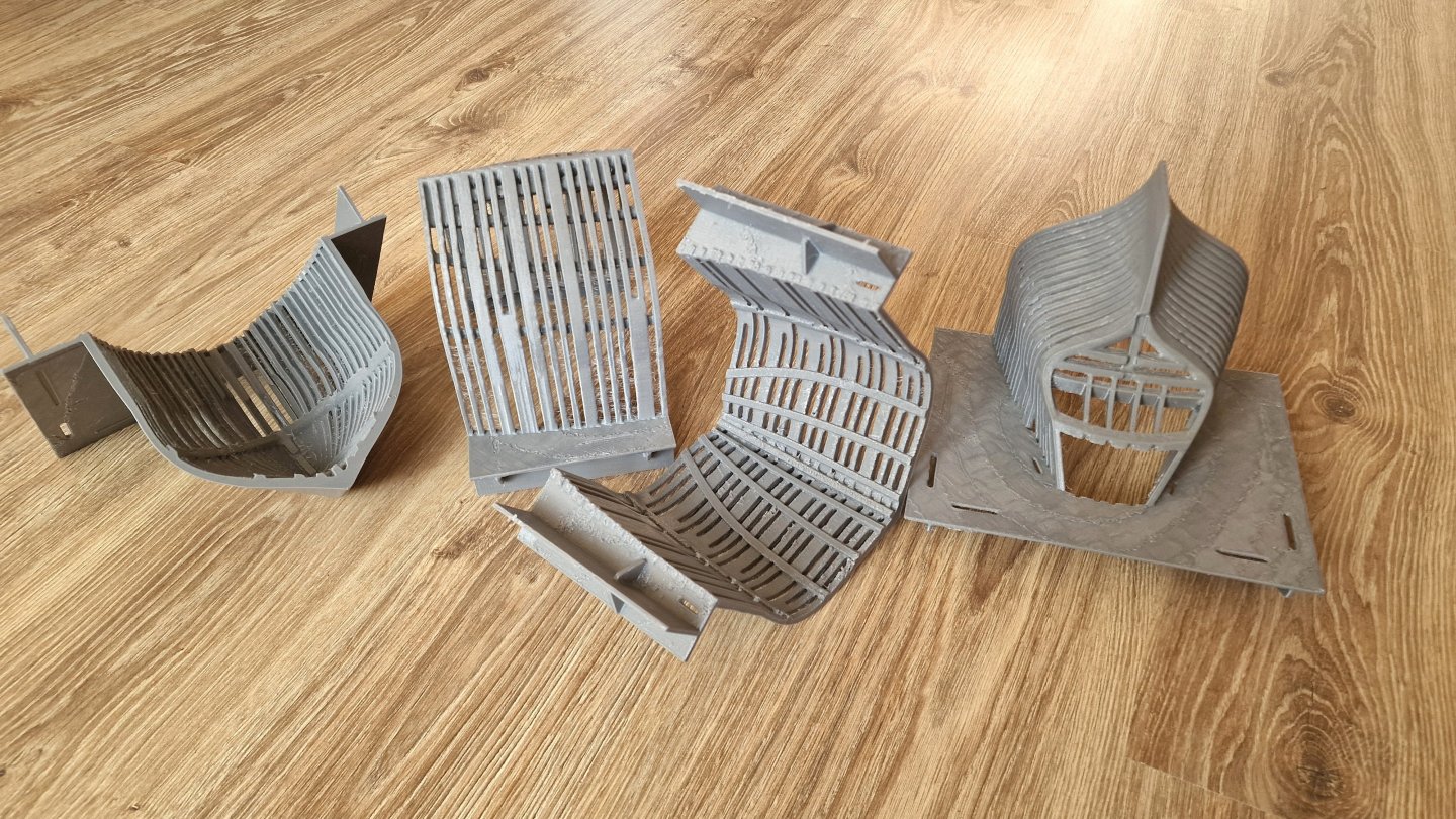

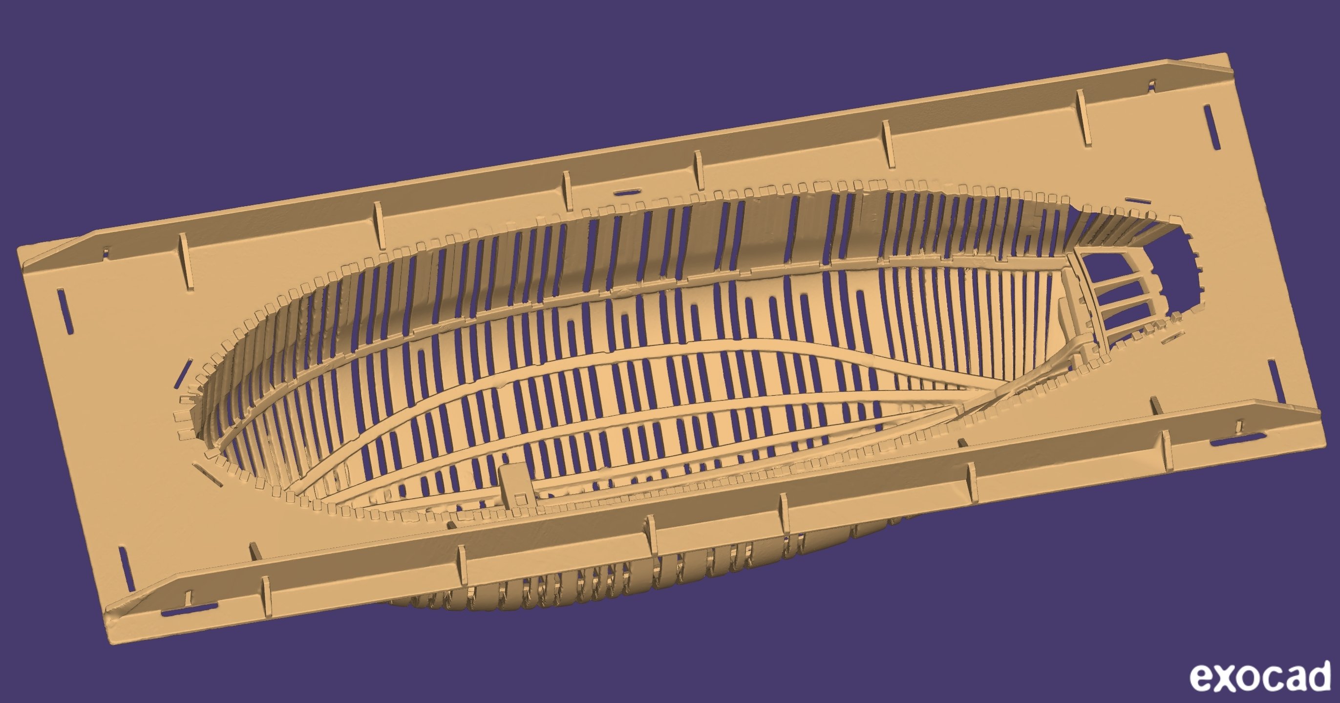

After sanding, everything is now ready to scan the hull.

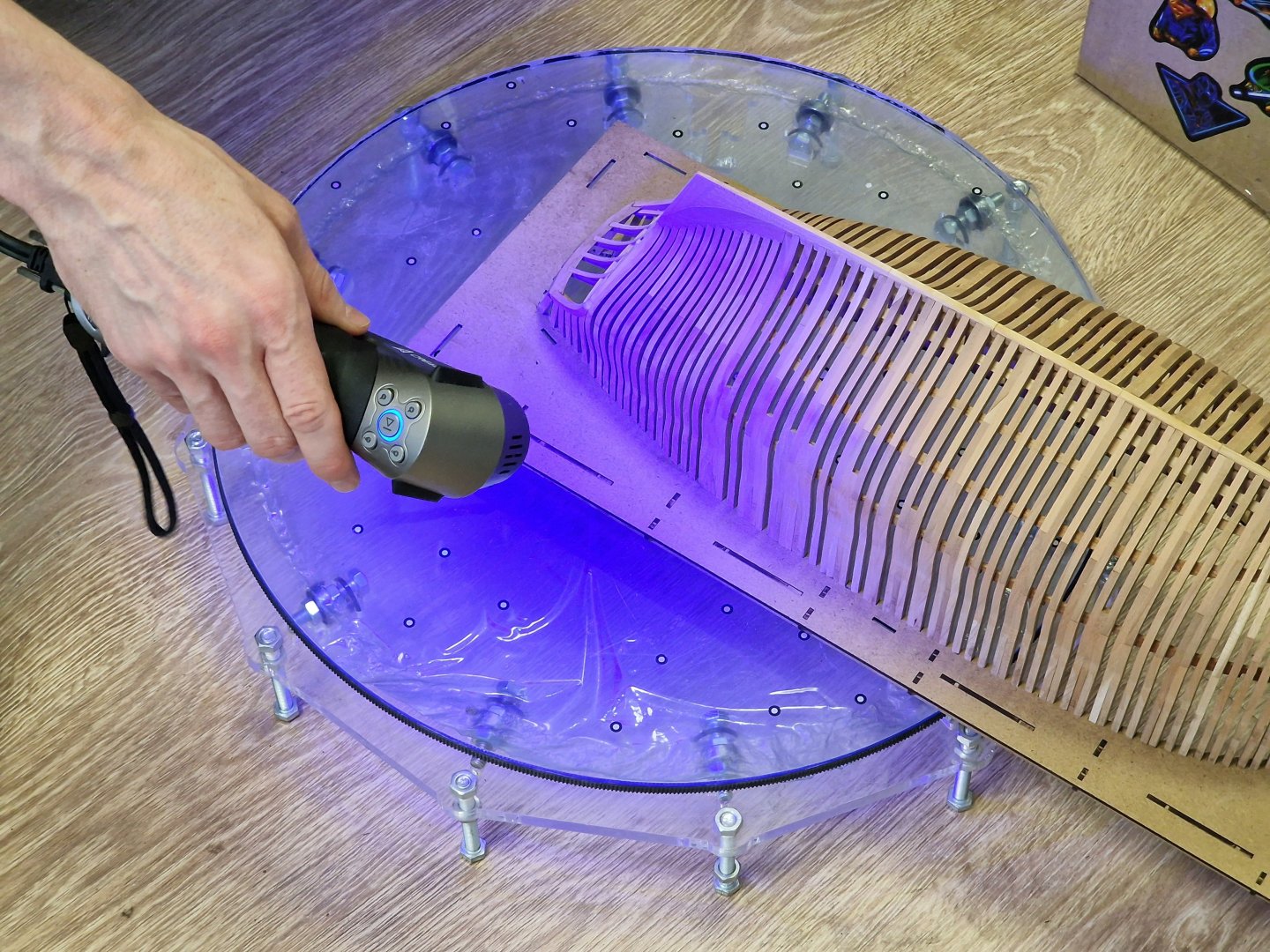

Then it was necessary to refine the STL file and everything was ready for printing.
And after 3D printing, I got a second hull, exactly the same as the first, but made of plastic.
This concludes the first chapter.
