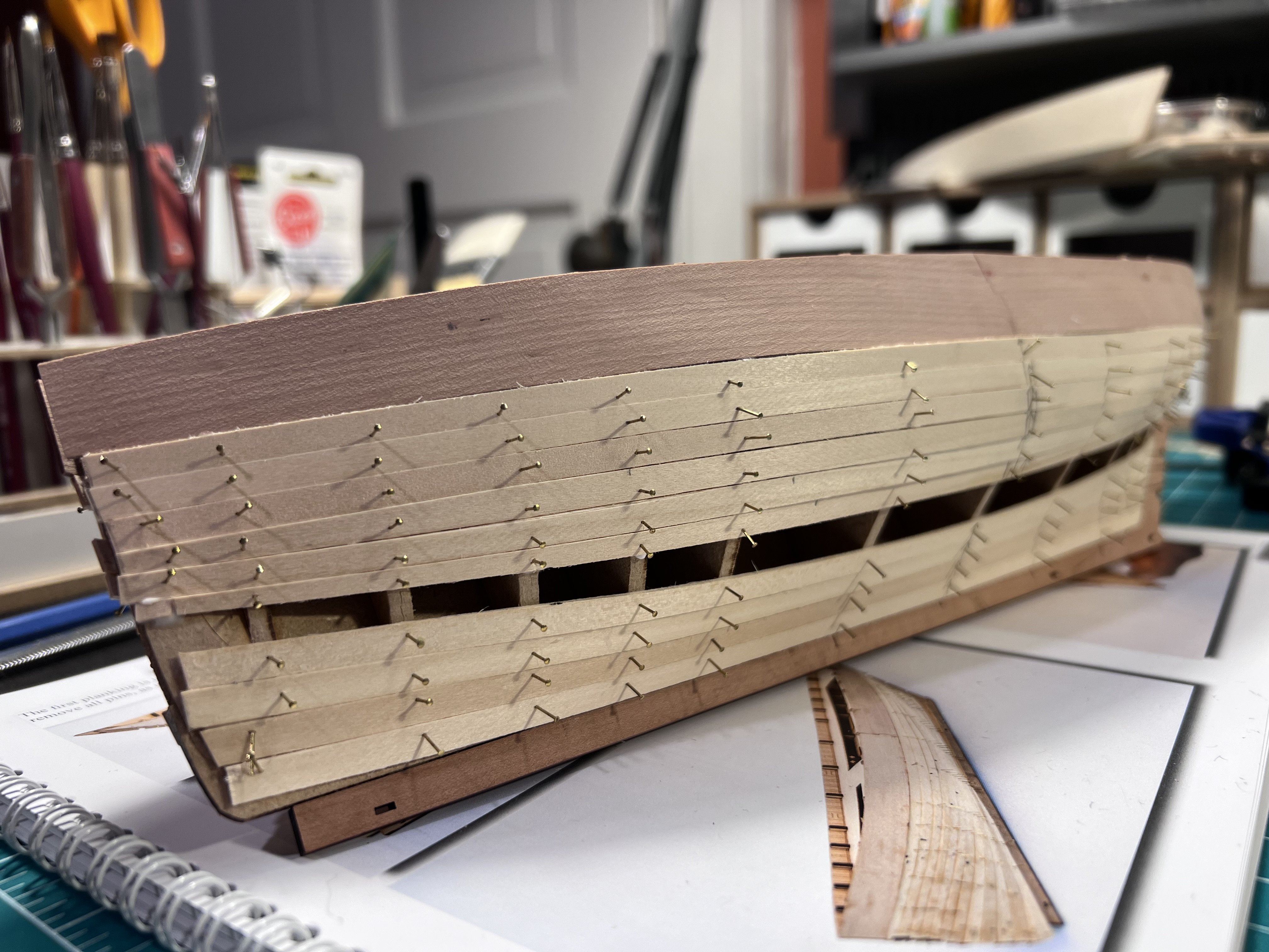

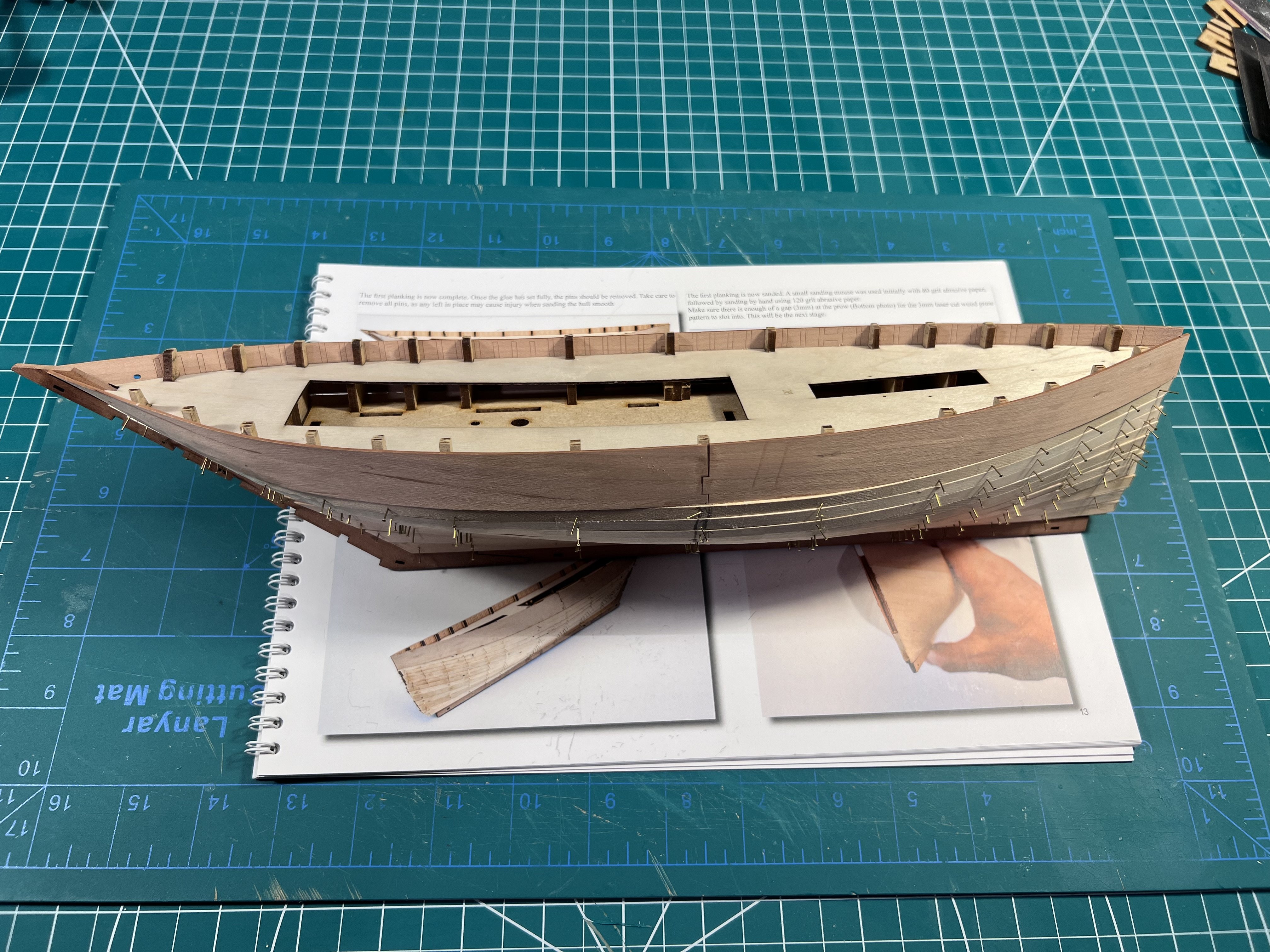

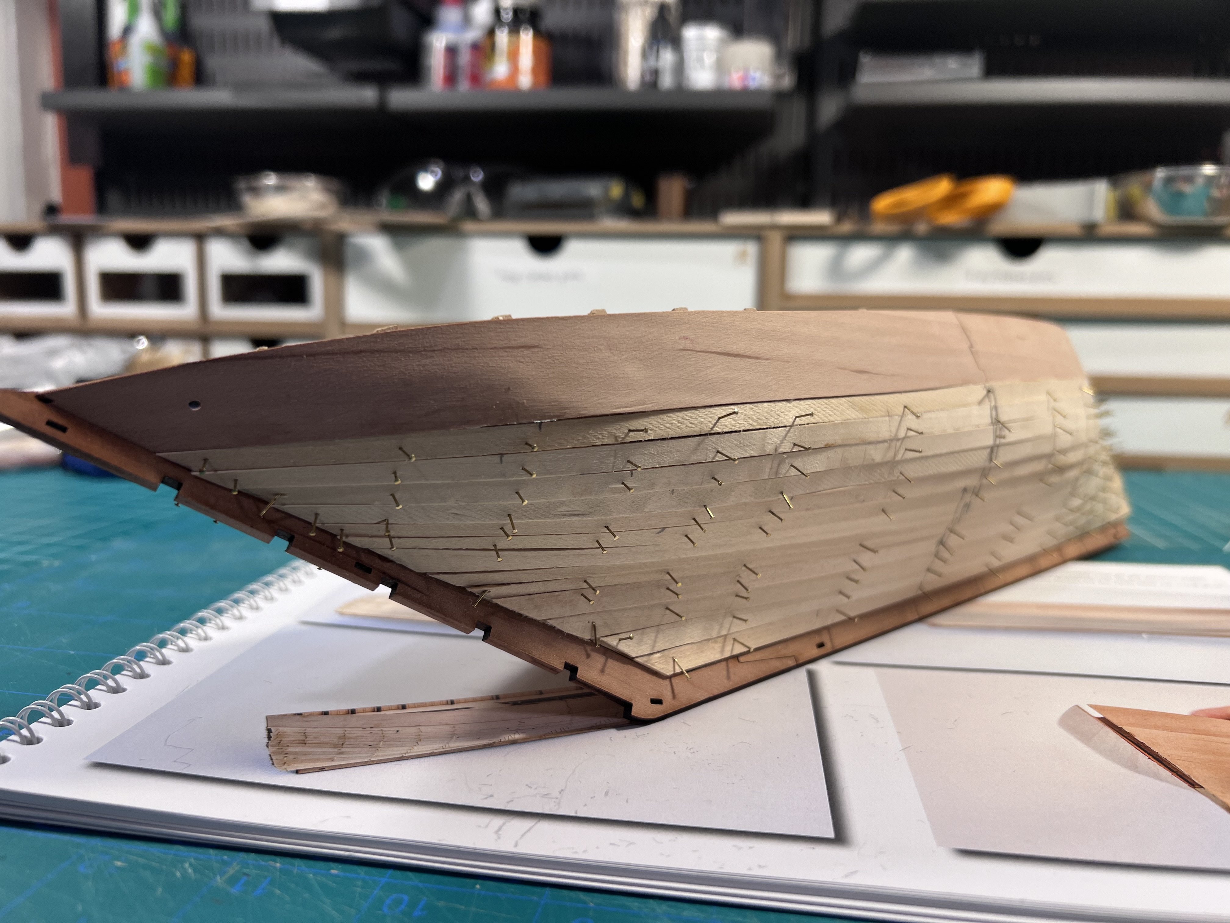

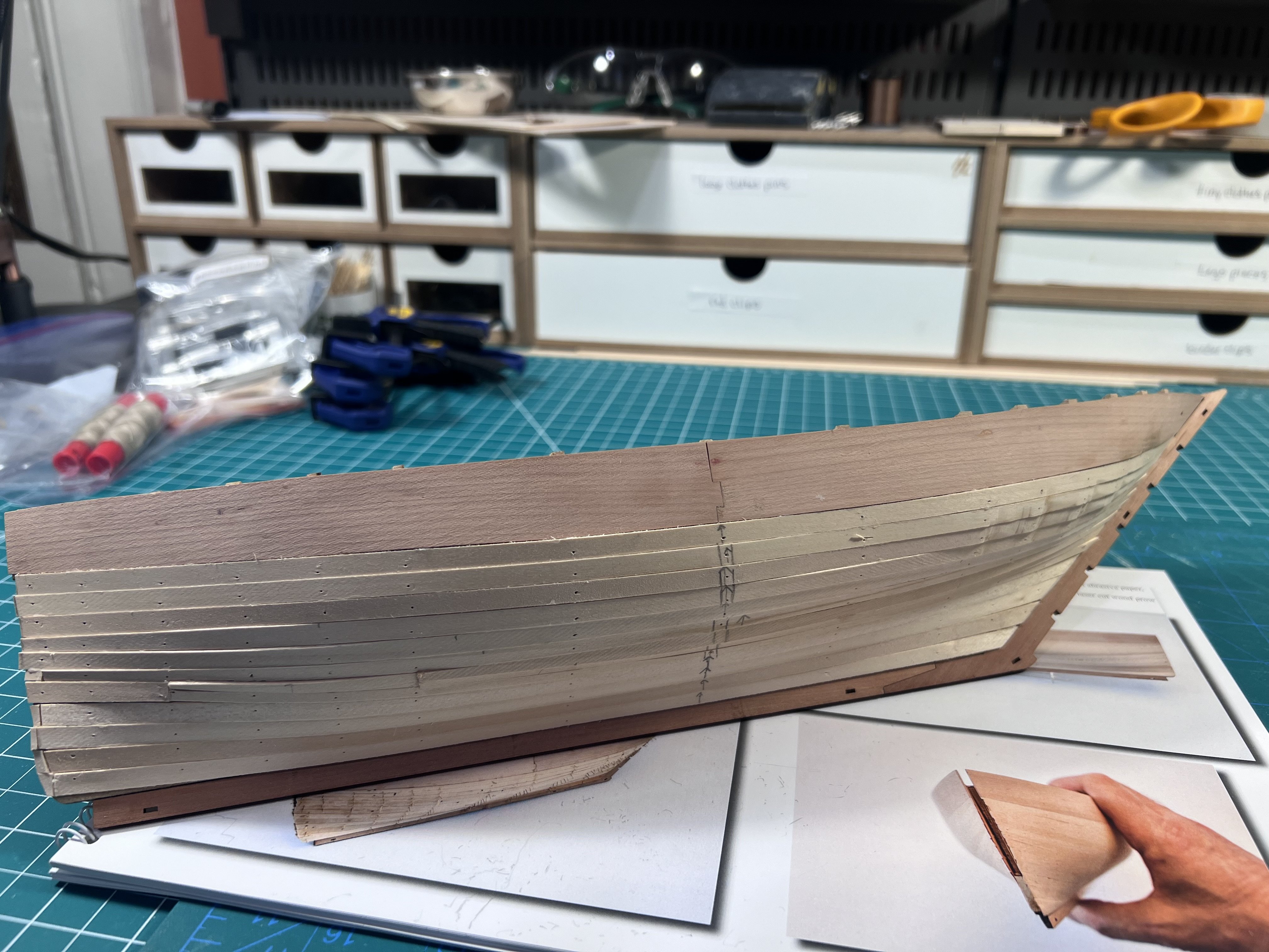

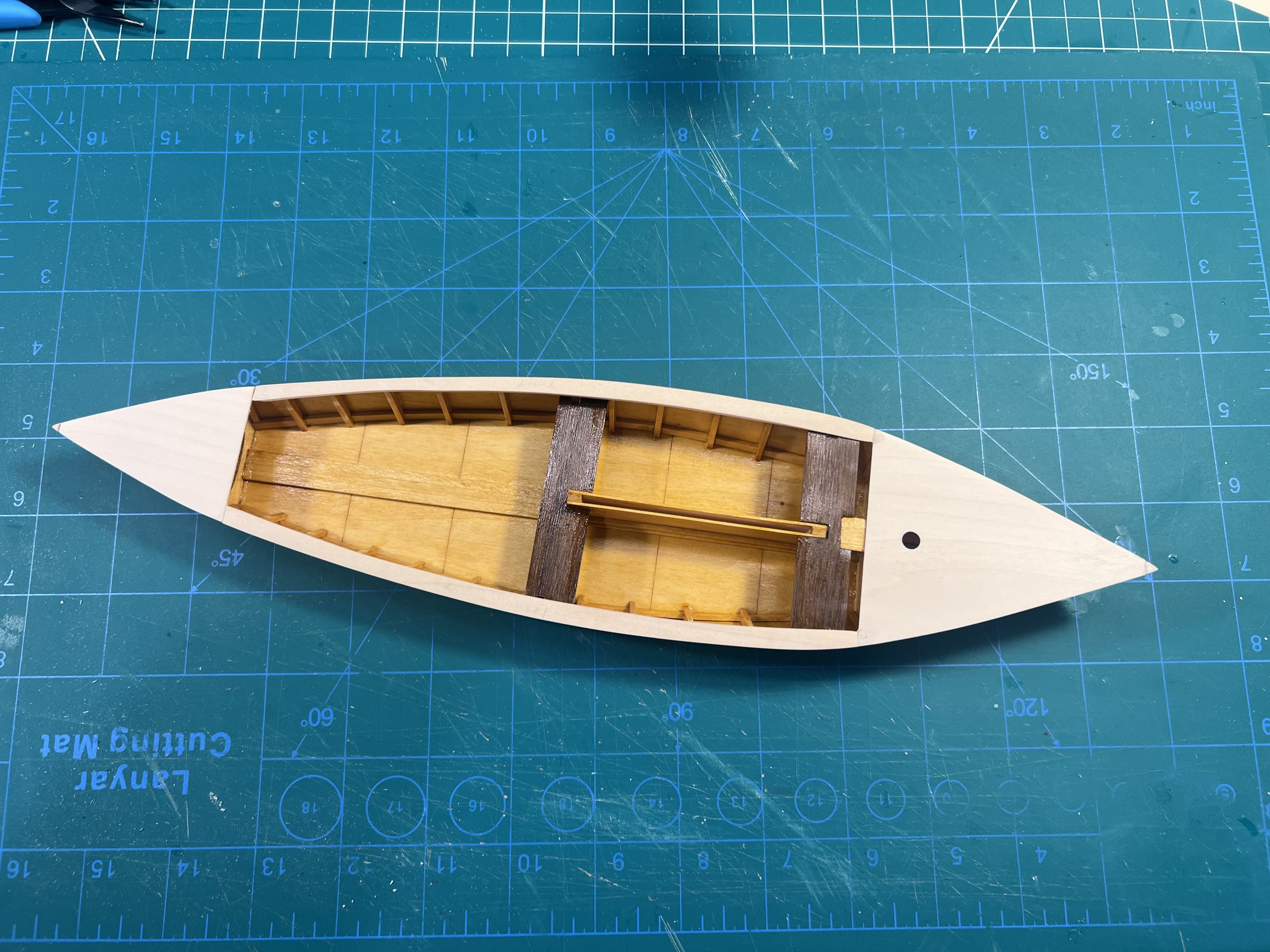

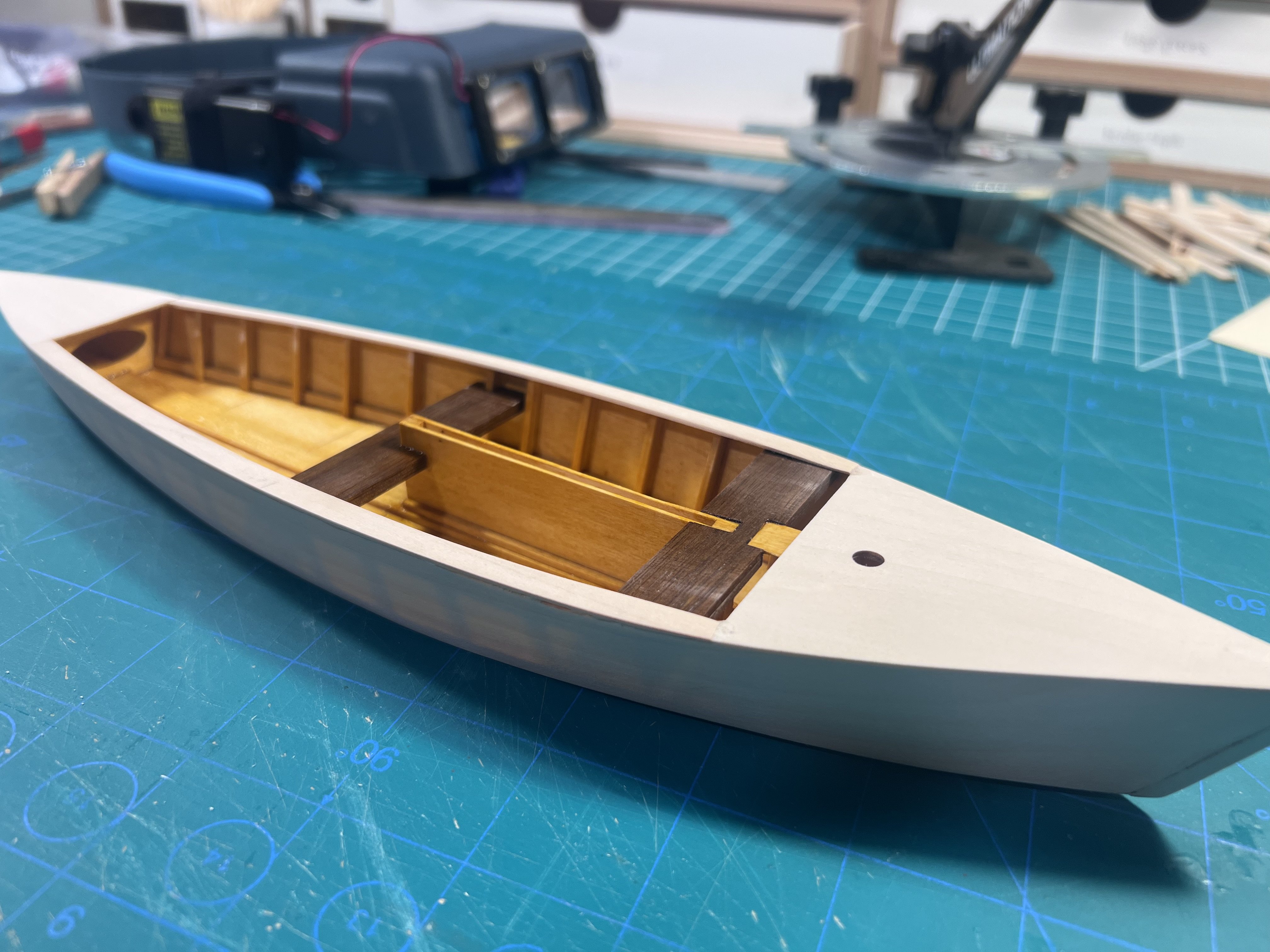

The shape of this hull continues to confuse me. The end shown in the photo above is the front and the heavily angled end on the other side is the rudder. When adding the lower planks, I forgot that and was thinking the end shown here was the rudder end and left some of the planks short since those usually end up being sanded down quite a bit. That's not the case here. I'll add some filler wood. Thankfully this is just the first planking.
The instructions don't mention anything about doing any edge bending (really any bending whatsoever). In some ways it's not needed since this hull is small and straight. And since this is the first planking, any clinkering can be sanded out. The instructions in fact point out some clinkering in the photos and say not to worry about it - they'll be sanded. I did end up doing some edge bending on a couple of planks. I'm definitely going to do edge bending on the second planking.
On the second planking, I'm also going to try to do some planning of the planking. I'm going to try - no guarantees - to be able to leave the upper part of the planking unpainted (if I'm unhappy with it I'll paint it). So I want the planking to look the best I can.

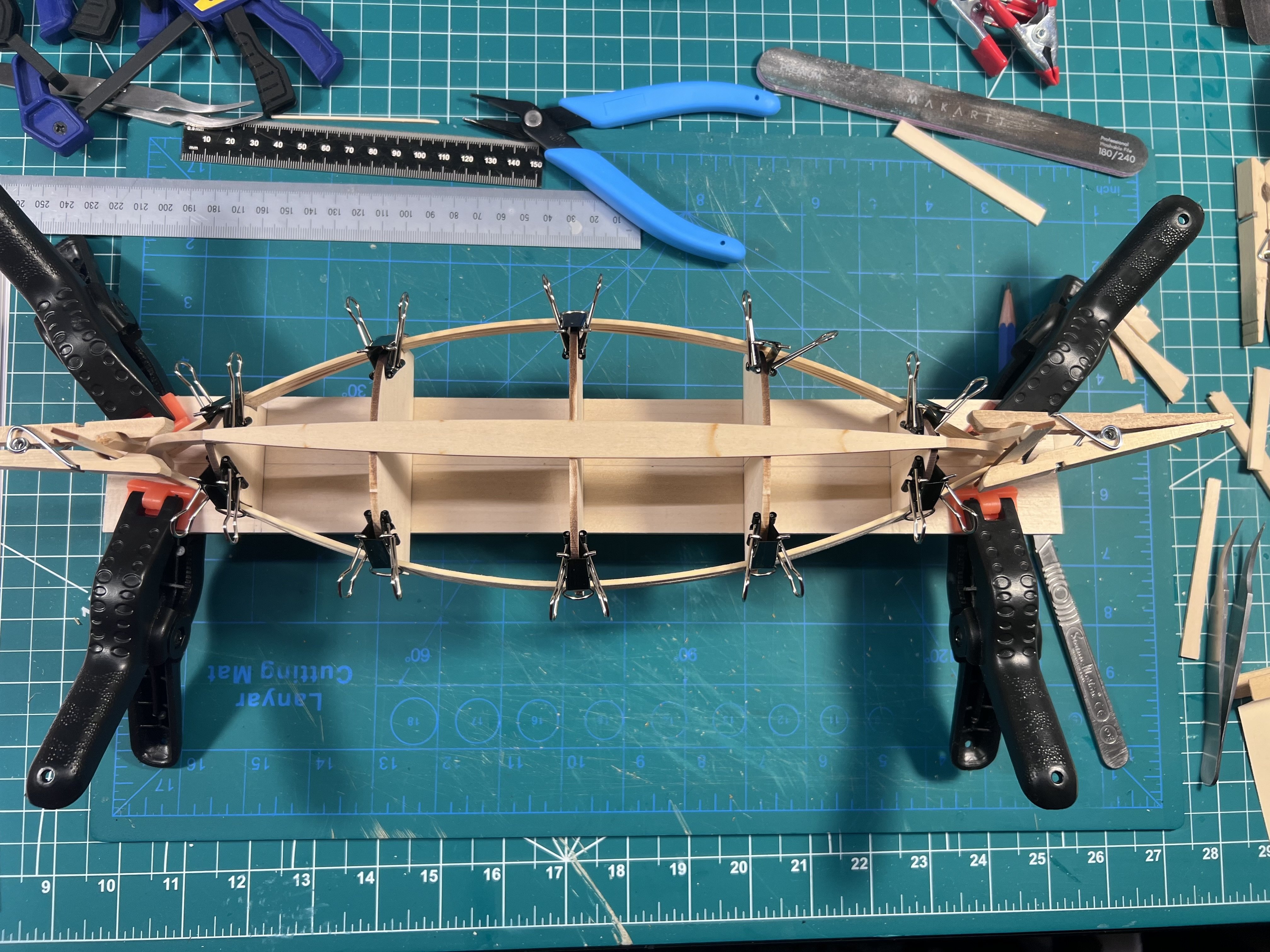

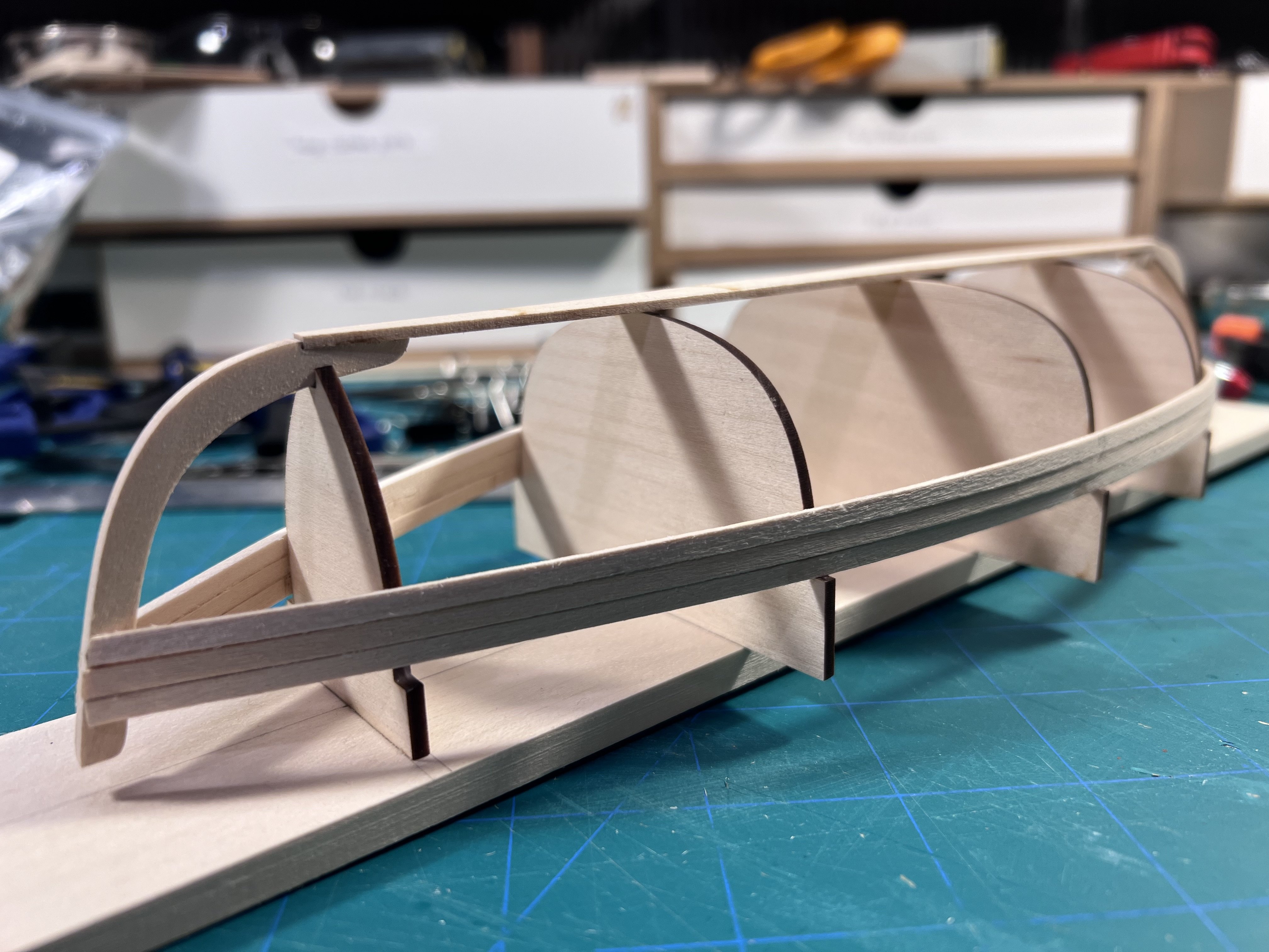

Lego blocks work great - they can be clamped or rubber banded down, or even glued.
You can put a few dabs of glue - more and it’ll be a pain to free the build frames from the build board. Look ahead in the instructions to see how you free in later - it’s good in general to look ahead in the instructions.
And definitely start by posting questions to your own build log.

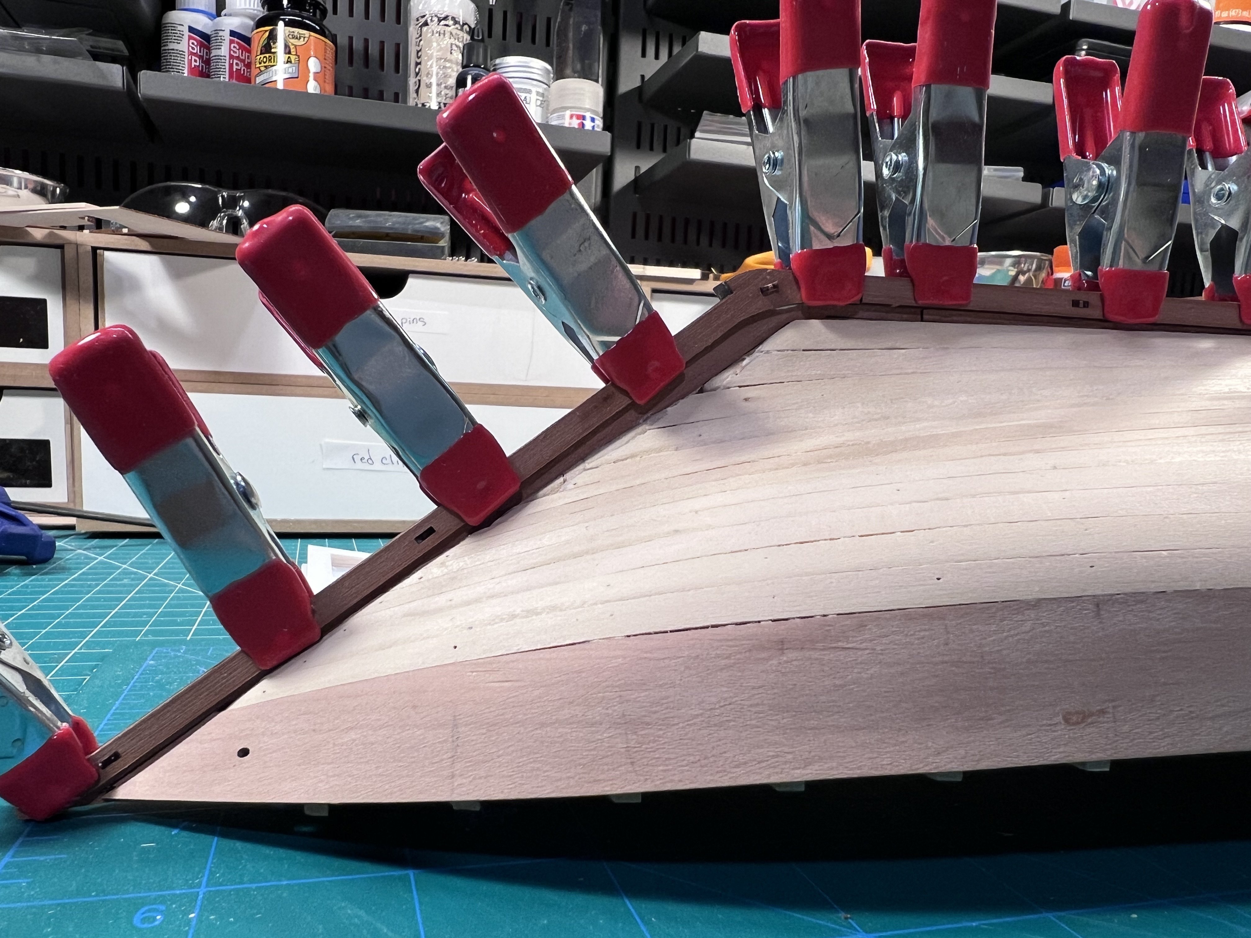

On your first post, you can edit it and add "tags" such as "muscongus bay lobster smack" and "midwest products" since they help people in the future working on this model find your build log. I use that feature all the time when working on a model to quickly pull up other logs when I hit a snag. There is also a "model shipways" version of the smack (I built that one). It's similar - and the end result looks similar - but it is a different model. If you poke around on other build logs just make not if you're looking at the midwest for model shipways versions.
Someone else might also suggest (or even just edit) your post to add "- First Build" on the end of your title. I think some people are sometimes more likely to pop in when they see a "- First Build" in the title of a log to see if they can chime in, even if they have not built that particular model themselves.
Did you see that Olha Batchvarov did a build of this on her YouTube channel? It's recordings of a live build (she does on Sat and Sun mornings). I think she finished this one back in April or May, it started last January. It's step by step, with each recording for about two hours, and she tries to go beyond to make a really nice version of the model. I've learned a lot watching (also listening) to her video series:
Something I've been learning (slowly) is that there are really no shortcuts to planking and having it look great (even if you get more efficient at doing it). In reading build logs and seeing videos, you get a real sense of how long it takes to do it right, which includes not being afraid to do something over. Better to eliminate the small gaps by redoing (or avoiding them, being patient, measuring, adjusting, measuring, adjusting) than to assume you'll just fill them with wood filler later.

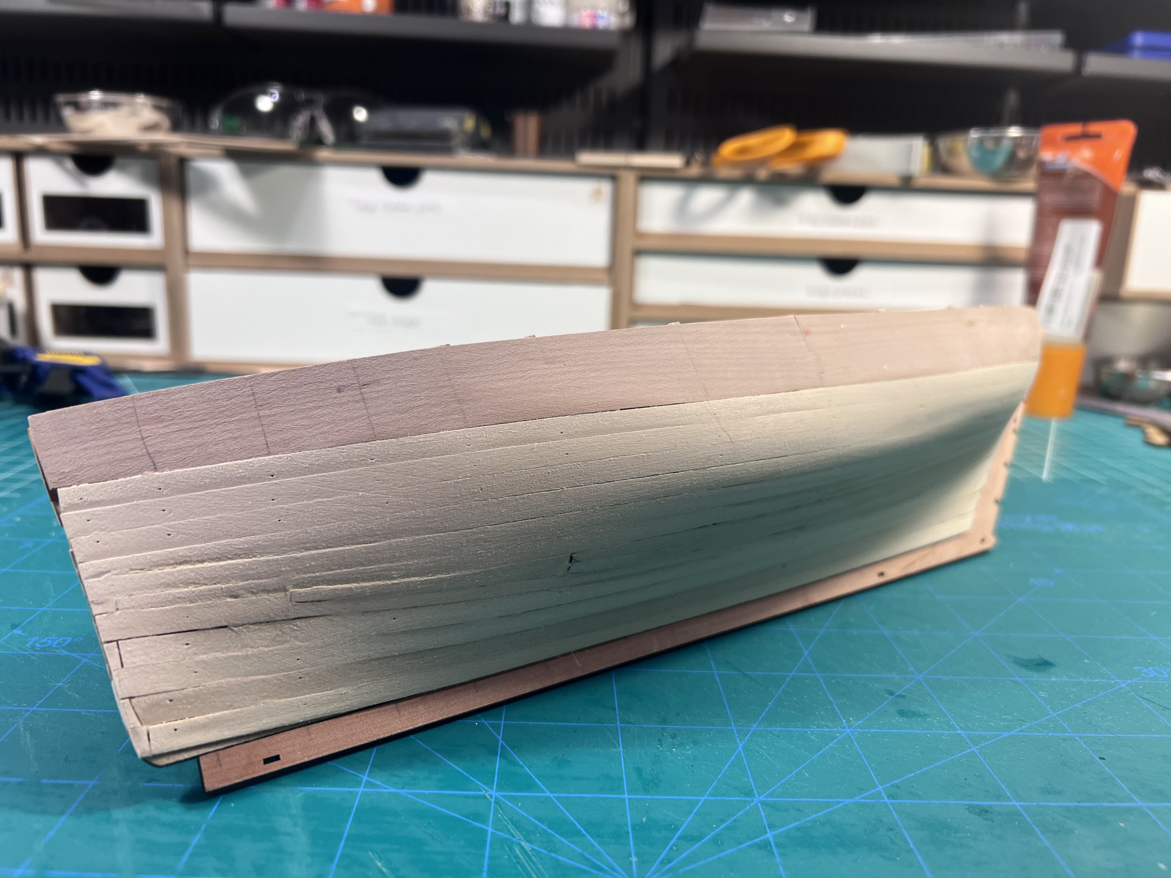

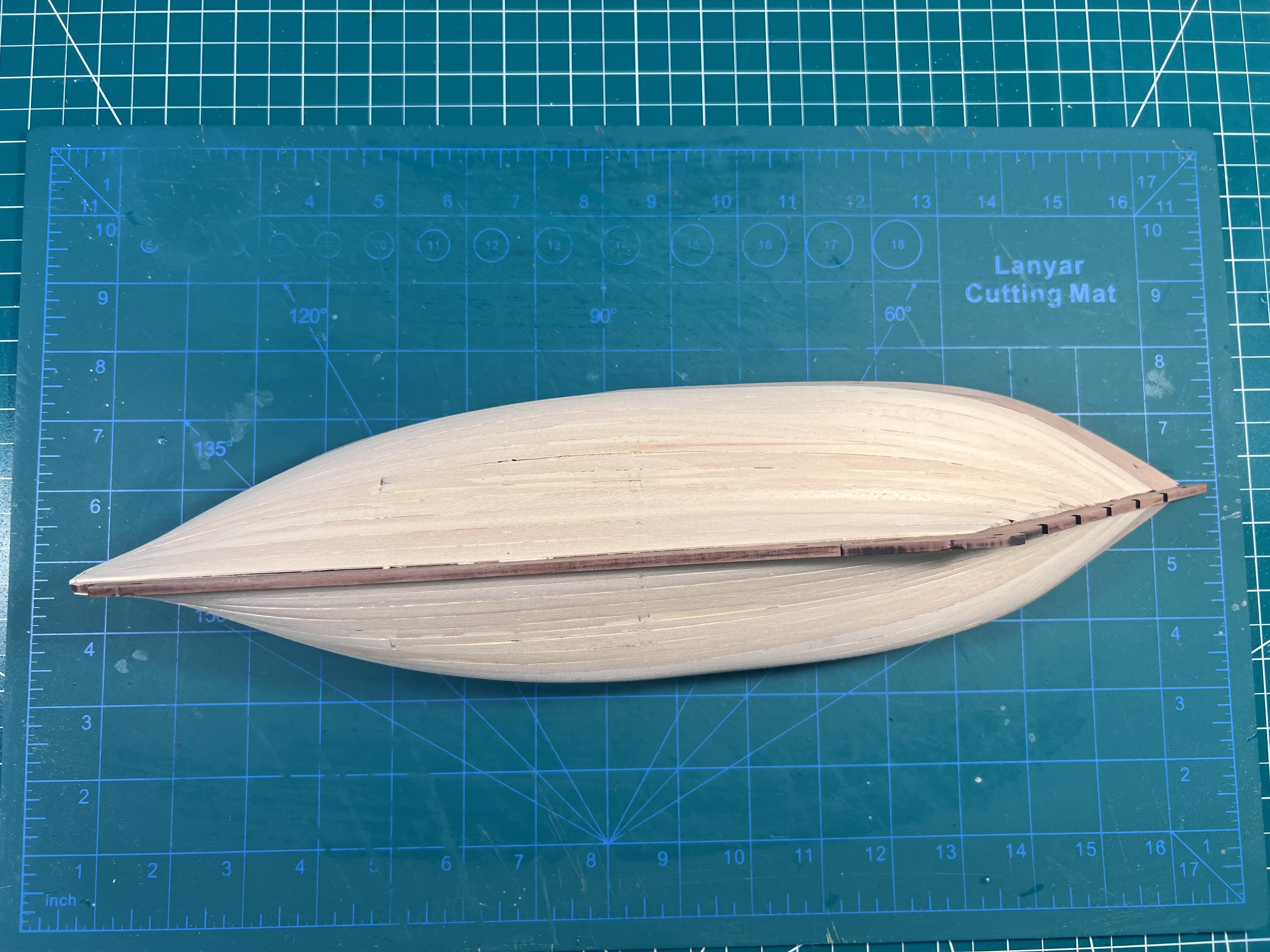

3 hours ago, Nightdive said:
but some of the gaps seem a bit large.
Sometimes - in my very limited experience - gaps only pop visually after a first coat of primer (I think some of the Vanguard instructions actually note that too, if not in the Sherbourne, then in the Ranger instructions). I'd try to fill and sand large gaps. I could be wrong, but the goal isn't to make it seem like a smooth fiberglass hull, because it's fine for some of the details of planking to show through the paint, but you also don't want large gaps - as you said. If you look at photos of real painted wooden ships, you can see the planking, but you don't see gaps or holes for obvious reasons.
If you use some really watered-down filler, it can get into some of the tiny pinholes you have, which would be the things I'd be most inclined to want to fill.
I first tried using a Minwax wood filler and it was way too grainy when watered down. Maybe fine for large-scale, but terrible for small scale. I found the Elmer's (water-based) wood glue to have a finer grain and it waters down a lot better. Would be interested to hear if other have different recommendations. You can apply it, let it get into the tiny holes and gaps, and just gently wipe the surface.
(You can also get yourself into a death spiral of adding filler, sanding, adding filler, sanding. Don't ask how I know.)

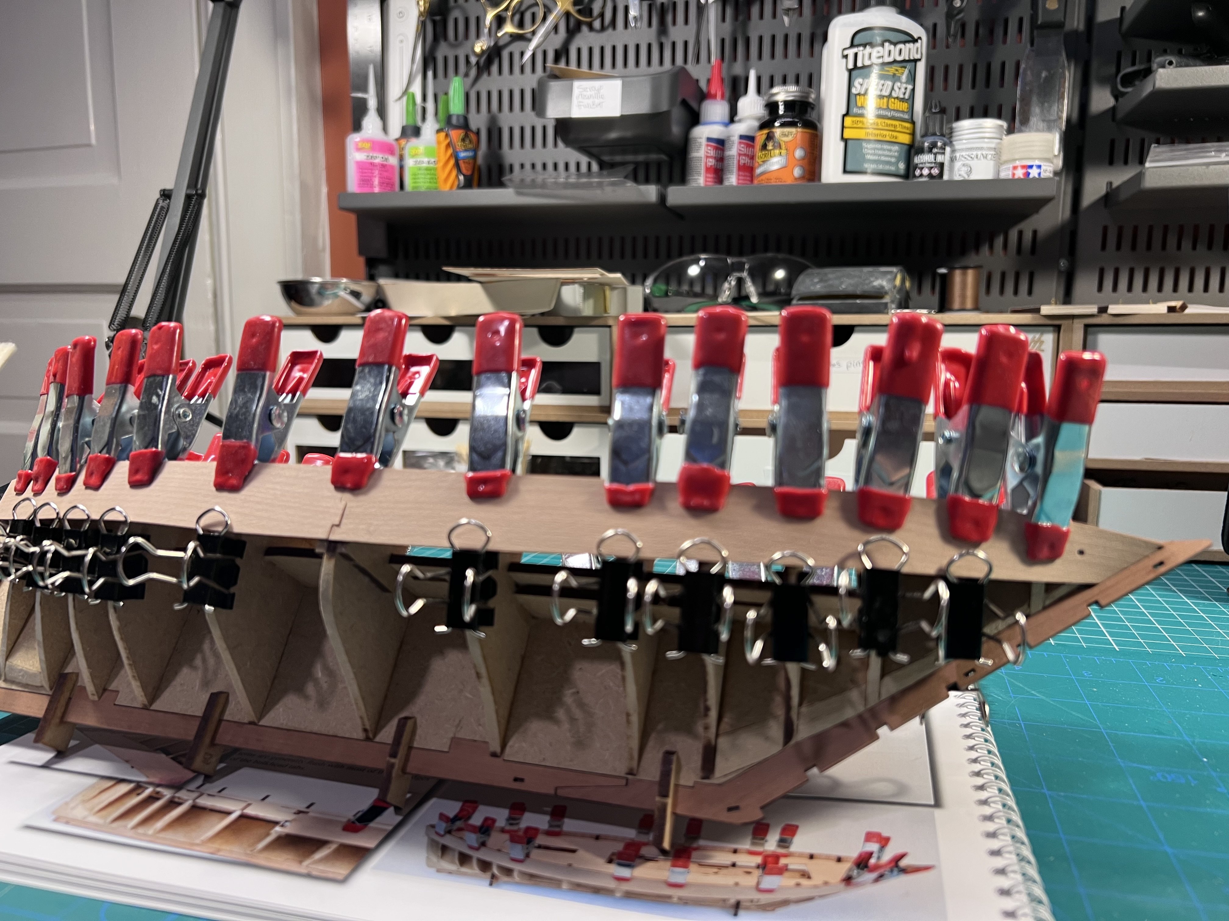

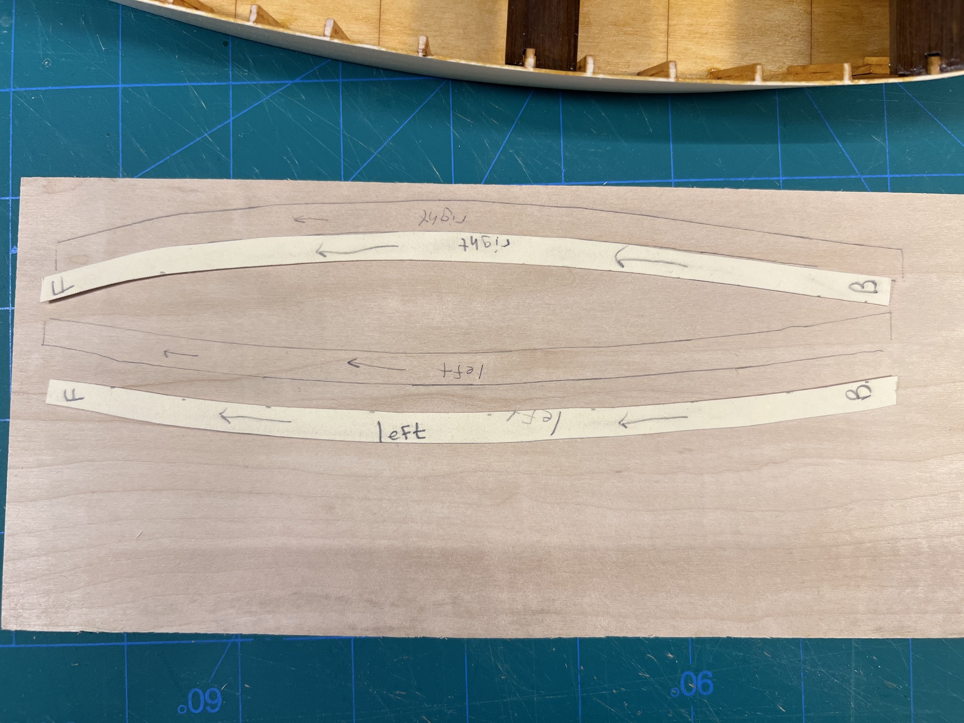

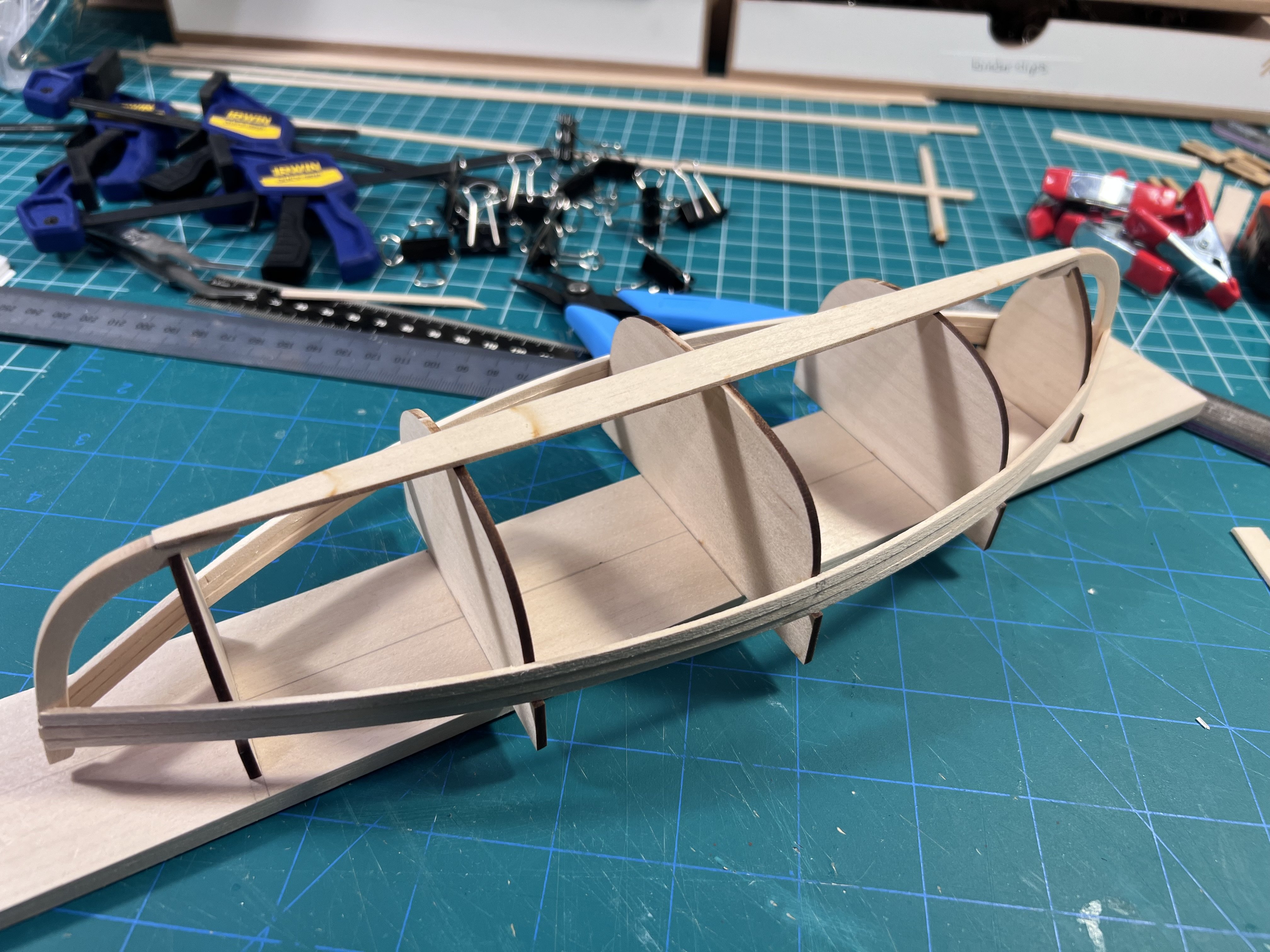

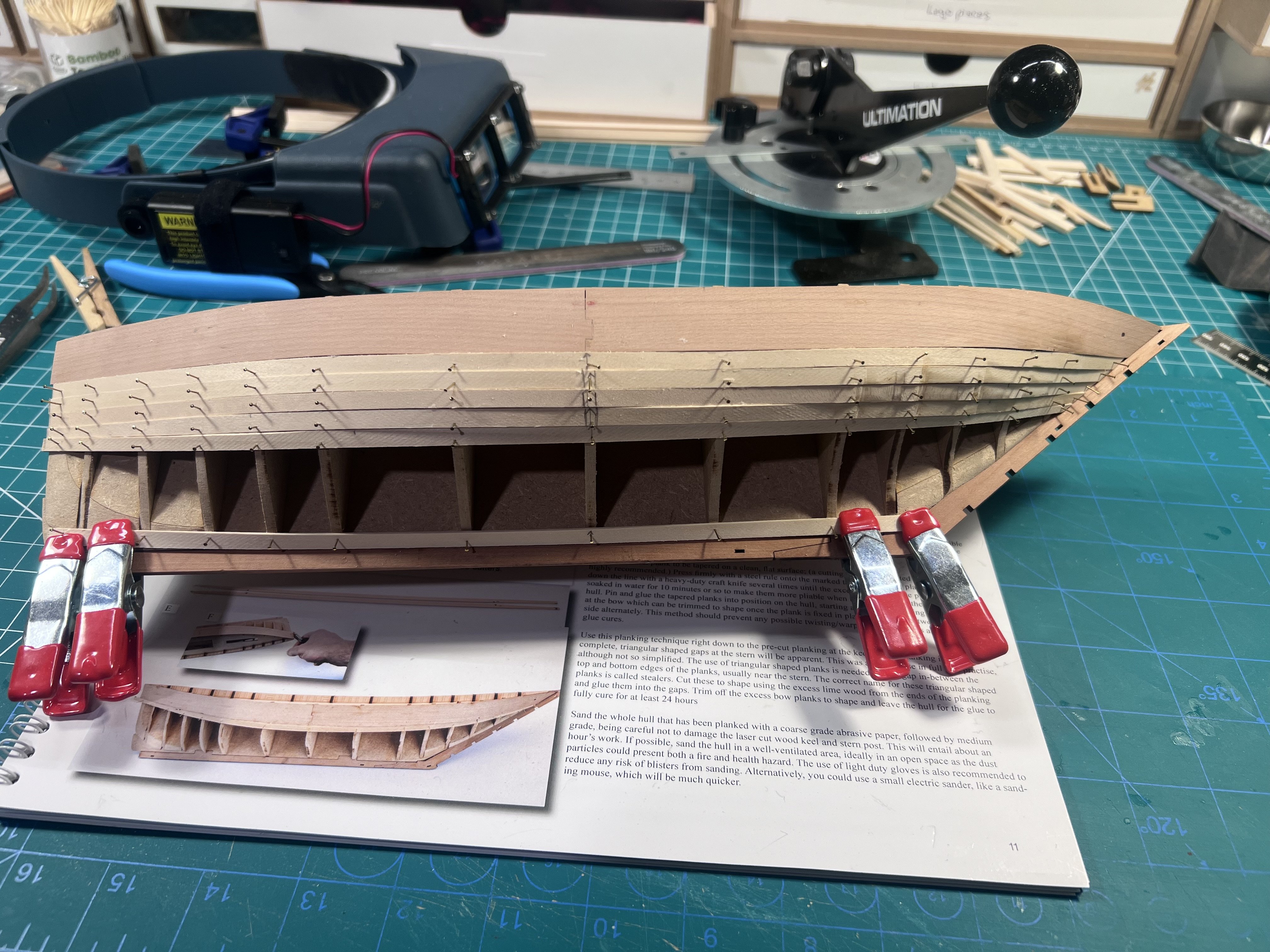

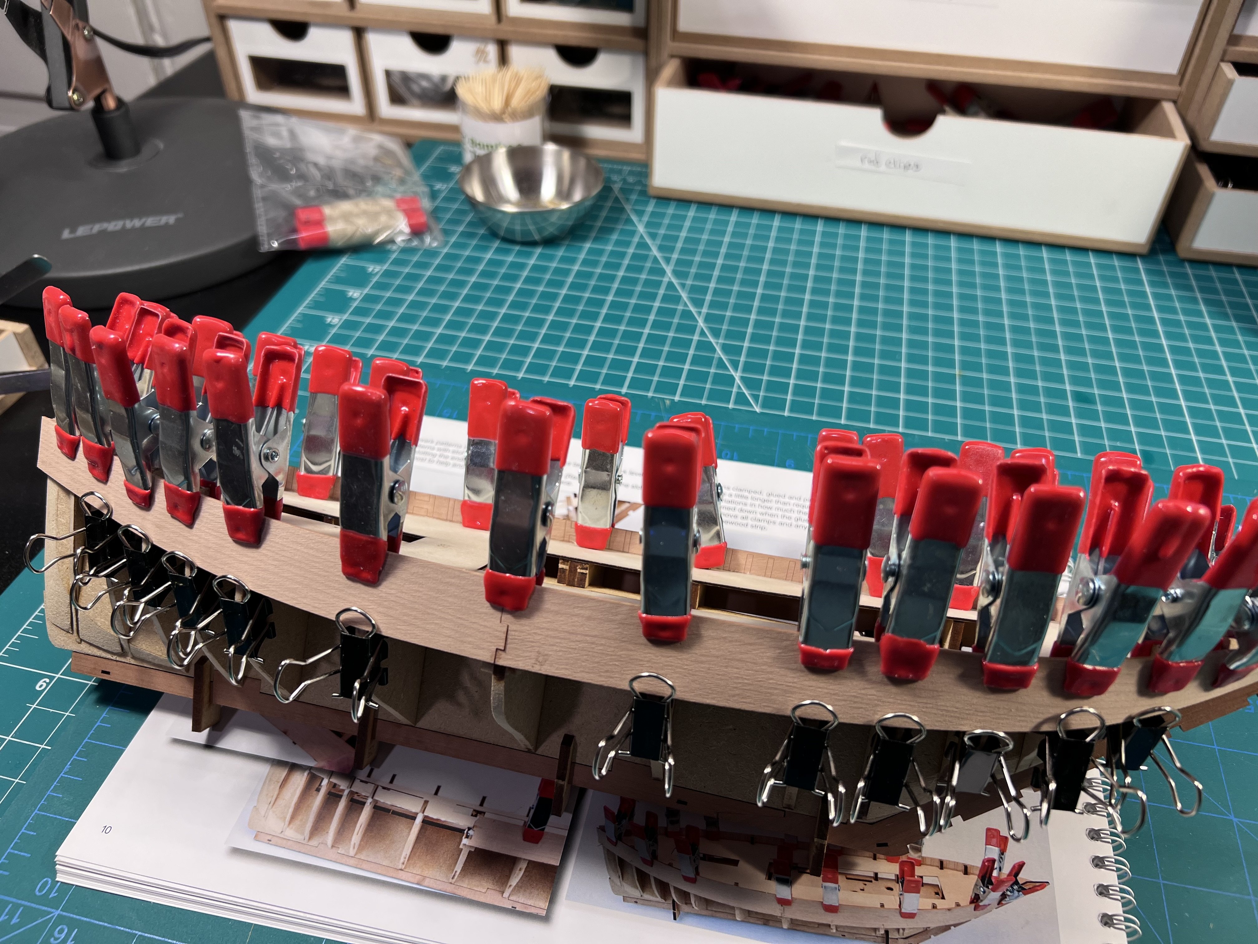

This is probably going to be a plank a day kind of model. That’s fine since I’m doing this one as filler while waiting for parts of other models to dry. I soaked the planks in hot water. I’ll leave them to bend overnight. After I get this first plank glued into place I might soak and bend a few planks on each side.
I’m going to have to figure out better ways of clamping the ends in place - a problem I haven’t solved satisfactorily with other models.

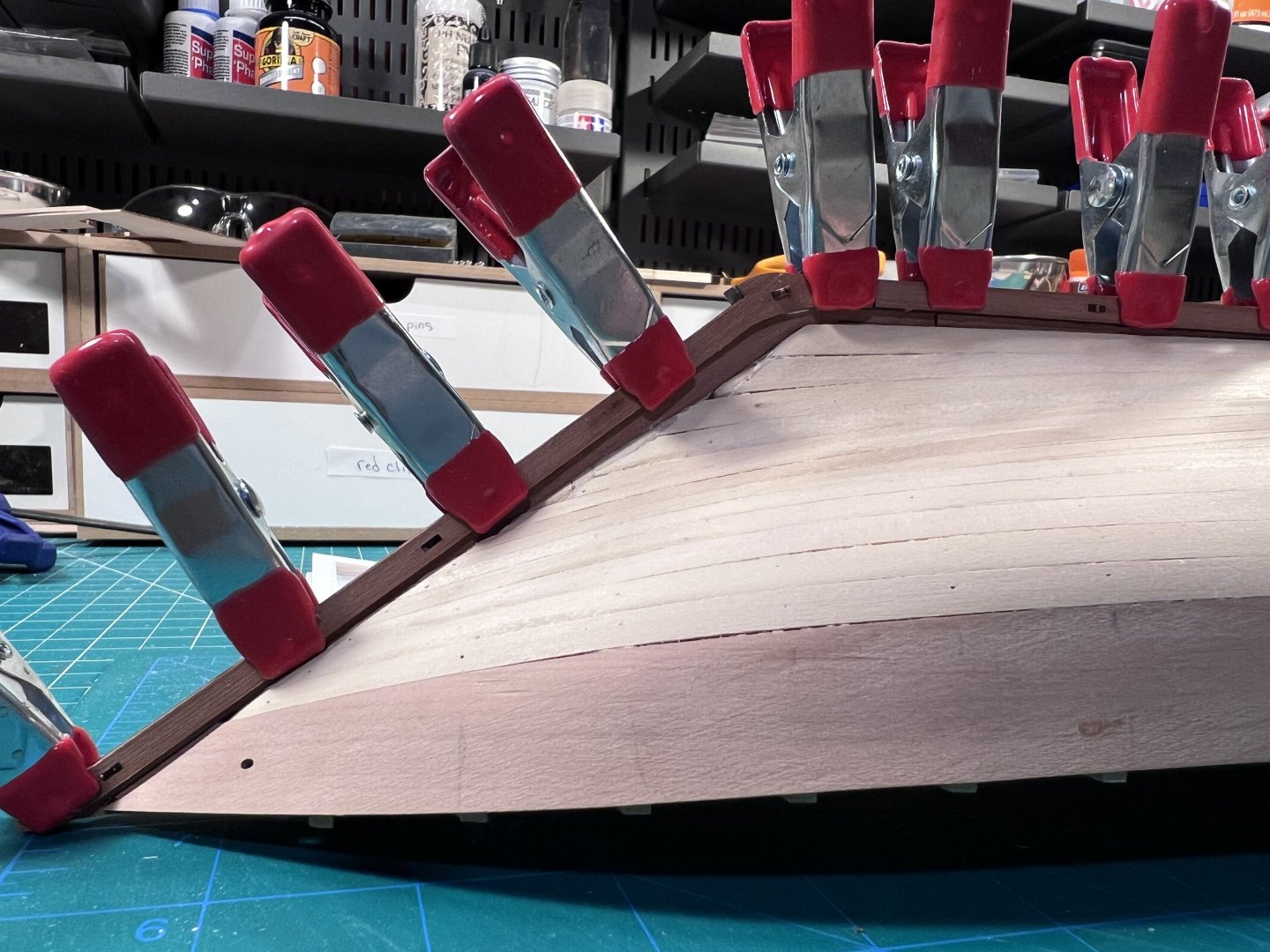

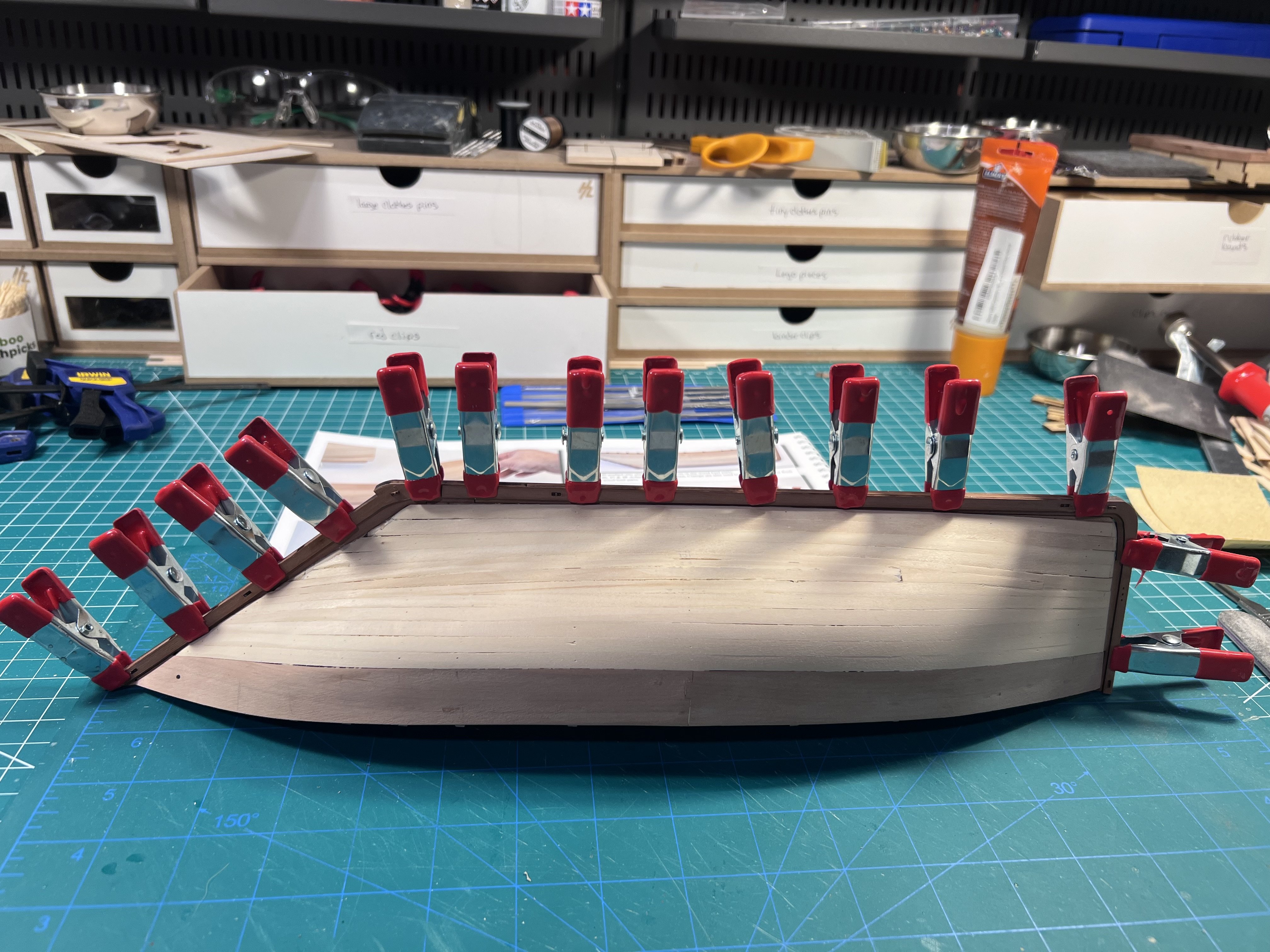

I shaped the bulwarks to the hull overnight (having soaked them in hot water for maybe 15min). Now they’re glued and clamped in place and I’ll let them dry overnight. Like the instructions say, you don’t add glue to the top tabs where the red clips are secured because those tabs will be removed later.

Added the keel pieces, which forms the rabbet for the second layer of planking.
