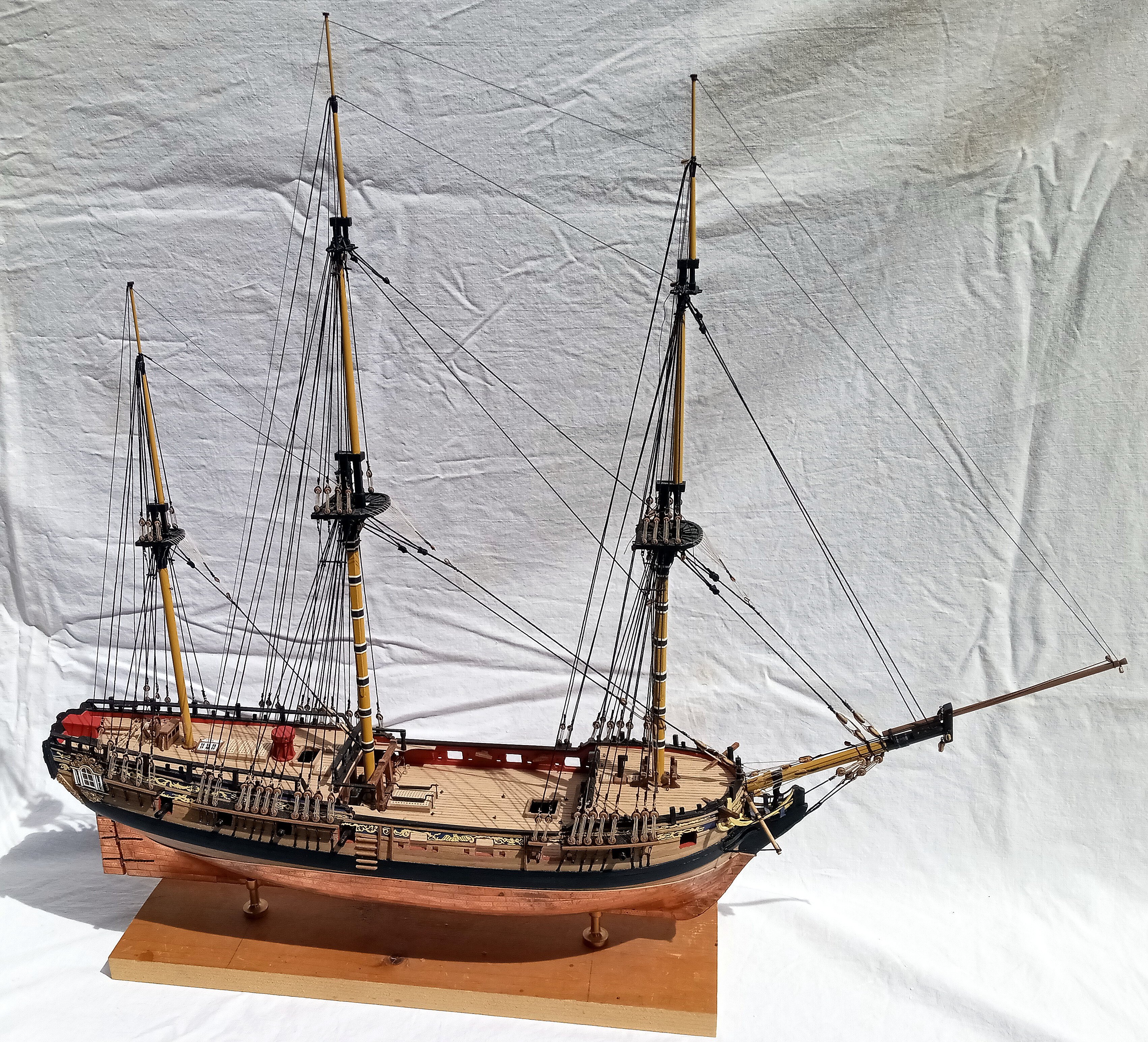

  1. I'm back. Haven't really gone anywhere, but progress has been a bit slow. I have reached what I consider a milestone; all the standing rigging is done. Finito. Now I am starting to tackle the running rigging which will take me a considerable amount of time. 🙂
  2. Well I know I haven't posted anything for quite a while, but I have not abandoned ship. Attached are two (not terrific) photos of the PEGASUS as she stands right now. Progress is being made, albeit somewhat slowly.
  3. I haven't been "doing nothing" even though I haven't been keeping up with the blog for a while. As you can see quite a bit more standing rigging has been added. The standing rigging is challenging, but fun. Still have quite a bit more to go, and need to start going "up in masts".
