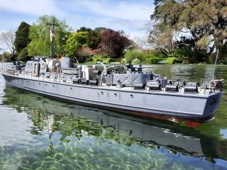

  1. I guess that just about finishes my nearly 2 years of building - a good COVID project! The maiden outing was totally successful - she needed about 2Kg of steel bars to get her sitting properly and a brass reinforcing strip added to the bow to protect her when running into the concrete at the local model pond. She's been out several times and after a few more minor details added after the maiden, Q406 was declared "finished". Young onlookers loved it - esp. when the loud fog-horn sound was played! There is video posted on a popular video-sharing site under my name and Fairmile! Thanks for the interest in my efforts. Pat Lynch

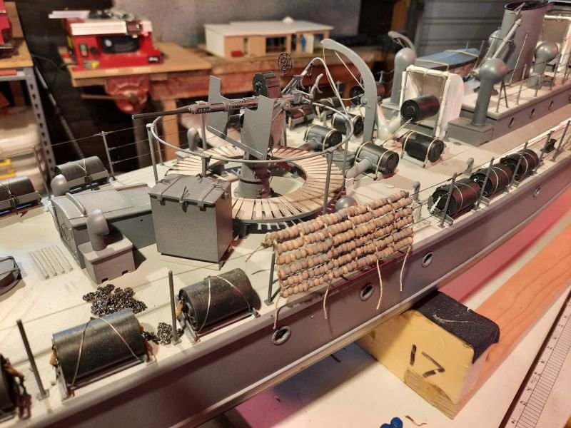

  2. With the model now mostly complete, it became a classic example of the expression "..a scale model is never finished.." - you just stop adding detail - the Fairmile was a good example. I had already begun planning (in my head) my next project so it was time to call it quits!☺️ However lots of little things were still in progress - Life buoys, flotation matts, a bridge crew and flag locker etc etc.......here are a few pictures..... The life rings were cast with resin, the flag painted onto an old, very worn piece of handkerchief - it actually flutters when in motion. The shrapnel matts were made 'squishy' with thin kitchen sponge and model rc plane covering - 'Solartex'. The sound system installed - it has the actual Fairmile twin petrol engine startup and running sounds. Then the requisite bath tub test - it almost didnt fit! But no leaks - now we are ready for a proper sea trial! Pat

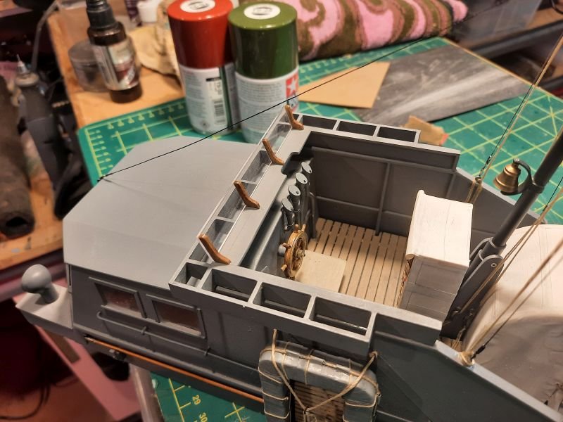

  3. No, the compass doesn't work - I doubt anyone look that hard at a model regatta! A few more details and soon it'll be done. The forward gun is a Rolls Royce 40mm - I'm told it wasnt all that successful but I doubt the NZ boats even used it - except for practice. The deck is finally getting the look I was aiming for - a lot of clutter. A bit more work and we can get it under power! A did one picture in B/W to see if it looked realistic! Pat

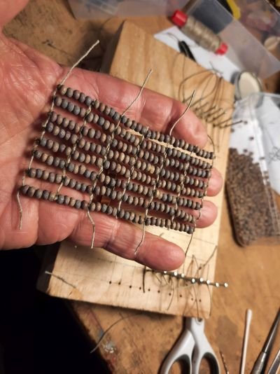

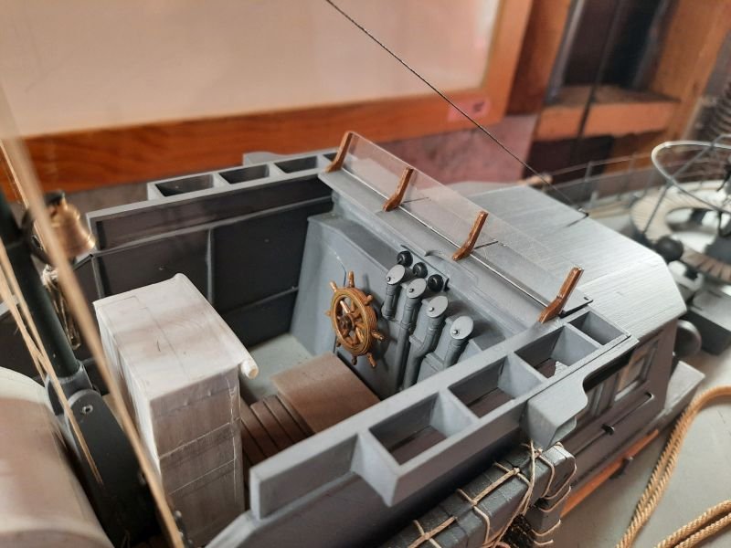

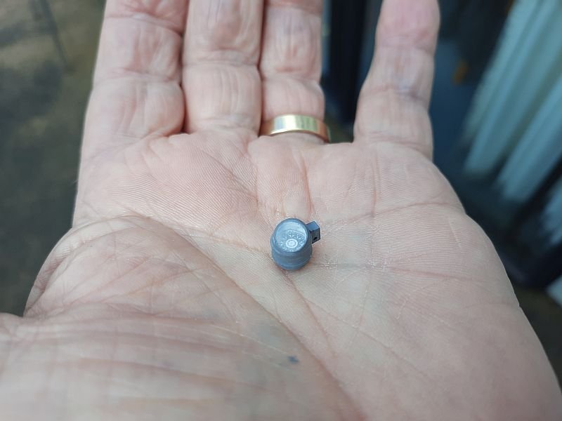

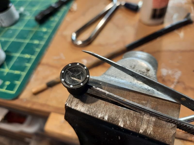

  4. A few more details as the build progresses. As said before, I found this 1:24 scale good to fabricate details but still make a modest size ship. Searchlight, compass (with a dial inside), flotation matts from tiny coloured beads, and the beginnings of the bridge - more later. Pat

  9. A few more details of the Fairmile as the build slowly progressed. Almost all the important stuff on the vessel is scattered around the deck - virtually covering it by the time the project is complete. At 1:24 scale, there is no excuse for leaving off visible details such as depth-charge securing cables and quick-release catches - I guess they were given a good boot over the edge! The forward gun platform has a raised wooden walkway and much of the foredeck clutter is complete. All parts have been scratch-built. This was my brief to myself when I started this project. I love the research and effort needed to work out ways of creating the odd-shaped bits on the model. ☺️ ps. I didn't make the chain or rope! Pat
