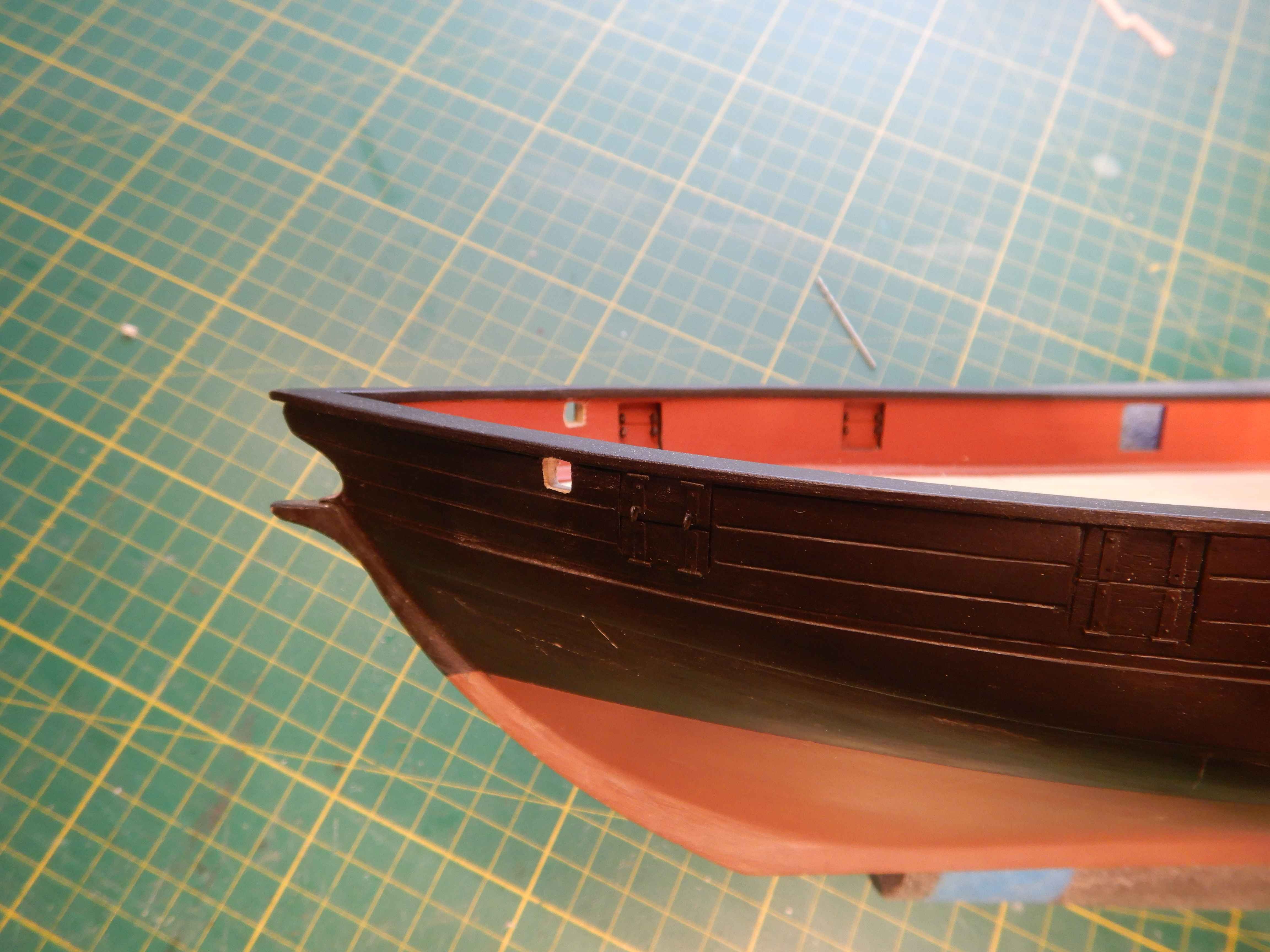

  1. Hello all! Another small update. I drilled the hawse holes and added the bolsters. The bolsters that came with the kit was plywood, and a little big, so I made new ones out of some walnut I found in the kit box.. I also made and added the ringbolts/eyebolts for for the breech rope/gun tackles. I predrilled the holes where the guns will be added, and rig those rings on the guns first, and mount the gun with tackles and rings later. That's it for now! All the best! Gaffrig.

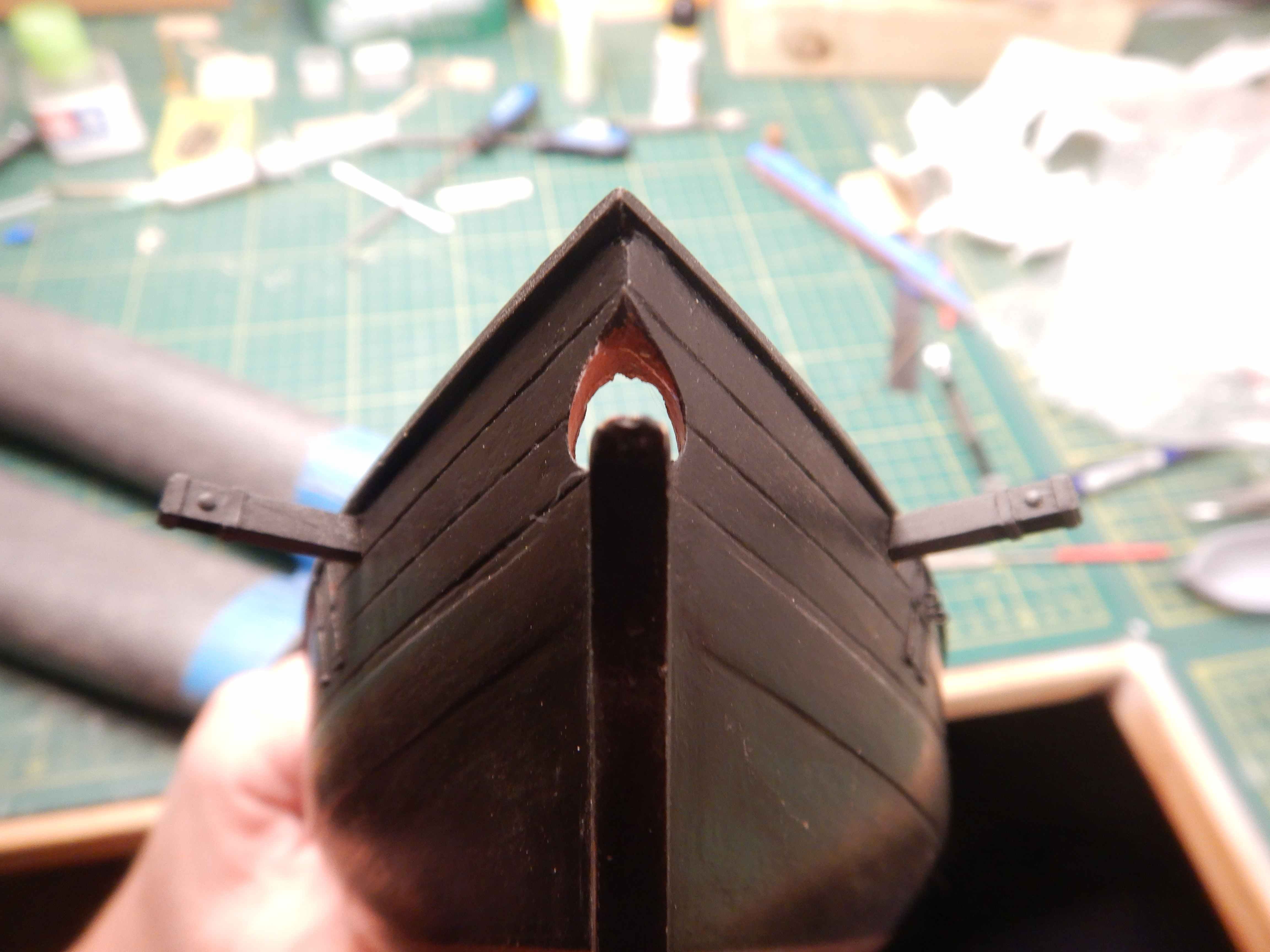

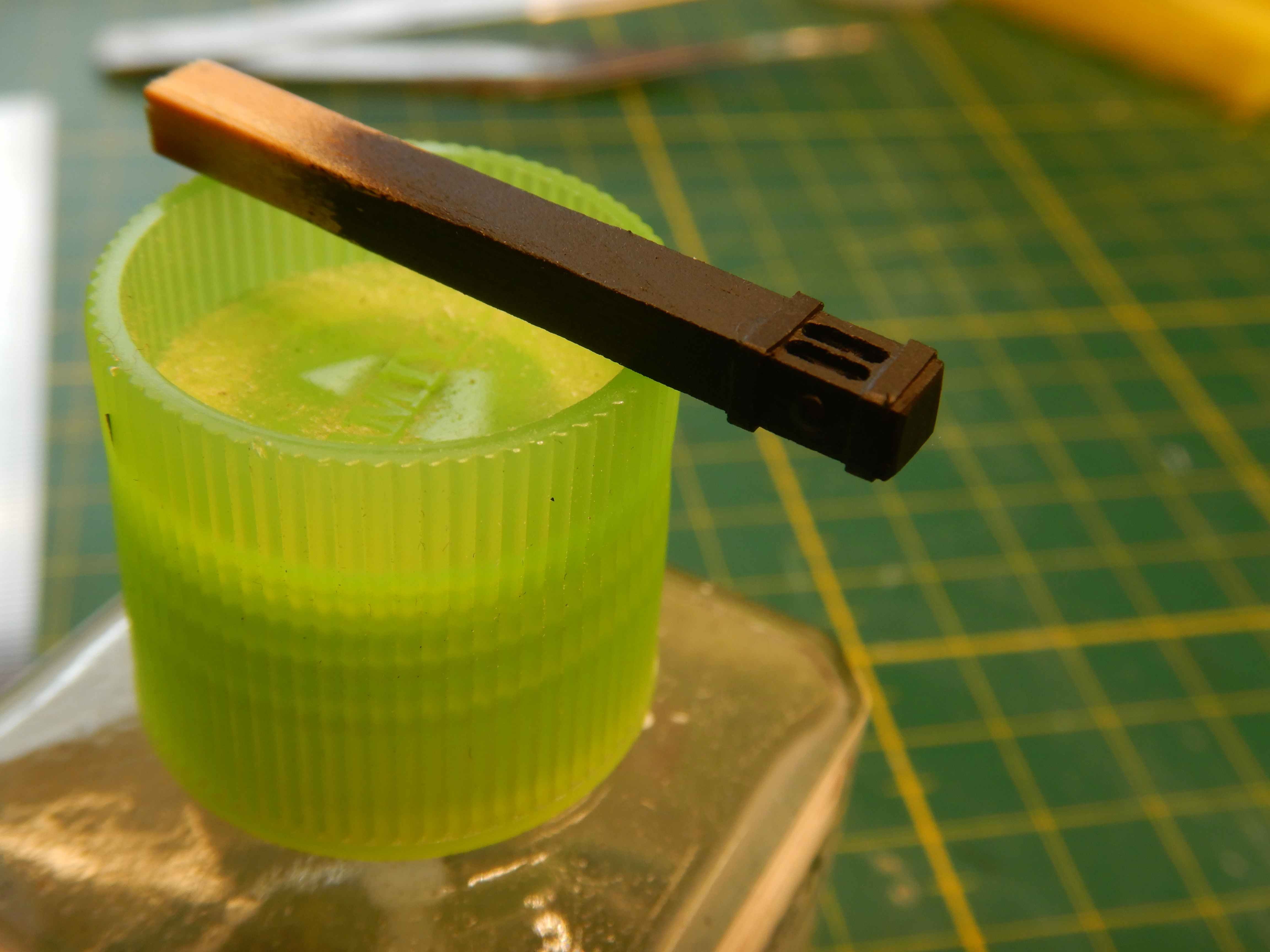

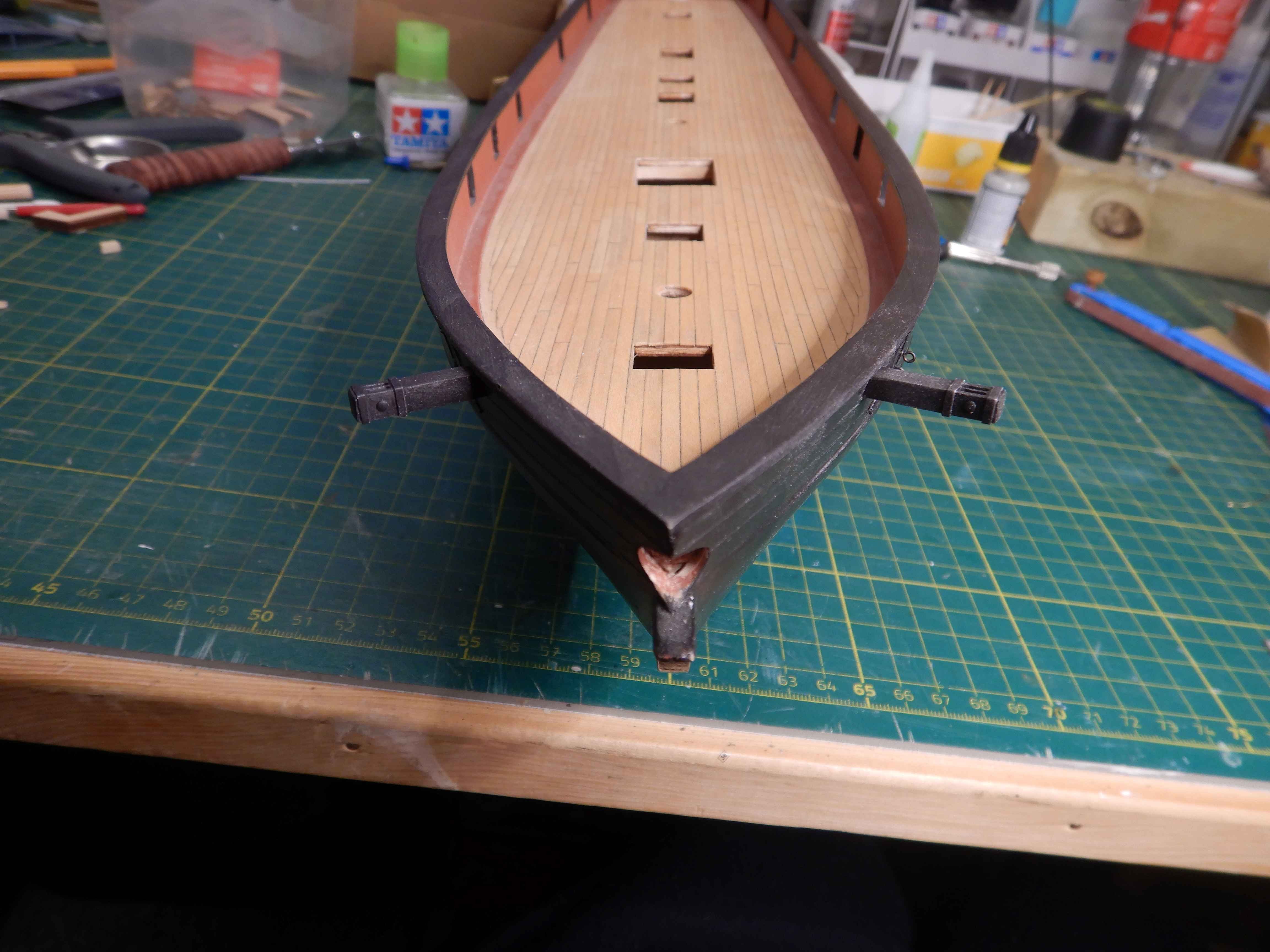

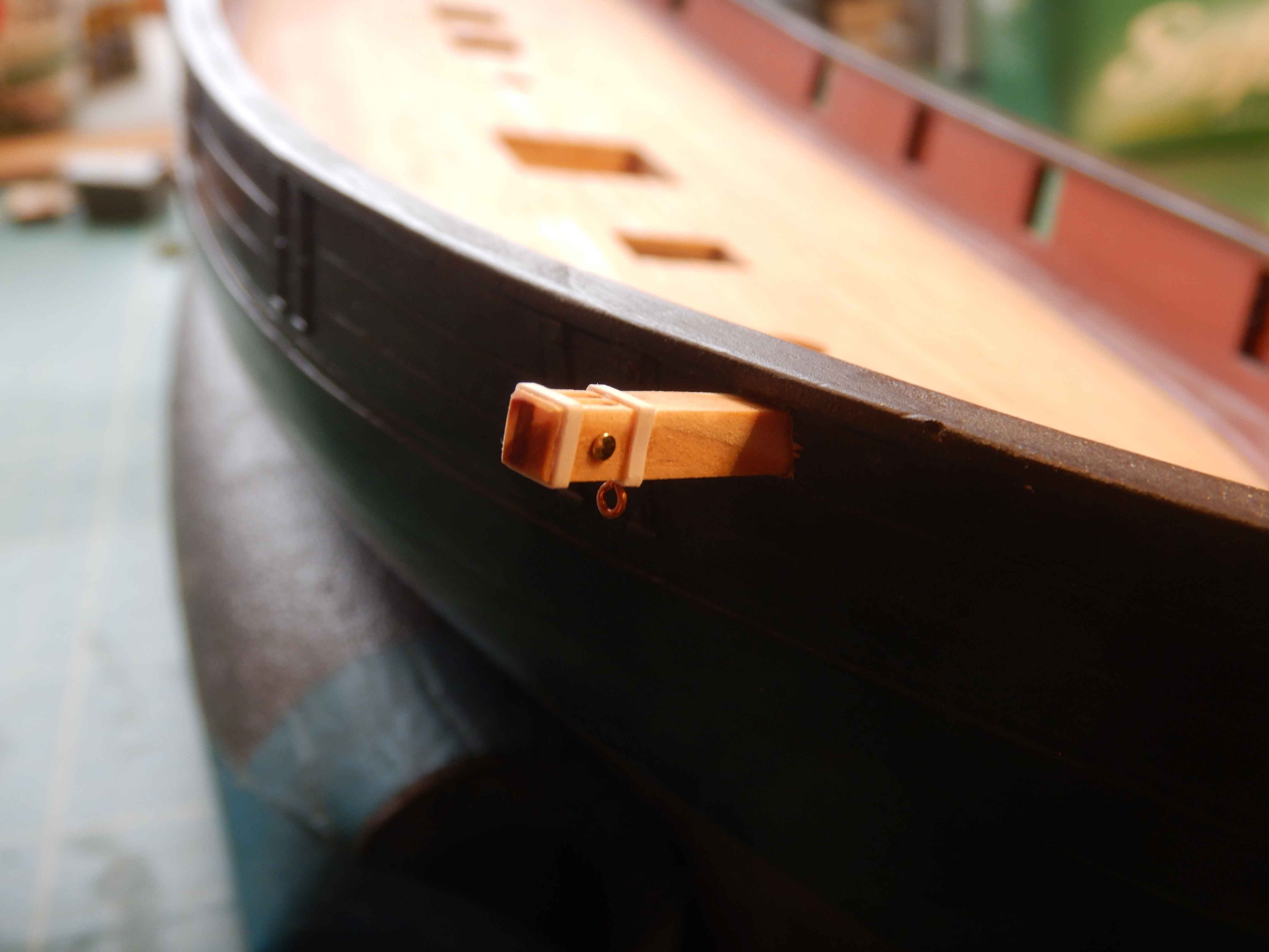

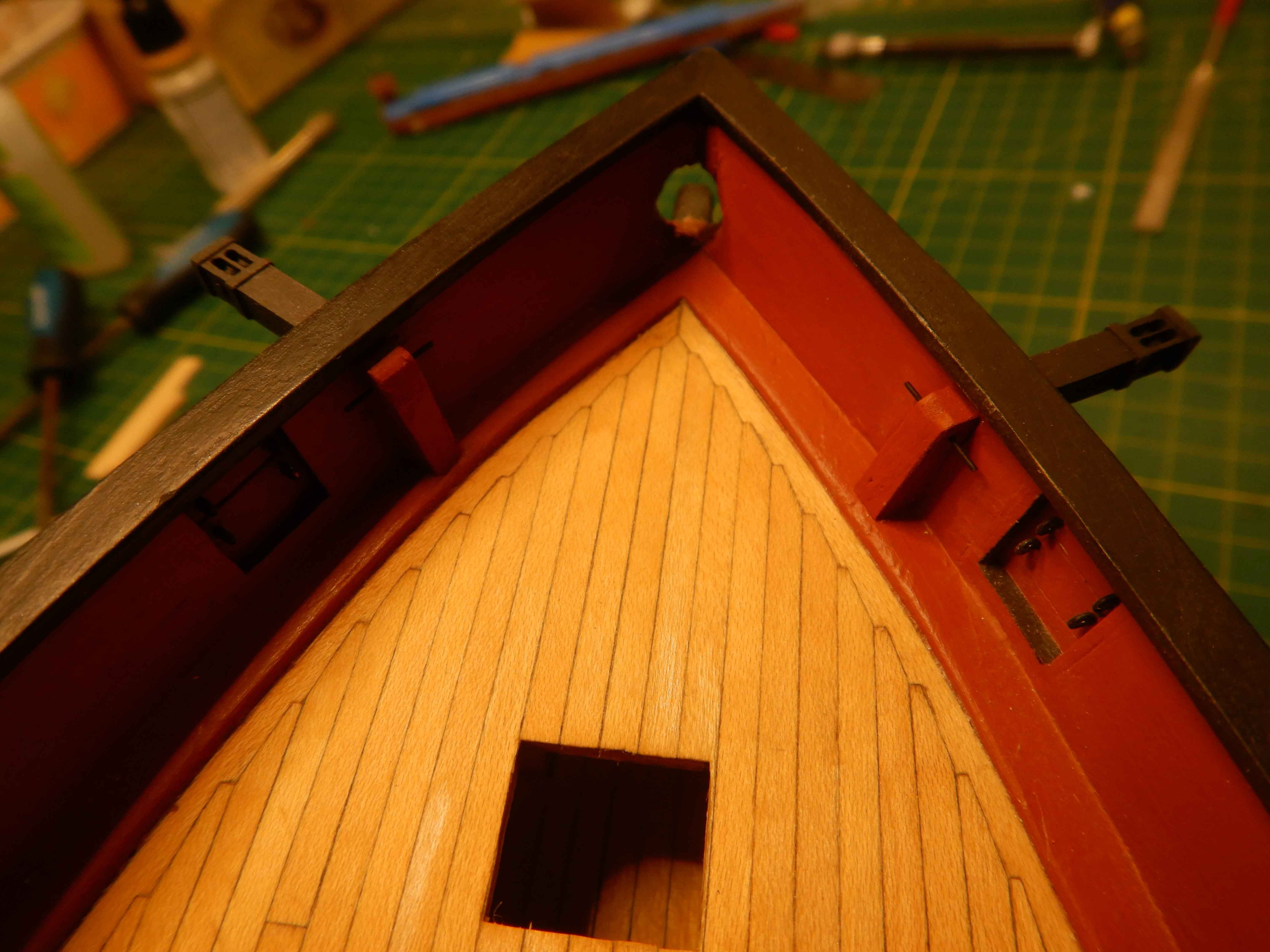

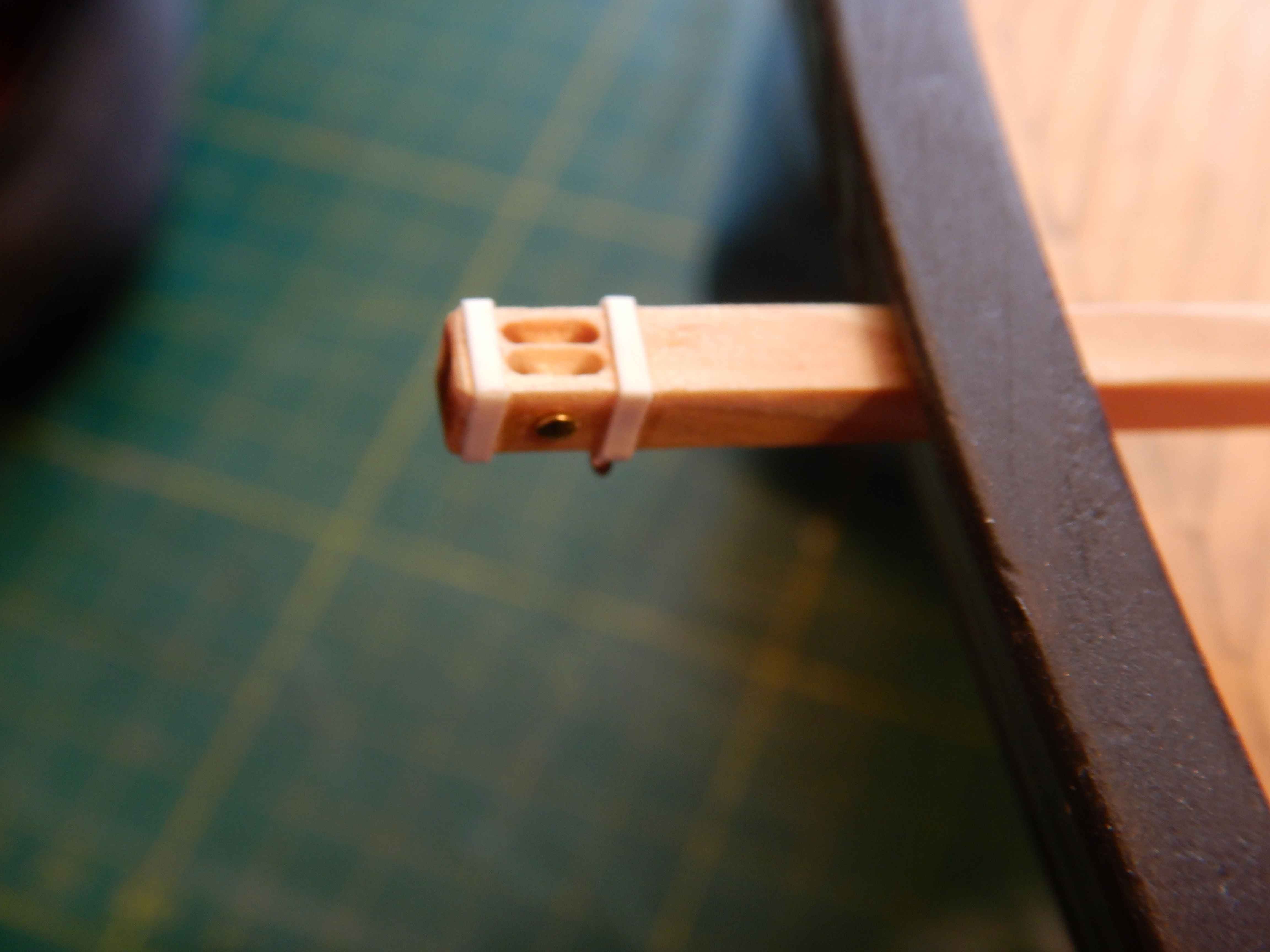

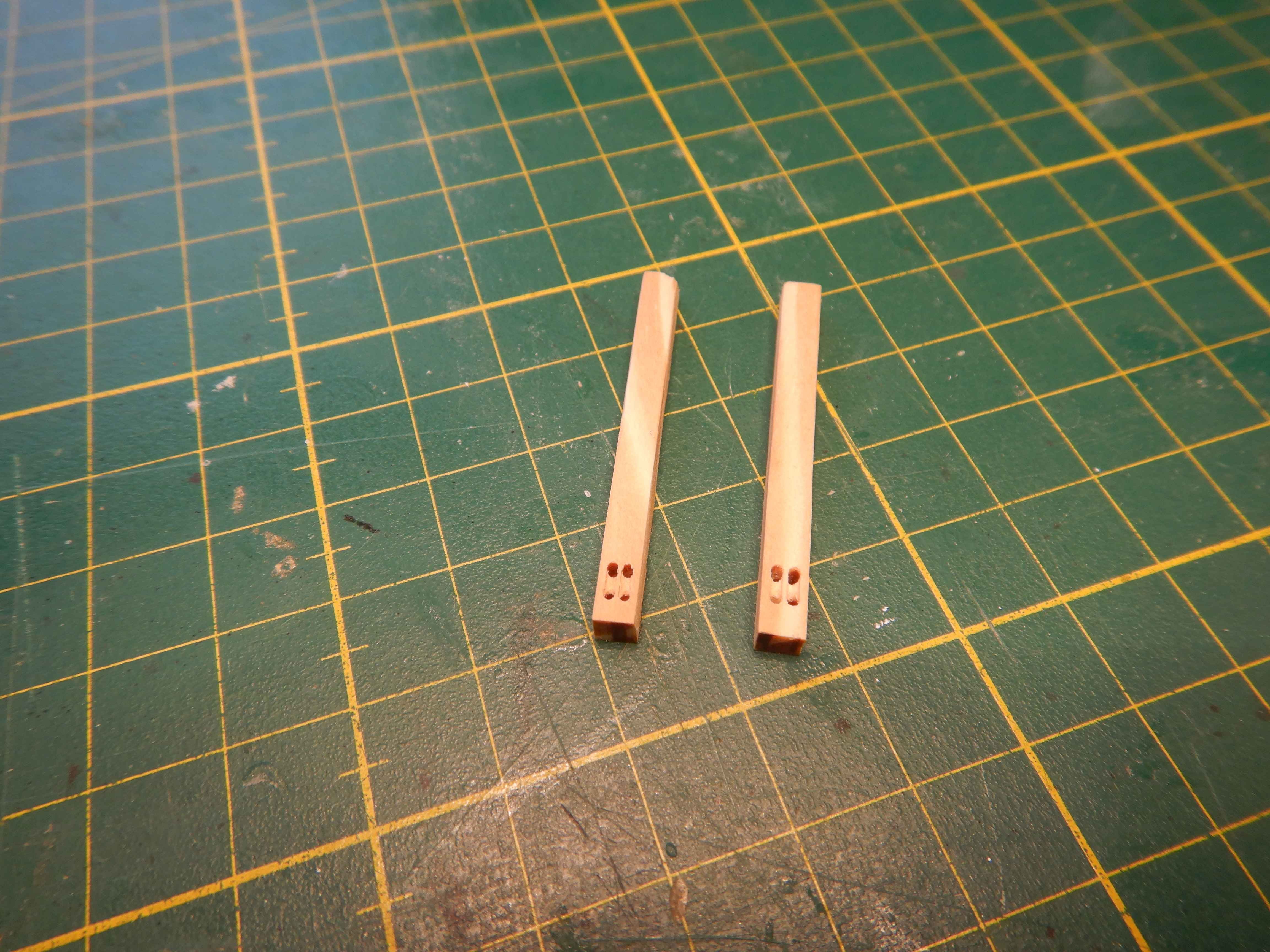

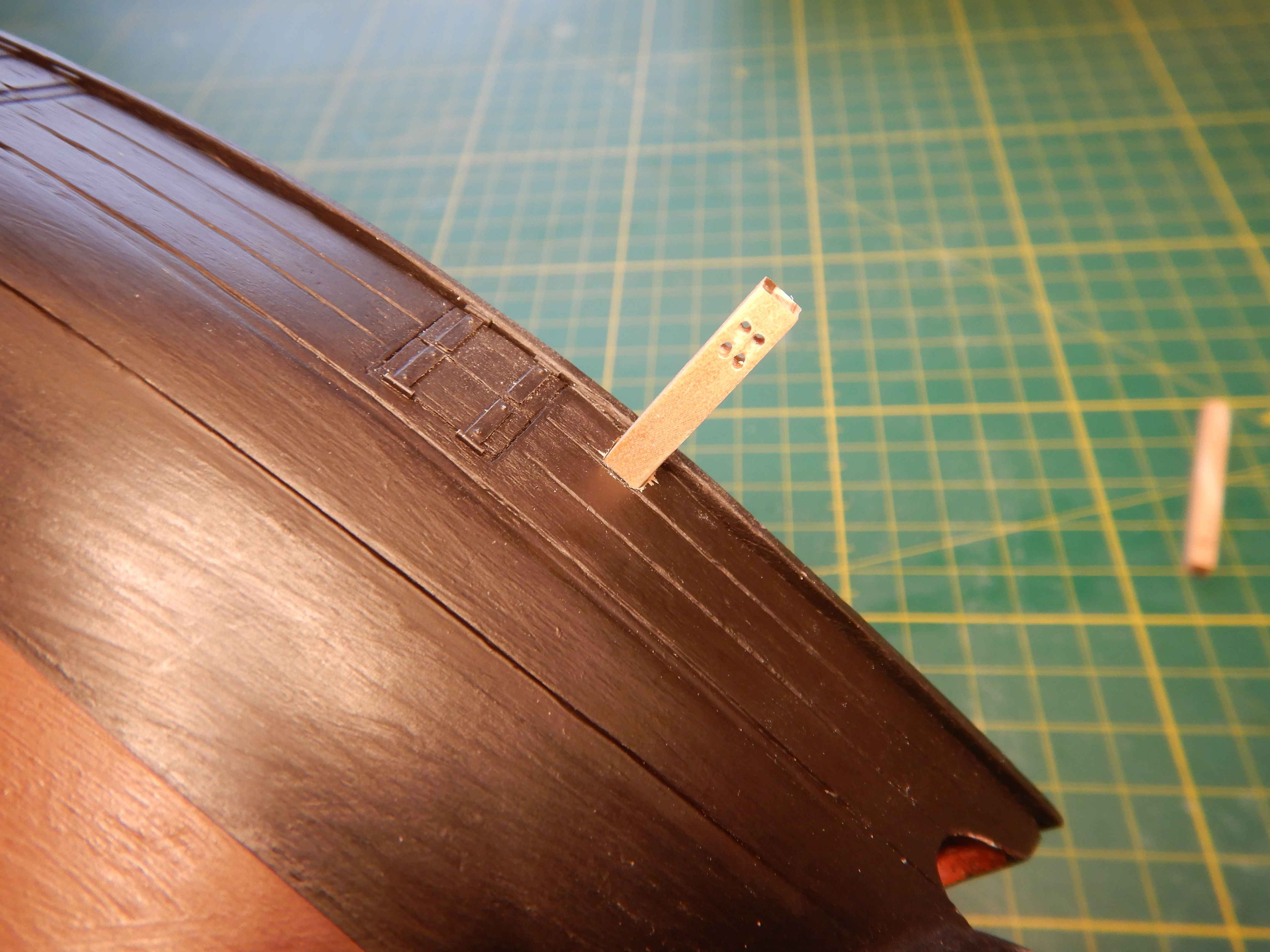

  4. Hello! After life has gotten in the way for too long, I have finally been able to find some time to blow the dust of my model and make a little headway.. Spent quite some time to get my bearings and figure out where I left off and what to do next.. I decided on cutting holes and fixing the catheads inplace. The kit part is a oversized plywood piece that leaves a lot to be desired... So I figured I'll scratchbuild theese. I had some 4x4 mm that I used and drilled/milled some holes/grooves to fake some sheaves.. I added some styrene strip to imitate iron bands, and brass nails for the sheaves. Also added a eyebolt for the end of the hoist tackle. I removed this again because I think it is easier to "splice" the rope in a loose eyebolt rather than one fixed to the model. Then added some paint.. Made the innfill pieces, glued it all inplace and painted and voila! my interpretation of Lynx's catheads are done! Next I think will be the rudder. Another plywood piece that I might end up scratch building. Gaffrig.
