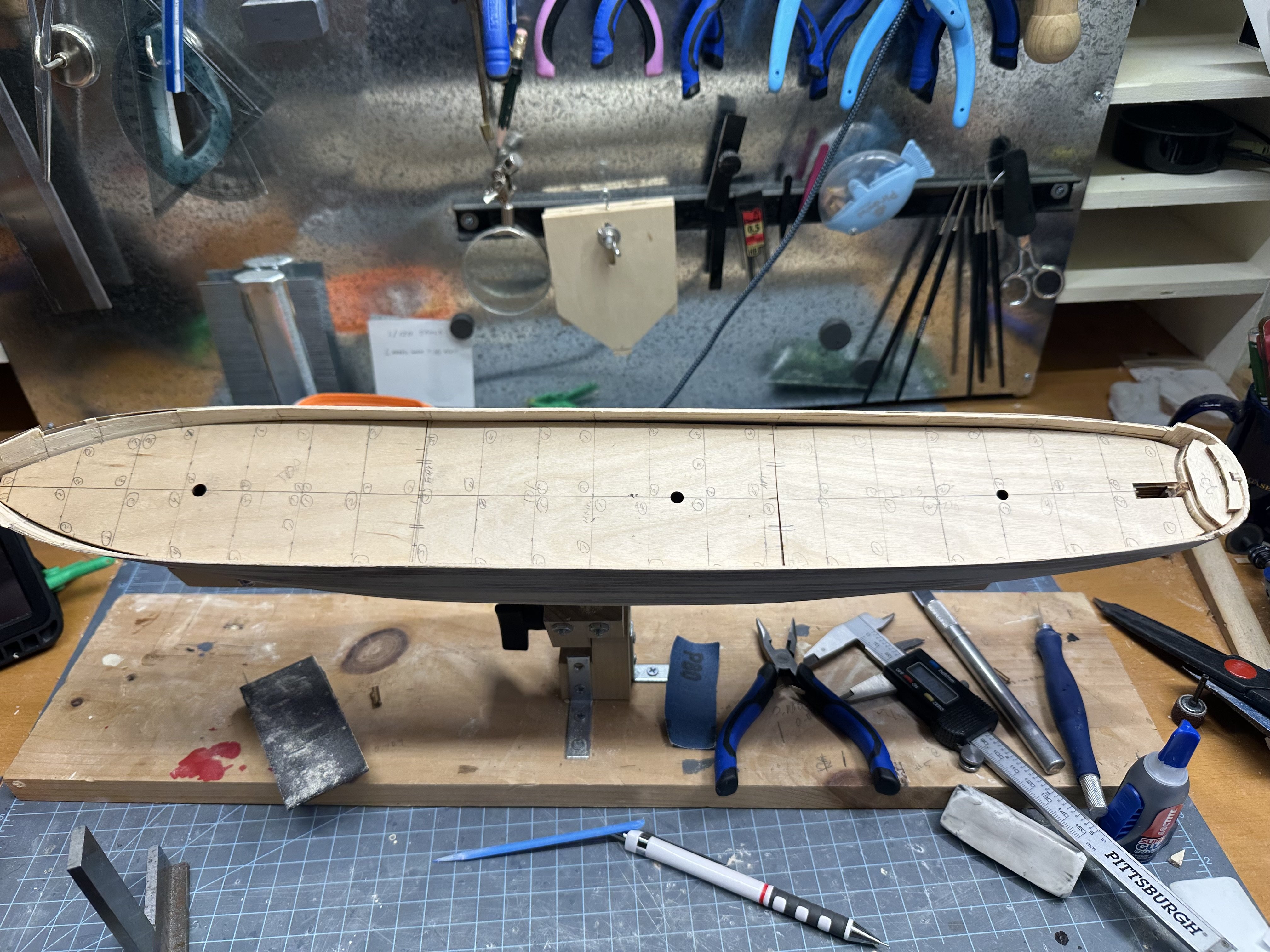

I decided to make tree nail “holes” using a 005 (0.2 mm) micro point pen. These pens are really nice because they don’t bleed. I decided to do a sepia brown to get as subtle as possible. I have an even smaller point pen, a 003 (0.15 mm) in black, but I felt that black would have been too abrupt especially at this scale. The scale of this ship is 1:120 but I still wanted to have that detail in there. My next big build I’m going to try to use the real thing. Next will be to get some clear coat onto the deck. But first, I cut out the gun ports. For the gun port doors, I made a sandwich assembly of one long piece of the 1 mm walnut interior plank, the 1mm basswood “guts” and the 0.5mm walnut exterior and painted them black (exterior) and “drab” (more on that interior color when I paint the interior bulwark). I’ll just slice off my gun port doors from this stock piece. With that done, I think it’s time to finally put a coat of black paint on the upper outer hull.
The planks are on. For the seams I used a #2 Ticonderoga pencil, just shaded one long and short edge per panel. I like the effect. By contrast, my last model (Pegasus) I shaded all of the edges and at the time was fine with it but the difference reminds me of a lady with way much mascara. I saw posts here that said to just shade only one edge. Much more subtle. I’ve also decided to add the tree nail effect using an ultra-fine no bleed pen. That’s the next post.

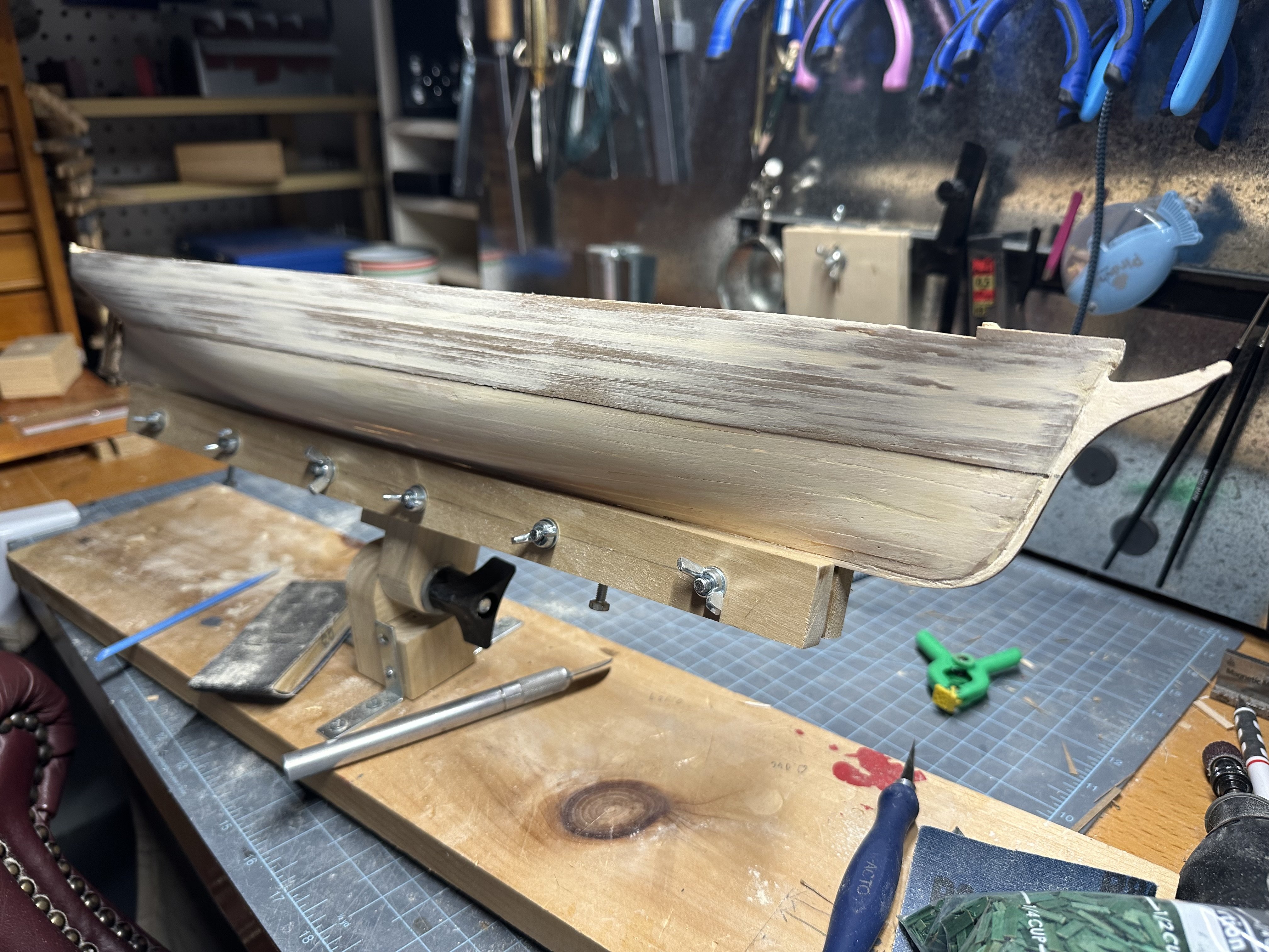

The last plank of the first planking layer was put in place…finally. I’ll start sanding down high spots and filling the gaps in with Elmers Wood Filler. The majority of the posts here say the Elmer’s works fine and is easy to sand. I’ve done some random spots on the hull already and I concur - MUCH easier to sand vs the Durhams filler. And since I happen to have a container of the Elmer's filler in my shop, money saved! I’m very pleased how the hull in general has turned out so far and wished “2009 me” would’ve taken a pic of my first go-around with this hull I when I had less of a clue than I do now. I know I didn’t do half the things I’m doing this time around. Funny what just a few ship models do for one’s experience level.
I realized quickly that when I tore the old hull down that I hadn’t replenished my wood strips to finish the first layer of planking, so I got new ones cut by the Lumberyard for Model Shipwrights (Link), which it turns out, is literally right down the road from me. David and Ev hooked me right up, and his wood supply is very impressive. So I was back on track. The new wood was 0.5mm thicker than the OG, so I decided to restart everything, no worries. It’s summer so I get to the shop when I can, usually in snippets, enough at this point to lay on a few strakes. So it is slow going. I did make those cool binder clip clamps out of mini clips. And I’m very glad I pre-fitted the keel bottom with screws for brass pedestals as I have something sturdy for my keel clamp to bite onto (see the two screws poking out from the bottom of the clamp). That’s it. After laying on the 1st layer, it’ll be a coat of Durham’s Rock Hard wood filler and sand sand sand. It’s early days, but it’s got the shape of a ship now.

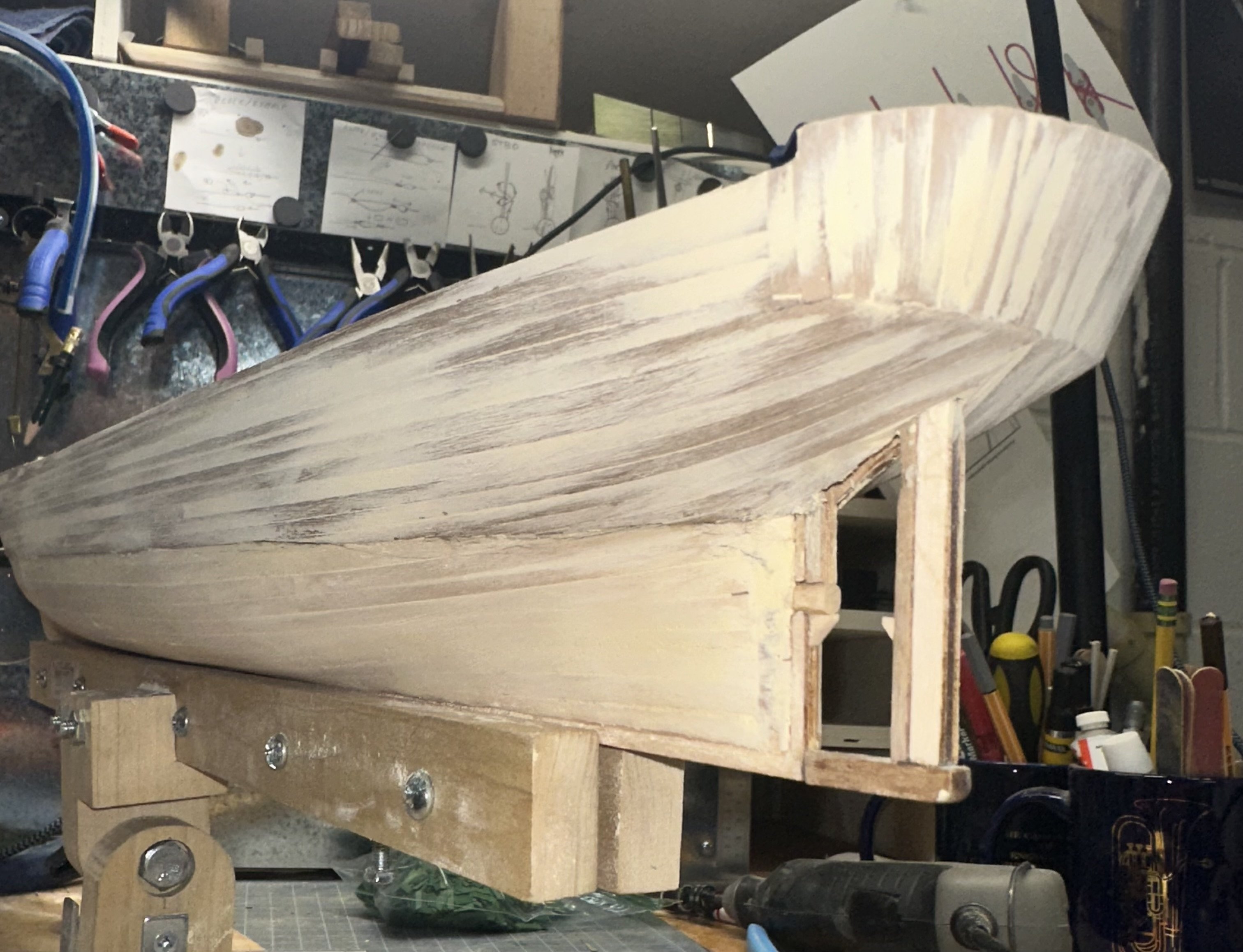

First plank of the first layer of planking is in place, this Mamoli kit is weird (to me at least) because I’ve always started with the wale as the first plank. They have you starting at a reference mark on the sides of the transom. The top of the plank runs flush along the very top of the bulkheads up to 6 and 5, which stick up higher. The way the instructions look, the remainder of the first layer of planks run based on this first one. Referring to the Bowcock book, the hull is very sheer, no protruding wale plank below the gun ports.
Tore he old hull down to the “studs”. Dusek Models sent me a new laser cut panel and replacement wood to start over. Shipping actually cost more than the wood. I’d do things differently now but I didn’t want complicated so I paid for convenience. Here’s the blank canvas in my homemade keel vice. I installed the lifting frame and propeller. using as my guide the Bowcock book, which bases its measurements and drawings on original builders blueprints as well as two models that are also based on those blueprints, one is on display in an art gallery in the town the Alabama was built (Laird Model), the other is on display at the Mariner’s Museum at Newport News (Bolloch Model). I’ll take the prop out to sand down the aft section around the stern cabin.
