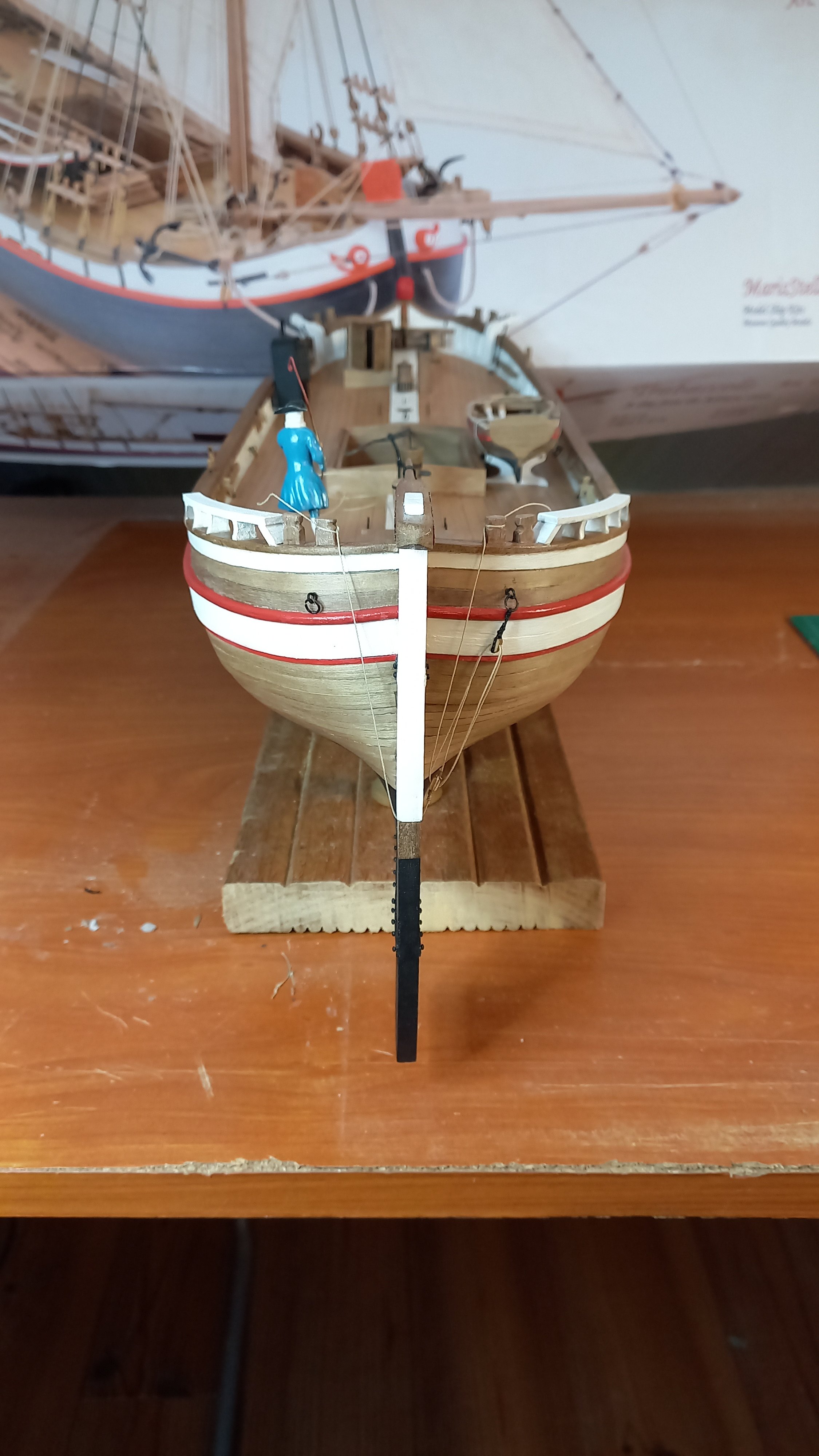

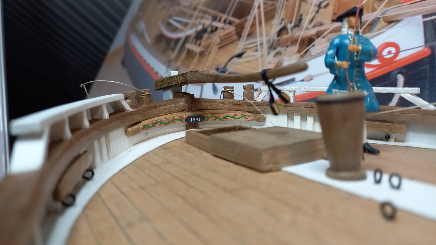

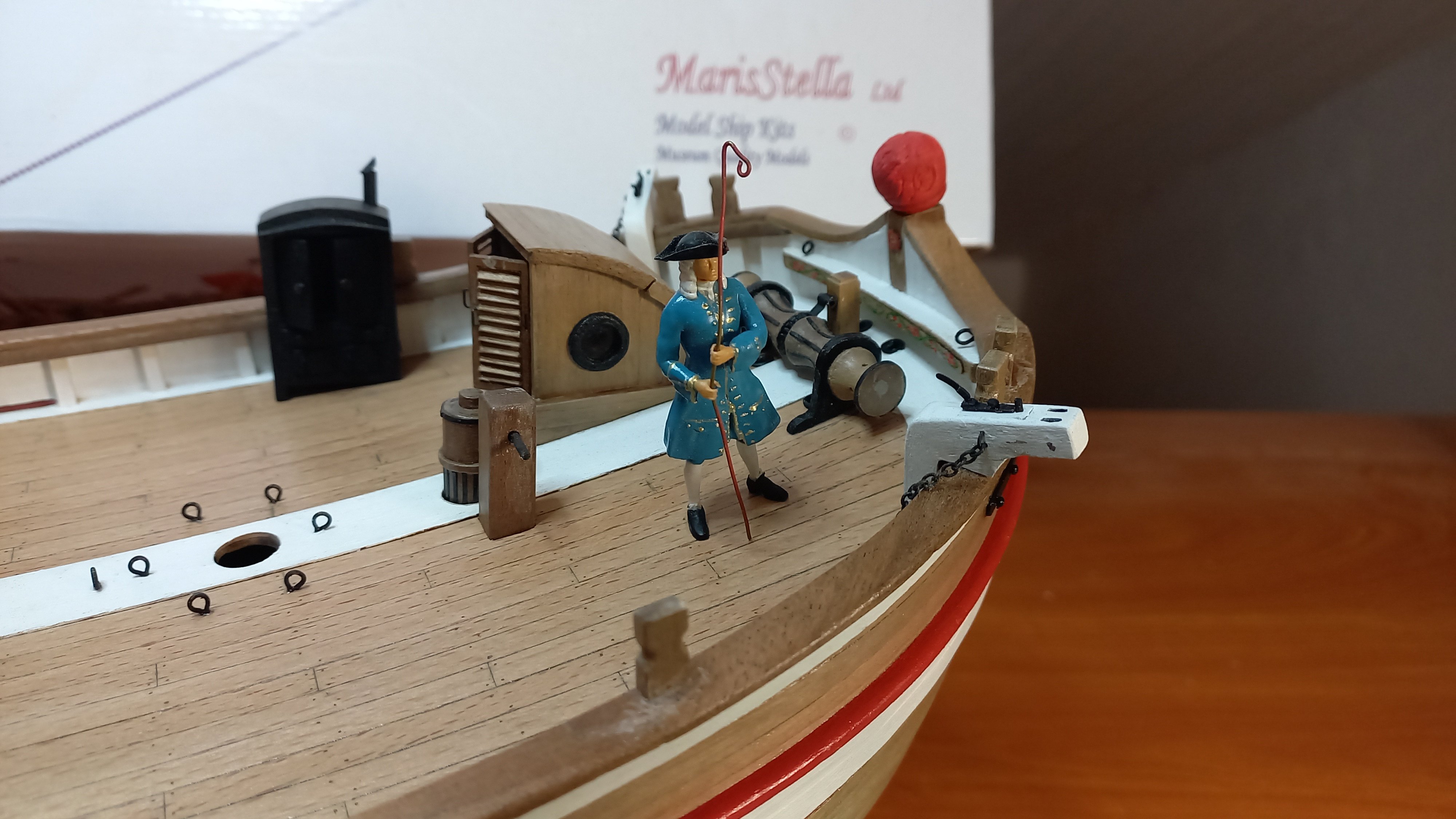

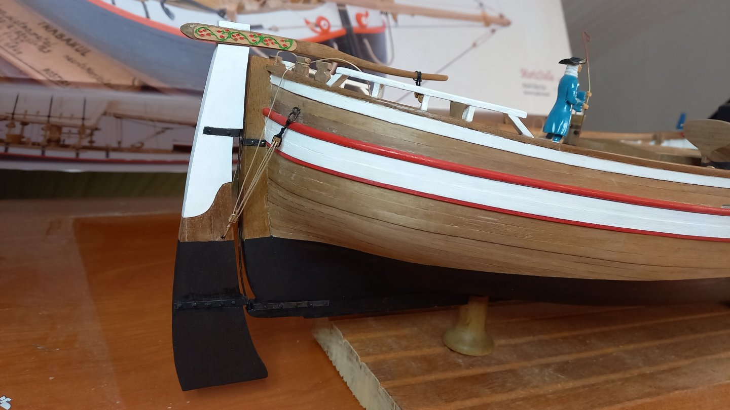

Hello all and happy new year, Rudder in progress. These fittings allowed it to slide vertically along the sternpost; when the vessel operated in shallow waters or was at anchor, it could be raised to the level of the keel. The lifting of the rudder was carried out by means of a double tackle fixed to two supports at the stern, one to port and the other to starboard, with the rope (vela) passing through the rudder blade itself, as can be seen below. Cathead in progress with stopper.

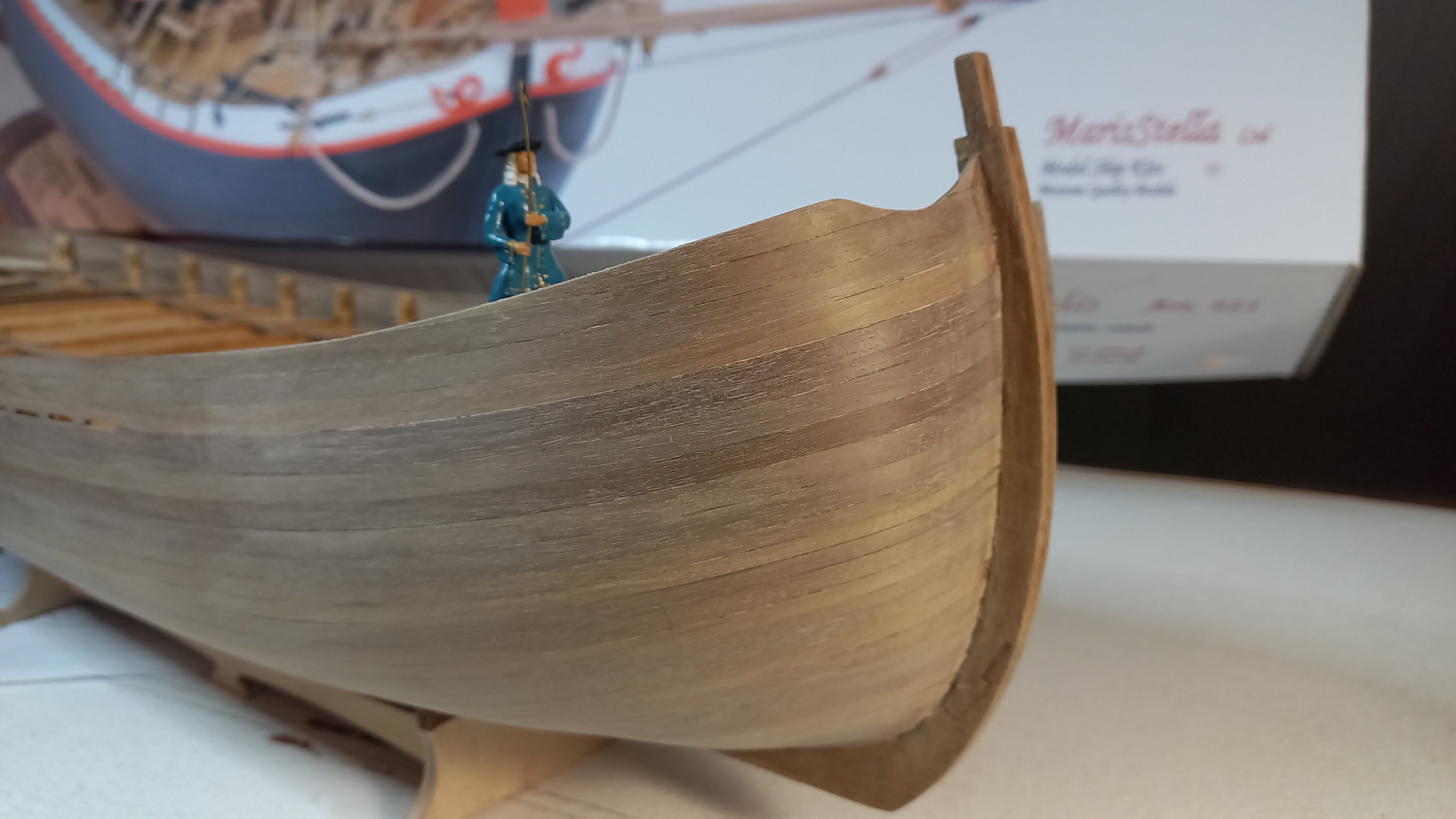

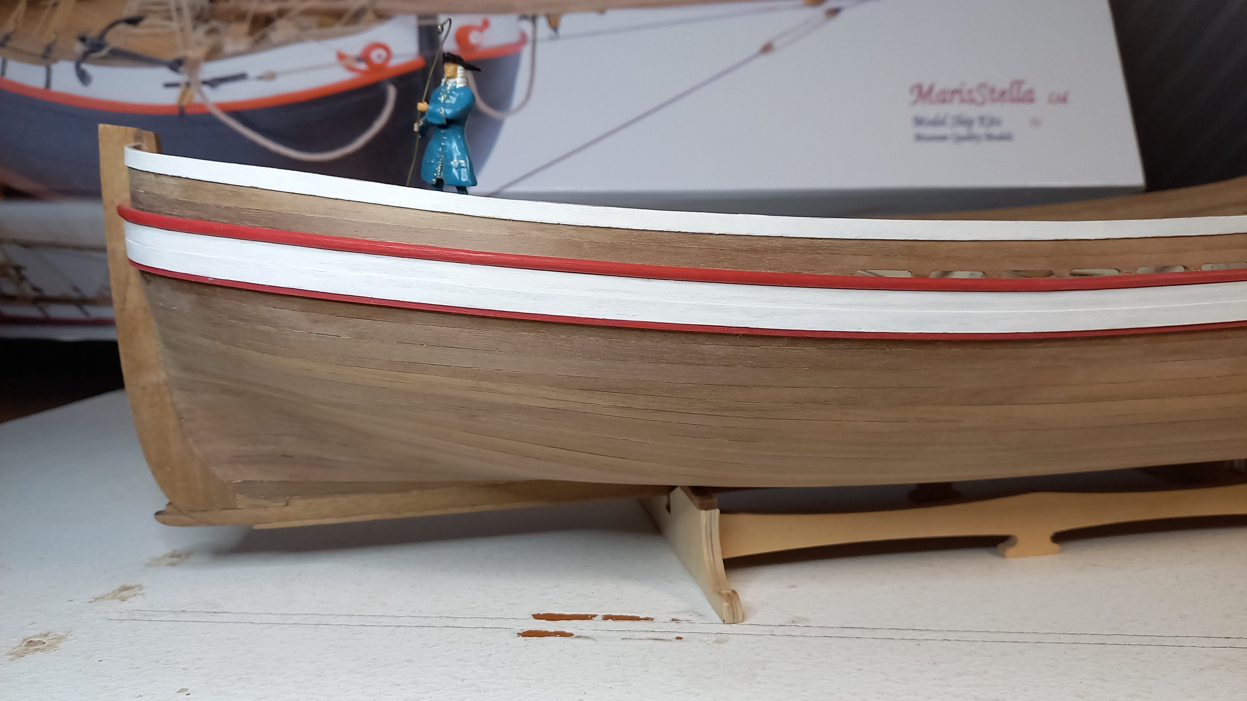

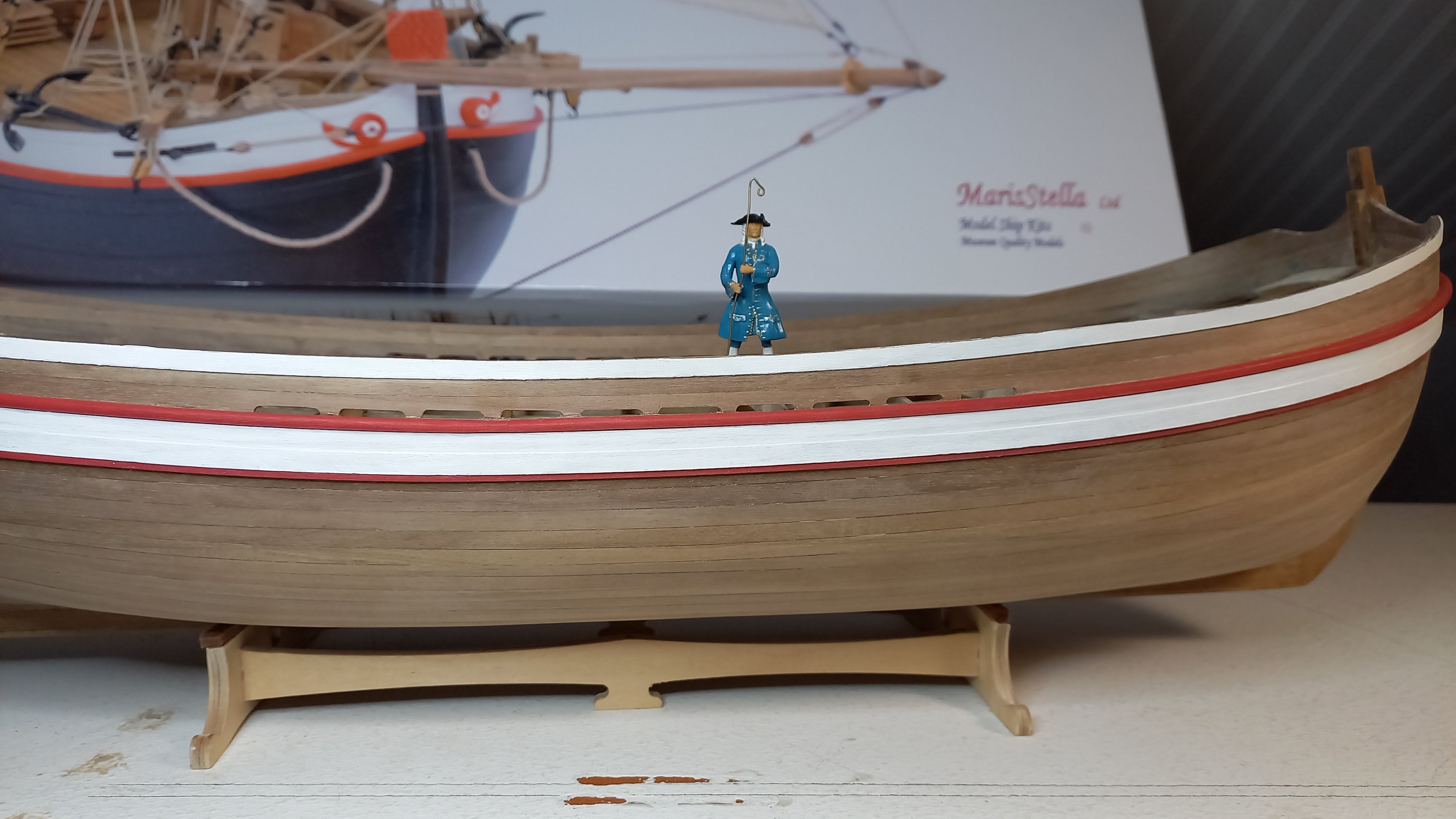

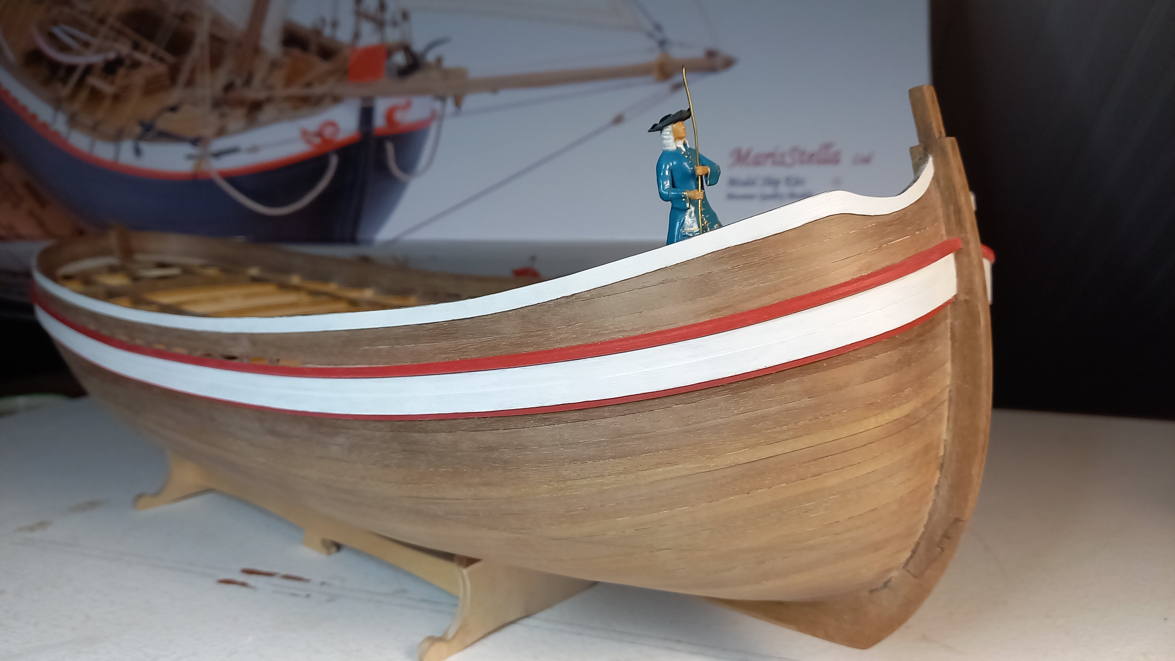

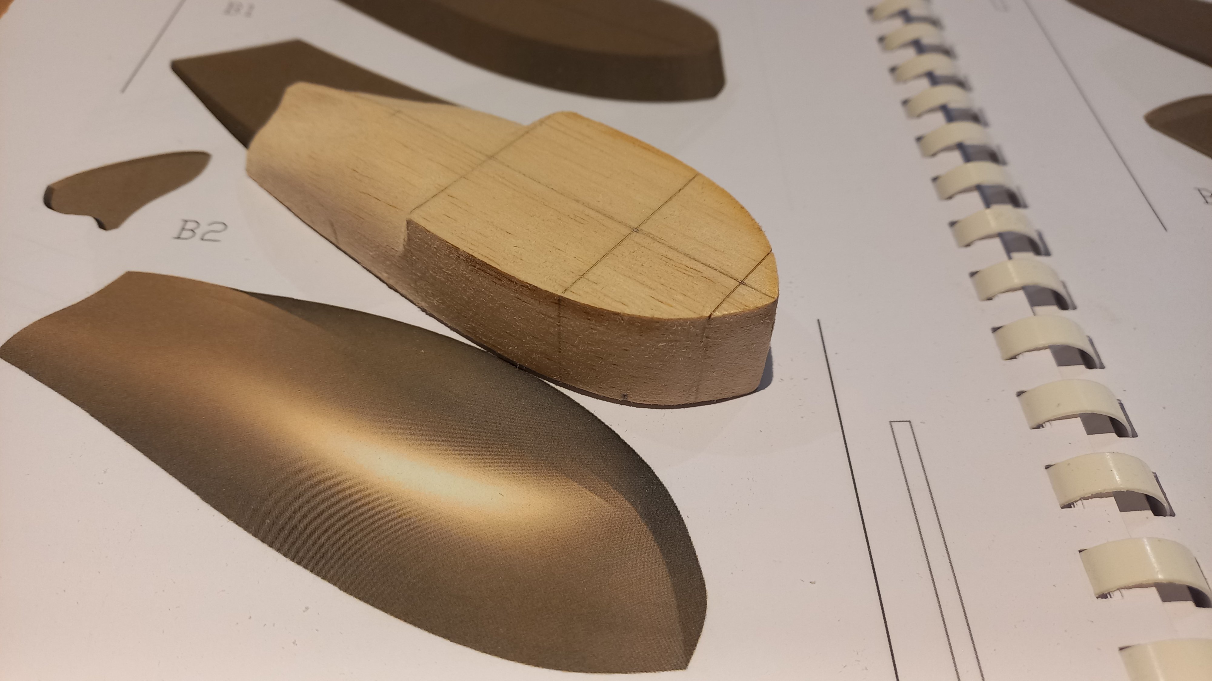

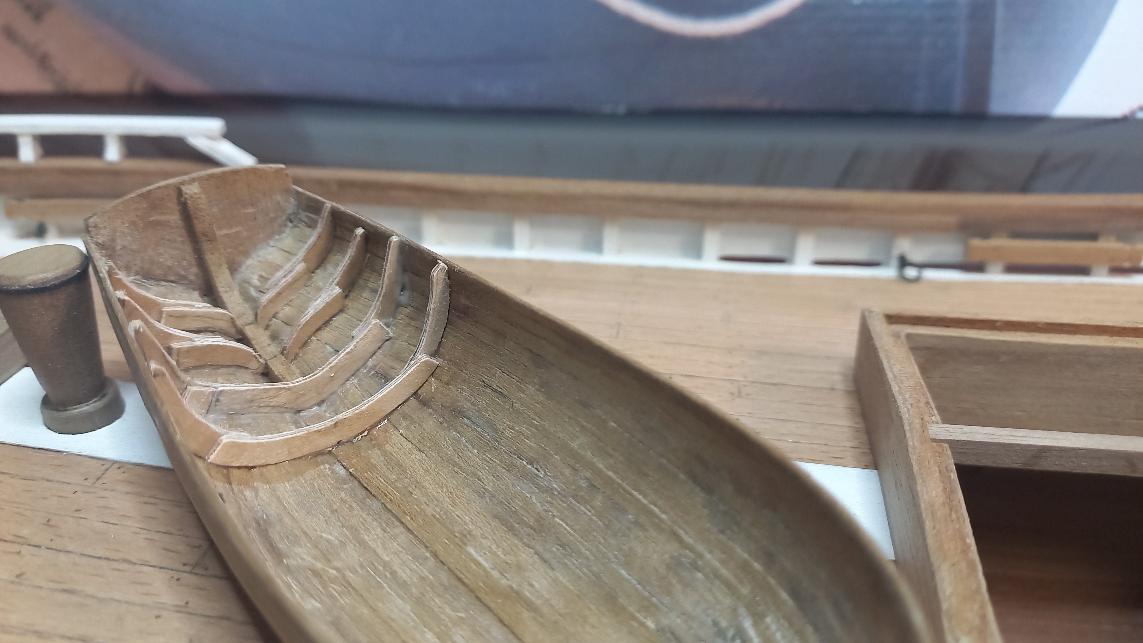

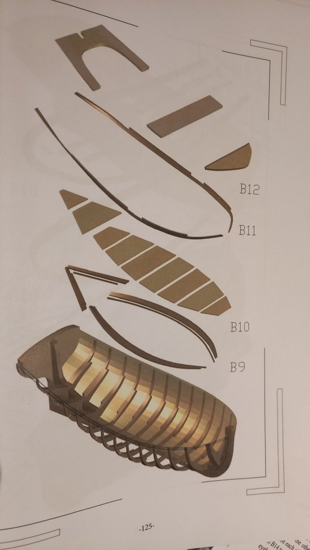

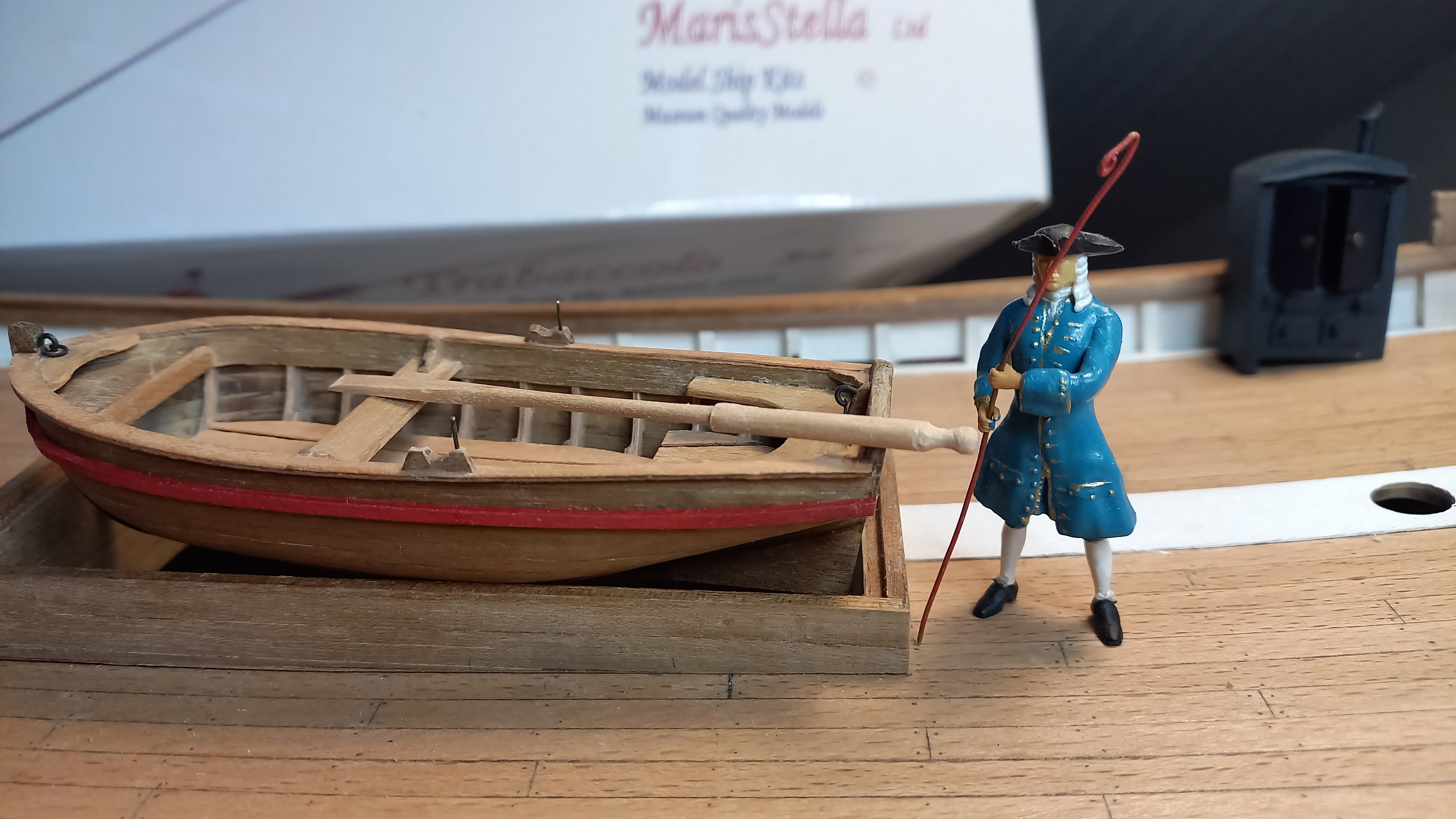

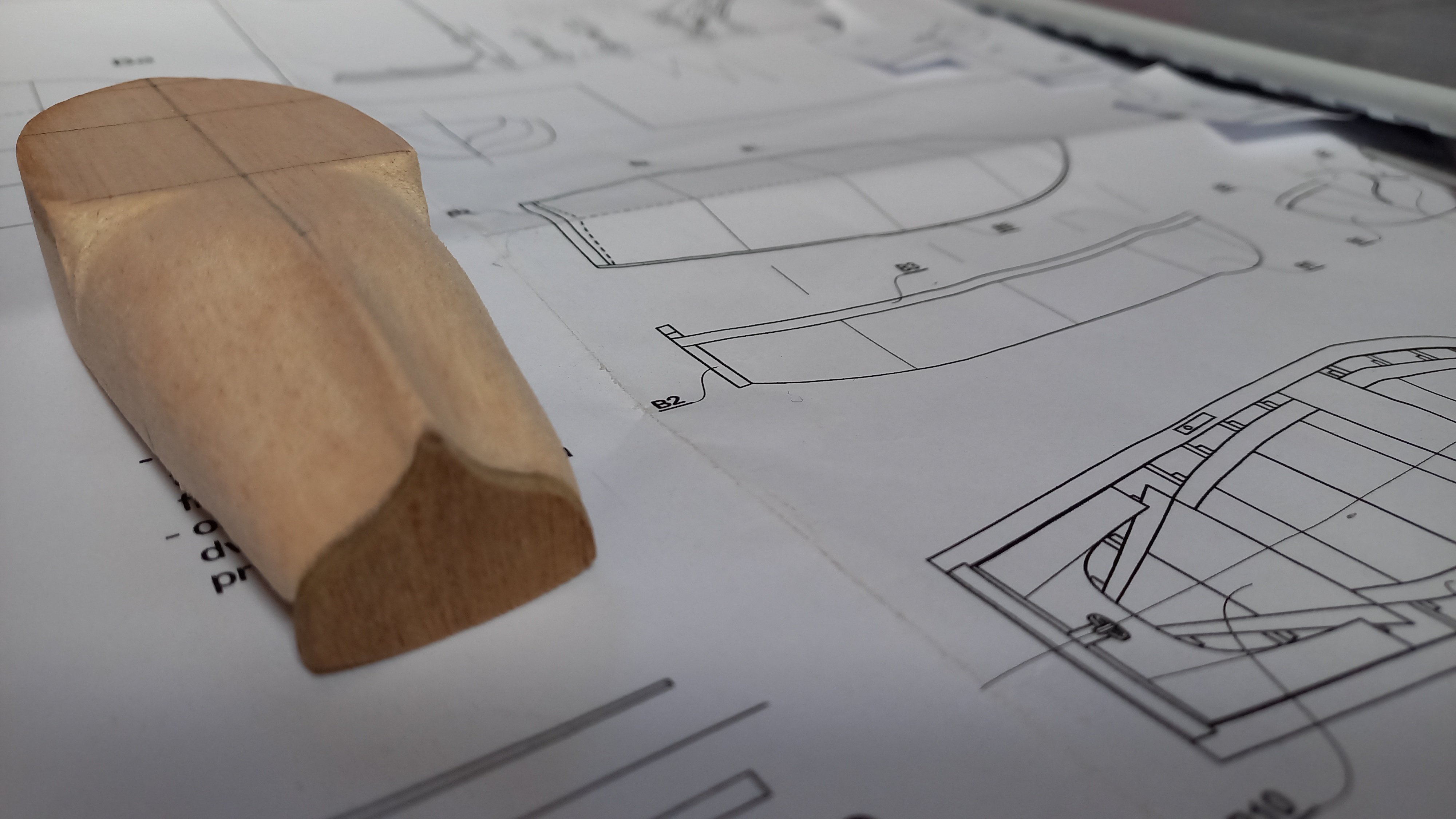

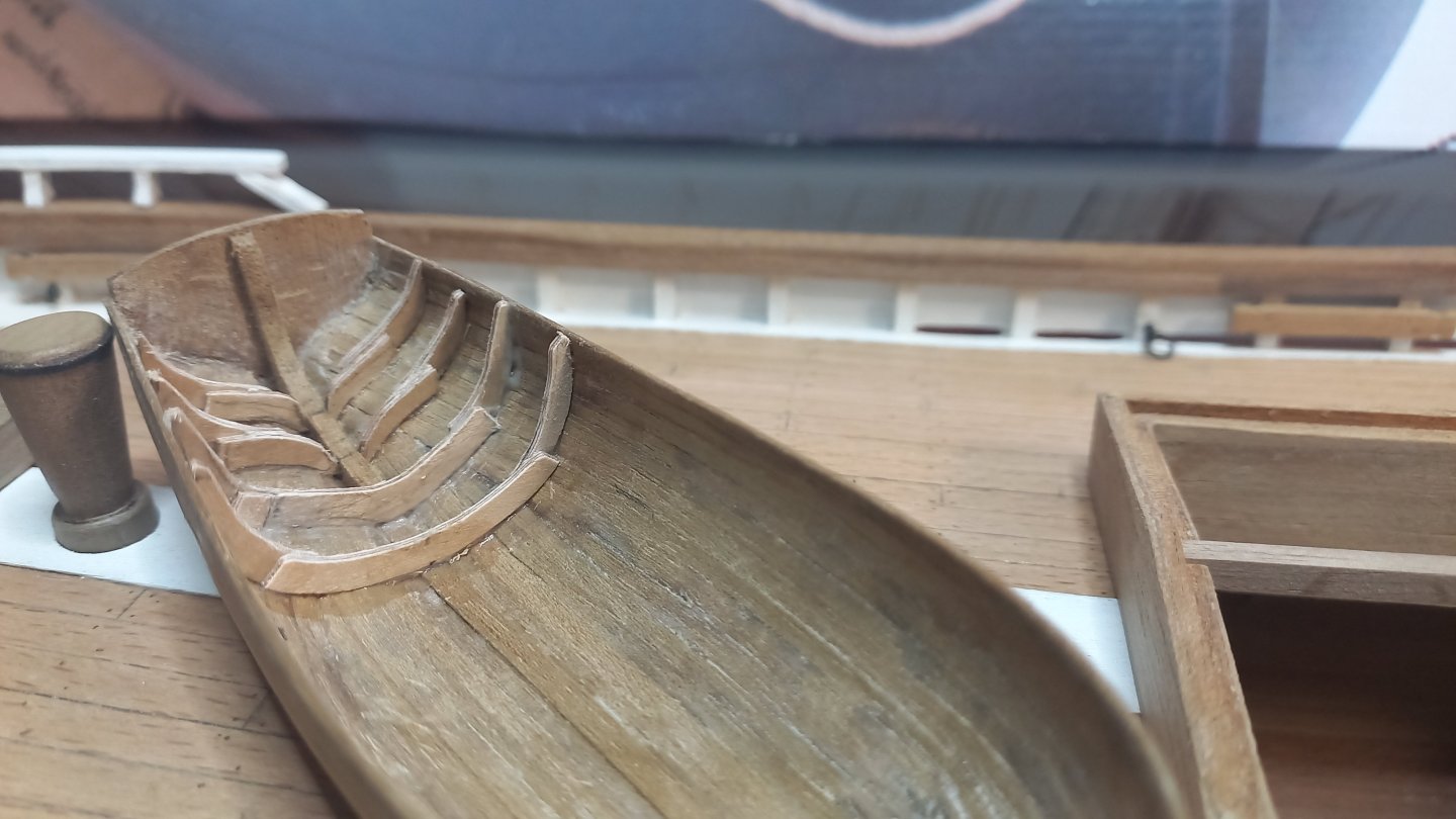

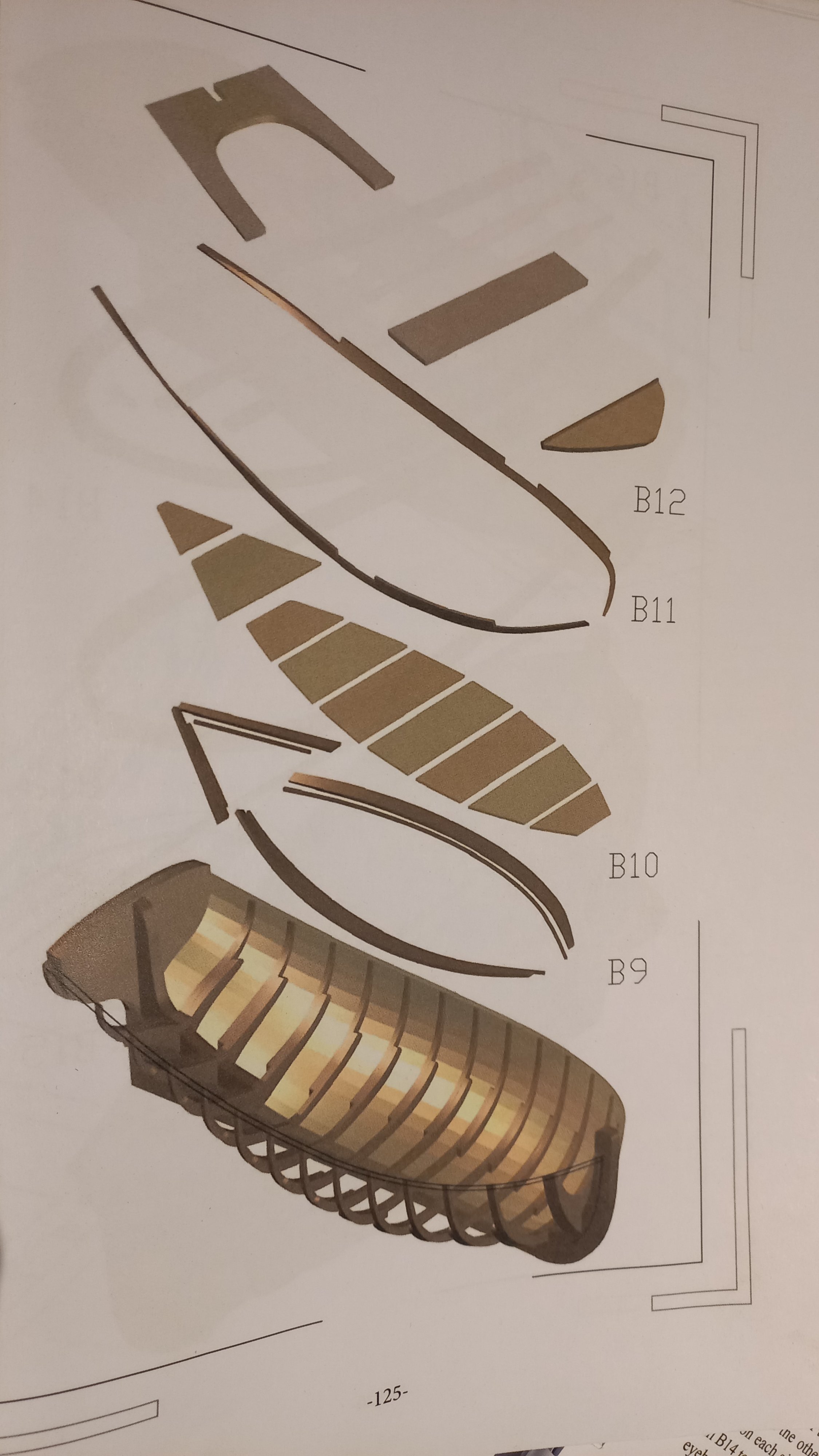

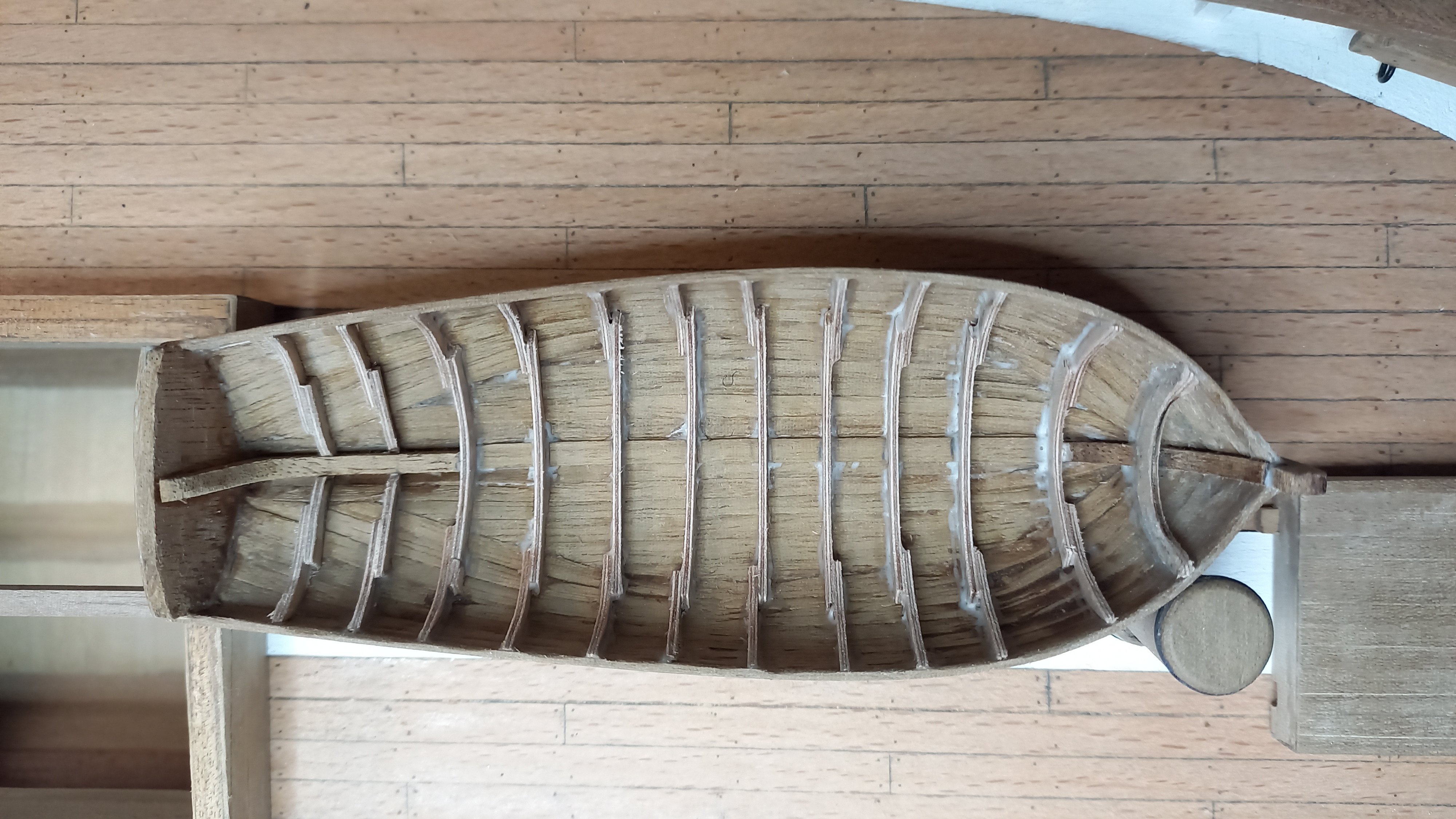

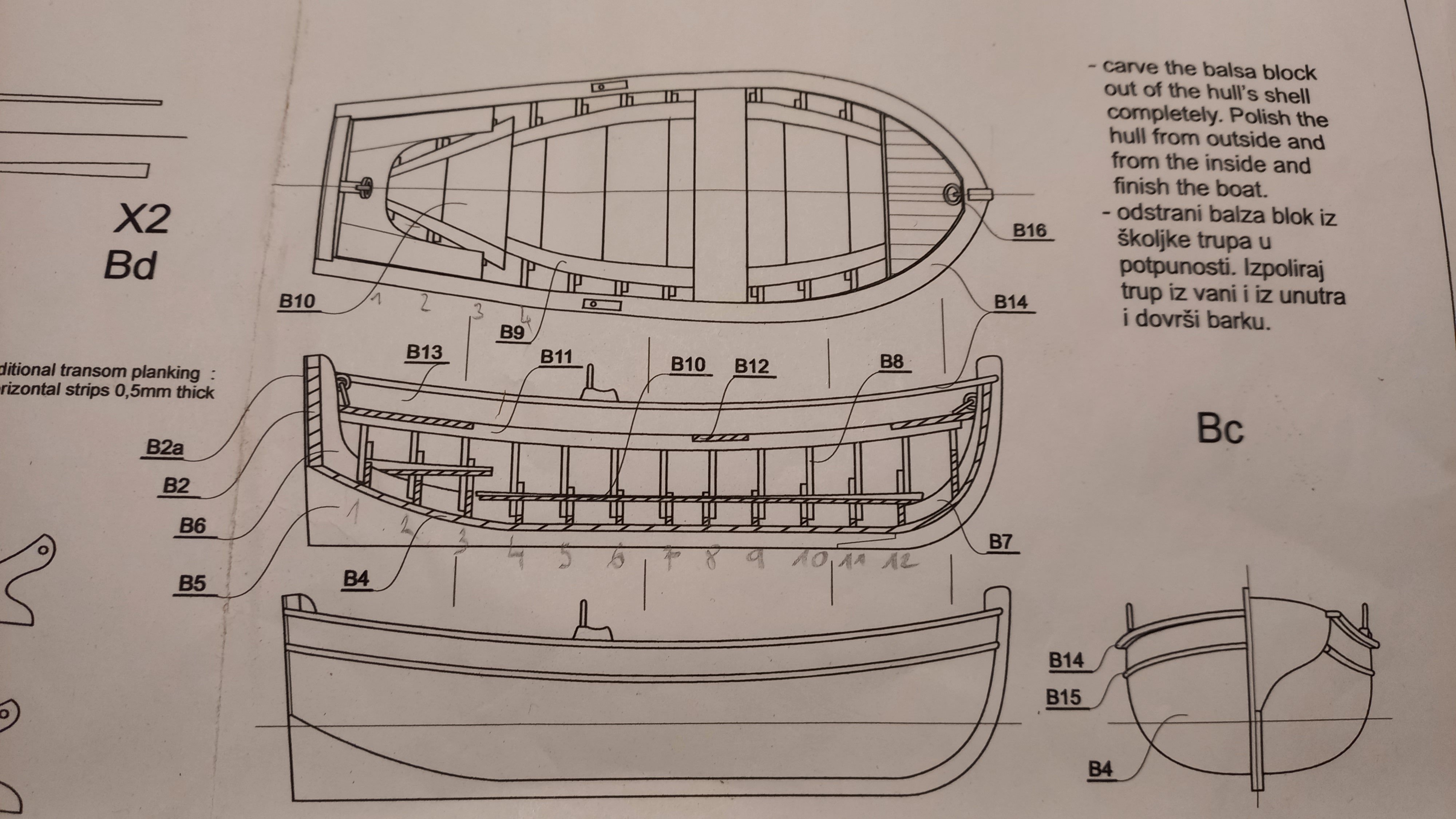

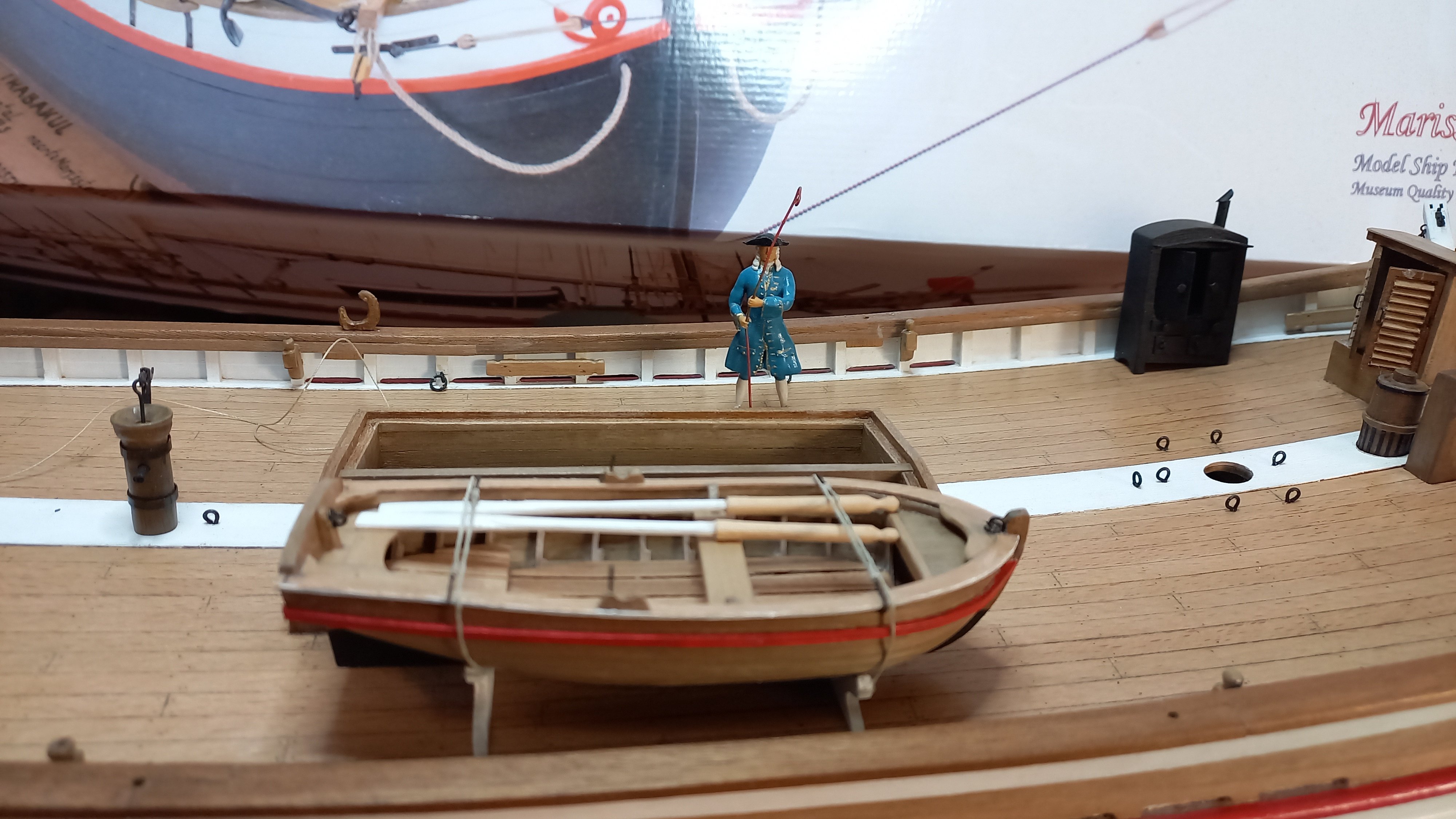

Bonjour, The trabaccolo traditionally carried a smaller boat, which was sometimes towed behind. However, during long journeys, this boat was usually secured on deck. It was typically lashed to the outboard side of the lanyards with a simple rope, either resting against the shrouds or sometimes placed on a dedicated stand located on the deck. The construction of the ship's boat is divided into three main stages. The first involves creating the mould (or 'jig') for the model's hull and preparing it for planking. The second step is the installation and sanding of the transom and planking the mould with two layers of veneer, followed by the removal of the mould. The third stage consists of fitting the outer keel and performing the final adjustments to the model's hull, both inside and out.
