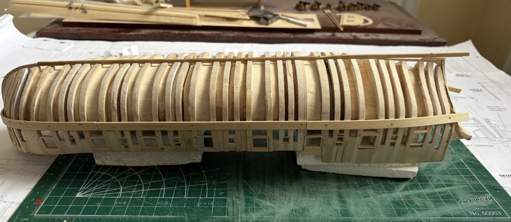

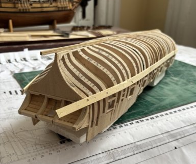

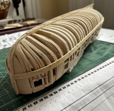

Well, It has been awhile since my last post. I encountered a lot of problems, mostly with the counter at the stern. I removed what I made three times before I got something I’m pleased with. I also had a problem getting the wales to look proper. I did a lot of measuring, and finally got them much improved. The wales and keel are only pined; not glued. Recently I added a ⅛ square keel binned down the middle of the hull. So now I’m ready to plank the hull below the wales. I’m attaching photos of what I’ve accomplished over the last months.
