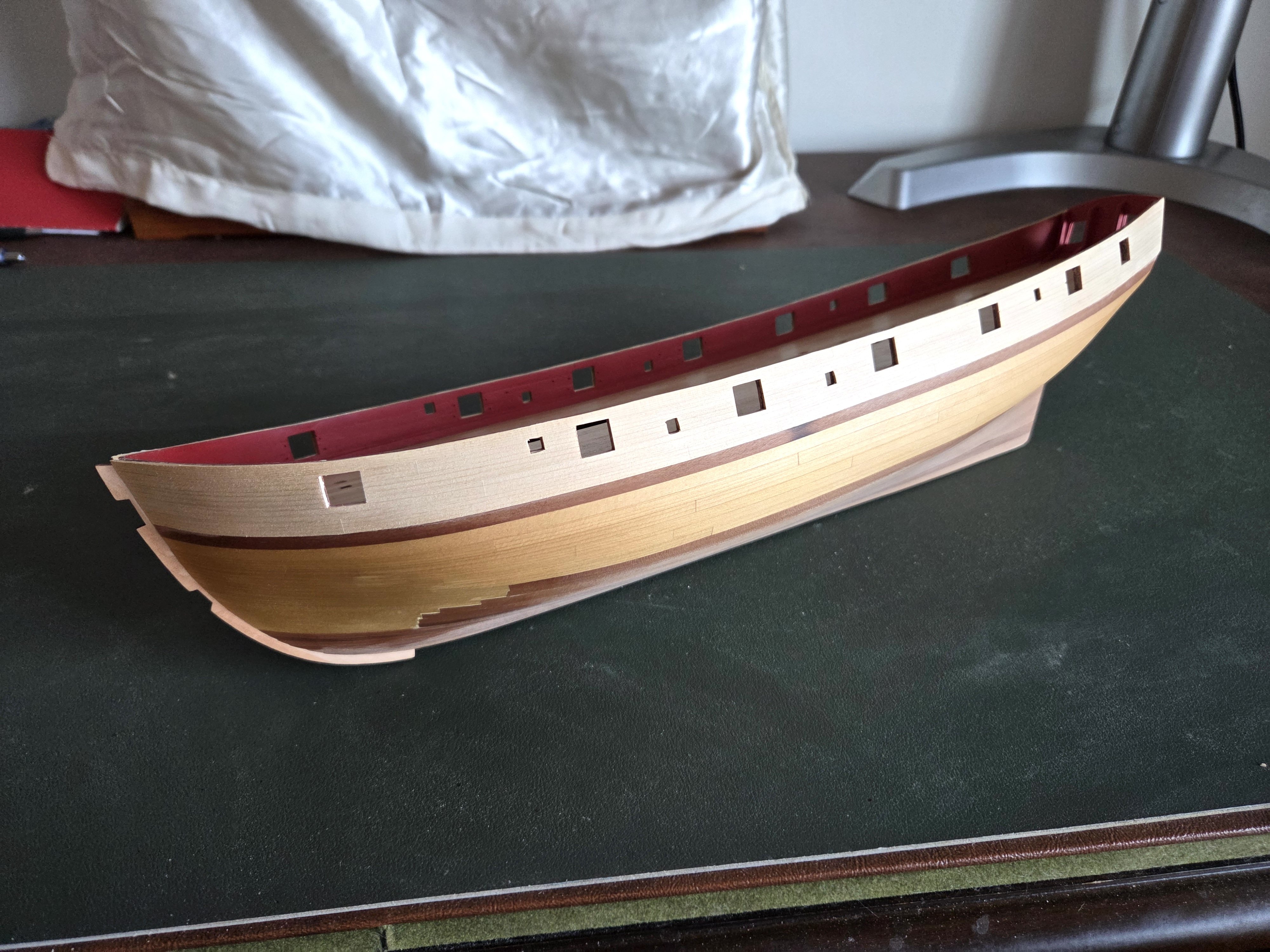

Proof of life:  Speedy has spent a lot of time in stasis, but recently has been making very slow progress. I've installed all the external bulwark planking, and am busily sanding away to smooth it all out. A little more to go there.
I still need to clean up the gun ports and sweep ports, and then hope to be able to apply tung oil soon. It's going to feel like quite a milestone if I do indeed ever finish all the planking on this model!
Current build: HMS Speedy, Vanguard Models 1:64
Past Projects: 18th Century Longboat, Model Shipways, 1:48
                         22 Foot Yawl, Vanguard Models, 1:64
After all this time, this does indeed feel like a bit of a milestone for me on this build. Hull planking all installed, (the wales don't count, right?) and the gun ports and sweep ports cleaned up, and tung oil applied.
I applied the oil to the planking below the wales so long ago that it has a slightly deeper, mellower color than the fresh part does, but hopefully that part too will mellow with a little age.
I have a little repair work to do on the stern, having clumsily nicked one of the planks as I trimmed the ends of the side planking (I'll need to sand out the divot and reapply the finish) and then it is on to the wales.
I am definitely going to be looking through all the Speedy logs I have already bookmarked on this site ahead of diving in to the coppering process, which is a little intimidating to me. Advice and warnings would definitely be appreciated.
