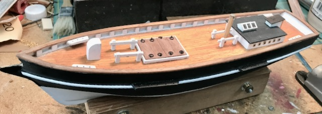

image.png.27a611fae8cbecba841e00680aab5d0d.png I have revived this build. Now being 93 years old I am not liking not doing building. I find my dexterity is failing but I'm not giving up.  I have started adding the deck furniture.  This is where I am at this point.
Fall down nine times, get up ten.
