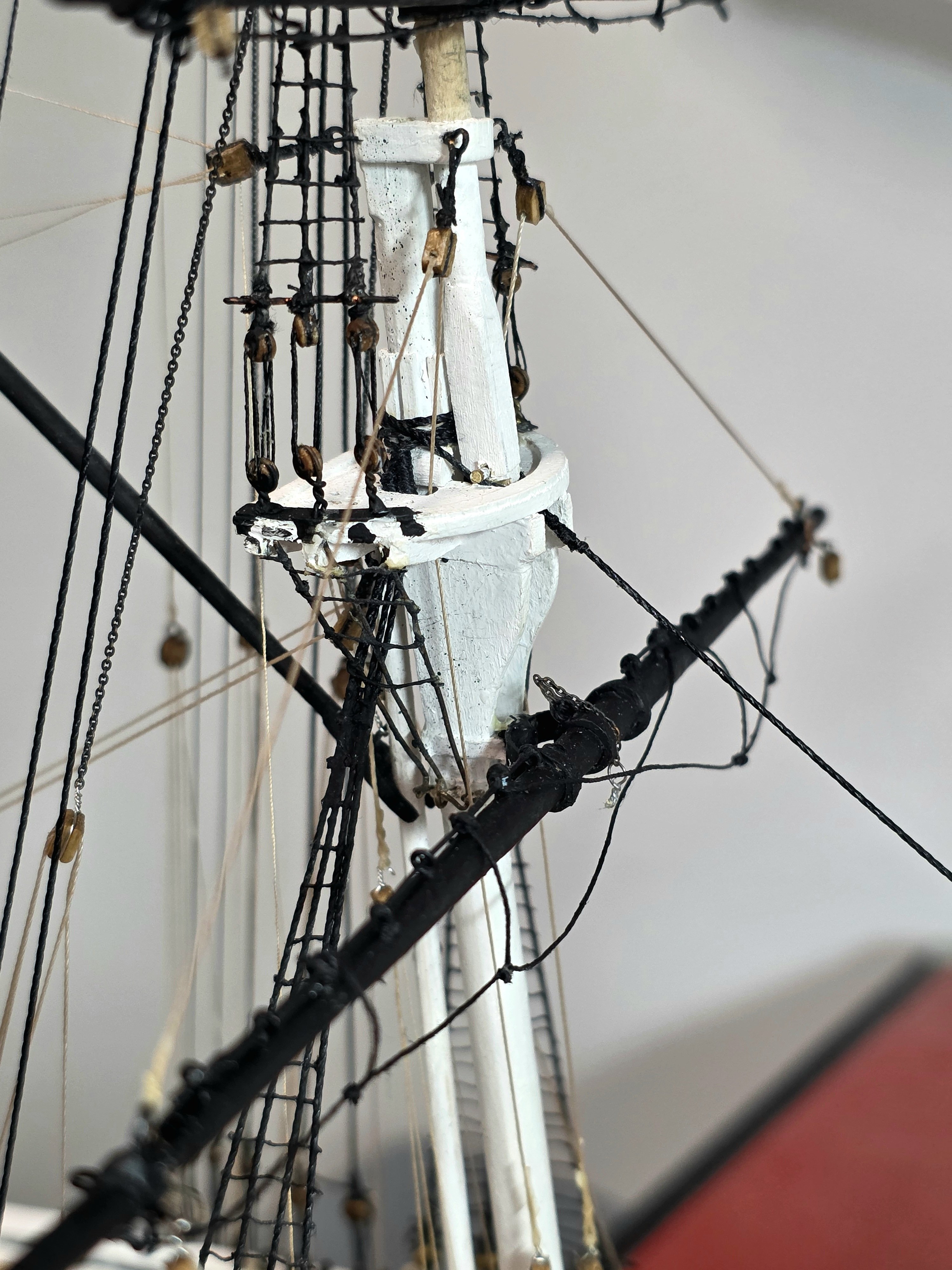

Progress on my Flying Fish has been slow this past month, due to the difficulty of the work involved with the rigging of the lower mizzen yard and mizzen topmost yard.  There were a few times I felt like giving up as the rigging challenges seemed overwhelming, because of the small scale and really tight spaces I had to work with.
However with a lot of thinking I came up with some tricks and compromises which allowed me to complete the following:
1.  Beginning with the mizzen lower yard, I secured the chain sling and the lower mizzen yard lift.
2.  The mizzen topmost was then mounted and the standing lift installed.
3.  Rigging the mizzen topmost halliard was the most difficult due to its complexity and the very tight spaces.  I had to remove the gin blocks from the model to allow me to run the fine chain though them. To help rig the chain I used fine 0.01" dia thread attached to a fine needle to help me fish the fine chain (see photo) through the gin blocks and eyebolt on the top center of the mast.  (I decided to skip creating a gin bolt on the mast).
Another simplification I did was to tie a square knot to secure the halliard to the belay pins.  The belay pins supplied in the kit are too short to allow rigging around the bottom part of the belay pins.  As a rope coil is secured to the belay pins, this hides my simplification.
I have attached several photos to help the viewer see how the lines are rigged.  Unfortunately with the depth of field limitations of the camera lens and numerous outer lines already on the model,  it will be difficult to really understand it all.

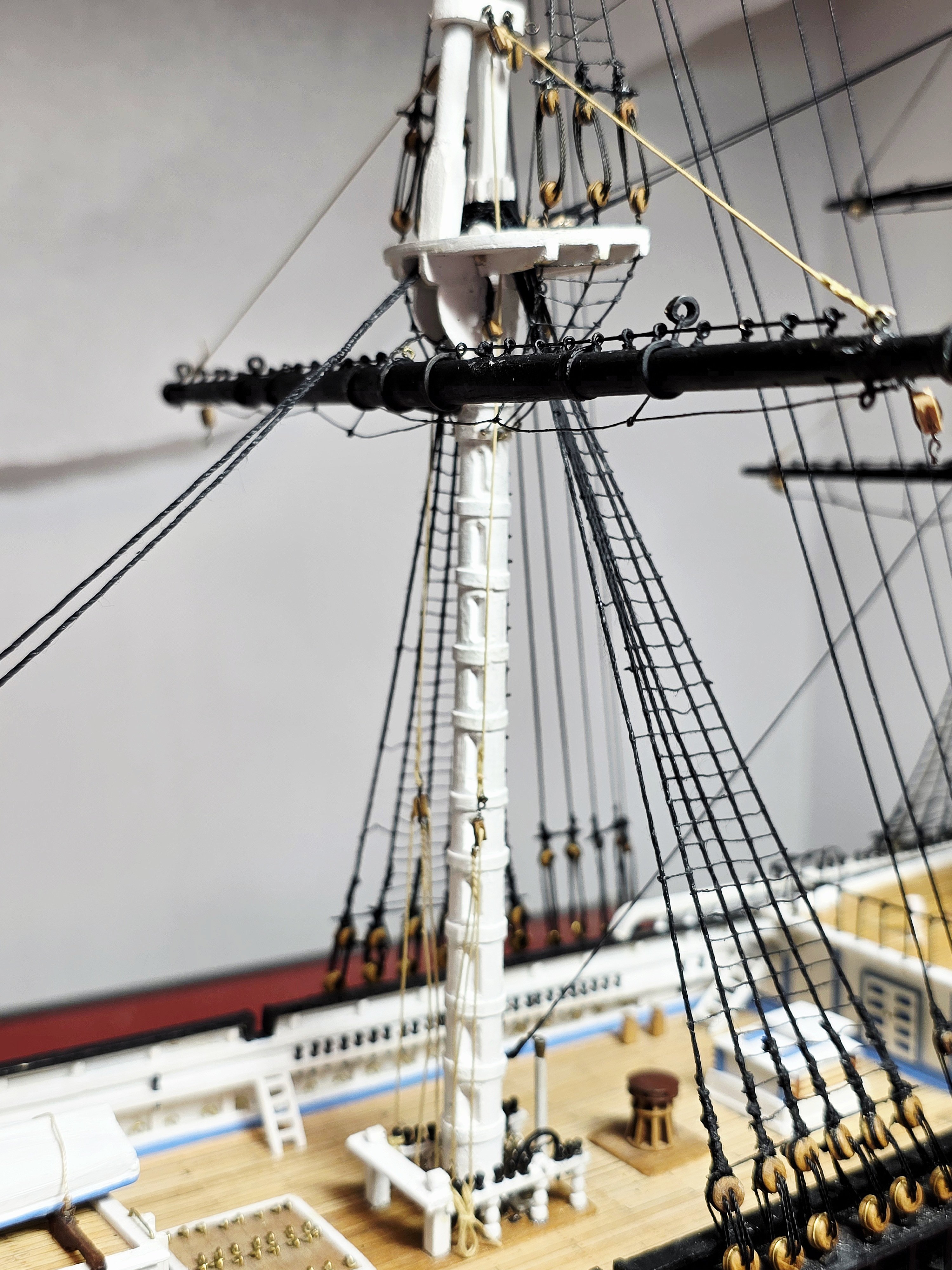

I am pleased to report that I have completed the mounting of all yards on the mizzen mast, along with the yard lifts and halliards.  The rigging of the top-most 3 yards was considerably easier than the lowest 2 yards.  I still have a few rope coils to add to a few of the belay pins.
My plan is to next mount the yards, lifts and halliards on the  for the main mast and then the fore mast, starting in about 3 weeks.
Thanks for looking.

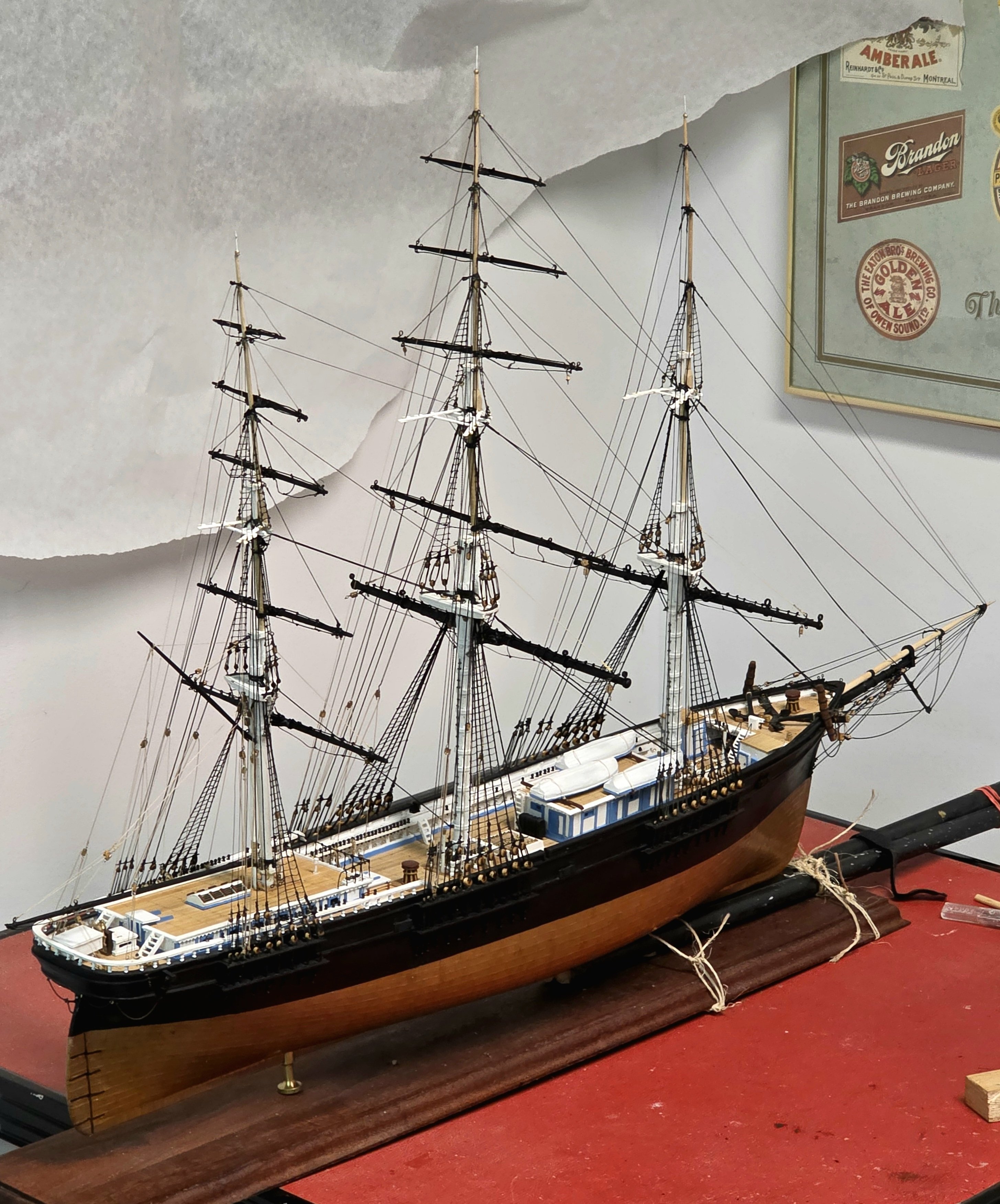

After a great eco-photography break to the rain forests of Costa Rica, I am back to my build.   Over the last 2 days I have rigged the lifts for the lower yard on the main mast, which required a lot of patience.

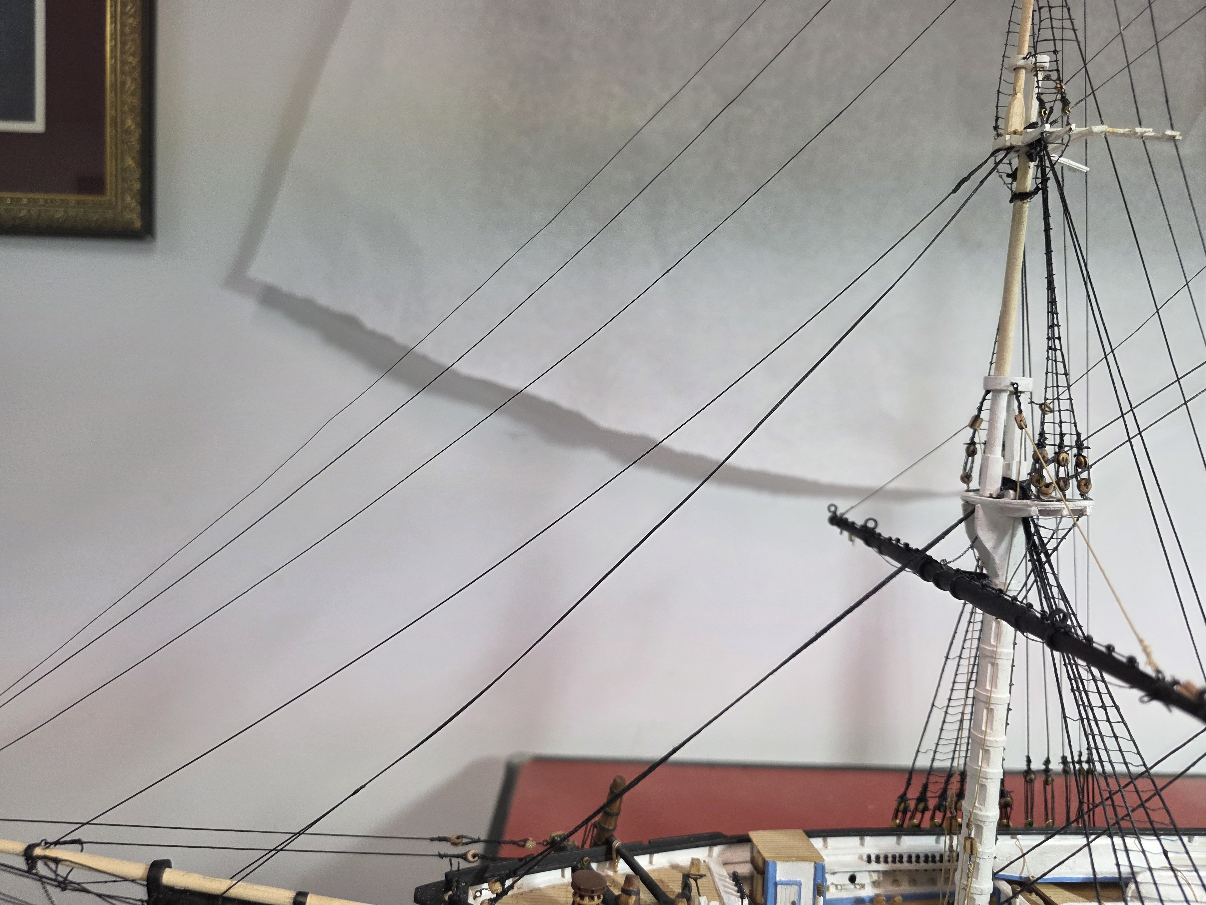

One question I have for the group.  As I proceed through the rigging I am finding that some of the lines have begin to sag.  I am looking for suggestions what I can do about this.   Having to tear out lines and re-rig would be a real nightmare.
Edited by Jared
Hi Jared,
     Glad you had a good time in Costa Rica. When you say that some of the lines are starting to sag, can you be a bit more specific? Are you concerned about the bit of slack in the tackles that are connecting the lifts with the deck or other lines, and if so, are we talking mostly standing or running? I found that I got a bit of slack in the tackles as well. Part of the problem (I think) is that the stress on the lines was bending the yards slightly up, which caused a bit of slack in the tackles. The crane on the model was made of brass, not iron and so bent more easily than on the real ship.
In a couple of cases, it got loose enough that I was able to do a wrap on one of the belaying pins, but I mostly just ignored it. No one else noticed, and real ships tend to not have running lines that are extremely taut when they don't have sails.
Regards,
George
I learned long ago to rig the ropes with barely enough force to pull them straight, without bending anything. This will eliminate almost all slack lines.
You can permanently fix ropes in the straight shape by painting the rope with shellac or white glue (shellac for polyester and white glue for cotton and silk). This is also good for "training" lines to have a  smooth curve or sag where appropriate.
However, I do have this problem on my current build with lines to the fore course (spreader) yard because there are several lines lifting the yard and none pulling down. The yard rides up and the lifts and buntlines go slack. If I had rigged the course the lines to that sail would have pulled the yard down. I can probably solve this problem by weighting down the yard to stretch the lines tight and then fasten (glue) the trusses to the mast. Another option is to drill a small hole through the yard and into the mast, and push a wire or pin through to hold the yard in position.
Phil

Thanks for the suggestions.  The lines that I am concerned about are some of the stays, which are starting to sag as you can see in the attached photo.
I have tried coating the lines with dilute white glue but so far it has not fixed the problem.  I am going to try more concentrated white glue near the rope attachment points once the ship has been completely rigged.

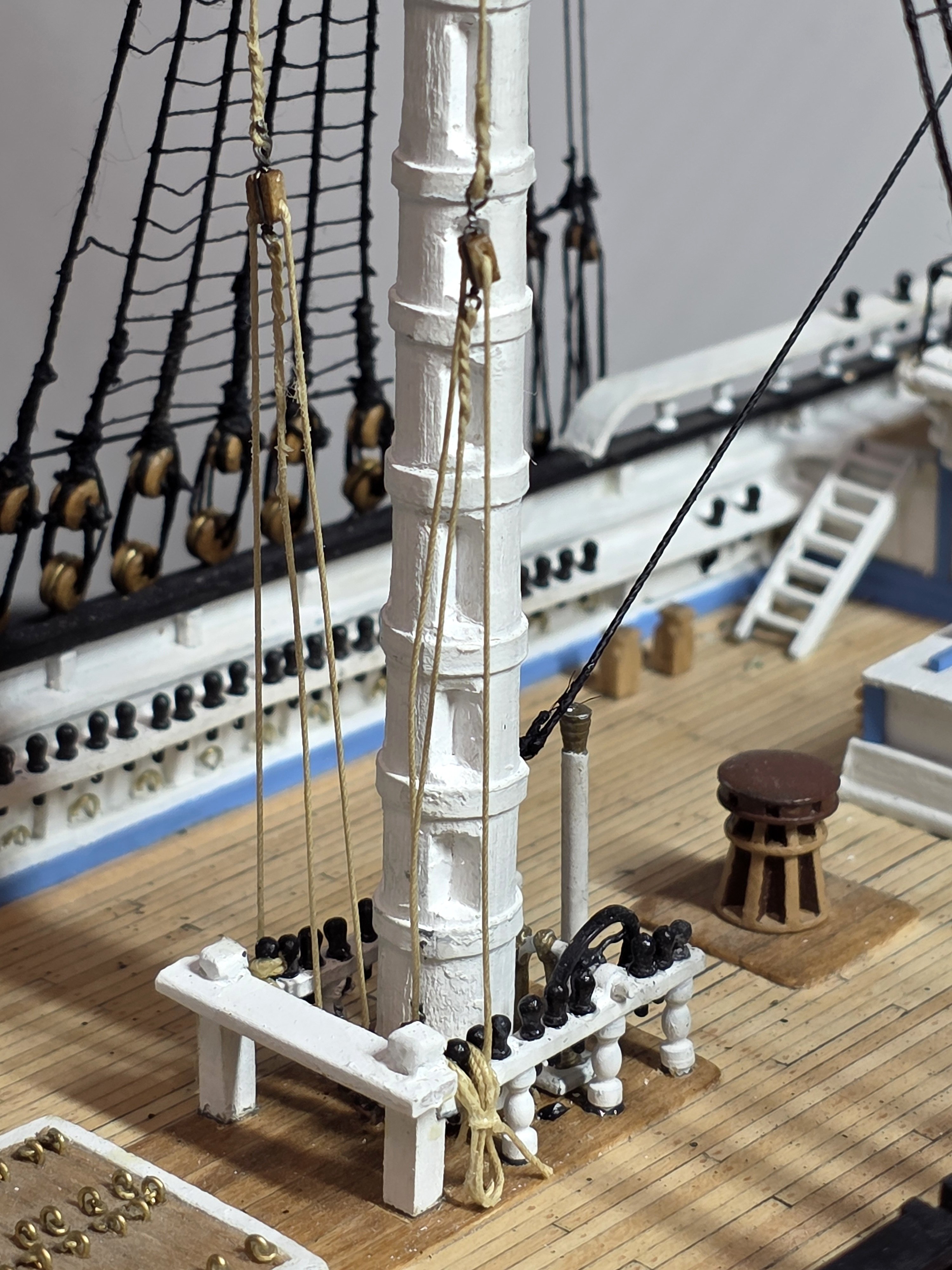

While rigging the lower main yard lift I noticed that I had made an error in rigging the lift on the lower yard of the mizzen mast.  The upper portion of the rope should have passed through the lubber hole and not outside the top see #310 & 313 above).   This has now been corrected.

Jared, for what it’s worth, I’ve been dragging my line through a dilute solution of white glue and then hanging it with weights to stretch while drying, both running and standing rigging.  Don’t have enough running rigging to tell yet, but hopefully the shrouds on the mizzen and main masts will stay relatively tight.  Been gone for last  10 days, so I will check when I get home tomorrow. I anticipate having to adjust the lanyards, but hopefully not too much.
One issue is the change in humidity, high humidity, lines swell and tighten up, dry humidity and line go slack, as I understand it.  The solution of white glue is supposed to protect the lines from moisture.  Running the lines through wax is supposed to do the same thing.
Jared,
    Is it only the forestays, or are you seeing other stays sag a bit as well? If it's just the forestays, did something happen to the bowsprit or the dolphin striker? That seems more likely than the foremast starting to bend forward to any degree.
It is mostly with the forestays George.   There is a tiny  bit of looseness in the bowsprit which I am having difficulty troubleshooting. The give is not much - but just enough to make the sagging worse.  I have tried glue at the base of the bowsprit with a weight attached to the tip but it did not work.  Will try again.
Thanks
Jared, just got home after being away for 12 days and the shrouds are still taut, although I will need to tighten the mizzen shrouds a bit at some point.  Passing the line through the dilute white glue solution and stretching them as they dry, seems to have worked well, as I had a dehumidifier running the whole time I was gone.
Rick
Thanks Rick.  I think some of my lines loosened after probably over tightening other lines.  It really does not take much to do this.  When the rest of the rigging is done I will see what I can do and if necessary, if I can't fix things, I will replace the stays.

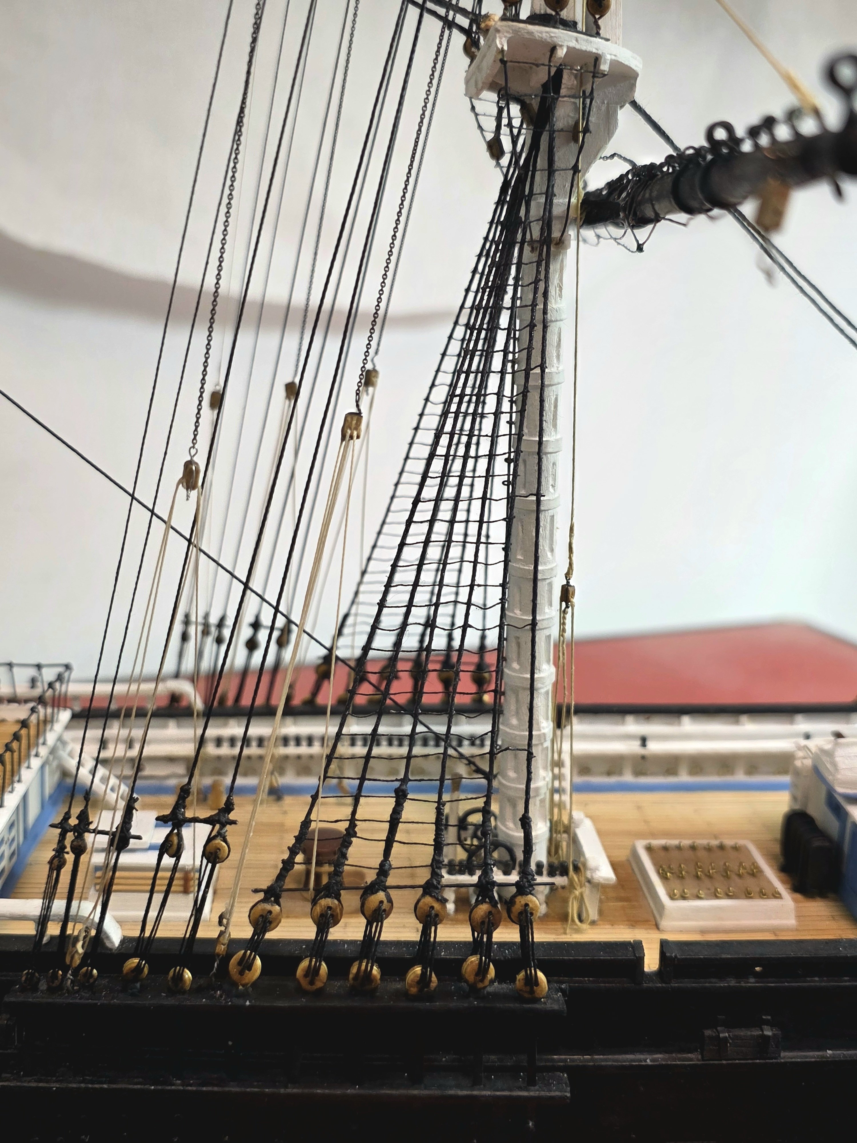

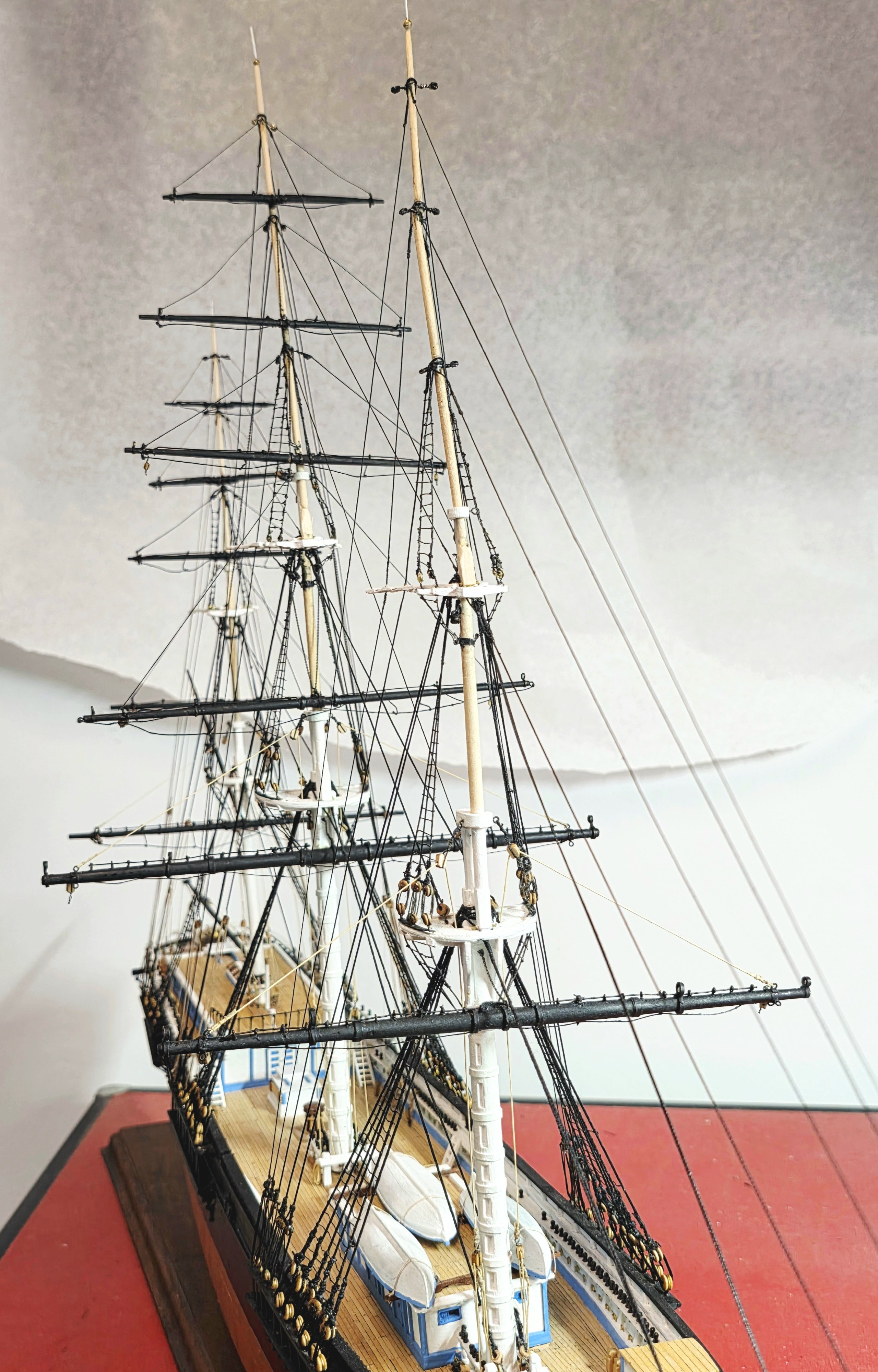

A quick progress report.  As of today all main mast yards together with their lifts and hoists have been fabricated and mounted on my model.  This required a lot of time and patience.  Rigging the main topsail yard hoist was probably the most difficult part of the build so far, especially the weaving of the fine chain through the gin blocks and getting the parts to stick properly to the model.  Next week I will take on the foremast yards!
Edited by Jared
Looking really good! I think the chain really adds some character to the rigging. Are you adding sails to your model? I'm guessing not, as the yards are attached to the masts already.
