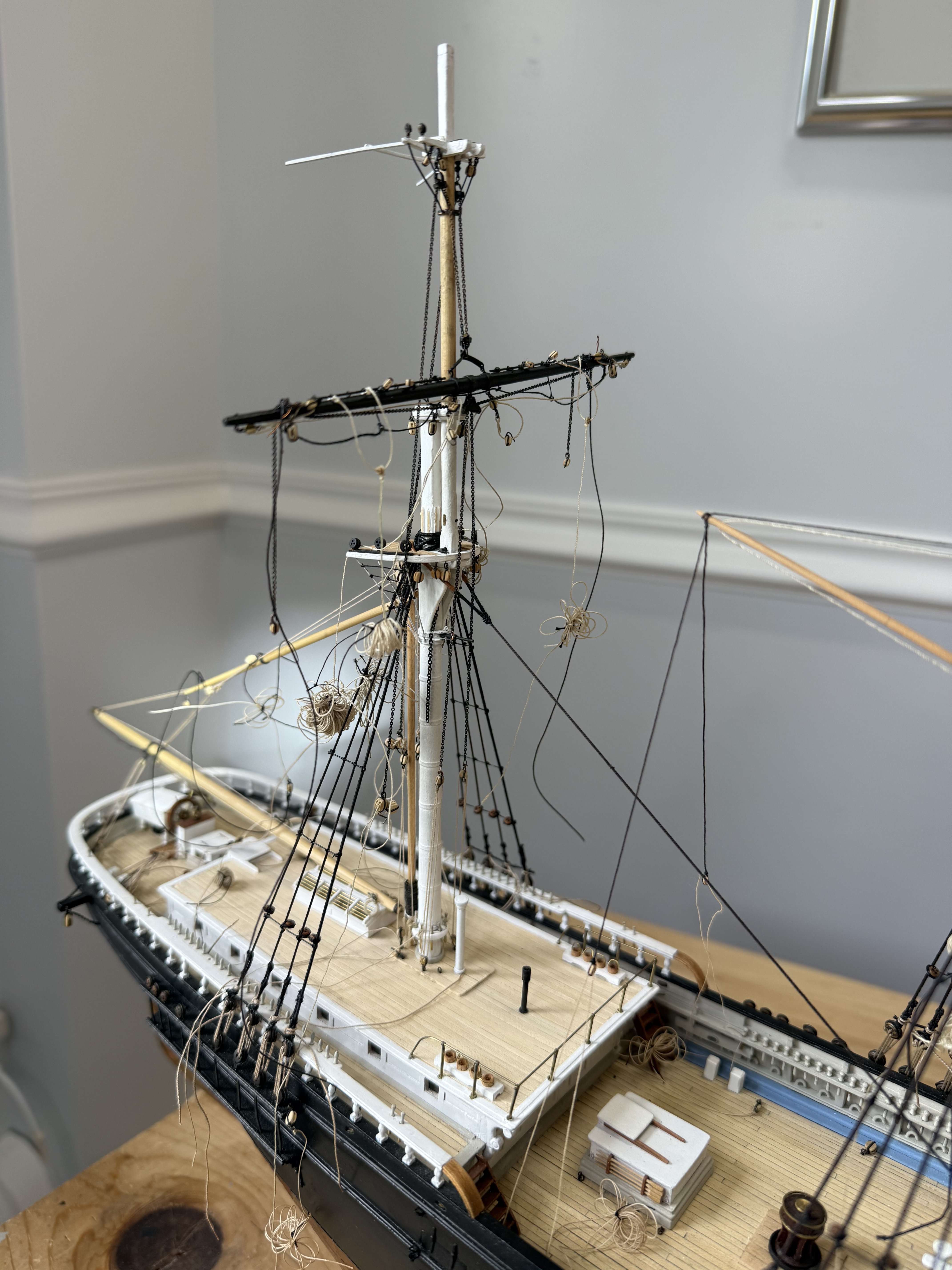

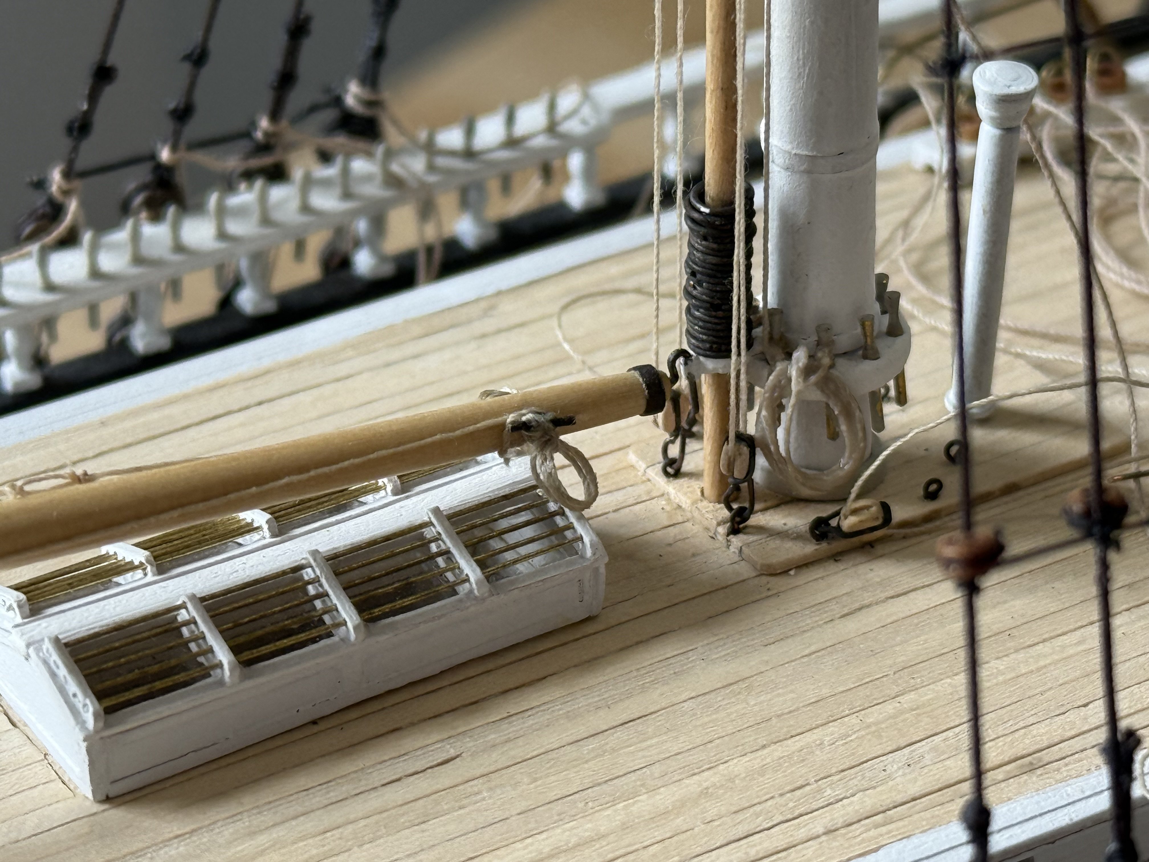

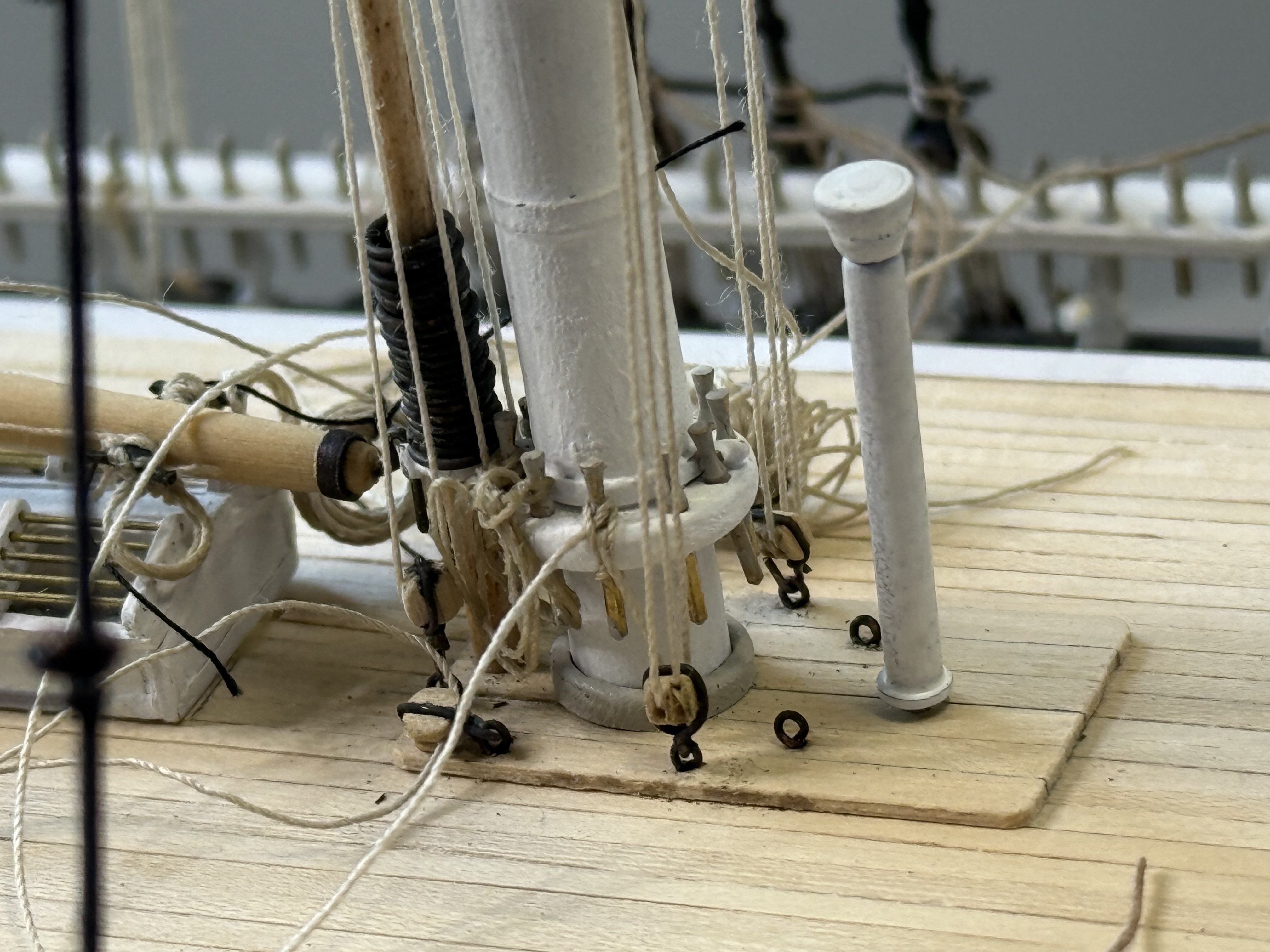

Started rigging the mizzen mast.  I decided to use .025 diameter line from Syren.  This is a bit undersized for the shrouds but I plan to serve the line, which will bring the served portion to approximately the correct diameter.
The thread I am using to serve is approximately .004 inch diameter from Bluejacket.  I will also use this thread for the rat lines.  This is a bit too large but anything smaller I fear will be too difficult to work with.
Several years ago I purchased a serving machine from Syren, forgetting that 3 decades ago I purchased one from Model Shipways(?).  It ended up fortuitous as the one from Syren works great for the shrouds and the other one works well for serving the 28 gauge brass wire sheer poles.  Serving extends from the futtock shrouds to the upper deadeyes on the first ( forward) shroud.
The shrouds were served and parceled per EdT and the Young America.
Serving the shrouds was not difficult and actually enjoyable as long as I gave it my full attention.  The parceling was silk span and painted black with acrylic paint.
I made a jig to hold the upper deadeyes, again, as described by EdT.  This seemed to work well until I went to lace the deadeyes and the last 2 were too long.  All three seizings had already been tied and when I tried to cut them to adjust the length between the upper and lower deadeyes, I damaged the last 2 shrouds on the port side and had to replace them.  I recalled from Nic at Bluejacket that to shorten the length, the shrouds can be twisted to shorten, or untwisted to lengthen   This is what I did on the other shrouds.  The downside is that the upper deadeyes want to untwist and getting them to face forward with the sheer pole was difficult and challenging.  The result of s not as good as I would have liked but I’m going with it.
One difficulty was deciding how long to make the short end of the shroud.  No where could I find any reference for the length, so I arbitrarily went with 12/32 inch or 3 scale feet.  All seizing were placed using a needle which worked well.
Again, not as good as I had hoped with the results but hopefully they won’t be that noticeable and I will get better moving forward.
Sheer poles were added at the junction with the futtock shrouds and at the top of the upper deadeyes. This was the only one I served.  Later, I will add the staves of 28 gauge brass wire.  Not sure if rigid staves are appropriate for 1851, but they will help hold the shrouds in place when I tie on the rat lines.
Starting with the mizzen mast was a huge advantage when I placed the mizzen stay!
After careful measuring and serving, the forward end of the stay was past through the bullseye and seized back on itself.  This was done on the bench.  The fairlead that attaches to the main mast was previously slipped on.  The bullseye was then glued into place, the main mast inserted, and the fairlead glued to the main mast.  The other end was taken through the lubber’s hole, around the mast head, and seized to itself where the serving meets.  This seizing came out much better.  Silk span was wrapped around the serving at the mast head and painted brown to simulate leather.
Additionally, the mizzen spencer’s throat halyards was rigged while it was still accessible.  I left it loose for now.
Finally, I made the in haul/out hauls for both the main and fore spencer booms.  These were attached together with bowline knots and threaded through the blocks  at the Spencer gooseneck.

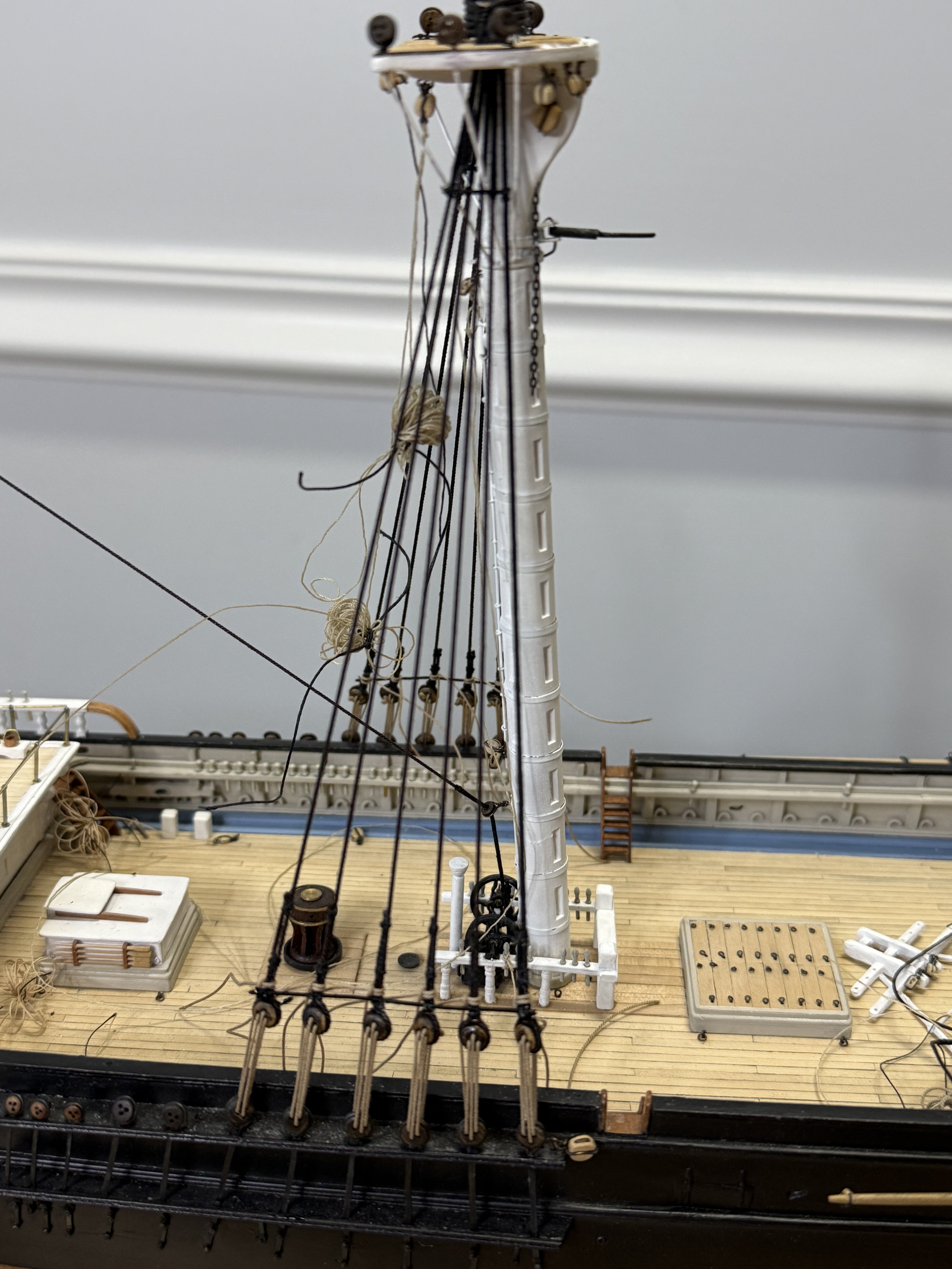

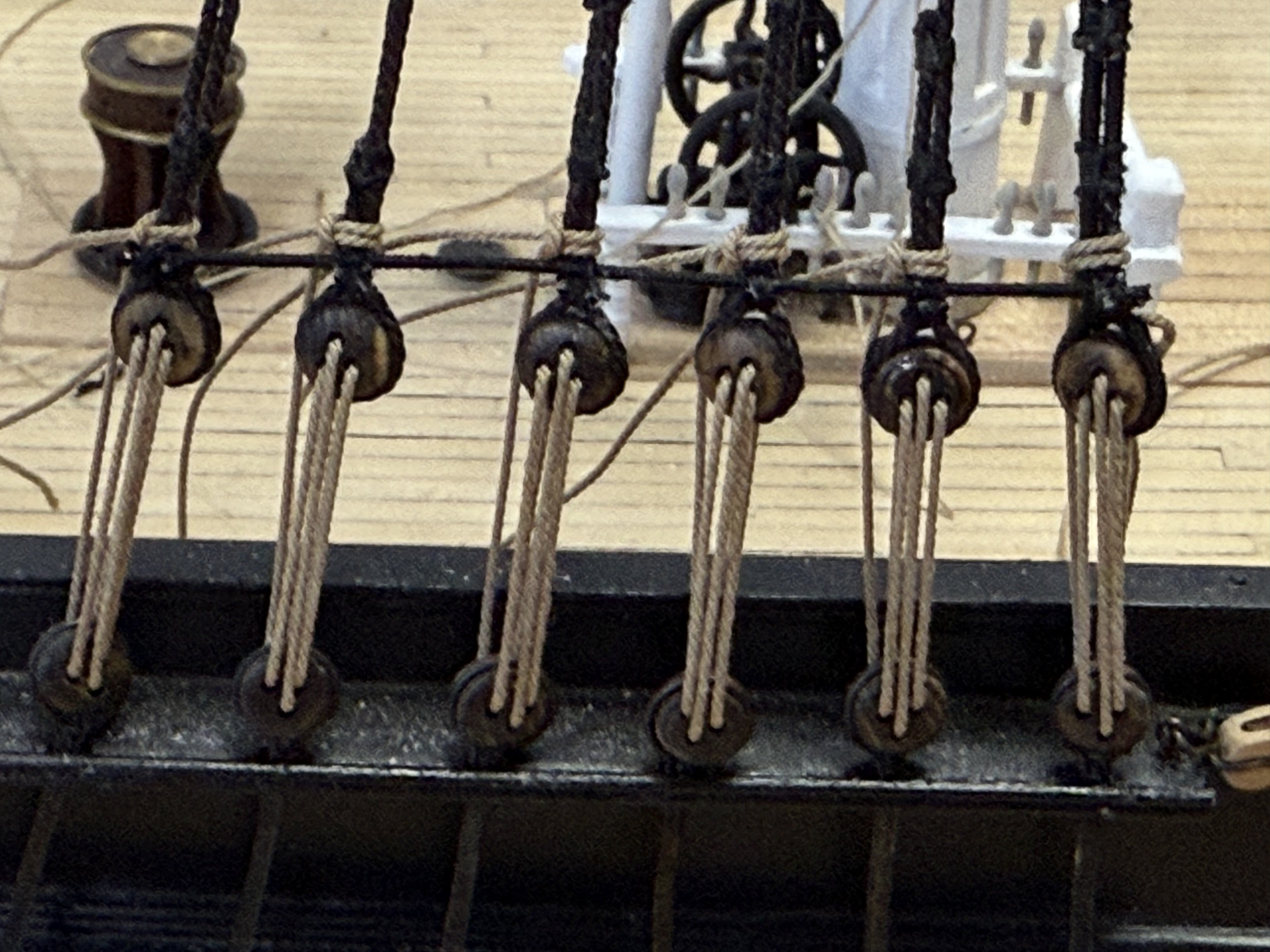

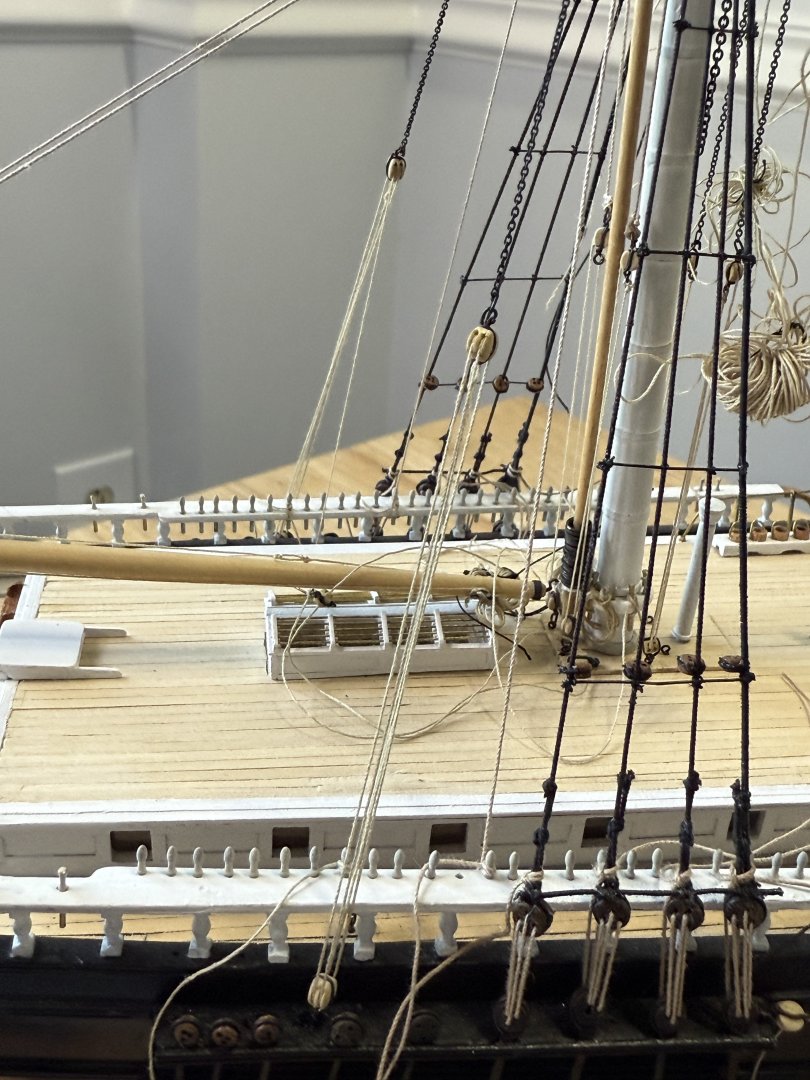

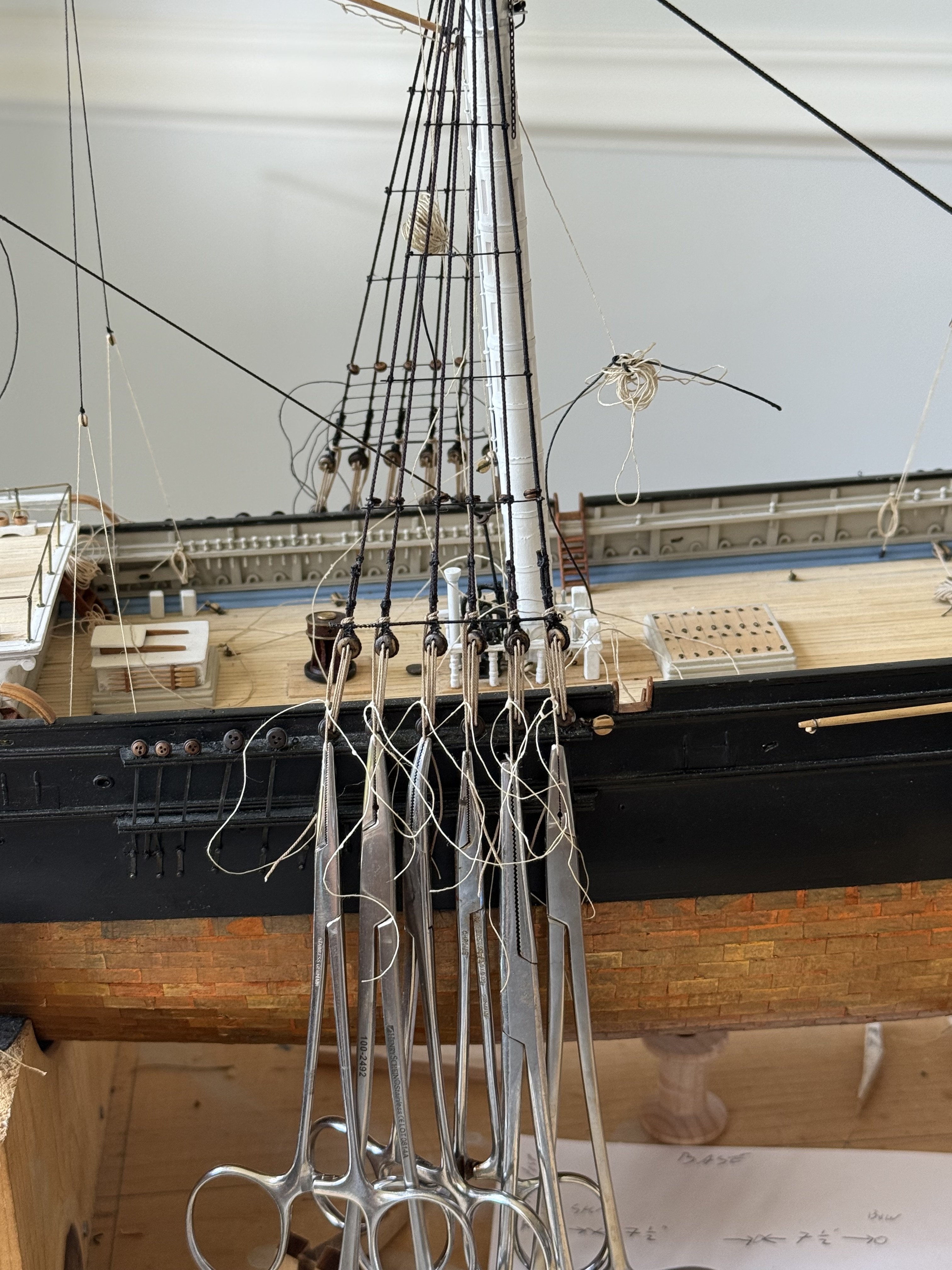

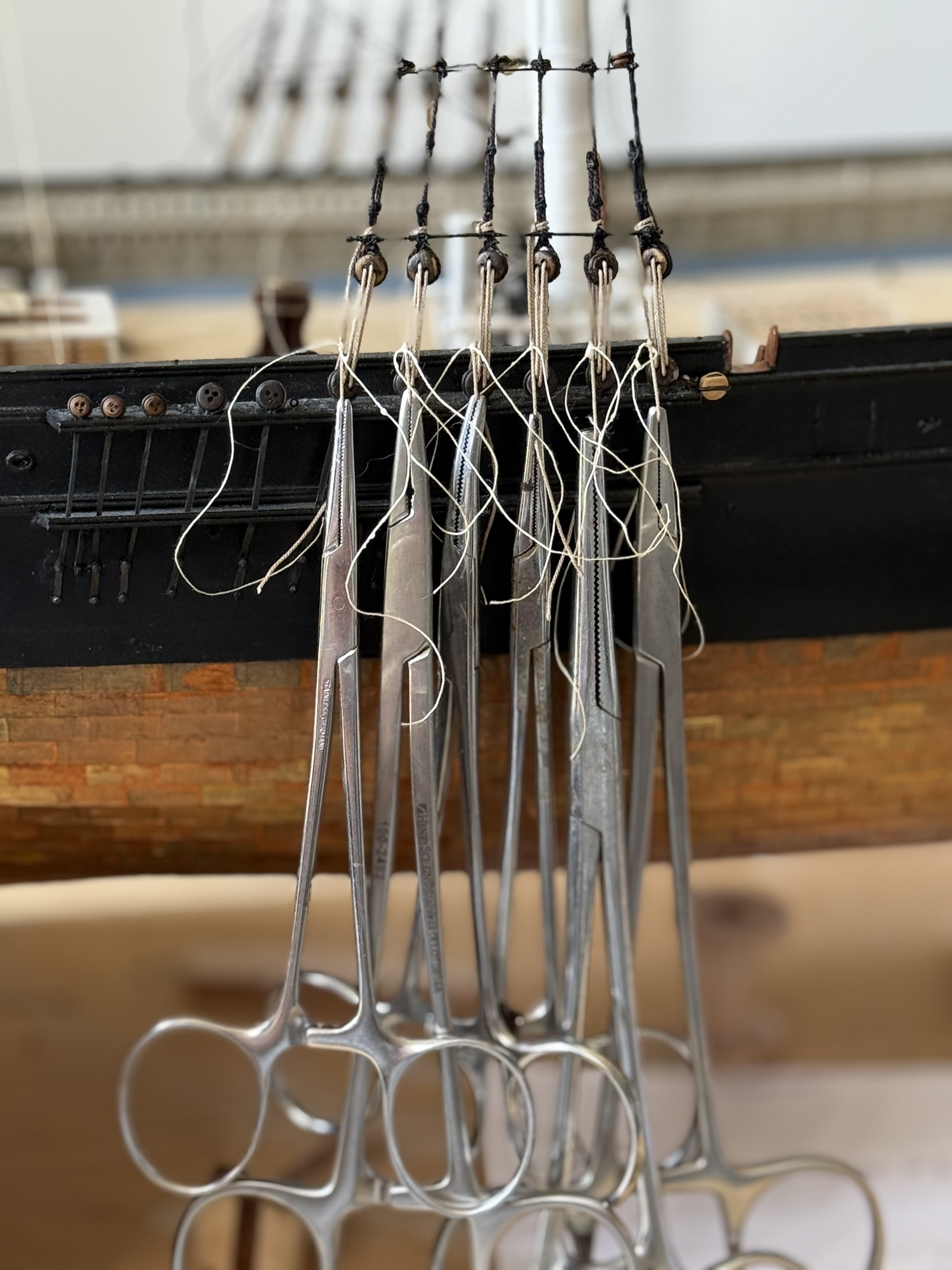

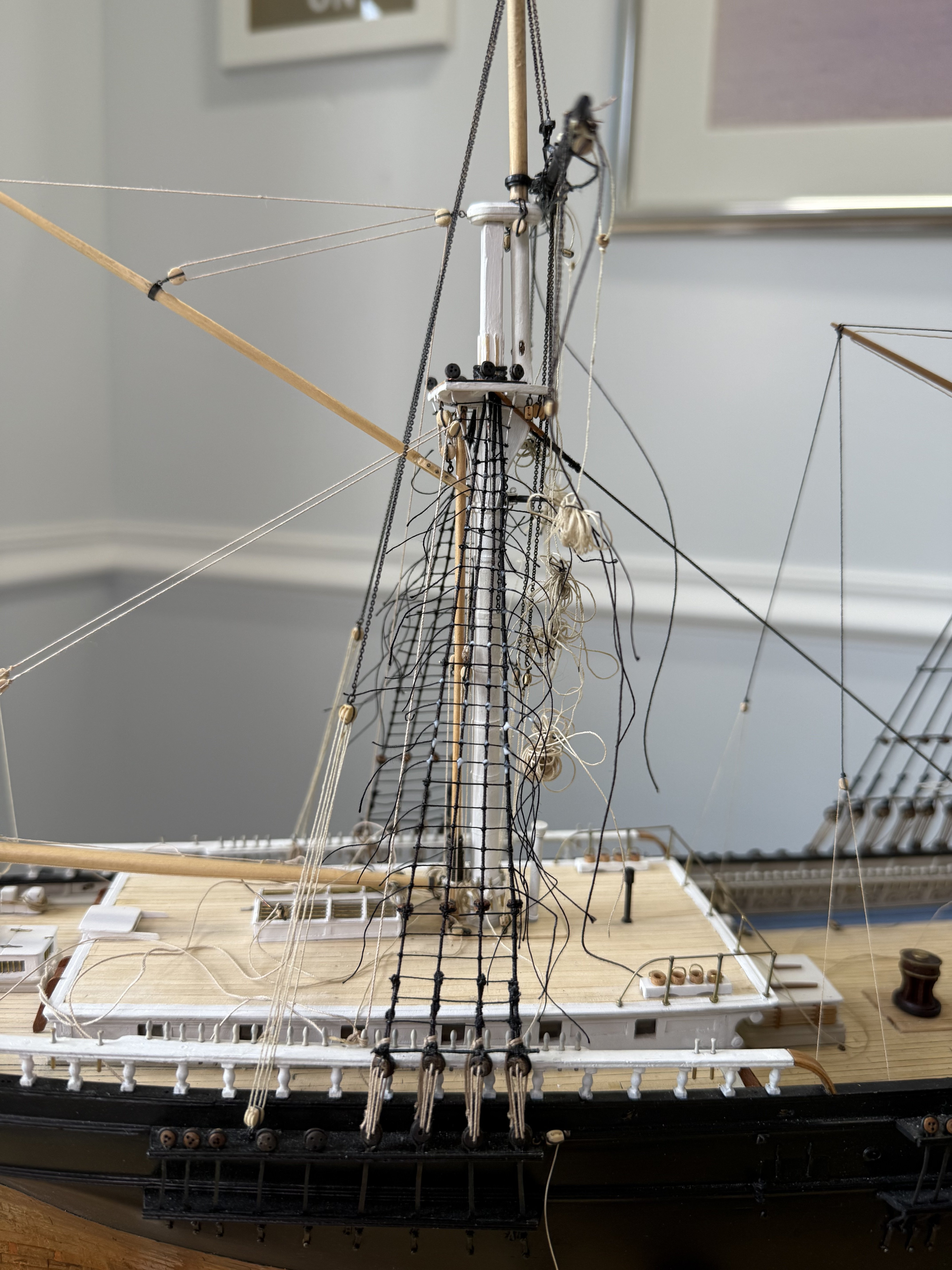

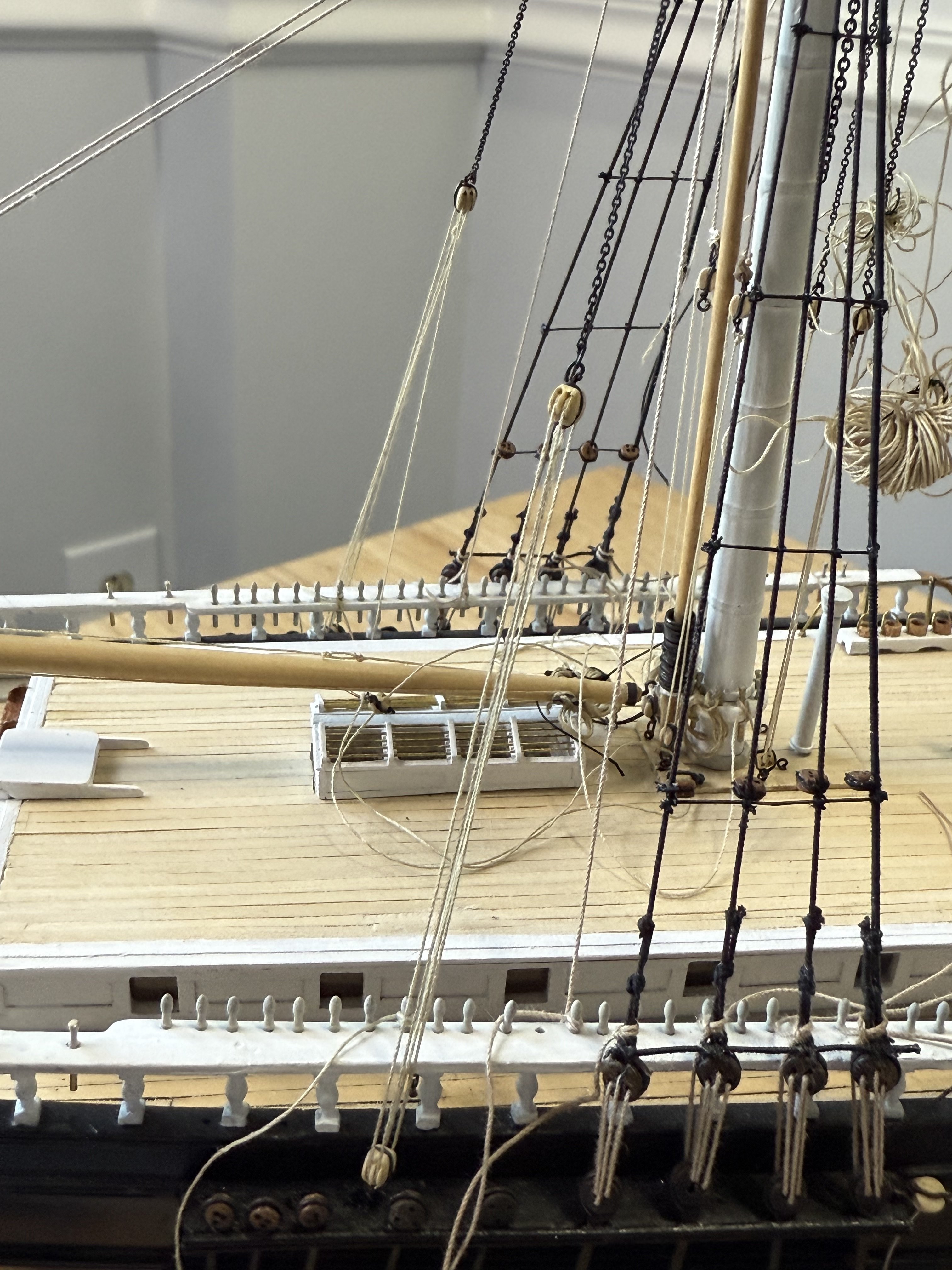

Brief update.  Finished the main shrouds, same as mizzen with serving and parcelling.
It was at this time I realized I needed to rig the main yard lift tackles. Access to the mizzen and fore mast is straightforward, as I have yet to place the fore cabin. but the main mast is severely restricted.  Should have rigged them prior to stepping the main mast.
After strapping 3/32 single blocks with 26ga copper wire and rigging the tackles with .008 line, I was fortunate to get the lower blocks into the eyebolts next to the mast by working under the fife rail.  Would have been much easier before the masts and shrouds placed!
Next up are the other lift tackles and the main stay.  Working from aft, forward has been much easier than forwards aft!!  Thanks Rob and George for the great suggestion!!IMG_4600.thumb.jpeg.64959354544a215bf6accf479ecd6fc6.jpegIMG_4602.thumb.jpeg.5f4c62b1c239f3b8cbf548d48048261d.jpegIMG_4601.thumb.jpeg.b8f0fca4ddfbd0555381f3ec2d516865.jpegIMG_4604.thumb.jpeg.b82fef3796b88627a5f24e9c0175612a.jpeg
Right...much easier working away from your work, then past your work...where bumps can happen.:dancetl6:  I go so far as to add all the backstays and the booms as well.  Rig that mizzen out....then move forward...and so on....

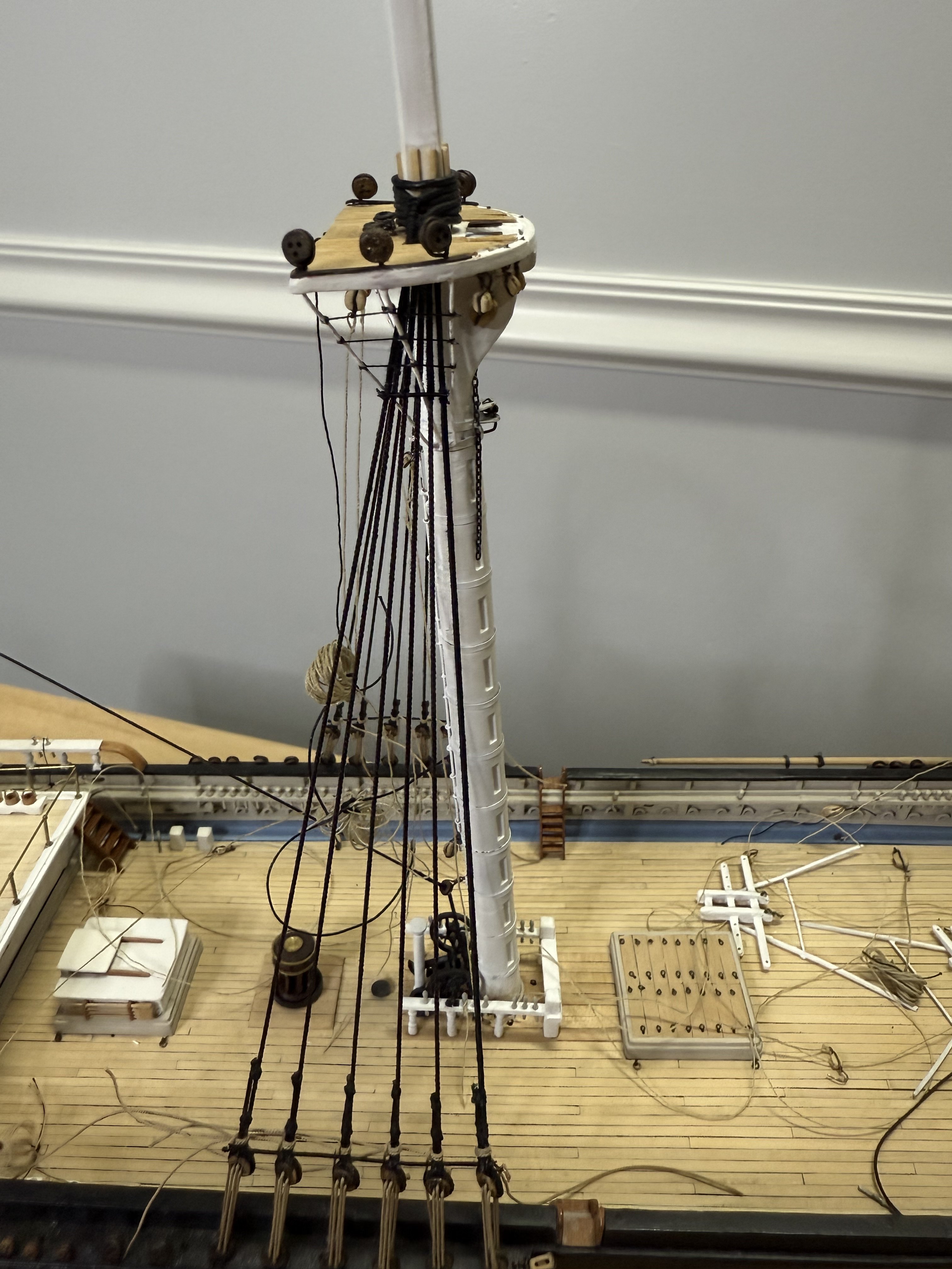

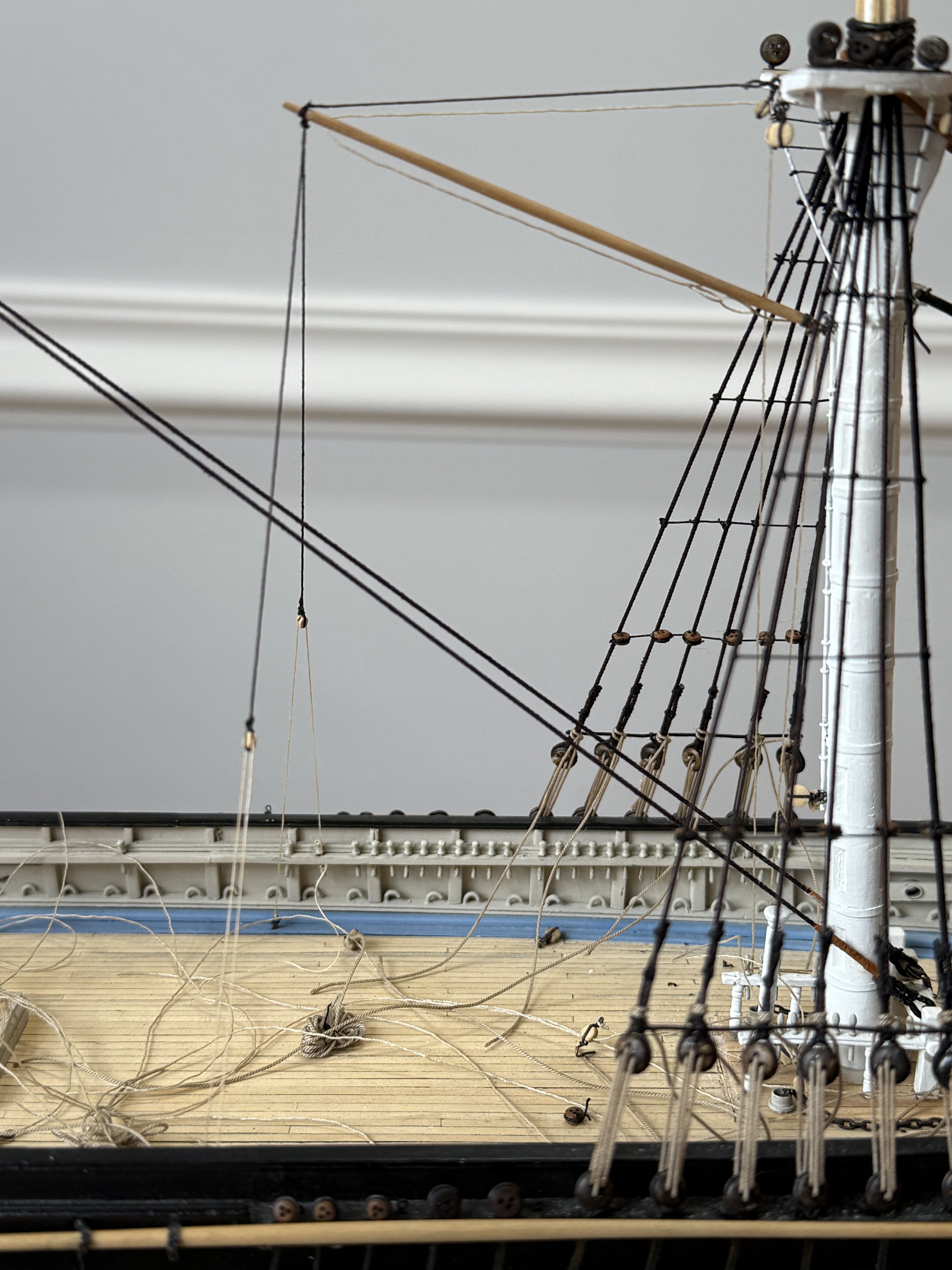

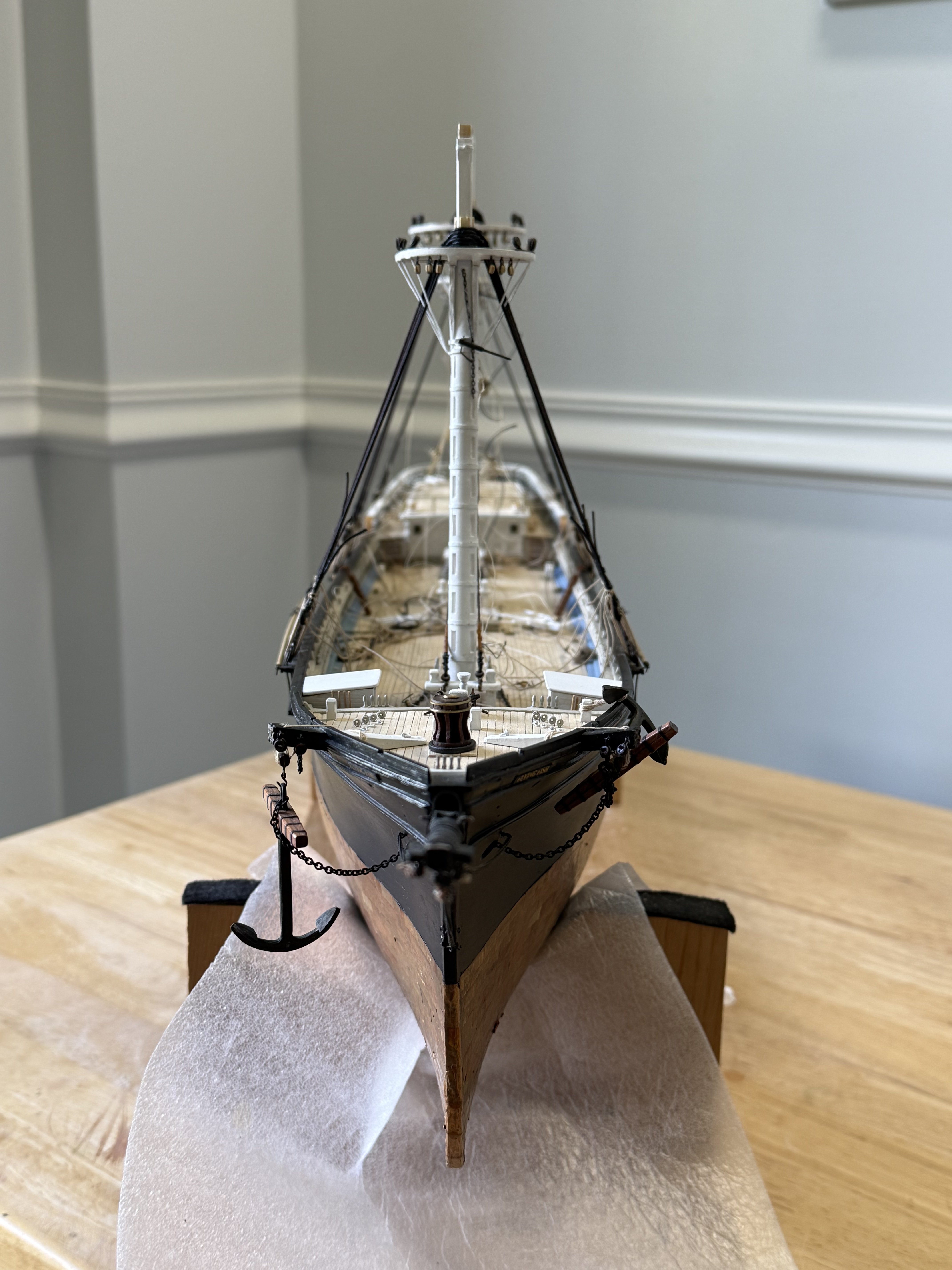

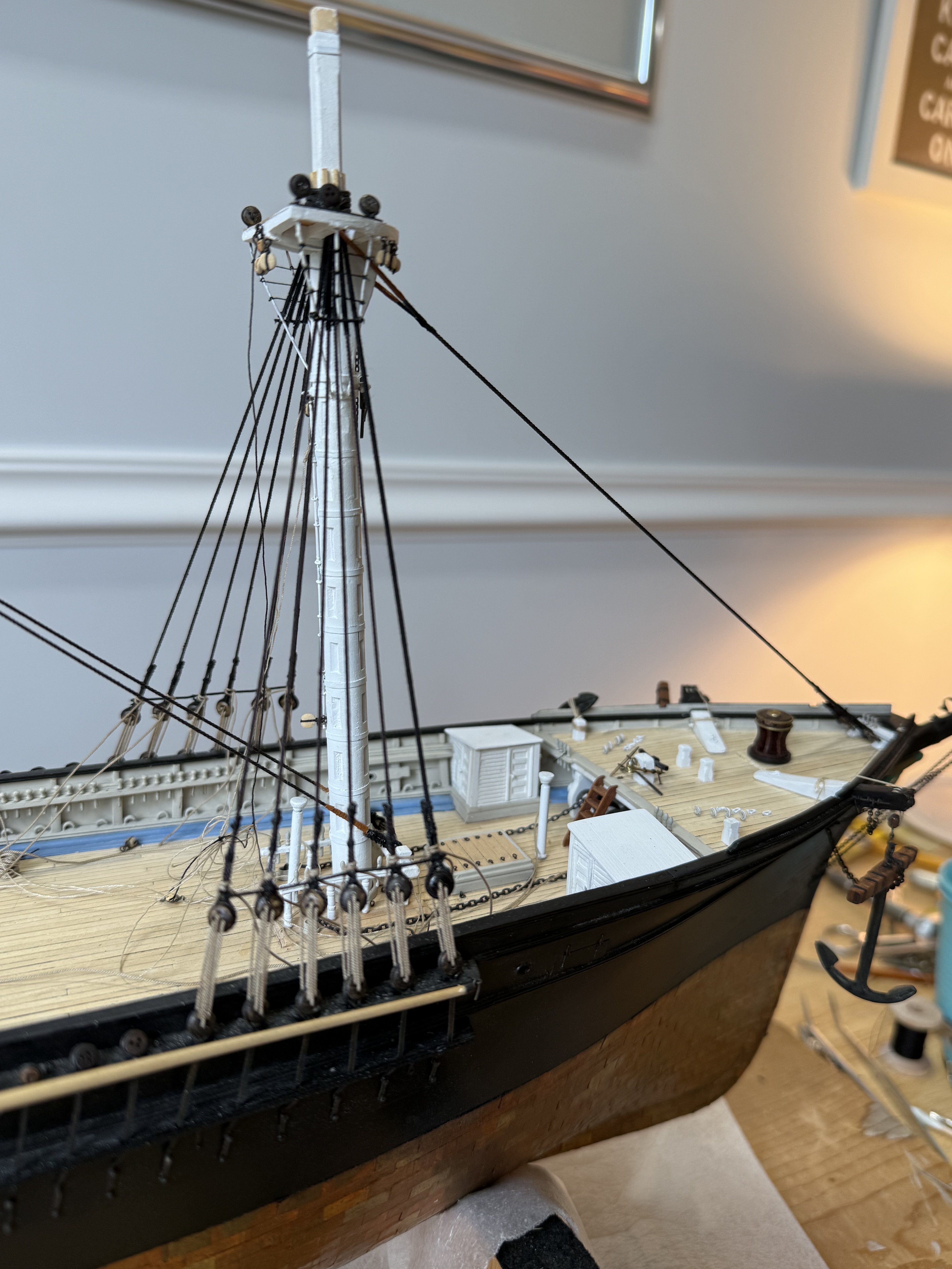

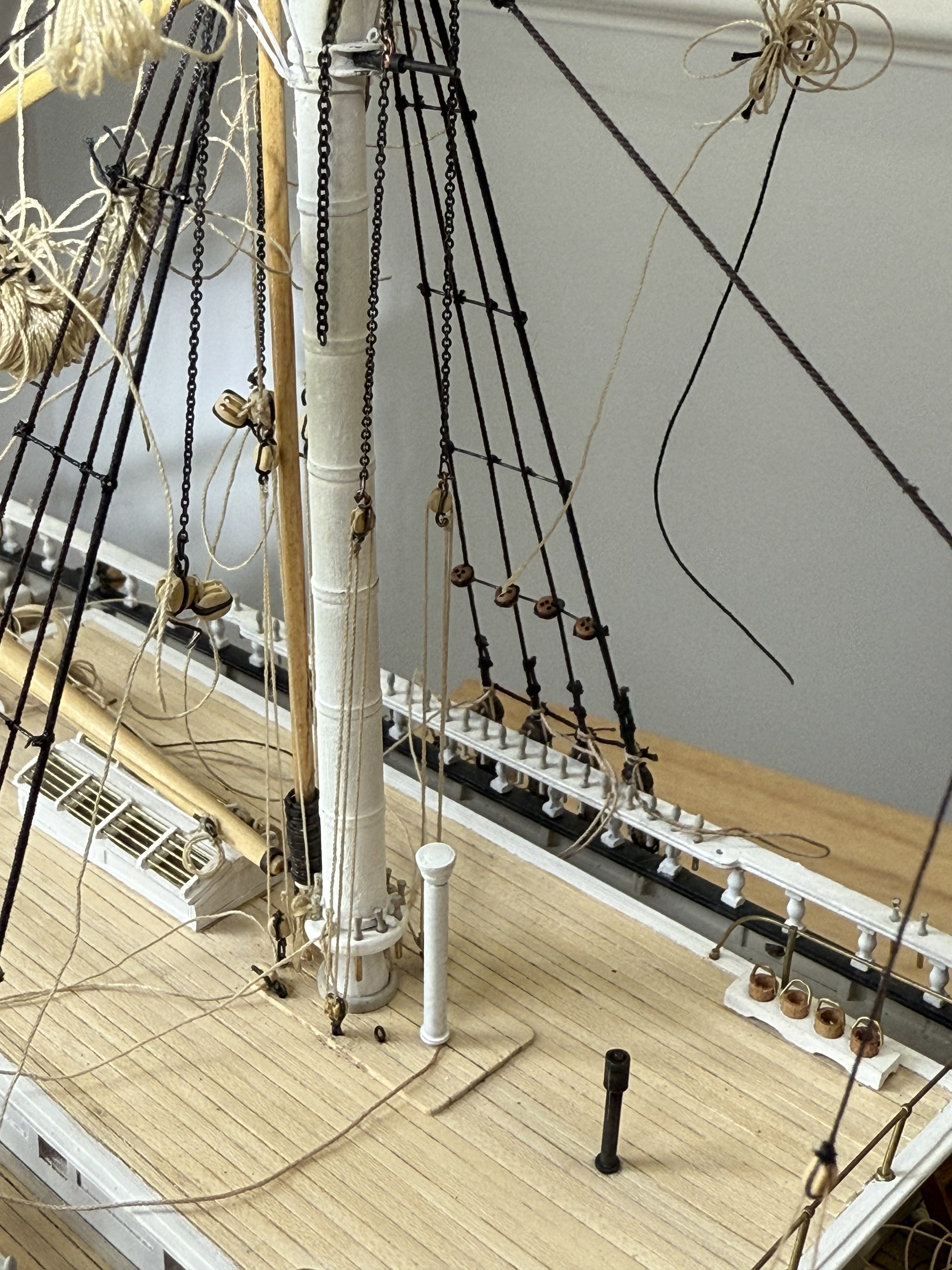

Finished the fore mast shrouds, with serving. parcelling and leather as per the main mast .  Took 2 attempts to get the fore stay right.  First attempt, I didn’t account for the line stretching, which caused the 2 legs to be misaligned in regards to the serving and leathering.
Second attempt came out really well until I noticed that the legs were crossed. This necessitated  cutting all 6 seizings which of course damaged the serving , which then had to be repaired. Self inflicted wounds are much too common!

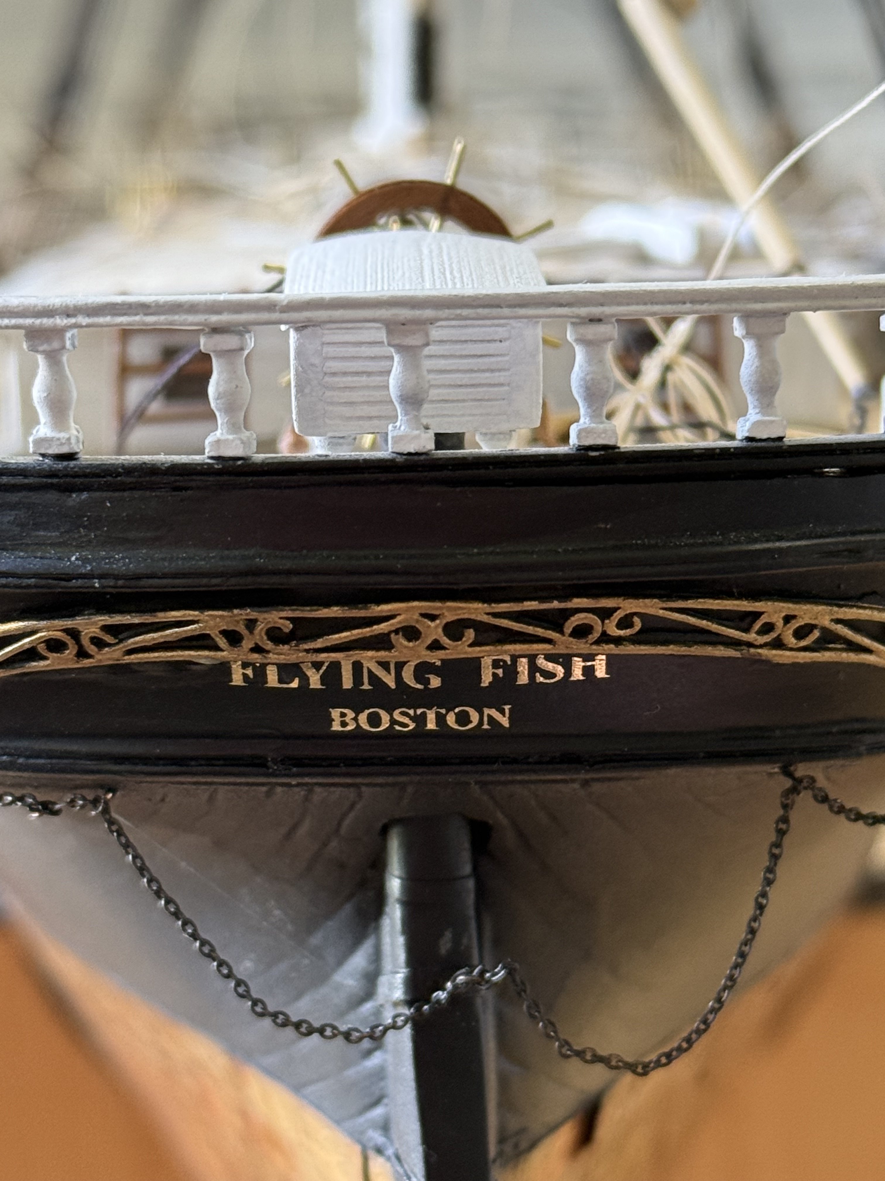

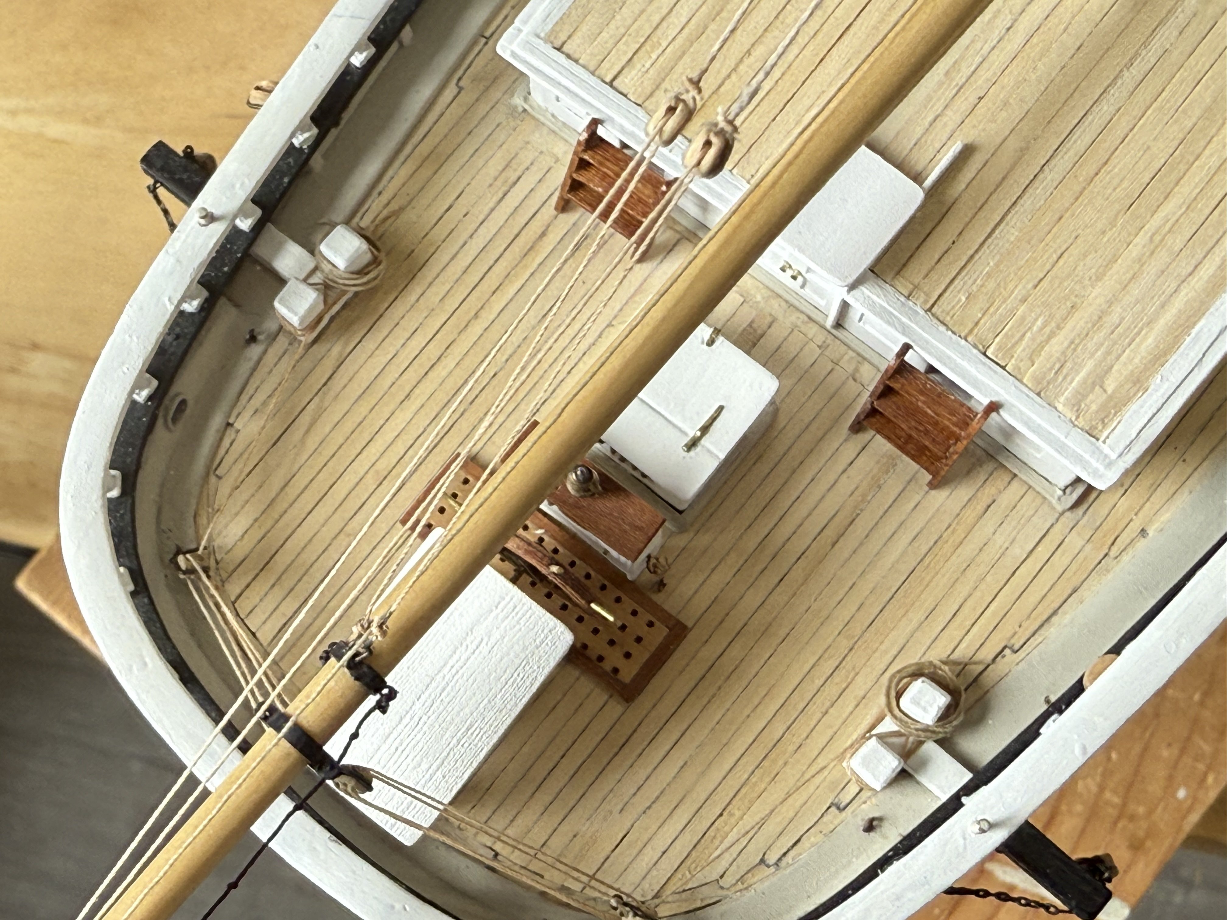

Next, placed all the shroud fairleads as per EdT. using 3/32 deadeyes with a groove filed to fit onto the shroud.

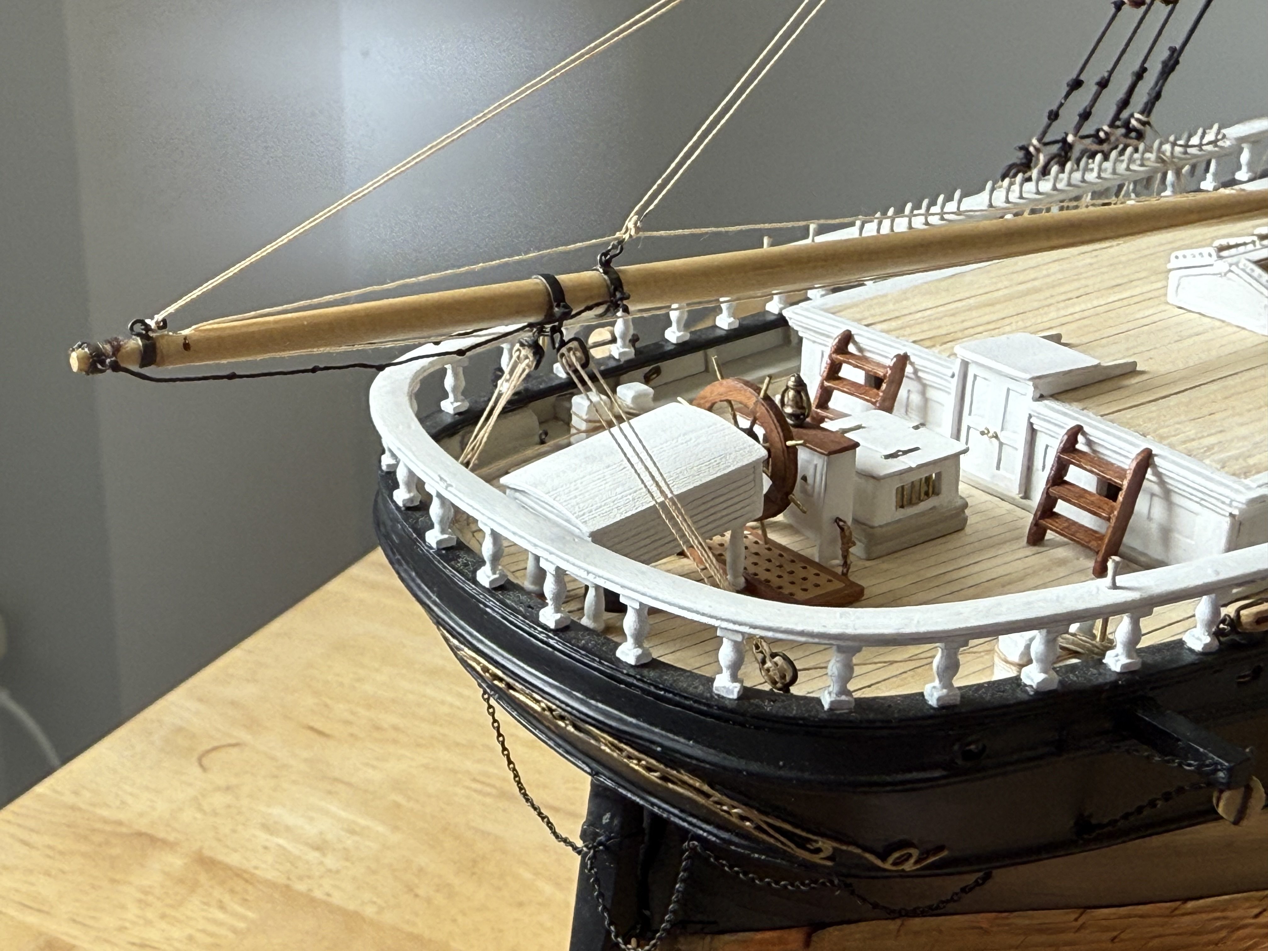

Finally, placed and rigged both Spencer booms. I included the inhaul/outhauls as I have never seen a model with them on.  I tied these together with bowlines as they would have been tied to the head of the sail.

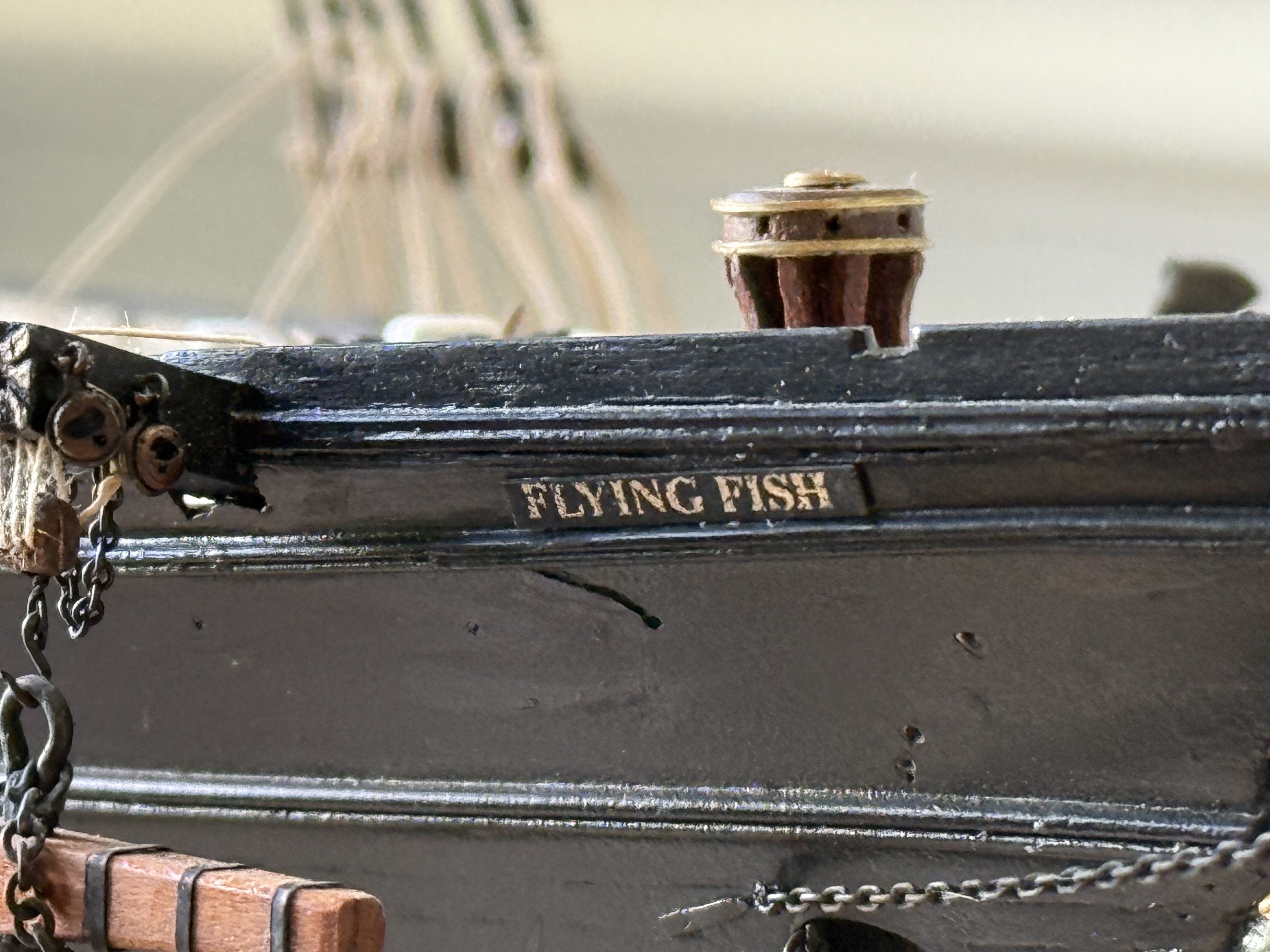

Looking great Rick. Love the stern detail, must have missed it all of these other times!
George
  AN absolutely BRILLIANT idea for a builder who wants to make the detailed hull the star of the show !   Build her to the point pictured so far (or thereabouts) in your build and call her finished !  Such a model will be easier to case - or perhaps may not need a case ... just a little 'dust off' occasionally, and one can always have immediate access to the model.  Transportation or moving won't be a problem, since the ship can be laid on its side over padding/bubblewrap in a box - and can even be safely shipped.
Thanks George and Snug Harbor Johnny!
The arch on the stern is pretty crude, but I didn’t have a better idea.  No way I could carve it out of wood and no good design for a decal .

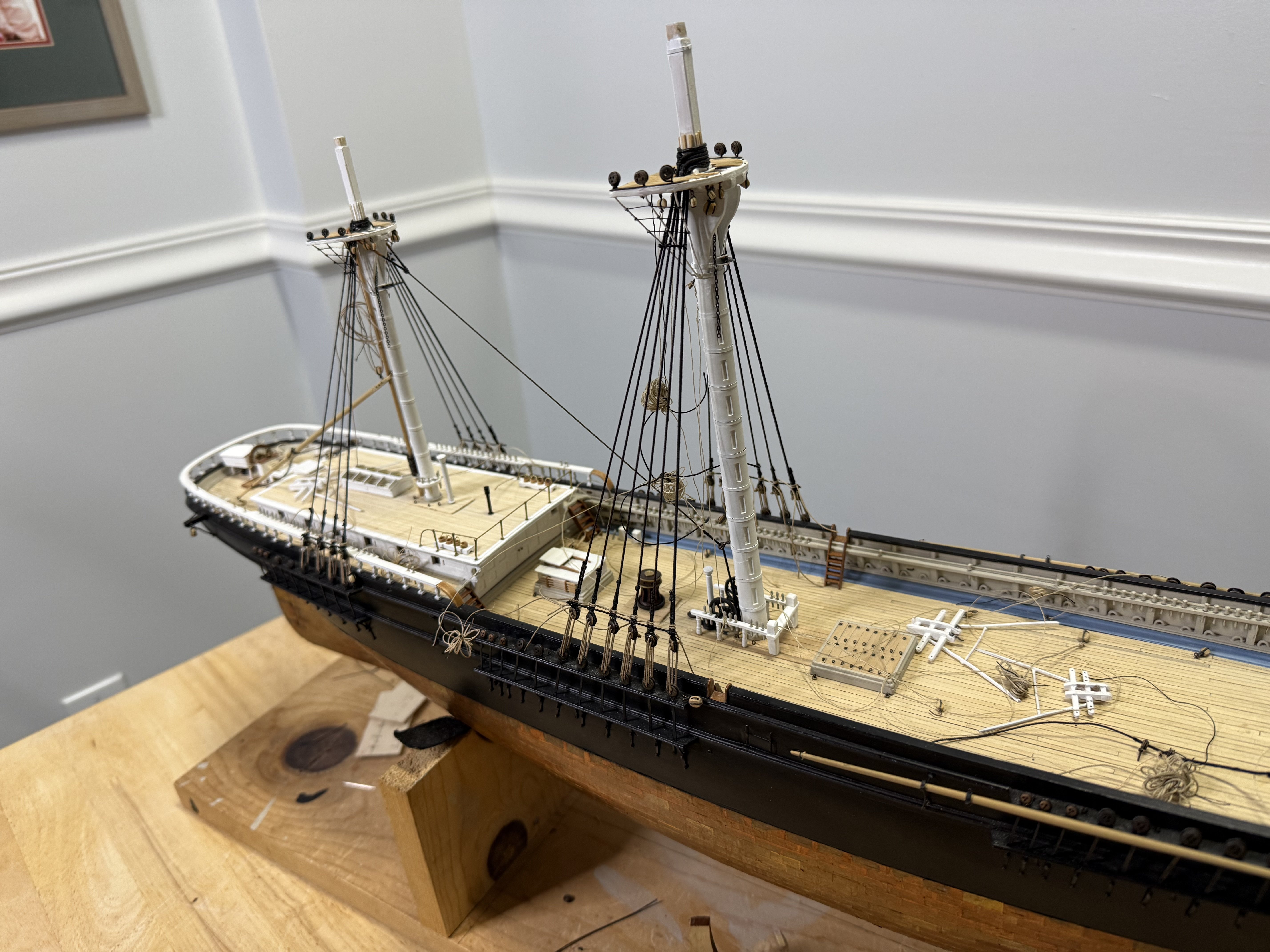

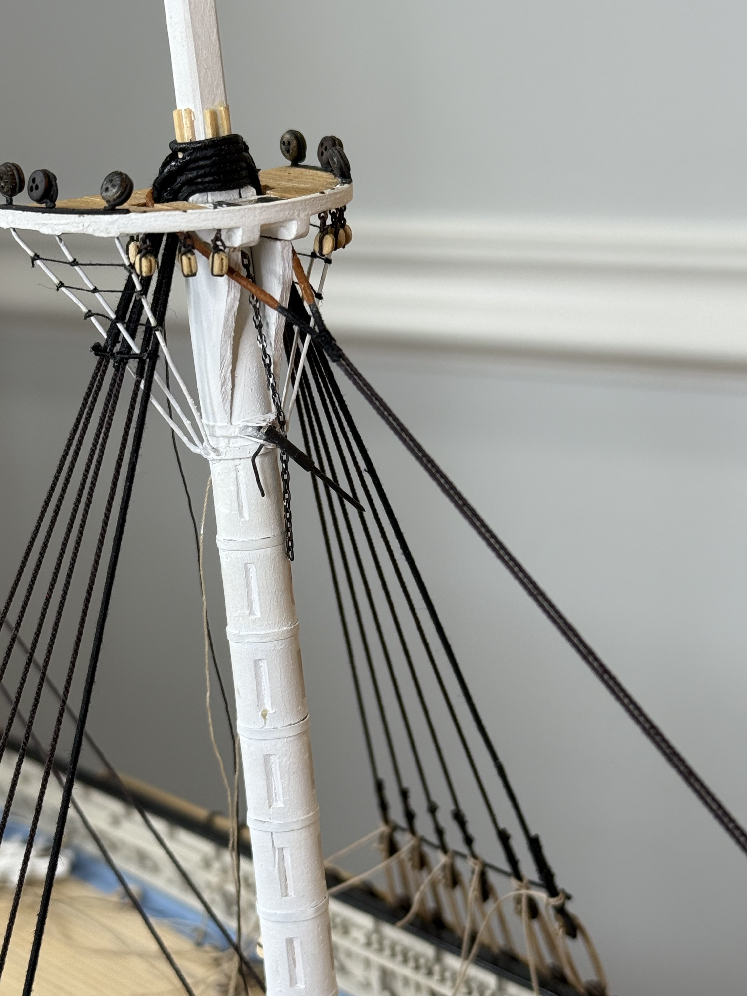

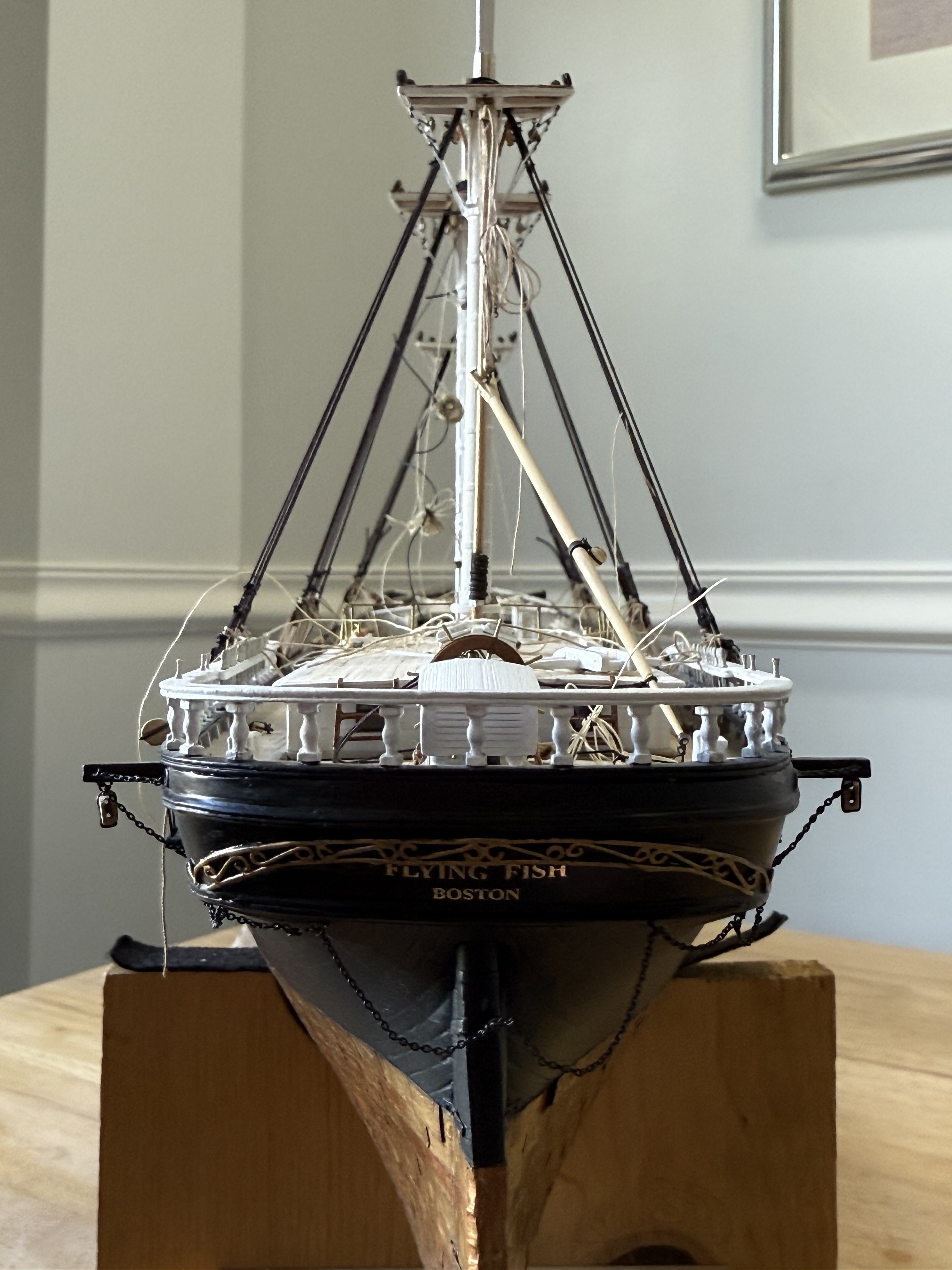

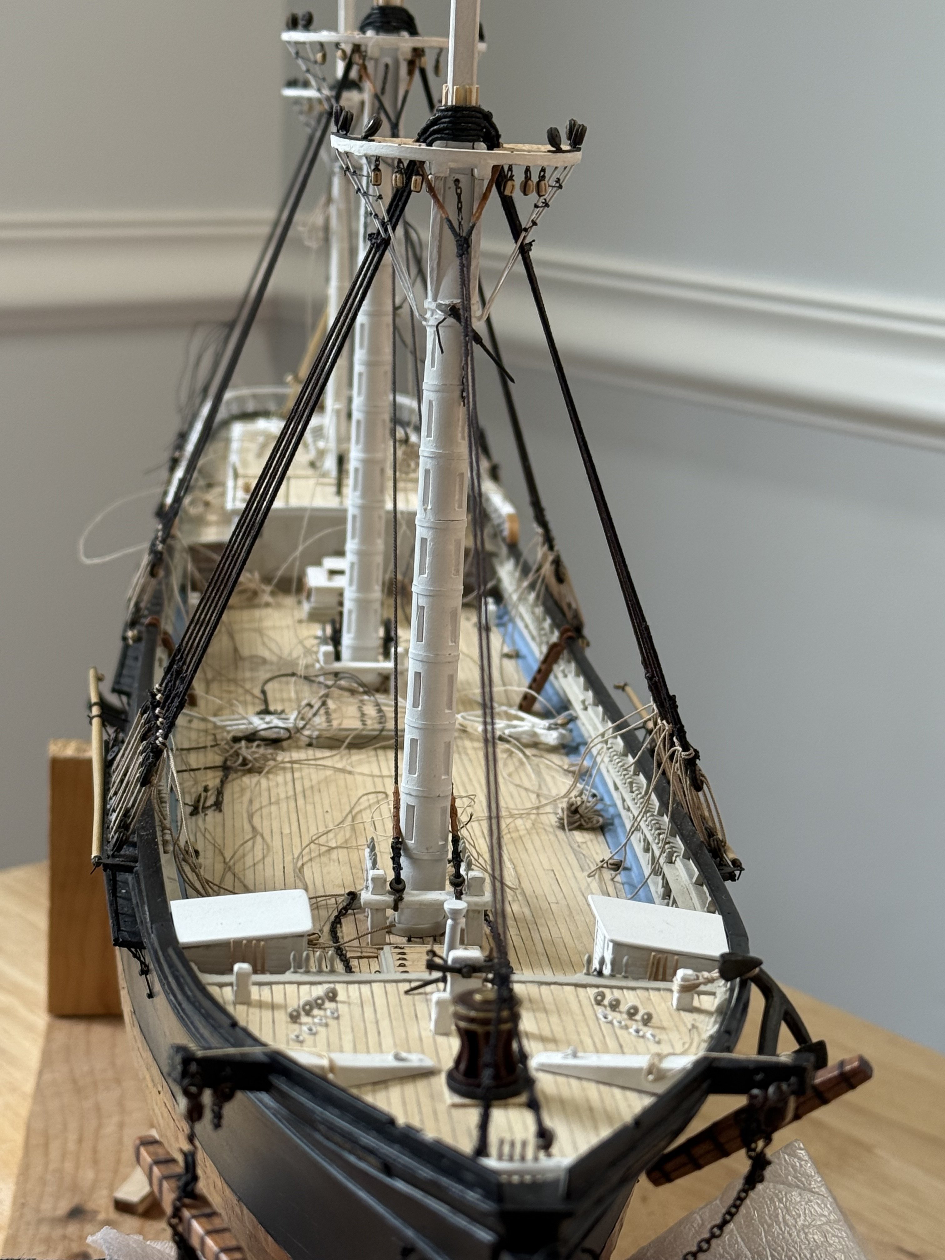

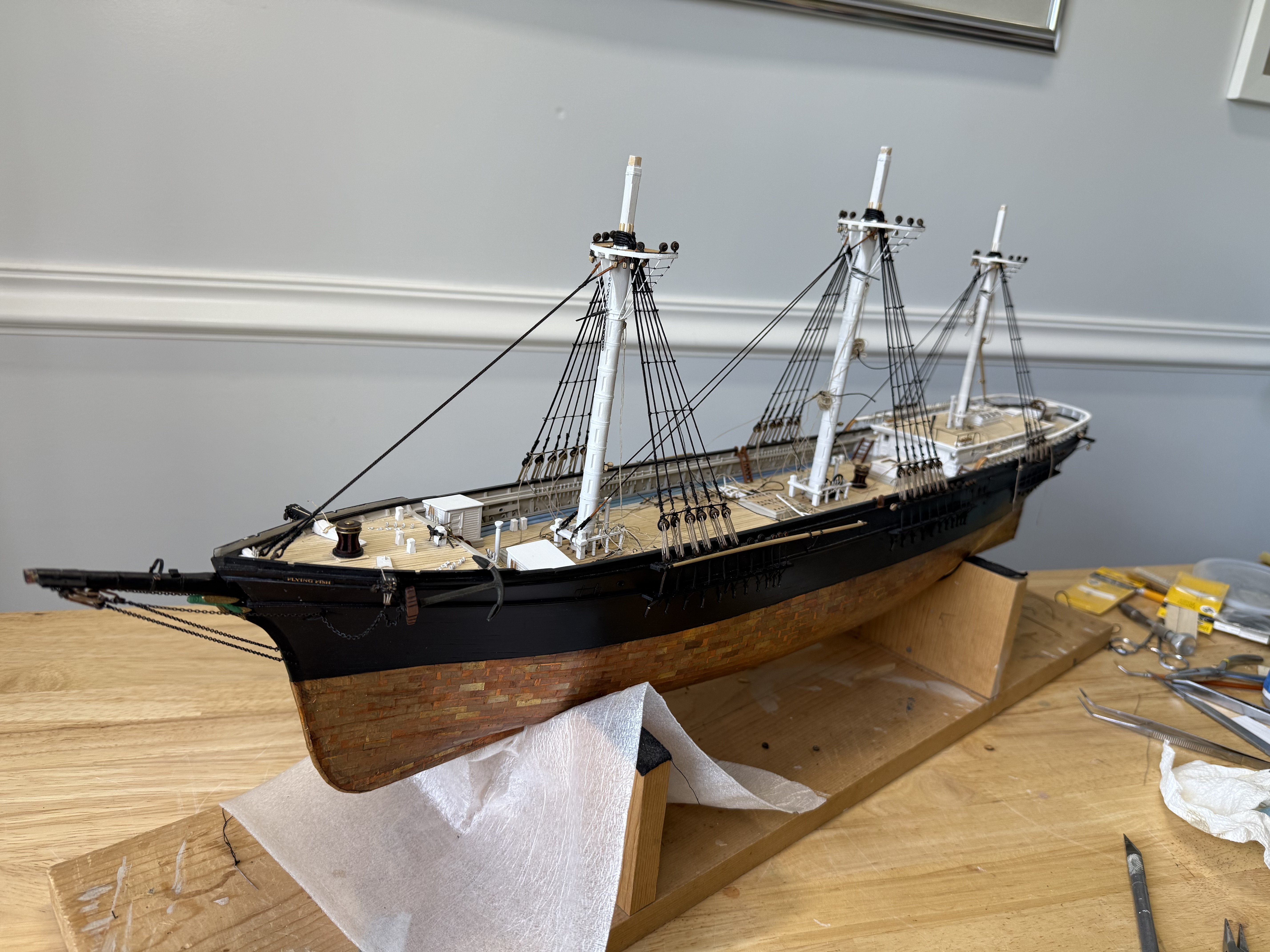

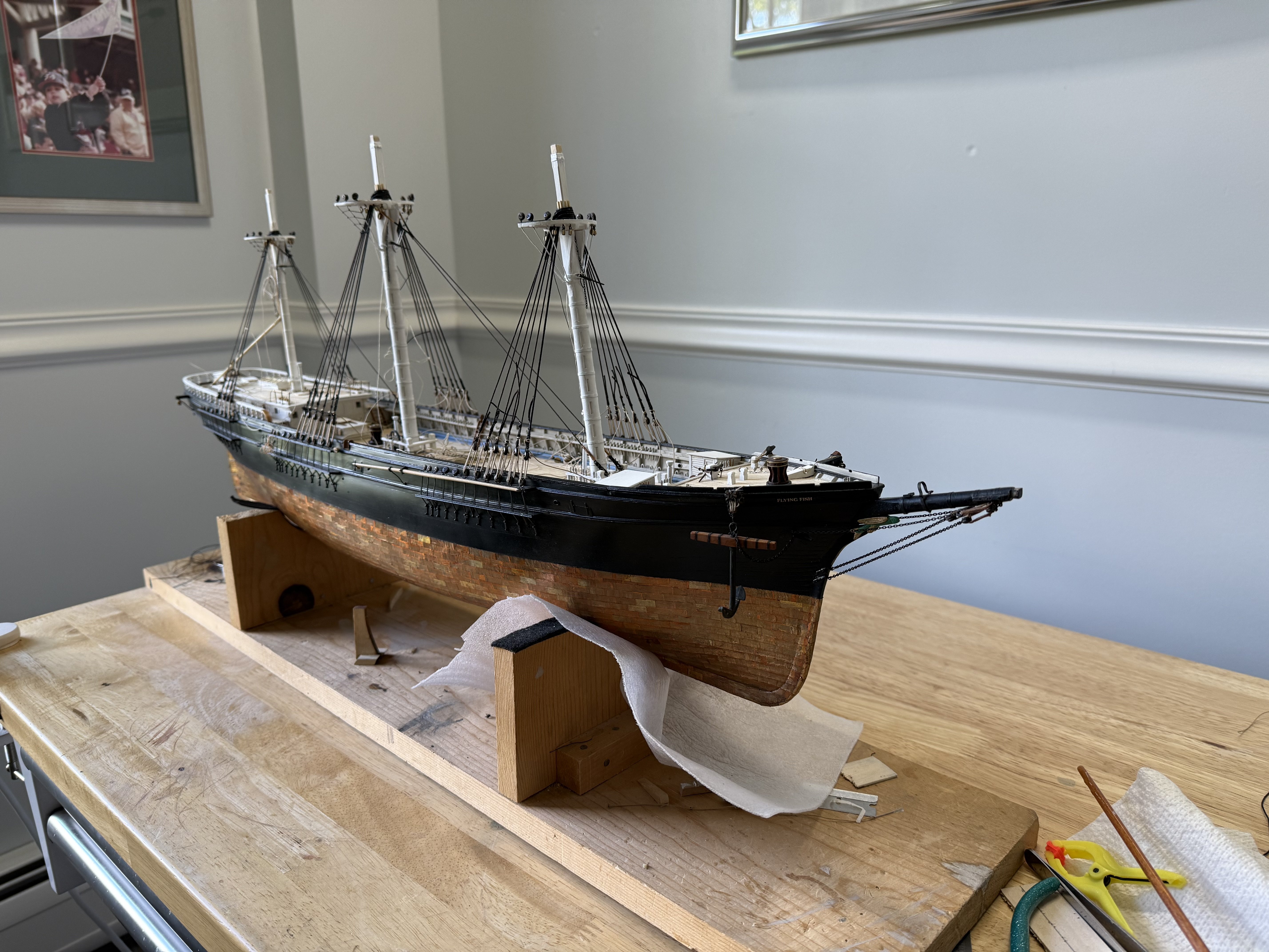

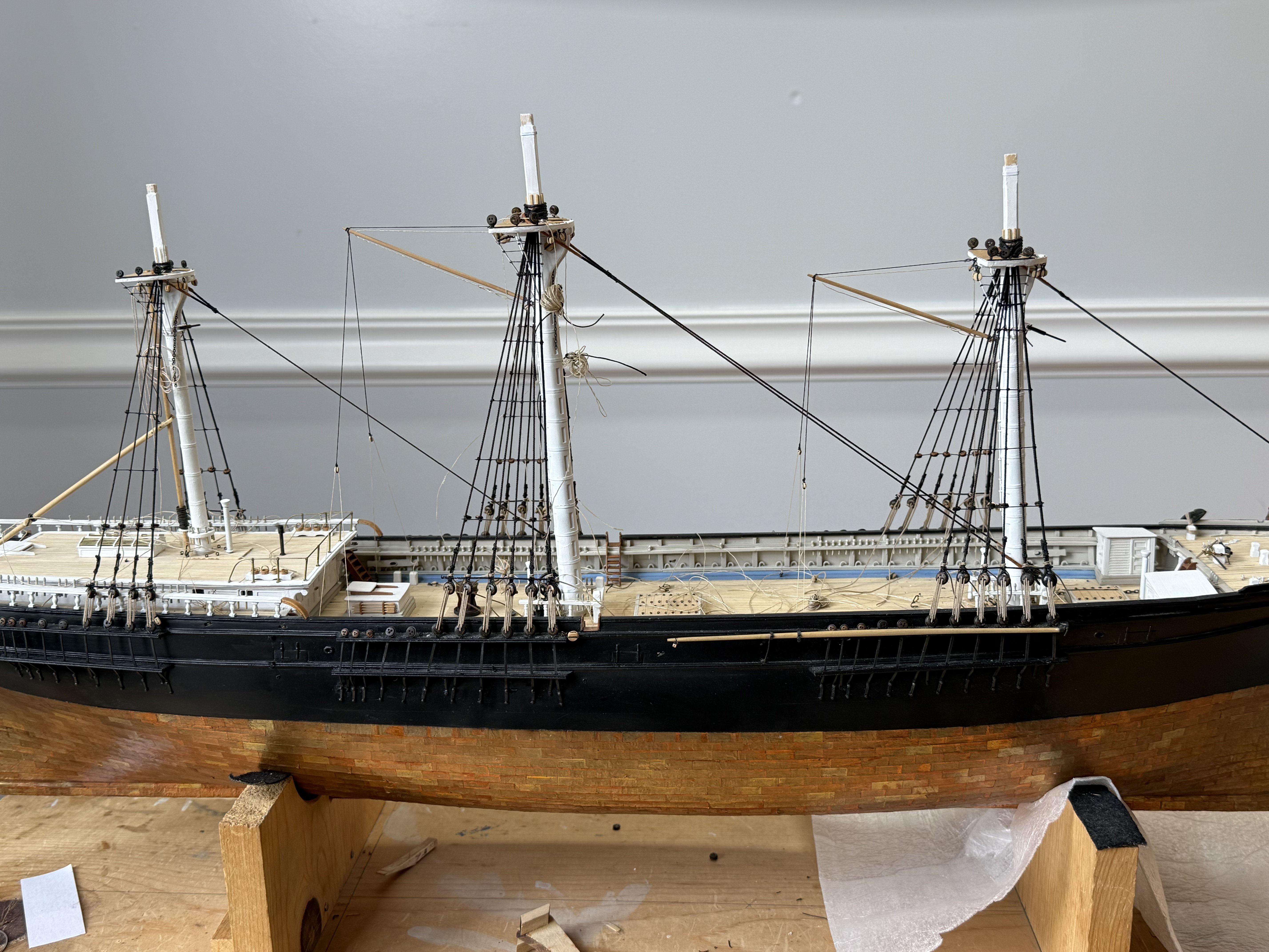

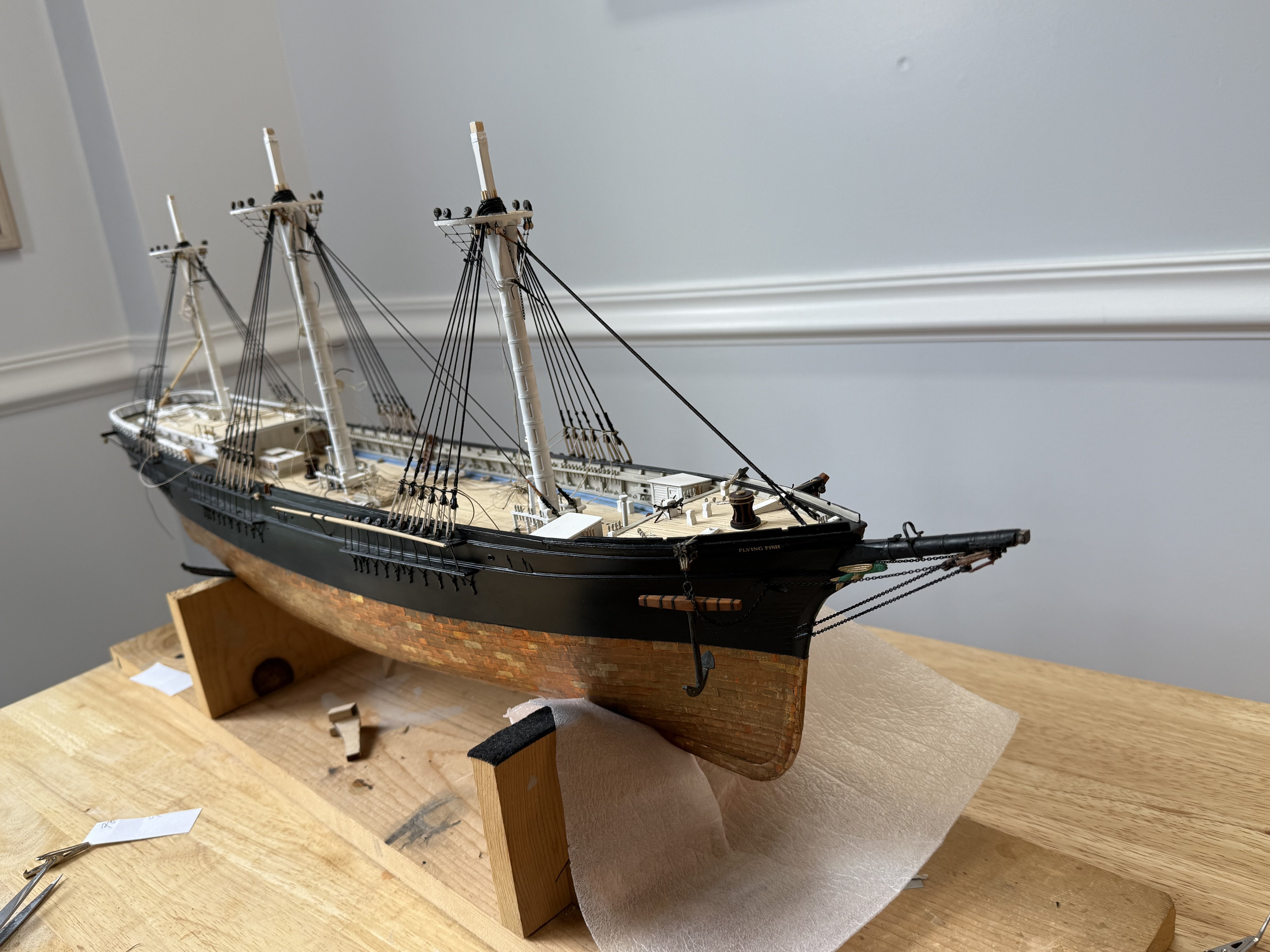

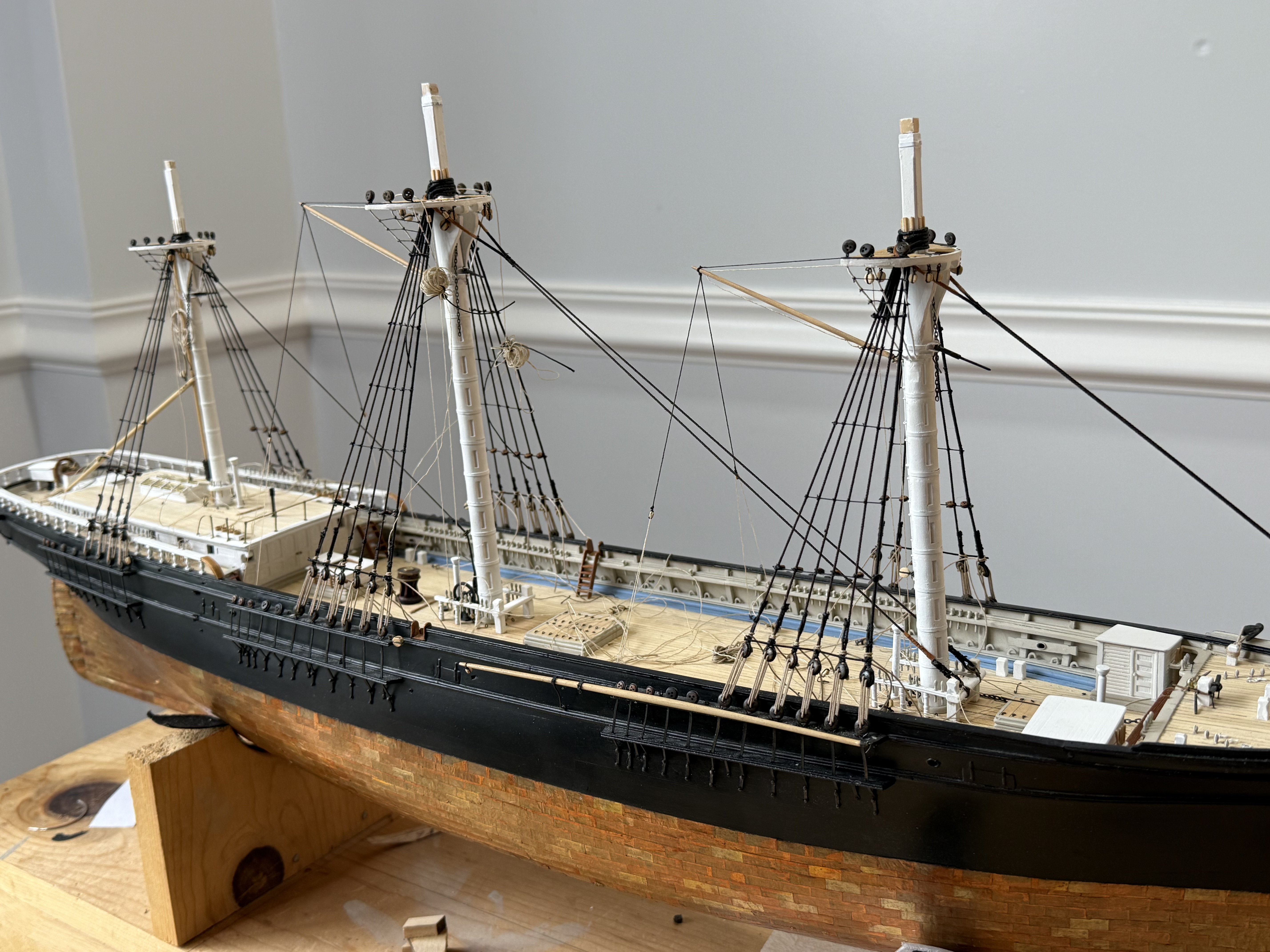

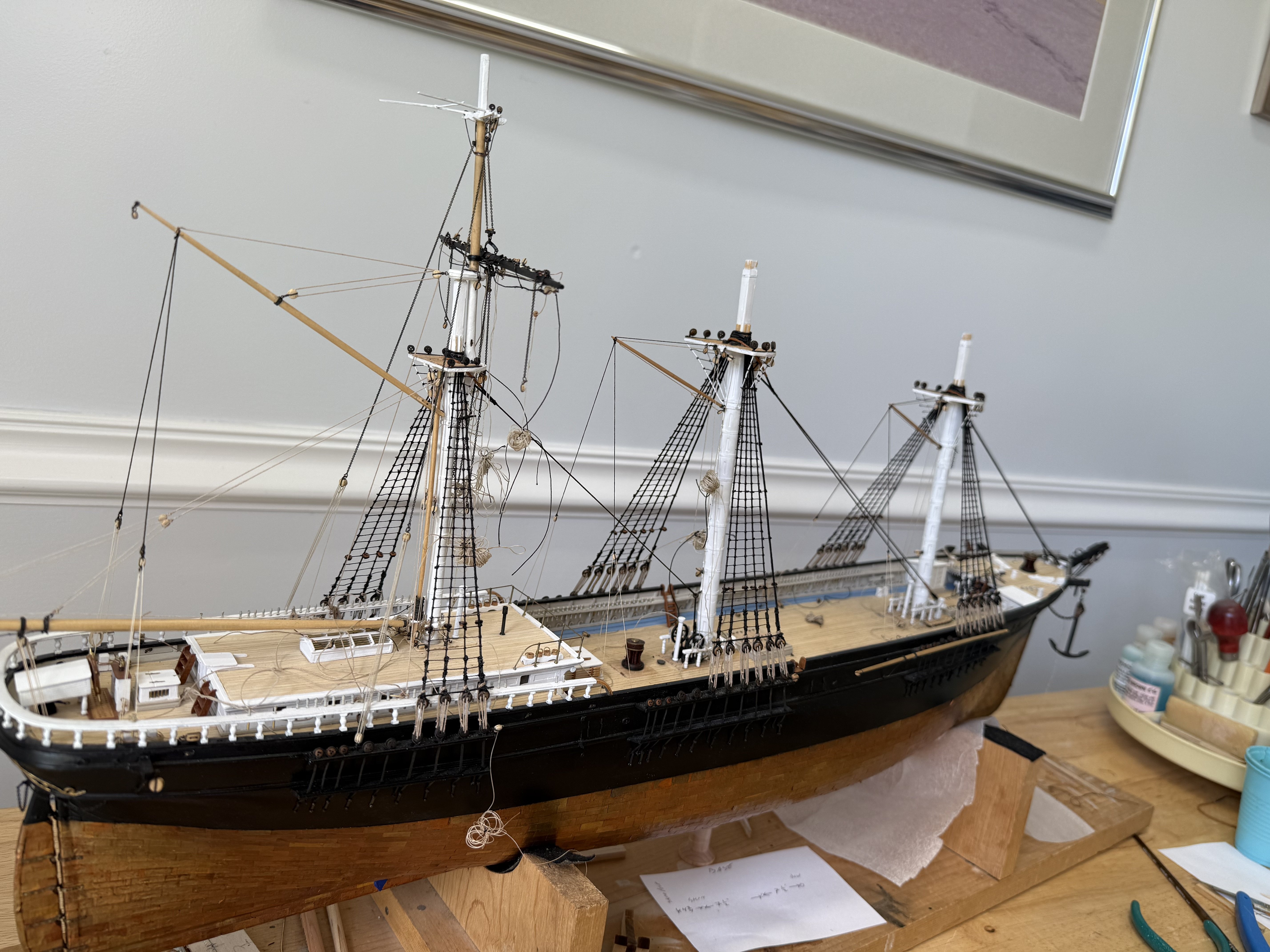

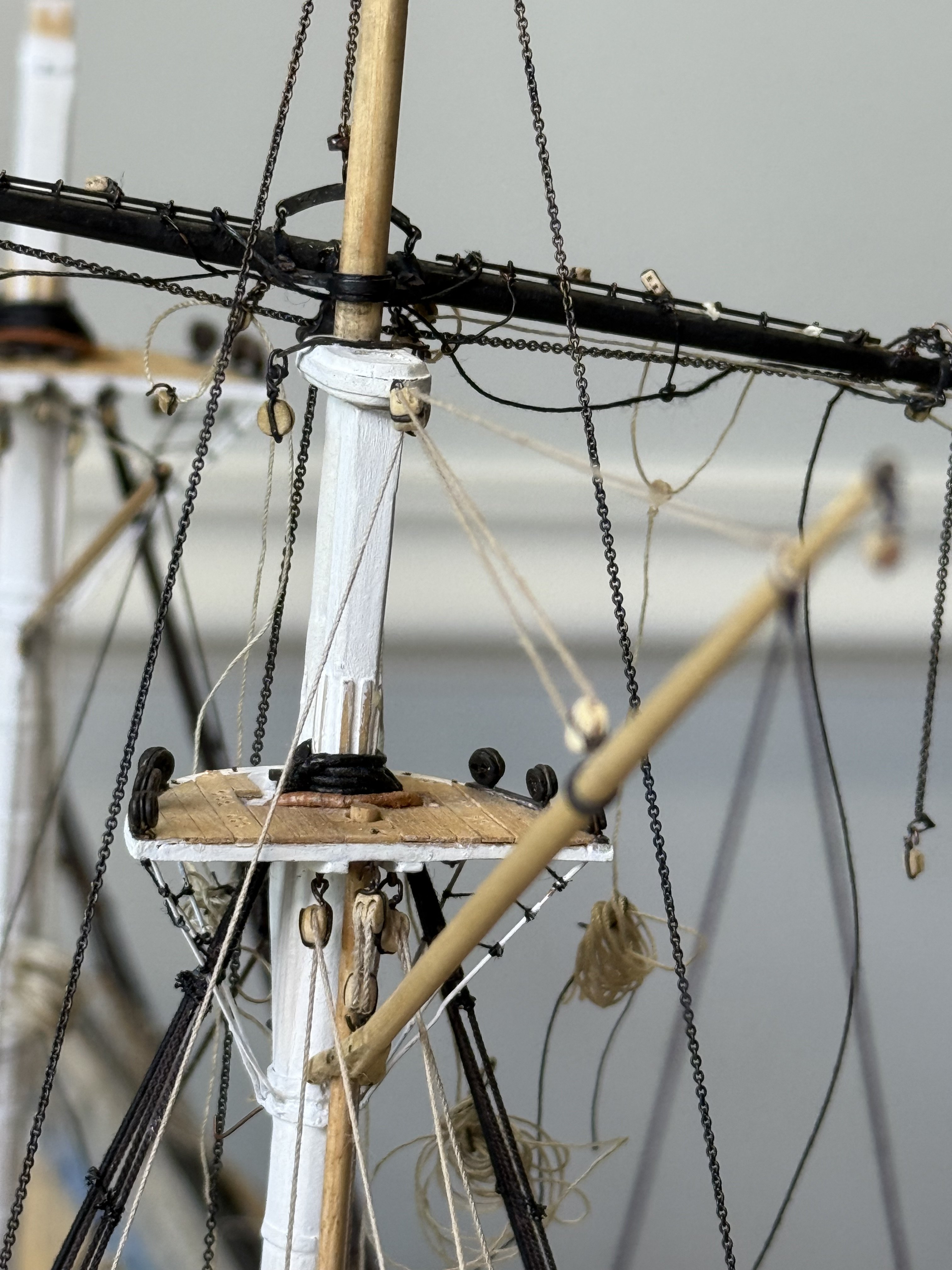

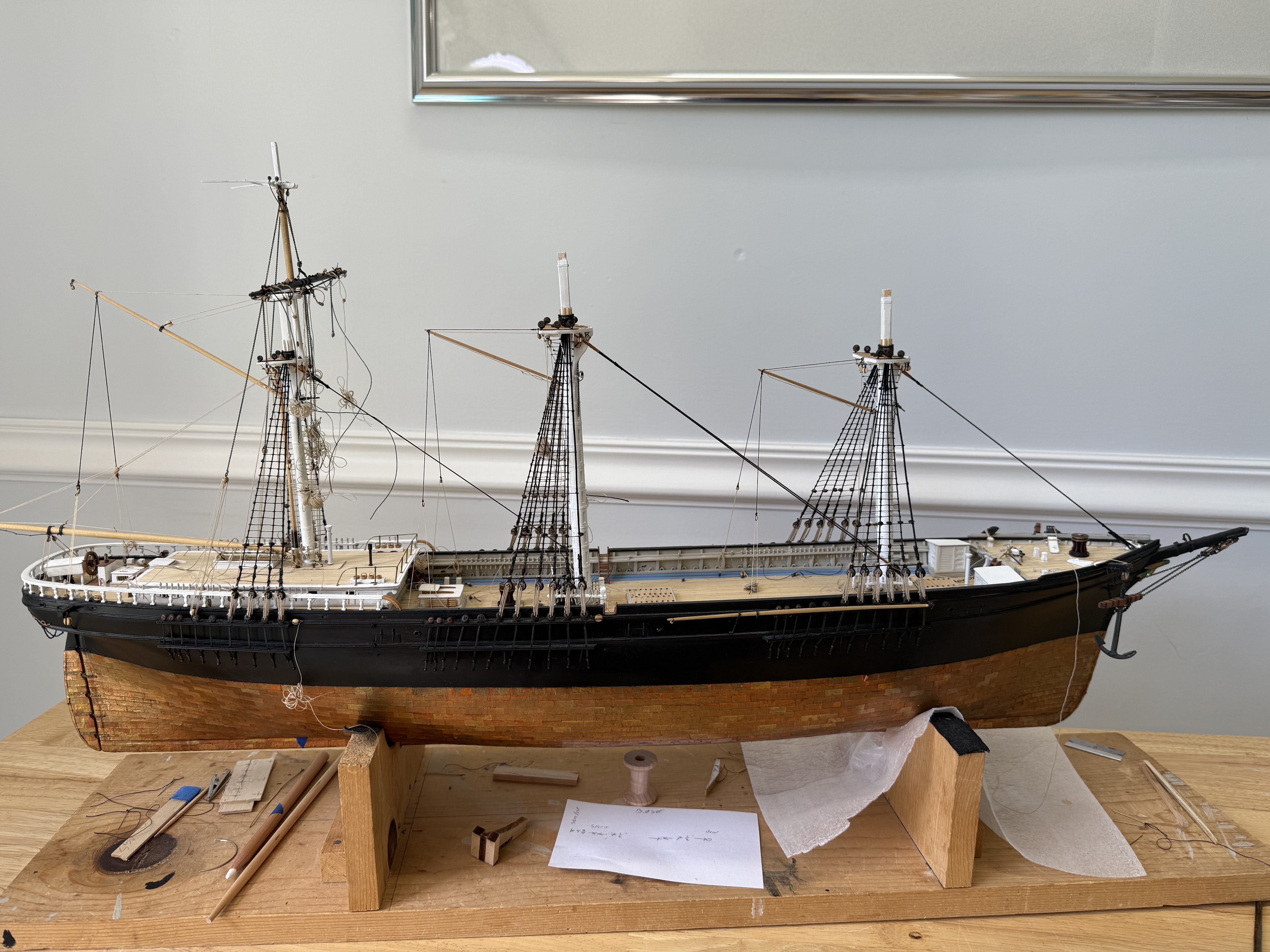

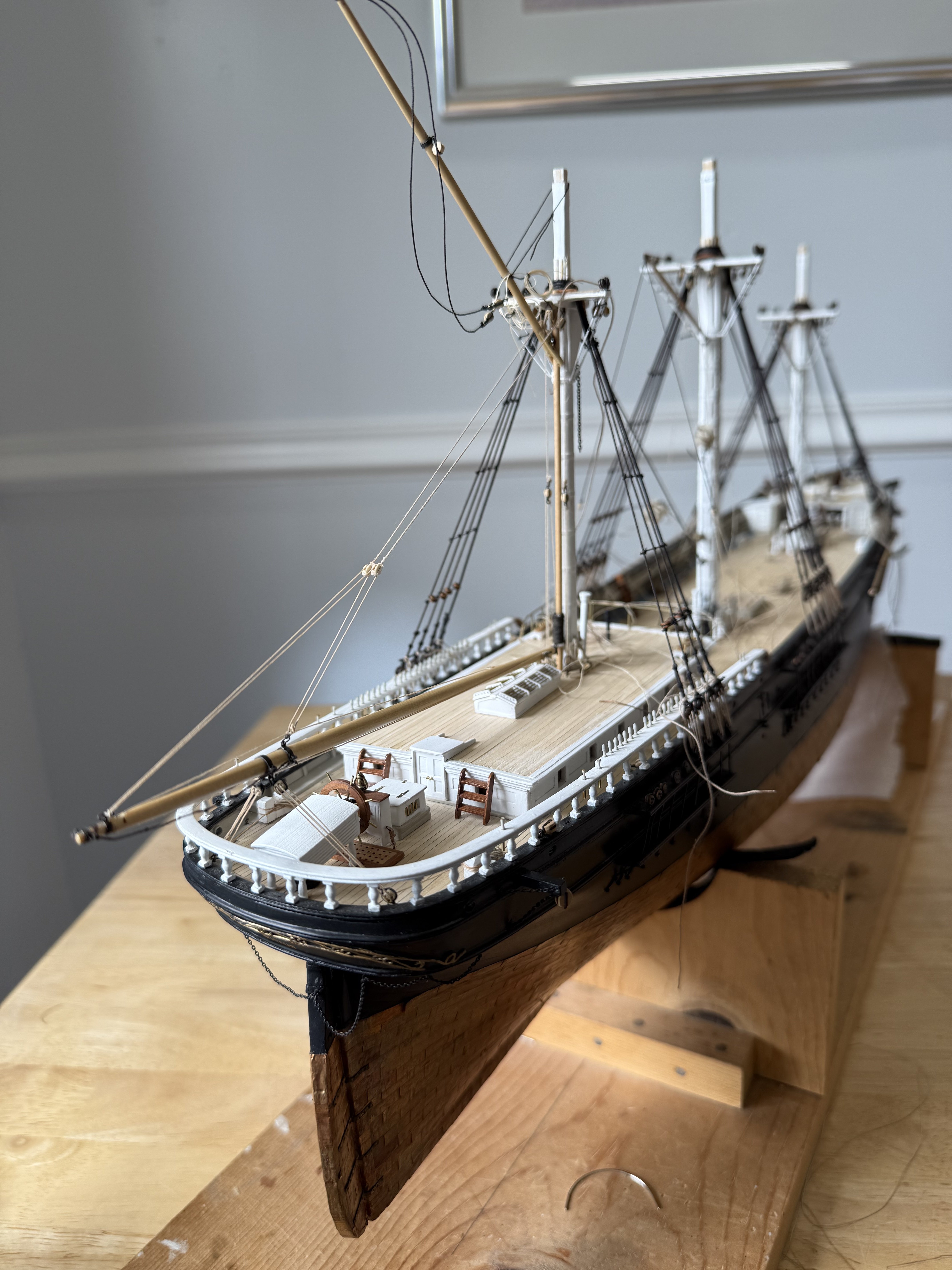

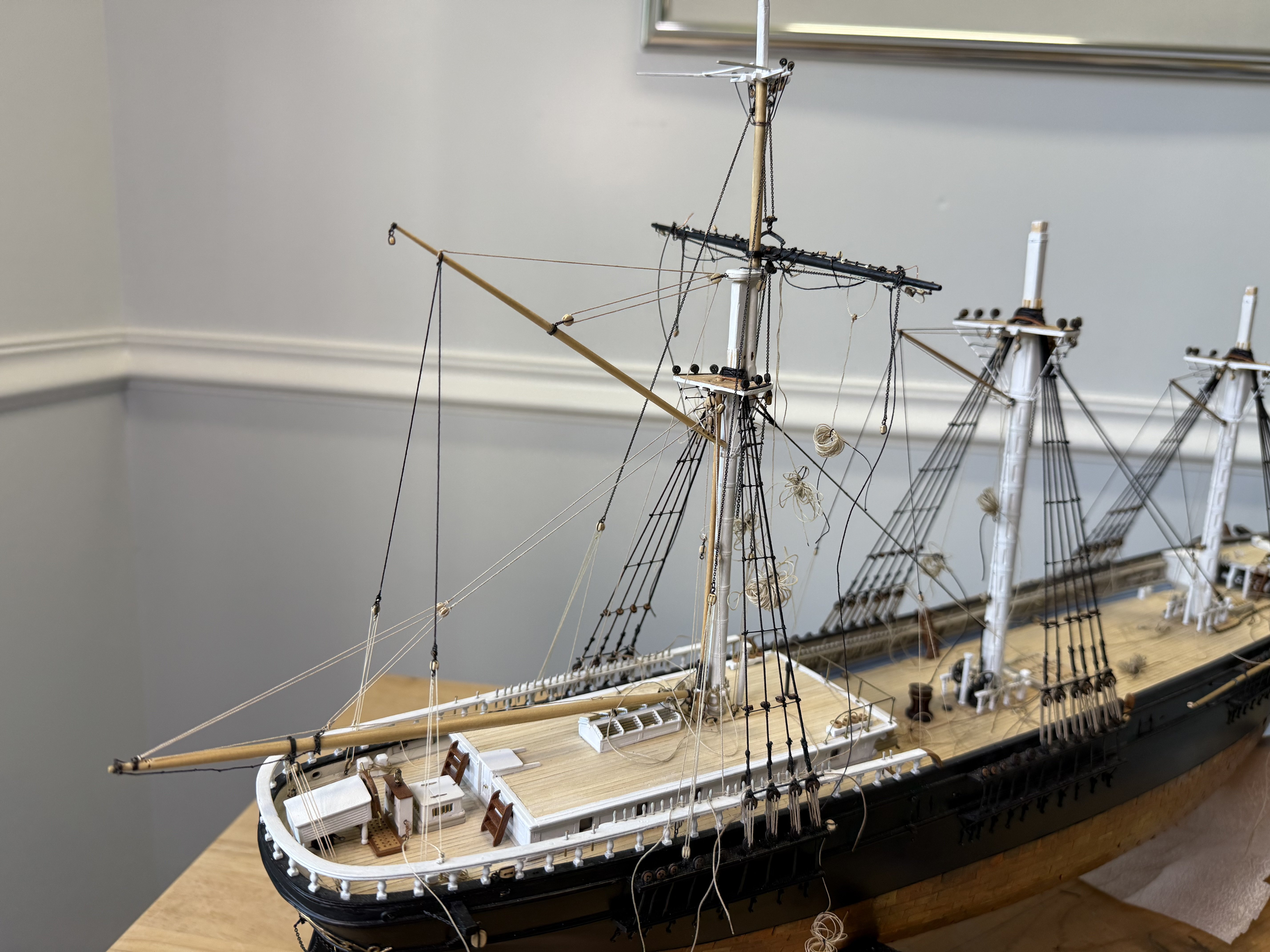

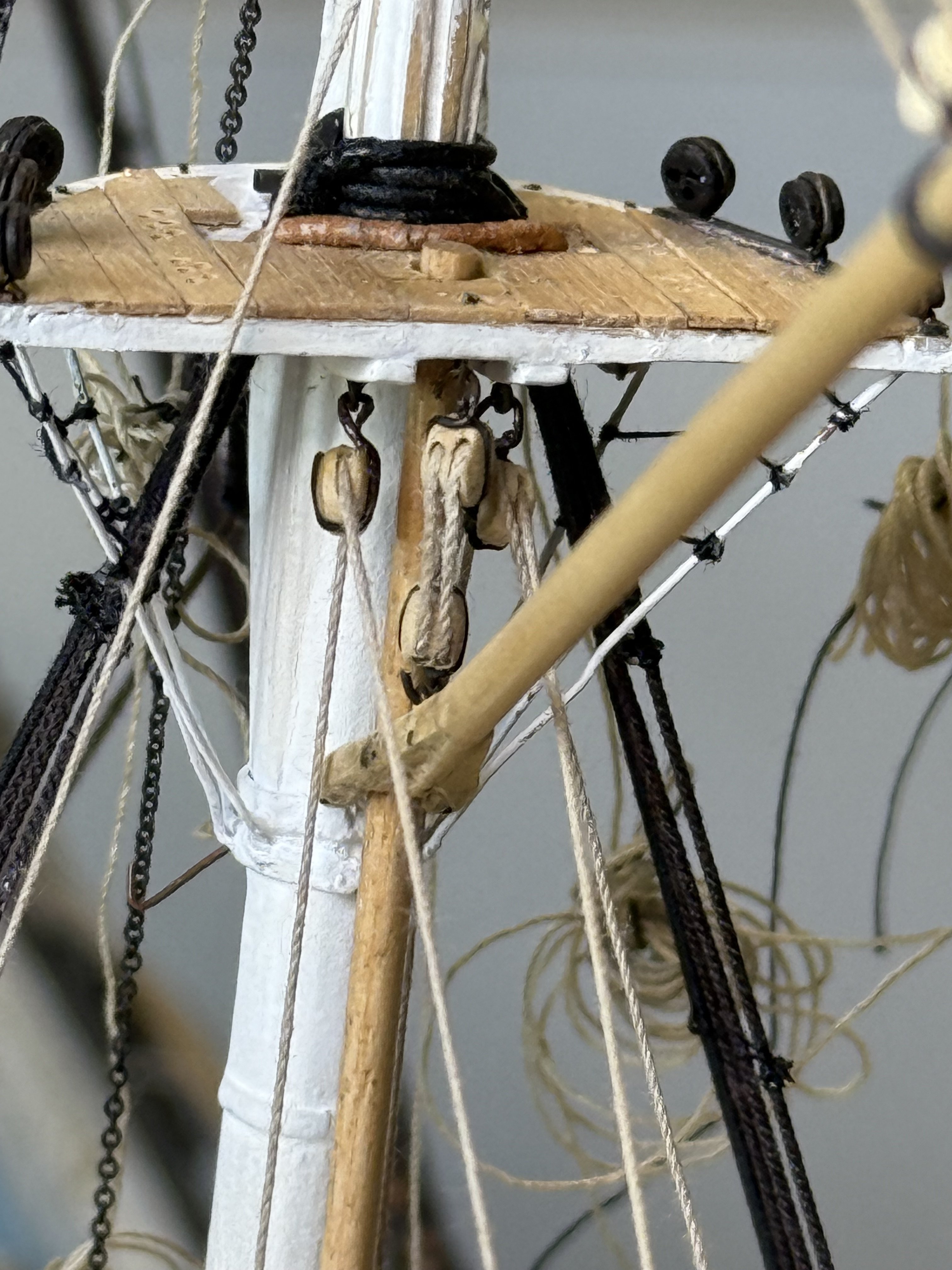

Well, as the end of summer approaches, work on the FF has progressed.
I finally rigged the mizzen Spencer and spanker booms.  Ran into a problem with the run of the peak halyard as the mizzen top prevents a direct run to the appropriate belaying pin.  This necessitated belaying the halyard 8 pins aft.  I checked the measurements of the top and they were spot on.  I also moved the throat halyard aft to be symmetrical with the peak halyard.
The topping lifts were belayed to the spider band, while the spanker sheets were belayed to the mooring bits.  I kind of made up the belaying on the bits as I not sure how  this was done.  Also added some rope coils.

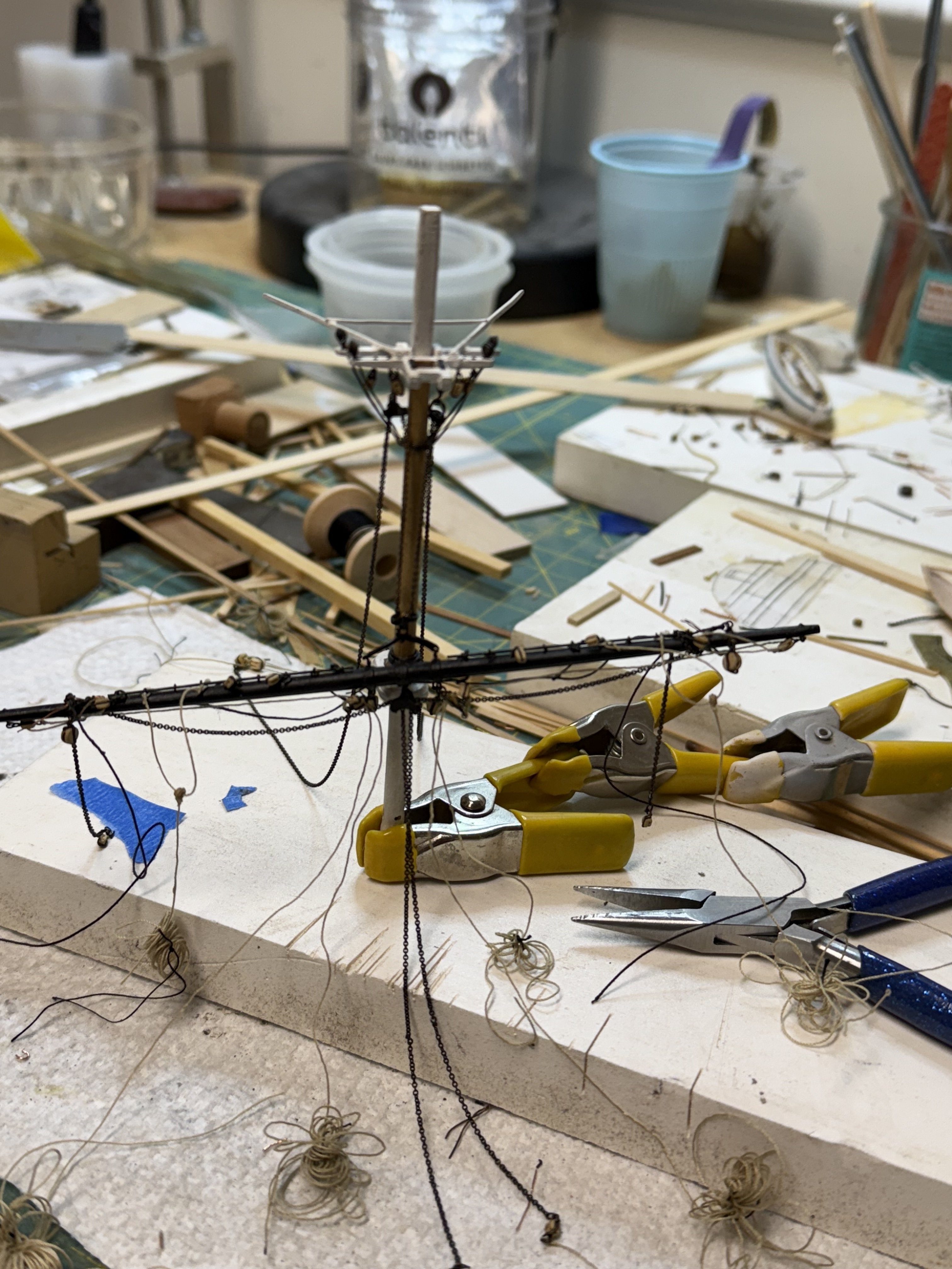

The topsail yard was added to the topmast and the topgallant shrouds installed and the topmast placed on the mizzenmast.
The topsail yard chain halyards and the topgallant chain sheets were also rigged.
The tails of the lanyards were finally secured to the last up leg as per the USS Constitution.
Finally, the rat lines were installed on the lower shrouds.

You are making great progress with the rigging.  The tight working space on the model certainly does not make any of the rigging easy!  However this is not stopping you and you are doing a fine job of it.  Like the detailed photos.
An amazing piece of work Rick. A stunning model so far. And the pictures really show off your workmanship.

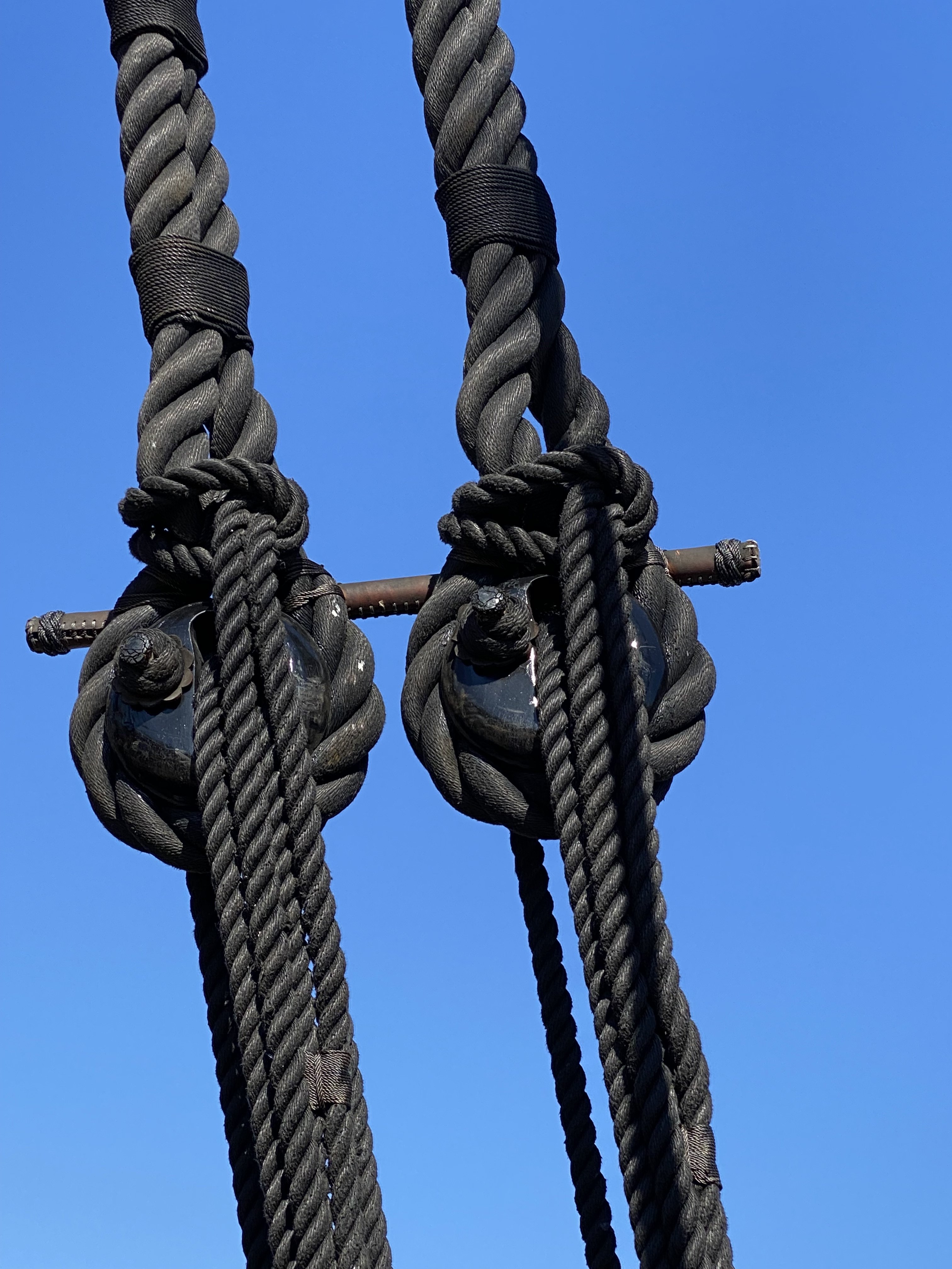

Rick.  I wanted to tell you, that I think your representation of this model is fantastic.  You've represented yourself as a very good model maker and detailer.
However, I have  issues with this tye and lift design the manufacturer has chosen to represent on this model.  It is clearly a plethora of engineering and design application....with a yard truss coupled with a gin block on the yard head...leading to two more bilateral gin blocks craned beneath the topgallant cross trees.
But looking at the overall lift characteristics and actual lift extension...when fully raised the topsail yard will just barely pass the mid point on the top mast.  The yard can never reach its full lift...due to the impedance of the exaggerated lengths of the entire lifting design.  You'll just plain run out of lift room due to, too many components of the lift system.
I noticed this same situation on other builders versions of this kit as well.  If the yard gin block was fixed directly to the yard, and the upper double gin blocks were fixed with less crane strapping.  Maybe it might be possible to lift that yard as far up against the futtock shroud band, as it should be.
This is only an observation of the kit...NOT your exemplary fabrication of it.
Sorry for any perceived malicious remarks.  I just always evaluate rigging designs that model manufacturers use and improve them for my own models if I can....to follow more traditionally functioning designs....of real sailing vessels.
