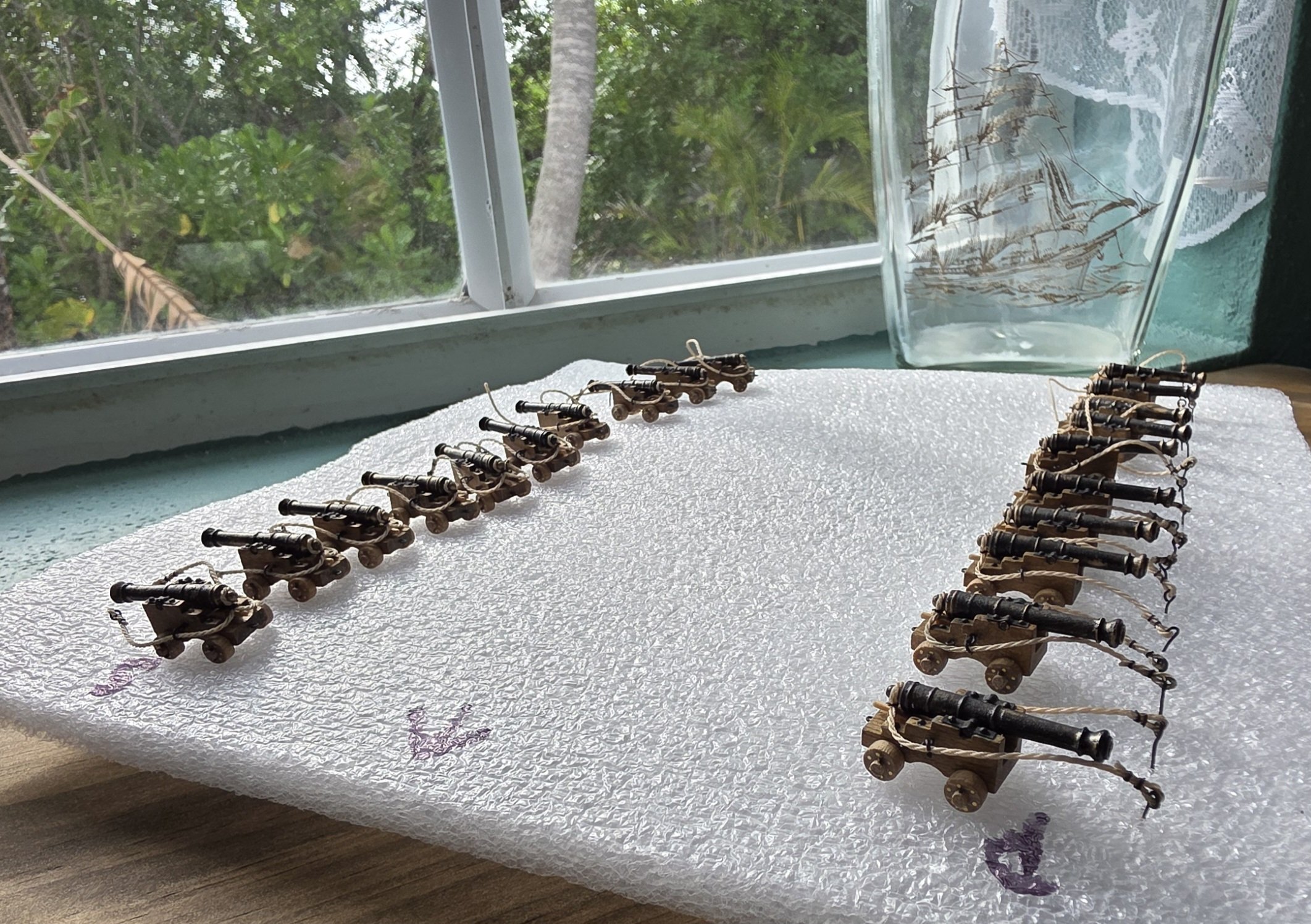

Hello All,
Well, it has been a few months since I updated my build log. When I last left off I was having a dilemma on the sequence of assembly. I have been working on some of the other items such as the mast and mast tops as well as the deadeyes that will be needed later on in the build. I have not included any pictures of these items as I will save them for another time and include them when I get to that stage. What I have been spending a lot of time on are the cannons that will be on the upper gun deck. I have been working on these for some time now as I did not know how I wanted to present them on my model. I started with using the pieces that were supplied with the kit. The carriages seemed to be fine as well as the trucks that were supplied. The plans called for cutting the 1mm brass wire and using them as the axels for the trucks. I did not like the look, and it seemed to be very plain. I thought that making marks on the trucks to simulate the pins that would have been used to hold them together would add a bit of character. I started with simulating 4 pins but did not like the way they turned out. I then tried with 6 pins and that seemed to look a little better. I thought that maybe 8 pins would look even better, but I was wrong and liked the look of the 6 pins. I substituted the brass axel using a toothpick which had a better fit on the trucks. I painted them black to see how they looked. I still was not very satisfied with how they were turning out, so I changed gears and started to work on the cannons.
I painted all the cannons an antique brass and then used some black rub & buff to blacken them. They came out pretty good in my opinion and gave them the look of being old and imperfect that I was looking for. Before I started mass producing the components that will make up the cannons, I decided that I would complete a prototype first. I drilled the 6 holes in the trucks using a .5mm drill bit and then inserted .5mm brass wire in them.  I made a jig that I could insert the trucks into to hold them steady while I filed the cut ends flat. I knew that I was going to do this with all the trucks, so I spent a few days drilling and filing until I had completed 80 pieces. After I completed that awesome task…just kidding, I made the quoin blocks that for supporting the cannons to the proper level. I used a 6mm belaying pin as the handle for the quoin block but was not satisfied with the look as it seemed to be out of scale. While I thought about what I was going to do about the scaling issue I went ahead and drilled the holes in the axels and inserted brass pins to secure the trucks to the axels. I placed the cannon on the deck to see how things were looking.
To tackle the issue I had with the quoin block handle, I decided that I would use a 1mm dowel. That took care of the scaling issue, and I feel it looks much better than the belaying pin I had used. After I completed the quoin blocks I moved on to installing the axels. I mentioned that I used a toothpick for the axels on my mockup. Well, I could not see myself using toothpicks for anything on this ship as I have come so far that I am not going to compromise using something like that. So, I purchased some 2mm walnut dowels and turned them down to the 1.7mm that I needed to fit the hole in the trucks. I installed the trucks and drilled the holes in the axels for the pins. I drilled the holes for the breeching eyebolts and inserted the .8mm rope that I had made some time ago. I made the eyebolts and rings using .5mm brass wire, the kit supplied eyebolts were out of scale.
Once that was completed, I made the brass straps that will secure the cannon to the carriage. I also drilled and inserted pins on the steps of the carriage to give it a bit more character. After the pins were installed, I applied a small amount of brass blacken to tone them down a bit. After I completed the prototype, I made the second cannon fine tuning my technics that I learned building the first cannon. I apologize for the long-winded update, but it took many months of trying different things before I came up with something I was satisfied with. My prototype will be installed far under the quarter deck to hide the imperfections. Well, that’s all I have for now, and as always, your comments and guidance are always welcome.

That is some fine work. It makes me truly want to scrap those 3D printed gun carriages I made and remake them out of "real" wood. It just looks so much better!!
Nearshore, hello! I'm impressed with your work on the cannons! It's been a long and meticulous process that has led to a remarkable outcome! The cannons look stunning! I believe the time spent installing the rivets on the wheels was well worth it. These small details add a touch of elegance to the overall appearance. And six rivets are just the right amount! Similarly, the use of wooden axles instead of brass wire is of great interest to me, as I have yet to explore these options. I want to take these decisions into account, if you don't mind, of course) Also, as I see it, you haven't installed the quarterdeck deck yet. Obviously, in order to be able to mount the guns under this deck. I have not yet determined the assembly sequence for myself, so I am not installing this deck yet either. But I still have a lot of work to do before making this decision, and I hope it will become obvious in due course. And good luck and inspiration to you in this difficult but interesting job!

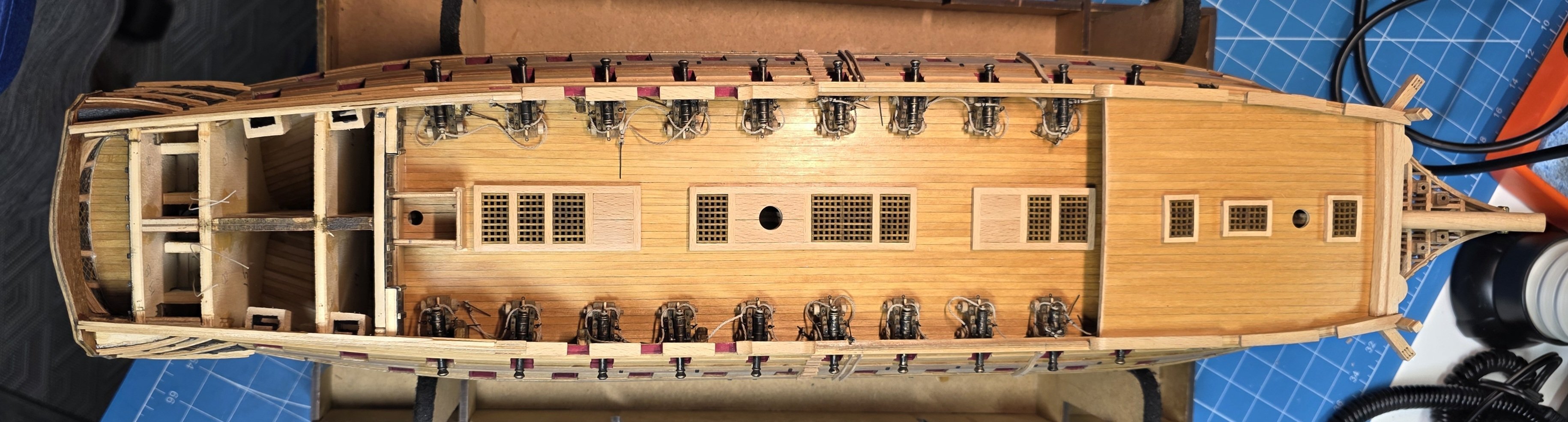

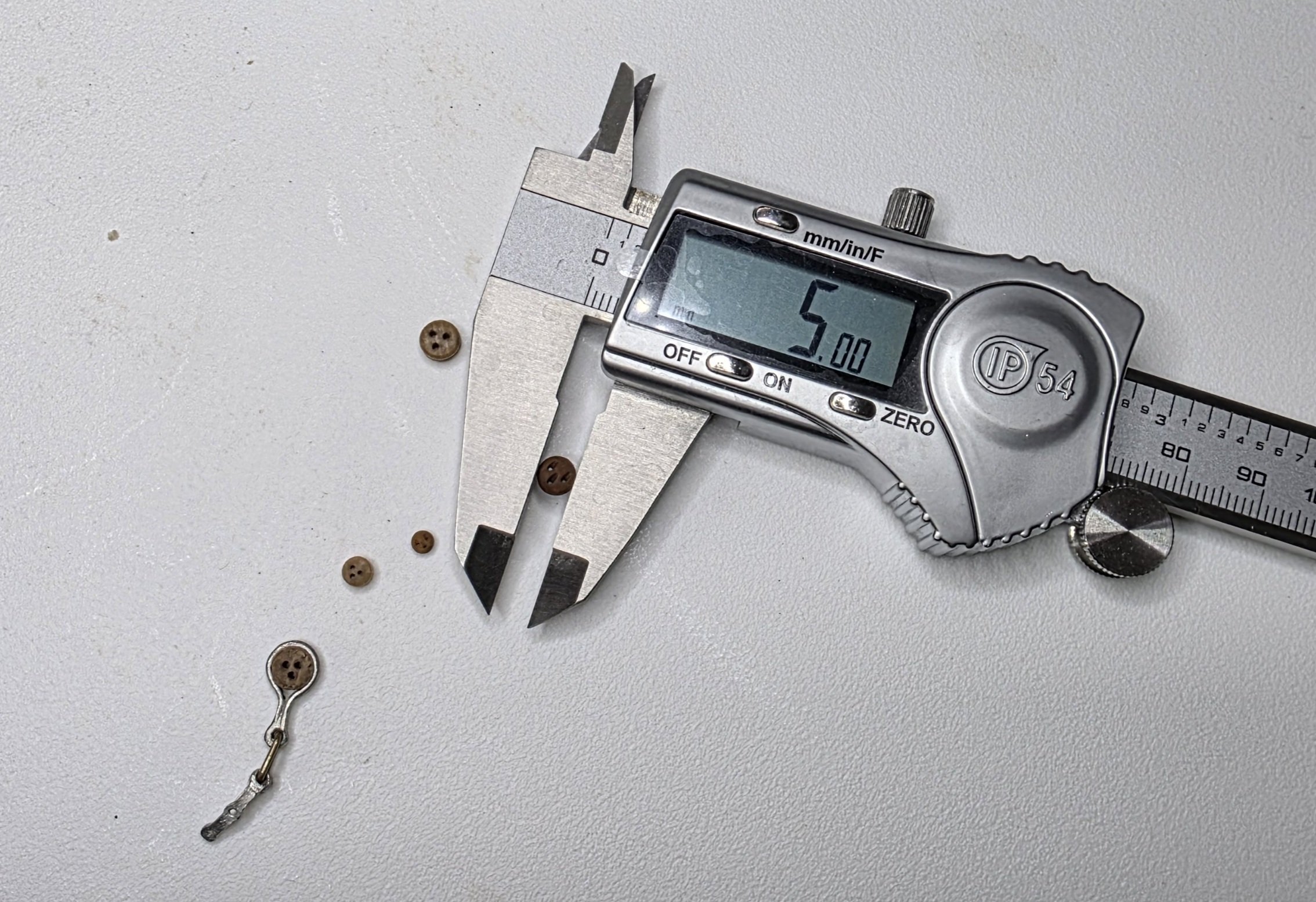

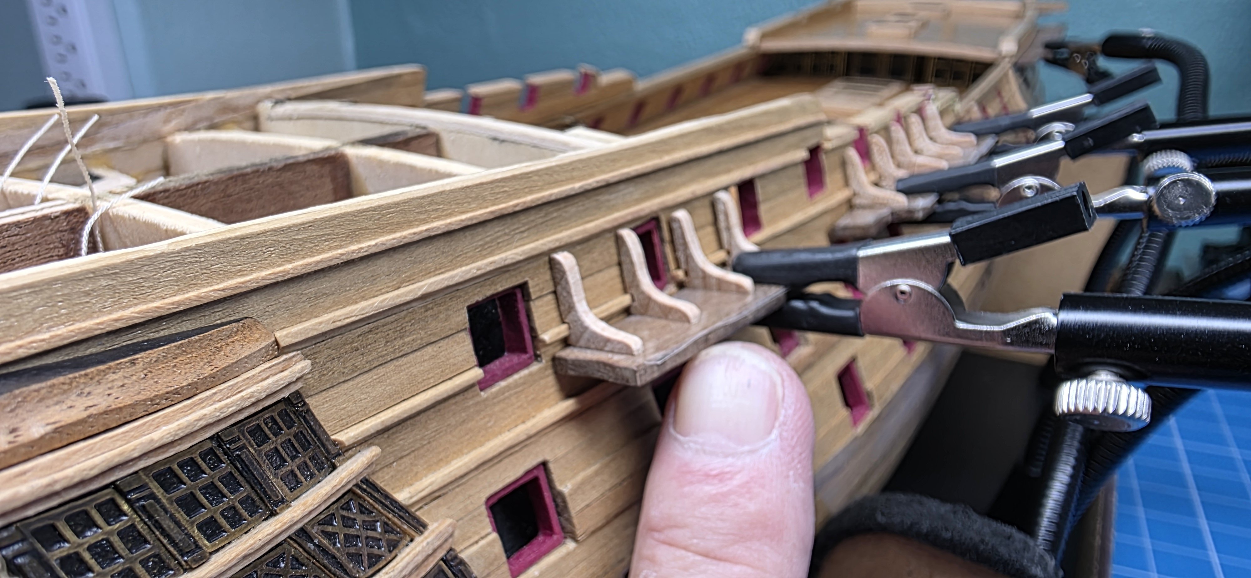

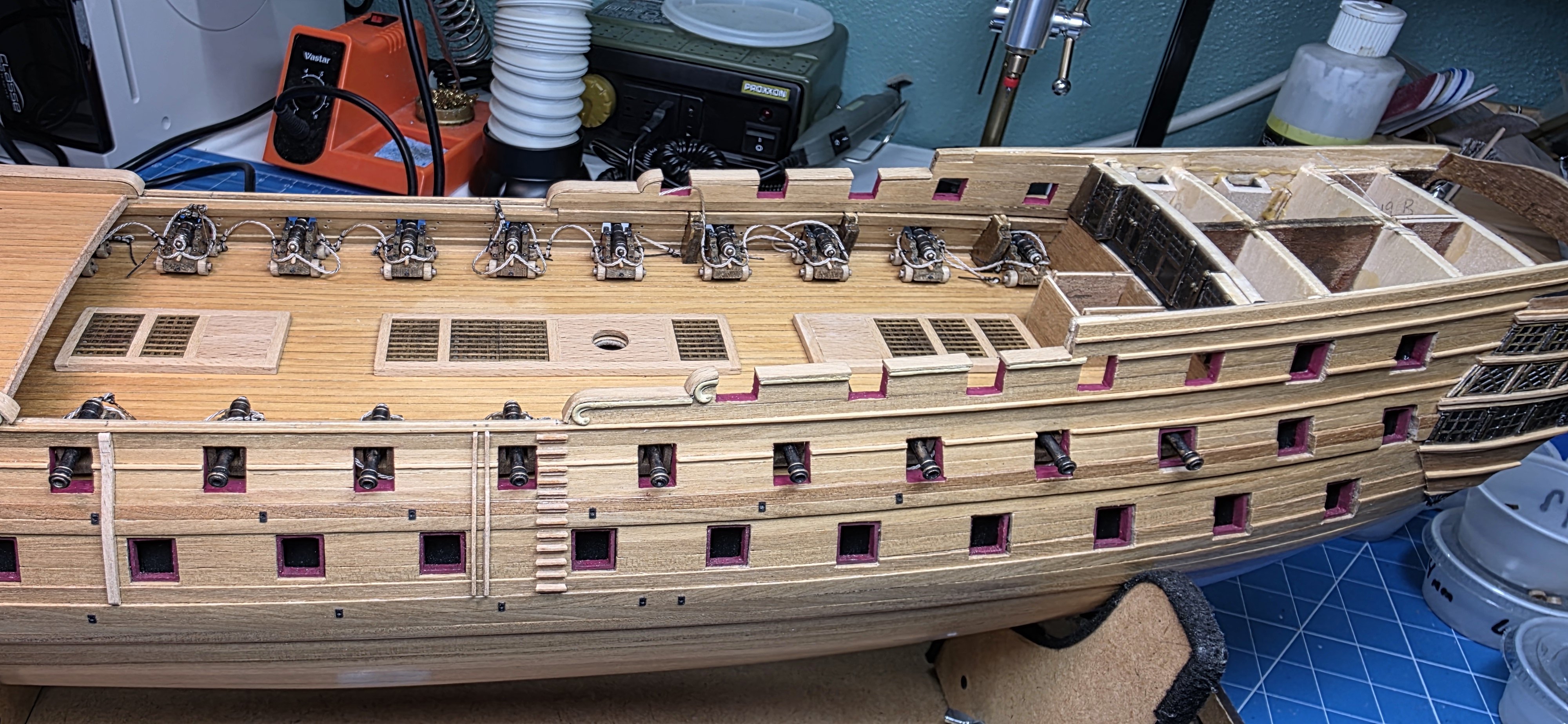

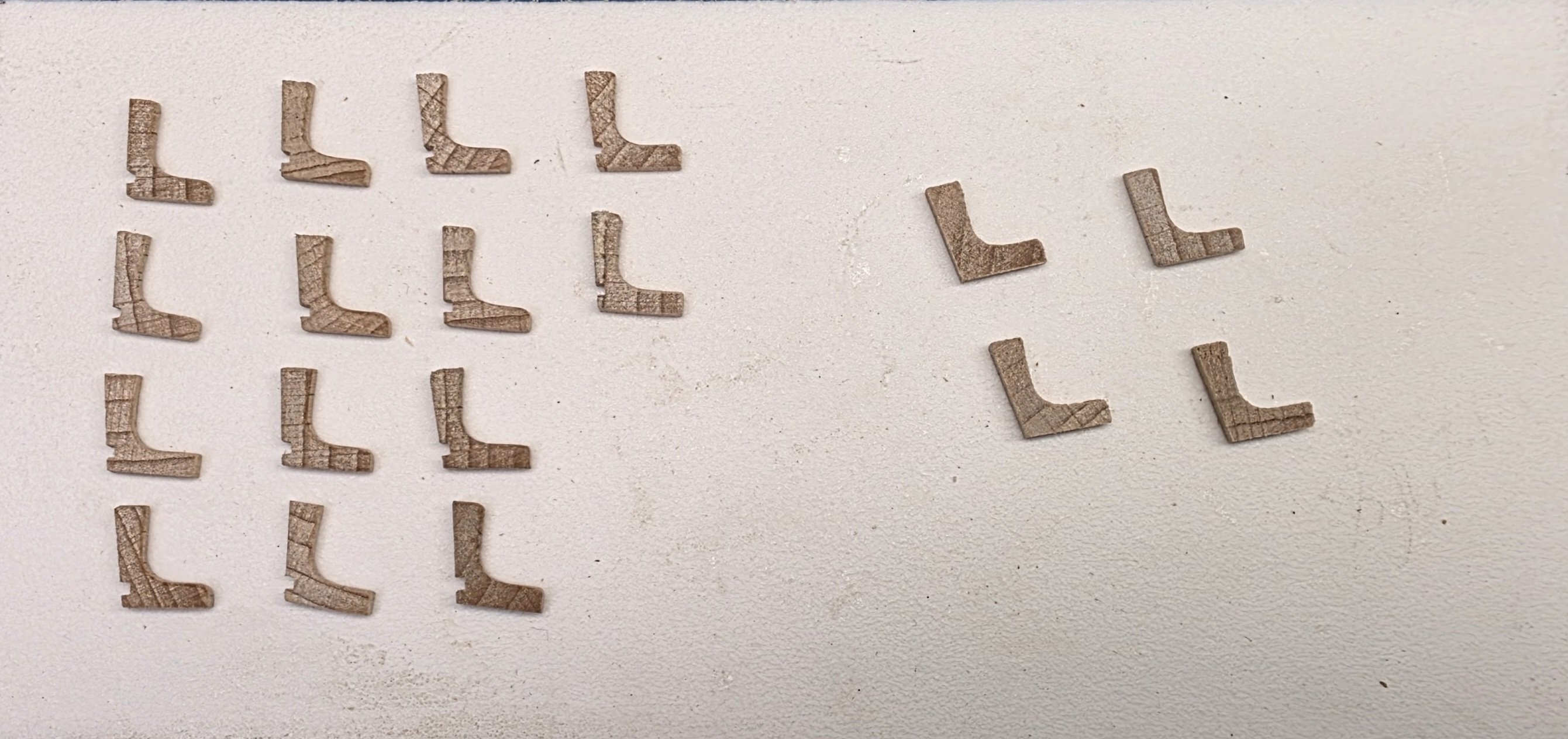

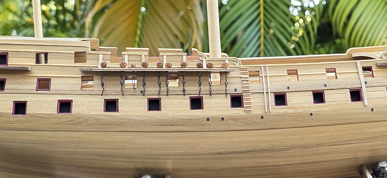

Hello All,

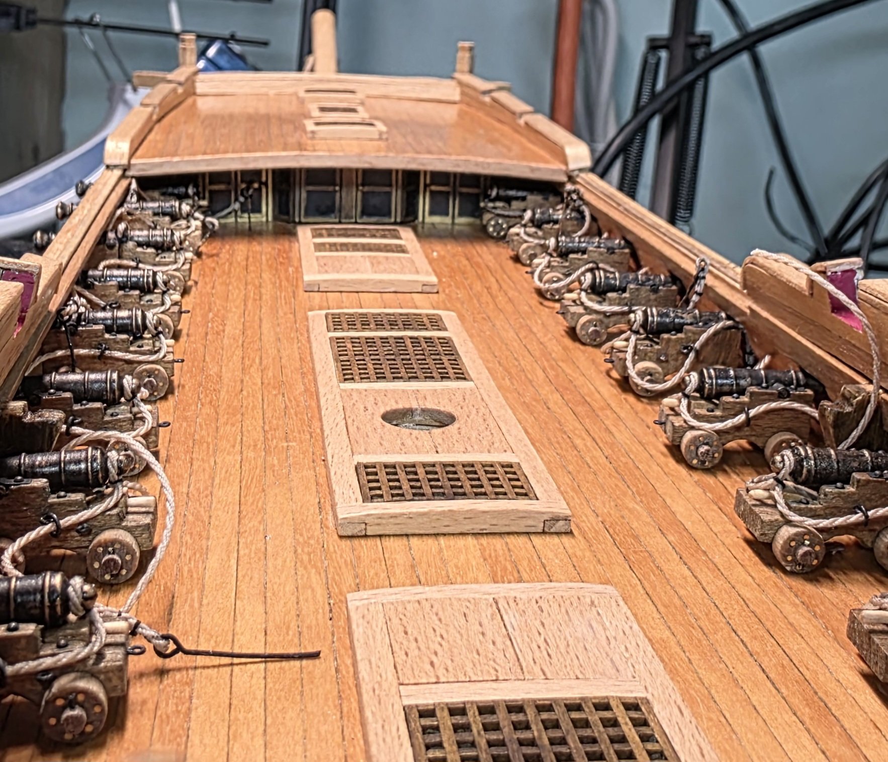

I have a small update on Bellona. I completed the 20 cannons that will eventually be placed on the upper gun deck. It was quite satisfying to see them all placed on the deck and I am very satisfied with the way they turned out. I will keep them in storage for now until the time comes to permanently install them, which will probably be some time from now.

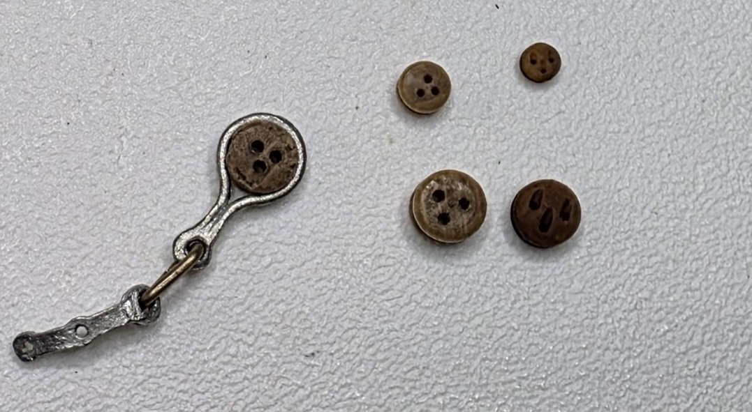

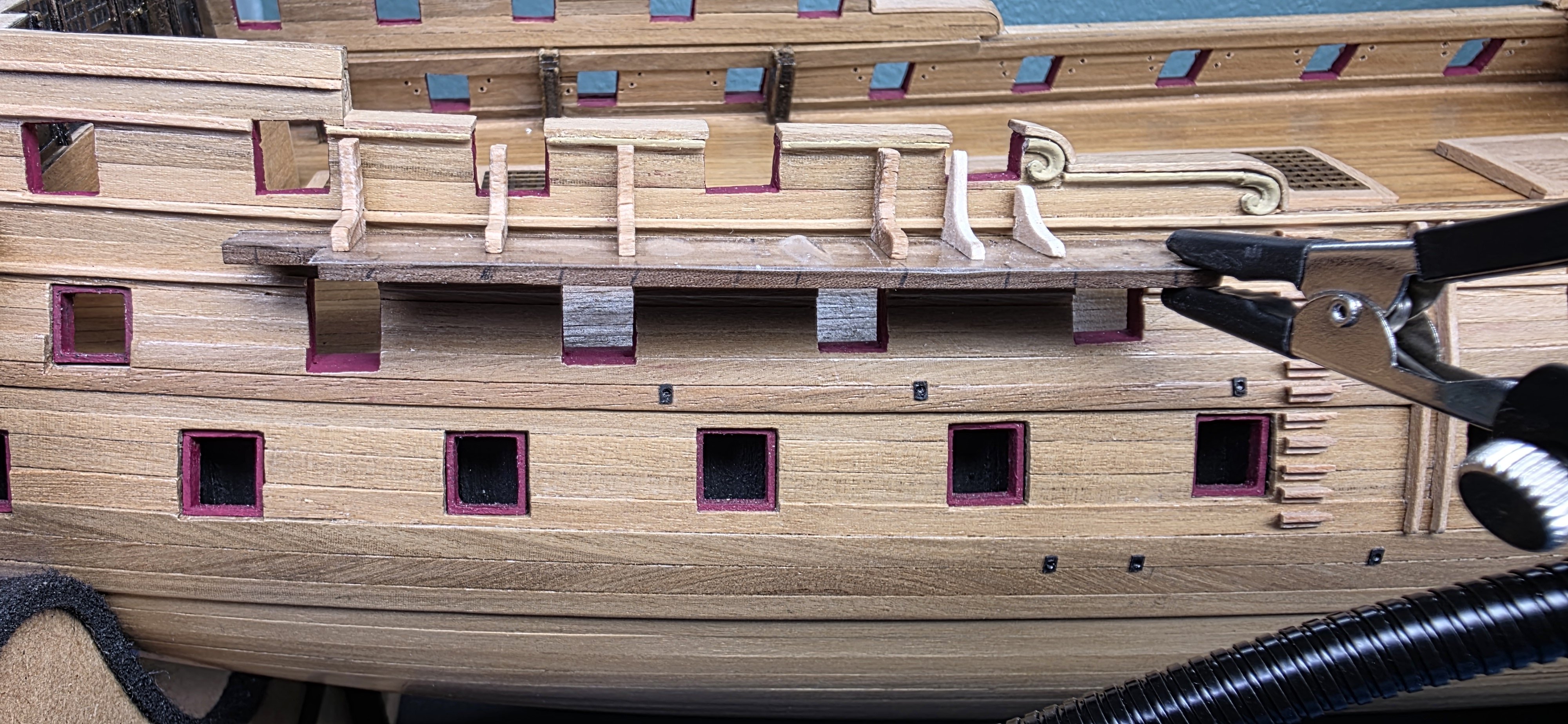

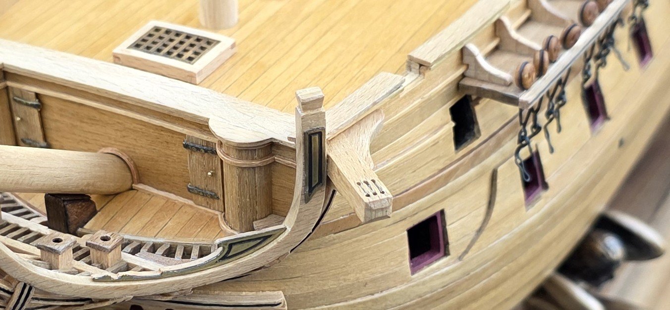

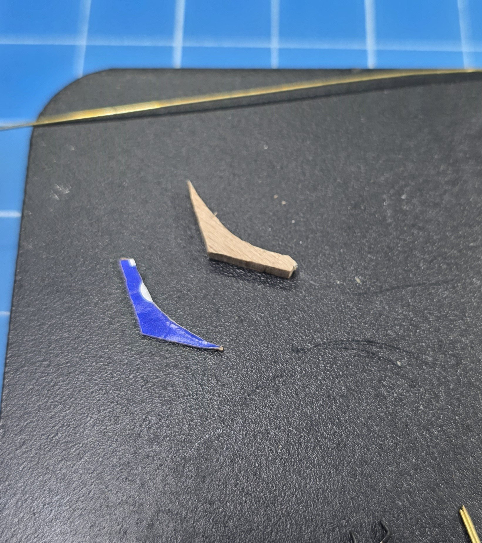

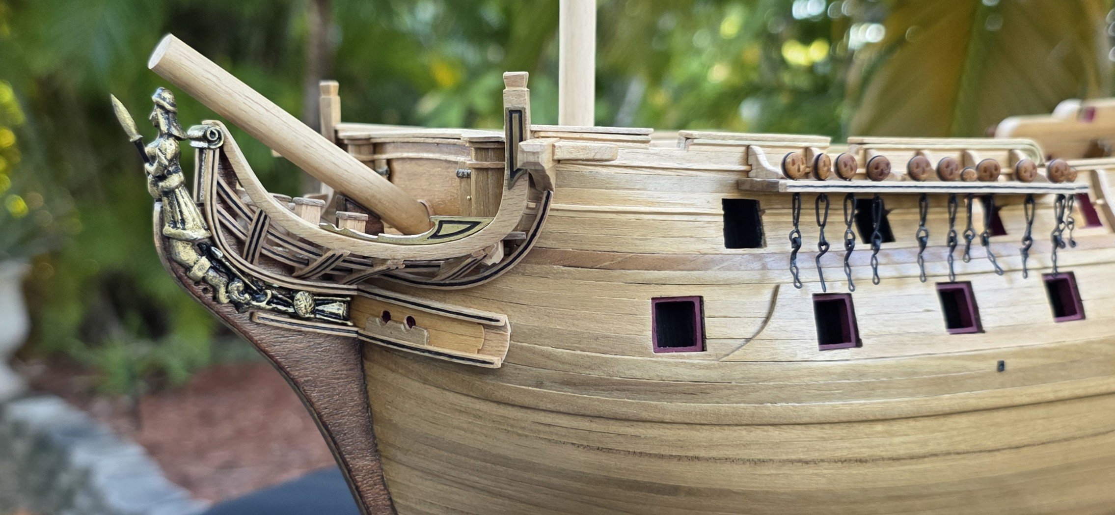

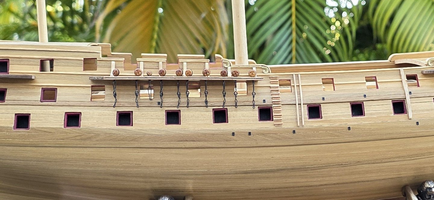

After I completed the cannons, I moved on to the installation of the channels. The plywood channels that came with the kit were replaced using solid walnut that I fabricated sometime ago. The knee braces that came with the kit needed a notch carved in them to fit between the raised molding on the hull. I used a third hand to help with getting the rough positions of the channels and applied two-sided tape to the channels to help with holding the knee braces in place. I made a couple of templates of the knee braces to get their final shape as the kit only came with the exact quantity needed and I didn’t want to mess up any of them and have to make new ones from scratch. I drilled holes in each of the channels and installed pins to attach them to the hull. Pretty straight forward technic. I shaped a groove in the center of a piece of 2mm x 2mm beechwood that will be installed as the channel rail securing the chainplates in place. I highlighted the rail channel molding using a black pigment pen which will match the molding on the head rails. I think having this detail on all the channels is going to add a nice flow to the natural colors I am using.
After I completed the channels and knee braces, which I have not permanently installed yet, I started working on the chain plates and deadeyes. Well, I must say that the deadeyes and chain plates that came with the kit are awful.  There are two sizes of deadeyes that are called out for in the plans. 5mm and 3mm. The 5mm deadeyes are more like 5.4mm and the 3mm ones are 3.9mm. I replaced them with ones that I purchased from Syren, and I must say not only are they much more authentic looking in comparison, but they are much more accurate in their sizes. There isn’t much room on the channels to begin with, so using the kit supplied parts would probably cause me some spacing problems. Well, I have begun the daunting process of making the chainplates from scratch and will provide and update on them once I have made some progress. That’s all I have for now and as always, your comments and guidance are always welcome.

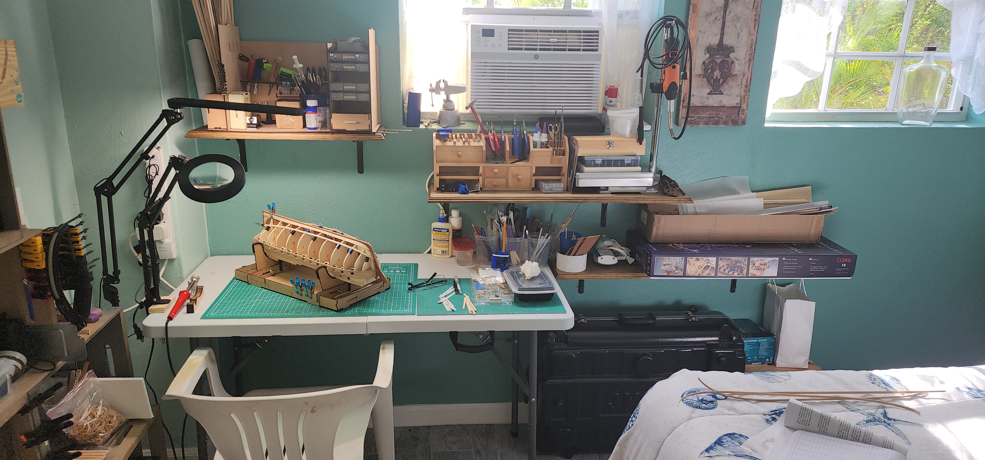

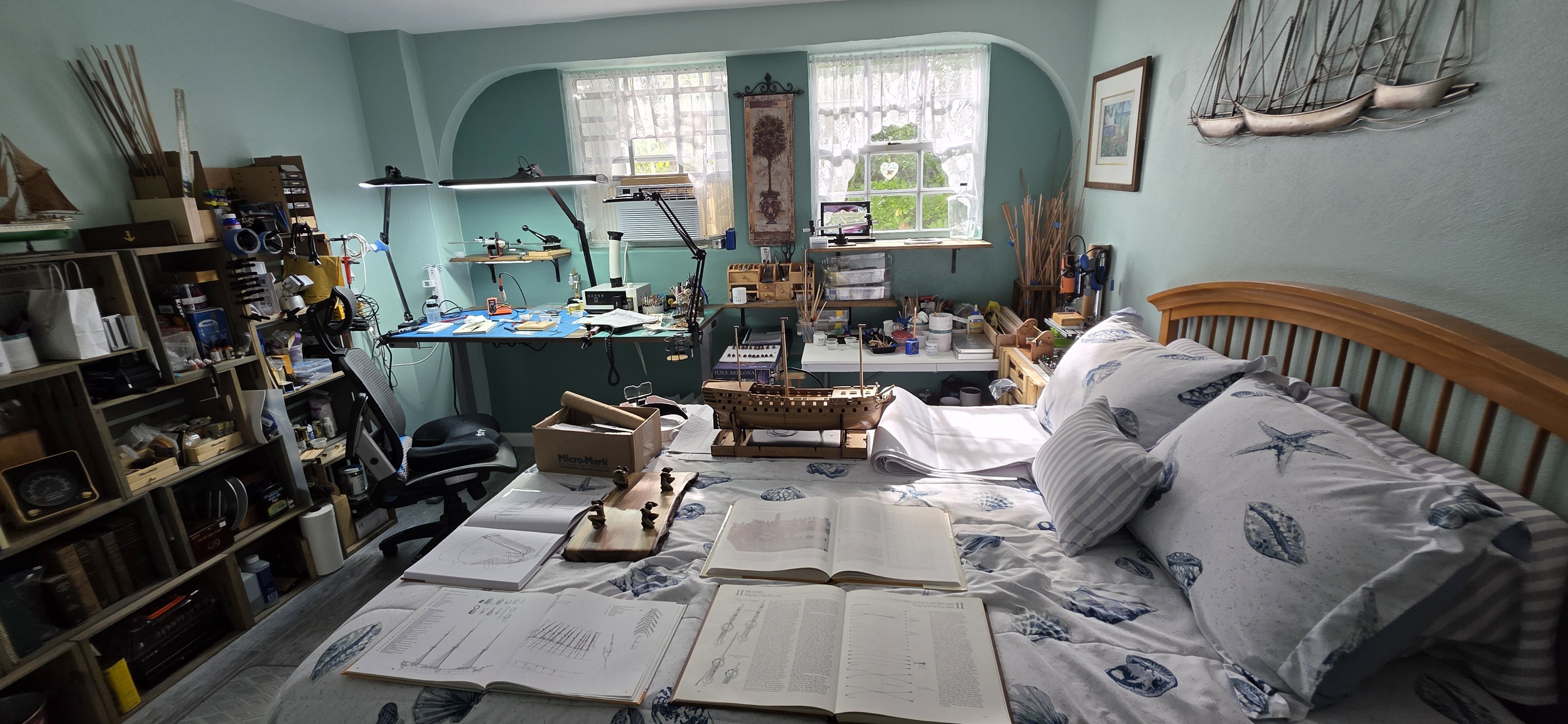

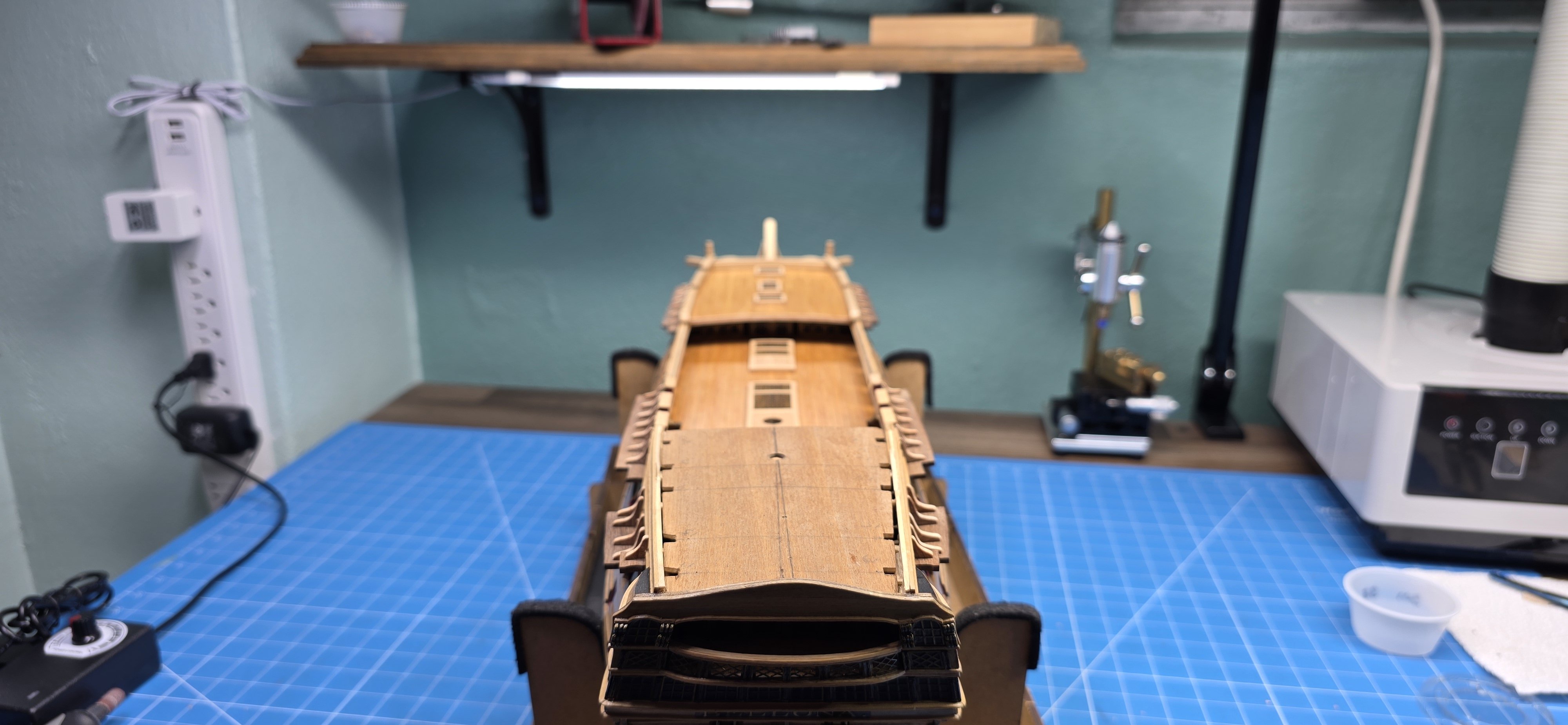

Hello All,

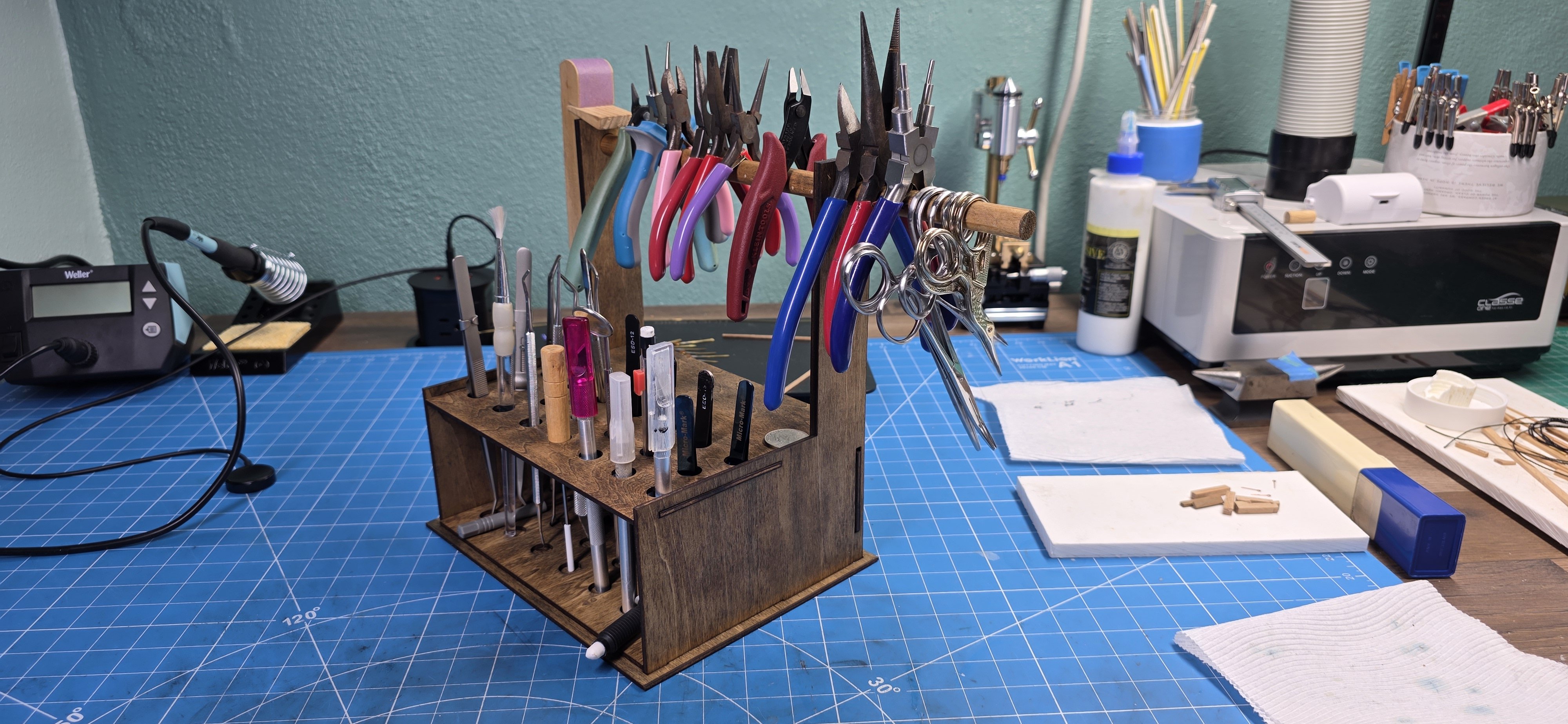

Well, I updated the shipyard again. This post isn’t necessarily related to my build log, but I find that it is appropriate because I find that looking back when I started building the Bellona 3 years ago and how the ship, the shipyard and I have grown, I wanted to share.  When I got back into the hobby over 3 years ago, I set up a small workspace in our spare downstairs apartment bedroom. I had a 2’ x 4’ foldable table and a plastic chair that I worked from and a small lighted magnifying glass. I wasn’t sure if I was going to enjoy this hobby and didn’t want to invest too much into my workspace especially since I had chosen a model as complicated to build as the Bellona. Over the course of time, I added a few shelves to clear up some space on my worktable and purchased a small floor lamp to help with the poor lighting. As time progressed my lovely wife purchased me an office chair to replace the lawn chair I had been using for the first year or so of the Bellona build. I must say that the office chair was a big improvement especially since I have a bad back to begin with. I also purchased another lamp that I was able to attach to the table to improve the lighting. I eventually added a larger tabletop to my foldable 2 x 4 table adding an additional 10” of workspace. I used a piece of starboard for this, and it was great until the edge started to sag over time and the game of keeping the round tools from rolling off the table began. Well after 3 years of working on the Bellona and loving every minute of the challenges that it has provided and the satisfaction of learning new skills, I must say that my love for this hobby has given me a sense of reward that I did not anticipate when I first set up my small little workspace. In addition to the shipyard, I have also turned my tool shed into a small makeshift wood shop that I go to for the messy stuff. I think that I have reached the maximum growth as I purchased an electric adjustable height table 60" x 30" to replace the 2 x 4 foldable one. I also added another light, and I must say, my new setup is awesome, and I hope to use it for many years to come. I appreciate you taking the time out to read this post as I think it brings an interesting point of how we grow in our pursuit in this hobby.
Cheers
Nearshore

Hi, Nearshore!
 When I read the posts of fellow modelers, I always try to imagine this or that master sitting at a table doing his favorite hobby. What does he do, what instrument does he use, what kind of surroundings are around… Therefore, the description of your workplace with the history of its development is very interesting, and the photos allow you to see it firsthand. You have a very cozy place and everything you need is always at hand, which is great. It is very interesting for me to observe the process of building your model, and I constantly refer to photographs of various components and details that I also have to make. One of the latter, the one that was made from the quarterdeck towards the forecastle with rows of standing guns, gave a sense of presence on a real ship. It's a very pleasant feeling. Since I've only been building my model for about a year, and even less on this forum, I haven't read all your posts in detail, but I've looked at all the photos. The work is neat and beautiful! I want to wish you good luck and progress in this interesting business!
Yours sincerely,
Frecap
The skill in modeling , or one of them at least, is the ability to duplicate things (in this case the cannons) and ahve them all look pretty much identical. You, sir, have achieved that and then some. Inspirational work indeed!
This is a fantastic post. The most important tool is the space and environment. As someone who returned to modeling just lately after decades, I'm straggling with creating a proper and organized working space and this is a great help.

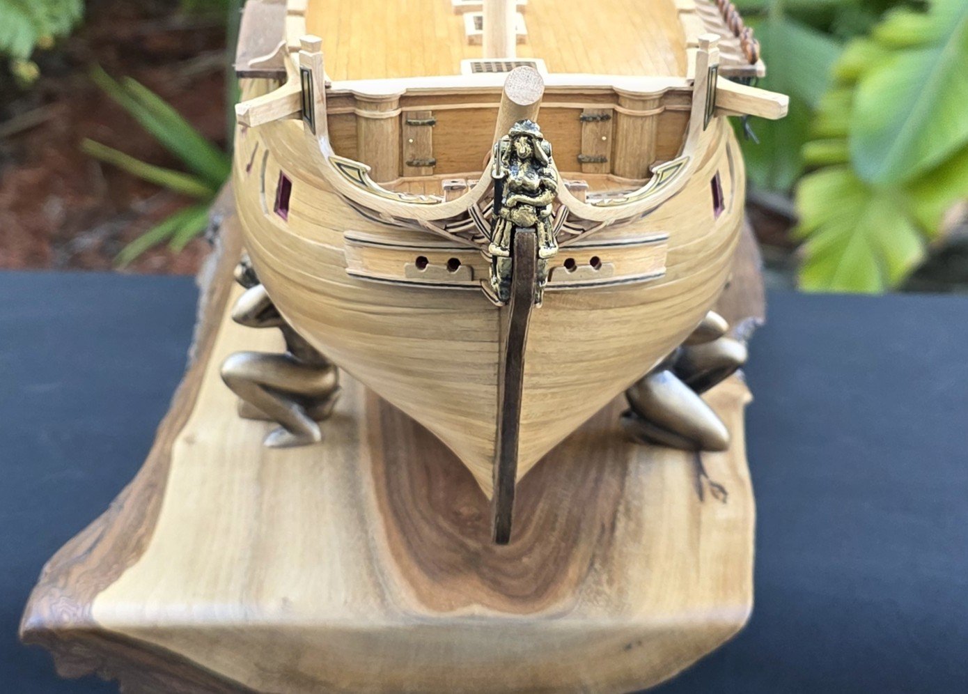

If you don’t mind, I have a question about the bearding and rabbet lines - for you and for anyone else with the proper experience. While I see them in the drawings (tables 4, 5, and 6), I didn’t notice them mentioned anywhere in the instructions.
So my questions are:
  1. Since this model has two plank layers, each about 1 mm thick, should the rabbet line be cut 2 mm deep on each side (which would leave only 1 mm thickness for the keel)?
  2. In table 5, there’s another dotted line between the bearding and rabbet lines. Is this meant to indicate where the first planking layer should end? I can see how that makes sense at the bow, but it’s less clear at the stern where the gap is naturally wider.

I stopped using the instructions a couple years ago as I found that they did not give the proper sequence of assembly and they are very vague. If you follow the instructions as they suggest, it will get you into a bind in the long run. The 2 lines that you are referring to are for the 2 babbets and bearding lines that need to be carved. The first one is for the first layer of planking. If you look at my post #53 I show where I carved out the second babbet and bearding line to recieve the second layer of planking. I ran my first layer all the way to the stern post and went back and carved the babbet and bearding line out removing some of the first layer of planking. This is optional as you can stop your first layer planks at the line shown on the drawings. I decided to run the planking all the way to the stern post as I figured this would add strength plus I needed the practice. There are a few build logs on MSW and only one that I am aware of that completed the Bellona at this scale. Halaquen completed this kit and did a very good job describing his build. I use it as a reference quite often. I hope I answered you question and that it helps you on your journey building this amazing ship.

I'm in love with that room of yours. Love the arc near/around the windows and the colours you used. Very relaxing atmosphere.
Apart from that, it's a brilliant looking model you're building. Looking forward for progress!
Roel

Thanks Nearshore. I created a groove only for the first layer and will continue to rabbet line for the second. Hopefully will work out.

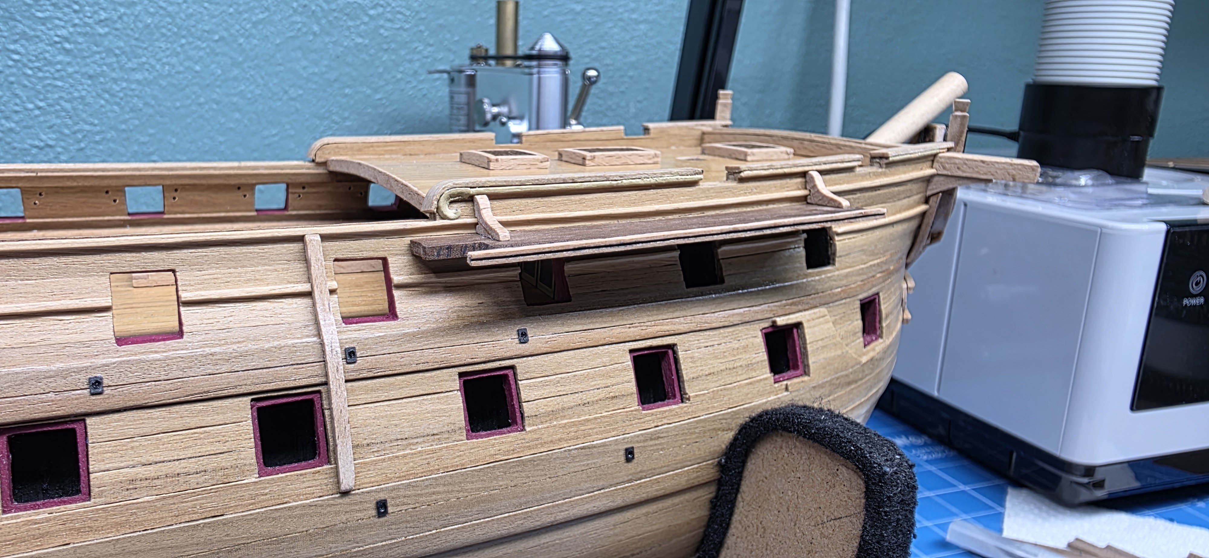

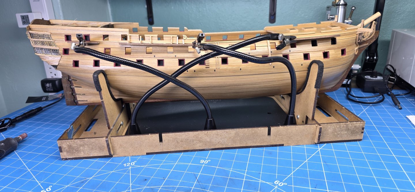

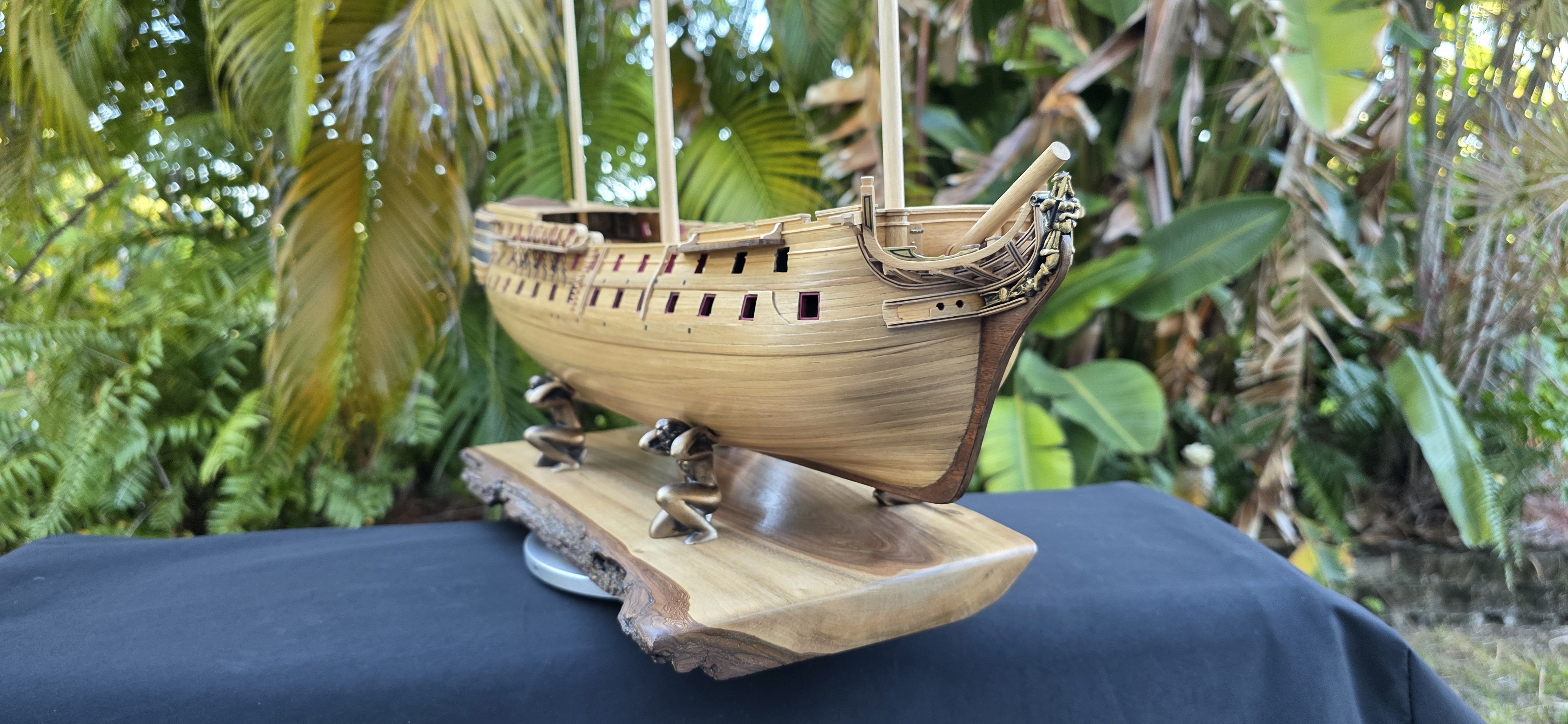

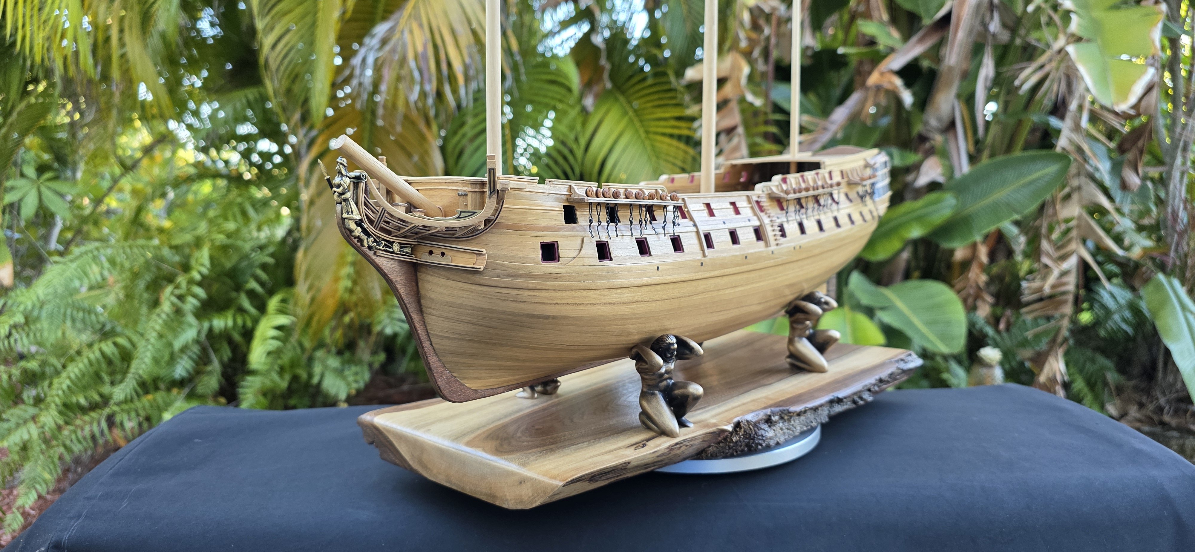

On 8/16/2022 at 7:07 AM, Nearshore said:

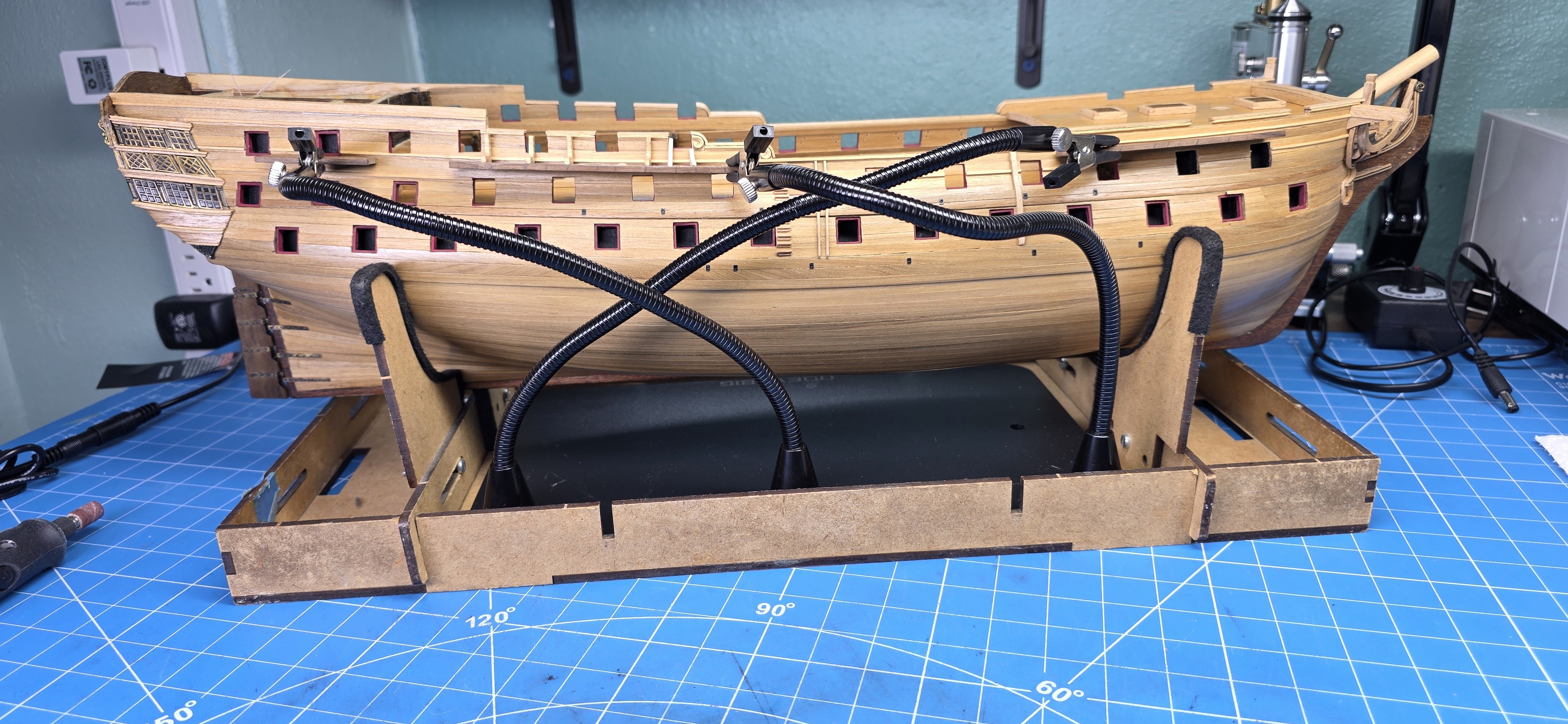

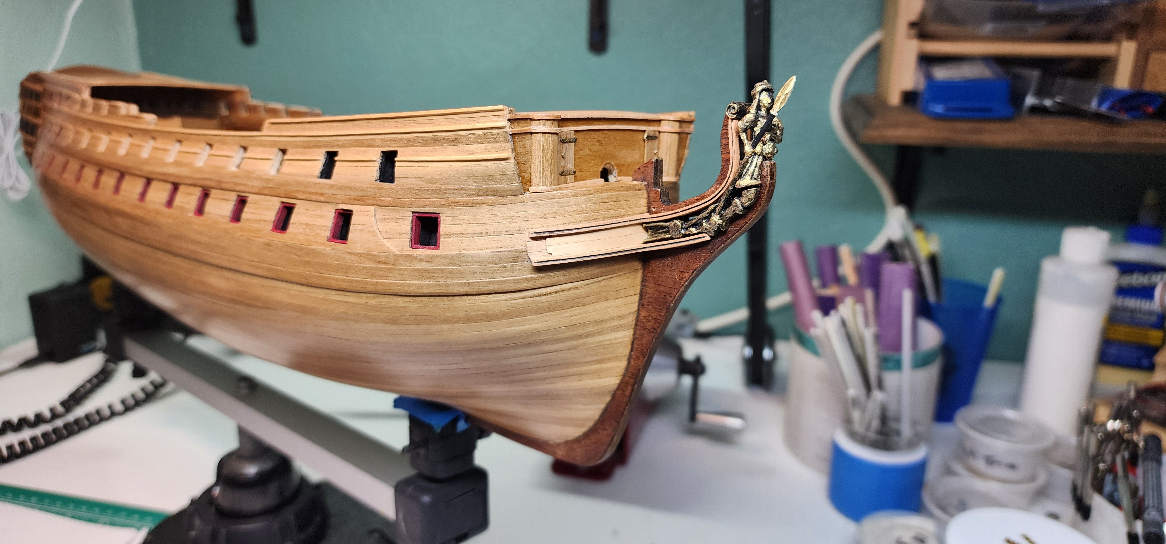

I am bringing this up to date to where I am on the assembly. I have been spending the last couple of weeks dry fitting the framing. The keel has a terrible bow in it. I tried to straighten it out with water and heat from an iron. It did get most of the warp out of it, but there still is a slight bow. I am using some 1 inch aluminum angle on my vise to keep things straight. Hopefully when the frames are glued and the upper planks are in place that that will keep things straight.
I decided that I was going to bevel the decks prior to them being installed. They sit in place rather nicely without having to pin them in place. I installed .5mm and 1mm shims on the frames to also keep them in alignment. So far everything seems to be lining up ok. I haven't glued anything yet, i still need to mark the keel for the babet and bearding lines.  Well that's it for now.
Nearshore

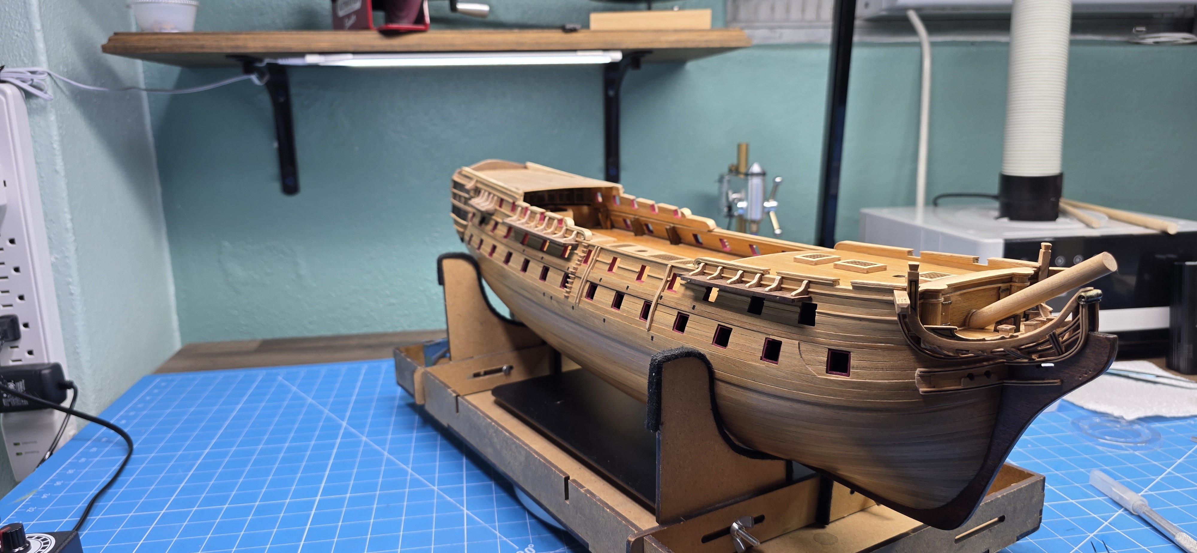

 Hi Northshore. I'm exactly at that stage with my own Bellona and are working on fairing the bulkheads. I noticed that some of your bulkheads were a bit short on the main false deck (i.e. not flushed with the deck). Including bulkhead #6 which is obviously shorter. I'm wondering how you went about that. Did you send down the edge of the deck? Or did you add some materials to the bulkhead? At least for #6, I'm assuming you shaved the deck.
Thanks. And BTW - your ship is amazing.
Hi Captain Amateur,
Yes when i faired the bulkheads I sanded the deck to be flush. I did have to add some material to a couple of bulkheads to allow for a smooth transition of the planking. Are you doing a build log? If i haven't clearly answered your question, maybe you can share a picture of what you are questioning. Thank you for the compliment.

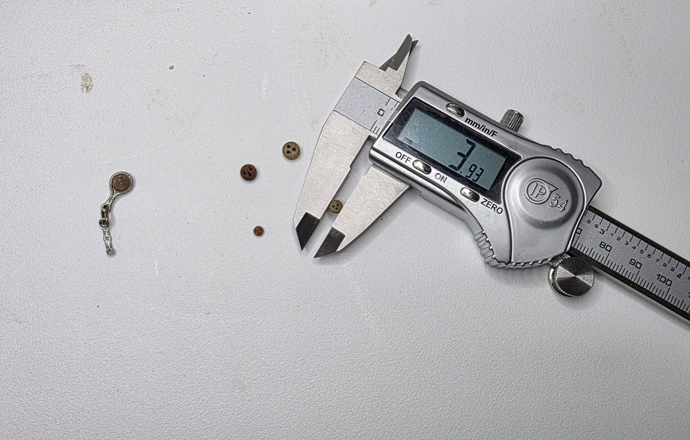

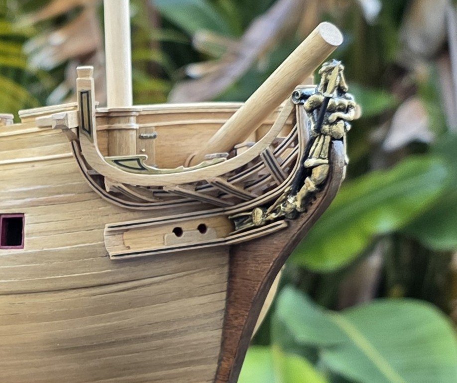

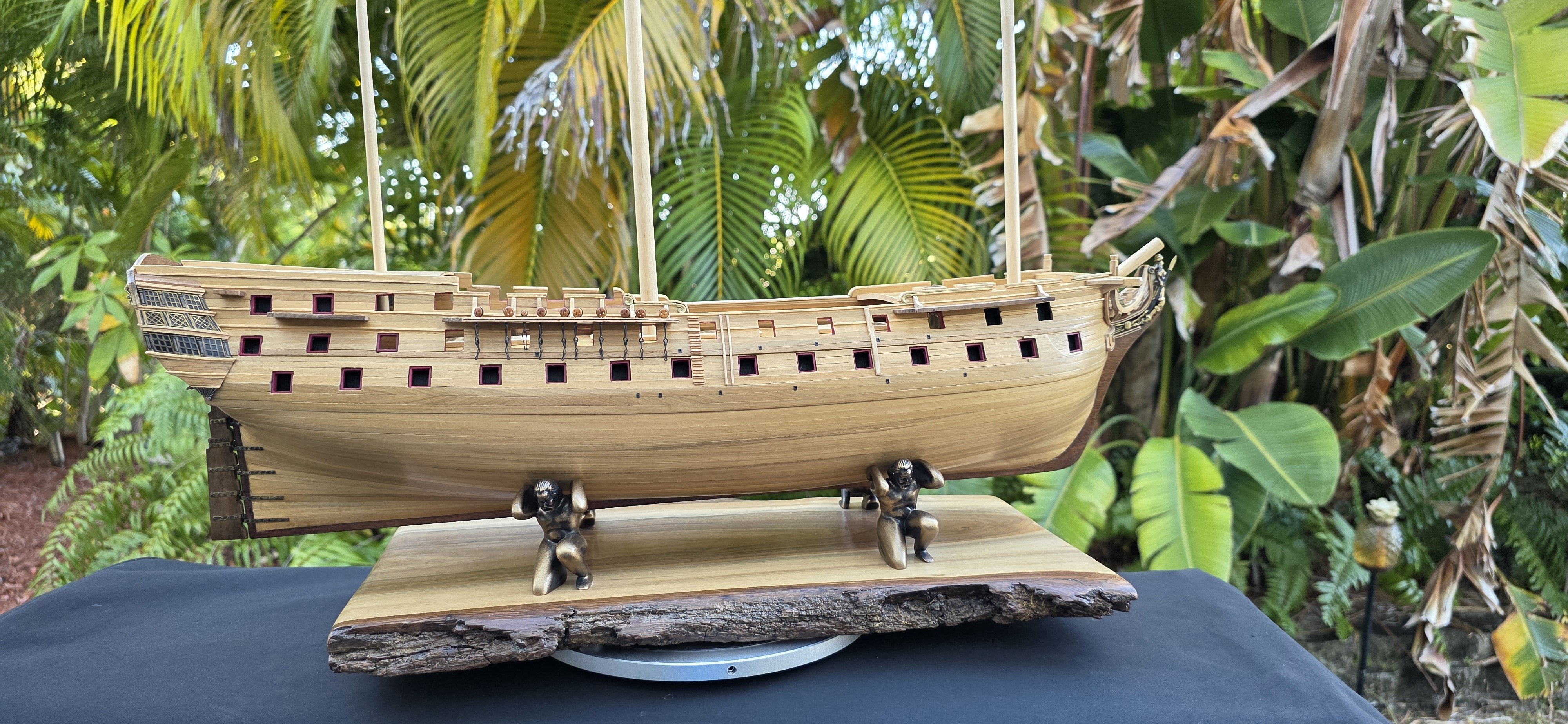

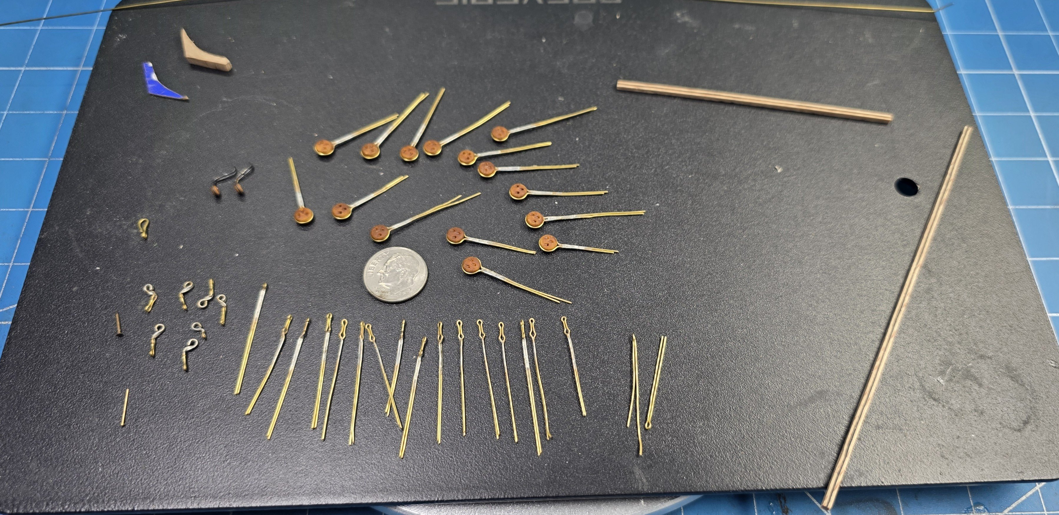

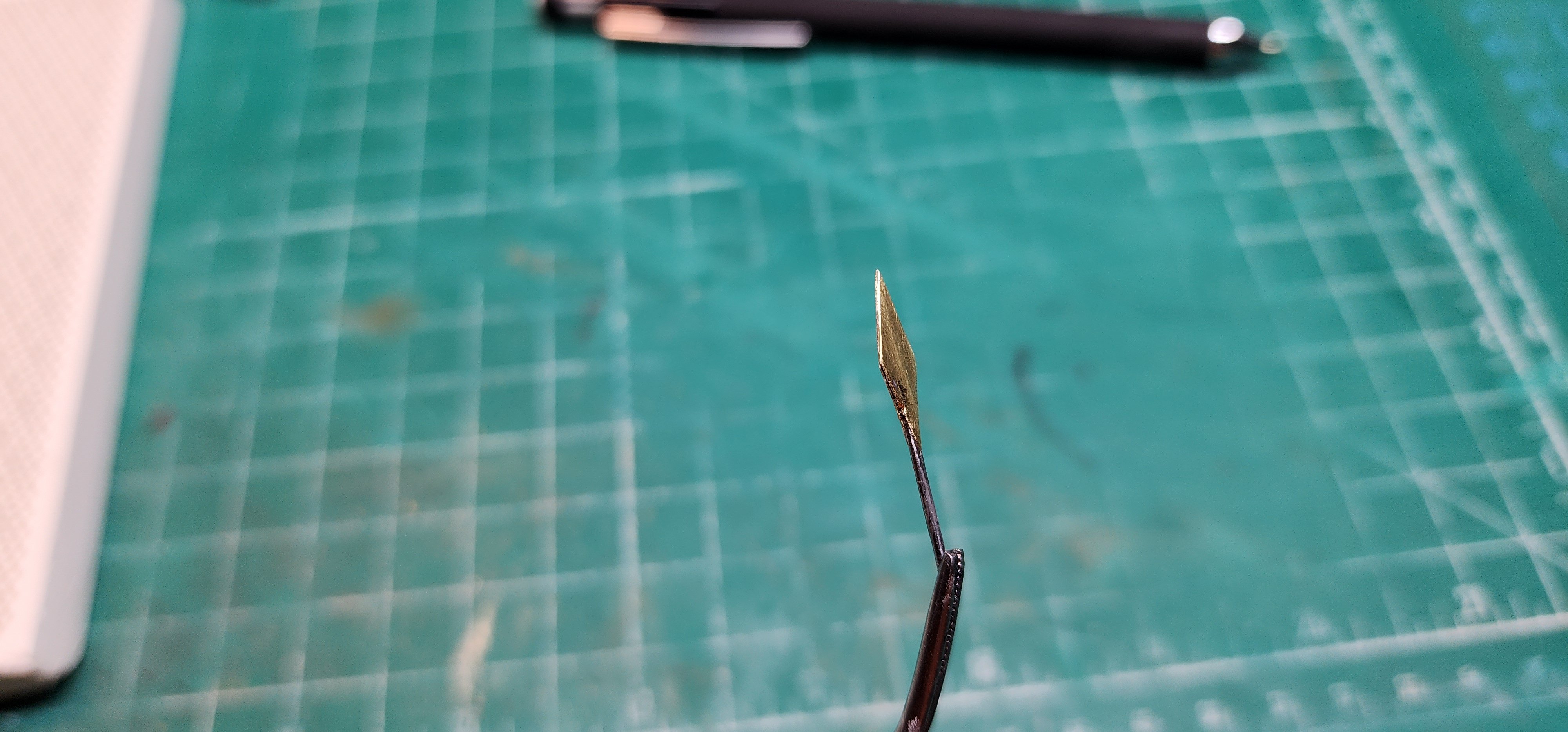

Hello All,

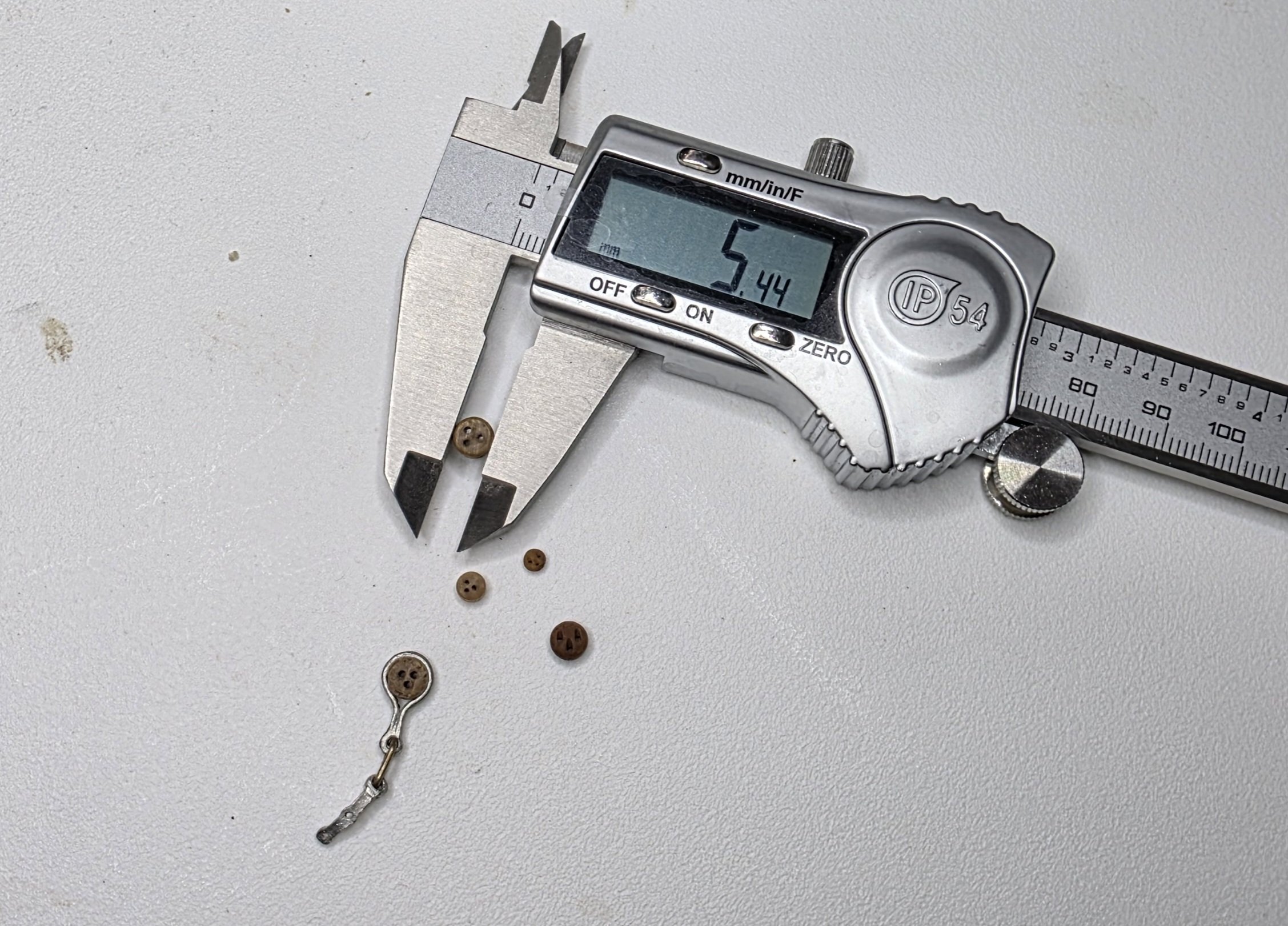

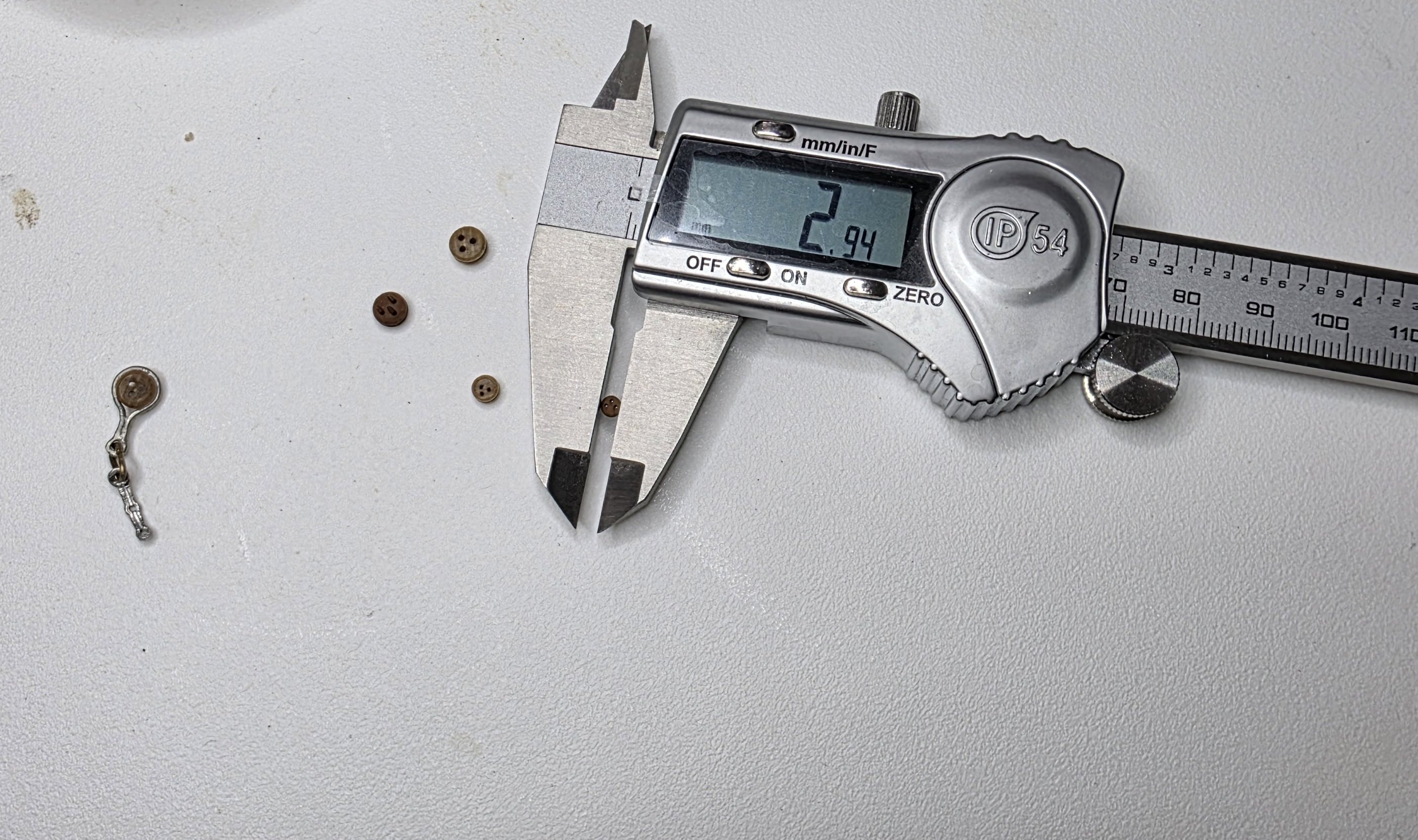

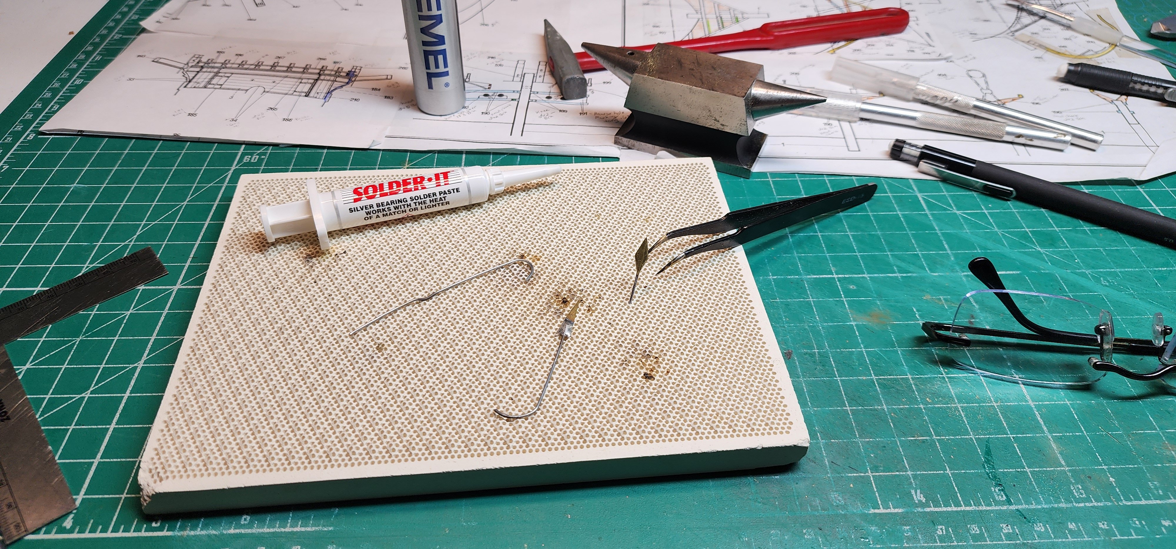

I have a small update on the Bellona progress. I have  been working on assembling the deadeyes and chain plates.  It has taken me several attempts to fabricate them and come up with something that I feel looks better than what was supplied with the kit. I used a .5mm brass wire for the deadeyes and a .7mm brass wire for the chain plates. I was not happy with my first attempt, the chain plates seemed to look kind of like a paper clip. My second attempt was a little bit better, but I was still not very happy with my results. My third attempt was more pleasing to my eye, so that’s what I went with. For the purest out there, they are not historically accurate, but there are quite a few things on this kit that are not accurate. I have completed the port side channels and will move on to the starboard side applying the knowledge and skills I gained. I don’t think the starboard side should take as long as the port side now that I kind of know what I am doing. LOL I won’t get into too much detail of how I constructed these, I will let the pictures speak for themselves. As always, you comments and guidance are always welcome.
Cheers
Nearshore
