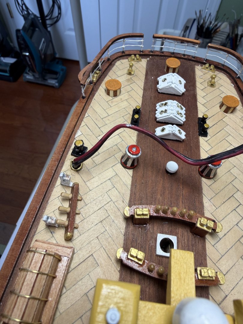

Bill, yes, I added these lights after I did all the initial planing and wiring and after closing up the hull. My mistake for sure as I believe them to be very beneficial to the deck lighting. Oh well, it was an easy fix. I drilled the upright dowels out to accommodate the wires for the new LEDs. Then added a hole in the deck under the uprights. Still to this day I have not glued down my bridge building as it’s just stuck to the deck with 3 or 4 dowel pins, so I just fished a wire through the new holes up into the floor under the bridge. Made the connections to the bridge wires, pushed them back inside the hull, and connected the new LEDs. When the bridge lights come on, in my case along with the deck lights, so do the new LEDs in that structure. I hope this helps.

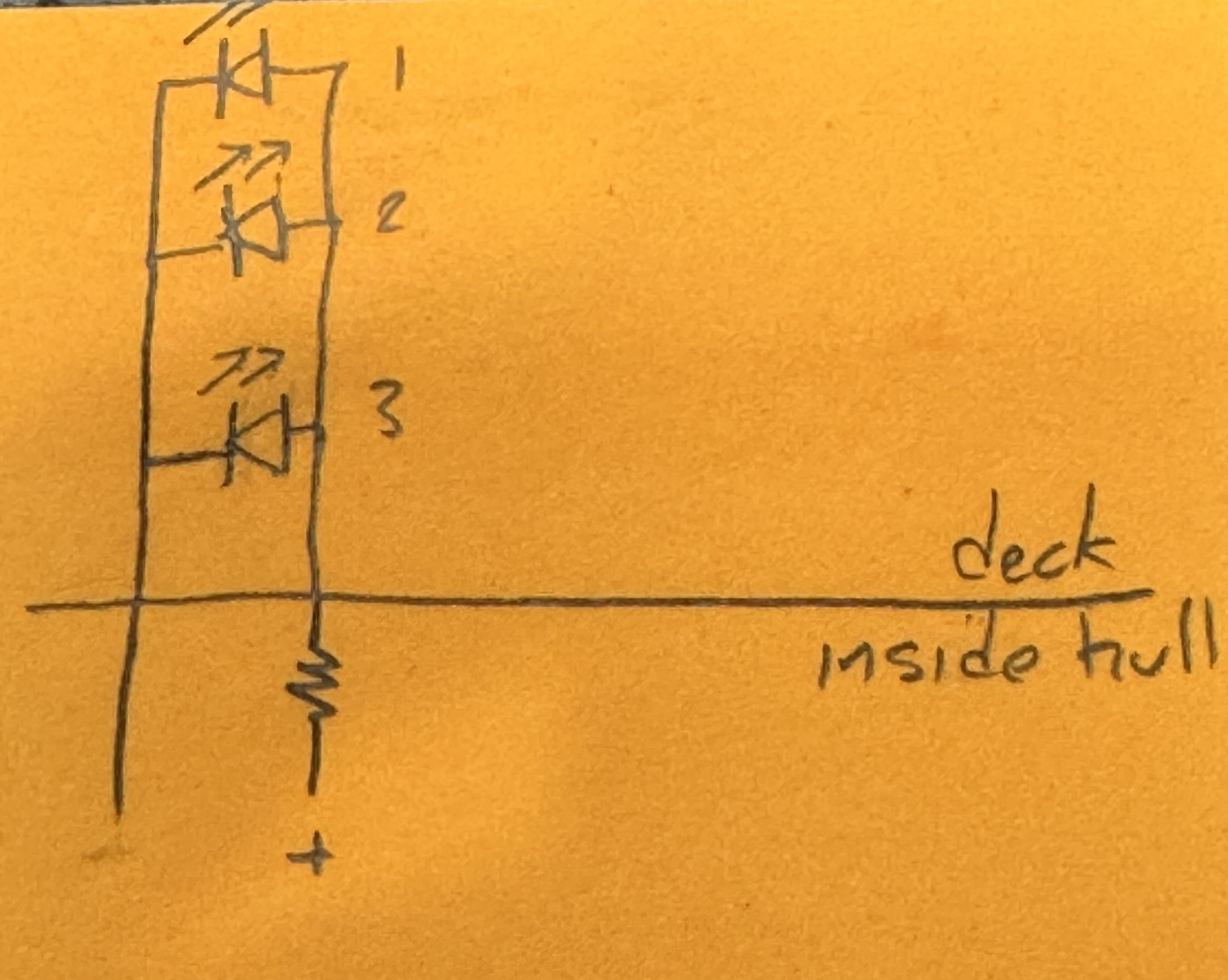

Daniel this was your reply when we were talking about the spots to illuminate the masts.
Bill, there is nothing that says the resistor has to be next to the LED, meaning, the resistor can be inside the hull and a wire from one end of the resistor goes to the LED. In my setup, I ran a series scenario with the LEDs, meaning one resistor then the LEDs are run one after the other in series. This type of wiring does have a draw back, for the same reason Christmas lights are wired in parallel now days, if one bulb goes out, they all do. That aside, the resistor is inside the hull making for less hardware in the box.
I don’t like how big my light boxes needed to be in order to house a 5mm LED and a resistor. Do I understand that you put one resistor on the positive wire below the deck and then ran the wires to the boxes with no additional resistors?  Also did you use 3 or 5 mm LED’s?  If I wire it like this you say if one bulb goes out the other 3 or 4 will also go out?  If in the future a bulb would go out would it just be a matter of determining which one failed and replacing it?
Hi Bill, sometimes electronics can be fudged a little, resisters are not precise, voltage drops are not always consistent, etc. Below is a circuit that fudges a little but works great, with one side effect, you will have to turn up the voltage a little to get the brightness you desire. Not too much, and no where close to overload the resister. So, I placed a resister inside the hull on a positive lead, the other side of the resister goes a max of three LEDs while the negative lead goes to the negative side of the same LEDs. This circuit is called parallel, which means that if one LED goes out (unlikely) the others are still connected and work fine.
I used 3mm high intensity LEDs for this circuit, 3 LEDs for one resistor. This allowed me to make very small boxes to house the LED as each box only holds just the LED (no resistor).

Yes Daniel this will help a lot. I noticed on your’s you have two wires coming through the deck for each mast. One on each side at the fore, main, and mizzen. That is how you are able to power 6 LEDs at each mast (3 each).  I only have one wire at each so I will be limited to a max of 3 LEDs at each mast. Wonder in this schematic if I could use 5mm LEDs instead of 3mm in order to get the max light possible?

Yes, I planned my wiring layout with this in mind. There is another option, I just did not have the parts on hand. Currently you are using 1/4 watt resisters as they are very small and easy to hide. To run 4-6 LEDs on the same circuit off a single resister you can use 1/2 watt resistor of the same value. These resistors slightly larger but would still easily find inside the hull but are able to handle more current without over heating.

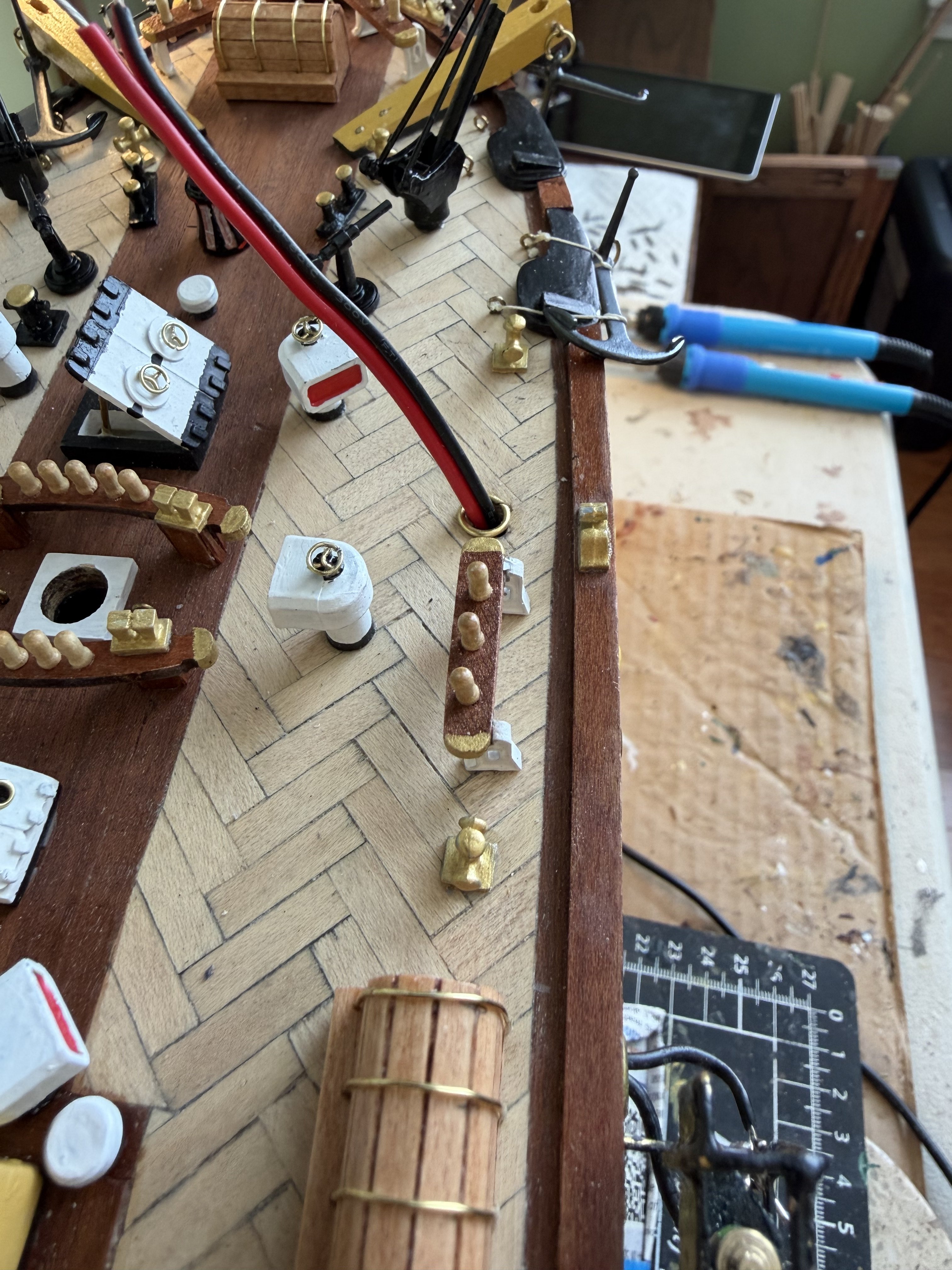

Daniel I was able to increase the size of the hole just enough to push the 1/4 watt resistor and soldered joints down into the hull. To improve the look of the larger hole I made some brass rings and glued in place. Now I have the resistor under the deck and will run three 5mm LEDs at each mast. Whatever brightness and illumination I am able to get will just have to be sufficient.  I suspect just the hint of the 3 colors will still be impressive.

Daniel I followed your lead on putting the resistor below deck. I only used three 5 mm LEDs at each mast. I think it is going to look great.
You said;
The three 5mm LEDs on the line from the one resistor show 3.2v.  Would you think maybe turn up the voltage to a max of 4v on the voltage regulator, or less than that?
