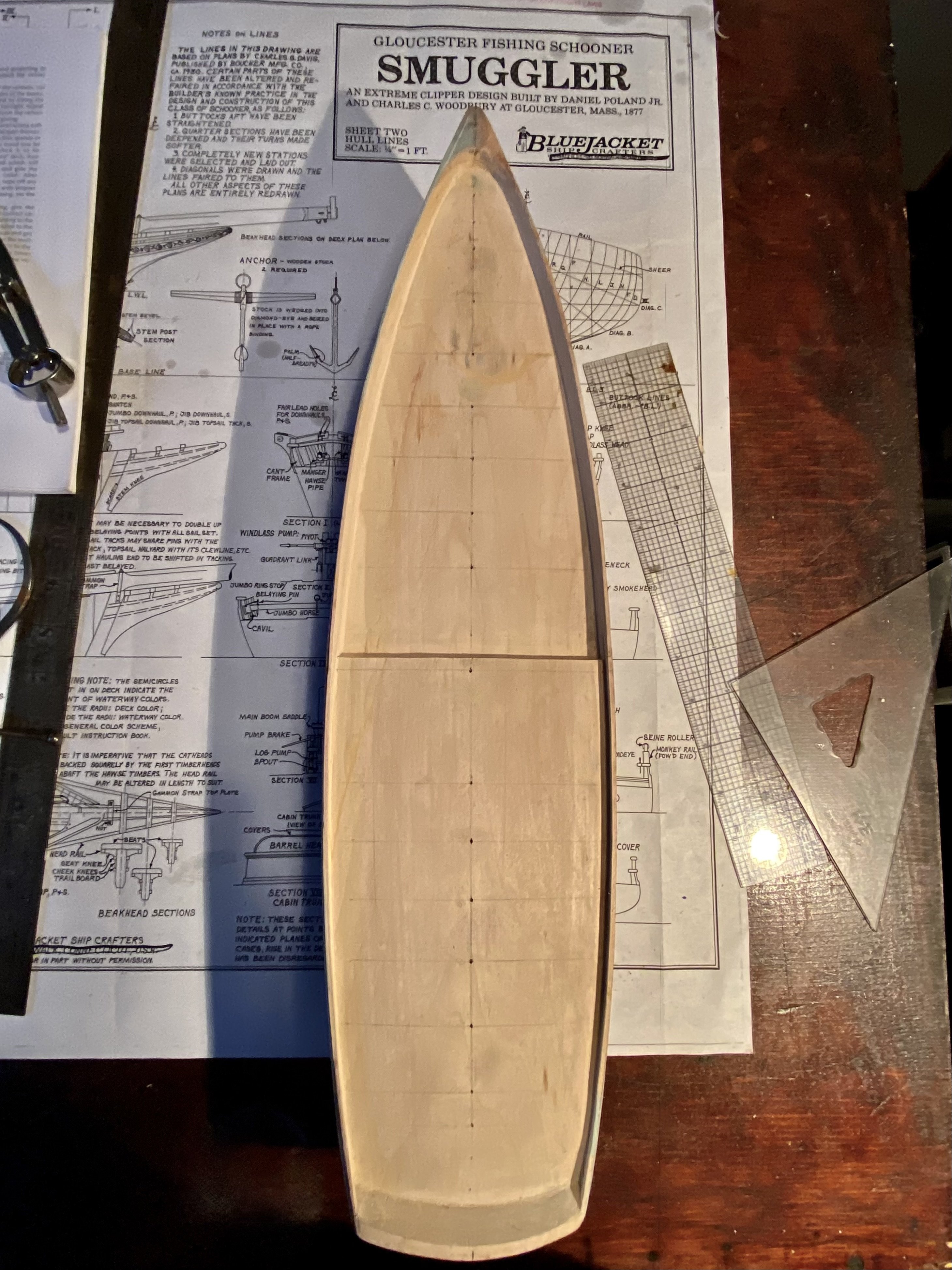

Today I started my second build, Bluejacket's Smuggler. My first build, the Grand Banks Dory was a simple plank of frame build and this being a solid hull, will be a new adventure for me. So studying the plans and reading up on the subject I started by creating the keel template. I scanned and copied the print ensuring that there was no difference in size after printing. When that checked out OK, I carefully cutout the copy of the keel/rabbit detail and laminated it on what I think is Birch, 3/16 thick. Very stiff and straight and checked for accuracy against the print, this is very handy when it becomes to trimming the solid core. No flopping around, just like a yardstick. After ensuring the keel was perfectly flat, I started trimming  the transom with  10" coarse half round and rat tail rasps while always checking the template against the midship tick mark. When the transom had a decent fit, I proceeded to the bow and trimmed for an exact fit using a course rasp, again always cross checking while holding the template firmly against the transom .A final tweak her and there and it fit like a charm. A problem I encountered was the hull moving around in my lap while filing. I did not want it in a vice as sitting in my rocker is a comfortable position for me, as my back has seen better days. What did work, by accident, was a piece of Tempur foam material. No matter what angle your working, the foam holds/cradles the model with out shifting and offers outstanding protection for dings and dents and allows you to file with any pressure you want. Tomorrow I'll finish cutting out the station templates and after finding the centerline, will start fitting them. I'm guessing you just carefully remove material in the general area of each station template one by one, then as the manual says, rasp it smooth connecting the hollows created. Any suggestions are welcome as to how to create those cuts/ depressions with the templates. Cheers, Tim

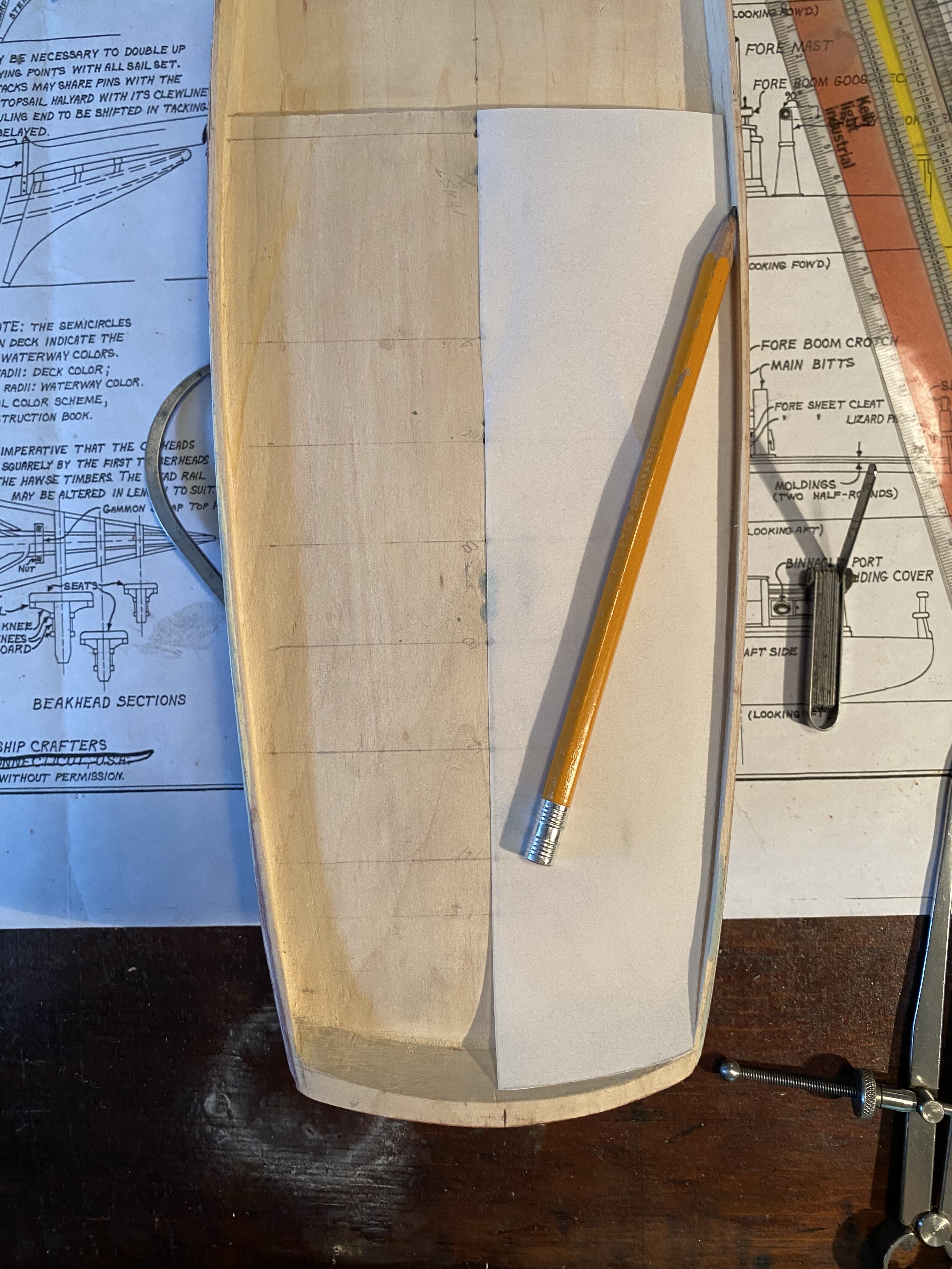

Bulwark where it meets the transom, (I think it's correct). Bulwarks are a slightly loose 3/32, I don't think I want to take anymore off. Will sand smooth what I’ve cut so far. Nic?

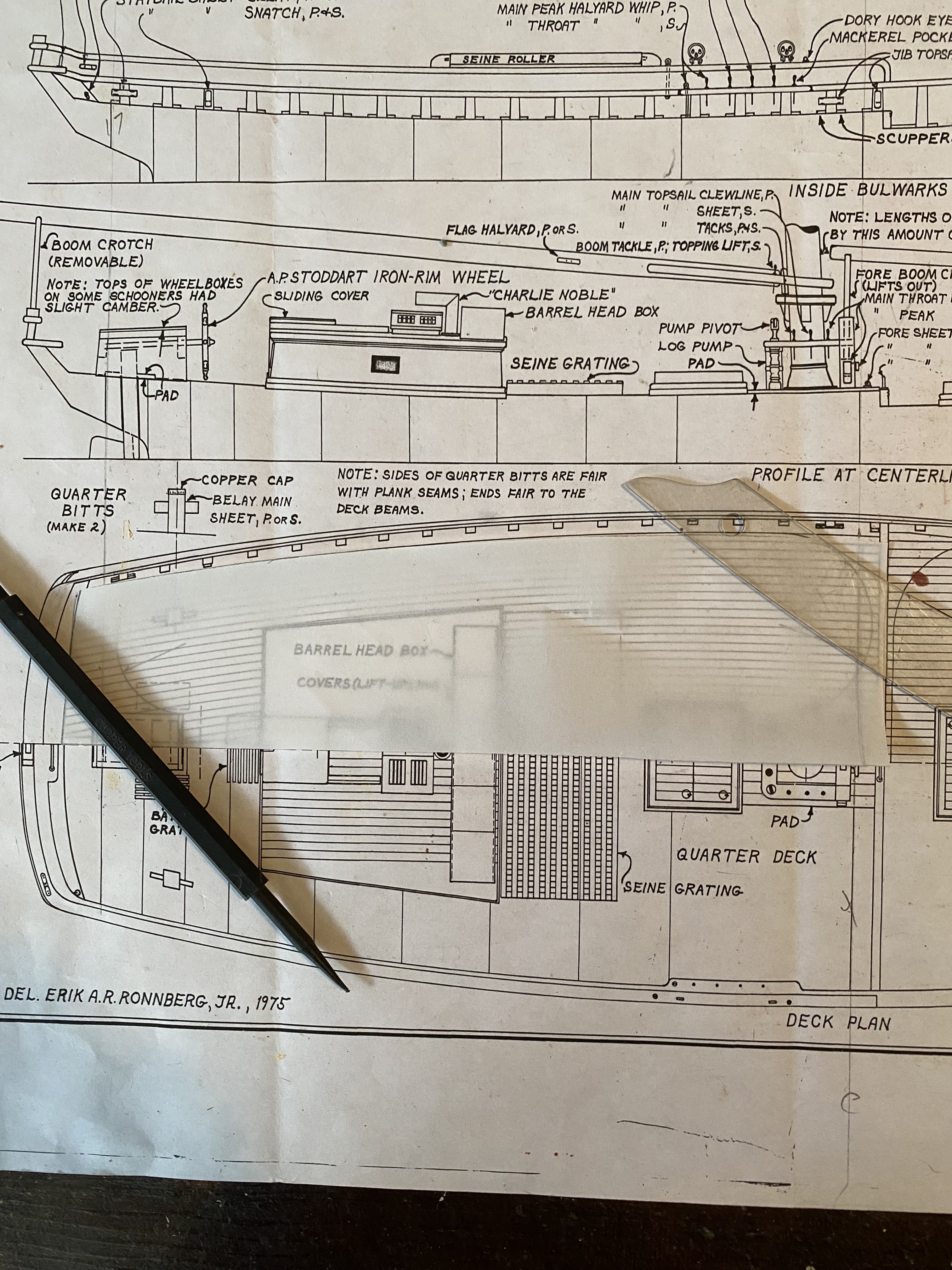

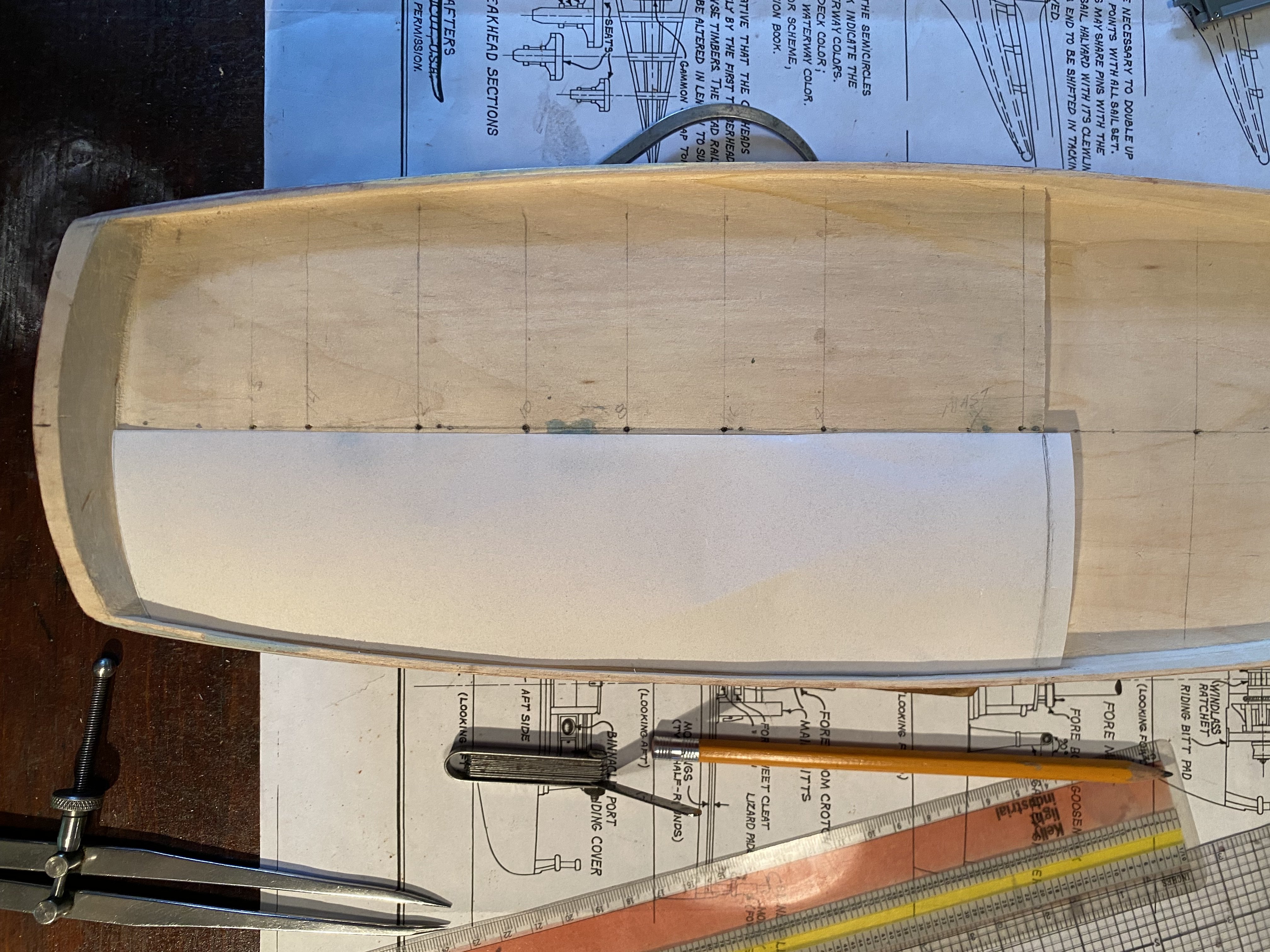

Used vellum to trace the decking, it seems I need to take more off the transom, so the tracing fits? I trimmed back for the Grub beam. What am I missing here? Maybe Charlie or Nic at Bluejacket could comment? Need some help.

Hi,
Unfortunately, Charlie passed away in Oct of '20 - Make the deck to fit the boat, or possibly the base of the stern is thicker than the top?
Nic
