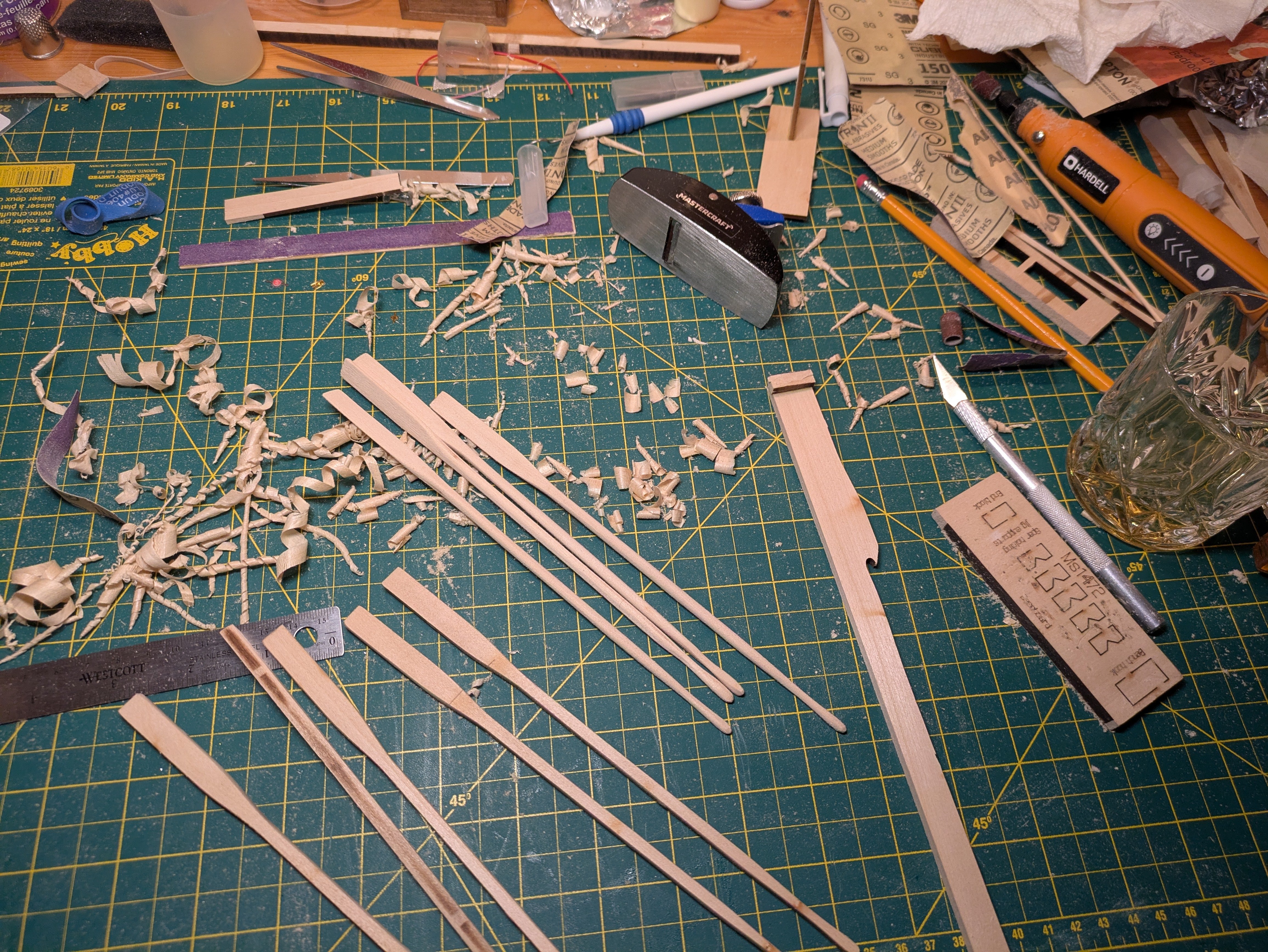

Masts and spars were next and went fairly well. I'm  used to making masts out of square stock or 2-ply laser cut wood and this was the first time tapering a dowel. I do not, like most people, have a mini lathe. I didn't know mini lathes were a thing until recently. I also didn't  want to have to create buckets (mini buckets) of sawdust samding dowels down to size and so used my mini plane on the dowels much like I would have with square stock. It went well!
I tapered the masts and spars and stained them. I also painted the tops of the mast "like the picture". I made cleats out of scrap which was a bit thinner, and hopefully more appropriate, than the 1/16 square stock called for in the instructions.

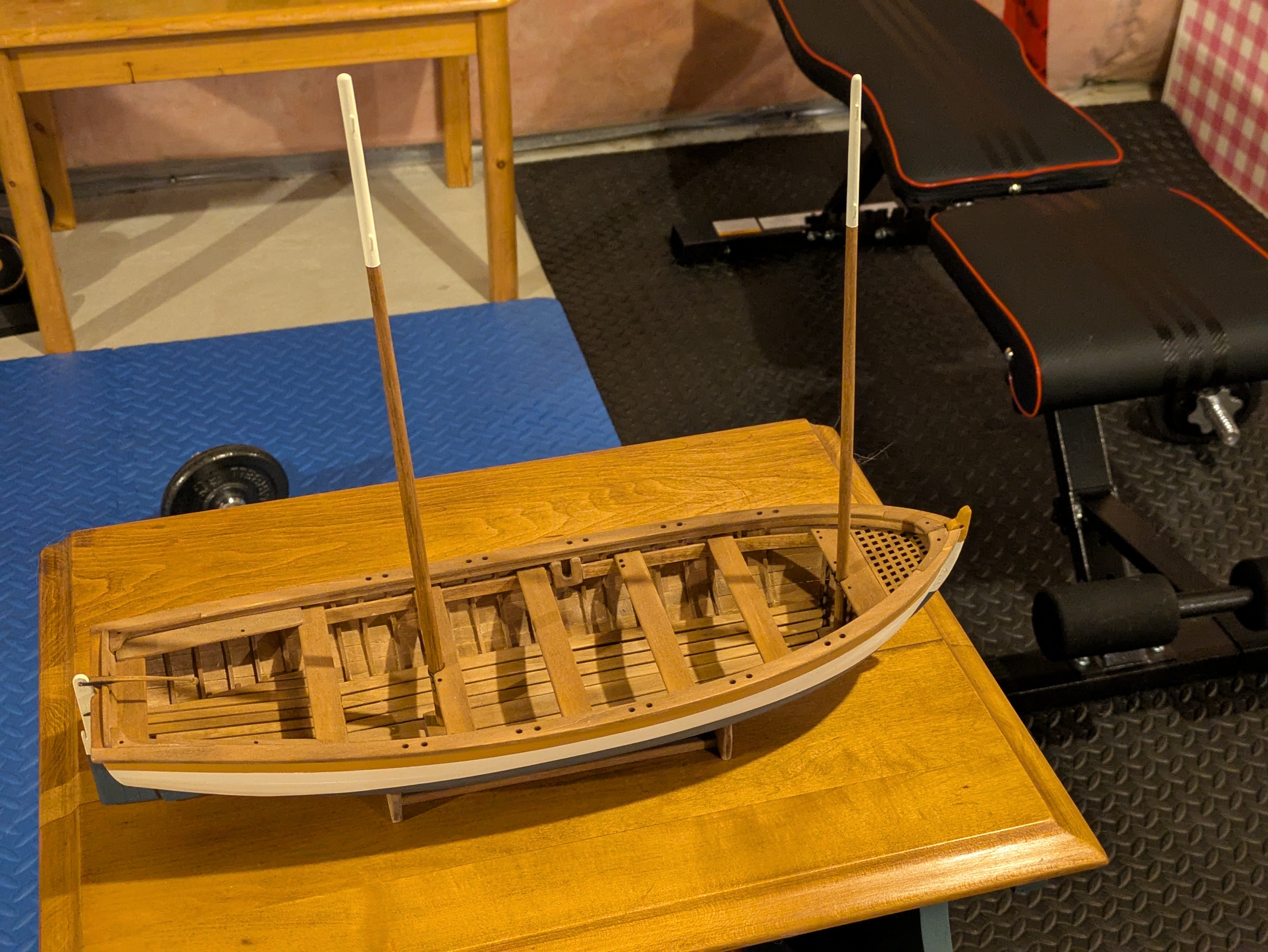

Well, I'm back. I looked at my last post in....March 2024!?! And see I had the audacity to say "we're getting close to complete!" Cheeky, no? I've been distracted with other things (including some actual sailing) but haven't forgotten this project and do occasionally chip away at it. I'll bring you up to date here. Currently, the ship looks like this:
In the last post, I'd finished the sails and was pretty darn pleased with how the bolt ropes added to the look.

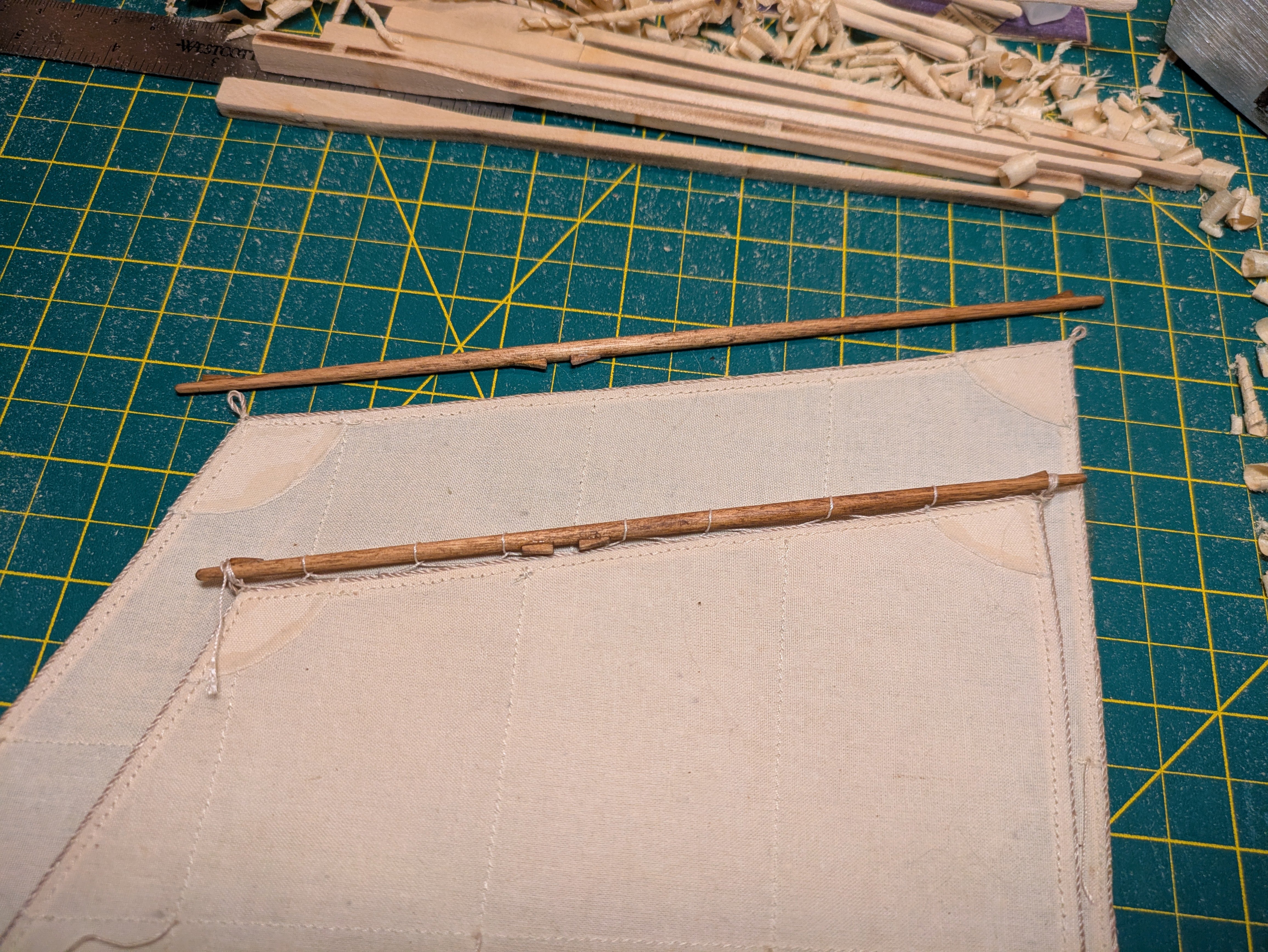

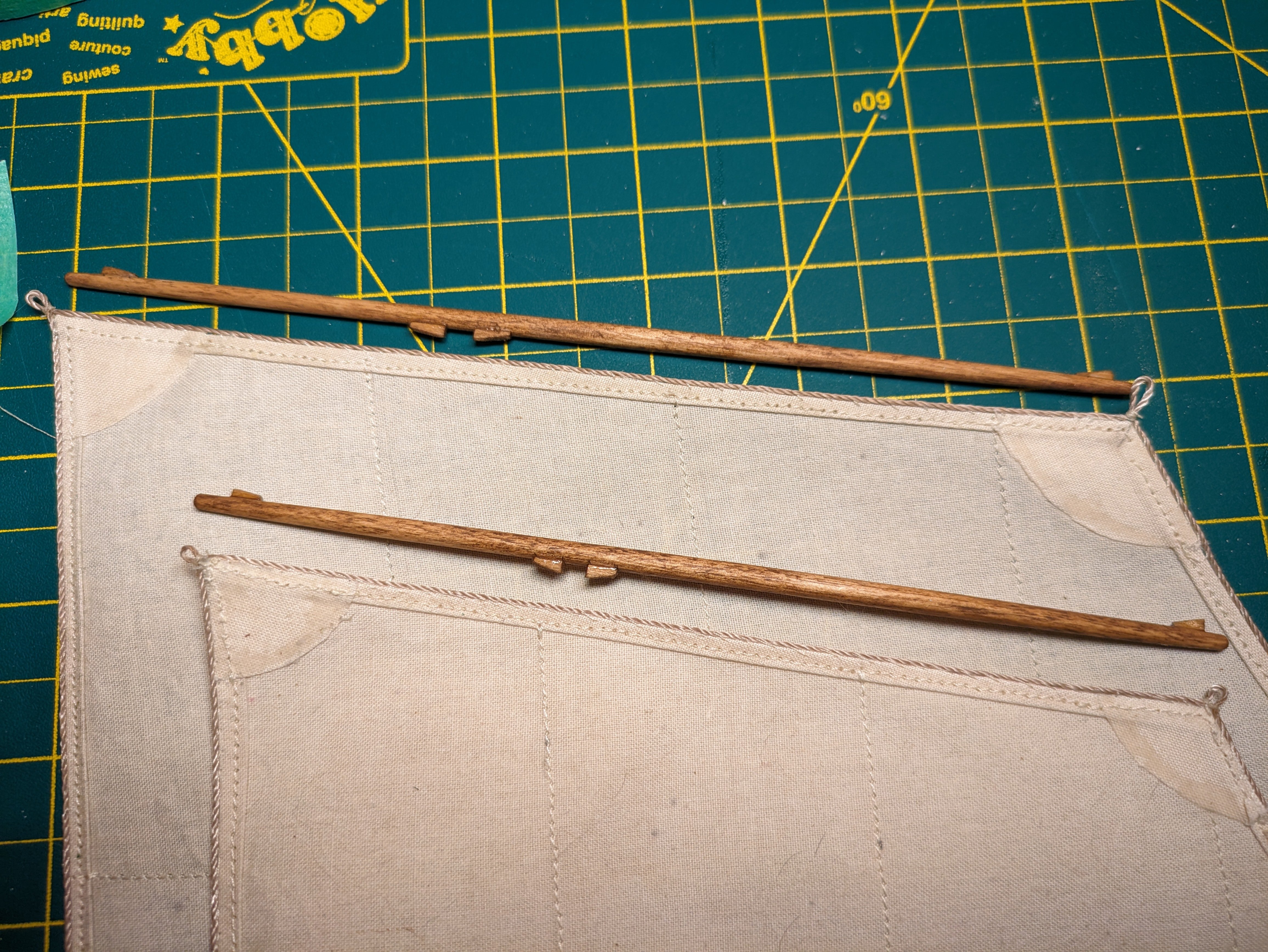

I then went to lash the gaffs to the head of the sail and:
Too short! Doh! The spars obviously shrunk somehow. Humidity???? No way the sailcloth stretched after I carefully measured it then dyed it, stiffened it, maybe even ironed it, etc. Must have been the gaffs.
Oh well, lesson learnt. Next time, I'll do what I need to the sail cloth before final measuring and cutting so that it matches the spar shrinkage./s
To fix this, I used the longer gaff from the main (?) for the jib and fashioned a slightly longer gaff to use on the main. Or vice versa but I think I have them right. Too lazy to check the plans.
This seemed to fit the sails better:

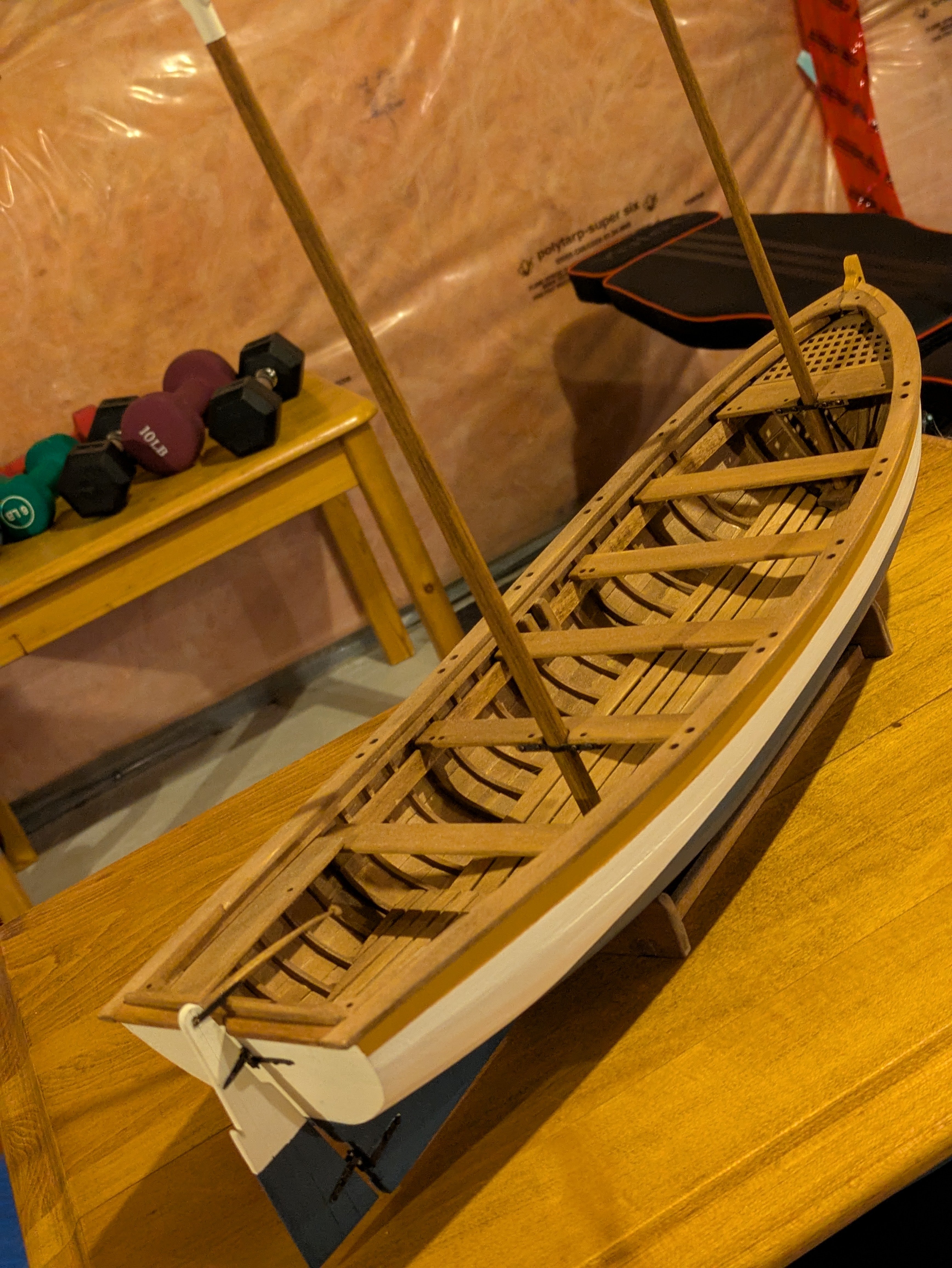

Since then, I've worked a bit on making the barrels look better (with limited success - I found it difficult to score straight lines for a planked look. Still working on a good technique) and  have been working on making the oars.
Somehow, I've lost an oar in this mess:
If you can spot oar number ten, I'll name it Waldo or after you. Your choice.
