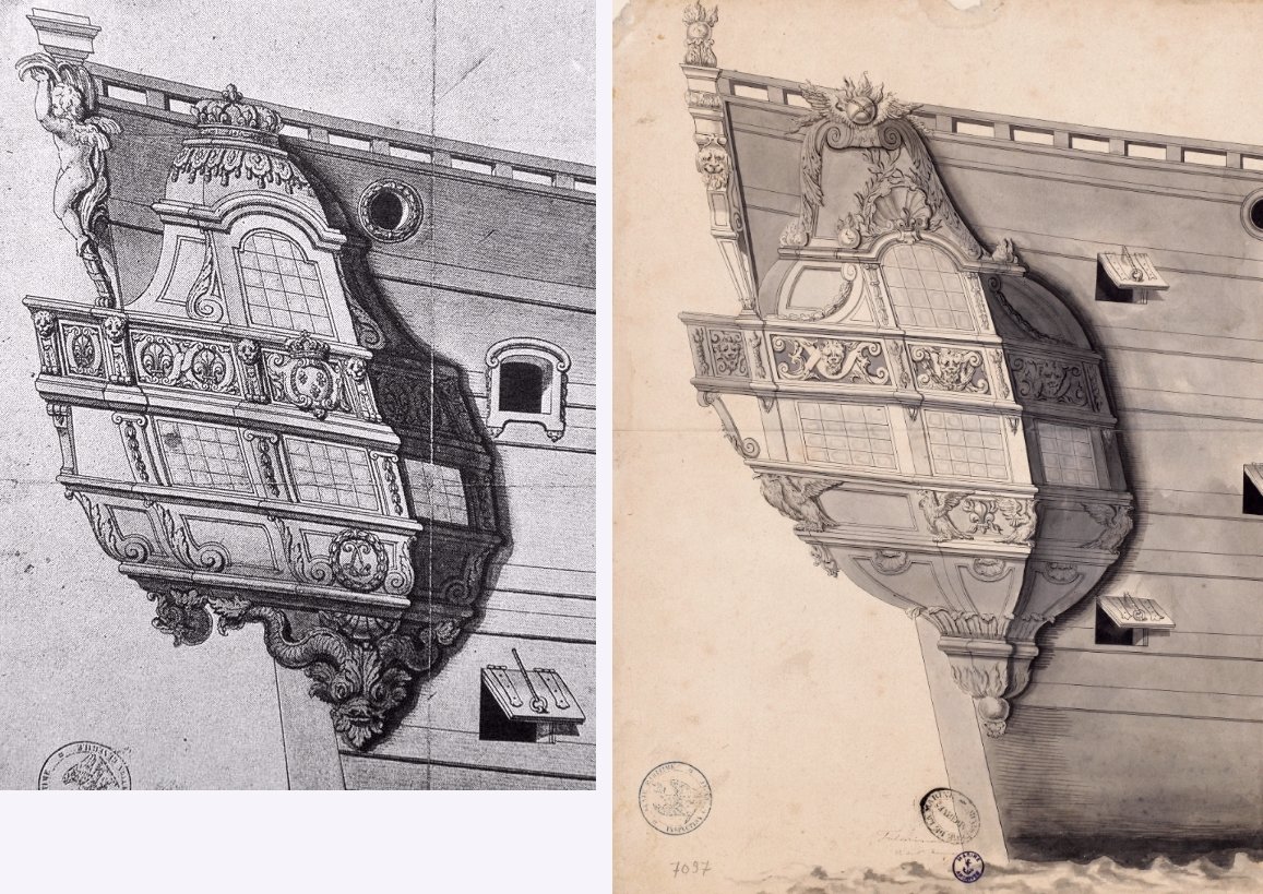

Mark, thank you for sharing your explorations and conclusions. In a way, I have encountered a very similar situation. However, while you decided to reduce the number of windows to achieve a more harmonious composition, I am considering increasing the number of windows from three to four. And the fact that my solution is turning out to be rather unsuccessful is precisely what is causing my confusion.
I don’t like the original three-window version by Beren, mainly because of the very long second window. But the alternative of splitting it into two doesn’t satisfy me either. I realize that over time, the concept of aesthetic taste has changed significantly, and what was not an issue for Beren now causes discomfort for me. But how do I determine where to stop and say, "This is the ideal solution"? For example, I used to perceive some of his other decisions differently. But now the time has come to examine them more closely.
Previously, when I looked at the eagles beneath the windows, I somehow thought that Beren was illustrating different levels of protrusions and that the oddly halved eagle was actually the figure placed in the central segment of the stern, where the wreath with the ship’s name is located. From the side, it is partially visible, and I believed this was what the artist intended to depict.
But now I see that it is something else entirely. It is actually positioned on the side castle. L'Ambitieux uses the same approach, but instead of a bird, there is an ornamental scroll. Budriot depicted it in the same manner, as if it were an accidental misalignment. To me, it looks like a clear mistake or a flaw. I cannot call such a composition a successful design. However, neither Beren nor Budriot seemed to have any issue with it. And if that was considered acceptable, how should I perceive my own discomfort with the elongated window?
There are many conflicting elements here that raise questions for me. If we compare the design of the transom and the side castle, we can notice discrepancies. For example, the upper frieze below the windows, where the lion heads are depicted, maintains roughly the same visual rhythm. From both the transom and the side projection, this line is executed in a fairly consistent manner.
However, at the lower level, where the eagles are located, the situation is completely different. The space between the eagles on the transom is filled with ornamental decoration. But as soon as this same strip transitions onto the ship’s side, everything changes. There is no decorative embellishment between the eagles—just emptiness.
Why? I could continue further, but that would take our discussion too far. I am trying to determine the best way to resolve these emerging questions, but so far, I have not found an answer that satisfies me.
Sincerely, Aleksandr

I like your analogy with the Jules Verne's Nautilus ; with this fantastic decor made by Disney, including extra large glass portholes ... and even an organ ! ... but maybe should we stick a little more to historic reality as per the number of pierced portholes :
- We know that the Fulminant was pierced @ 14 for the lower deck ... there is no problem about it and this doesn't concern the port windows.
- For the mid deck, it was pierced @ 15 (for it's 18 pdrs guns) as the best reference historic study by Demerliac indicates ...
... anyhow, some other information indicates "pierced @ 14" ... but I am quite certain that "15" is more correct because the Orgueilleux and the Formidable, which were 1st rank vessels launched earlier (in 1690), were already pierced @15 for the 2nd battery, whilst their dimensions being a little bit shorter than the Fulminant (and the same is for the Ambitieux pierced @ 15 portholes for the 2nd battery).
Moreover, the Ambitieux, Fulminant's sister ship, had the (bad) reputation of being overgunned ... which was not good for its inner sailing maneuverability.
Honestly, this point (14 or 15 portholes for the 2nd battery) can be fairly discussed as there are as many "pro" examples" than "against" example (please refer to the attached files).
(a) Then, PRACTICALLY, your model should (I suppose) show 15 portholes for the 2nd battery.
In a logical point of view (and I rejoin here your conclusions), all the windows N°s 2 ; 3 and 4 should be false, because a real window with glasses would explose due to the blast of your own cannons when firing.
Moreover, your idea for 4 windows instead of 3 may be interesting, as far as you can increment the 15 portholes REGULARLY along the hull of the vessel ; then, the question is : are the 15 portholes equally and regularly balanced with 3 or 4 false windows ?
(b) Another alternative is to pierce it @ 14, if it appears that the implementation of the extra portholes (one or two) into the rear castle appears too inadequate or aesthetically disastrous.

Too true. I'm actually writing a novel on time travel using a steam powered machine. Definitely dangerous!
On a more serious note, the 'blank' panel of the lower gallery is logical, as it balances another blank one on the foremost panel.

So, the question about real and fake windows is complicated and individual from the very beginning. If we are to look for any analogues, then it would be, of course, L’Ambitieux...
We will look at it, compare, take it into account, reject or rely on this example.
And it’s also time to voice the second component of the mystery with windows and gunport dummies. Somewhere in the area of the side castle, it is necessary to place an additional cannon. This question was also widely and thoroughly discussed last time. And I thought that a solution was found in the end. But now the client is raising this question again and suggesting his own version. And what exactly is this version? I will try not only to paraphrase it, but to bring it here directly from the letters:
"...Hello, Sasha;
If AMBITIEUX became famous (among ship modelers), it is because (a) in the first stage, Boudriot developed a monograph for AMBITIEUX. In the second stage, Frölich received a commission from the Naval Museum to build AMBITIEUX (based on Boudriot’s plans), and that commission was used to create a book for modelers (about the fleet of Louis XIV), which was translated into more than 5 languages.
Sasha, if I ask you to emulate (as much as possible) what Frölich did (for AMBITIOUS), it is because all modelers (looking at our FULMINANT) will immediately compare it with AMBITIOUS.
Let’s assume (for simplicity) that FULMINANT has a few more guns than AMBITIOUS... at least, as they were presented in Frölich’s model...
Therefore, we will follow Frölich’s design (for the stern castle), i.e., with a window drilled for gun No. 14)... and that way, we will not attract criticism (justified or not, it doesn’t matter) and controversy from all modelers who will ask us why we didn’t follow what everyone else follows, and why we tried to change something in Frölich’s well-known standard.
So it is reasonable (and wise) to make the middle window as Frölich did, and to make the upper window “real,” like in the English Naval Museum..."
"...I’m going to show you my way of reasoning (which is adaptive), and don’t think it’s anything special... I reason this way because that’s how my brain is wired (or trained). I’m going to talk about the middle window, where gun No. 14 is located.
I base this on the fact that my modeling experience and historical knowledge (I’m a modest person) probably fall far short of Mr. Frölich’s, who was commissioned to build the model of L’Ambitieux (and, I presume, paid a considerable sum) by the Paris Musée de la Marine. I saw this model of L’Ambitieux with my own eyes, and its photographs have gone around the world, it became the subject of technical books, and I assume Mr. Frölich had to meet with all the experts in France and around the world to justify and explain how he made his windows. There must have been more than a dozen discussions (with arguments and counterarguments)... which eventually led to a certain outcome.
My pragmatism tells me to do what Frölich did..."
"...Hello, Sasha;
I will explain the number of cannons in more detail, it’s not that complicated.
(a) For the lower deck everything is fine, and nothing needs to be added.
(b) For the middle deck, the 14th cannon must be added. This cannon goes through an already drilled hole (a door), but since I don’t have the model in front of me, I assume that this already drilled hole corresponds to the center of the three lower windows. Is that correct?
If so, then we will proceed as planned: all 3 windows (on the lower level) will be fake windows (i.e., with window frames installed on top of an ivory plate).
I will send you an example.
(c) Frölich made the upper window real (with mica), and the British Naval Museum also makes real windows, so I recommend making the upper window real.
(d) For the upper deck, the additional hatch openings we will make won’t interfere with the side bottles, so we’ll talk about that later.
Let me know if that’s clear, or if you need further explanation?
To sum up: the 3 lower windows are fake (thus covered with ivory), and the middle one must let a cannon pass through (see Frölich); the upper window is real (covered with mica), as done by Frölich and the British Naval Museum.
PS: model shipbuilders can make their own windows; in the British Naval Museum, all windows are real..."
this is an example from the British maritime museum
I have included several letters at once. All of them complement each other in meaning and form a single overall picture. To combine them into one answer, I will once again summarize the client’s wishes:
  1. There should be a glass observation window on the upper deck.
  2. On the lower deck, the windows should be false, and a cannon should be placed in the middle, which must come out through the toilet exit. In this case, there is no point in cutting an additional window in the hull next to it.
The letters also clearly show that the client has a special reverence for Froelich’s model and sees this particular model as an example. And therefore, it is also set as an example for me. I must rely on it.
Now I must try to respond to these words, since I am not sure whether my letters are reaching the recipient and whether the client is able to read them.
So where should I start? On the one hand, the client’s wishes seem logical. And what difference does it make to me? Is it really so hard for me to meet these wishes? After all, the client’s opinion is not very different from my own thoughts. The only significant difference in our approaches lies in the window on the second floor. The client wants it to be transparent. But I firmly believe that it cannot be an observation window and must be a false one. And below — both in my version and in the client’s — all windows should be false. So what’s the problem, then? That’s how it looks at first glance. But let’s go step by step. What is it that troubles me so much?
First, I want to address separately the issue of placing cannons inside officers’ quarters. Is there a certain order or rule about where a cannon could be placed and where it most likely could not? For me, this is now a question that goes beyond just the Fulminant. It is a topic for a more precise understanding of naval engineering and architecture. Something that will help me grow personally and will also be useful in the future. I want to understand correctly how I should think in similar cases. Are there any clear rules? Any prohibitions or taboos? Things that absolutely must not be done?
And from that point of view, let’s consider the question: can a cannon actually be placed in a doorway? It seems so logical and natural. The opening already exists. Just roll the cannon into the doorway, open the window, and let it fire! So simple.
But no. I see major problems here. What can we observe on L’Ambitieux? What disturbed me? How exactly do we want to position the cannon? There are two options here. In the first one, the cannon is rolled out through the toilet entrance and fires from there. In the second, it remains inside the cabin, and the firing is done from within. And now I will describe my doubts.
Edited by empathry

Now about what you said about the working space between the guns. You are right, it is extremely important that they are mounted at a sufficient distance from each other. I absolutely agree with you. And that's why there was a discussion on these same pages a few months ago about where exactly to put an additional cannon. Putting the cannon in the outermost segment is the most convenient option and in terms of the issue you have raised. A cannon placed in the outermost section of the Bottle will not interfere with the “neighbors” in any way.
However, I cannot agree with you on the most important point. There is a very big difference in exactly where you can put a cannon in a side gallery, and where you can't. And if the outermost segment is too close to the outermost cannon on the deck, I would never put a cannon in the middle of the side gallery.
I've written quite a bit on this topic before. And believe there is no point in repeating myself. About the fact that there are mentions with cannons, I tried to be objective and point out that side too.
But I can't call these examples worthy of serious attention. All images can be divided into two groups. These are drawings. Simple pencil drawings. Let's be frank - these are in no way suitable for a serious document. I just imagine that a few centuries later someone will find my childhood sketchbooks where I drew cars, airplanes or ships and will claim that this is exactly how it looked in the distant 21st century. Here's the proof. We will repeat exactly.
Parsing what in the old drawings was actually correctly depicted, and where the artist's imagination or lack of knowledge is a separate topic altogether. I think you'll agree with that.
We often argue about nuances not only when looking at fuzzy handwriting, but also drawings made as an exhibition project for a king. And even here we can debate what Beren meant by making the floor lines not parallel to each other? And here it should be a volumetric construction or a flat bas-relief? And we end up with models where there's no exact replication. Created after personal research work, private representations of a particular author. And you can either agree with it or not. Please, make your own version. The modeling world will only get better. And let our descendants go crazy, compare different variants and think why they are different? Which one is right and which one is wrong?
The second group is models in museums. And this is a much more serious argument. But what do we actually see on these models? I have already mentioned that some of these models are ships that were not built and do not reflect accurate data. But now let's put that argument aside.
Let's take another close look.
You can see the standard cannon positions right next to it. And that's where the cannon barrels are. If the windows in the side locks are also cannon windows, then why did not they put cannons here? What prevented it? Or maybe it's just a window? And there shouldn't be a cannon in it? I willingly agree that from these windows it is possible to fire muskets, arquebuses or other kinds of hand-held light weapons. But not a cannon.
And this is an example that I myself was interested in, and am now already using strictly in counter-evidence.
The small size of the porthole already speaks volumes. Now look at this porthole. You can see perfectly well that it is much higher than the cannon windows next to it. There's no way this porthole could have been a gun emplacement. It's just an open little window for ventilation, that's all. The only thing that could have been fired from here was something portable.
I tried to find some documentary information and couldn't find any evidence to support the theory that a cannon could have been placed here. I looked at every book I could find. Spent a lot of time searching the internet. I couldn't find anything. I also managed to get in touch with Michael Bezverkhny. He's one of the masters who built Ambitionary. And his opinion deserves attention. Especially since he is also a man who is well acquainted with ship history and engineering. I asked him questions about Ambitious and about the possibility of placing artillery in side locks in general. And he too confirmed that it was technically impossible.
By the way, if you can find such information, I'd love to continue the discussion. I've become so interested in this that I'd even like to see some actual Legend Breakers style experiments. So that replicas of ship rooms could be built, in which cannons would be set up and demonstration shots would be fired.
How can I finish what I'm saying? This model can accommodate an additional pair of cannons on its side (one on each side) so that these cannons are positioned in the side castle area. But ONLY in one place! In the outermost section. In this case, there will be no conflicts with the standard distance to neighboring cannons, nor with the impossibility of anchoring and firing. And this is the ONLY possible option on this ship.

Moreover, Berain drew two sketches ; that of the Ambitieux and that of the Fulminant, and he must (normally) have known that these would be constructed as twin ships ...
... so why are the port holes different on those two sketches ?
This suggests that Berain is primarily an artist (and courtier), not a naval architect, and that his sketches could be interpreted in a very large manner.
Edited by empathry
