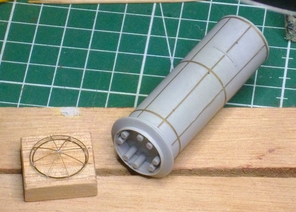

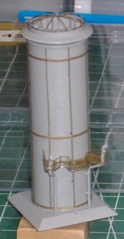

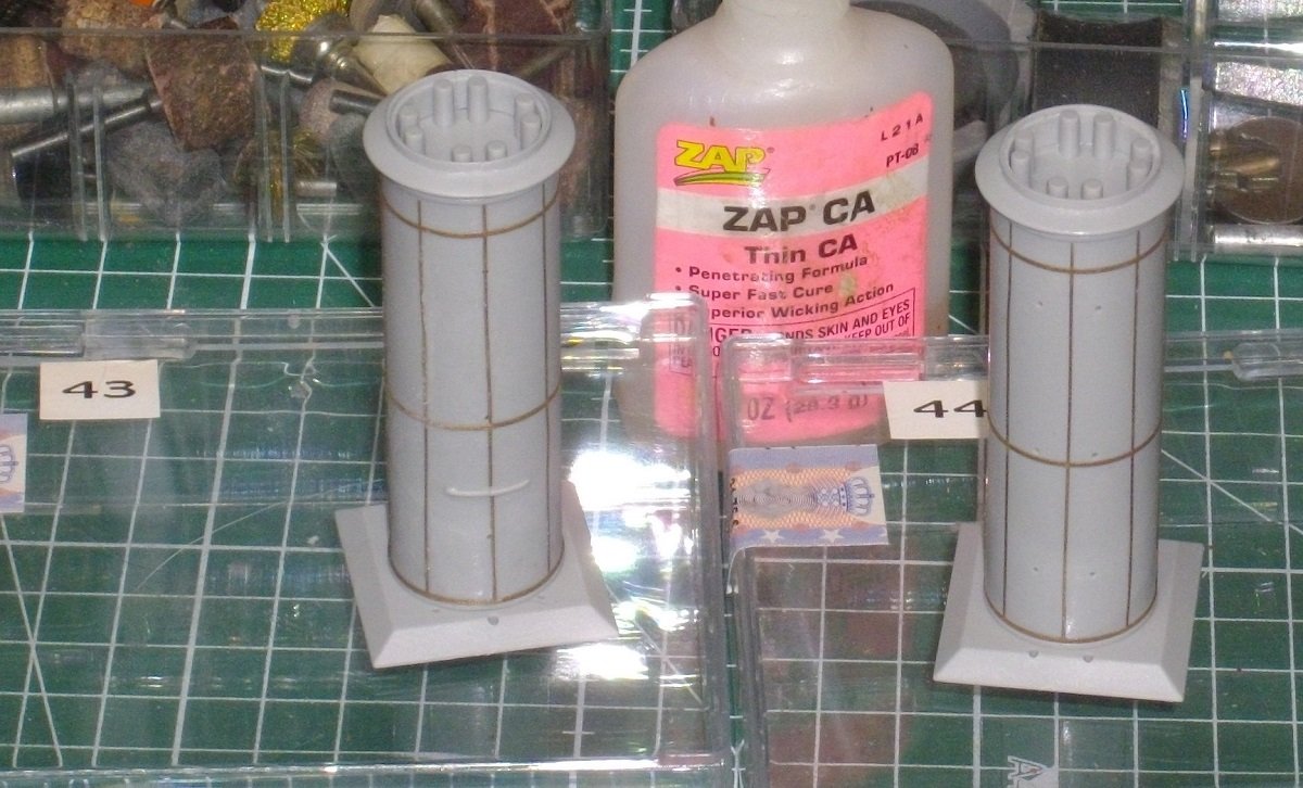

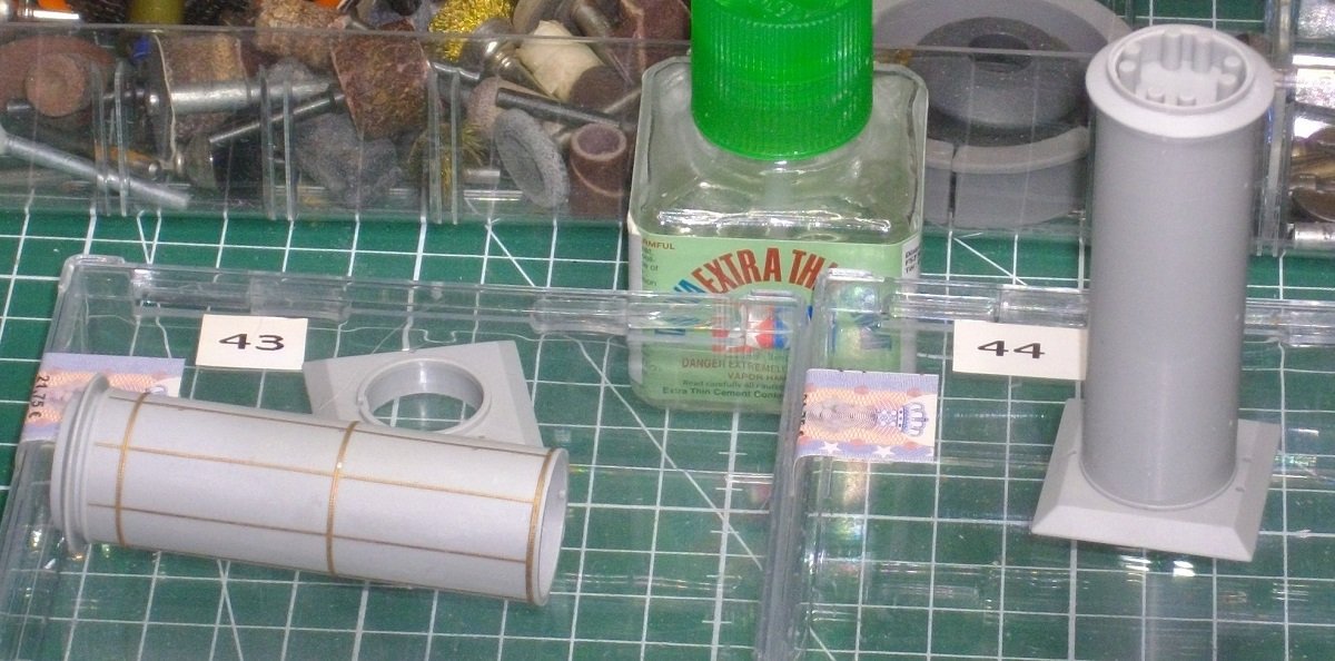

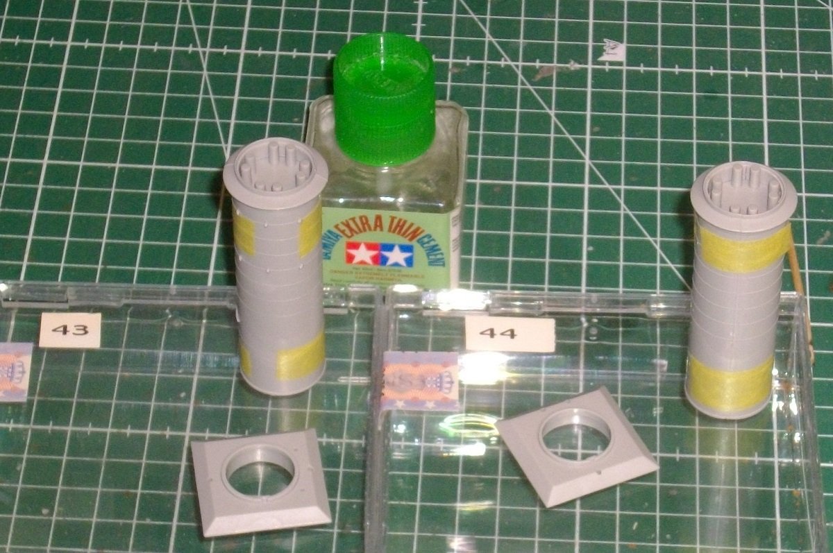

Merit steps 43 and 44 , I assembled an cleaned the plastic parts and glued them with extra thin cement.

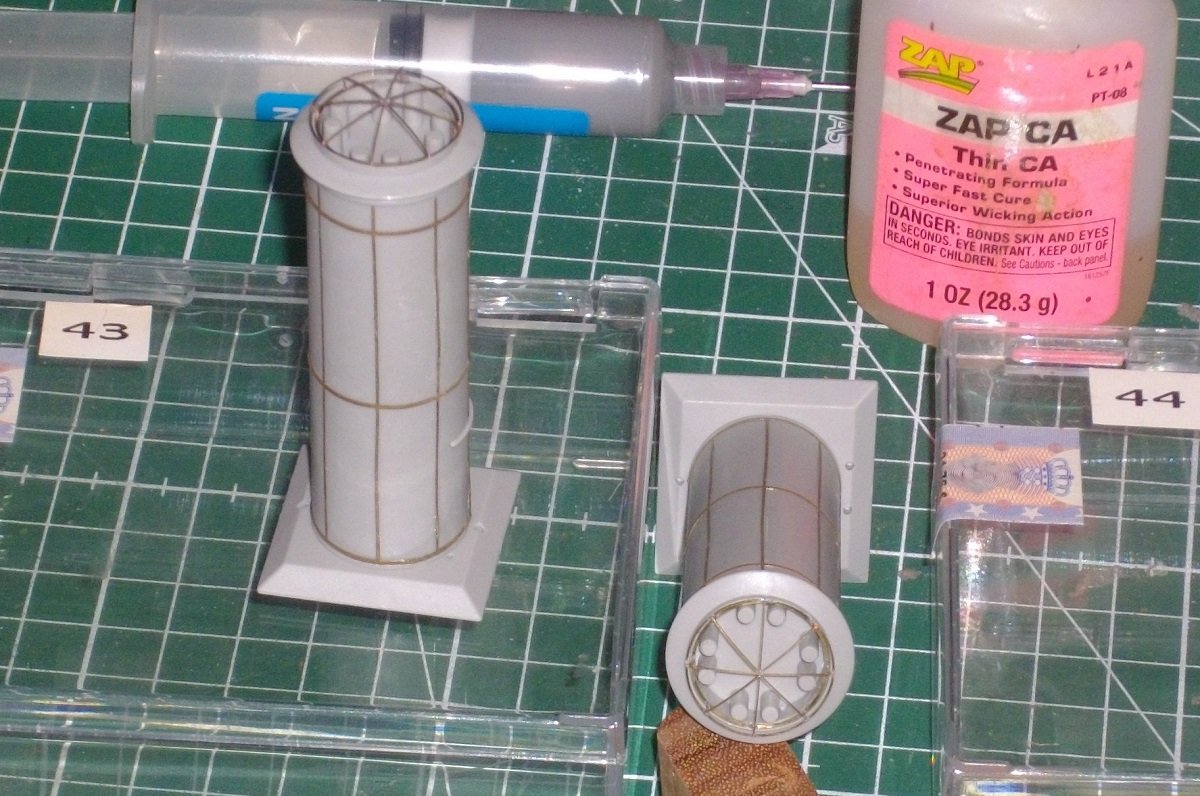

Rivets applied to the back smokestack with pink Zap.
Rivets applied to the fore smokestack. Well prerolled, the gluing goes much smoother.
Then I soldered the Pontos parts for the funnel caps and clued them to the funnels with pink zap.
IMGP6615.JPG.4742c5cc8f38411a710ac614d3db39e4.JPGIMGP6616.JPG.4c68a7e67b9af86b520b2acb26182131.JPG
and the funnels are glued to their bases.

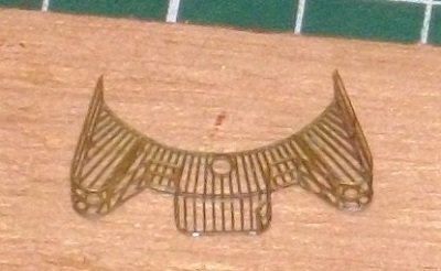

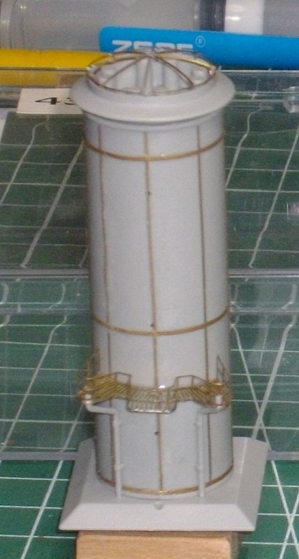

Next I soldered the Pontos parts for the platform. The railing demanded some accurate bending.
IMGP6617.JPG.371ebb476bebeff5627c8f65bbc347fe.JPG IMGP6618.JPG.9faec03f216c50ce11337be6b296ee16.JPG
and glued it to the fore smokestack with pink Zap.
Next step is gluing the curvy pipes under the platform.

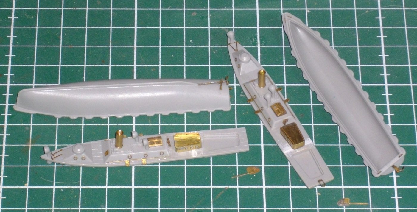

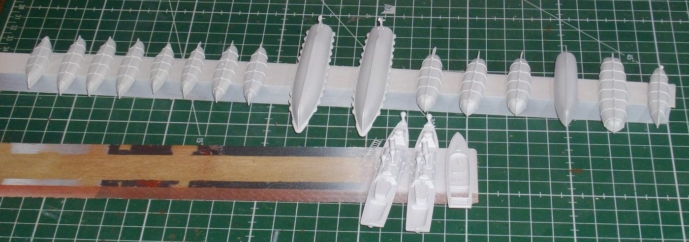

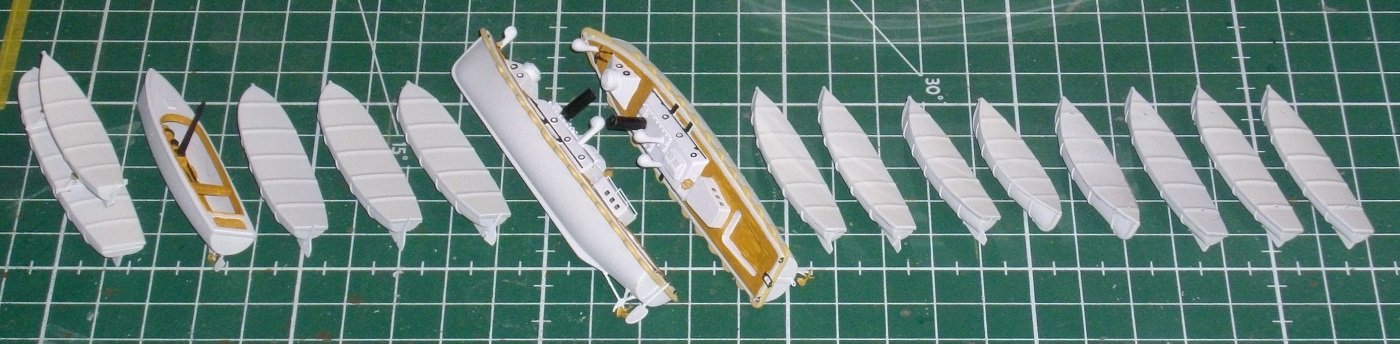

I prepared the steamlounches, collecting and cleaning up the Merit parts, and removing the details to be replaced by Pontos parts.
The deck housings were soldered, and all parts were CA-ed to the hulls.image.jpeg.38579e631a6e1bef24817fe26a686765.jpeg
Kind regards,
Herby
I attached the photo-etch parts to the other boats and soldered the brackets (Pontos 526) to the 5 exteral steampipes of the smokestacks (Pontos Brass 22) and I bent the 4 stairs.

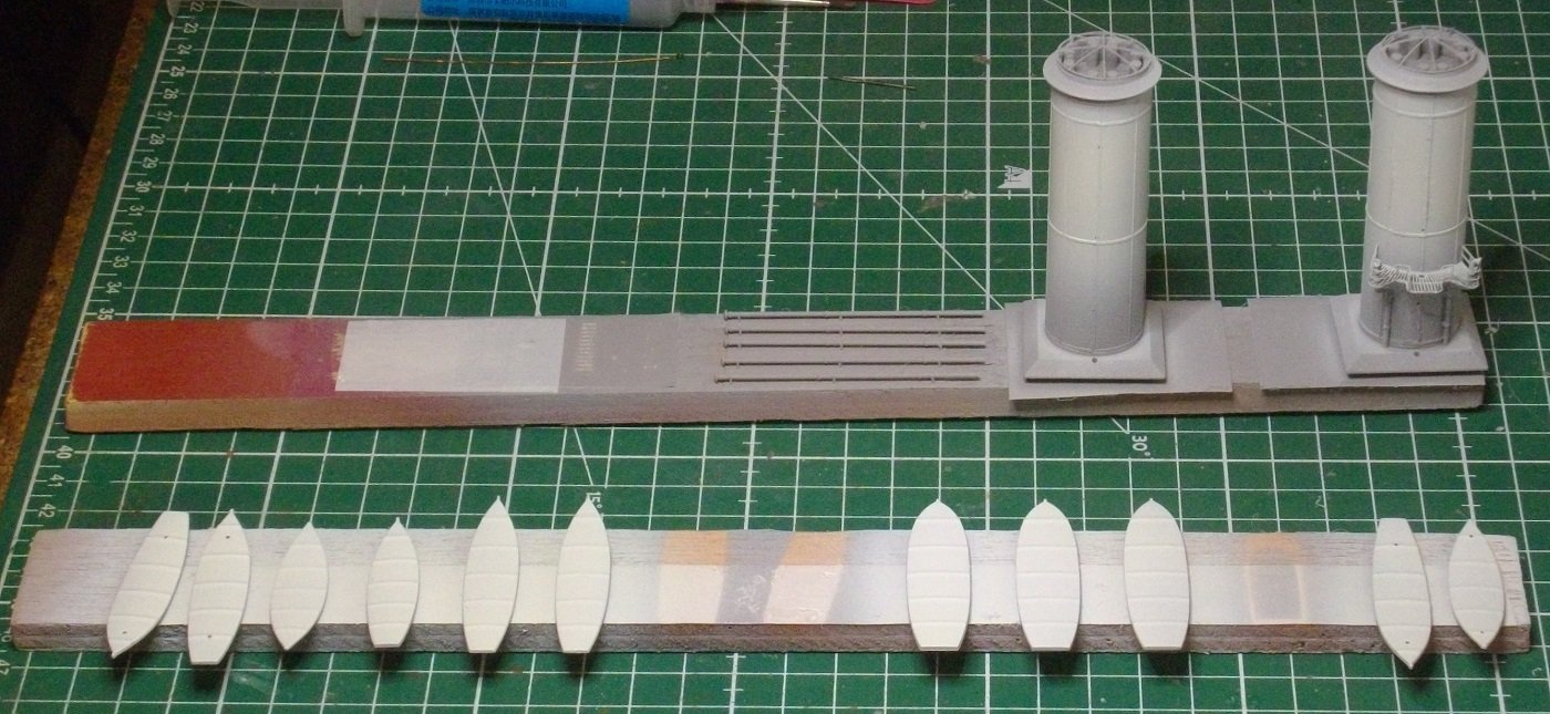

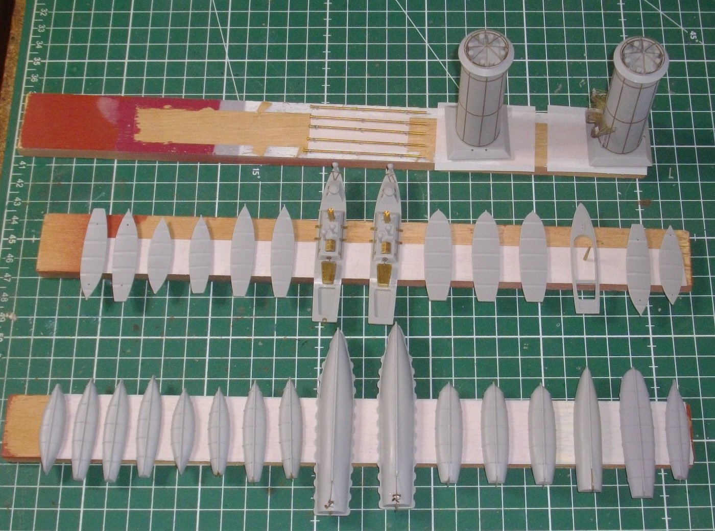

Sloops and smokestacks are now ready to be painted.
They are attached with double sided tape to some battens which facilitates airbrushing.
Kind regards,
Herby

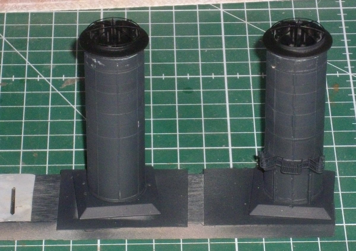

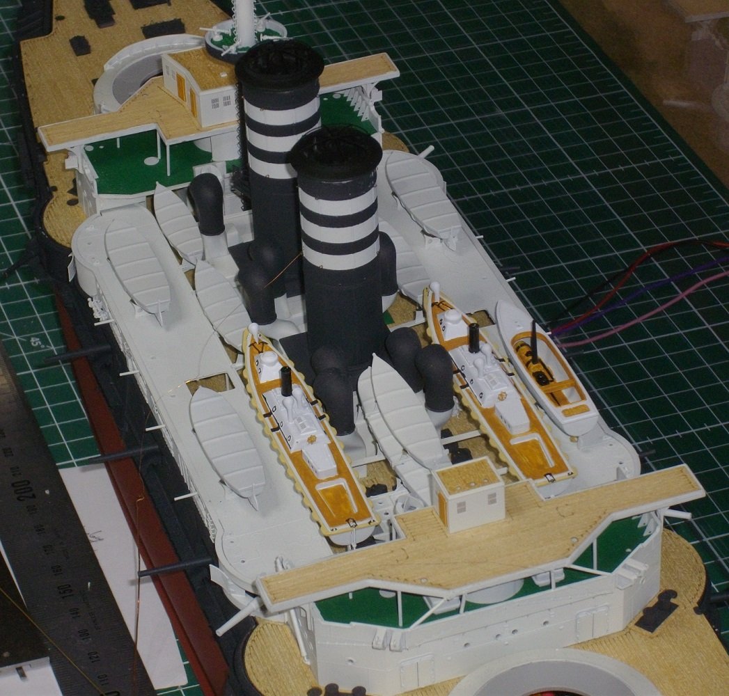

I grounded the prepared pieces with Vallejo grey.
Then I airbrushed the funnels and decks covers with Vallejo 71.279 Insigna White.
The hulls of the boats were airbrushed Vallejo 71.001 White.
Finaly the decks and covers were joined with their respective hulls and some details added.
Untill next update, enjoy modeling.

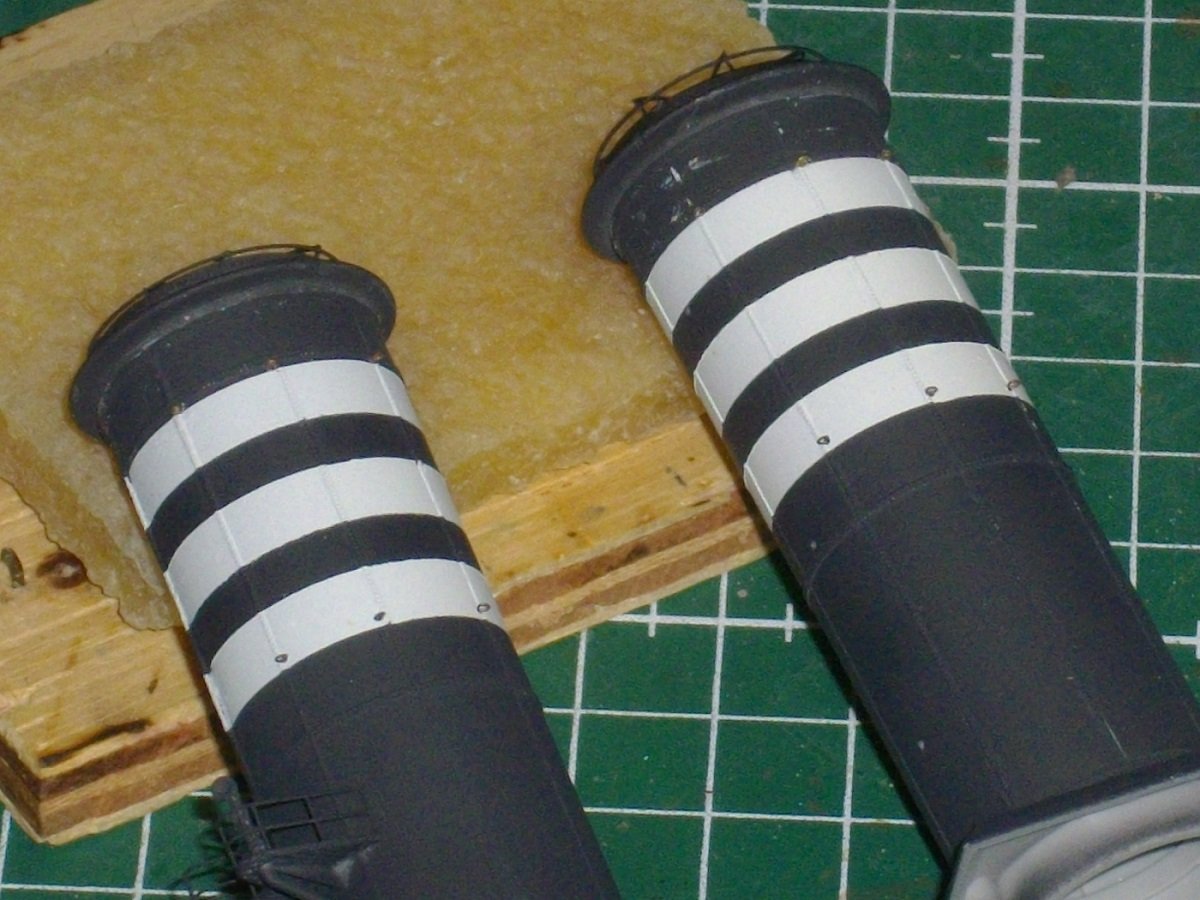

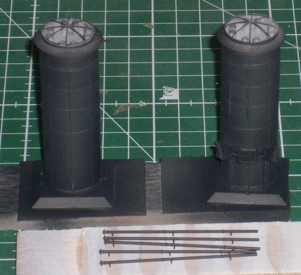

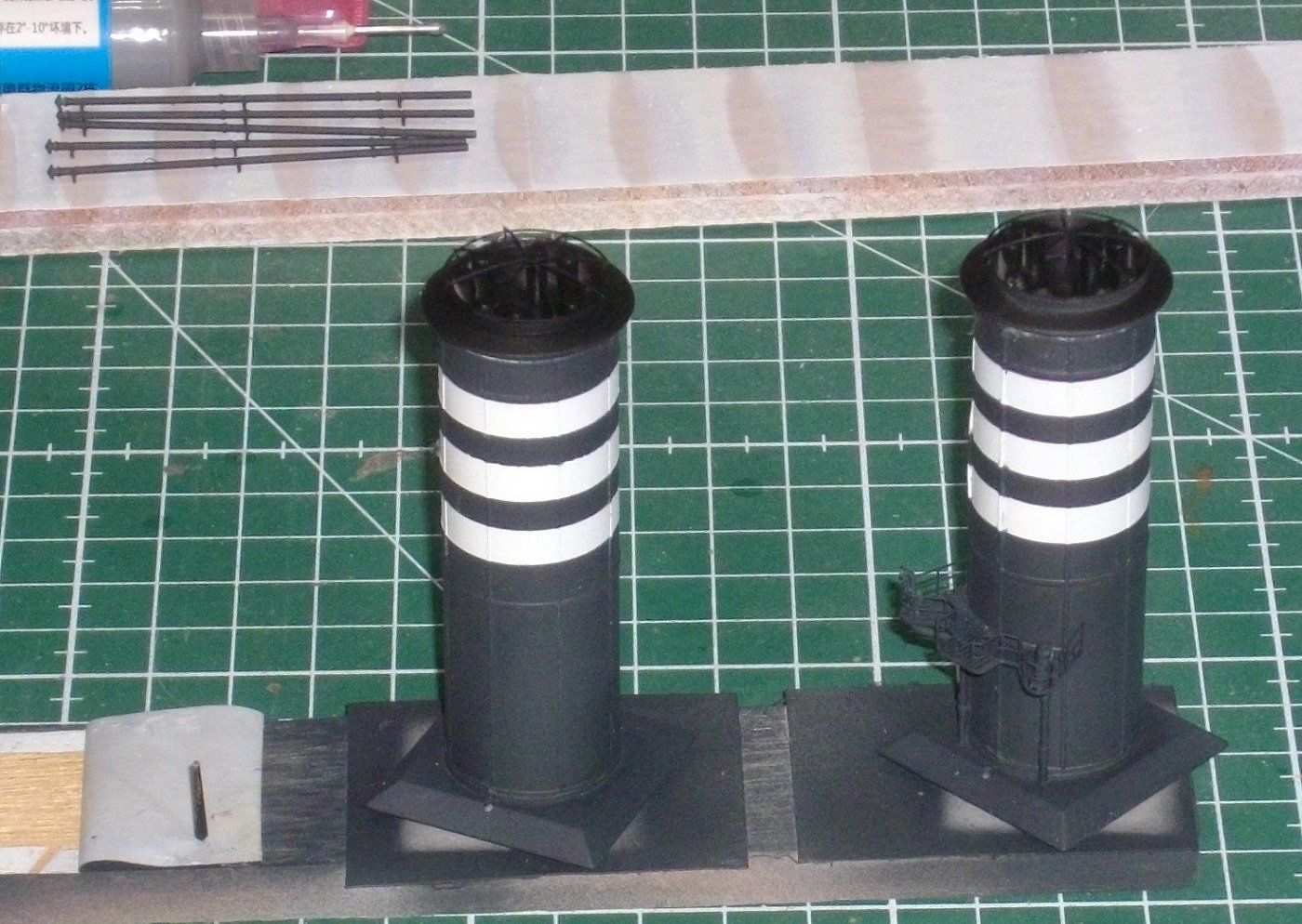

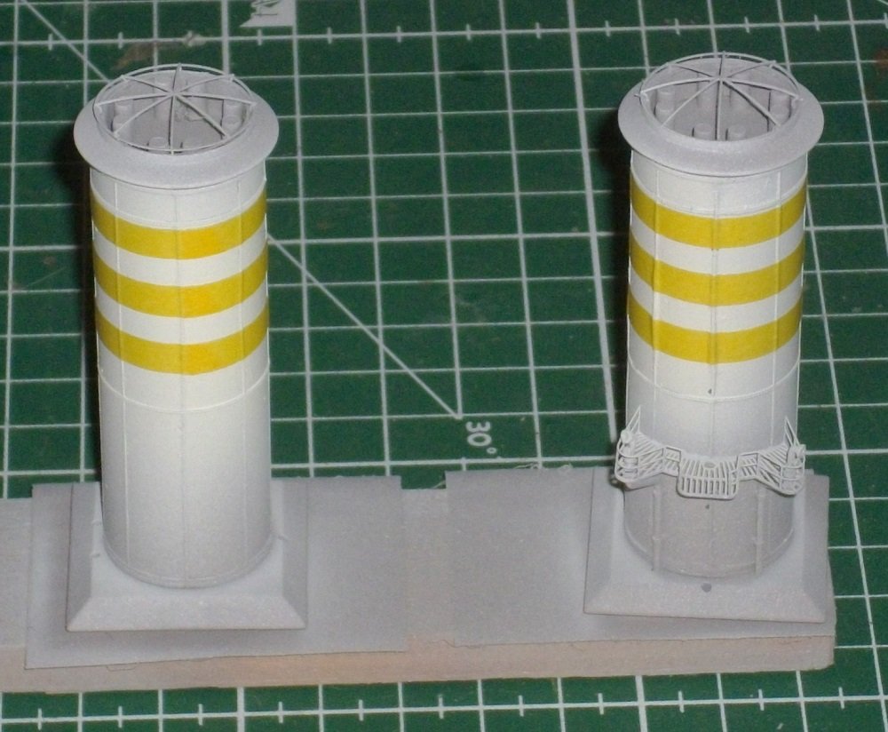

I masked off the 3 white stripes on each smokestack with tape cut to size.
Then I painted them Black grey.

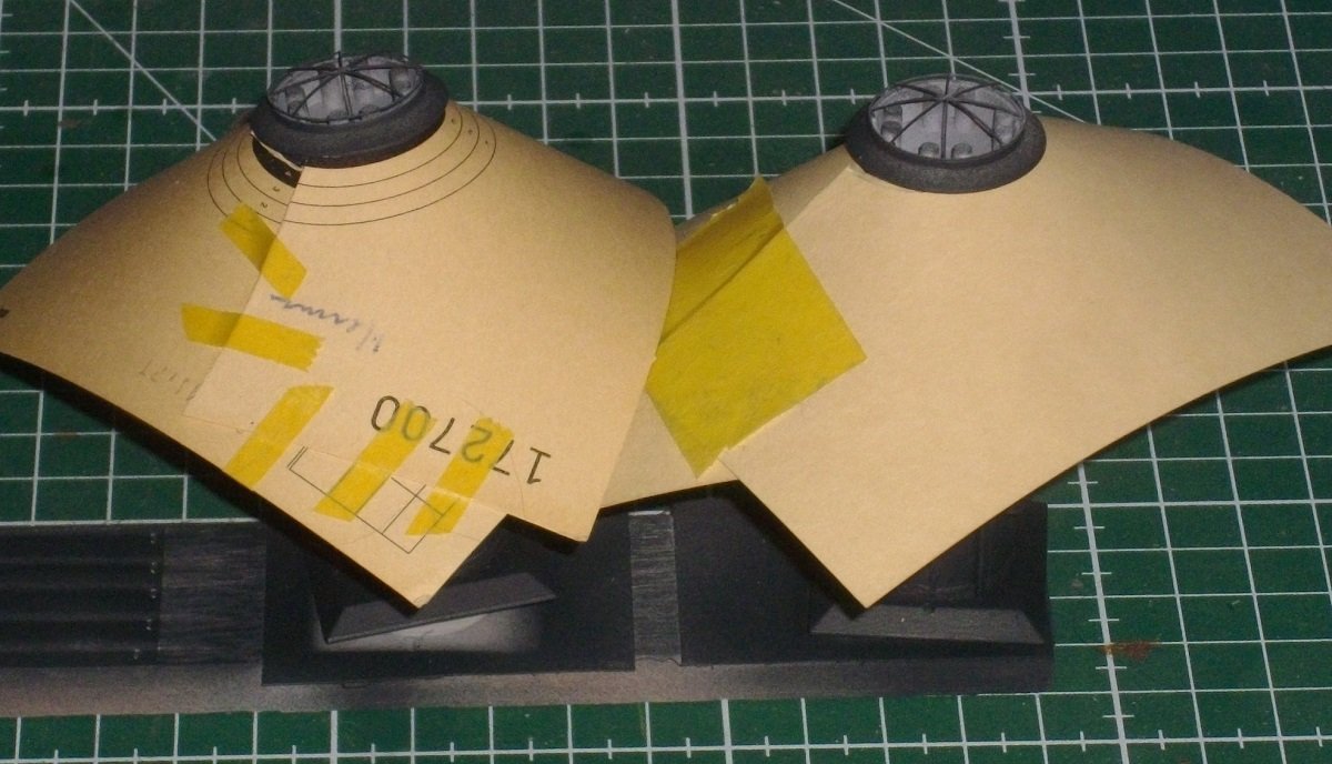

Then I masked off the smokestacks to prepare them for airbrushing the funnelcaps.
Finaly I removed the tape, revealing the result.
Until next update, enjoy modeling and thanks to the folowers for taking interest.

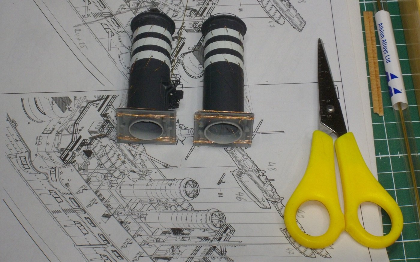

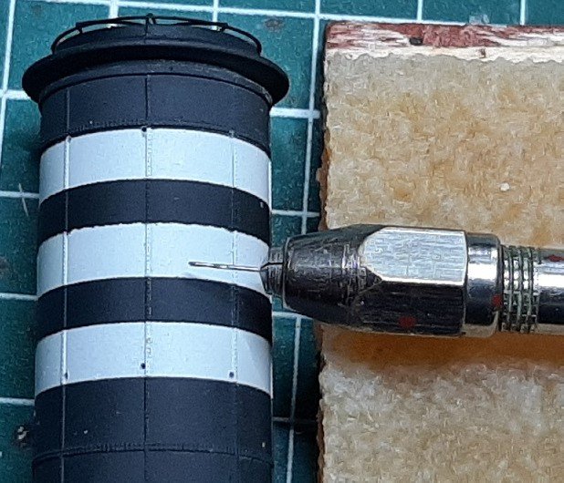

In this episode I shall start scratchbuilding the funnelstays. which are not provided for, neither by Merit, nor by Pontos.

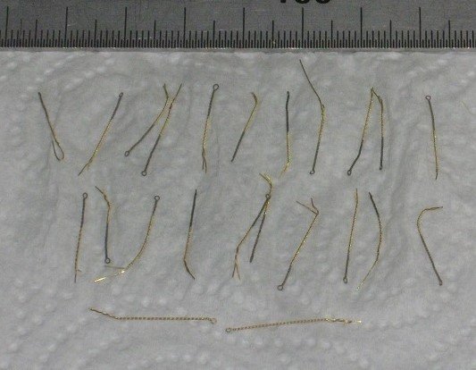

At first I shall have to provide for some kind of attachment at the funnels themselves:
-          I drilled 24 0,4 mm holes;
-          24 eyes turned out of 0,2 mm brass wire;
image.jpeg.ab4f75ed30a996f8d9f1eb607f2fedf6.jpeg image.jpeg.ed04260e710e57097370f7bf9b61e65b.jpeg
-          After burnishing the eyelets, I shortened them, inserted them in the holes, and sealed them on the inside with a dot of PVA-glue

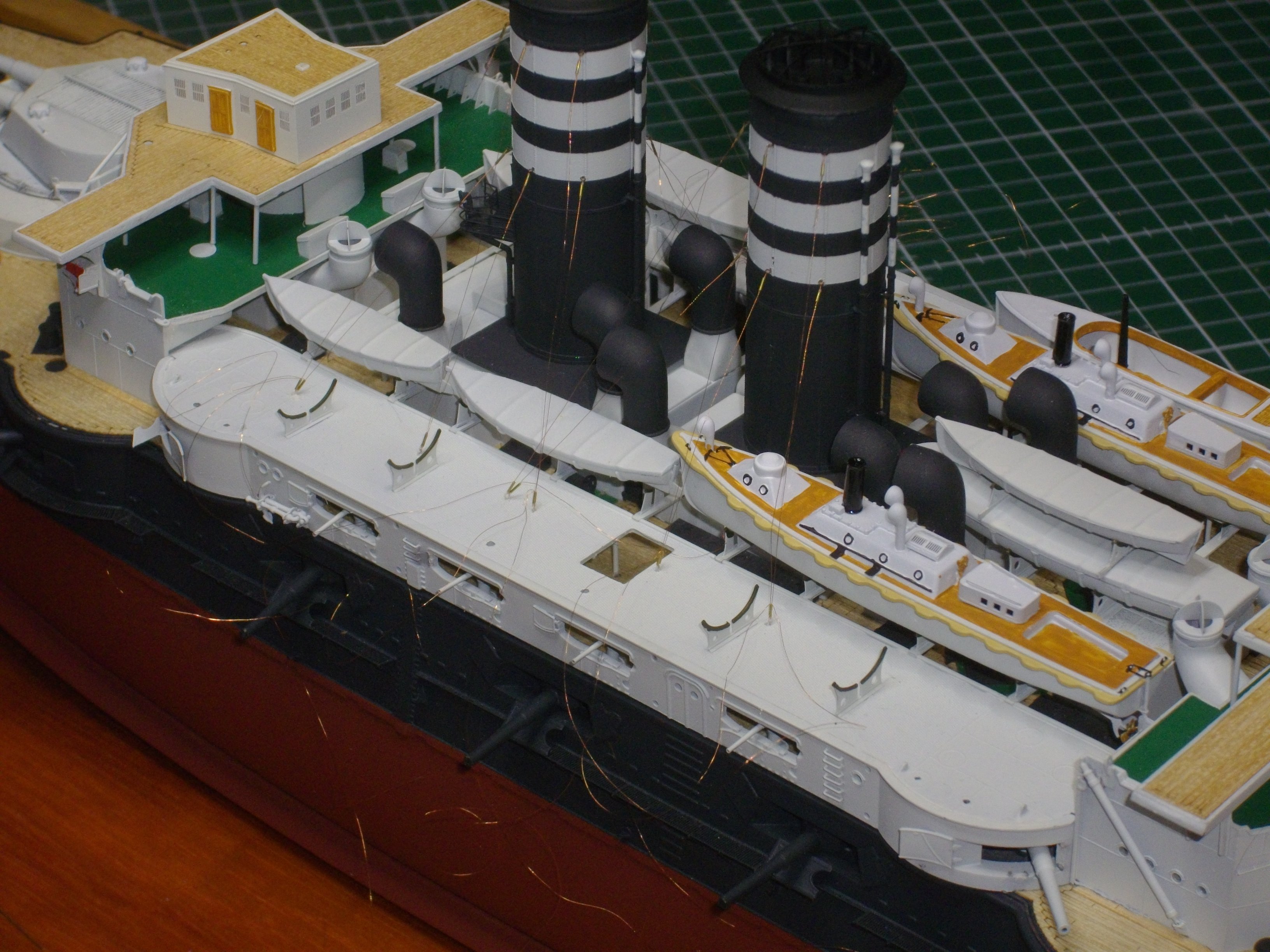

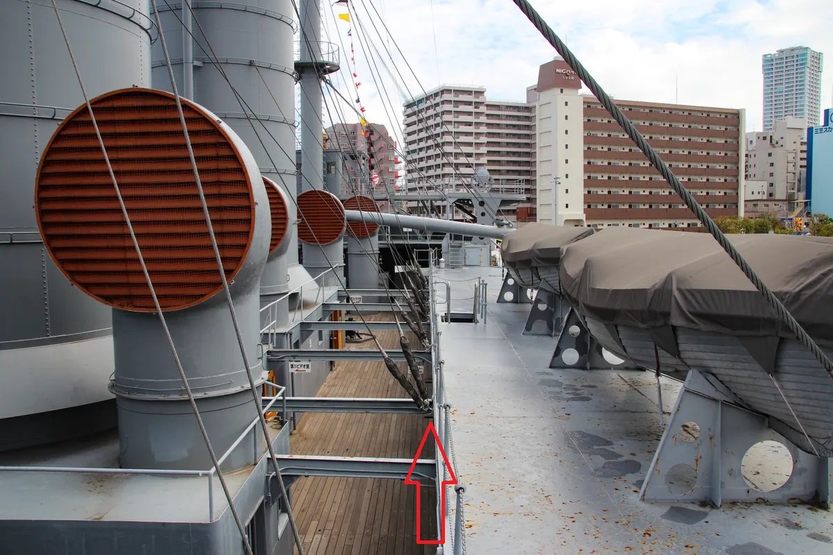

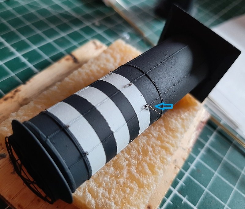

I testfitted a 0,056 mm brass wire with some microtubing with an external diameter of 0,4 mm.
In order to establish where the belaying points should go on the boat decks, I placed the boats.
One thing is shure, The present day attachment points are not realistic with the ships boats in place.
Keep on modeling.

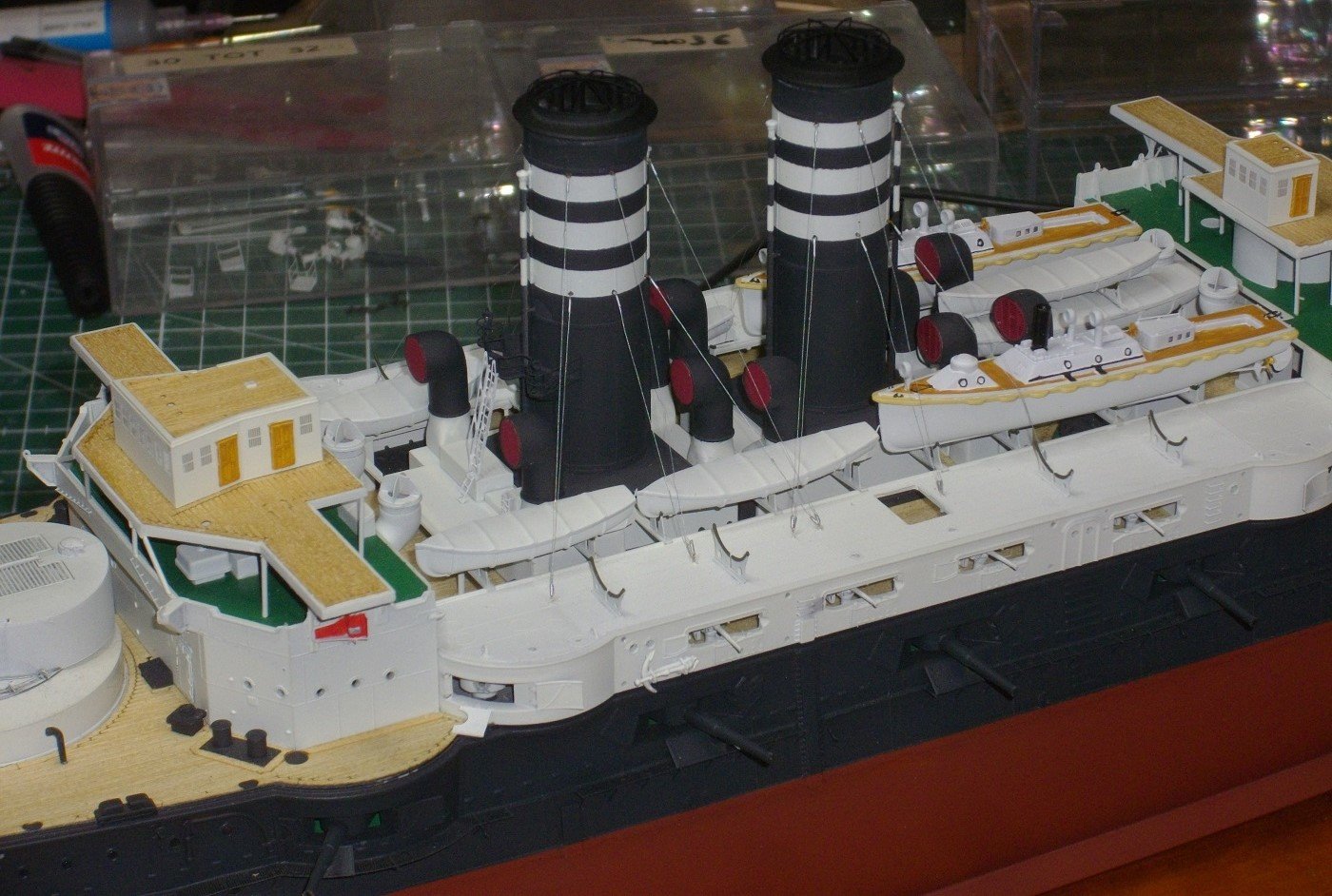

All stays attached to the funnels
After drilling some 0,4 mm holes in the boatdecks and inserting eyelets made from 0,2 mm brass, I connected the stays to the decks. An other piece of microtubing allowed to make the stays to measure.   A tiny amount of superglue was applied to the microtubing .
After cutting off the excess wire, I painted the stays with Vallejo Model Air 71.065 Steel.
I thank my dear followers for hitting the like button, an hope you enjoy the show. 🤩

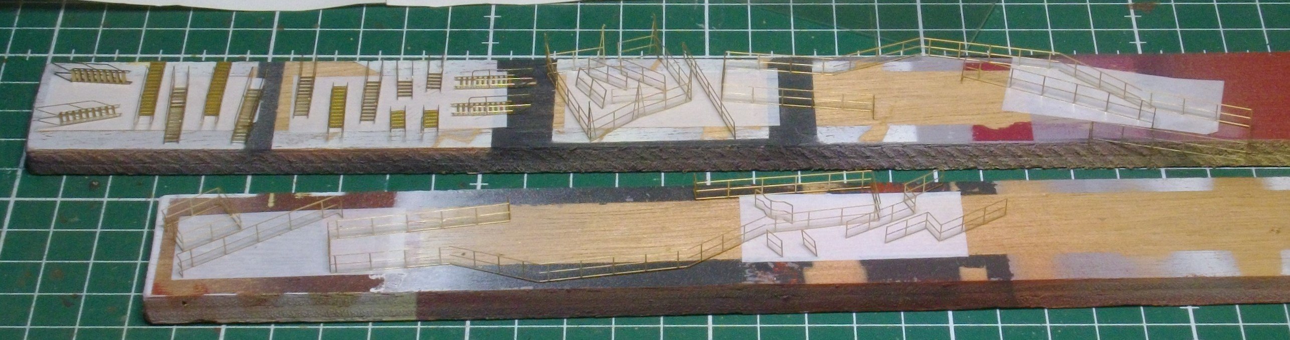

Before installing the masts, the bridges ans boatdecks must receive some details.
I collected and bent all pieces necesary.
Until next update, enjoy modeling 😀

Thanks for the kind words guys, and indeed, she is turning into a lovely lady.
Especialy after I grounded and painted the railings with Insigna White and mounted them on the fore bridge with some diluted PVA-glue.
and the ladders,
and on the aft bridge raillings.
In this process 2 ladders got "lost".
Afterwards I realised that Merit has provided these ladders too, so they will be added with the next batch of goodies.
In the meantime, enjoy modeling. :)
Time to put some deckfurniture on the bridges:
- compasses,
- communicationtubes,
- searchlights,
- small caliber armament.
IMGP7187.thumb.JPG.3904af28e9ee7e5780fec9e9419f2909.JPGIMGP7188.JPG.b11a0eec7e3f146dae23b7f9a15ce922.JPG
Until the next update, enjoy modeling, and thanks to my followers for the support.
