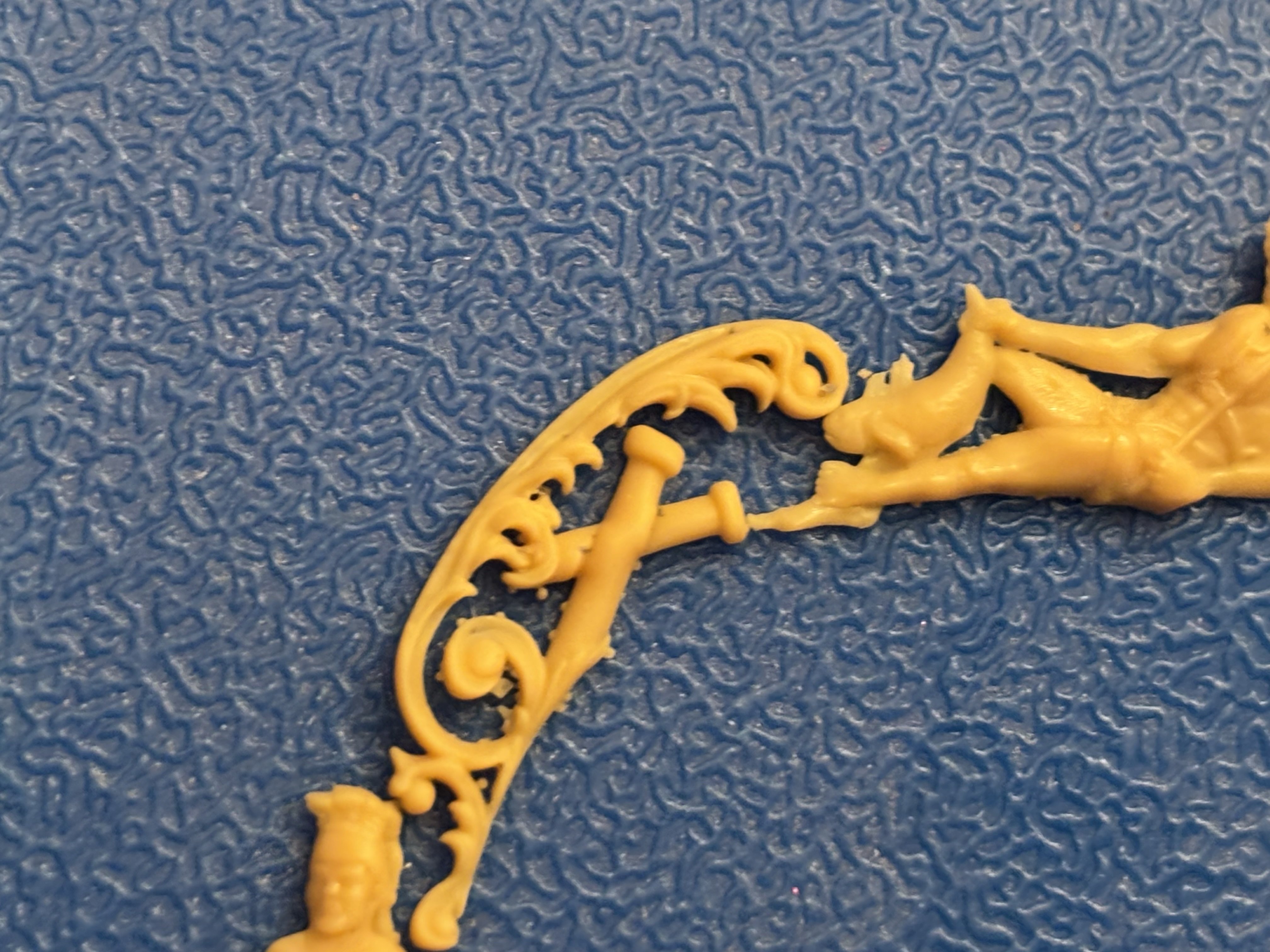

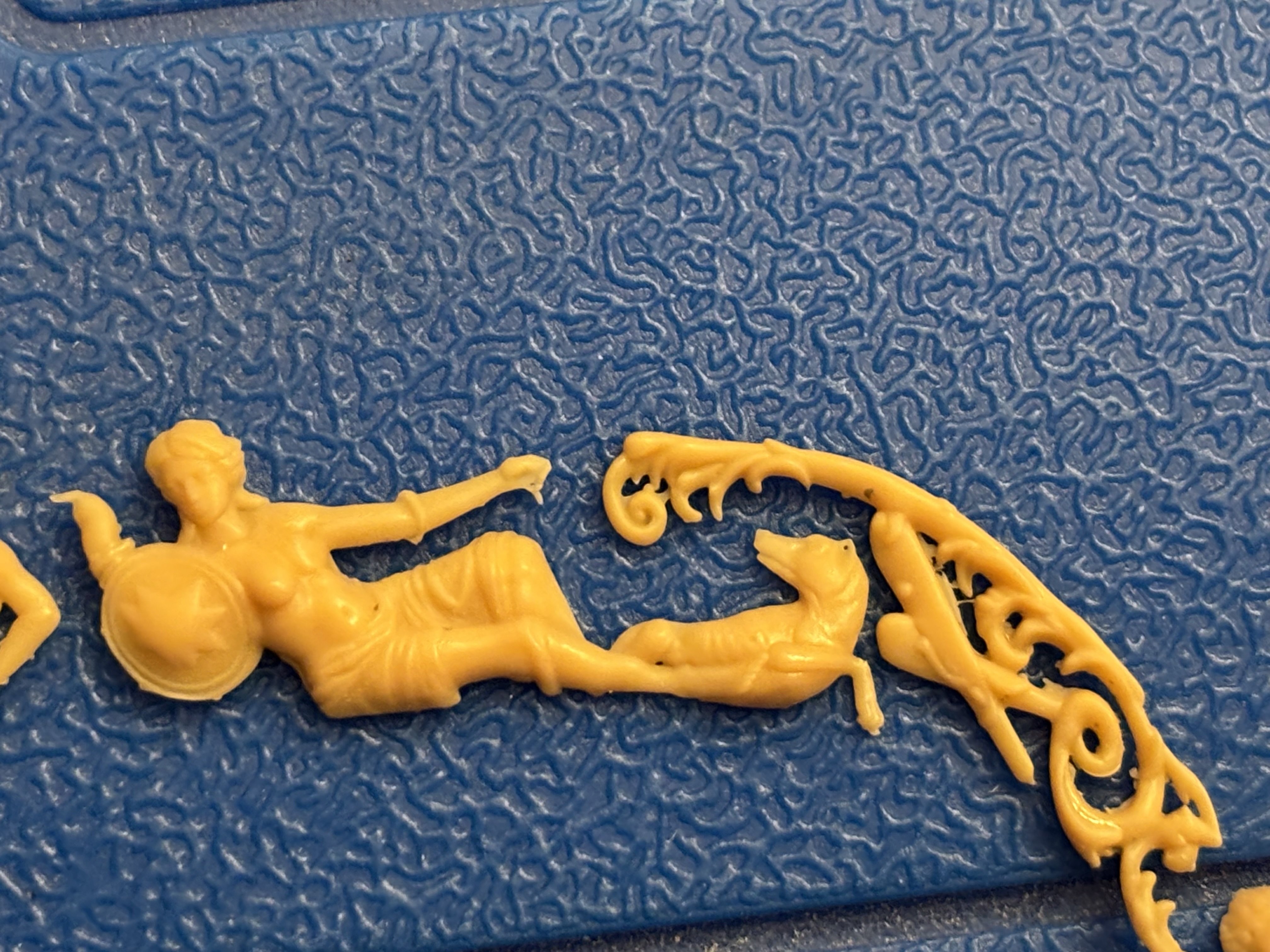

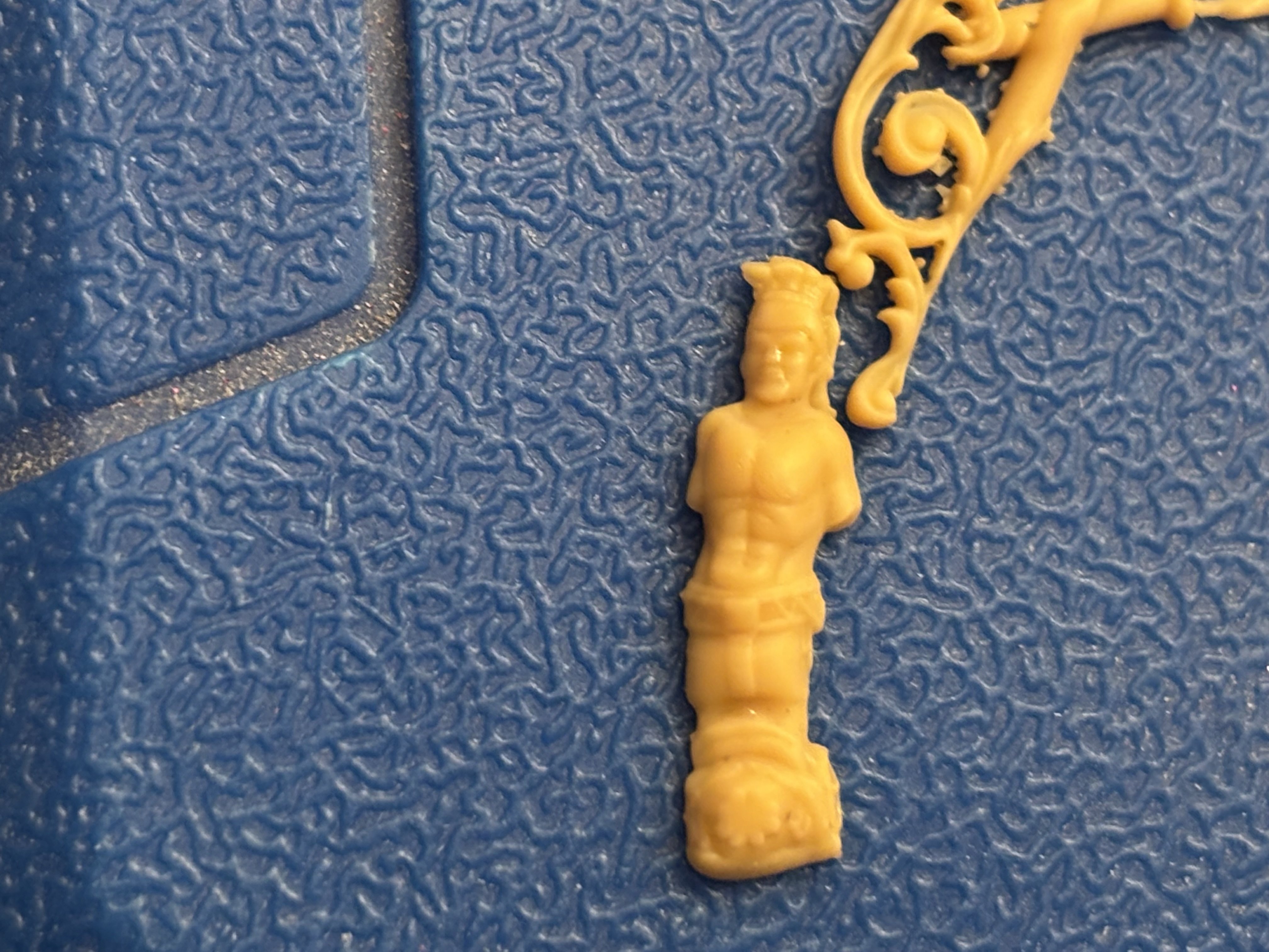

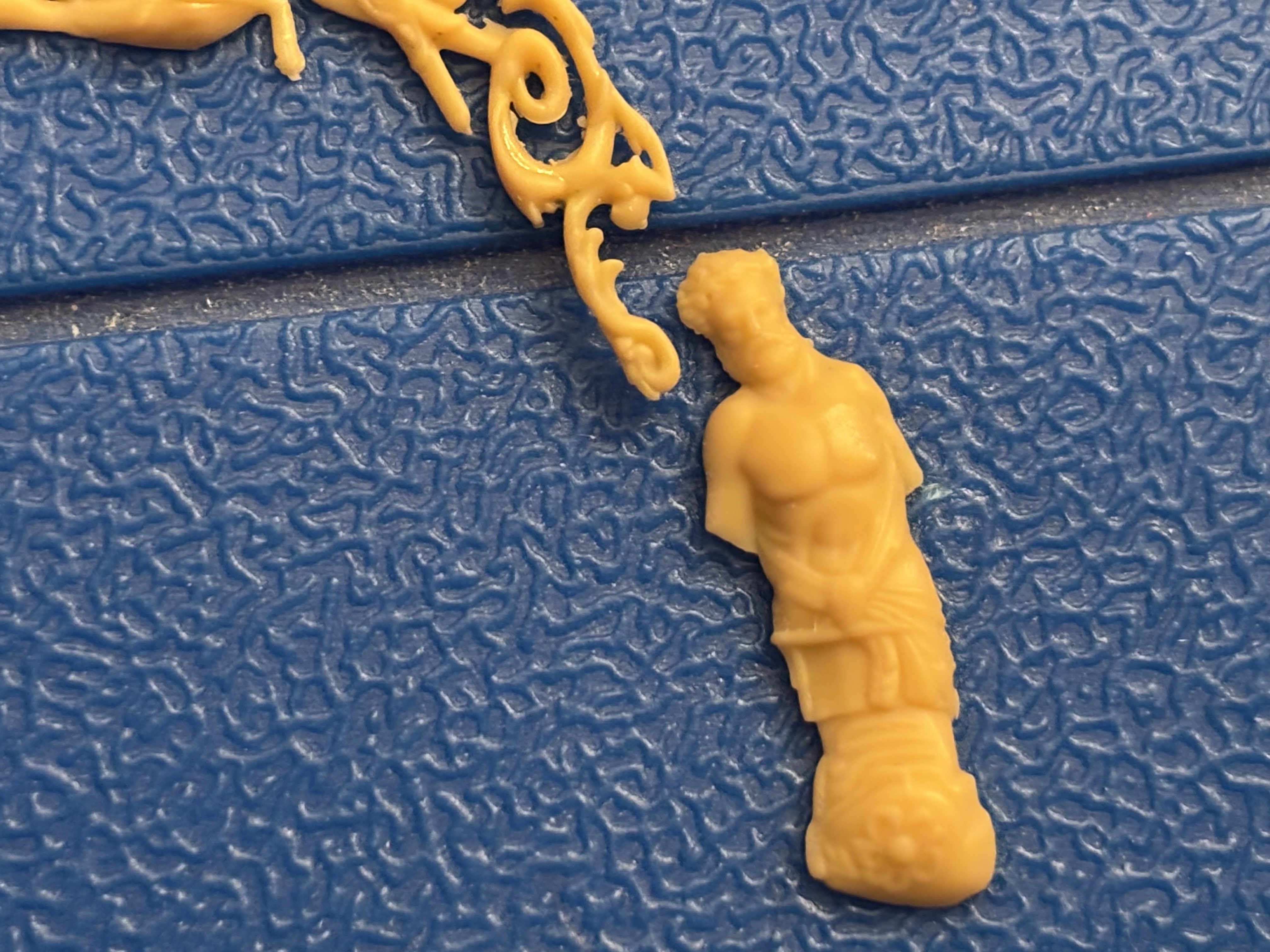

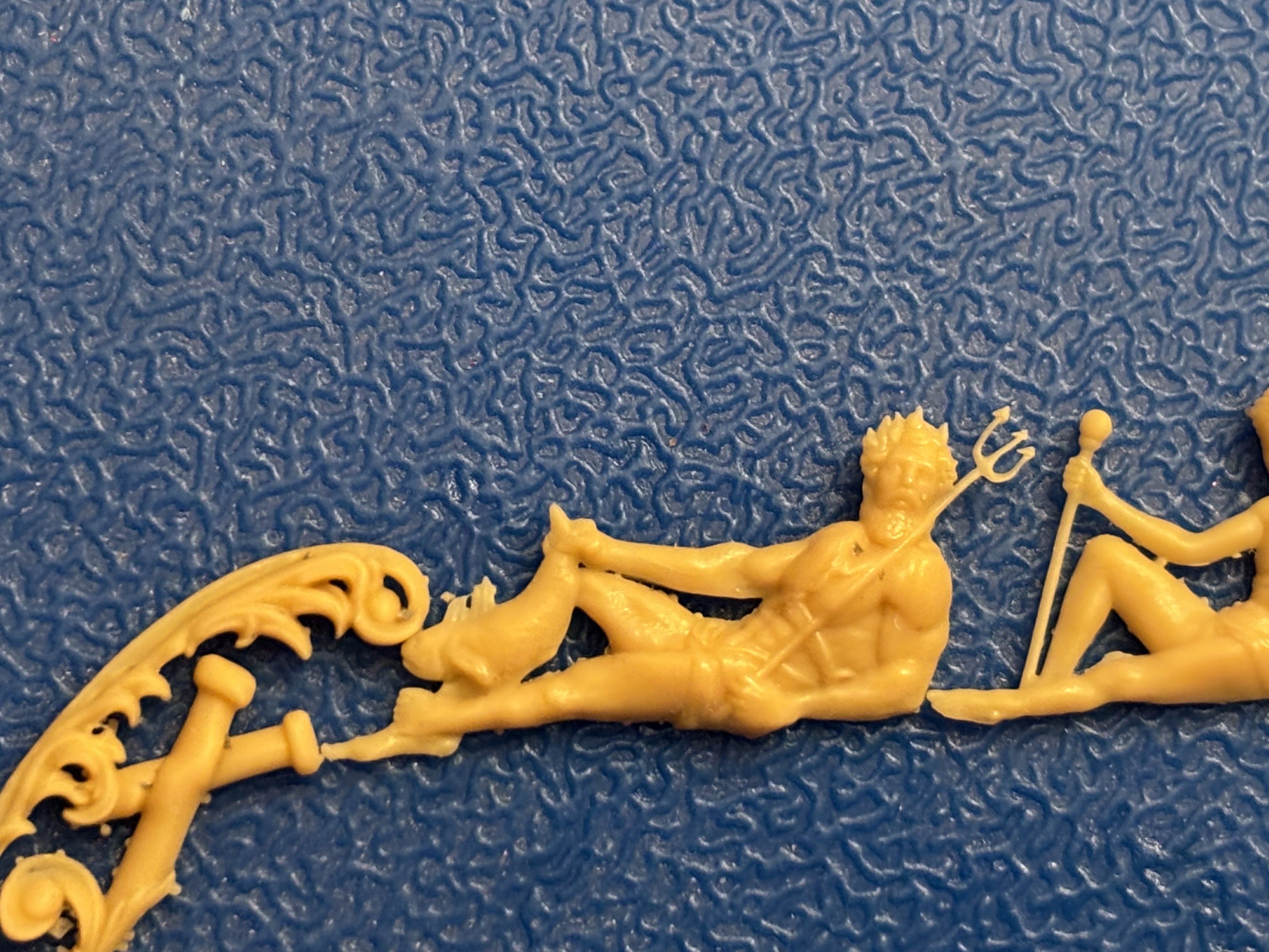

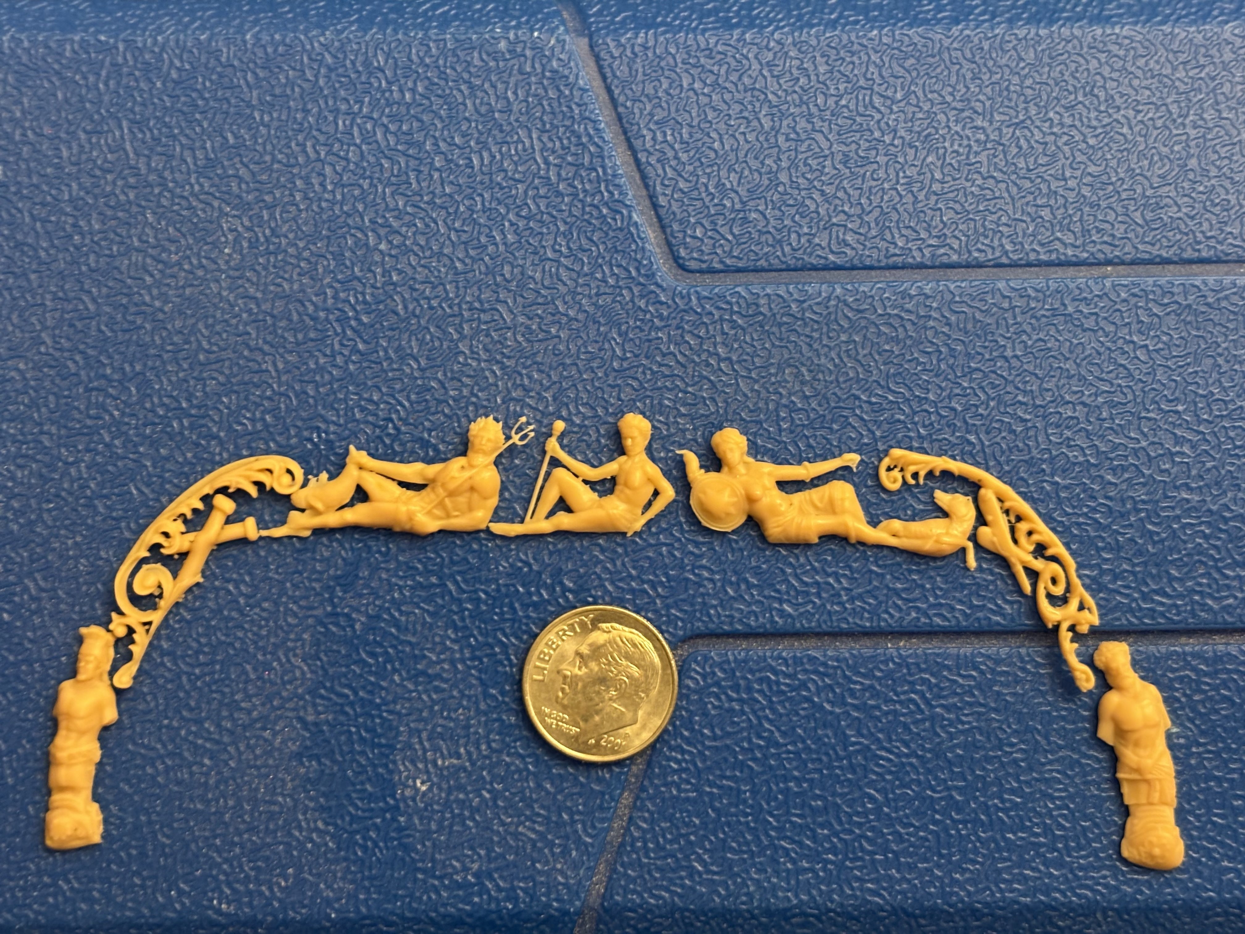

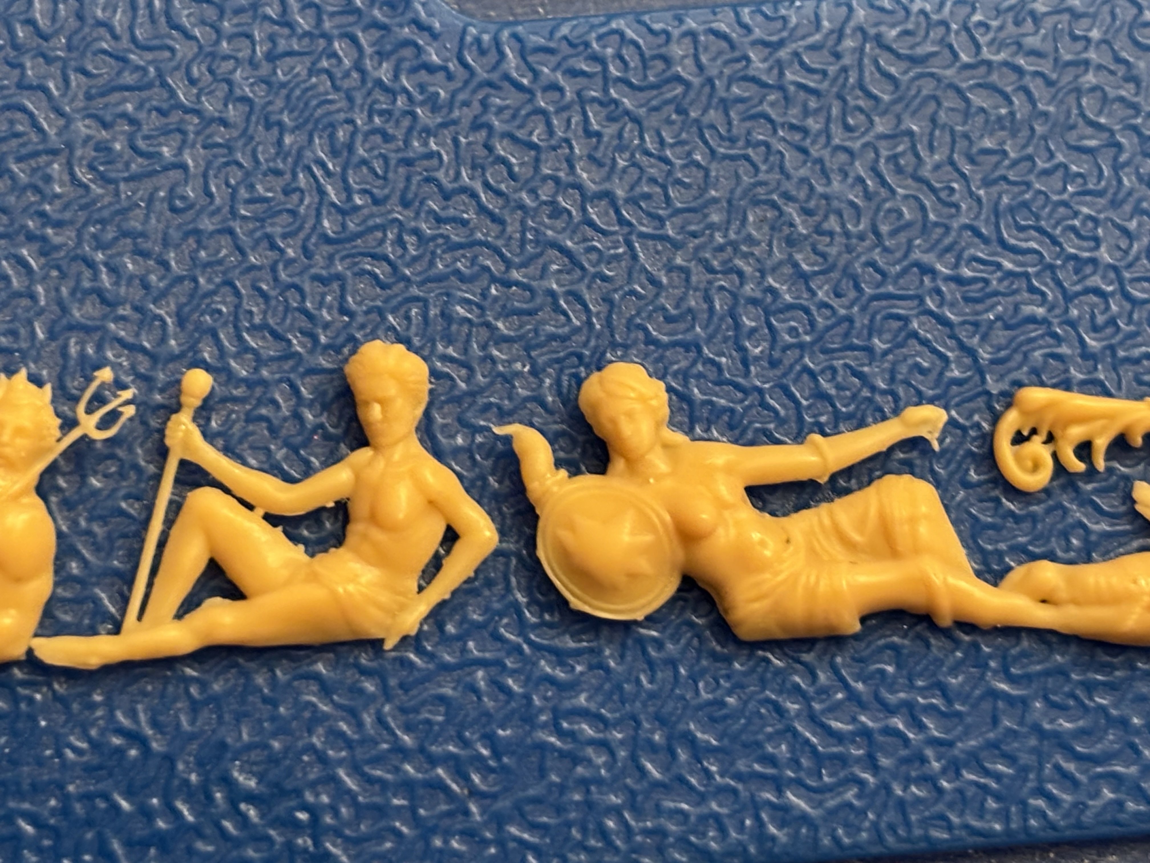

Work has been slow in the shipyard, but I did get some work done on the stern carvings.  I used meshy and relief maker to generate the stl files and then printed them out on my resin 3d printer.  Now I need to do some test to get them to close in color to the stained basswood of the hull.
IMG_0262.thumb.jpeg.42ff0c83acecf3b52a56c2a2b108355a.jpegIMG_0261.thumb.jpeg.714e4f719df2ead74e44768249cc5c94.jpegIMG_0260.thumb.jpeg.e447b66a458bc90c977a42196b59dd02.jpegIMG_0259.thumb.jpeg.2b529b182ce62b23141aafe8bba53c67.jpegIMG_0258.thumb.jpeg.23a3167953ebb302f316e45d0db5c002.jpegIMG_0257.thumb.jpeg.3d6f8685ea301bc3b2646f9f3f027ca5.jpegIMG_0256.thumb.jpeg.c6c0d6aef260cad26994f34a9ad0f93b.jpeg
Kenny
They definitely look way better than the white metal ones supplied by model shipways in the kit.
