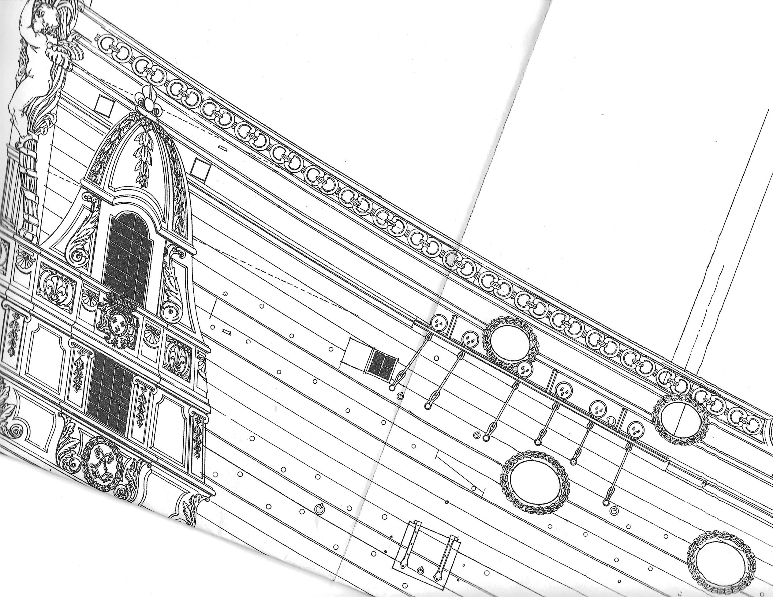

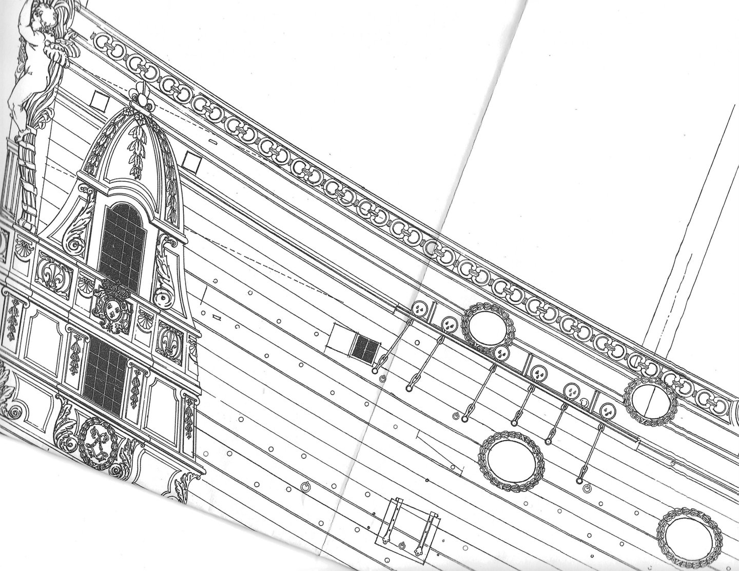

I can see the appeal of having the trophies stay in-line with the run of the ports, but I am thinking that these ornaments would not cross the wales on the aft two ports.
On the DR of 1680, as the wales are cut by the ports, albeit not to the same degree, the ornaments remain on the planking between wales:

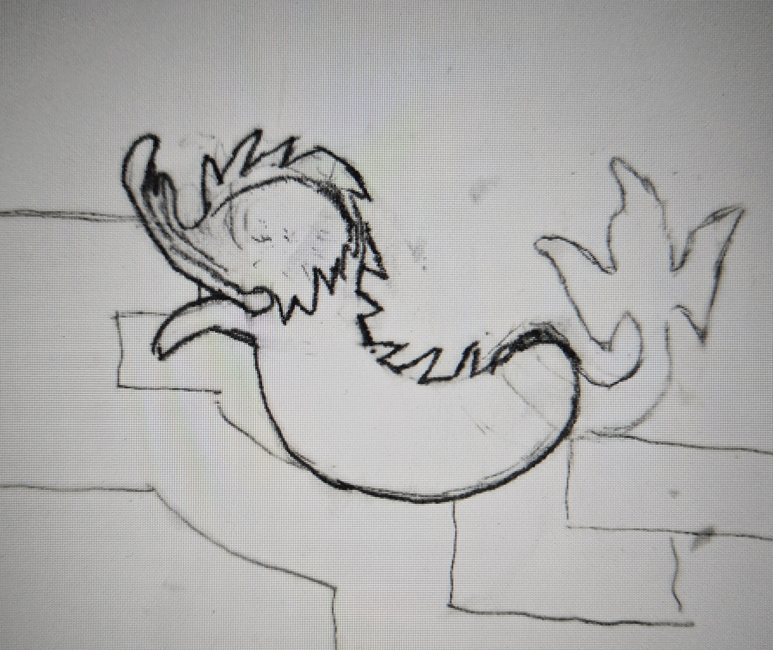

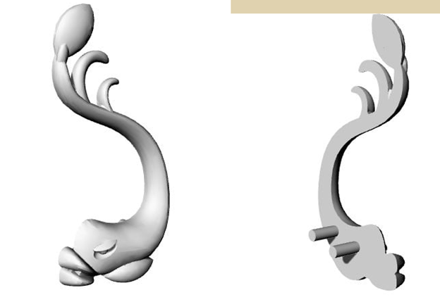

I found a dolphin in a fountain at Versailles that I really liked, and I created a drawing (using the exact dimensions of the railing).

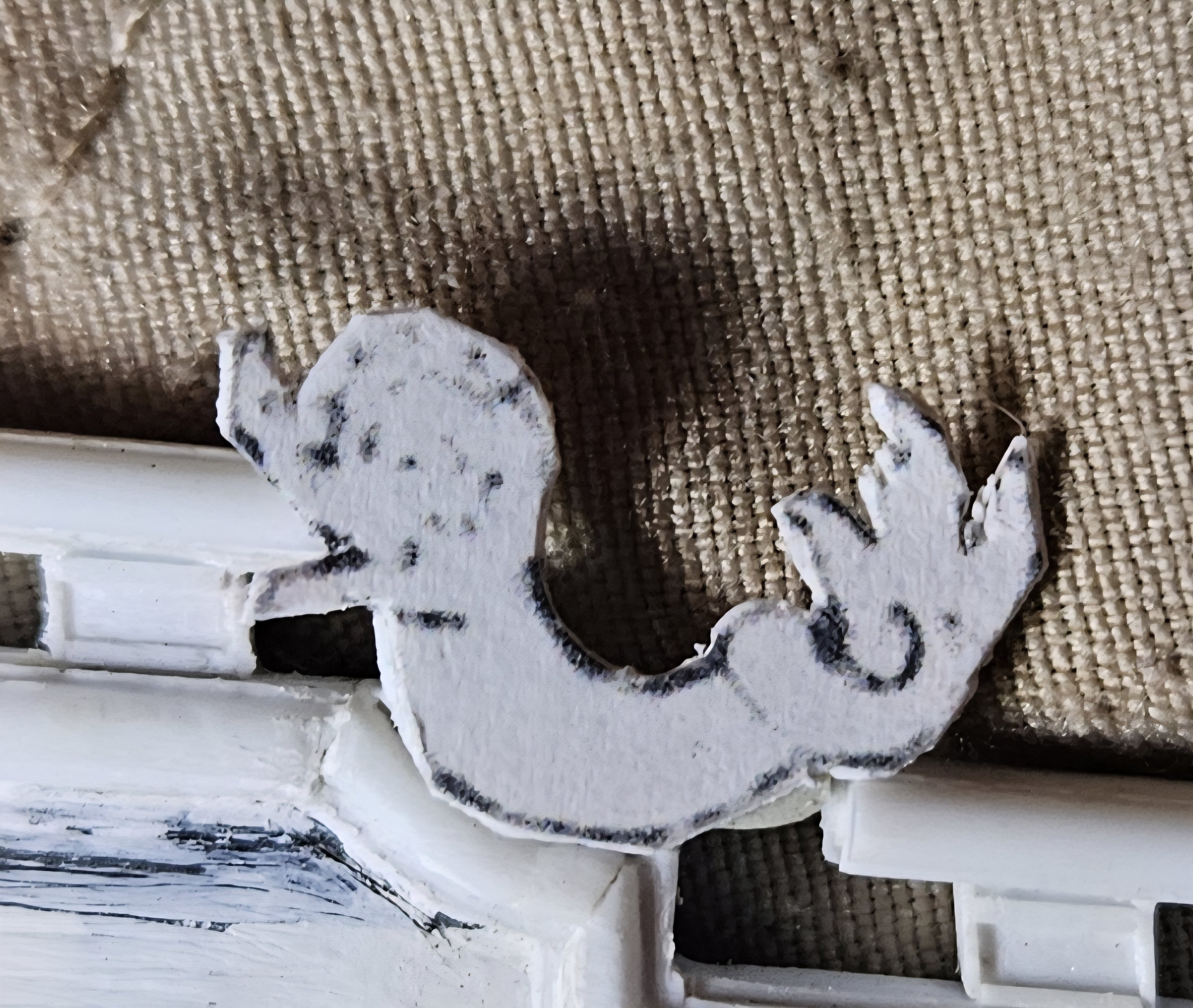

I cut out a very rough template to check the fit, and was satisfied.

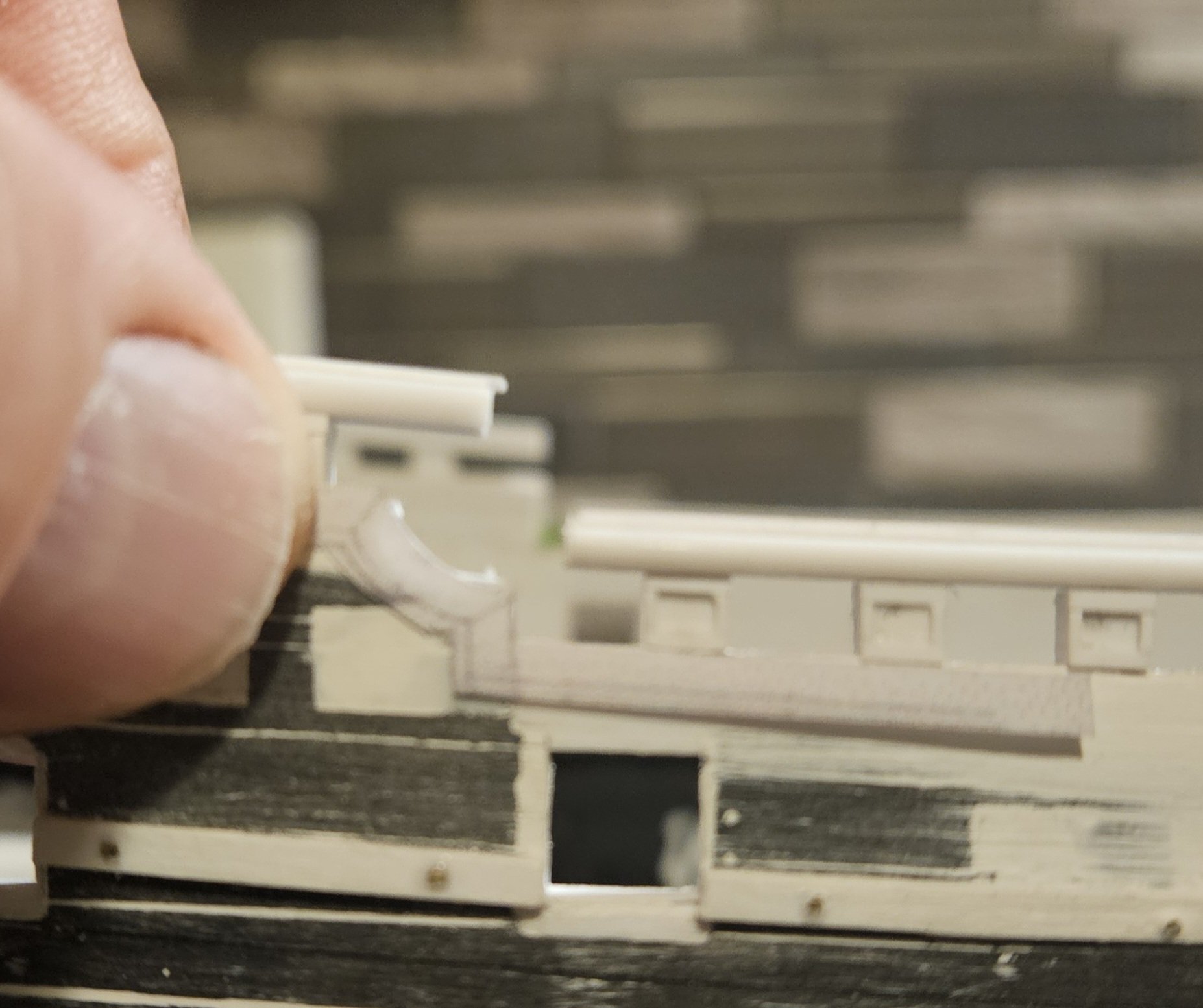

Now the thing that I need most is patience, as I really have to let the ApoxieSculpt dry overnight, else all is ruined. You can see my original hance piece from last year (bottom of the picture), and the scale will be much better. The half-piece at top has been built up with two thin layers of ApoxieScuplt on the 0.5mm thick Evergreen template. I am trying to add some subtle details, like lines and fish scales... if they don't dry overnight - they are lost!

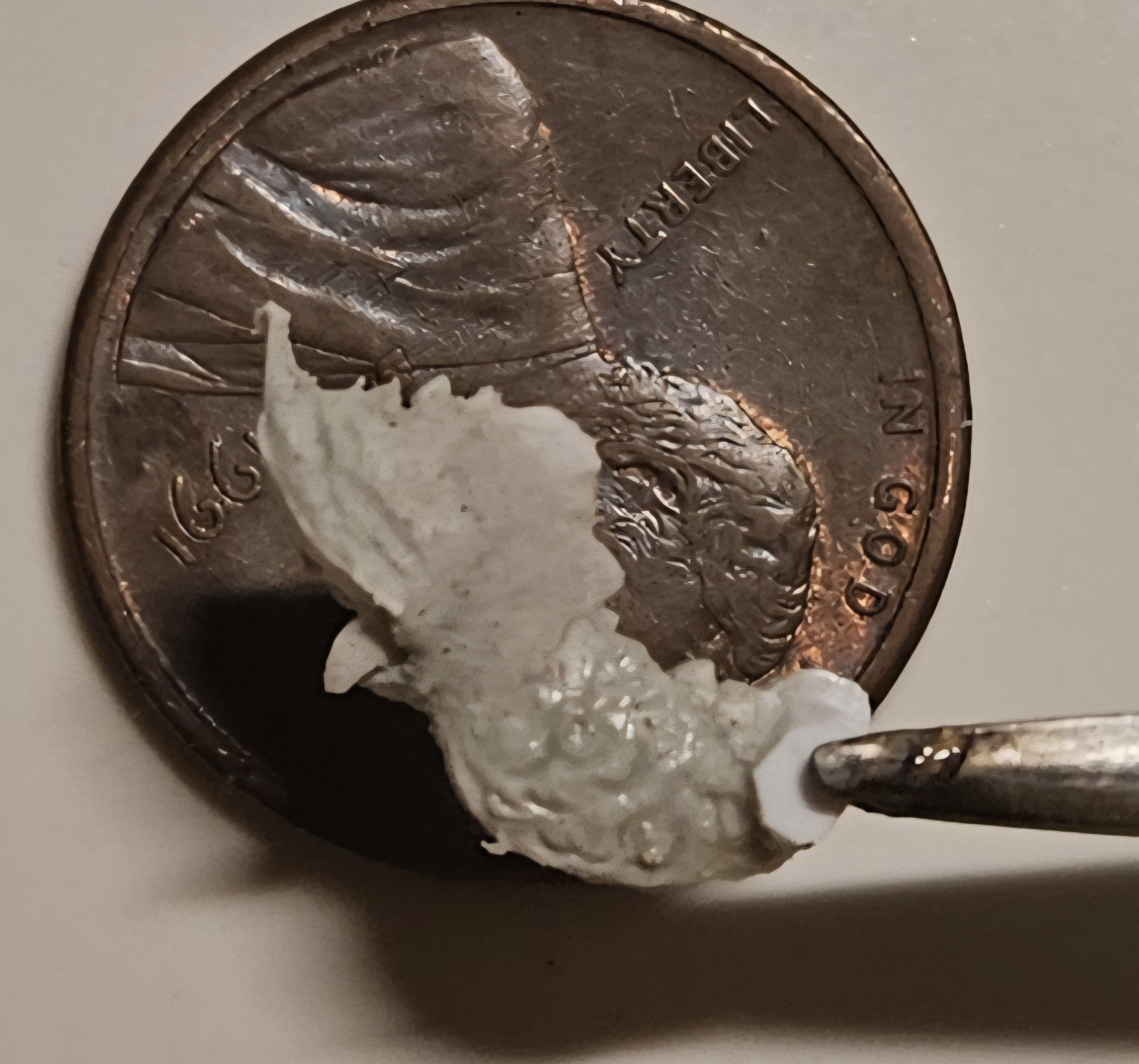

The tweezers is holding onto a tiny 1mm thick disc glued to the body stock. This will allow me to offset the tail from the main plane of the body, like the foundtain dolphin at Versailles. It will realistically take me another 3-4 days of work to finish this first one - 15 minutes of work, then 16 hours of drying! However, once I have the process down, I will just build the other three hance pieces together, step by step.

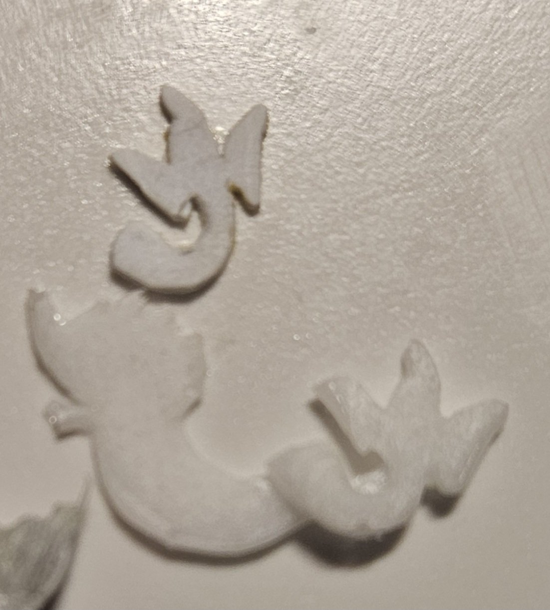

Note below the original template, which is one piece. I quickly found that it worked much better if I seperated the body from the tail, then added the tail at the end.

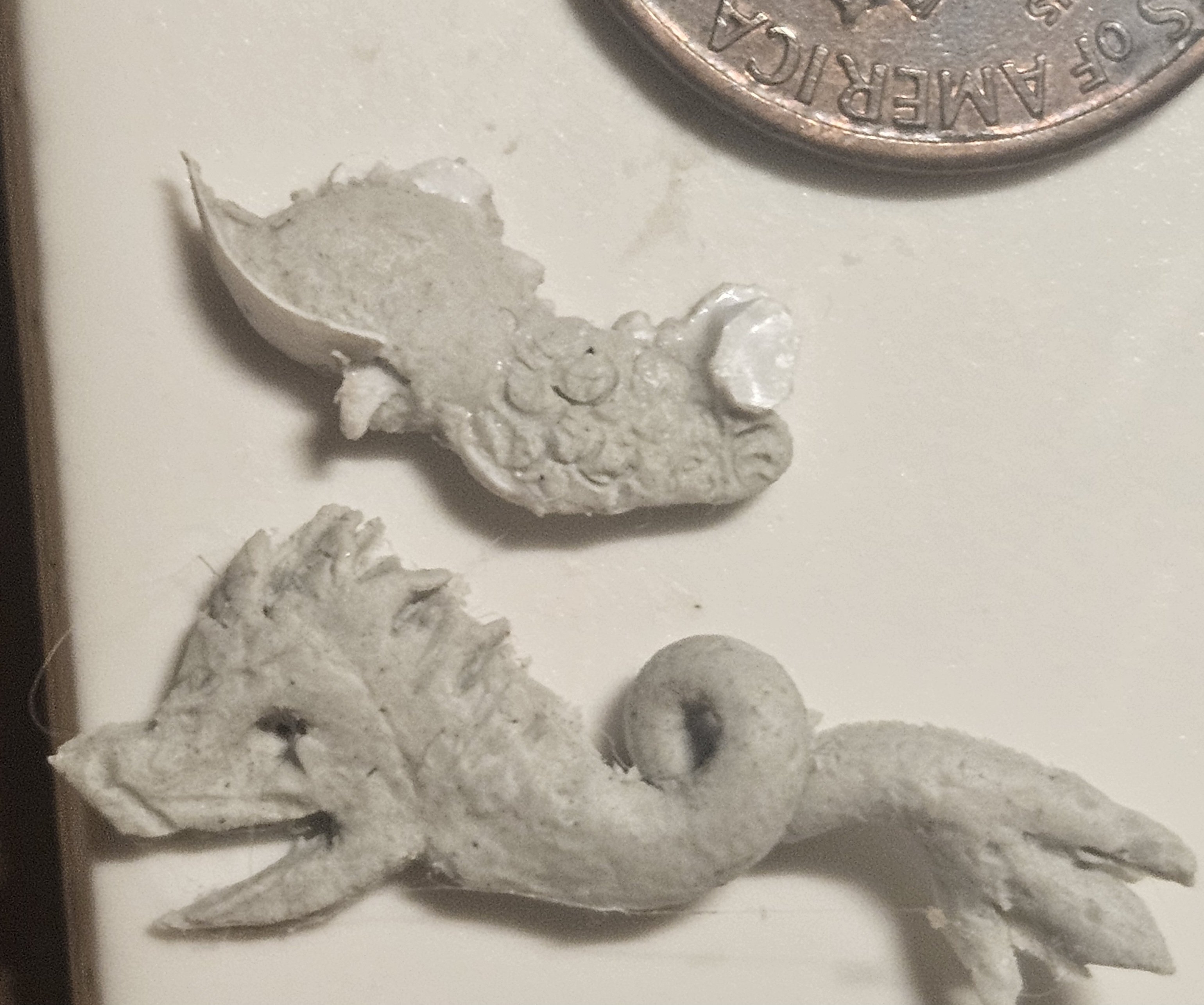

I am pleased how the prototype dolphin hance piece is coming along... I was able to attach the offset tail. Of course, working on the hance piece is a lot like an NFL game; 5 minutes of action in 60 minutes of time.
At least I was able to start the assembly line process. Honestly, I am putting in 5-10 minutes of time on each hance piece, and then drying for at least 8 hours - depending on the thickness of the ApoxieSculpt coat.

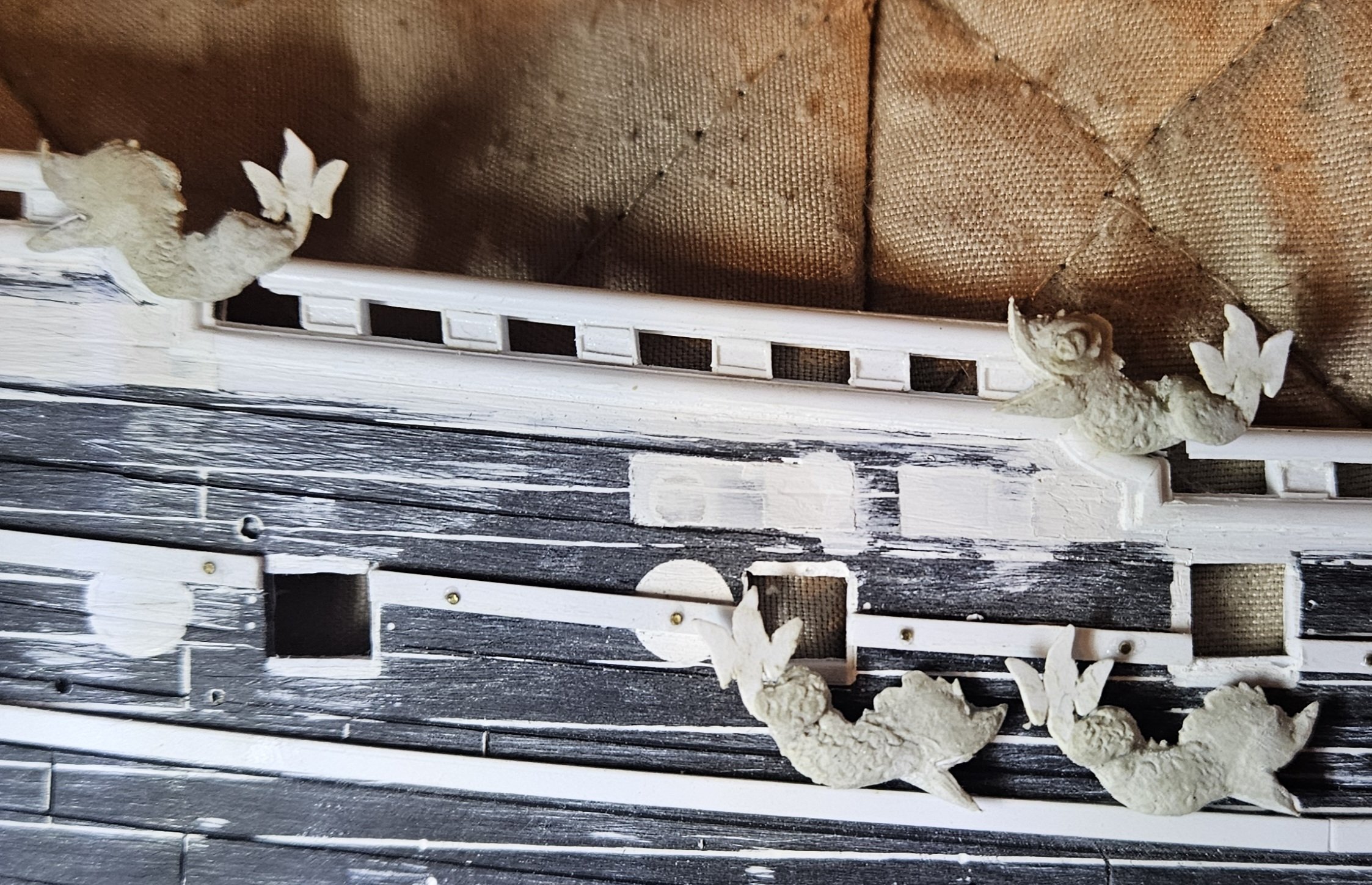

And...just about ready to finish the facial features. The two dolphin hance pieces on the rails are roughly laid in now, as I need to finish off the railings and the curve where their bellies will sit. I tried painting a fine wash of ApoxieSculpt on the tails... but I may just leave them as is.
Then.... cleaning up 60 dolphins that will bracket the upper gun deck ports...
Of course... I wasn't satisfied with my initial dolphin hance pieces.. so I started over! After studying the dolphin in the fountain at Versailles, I made some adjustments and I am much more satisfied now. The top dolphin is Version 1.2... the dolphin below is Version 1.1.
I wanted a bigger tail section, and more detail in the edging of the back and the tail fin... in addition, the head became smaller. Finally, I wanted the tail to protrude out in the horizontal plane toward the eye before sweeping back, and to tip the tail fin at an angle to give it a more dynamic look. I couldn't find a material that would allow me to have these complex curves in the tail.. and them I remembered.... copper wire!

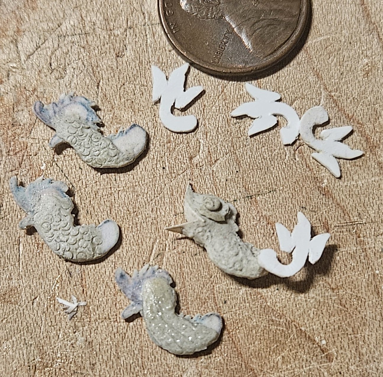

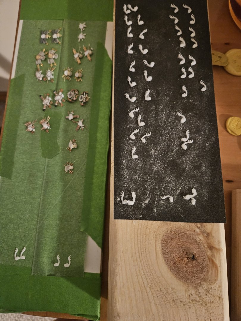

Here are all of the basic components cut out and ready to assemble. The triangles (big and small) are 3mm wide and fit into the mouth of the dolphin. I also then added small pieces of 1.0mm half round Evergreen to the body section. The body is carved from 0.75mm thick Evergreen sheet and the triangles and half round pieces allow me to build up with ApoxieSculpt.
You can just make out the half-round pieces on the body as I slowly layer up with ApoxieSculpt.
It's actually very easy to build up the bodies of the dolphin pieces; the only drawback is the drying time of the ApoxieSculpt as I slowly build up the layers. When the bodies are entirely filled out, I will do some light sanding/finishing, then add the detail to the faces... and I have an idea on how to add much better looking fish scales to the bodies... we shall see!

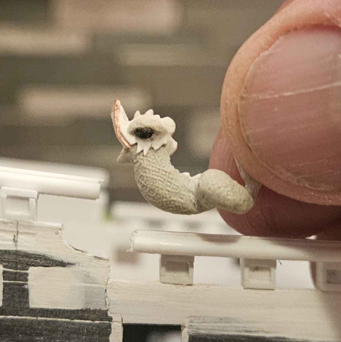

I think I have figured out a way to apply scales to the dolphin hance pieces.
The first step was to roll out some ApoxieSculpt into a very thin sheet. I rolled it on a small piece of ceramic tile, and then put the tile in the freezer. Every hour or so, I took the tile out and let it sit at room temperature for a few minutes, then back into the freezer. I eventually found a point where the ApoxieSculpt was not tacky, and yet was still malleable (putting ApoxieSculpt in the freezer stops the hardening process). Then I cut a small sheet... this small rectangle has some texture on it that I was experimenting with. Also, I should note that prior to this, I made a thin "mud" of ApoxieSculpt and applied it to the hance pieces... the "mud" was thin enough that it self-leveled and the surface of the hance pieces became smooth.
Next, I dabbed some cyanoacrylate on the dolphin body, and then applied the small sheet of ApoxieSculpt. I then used my thumb to level the edges and cover the entire half of the body... no scales on the head.
Next was several passes with the knurled handle of an X-Acto blade to make scales. I lightly rolled the piece several times. The piece can't get into tight areas where the tail curves, but I am not going to sweat that. I am not looking for perfect scales. I did try with multiple individual tools to press or carve in rounded scales one at a time, but I didn't have the skill (and patience), so I knew that I needed something to take away the guesswork.
Now all four hance pieces have one side of the body textured. They need to dry completely overnight, and then back to the other side. Ultimately, I just wanted a fine, consistent texture, and as Marc LaGuardia has observed on his build log, that fine texture on his dolphin tails will pick up a wash!

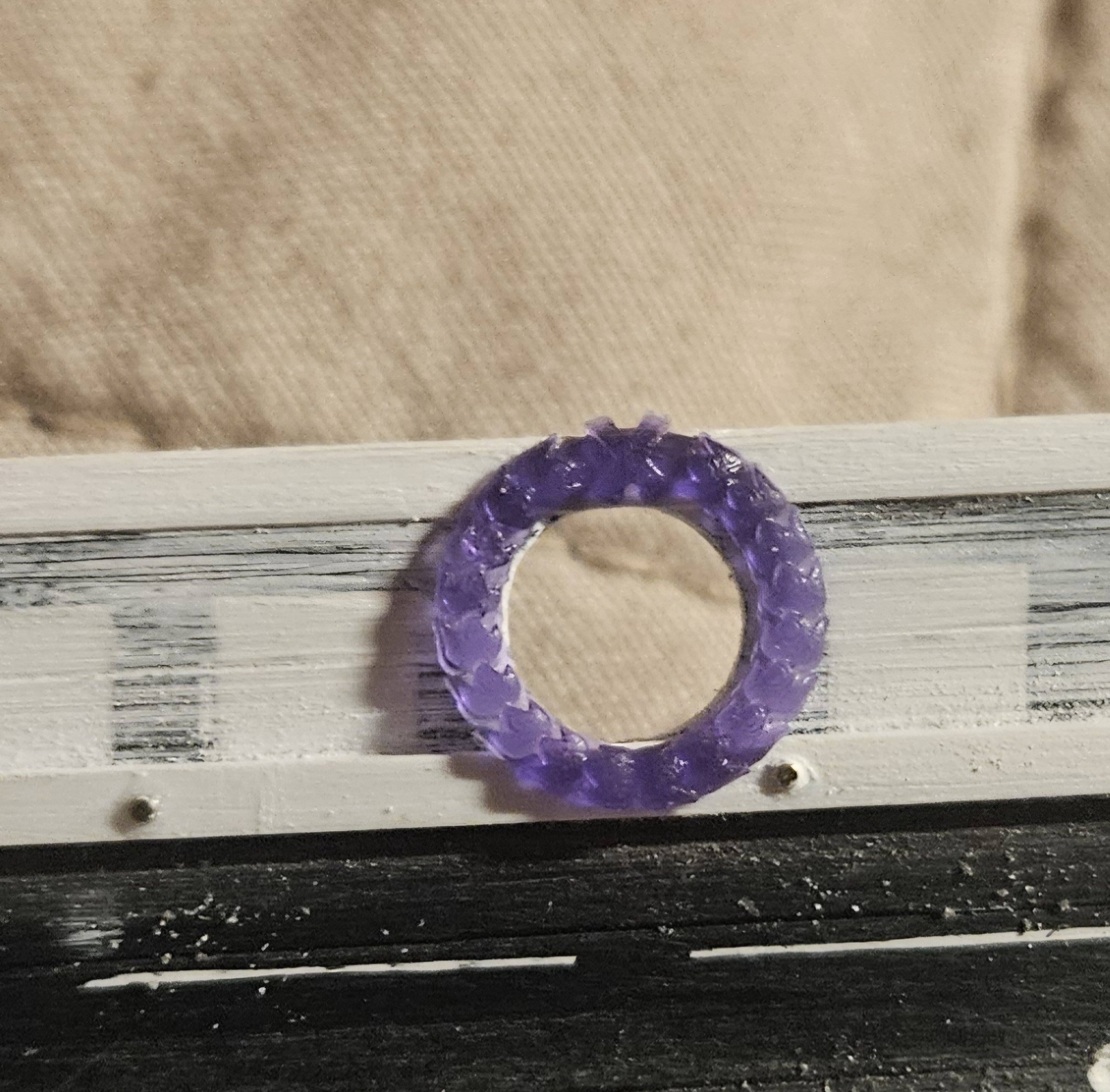

I just laid the circular gun port wreathes and square gun port decor on my beakhead bulkhead - obviously I have some fine tuning work to do, but this saves me a lot of work.

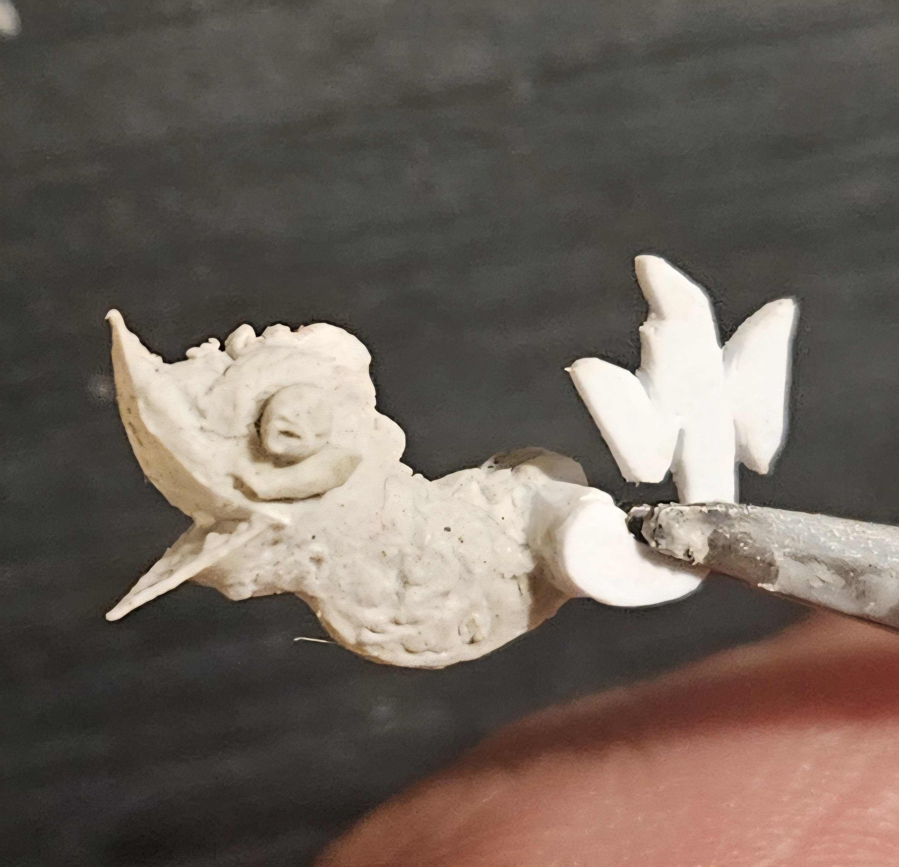

OK, I am satisfied with my first dolphin hance piece... well, actually Version 3.0. This fountain at Versailles is what I was aiming for, and now I have some cleanup work, as well as the assembly of the other three hance pieces.
EDIT: Stock photo removed by moderator.
I do need to trim the tail down a bit, where the tail turns from the body and extends to the viewer... that is just a little light sanding of the ApoxieSculpt. I know.. dolphins don't have scales or gills, but the French dolphins often seem to be very stylized. So I decided I wanted to mimic the "gill plates" extending behind the eyes, and have them stan away from the body a bit - so that needed a 0.13mm thick Evergreen sheet. I also wanted the "lips" of the dolphin statue.
Note to self... as I look at the magnified pictures, I am going to redo the eyes... I might actually drop a #9 shotgun pellet in the socket.
Overall, I am satisfied and the next three will look even better, especially when I fix the eyes/eye brows. Ohhh - and that too thick tail! I still see too many flaws, but I remind myself that no one is going to be looking at these with a microscope; they will be at least a foot away.
And the dolphin hance pieces are 95% completed... I am carefully configuring the railing to the contour of each dolphin. I have an idea for a subtle cradle that the dolphin will nestle into, simply using several thin half-round Evergreen strips. The dolphin is not tight fitted in.
I still have a little bit of finishing work to do.. very subtle things like the eye is too round, as in the lower right dolphin.
I wasnlt satisfied with making eyes from ApoxieSculpt... the eyes were just tiny little balls that I couldn't get right. I rummaged in my shotgun reloading supplies and pulled out some #9 pellets, which happen to be 0.08" diameter. Still too big and round, but I popped each pellet into a vise and then sawed a cut into each pellet. I then split each pellet in half... lead is soft.
I didn't like the round eyes... what to do? I sliced with am Xacto knife and made a different eye shape that - hopefully - looks a little meaner with an ApoxieSculpt brow. Marc LaGaurdia has observed that statue work like these almost bordered on the grotesque side, exaggerated like gargoyles.

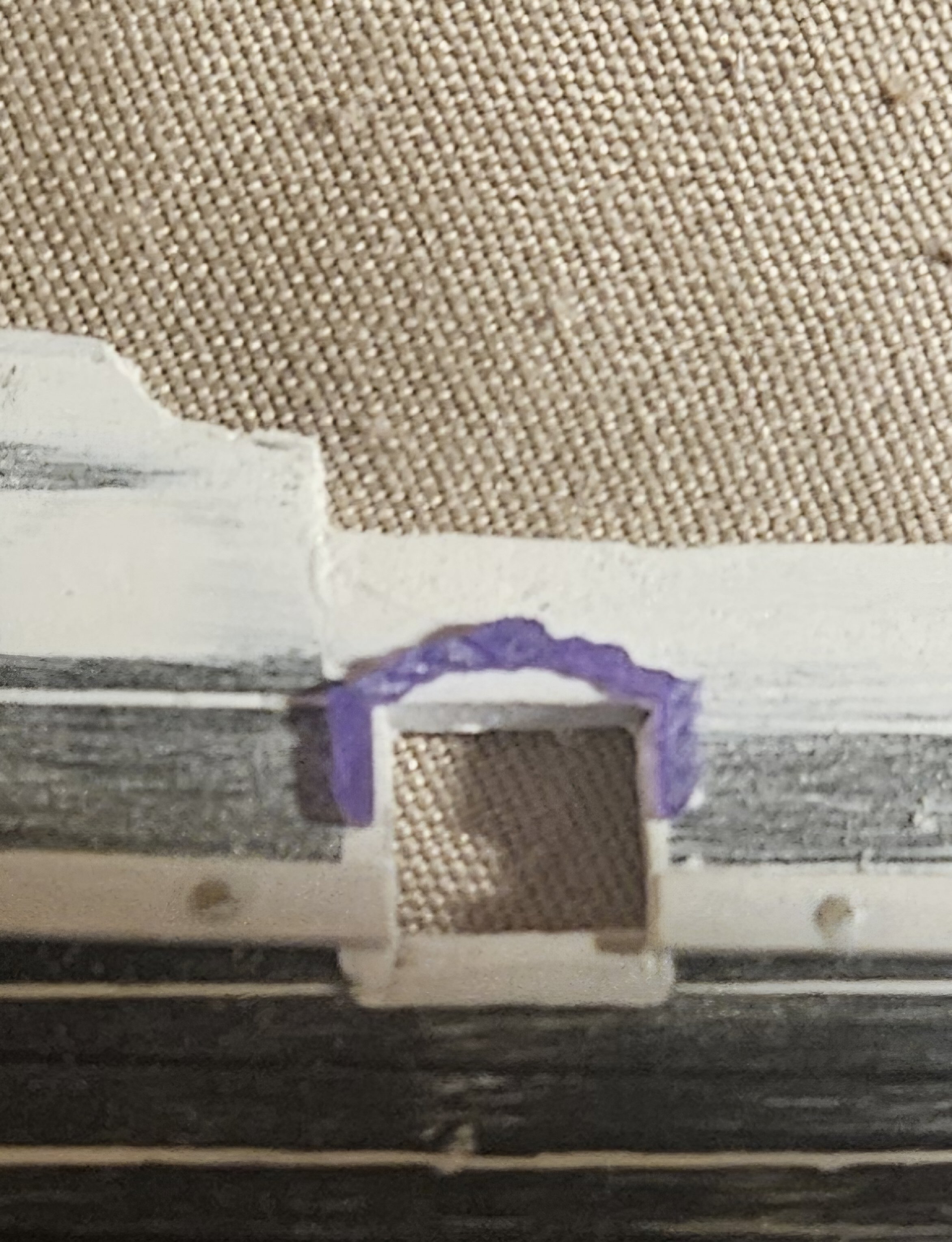

Now on the finish the inletting of the rails. Last week, I had figured that I needed to have some sort of "cradle" under the belly of the dolphin; I was visualizing two 1/4 round or two 1/2 round pieces. However, in looking at any old drawings that I can find, as well as what Marc LaGuardia has done, I don't see any evidence of an obvious cradle or support system, other than the railing is simply contoured to the belly of the dolphin. Of course, a 1/100 dolphin hance piece doesn't need a cradle, but I still have it in my mind that a full size wooden hance piece might need to be supported at the belly.

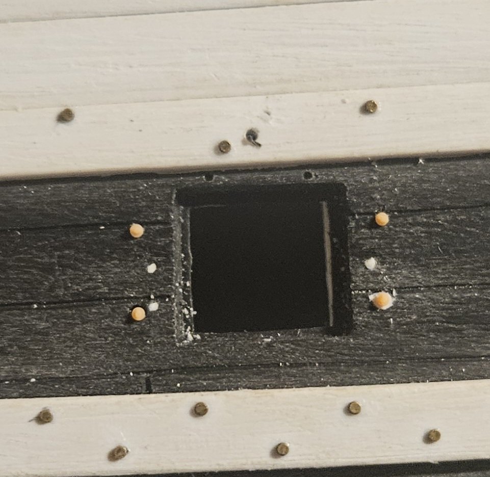

Many of these are already in place, but now that I have the gun tackle bolts from Kris in Poland... that leaves me about 400 gun port tackle holes to do next! Fortunately, the "hard" part is just making an appropriate jig for each of the different gun ports.... the drilling then is very easy and robotic.
Well... I have made a slight change in my scope.... I went from this...
To this, by ripping off all of my timberheads and railings and mouldings....why?!?!
One reason was that I made the timberheads a year ago... and my skills have continued to improve. The other day, I noticed the glue smears and the framing of the timberheads, which weren't uniformly crisp and clean, and decided... I can do better. So the timberheads were ripped off like a Band-Aid. And that also allowed me me to look with a very critical eye at the various little imperfections that I had "let go" when I proceeded on with the timberheads last year... for example, plank lines, and other tiny items that  now bugged me. Stripping away the timberheads allowed me to focus on the entire hull, which was now a blank canvas again.
But... a primary reason is that I didn't anticipate the offerings that I would get from SKUTZNIK (Kris in Poland). I first saw what Kris and his team could do with the cannon they made for NMBROOK and his Soleil Royal, and ordered a full set of cannon from him... I am very happy with the cannon, and that opened my mind to other possibilities from Skutznik, possibilities that I didn't plan for as I didn't know the existed.
1) Gun port decorations... it will be so much easier if I carve inlets in the mouldings in advance, especially for the circular wreaths.
2) Gun tackle bolts/wedges... I have made jigs for the various gun port sizes to drill holes, so that I can insert the gun bolts after painting. I know that I have to make and use jigs whenever possible, so that I get uniform results. Note that a few of the prior holes (lower left bolt) are slightly too big, so I have to fill them in.

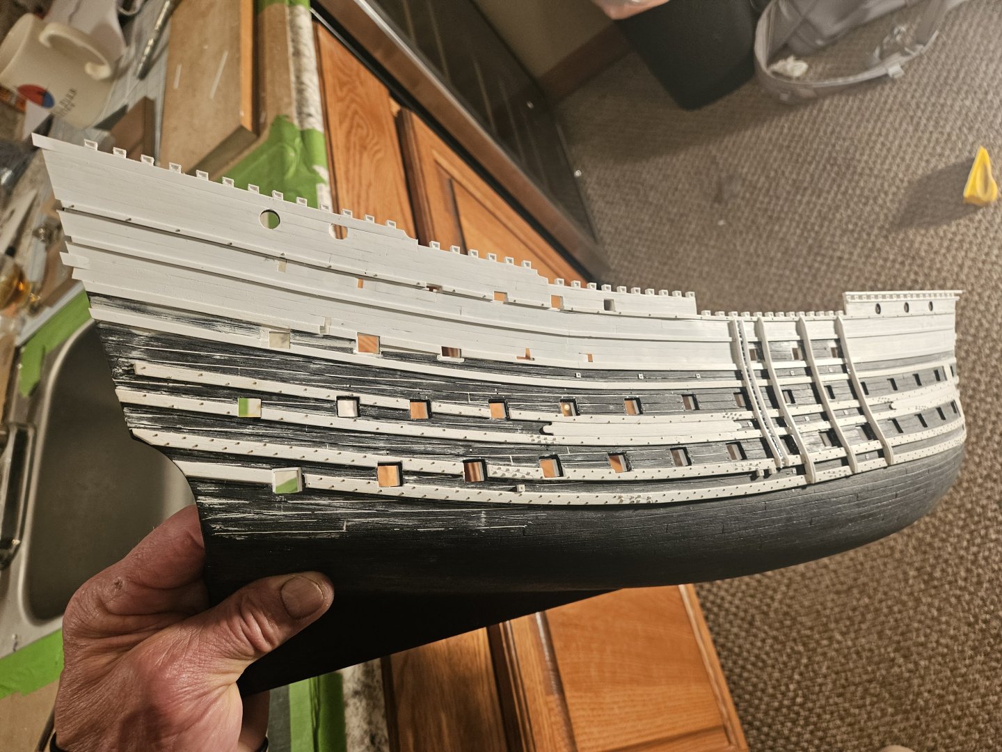

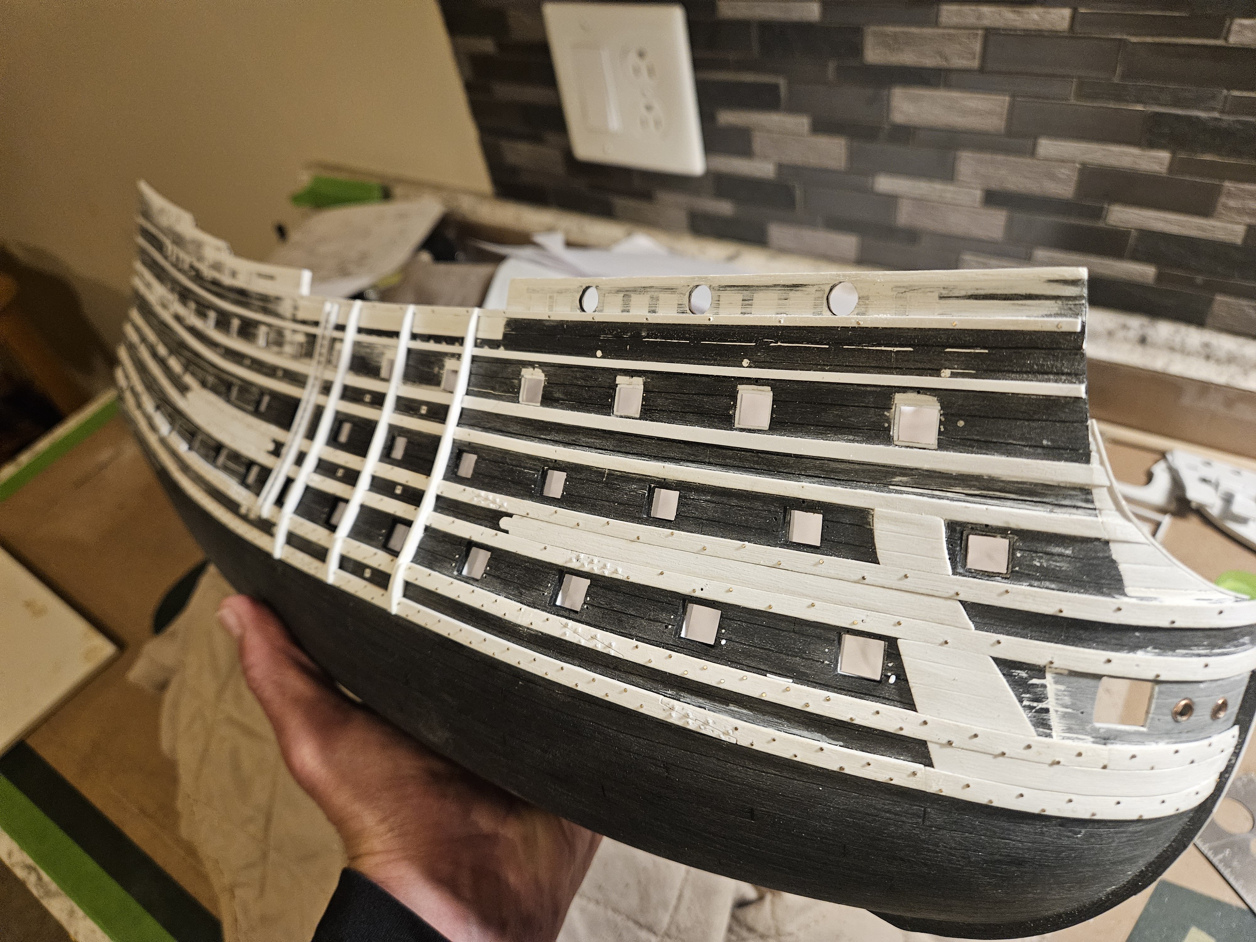

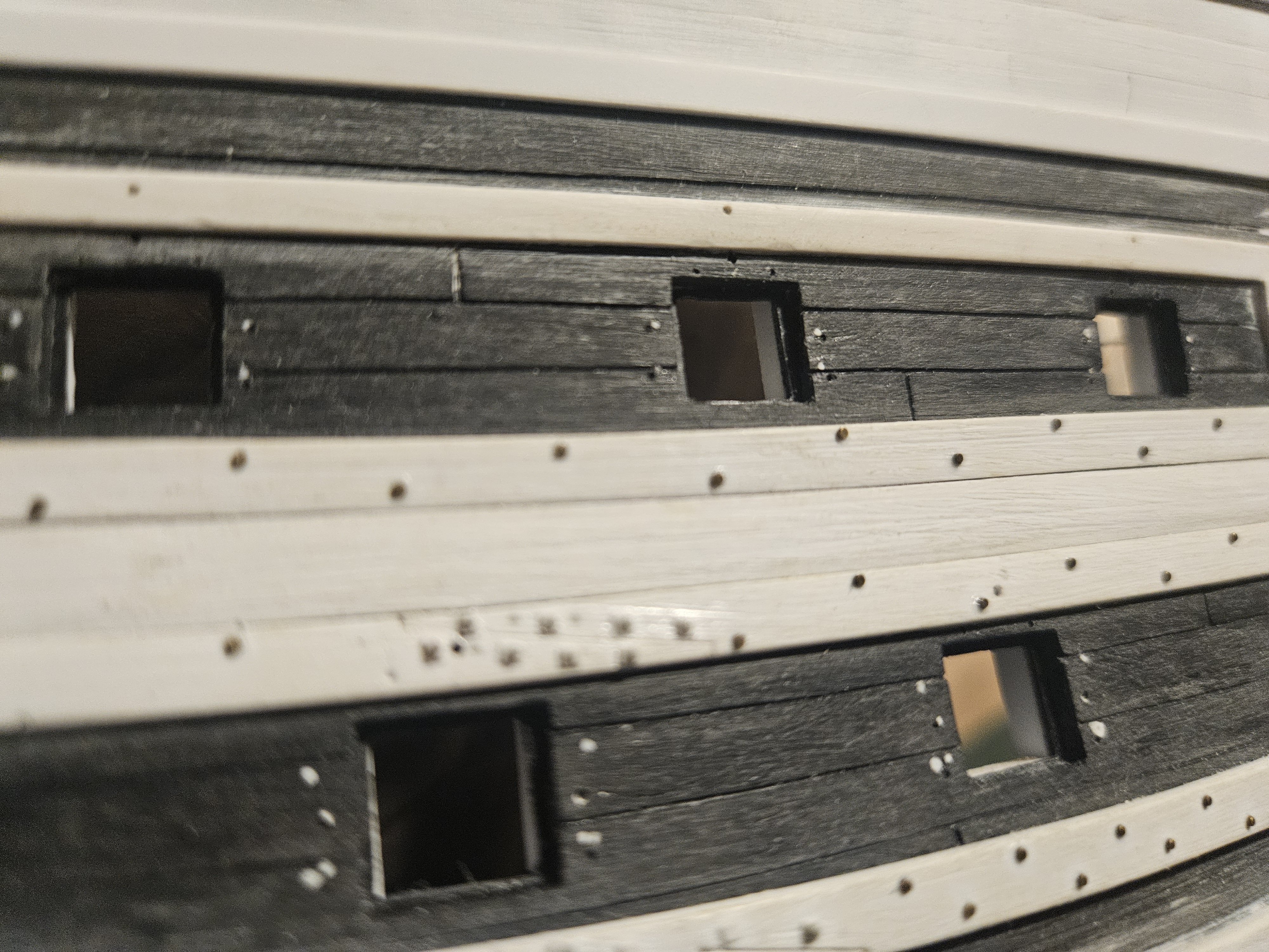

First post since I ripped off the starboard railings and timberheads three weeks ago (and the college soccer season has been very busy). I am about to wrap up the fo'c's'le timberheads and railings. The top rail is simply laid on... no glue yet. You can see the timberheads have some sanding dust on them. I should mention the nails. I have a huge surplus of tiny nails in three sizes; I used the largest nails (0.6mm diameter head) on the wales. I was browsing through Neko's Soleil Royal log, and I saw tiny nails on the railings/half-rounds (obviously they are on other wooden ship model builds as well)... and I decided that my railings would have "nails" as well, reasoning that they needed to be held in place just like the wales.
The primary reason that I ripped everything off was that my timberhead spacing was incorrect; here is the port side and you can see timberheads magically above the circular gun port holes. Ugg.
So this time around, I used the exact spacing of the Heller kit timberheads, and just clad them with framing, so that the timberhead spacing would be correct. Now, my timberheads are still 2.5mm in height with the railing on the timberheads being 2.5mm thick as well... but this time, instead of using 0.25mm stock to frame the timberheads, I used 0.5mm stock on the sides, and 0.75mm stock on the top and bottom. It seemed to me that this contributed a beefier look, a more solid look befitting a massive ship like SR 1671... at least in my vision (and the framing protrudes 0.5mm now, instead of 0.25mm on my first attempt).
I used 2mm x 2mm stock for the body of the timberheads, and then laminated 2.5mm wide strips that were 0.5mm thick on the sides. After cutting the appropriate angle, I glued a .75mm thick piece on the bottom as the base. All of my timberheads were 6mm tall and spaced exactly 5mm apart (I made a space block). After sanding the heads down to 1.75mm, I just glued a 0.75mm square on the top, and the framing was done. I made four different framing sticks, so once I got in the rhythm, they just popped right out. Now down the rest of the starboard side..... and then the port side.

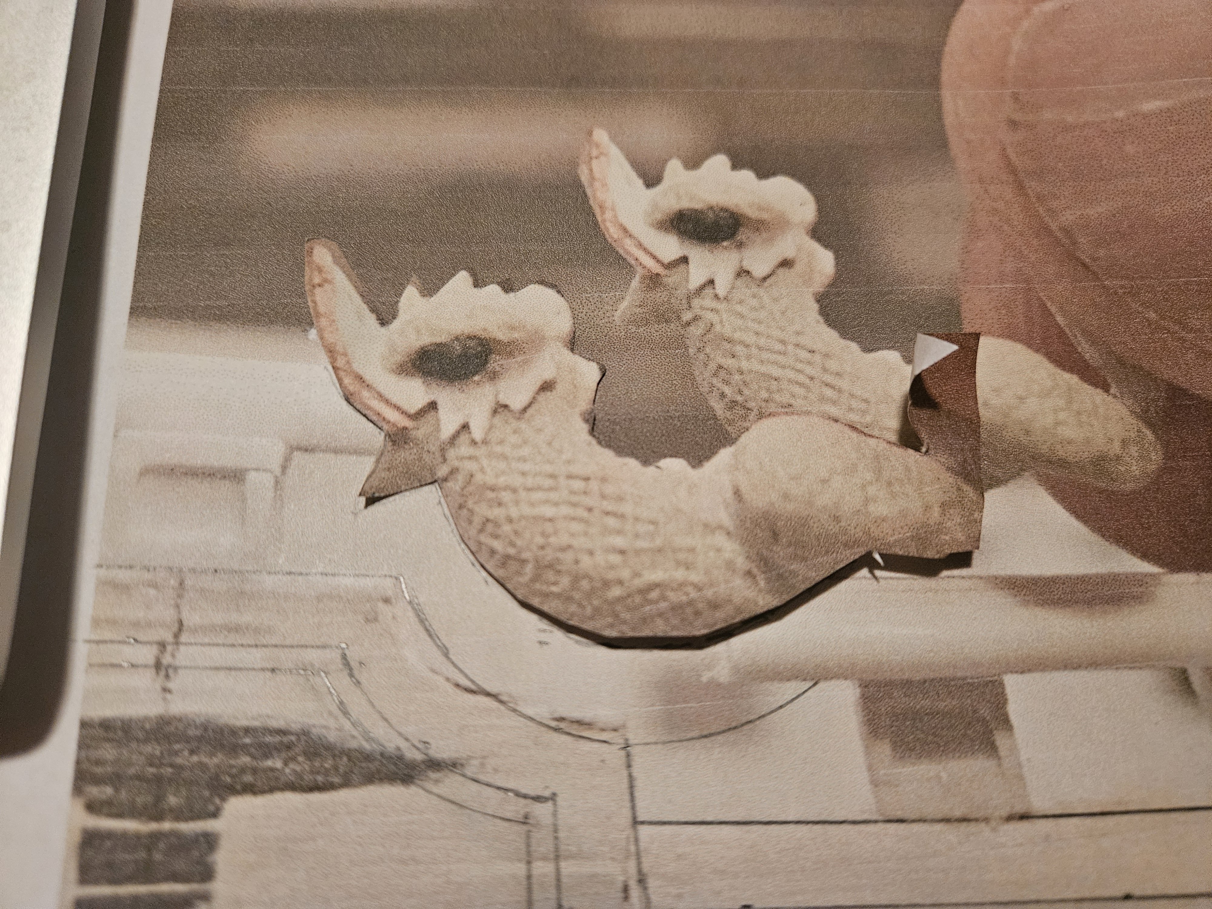

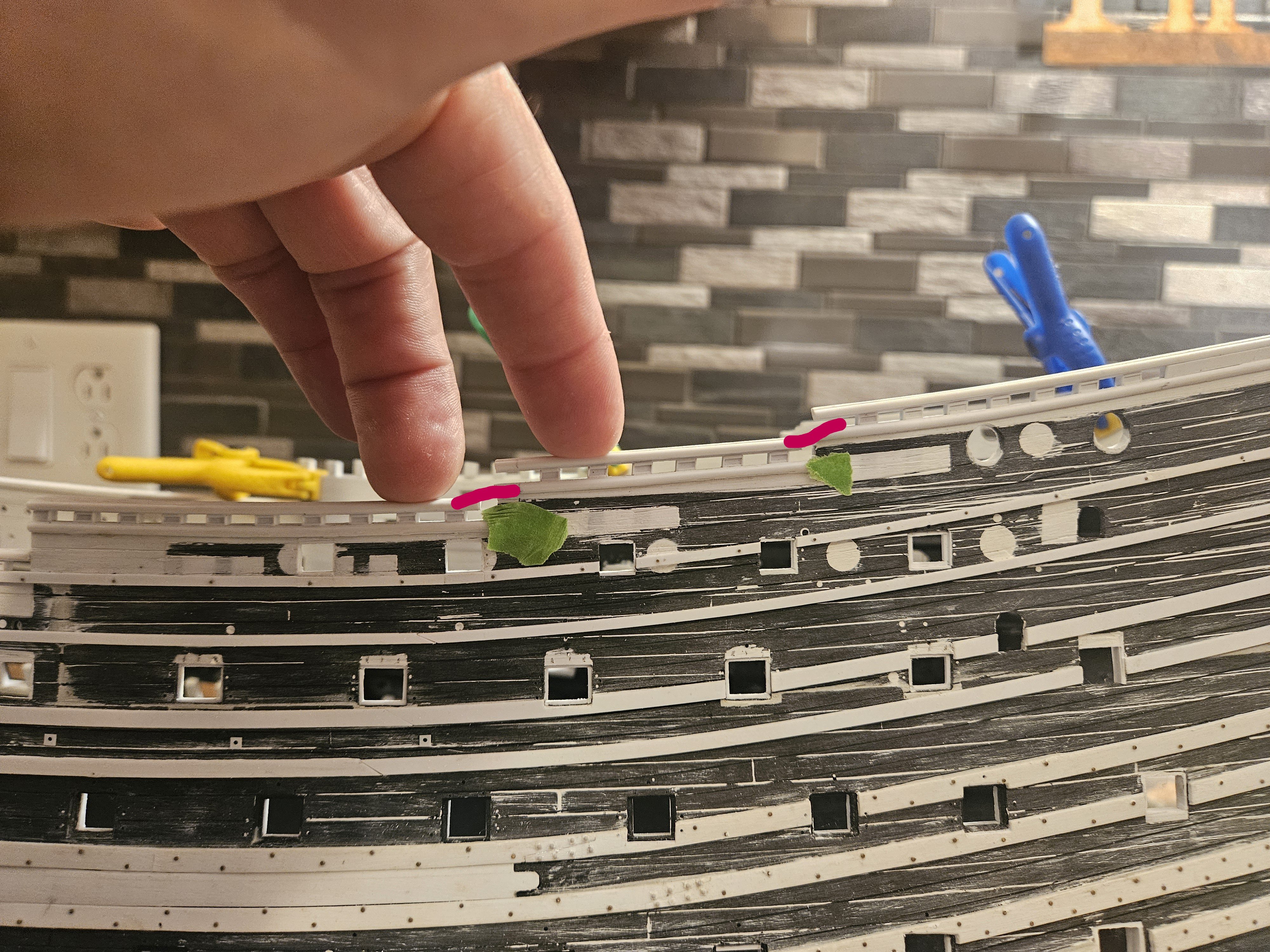

Timberheads and cap railings are going well on the port side; I reached the point where I needed to figure out exactly how the dolphin hance pieces would fit. I had some initial sketches on vellum paper, and then I thought there might be an easier way. I took a photo of the area where the dolphin hance piece would sit.
Then I made two prints of the photo, and simply cut out the dolphin body from one sheet, and that allowed me to move the paper dolphin and figure out exactly where it should go. Then I was able to get the French curves out and draw in the hance piece area....
Finally, I shrank the sketch down to the proper size, and cut out the rails, and laid them on the actual model hull to test the fit. The fit is spot on... now I can glue on the half-round drift rails that border the bottom of the timberheads and create the curved drift rail pieces that will sit under the dolphin. There is a support piece that I have sketched out on vellum paper; this piece will nestle into the concave curve in the railing and support the dolphin hance piece above it.
One unattended benefit of ripping off the timberheads and railings and starting over; I will now have the various cap rails and drift rails blend together (see the red lines on a photo of the port side with the old timberhead pattern, and the differences in level!). I had no clue when I first did the timberheads that these various rails should seamlessly flow into each other. I was prepare to run these various drift rails all the way to the transom, which would have carved up the rear bulwarks into many small zones. Marc LaGuardia (Hubac's Historian) pointed out that in reality on the First Rank ships, the French did not extend the drift rails to the transom... as, in my words, that would ruin a large "bulletin board" where the various oranaments and decor would trumpet the glories of Louis 14 and the French State.

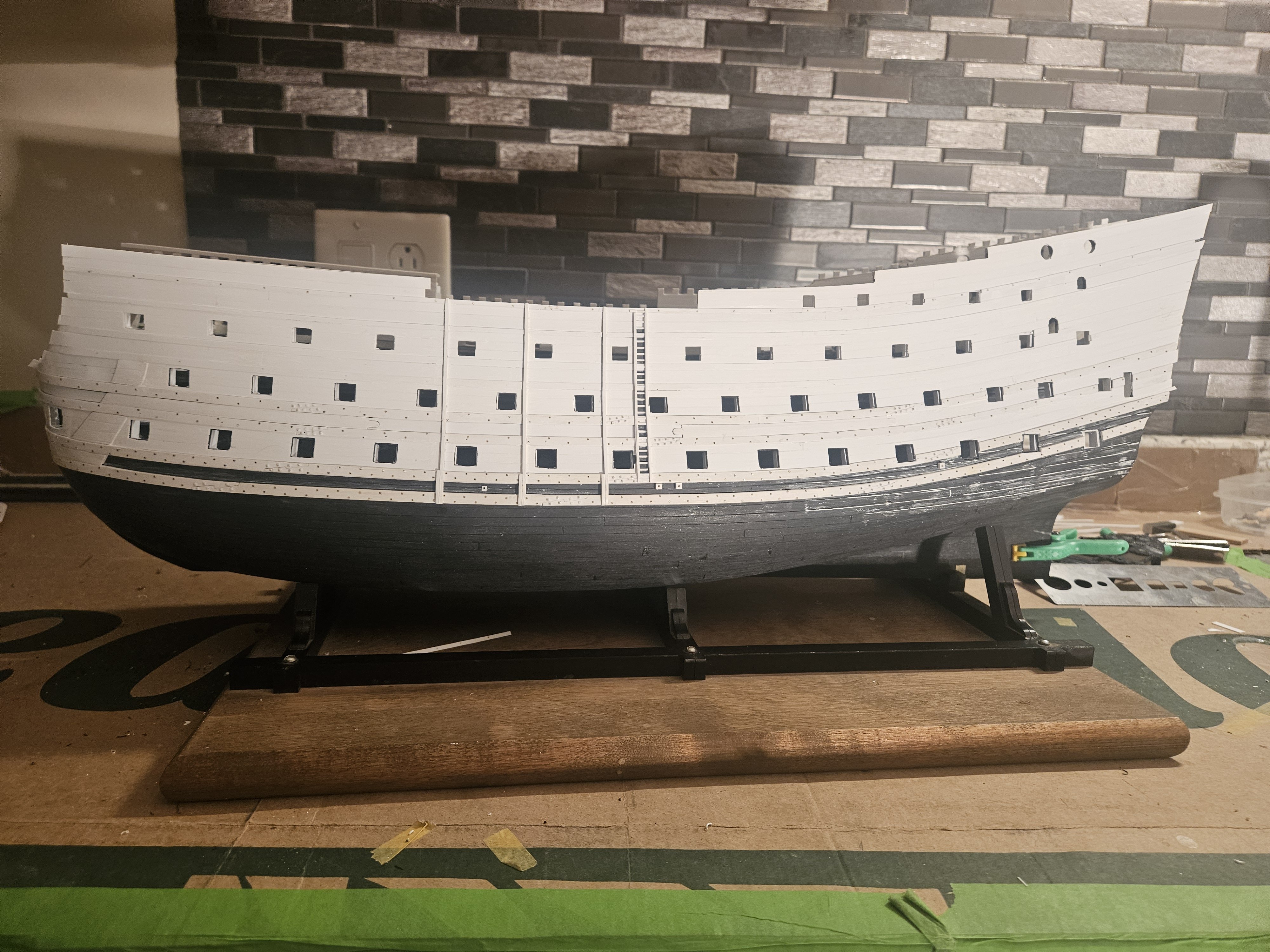

All of the starboard side timberheads are framed and I can start the addition of the railings and the dolphin hance pieces. I am happy, as I will have corrected a major flaw by now having my railings flow into each other as the aft decks rise up.

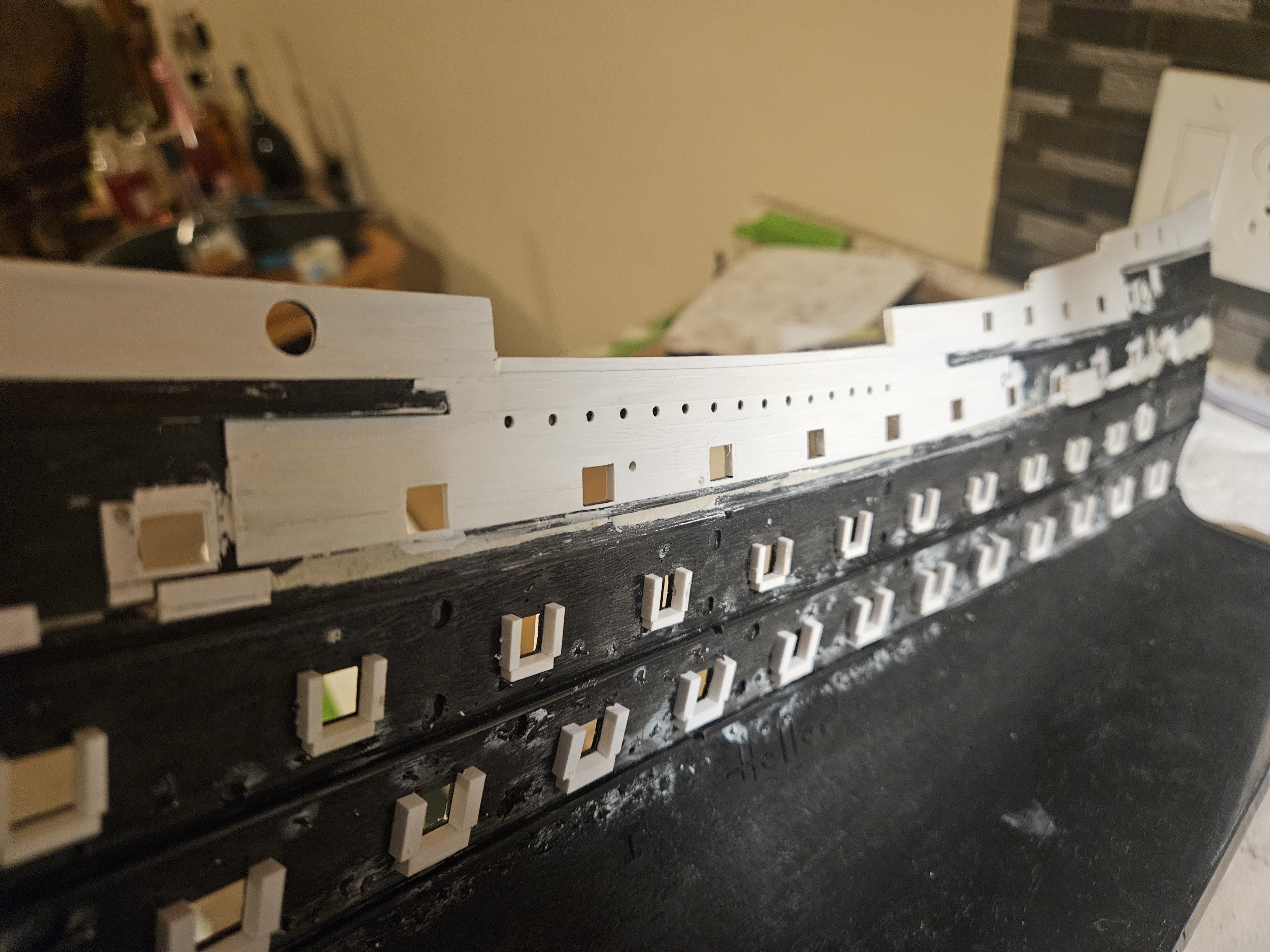

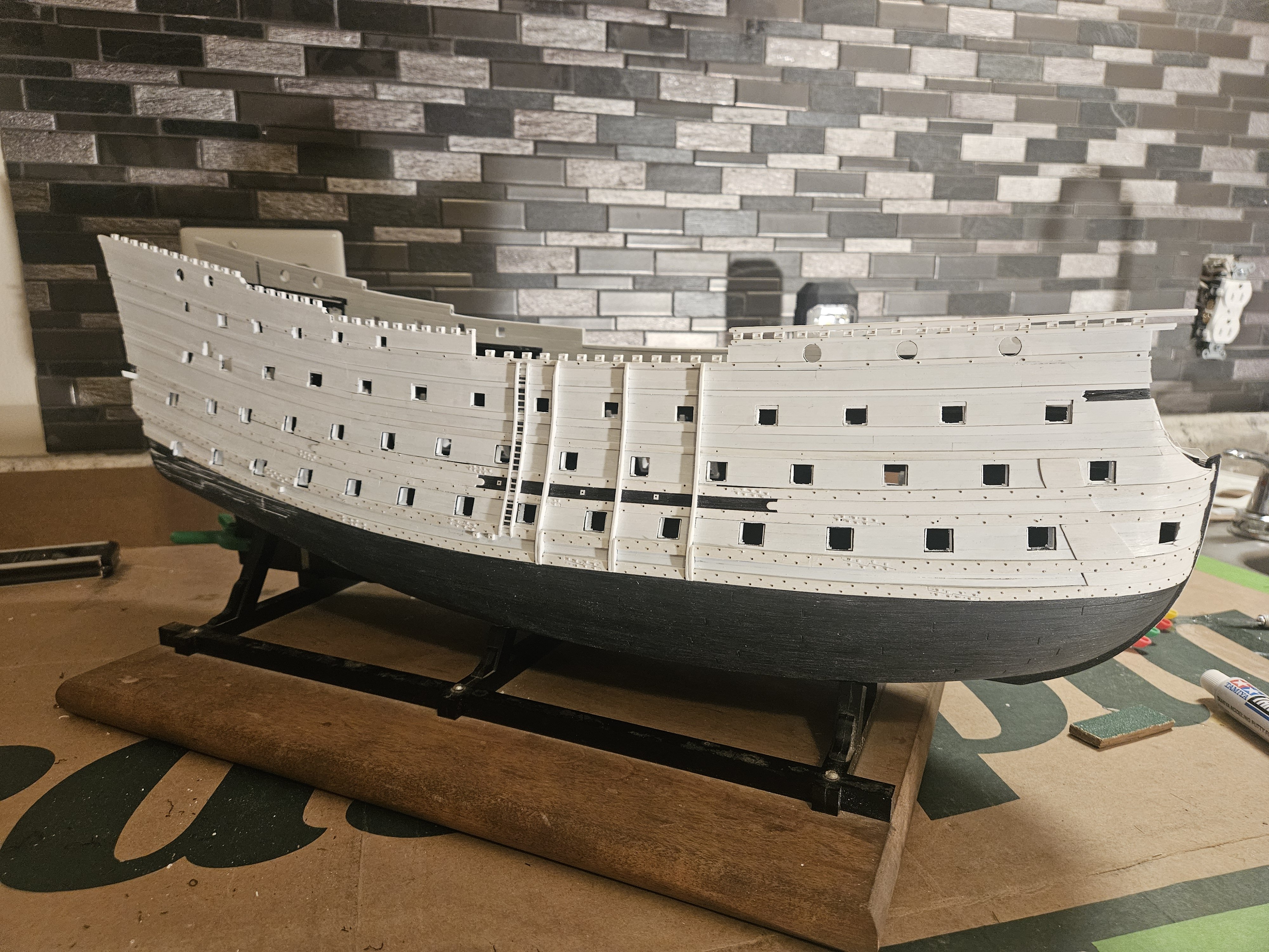

Now, you may notice that the upper portions of the hull are now cloaked in white. It started because of this, believe it or not. A "honey do" project before the snow was to construct three cedar divider screens. As I was looking at the first finished screen, with inserts keeping the boards 1/2" apart, I had a thought. I simply stacked six boards horizontally without the inserts, and walked about 30 yards away. I turned and looked, and saw some semblance of a fine line between the boards, but if the stain and wood grain were similar, I couldn;t see the gap at all.

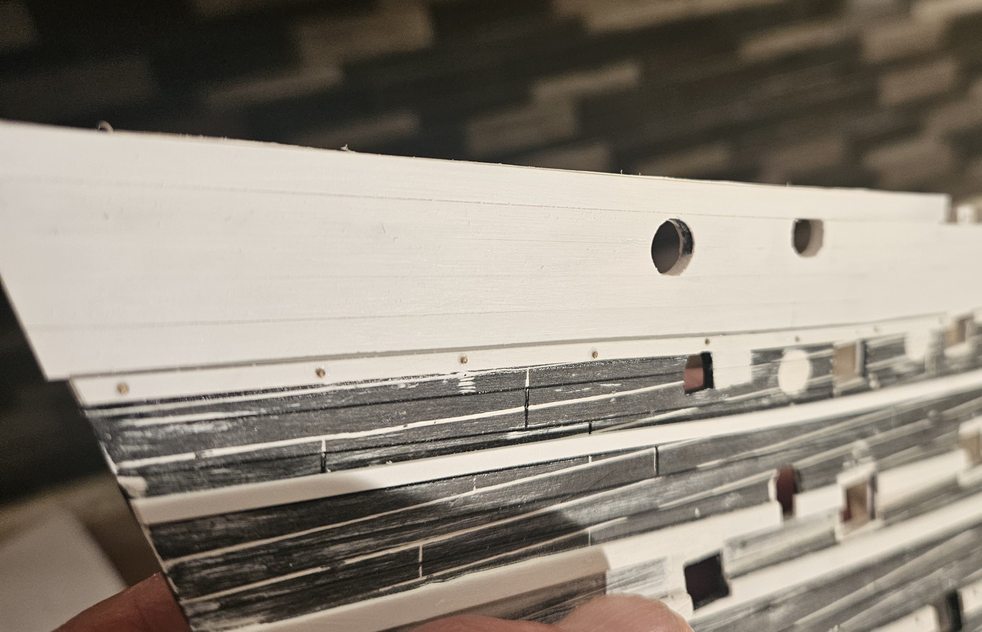

Hmm.... I looked at my hull, and fixated on the deep scribe marks that I had made; as my wales swooped up, especially at the stern, I had to (re) scribe matching planks to follow the wales... and now those scribes looked like the Grand Canyon to me. I clearly had broken the cardinal rule of "scale".... and that bugged me. In addition, I had a crazy plank outline scribed in from over a year ago, before I realized that the number of planks between the wales was always a whole number, say 2 planks and not 1 1/2 planks. Grrr....
Well, what could I do about it? I grabbed a ruler and measured the gaps between the wales and the drift rails, and realized that somehow I had essentially spaced them on multiples of 4mm apart. And 4mm is the width of the Heller kit plank lines, as well as the plank lines I scribed in. Hmmmmmm. There would be no destruction required here.... and I looked at all of the various scars that I had inflicted on the hull... what would replanking the upper part of the rear bulwark harm? It was going to be covered with decorations anyway... and in about 20 minutes, after using 4mm wide planks by 0.25mm thick...
I immediately liked the much tighter look of the plank seams... I won't even bother to scribe them, as in some areas you can see the plank seams, and some areas they practically disappear. So after about three hours of work since last night, I have essentially finished the upper three tiers. Again, no destruction, and easy enough to install the strips.. sometimes they require a very light sanding for a perfect fit.
This is absolutely what I should have down in the first place after I sanded off the old wales and installed new ones. To create/scribe new plank lines, I first had to fill the old plank lines in with Tamiya putty, and then laboriously scribe in the new lines... and make some occasional gouges and scratches. Laying down new planks is so much faster, easier, and cleaner. Yes, I will have to go back and drill a bunch of holes for the gun port tackle, the gun port lid ropes, etc., but I have jigs made for those already. Now, I will have to trim out some gun port openings, but with 0.25mm thick stock, that is very fasy and clean. In fact it is easier to simply apply long strips and cover over the gun port openings instead of precisely trimming pieces to fit between the many gun ports. So I am going to plank down all of the way to the lowermost wale... below that is the water-line and the white stuff, so NO need to do the lower hull.
So there it is - I am much happer with the appearance, and again... I should have done this right away!
Starboard planking is finished (note the one center area between the middles wales didn't require planking). Fairly straightfoward and easy, but there were a few finicky pieces that required some shaping by sanding. The planks cover a multitude of... mistakes/"learning experiences" that were incurred over the last two years as I changed direction on several occasions.
I then made a thin wash of Tamiya putty and laquer thinner (almost like Elmer's white glue) that I brushed on all of the seams and little crevices... there are several larger gaps, usually between a plank and a wale, that I will have to fill with tiny strips of polystyrene. For example, directly below the brush. However, these will be very easy to fill in and correct.
Then I used a 4mm wide block (to match the width of the planks) with 150 grit sandpaper adhere to it. This smoothed all of the seams and planks.
This generated a lot of dust, so a bath with soap and warm water was needed. After drying, I willbegin to cut out the gun ports.

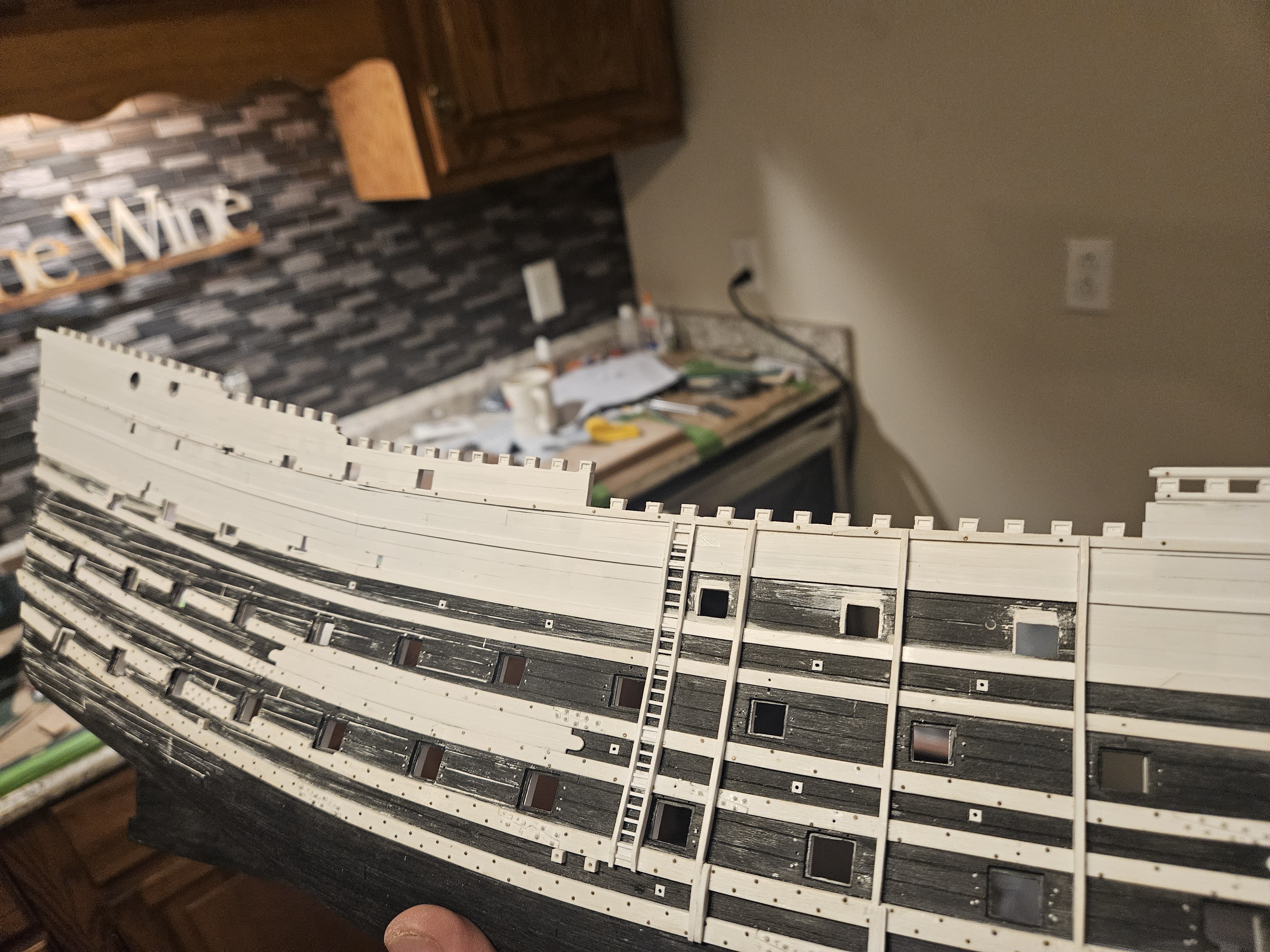

Finally.. just the planking and timberheads to finish on the port side. My goal has been to get the hull halves ready for painting by early January, which is coincidentally when I am having surgery that will basically leave me with one hand for three weeks (no idea if I will even be able to work on SR during that period)!
I should mention that I resized all of the upper deck gun ports on both hull halves, as they were too large. The lower and middle deck gun ports are spot on for the gun port size "rule", that the gun port width is 6.5X the diameter of the cannon ball that gun port cannon fired, and the height is 6X the diameter. For some unknown reason, I made the upper deck gun ports much too large.
I did have one other.. detour... the last two weeks. Since I had to redo the upper gun deck gun port linings, I did some research on gun ports and gun port linings. I noticed this type of gun port lining on Andre Kudin's Fleuron (1729) build. I saw this type of lining on several other models, but it does seem the majority of models have a lining on all four sides of the gun port. I can't determine if the linings Kudin created on his Fleuron are period specific, or nation specific, for that matter.
Screenshot_20251201_070652_YouTube.thumb.jpg.75730fc57d6b58ab2ba0d6da5821ea61.thumb.jpg.8f7df6440688a8af697b3902ca396ba9.jpg
But I really liked the look and decided to incorporate his approach on my SR 1671. So, after scraping/sanding all of the kit linings on the 78 gun ports with lids, I installed the "Kudin linings". Now on to planking, and then the timberheads and railings.
Edited by EricWiberg

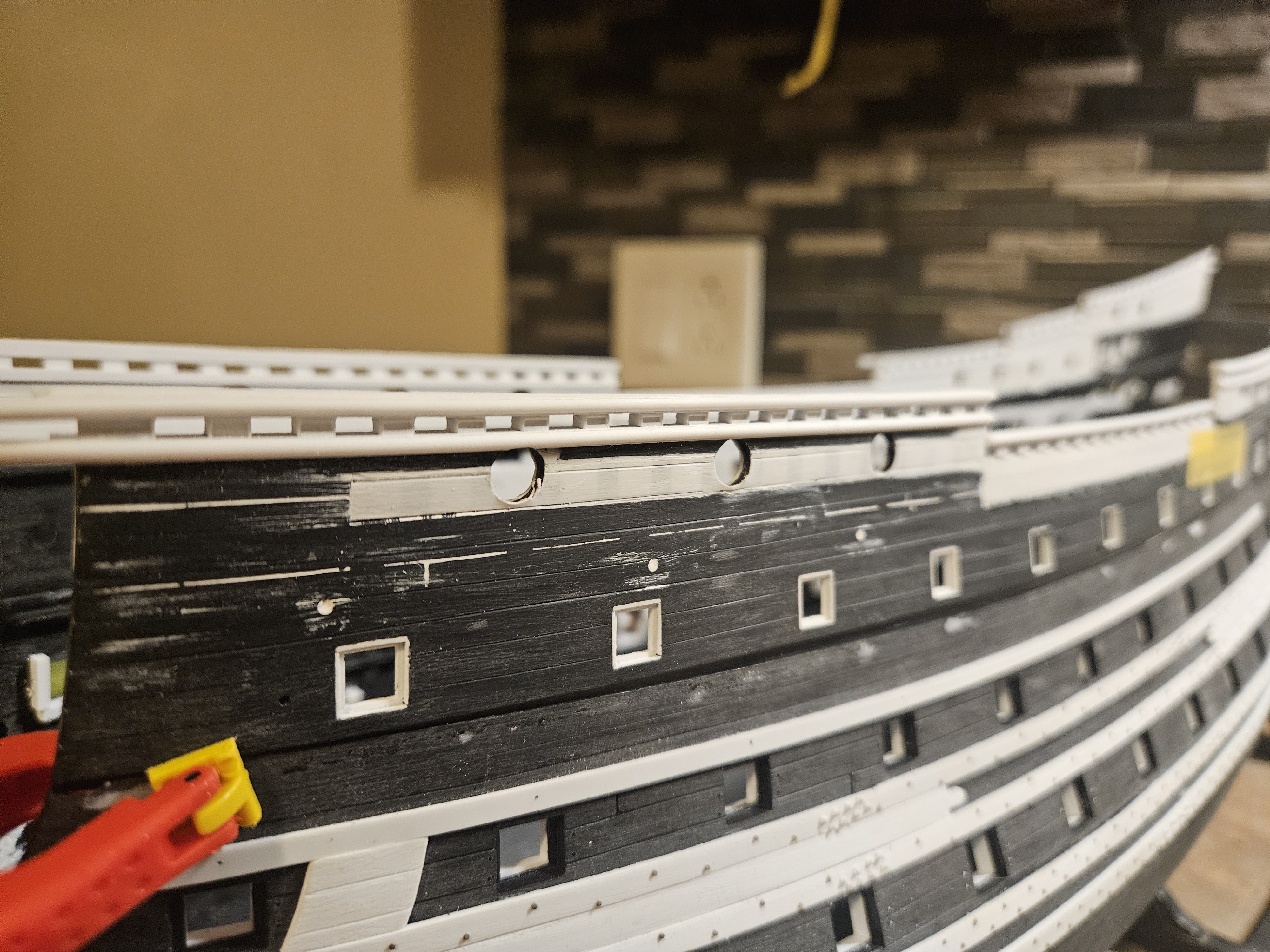

The planking is done on both starboard and port sides. I am starting the timberheads/cap railings on the port side, and install the cap railings on the starboard side. After that, there will be only some general cleanup left, prettying up gun port framing, making sure all of my holes are drilled, etc.. My goal was to get all of this work done before my surgery in eary January, as I really won't have a left arm for a few weeks! But that time period will allow me to to completely focus on my Quarter Gallery design.
I am happy that I planked both sides with 4mm wide X 0.25mm thick strips; as I mentioned earlier, after I fabricated wales that sweep up at the stern circa 1671, I scribed in new plank lines to match the wales, and those lines were way too agressive. In addition, I covered up the Frankstein mess of tiny holes that I had drilled - and then redrilled! - as my scope has changed over the last eighteen months.
I also carved out an access door to the "seat of ease" located on the middle gun deck level in the QG (thank you Marc LaGuardia for your thoughts on Quarter Gallery design!). I had difficulty finding period sketches that display such an access door, but my assumption is the door wouldn't need to be as wide as other doors on the ship, as this would strictly be a one man operation that a person could turn sideways though a 2 foot wide opening, and it would likely have a curtain hanging on the door, as opposed to a solid, swinging door (if I am wrong on that, it will be very easy to add a door).
