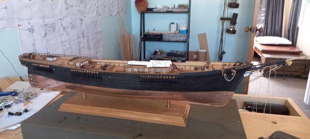

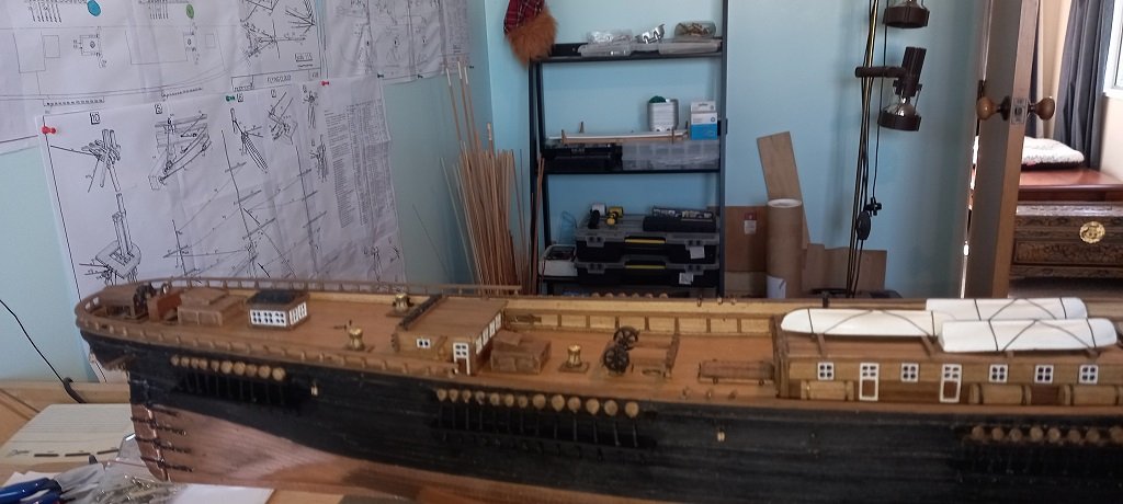

Hi All,
Lower Channel update....
I began by pinning the Fore Lower Channels to the Hull, easy enough.
I then decided to make s Mock-Up, (Prototype), the Channels to fit the Chainplates. (I had already drawn this out....)
As per my Drawing, the Chainplates were too short, esp. the Backstay Chainplates.
Regarding the Backstay Chainplate with respect to the Lower Channels, the slot that I would have to cut in the Lower Channel to accept the Chainplate would leave about 1.5mm thickness where the Channel meets the Hull, far too thin.
The kit utilizes a 2.0mm thick strip mounted on the Lower Rub Rail to simulate the Lower Channels.
I now have to choose the way forward:
  • Not really keen to construct/replace the Chainplates
  • Lower Channels are not designed for this kit
  • Not 100% accurate to leave Lower Channels off
  • Photo, (On Box), looks just fine without Lower Channels
  • Pushing ahead with Lower Channels risks breakages
  • KISS - Keep It Simple Stupid
Finally, what am I building this for? It is something that I enjoy, not a gift or presentation.
My decision to omit the Lower Channels may upset some who are following this thread but that's just the way it is, constraints of the kit, engineering/design do not allow for modification.
So, in conclusion, this model will be "Devoid" of Lower Channels
I have tried and prototyped to install these items; I have to admit a small defeat....
With this attempt out of the way, I can concentrate on mounting/positioning Chainplates with only Upper Channels.
In saying all of the Above, I will most probably install a 1.0mm strip on the lower Rub Rail where the Channel would have been, this will assist in Marking and positioning individual Chainplates and will be more in keeping to the kit design.
Onward!! Many more challenges ahead.... 🙂
Cheers....HOF.

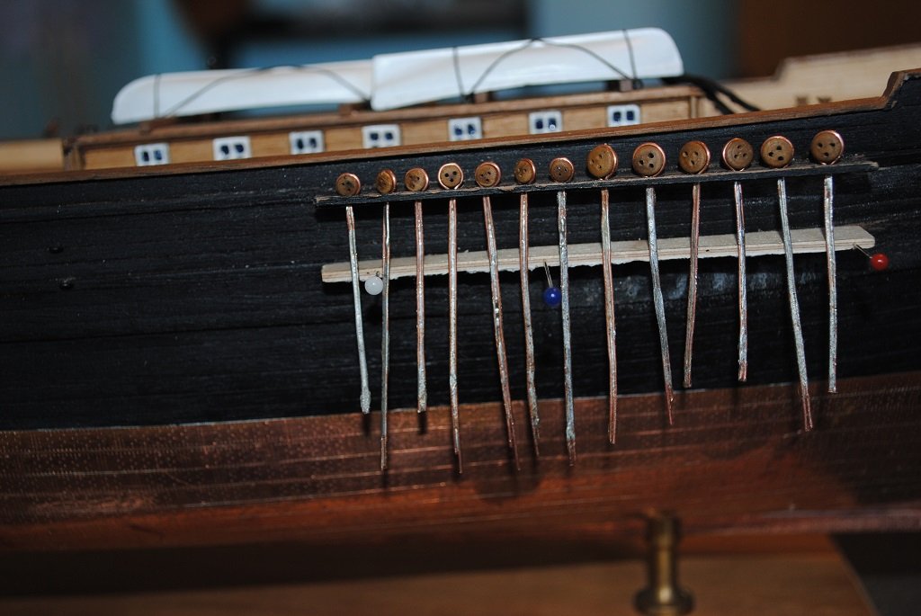

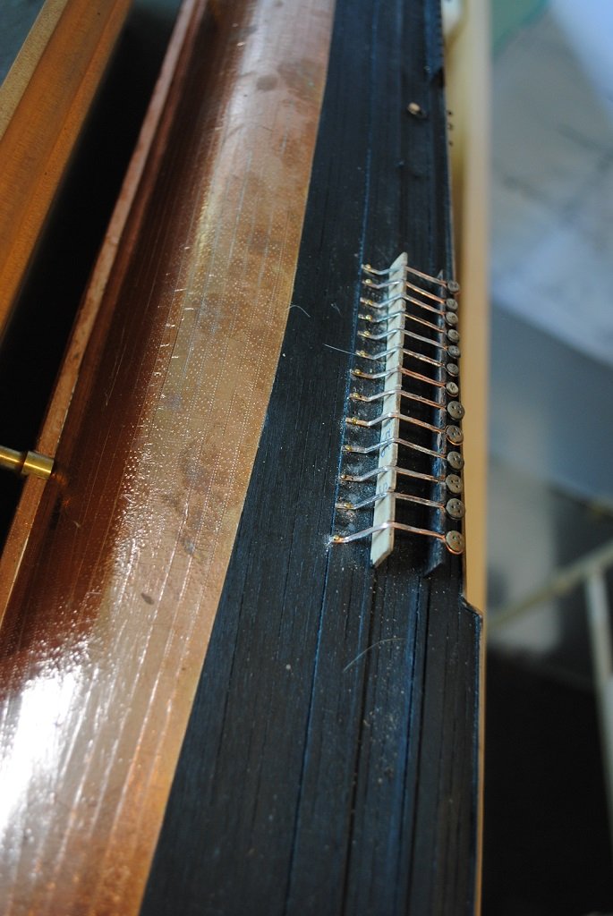

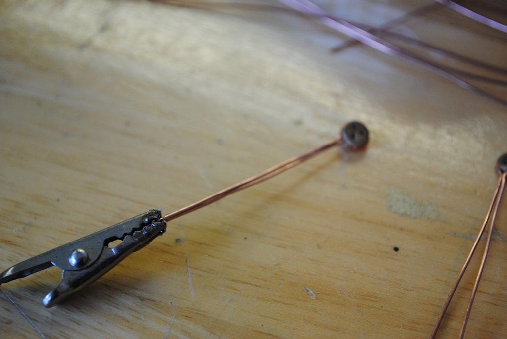

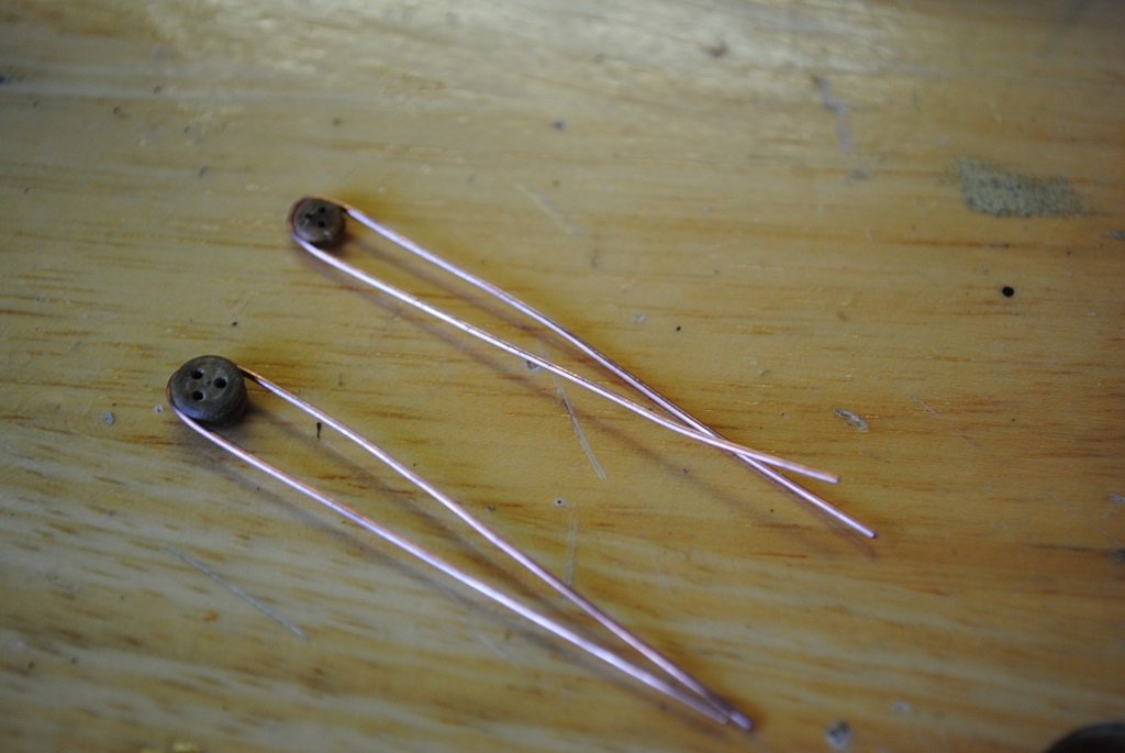

Hi Rick, Et All,
I have taken a few photos to hopefully illustrate the method to the madness.... 🙂
At this time, I am concentrating on manufacture of the Chainplates and have not as yet "Notched" the lower Channels, nor have I Blackened/Filed/Drilled/Tweaked the Chainplates, so, you will have to imagine them fixed in place under the Lower Channel.
Yes, the Chainplates are long at the mo., this will give me something to hold while "Manipulating."
A big advantage, the Deadeyes sit "Flat" on the Channel, no nasty gap and in line.
The method seems to work, a bit of time but very cheap, the wire was harvested from a bit of heavy electrical flex that I have in my Garage.
The solder is 3% Silver, 1% Copper and 96% Tin with a "No Clean" Flux Paste. (I just have to be careful not to "Flame" the Deadeye. 🙂)
Cheers.... HOF.

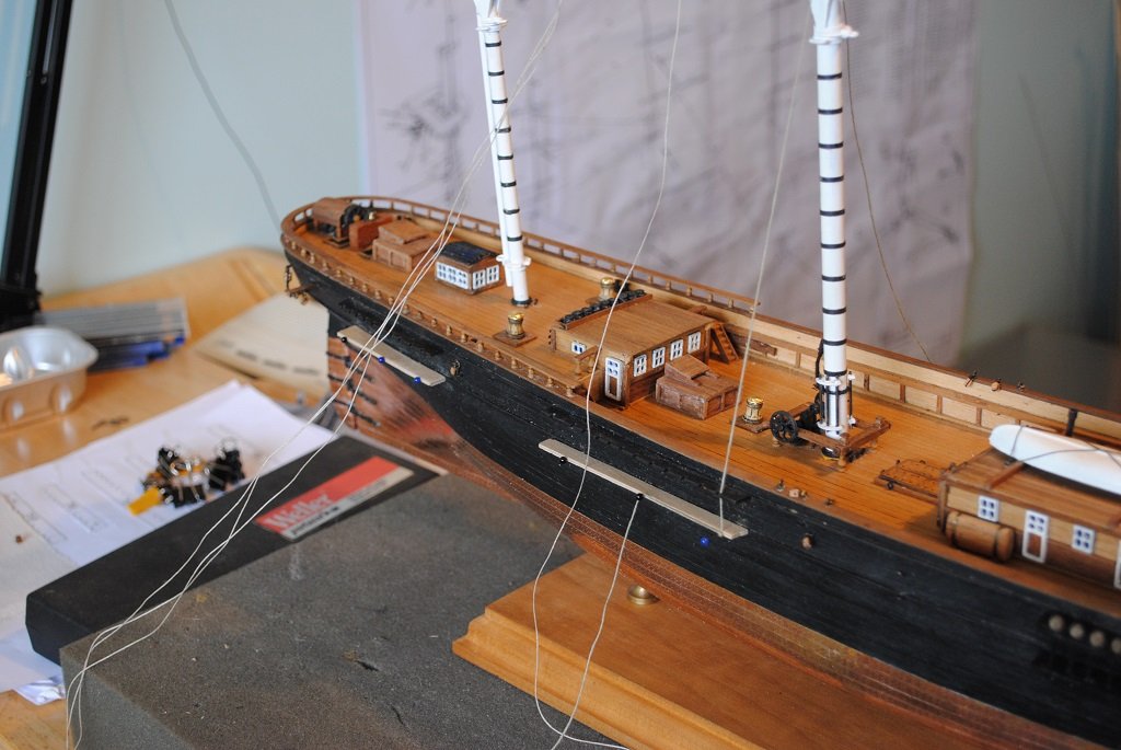

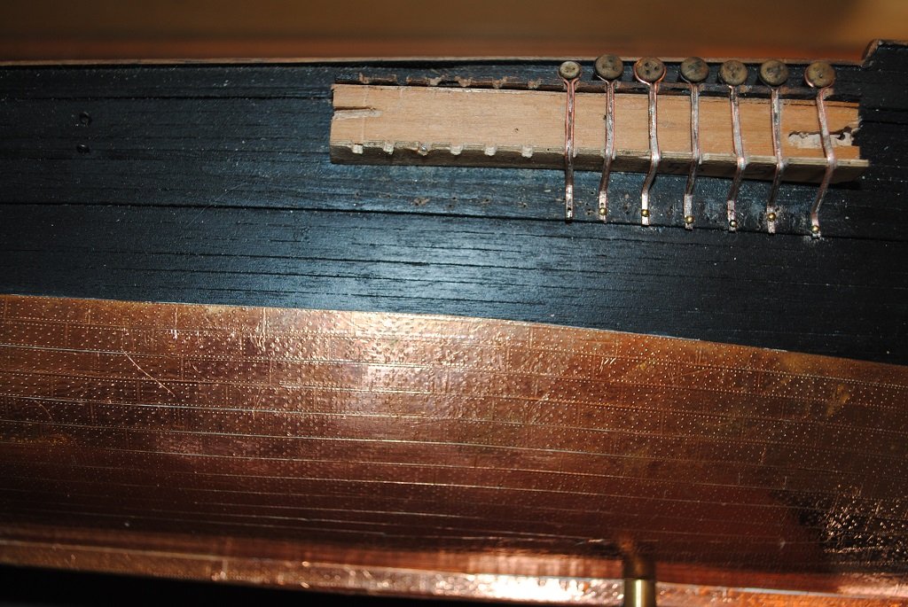

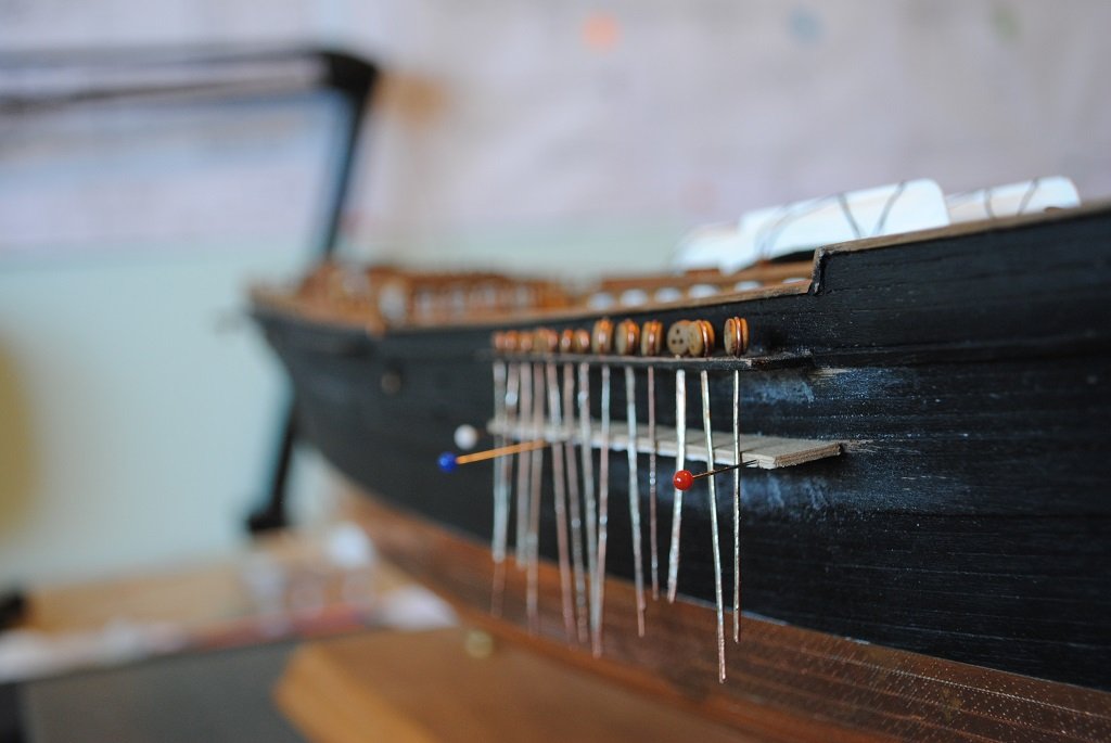

Hi All,
Small update:
Starboard Fore Channels/Chainplates, (Raw), Pinned in place.
A bit of a learning process for me. (I may redo these, well probably.... 🙂)
Some takeouts:
  • Lower Channel needs at least 3 pins along its length
  • Slots for Chainplates need to be a tad deeper
  • Spacer required between Channels to prevent bowing as Chainplates are installed
  • Need a more accurate drilling/cutting method for Chainplates
I need to make up some more Chainplates before having a go at the Fore Port side.
Anyway, enough for the mo.
Cheers.... HOF.

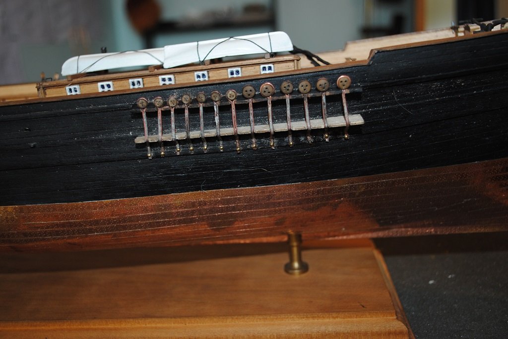

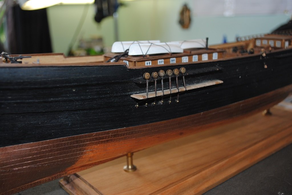

Hi All,
Another Channel/Chainplate update I am afraid.
Started last night with the Port side utilizing my Channel "Spacer."
So, with a modicum of success, this morning, I decided to de-construct the Starboard side.
An additional pin in the center of the Lower Channel fixed the "Bowing" issue.
Spacer inserted, Chainplates were rescued where possible, bent and pinned to the Hull. (I only had to make two additional Chainplates. 🙂)
I also made a very simple Jig for the initial bend for the Lower Channel. I decided on an angle of 18' At least all Chainplates are now more consistent.
I am now a bit happier with the Starboard side. Once Channel Caps are fitted and all painted it should look the part....
Tomorrow, I'll finish the Port Side, Fore Chainplates and have a think about attaching Channel Cap-strips. (1.5 X 1.5mm Walnut)
Cheers....HOF.

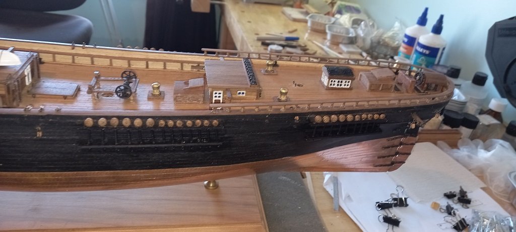

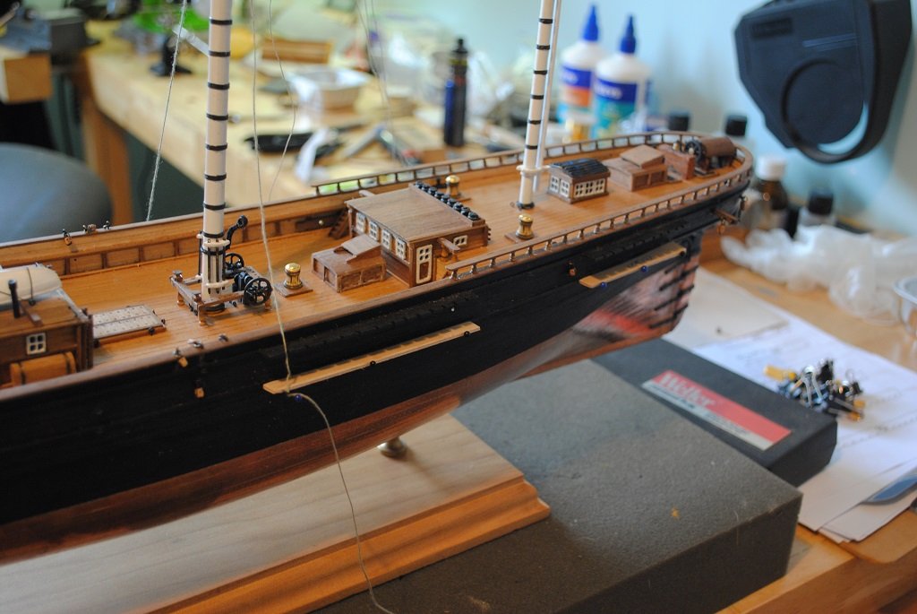

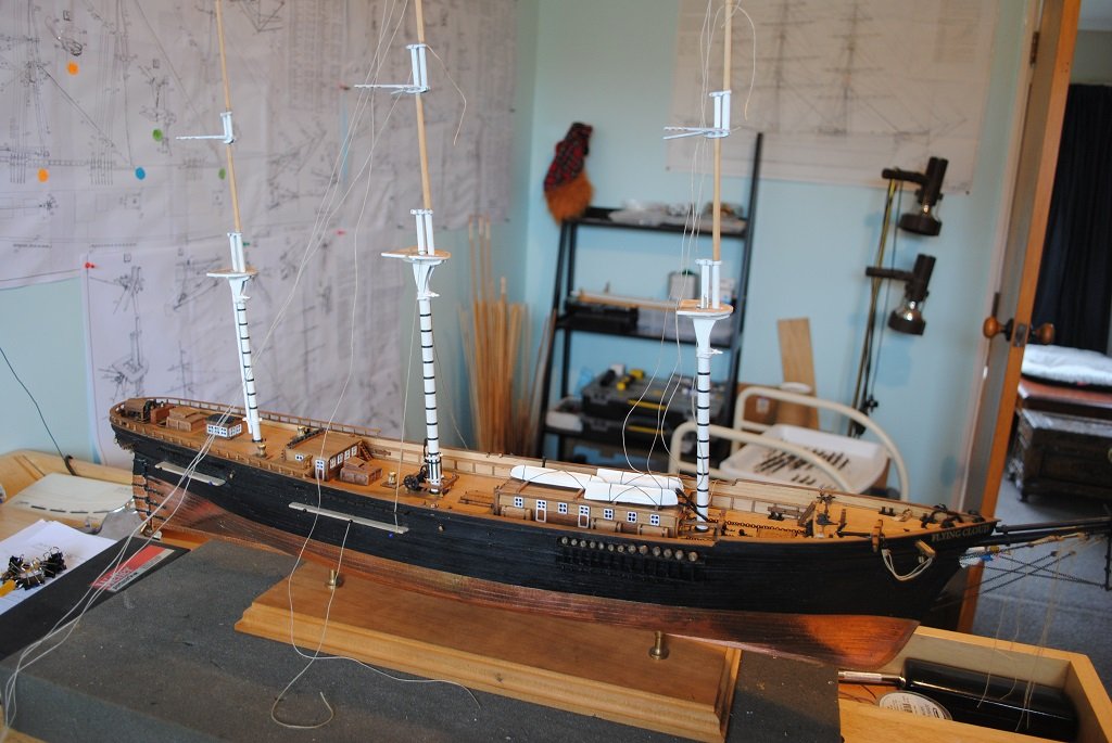

Hi All,
Fore Channels complete?
(Maybe a paint touch-up here and there.)
So, now I have done the Fore Channels, I feel a little more confident that I have an idea of what I want to achieve.
The only take-away from this assembly is that I won't be using "Blackening" solution, it stained the Deadeyes a bit, paint is better for these, the Blackening does not like the solder, and the Deadeye Strop is gaining a good patina after a few days anyway.
I guess I am o.k. with my work thus far. Next will be the Main Channels/Chainplates and I have been busy making a bunch of Chainplates. (Low impact work 🙂)
You'll have to excuse my grubby fingerprints on the Plating; I'll polish the Hull once I have completed Channel/Chainplate works. 🙂
As Rick310 stated, the Chainplates blend in, yup, they do. Only the Camera Flash picks them out.
That's me for the mo.
Cheers.... HOF.
