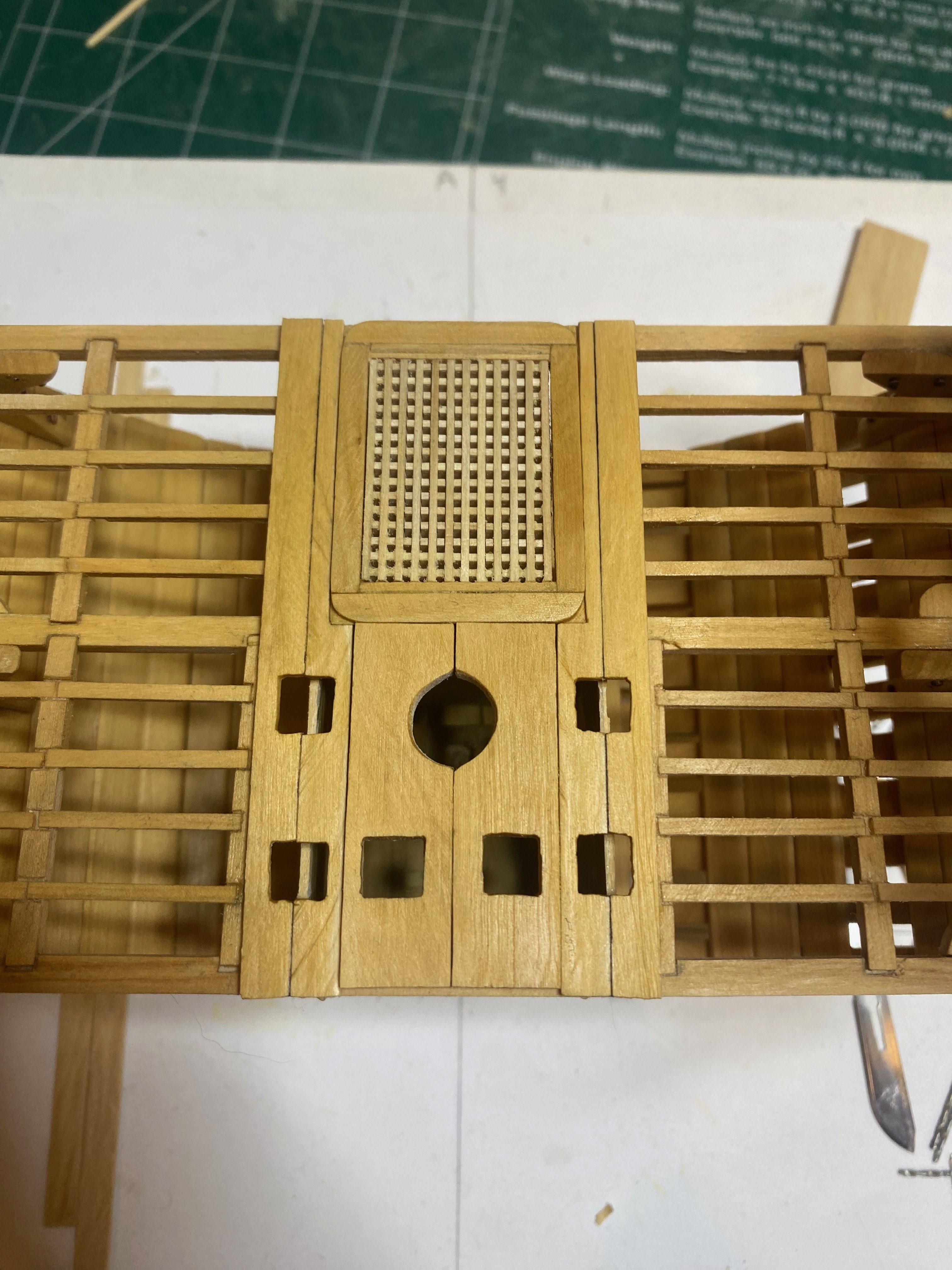

After spending a week looking at the lower hatch, I found myself becoming increasingly dissatisfied with it. So today I rebuilt it. The most difficult part of this was prying the old one off the model - I used a micro saw for this and worked very slowly and gently until it came loose. Sanding down the deck framing and re-applying some wipe-on poly made it look fine - a couple of blemishes, but these are hidden by the hatch itself, so not a big deal. The blanks for the partners are obviously just dry fit for now - lots of work to do on those before they're ready to be installed!
It's still not perfect, but I think it looks much cleaner than the last one. I had intended to spend today milling the pump shafts, making a mast dummy and starting work on the lower mast partners, but that now is put off to a later time.....

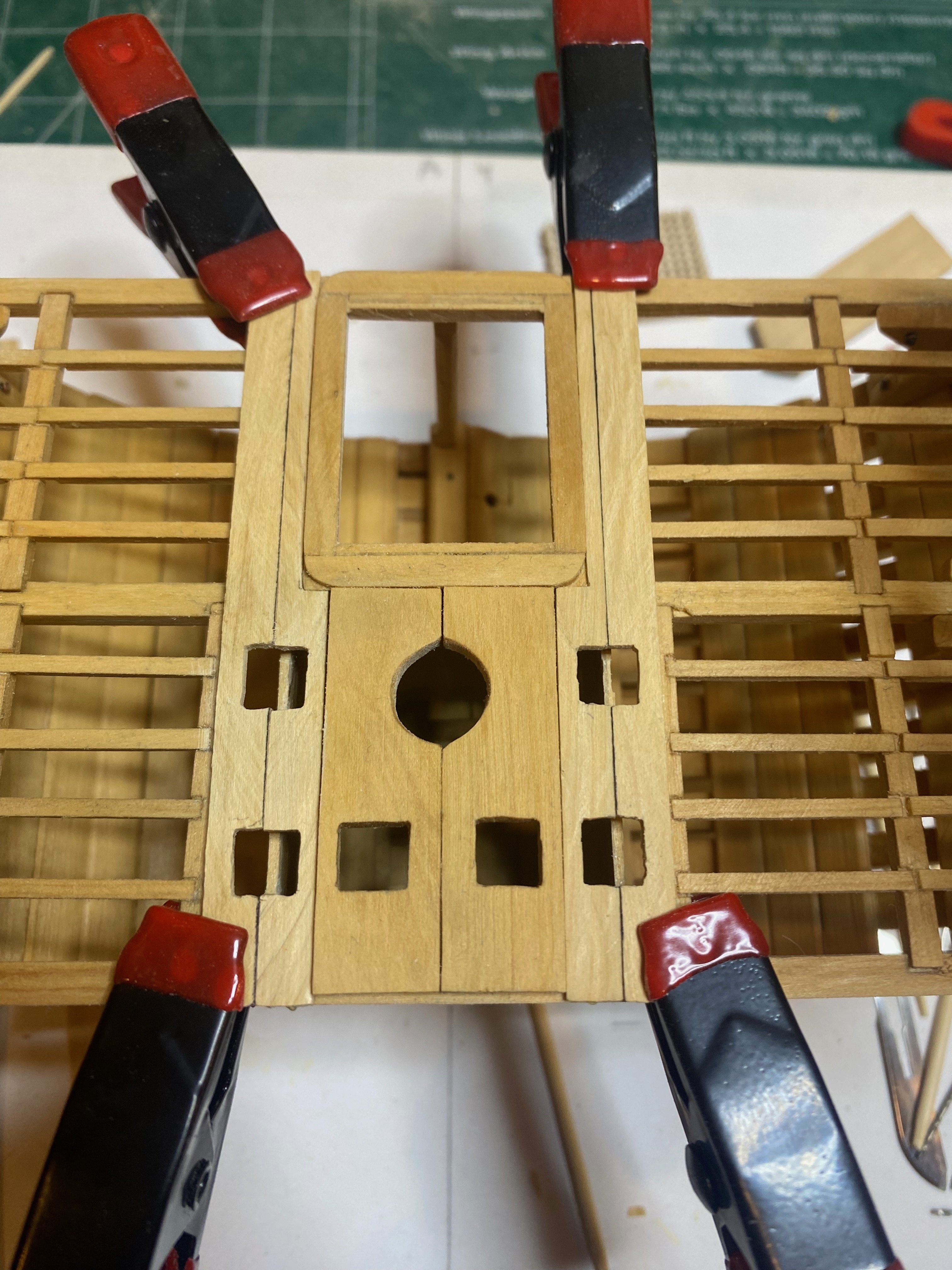

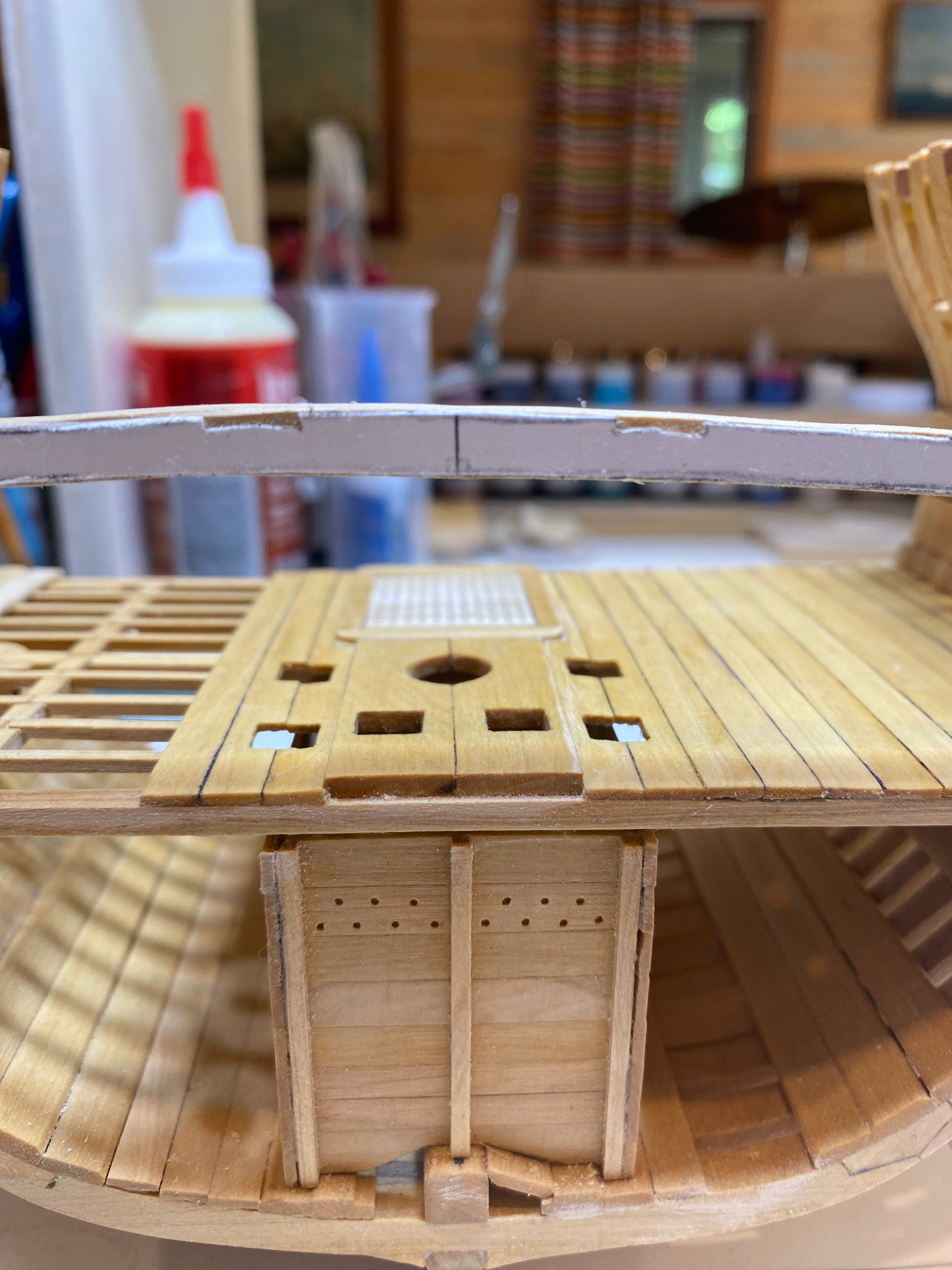

Well it's been way longer than I had hoped, but work has been busier than usual and so I haven't been able to clock any time in the workshop until today. The morning saw the completion of the lower deck mast partners. This involved first cutting a dowel to serve as a blank for the main mast, cutting a tenon into the lower part to fit into the step and then dry fitting that to get the position of the mast hole in the partners. I used a combination of round and half-round files as well as the dremel tool for finishing. The hole is not entirely even, but this will not be very visible in the end, so I'm not too concerned.
Marking, drilling and filing out the square holes for the chain pump shafts followed a similar process. I already milled a bunch of 11" square stock for the pump shafts and, using two of these, I marked them out on the partners. Small holes were drilled on the drill press and then widened and squared using an assortment of files.
The partners were then installed permanently on the deck framing. Next step will be to make the lower deck waterways and spirketing planks, and then lay the deck planking. I'll fully plank the port side and leave part of the deck framing exposed to starboard. During the planking, I'll also have to consider the run of the return shafts of the chain pumps....but that's for later. In the meantime, here are some photos. Enjoy and happy modelling

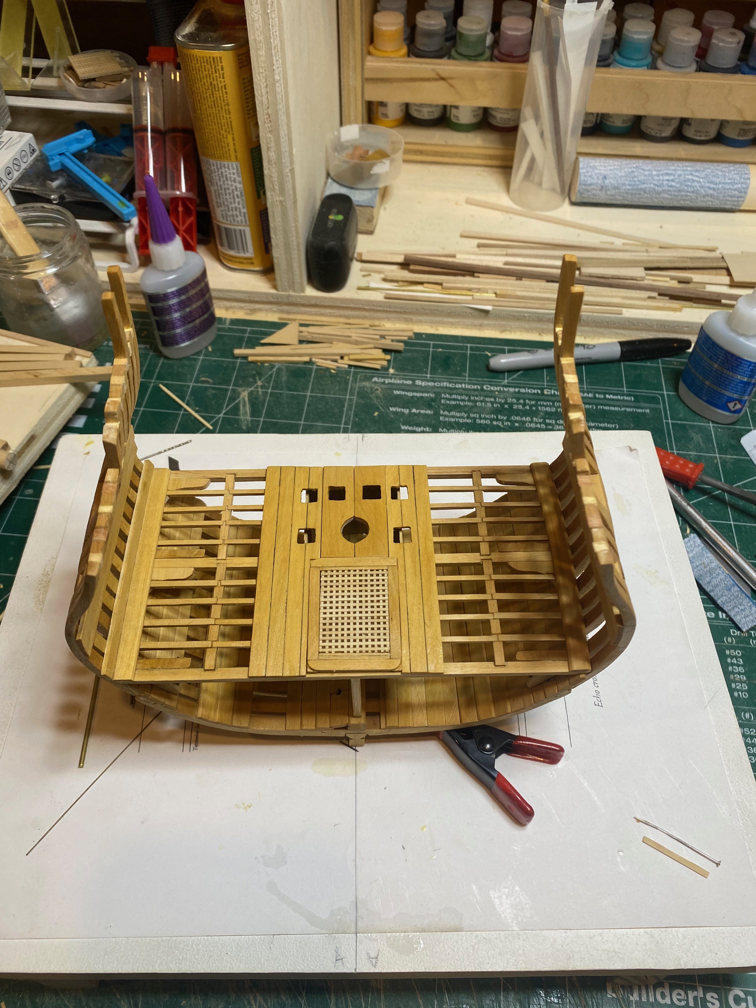

Managed to get a few more hours in the workshop this afternoon and made/installed the lower deck waterways. These were relatively straightforward, though I had to take time to mill a 3" sheet of boxwood. I then discovered that there is a bit of asymmetry in the frames, as there is a noticeable wasting aft on the port side but this is more subtle on the starboard side - this means that the port side waterway is slightly curved in shape while the starboard side is more or less straight.....this is teaching me a lesson for the next time I try something like this.
In any case the waterways were chamfered on the outboards lower edge to fit nicely against the frames, as well as on the outboard upper edge to fit the spirketing (which is next up on the list). The plans show them reducing to 2" to meet the deck planking - I simplified this by chamfering off the inboard upper corner at as oblique an angle as I dared - not perfect and not reflective of actual practice, but.....I'm keeping a list of things that I need to work on more rigorously next time.....

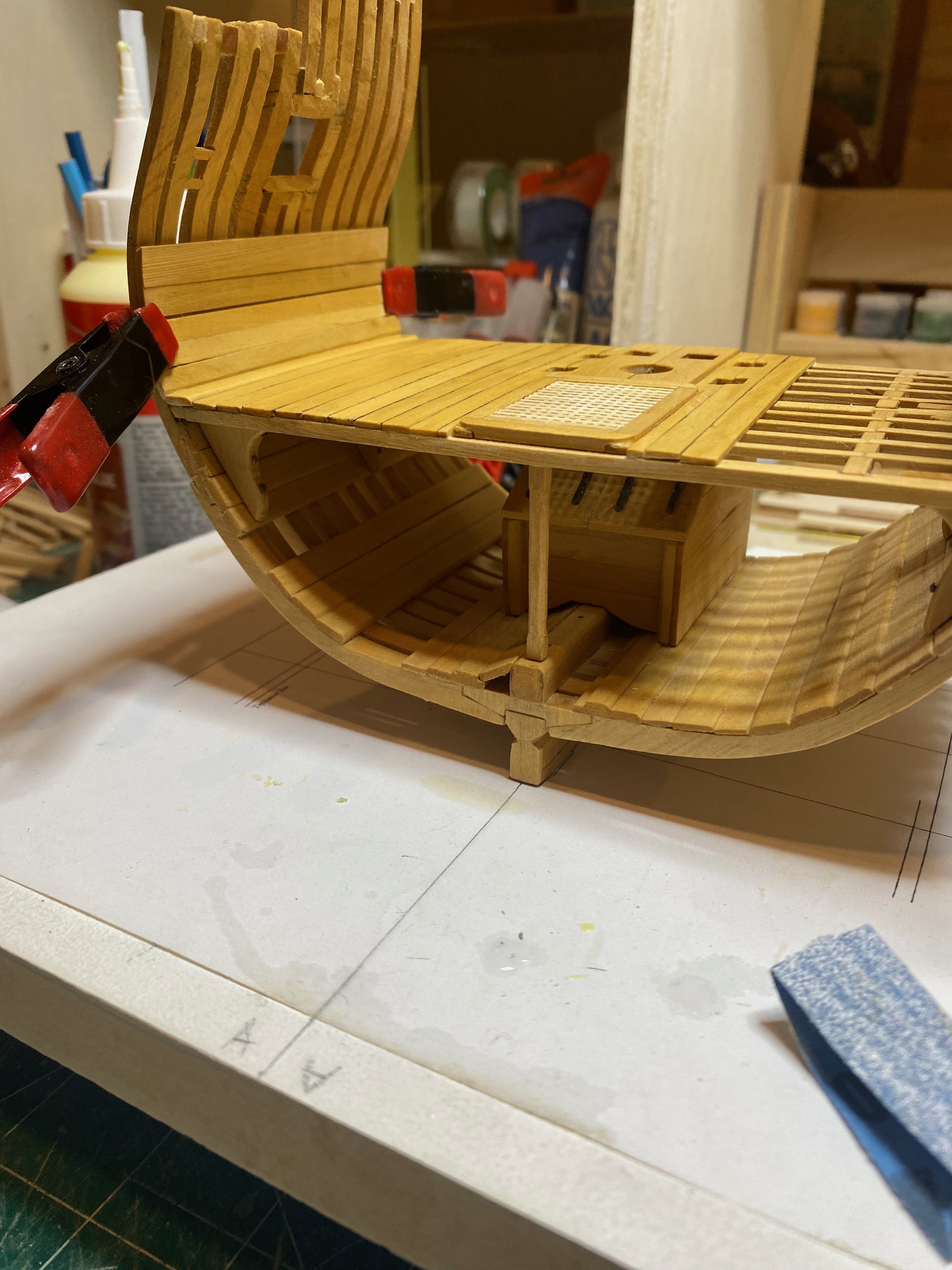

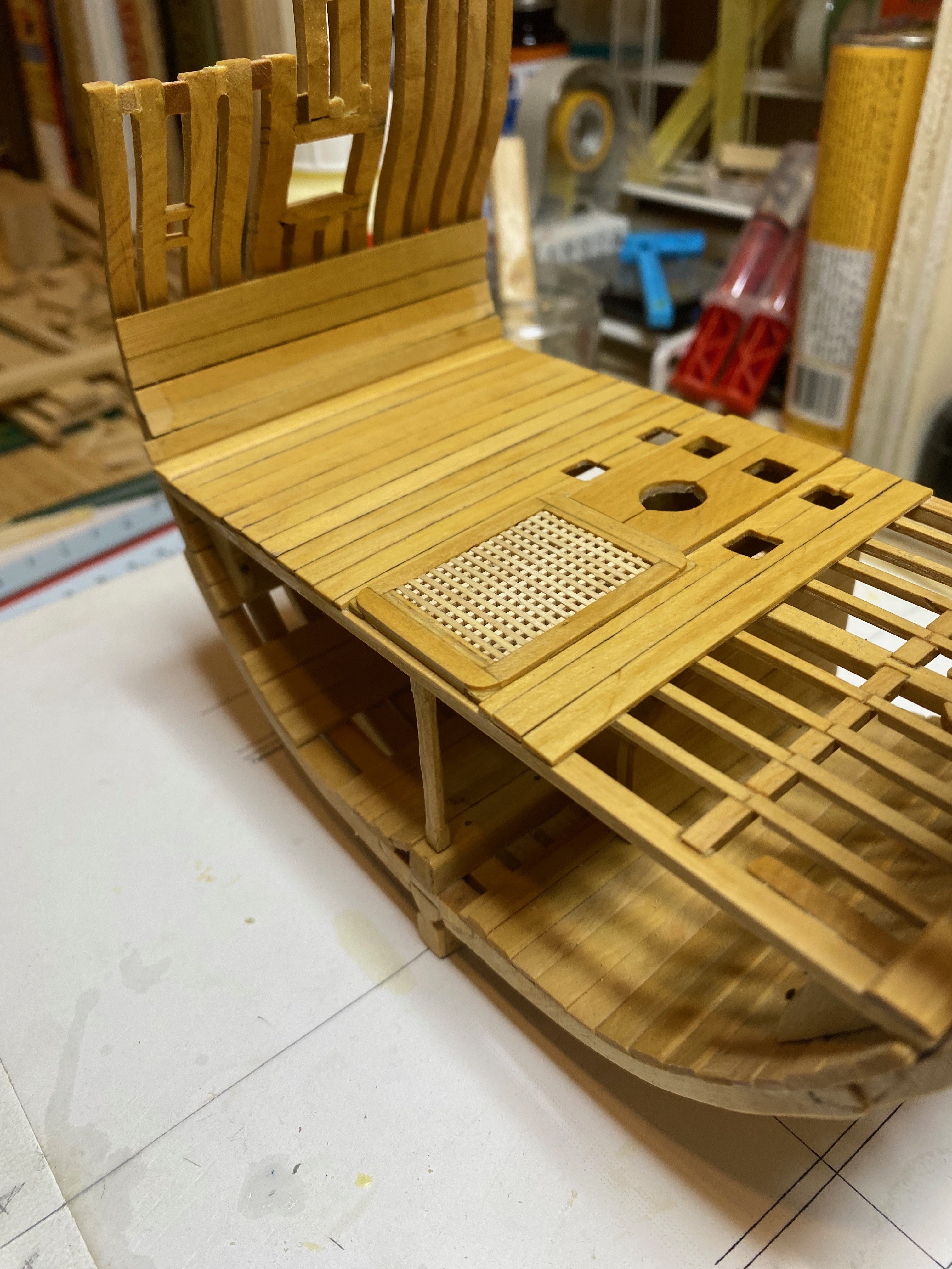

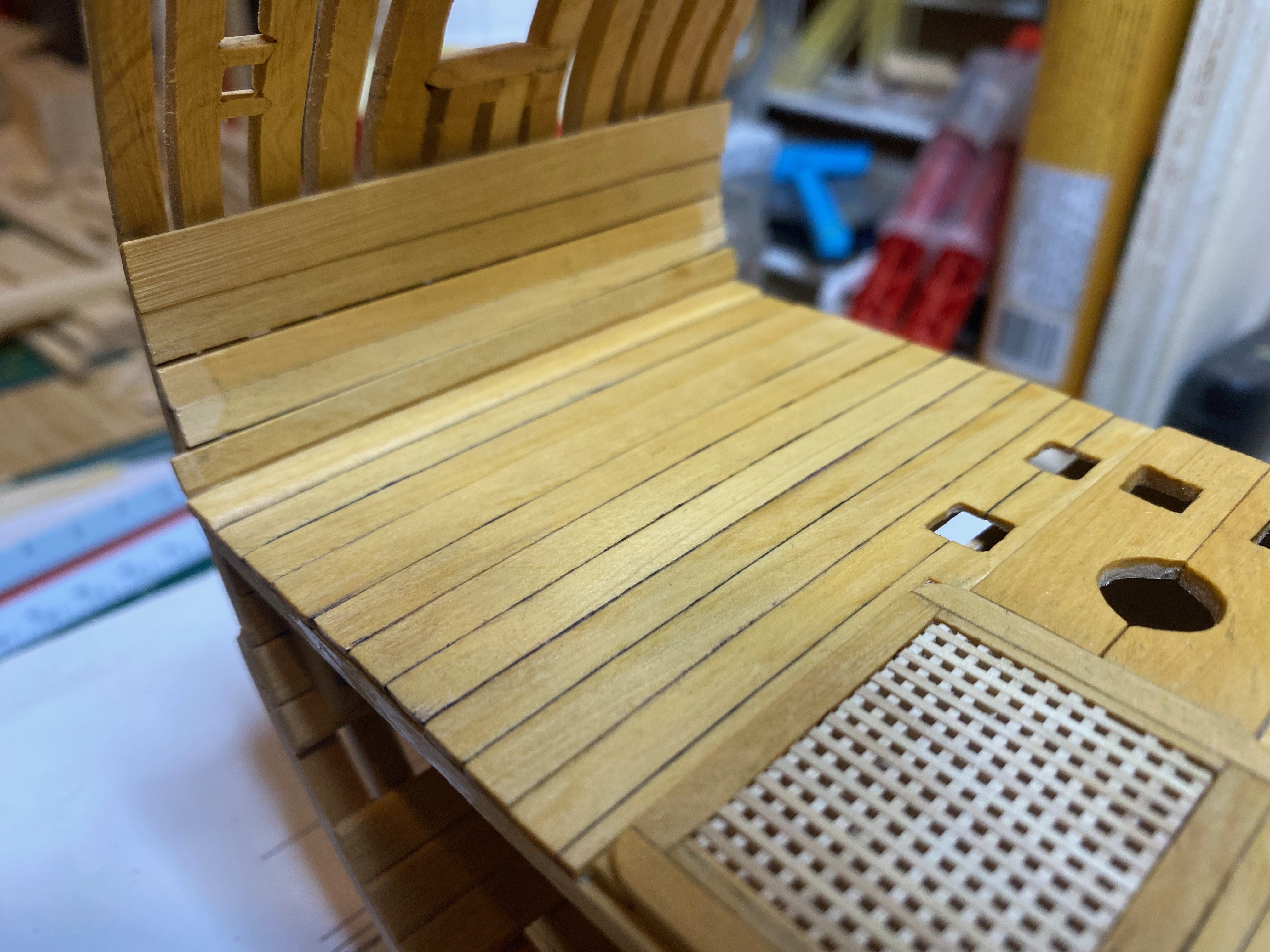

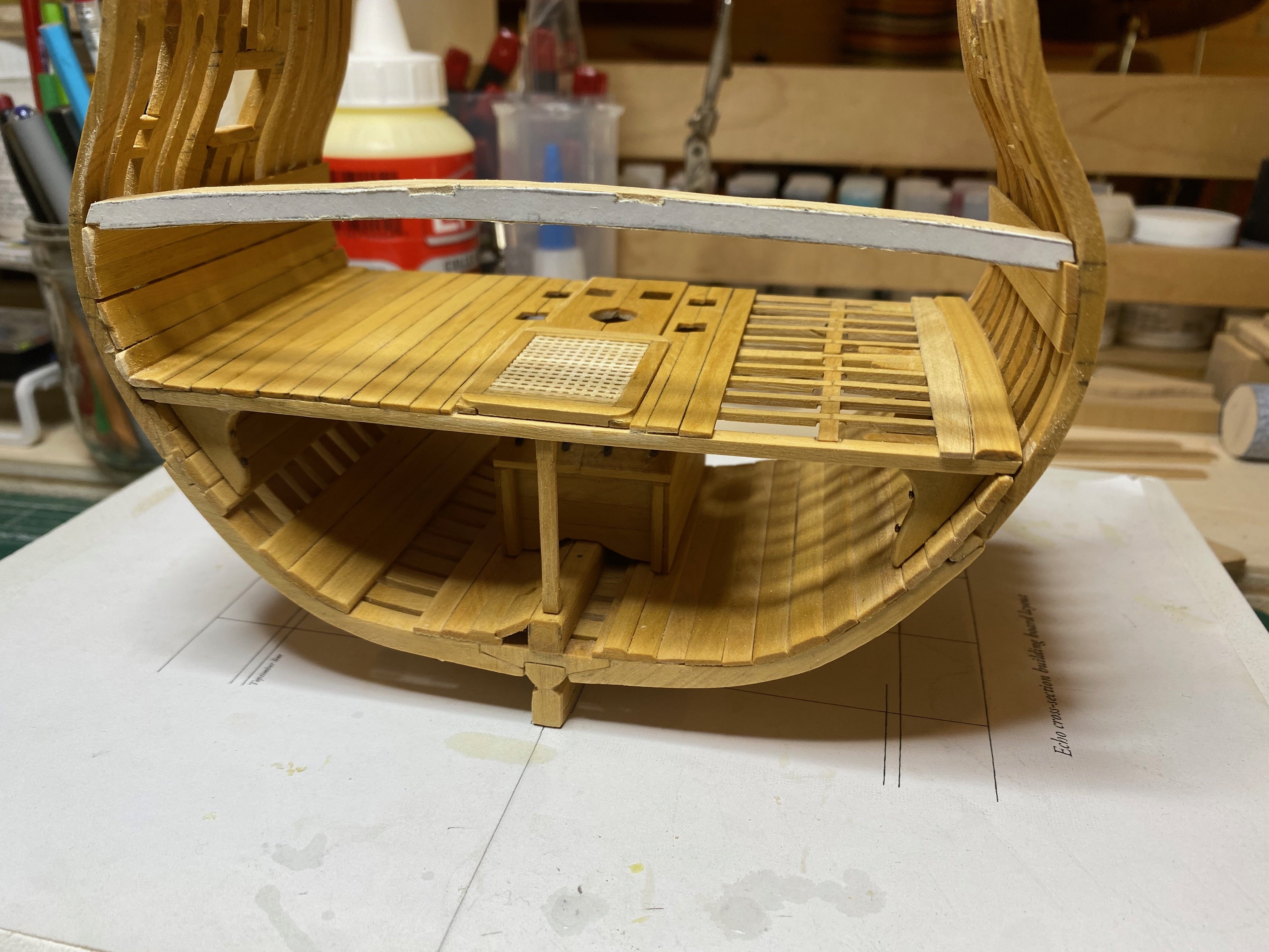

A small update on Echo. I've made and installed the spirketing plank above the lower deck waterways on the starboard side. As noted above, the port side is asymmetrical to the starboard and the waterway curves inboard as it runs aft. I made a spirketing for the port side, but this curved waterway means that I need to sculpt the plank a little bit more than was the case with the starboard side....I'm considering not planking the port side lower deck to avoid this....and rationalising this choice by deciding to alternate the full planking port and starboard...anyways, there's lots of time to make decisions...
I also started the lower deck planking - beginning with the strakes just outboard of the hatch/mast partners. These have to be notched around the hatch, which is wider than the partners, and a notch needs to be cut in for the passage of the outboard chain pump shafts. I marked these cut-aways out and removed the wood on the scroll saw, cleaning them up with some needle files after. I will be planking the deck fully on the starboard side, but will only install one or two other strakes outside of the currently laid one on the port side. These planks are as yet unfinished - a light sanding and sealing will happen once all the deck planks are in place.

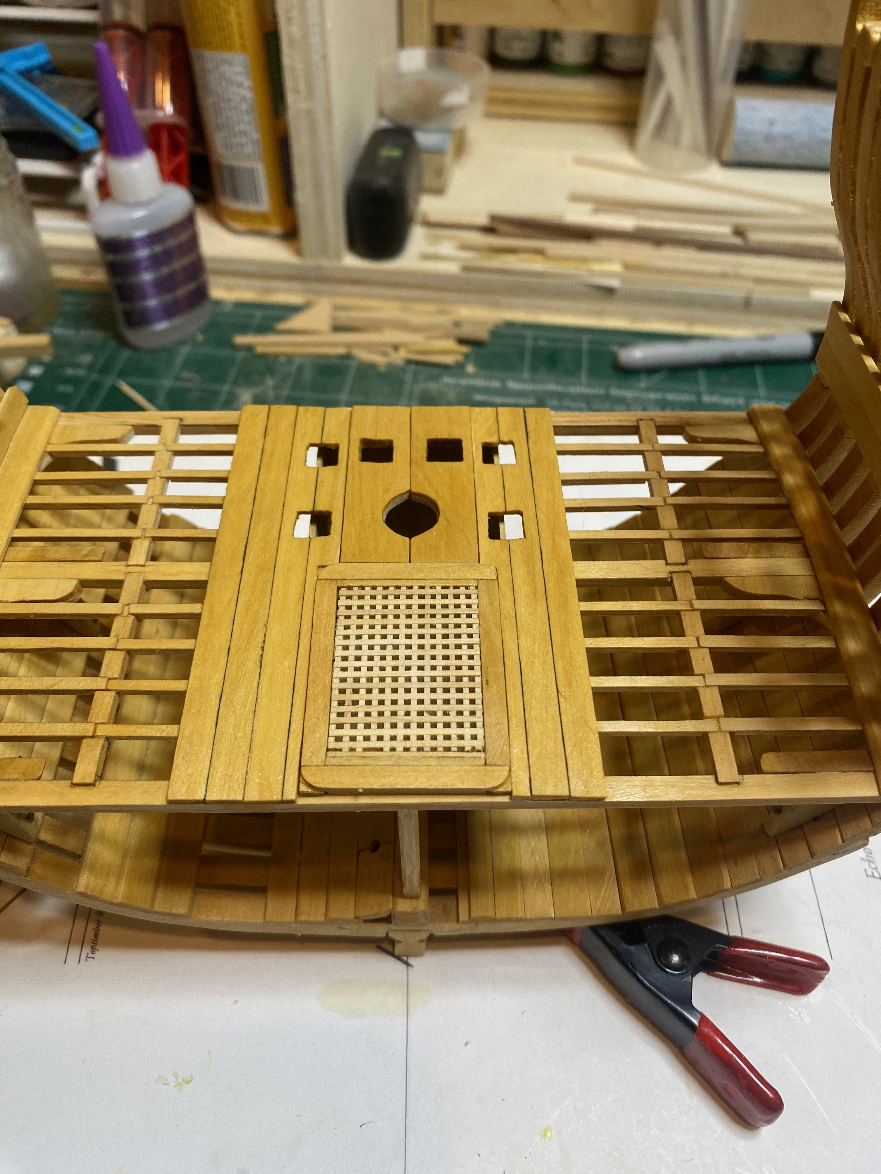

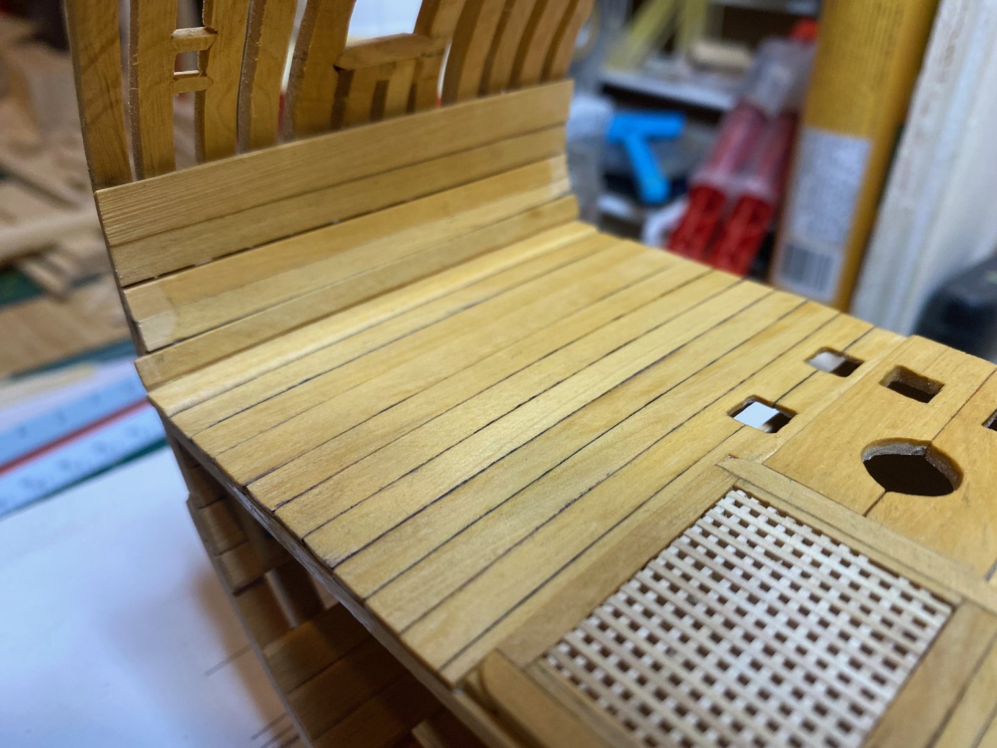

Something looks a little off with your coaming: it seems very wide. Did you check the drawing? Nice grating, though.
Yes - that's true - the gratings were pirated from my Syren kit and they were slightly short of the correct length, so I had to add some padding on the fore/aft inside edges of the head ledges...so those are too wide - the coamings port and starboard are 6" x 4" as noted in the practicum...Buth the head ledges ended up at 7.5" instead of 6.....next time I will make my own gratings to size - I was just cutting corners...not good modelling practice, but.....

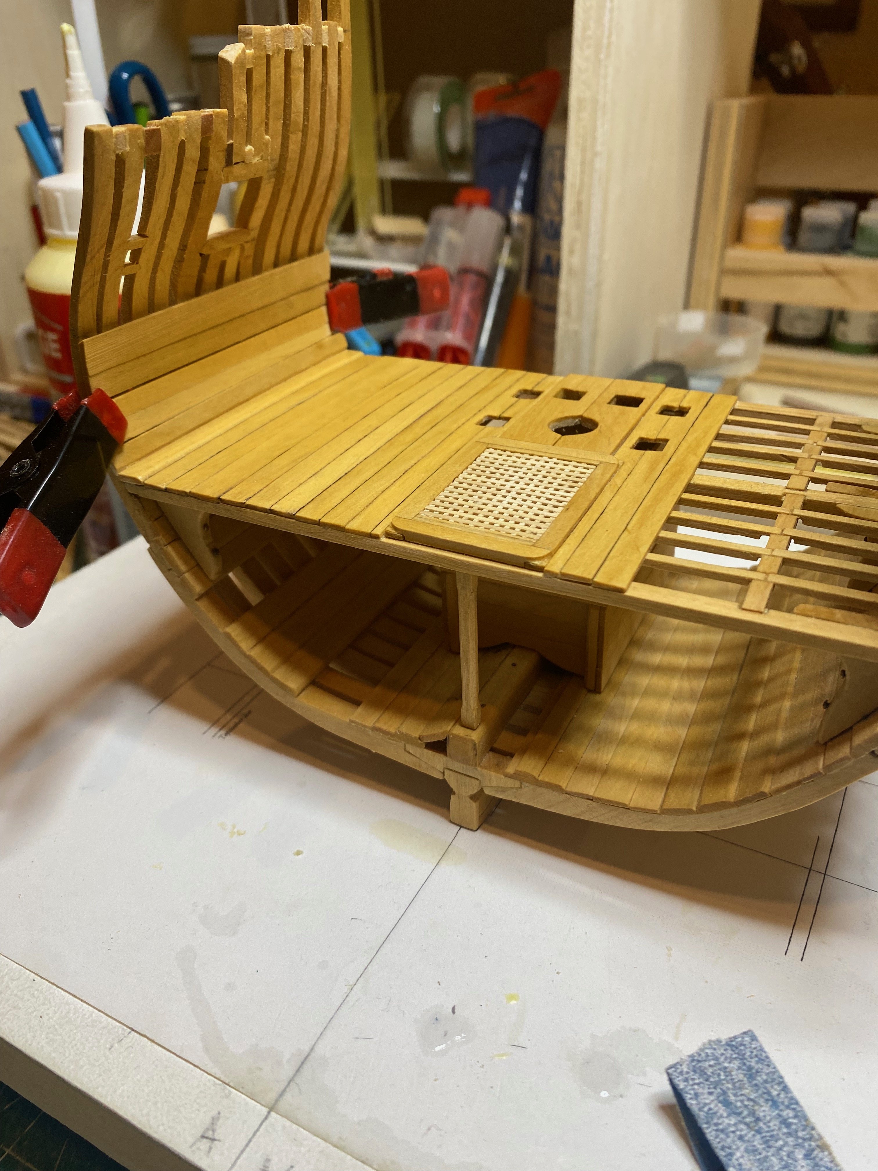

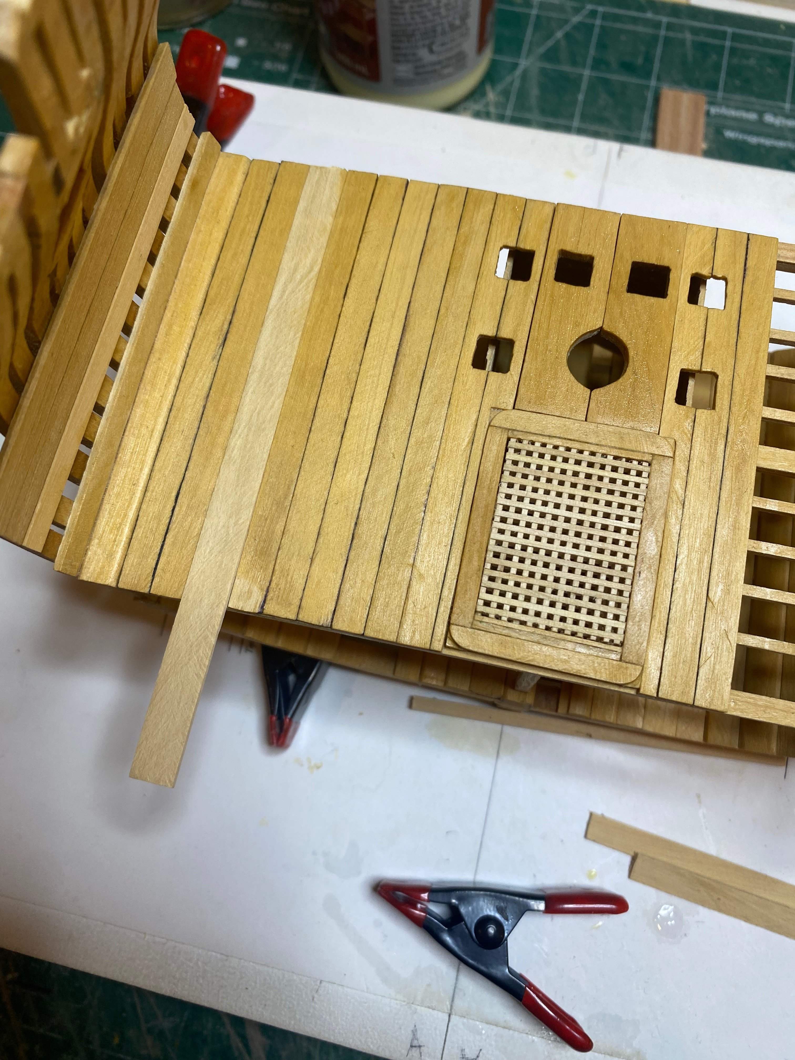

After a longer-than-expected break, I managed to put some time in at the bench today, working on the lower deck planking. I realised that I had forgotten, when I installed the strakes around the mast partners and hatch, to file out a notch for the passage of the break pump shafts...so I lightly pried those pieces off and completed that step - truthfully, I broke one of the originals in this process and made a new one to replace it! I had milled a relatively small amount of 10" x 2" boxwood for the deck planks - only 7 strips total. So after installing the strakes around the hatch/partners, I had only 5 strakes. My plan is to lay only 3 strakes outboard of centre on the port side and full plank the starboard side - this alternates with the full planking of the inner hull on the port side and only partial planking there to starboard. I will also lay a binding strake along the inboard edge of the port side waterway - this will have to be spiled on the side laid against the waterway to account for the slight curvature on that side - noted above....
Quick question - were the lower deck planks trunnelled?

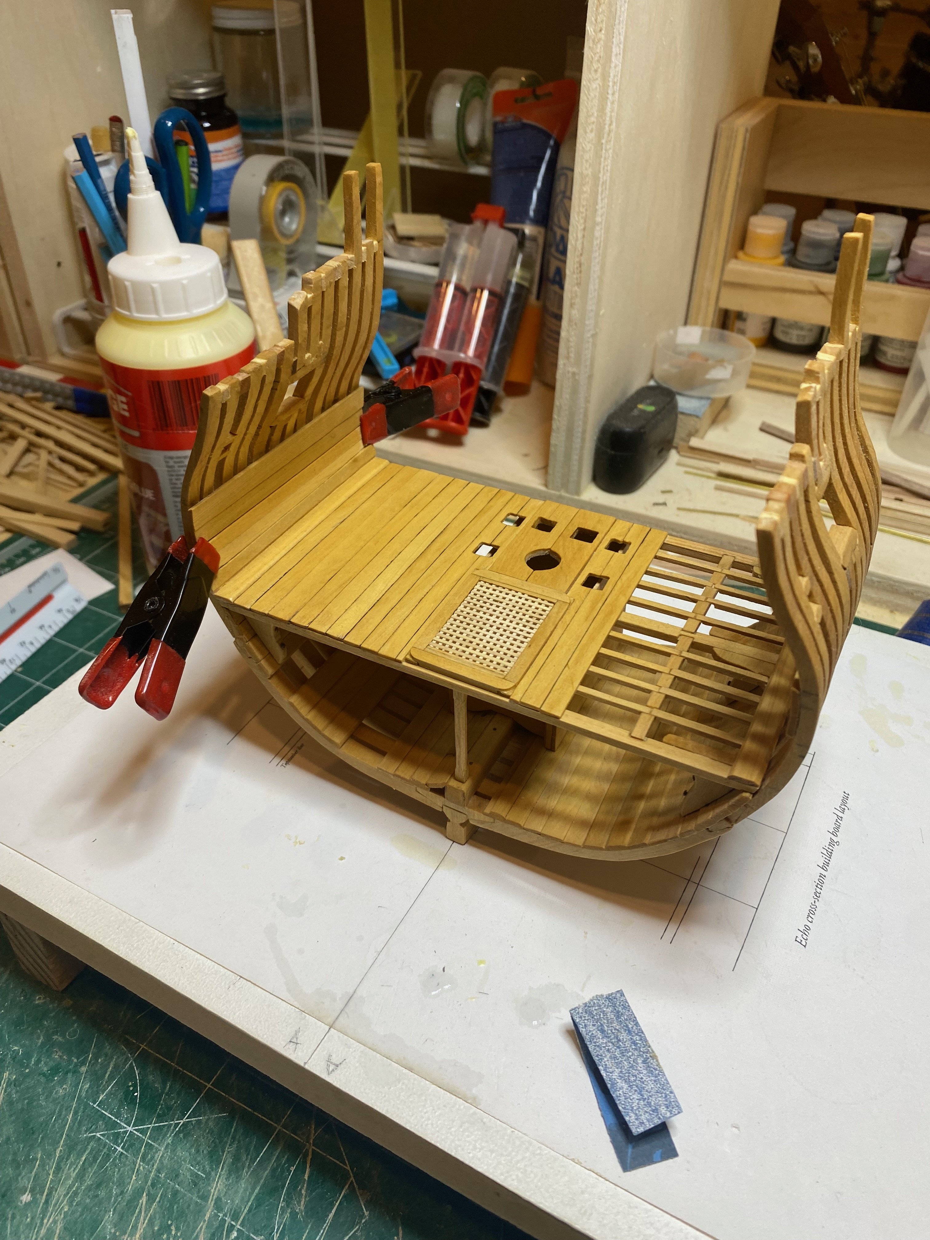

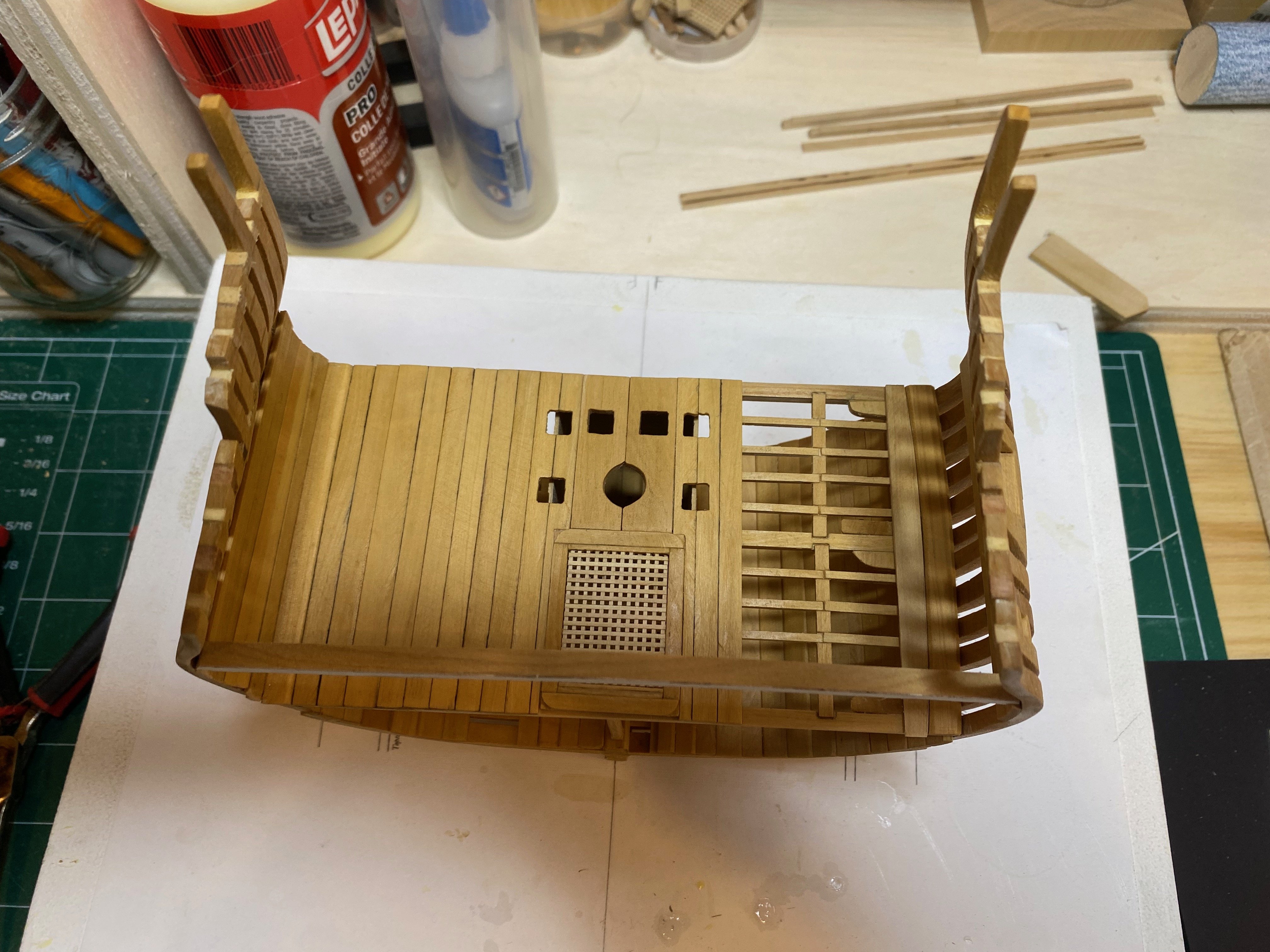

Managed to install a single ceiling plank this morning and to mill the remaining strips for the lower deck planking. I will have to fudge the planking a little bit, as the space to be filled is not exactly equal to the number of 10" wide planks that will fit there - there is a roughly 2" space remaining, so I'm going to mill a couple of 11" strakes to compensate for this - hopefully the difference won't be too noticeable at this scale.
I'll also need to figure out the spirketing plank on the port side - this will require some spiling to fit against the curved waterway. I won't be fitting ceiling planks on the port side, in line with the overall concept of alternating the planking decks and hull) port and startboard. Externally, I'll plank the port side but not starboard below the wales, but I won't leave the frames exposed at all above the wales.
hamilton
Last update of the day....the lower deck planking is now done, as are the ceiling planks on the starboard side. I ended up using 1 12" plank to round out the deck planking...it stands out a bit, but hopefully when the upper deck is done it will be a bit less noticeable. Bye for now

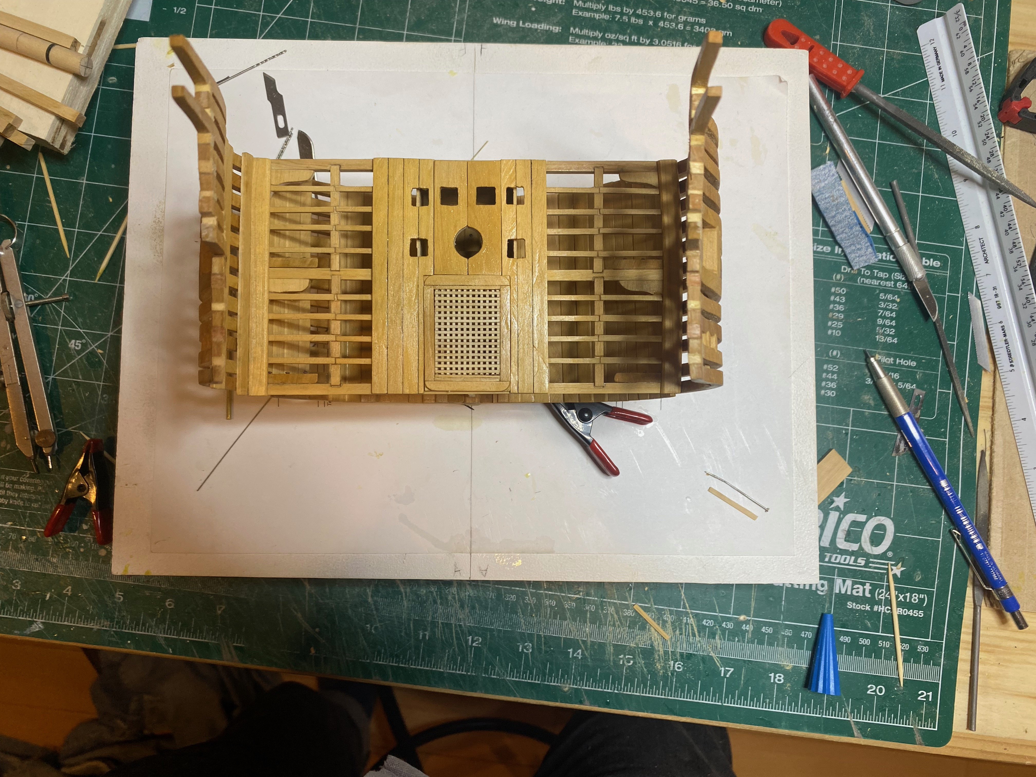

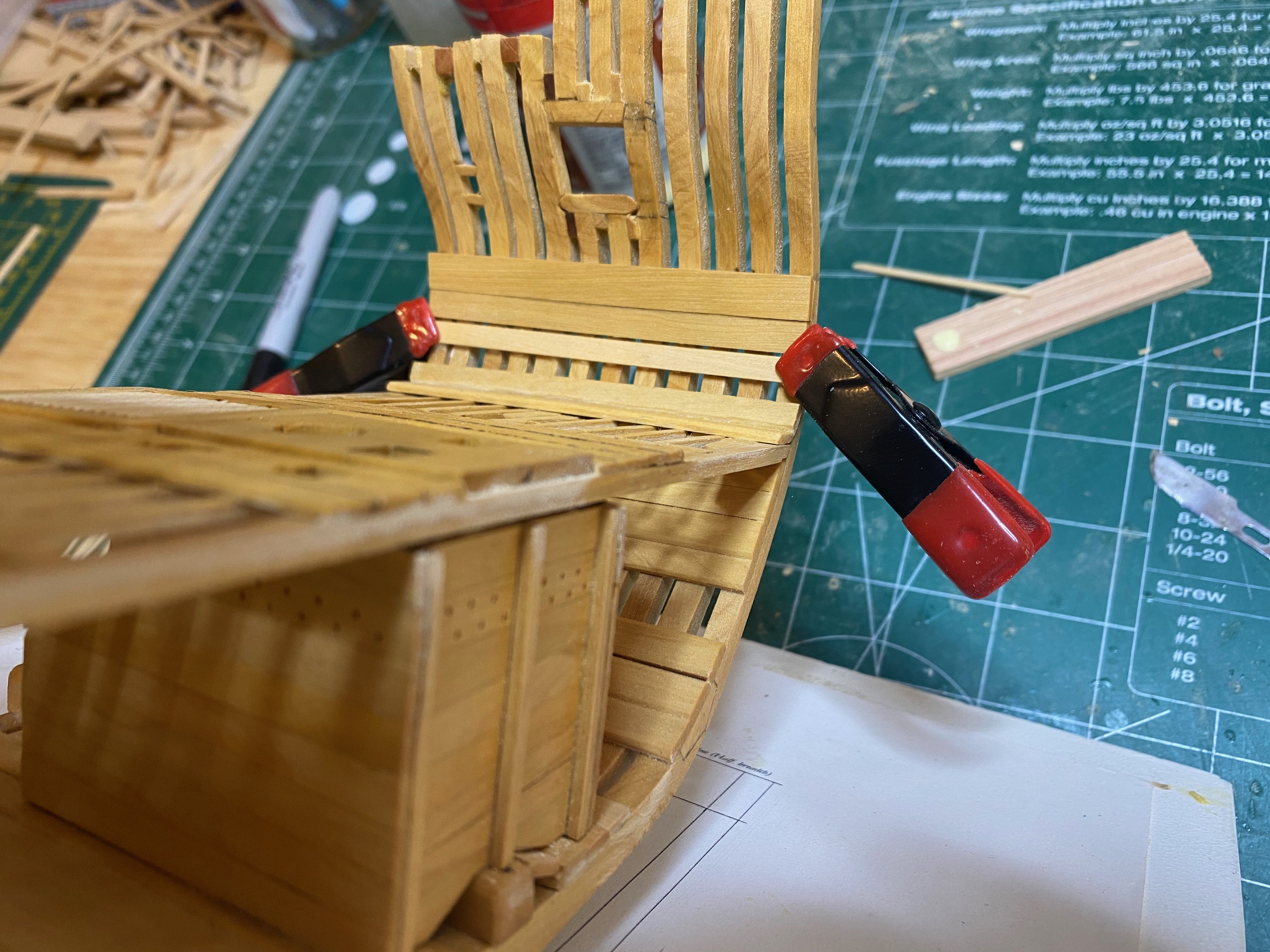

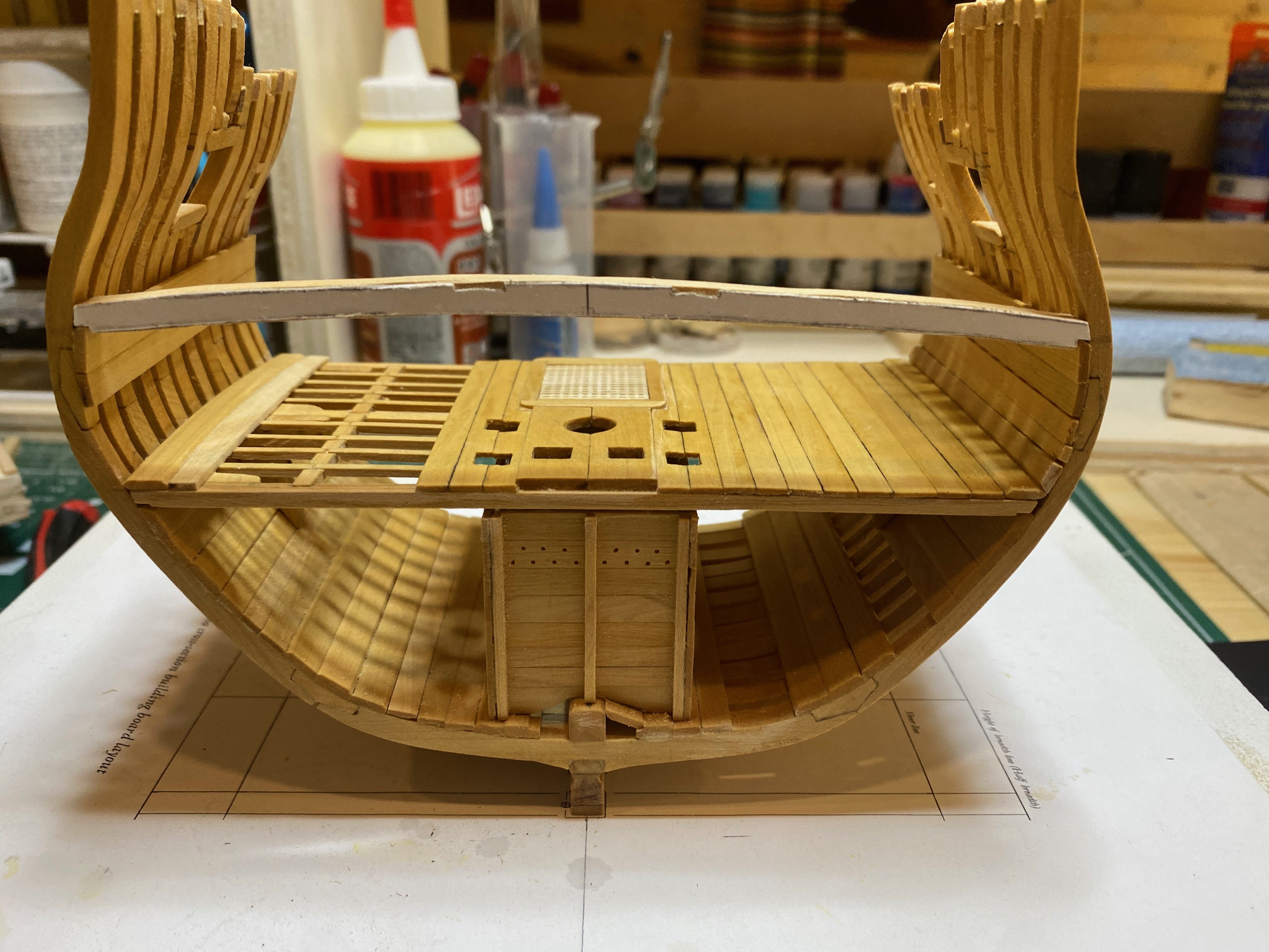

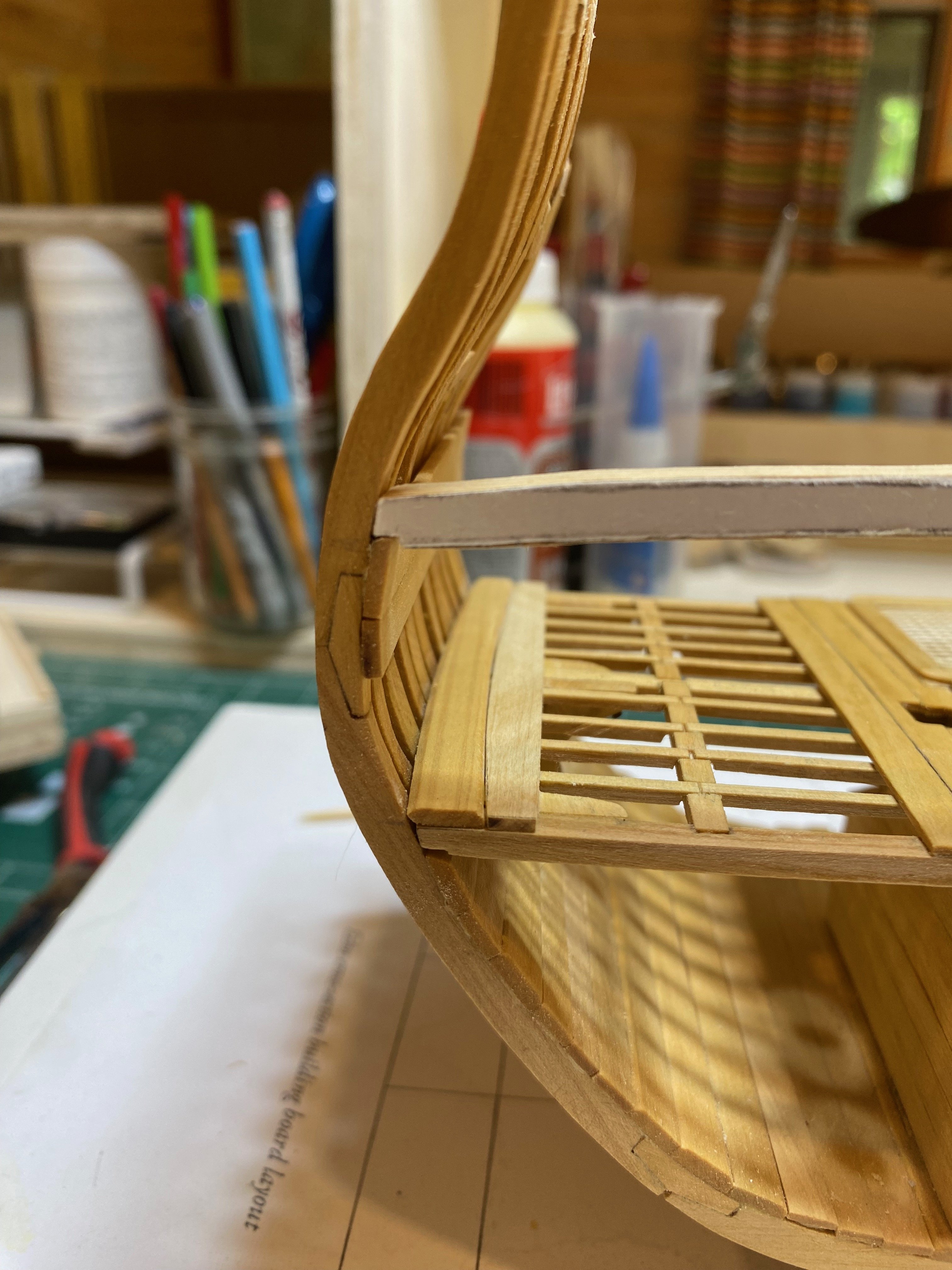

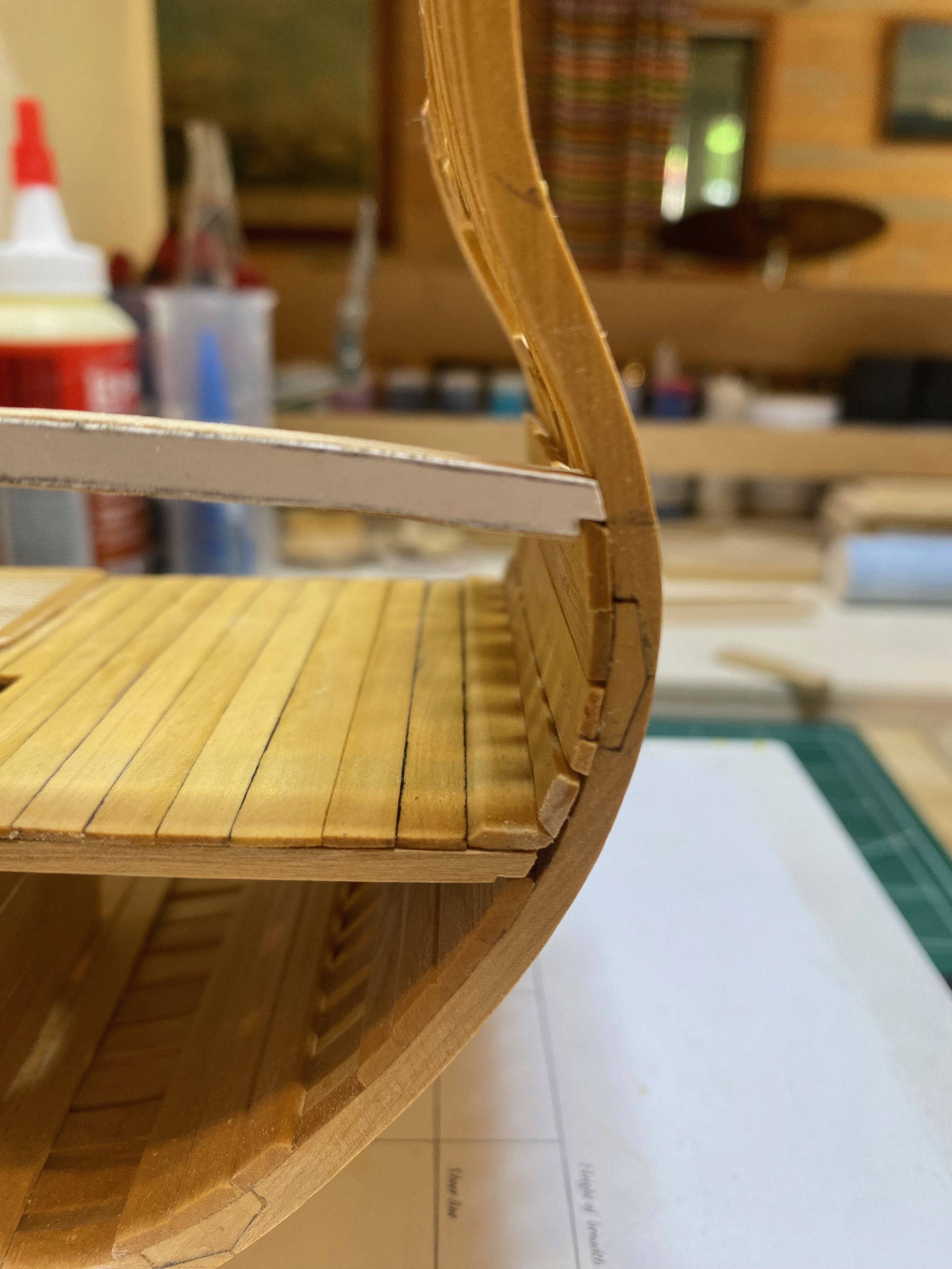

After another relatively long break, I've managed to find a bit of time to work on Echo this afternoon. No great strides forward, though I did manage to make a test of one of the upper deck beams. I made a template out of card paper using the drawing in the practicum against some carbon paper, and then rubber cemented this to some 9" boxwood that came with the original framing package. I think that next time I will simply use copies of the drawing itself, printed onto card. I think this will likely lead to a more accurate template and a better result. Fortunately I have enough of the 9" box to do a bit of testing before committing to anything.
I had imagined that the test beam would be fit forward, but it ended up being a fraction to short for that purpose. But it fits perfectly athwartships in the aft beam position at frame 5. So even though right now the piece still looks very rough (as seen in the photos below) I hope I can tidy it up and perhaps use it since it does fit so nicely....I also made a strake of deck planking to fit in line with the port side lower deck waterway - not too difficult or exciting.
The upper deck framing is going to be quite tricky I think - I'm not looking forward to making and fitting the beam arms and am a bit concerned about the beams being at the correct height.....but we'll see in the next little while how it comes together.
