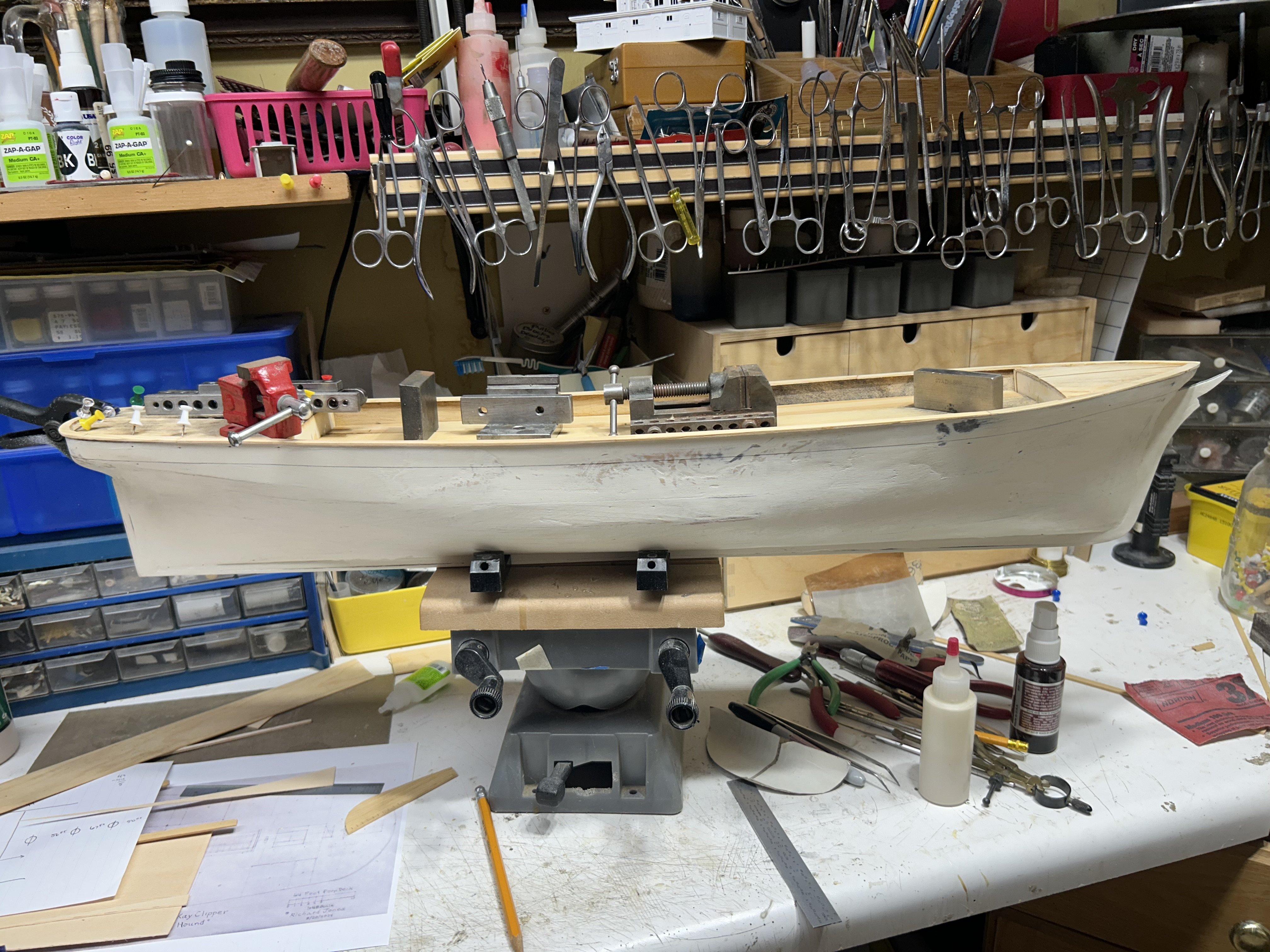

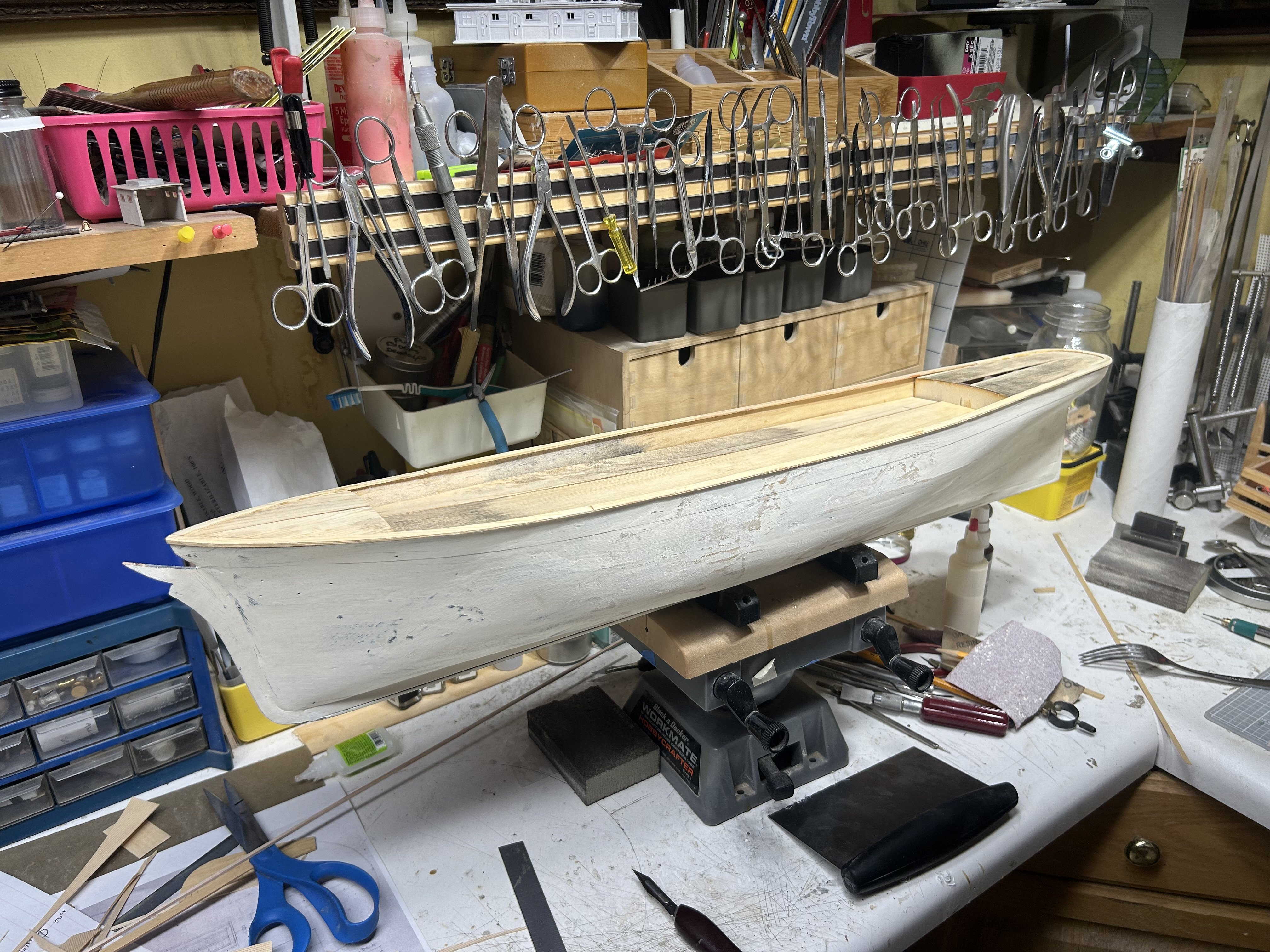

Being Sunday, I only spent time finish laying the sub flooring planks. They are 3/32” thick ,  Good and sturdy.

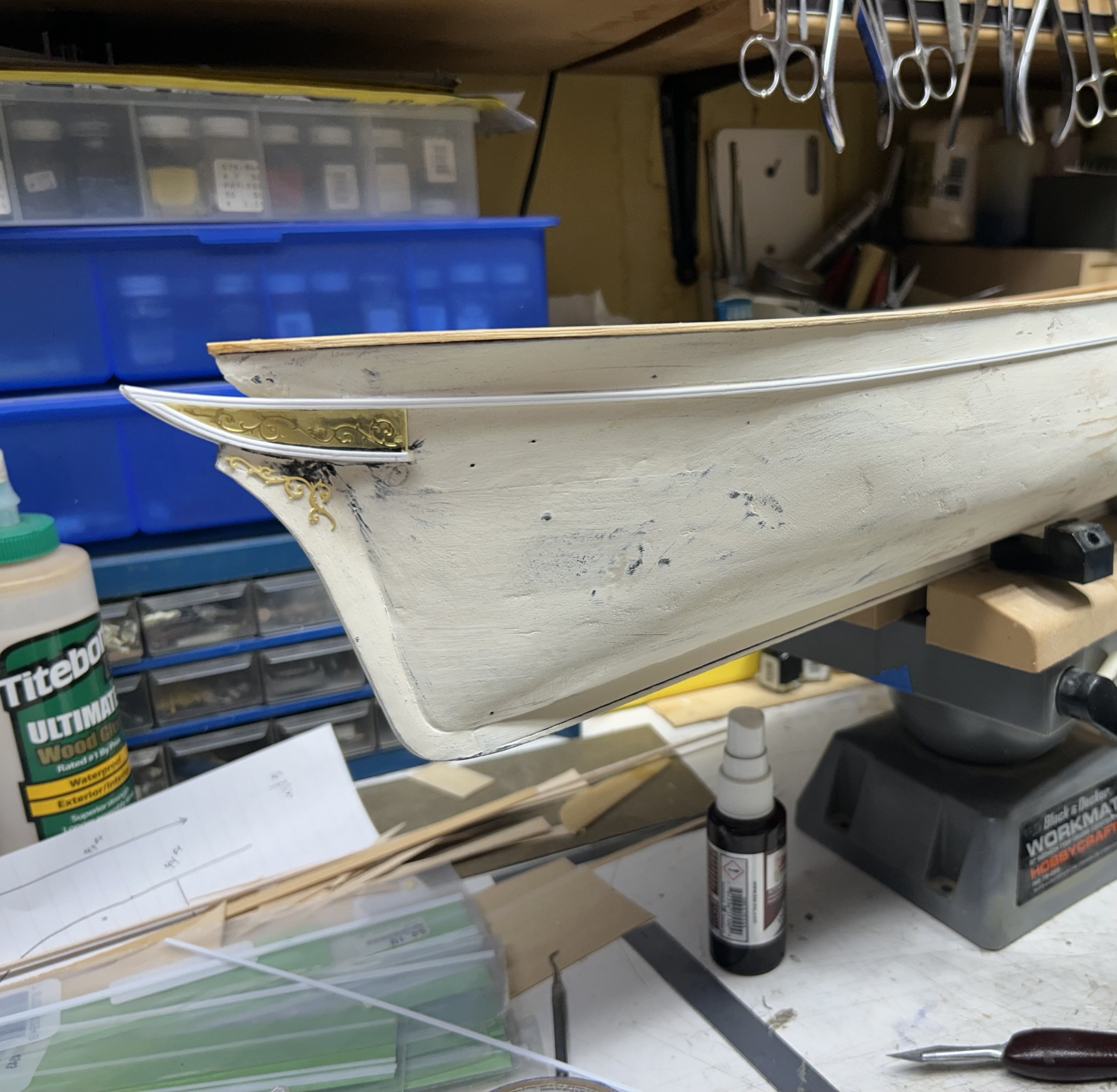

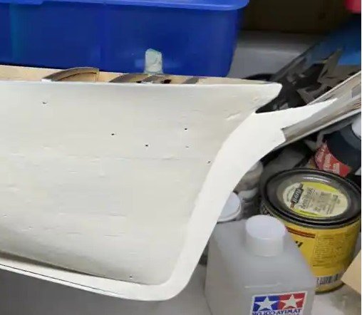

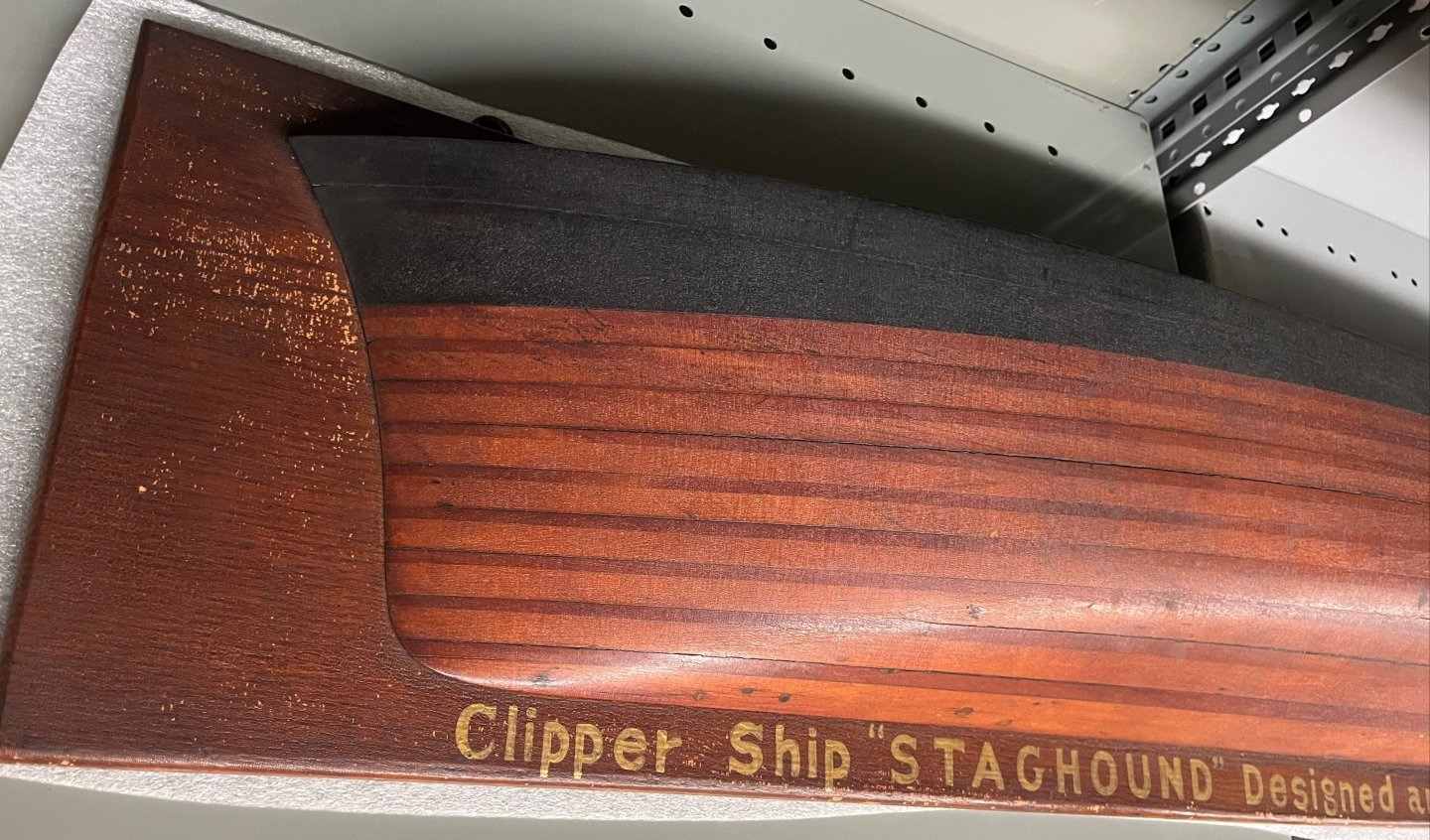

Comparing the stem of my Staghound to a painting of her....You can see the extent of the prow exerting itself forward of the knightshead.  The *navel* hood and the figurehead are projecting far forward.  I think I'm in the ballpark.
Rob

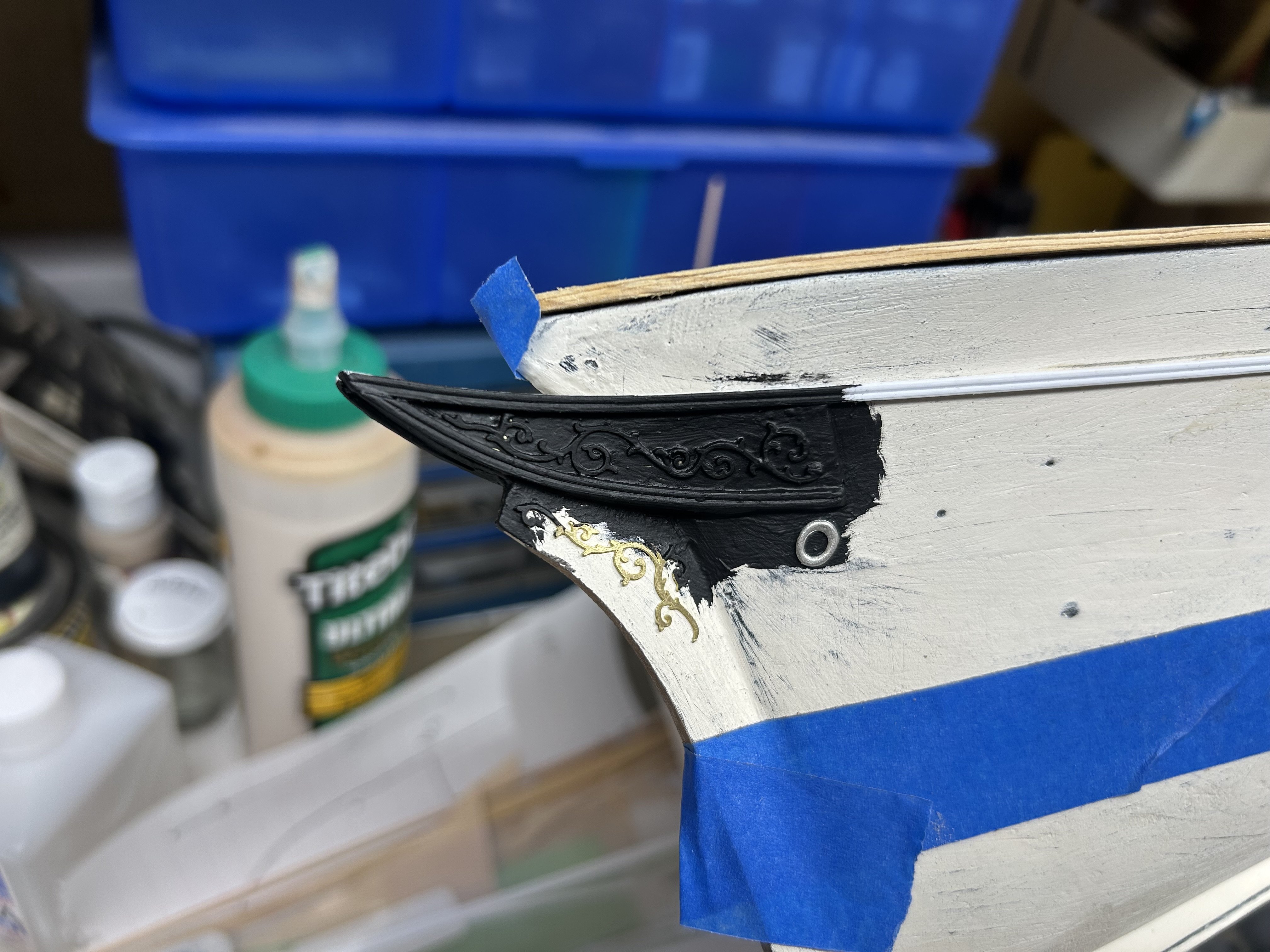

Fabed the port hood.
Rob
Rob
Rob, that looks like a bow detail from a lovely Frank Vining Smith piece. I would appreciate seeing the entire work, as it looks quite colorful. Once again, this structural work demonstrates McKay's nautical design brilliance. It may even go back to his designing and building fishing boats in Nova Scotia. Those vessels had to be sturdy and tough for the type of work they were employed in. Here, we see the cutwater as the central backbone of the prow. Then two navel hoods sandwich this piece identically on both sides with the lower level of the cutwater extending the prow while doing double-duty as a sturdy base for figureheads. Meanwhile, the triple layered devices above provide a more than stable base for the massive bowsprit-jibboom just above while also providing a mounting point for the back of a figurehead and giving shelter at the same time. If you look at the Scottish tea clipper Cutty Sark you'll see that her bowsprit-jibboom mount above her bow and not into the built-up hull as in American clippers. Maybe that design philosophy was a difference too.

9 hours ago, rwiederrich said:
Both sides are done.  Now to finish the plank sheet molding.
Rob, those beautifully done navel hoods really extend the prow of your Staghound and give her a genuine clipper bow. One observation I offer is that on your original outline, the cutwater had a higher curve which appears to accentuate this feature a little more gracefully. It also more accurately reflects McLean's statement that this piece appeared to descend in unbroken curvature until it blended with the waterline. The end depth where it provides a mount for the figurehead is fine.
Rich.  I see what you are saying....however, after great reflection and profiling from every painting we have of her....it appears to me that the correction I performed makes her stem more of the upward angle also described by McLean, "The cutwater is tapered to an angle".
Are you suggesting I cut it back to my original curve?  Back to the original stem line, I had originally cut...without the addition?   I supose I could cut the stem back half way...to mimic more like Glory.
Rob

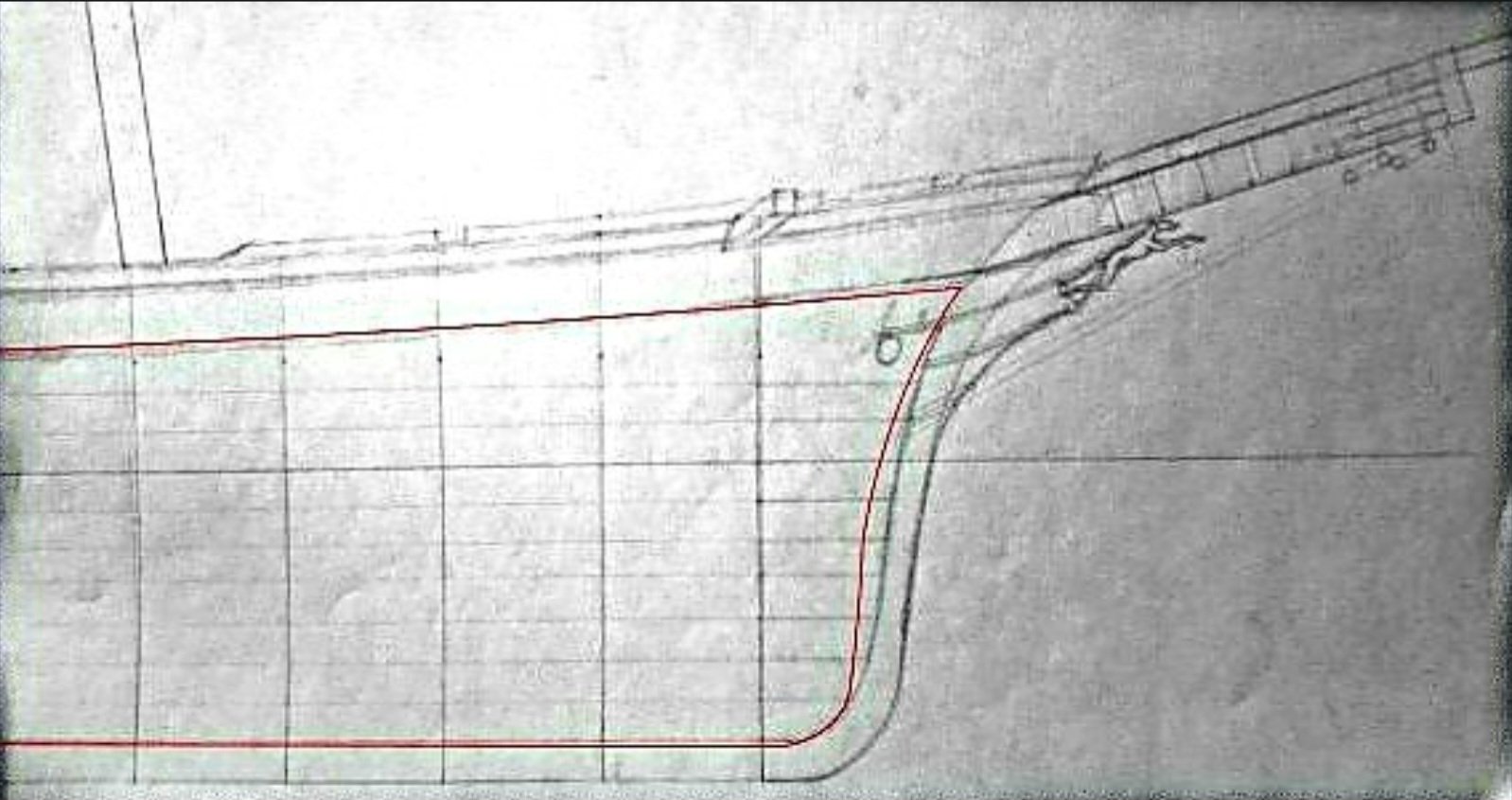

Rob, not all the way back but doing so at a gradual tapering inner curve. The Glory of the Seas picture you chose is perfect to illustrate how the cutwater blends into the stem to maintain the profile of the bow. You can also clearly see how this property accentuates projection of the figurehead as well. I've included my Staghound bow sketch so you can view how the graceful cutwater curve quickly intersects the stem. In doing this sketch, I relied heavily on what we learned in our research on Glory of the Seas as well. I also included a second curved molding as on the other clipper since in my studies I've seen this same feature consistently illustrated too. On your model, the outer depth of the cutwater is fine, it just needs to be a little trimmed back to match the photo and illustrations.
Problem is...the outer stem from the foot of the stem...is more vertical from McKay's half model, then these drawings depict.  I went with McKay's half model profile.  Double check for yourself.   so are you saying your own drawing is incorrect?
Rob

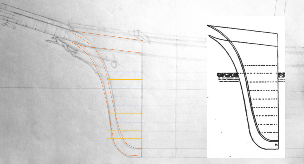

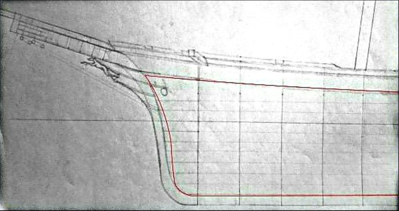

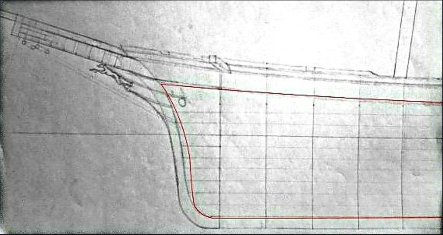

Rob, Vladimir supposedly overlaid the Cornelius McKay Staghound bow profile on my sketch in red lines. If that's true, than my sketch is almost exactly the same. Your cutwater as it is now is fine, it just appears to me that your original pencil lines look just a little closer to how it appears in my sketch. If you print out the sketch on an 8 & 1/2" × 11" paper it should be exactly 1:96th scale. Then you might be able to see what I'm trying to describe better.
Edited by ClipperFan
added files
I'm thinking of cutting in the angle a bit more.  Cutting into the darker wood...to slightly harmonize the vertical and the curved.  I think I might have added a bit to much to the curve...filling it out a bit too much.   No problem.
I'll add that to the several adjustments I need to make before moving on to finishing up the planksheer molding.
Rob
Rob, most of the darker wood can go. You just need to blend the top end of the cutwater into your original lighter stem line so that it merges just above the waterline.
I cut it back and blended it into the cutwater.

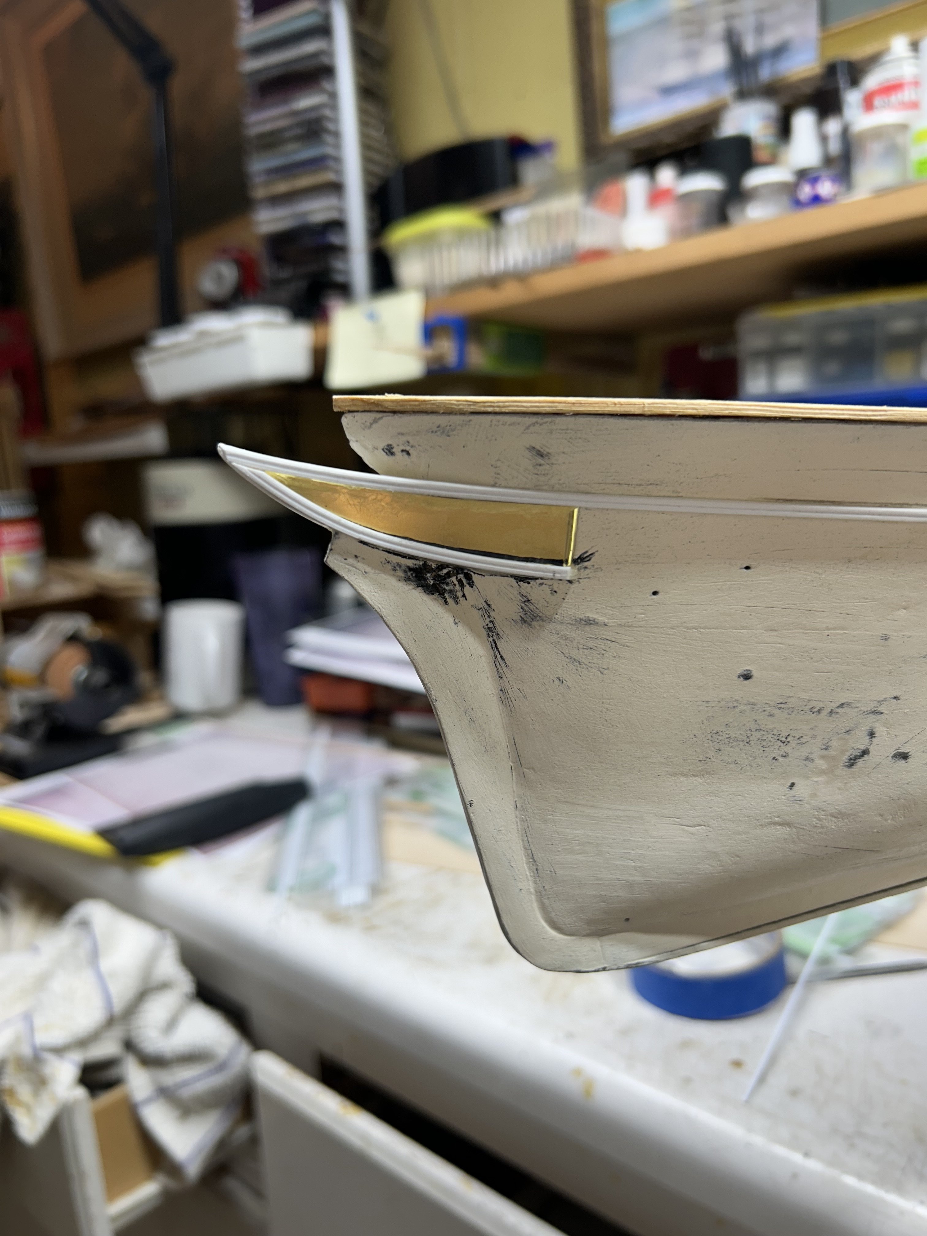

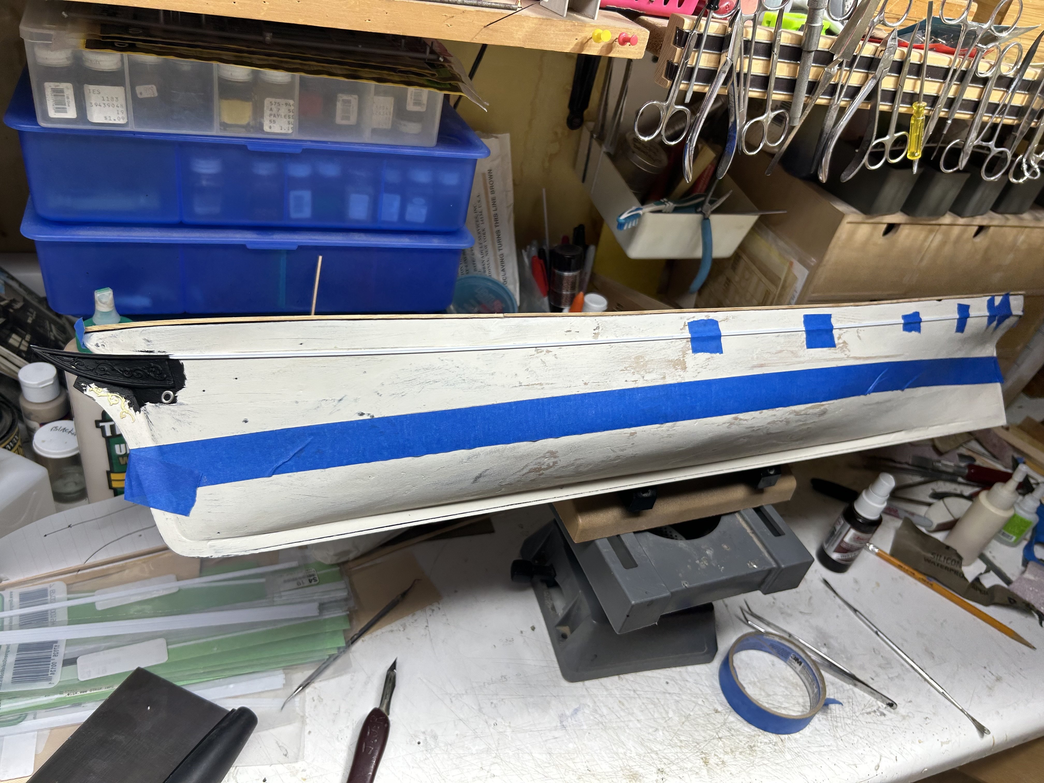

Did some work today.   Adding the planksheer.  Masked off the black hull.
Rob
Current build:
Finished build:
Current build(On hold):
Thanks Pat. Still got minor planksheer moldings left to do and half round molding under the main rail.  I corrected the stem, adjusted the hoods, and will be painting the hull black soon.

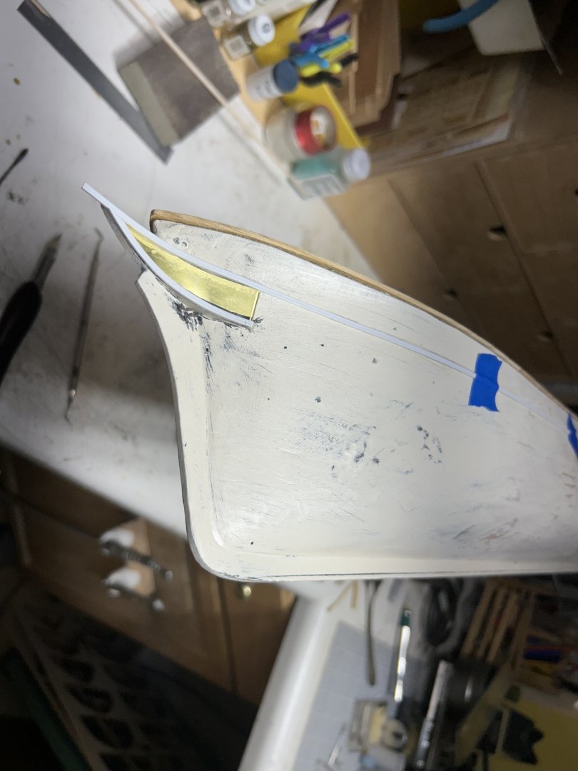

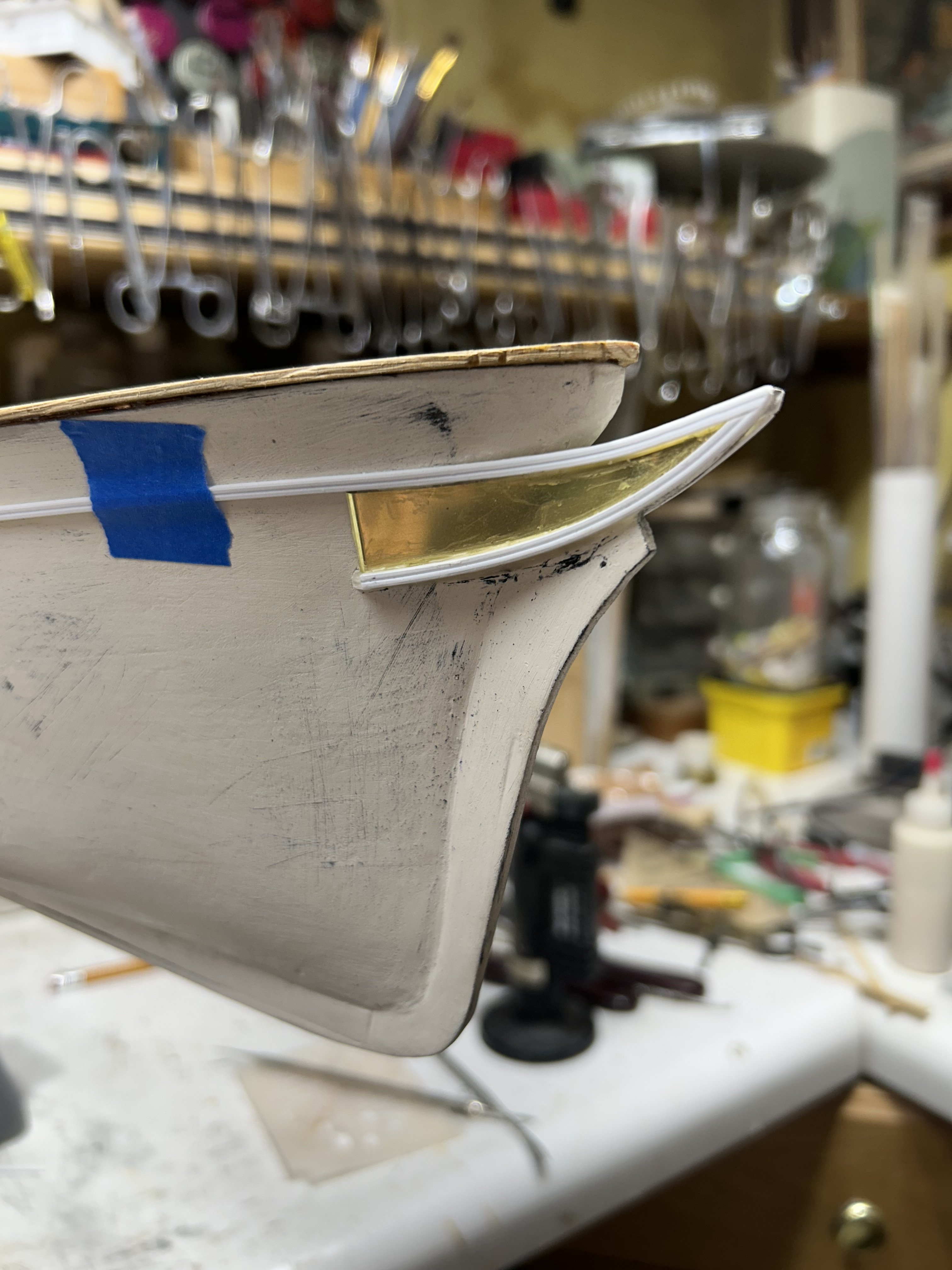

  Rob,  it looks like the hood is fashioned to fill the entire gap between it and the cutwater - making for a solid assembly with no gap between (so stronger).  This would be as opposed to just two angled pieces attached to both sides, having a gap behind.
  Perhaps a picture from directly below would illustrate your construction to advantage.
Unlike an externally  suspended Headboard...the McKay *Hood* is part of the hull and cutwater.  In essence strongly joining the two.  I'll take a picture of the fillet, I had to fashion between.  It simply fills the space and is bolted firmly, making it all one piece.  I already painted them with the hoods,,..but you can see how it fills against the two structures.   Thanks for noticing.

I've learned so much following this project, even if sometimes the hood debate gets a little emotional.  It's all sausage making and, in the end, the results are very desirable.

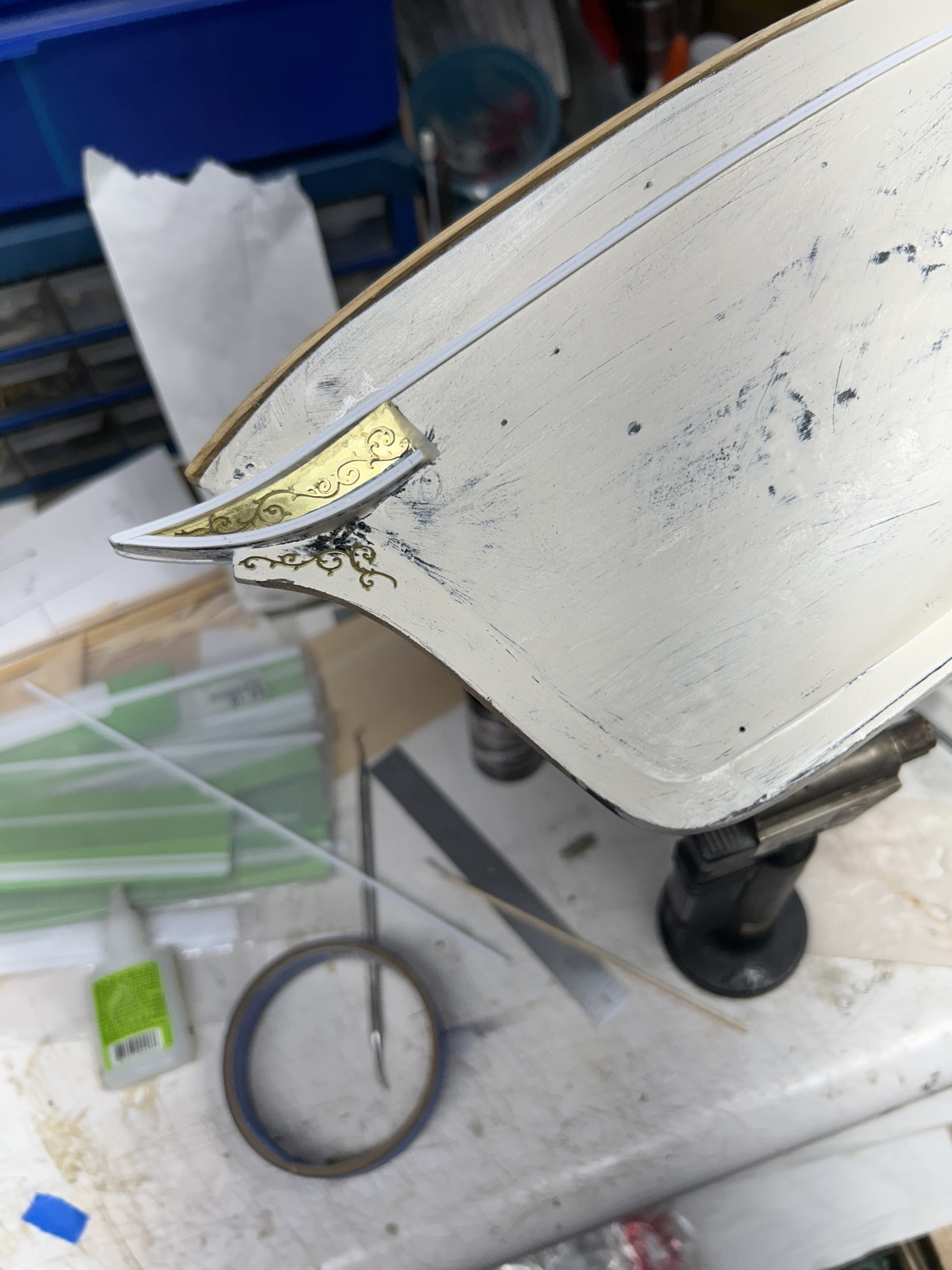

Rob, how did you fabricate the brass designs applied to hood and cutwater???  Etched?
I'm glad you were able to learn something from all the input (That's what it's all about) 🤩. Especially the *hood* discussions. Rich and I, along with decades of research from our friend author and historian Mike Mjelde...we have concluded the validity of said McKay *Hood*.
I'm not prone to use a lot of acid etched scrolling....but in this case, since no real concrete evidence exists about what type/kind/detailing scroll work was on Staghound other than McLean's *thin* descriptions such as, "carved work, devices, and Neatly executed ornamentation", I chose to use scrolling provided by Bluejacket...for their clipper, Redjacket.  I had to heavily modify, cut, bend, reform, their wares, for my purposes.   I'm not afraid to use, rework, or modify someone else's engineered material for my clippers.  I prefer to scratch build myself.  But I am lazy too.
