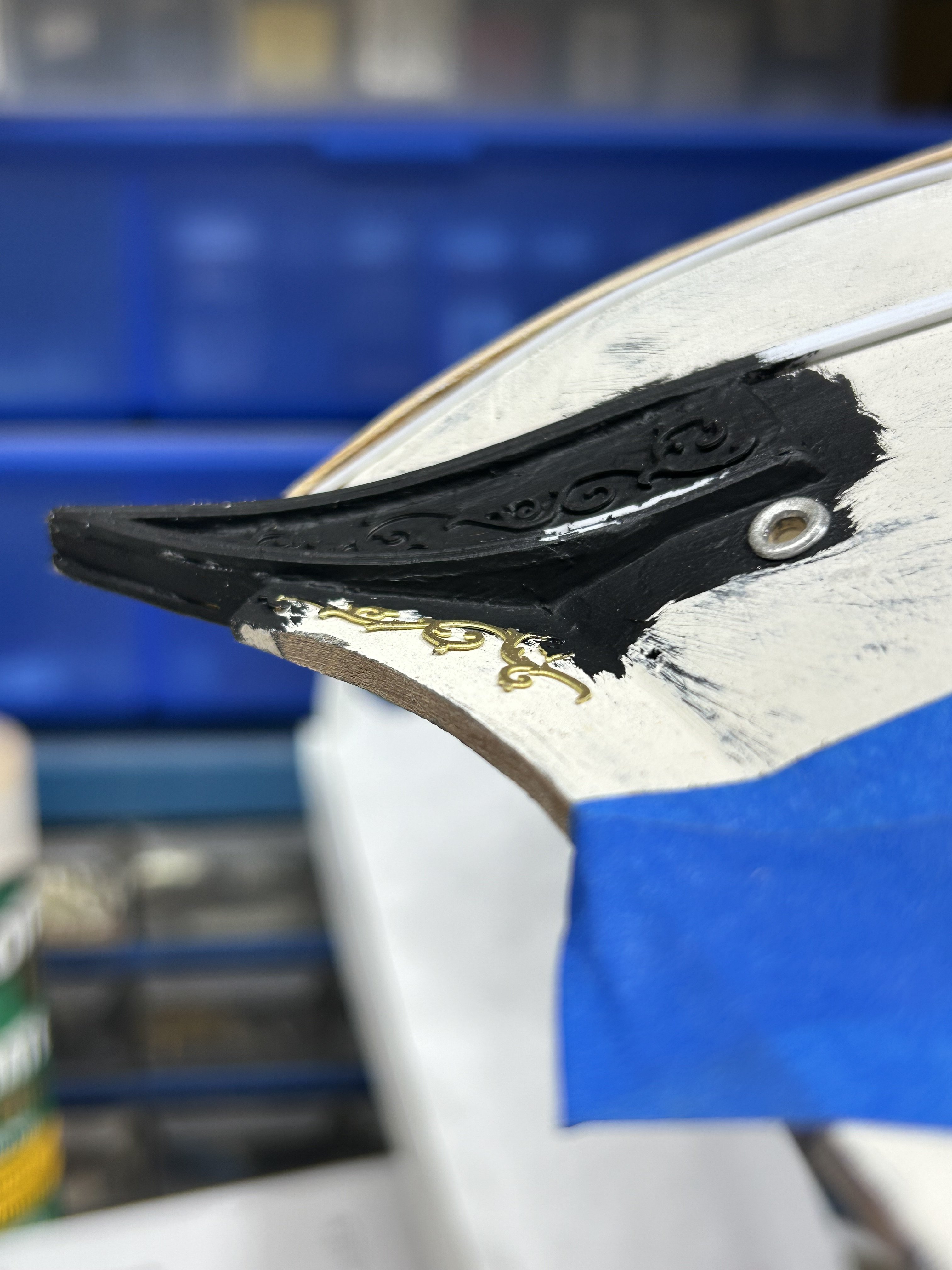

Rob, at the rate we're going, it's already apparent that this clipper Staghound is another unique tribute to Donald McKay's creative genius. My only other request about the current cutwater decorative treatment is to add a single curved molding at the base of the cutwater, similar to what's seen on Glory of the Seas. It strikes me that this embellishment was added to minimize the wedge shaped appearance of this particular piece resulting in a more graceful appearance.

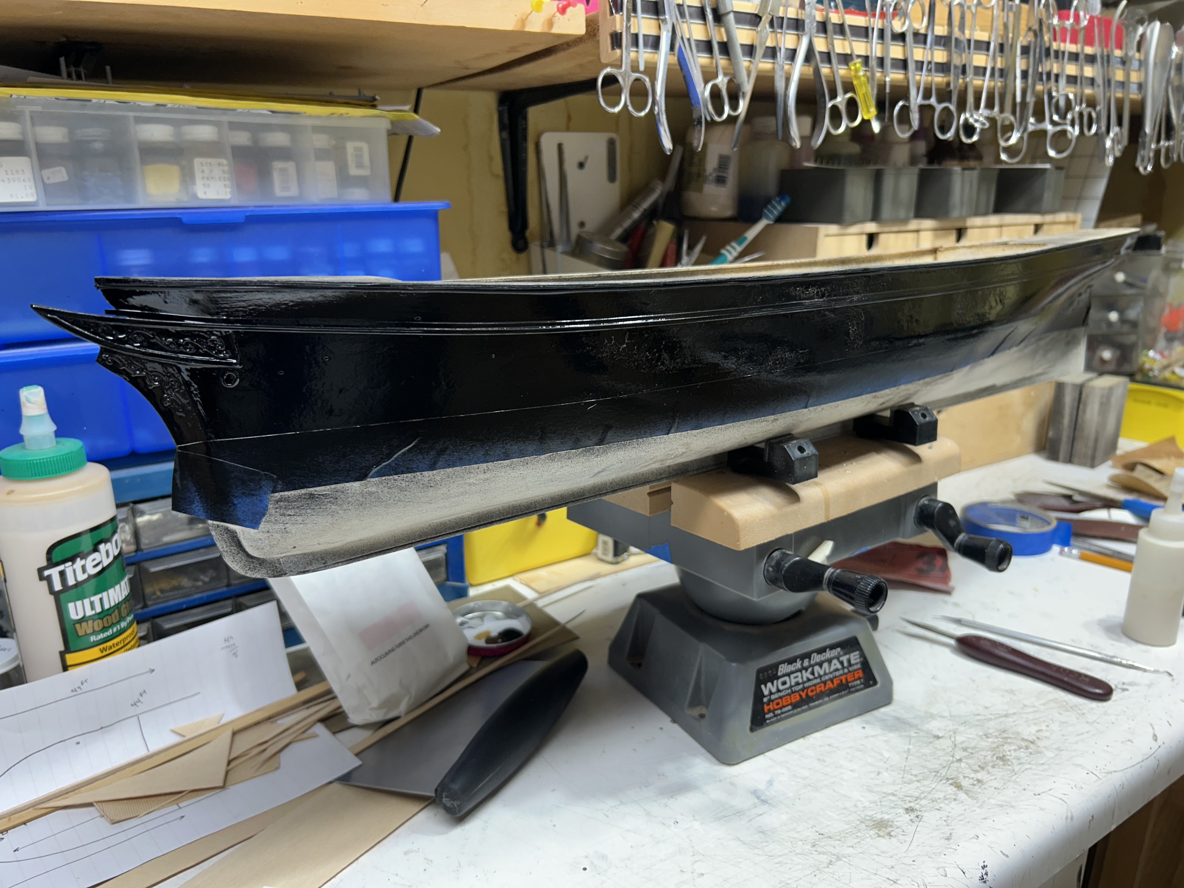

Finished the planksheer molding and put down a coat of black paint.  Lots of sanding between coats.  Gotta finish off with a dull coat.
Rob
I thought that through, thoroughly before I added the scrolling.  However, I did not want Staghound to be a *repeat* of Glory of the Seas.  It is true, we do not know what her embellishments were fully, and as with the Great Admiral....I wanted a bit of difference on her stem.  I know the true structure of the McKay *hood* has been concluded to be the structure that would find no alterations from clipper model to clipper model, in the McKay line-up.  With that being said , I'm going to keep the scrolling as is, for the time being.  IMHV, it actually individualizes, the detailing of her stem/cutwater.  I have both models to make comparisons to, and it is enough of a difference to make her distinction all the more profound.  We'll see what she looks like after the gilding of her scroll work is complete and the staghound is installed.
Rob(I hope you understand my point)

Weathered the hull and painted the scroll work
Rob
Rob, I understand. As there's no documented proof specific to her decorations, that's open to interpretation.

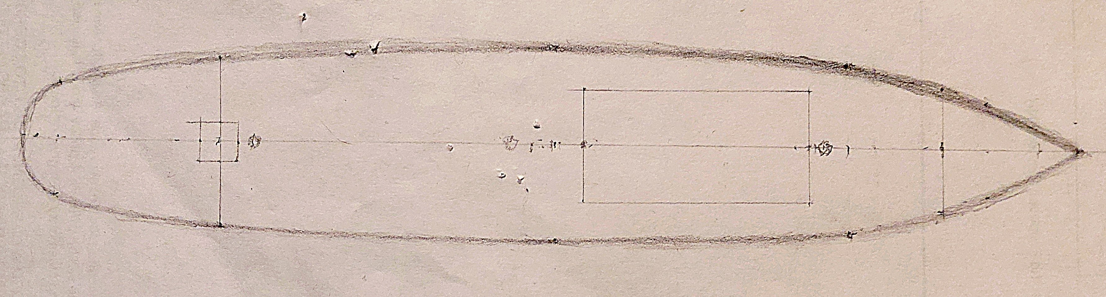

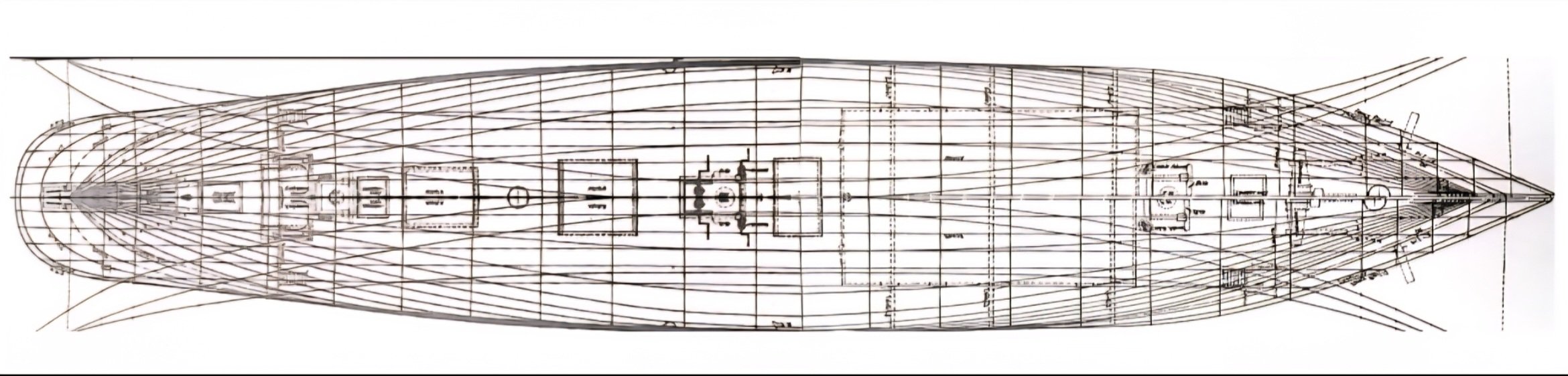

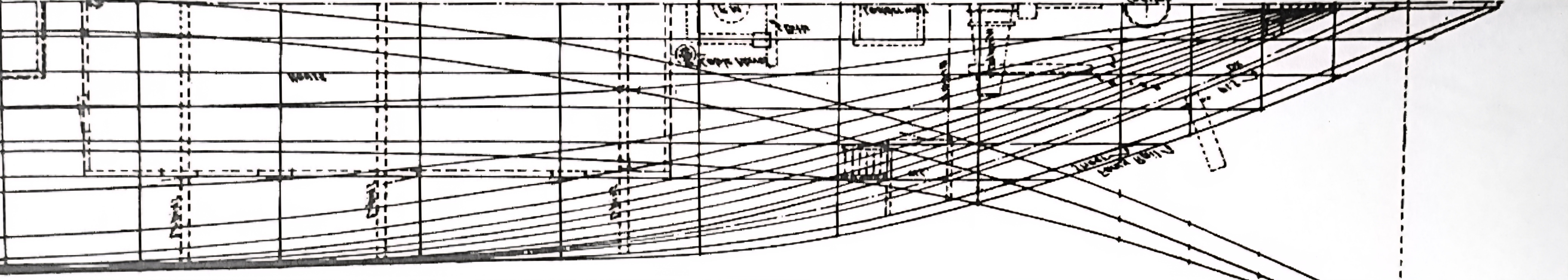

@rwiederrich Rob and @Luis FelipeLuis after our discussion about relative deck dimension issues, I used a photo app
On 5/23/2025 at 6:09 PM, rwiederrich said:
Set the house and deck furniture to see.
Rob

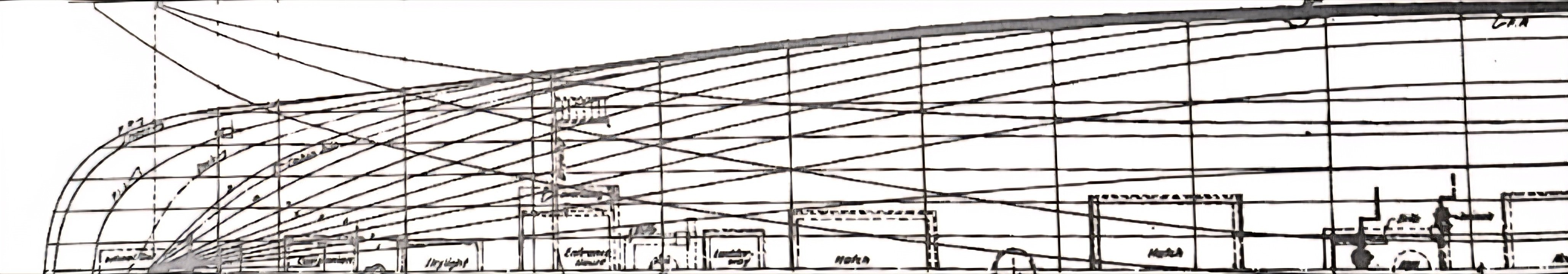

to realign the few deck sources available. Both the 1881 Hall and 1967 Chappelle copies we have were slightly out of true. I have corrected that as best as possible. The same process was applied to the sole deck image supplied by Luis. Finally, I've included my own beginning deck sketch. By comparing each of these, we can more accurately nail down this portion of Staghound.
Rich.   I’ve spent some time making similar half comparisons of the McKay half model.  And she produced a similar overhead profile as with your Champelle’ drawing. Compare the narrow aft section, aft of midship to Buttersworth’s painting of FC.   I know this painting is not just a characterization of the real ship.  I think it is a depiction of the actual narrow hull this model of clipper had.

@rwiederrich agreed Rob. These early vessels were definitely leaner and narrower. Still, with a maximum 40' beam Staghound was only 4' less wide than Glory of the Seas which also was 40' longer than Staghound. I immediately noticed that my initial attempt to match the Hull diagram is too stocky, while it appears at first glance that Luis' deck profile is just a bit narrow. I've shared these because by matching halves we can finally generate a whole profile. It appears like grid lines on both Hall and Chappelle are 10 scale feet apart. My next step will be to combine these pieces to create wholes and then get those precise dimensions.

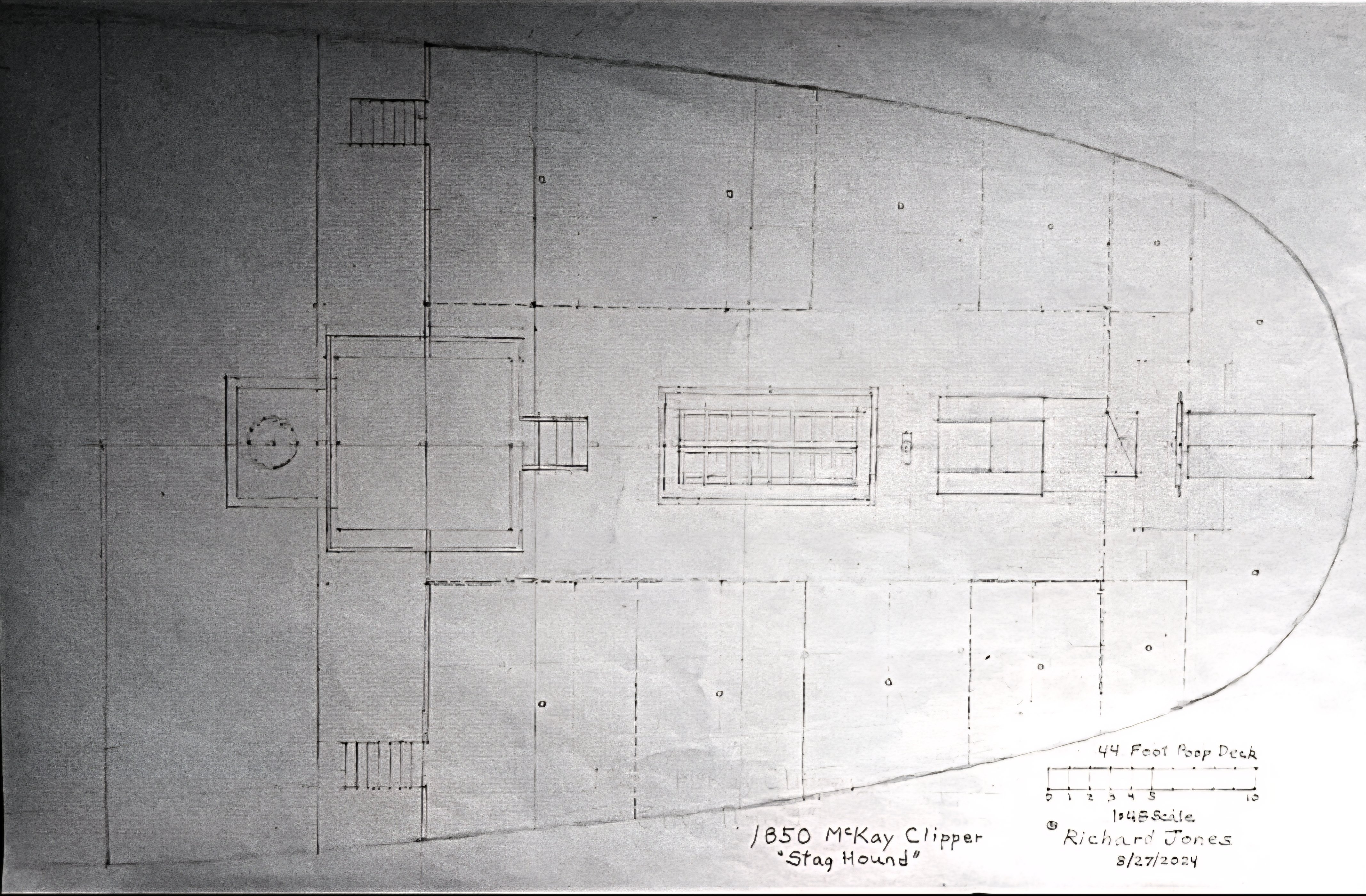

I began to scale out your drawing, and at amidship you have her 40ft...if this is the measuring stick then, your poop deck length is also 40ft...4 ft short.  Placing her sternpost 7ft inboard of her taffrail, we can see that you correctly made her 24.6ft at 8ft.  Personally, I think her lines are sharper...and if you draw from her widest point amidship back toward her narrowest (24.6ft)..you will have that, "Smallness of her stern" idea, McLean describes.  She is also, "Uncommonly sharp forward".  Again, looking at Butterworth's painting, we can clearly see the almost exaggerated narrowness of the vessel, once you establish her greatest breadth amidship. Butterworth, painted Glory of the Seas, and he is very accurate and paid close attention to dimensional accuracy. No reason why we can't continue to trust his perceptions.
Rob
Rob
@rwiederrich Rob, as I mentioned, that deck sketch is a preliminary effort. To fit onto an 11" space I used 1cm to be 10'. Working at such a tiny scale made it very difficult to be fully accurate. However, my 8/27/2024 poop deck sketch is correctly scaled at 1:48th. As for Buttersworth, he did magnificent Staghound, Flying Fish, Sovereign of the Seas & Great Republic works. I don't recall him doing a piece on Glory of the Seas however. You might be thinking of Samuel Walters for that one.

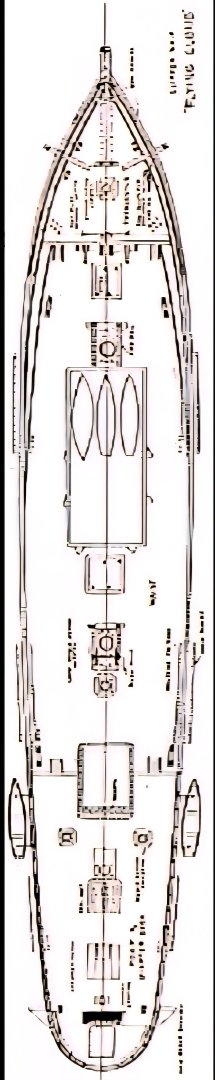

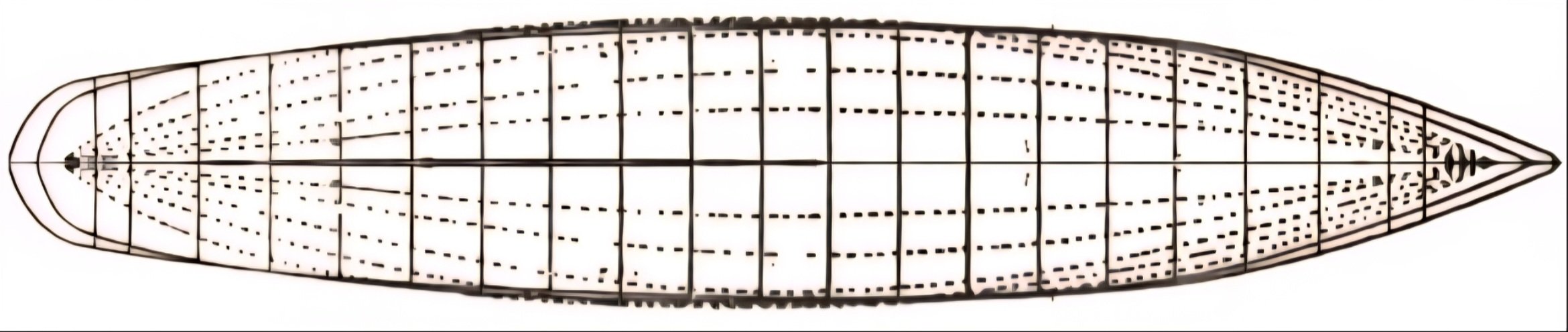

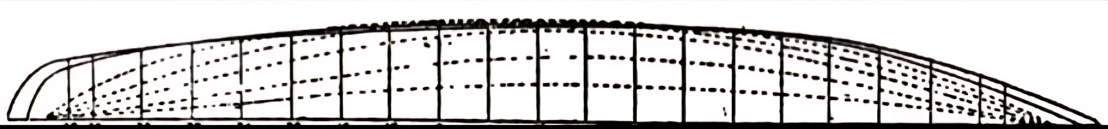

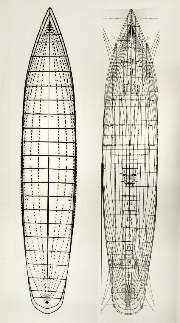

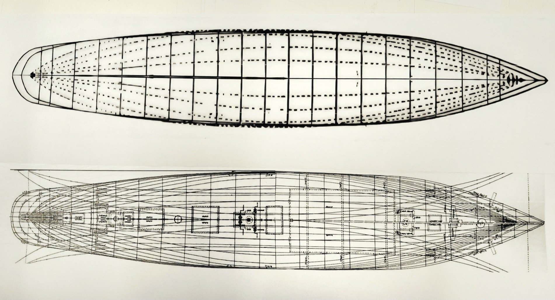

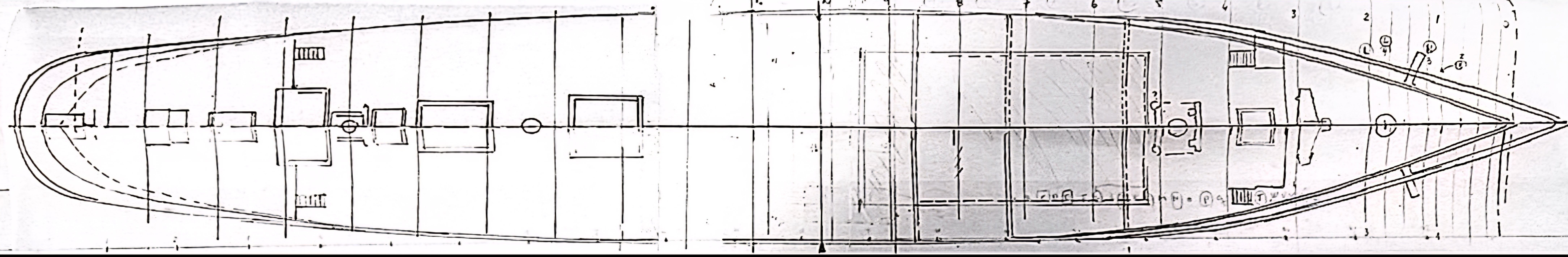

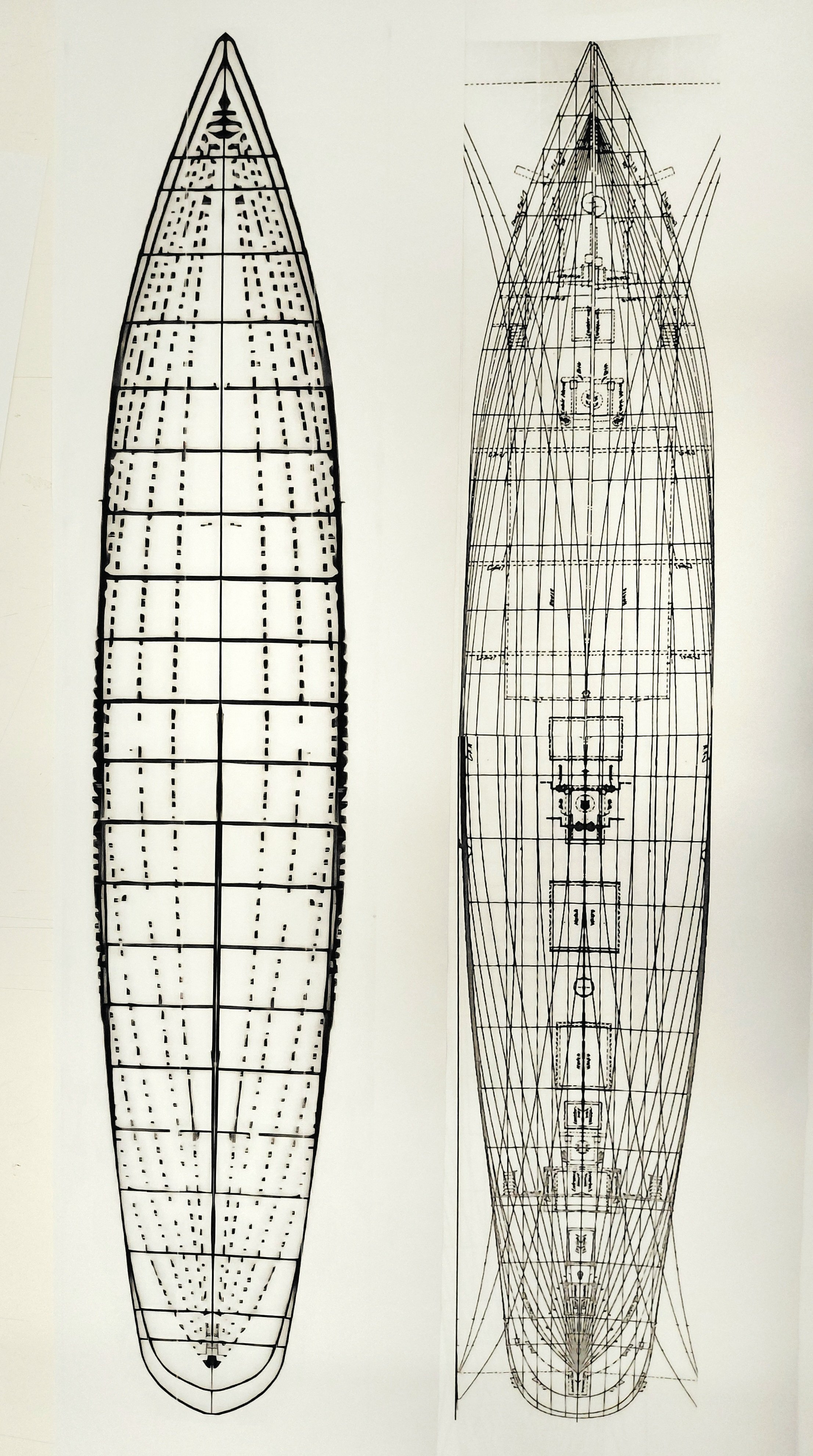

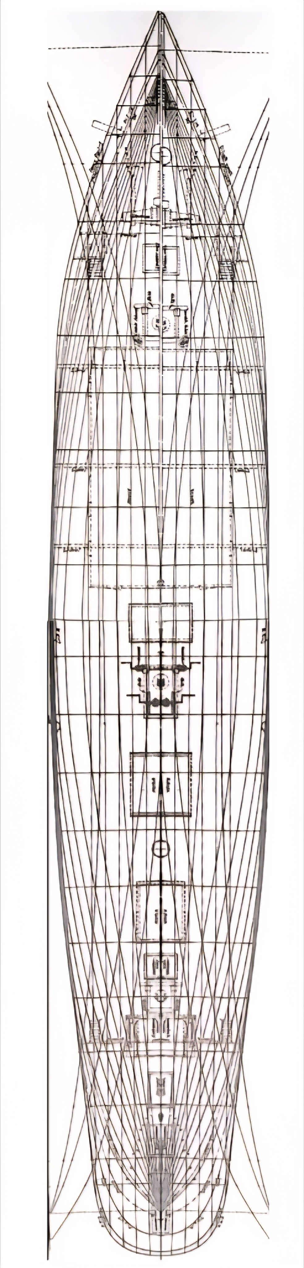

Rob, If you don't realize it by now, I border on anally retentive, obsessive-compulsive when it comes to wanting to make sure everything's perfectly accurate. Makes for great, meticulously accurate plans but it probably explains why it's been decades since I've built anything myself. You're the veteran modeler with 50 years' experience, I'm sure you'll make it work.

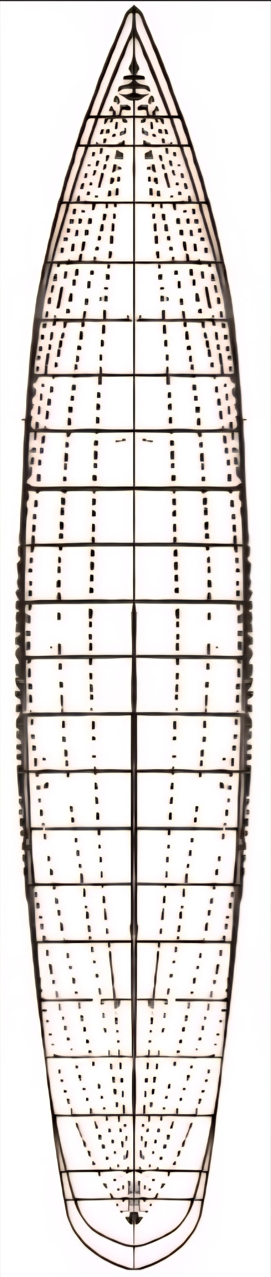

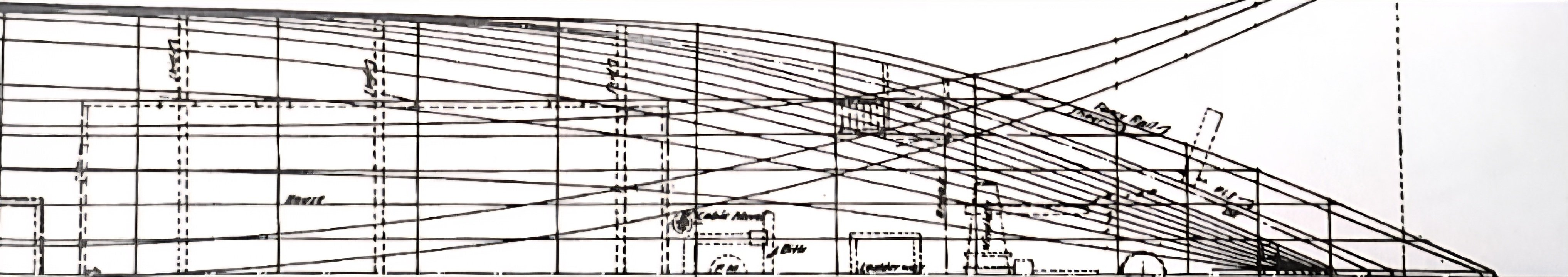

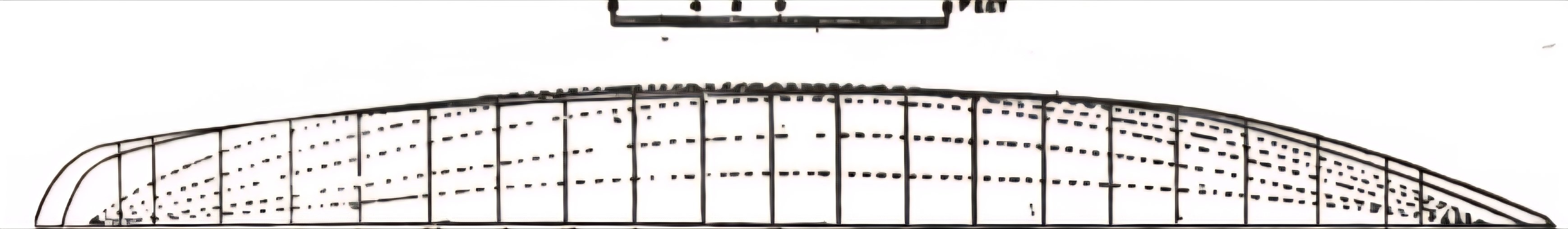

For the next step in ensuring accuracy of the Staghound deck, Dan at my local Staples digitally matched both 1881 Hall diagram halves and all four 1967 Chappelle sections to create two equal 1:96th scale 28" enlargements. Hall is on left in vertical image, Chappelle on right. And Hall is on top while Chappelle is on bottom in the horizontal one. Despite the odd somewhat pointy stern which doesn't match McLean's description at all, the Hall profile is the more graceful. Meanwhile, Chappelle offers a good deck layout, other than the inaccurate forecastle arrangement.

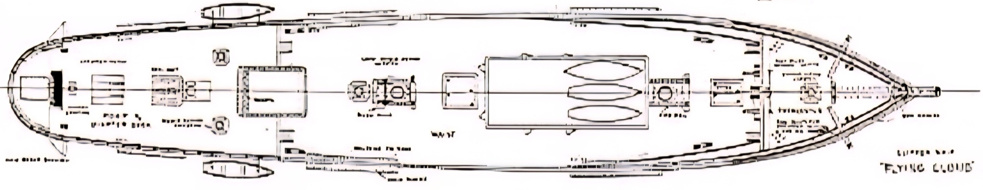

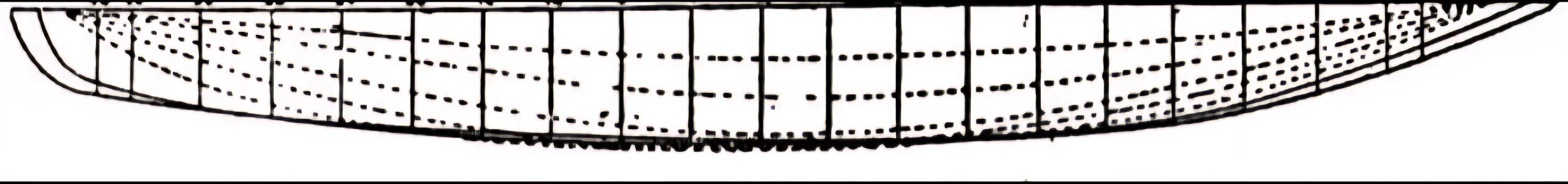

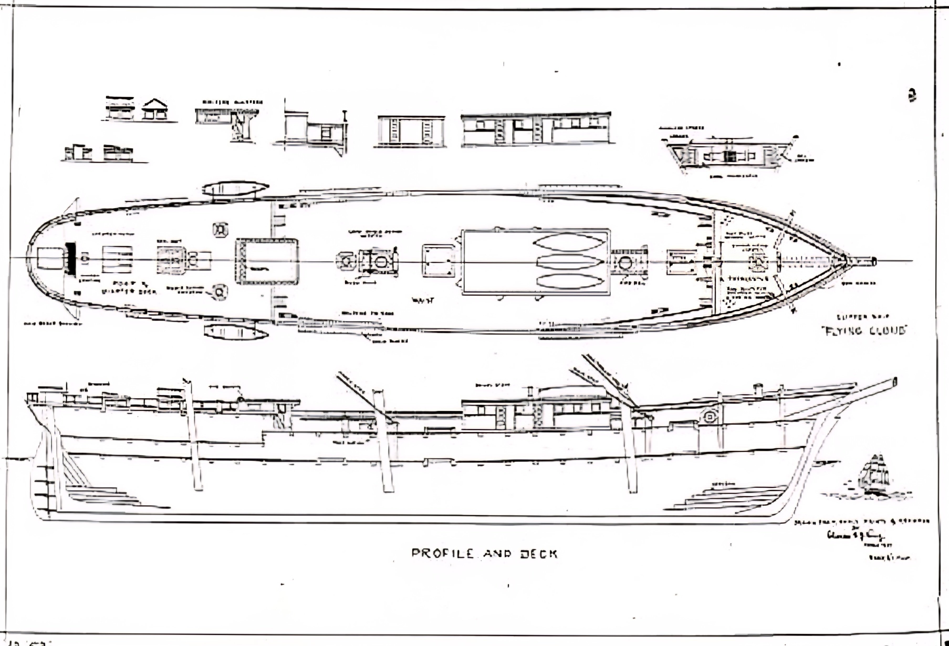

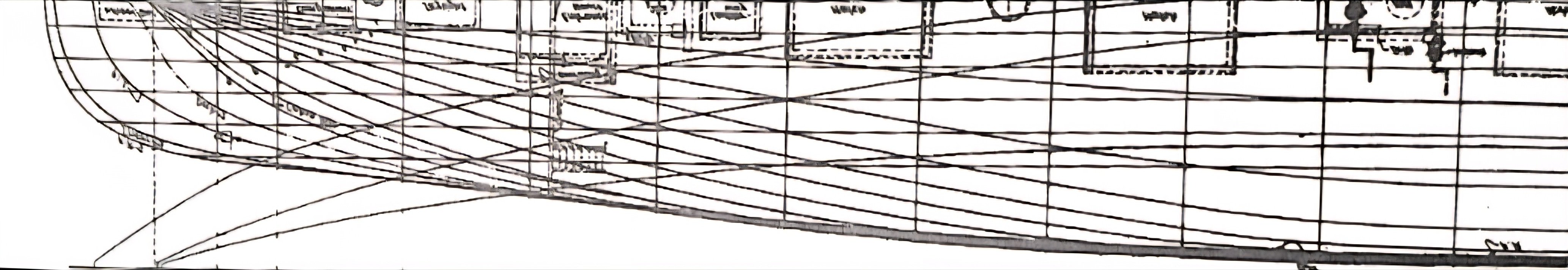

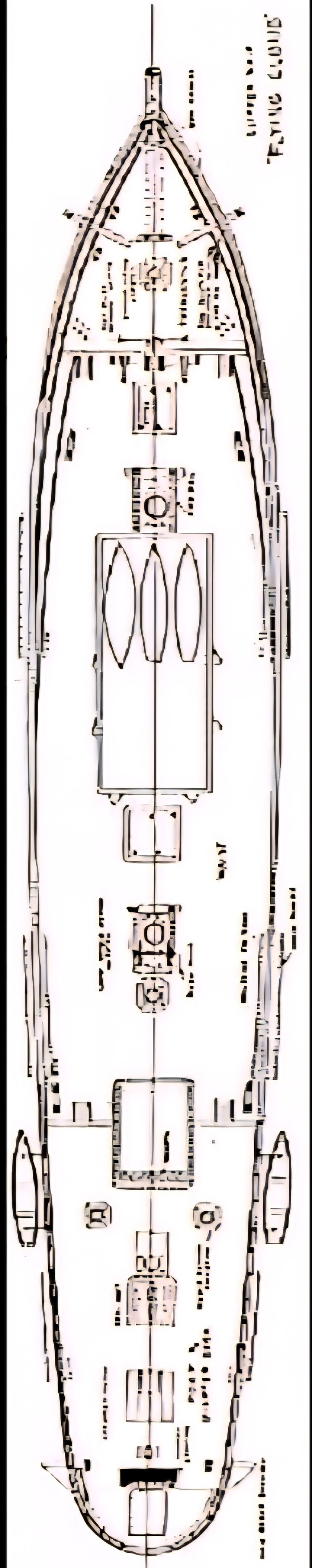

As a way of evaluating Donald McKay's continuing nautical design evolution in his developing pursuit of the fastest hull, here are 1928 Flying Cloud plans. Besides dropping her angle at half-floor 10° it's clear that he widened her overall profile. In fact, it's quite likely that Staghound was McKay's slimmest, most aggressive vessel of his entire California clipper fleet.Screenshot_20250530_101718_Gallery.thumb.jpg.608987377a807cb8f83f8d3a420aea8a.jpg
Edited by ClipperFan
added info
I remember reading that Staghound was  McKay’s only true “extreme “ clipper.   From her came fuller designs.
Rob
